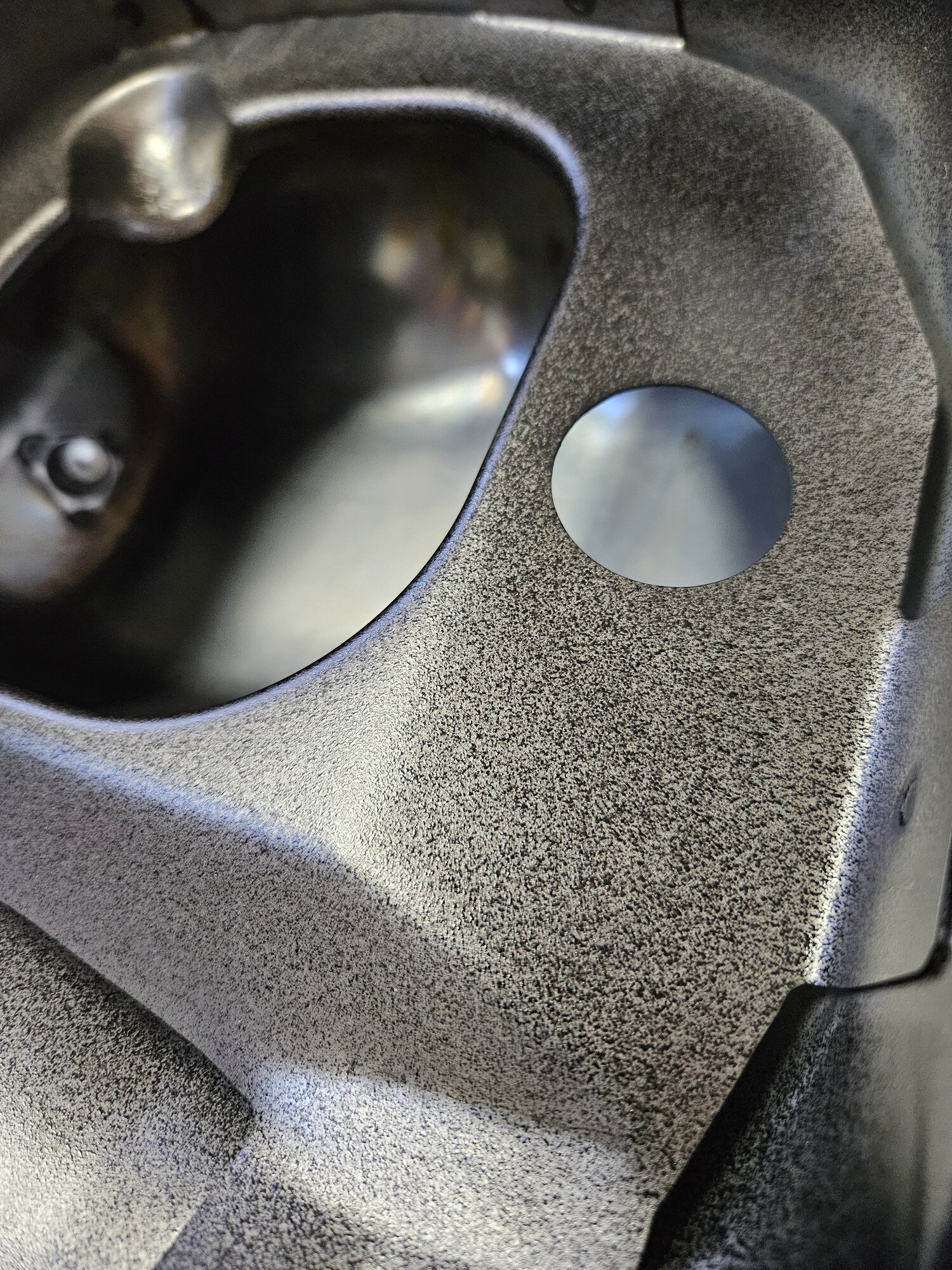

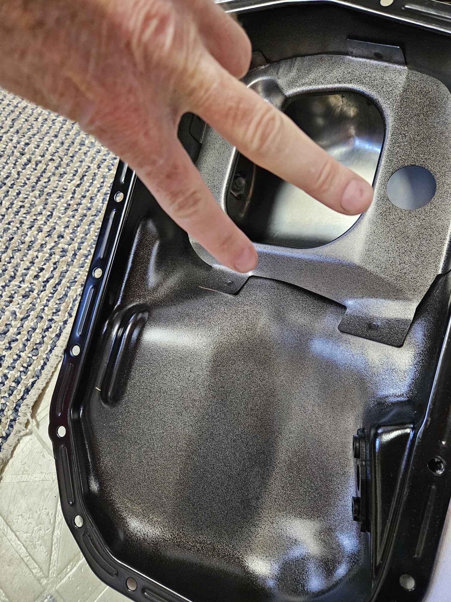

This shit....it feels solid now but I bet it does breakdown. I haven't pulled the pan on my other 6 bolt to investigate it's issue but this is the same pan as you have. I'll be looking at the pan to see if it still has overspray on it.

So, a lot less large metal shit in it, a little bit of black flecks. Still convinced that's from the overspray on the pan.

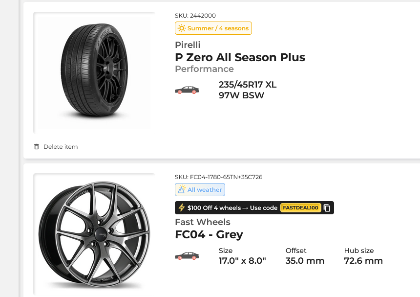

h) fine some new wheels + tires. I like the evo x bbs look but they're too big, leave too little sidewall, and 245s are just too fat for me. 235s in a 17 is where I want to be.
in 400km I don't appear to be burning oil as the level hasnt changed. i've been running right above full due to the larger oil cooler capacity and so much of that that disappears the moment it's running (and then comes right back after sitting) so I should be ok with drainage still.
I was going to go with a new, quieter chambered muffler but now that I just realized I can hear my turbo spool down, I don't know if i want to give that up... it definitely helps announce your presence rolling up to a light :p
Also, to anyone installing a 6851S/68HTA v3 using ARP turbo bolts, the front driver side hole in their turbine housing isn't deep enough to fully seat the bolt, at least when using the Evo3 manifold. You'll need to double washer it.
Considering pairing these together (with hub centric rings, obviously)
Right now, I have Evo X BBSs (18x8.5 ET38) with 245/40/18 but the tires need replacement and all four were curb rashed pretty good from the previous owner.
I'd go 225 with 17x7.5+40 or something similar but I like this style, reminiscent still of the BBS wheels.

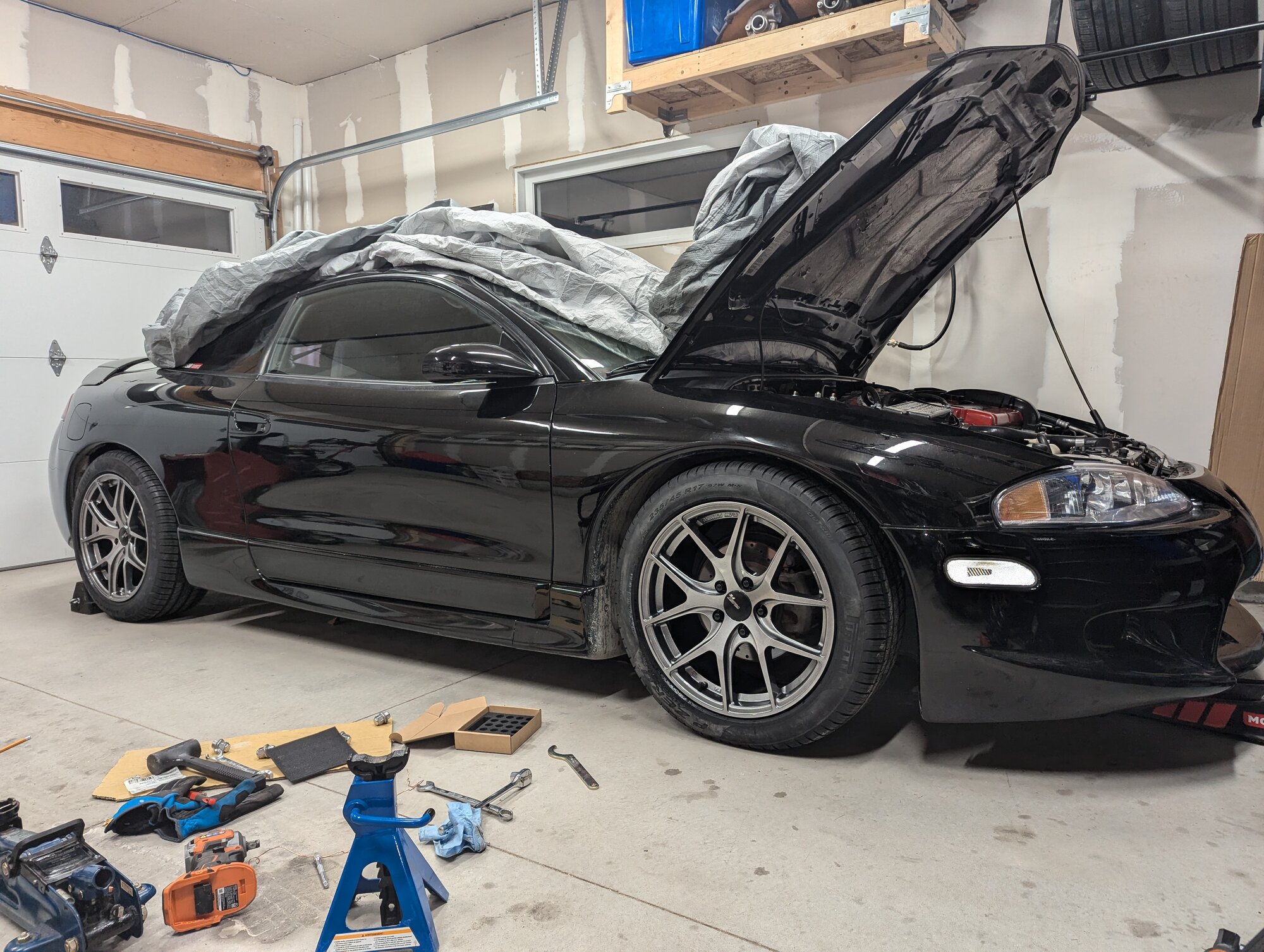

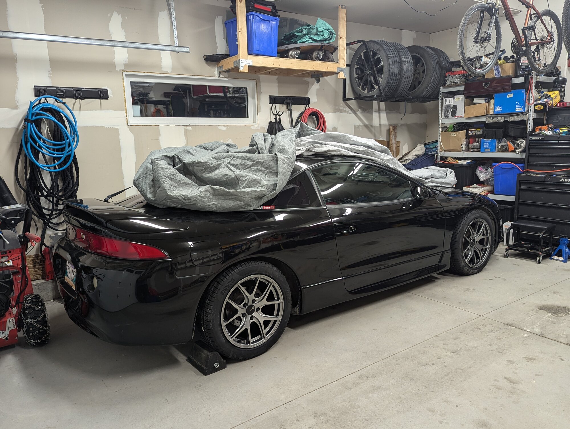

New wheels and tires and some "good enough for boostin around town" coilovers later and it's sitting pretty nice.
I might have to raise the rear end a quarter inch for balance, though.
Shes sittin pretty :) Love that the wheels have a darker tint to them instead of the typical alloy silver. I mustve missed it somewhere but what coilovers did you end up going with?
Just a set of Yonakas.
I'm coming from AGXs with already used H&R Sport springs meant for a FWD, so this is still an upgrade. Rear end squat trimmed my tires but those are 15 years old and I'm trying to unload the BBSs anyway.
I am ok with going entry level at the start, see how they work. They aren't adjustable so besides preload they are what they are.. maybe they are enough for my needs. If not, I know I have other options.
They're not great but they're not too bad. Unfortunately their bushing is sized too small for the post so I had to open them up with a drum sander a bit. About 0.2mm but it mattered -- otherwise it would seize on the post and you can't get it off. Hell you couldn't even get it on without pressing it. Dumb.

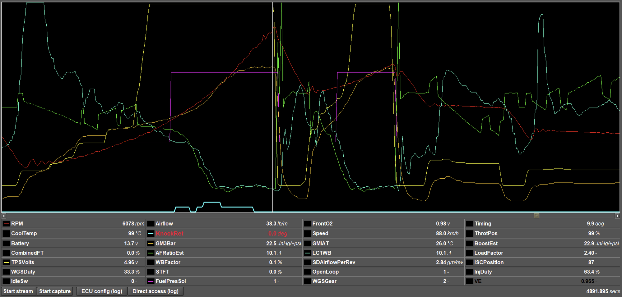

BoostEst and AFRs are pretty damn close. The car can move ok but I was expecting a bit better of spool response with the 8.5:1. It even sounds like I'm surging it hard down (ffFFFFFFFFFFFFPFPFPFPFPFPFP) but I don't understand how. Or maybe that's just the sound my intake makes -- 8" cone on a 4" S-pipe with an appropriate reducer. Perhaps very turbulent flow.
