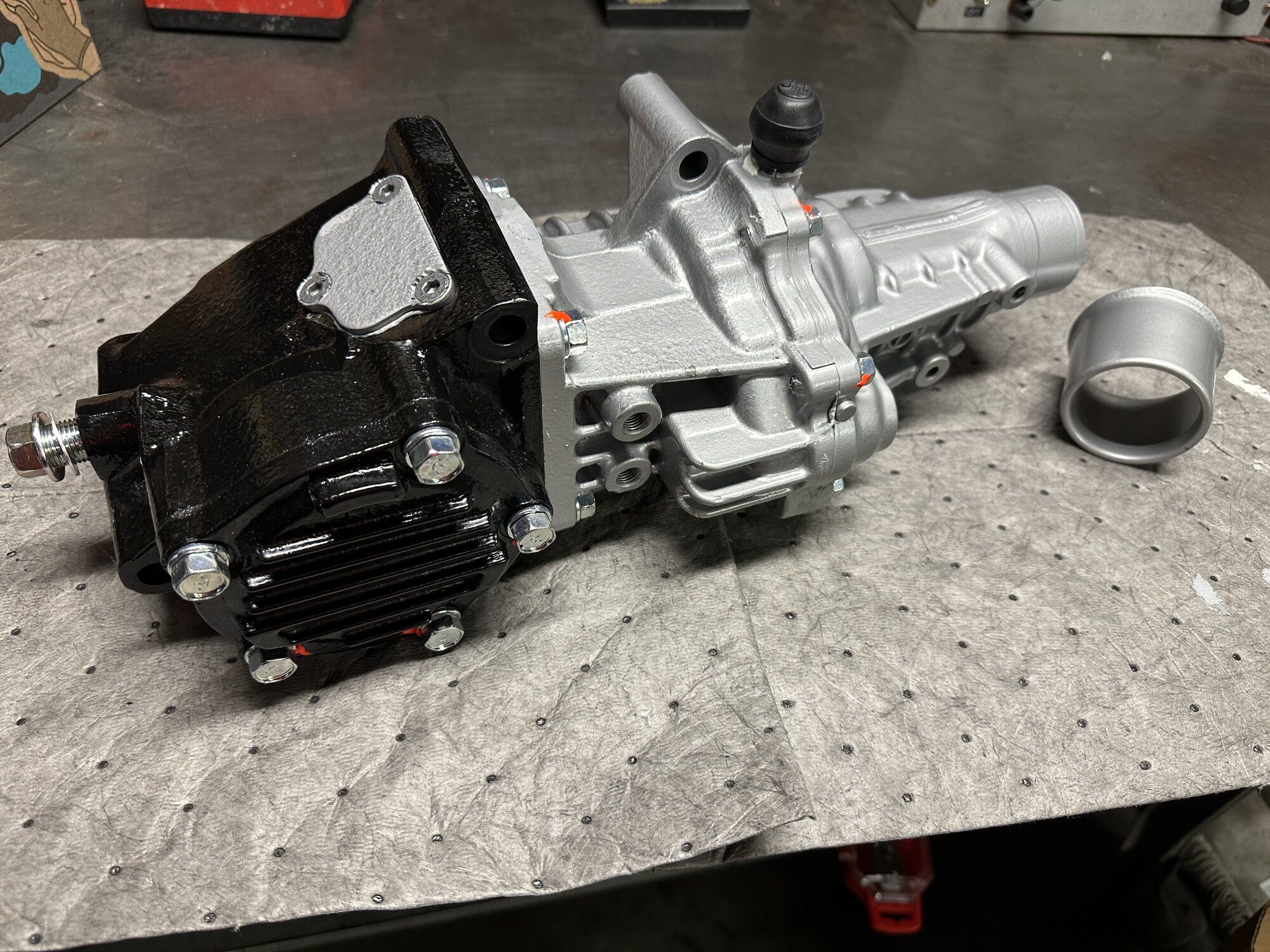

So for the tail housing section, I used the oem sealant recommended in the rebuild manual. The center and forward housings actually go together with no sealant OR gasket. There is a shim used for setting the contact pattern and back lash but that is it. Where are you trying to place a gasket and where would you even GET a gasket for it??? The o-ring is what will keep the cases from leaking.
For the cover plate, not any of the assemblies. #2 in that diagram
Ohhh, the inspection cover... yeah that gasket is actually discontinued, so I ONLY used the oem sealant listed to use. Just used more than usual and made sure to get it all the way to the edge.
