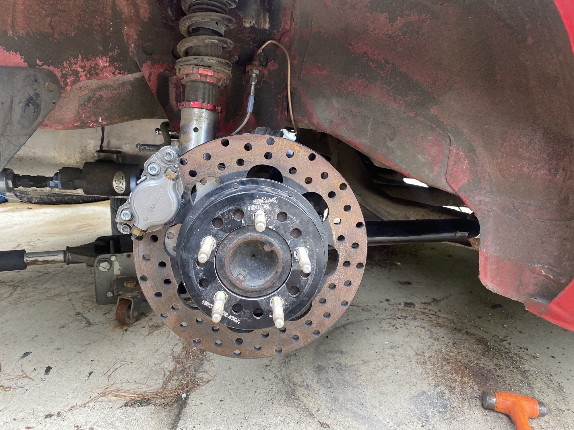

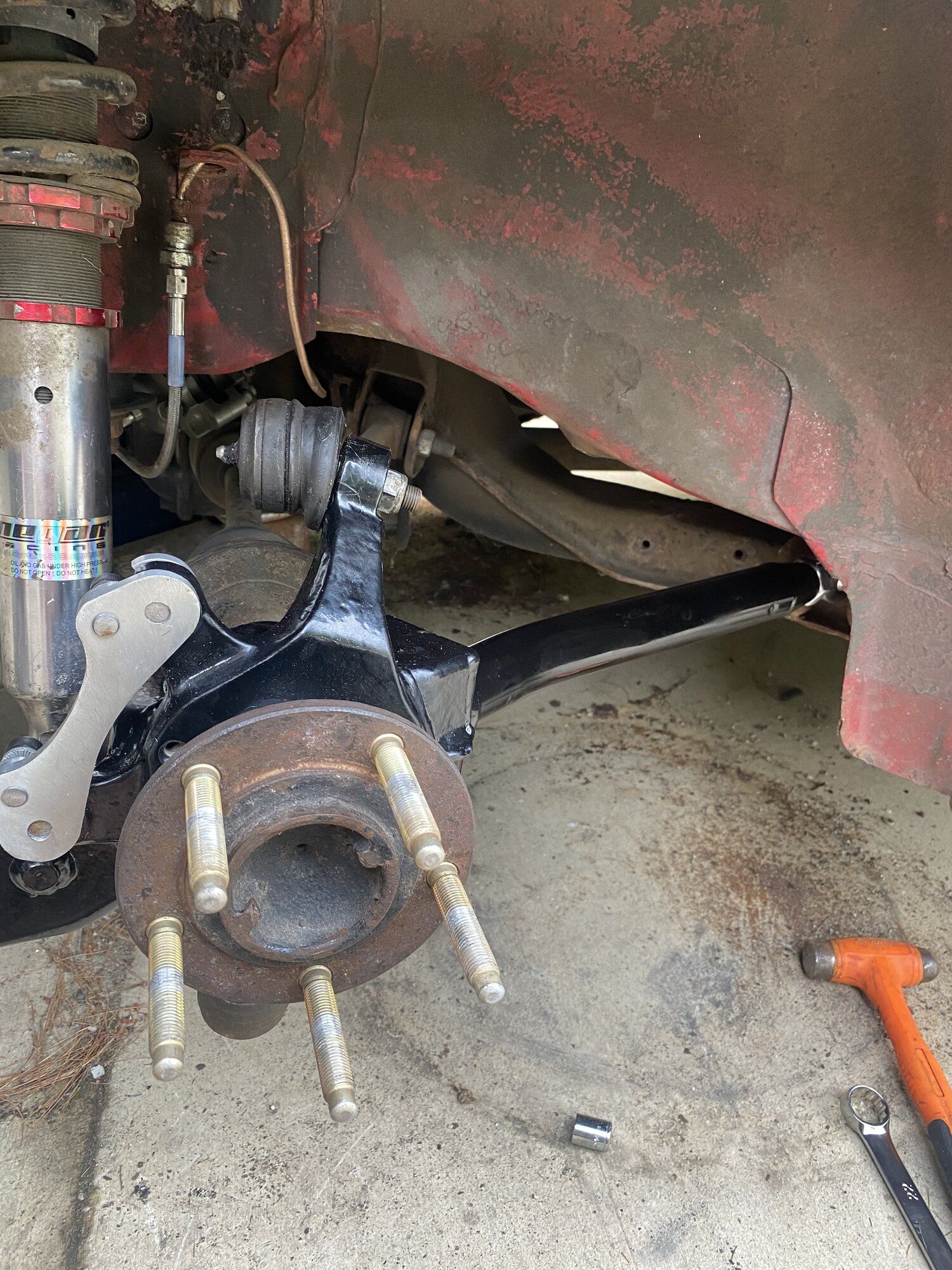

Ran into a couple snags though… can’t find the bolts for the axles and I need to lug nuts for the 18s so I can bolt them down. Already ordered new bolts from extremepsi. Just got to figure out lug nuts. Super easy install otherwise.

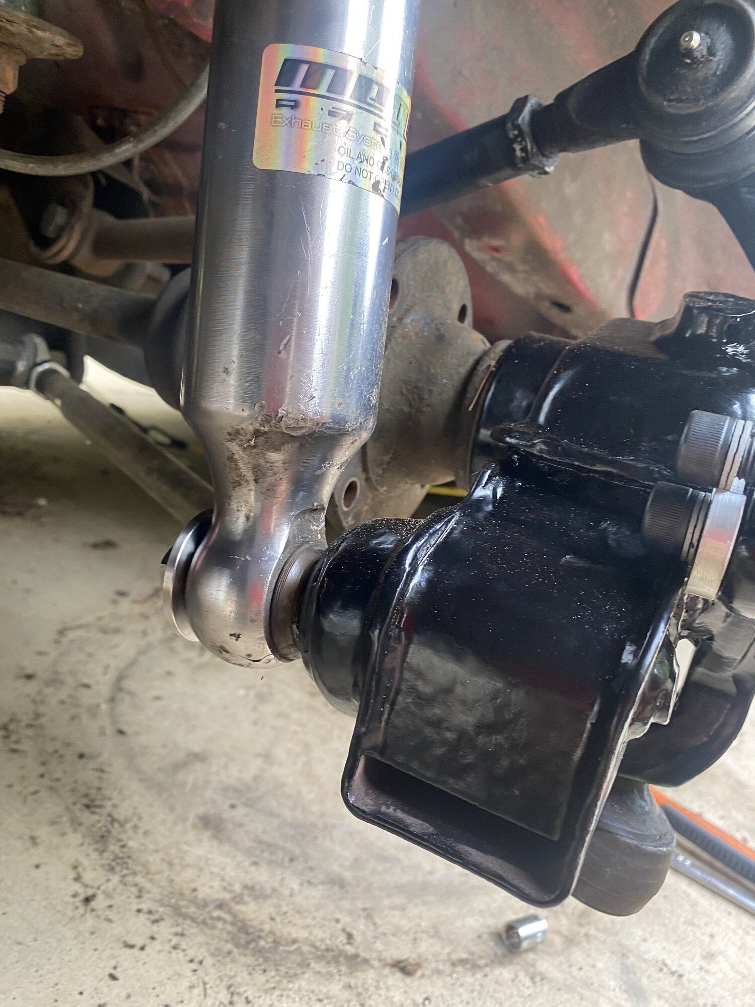

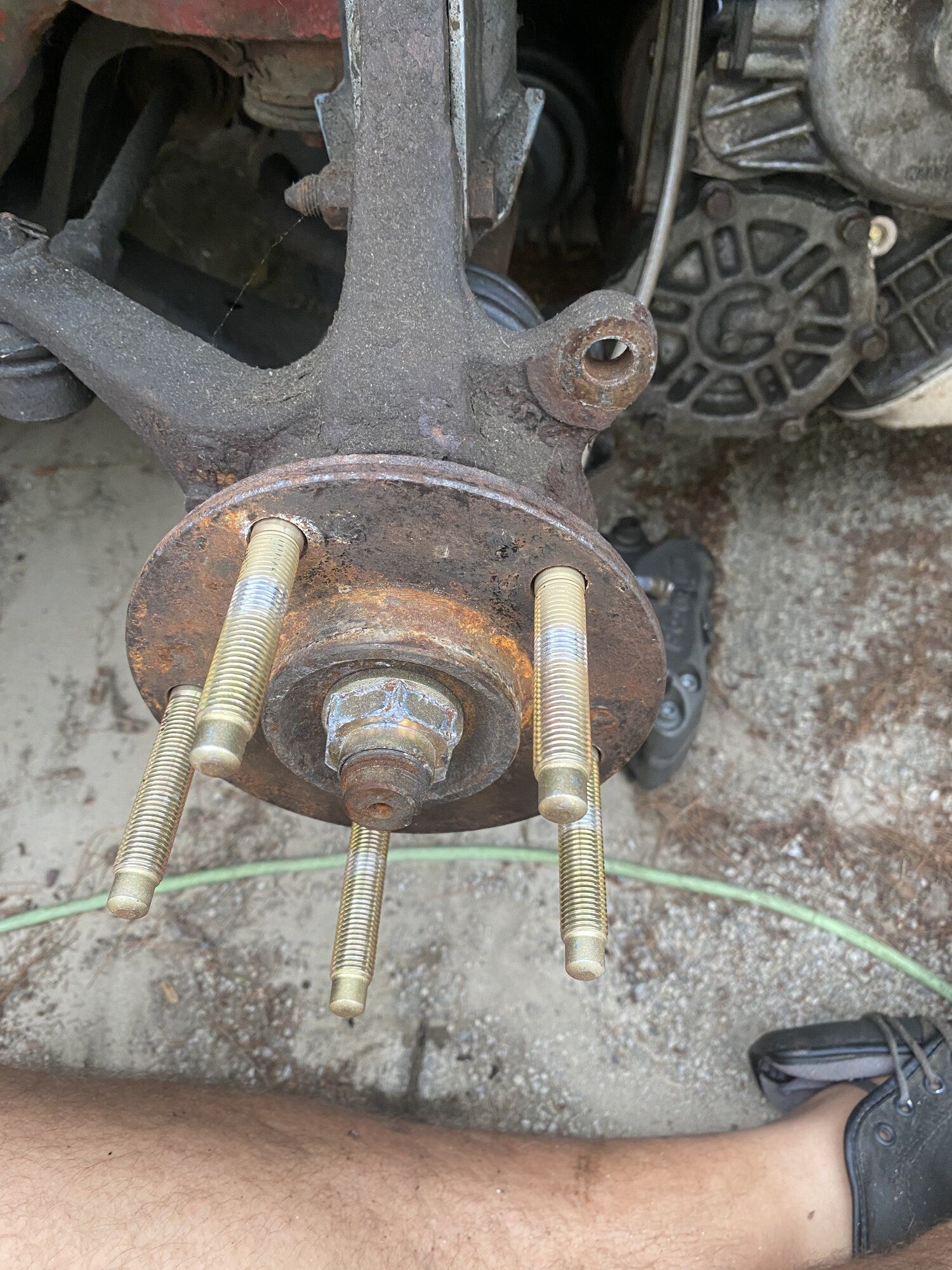

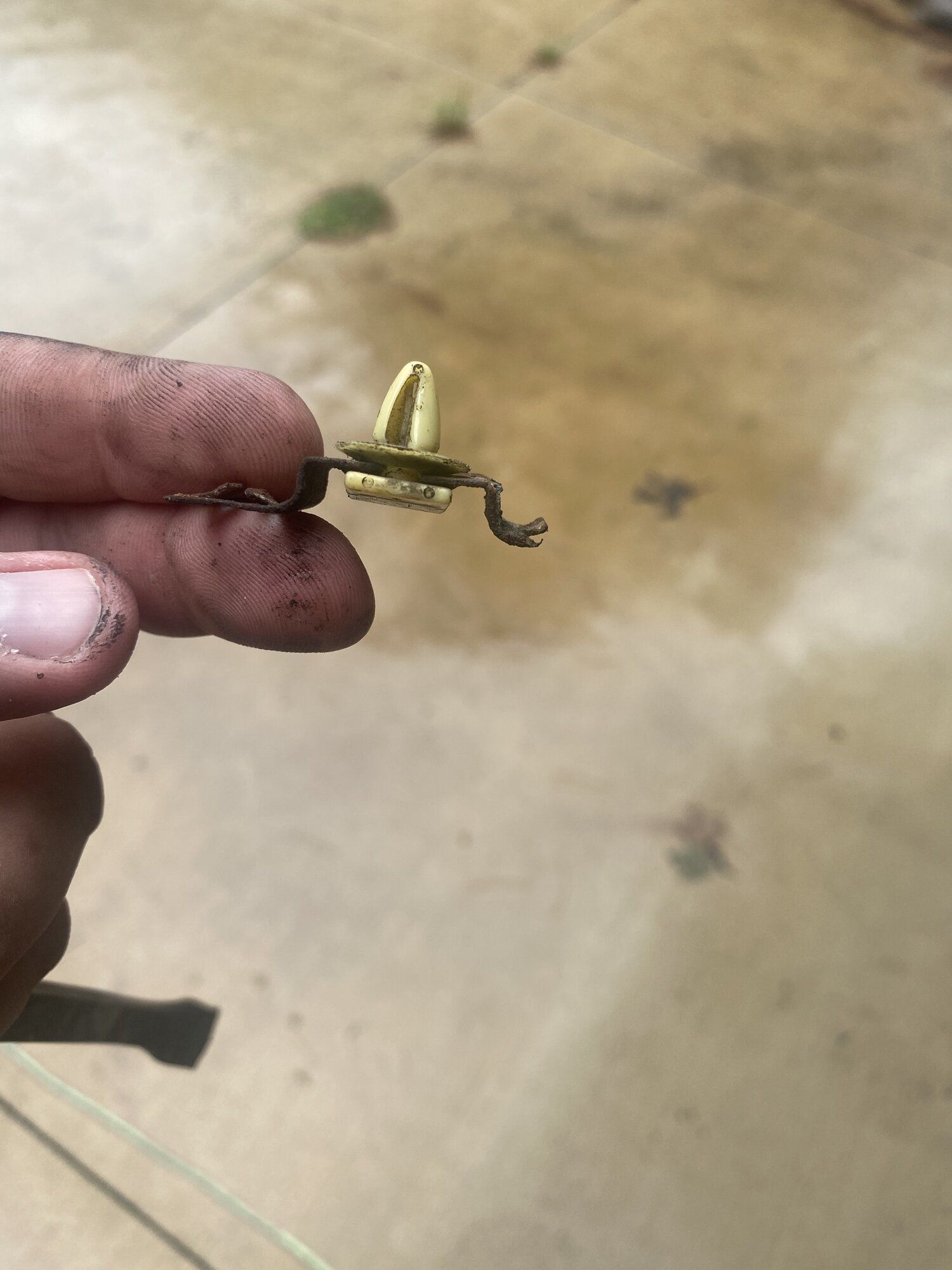

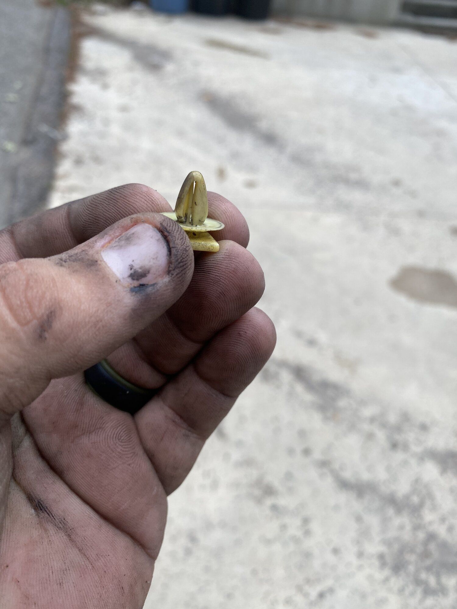

Axle bolts came in and got those installed. Also started working on getting the front wheel studs in. Ran into a little hiccup when opening the drivers door. One of the body molding clips mounts broke and let the molding catch the door on the fender pushing it in. On the hunt to find replacements for those
Back on her feet.
Was told the front studs would be the hardest. These were easier than the rears were.

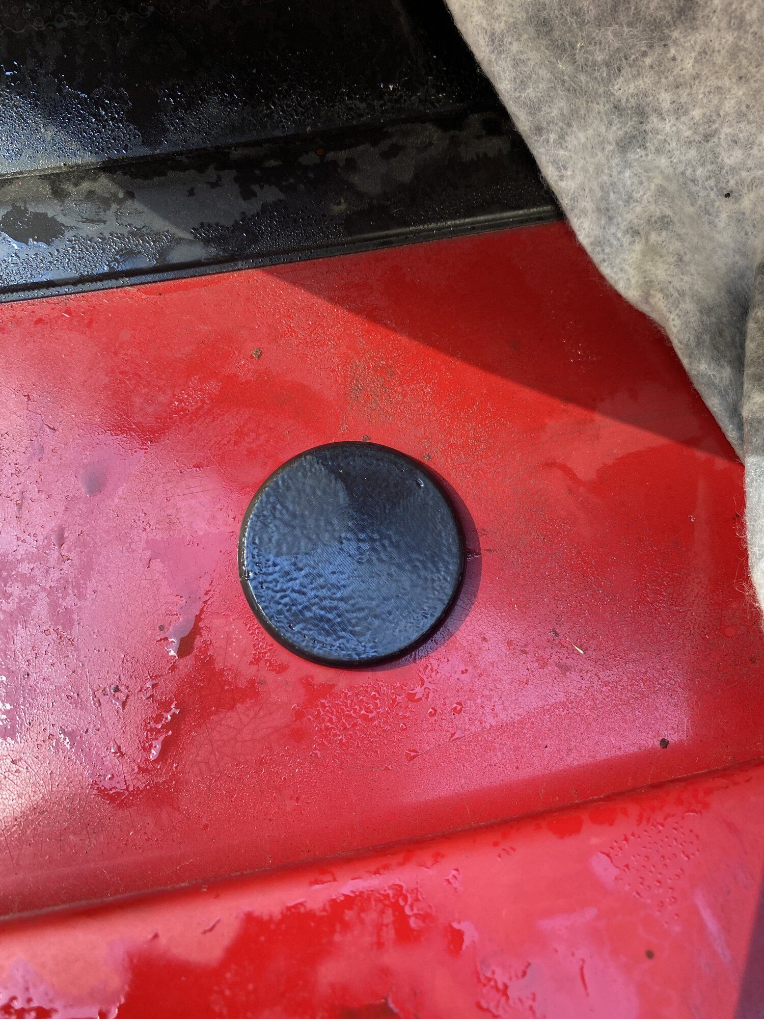

Got to find some Of these guys.

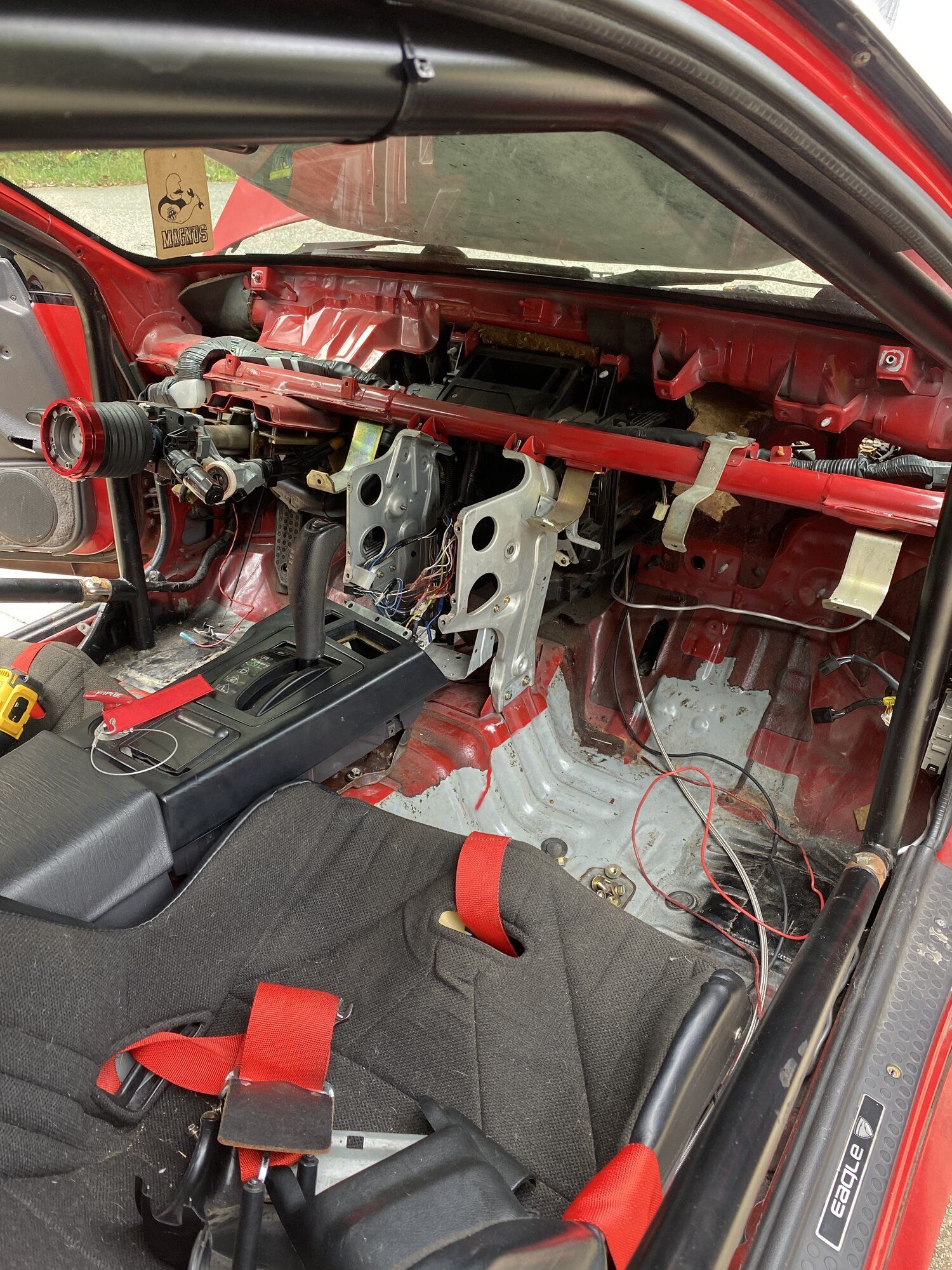

Ready to see it back out. Hoping to have the engine harness in the car by the end of the month and starting the wiring.

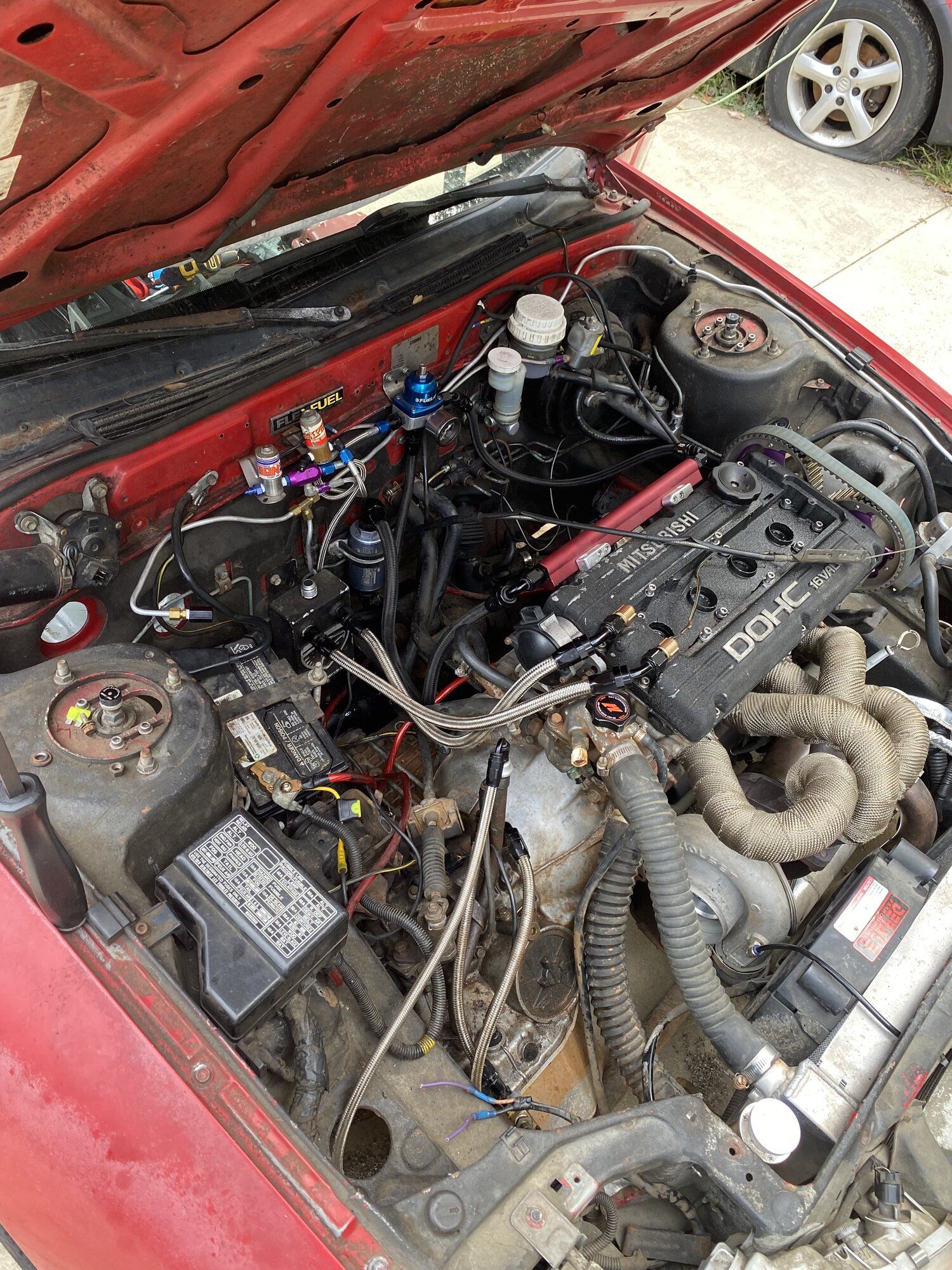

So I guess I’ll toss some progress pics up of what I have so far:

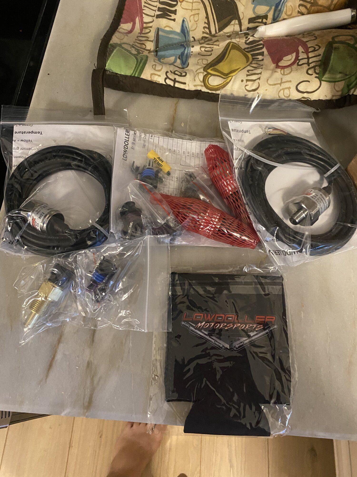

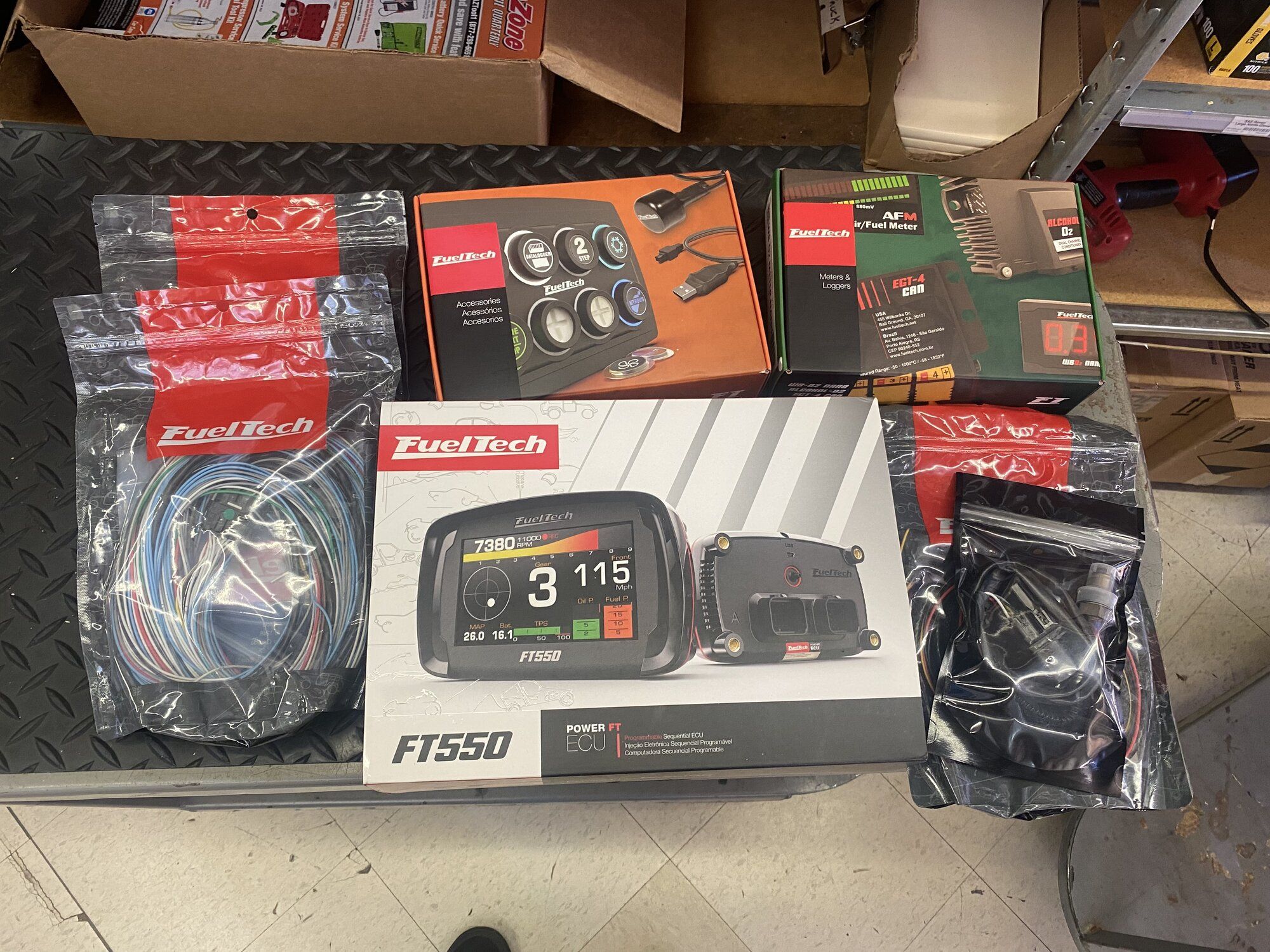

So I was having some electrical issues once I got the suspension back together. I checked everything and seemed to be ignition box related. So instead of dwelling on it I pulled the trigger on the fueltech stuff. Started by acquiring sensors and connectors to get the wiring started.

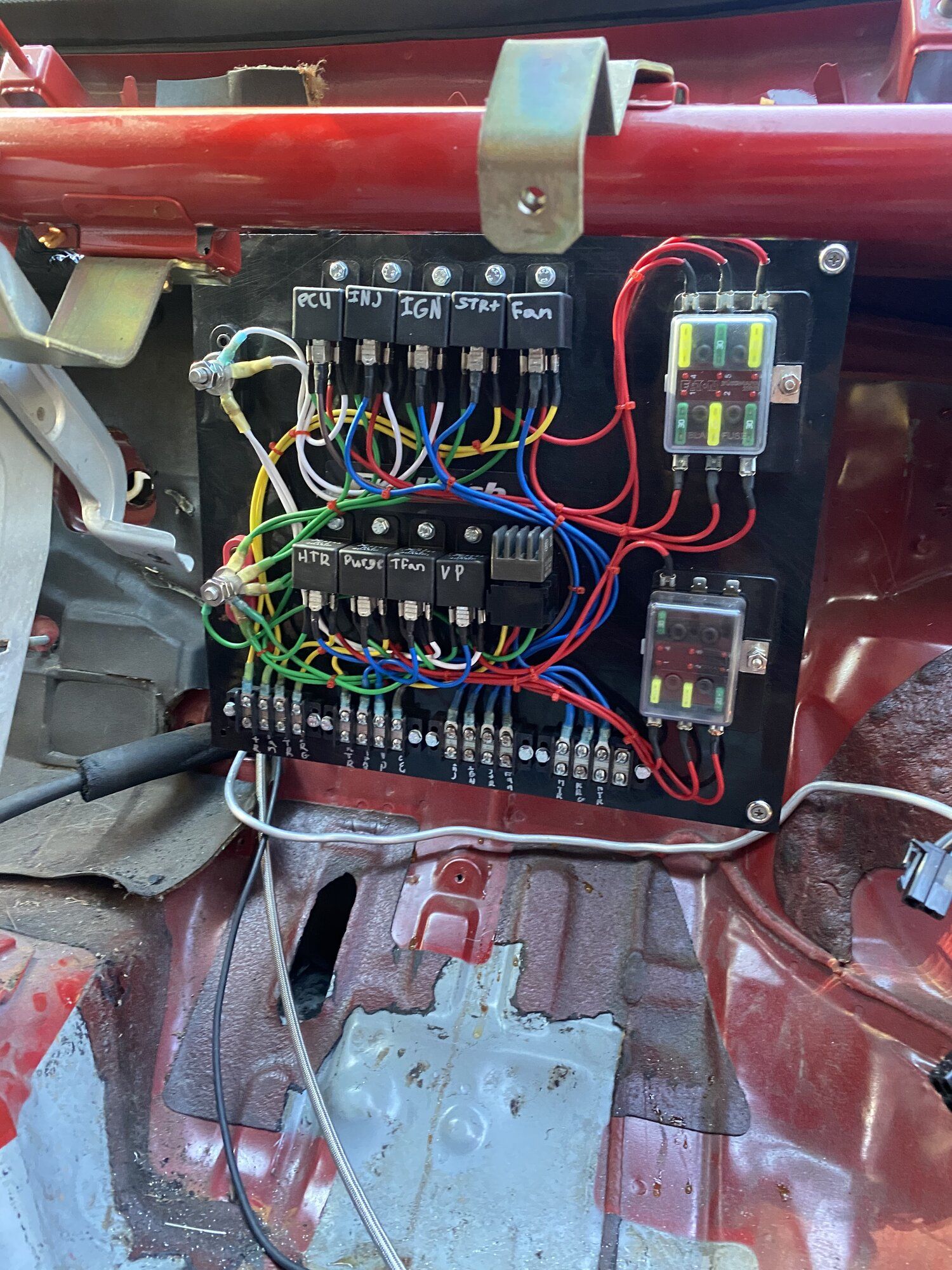

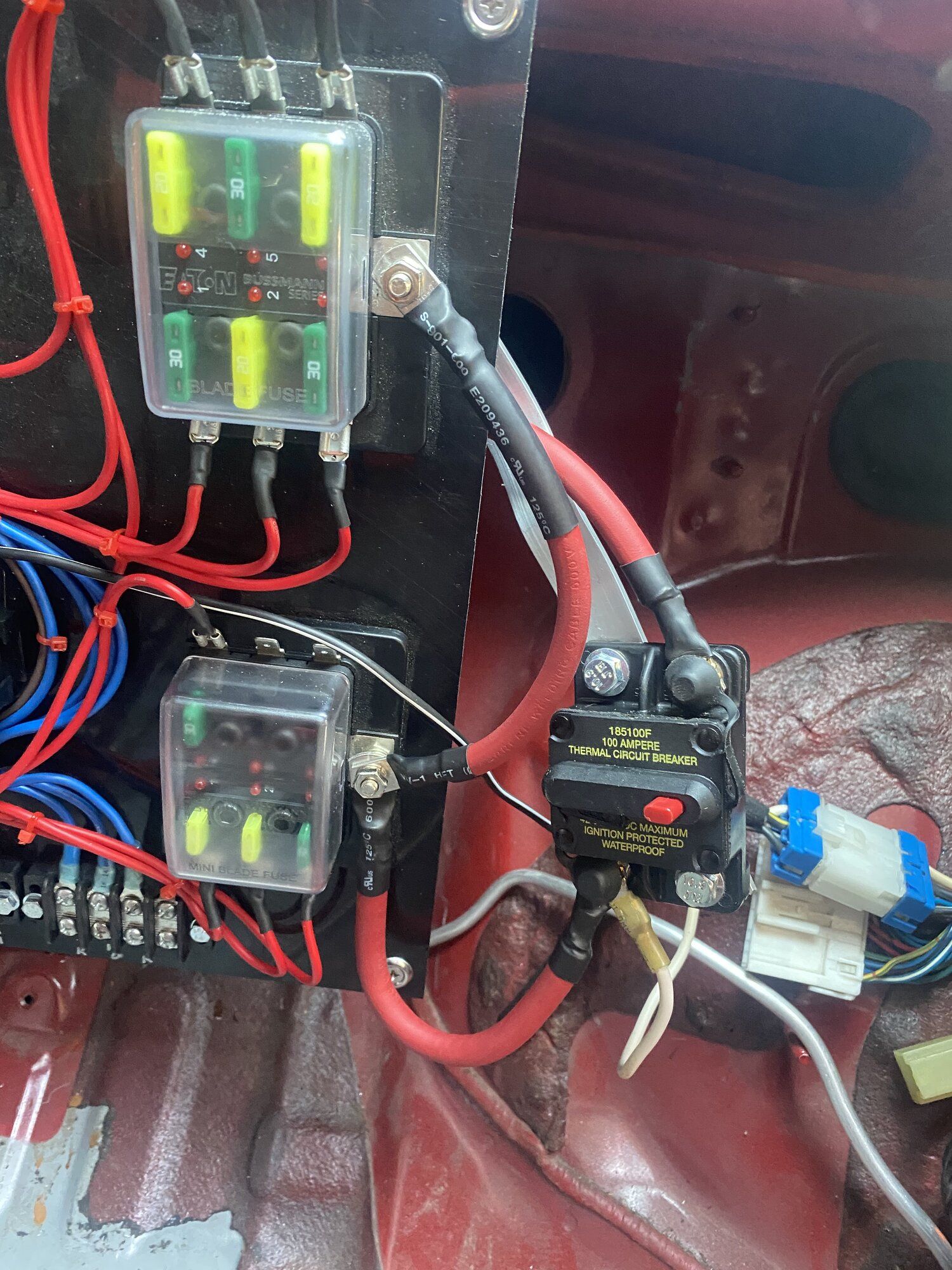

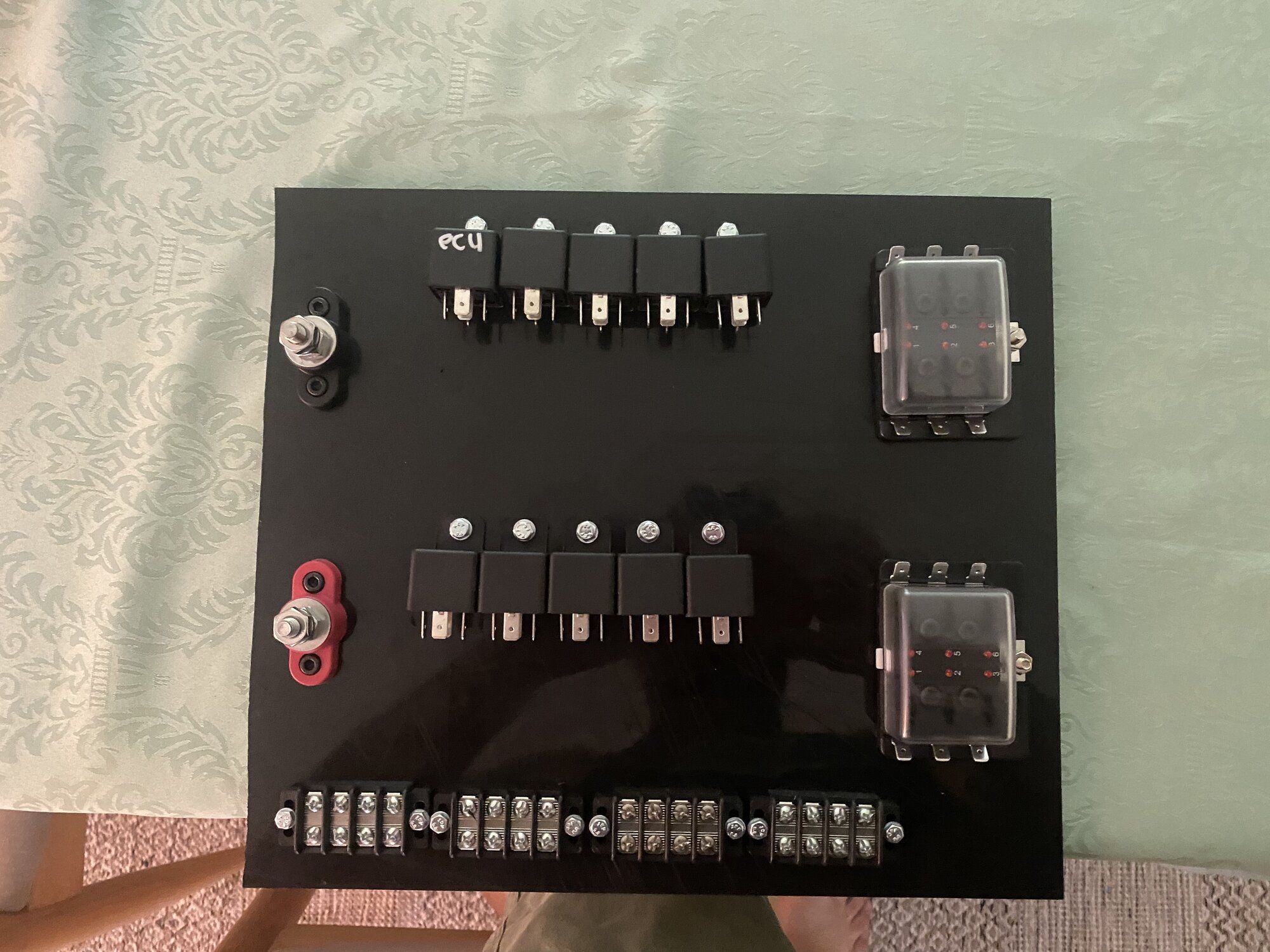

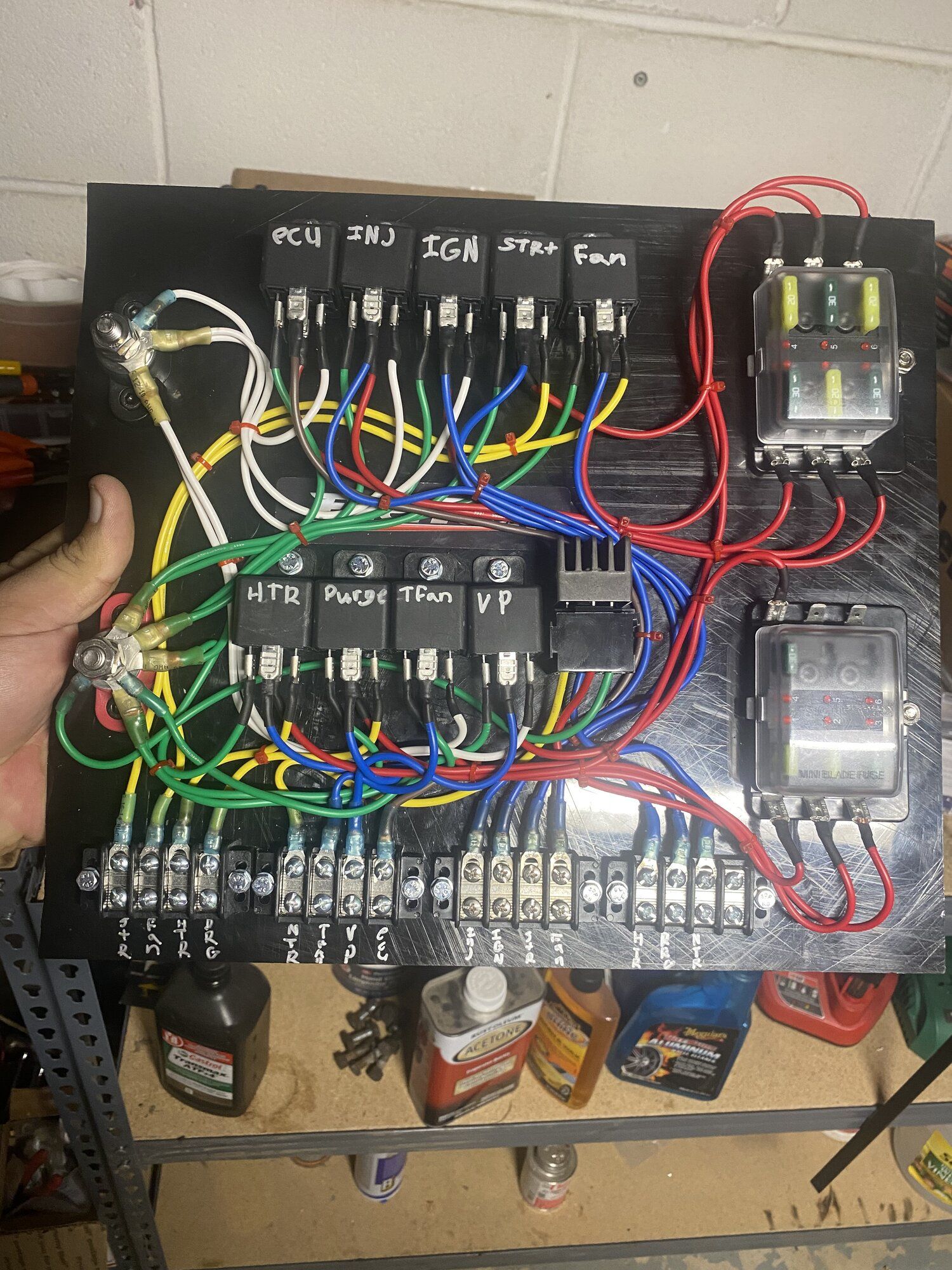

Then decided I was building a full relay board to power everything

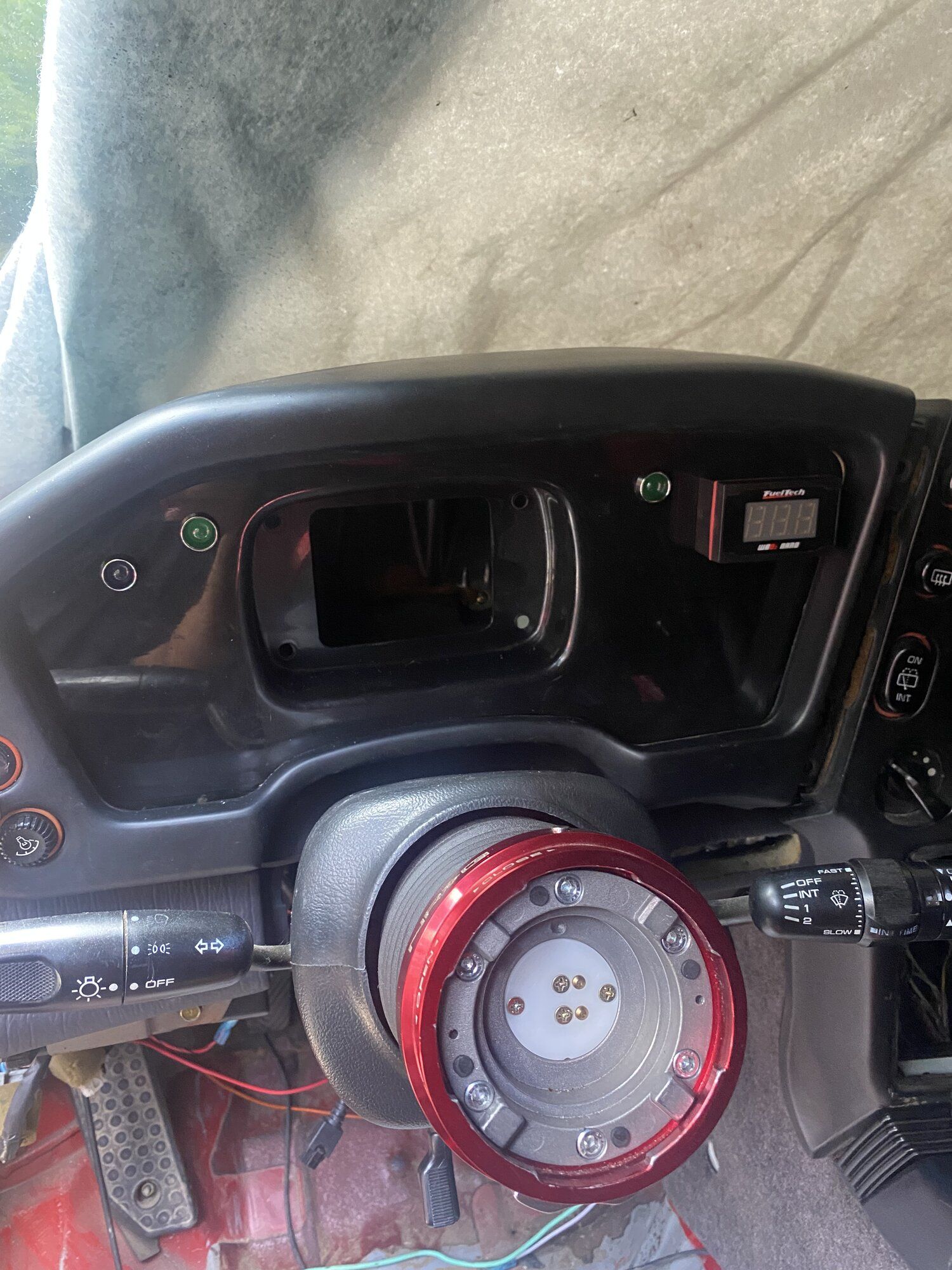

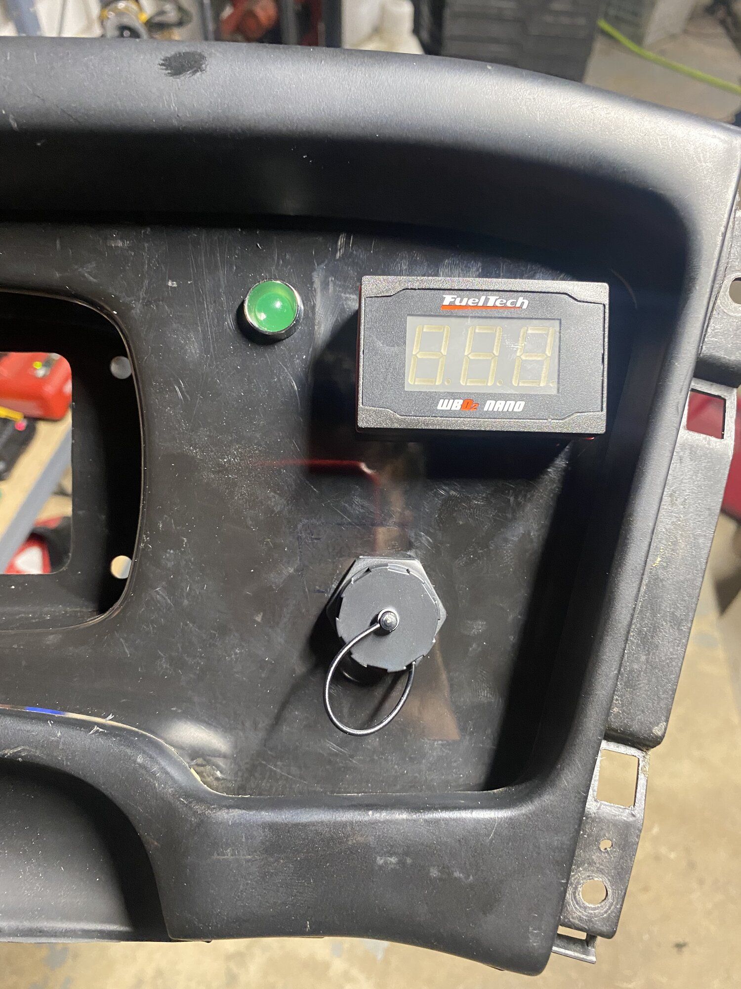

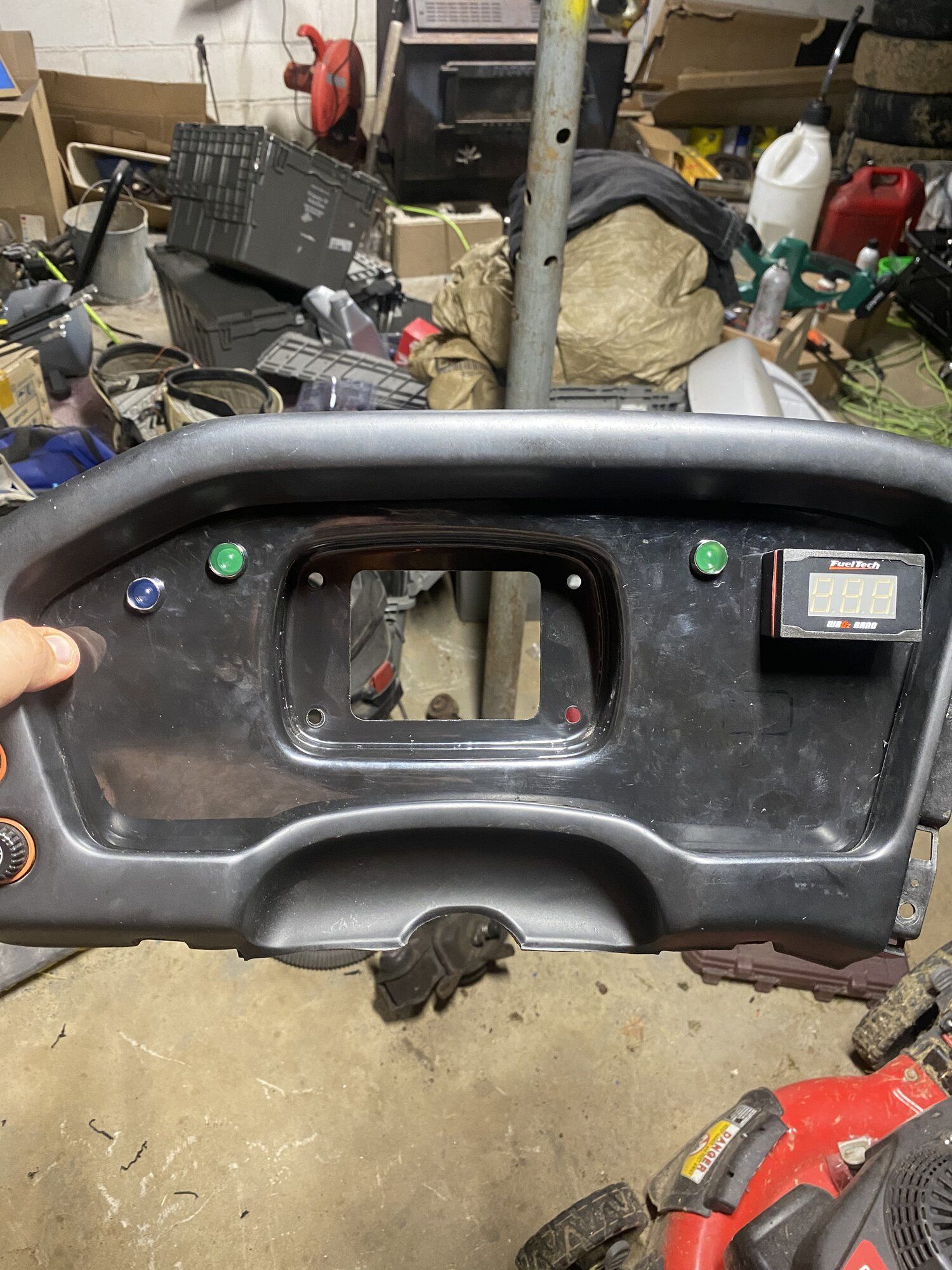

I then sourced the dash piece to mount the fueltech and wideband. Also wanted to have turn signal and high beam indicators when we were on the street with the car.

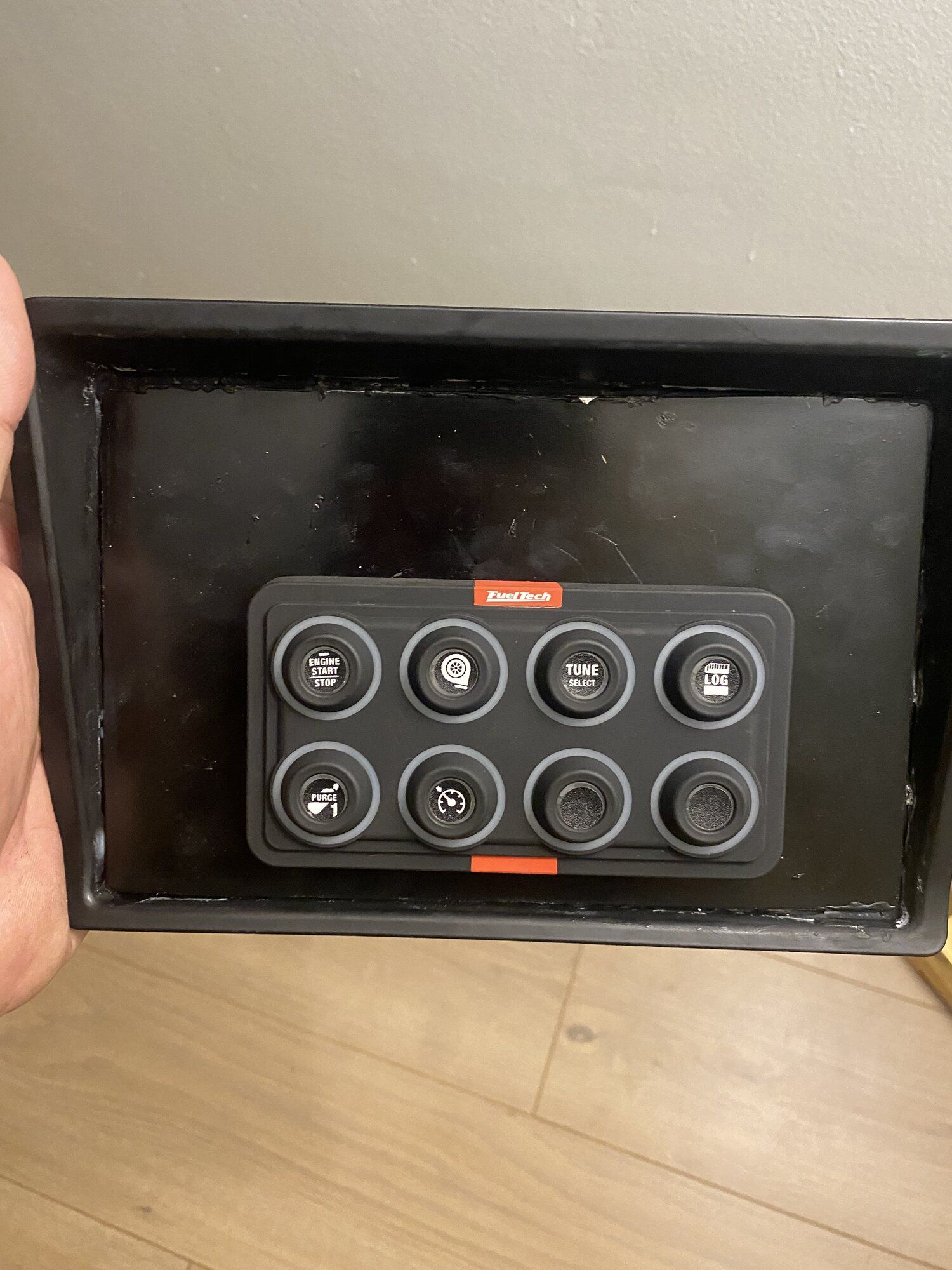

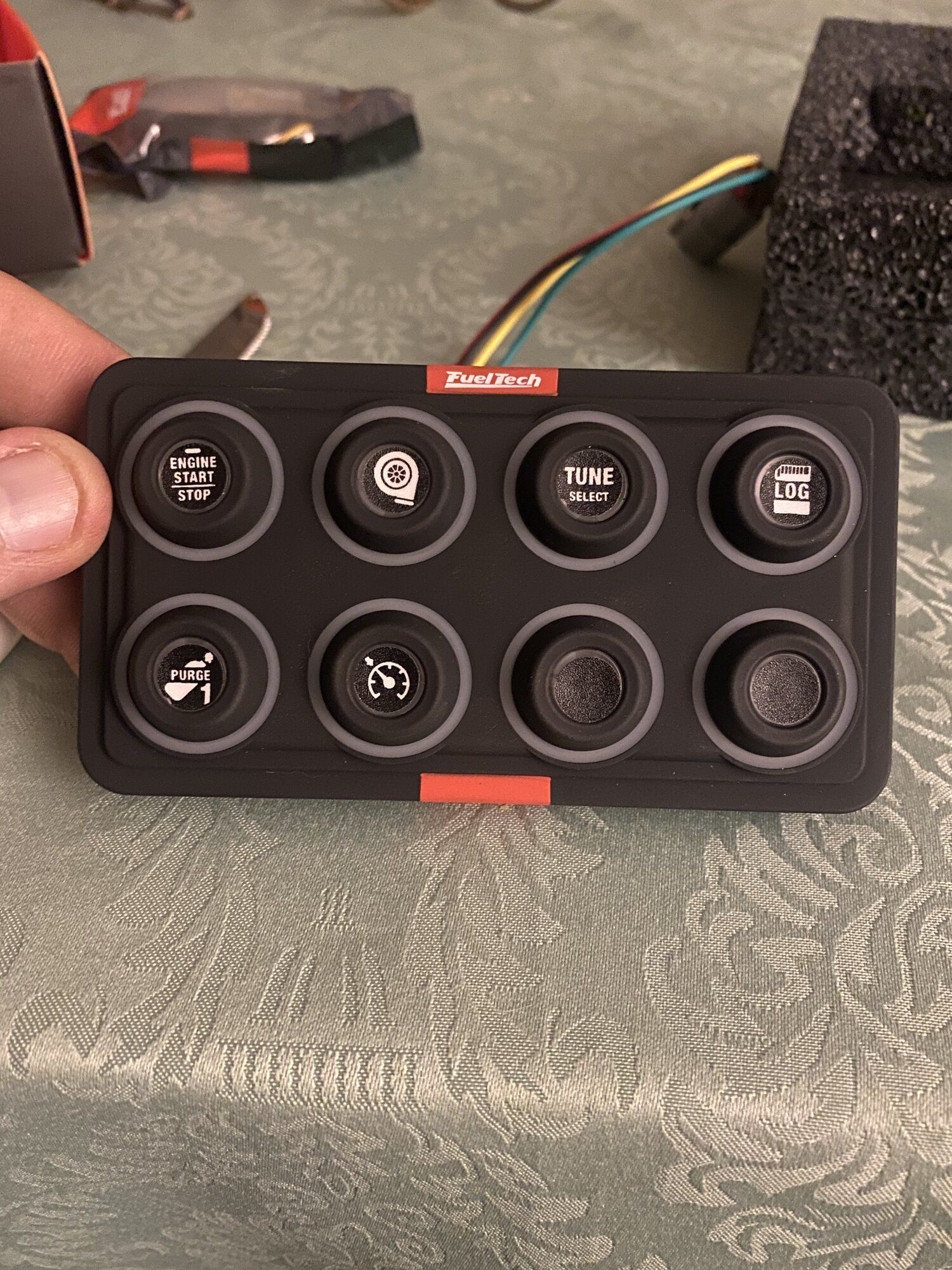

I also got setup with a 8 button switch panel to do the starter and a few other things

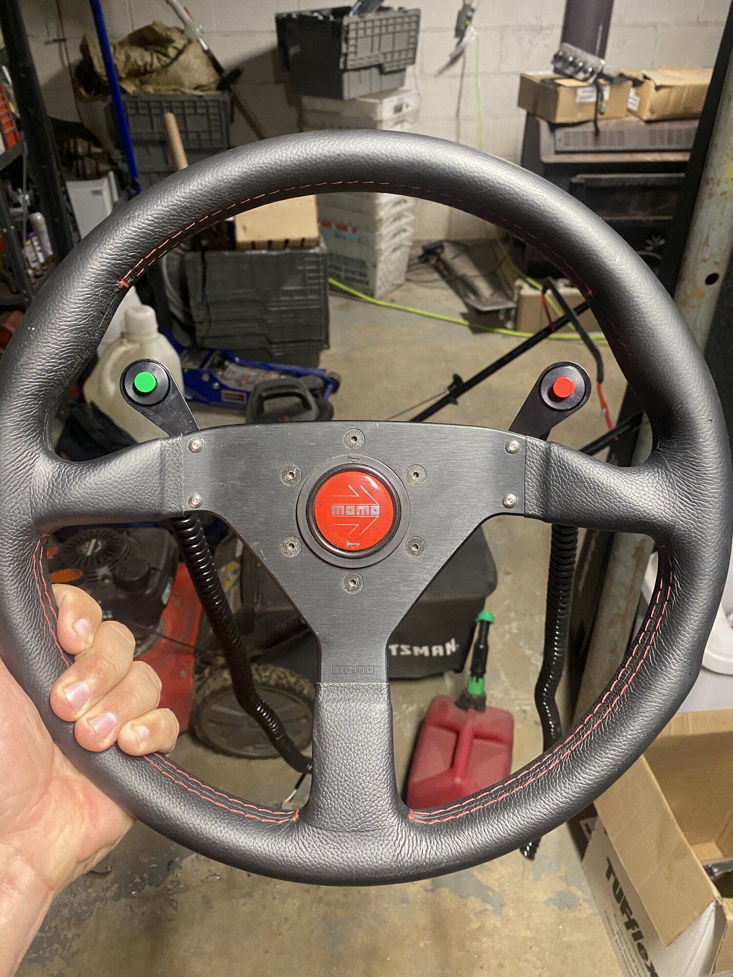

added these two buttons for nitrous and 2nd gear stall up.

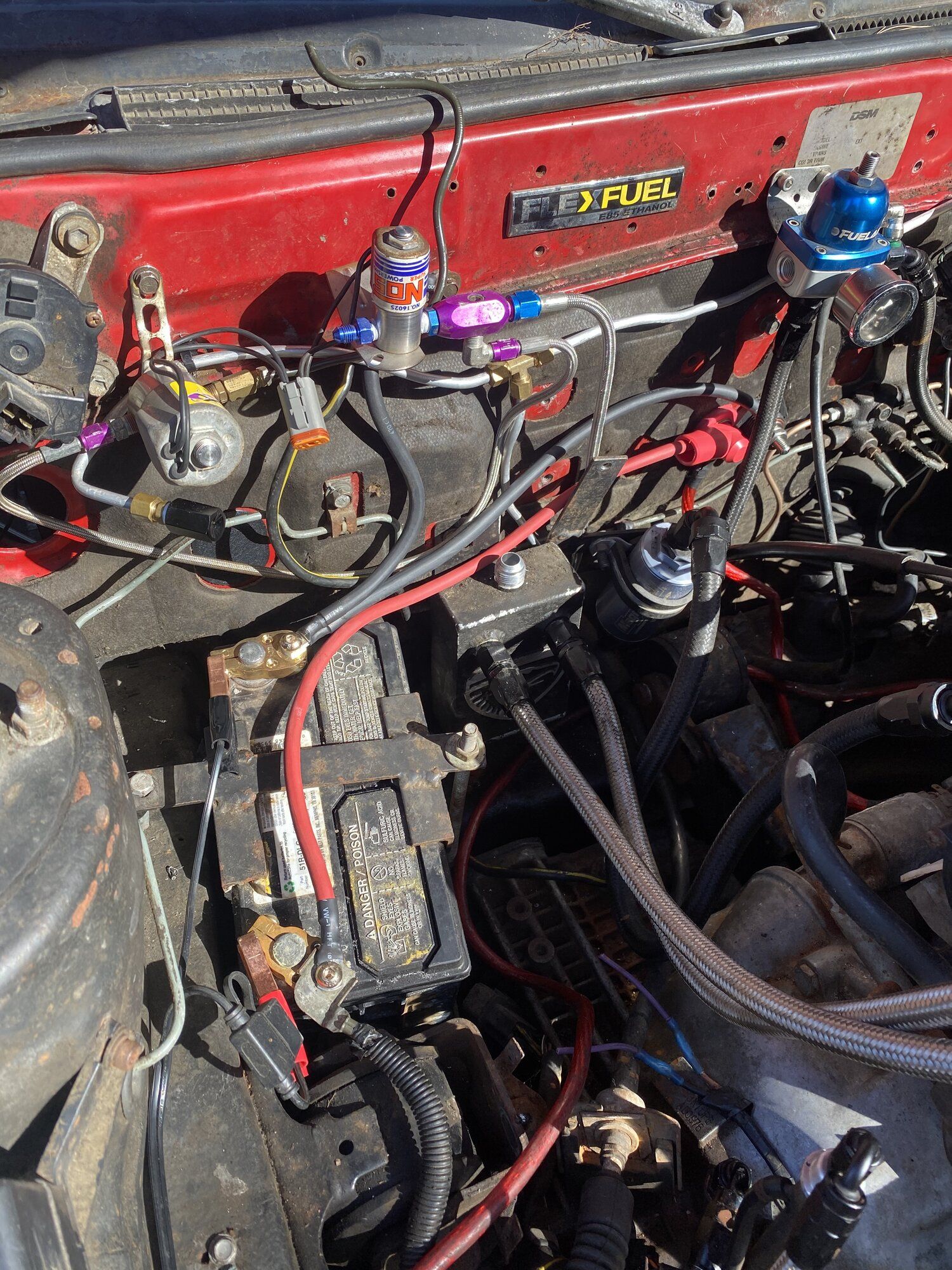

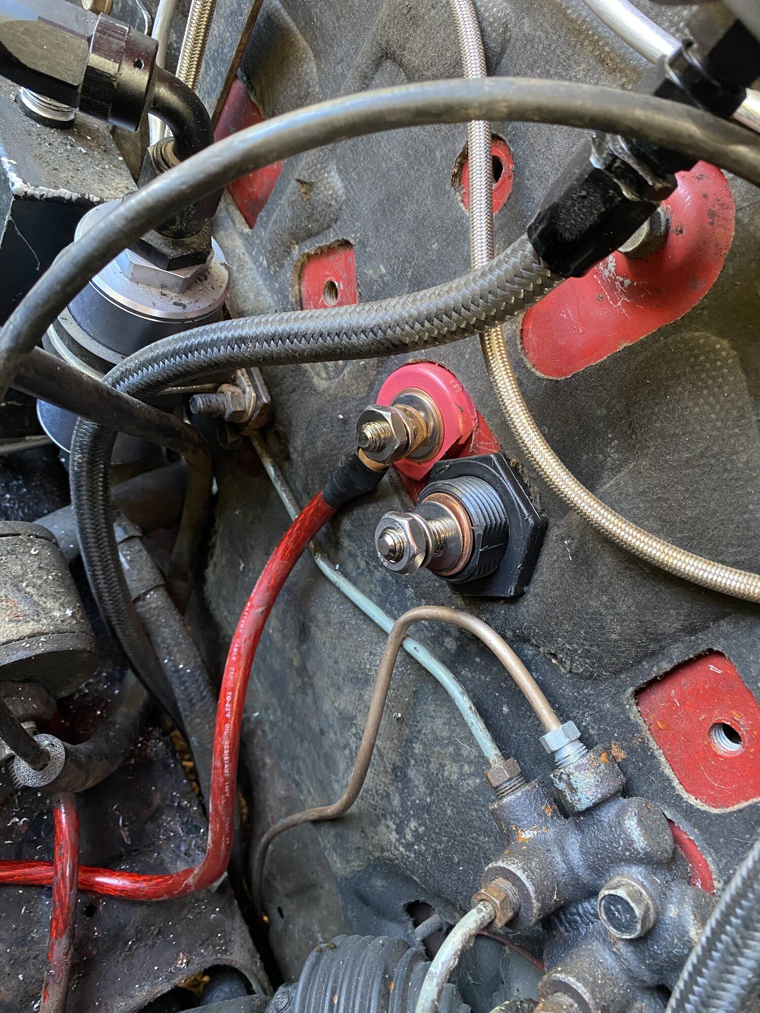

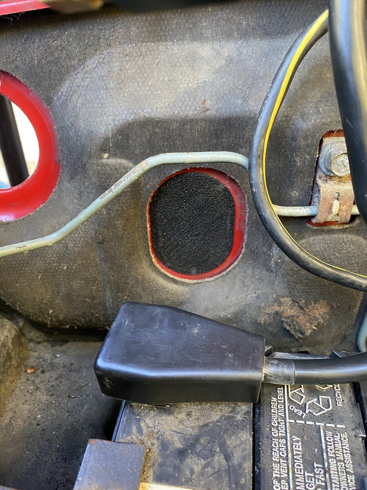

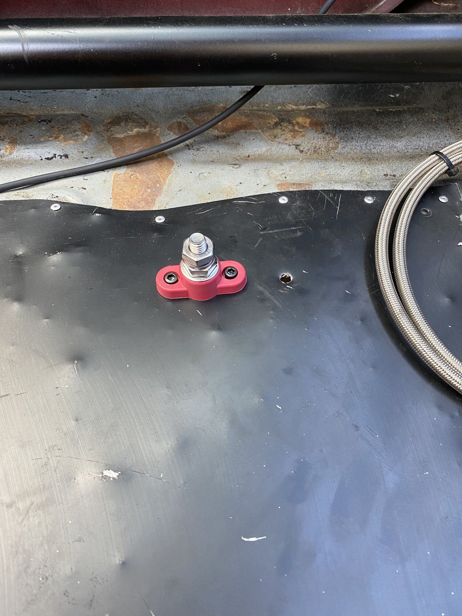

Repurposed the heater hose ports for my battery bulkheads

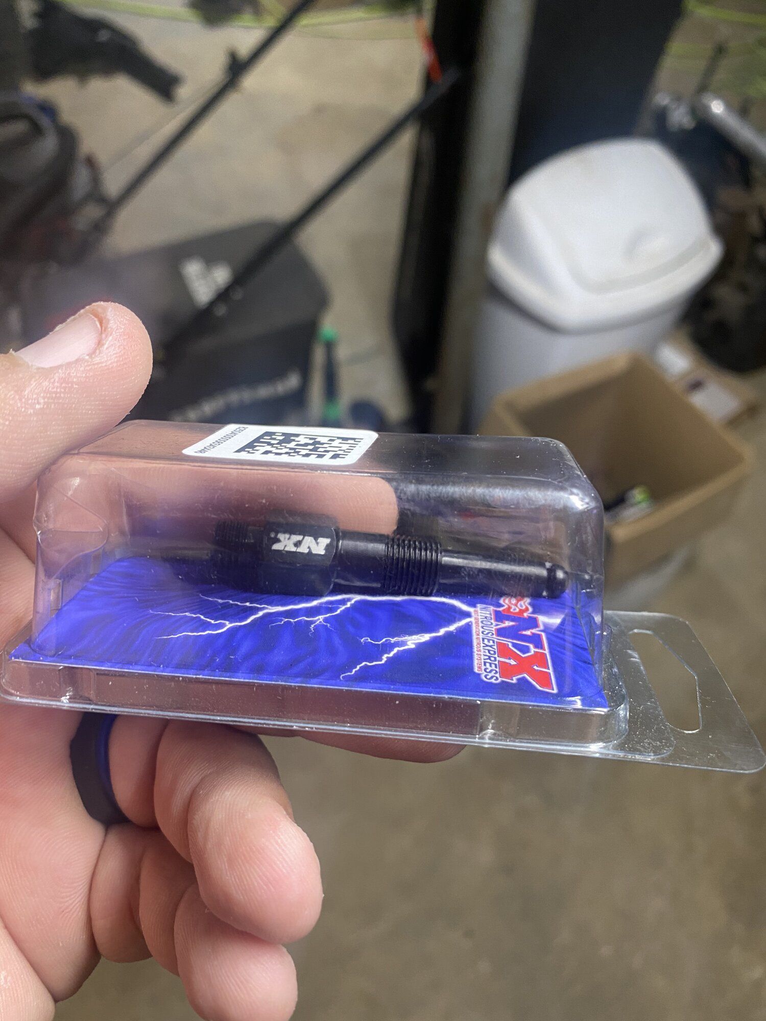

Switched the car to a dry shot to be safer when spraying the car

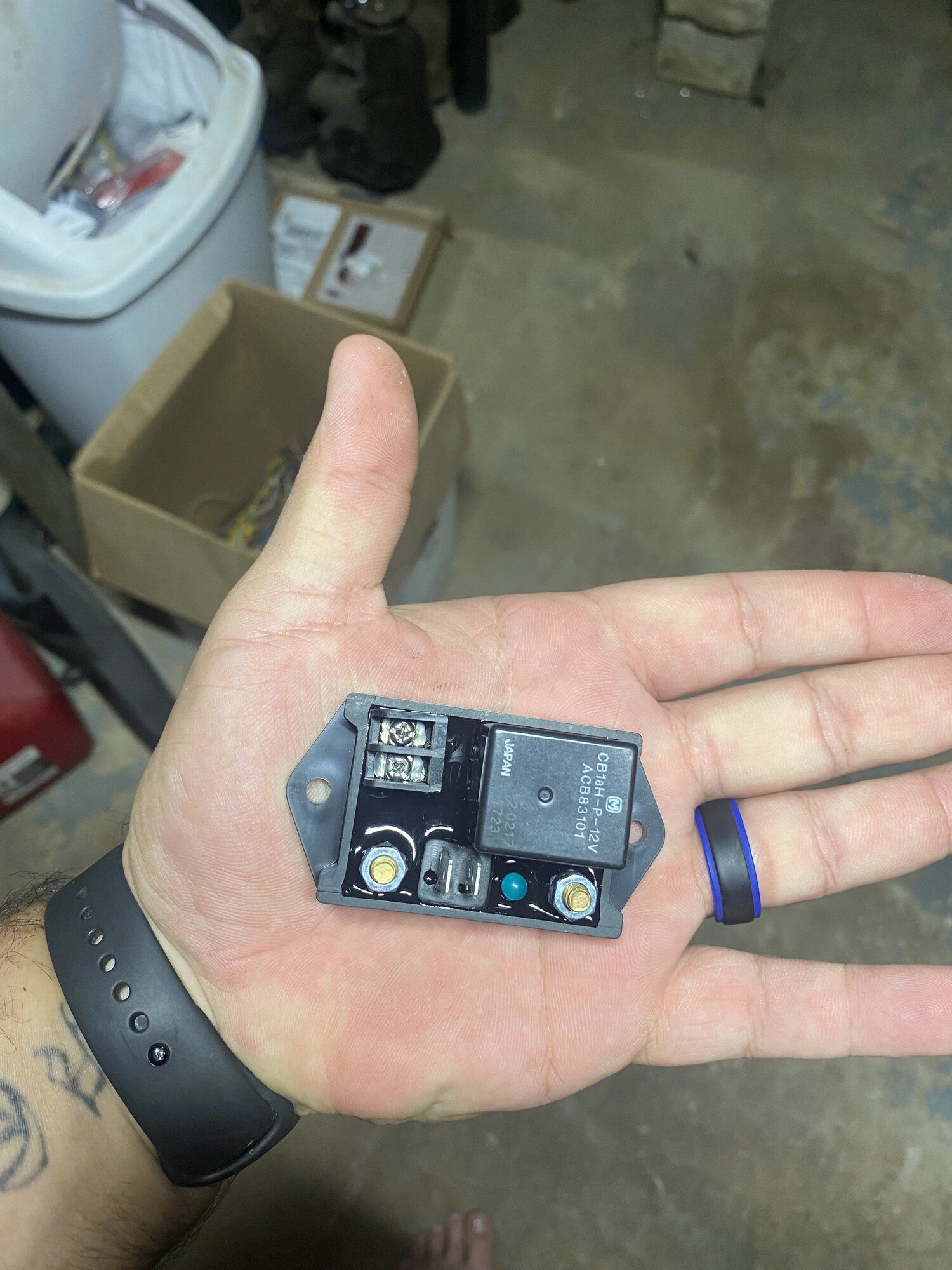

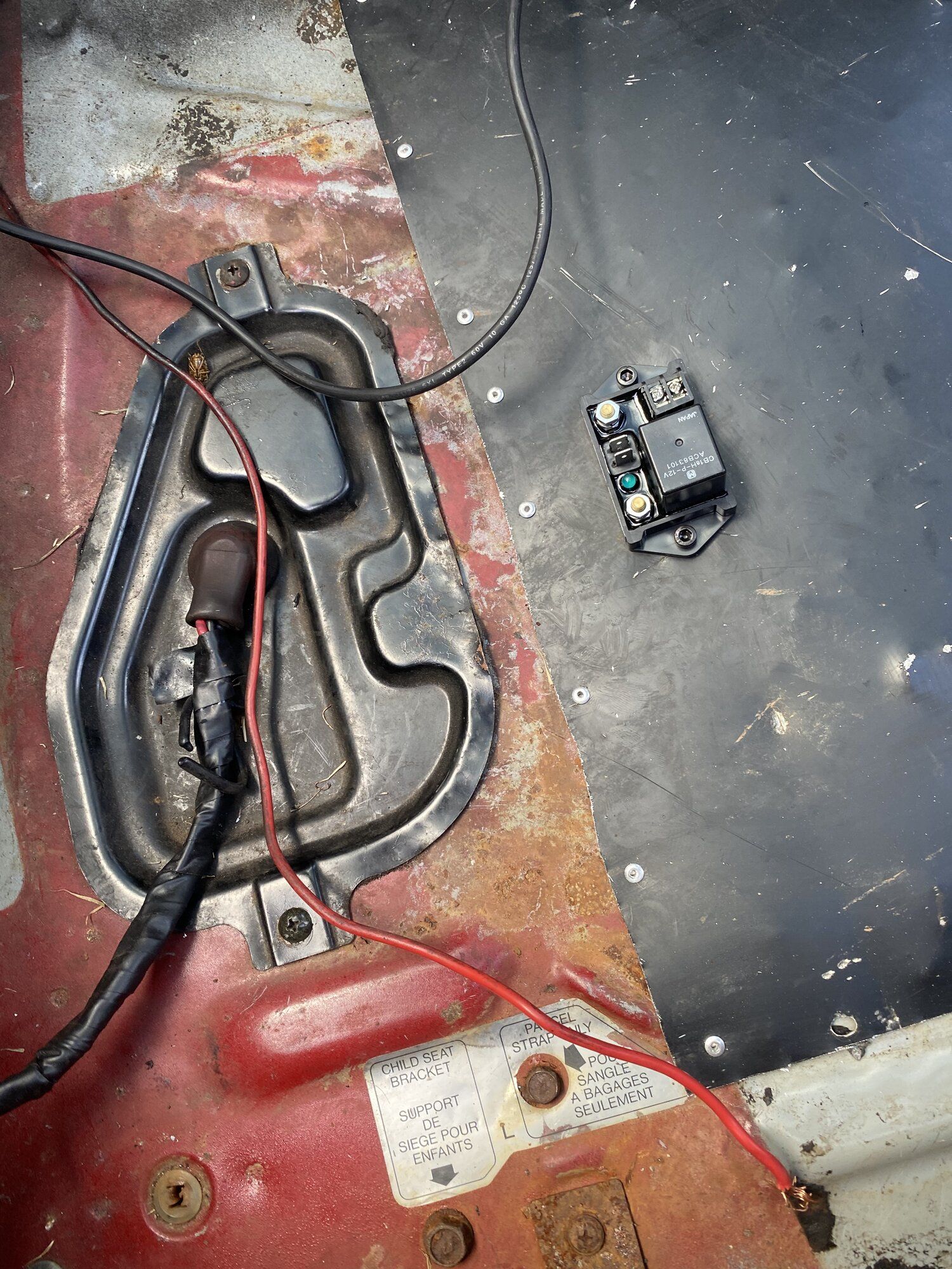

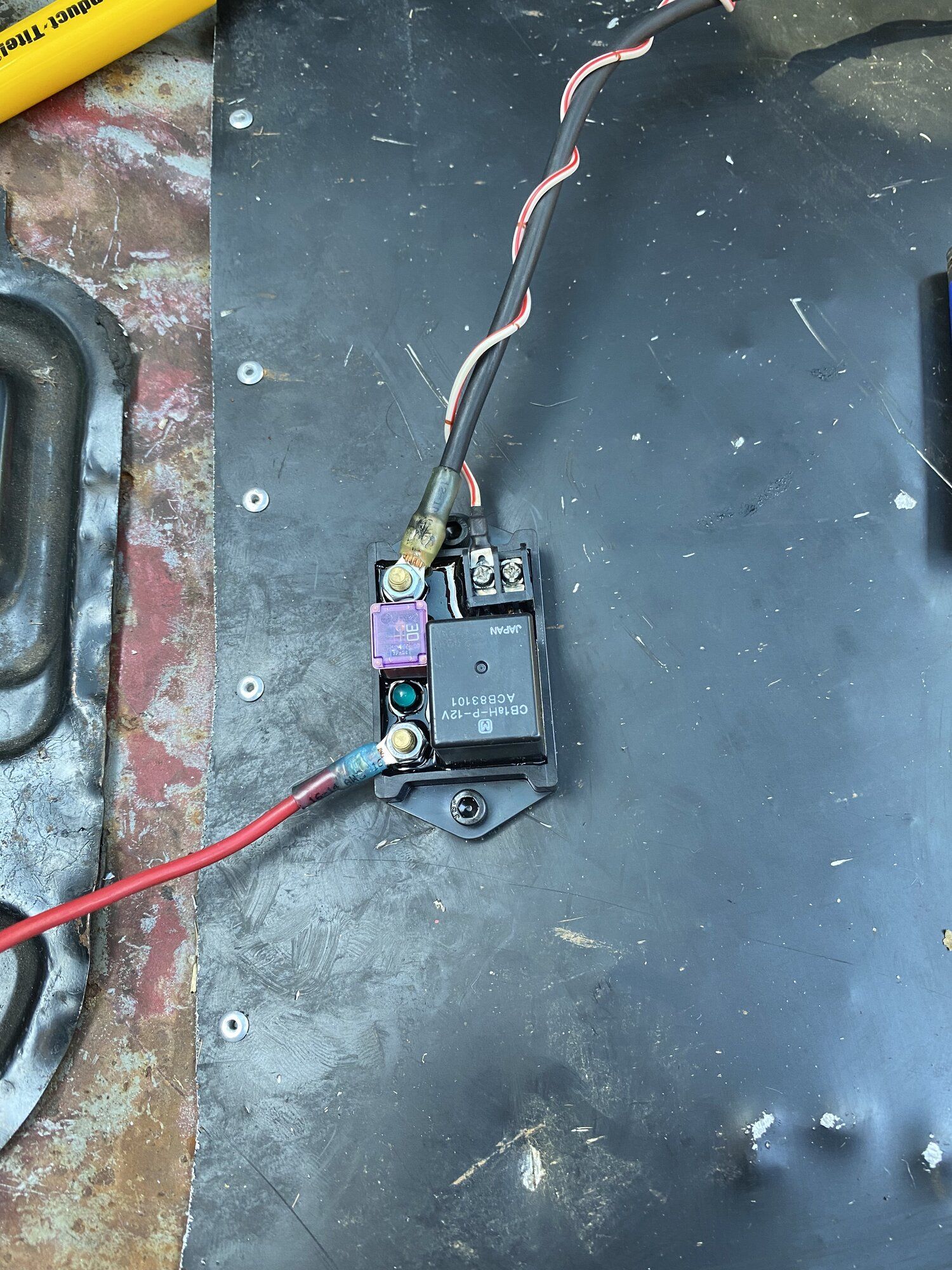

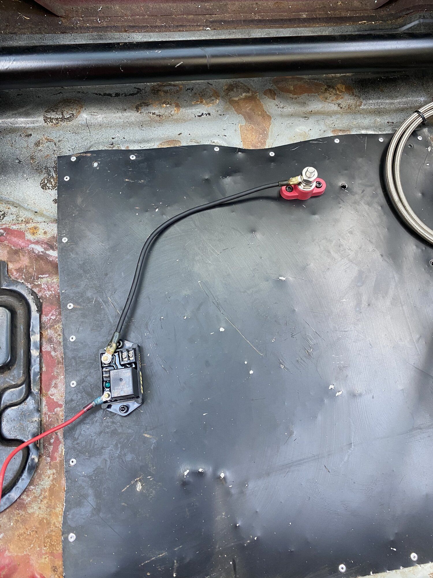

Leash electronics 70 amp relay for the fuel pump

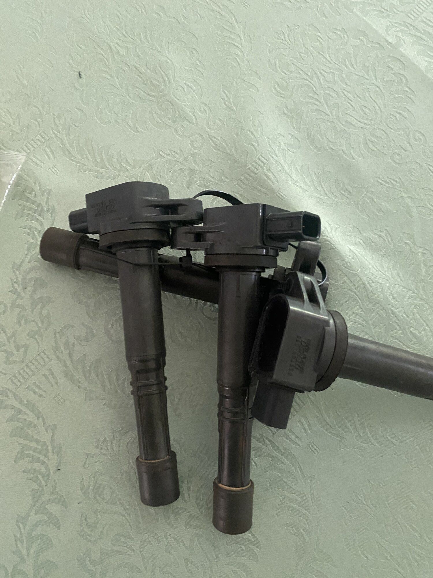

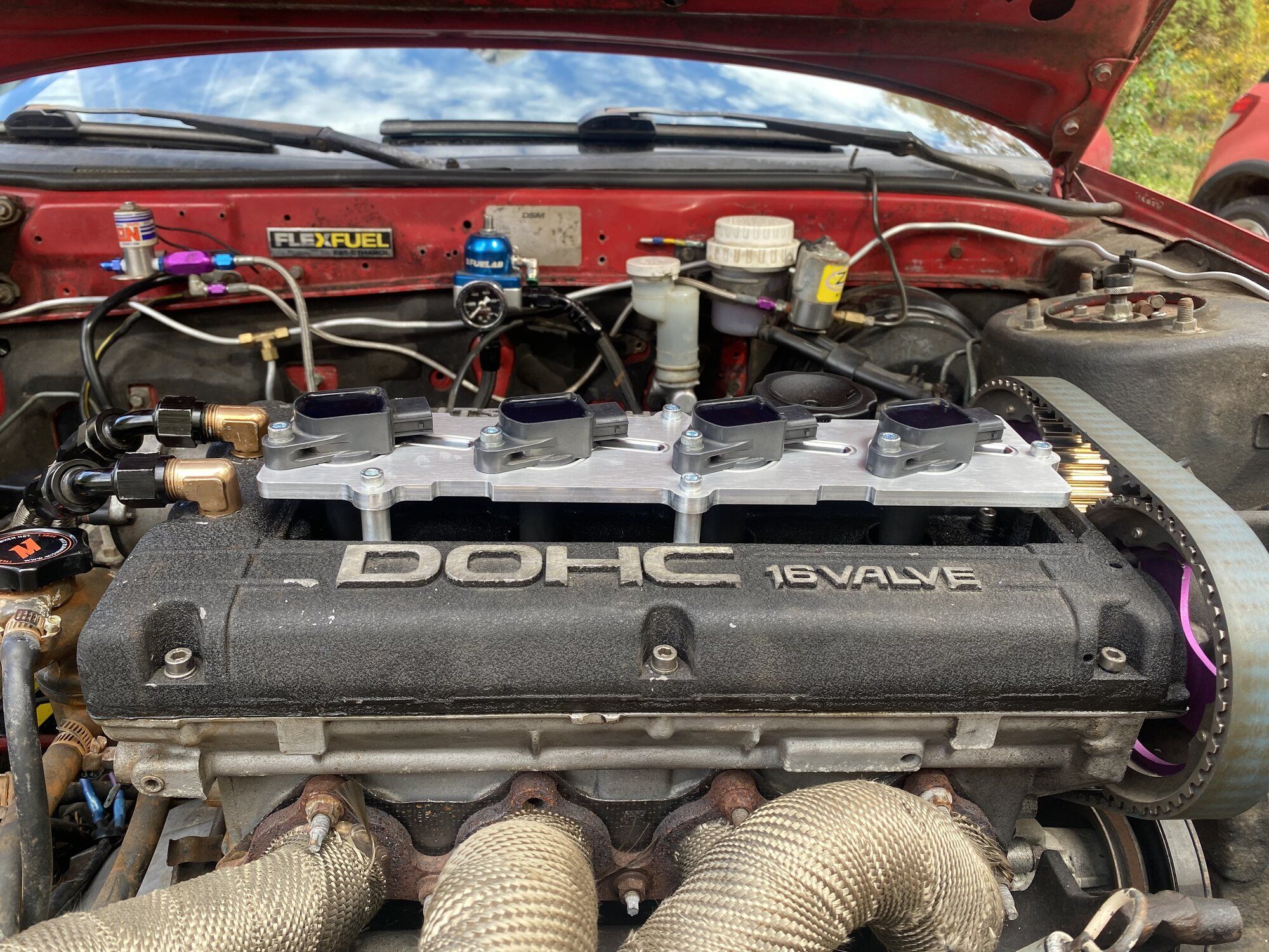

Going to be running k series coils. Should be plenty of spark for what I’m doing.

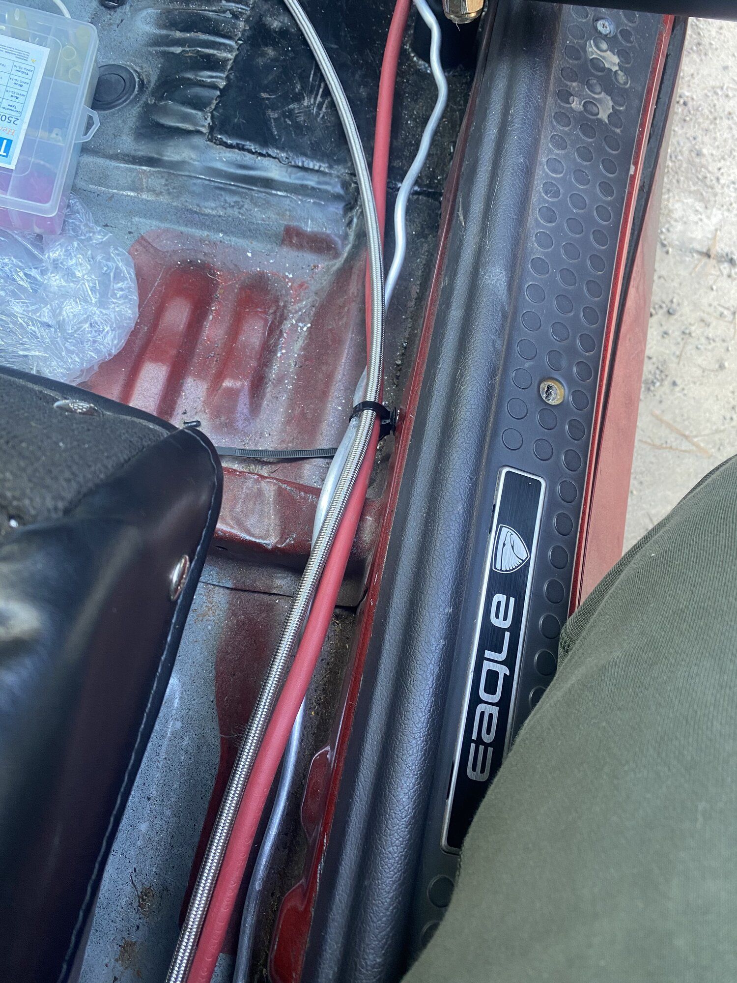

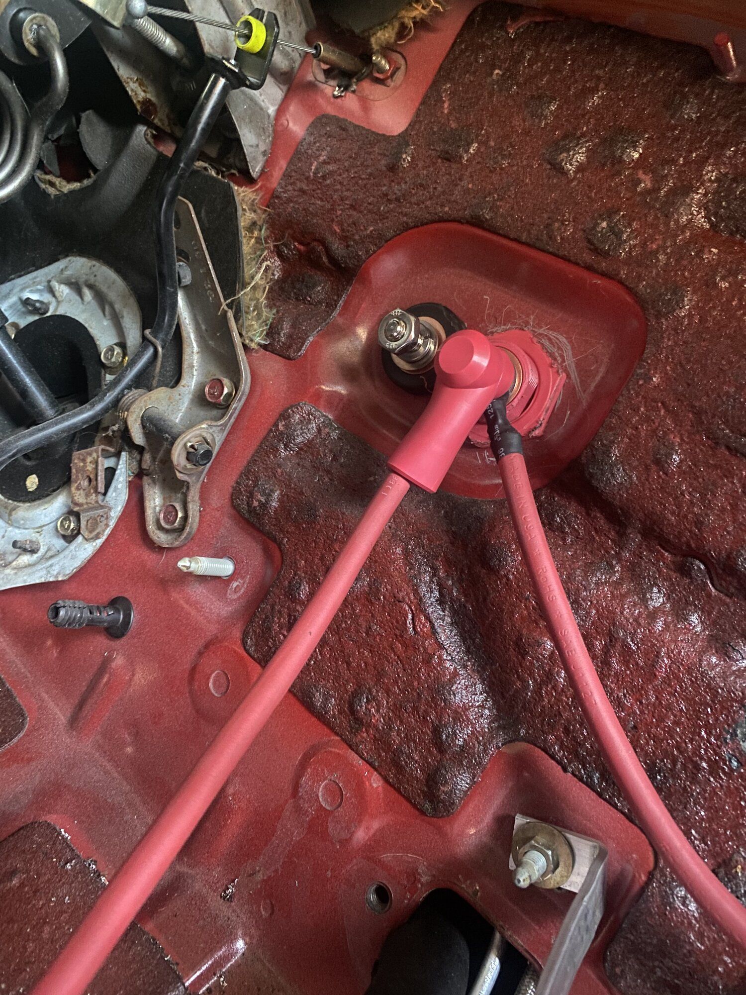

Running a big battery cable to the back to run the fuel pump power and power for the bottle heater

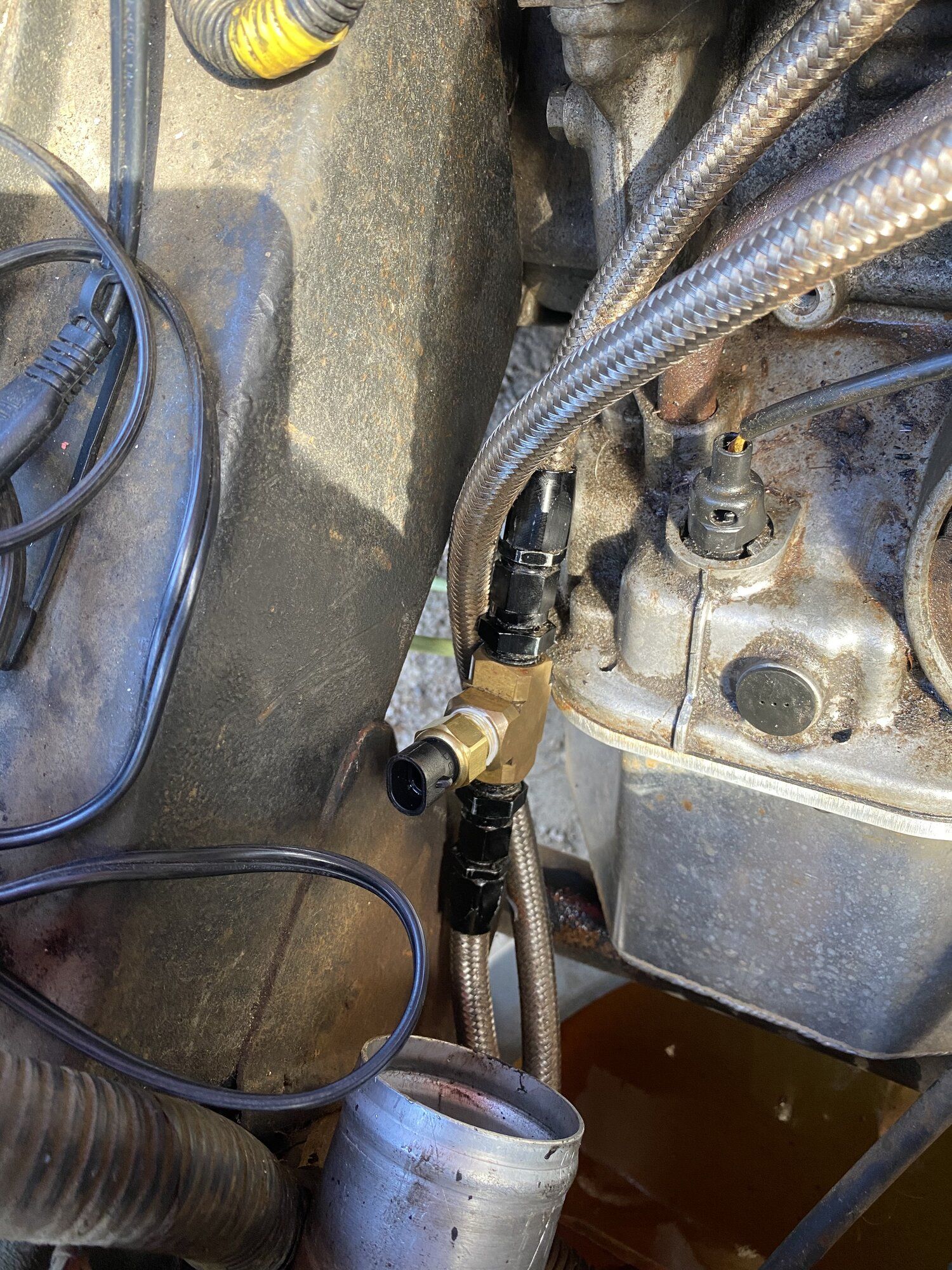

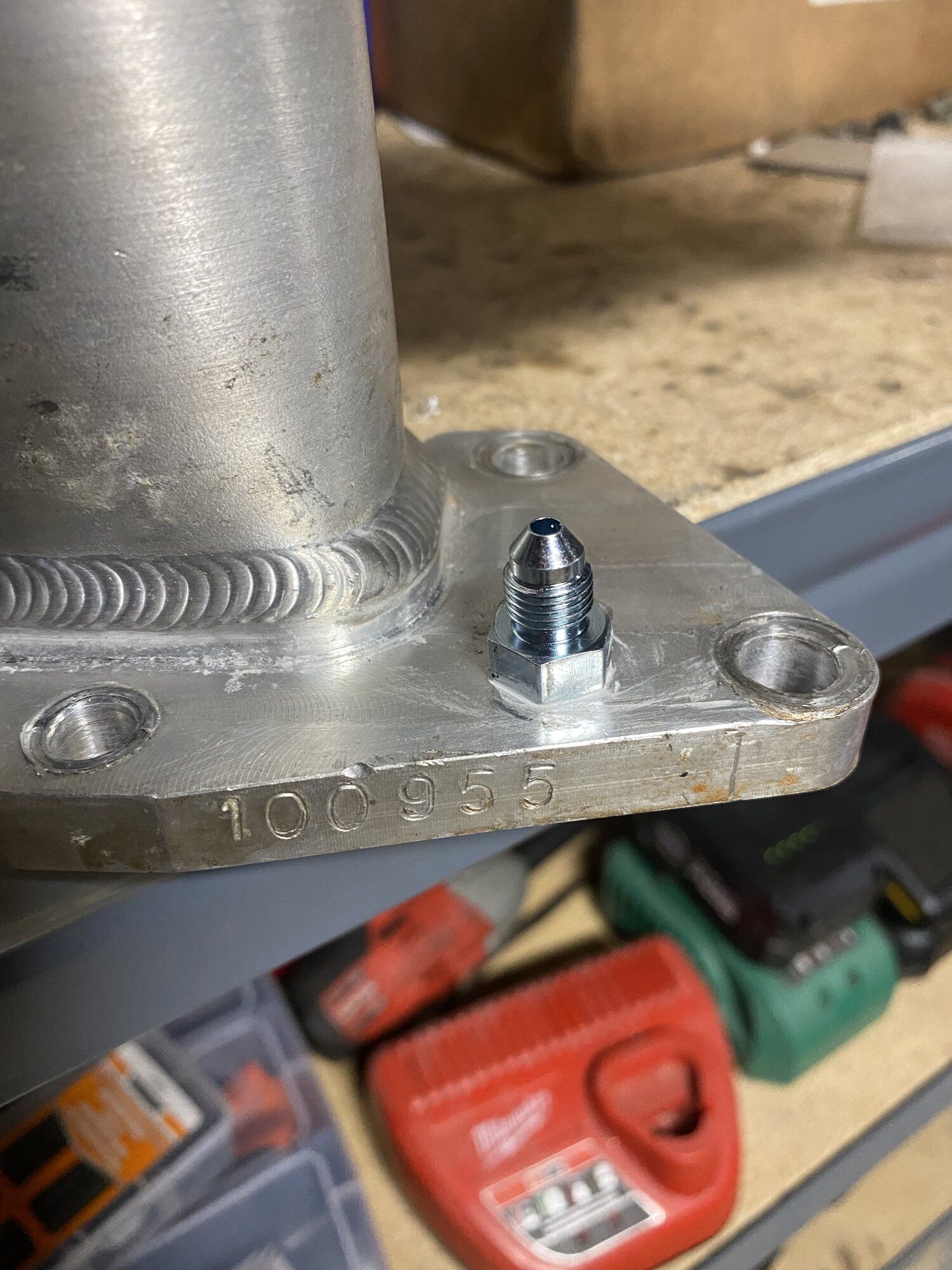

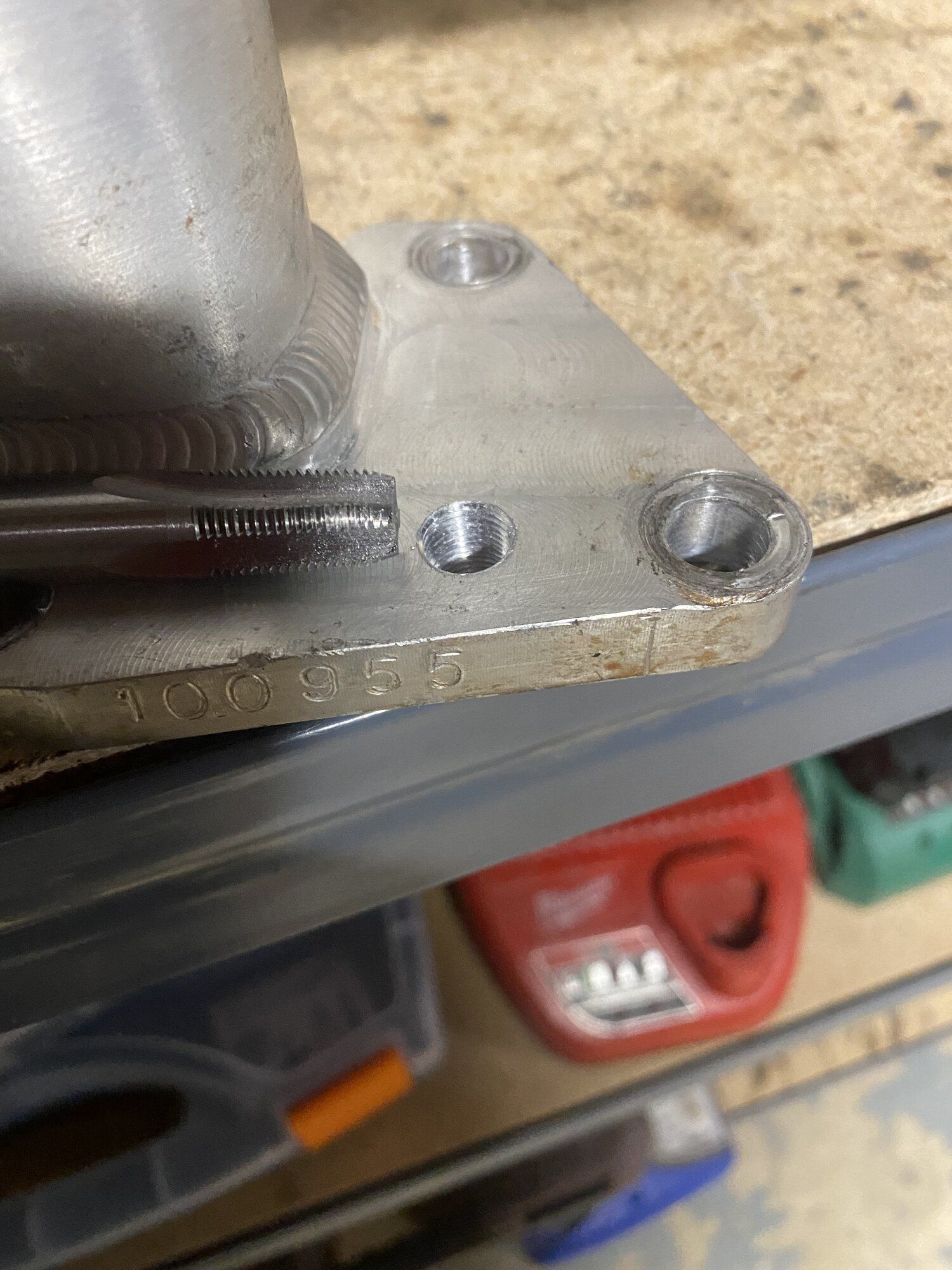

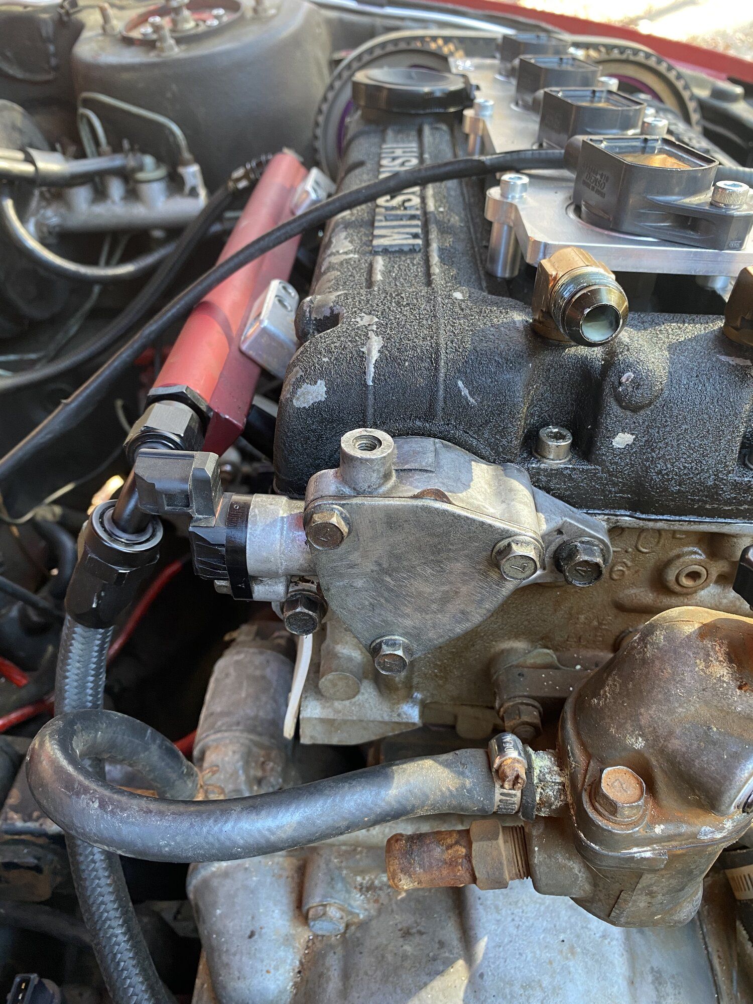

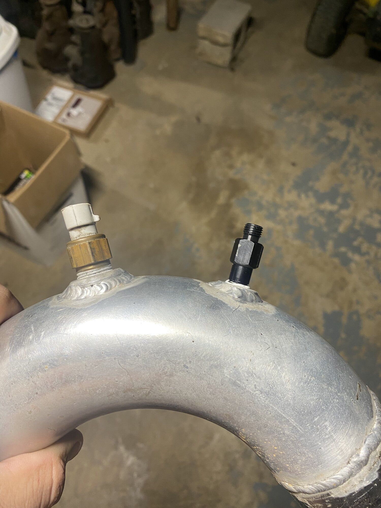

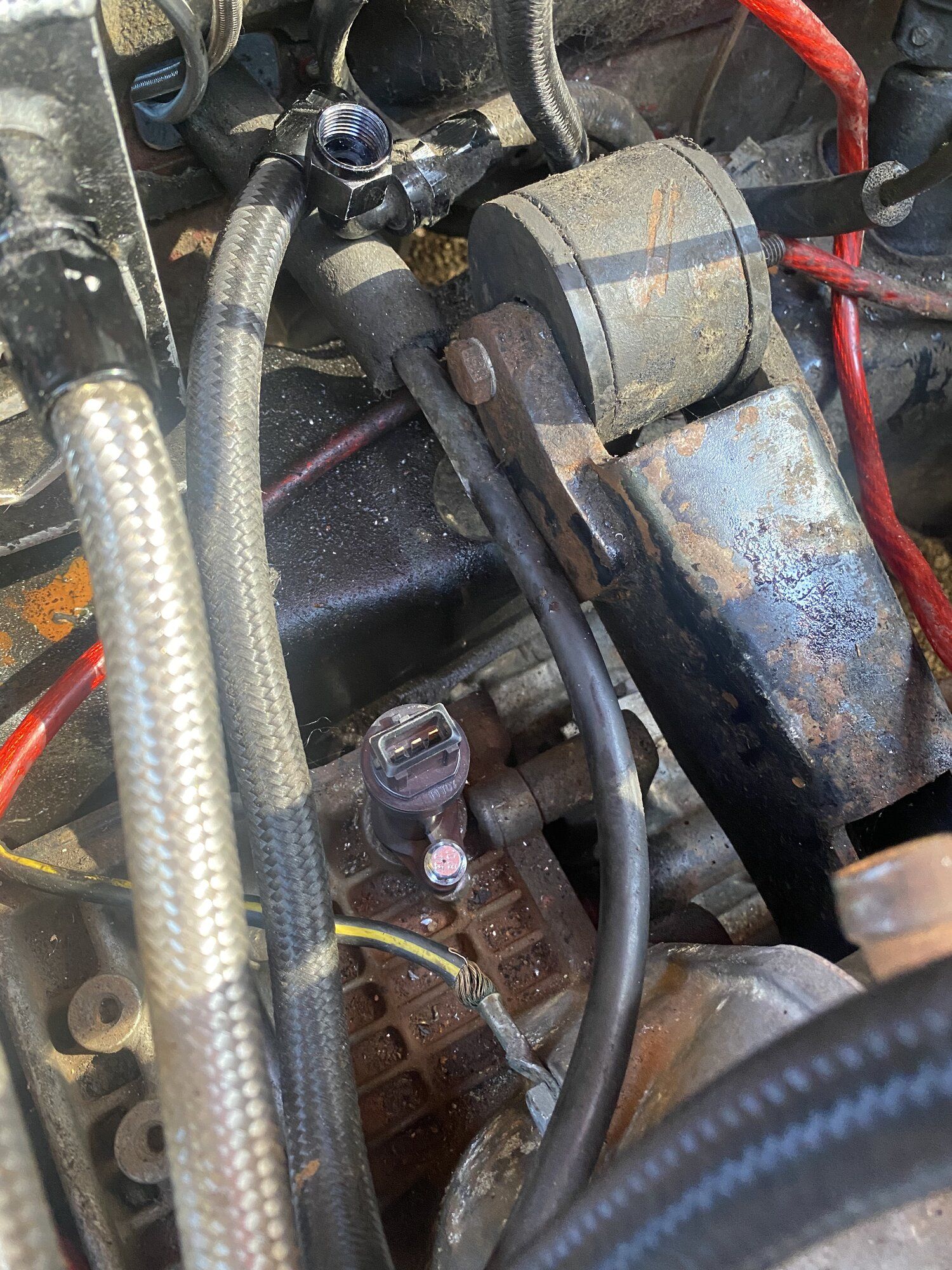

Drilled and tapped the intake for my turbo back pressure sensor
Got battery cables ran and all setup.
Some of the sensors going into monitoring things on the car. Still have a couple to put in.

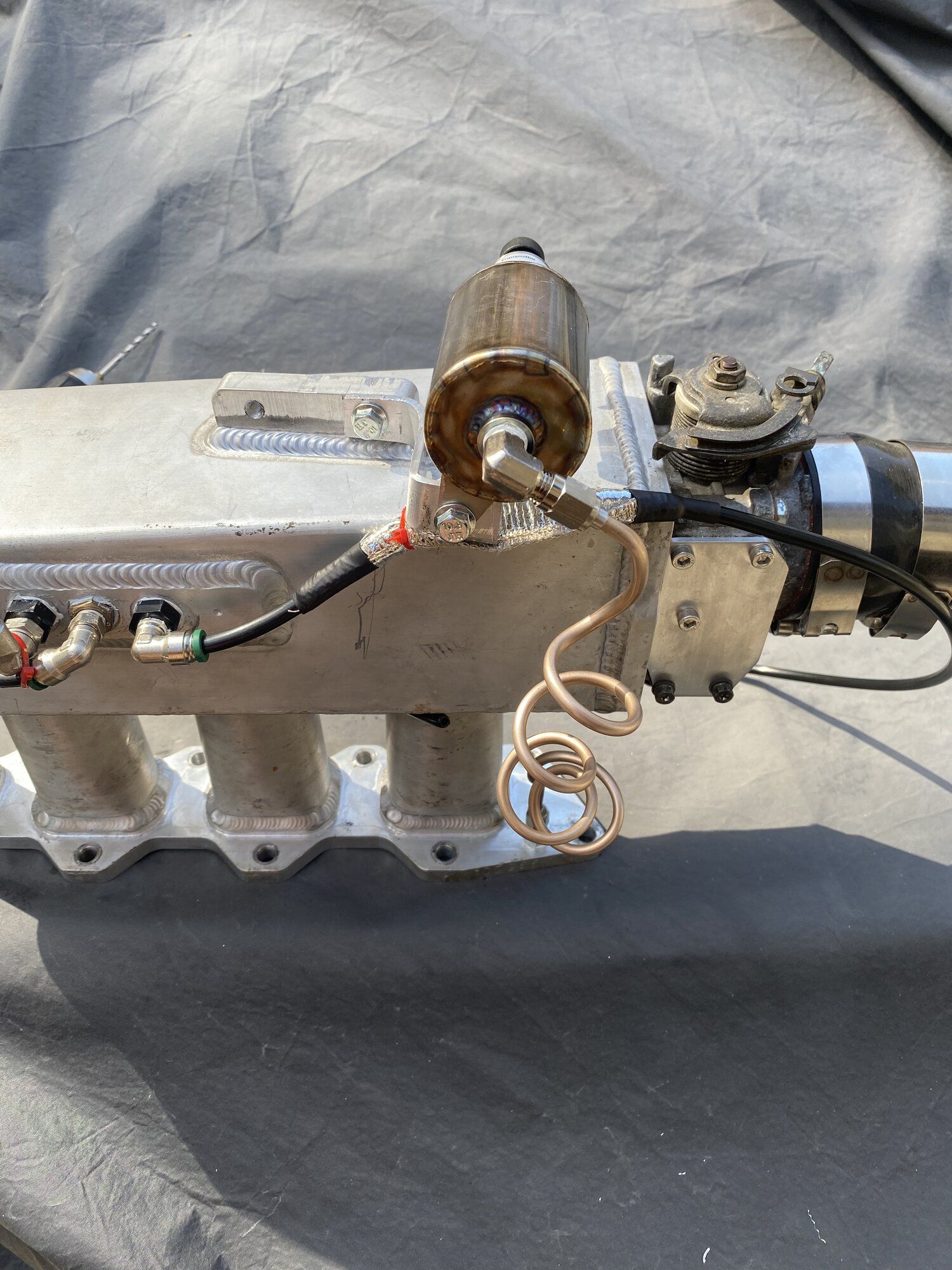

Here is how I did my back pressure sensor.

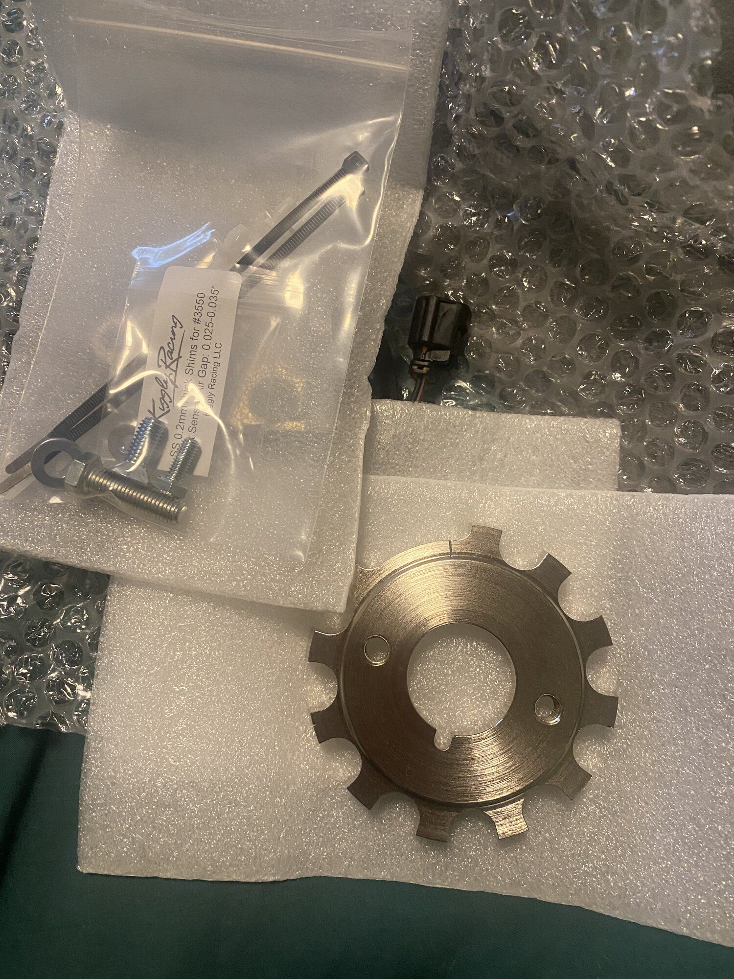

Next thing is to pull the timing stuff and get the crank trigger kit installed. Got a few more sensors and things to mount up and then it’s time to start wiring things

I’m curious to see how you like Fuel Tech, I keep seeing nothing but good from those who use it. Seems to be pretty involved but well worth it once together, plus I absolutely love the ECU itself is a dash display
The ecu being the dash is what sold me honestly LOL that and the trans control is pretty awesome. Going to be odd not shifting the car tho.

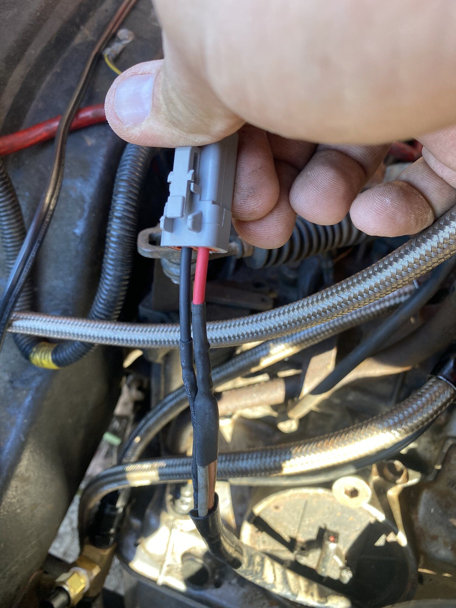

Got a couple things bolted on to get in place to start wiring also added a Deutsch connector to the fan.

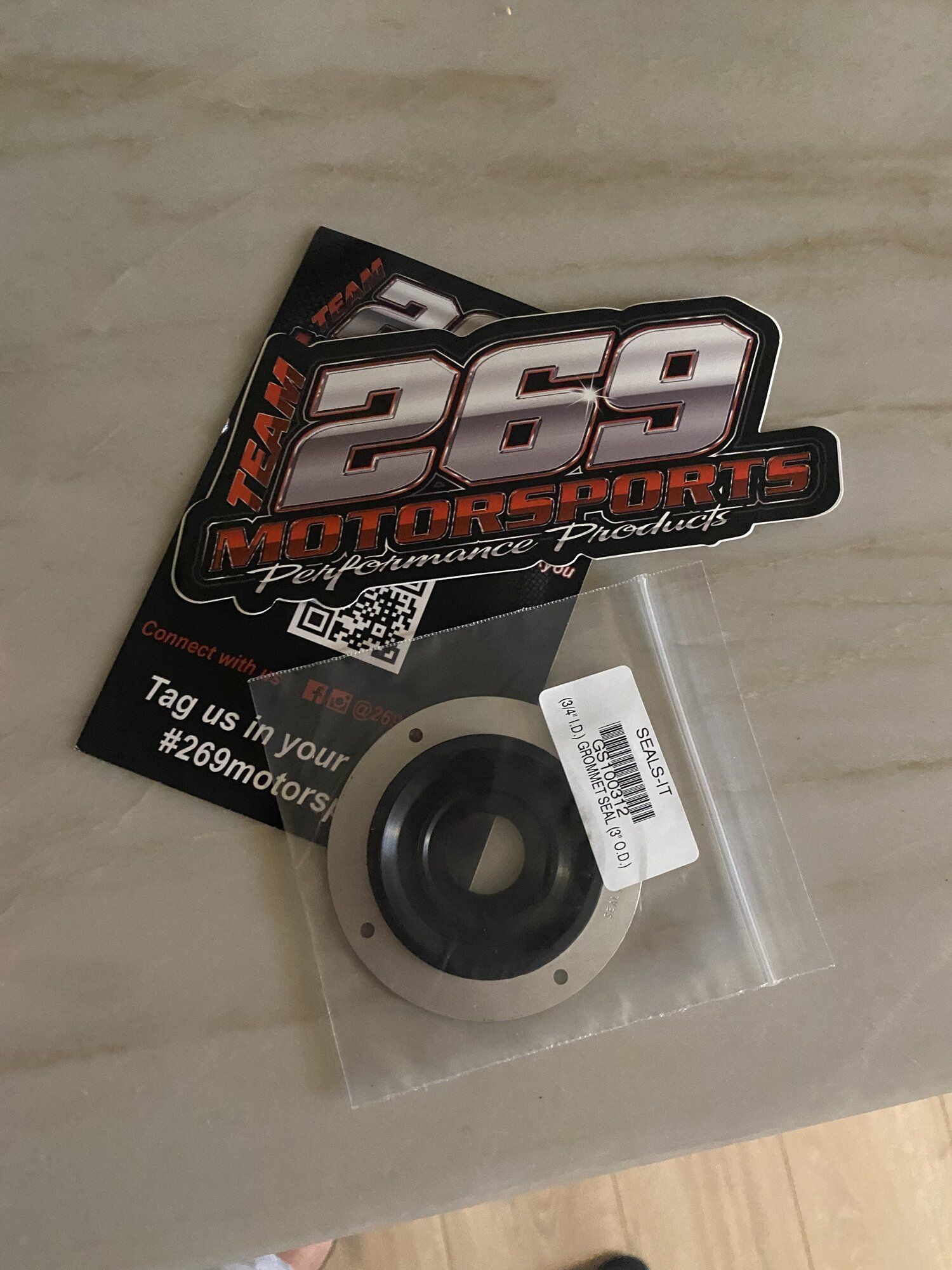

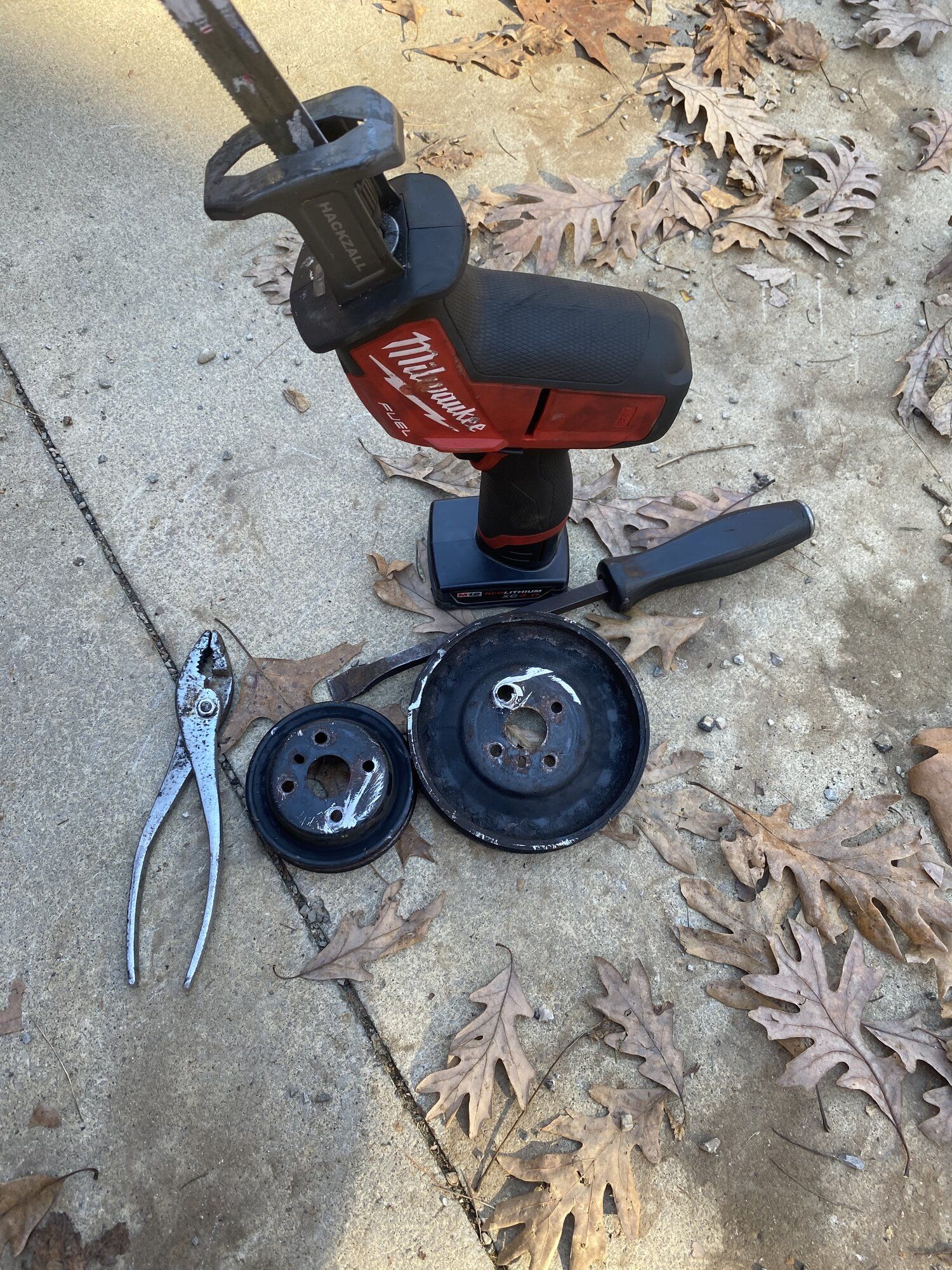

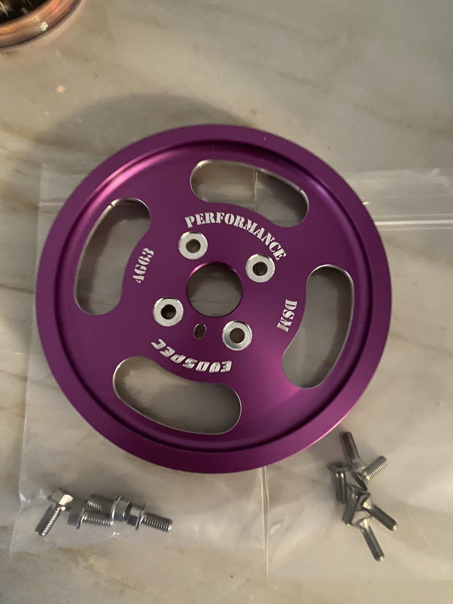

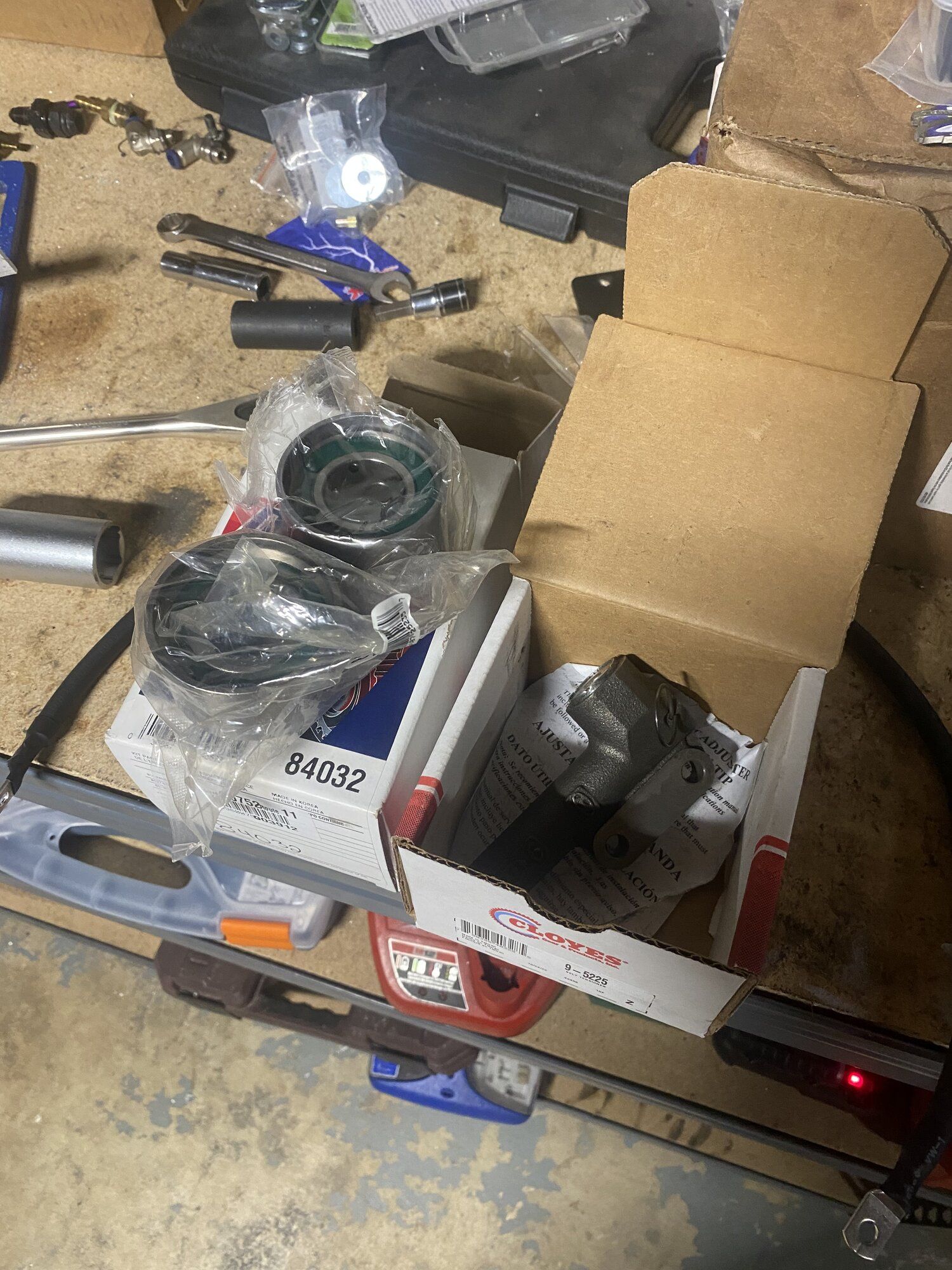

And then things took a turn. Started to pull the belt side apart to get the crank trigger installed and new timing components installed. Last bolt holding the water pump pulley rounded off….
Decided that I would
Just get an evospec water pump pulley and call it done. Also got a couple more wire colors ordered in so I can color code my 12v wires to make it easier to trace. I’ll post more once my other parts get here.

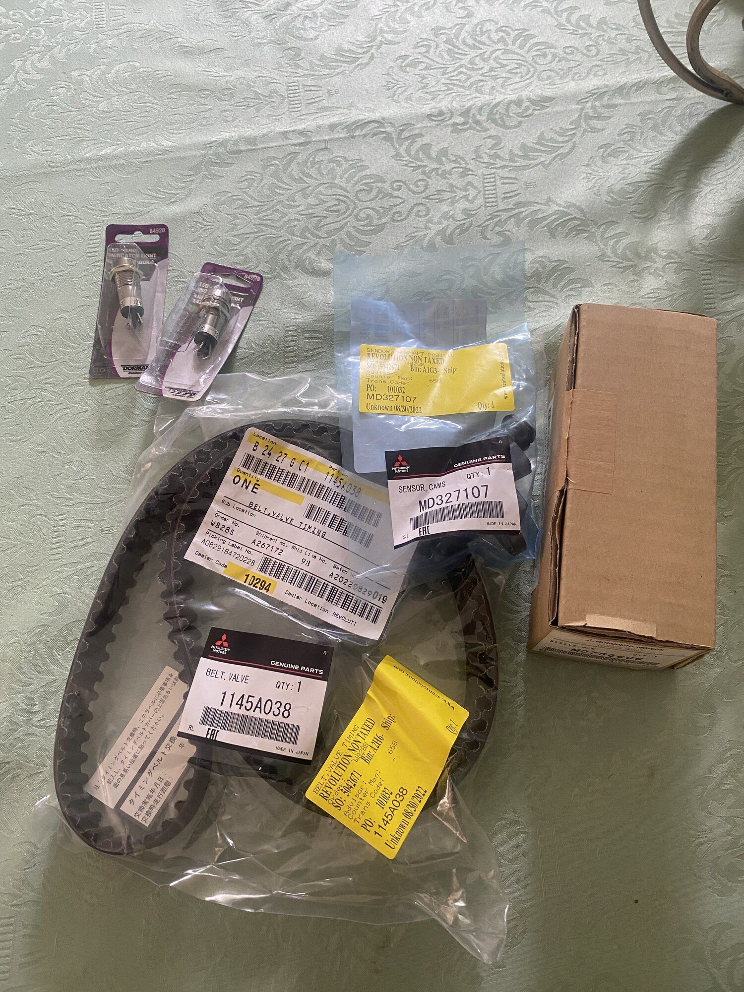

Parts update:

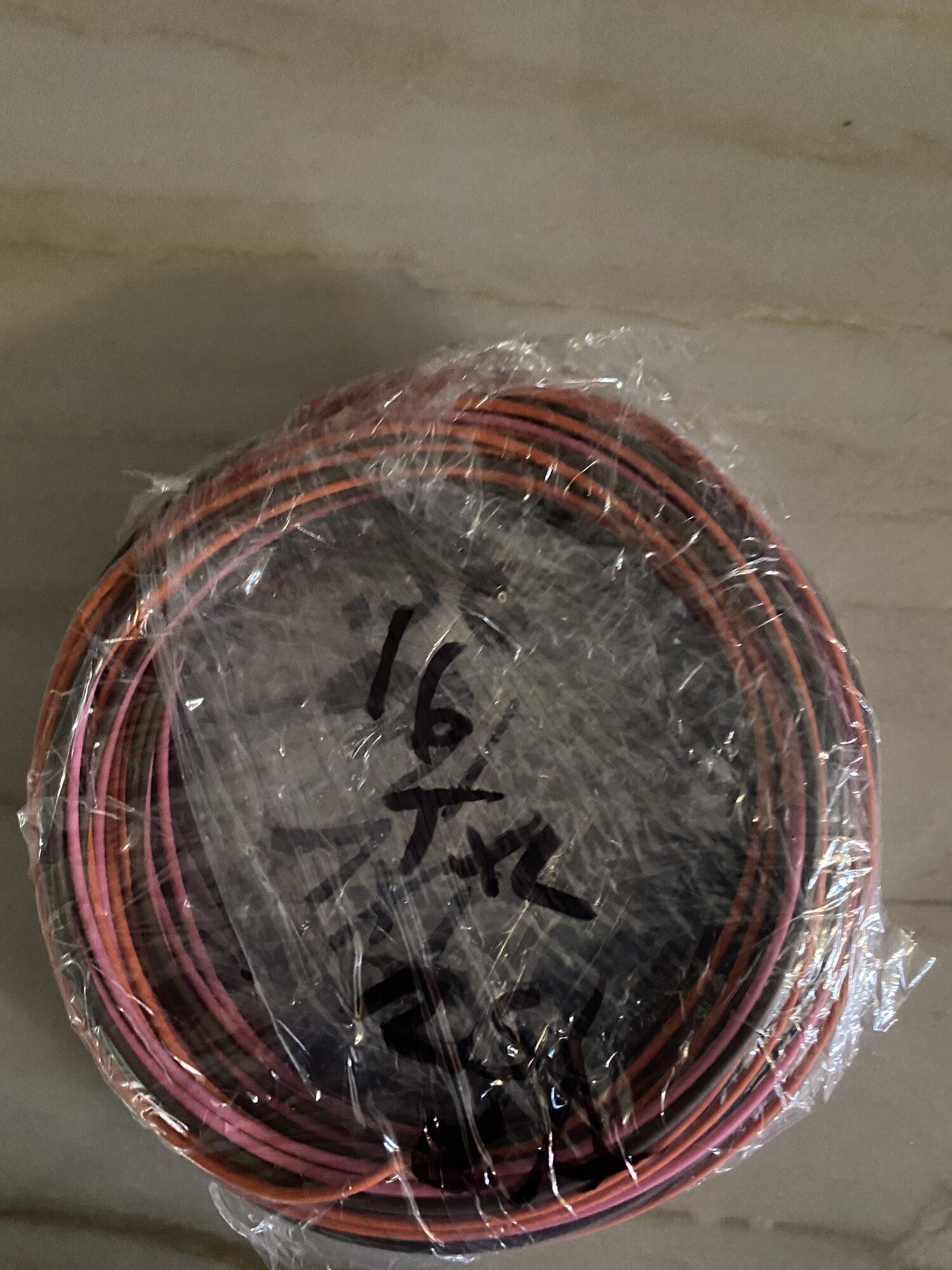

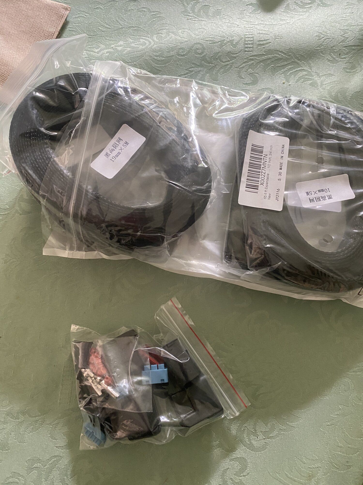

Last bit of wire I needed to get the harness started

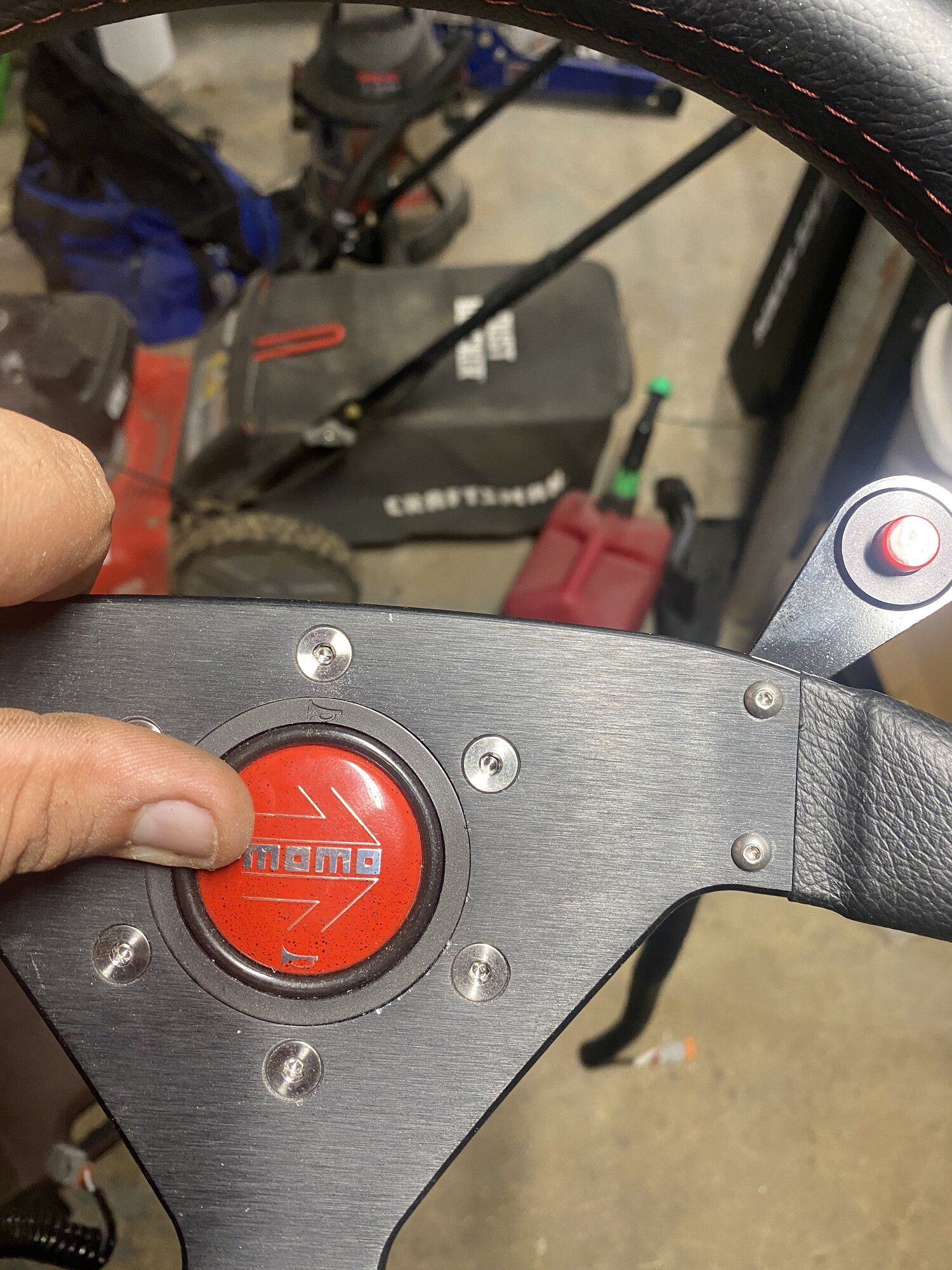

Ti steering wheel bolts

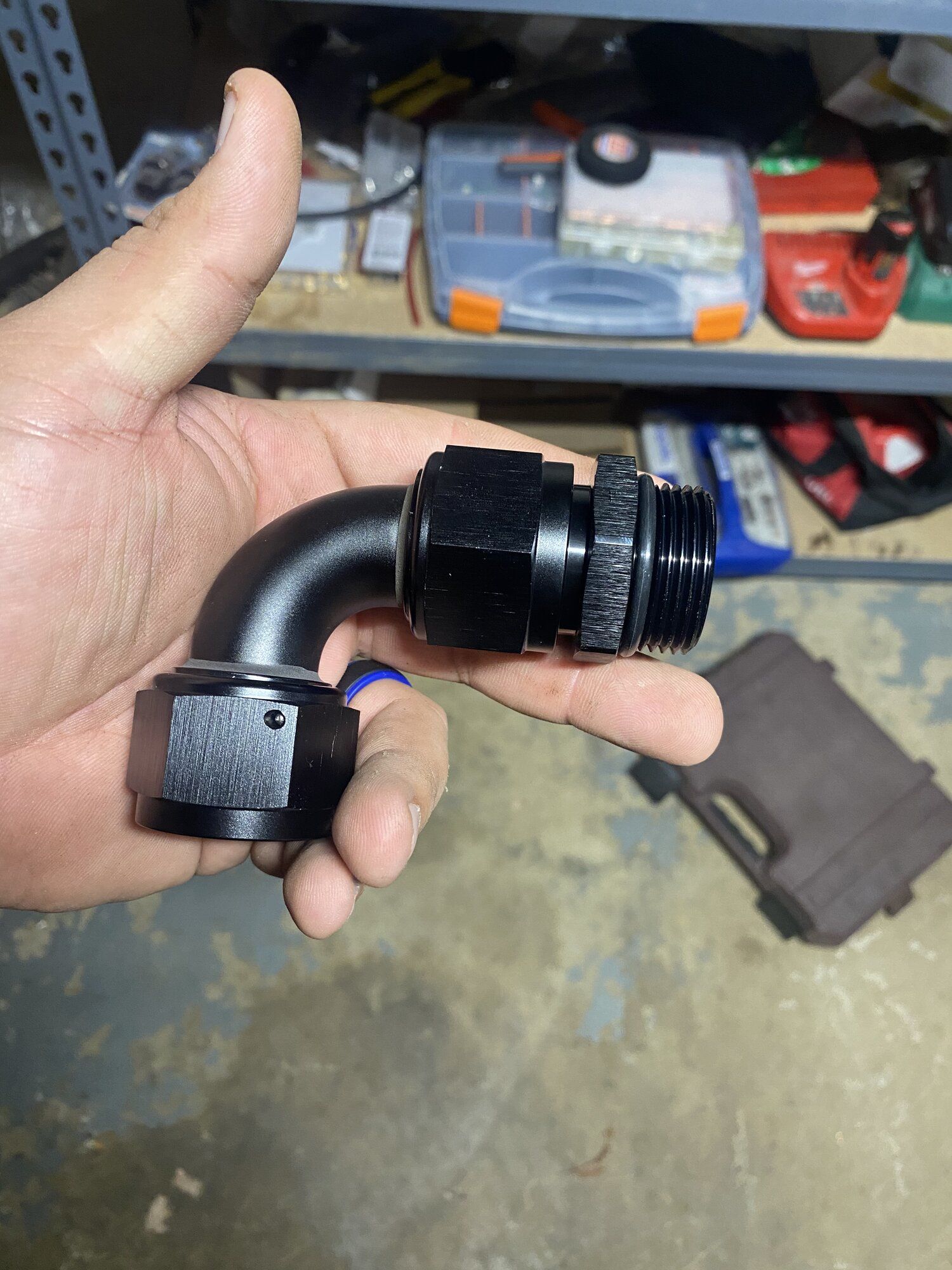

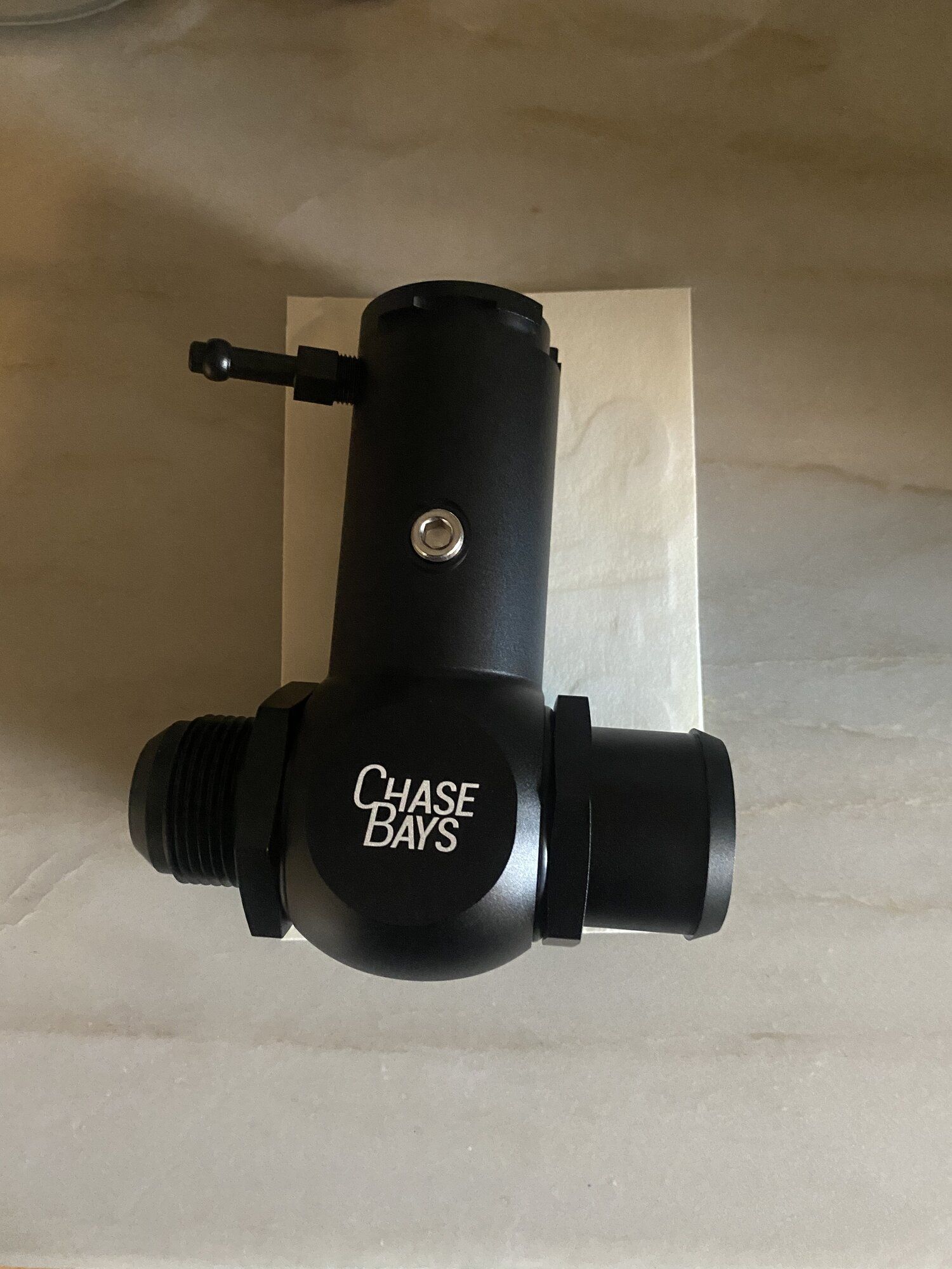

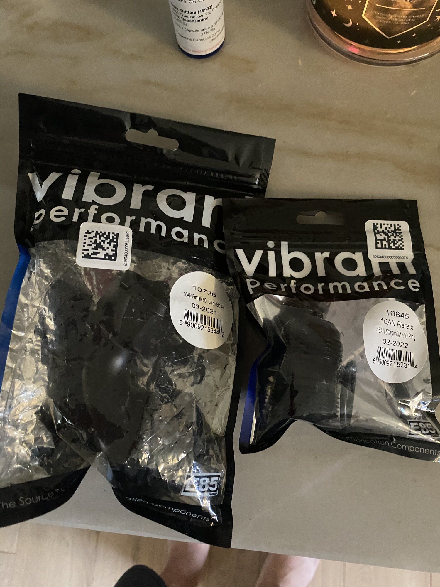

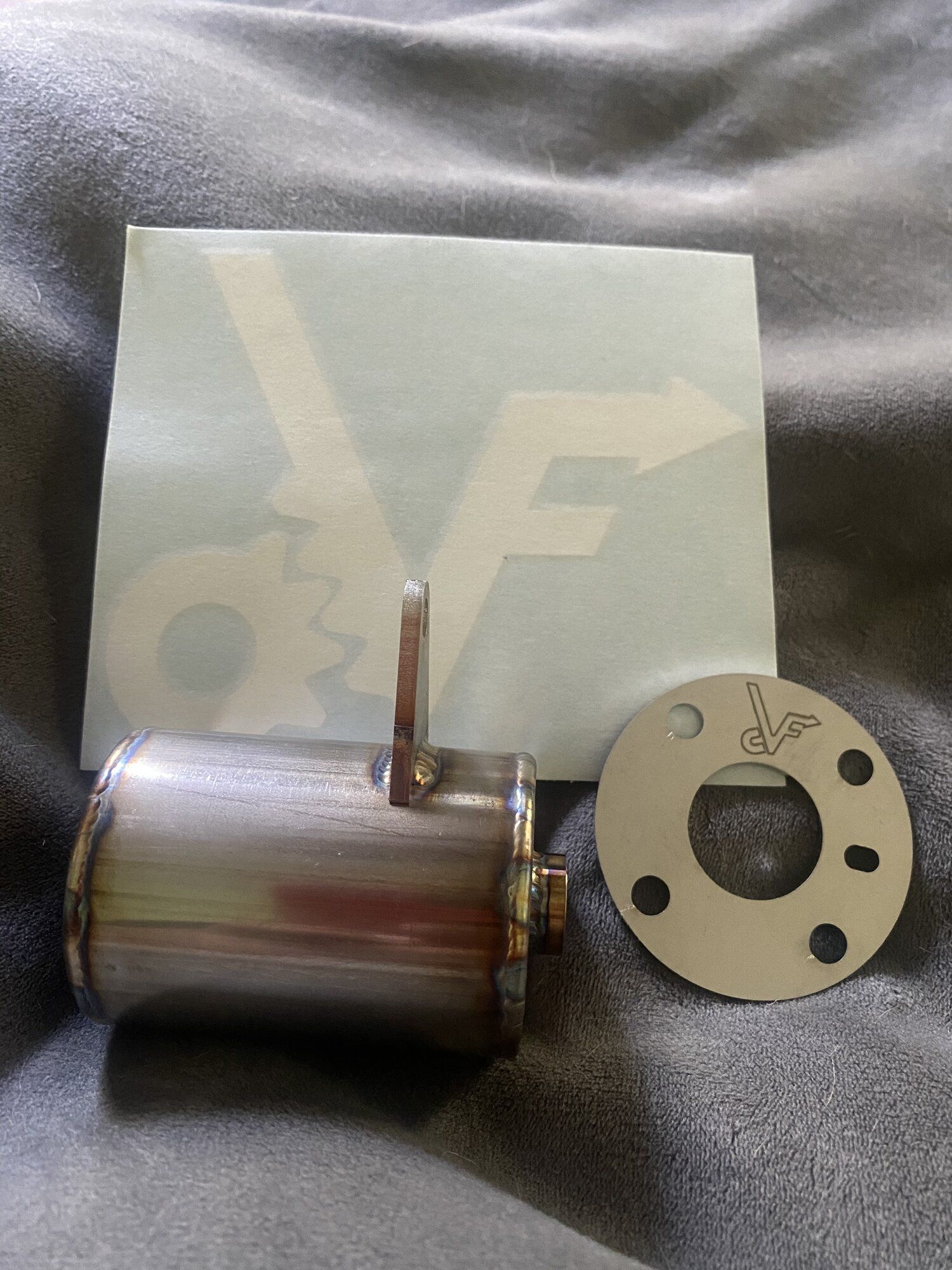

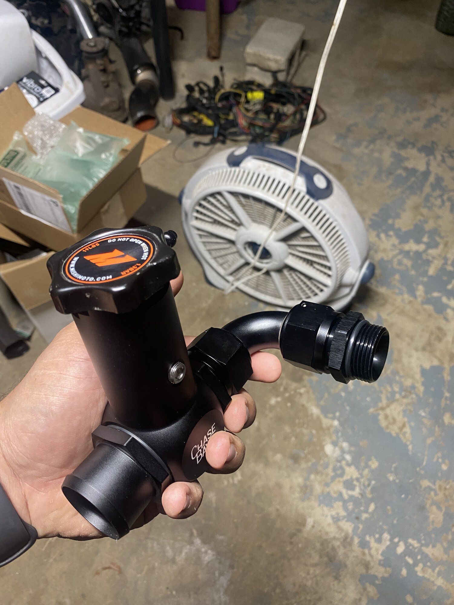

Couple of the 16an fittings I needed for my thermostat delete. Just waiting on the piece from chase bays and from frontline fab

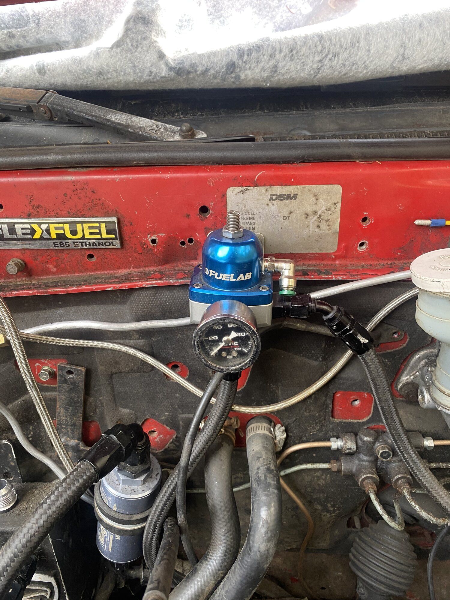

regardless, what is the fascination with these type things. The stock parts work excelent, are compact, and easy to remove and plug the extra ports. This looks like a nightmare of adapters on adapters adapters..
