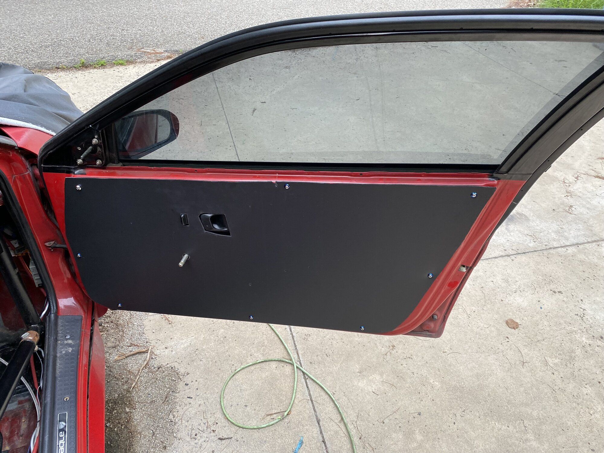

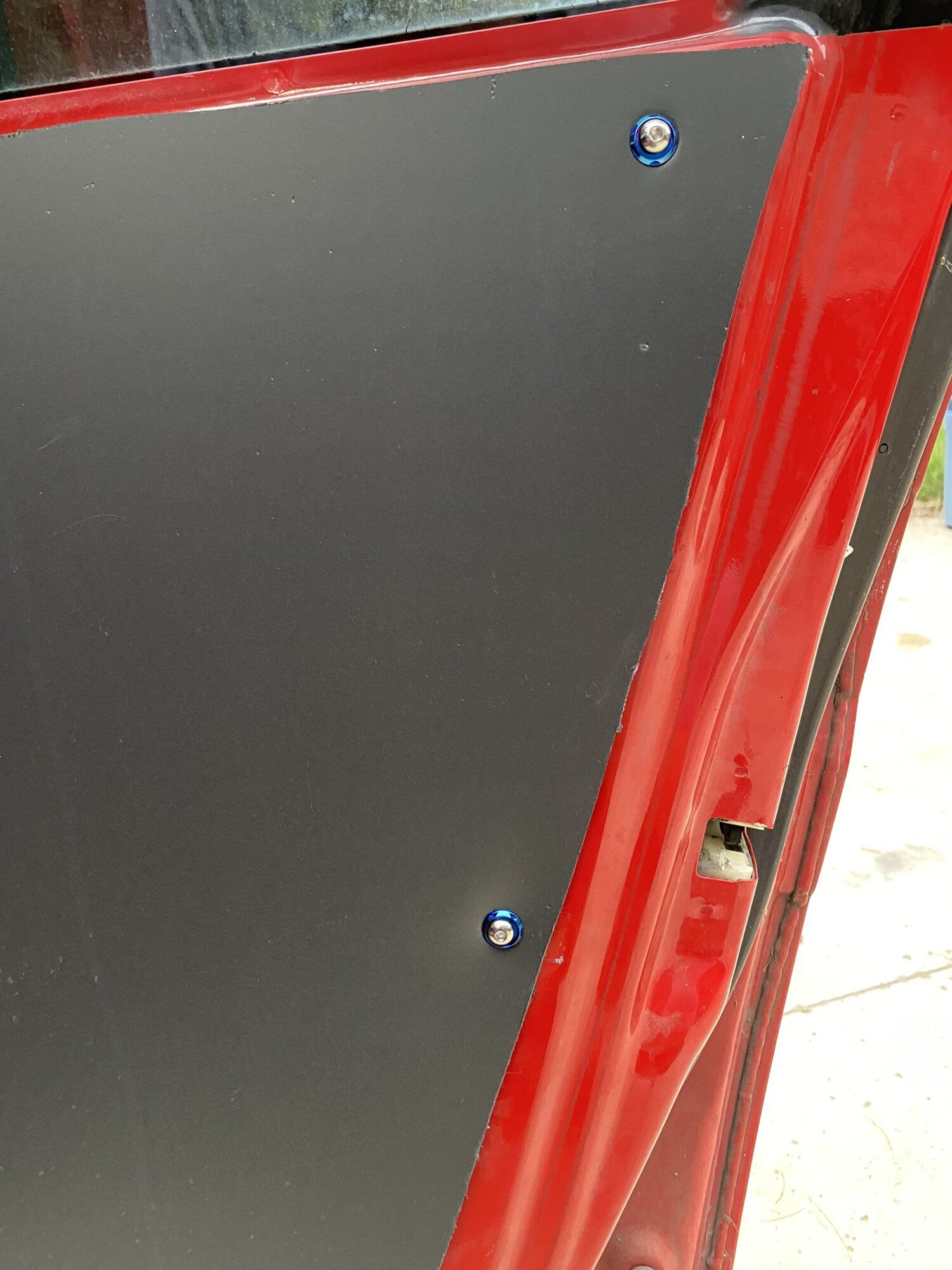

I did however start working on door cards
Had to order hardware to bolt them on and got to finish putting riv nuts in place.
Also got my pieces to do the grab handles for the doors as well

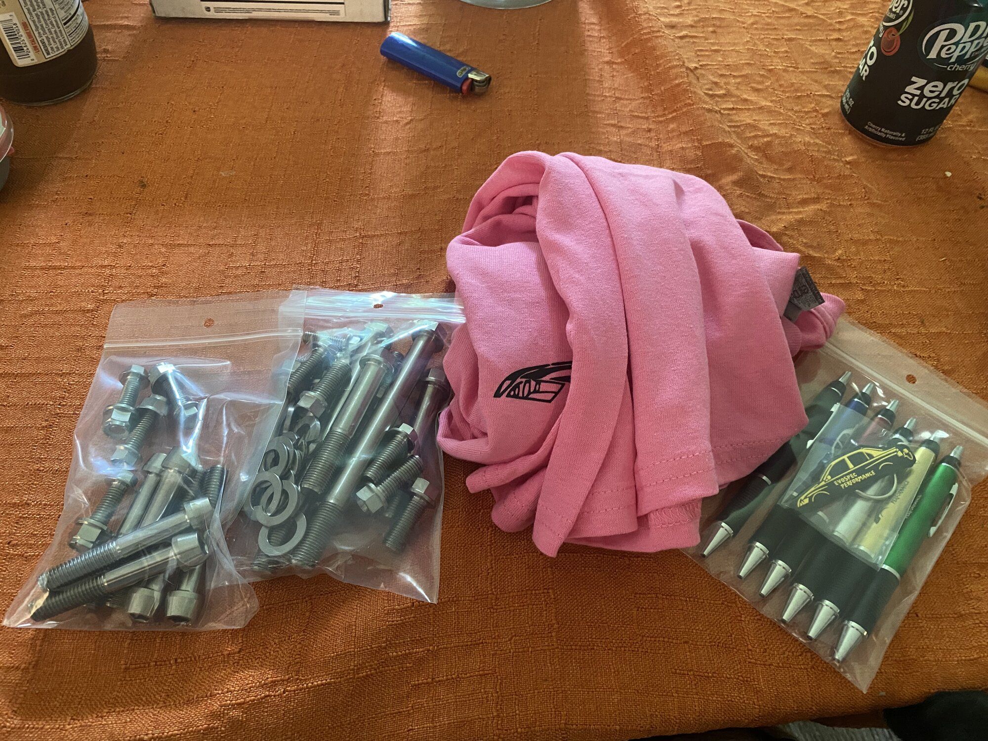

Eveospec performance ti bolts for intake manifold, cam gear bolts, and balancer bolt for the new motor
New valves from gsc and ferrea valve locks
Also ordered parts for refreshing the t case when I get it set up for the 300m shaft.
Also went ahead and ordered ti t case bolts 🤣 wanted new hardware to bolt it together and found those so why not LOL

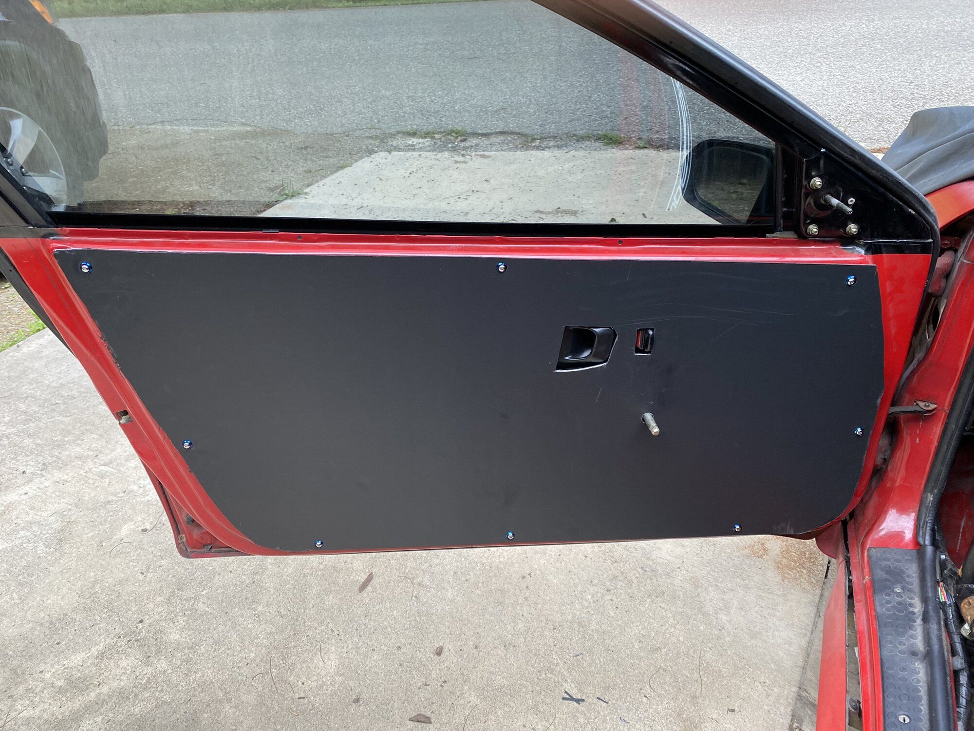

Pretty sure Ohio weather hates me😔. I have gotten a few more parts in and did get my hardware for the door cards in so go those put on.

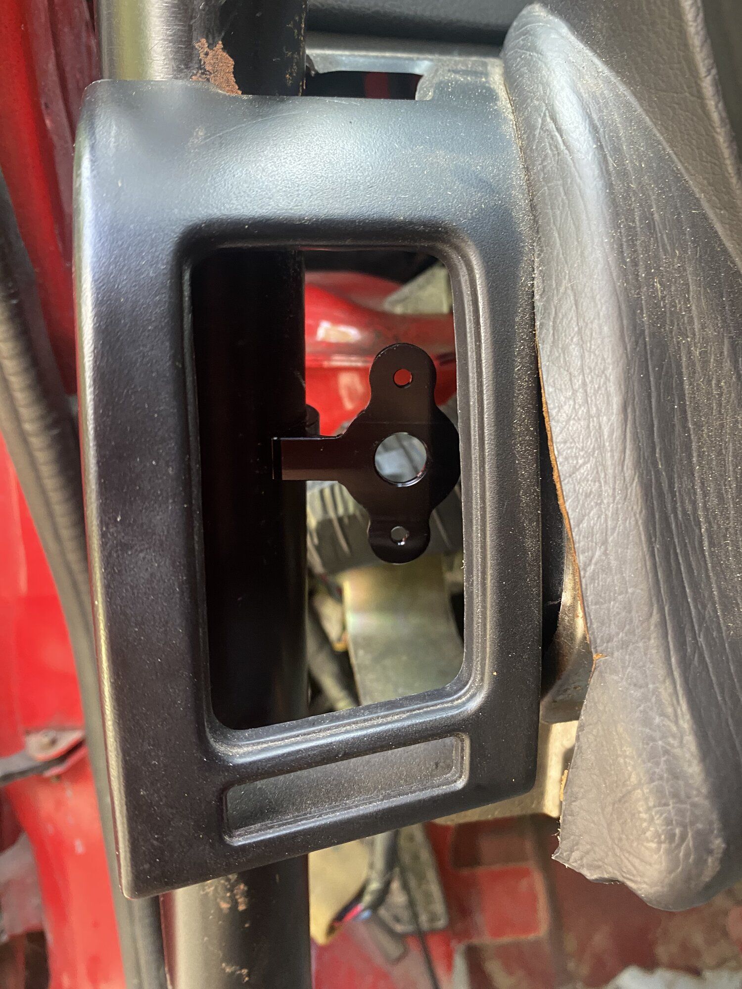

Found this little mount for the pull handle on the second fire suppression kit I plan to install.
All bolted in.
Just about done.

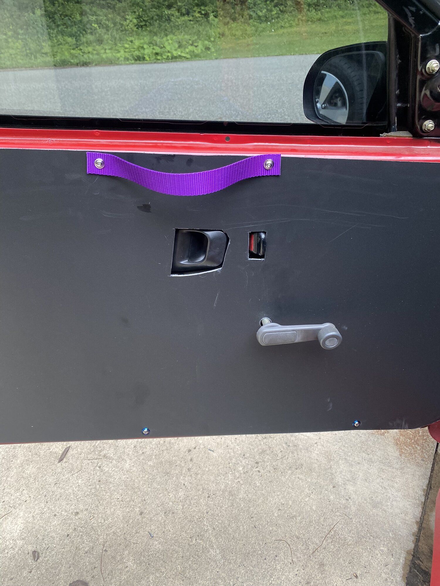

Added the pull handles so it’s easier to pull the door shut from the inside.
