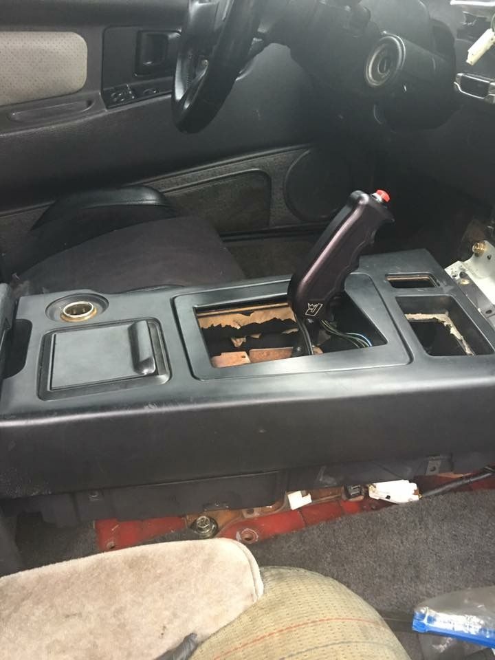

it was originally a 5spd car but that soon changed. I had already started getting parts together for an auto swap. now everything just had to go into this chassis.
all done here getting its initial drivabillity tune.
first time taking it out for a cruise.

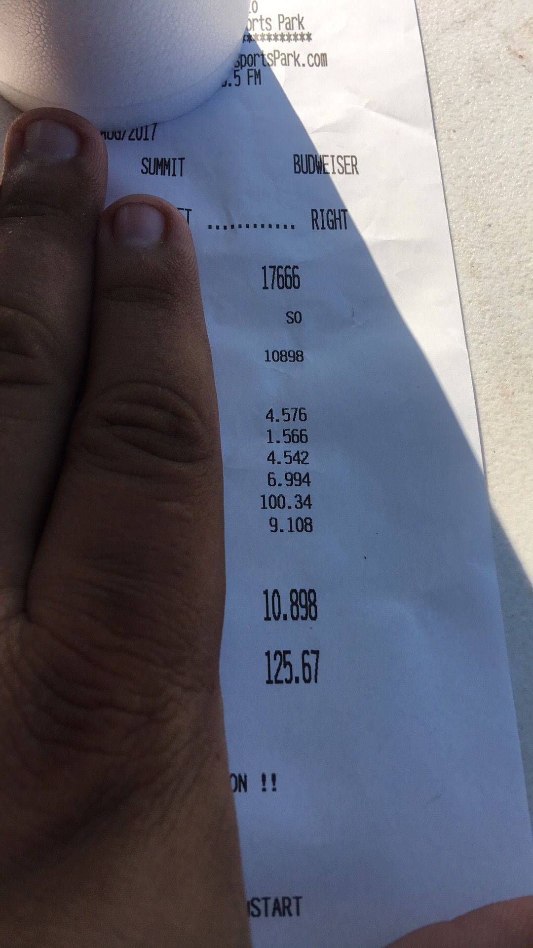

so got the bugs worked out of the car. we got it tuned on wastegate pressure just in time to take it to the 2017 dsm shootout to make some shakedown passes in the car. car went a best of 10.89@ 125.6 with a 1.56 60'. ive since then ran into issues with the intank walbro 450. so building a home made bolt in fuel cell and going to be running a magnafuel mp-4303 pump. more pics soon to come.

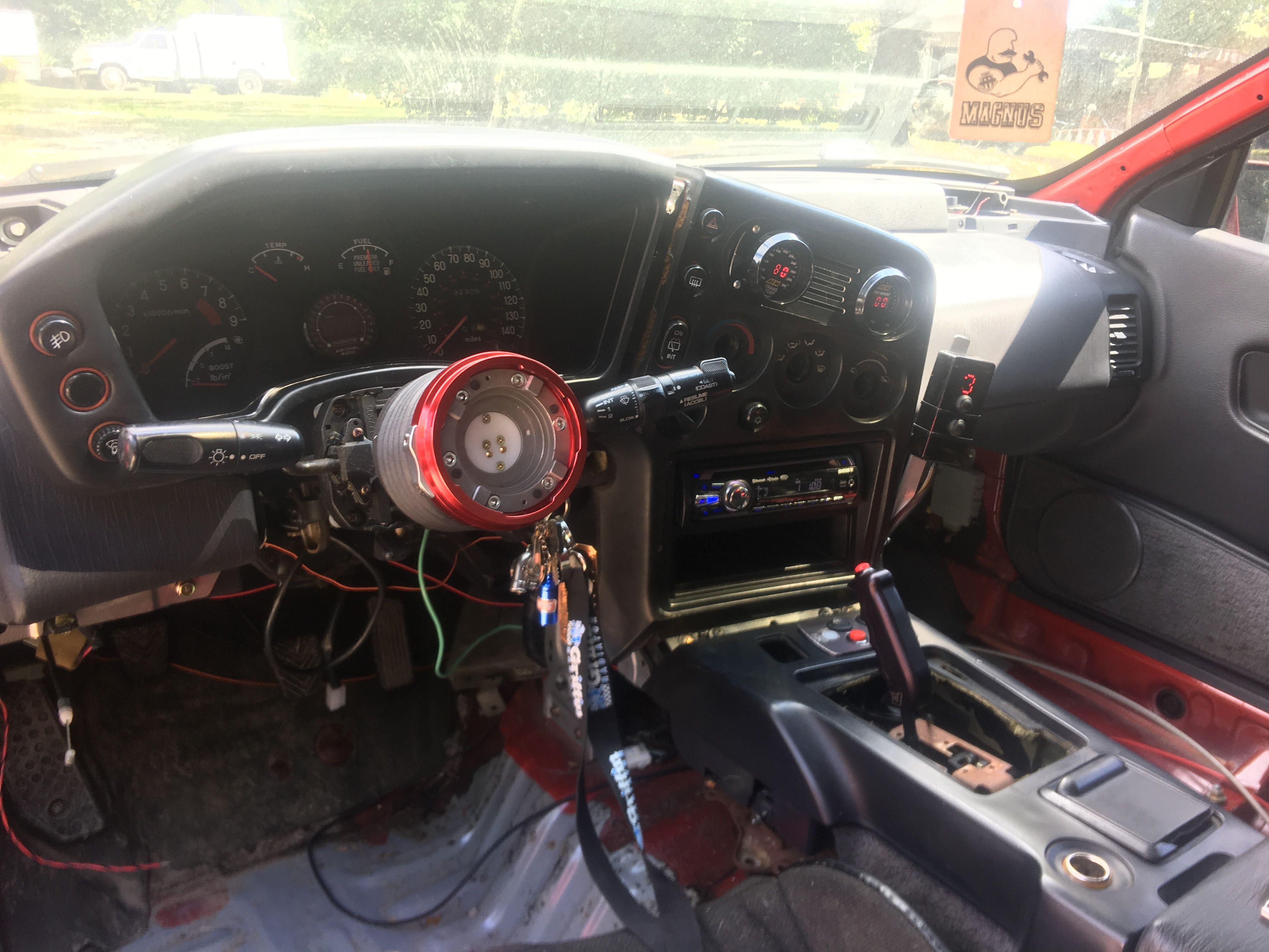

new steering wheel I got from the gf for Christmas. now to get the install kit and slim quick release for it.

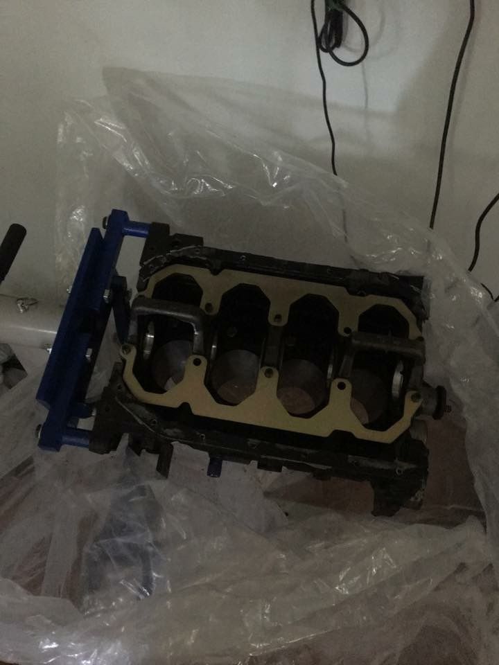

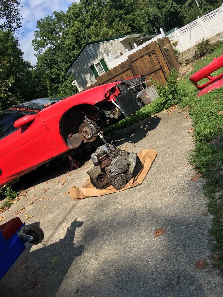

figured id post some more pics of when we were getting the car together.
the first weekend I got her home and started tearing the 91 apart to start transplanting everything over to the 92 shell.

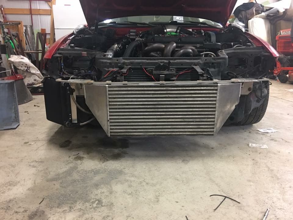

putting the true street front crossmember in. waited forever on this and the mustache bar LOL.
swapped the old 5spd 4 bolt out in favor for the auto unit and installed the mustache bar.

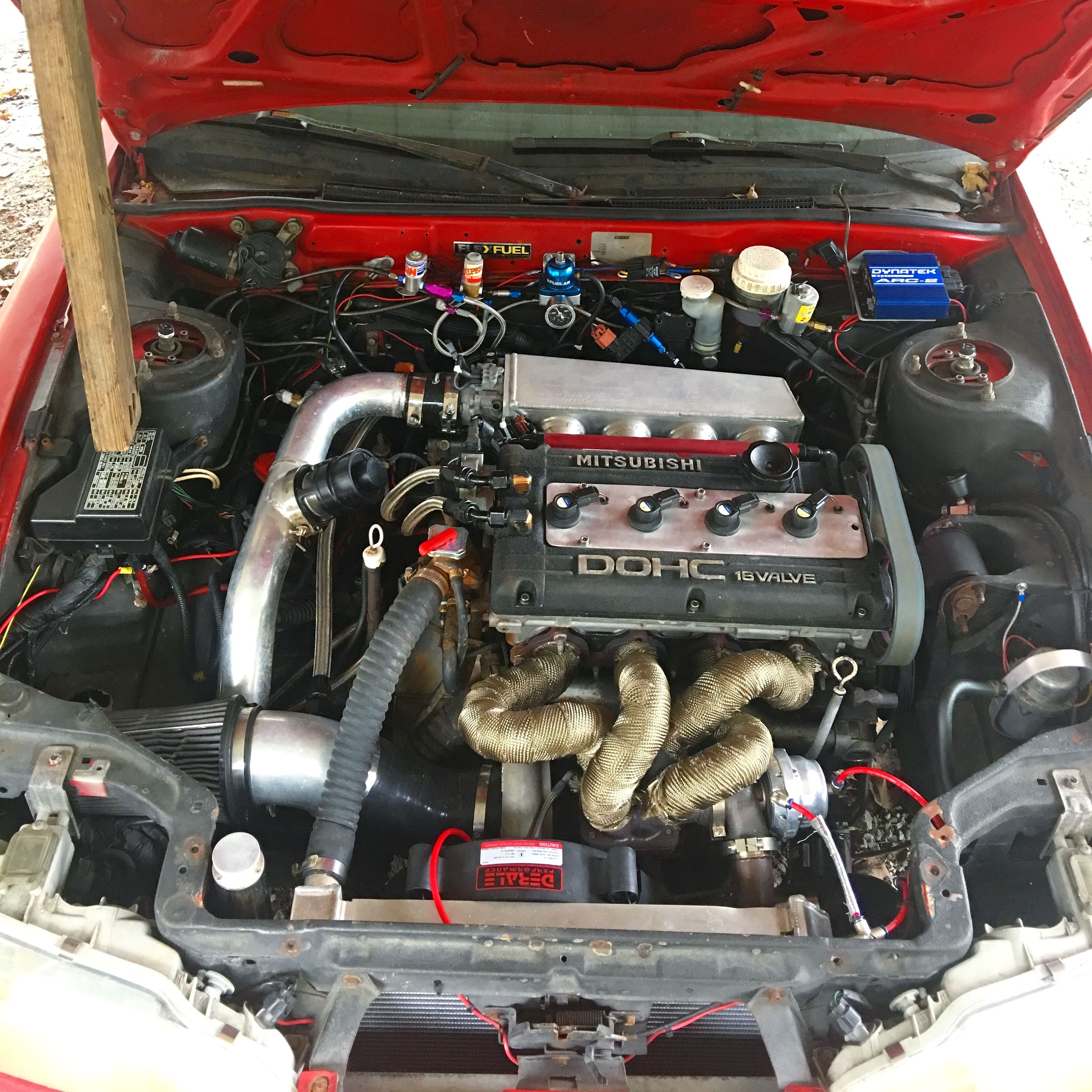

then decided to put the manifold and turbo on. they were right at home there
got the new e85 safe lines ran then.

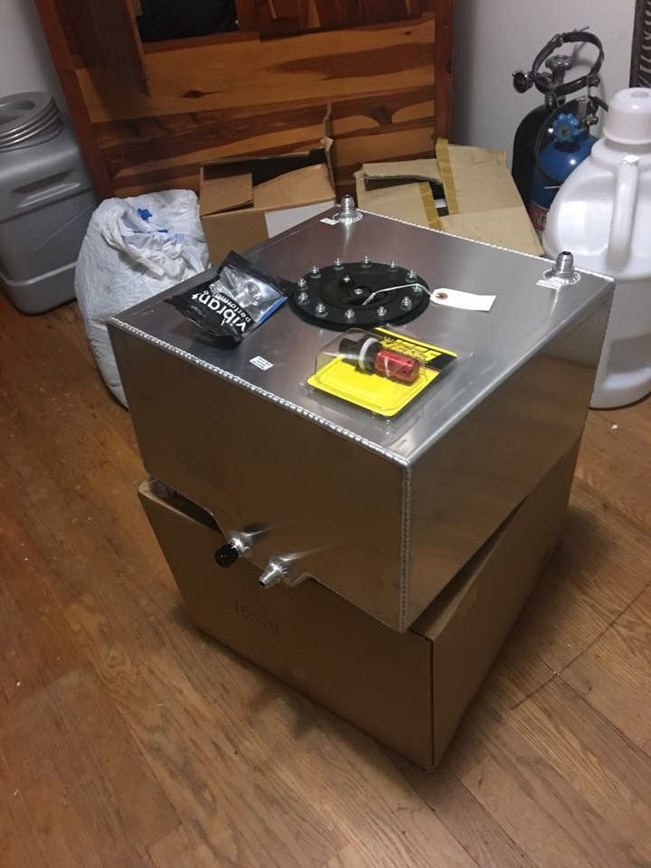

so after all of this stuff being done we got the tune and went on to shootout. a week or so after shootout I was having issues with the car breaking up and giving me all kinds of hell. finally traced it down to the walbro 450 getting hot and dropping fuel pressure off in boost. I had already had the magnafuel mp-4303 sitting on the shelf waiting for the winter to go on the car. decided it was time to throw it on. the plan was since the jm fab cell was so damn expensive (im a broke man LOL) that we would just build one from a regular 10 gallon cell for much much less.
day I picked everything up. ended up not using the bolt in rollover since the cell had one already welded in. so we then got to work. I designed everything and had a buddy weld it all up.
this was the last semi unfinished photo I have of it. I have pics posted above of the finished outcome. fit like a glove and sits about the same height as the jm fab unit.

this finally came in so I can get the steering wheel installed. it was ordered like a month ago and momo took their sweet time to get it shipped out.

What fuel cell is that? My oem gas tank is leaking so I'm thinking about buying a fuel cell to replace it. Not man enough to run the rpf1s anymore? :)
LOL the rpf1s have my drag radials so theyre tucked away till it stays warm out. the fuel cell is a home built unit because im poor and jm fab was over $600 LOL
