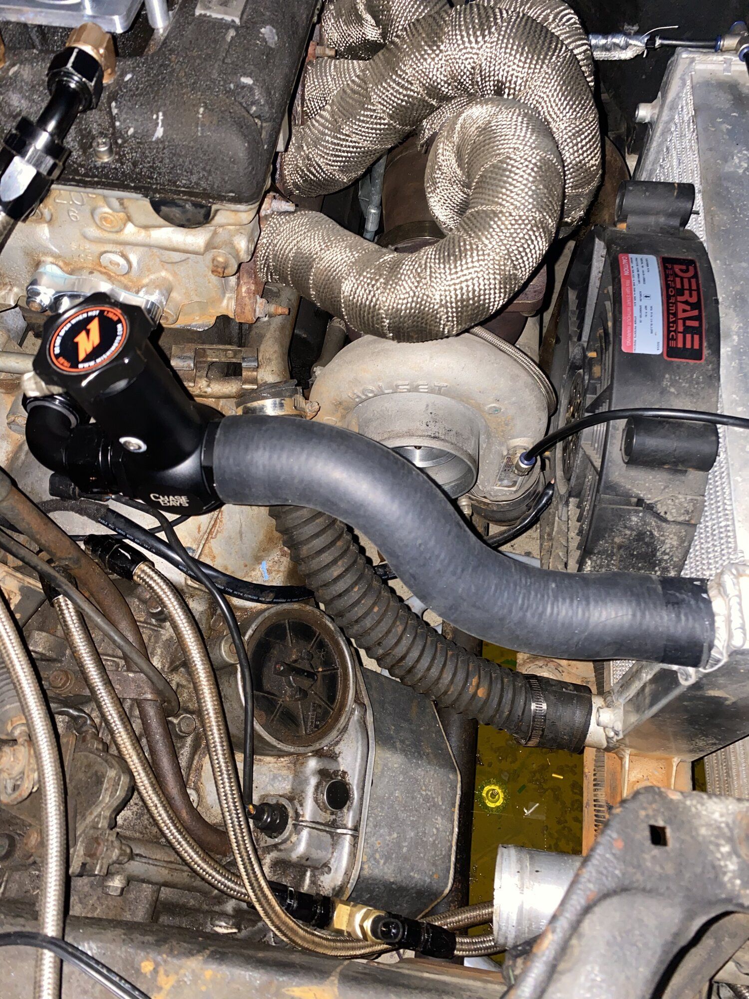

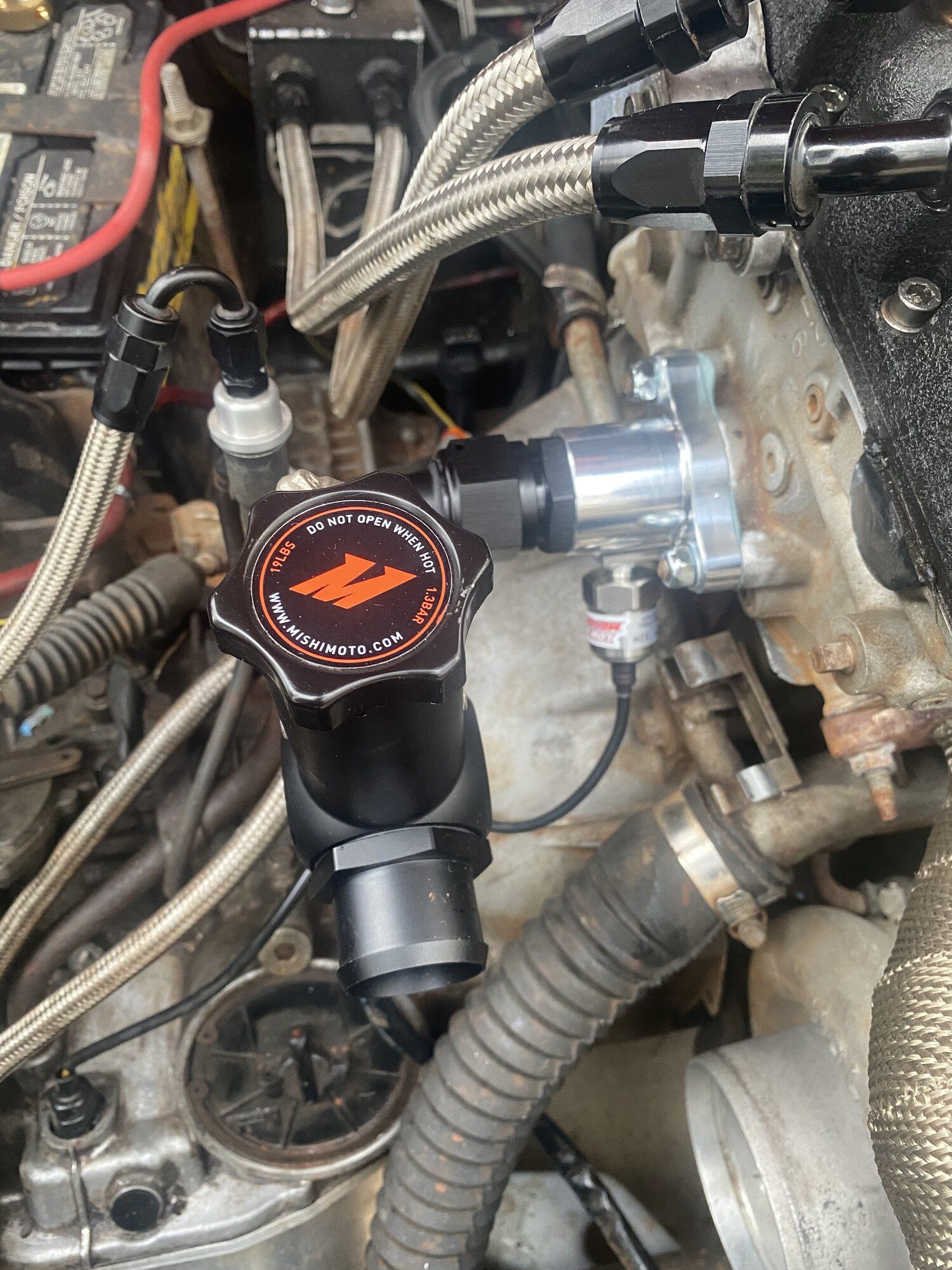

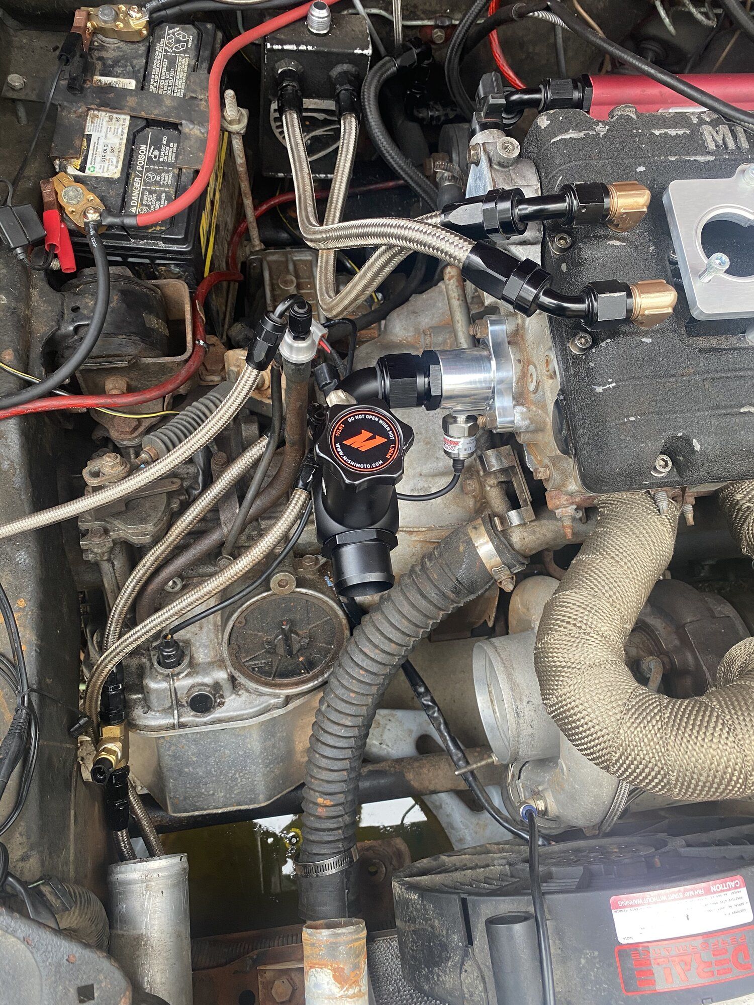

regardless, what is the fascination with these type things. The stock parts work excelent, are compact, and easy to remove and plug the extra ports. This looks like a nightmare of adapters on adapters adapters..
For me this was visually more appealing 🤷🏽‍♂️ Did not like how the stock unit looked even with a bunch plugged off.

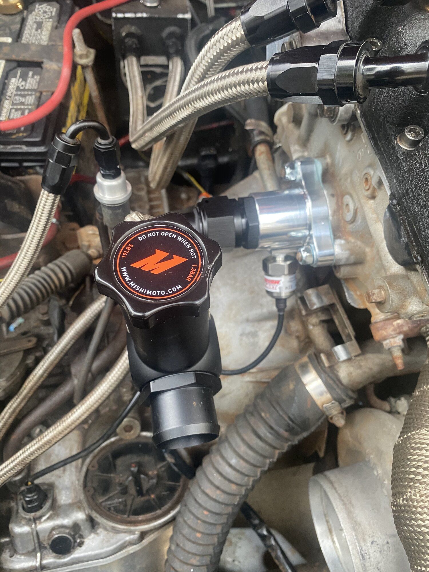

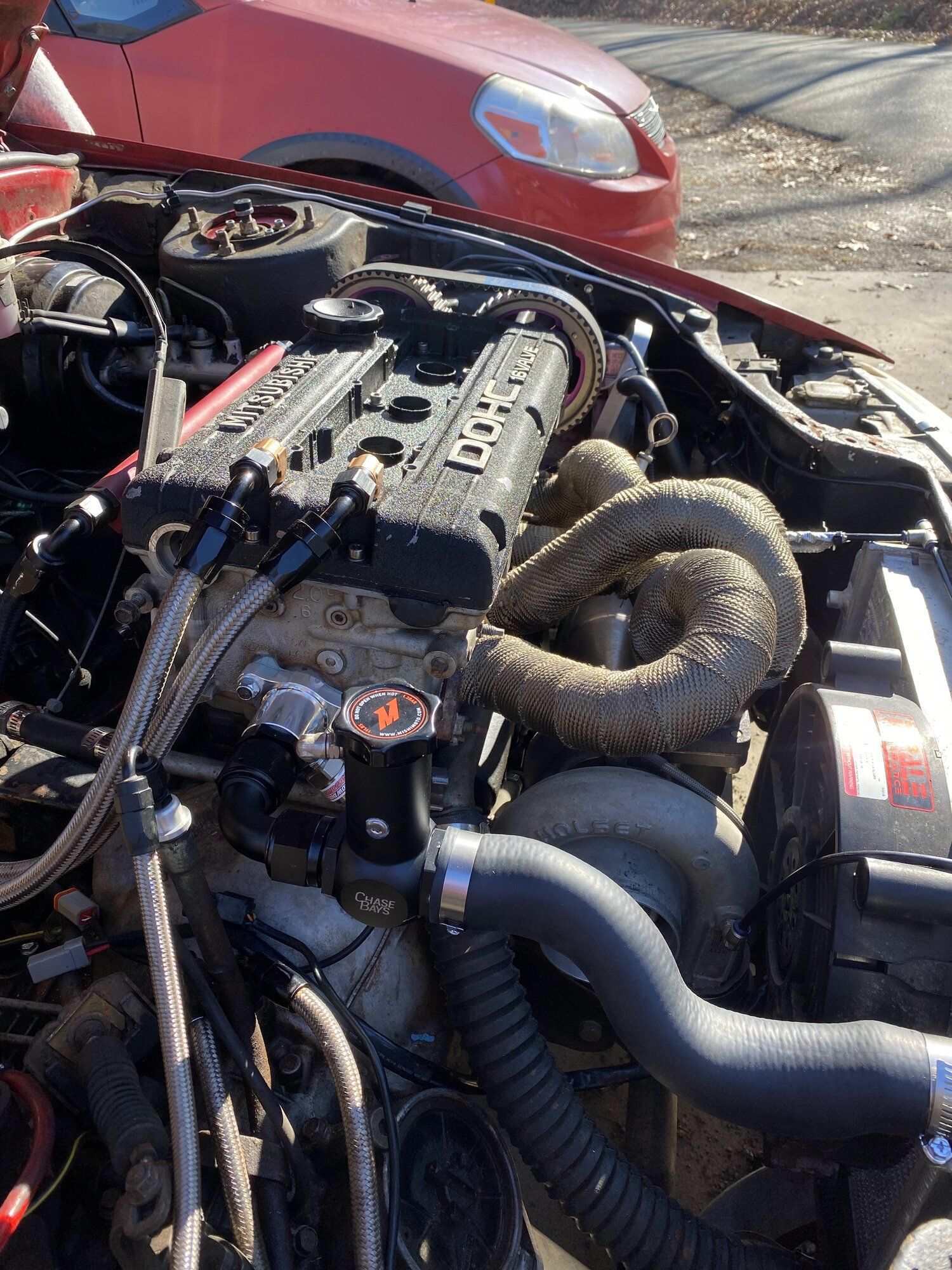

Last piece from frontline fab came in. Thought I had a gasket but cannot find it anywhere so guess I’ll need to order that now.
With everything assembled
Plugged the big hole since I won’t need it.

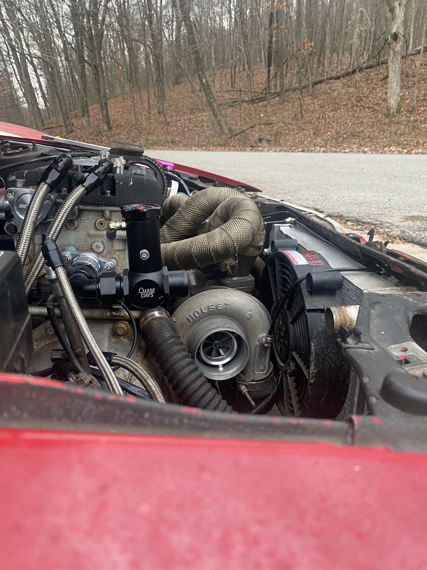

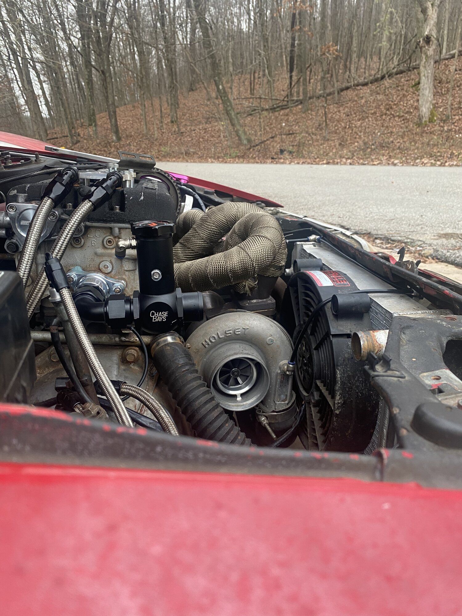

Going to run push connect hose to my coolant reservoir and mount it In The rear of the car.
I’m liking how that chase bays piece routes it, I’d just keep an eye on the Mishimoto cap. I’ve seen more than one instance where those Mishimoto caps don’t hold the pressure they’re rated to, in all cases they were switched to an 8 dollar hollar Motorad job from the parts store that held no problem.
We’ve had one on the wife’s Genesis coupe for a couple years now and it’s done well on there. Worst case I order the chase bays cap LOL

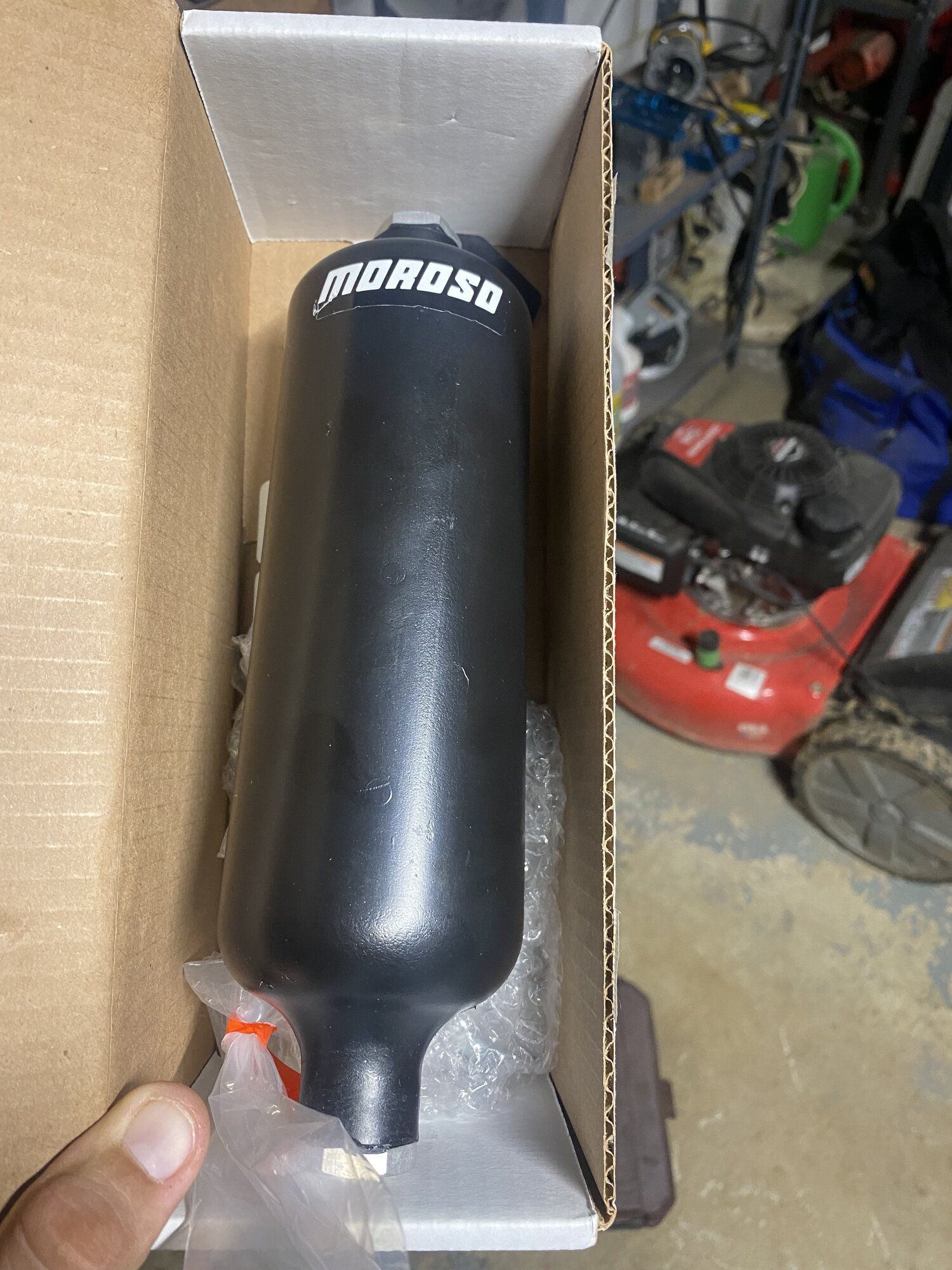

Little work done today before it started raining .

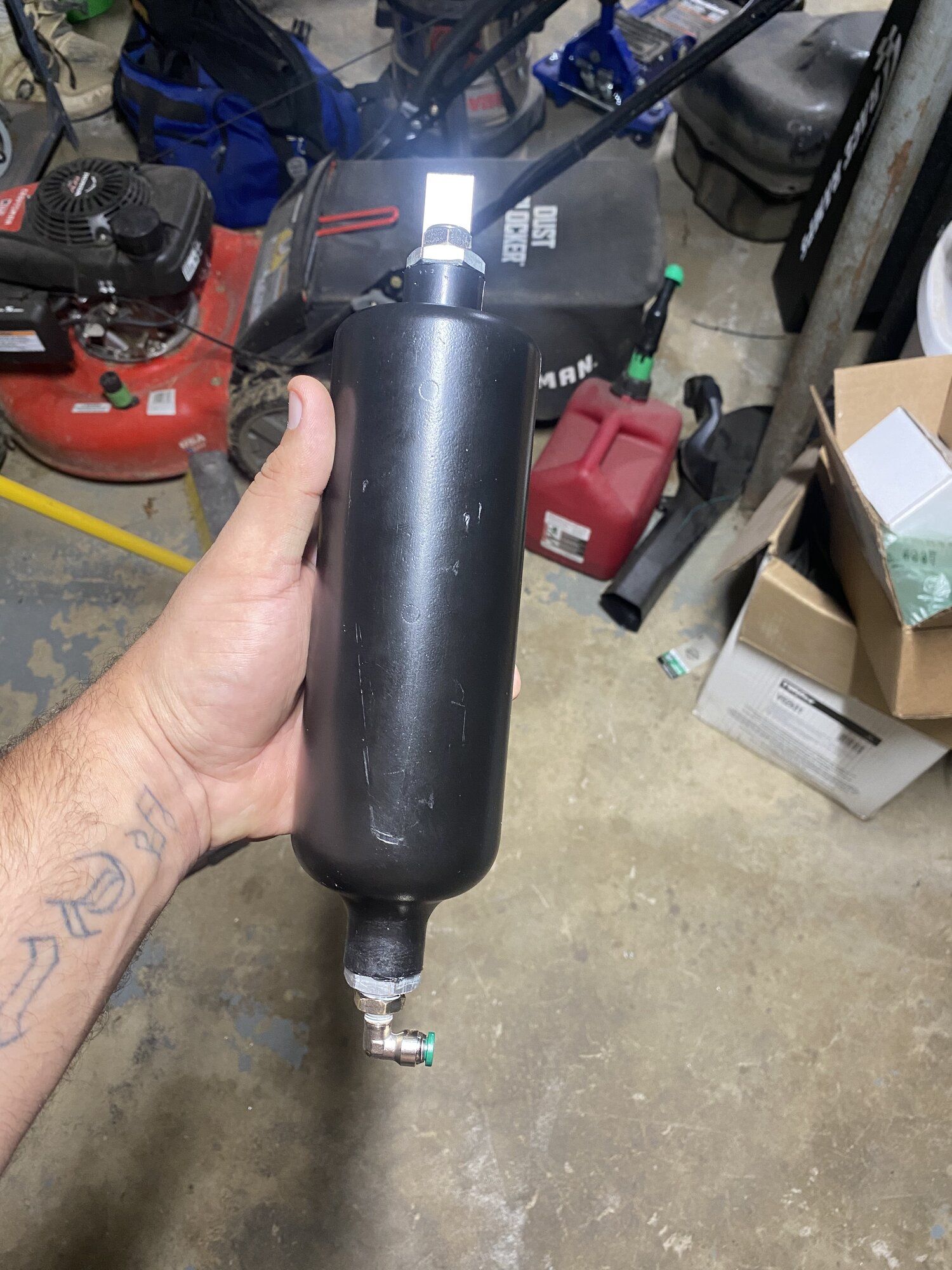

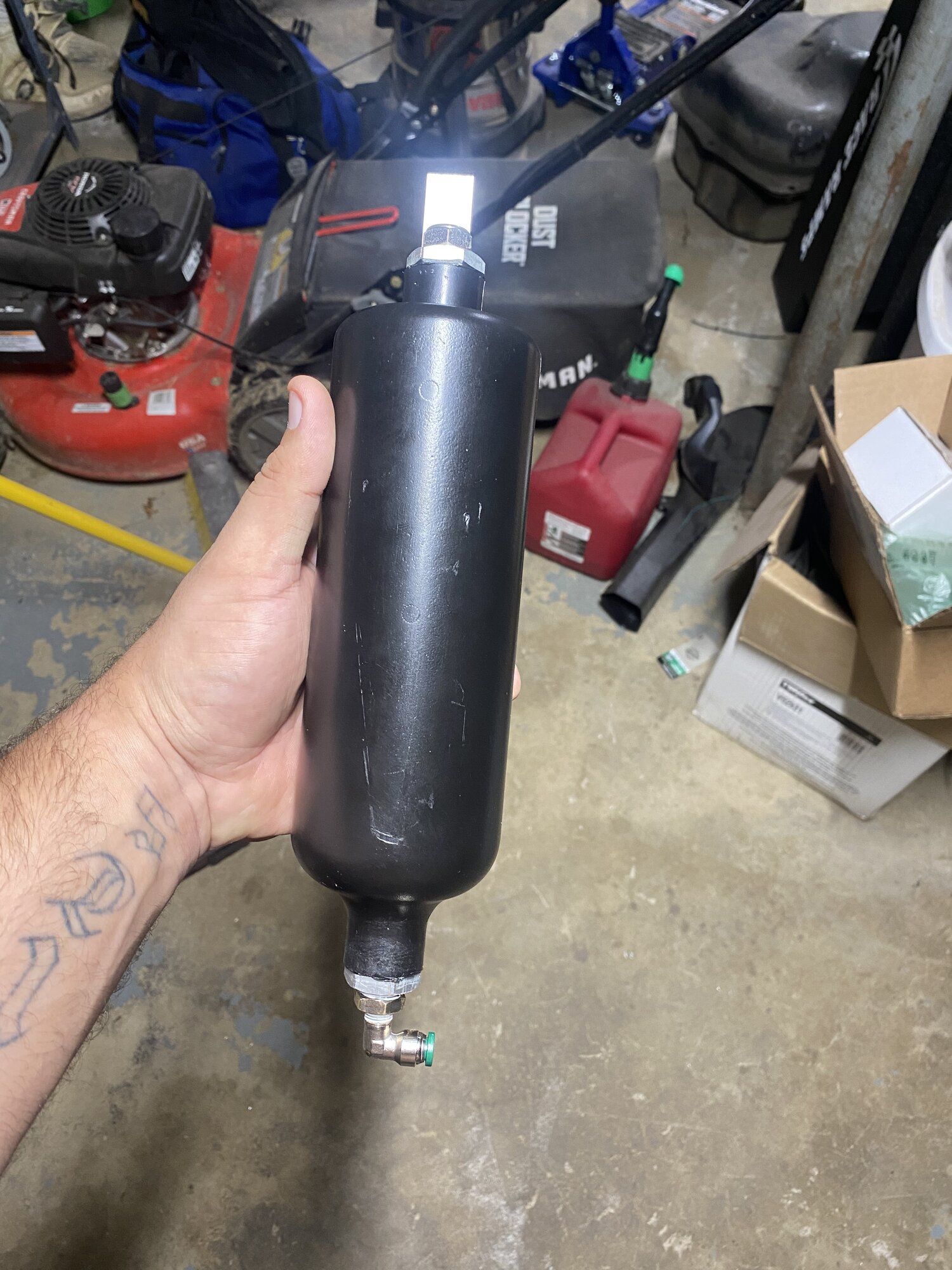

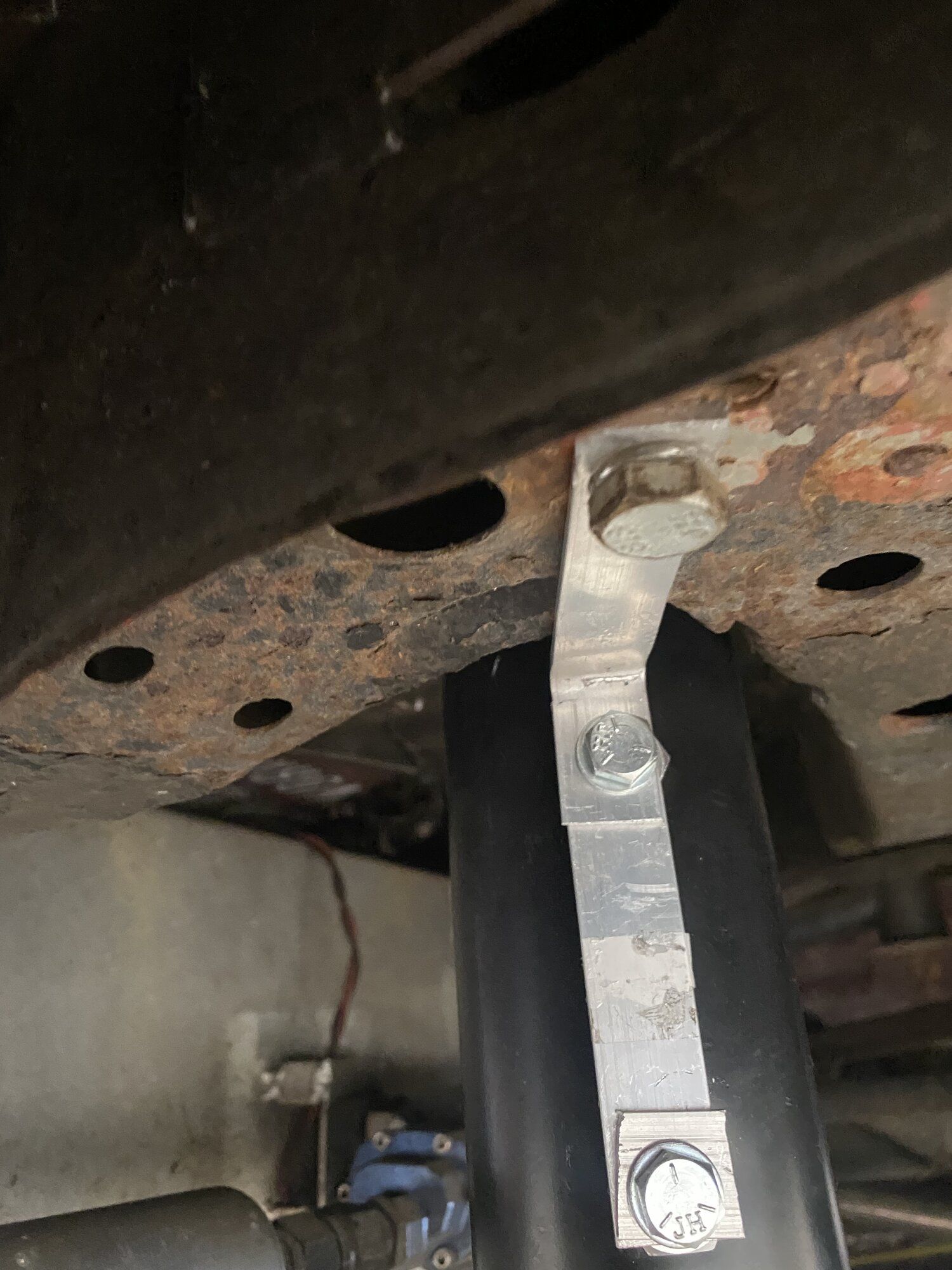

Got all my fittings for my new coolant reservoir. And a simple bracket made up to mount it under the back of the car

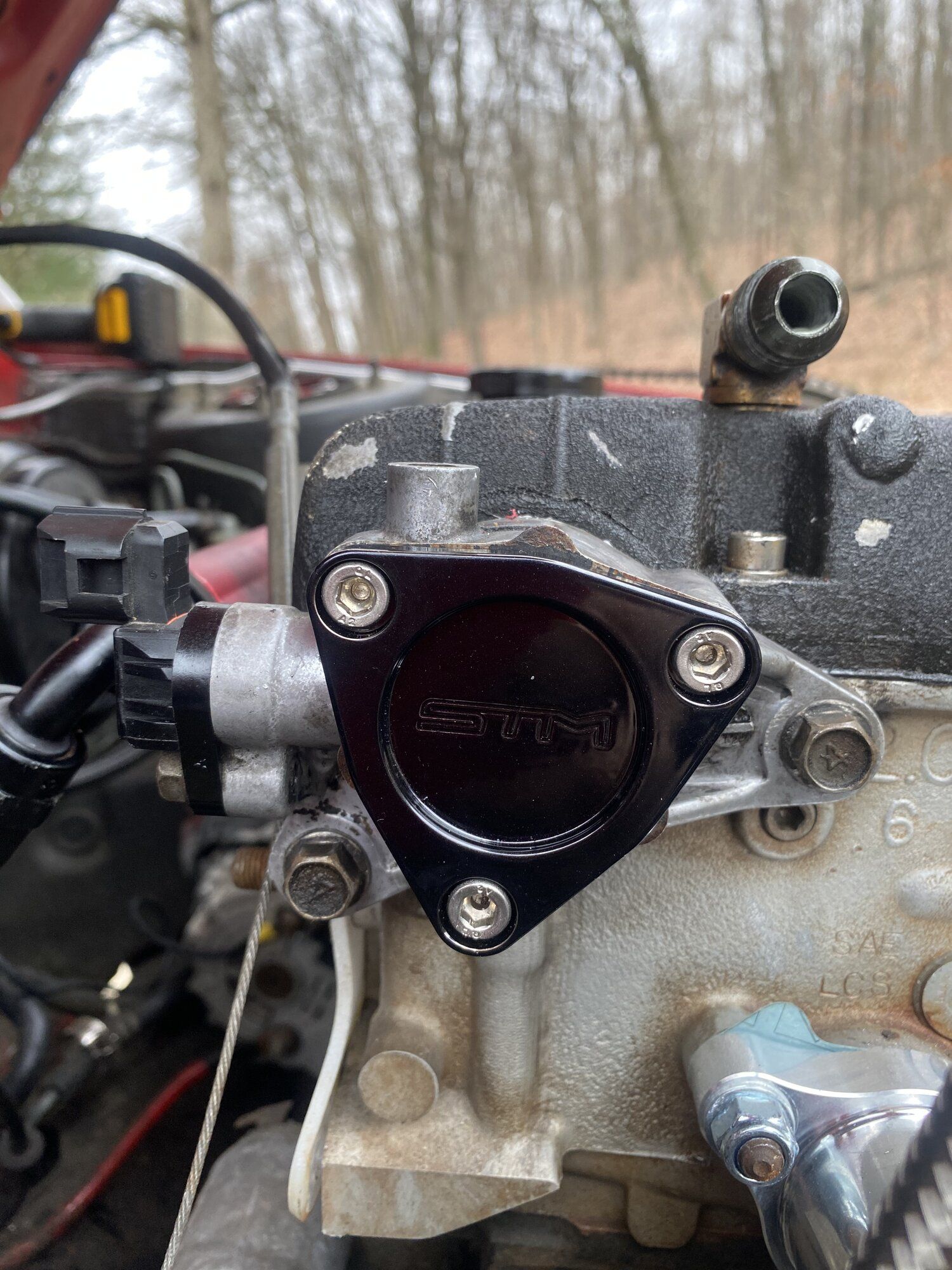

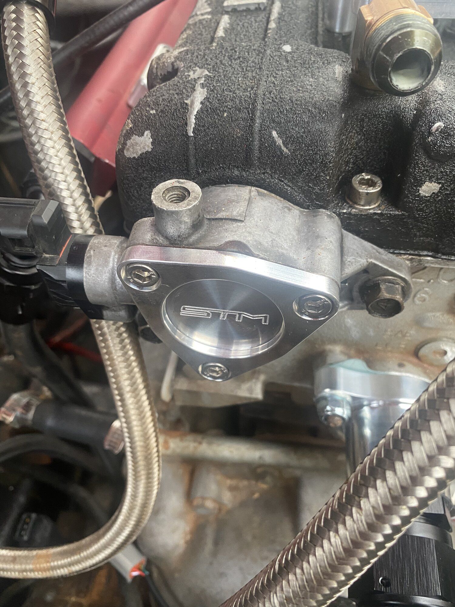

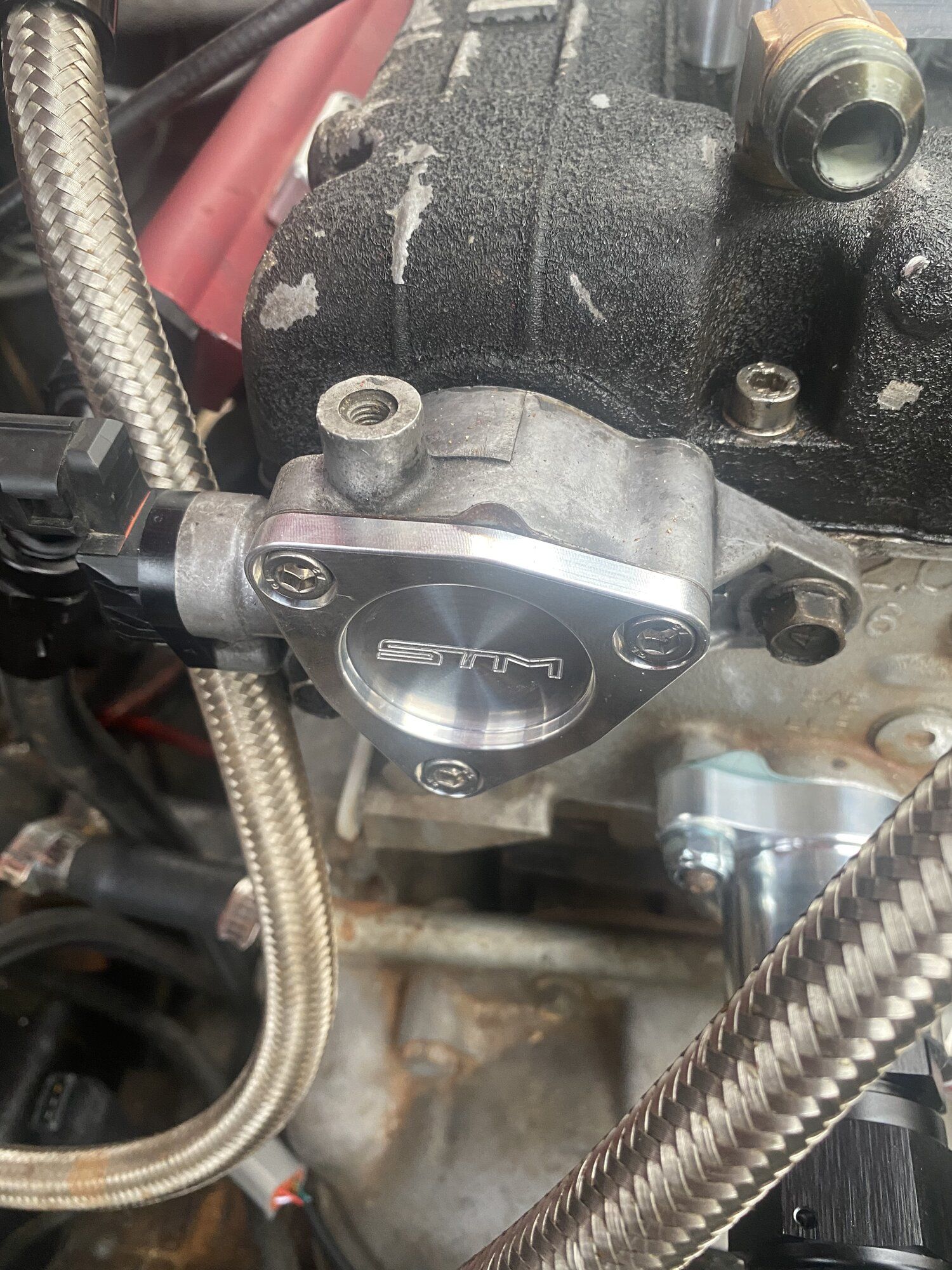

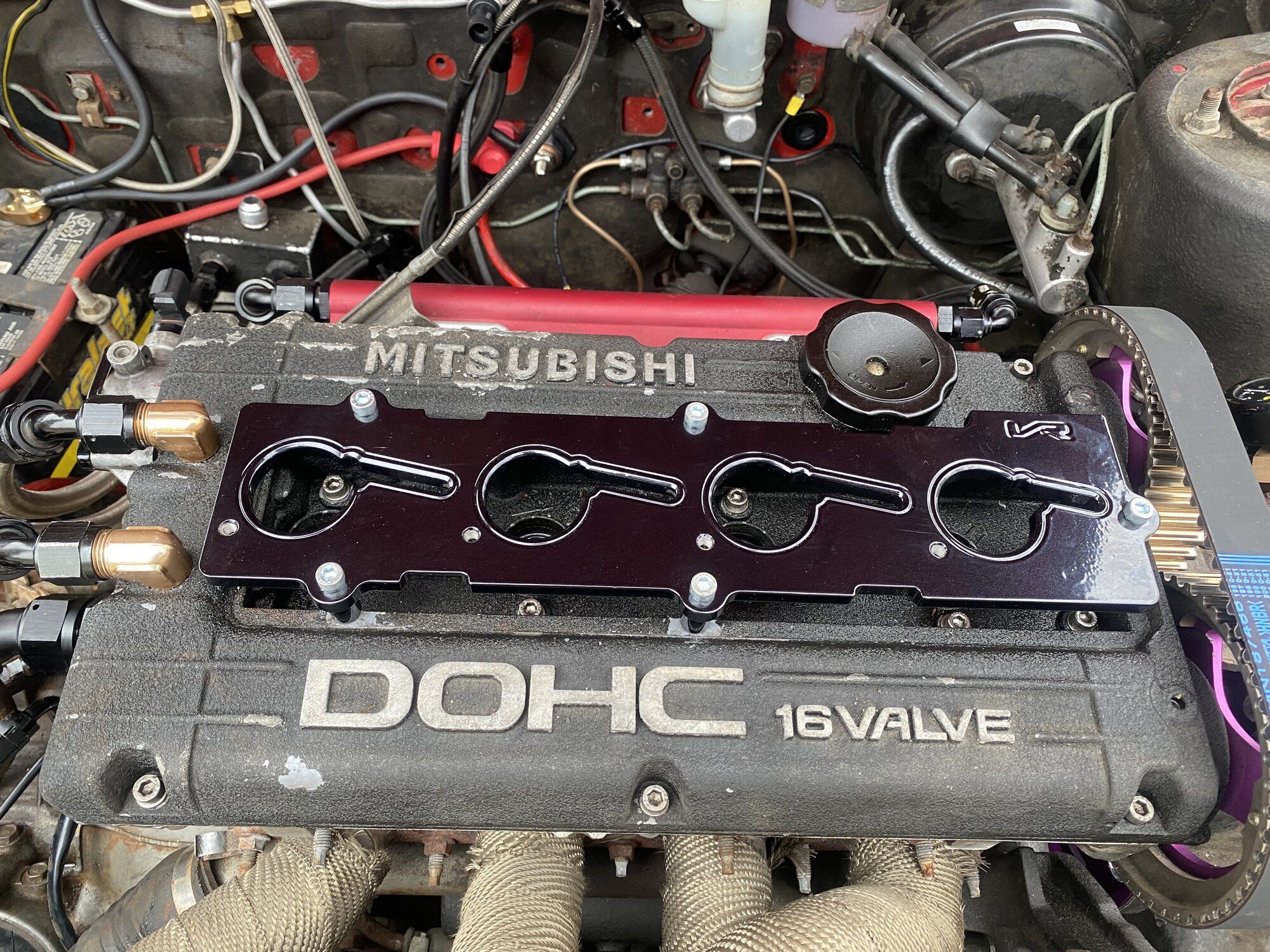

Got my gasket in for the thermostat housing delete in so bolted it down with new hardware and got the chase bays full put on

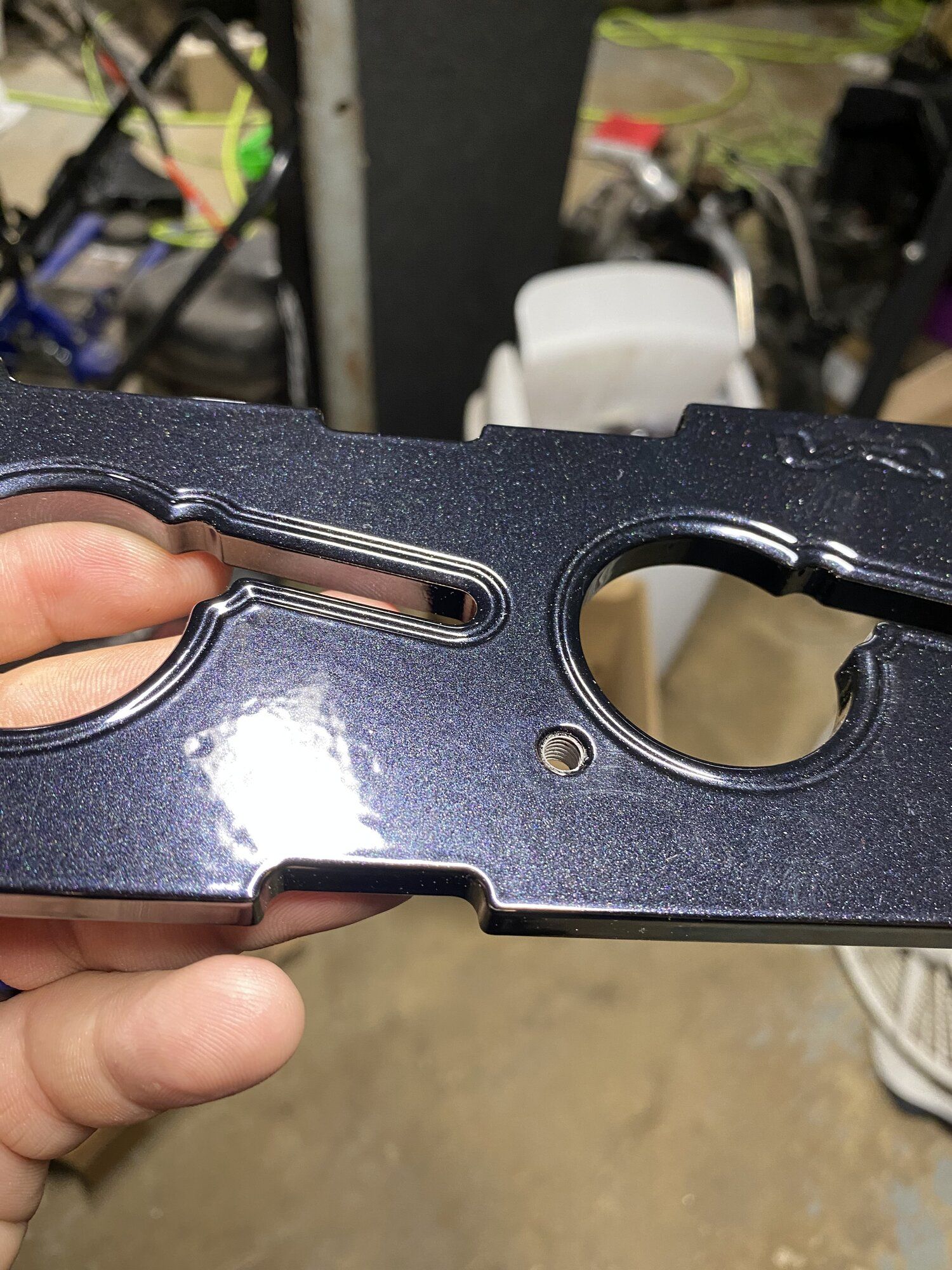

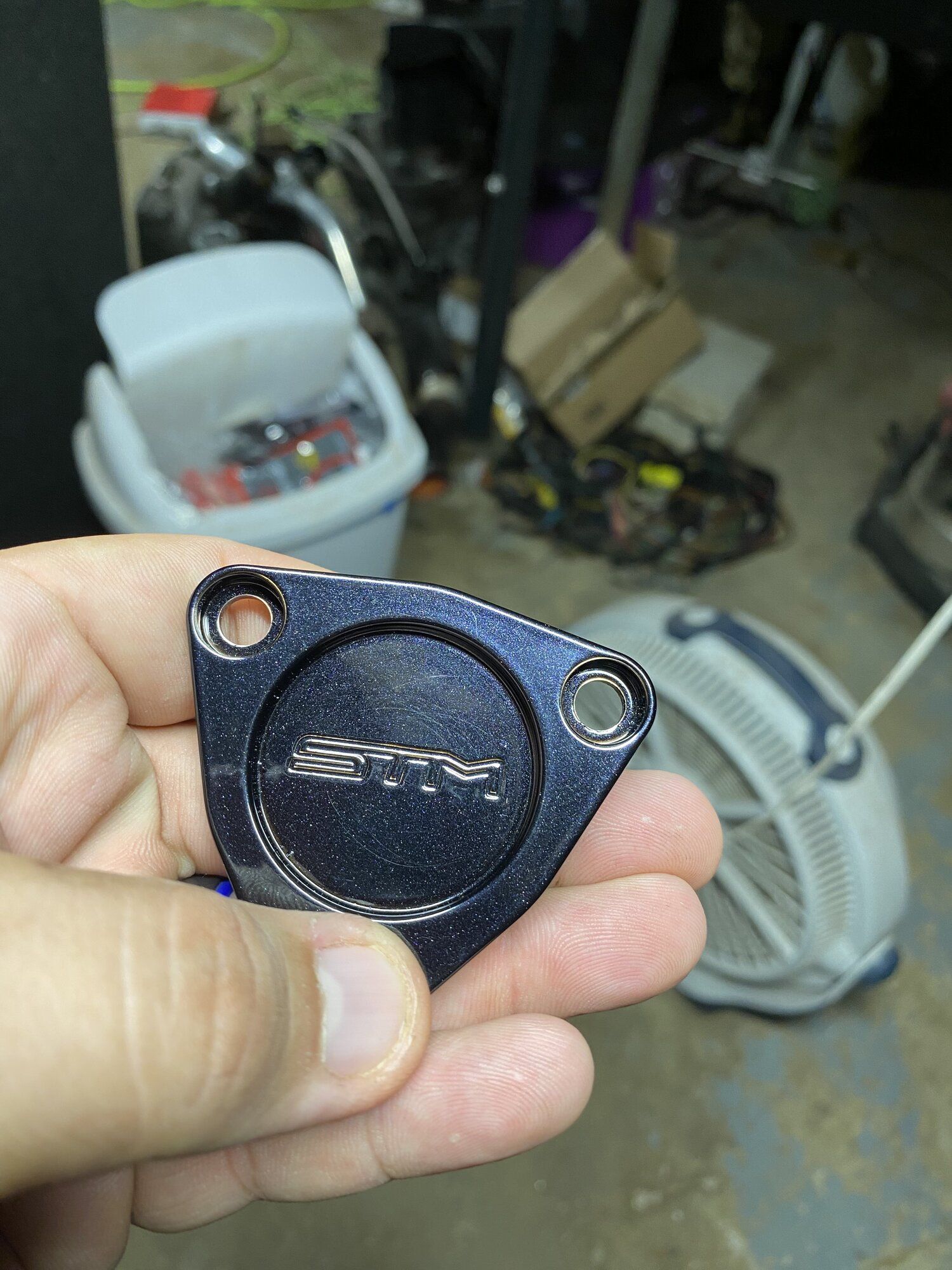

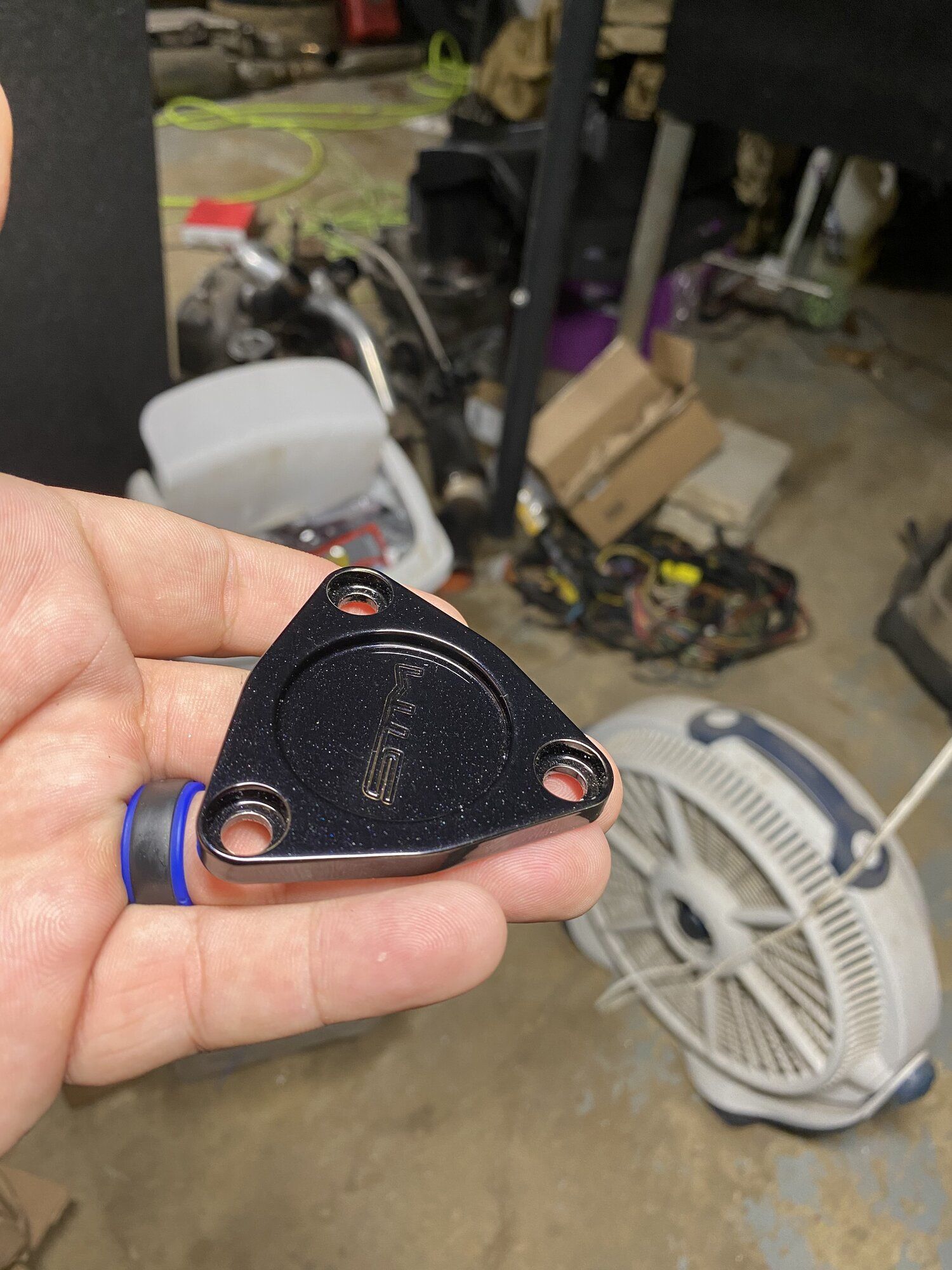

Also picked this stm cas cover since the old one looked rough LOL. Kind of thinking about having a sticker made for the center so make it my own

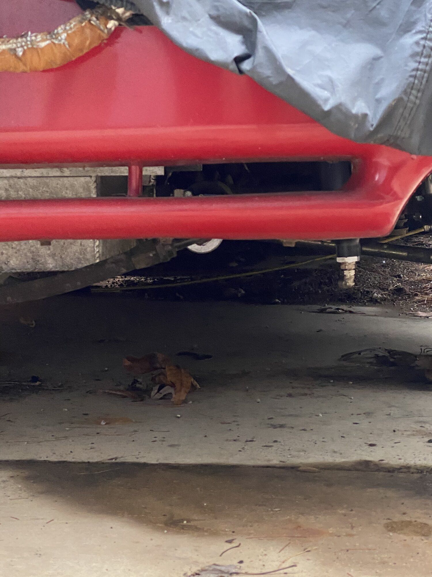

Got the coolant reservoir mounted under the car
The top vent is touching the floor panel so it’s up as high as I can get it.

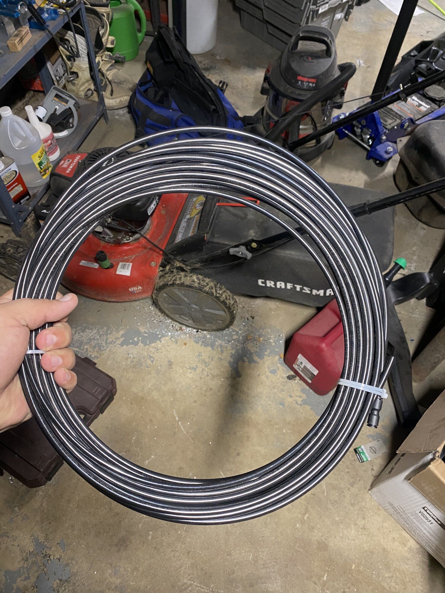

Got the line I need to run from the fill neck to the back of the car from a good buddy of mine.
Also found a molded hose that fits how I needed it to without having to a bunch of extra stuff

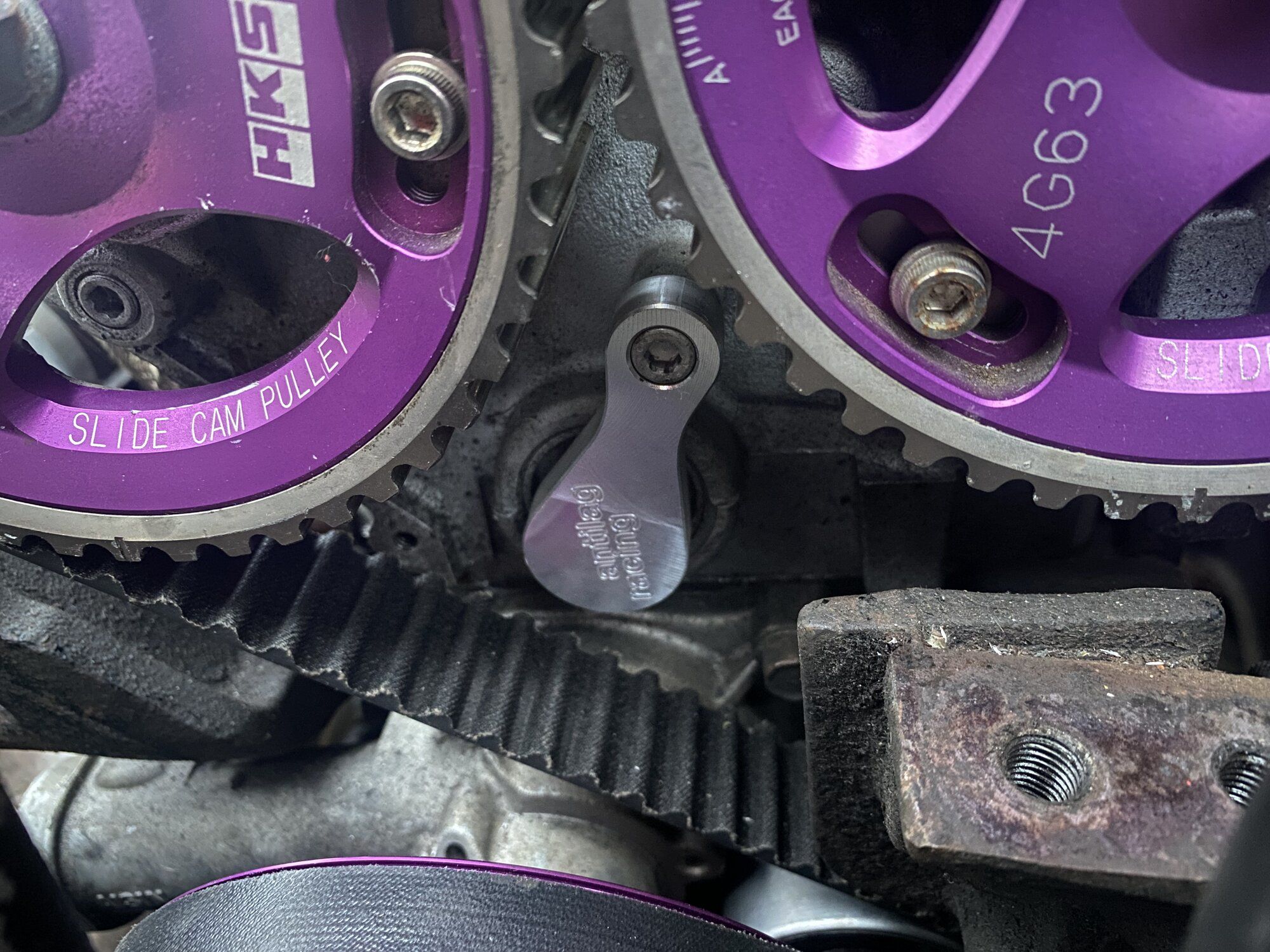

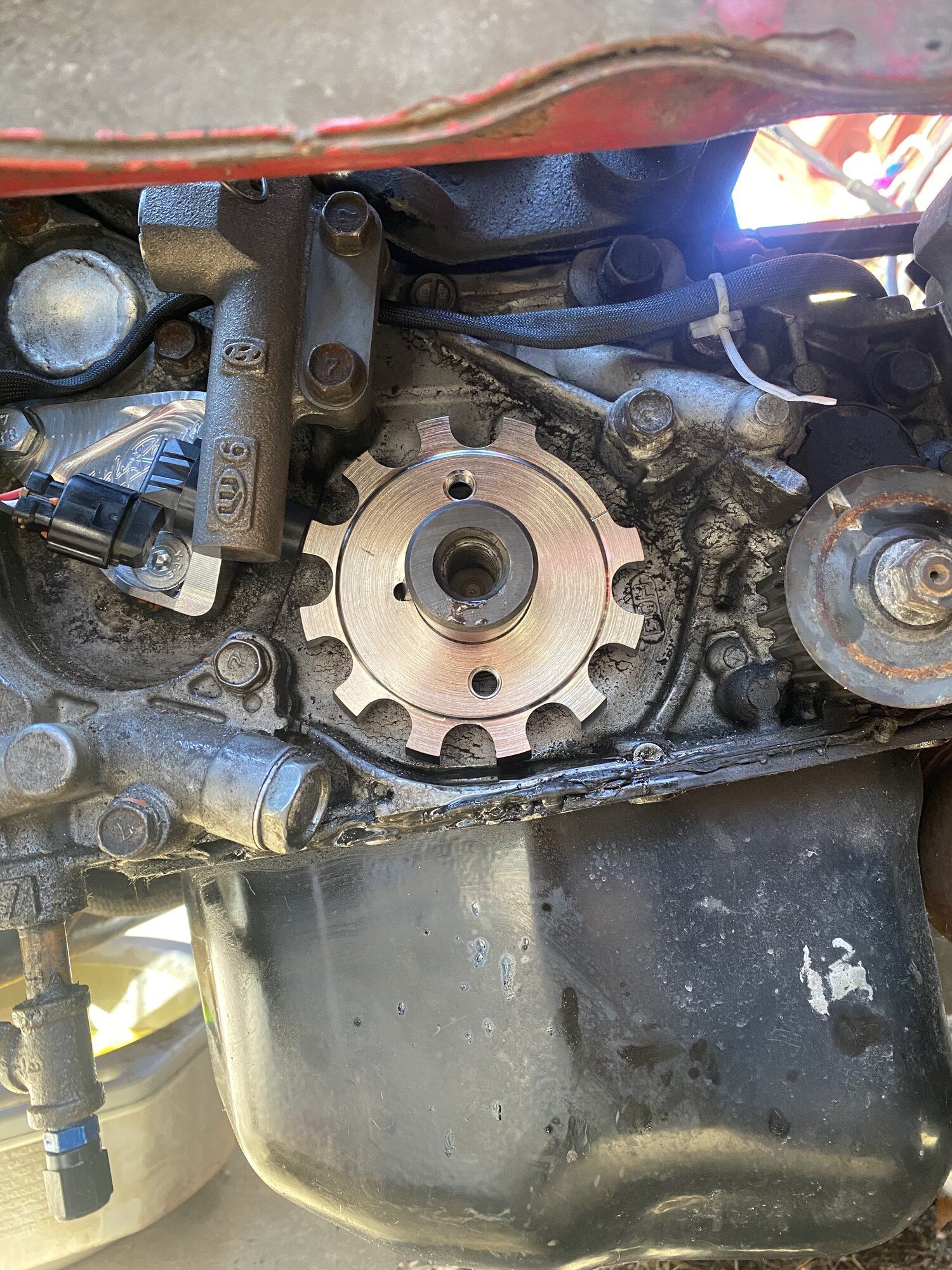

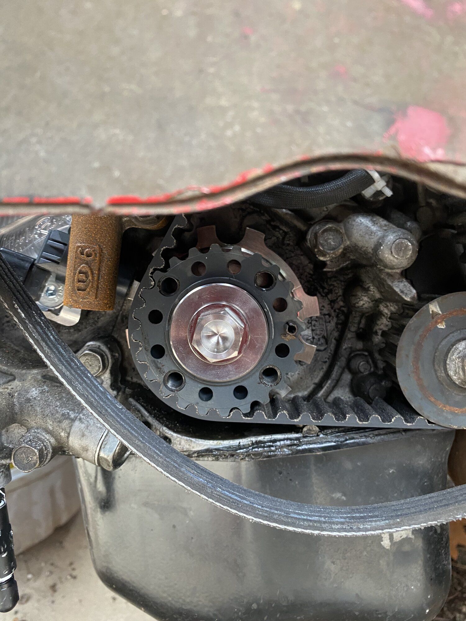

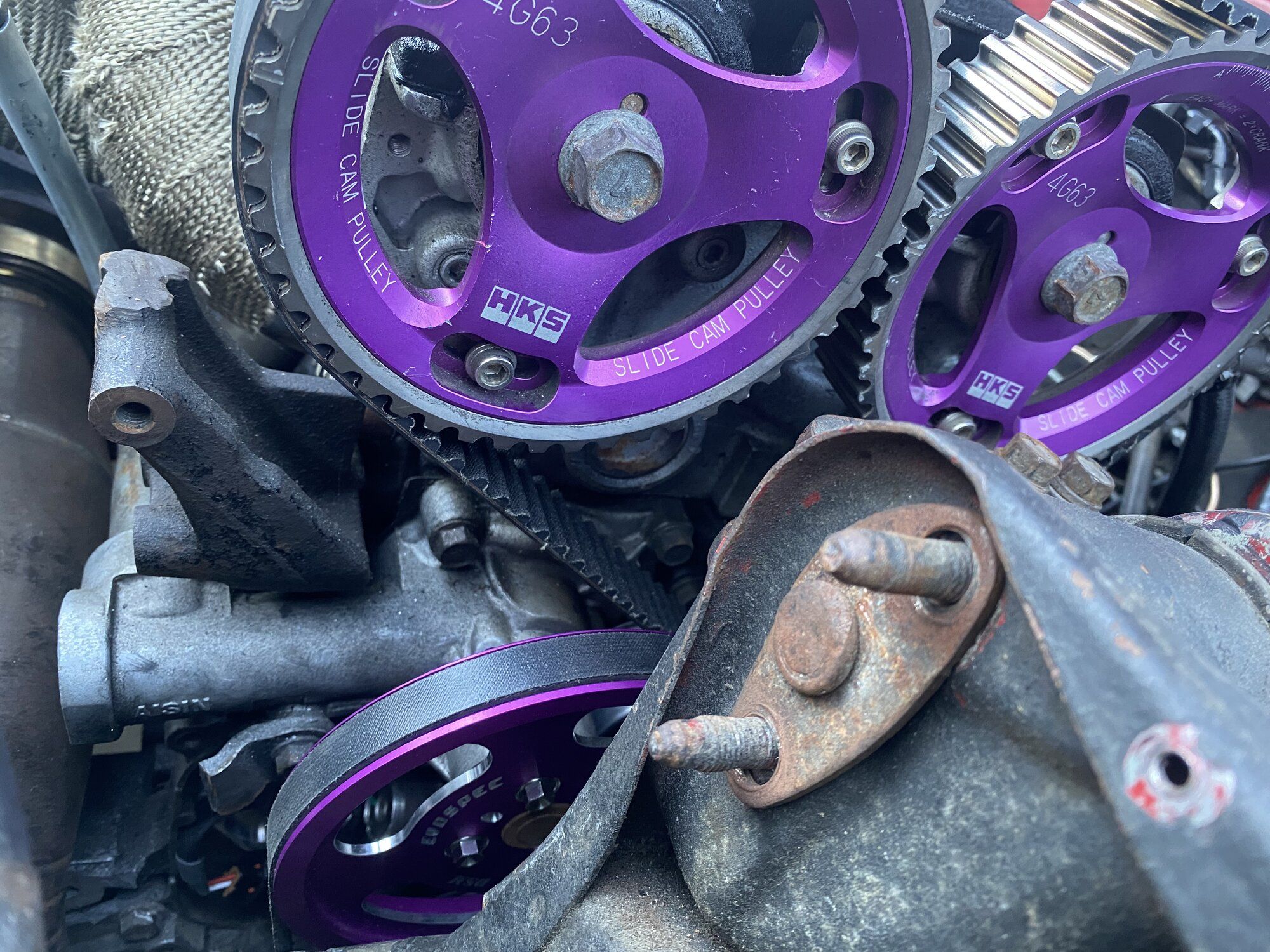

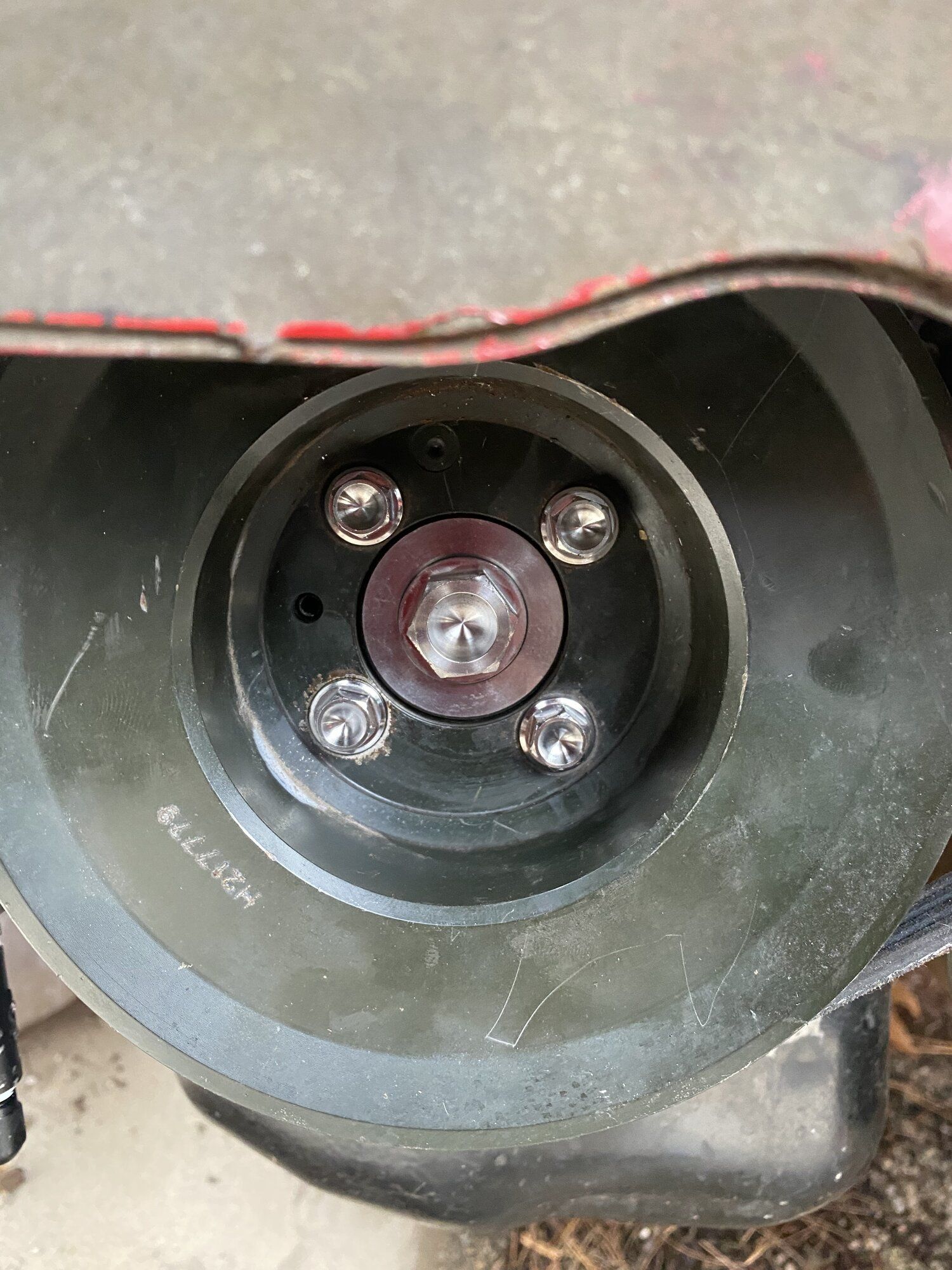

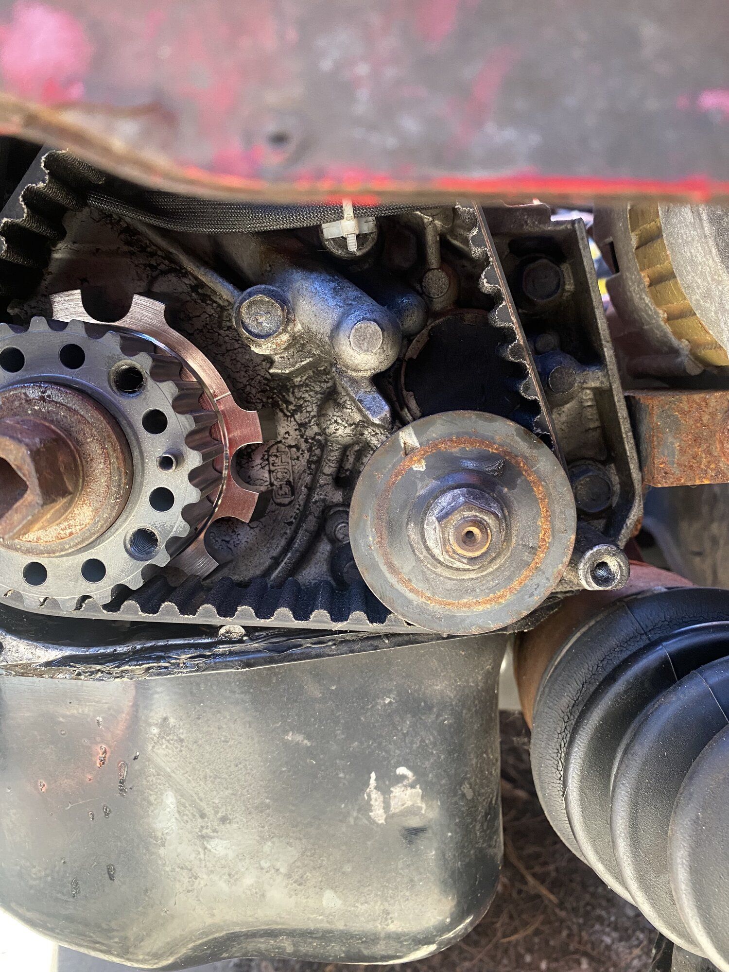

Timing tide needed taken apart so I could get the kiggly crank trigger installed.
Started getting the kiggly stuff installed

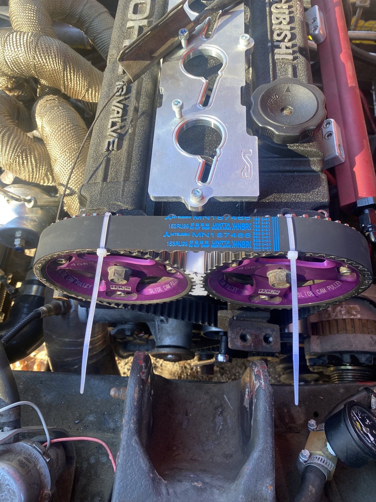

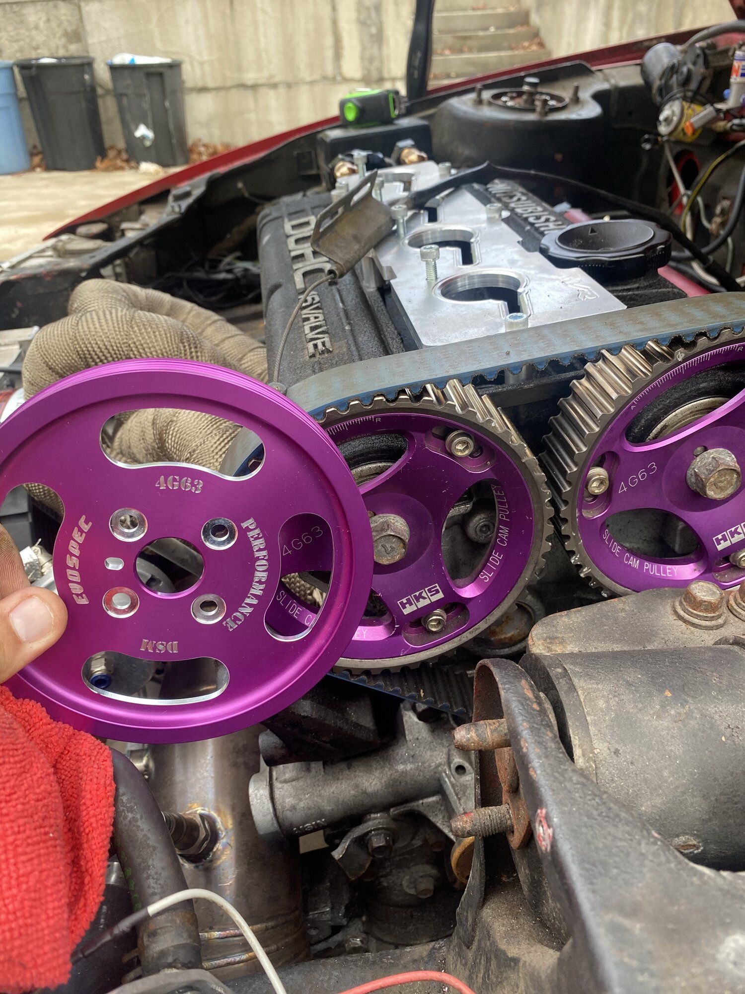

Set my sensor air gap and was ready to get the belt back on

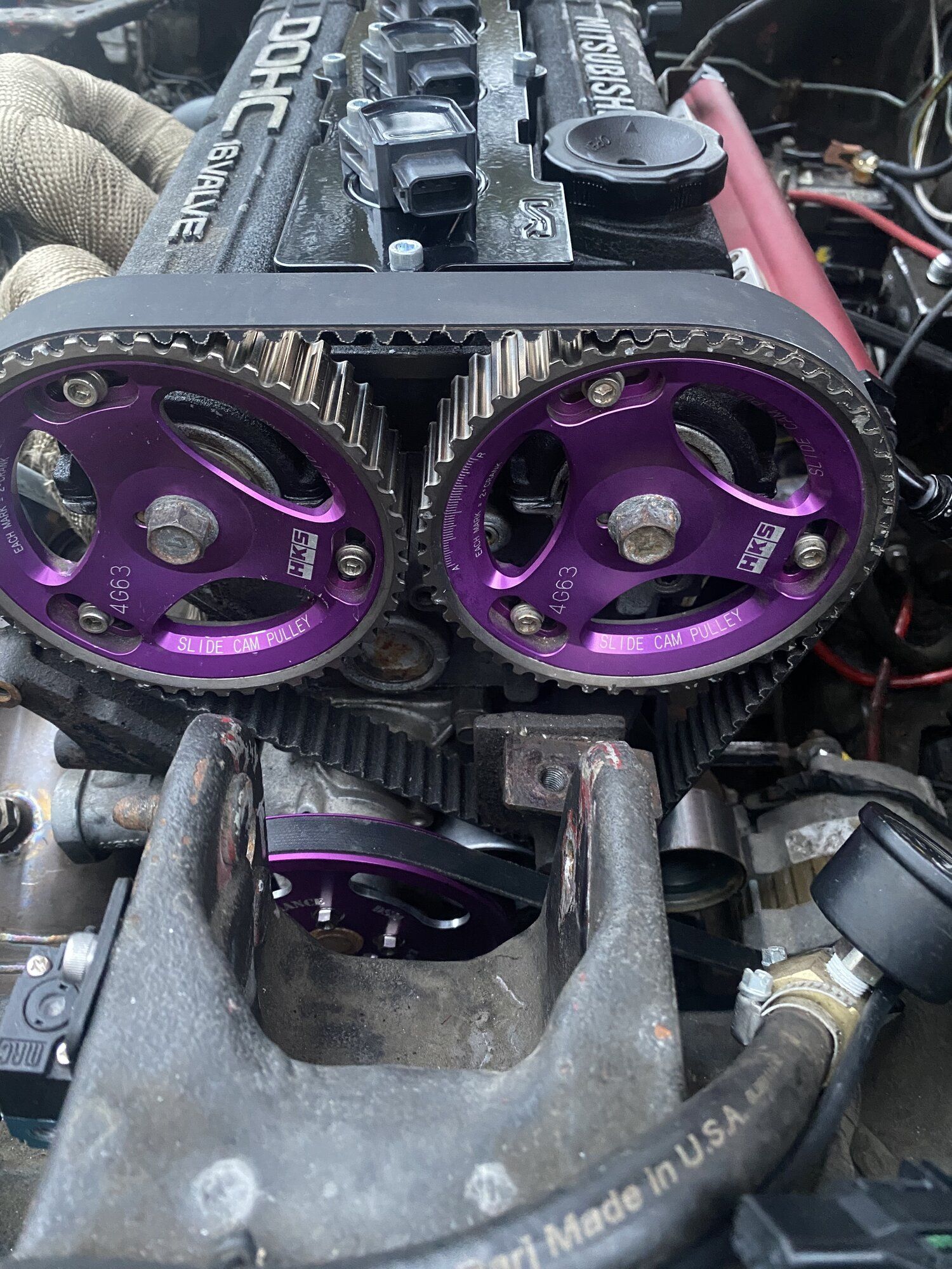

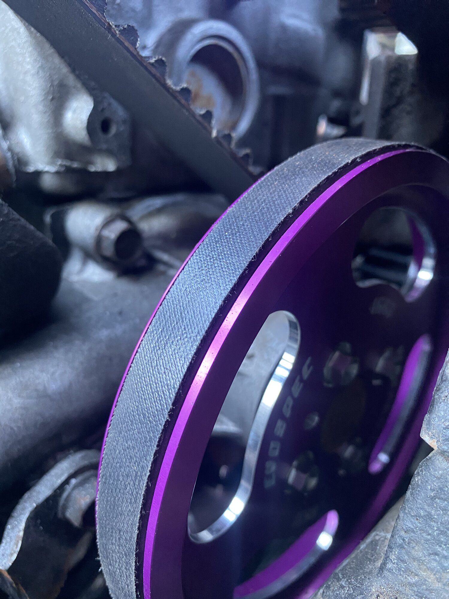

Then get my evospec water pump pulley put on as well
Next I need to get my oil combo sensor put in and then it’ll be time to get everything wired up.

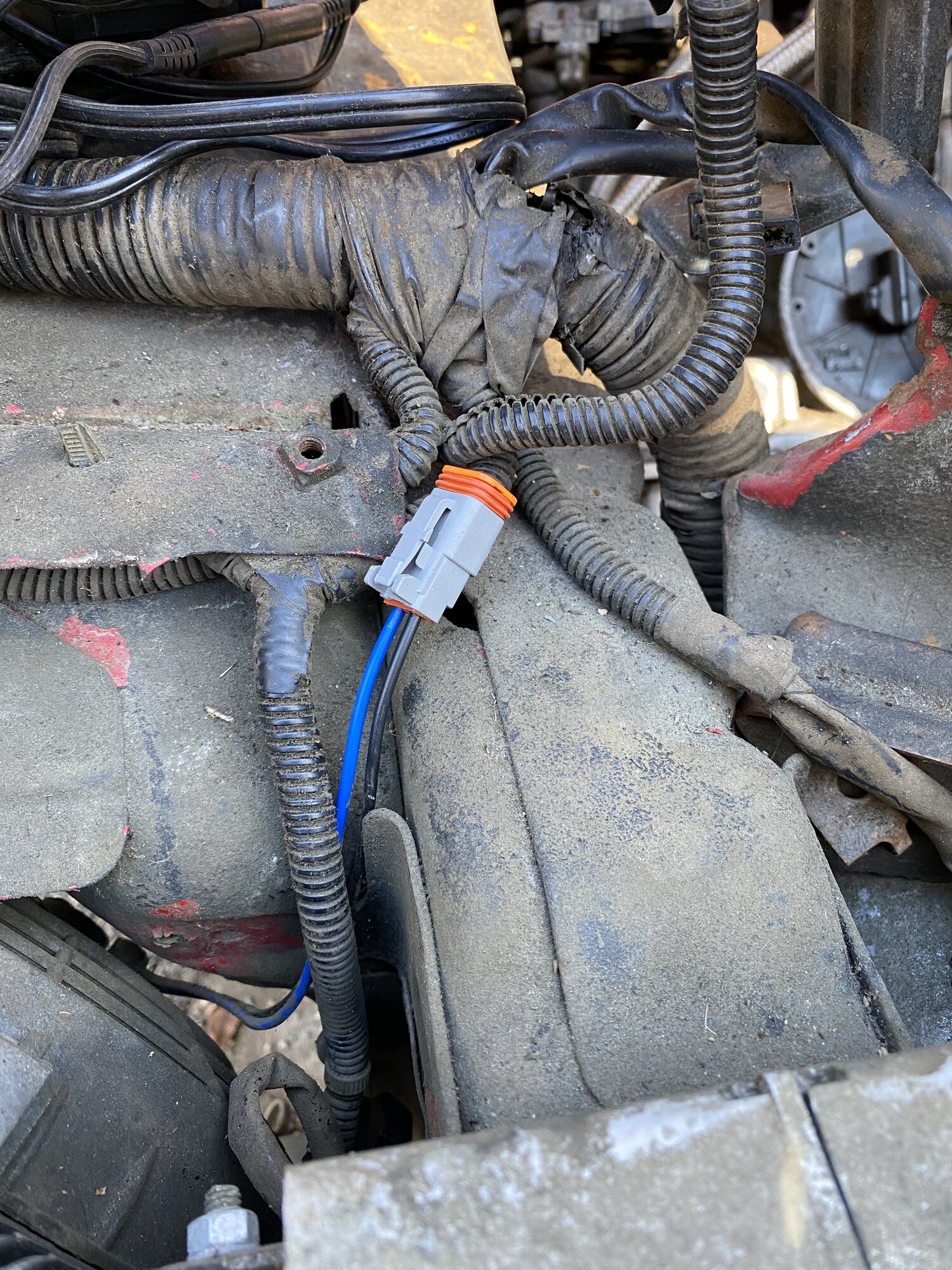

Put a new plug on the trans fan. Really liking putting these connectors together l.

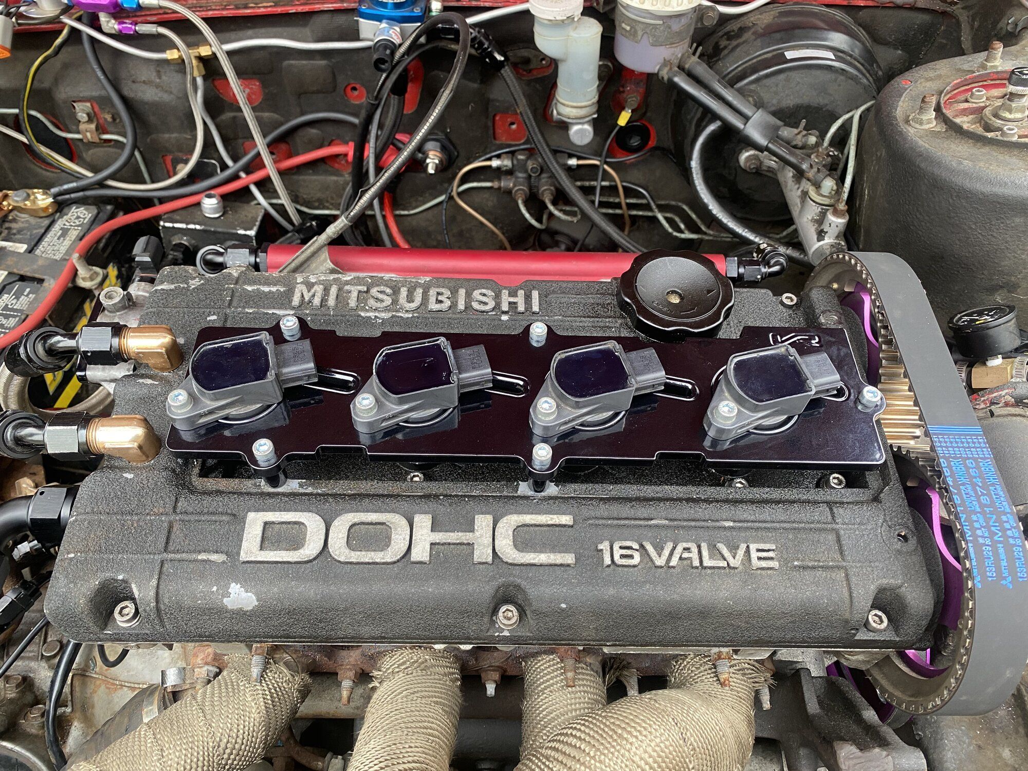

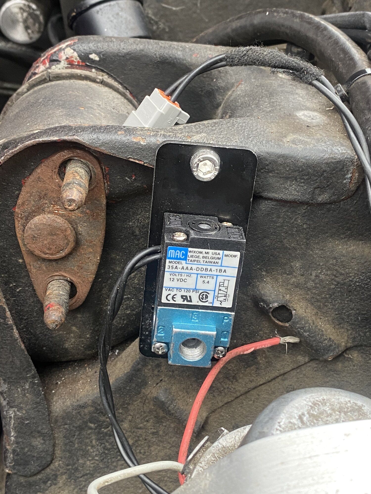

Got my bcs mounted. Had to order some more fittings so I can plumb it.
Cas cover put on. Really liking this color in the daylight.
Cop plate tossed on too

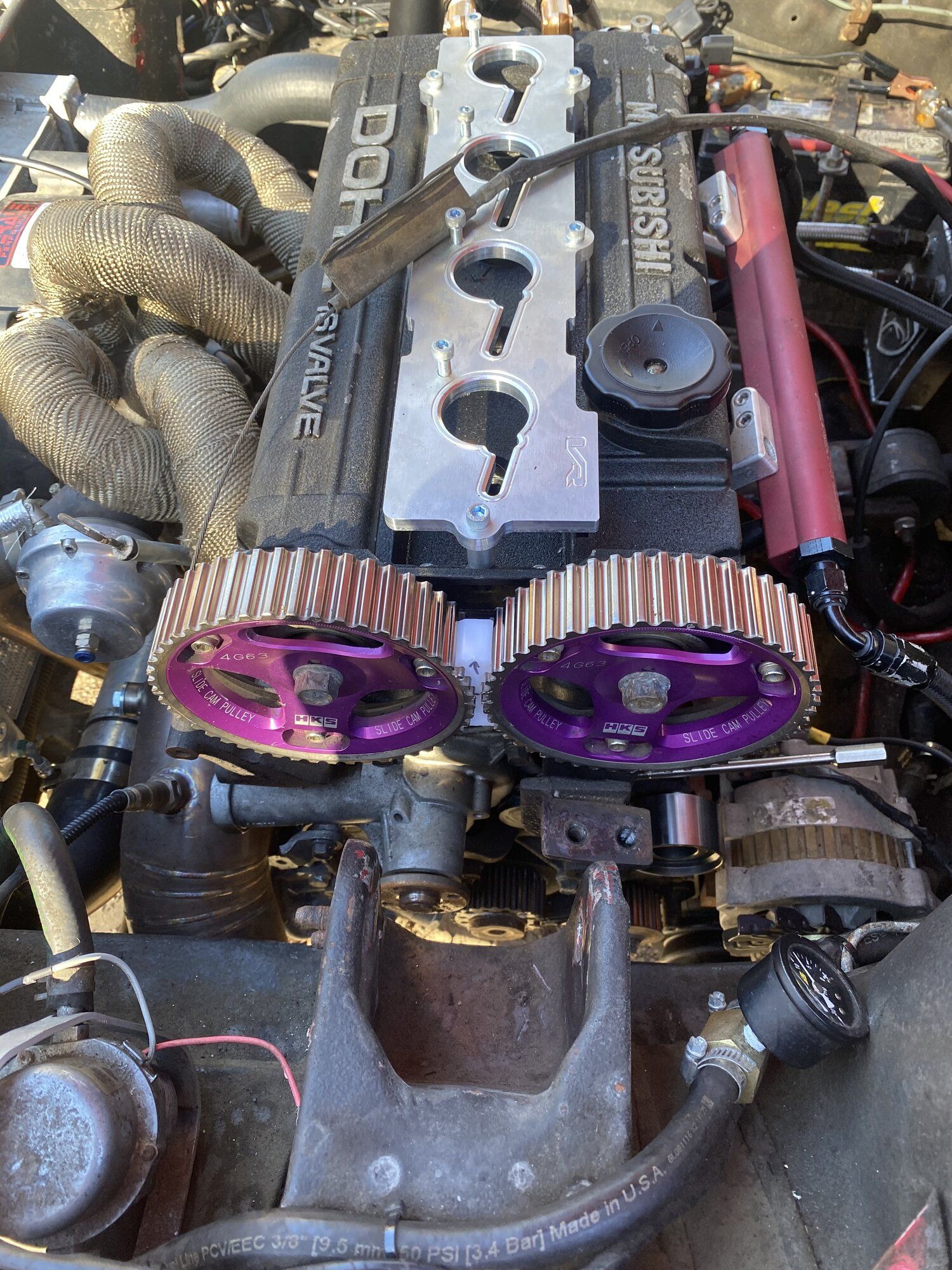

Also put the coils on while I was here. You can definitely see the purple tone in this color so much better in natural lighting.

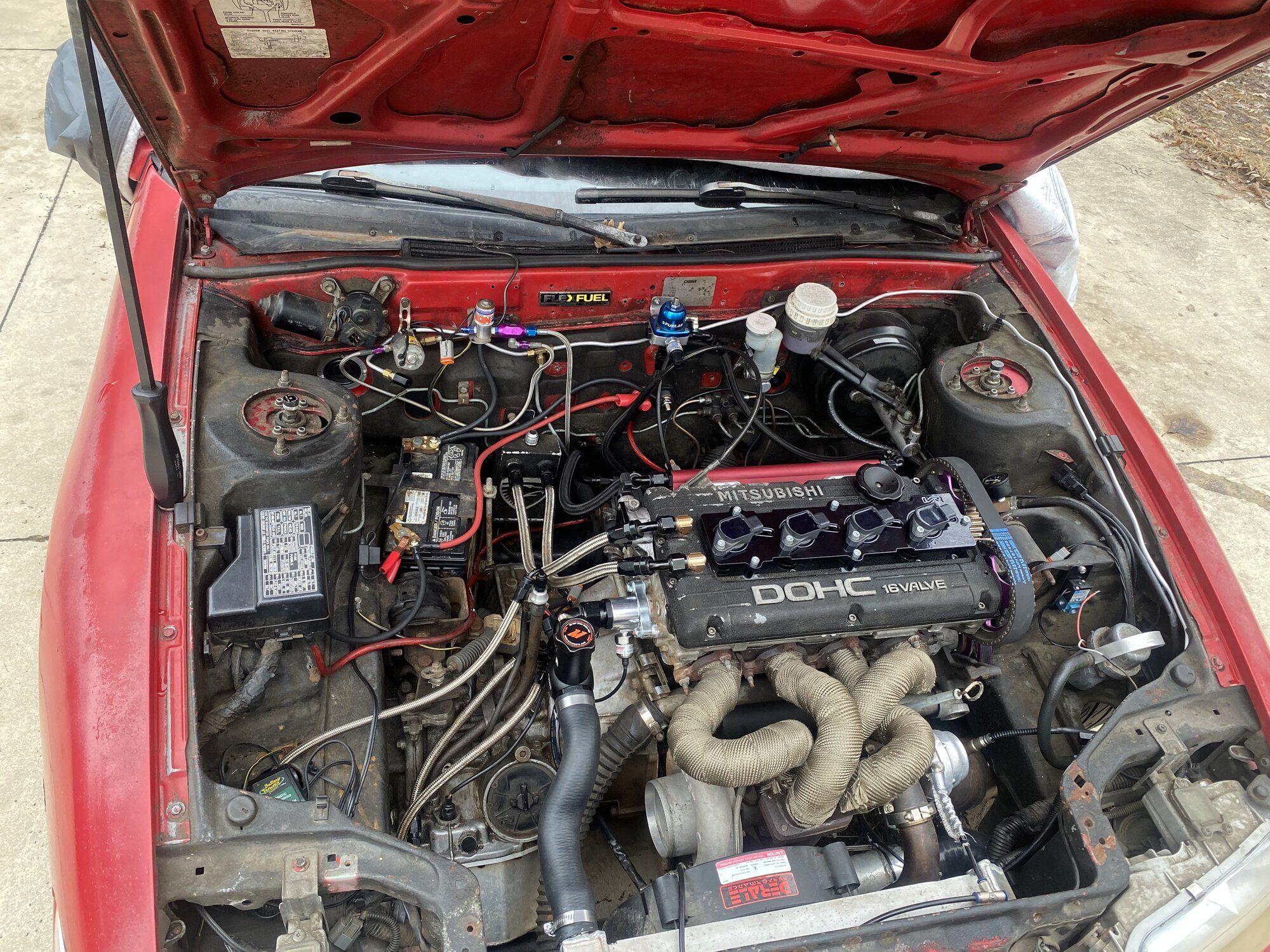

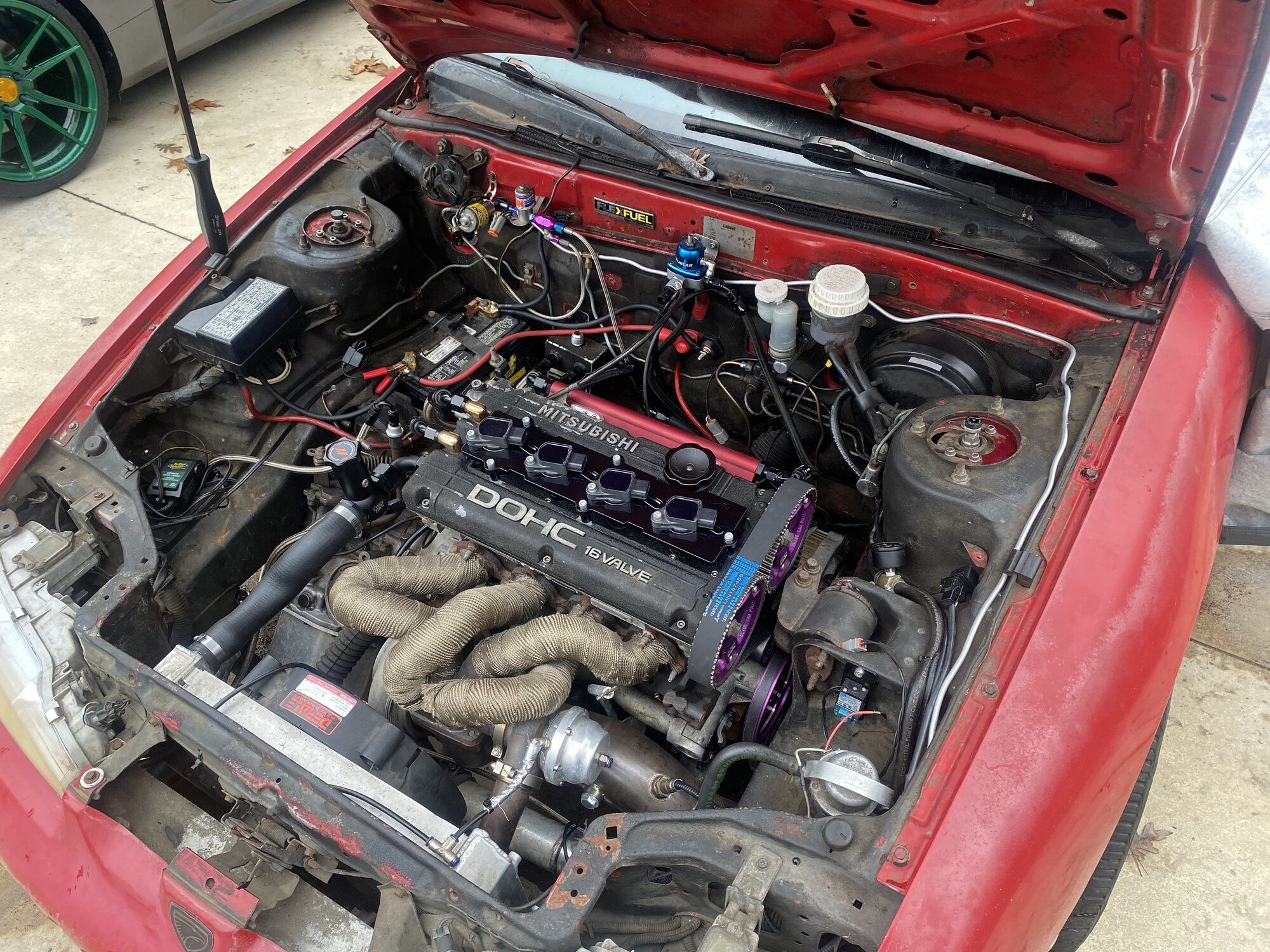

Also took a couple current engine bay shots.

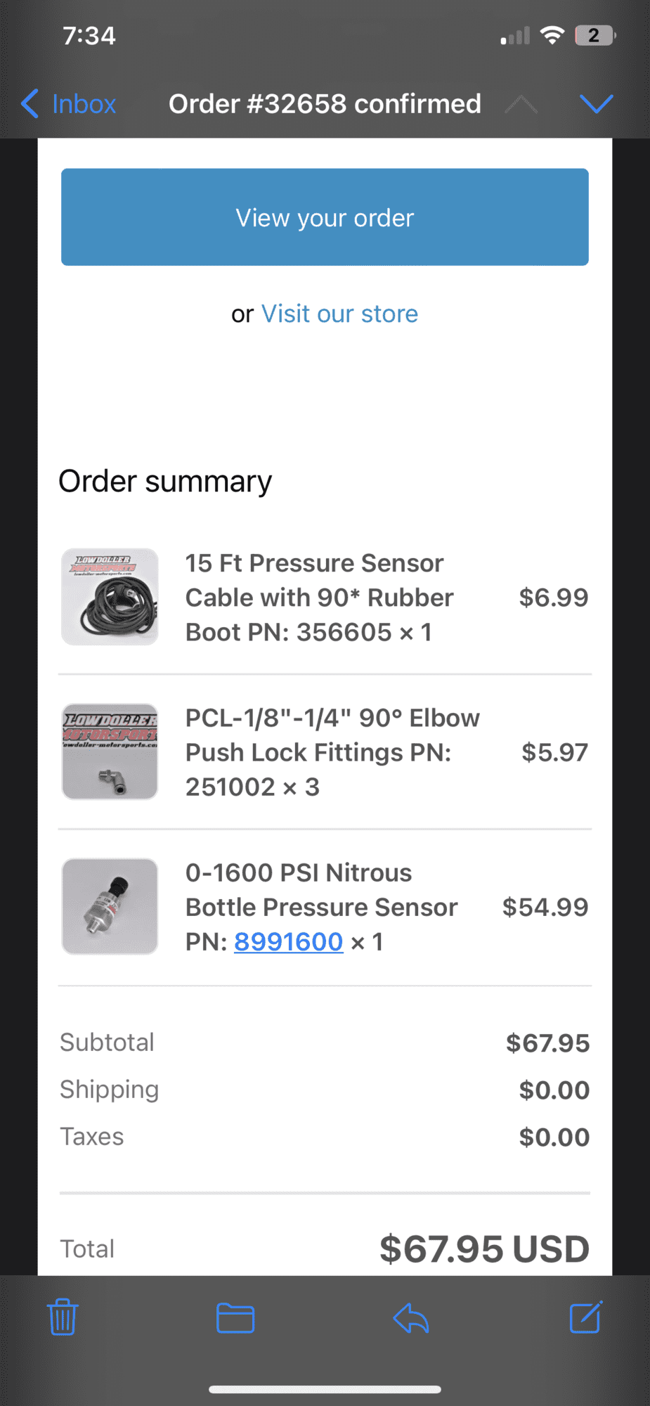

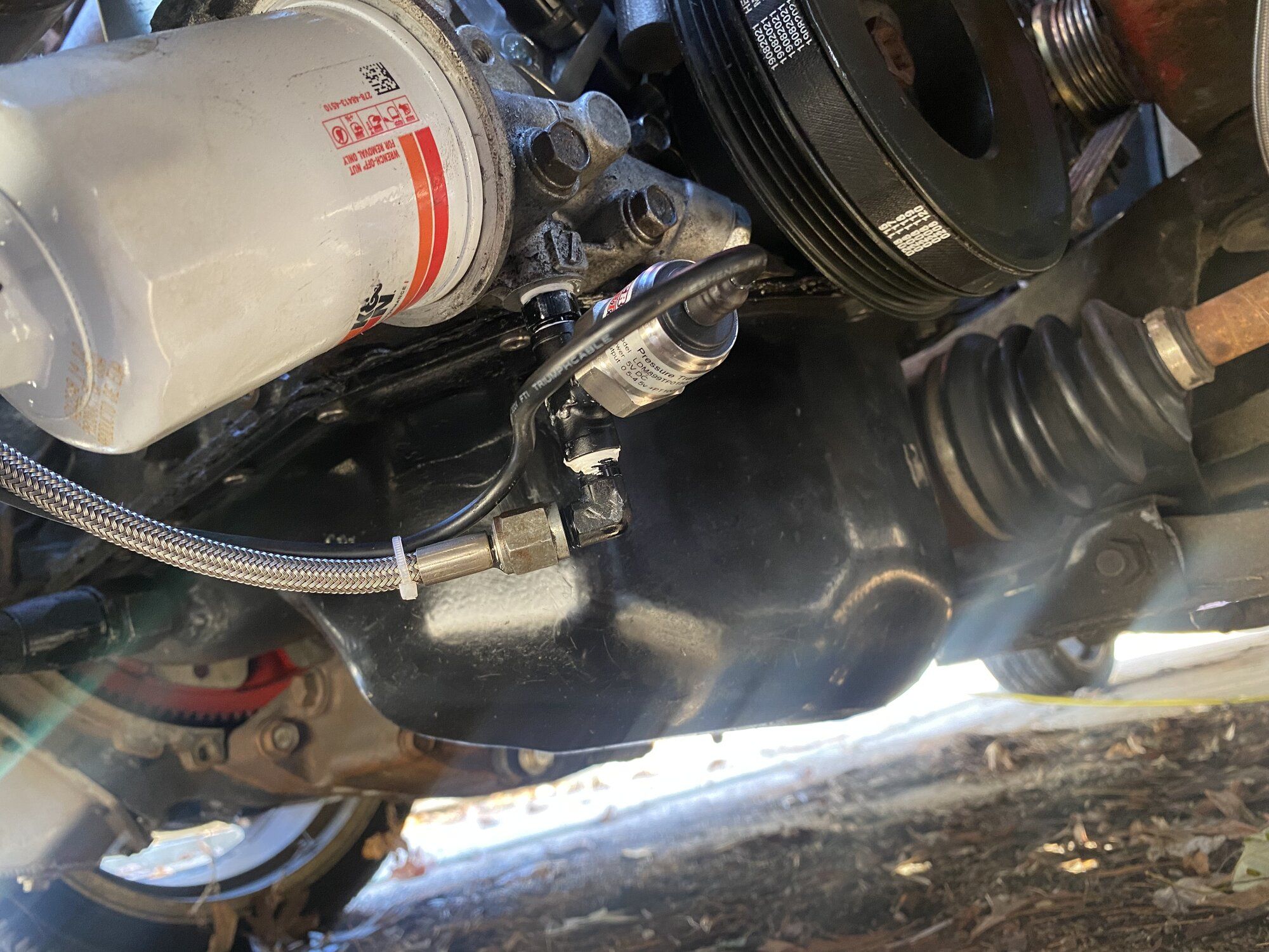

My nitrous pressure gauge started leaking fluid out of it so decided to just tie nitrous pressure into the fueltech as well.

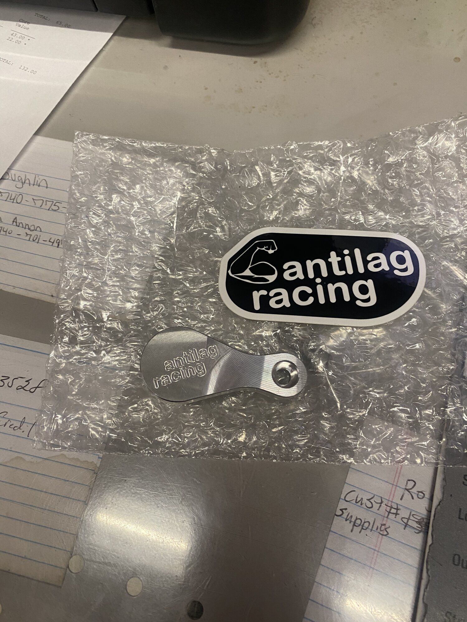

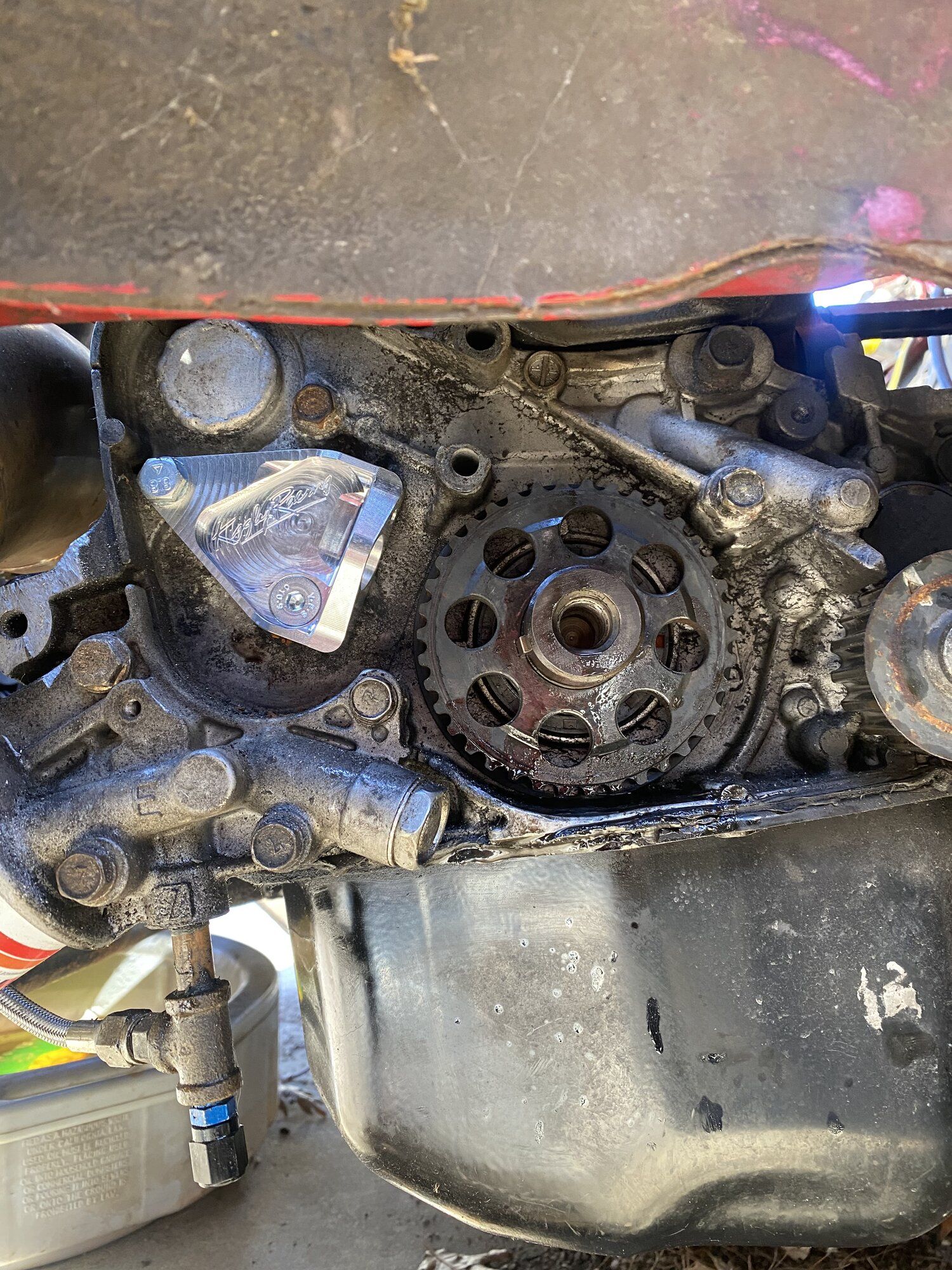

Buddy of mine got me an antilag racing freeze plug retainer for Christmas
Wasted no time in getting it put on
