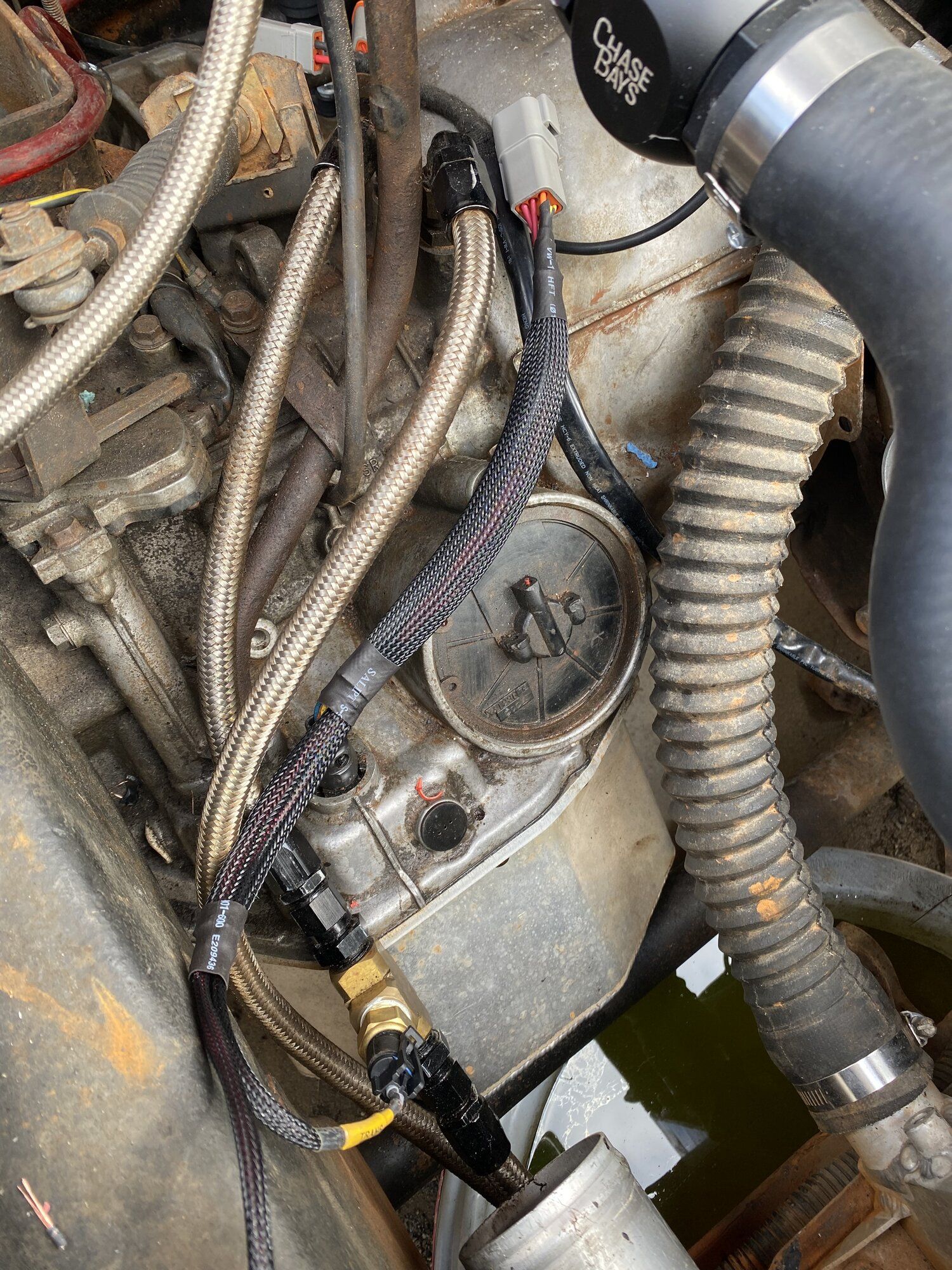

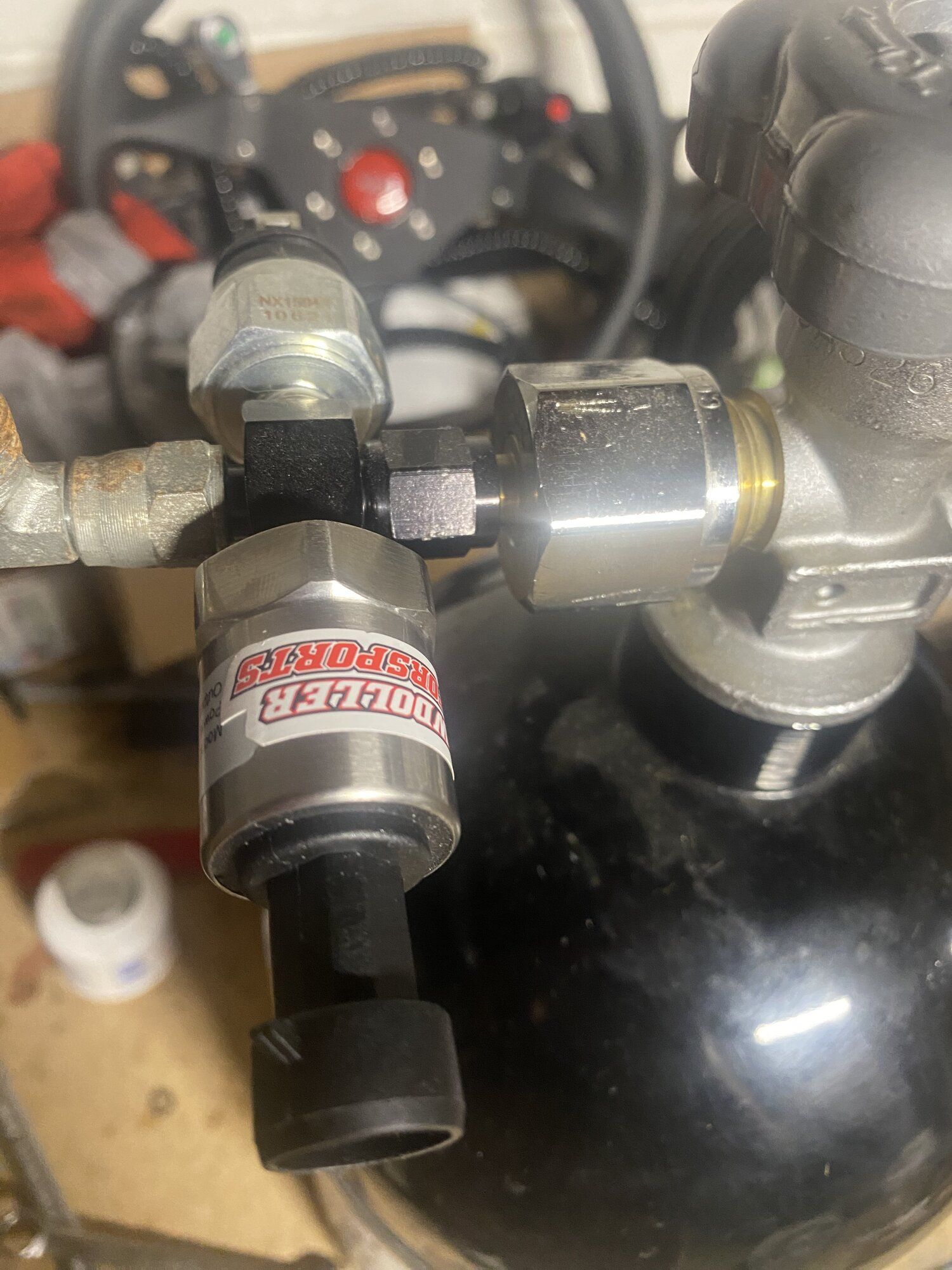

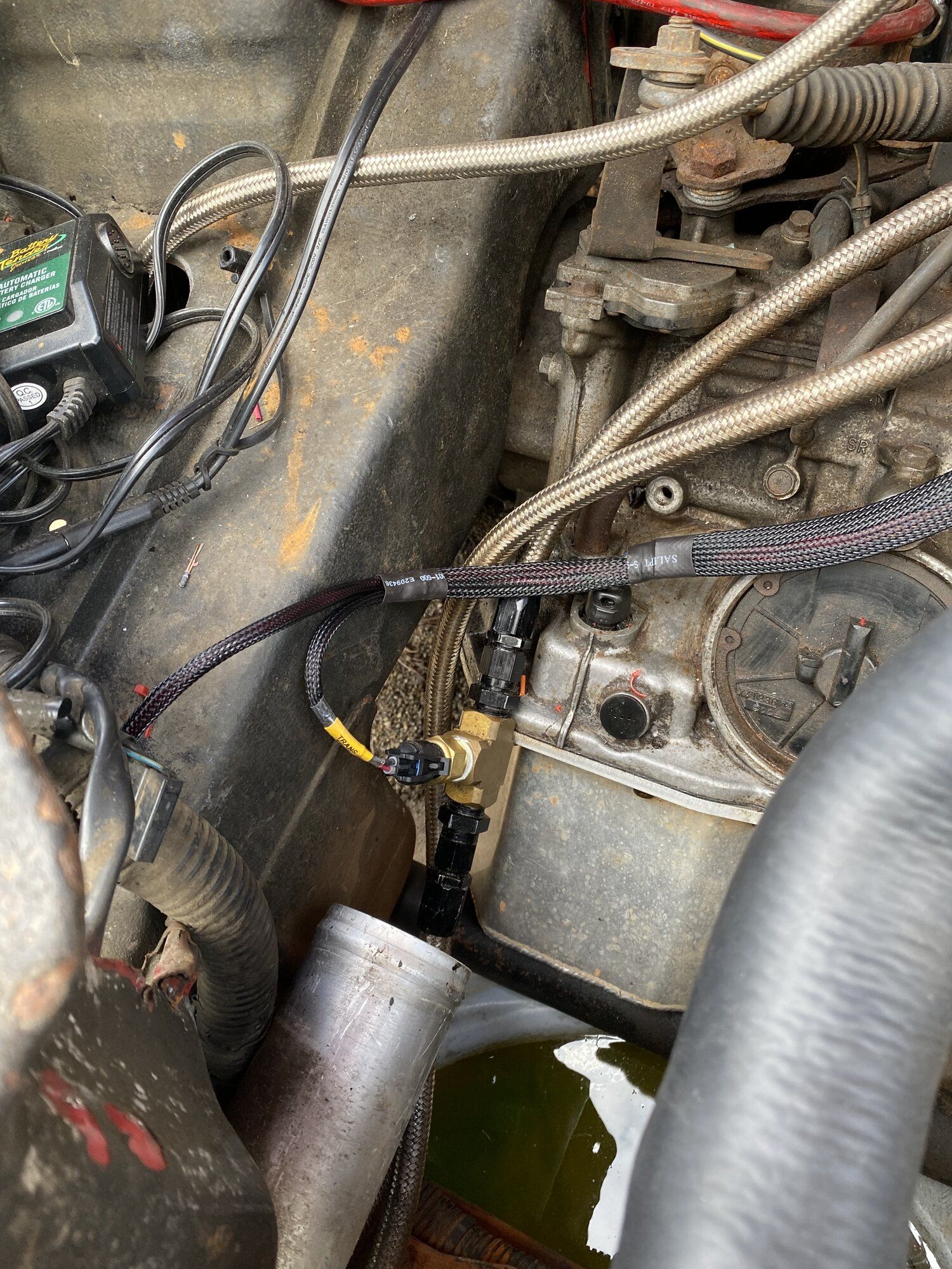

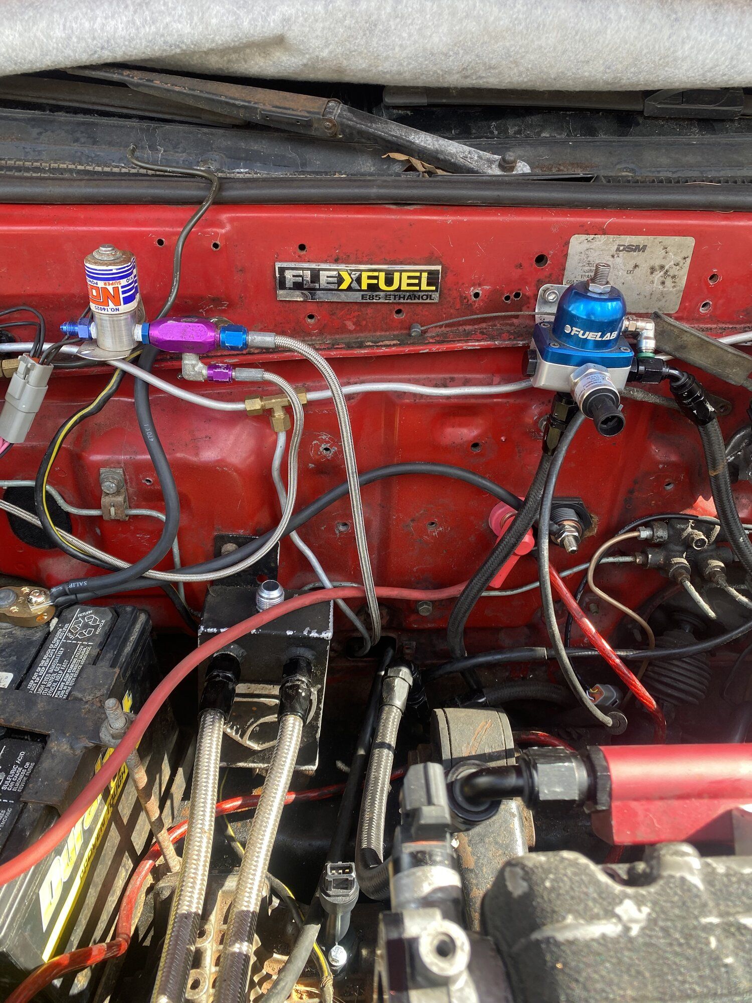

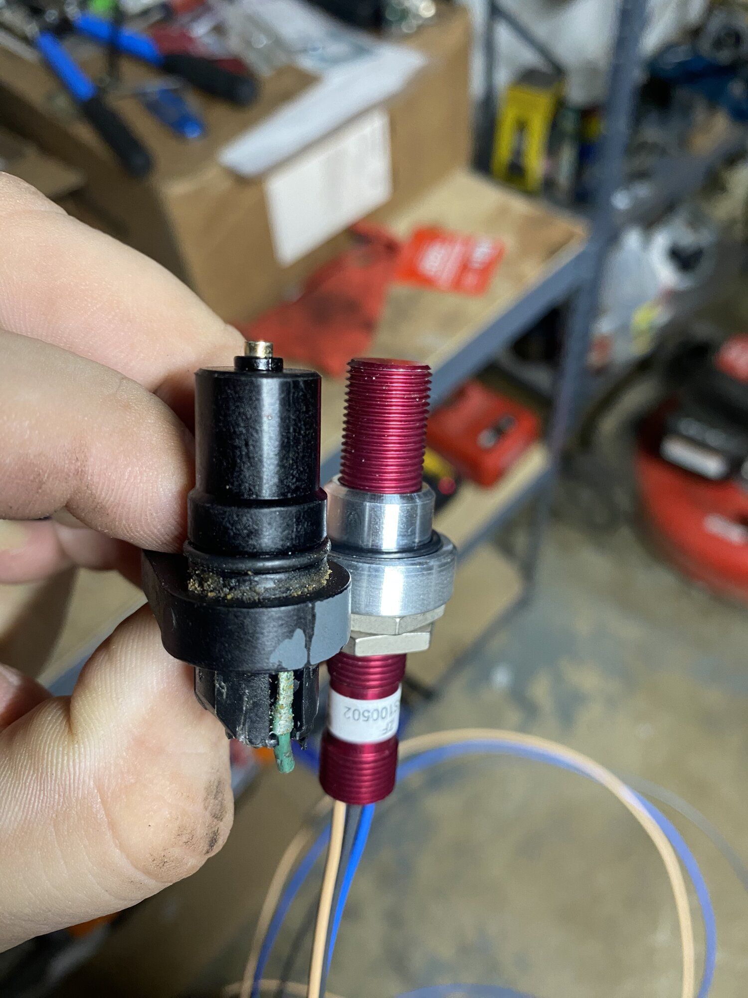

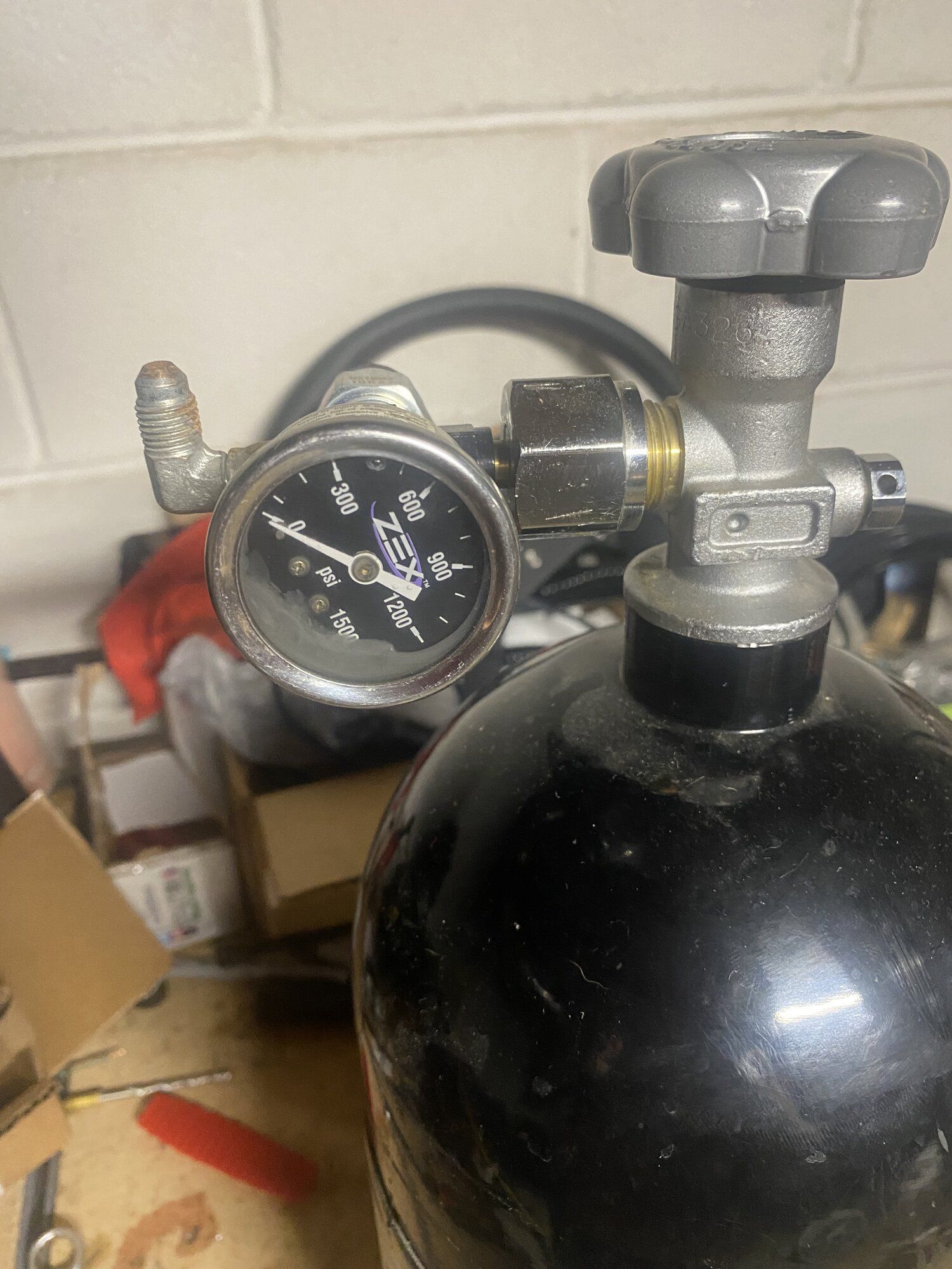

Nitrous pressure sensor, wiring to run to the front and new push lock fitting for the bcs.
Out with the old
In with the new.

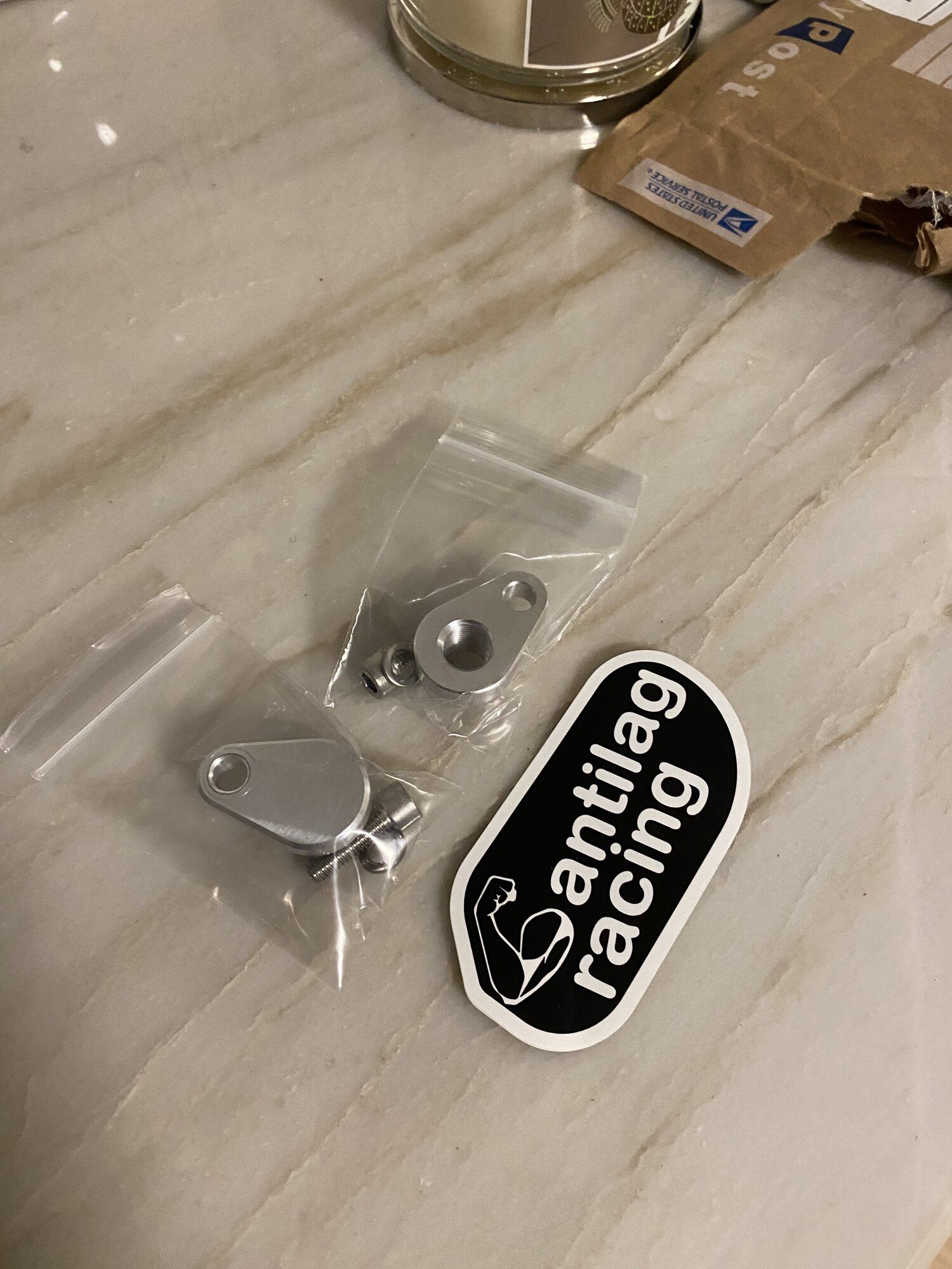

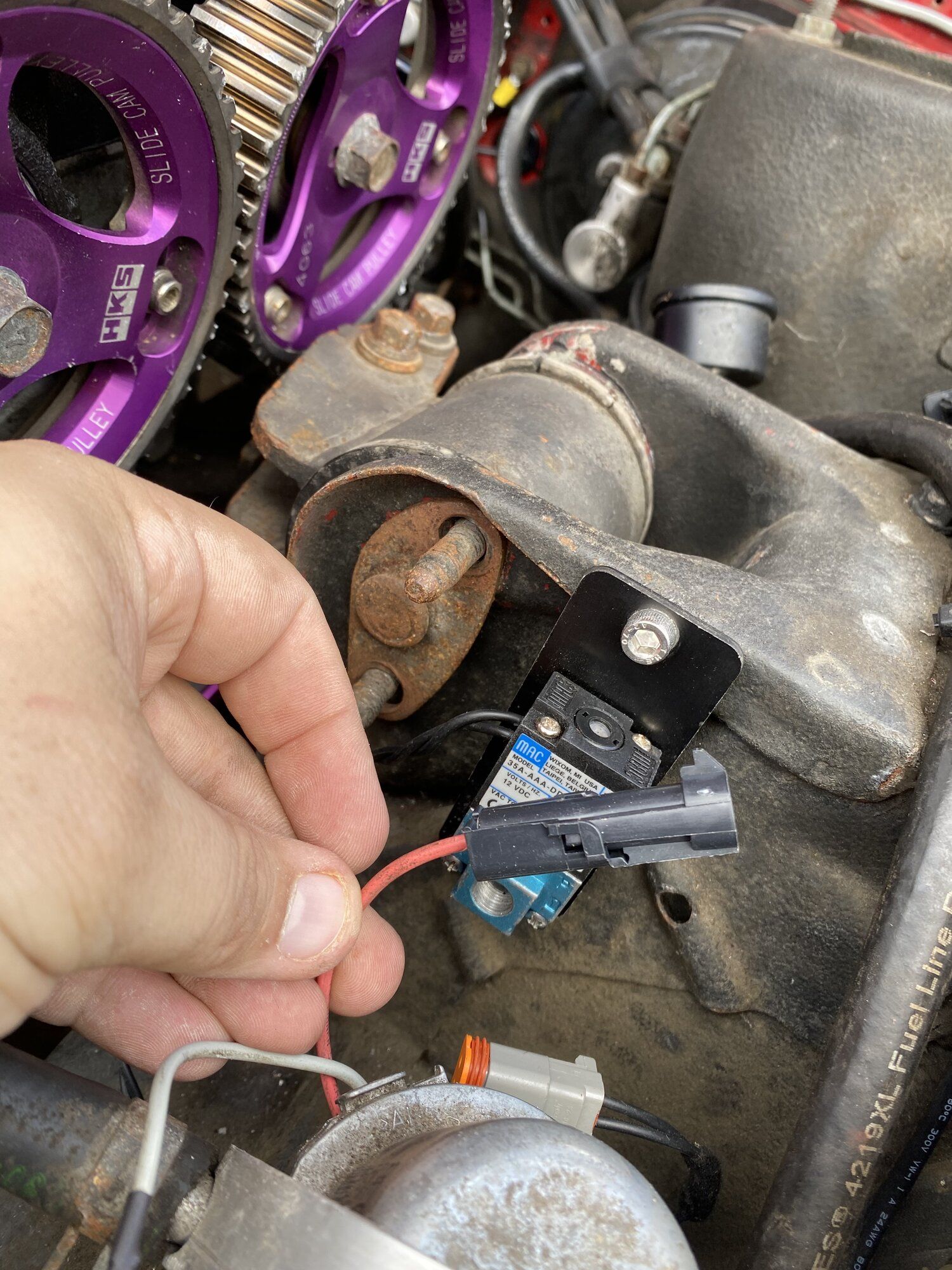

Antilag racing w4a33 sensor adaptor and sensor plug. Waiting on the sensor to come in and I’ll get these installed.

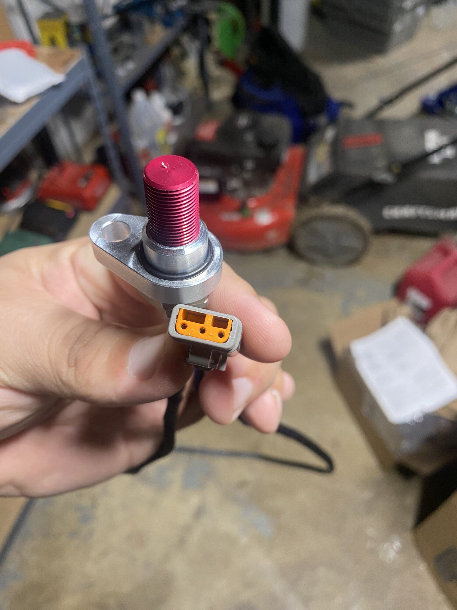

Got the cherry sensor I needed for the trans input speed sensor setup.
Also picked this dead plug setup to make my sensor 5v and sensor ground distribution easier.

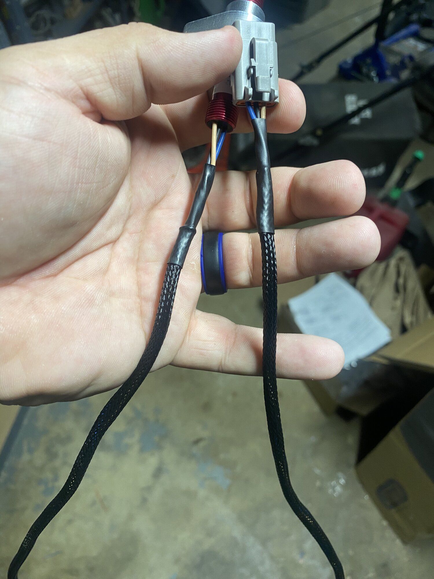

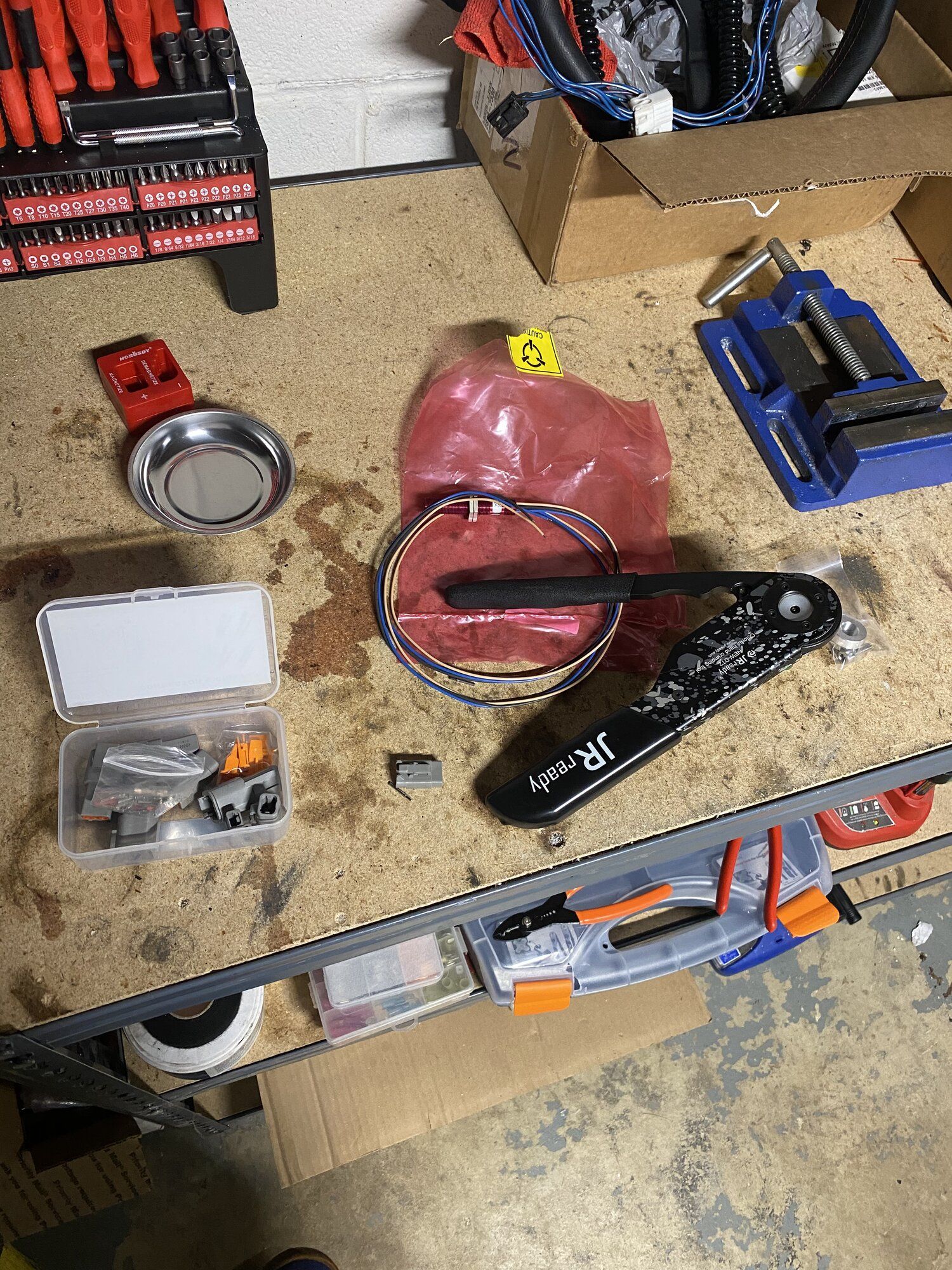

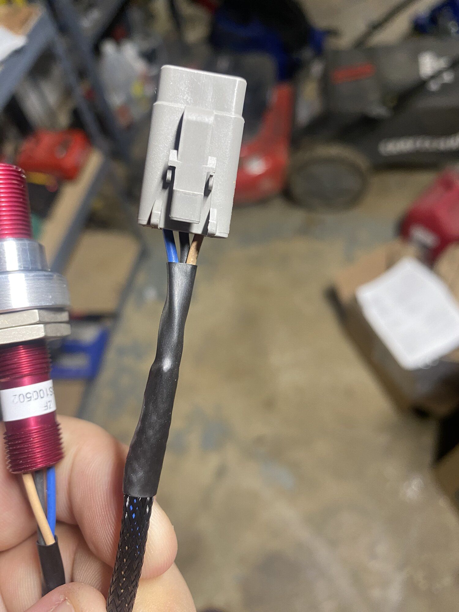

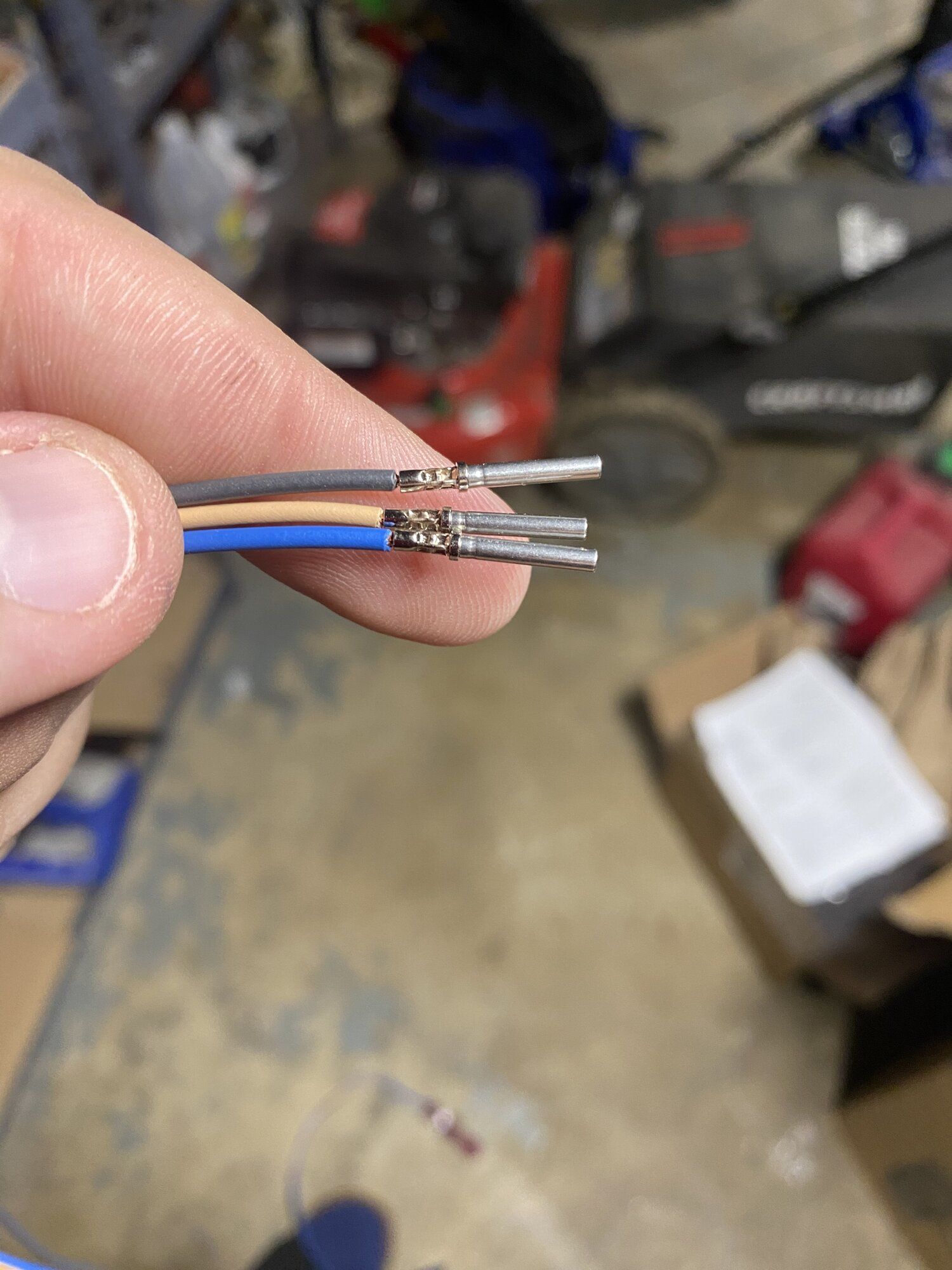

So after the holiday hustle was over I decided to put the connector on the cherry sensor.
The new crimper working amazingly
Getting the sensor depth setup so I can put this in the car.
Got the sheathing on the wire
Plug fully installed
And it’s ready to go.

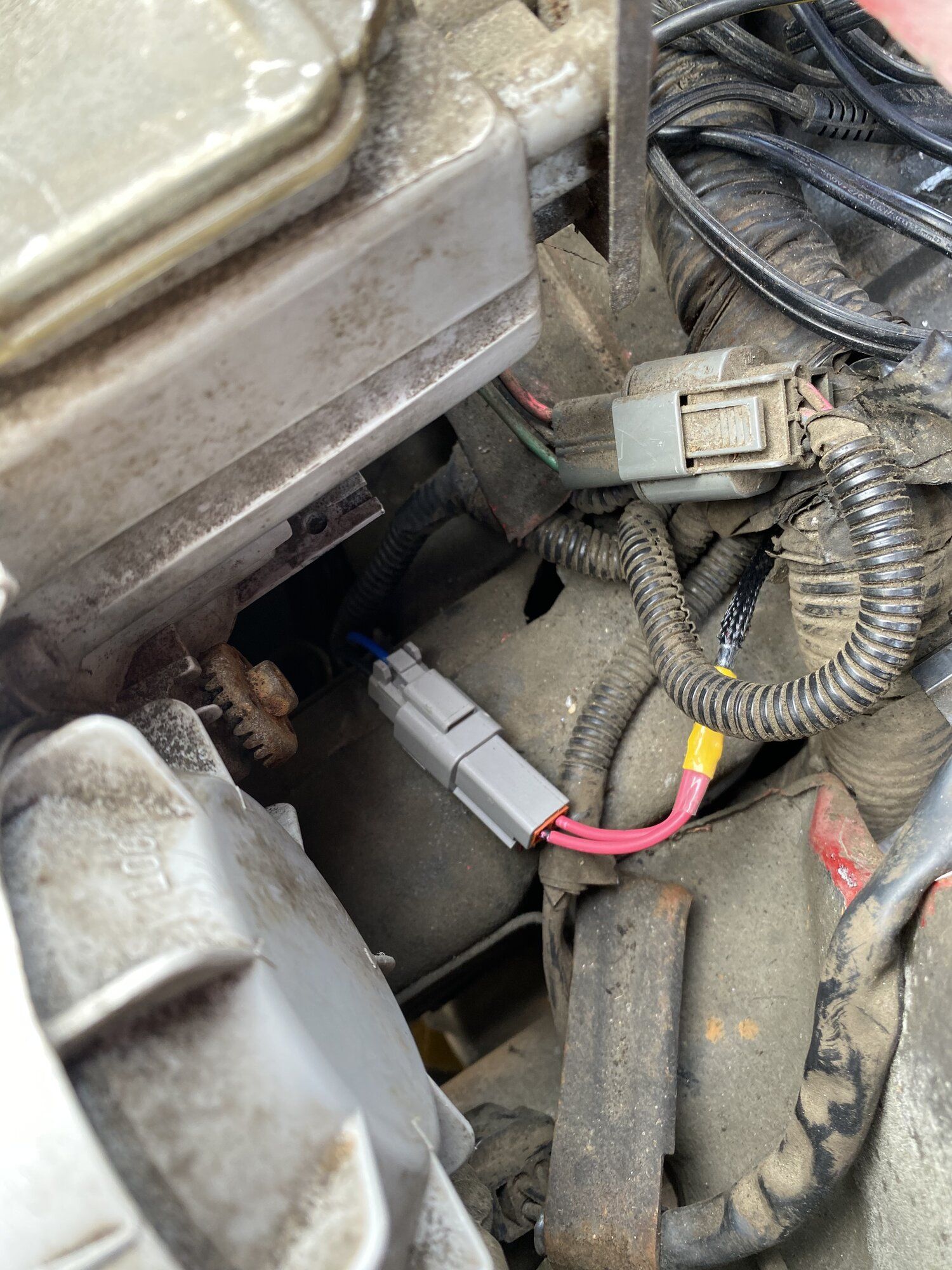

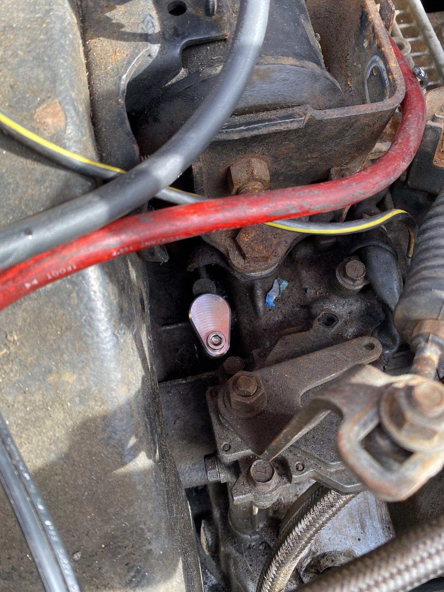

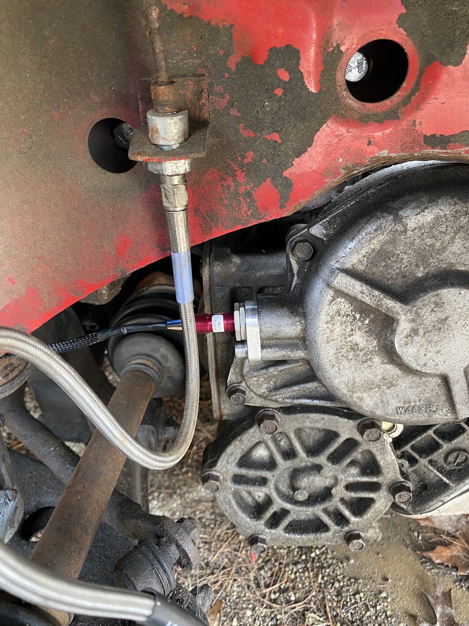

Got the antilag racing auto sensor plug and adapter put on the trans. These fit perfect.

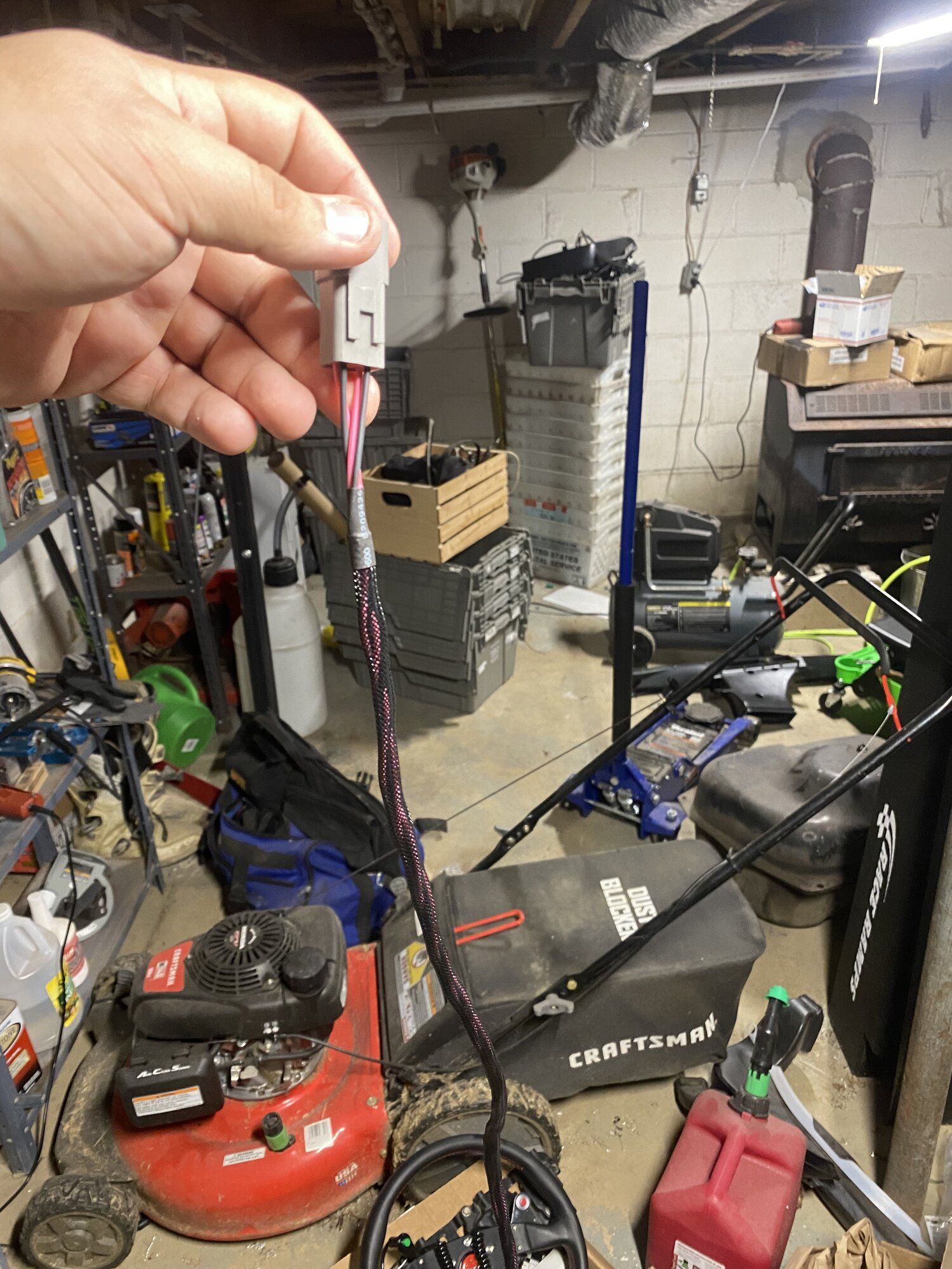

I decided I wanted to make a sub harness for the trans, trans temp sensor, and trans cooler fan. There’s a few things I would’ve liked to do differently but came out pretty well.

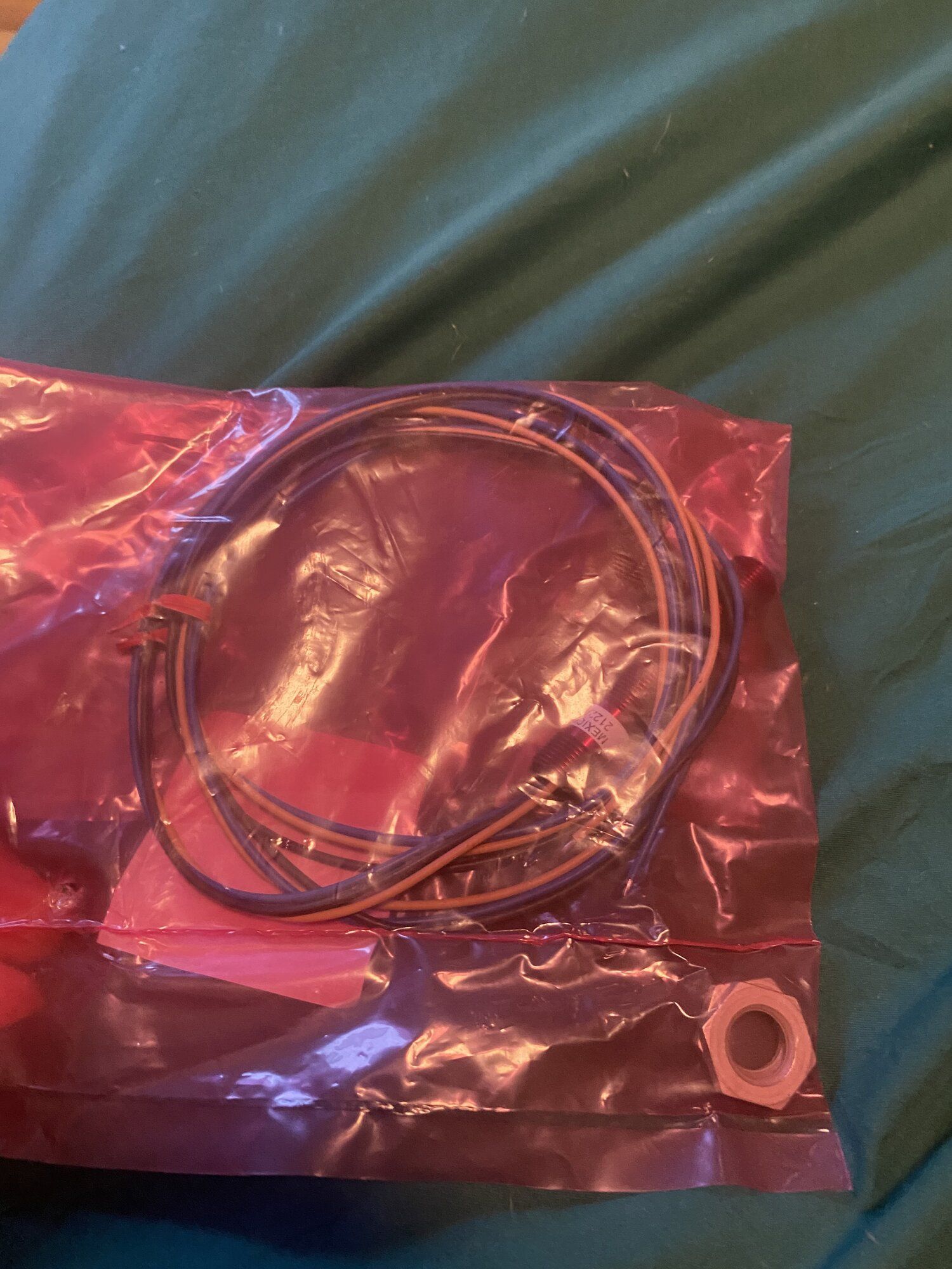

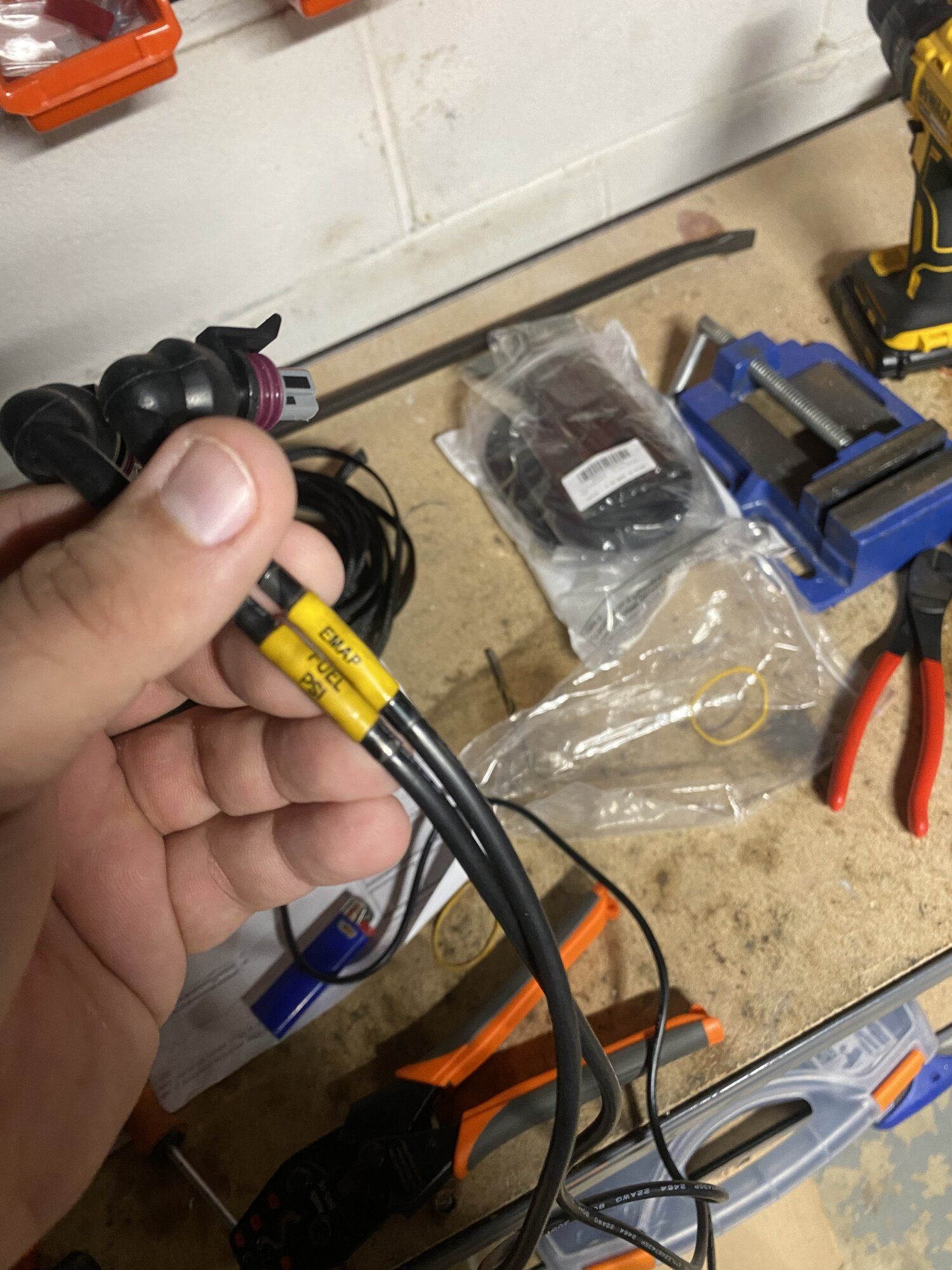

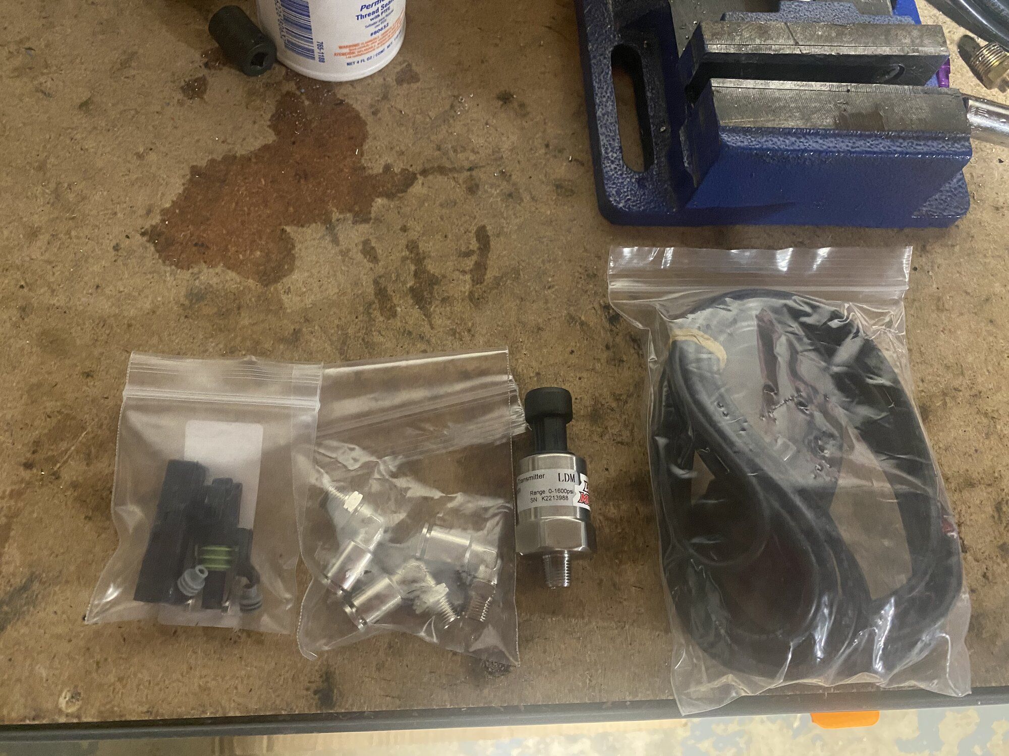

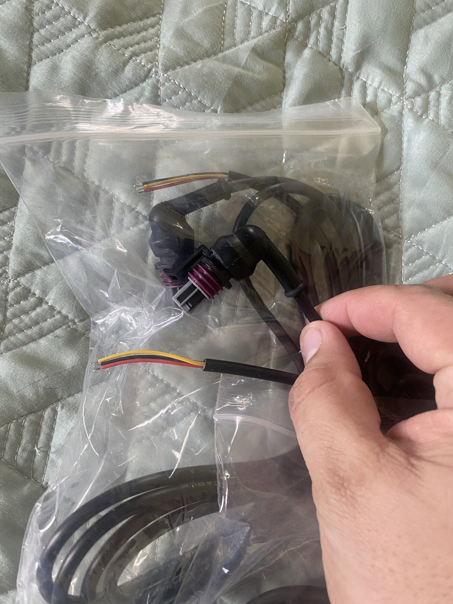

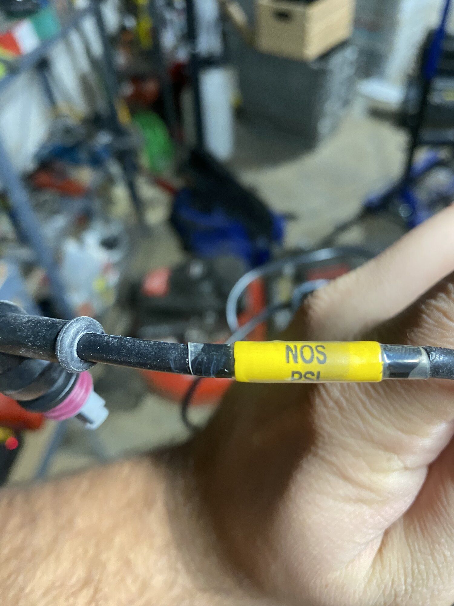

So I picked up a few of these prewired pressure sensor plugs to try to make wiring the pressure sensors up a little easier.
Added the labels on and they’re ready to get laid out and wired now. Thinking about leaving the emap wiring a little long if I decide to change the setup later on.

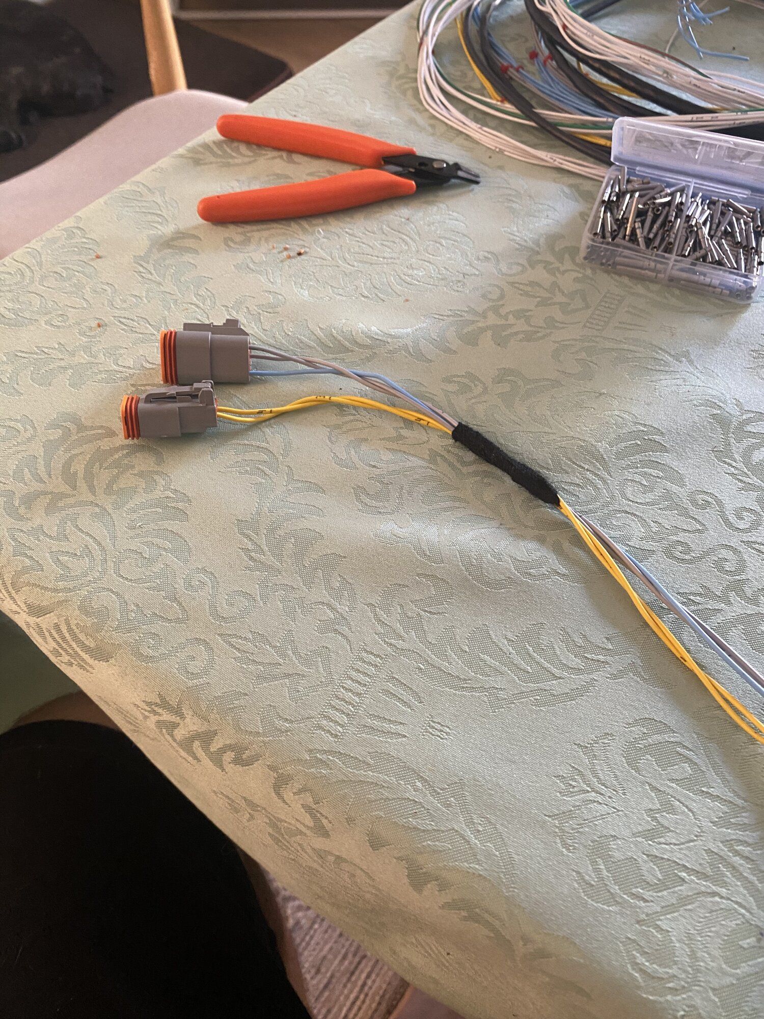

Next I made a harness to run out to the nitrous and purge solenoids. Pretty happy with how that turned out

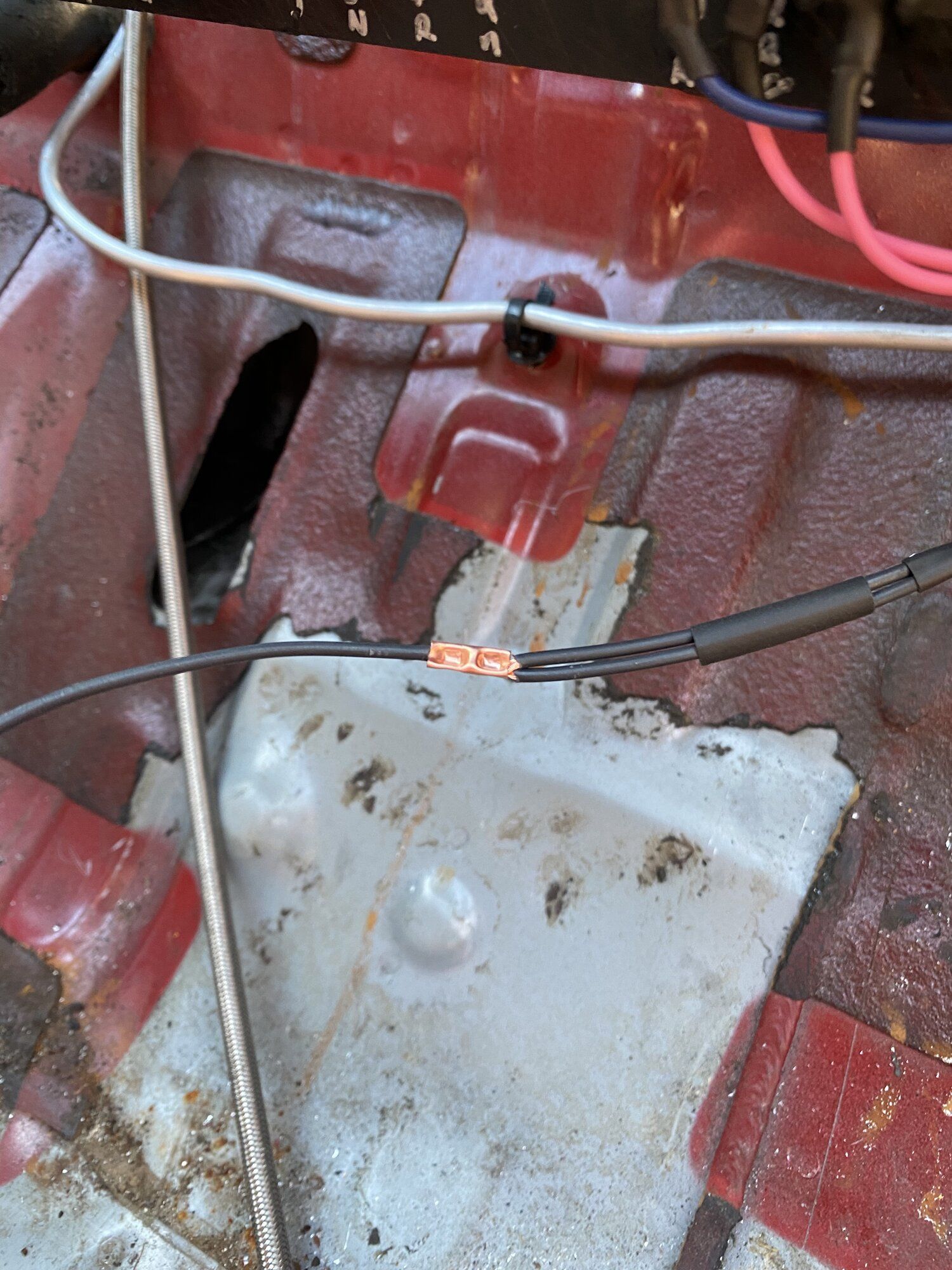

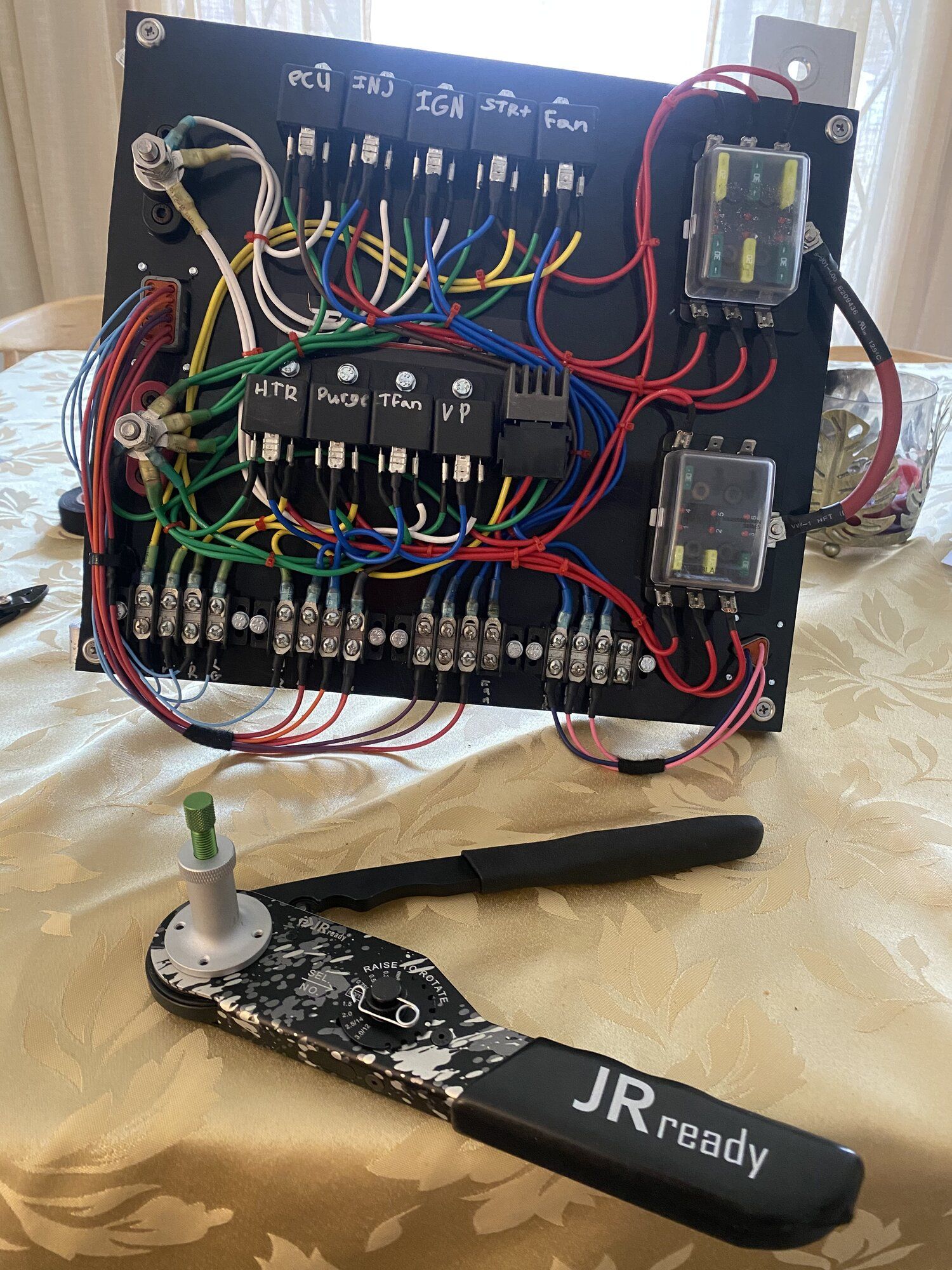

This was in the middle of wiring them up. Took both grounds and put them into one wire. Then put the ends on to the power wires and put them on the relay board.

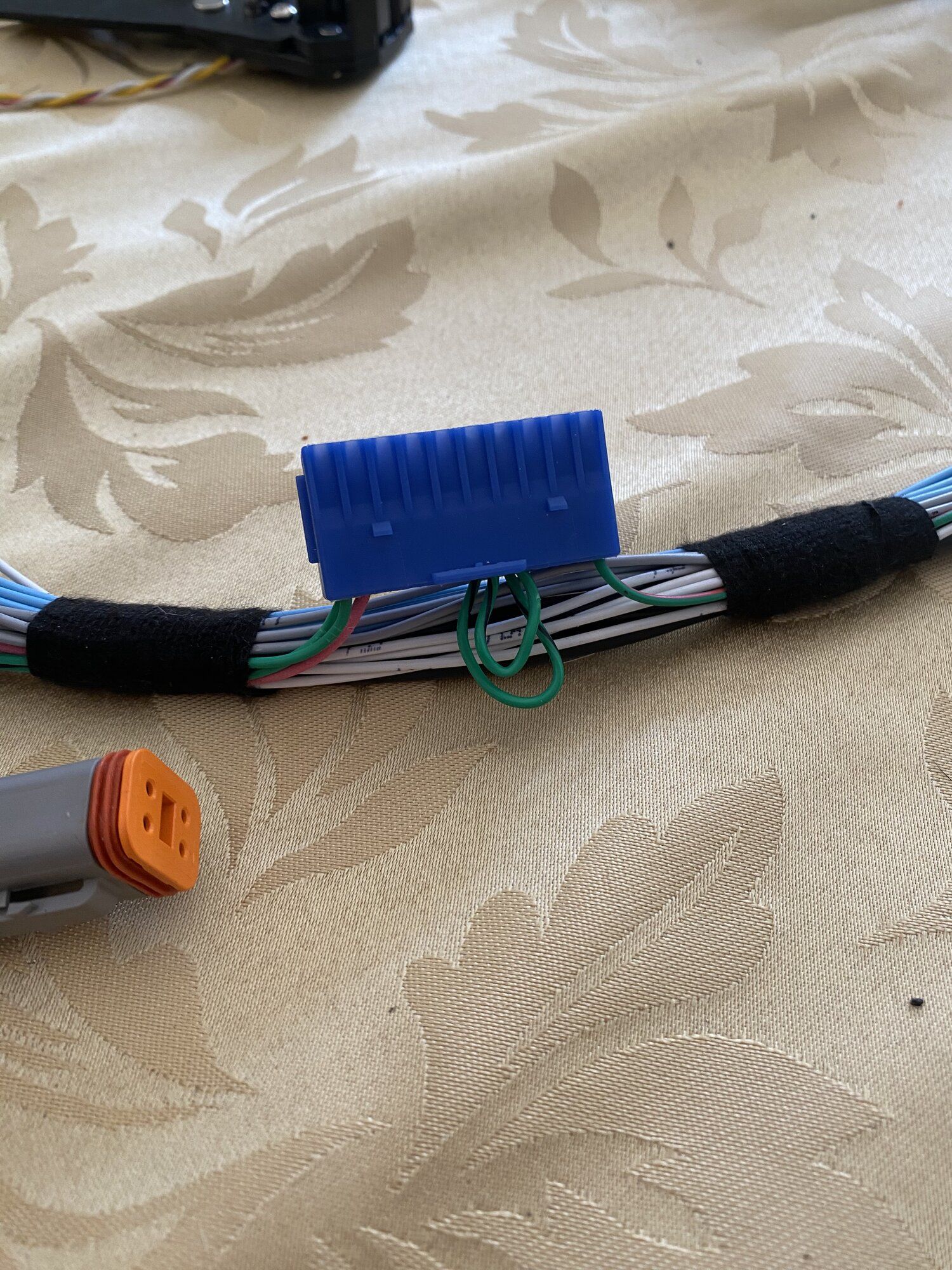

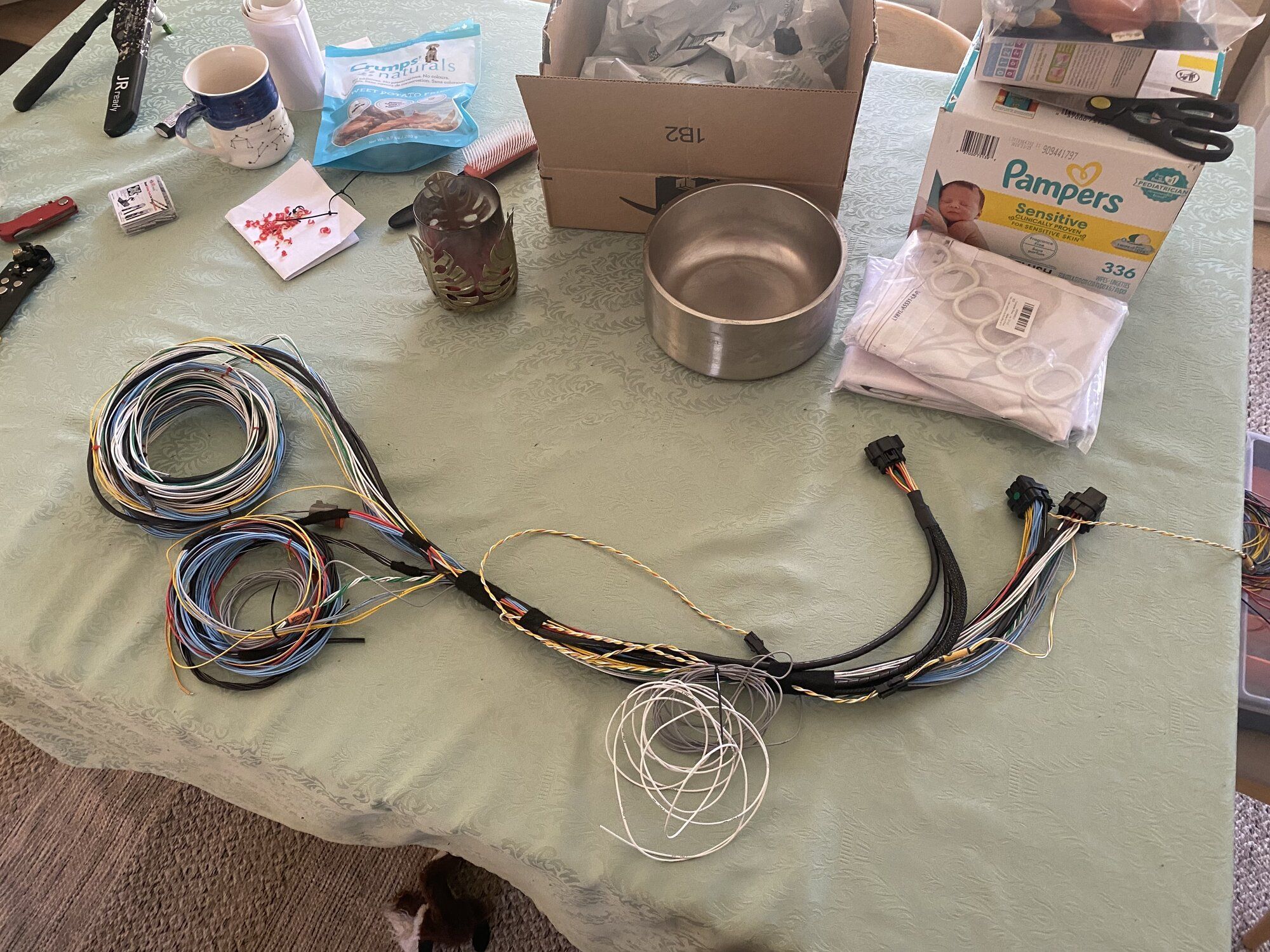

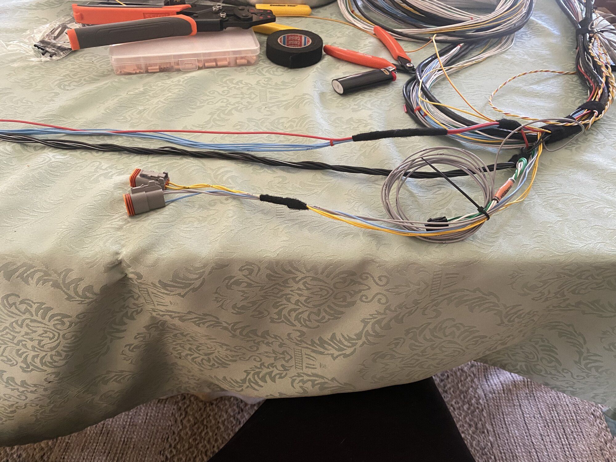

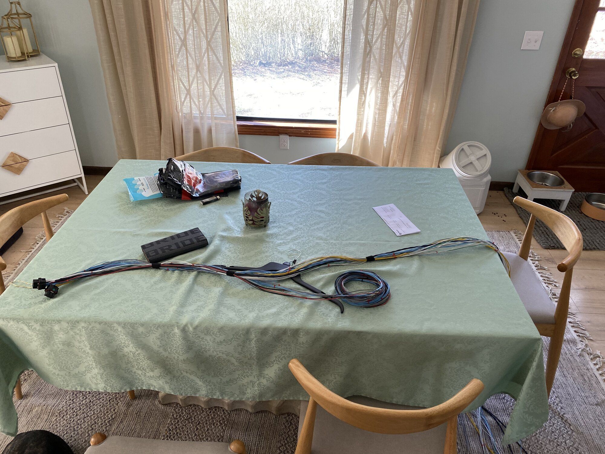

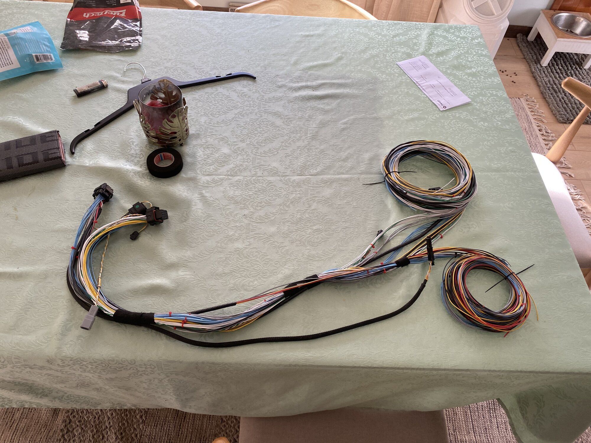

I then decided to put the harnesses together and start slowly laying it out inside the car. Put tape in a couple spots so I know the in car routing and where it’s going to go out through the firewall. I then pulled it out and started splitting the wires up even more than I previously had (what goes into the engine bay and what stays inside)
I also added the wideband harness into the mix. Next I’m going to go get some twine so I can plan the layout in the car and build the harness on a table.

I then started getting inputs and outputs pulled back and set into place so when I lay the harness in the car I won’t have to fight anything.

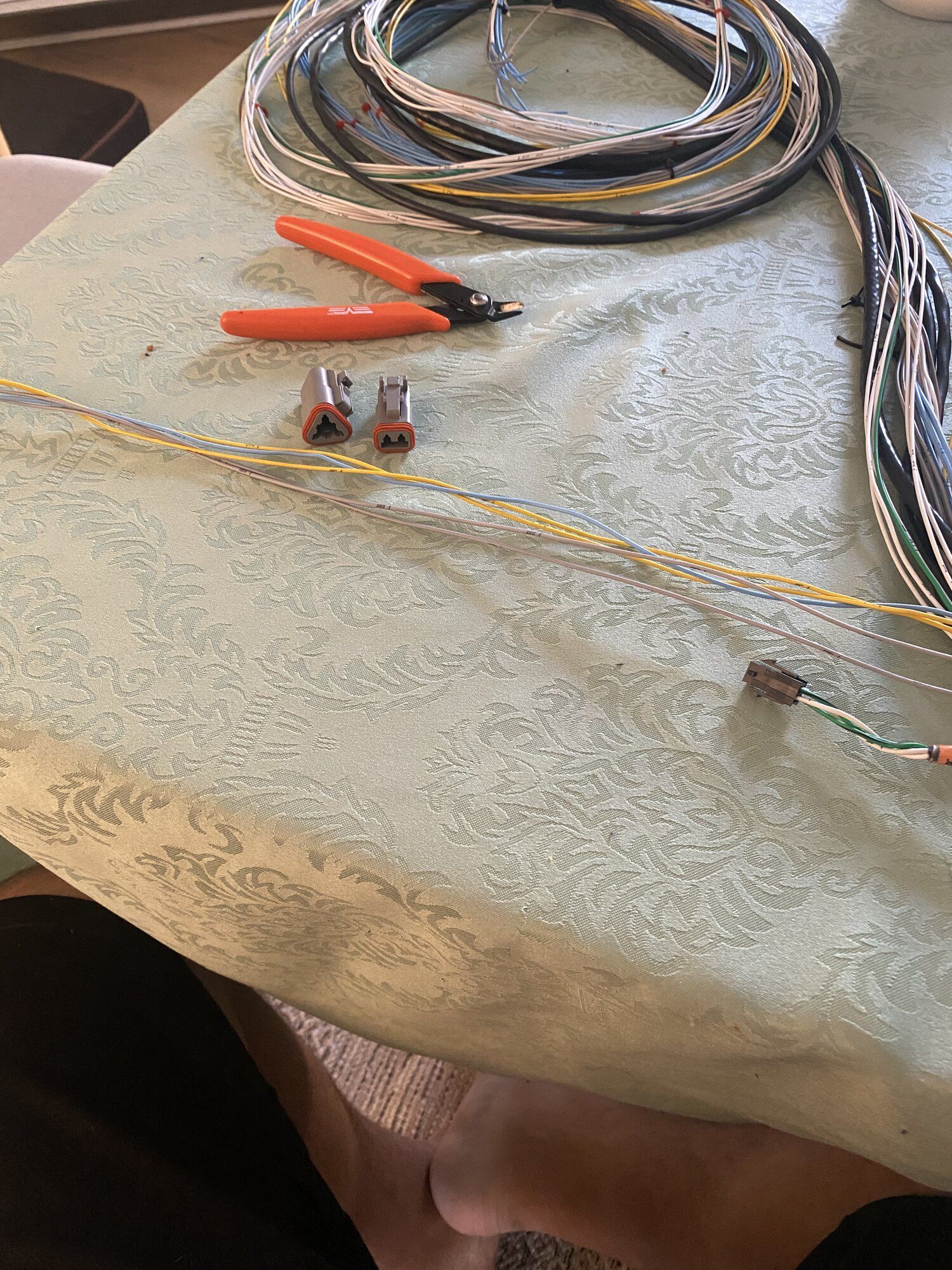

Harness is pretty well done till I get rope and make a mock up so I can lay it all out on a bench and get it finished up.

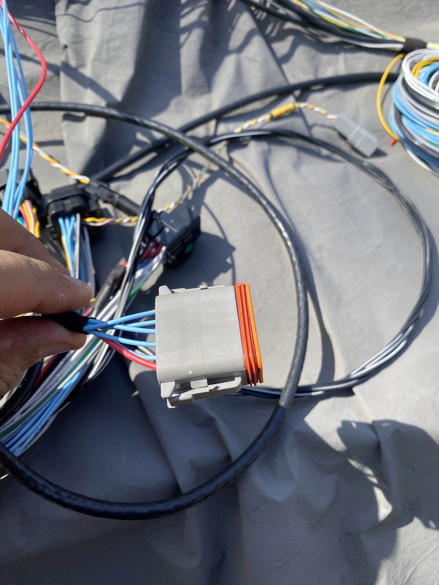

Small update on this wiring job:

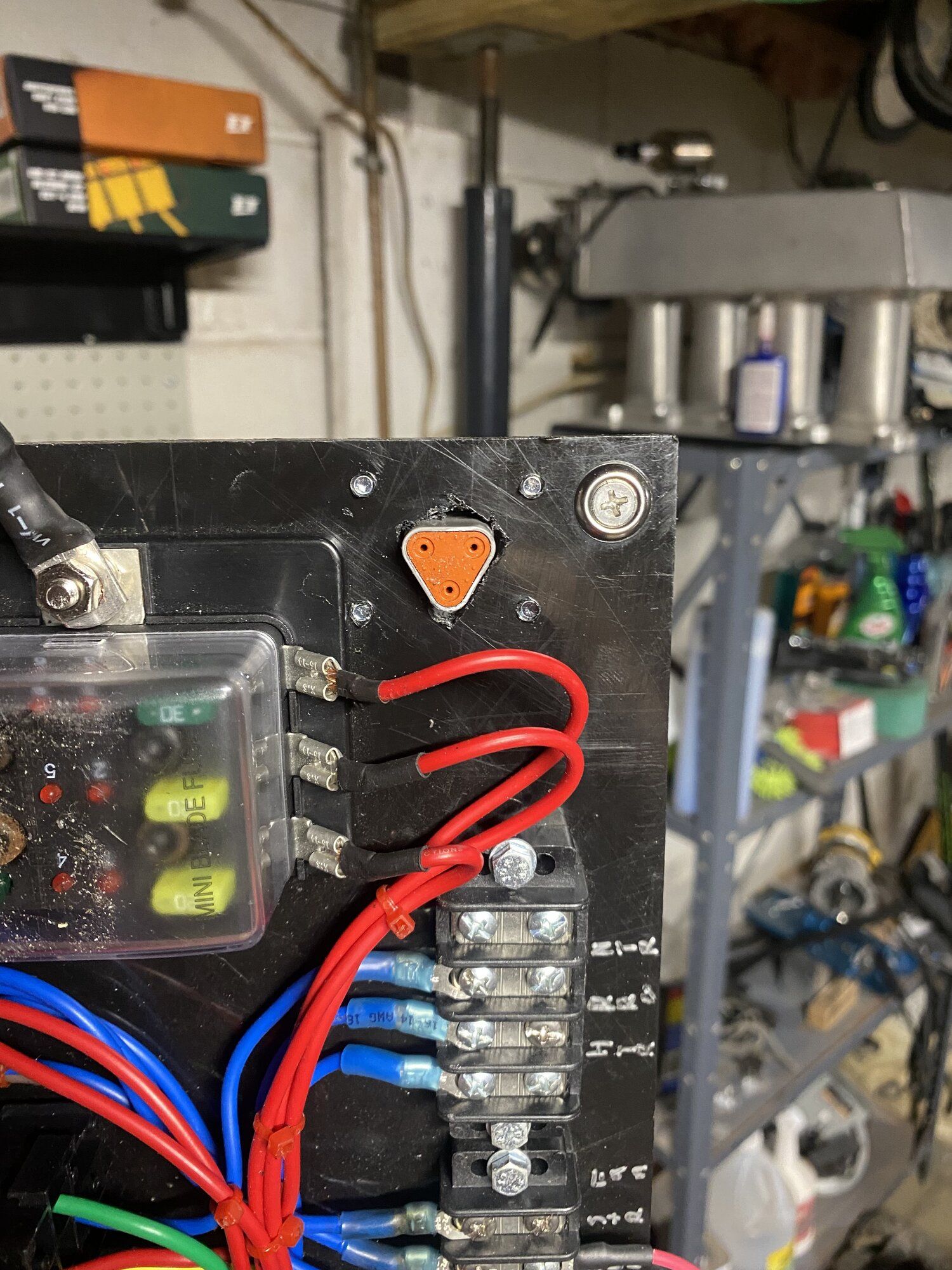

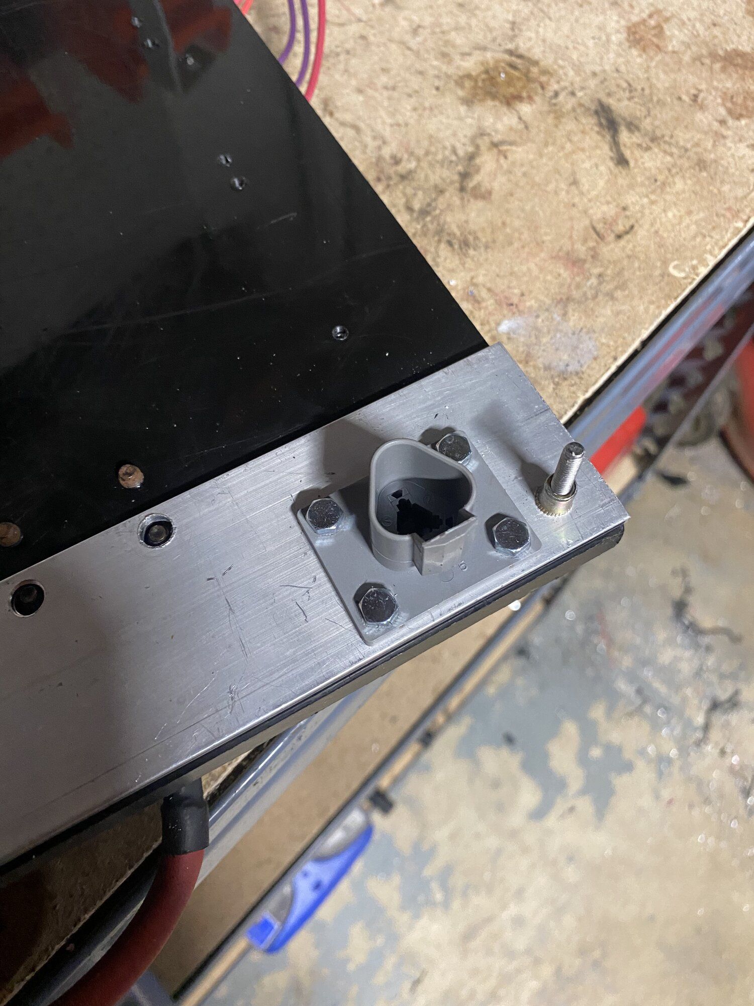

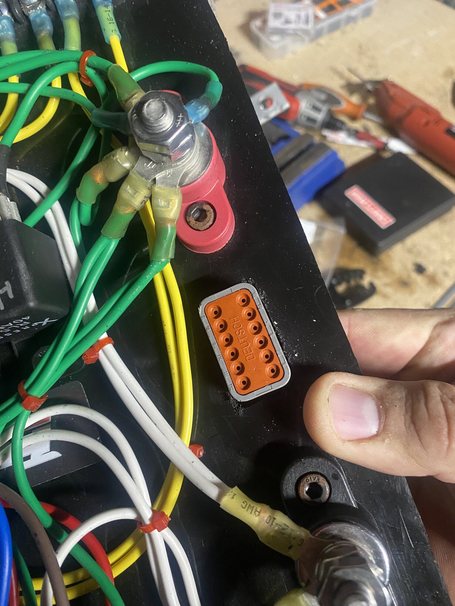

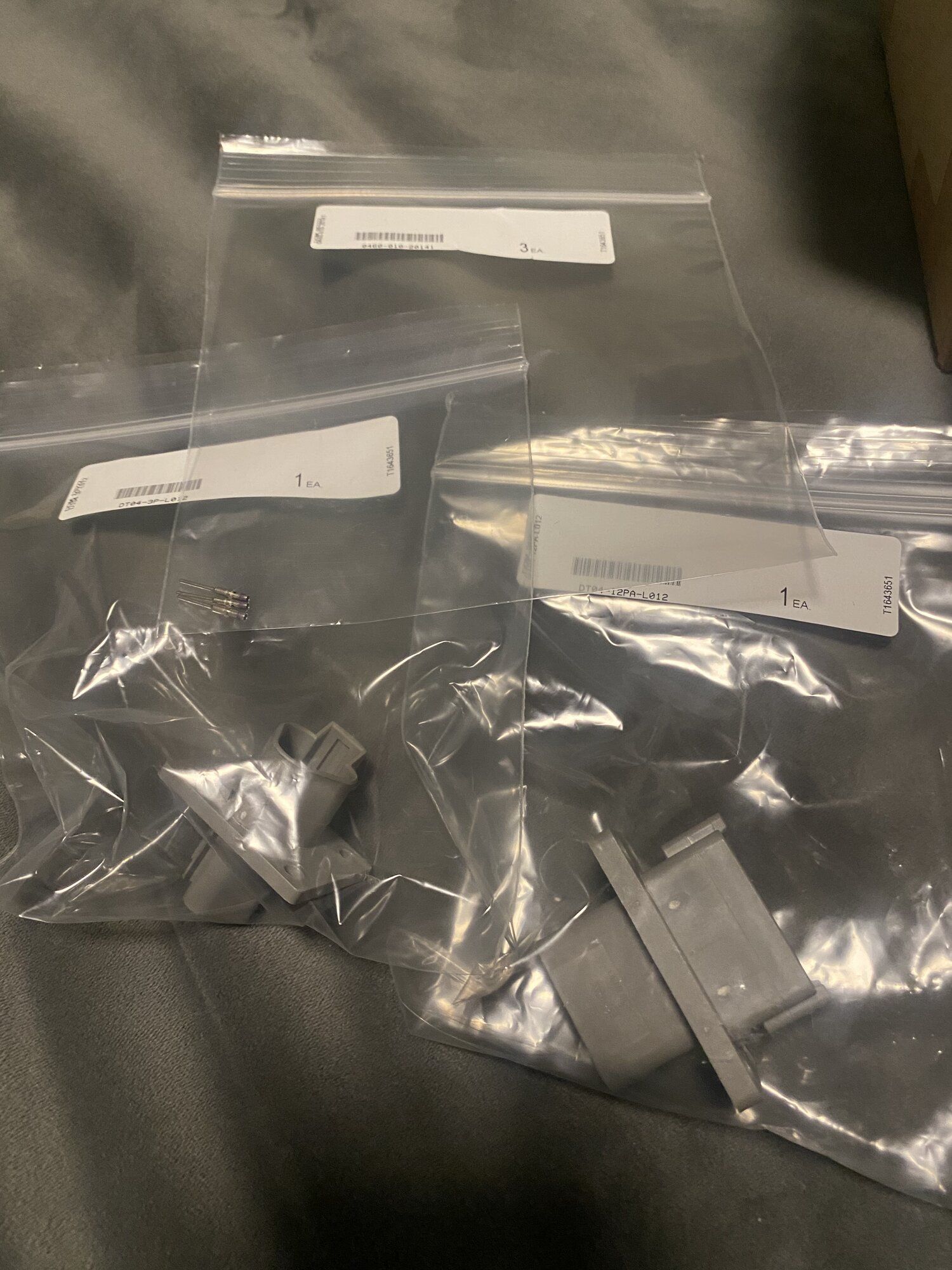

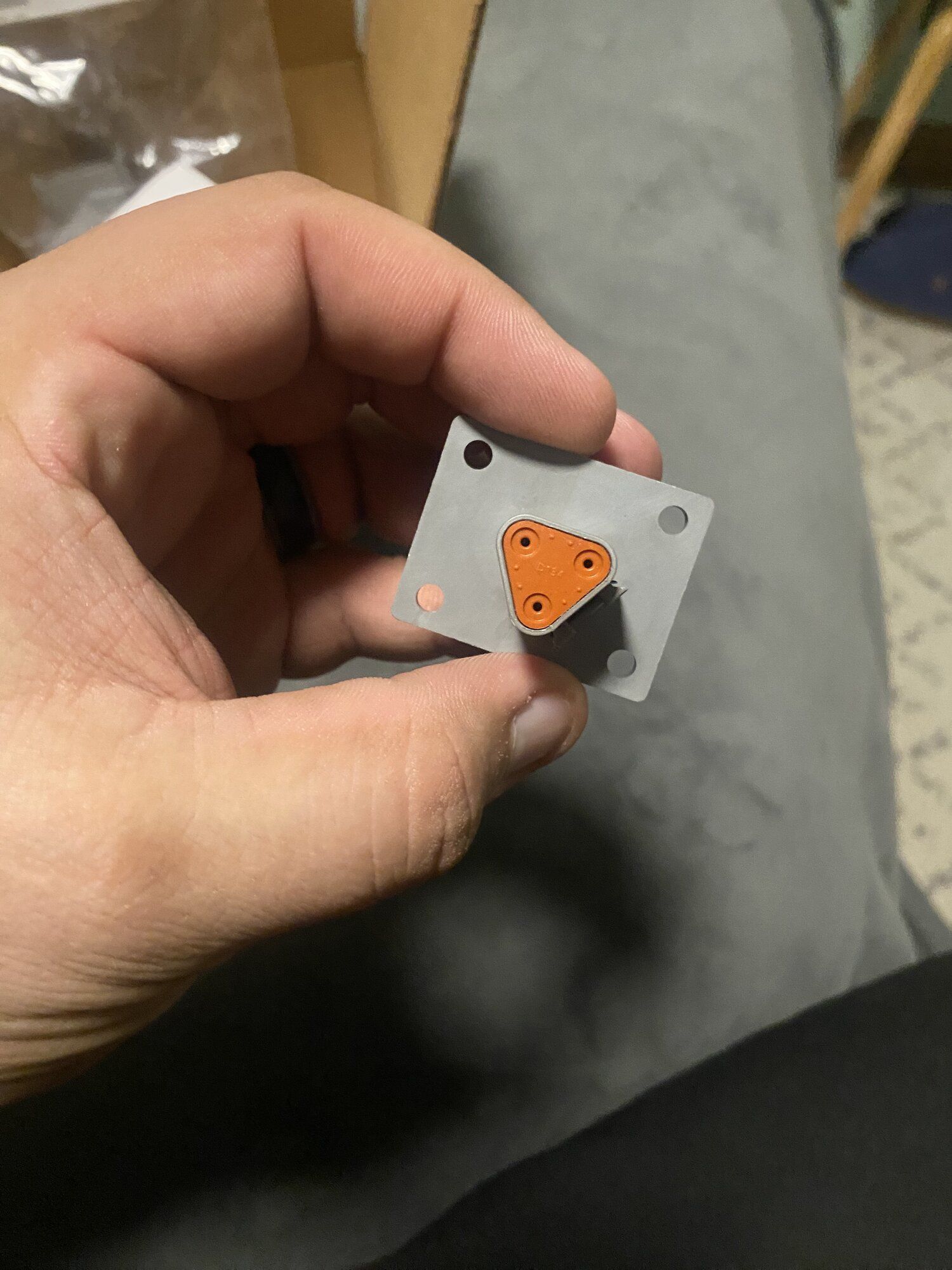

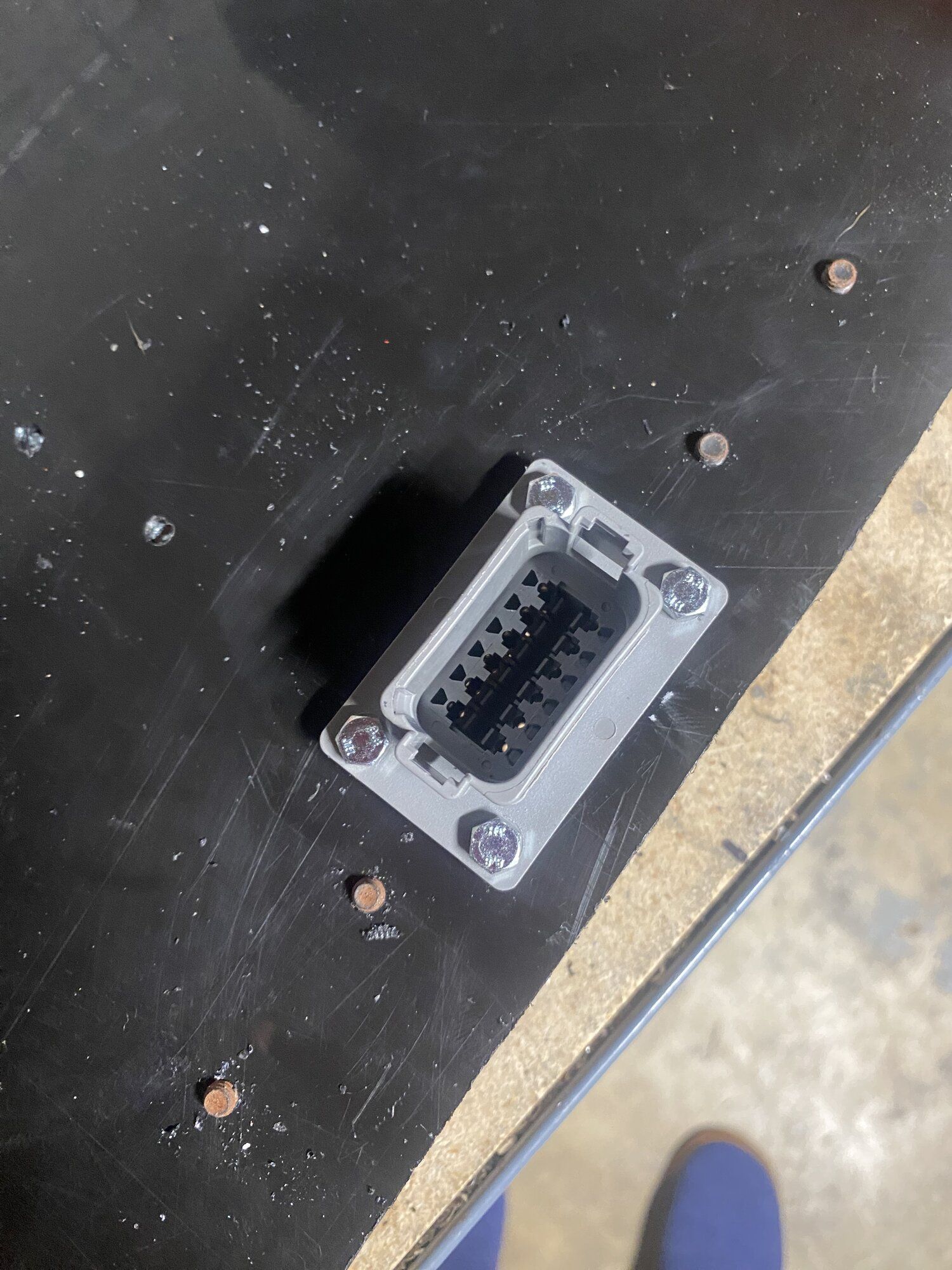

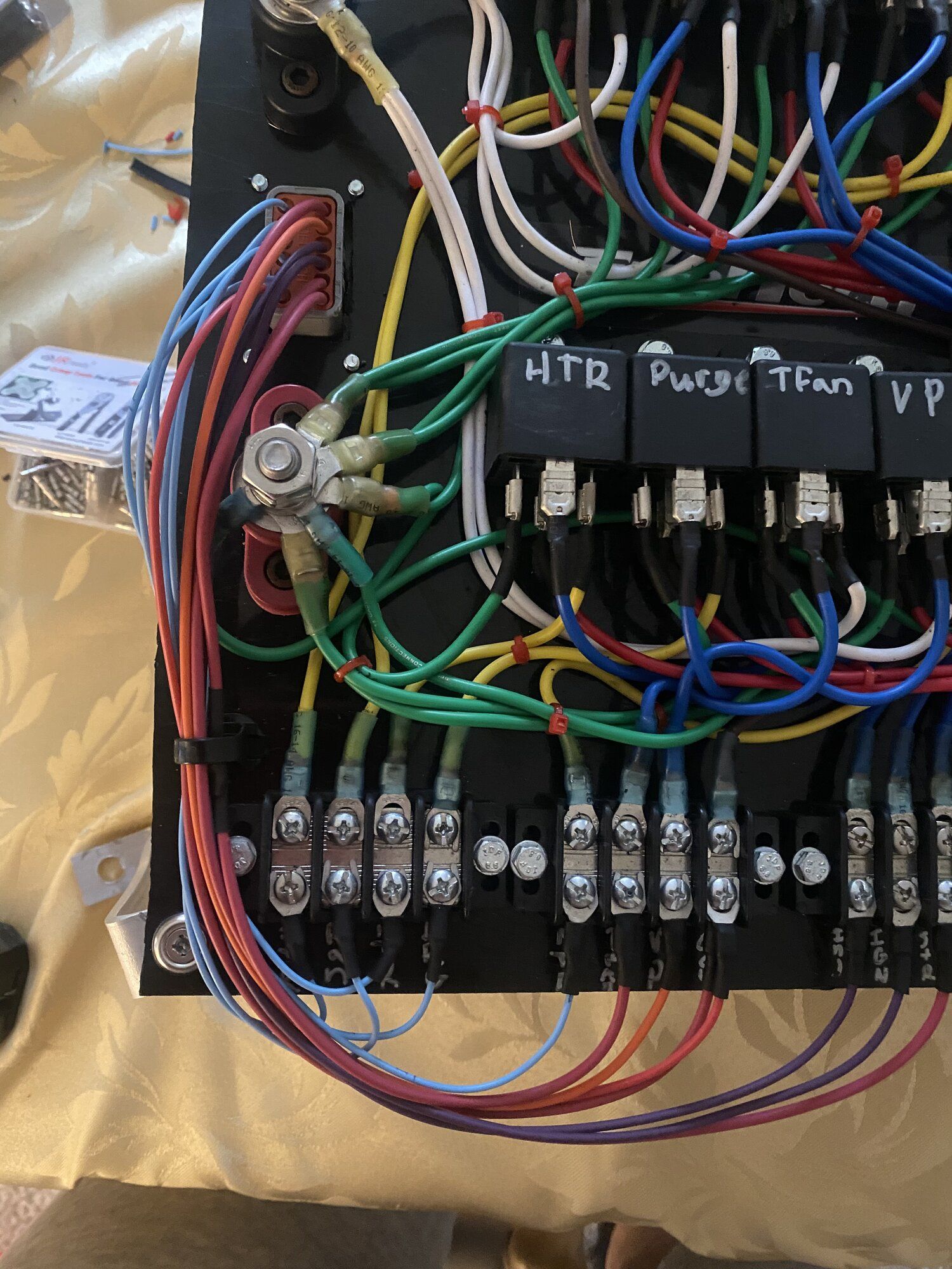

So I got to looking at running the outputs and stuff from the harness to the relay board and got to thinking that if I ever take the harness out it’ll be such a pain to unhook all those wires off my buss bars. So did some digging and came across some flanged Deutsch connectors. So got some ordered in and got to work

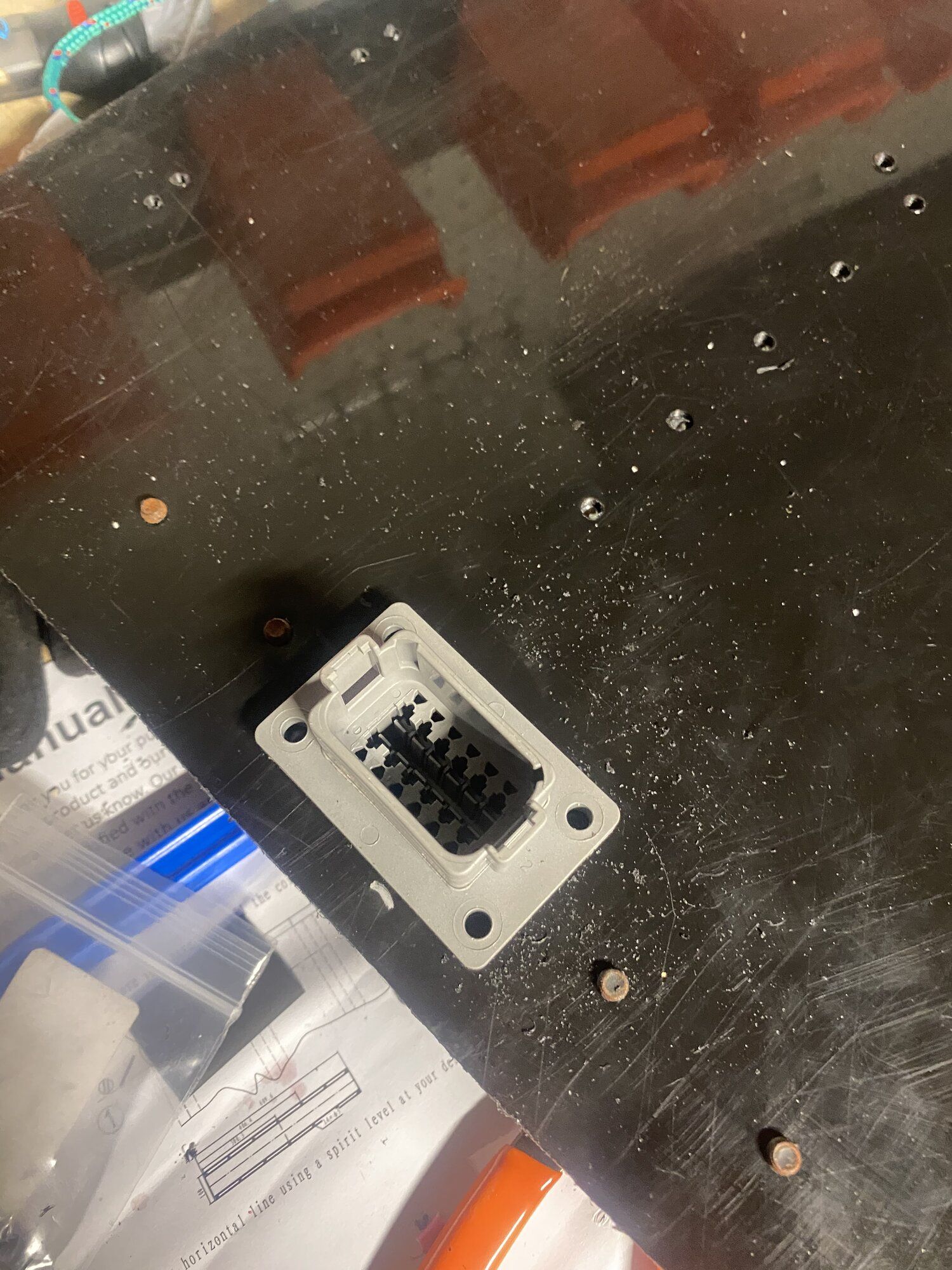

So after these things got here I pulled the relay board back out of the car and picked a couple spots to put these.
Got the first hole cut and connector mounted
Second one mounted up for the nitrous stuff going out.
Now it’s time to wire this board up and finally (knocking on wood) it’ll be complete.

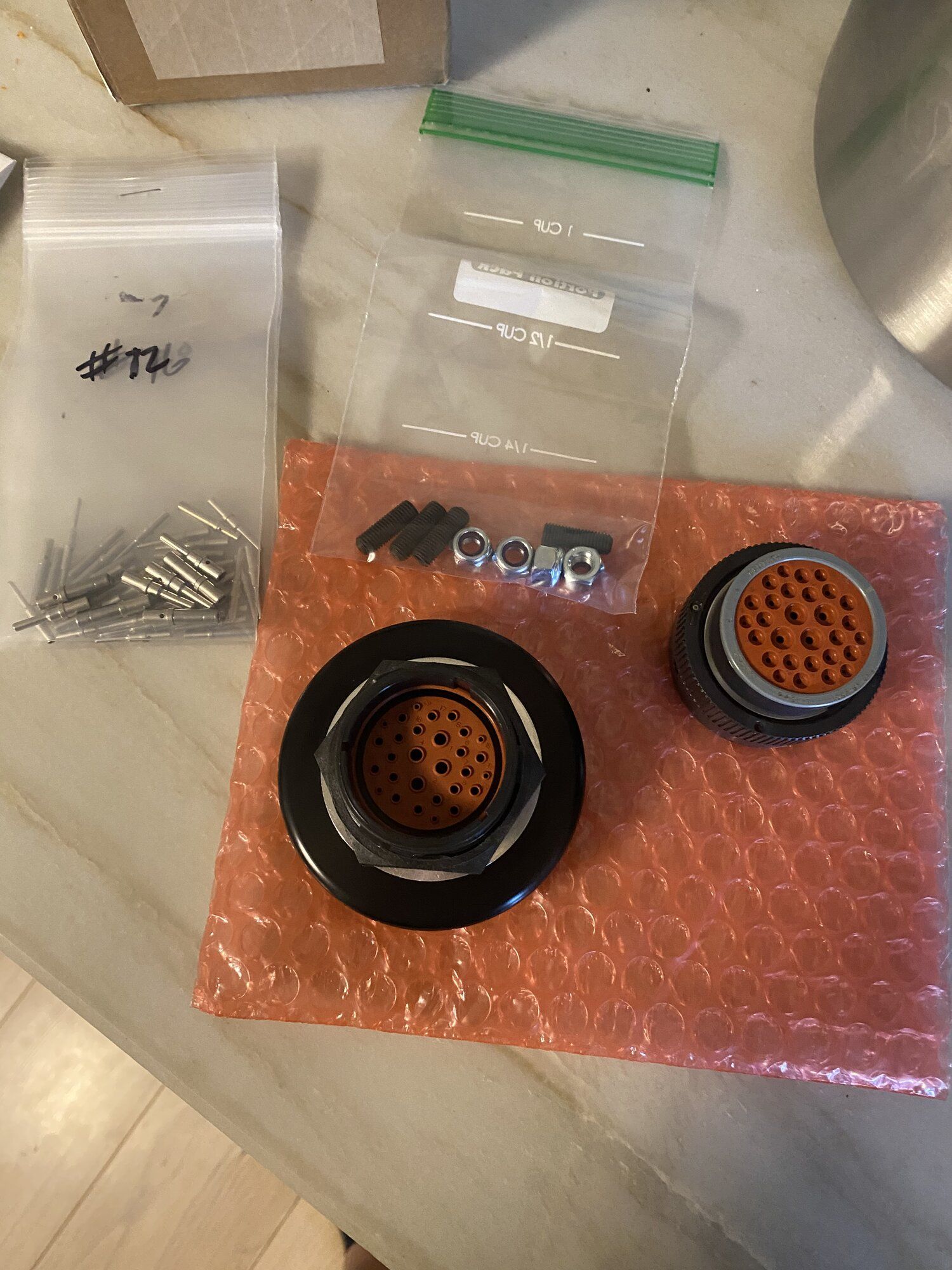

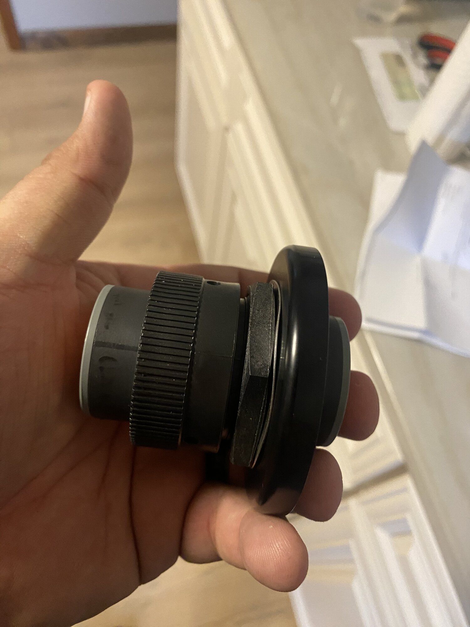

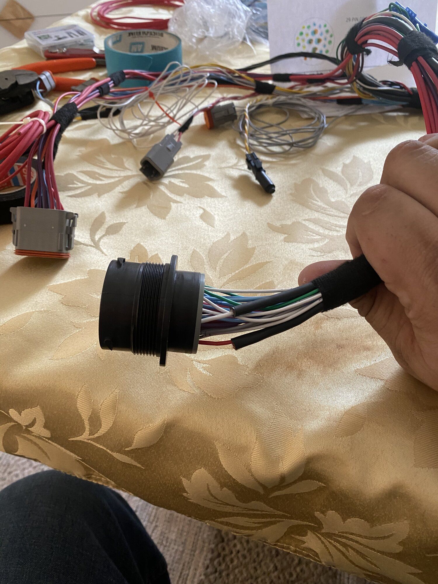

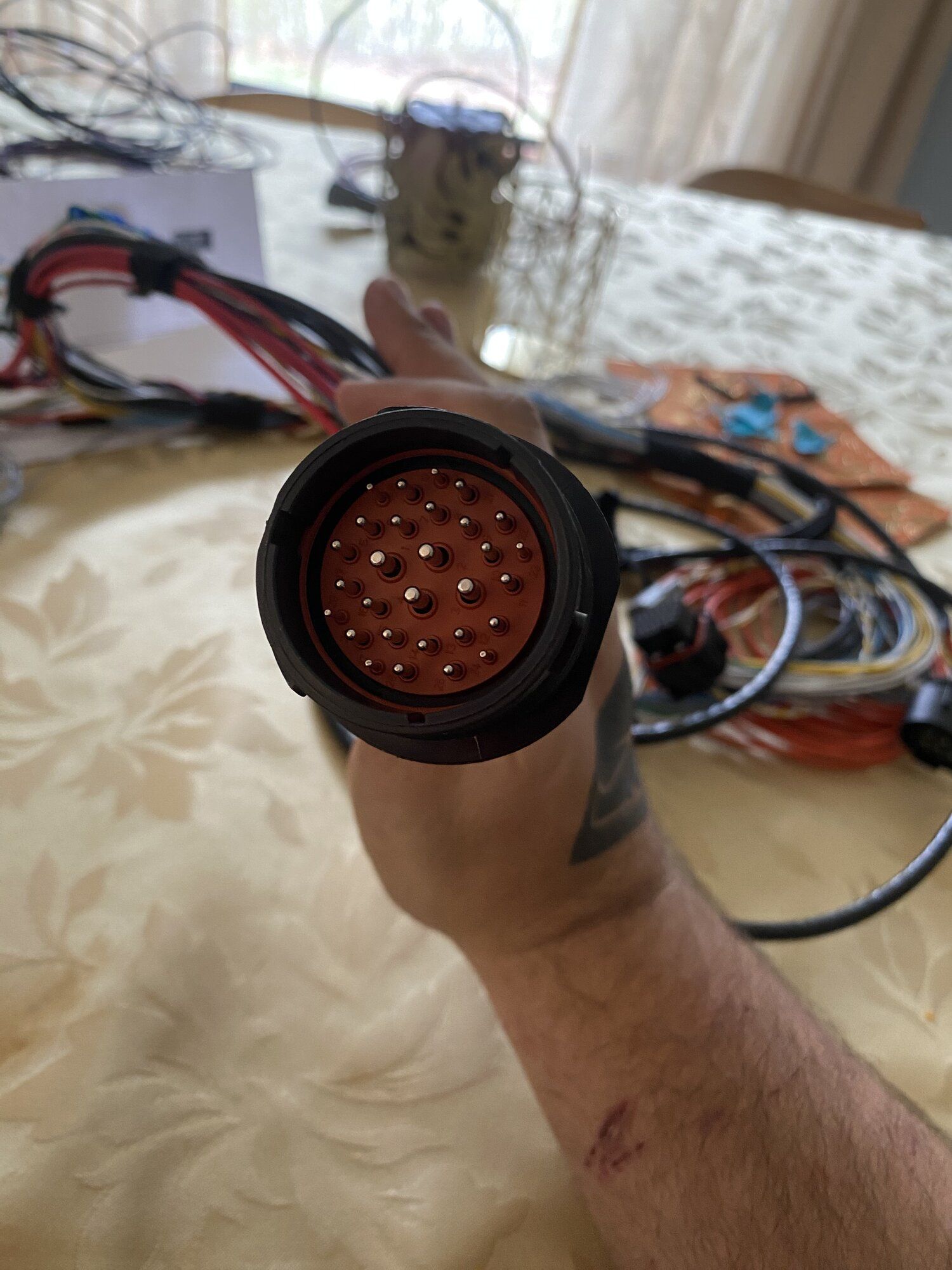

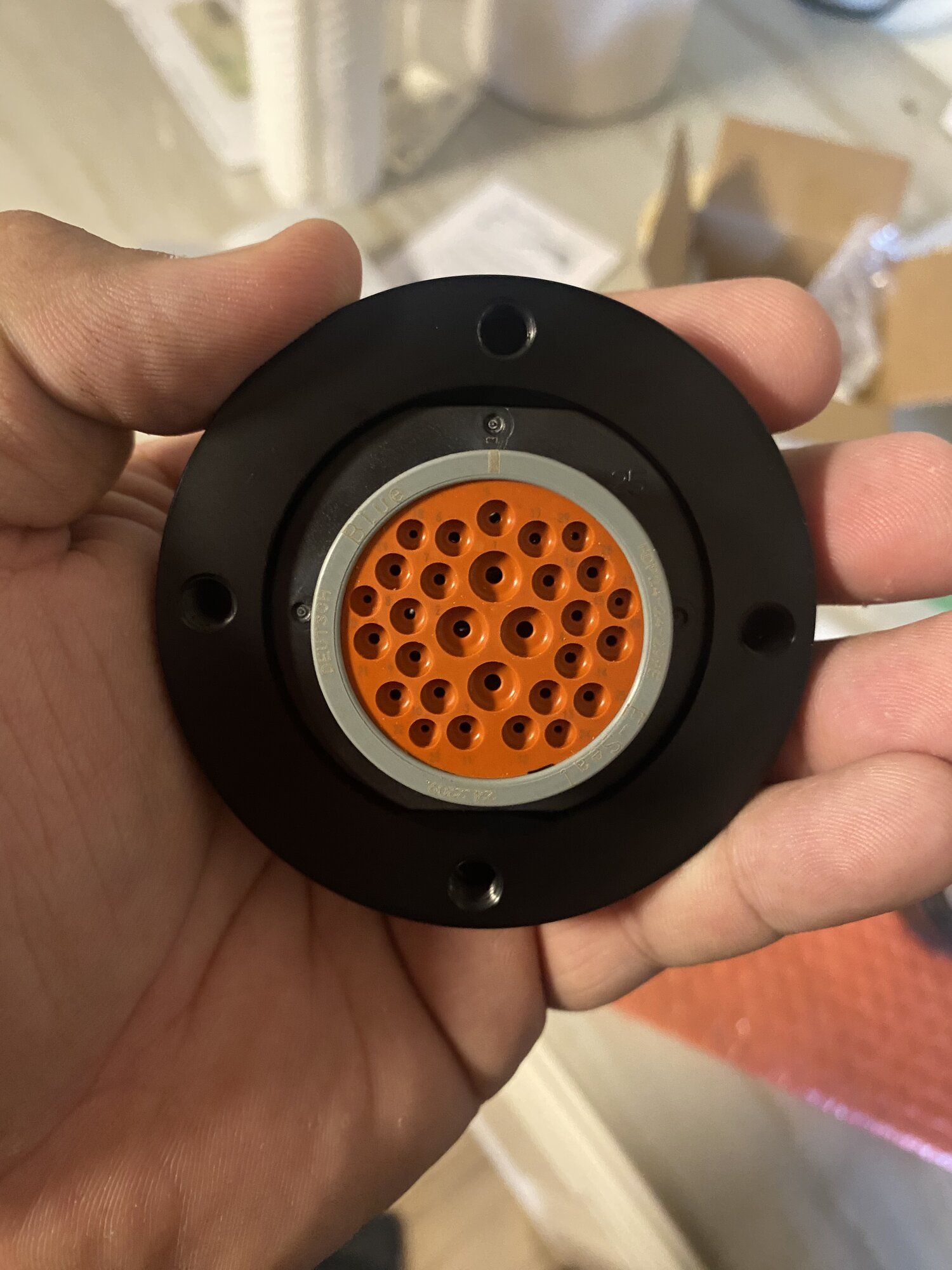

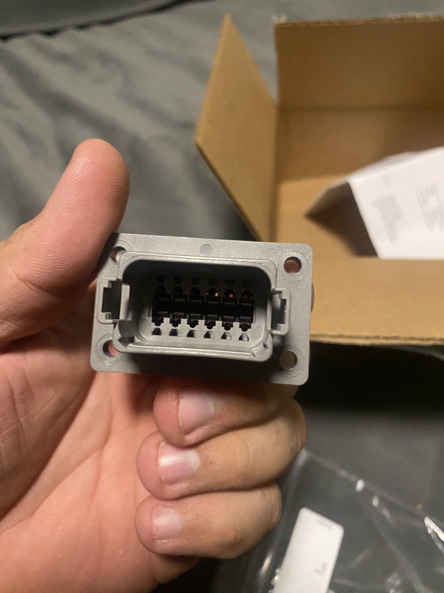

So I’ve also got a firewall bulkhead connector ordered in to make the engine bay side wiring that much easier. Waiting on it to ship still 🙄.
I’m going to get the relay board mounted back in the car and get the nitrous plug wired up, set the harness back in the car and trim the wires going to the 12 pin and start wiring that side of the plug.
Update pics from yesterday afternoon:

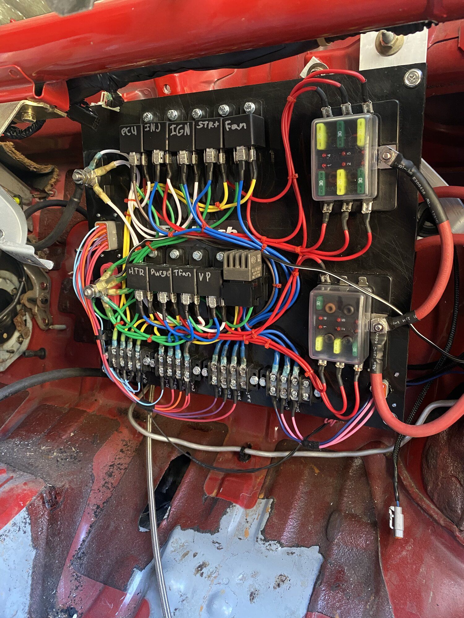

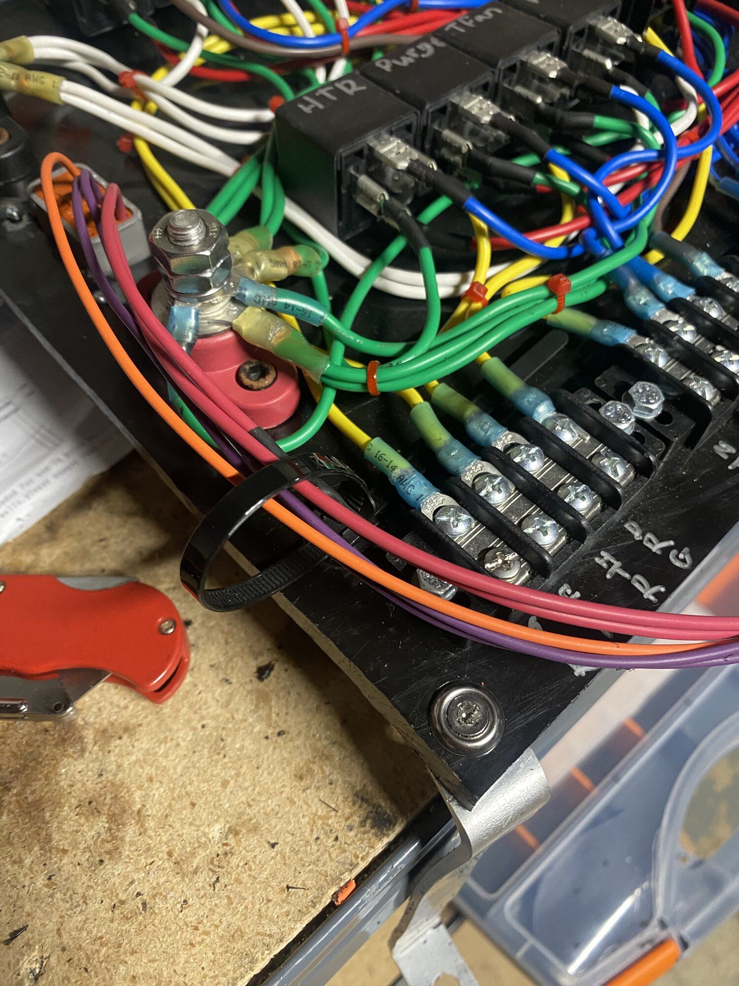

So went out and put the relay board back in the car. Also wired my 3 pin connector up to plug into the board and also started wiring my 12 pin (I’ll finish it once my firewall connector gets here)

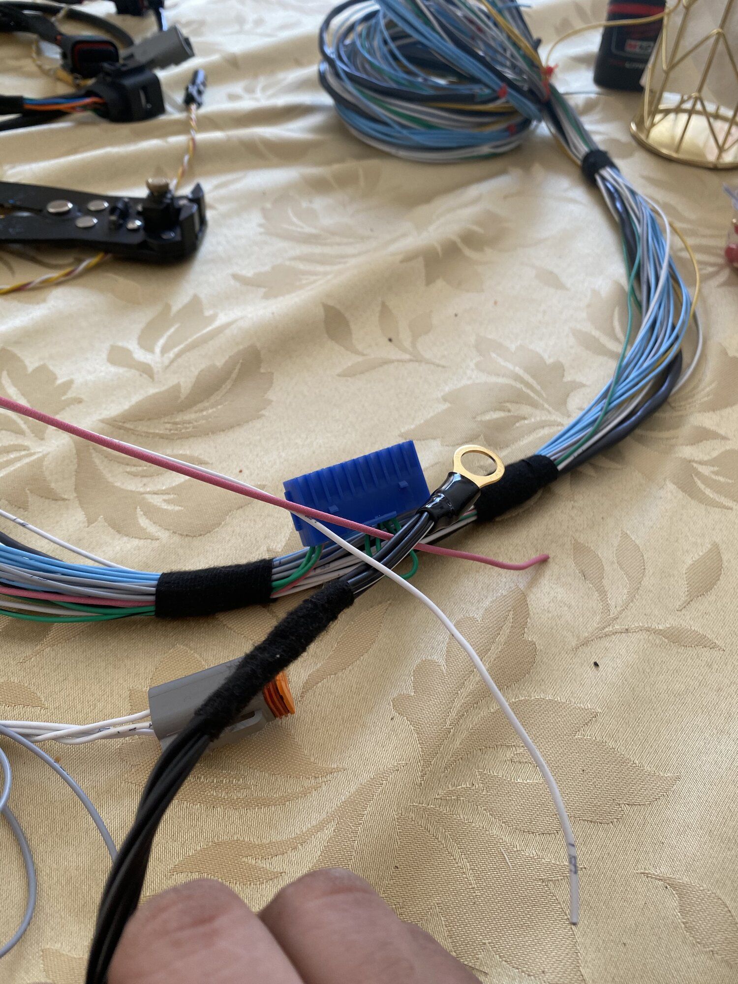

I then made some measurements and brought the harness back in the house to make some more additions.
This is a distribution connector for my sensor ground and sensor 5v for inside the car.
Also added this eyelet for my battery grounds all to go to my firewall bulkhead.

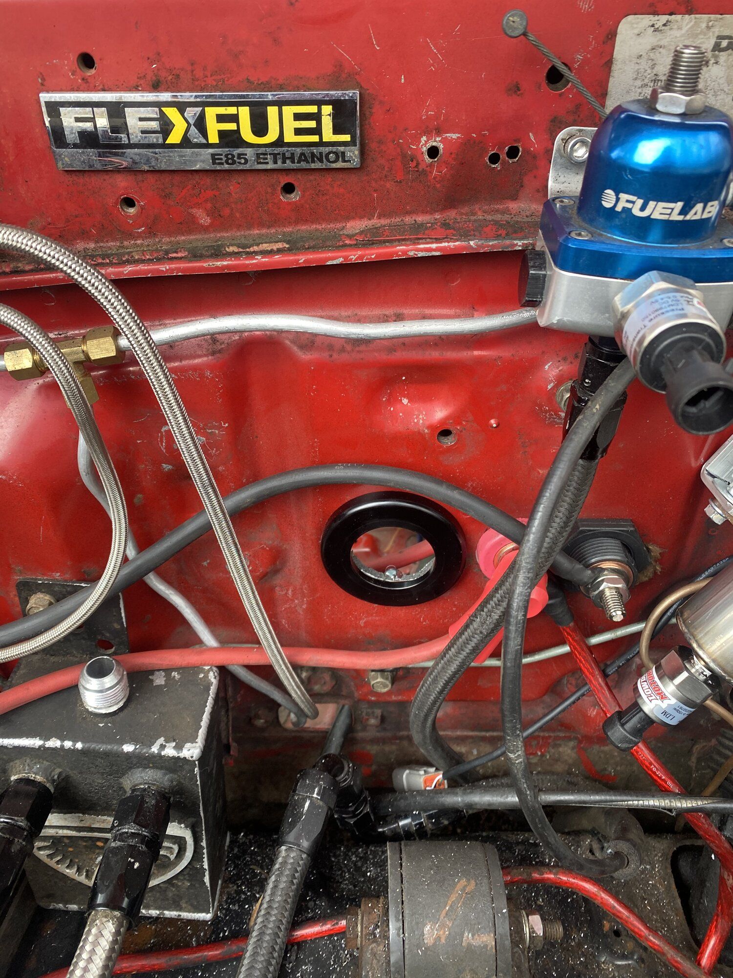

Got the emap

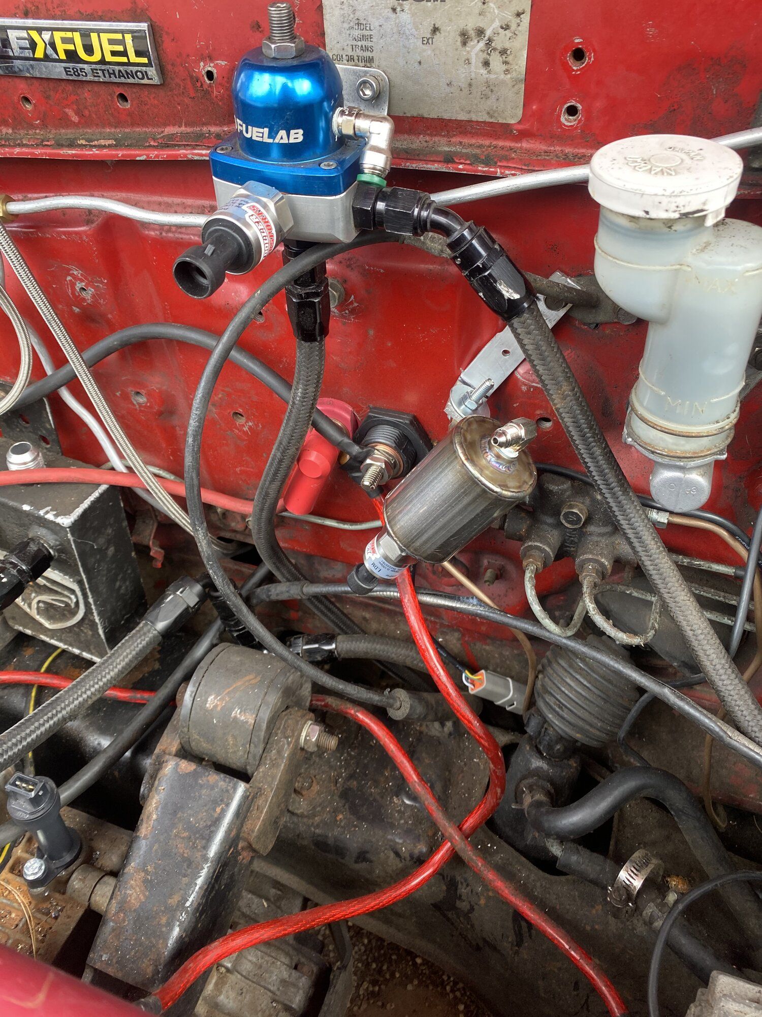

Canister moved off the intake and put it on the firewall. Also after bumping the fuel pressure a donzen times trying to get the intake off I’m going to put a 90* fitting on it.

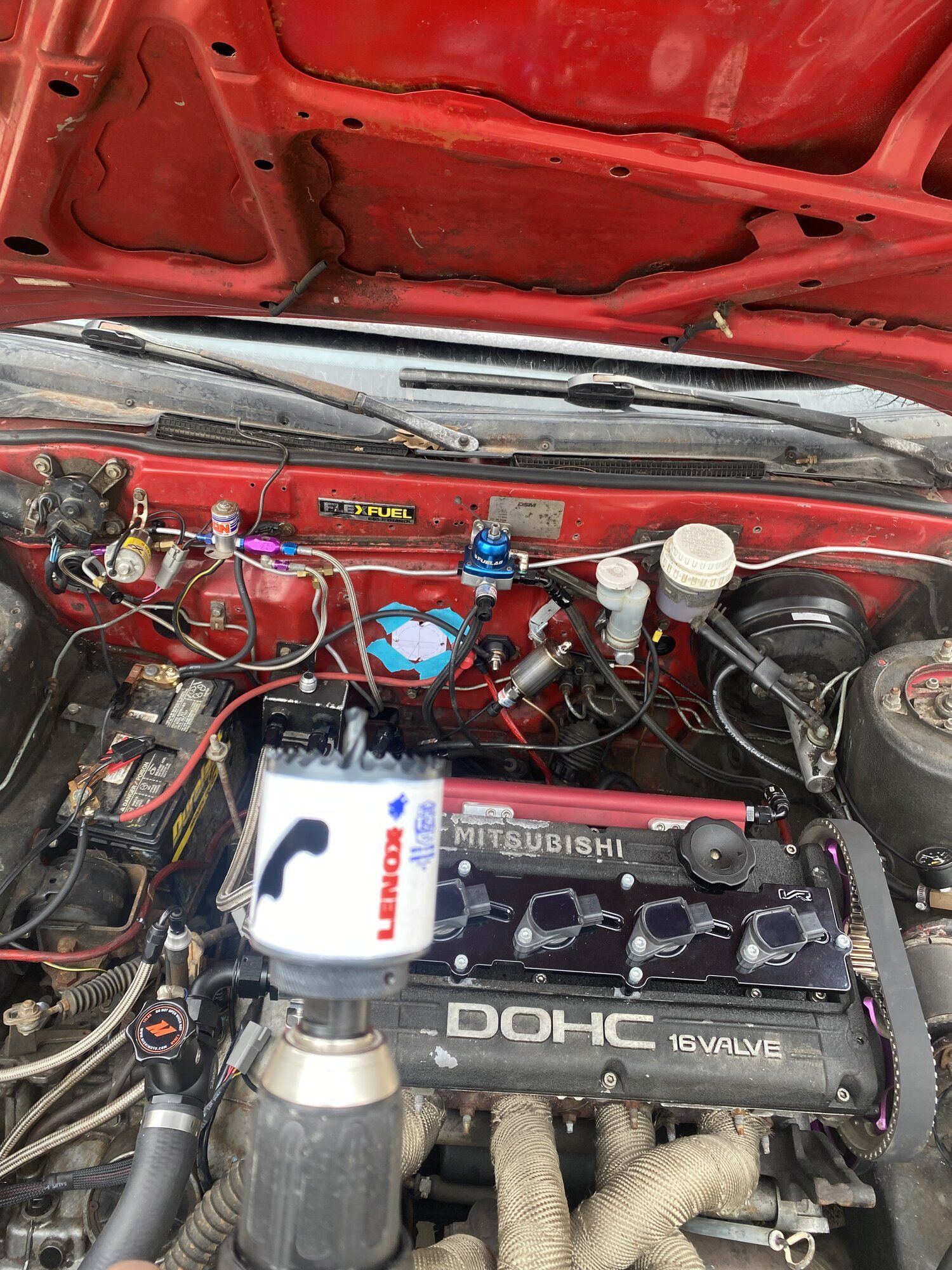

Today is the day we make a hole in the firewall!!
Got my template taped on the firewall and went to town.
Got the trim ring for the bulkhead connector bolted down on the firewall. That took a little finessing on the inside to get the studs to poke through bolts pieces of metal.
Marked the harness where it pokes through the firewall and cut. Then it was time to start wiring.
Got a couple things o. This side to finish up and it’ll get mounted inside the car and I’ll start putting the dash back in.
