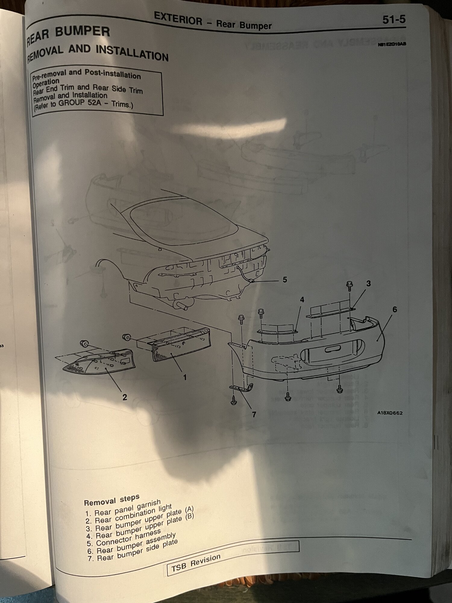

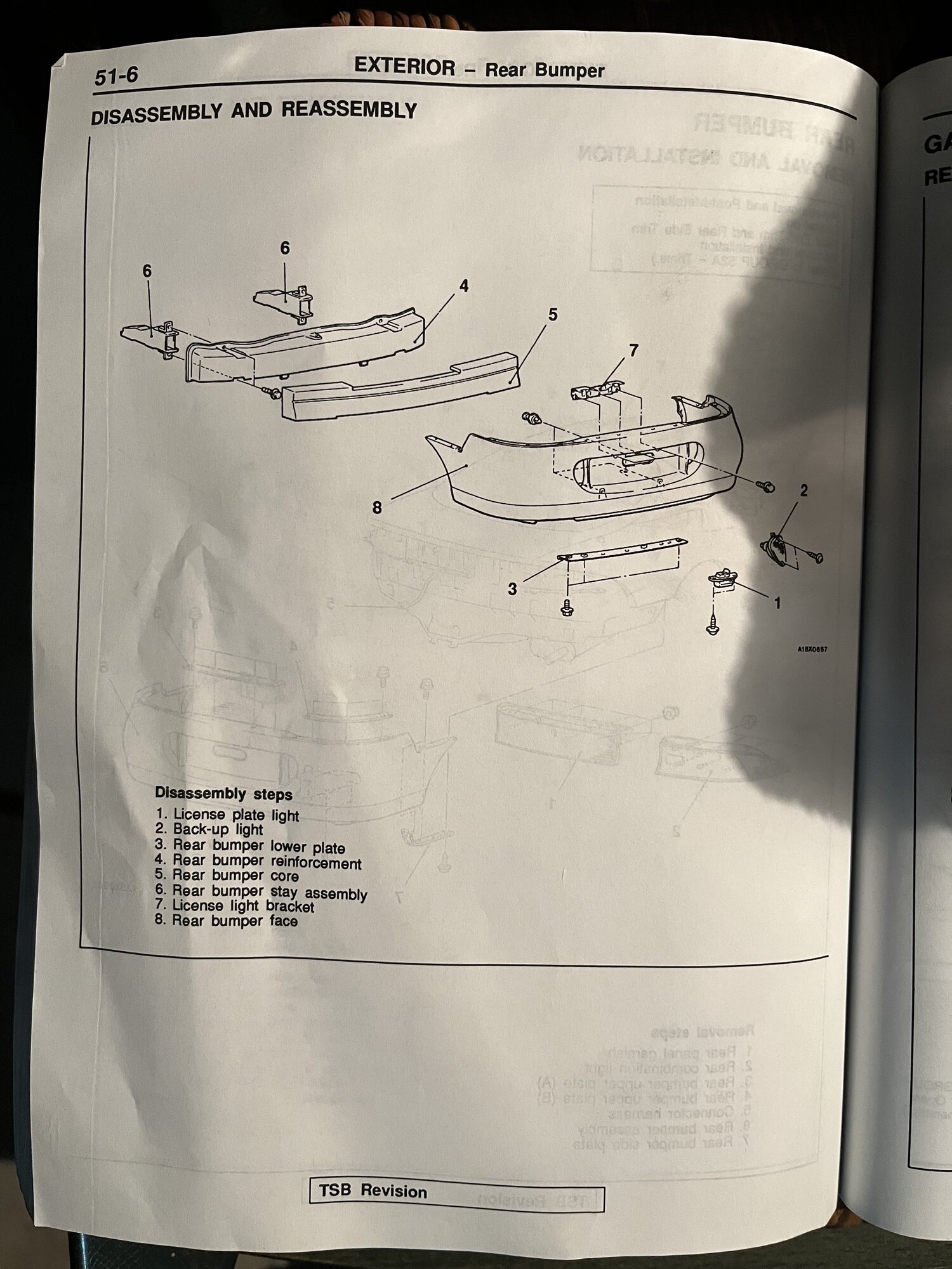

There is no easy way to remove the rear bumper cover.
Jack up the rear, remove two wheels, remove the back fender liner to get to the corner bolts.
All the lower rear interior has to come off:
This lets you remove the tail lights and center garnish, and THEN you can get to the cover bolts top and bottom,
Undo the license plate wiring, and in my case unmount a rearview camera so that, you can carefully lift back the cover. Don’t forget the cover clips that tie into the bumper.

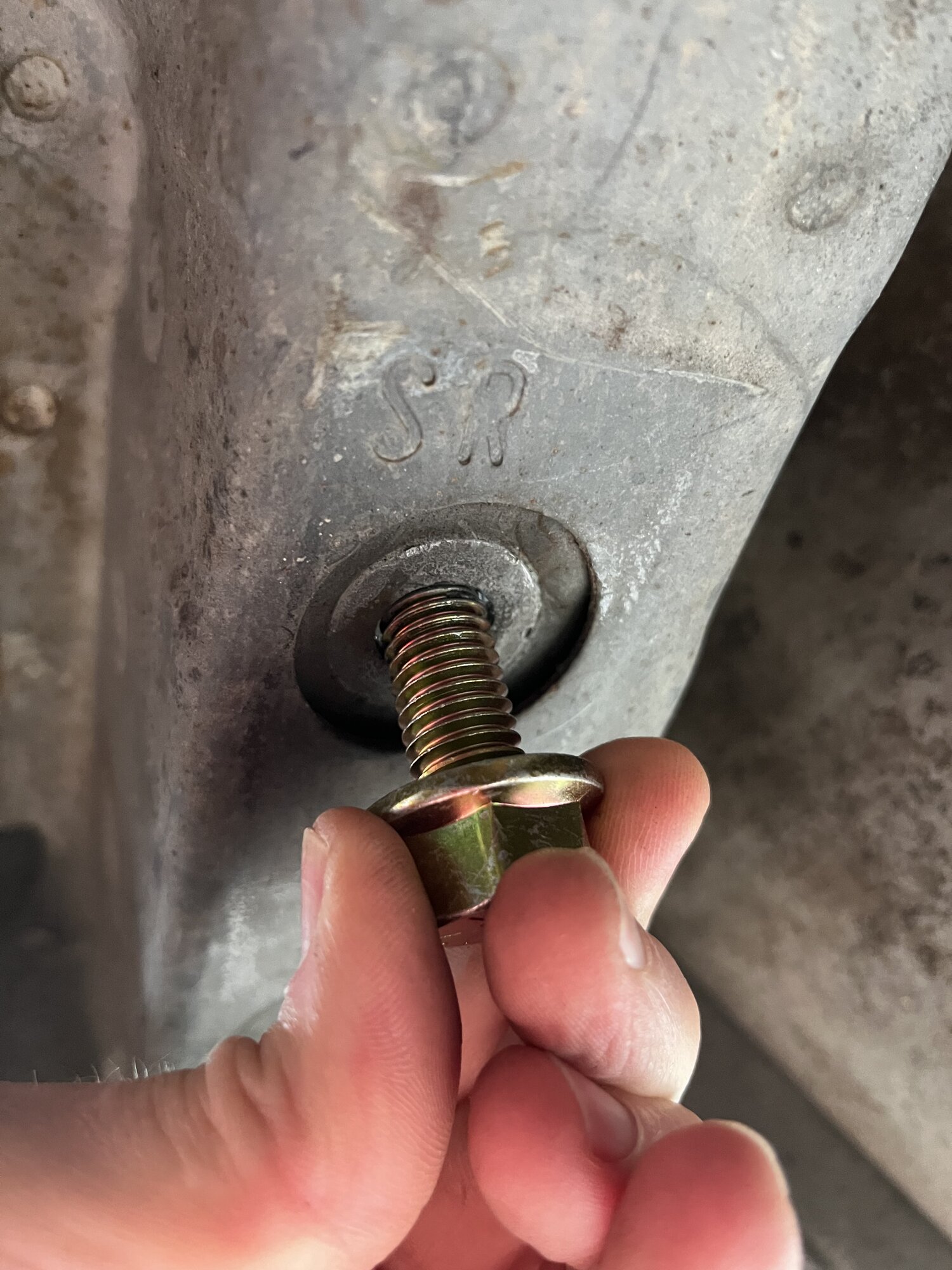

Hmmm i dont see copper seize anywhere LOL
Do yourself a favor and every bolt you remove ALWAYS use copper seize on the threads. Make it a new thing. Touch the car = add copper seize 🤣

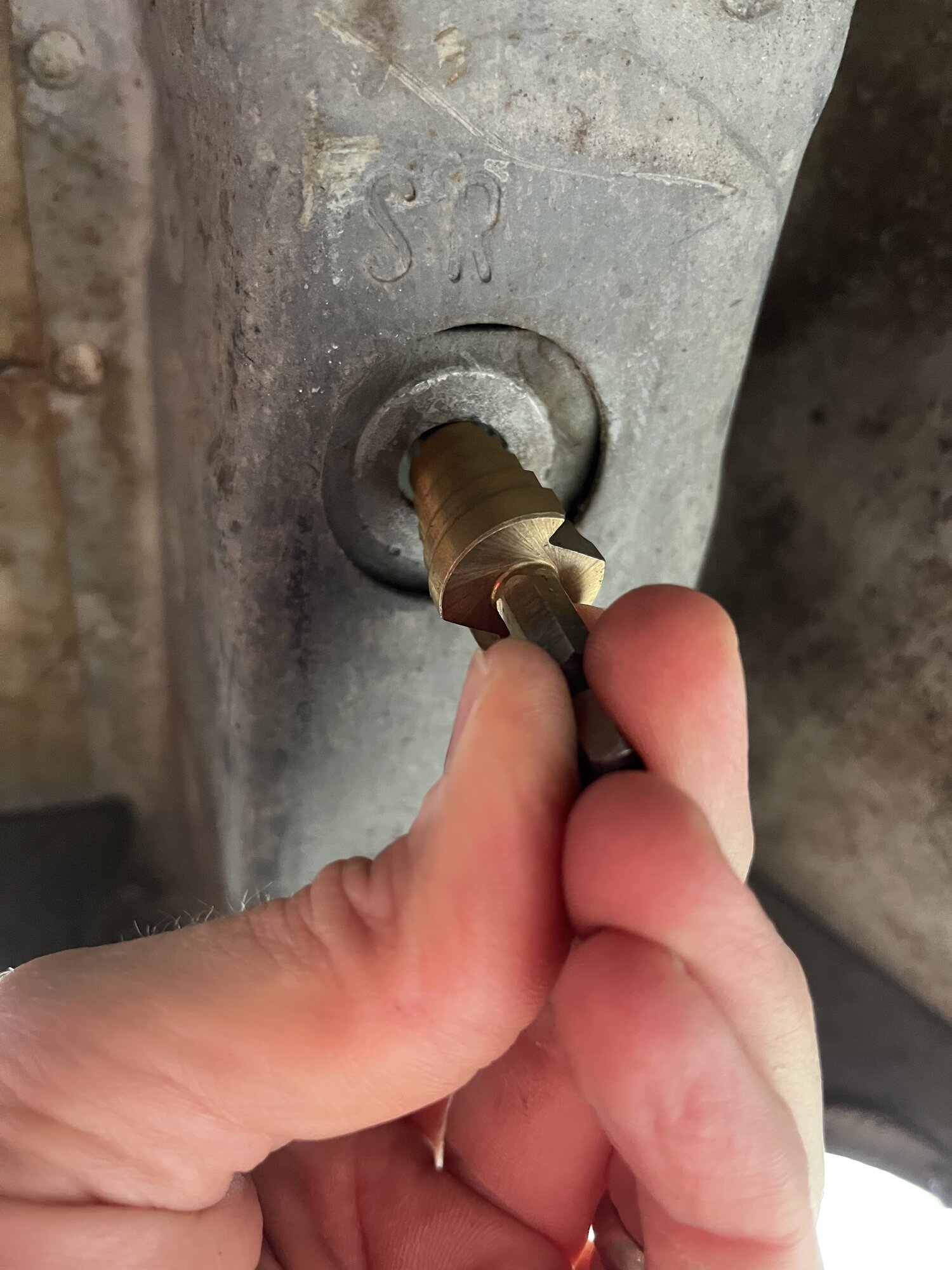

I did in fact re tap the chassis nuts, SS brush the best of the old two bolts that were re-used, and coat the threads with nickel anti-seize. I do that so much I don’t even say anything abut it. - it just happens

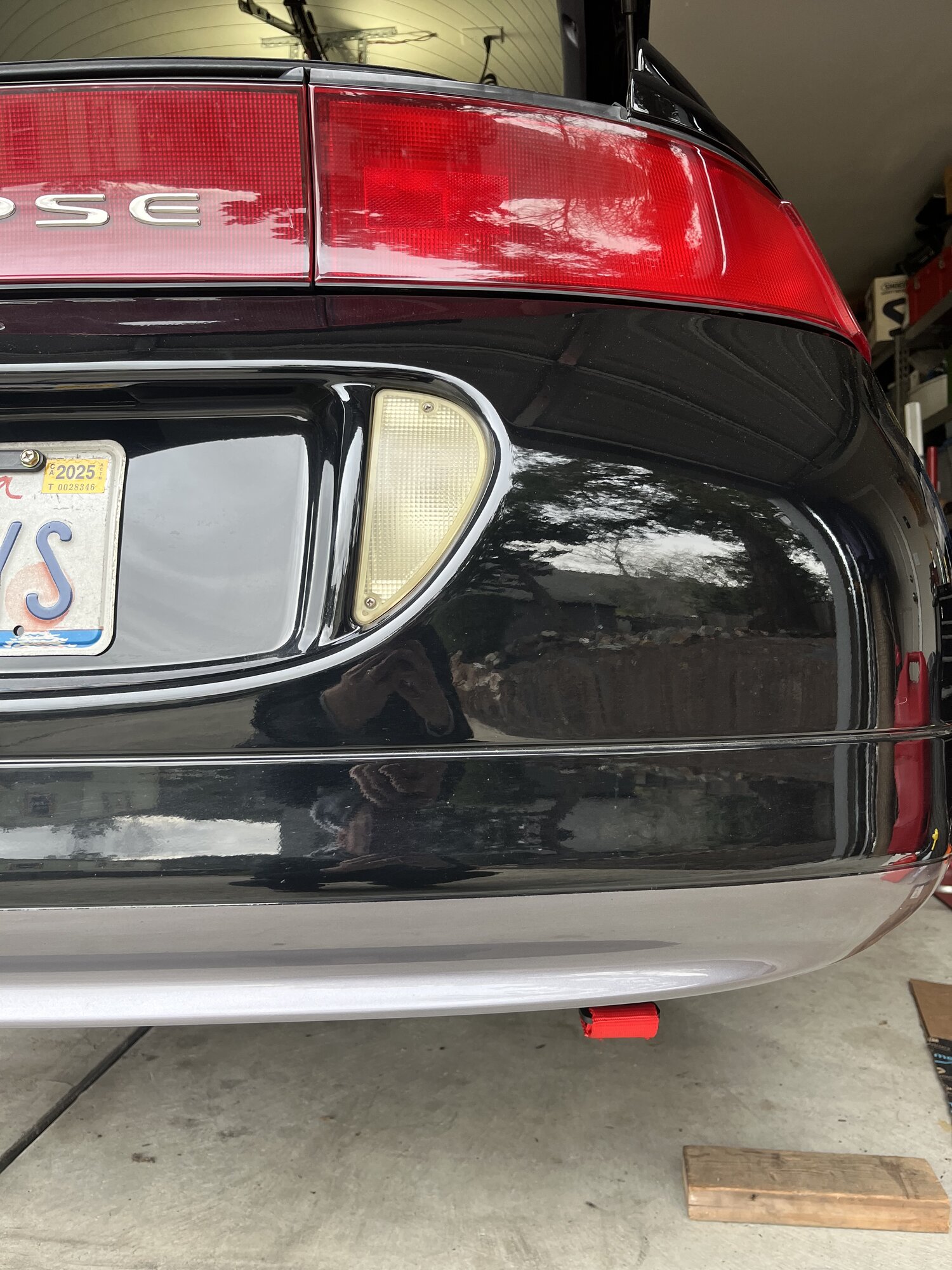

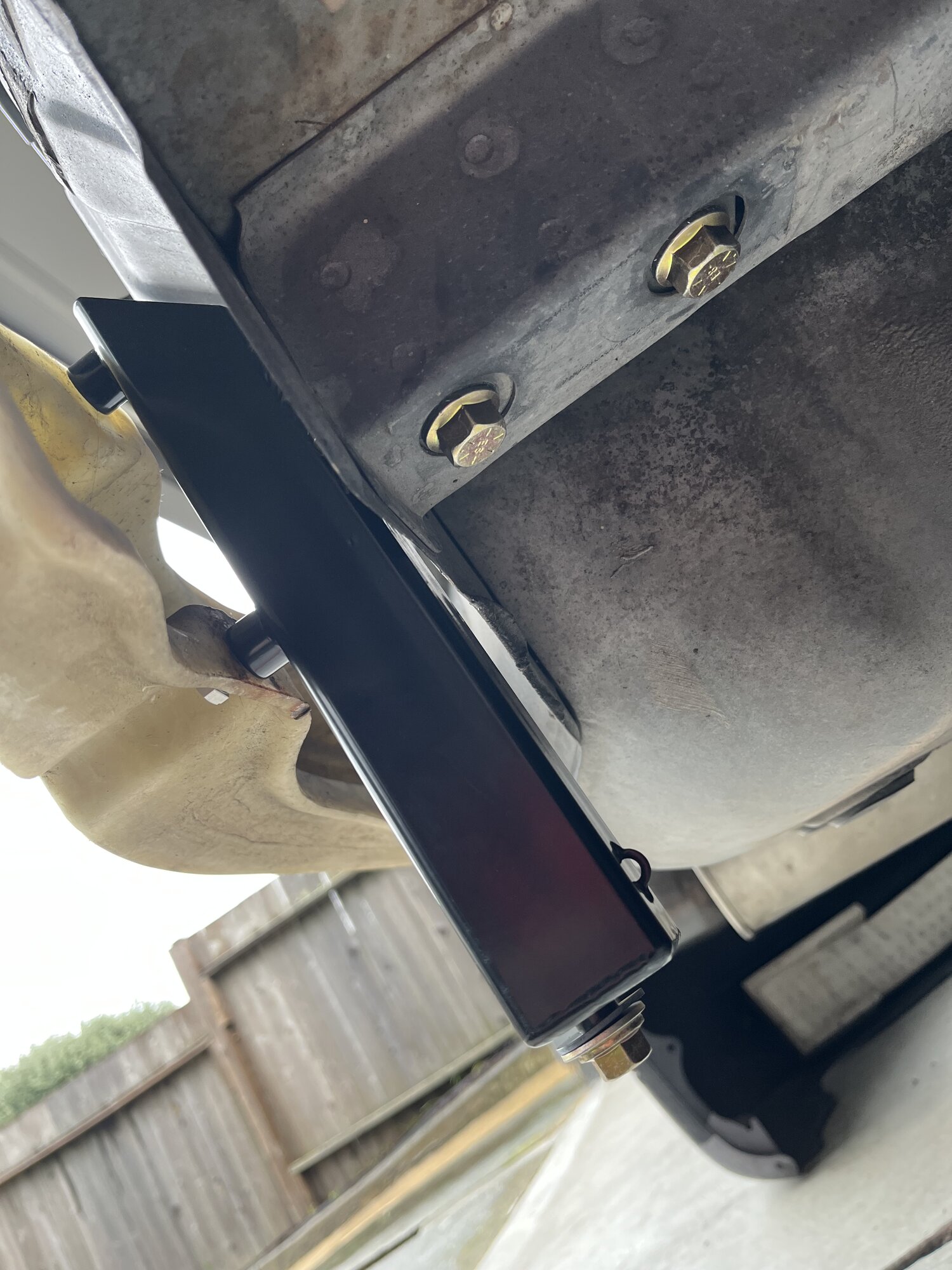

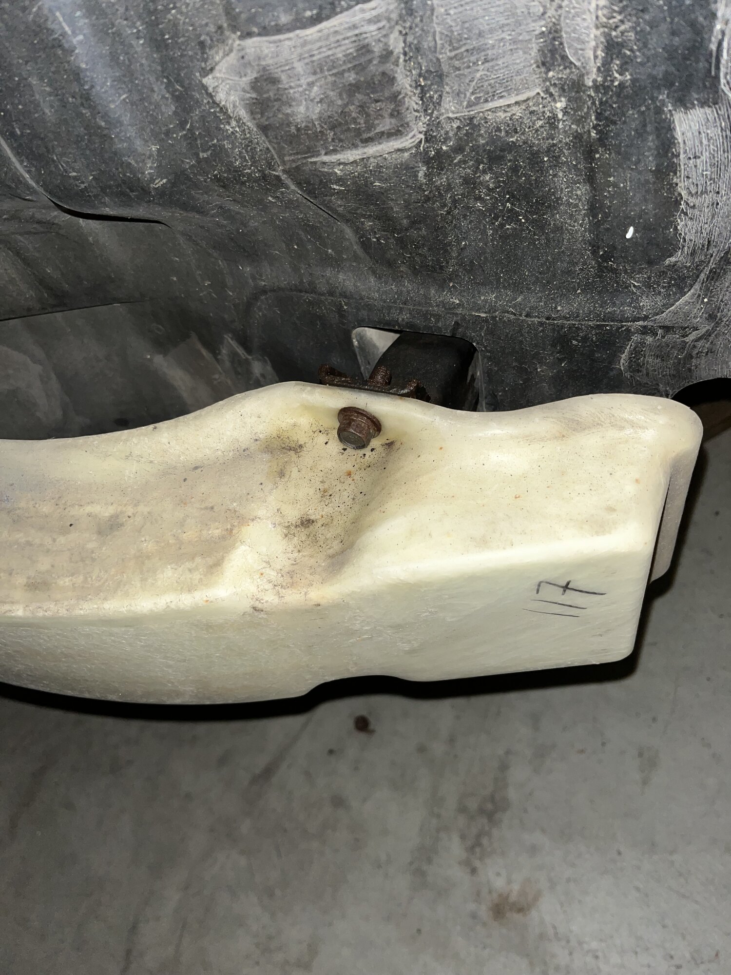

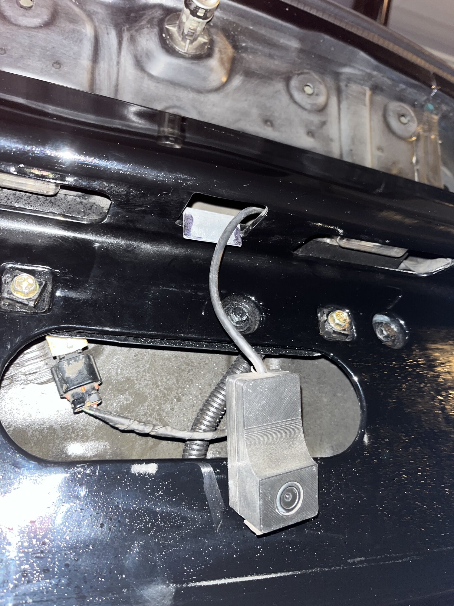

Task 2 under the bumper complete- a little aluminum L bracket for the back up camera. If I’ve done this right, I won’t need the bolt on license plate support, and it’ll clean up the look.

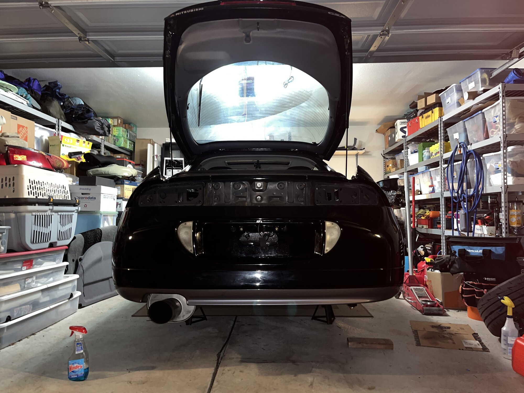

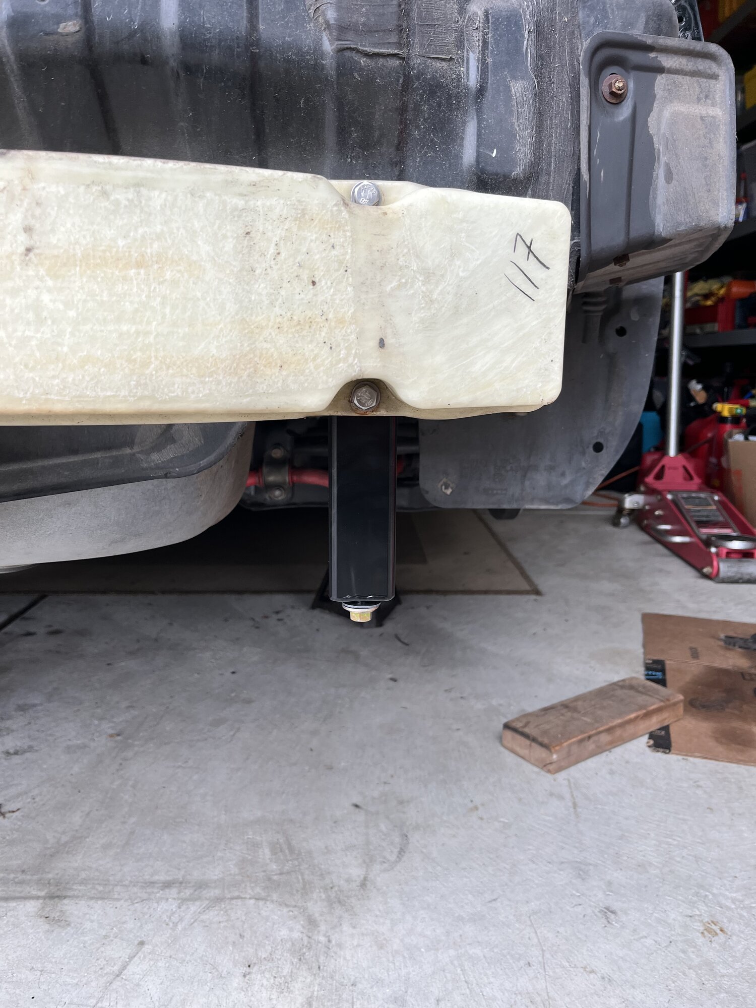

With no bolts in at all the bumper just hangs right where it should.
now all bolts in, hand tight, clips installed, and go back and count to doublecheck

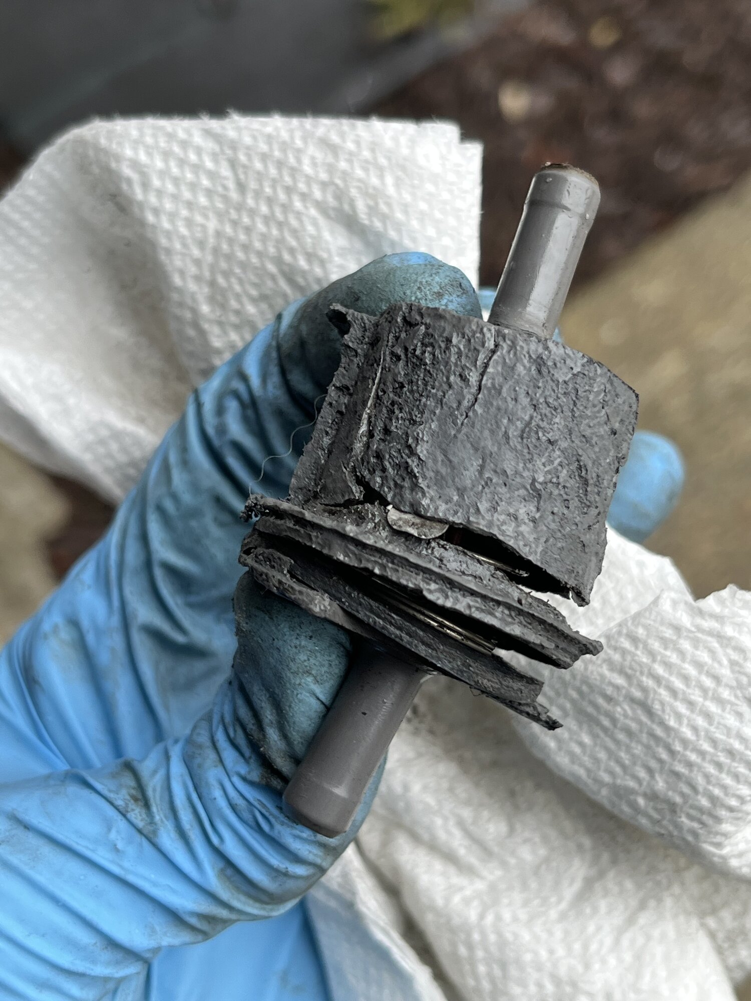

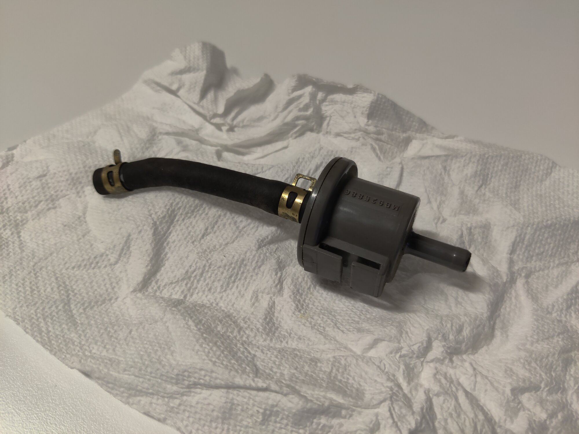

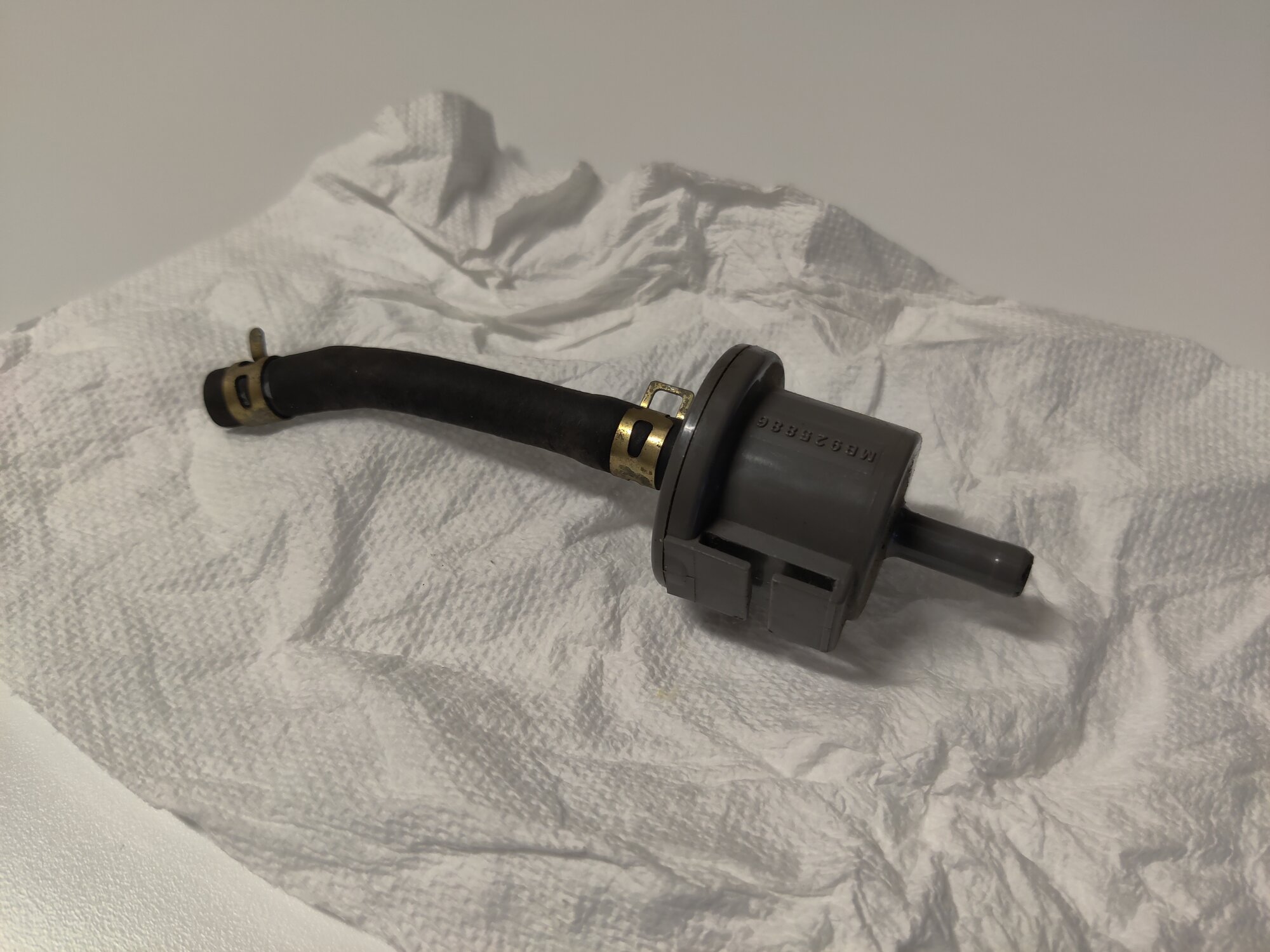

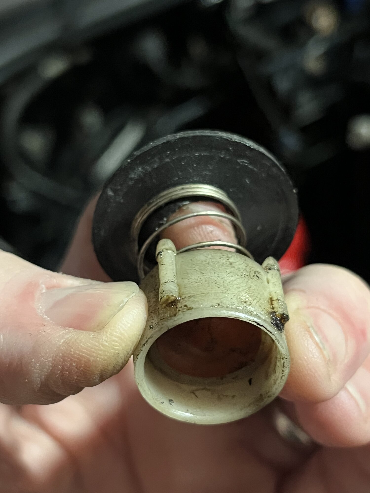

looks like the acid took out some more stuff. anyone got a part number for this? It was hanging on the charcoal canister with a hose, heading toward the rear of the car.
I think it might be this one: MB925886

Thats when I found the dissolved parts of the valve connected to the charcoal canister.

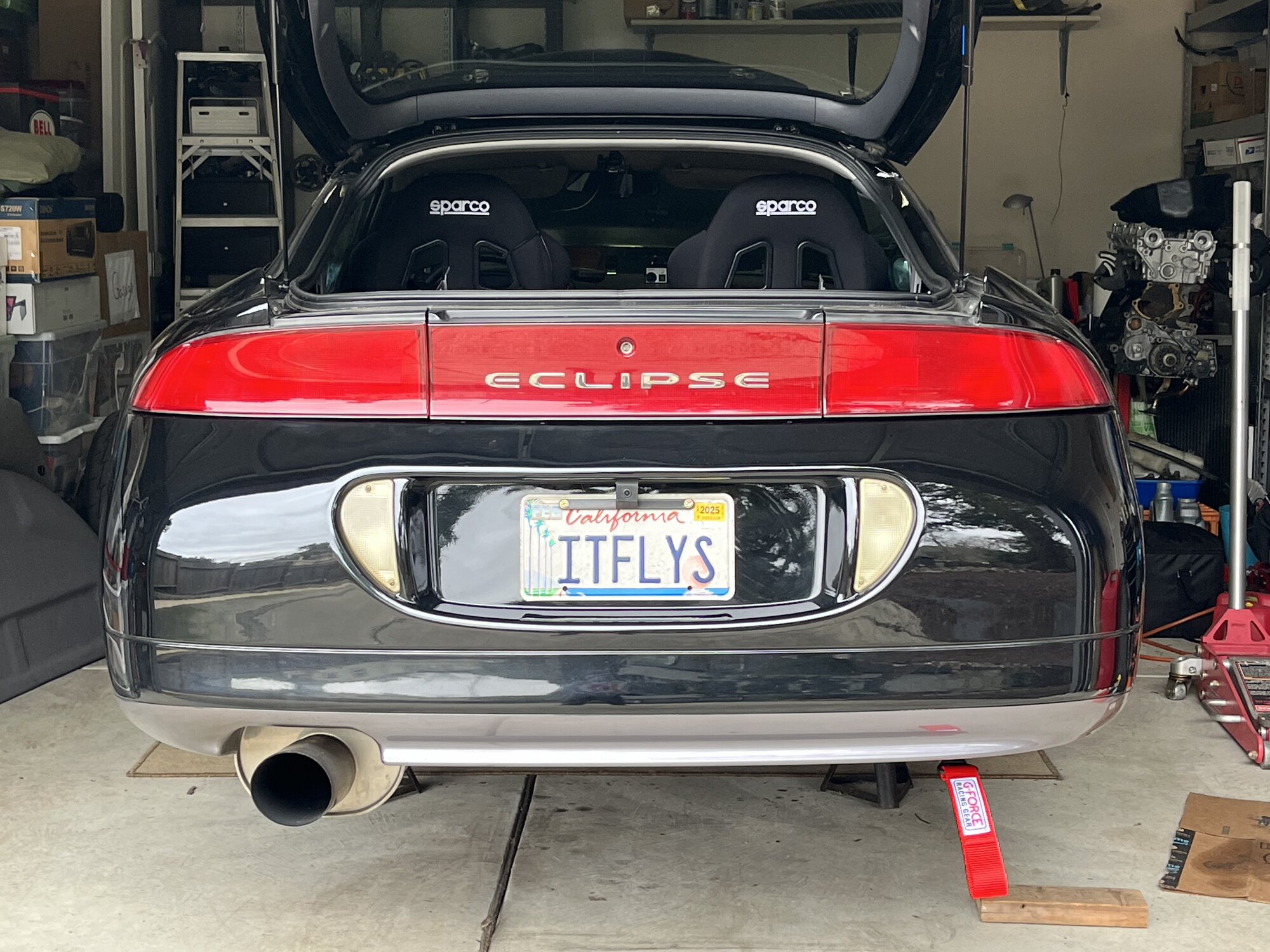

In the back, I made the bolts all tight, and installed the tail lights. i’m gonna wait to mount the camera until I can turn the car back on.

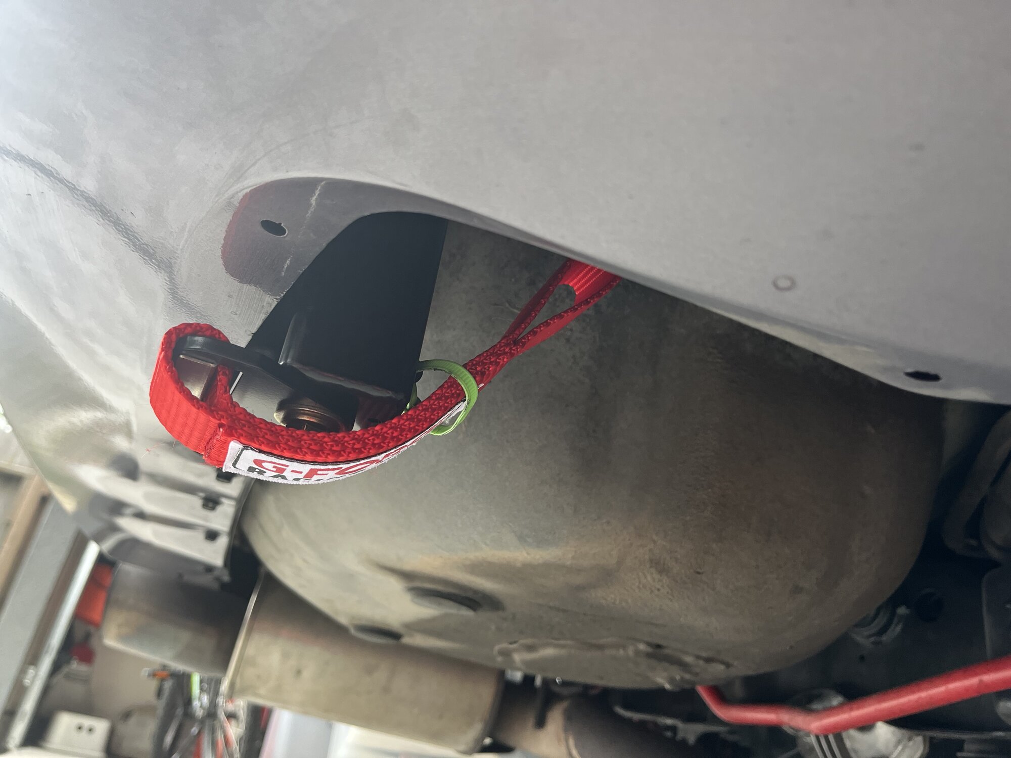

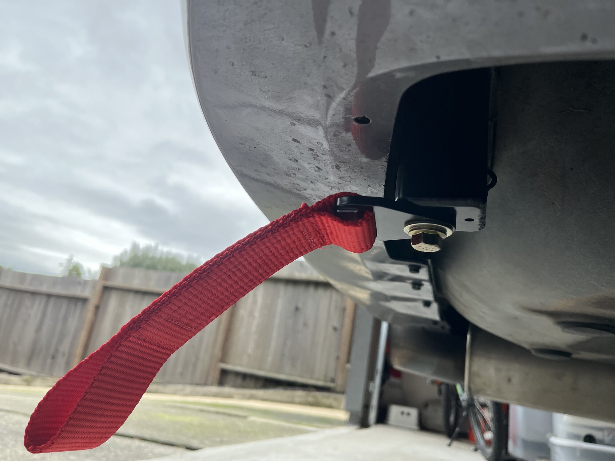

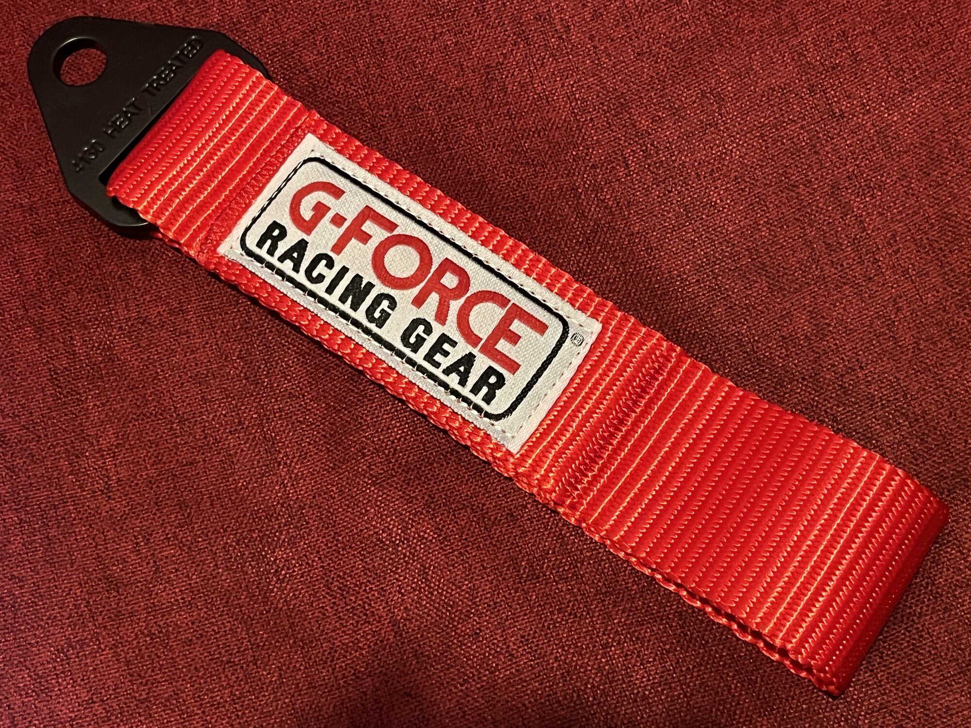

I ordered up a tow loop from Summit Racing with the G-Force logo on it, same make as my driver suit. Its raited for 6000 pounds, and it’s coming from a reputable race shop. Some of the questionable tow loops I’ve seen out there on Amazon and eBay are downright scary. No way you should tie into any strap that has no rating, and 2000lb isnt actually very much - might be ok if you are on flat asphalt, but in a muddy ditch? good luck.

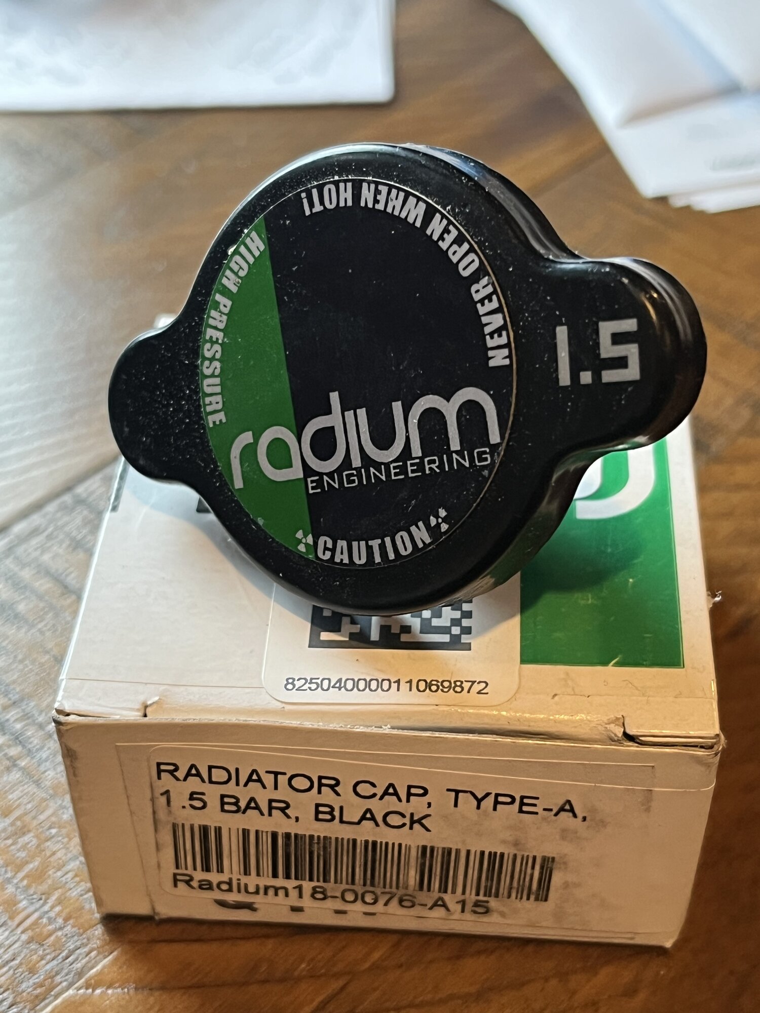

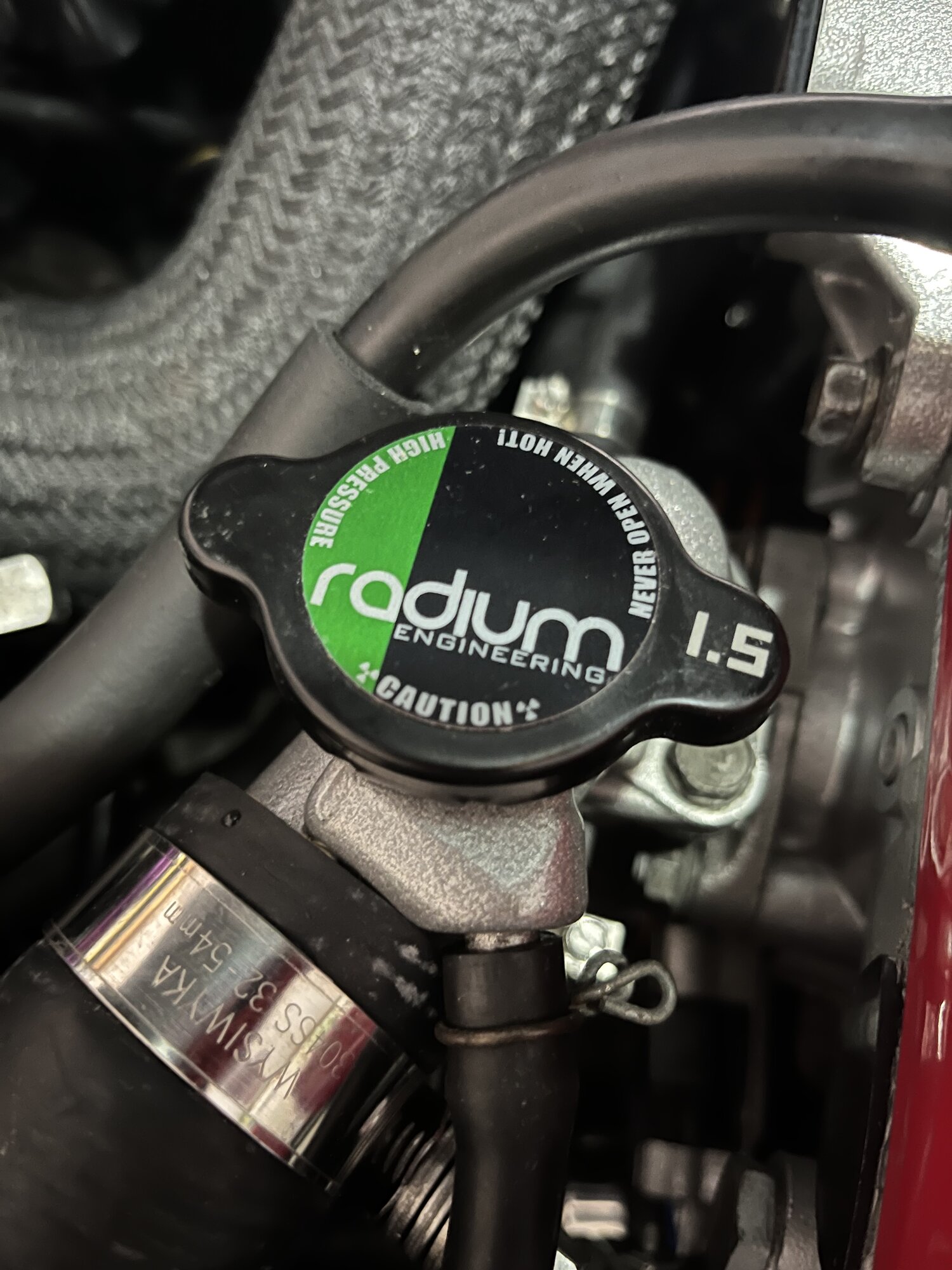

I also ordered a 1.5 bar radium radiator cap. Heat is definitely the Number One limiting factor. I need to invest time in moving some air flow towards hot spots
PM me your info and I'll get it out to you tomorrow. Are you sure you don't need anything else from the EVAP system before I pack this up? If I have it I'll throw it in there as well.
MB920554 - the battery tray lining if you have it?
As far as I can tell, the rest of the charcoal canister and other valves are still intact.
