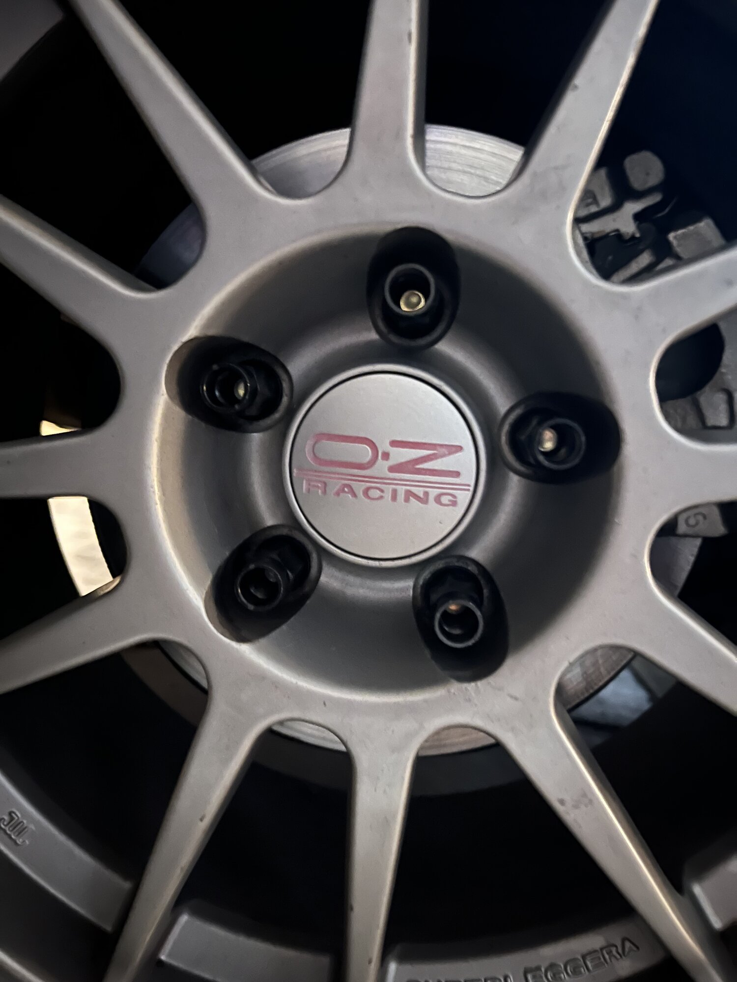

12. Remove and re-pack driver side front axel - grease puked out
13. Thread repair on valve cover - lost a bolt
14. Replace radiator hoses and clamps

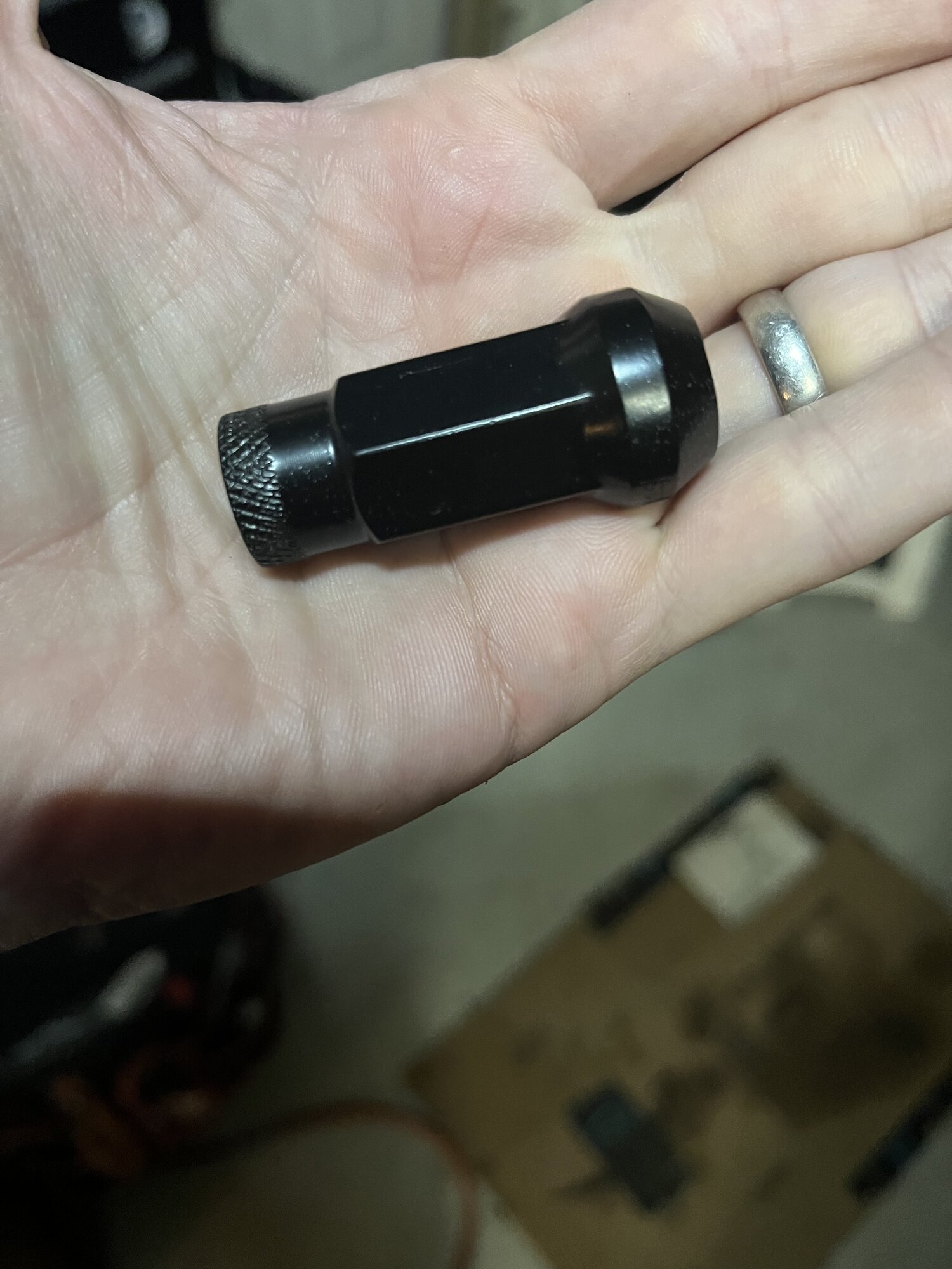

15. Replace large 21mm lug nuts with longer 17mm nuts.

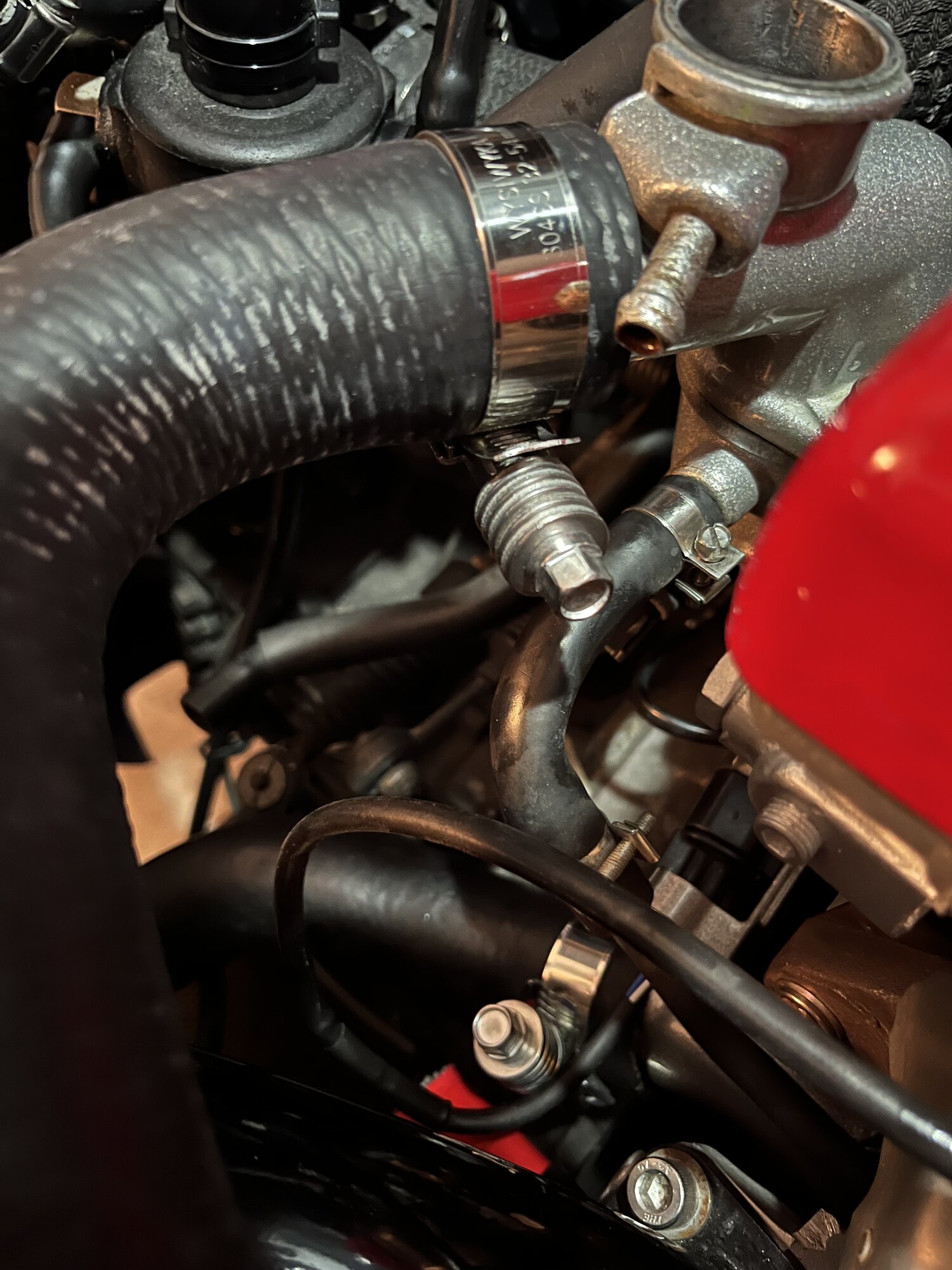

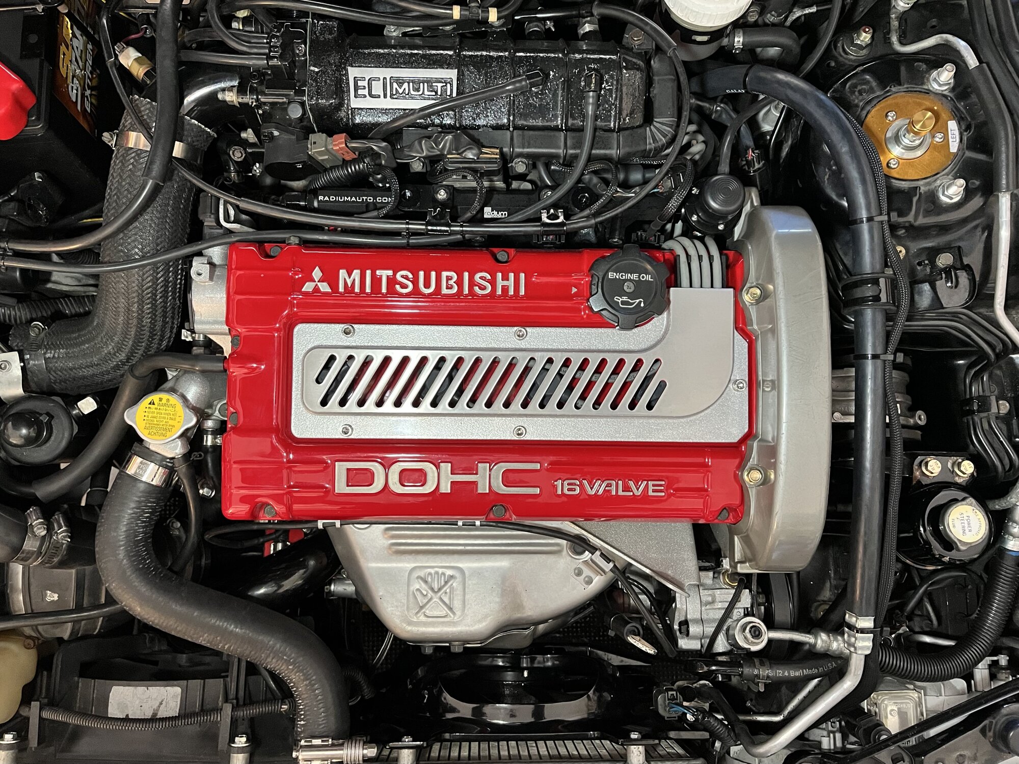

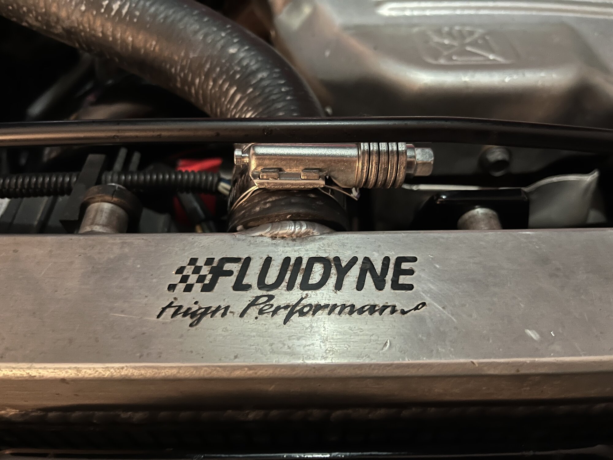

The new clamps and hoses are in place, or I should say, one of the new hoses is in place. The upper gates hose is a great fit - the lower hose is more of a puzzle.
I ordered a 2G upper hose, and a 94 1G lower hose. Unfortunately the lower hose is a bout 1” short. I dunno if that is because I picked a bad match, or if the gates hose is cut short, but I will try the 2G lower part number next.
The clamps are beefy - had to clock them in a convenient spot, and before I put the hood prop down I was concerned for clearance at the top of the radiator, but it turns out there is good room there after all.

May want to look into floating nuts as they lock better and alloy is a no go if racing. They dont generally suggest them. Not sure if these are steel or aluminum.
Bout time you got extended studs also i think 🤘
Heh - yeah I figured I'd look at the axle last. I want to drive with the latest changes first. I think - 13 and then I need to go burn the tank down.

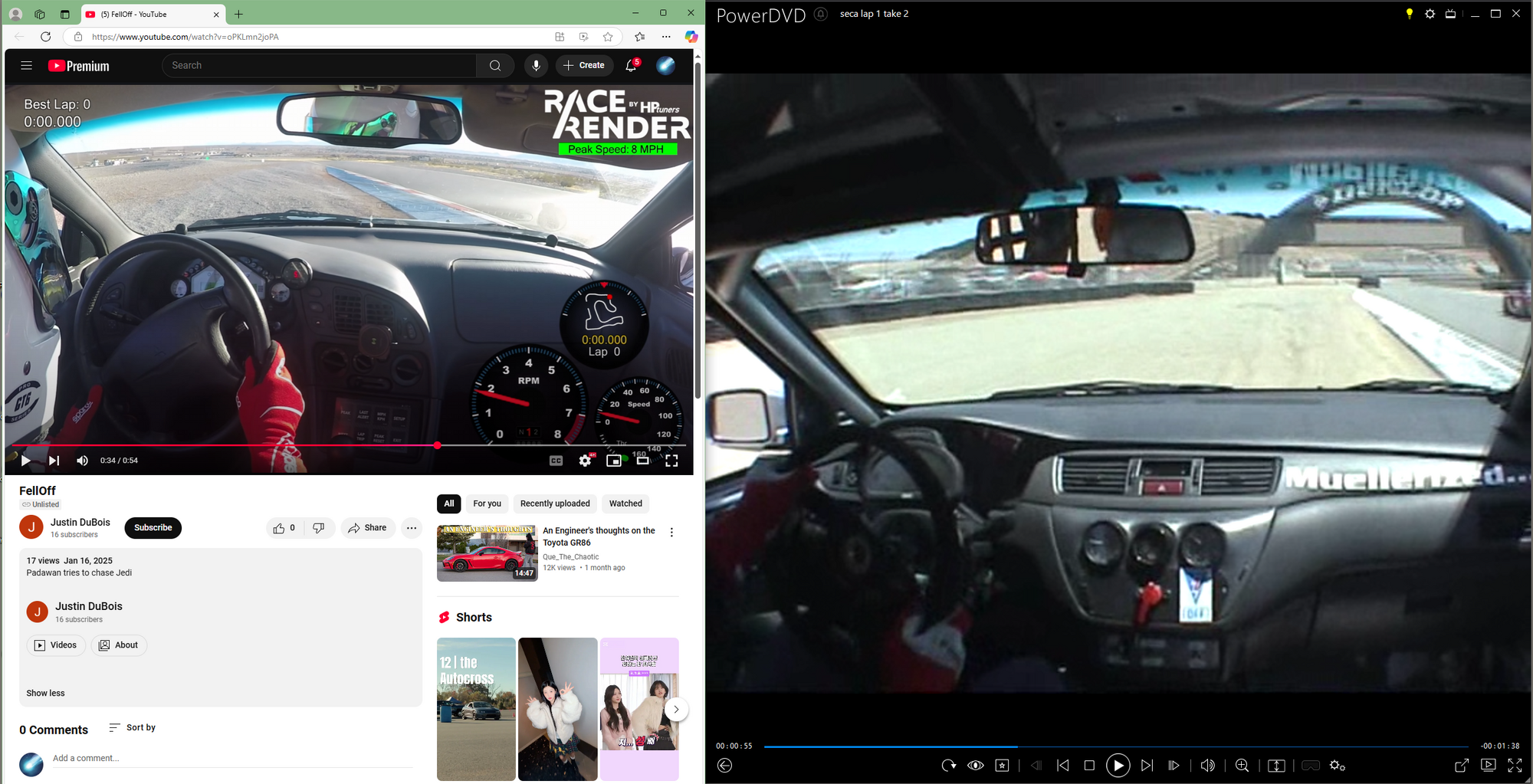

I was going to wait to post this until I had worked out all the data overlay - but this is a fair example of what RaceRender can do combining two data files and a mp4.
Context: It's the end of the 2nd day, Last session. Kept it on track the whole time. With new found confidence, I get the bright idea to try and chase down a Jedi Master. I had them hold me on pit lane and time my outlap to join John at turn 2. I didn't know it, but he was on a flying lap - and - well, I did this:
Bad driving...

There is only one track in the US with a Dunlop bridge, and that is Mueller sacred ground. When is this shot from?
Yeah the Dunlop bridge!
I don't know when it was shot but the file I have on my computer has a Date Modified of 9-24-2005.
I rediscovered this on my computer when I was looking for video files that would play on my ancient WinXP laptop.
These old .wmv files were about it.
I've never uploaded a .wmv to YouTube so I gave it a shot. Here it is. The file is 640 x 480 and that's how it is in YouTube so if it comes up in 144 or some such thing, set it to 480p. I think the name "seca lap 1 take 2" is the name he put on it.

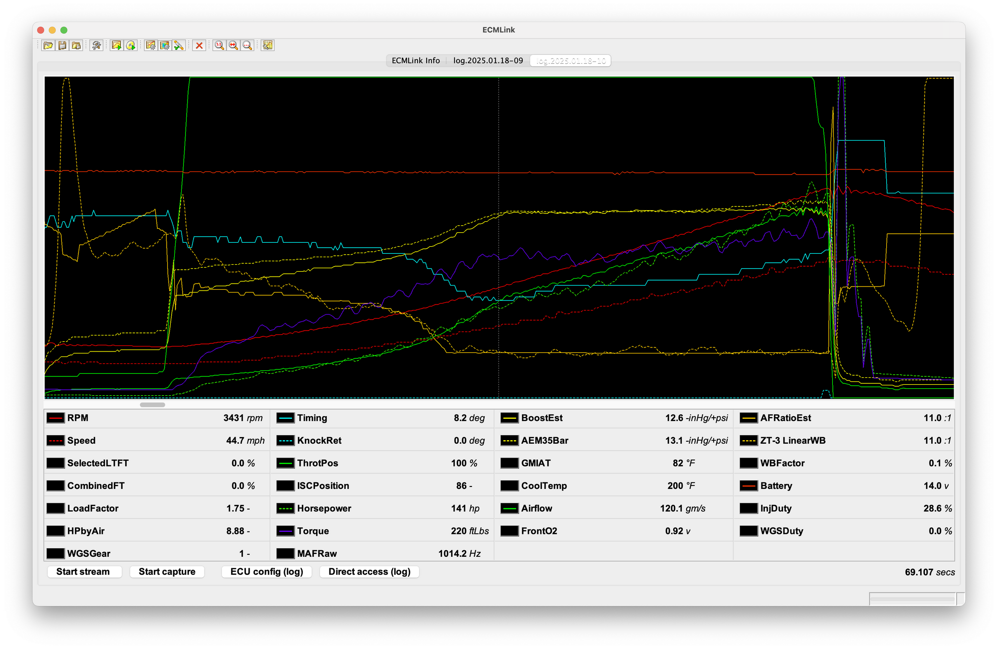

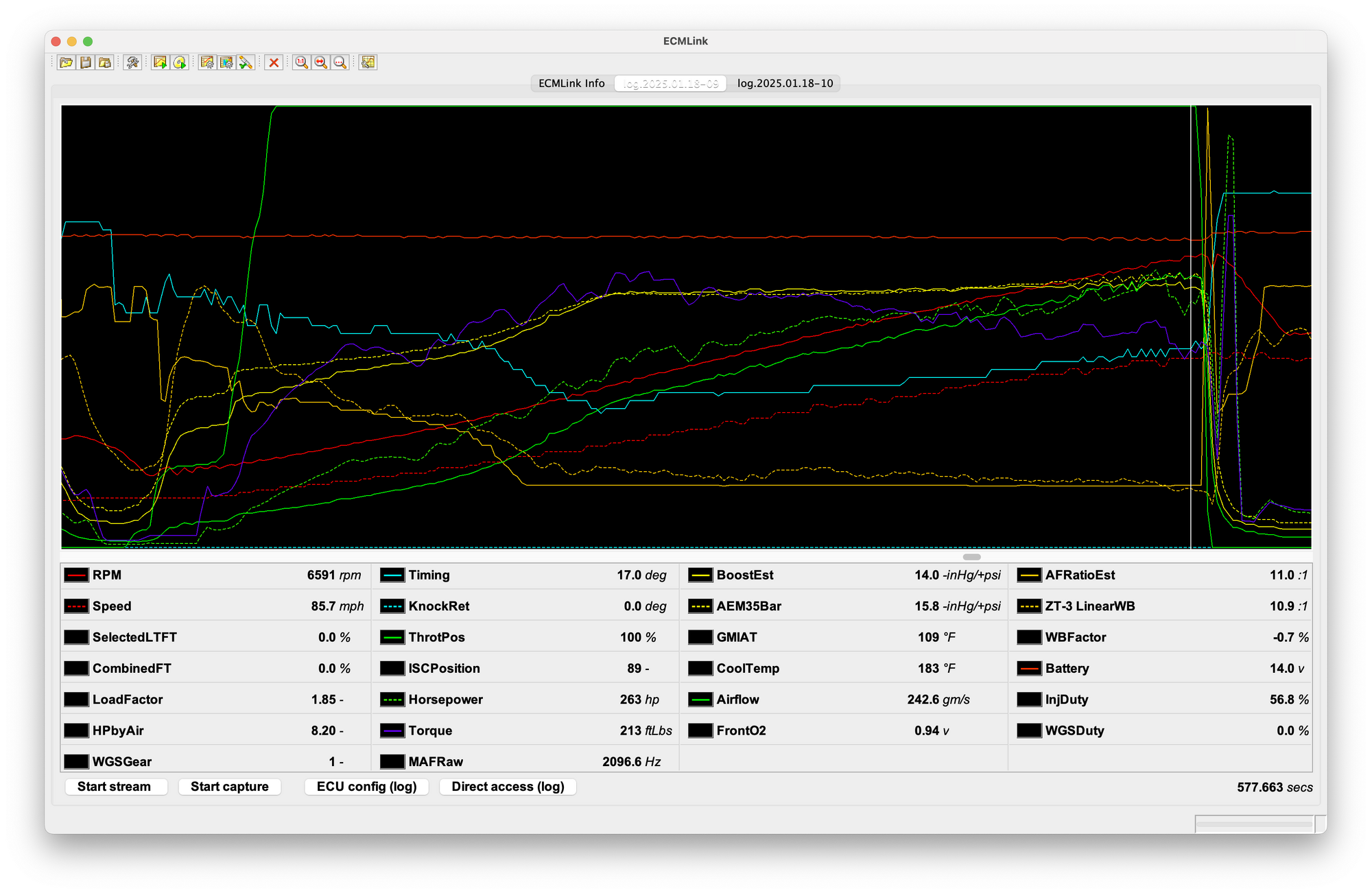

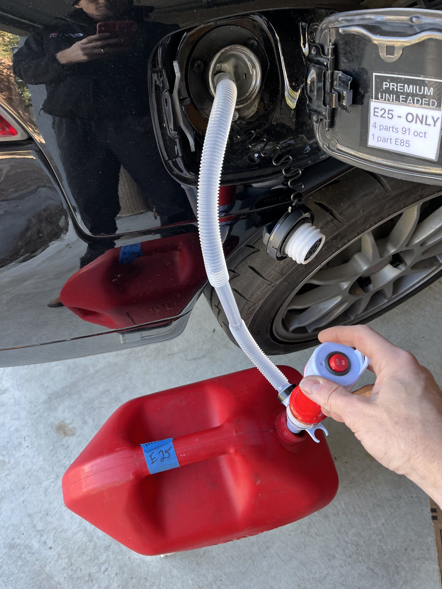

Burning Gas - This is the lean global fuel result today, I did not change it since the track event:
-43.8 Global Fuel ( 70.8 WGSDuty = 20psi )

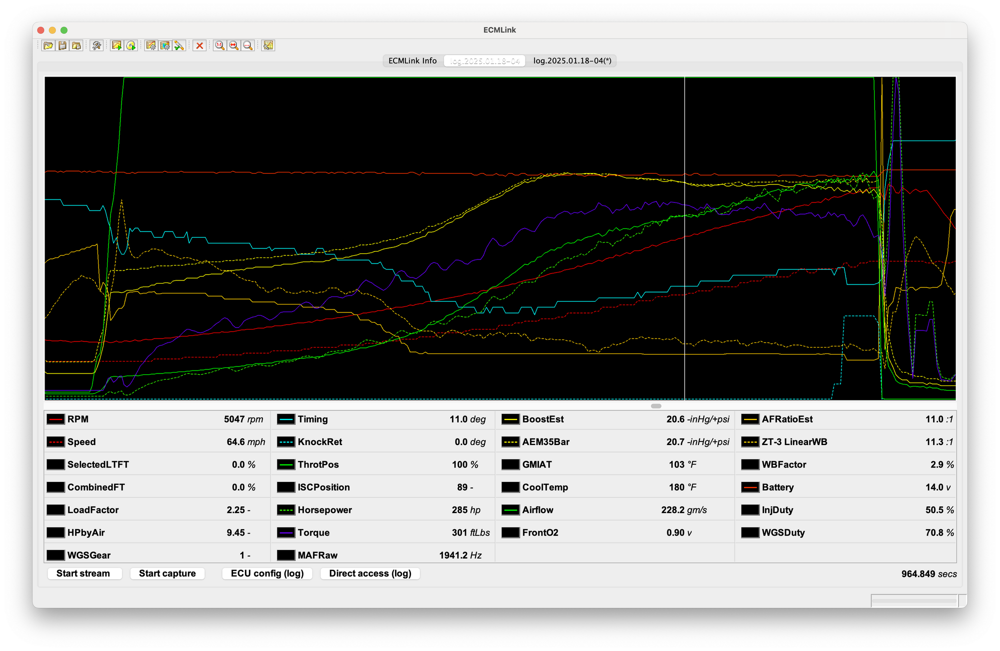

The base fuel pressure without the vac line on the regulator was at 43 where I left it, so It's time to change the global fuel value.
-41.0 Global Fuel ( 0% WGSDuty = 14psi )
-40.2 Global Fuel - ( 0% WGSDuty = 14psi )
1.5 Bar WG spring is working well. I wonder if it will go more max boost now?
It's sure tracking well!

If you still have some trace of e85 in your tank and you're slowly working it out you will be chasing the global % until it is all gone. If you ever do go full e85 via 'pump' (idk what you have access to), I have had to make a global change of up to 5% between actual e85 and the winter blend of e70. I guess if your fuel isn't stable your global % won't be stable.
That aside I don't see any issue of a stiffer wg spring and/or boost control. Give it full beans.

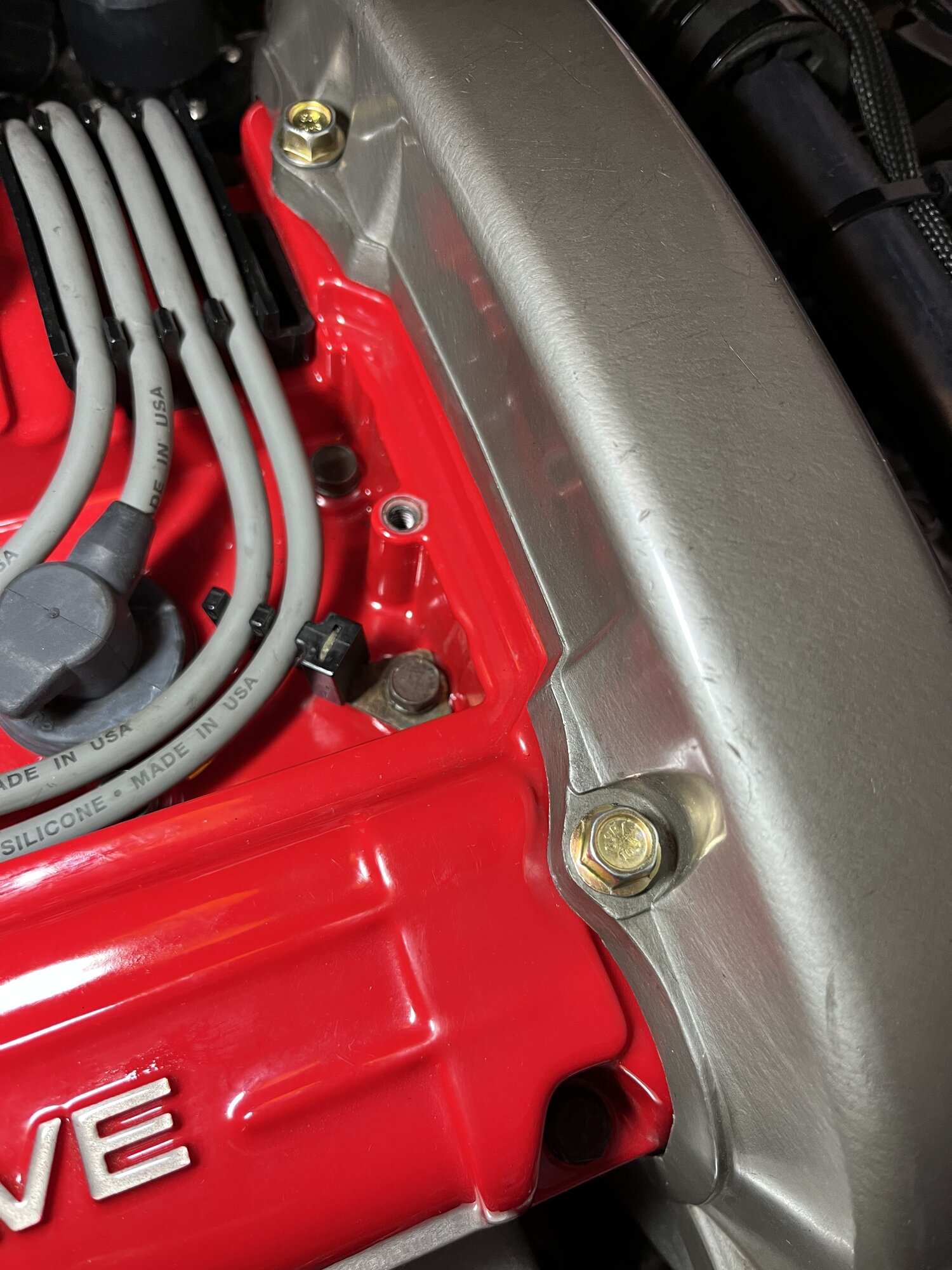

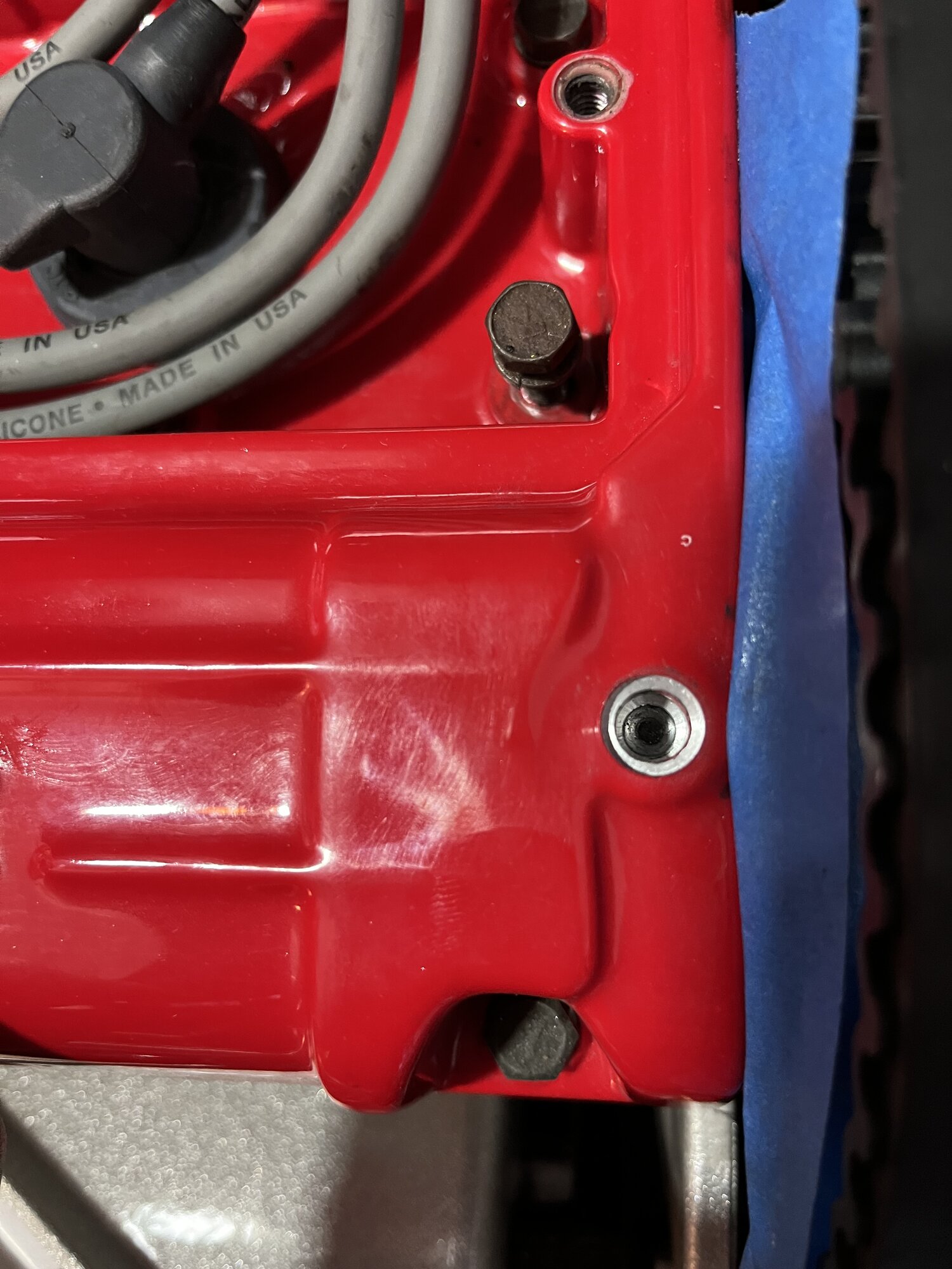

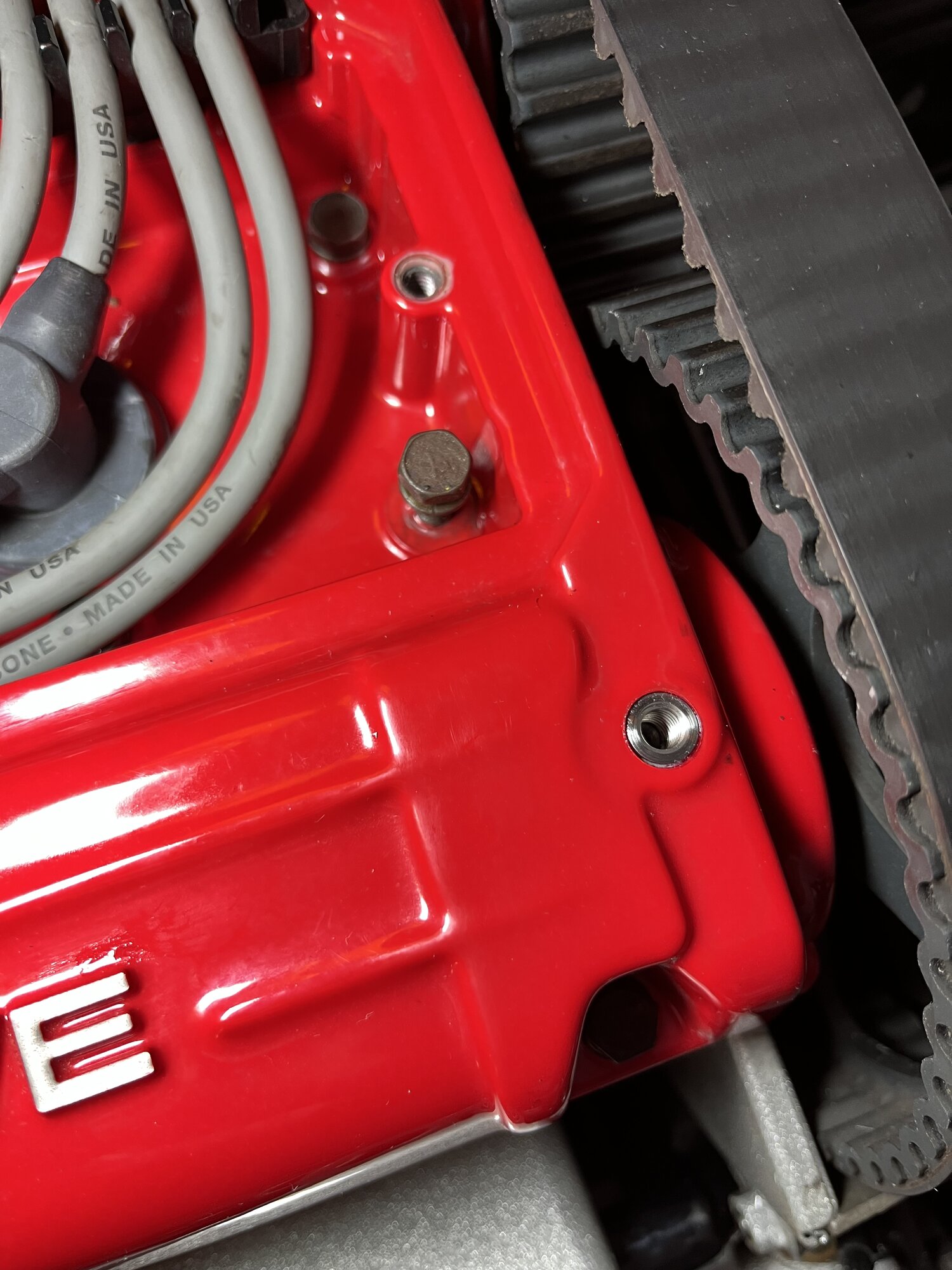

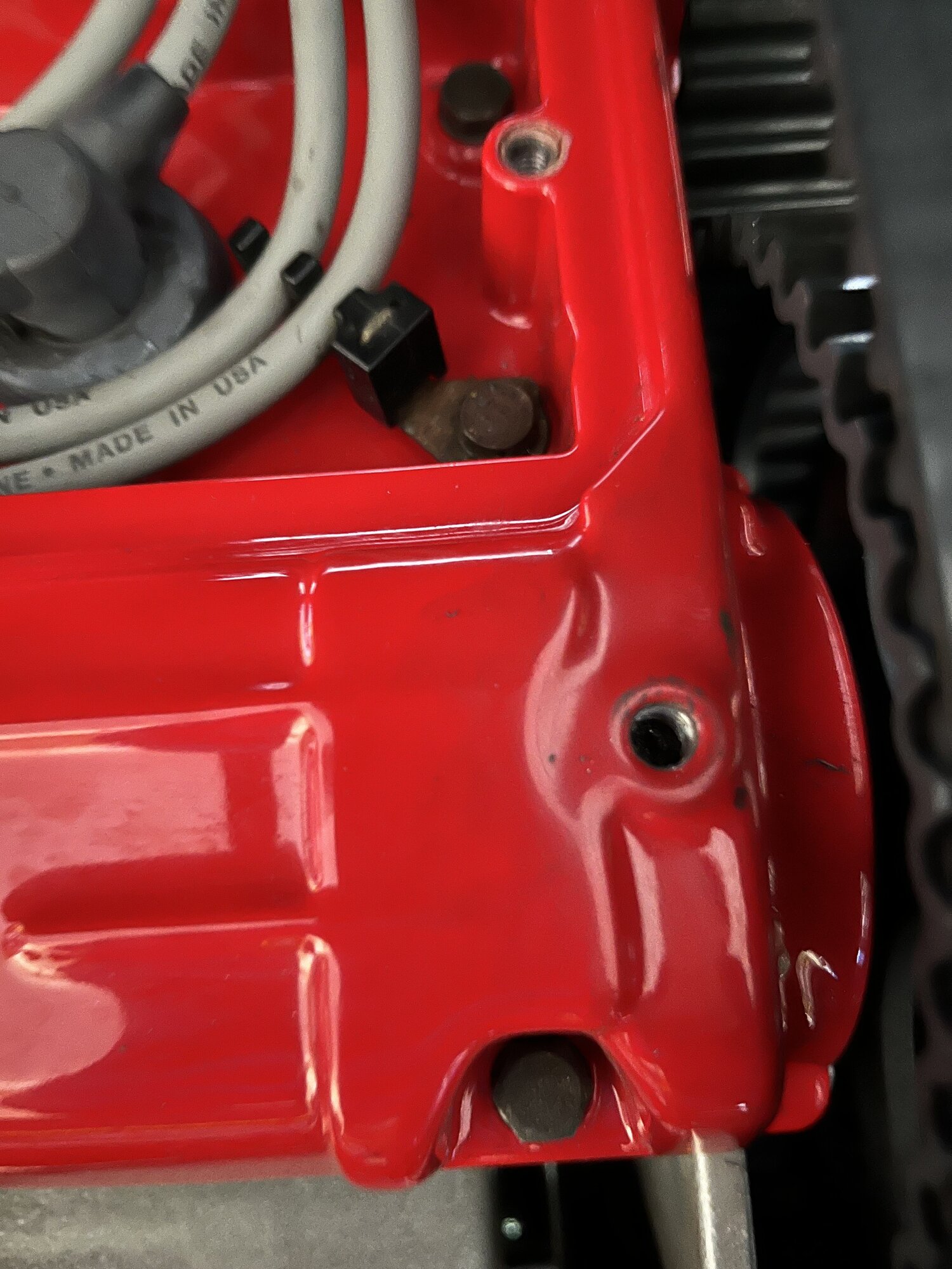

Oh, Thread repair:
stripped
drilled, and beveled
tapped and insert installed with red loctite
New m6x1.0 20mm bolts
