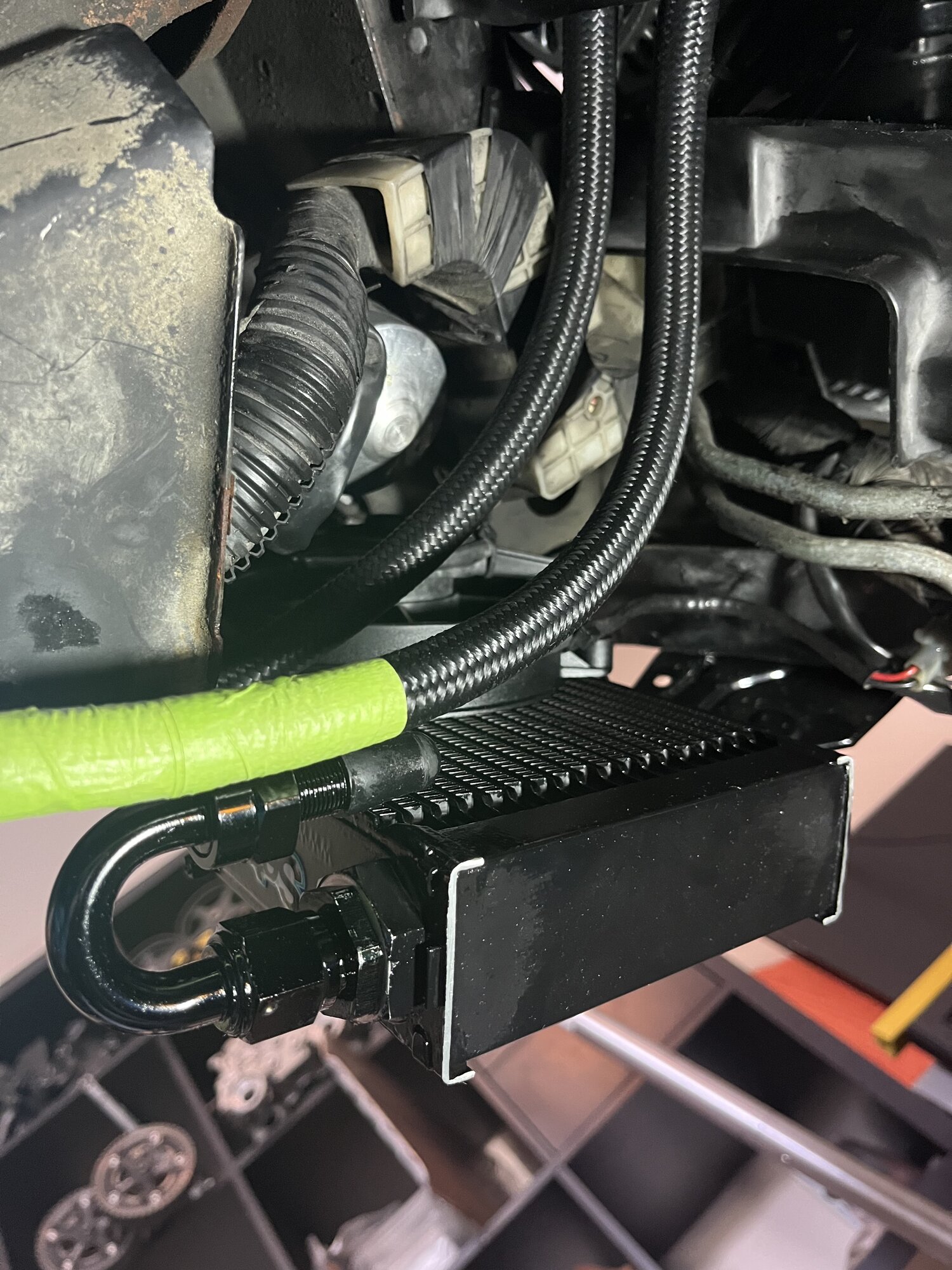

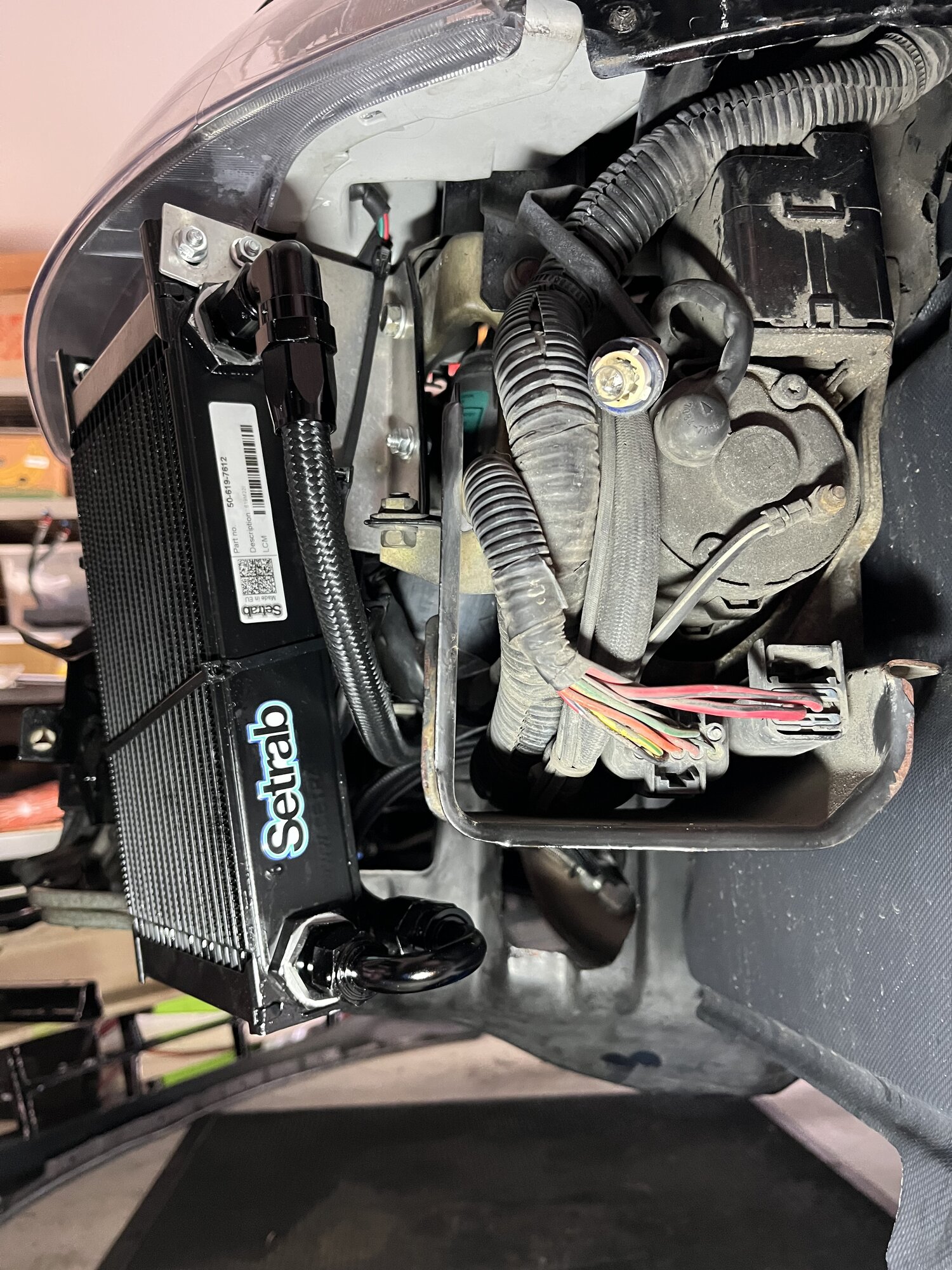

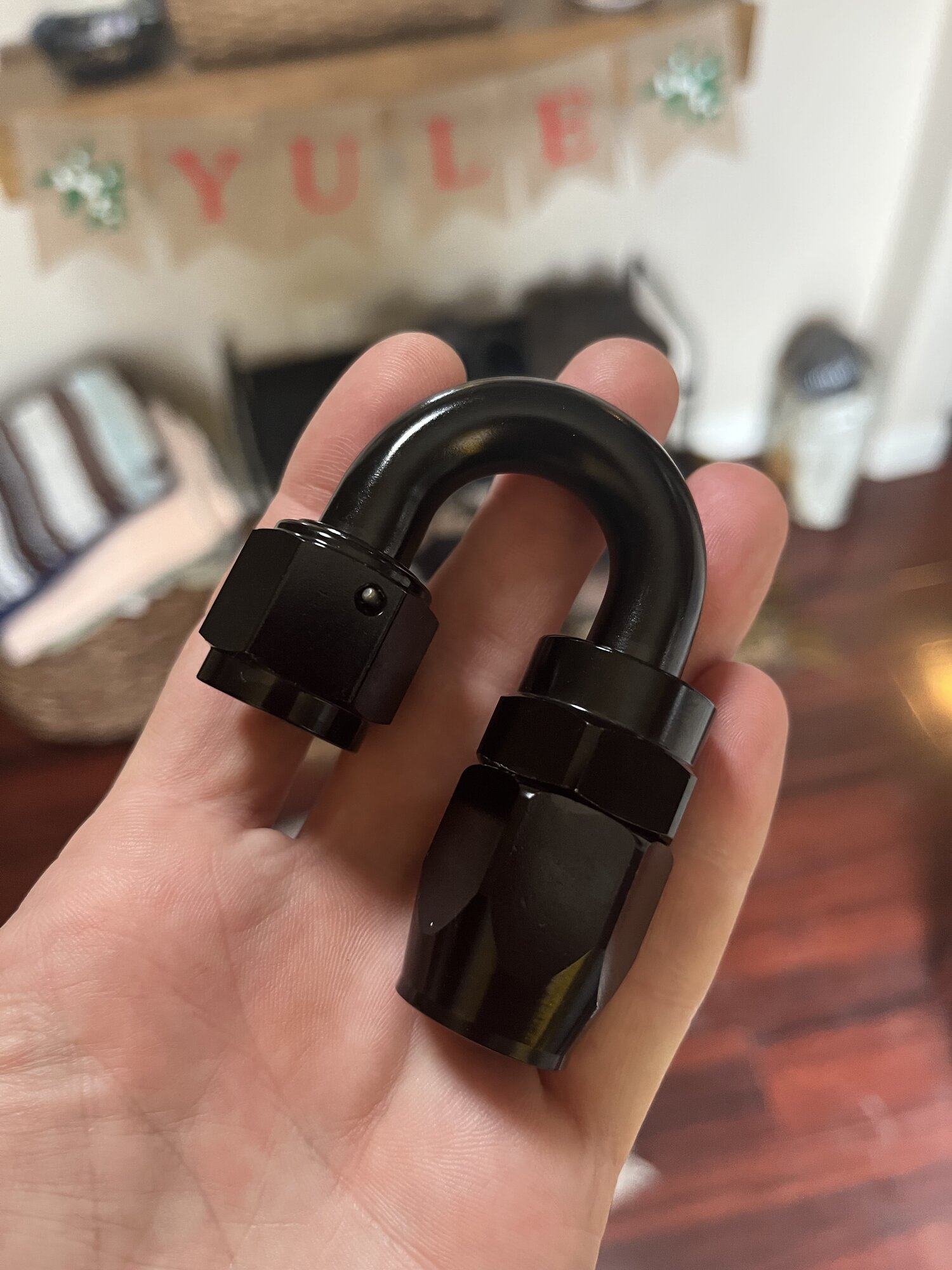

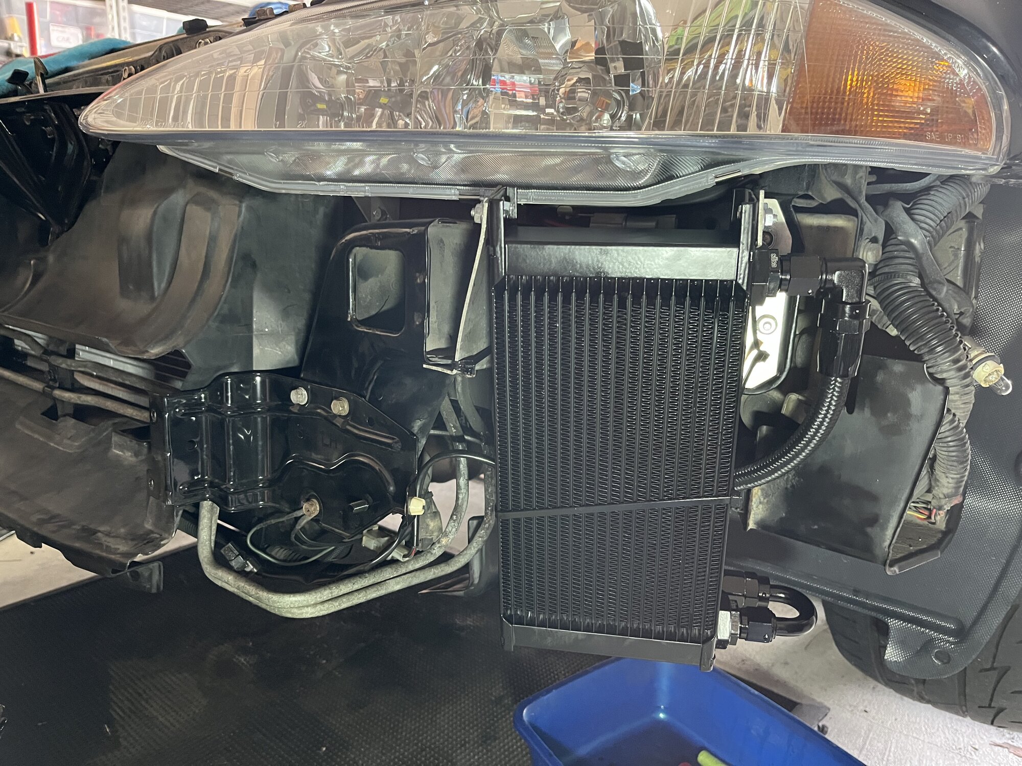

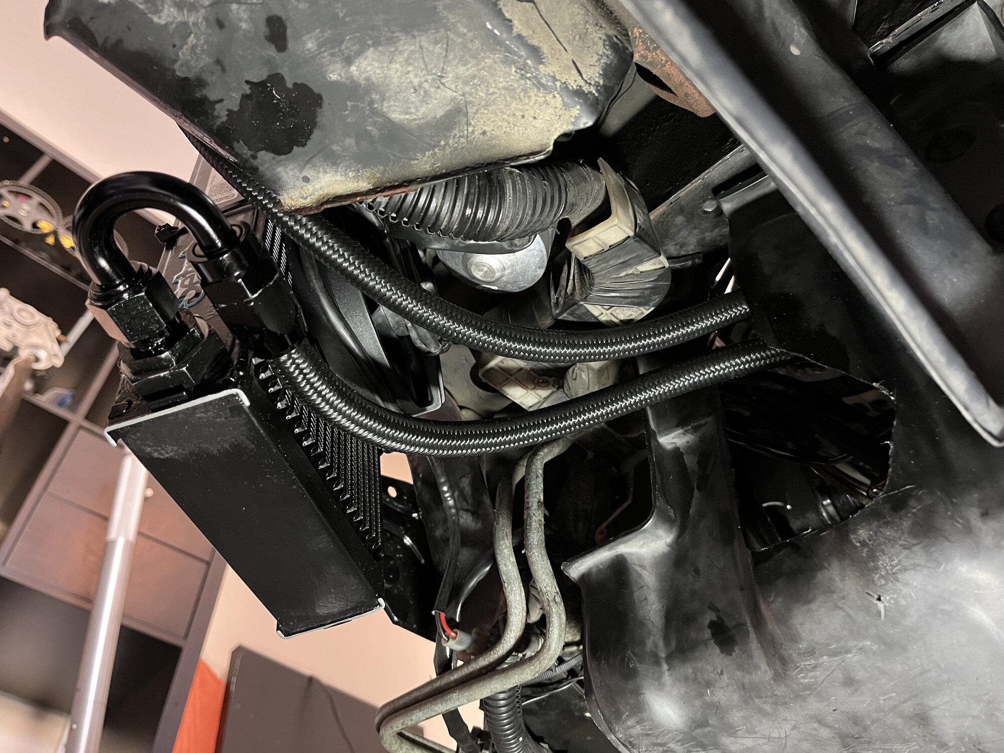

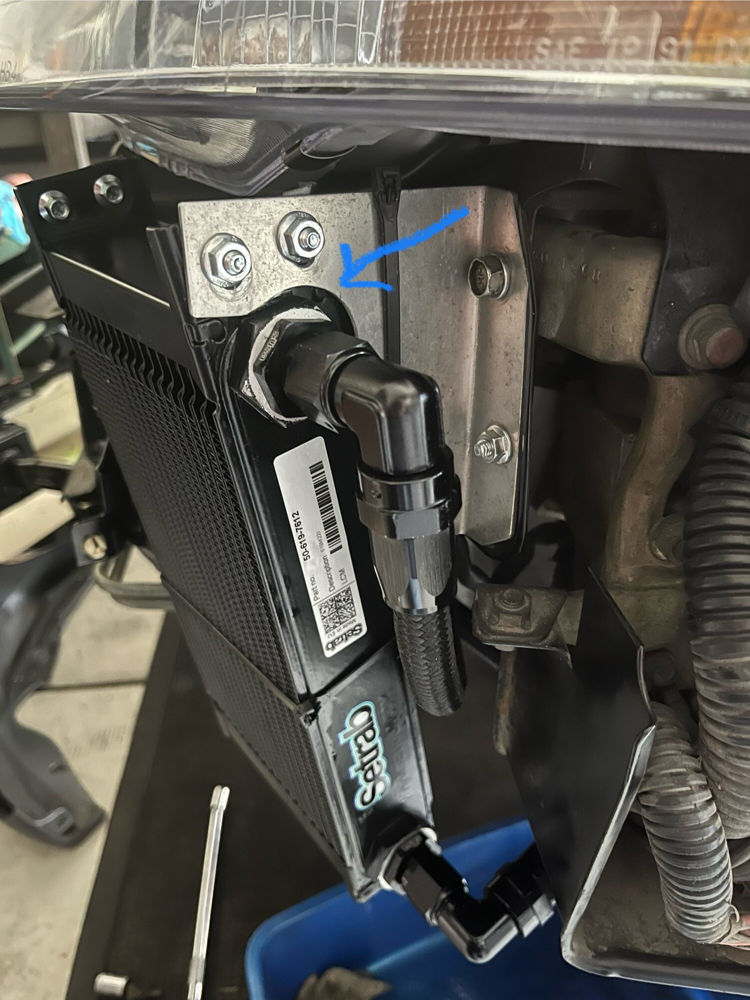

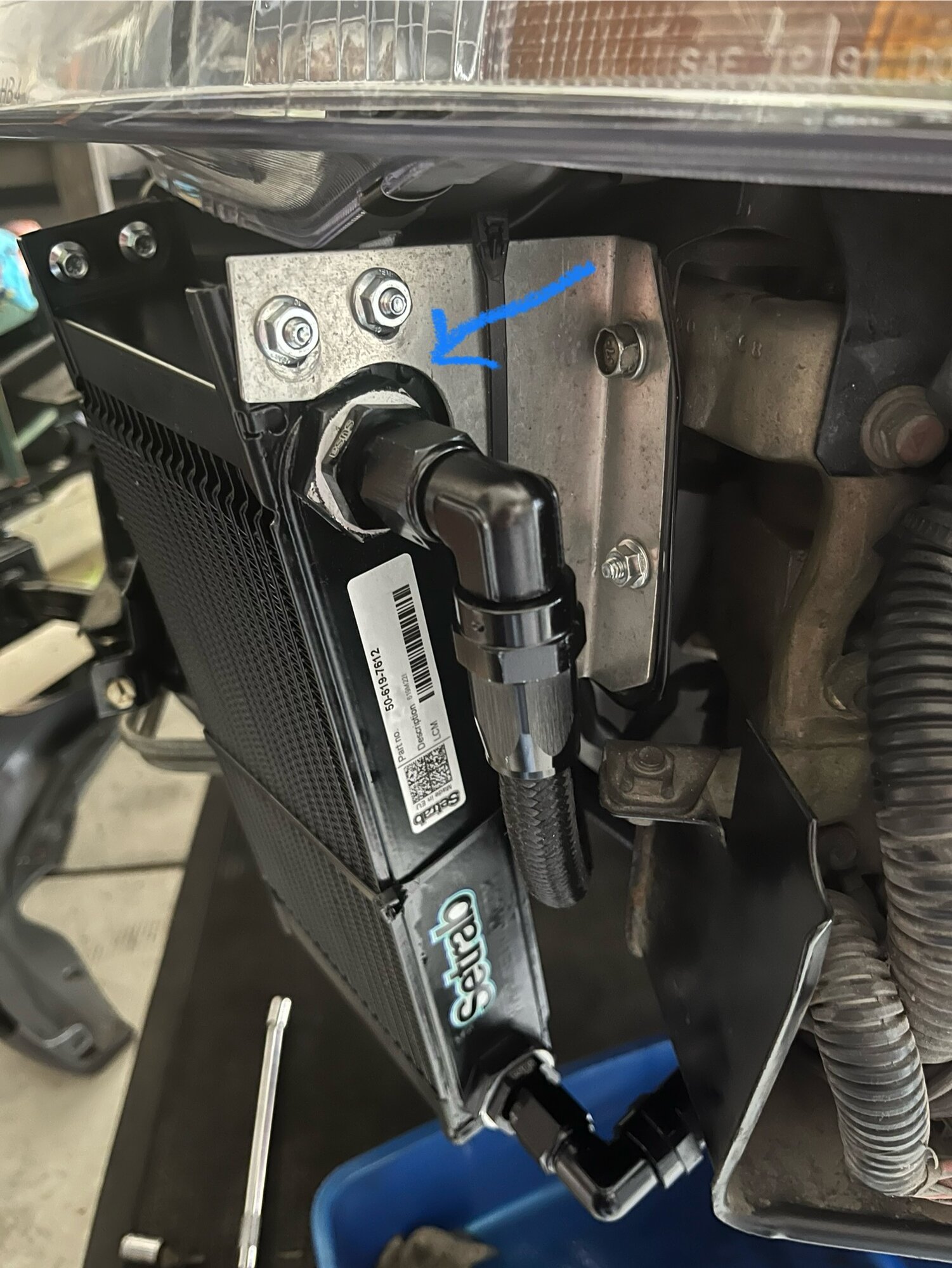

Final prep for a 7.5hr road trip from Oakland to Spring Mountain motor sports ranch in Nevada. I removed the front bumper again, and improved the oil cooler clearance with some bracket modifications. Now the hose on the lower port is too long for the routing. I ordered a 180 deg 8AN hose end to make it work best. Hope it does not get here too late in the day. I really need to check the reliability on the hose before the freeway.

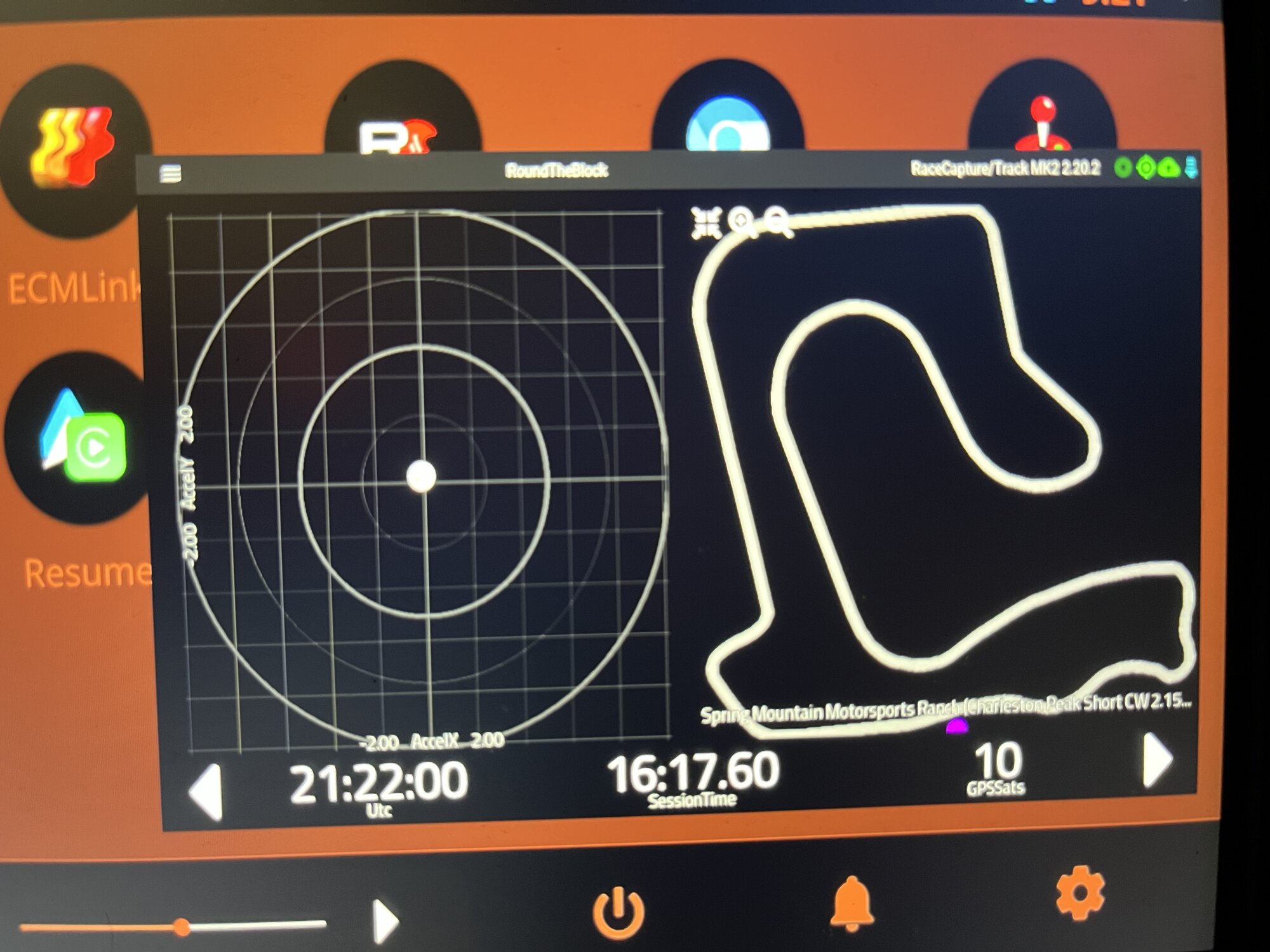

Well what do you know - If you follow their directions you can draw a track in google mymaps and upload the exported file to Podium/RaceCapture

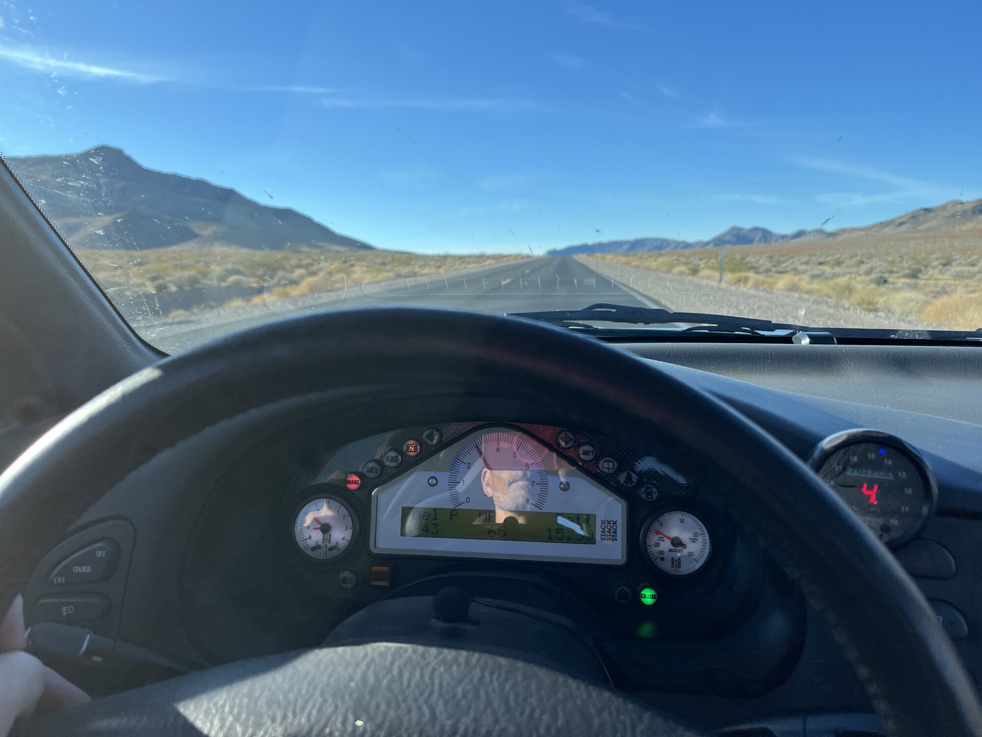

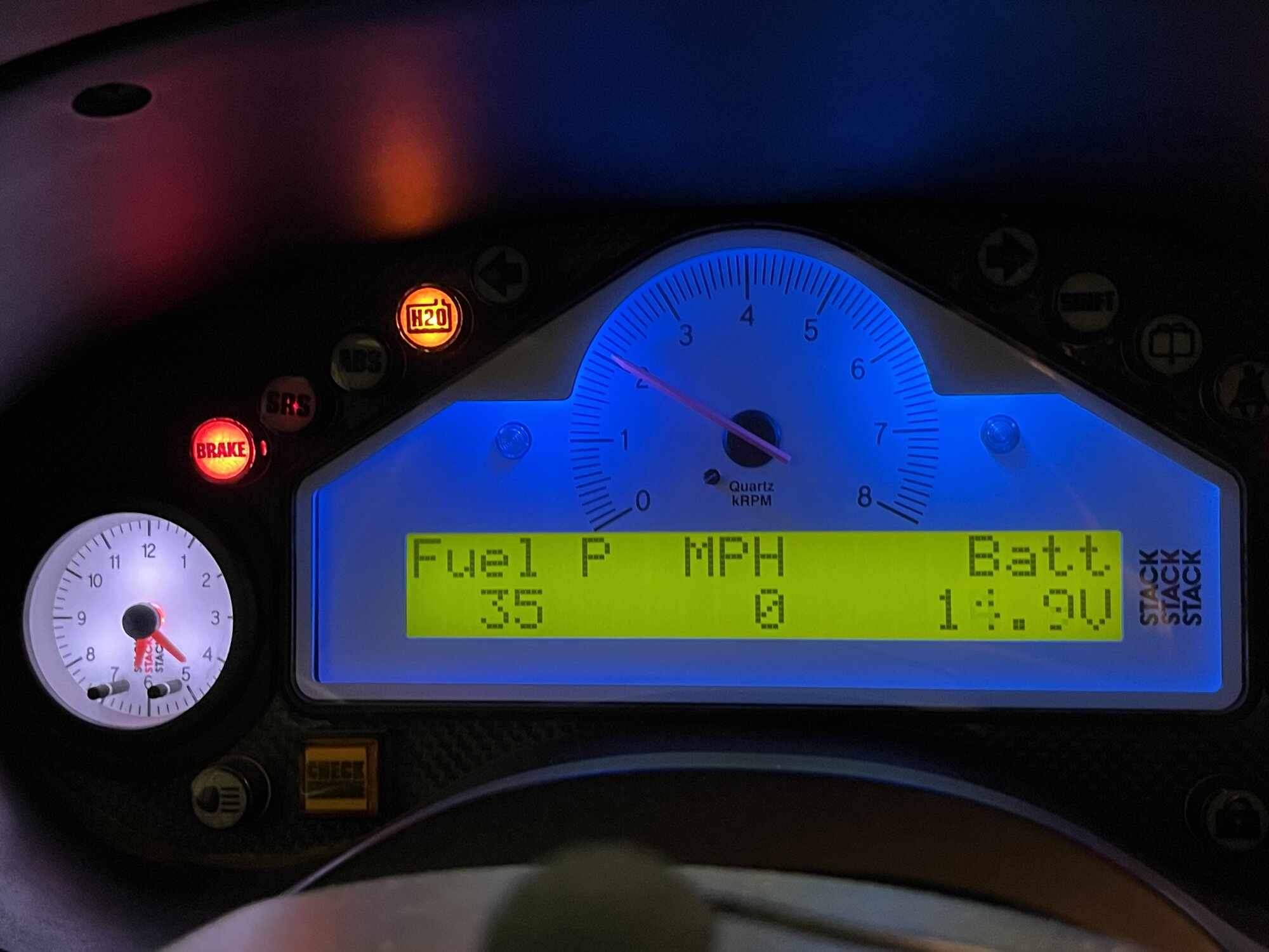

Hey - what dies this mean - 15.1 v and my hand brake and coolant bottle light are flickering and on now constant. I think this is a voltage regulator issue?
I think this is the normal sign of alt regulator issues and basically your alt is now bad. I forget which 2 come one as its been years since mine went bad.
I think its brake and oil pressure light. But your dash maybe wired slightly differently for the water to come on. But thats where I would start with that voltage. What revs do you normally go to and volts do you see at those revs?
14.5v is what I see mostly, dips a bit under higher rpm i assume from higher spark and coil loads, but who knows. When hot maybe 13.5v, and as low as 11v under cranking load.
So - 15.1 is new

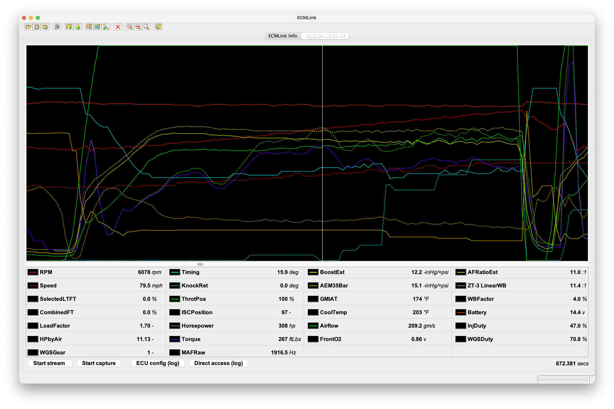

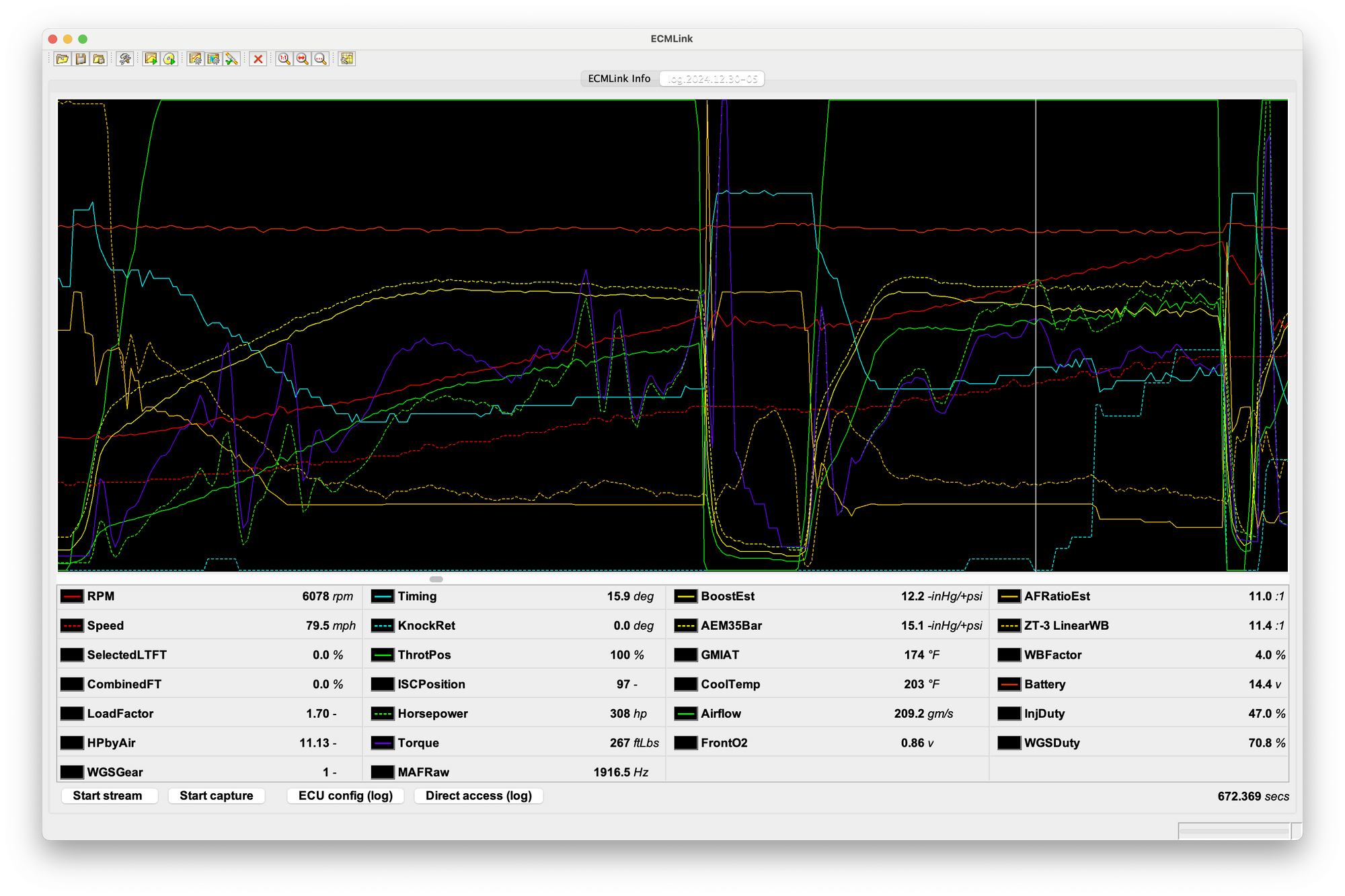

Initial looks:
Engine performance - Data from a track day is gold - I can see at temp if the tune is holding. As far as proofing the big changes on the engine - Head swap success, Turbo swap success, Fiber Head Gasket is holding - Injectors and fuel regulator performing well. Oil catch can had a oz or two of liquid - so the rings seem to be holding up - I can check compression to confirm.
Boost: 15psi.
For this event I set a 70% duty cycle on the WGA solenoid, and that resulted in 15psi of boost all the way to redline. With the 1.0 BAR spring in the new WGA, minimum boost at 0% duty cycle, I got 10psi. and 100% duty cycle got 21-23psi. Good to know reference points for the future..
Knock/Fuel:
There is a lot of knock over 6K, AFR alignment to target is 11.4 vs 11.0, but the kicker is the intake temps - 174deg, and this was on a day where the ambient temps were in the 60's.
I'm glad I de-tuned the boost to 15psi for this shakedown. 300hp was plenty enough to be getting on with. There was way more to learn on track than how much HP I could get out of the engine.
Control of the fuel mix was more difficult. E-85 was mixed with pump gas from multiple sources, with octain from 91-94. This probably explains some of the global offset between AFRatioEst, the ZT-3 Wideband. Thankfully the knock sensor did its job and the engine held. I'll look at how to pull air from colder sources, and see if there is anything I can do to improve the IC efficiency. Right away, some ducting would help.

Based on the examples you guys found on this forum, is seems like 15.1-15.3 is what you get when the voltage regulator can't measure itself! I believe there is a breakdown in the voltage monitoring signal (one of the pins) on the alternator - so I'm getting max charging output. Not the end of the world for a track session, but the battery might get pissed off if it is being overcharged in time. I'll swap in the spare 75amp alternator I picked up in Pahrump, and that will tell me if its a regulator or wiring harness issue.
This log was kinda fun to look at. Thanks for posting it.
I don't know myself if full-on E85 will get rid of the knock when IATs are that high.
Will be looking forward to seeing your data after getting the fuel switched over!
Wouldn’t that be nice if it did eliminate the knock? The switch to E85 is coming 10 years behind my kin. It makes even more sense for economic and fuel management convenience, as well as a path to more overall power. I just need to commit.

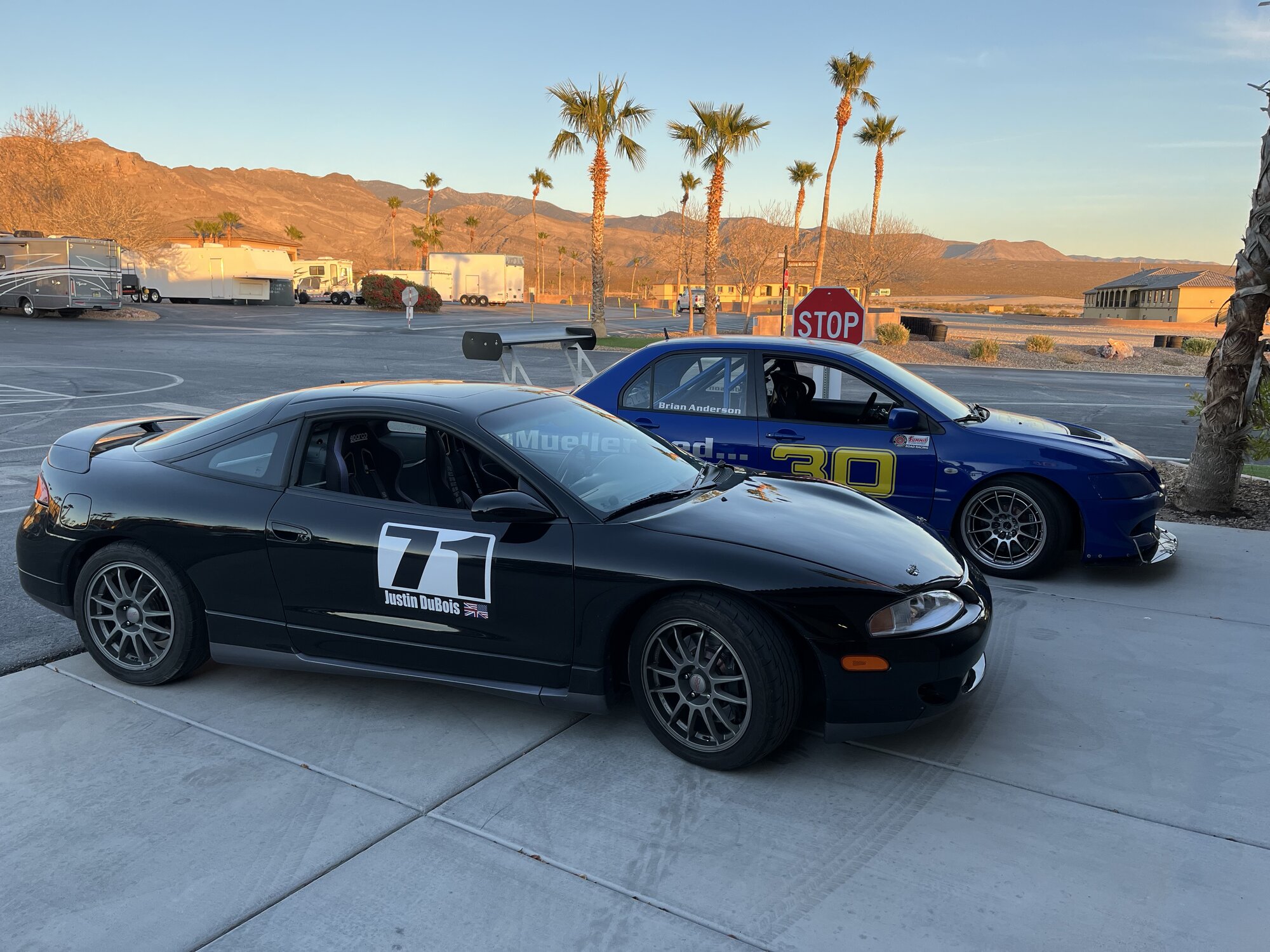

Here are a couple shots from my phone - I’m gonna start processing some clips, and see if I can add telemetry data with the ecu data and render the clips with overlay.
For now -
John has a blue 2003 Evo behind the eclipse

That datalog is pornography.
You are 'tuned' lean. If you gave your AFPR a fat turn clockwise you'd be doing so much better overall.
Thank you for looking - I’m glad it has use
I had extra E85 in the mix (not adjusted for) at a higher altitude, at a monster high intake temp - more fuel would have helped. If the base FP is still correct, I’ll make the change with Global, or IAT enrichment or somthing… I need to look at the new cold fuel trims.
