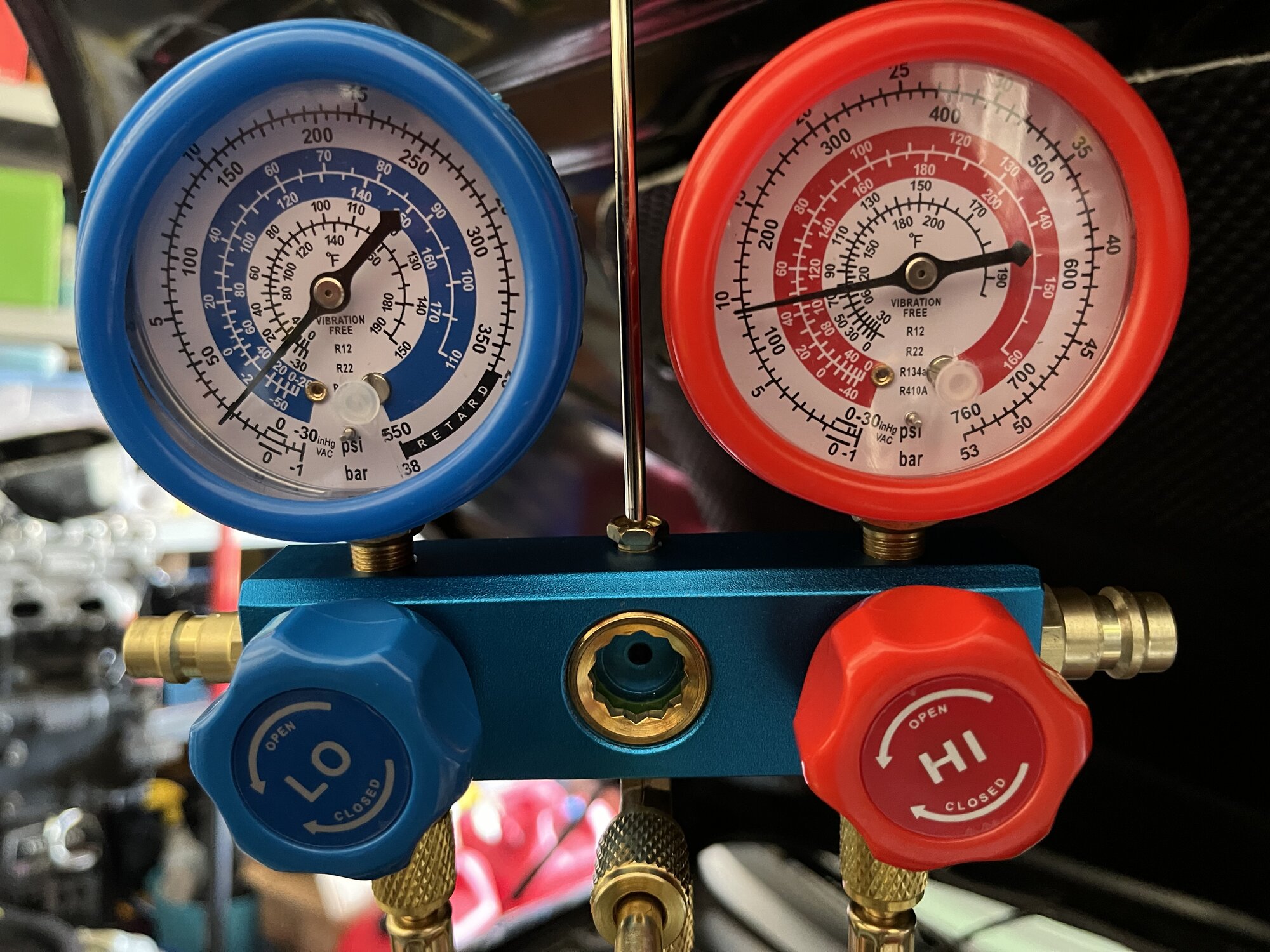

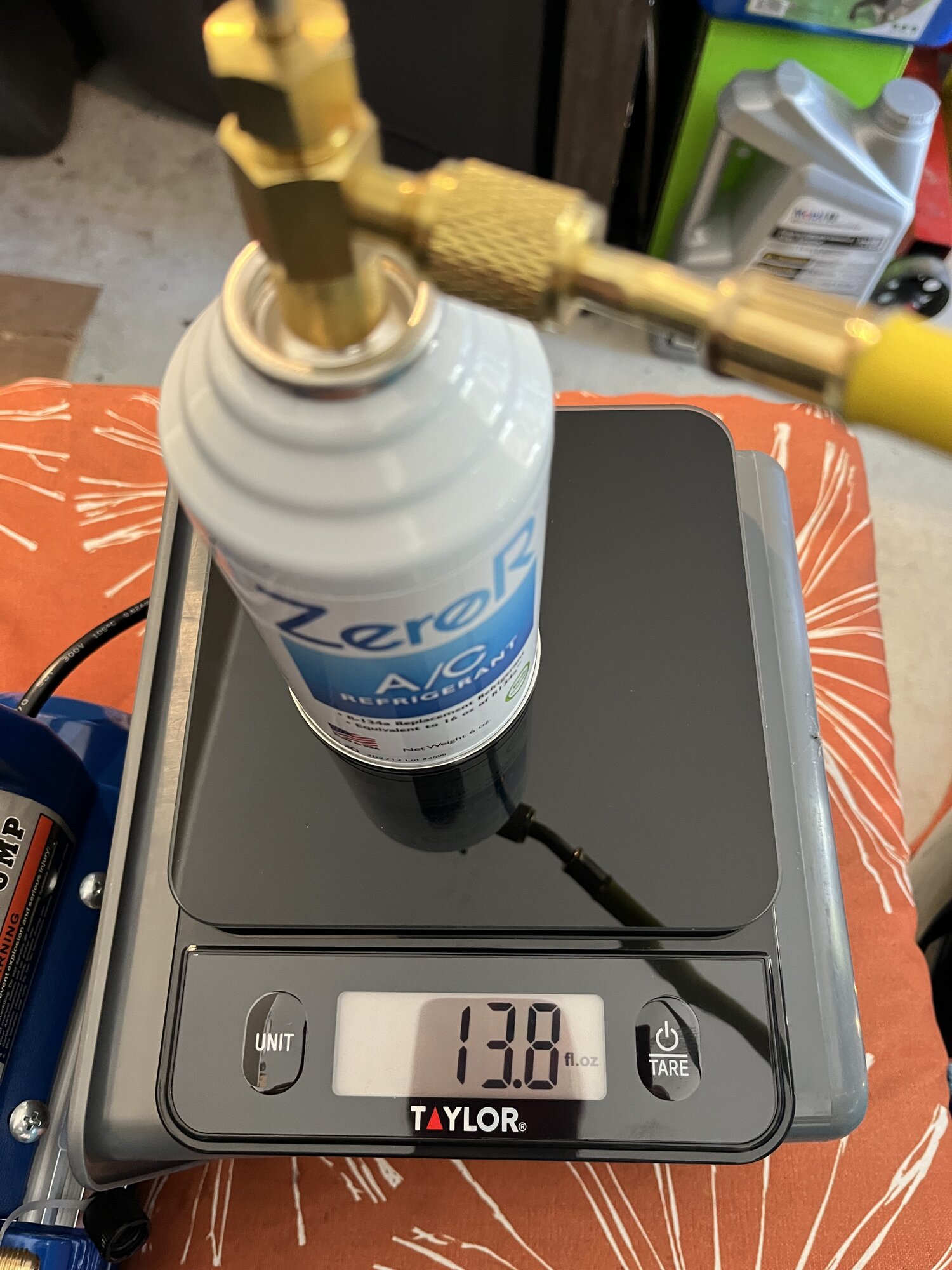

To be honest - it was my error when selecting it. ZeroR would have worked great, but the valve that punctures the can that came with the kit leakes. I could not fix it.
The kit also came with another valve that is for cans that self seal, so I picked up 2 - 12 OZ cans of real 134a from AutoZone.
I didn't have to weigh or check temperatures, cause two 12 OZ cans filled it to 24 OZ. good enough for today. I'll order another piercing valve and keep the ZeroR cans for another time.

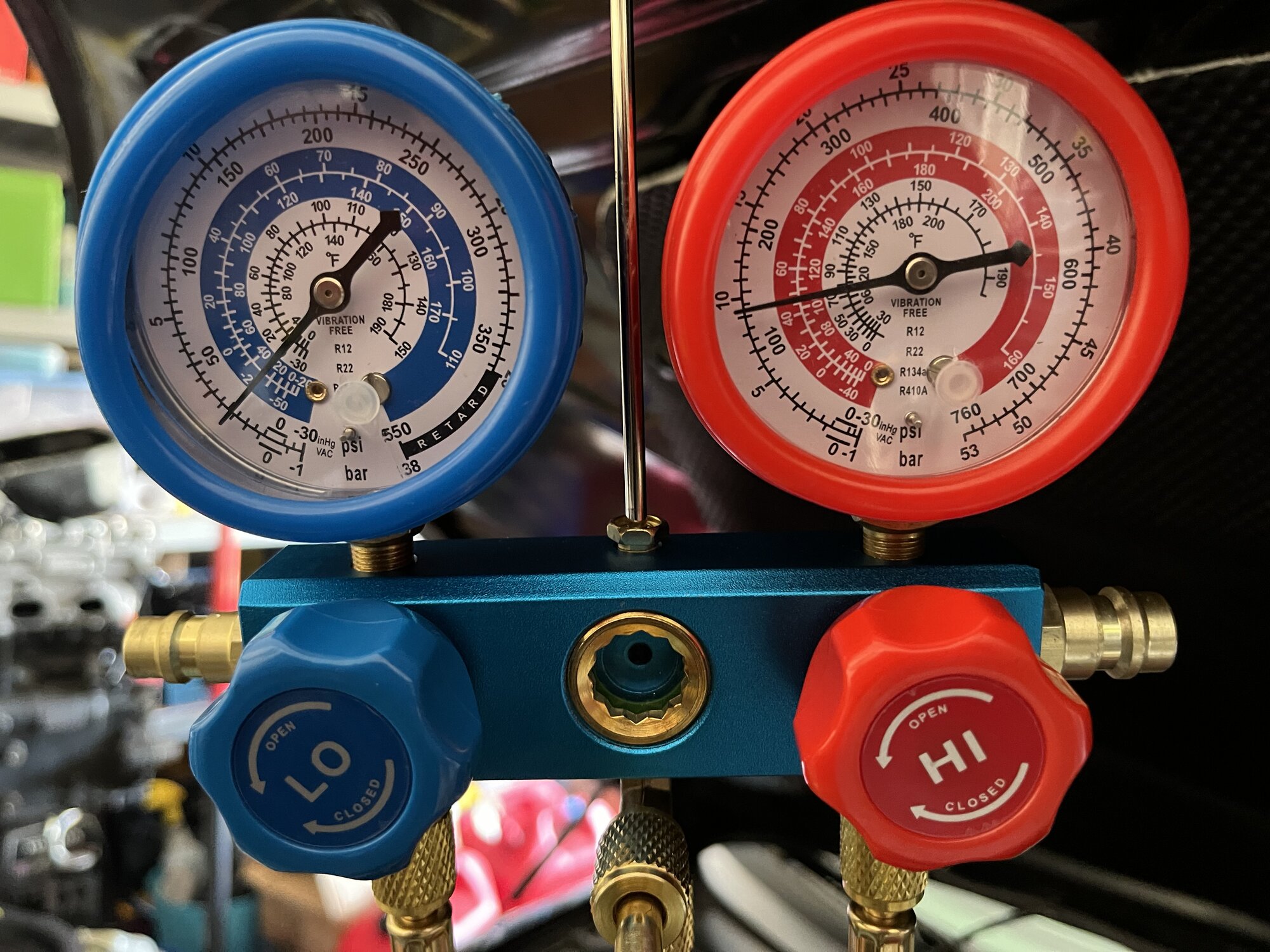

The low pressure seems high 40psi, and the high pressure seems low 90psi. I’ll see how it goes. The compressor wiring worked, but I wonder if being 4 oz low is contributing to low differential.
My dad would always put in a couple of extra oz "for the lines" in R134a systems. He might be a cracked out drug addict now, but automotive A/C systems were his bread and butter back in the day. He'd routinely test his R134a systems and get it blowing out of the vents down into the 30's. Won't hurt to put a couple oz more in there.

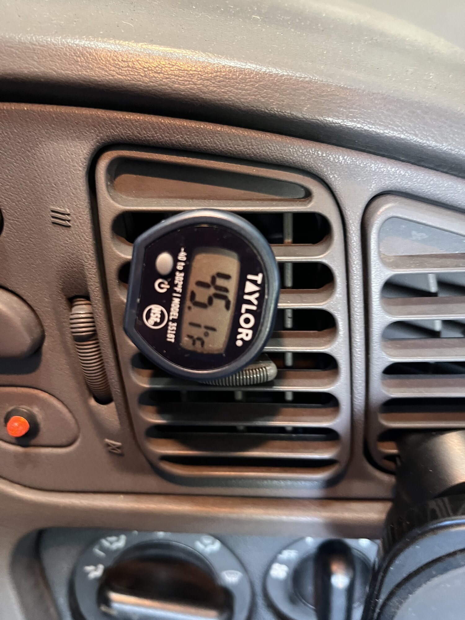

How's the temps out of the vents? Glad to see ol' pops advice still coming in clutch well from his less-druggie days. I'm so insanely envious of your working A/C. There just always seems to be something that pops up on ol' AMS that takes priority right when I think I'm gonna do it. I've got all the stuff to (at least in theory) get it to work(Seals, new dryer, compressor, bracket, belt, etc) but yeah.

It measured 43deg with the ambient temps in the 60's. I want to check it when the weather is a bit warmer.

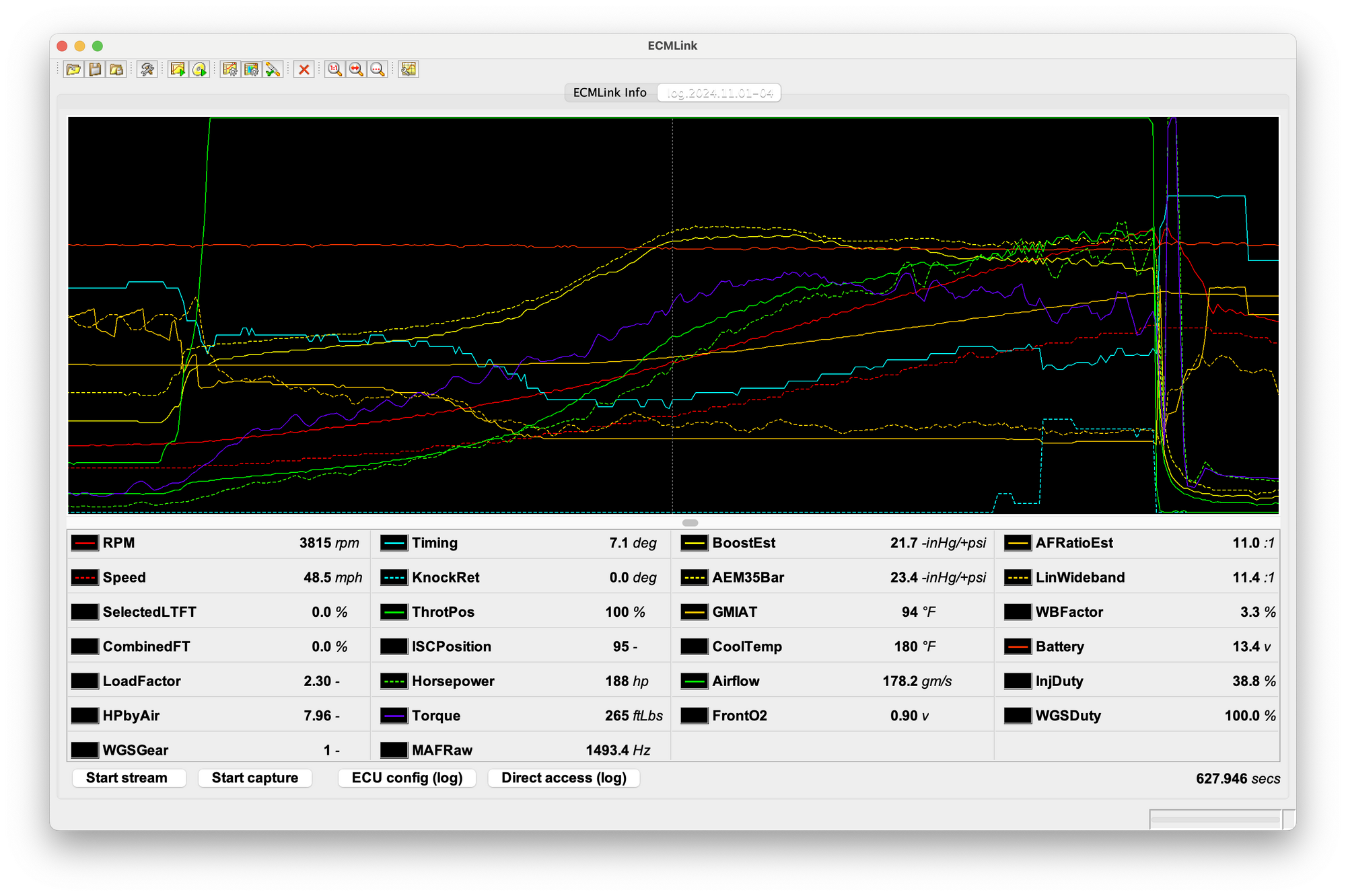

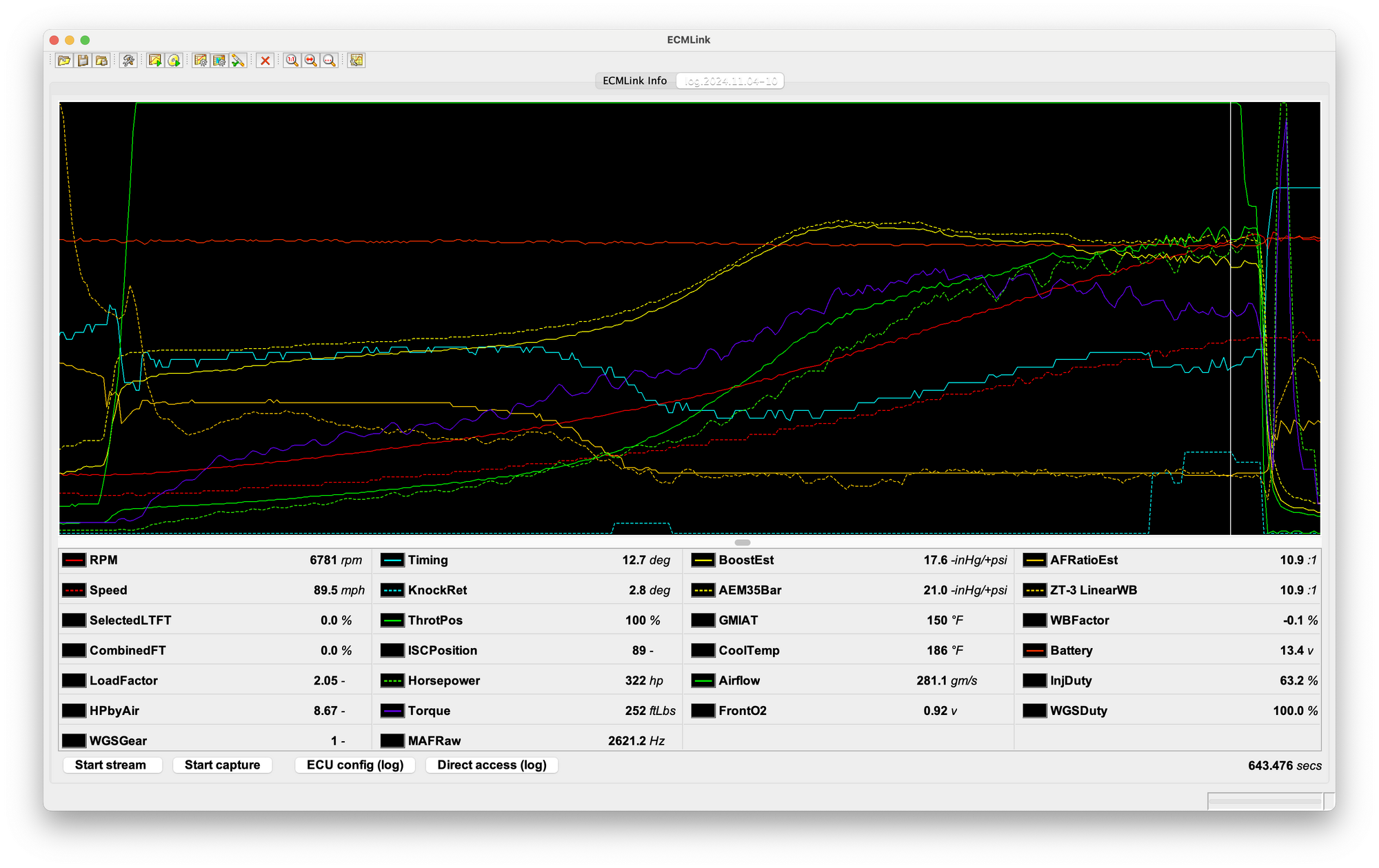

I was getting confused - the data plots in the car were graphing different than the data plots on my Macbook. I found my graph range for AFREst and LinWB were not the same. Thankfully this has no effect on the way WBFactor is calculated, only how the lines overlap - so at least my SD edits were going in the right direction. Boy, that knock at 6k is showing itself consistently. Max boost increased, and I needed just a little more global fuel.
Now I am adjusting cells I have not reached before.

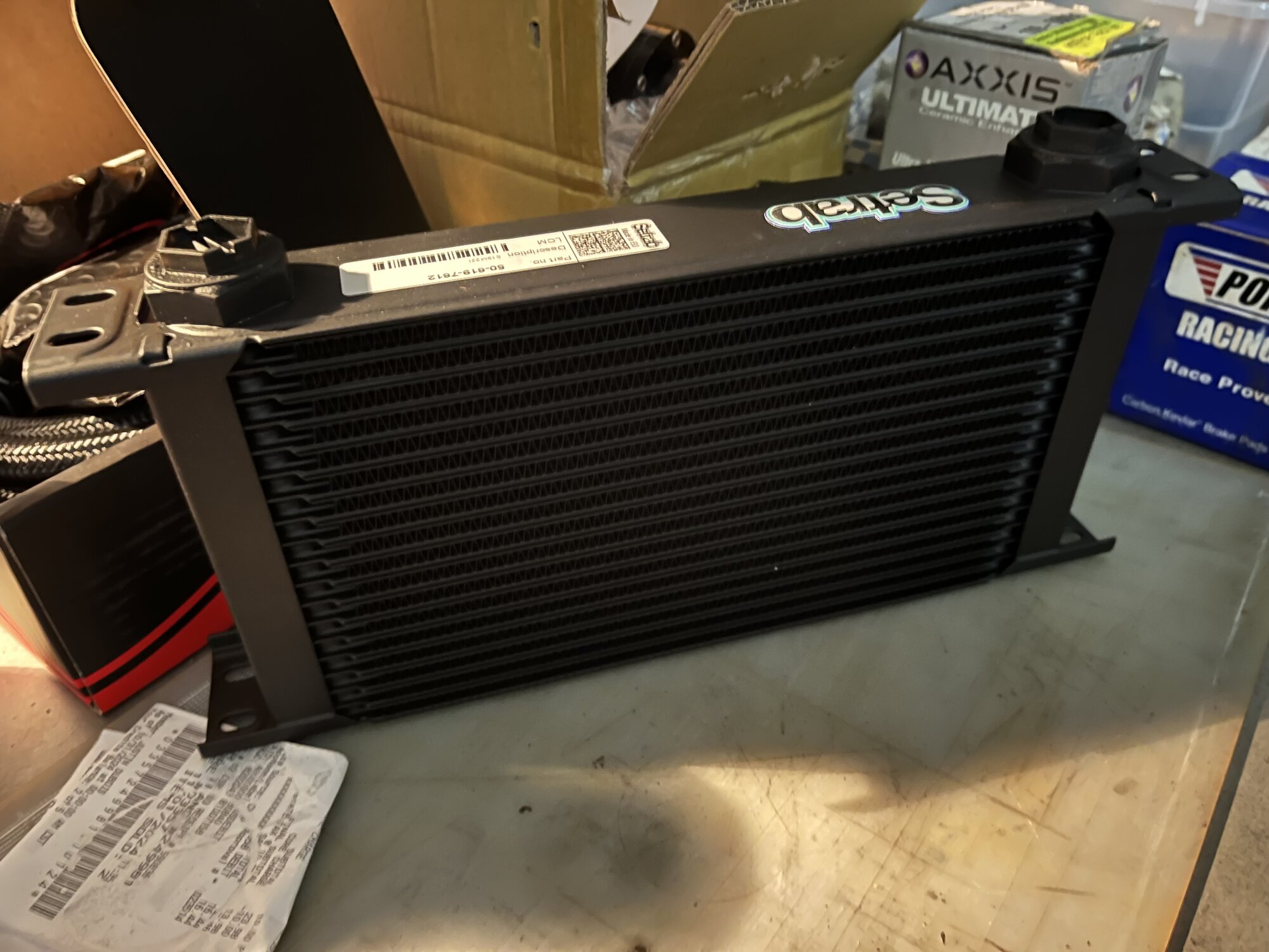

1. replace the oil cooler and oil lines

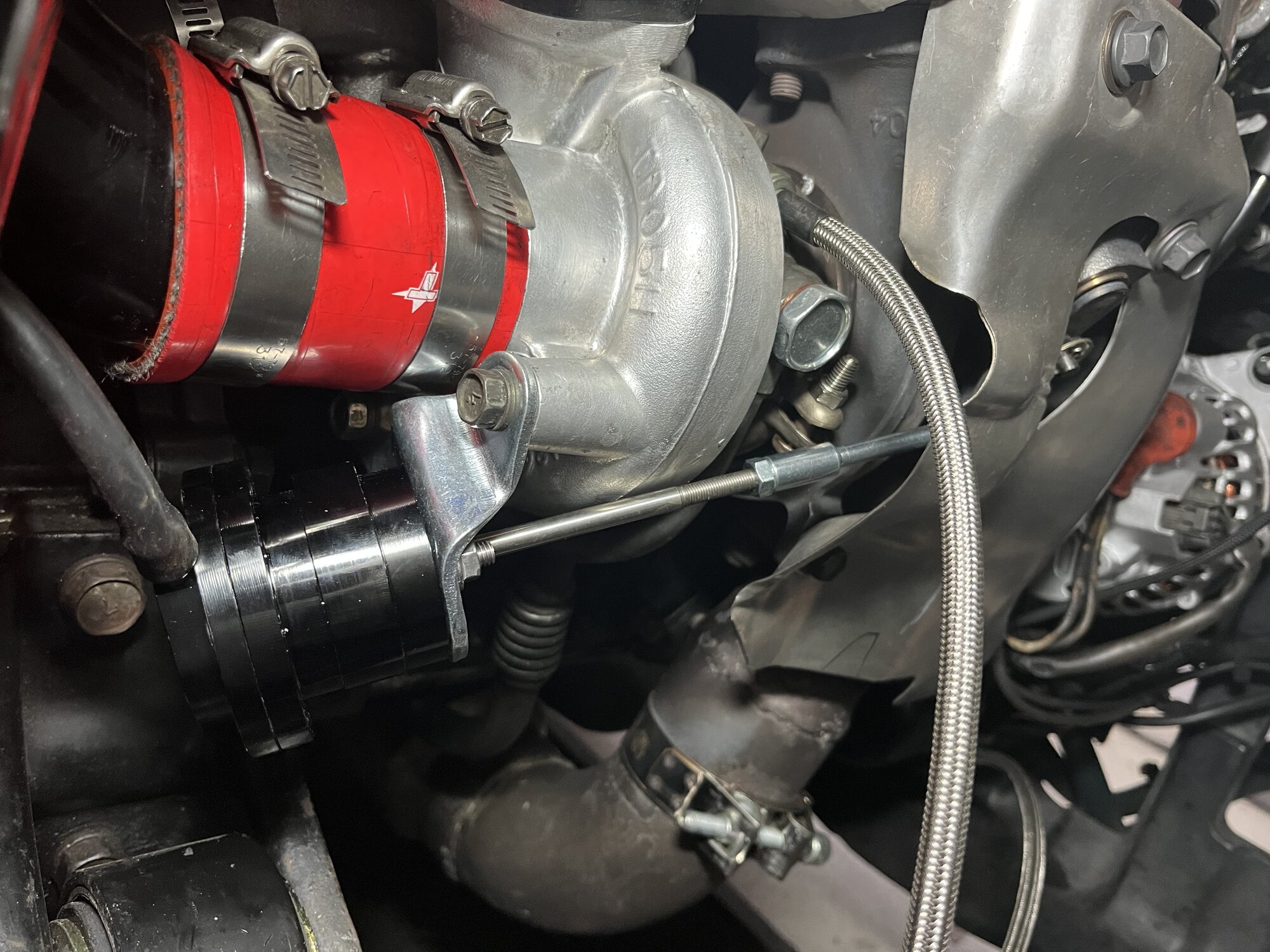

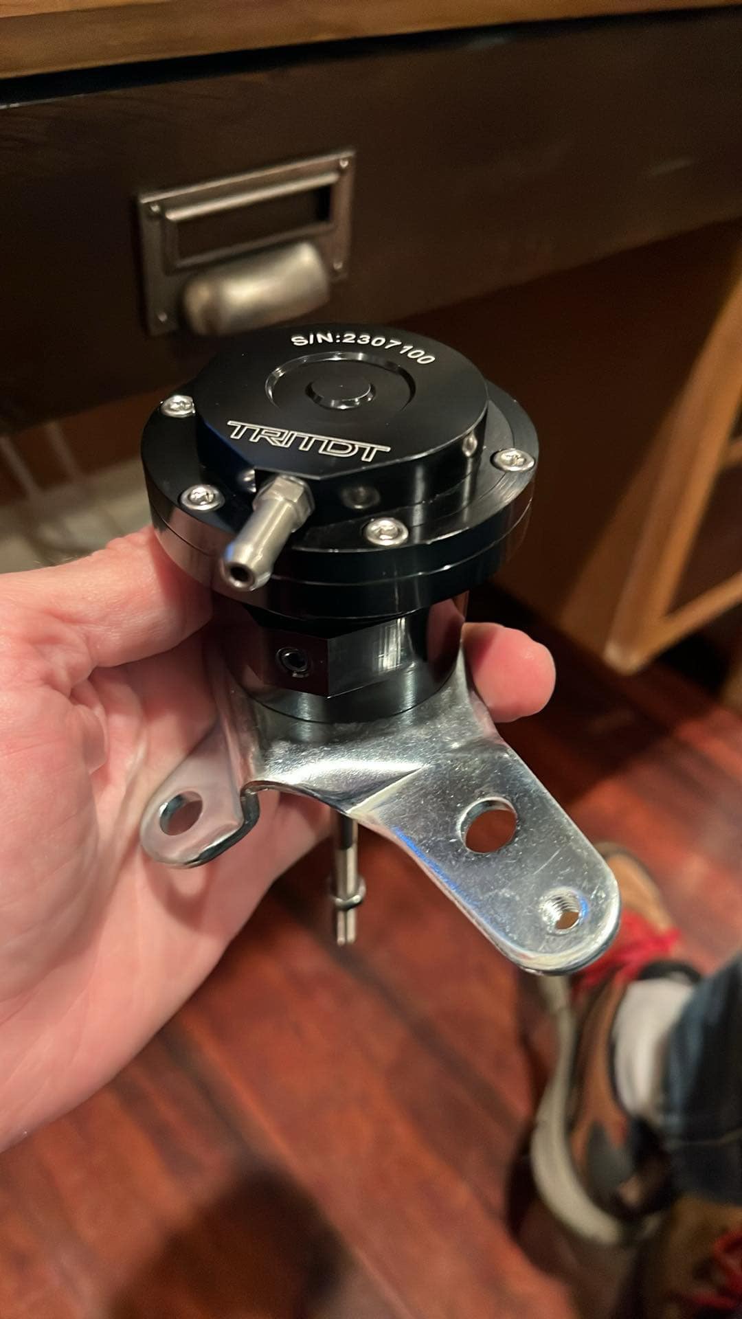

4. Upgrade the WG actuator with a stronger spring. I want to see how much more boost I can squeeze out of this TDO5-20g

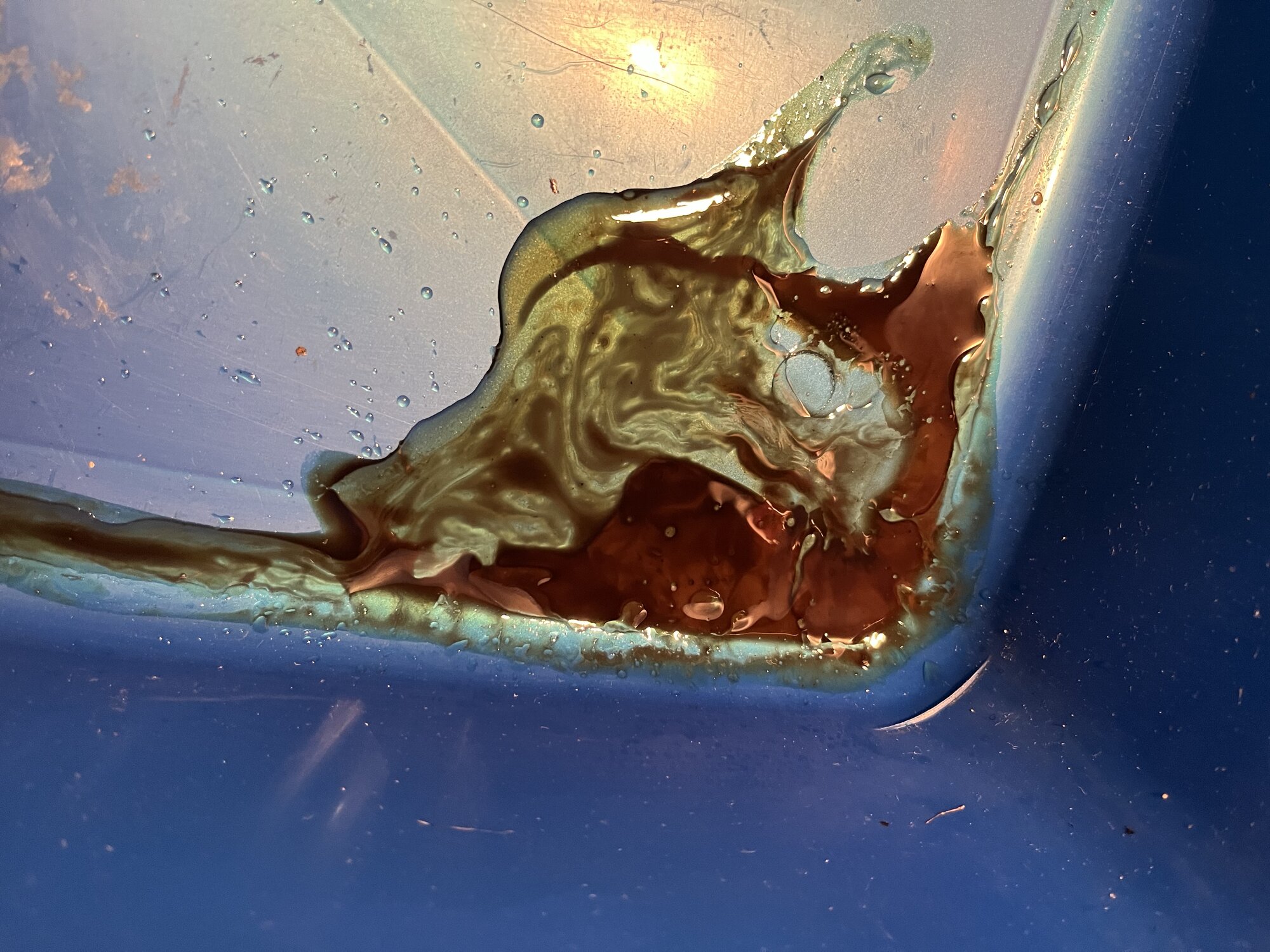

Not much in the catch can, but there was a mix of oil and some-other clear-ish liquid. Happy to say the AC system is still charged, and the engine bay is staying clean! No new leaks detected.

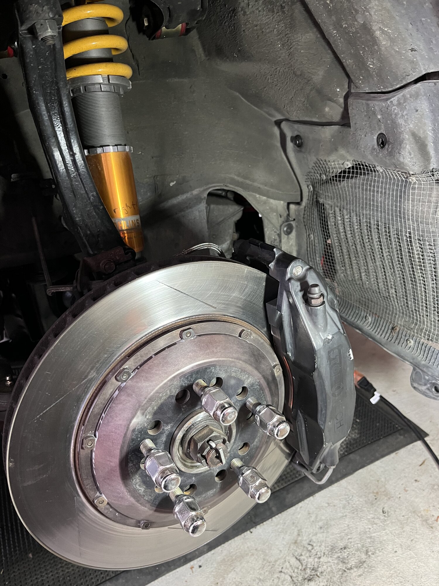

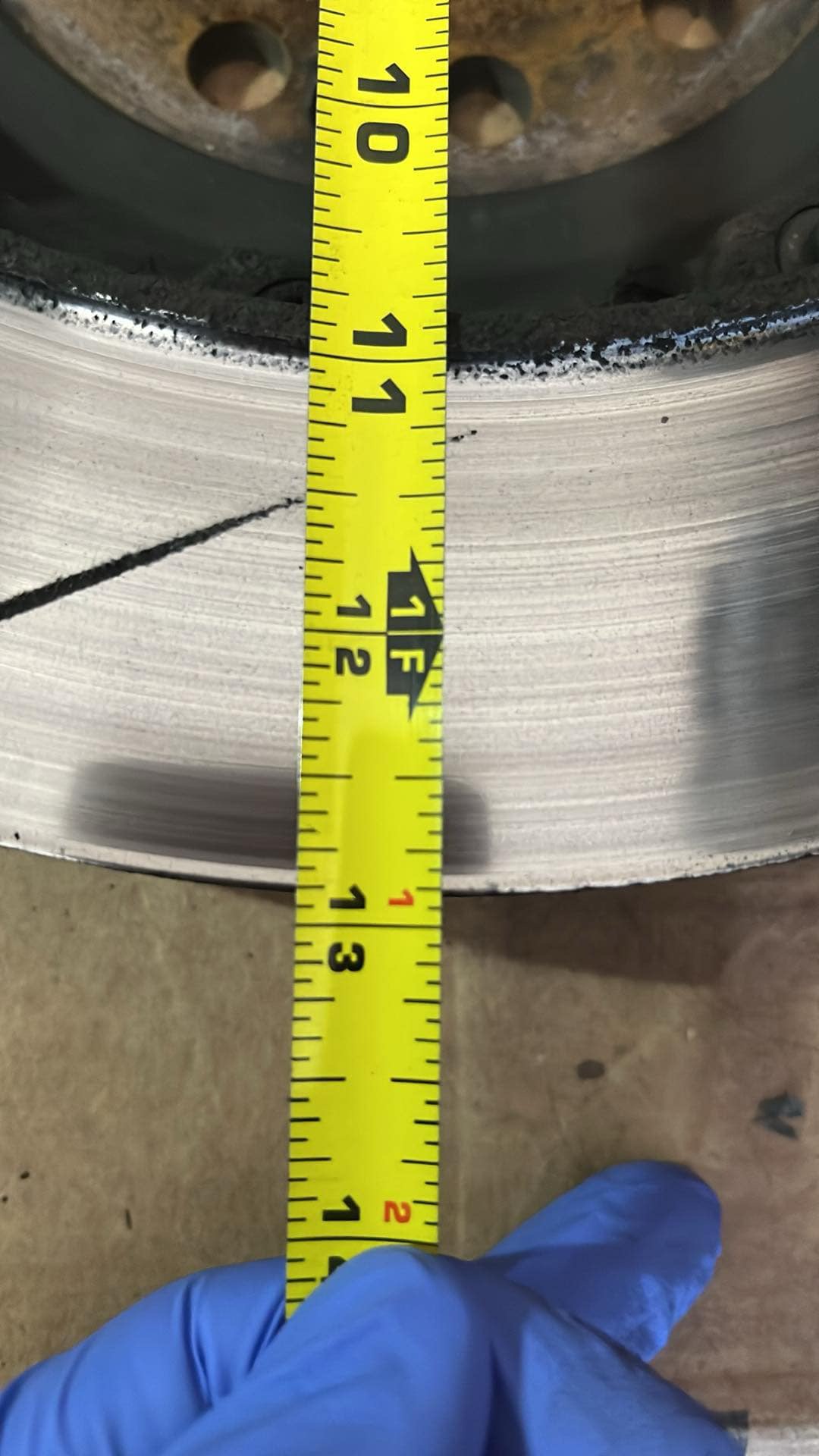

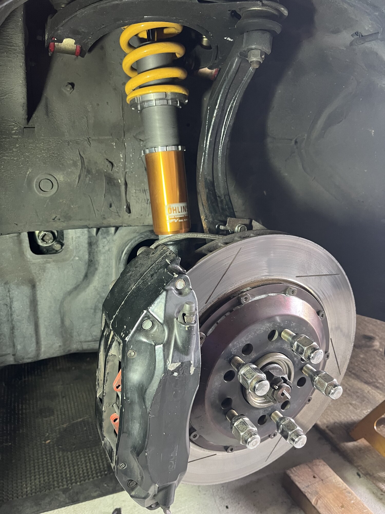

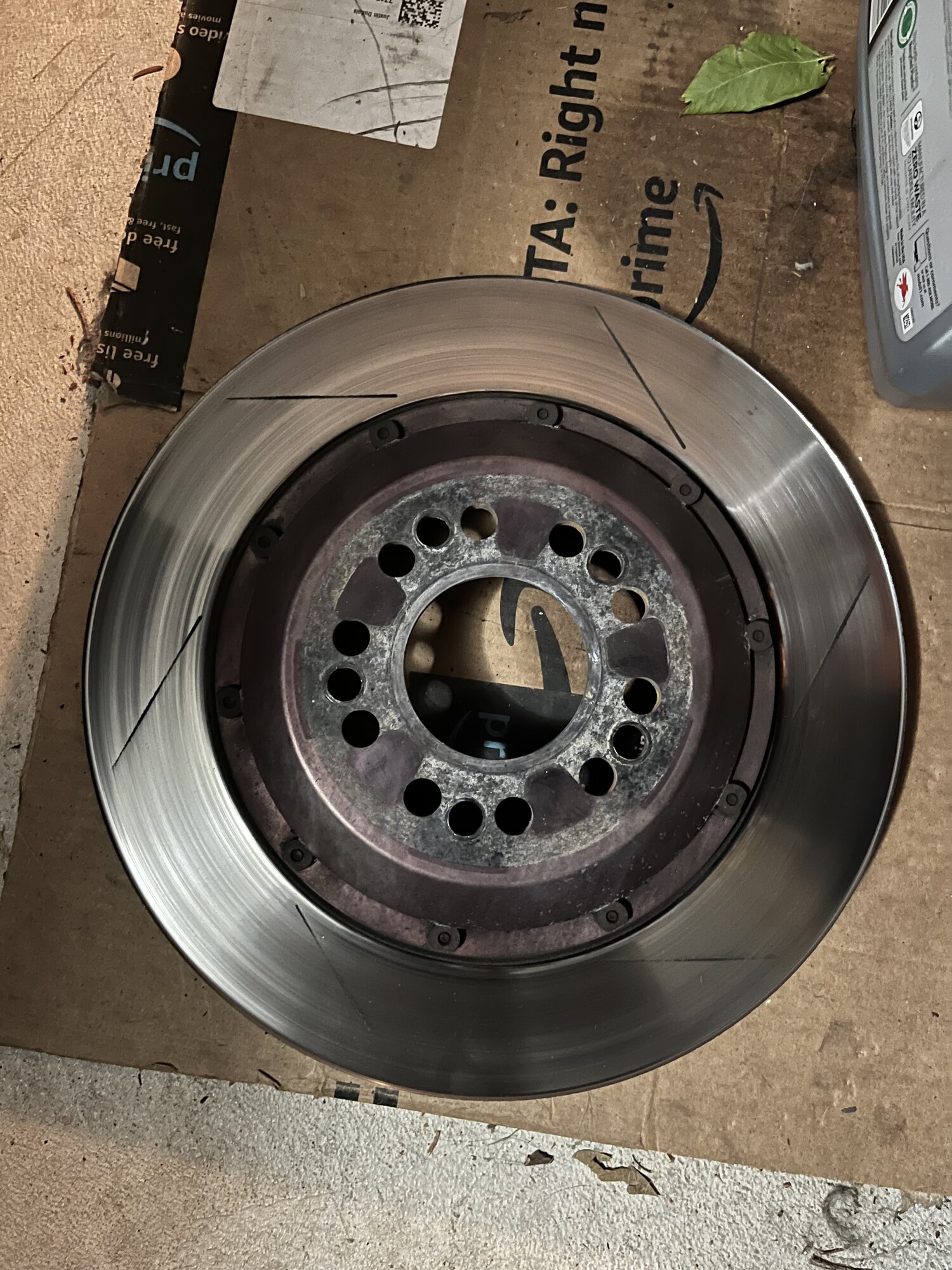

To measure the rotor to make sure I get the right one - 328mm (12.91”) the caliper has to come off.
This is the original StopTech DSM vented floating hat rotor, and it you can see the slots are almost warn flat.
I’m gonna half ta measure ya…

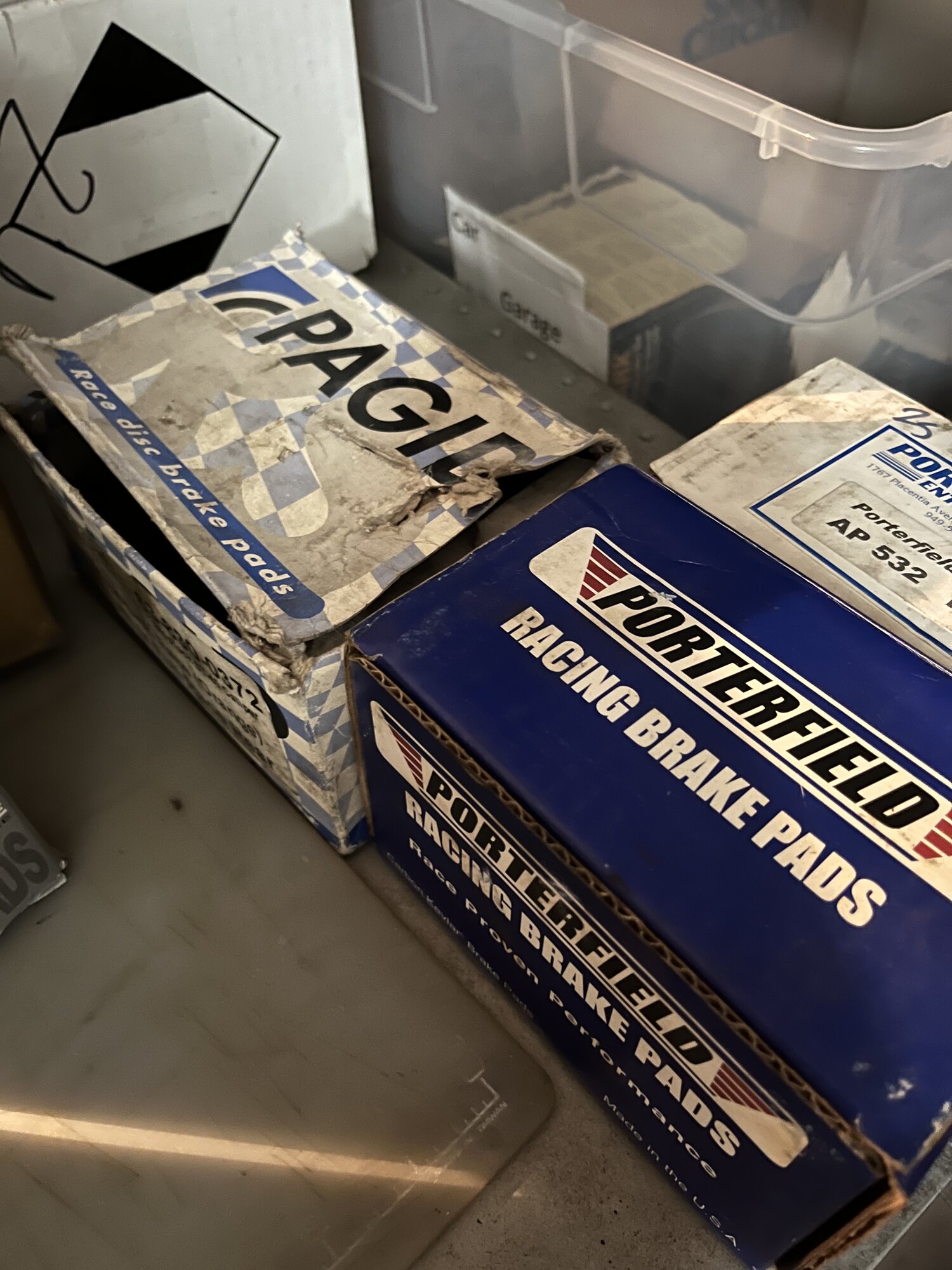

Track day pads

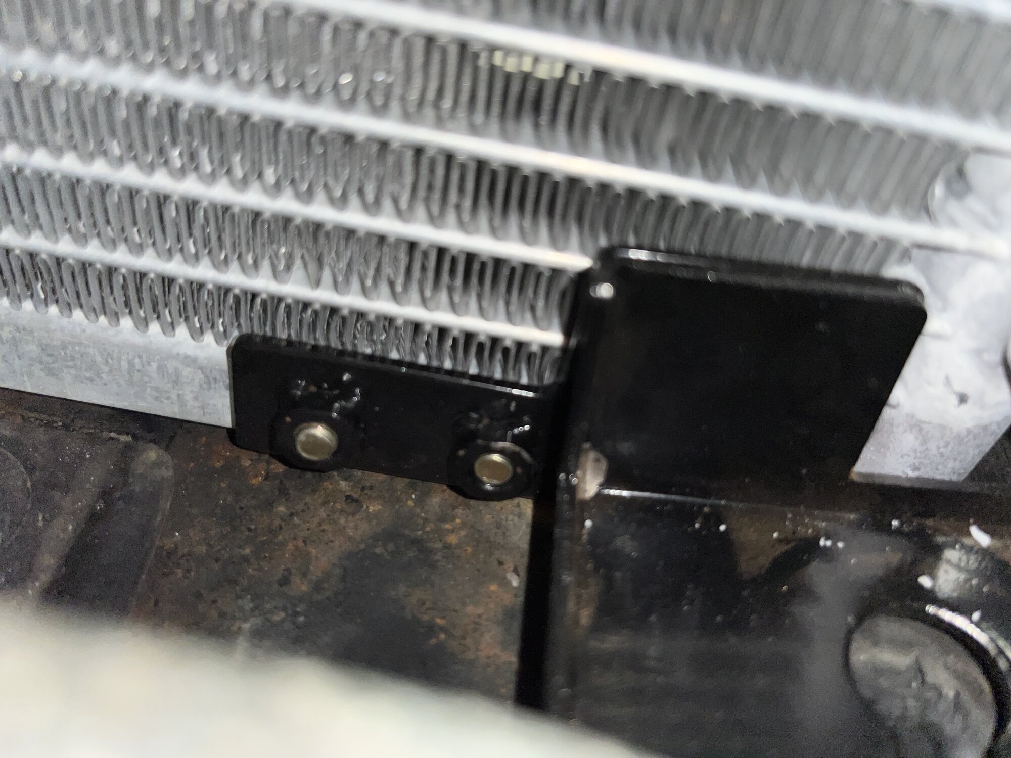

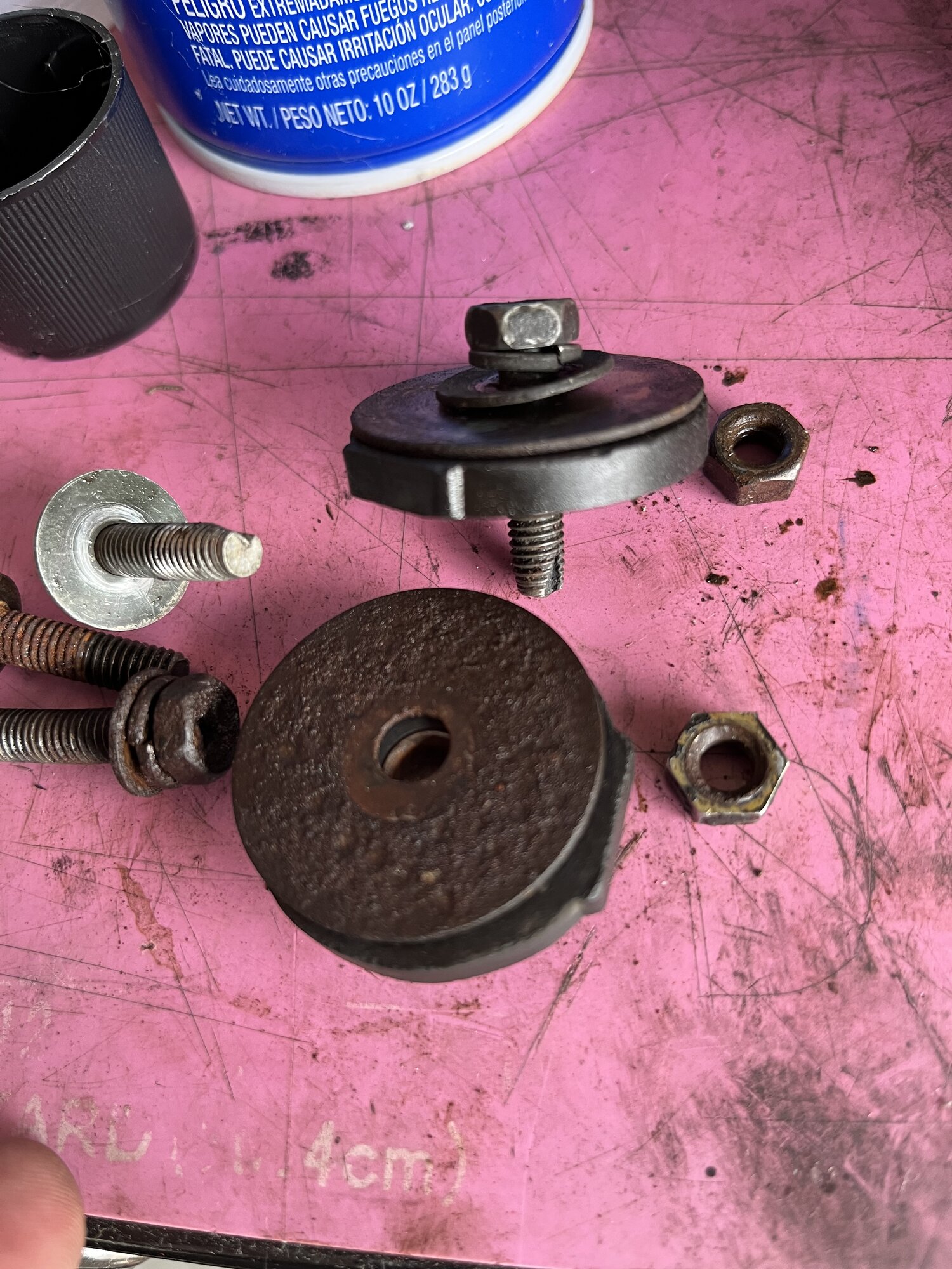

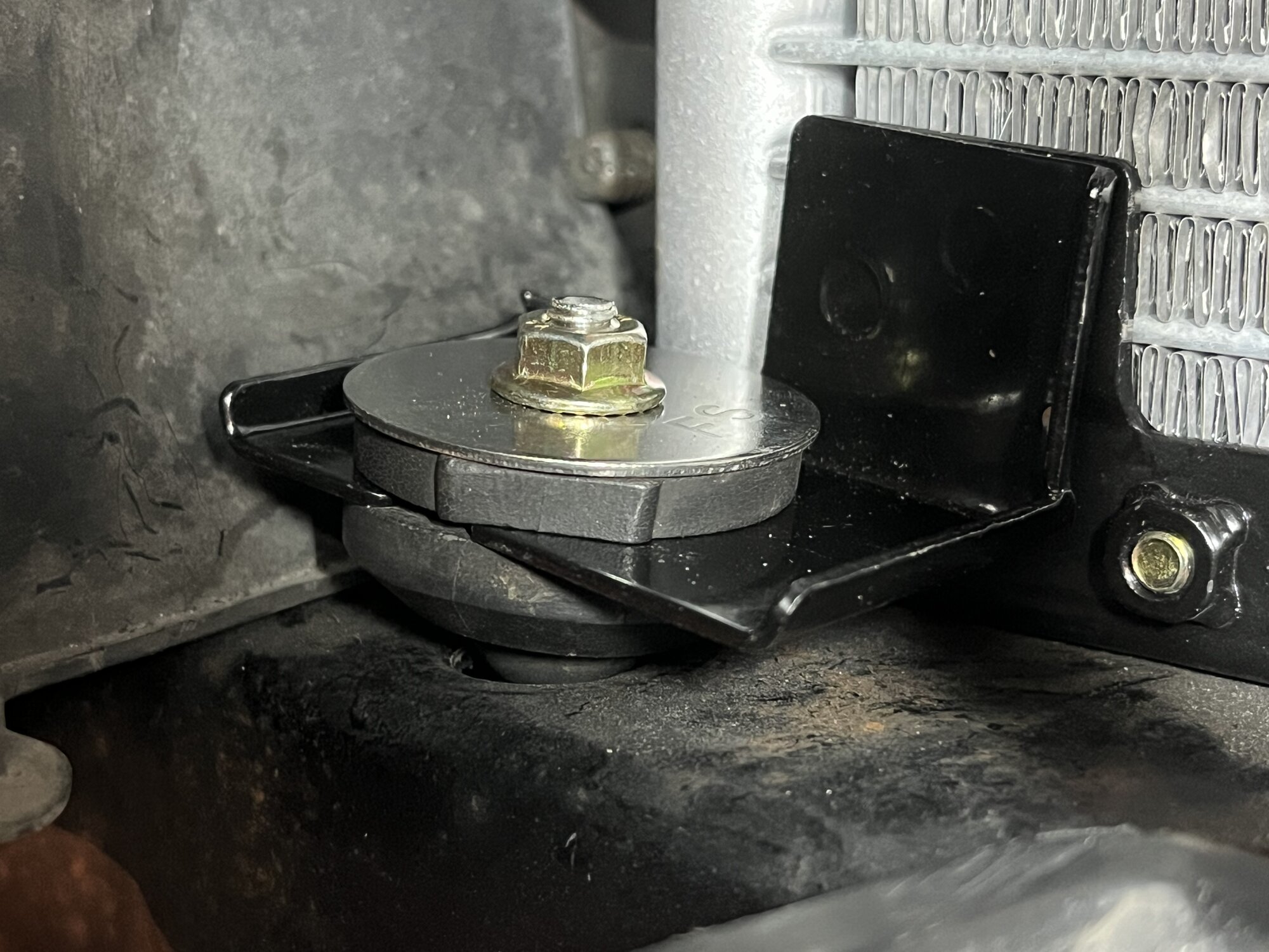

Now that I can see the AC condenser well, I noticed the vibration bushing on the feet was really corroded, falling apart, and it must have self destructed when the AC shop tried to back out of bolt from the embedded nut that is inside the bottom half.
So I replaced the bolts, nuts, and washers with stainless, and inverted the bolt setup so it works like a nut on stud.

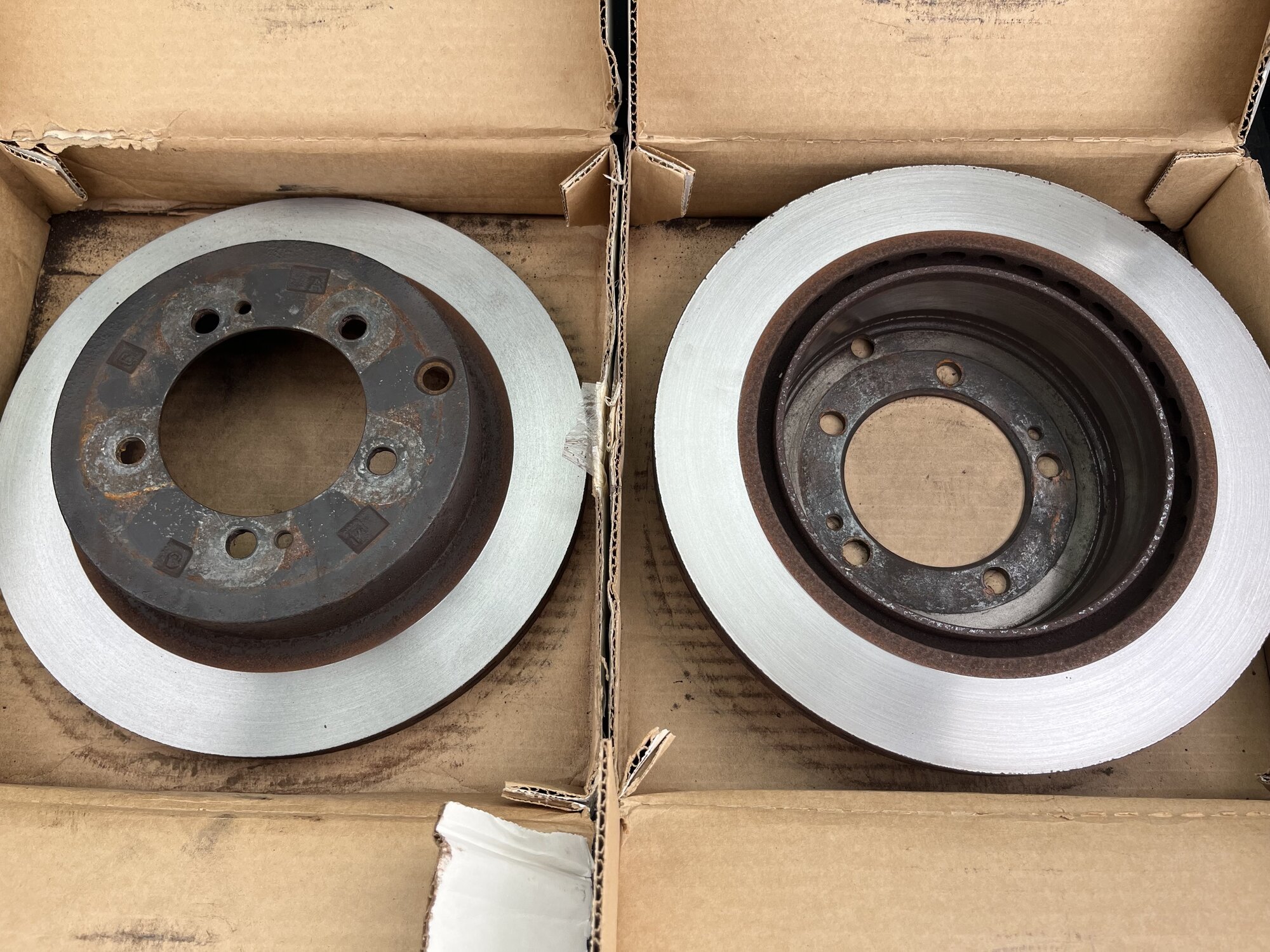

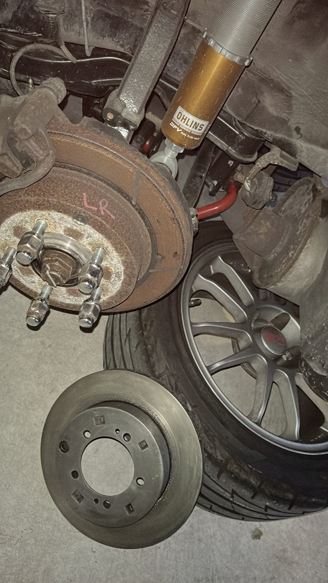

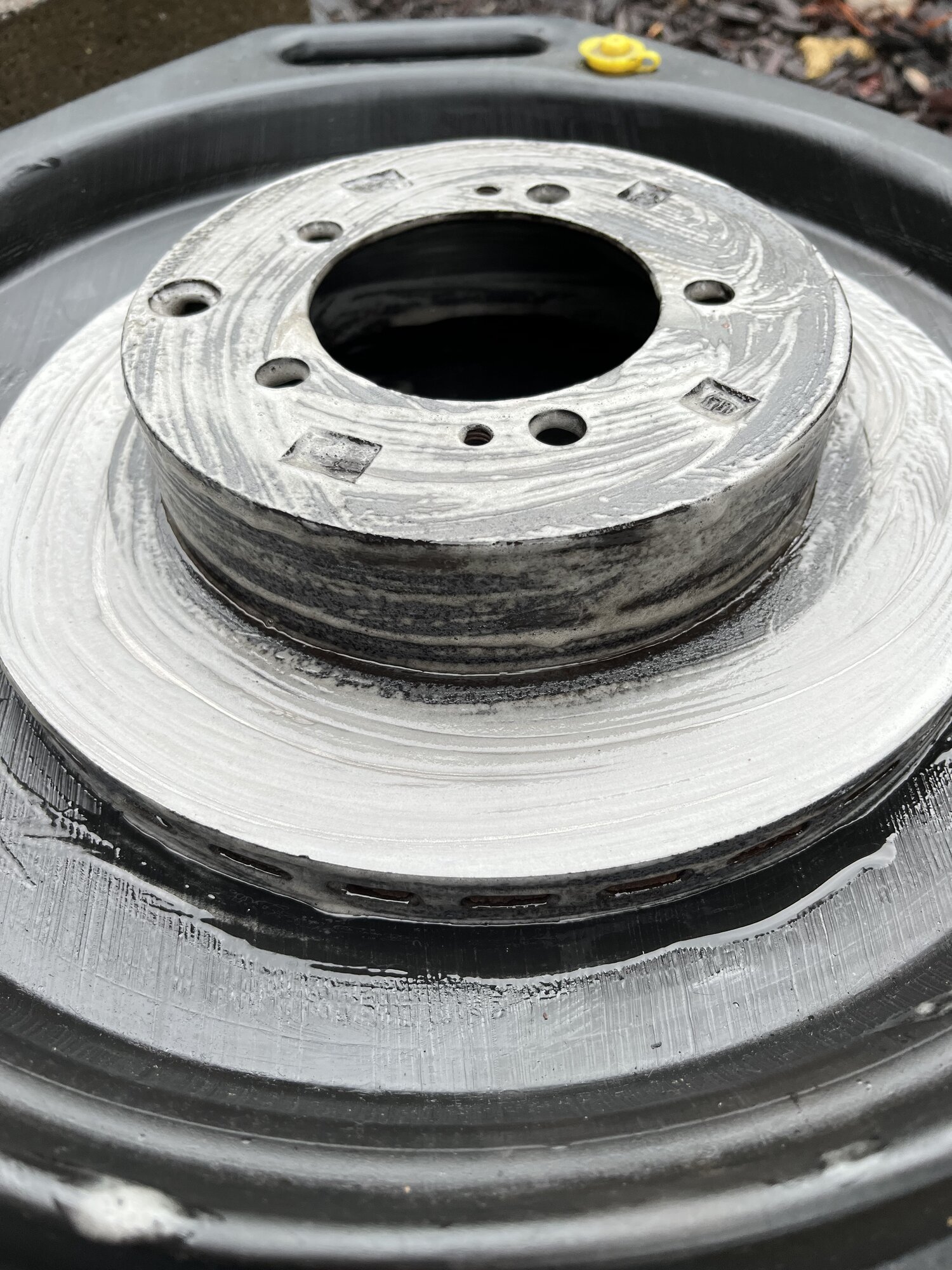

I picked up a 4 1/2” abrasive pad for the angle grinder, and went at the turned rotor taking down the rust scale. Next, 30min of rustoleum, rust dissolving gel. And finally a scrub down to remove the gell residue in a pan of water with a red Scotch-Brite pad.

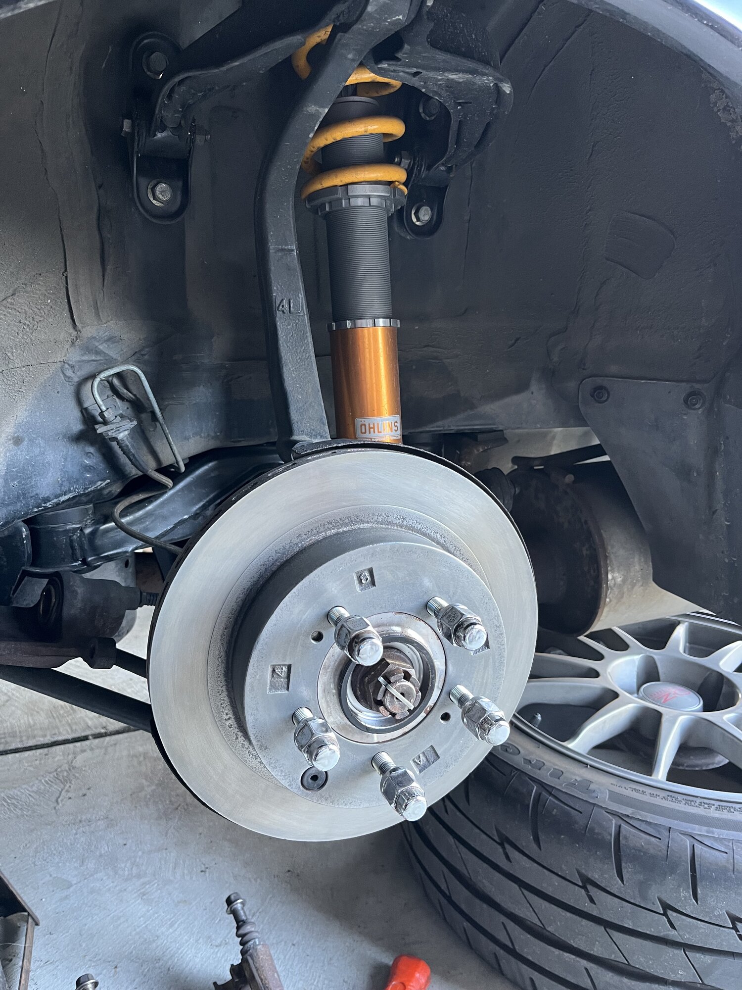

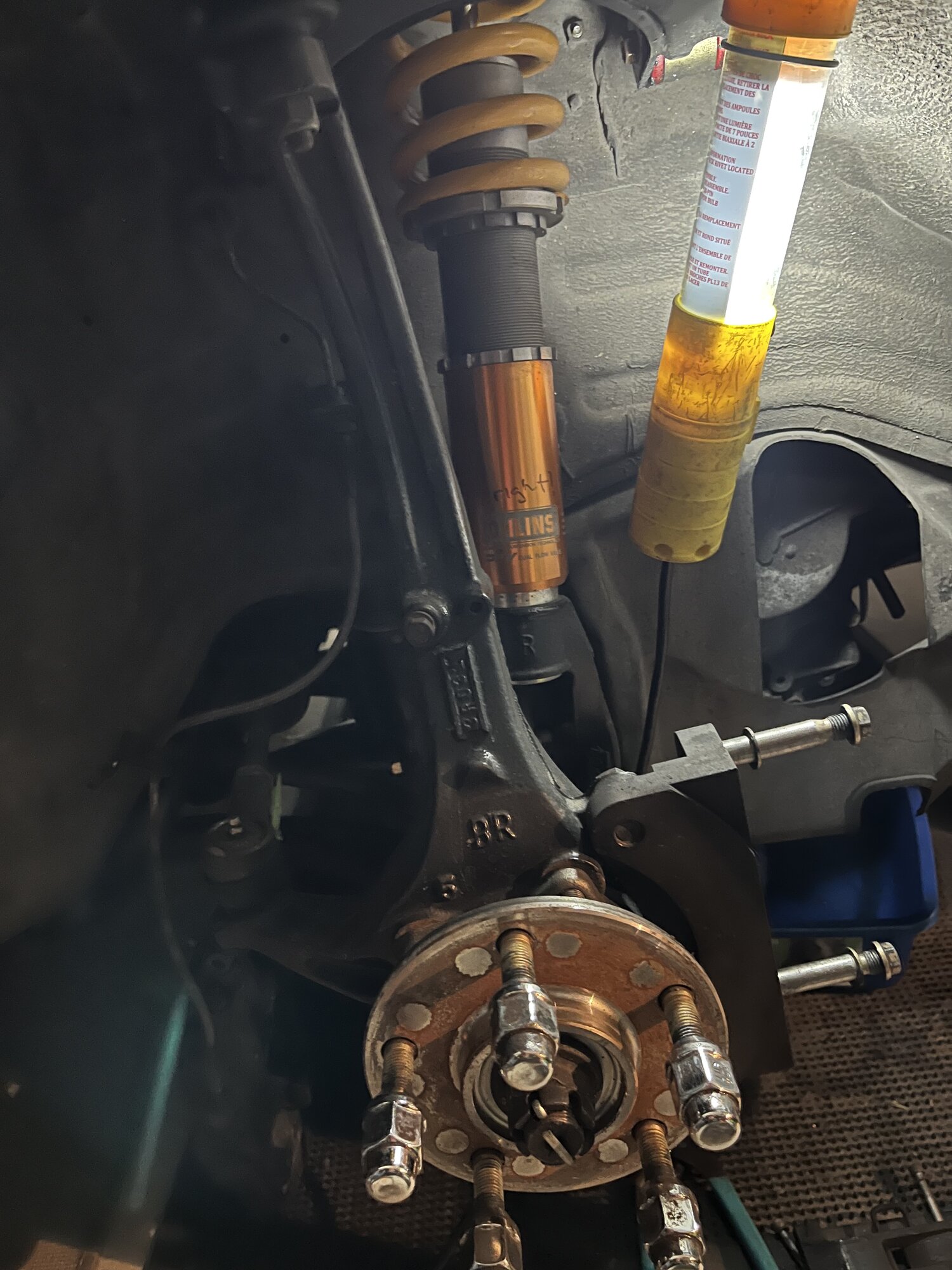

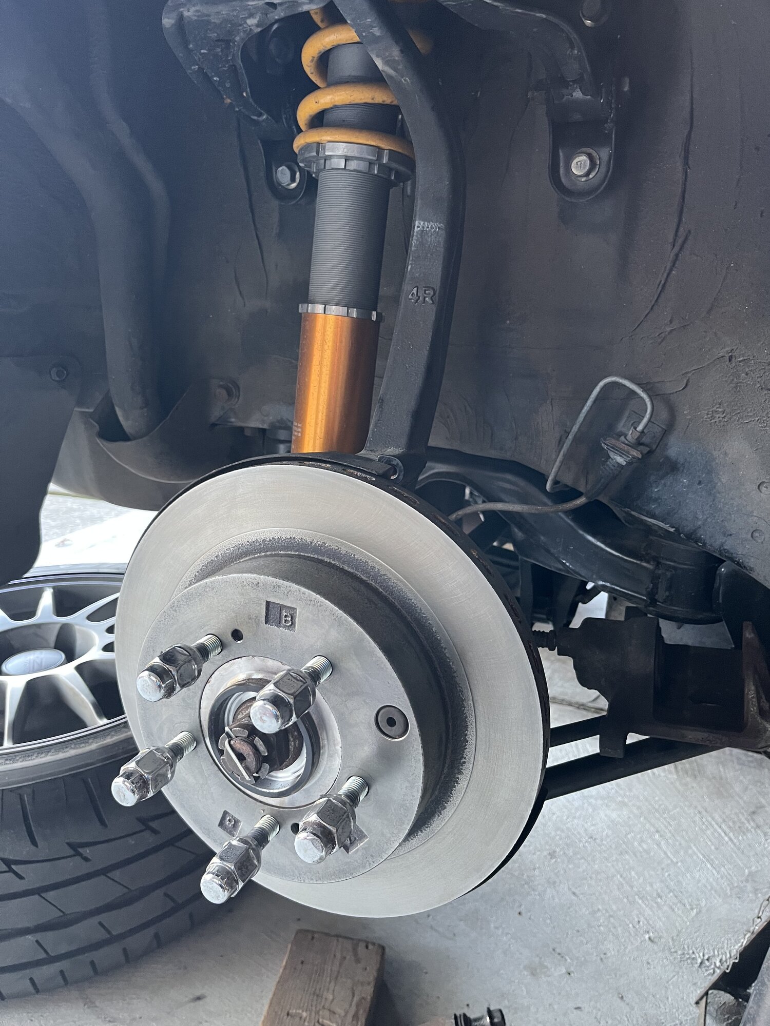

Front Rotors will be a track day update, and the rear brake calibers are due to arrive in 5 days. For now I cleaned up the rotor hats and hubs with a combination of stainless steel brush on a drill, and a nylon stripping wheel. Amazed to learn the stainless wire did a great job on the rust and brake dust on the hard anodized hats. The Nylon was actually more aggressive and starting to scratch. I should be able to put the front end back togeather today, and get the cleaned up rear rotors on. Not sure I will put the old rear calipers back in place or not. I might as it would be handy start setting up the boost control with the new 1.0 bar WGA.
