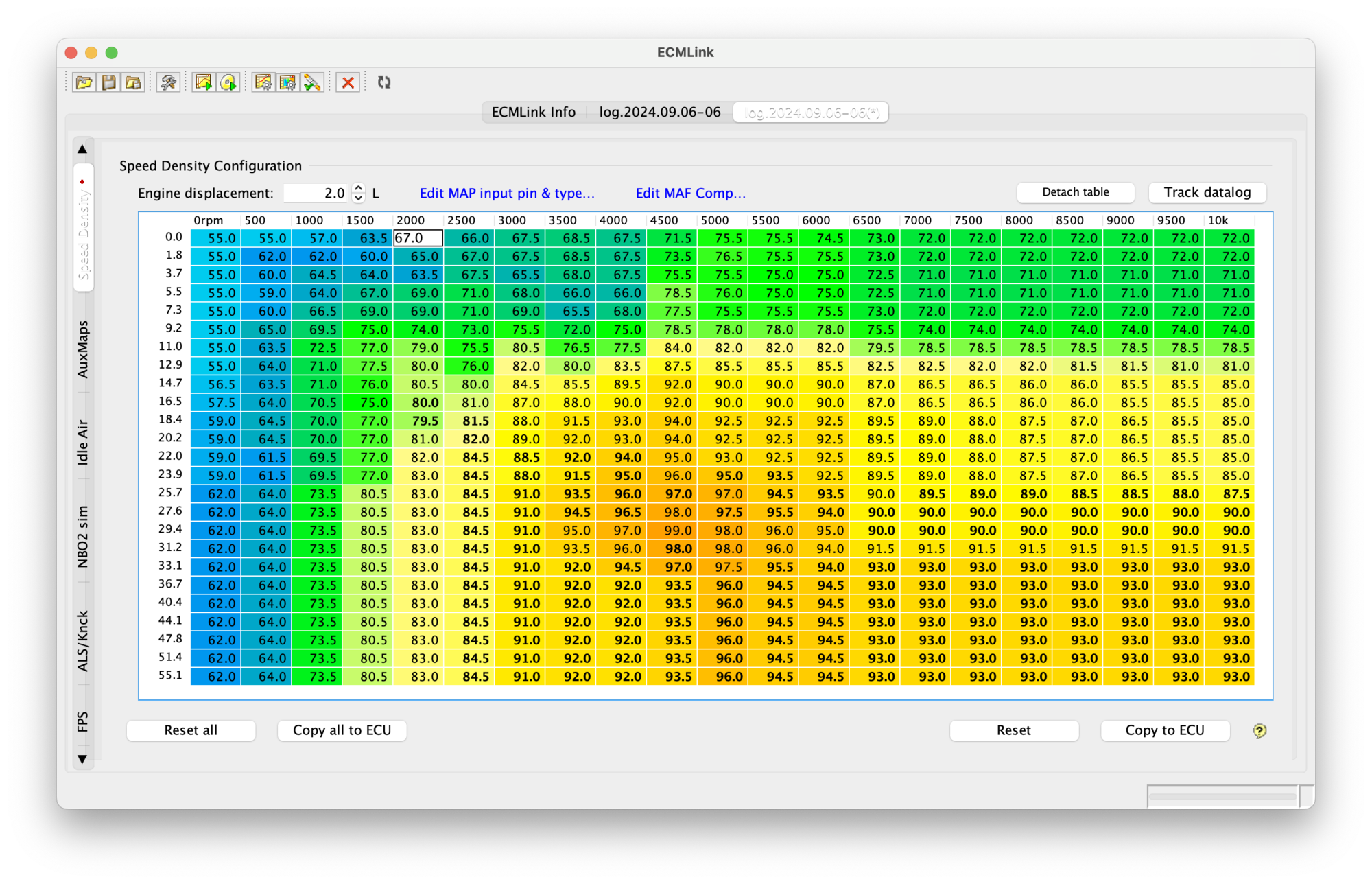

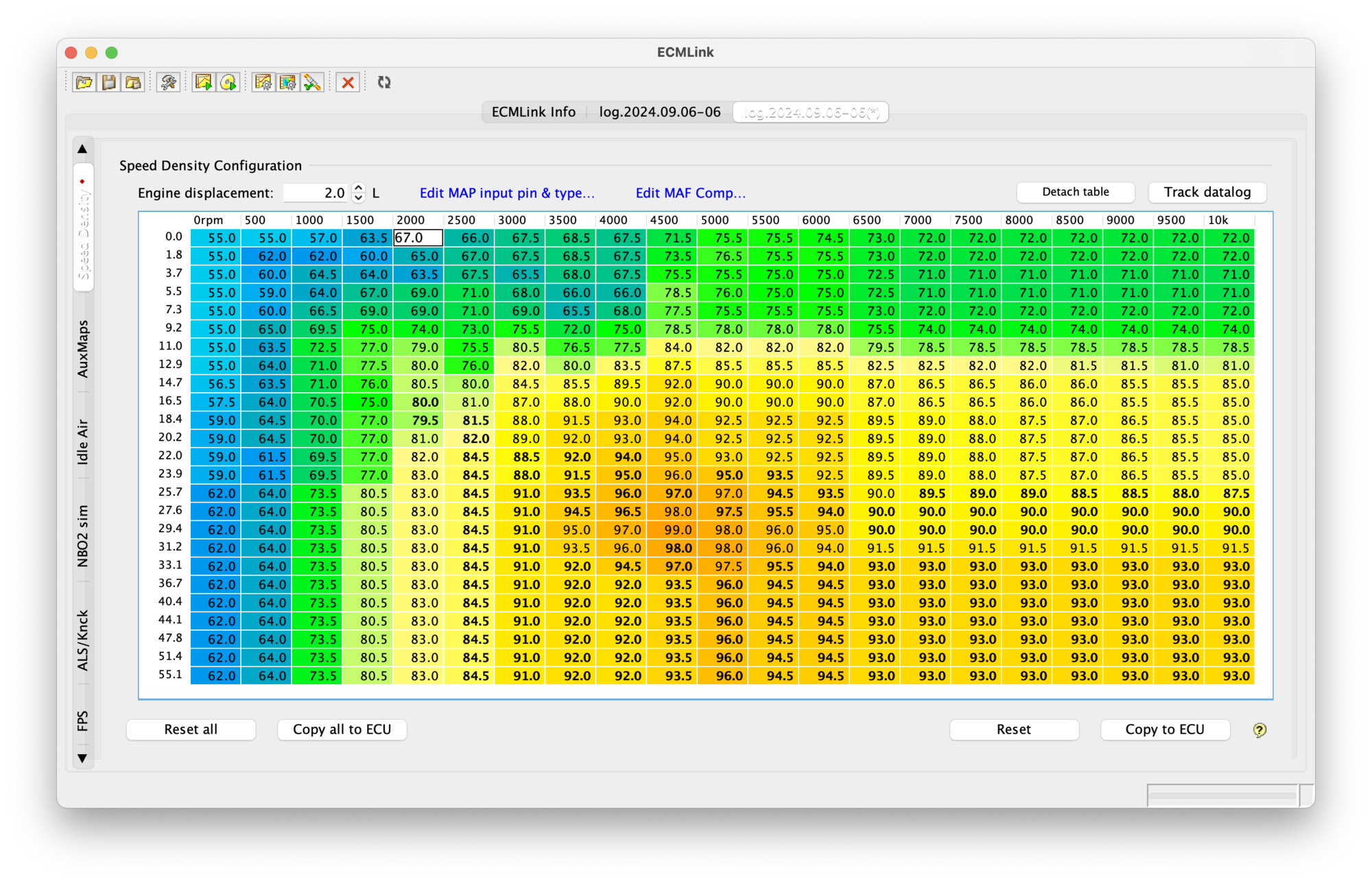

Adjusting SD for Bastard 20G vs Big16G

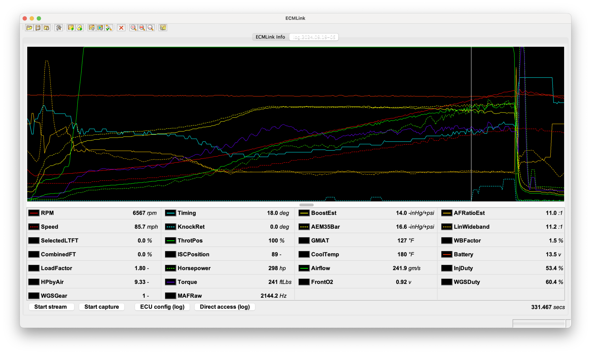

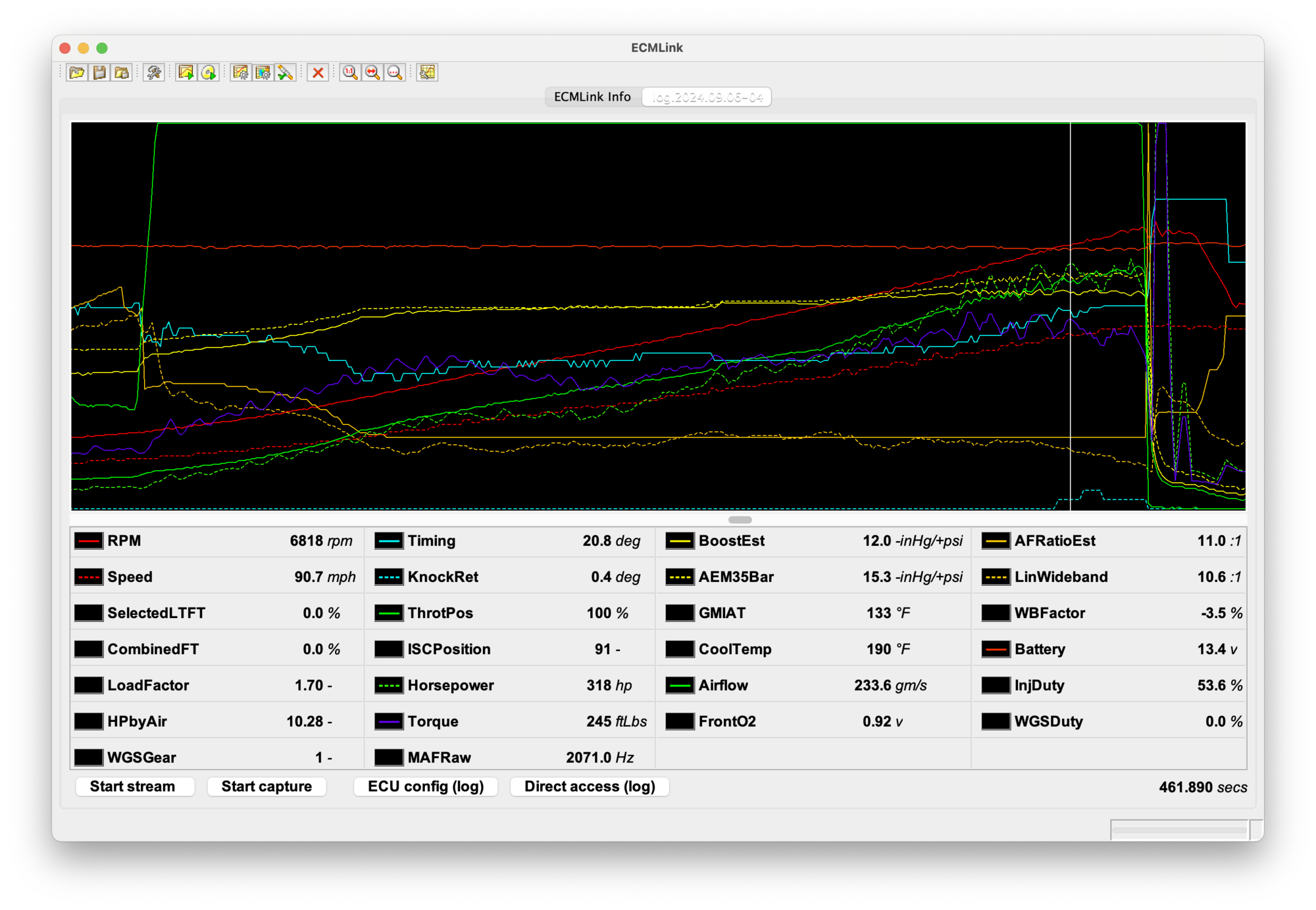

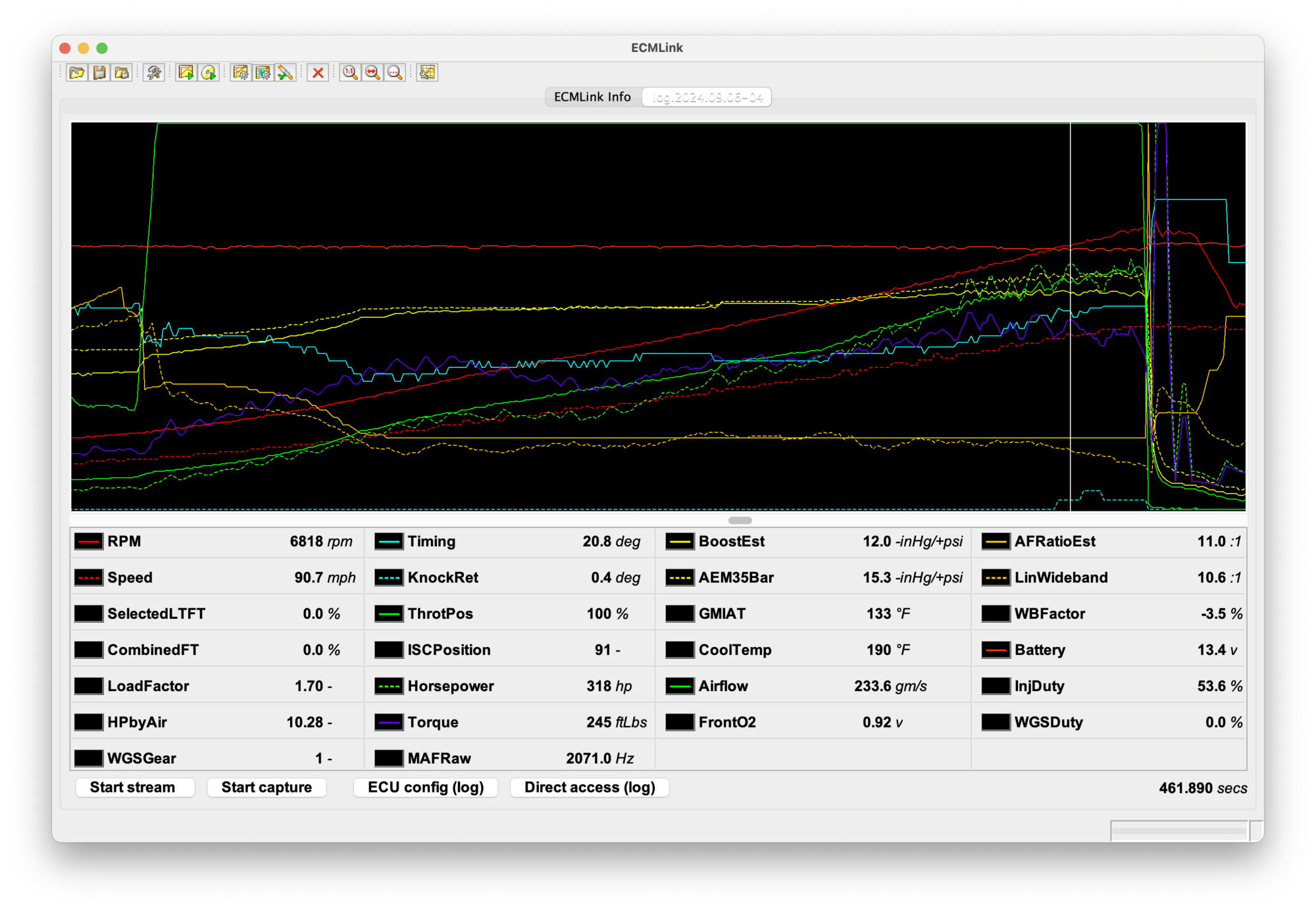

Here we have minimum boost pull:

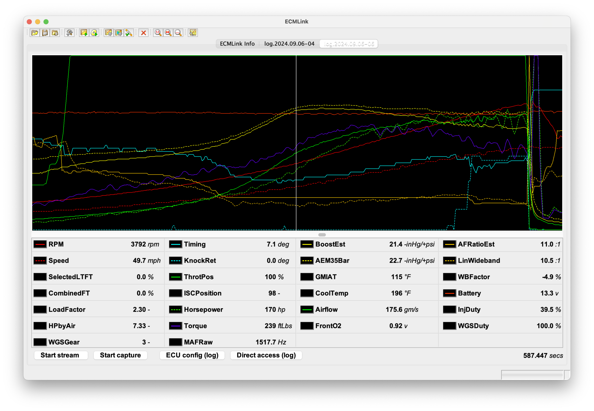

Here we have a maximum boost pull:

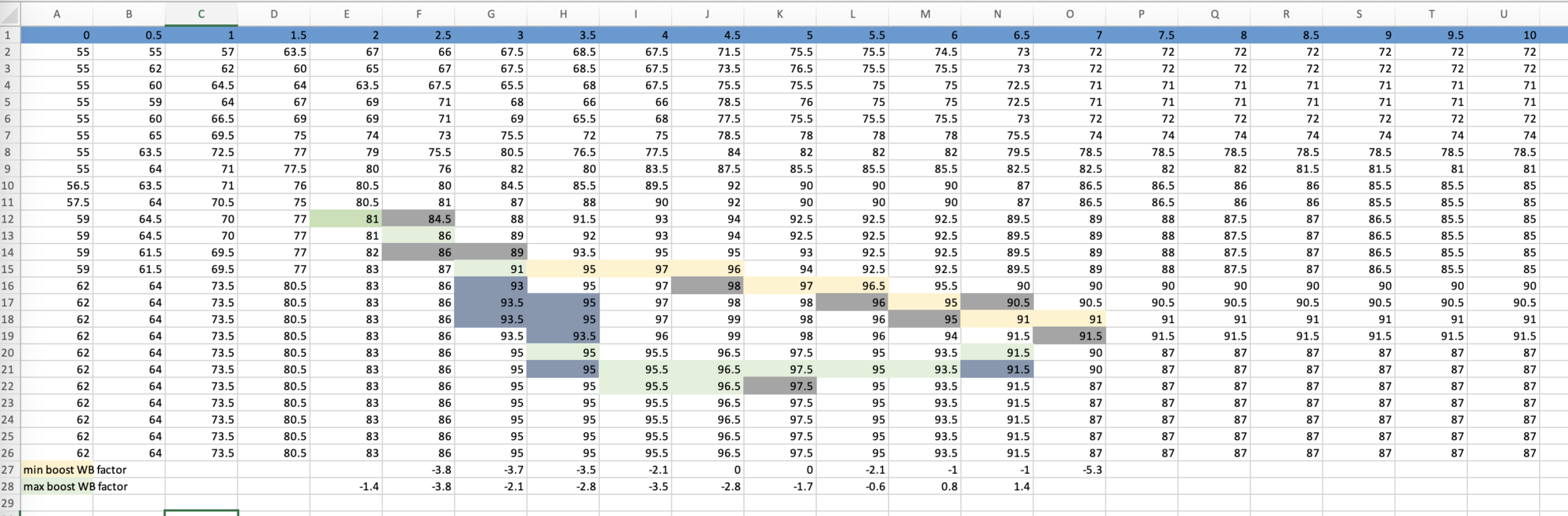

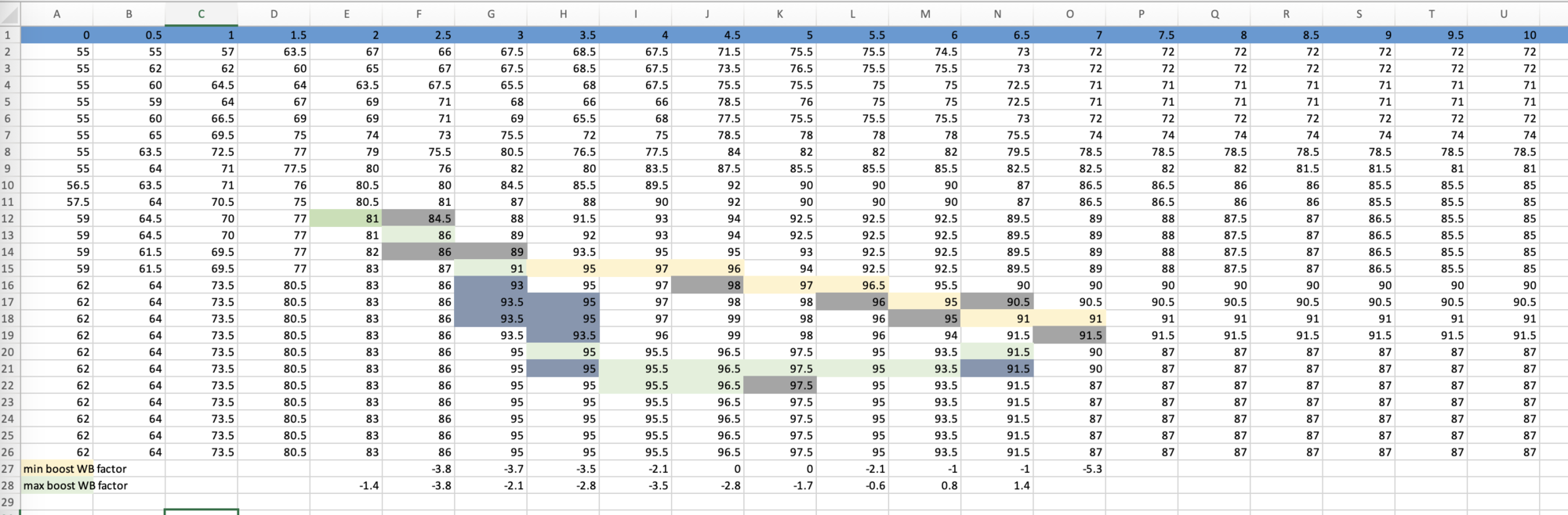

Noice the LinWideband results are a little off from the AFR direct access targets (AFRatioEst). With the Bastard 20G Turbo upgrade, the VE table needs a little update. Using both Min/Max pulls, I copied the VE table into XL. Every 500 rpm, I note the WBFactor with a colored highlight, and as I scroll through the log, I also note where the ECU is highlighting fields used between each.
On a second tab I modify the VE table, adding the WBFactor to the fields that were covered during the pulls. After that, I copy and paste the rough edits into ECM Link, and then apply some interpolation between adjusted fields and the surrounding fields - with a best guess on fields in-between.
The result is a new smoothed table, ready for another run.

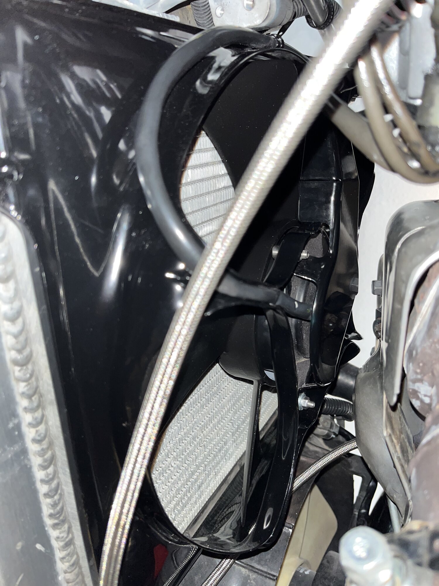

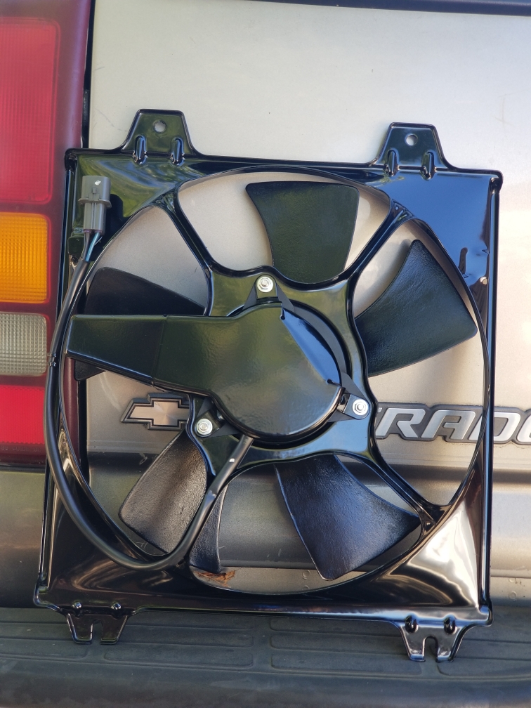

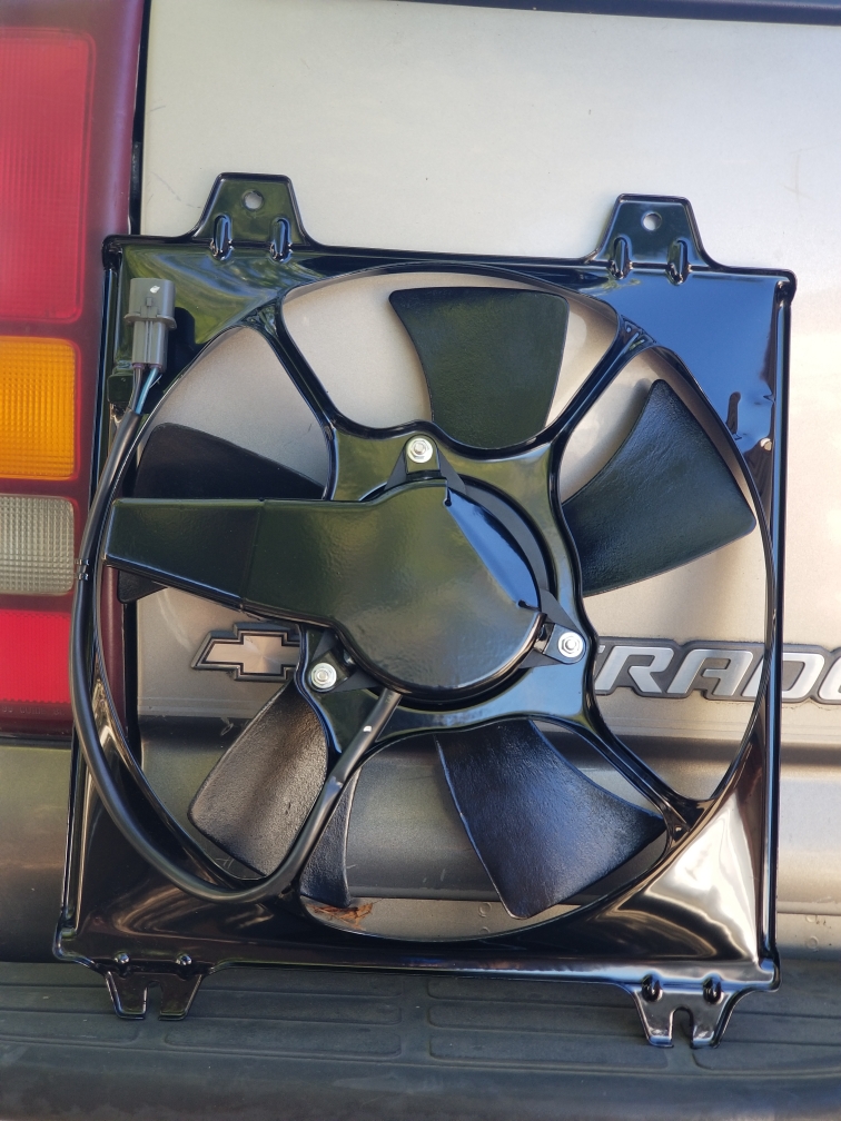

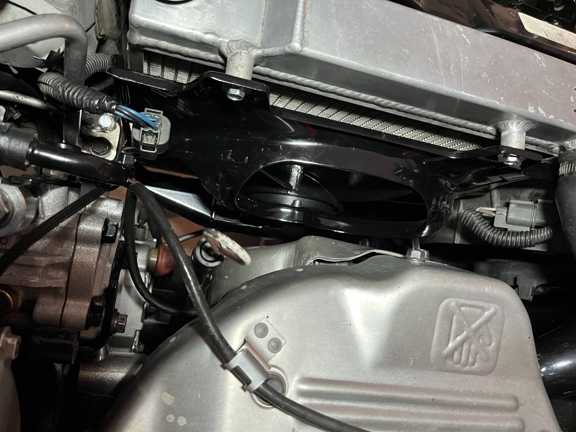

Fan - installed - and tested!
and from below

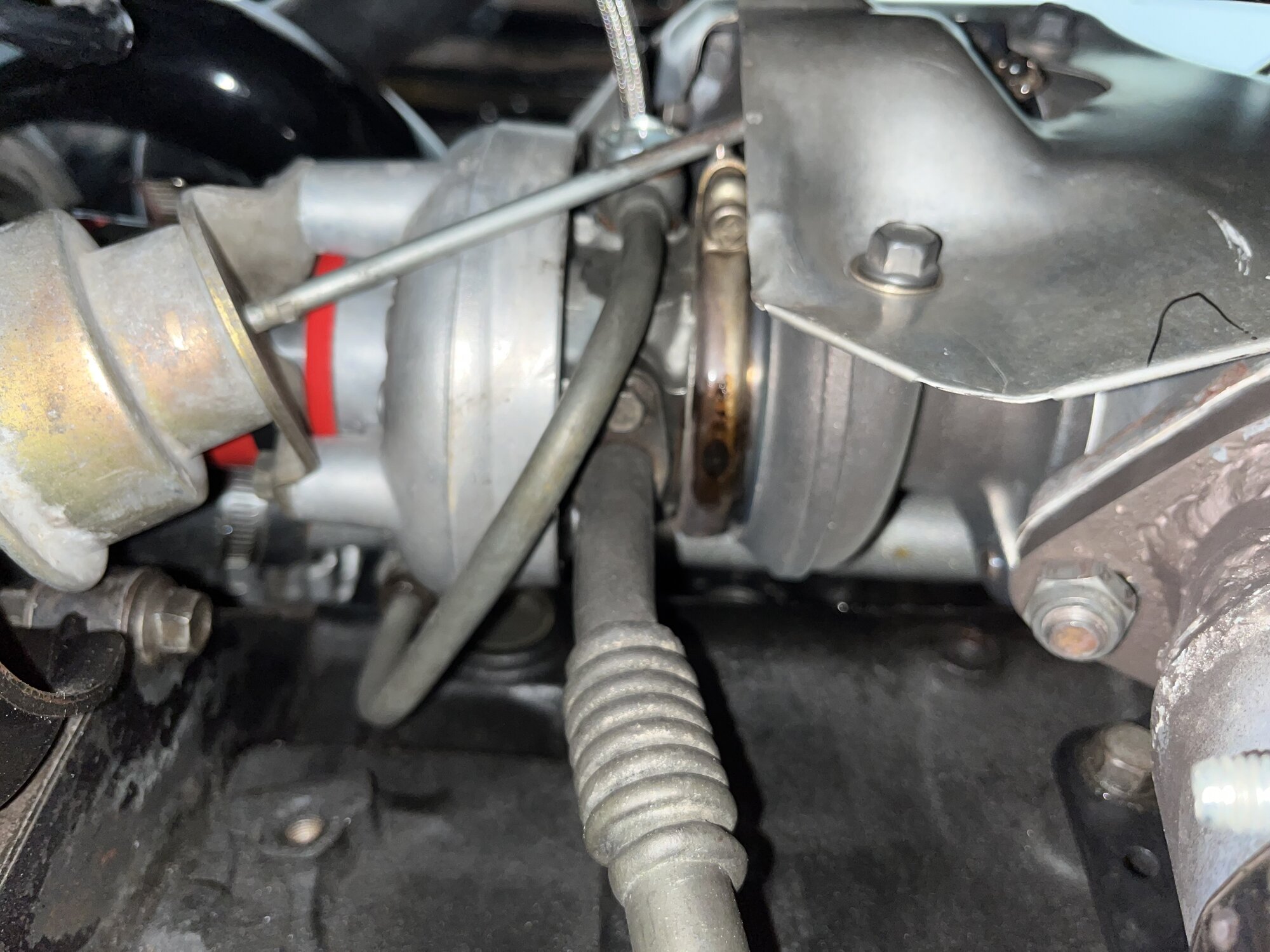

I took a moment to look over stuff. Replaced a missing down pipe bracket bolt - (hmm, where’d that go?) and I see there is a bit of oil on the turbine housing to cartridge clamp. (hmm, wipe that off, and see if it returns) Ah, well now. Ever since the head swap and the turbo upgrade, I’ve been seeing oil smoke in the exhaust occasionally. Now I think the turbo more than the head as the source.

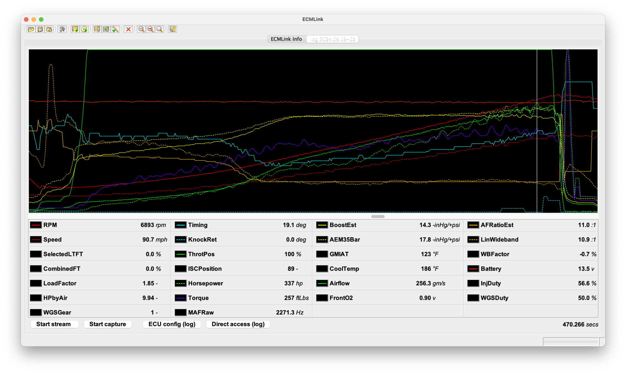

Playing with boost to get to different parts of the SD VE table. I wanted to cross over the 98-99 VE peak with a couple pulls, and I made a small tweak to global fuel just to be sure I am dialing in the table in the right direction.
This was 50% duty cycle boost control ~14.6psi boost
I made some more calibration adjustments - especially in the low RPM area between 2-3K. I over shot it a little. Its hard to control between 2k and 2.5K
This was 60% duty cycle for boost ~15.6psi

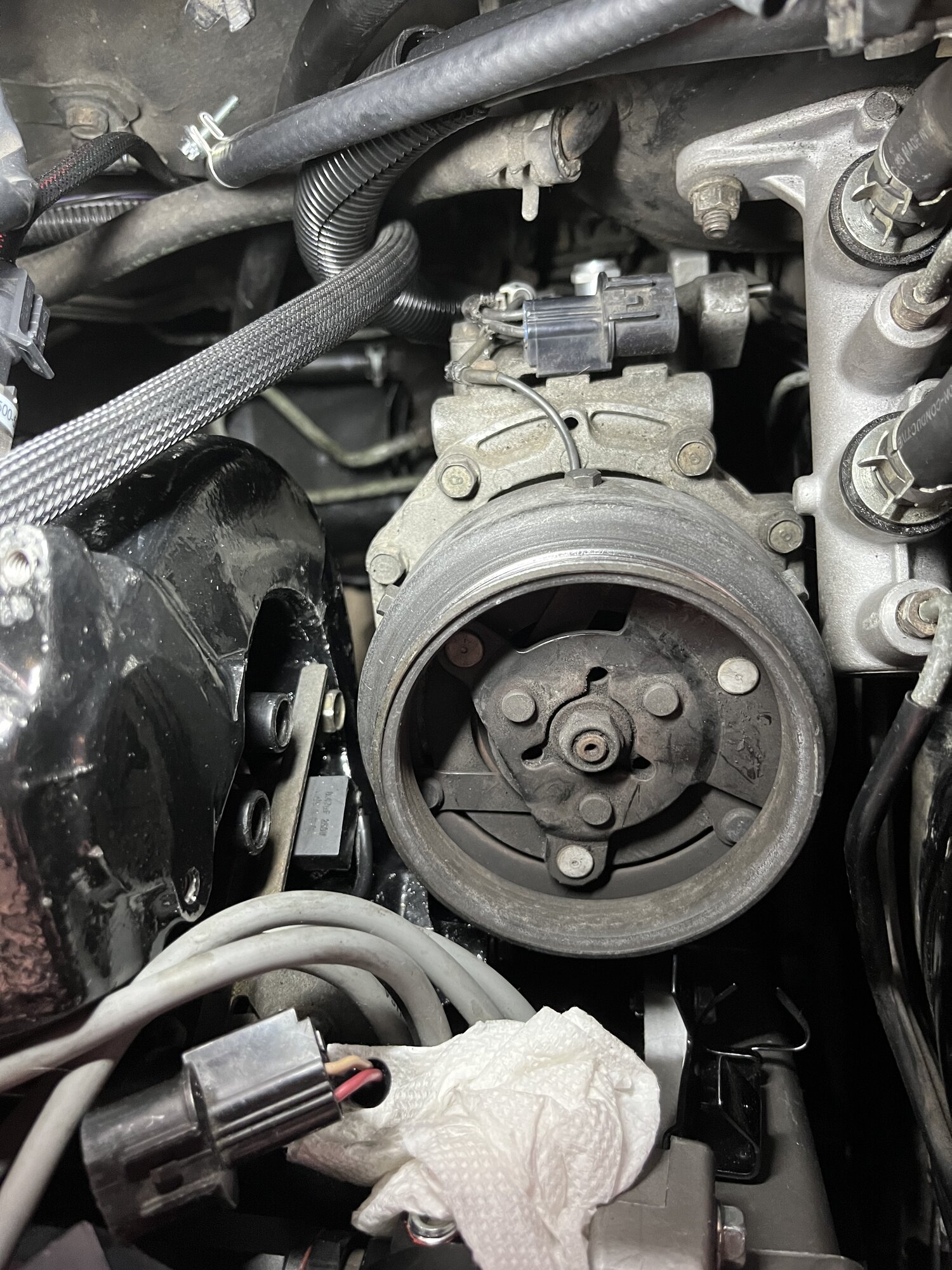

Hoses ready for pickup,

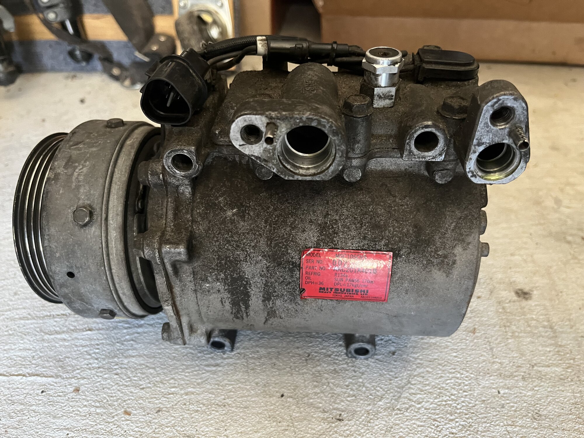

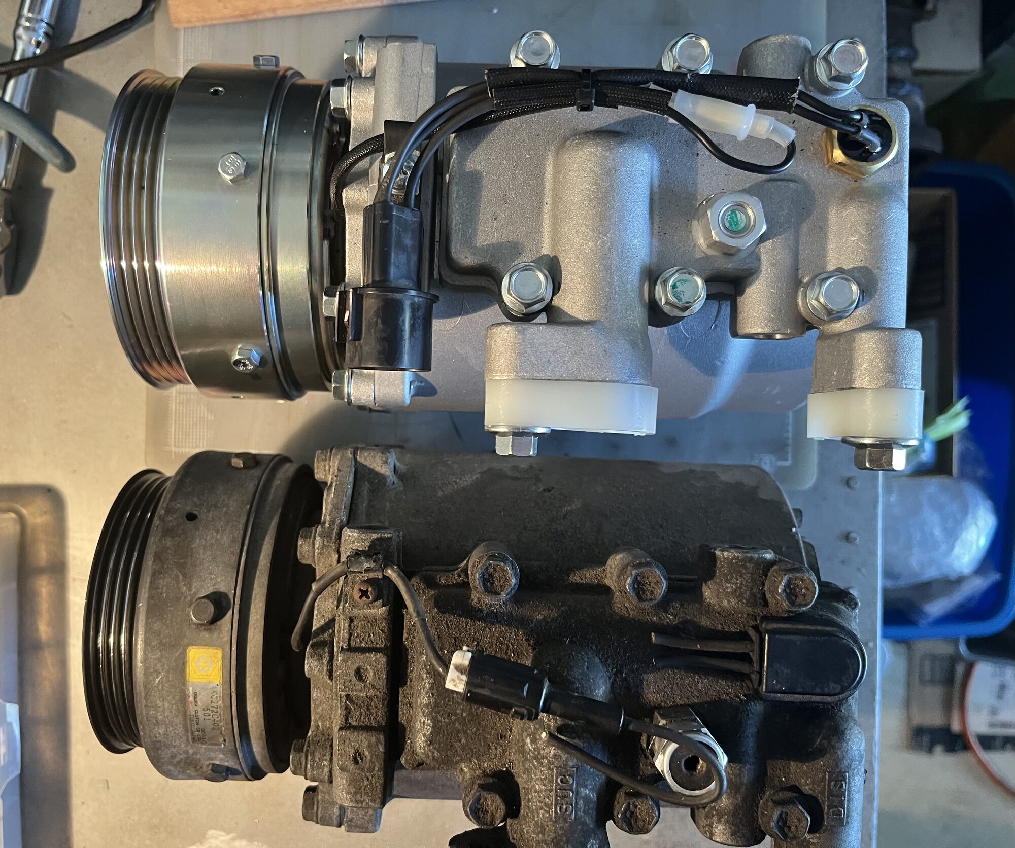

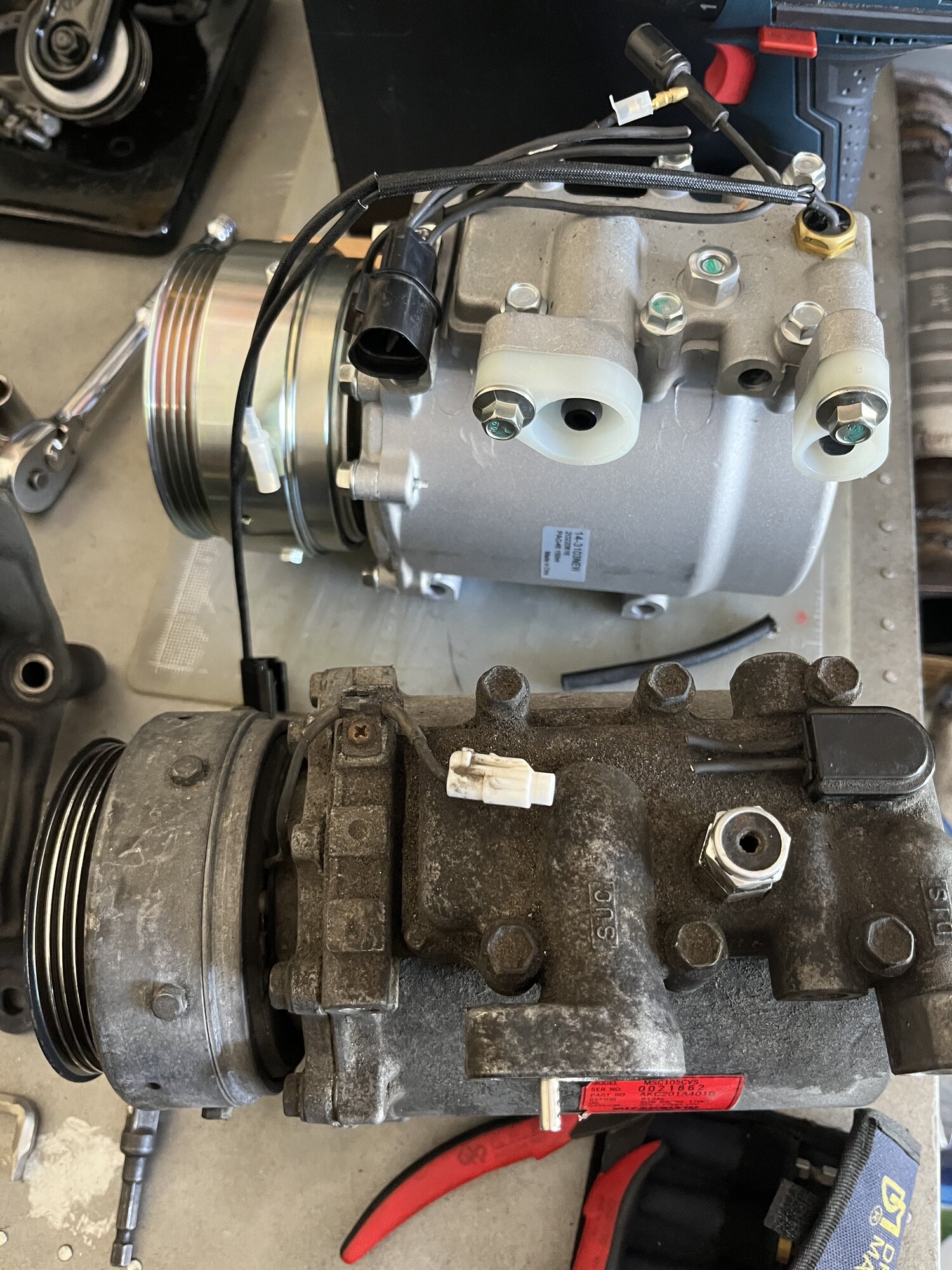

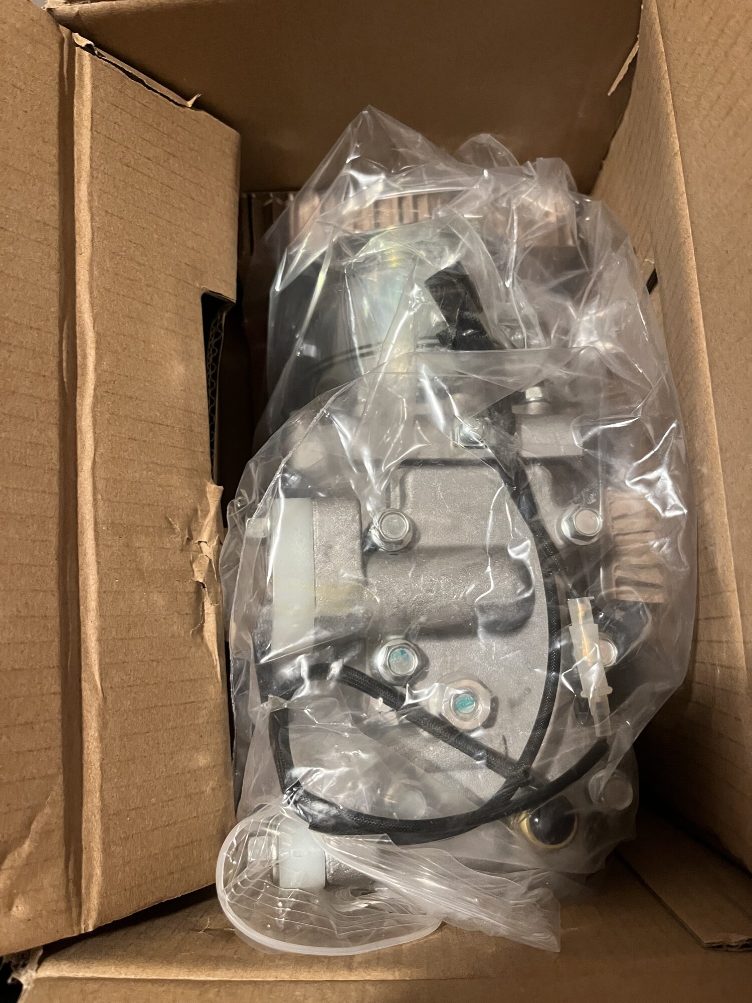

New China made compressor arrived, and I need to transfer over the wire harness from the old one.

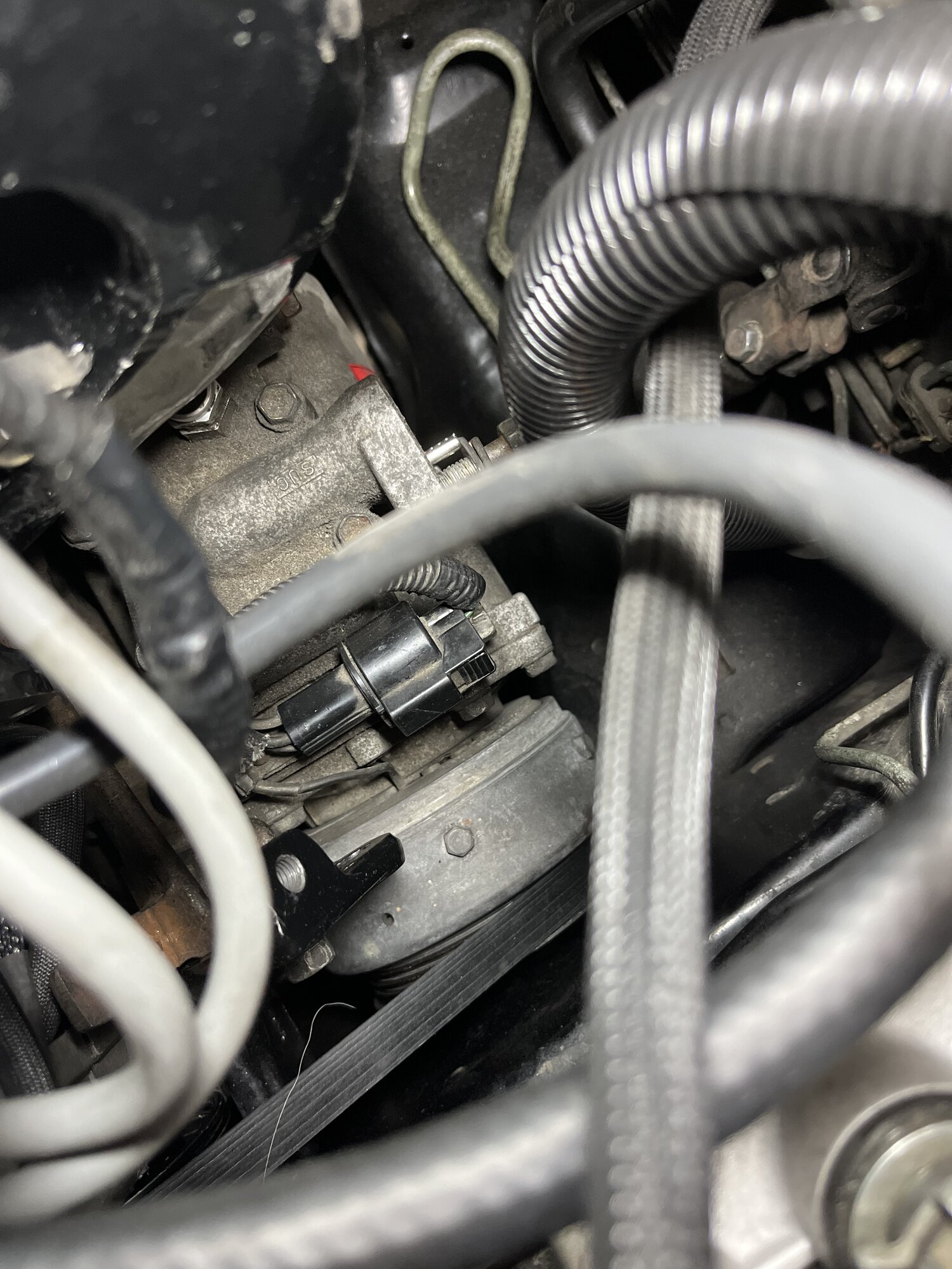

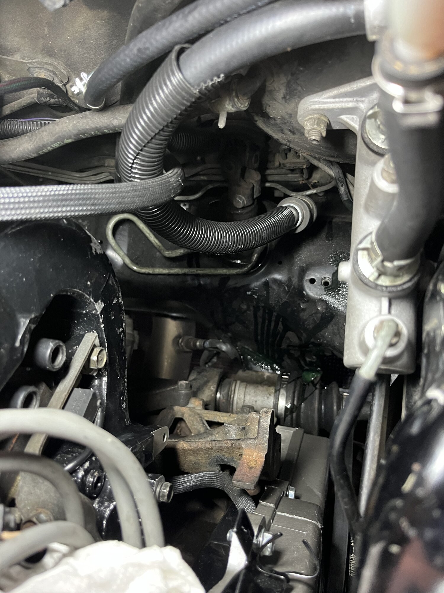

Can you fish the thing out from the top? or is it better to go out the bottom removing the down pipe, or is there a gap to the wheel well?
I just went through the compressor swap on my GST. The car has a 7 bolt though but yea I was able to fish it out through the area between the L strut tower and engine. Almost started taking the battery out to run under the IM and R strut tower but it worked fine. Need to unbolt the brake fluid can and the clutch fluid can as well as the PS lines and unplug all the wiring in that area and it is super tight best have a beer first.

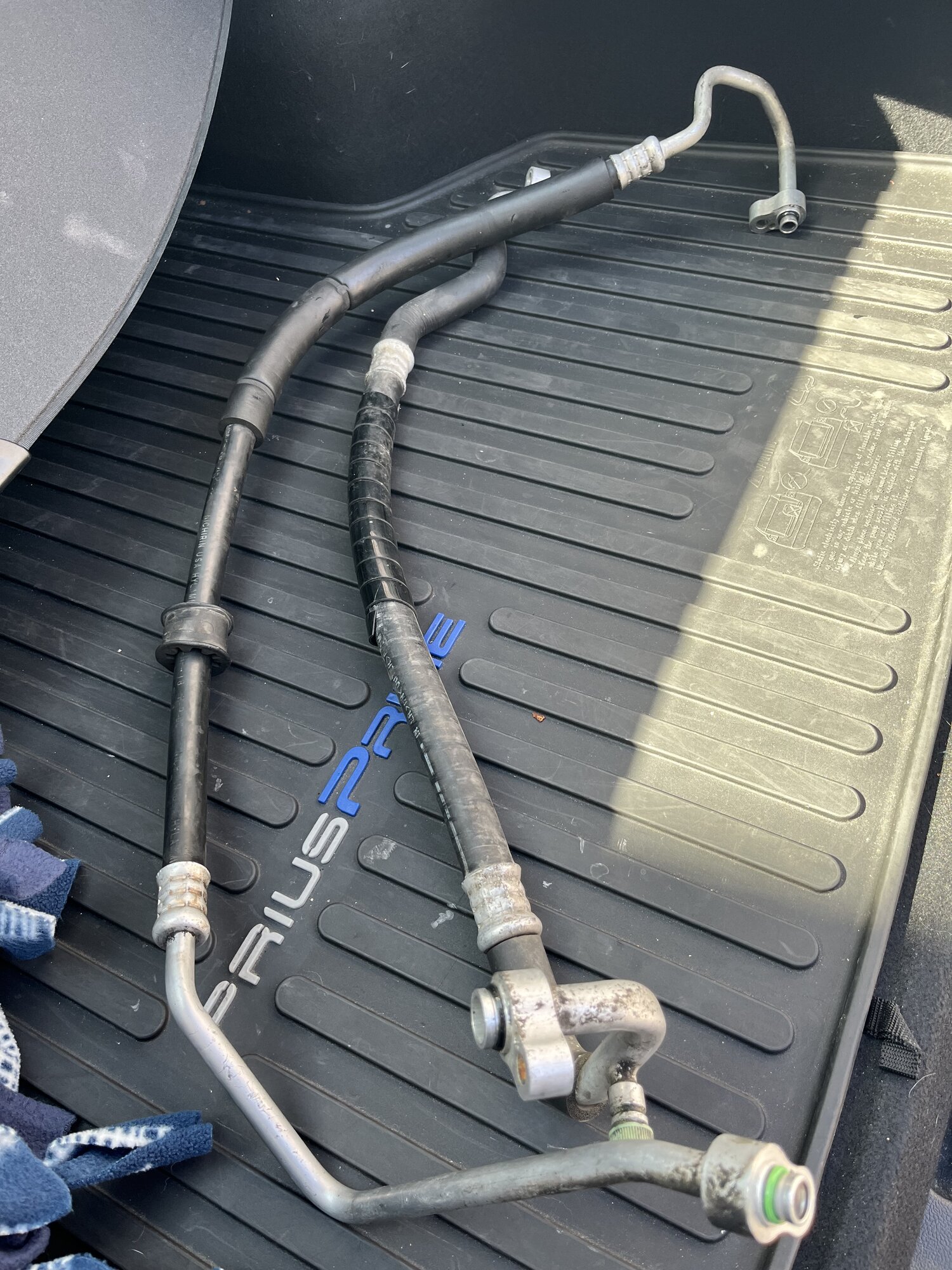

Soo, was the ac leak came from the ac line joint where rubber o-ring sits or somewher along the line itself? I'm planning on putting ac back in my car and was thinking about using my old lines with new o-rings, i do have new ac compressor, dryer and condenser.
In my case, there were 2 leaks detected so far. The condenser probably took a hit from a rock, and had a leak, that was replaced. The upper hose had a leak in the hose itself, right where the hardline is crimped onto the rubber near the PS pump. My hoses are original 30 year old rubber, so this was not a surprise. Since the system had lost it’s charge, I decided to pull both rubber lines and have the rubber replaced.
I did not find leaks at the o-ring connections, but I will be using new o-rings.
The components I did not replace are the hard-lines, and the AC core in the dash.

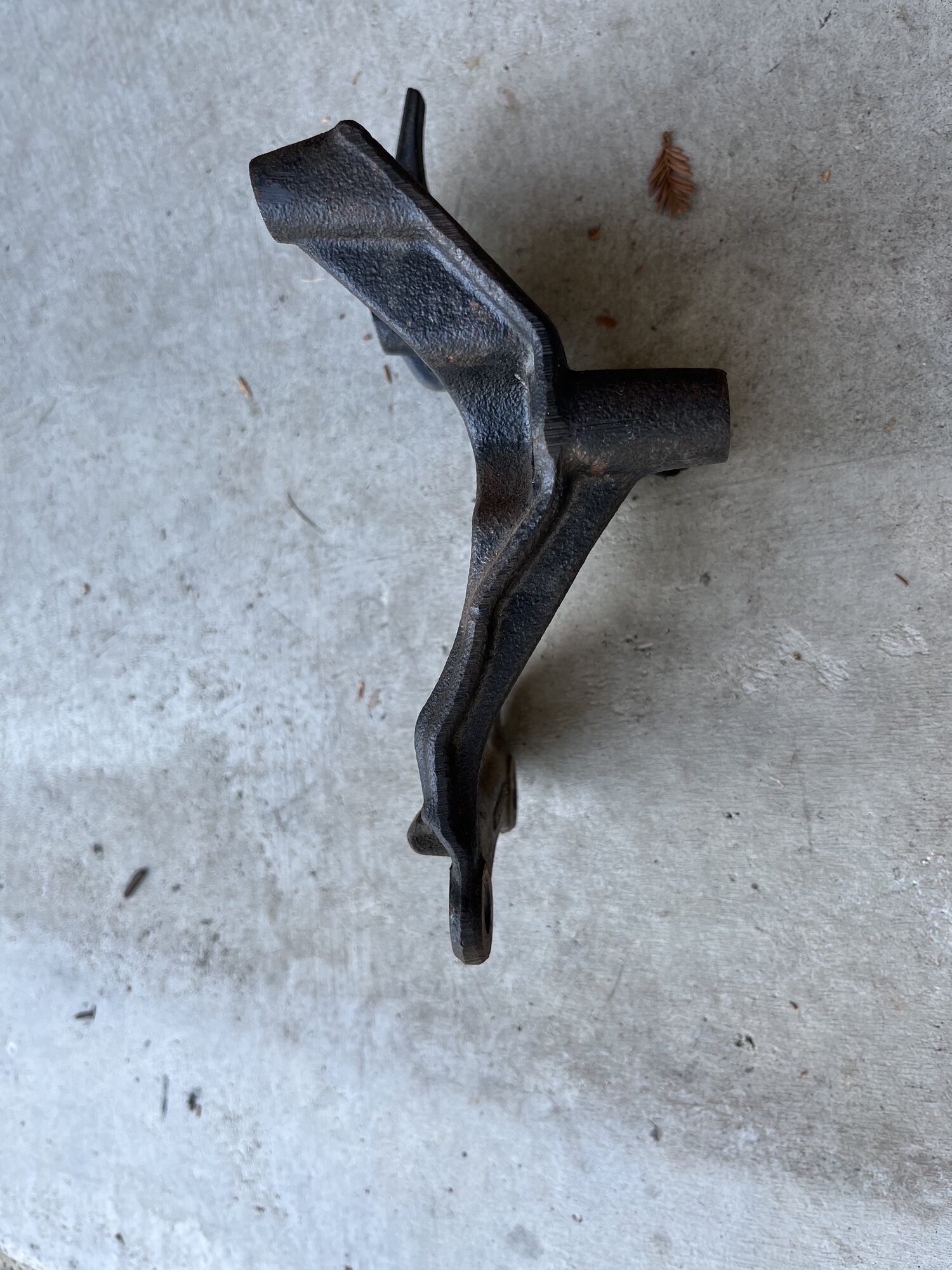

I measured about 6" from my 1G IM, to the DS Strut tower - and the brake lines next to the tower are inside those 6". I'm going to try clearing a path here.
1. unbolted the throttle cable
2. disconnected the coil pack spark wires (left it in place)
3. disconnected the fuel return hose from the fuel regulator at the rail
4. disconnected the engine wiring harness that wraps around the end of the IM
5. unbolted the brake fluid reservoir, tilted it out of the way.
6. remove bracket on front sub frame holding the PS pressure hose
7. remove 95/96 cam and crank sensor plugs from the upper timing belt cover
unbolt tensioner

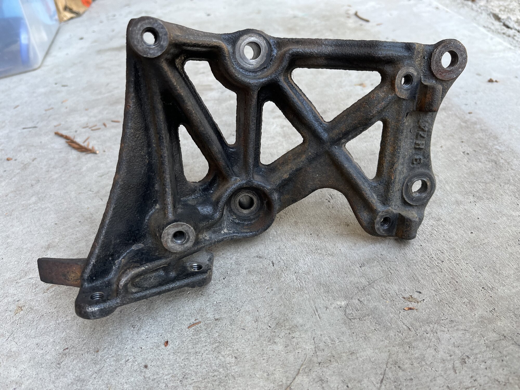

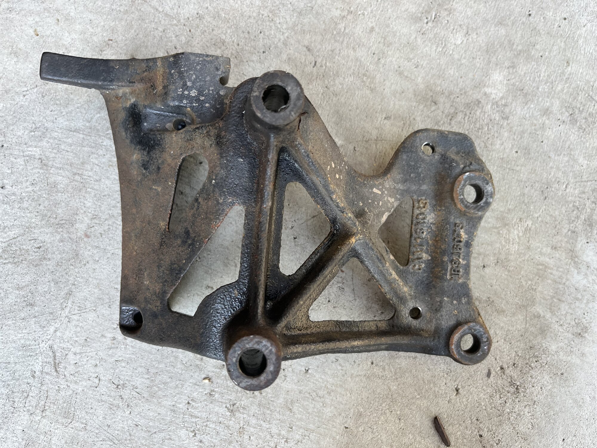

unbolt compressor
clock compressor pulley up (fluid may spill)
wiggle the thing out - push PS hose out of the way
vacancy
on the floor at last
