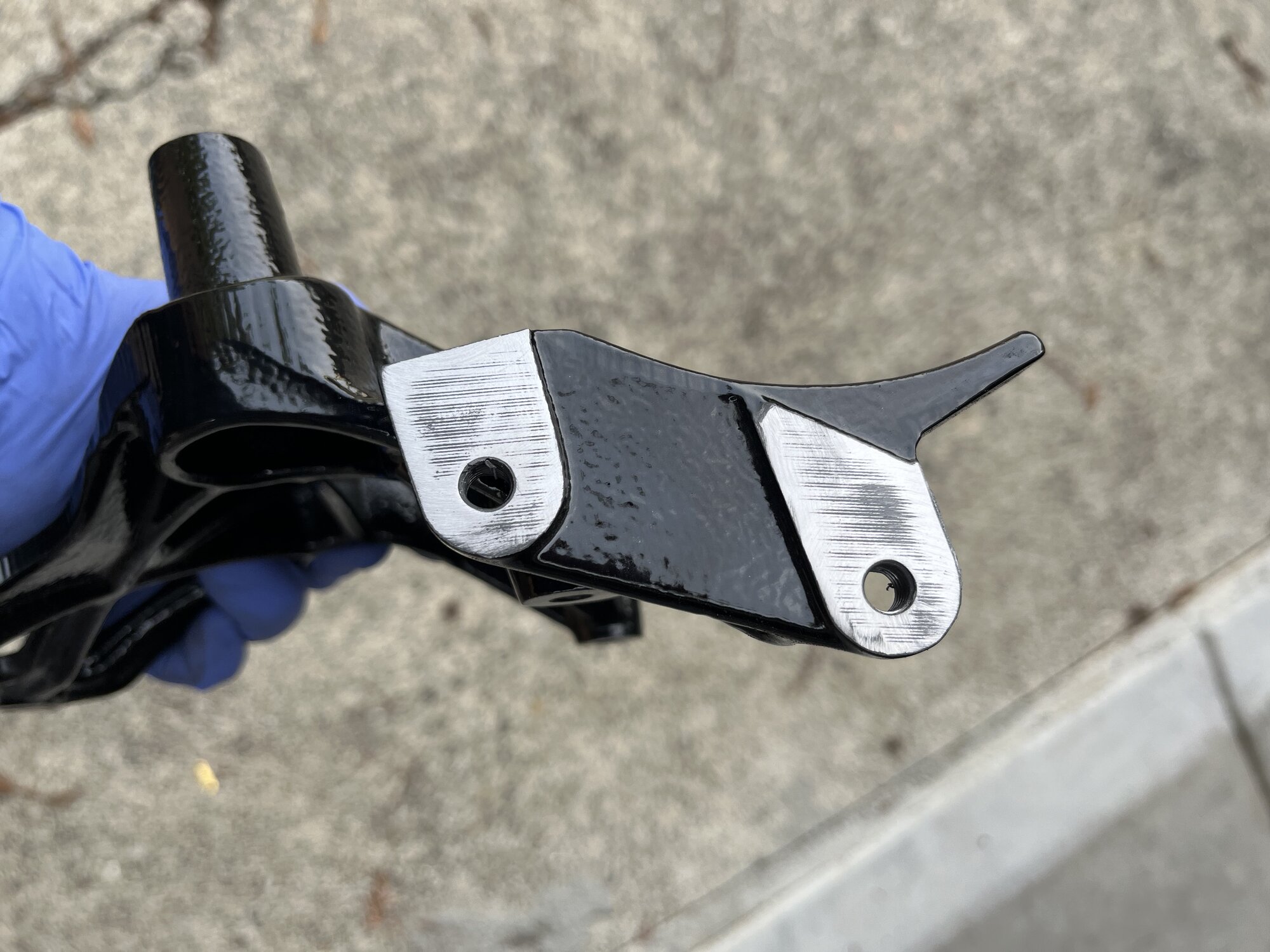

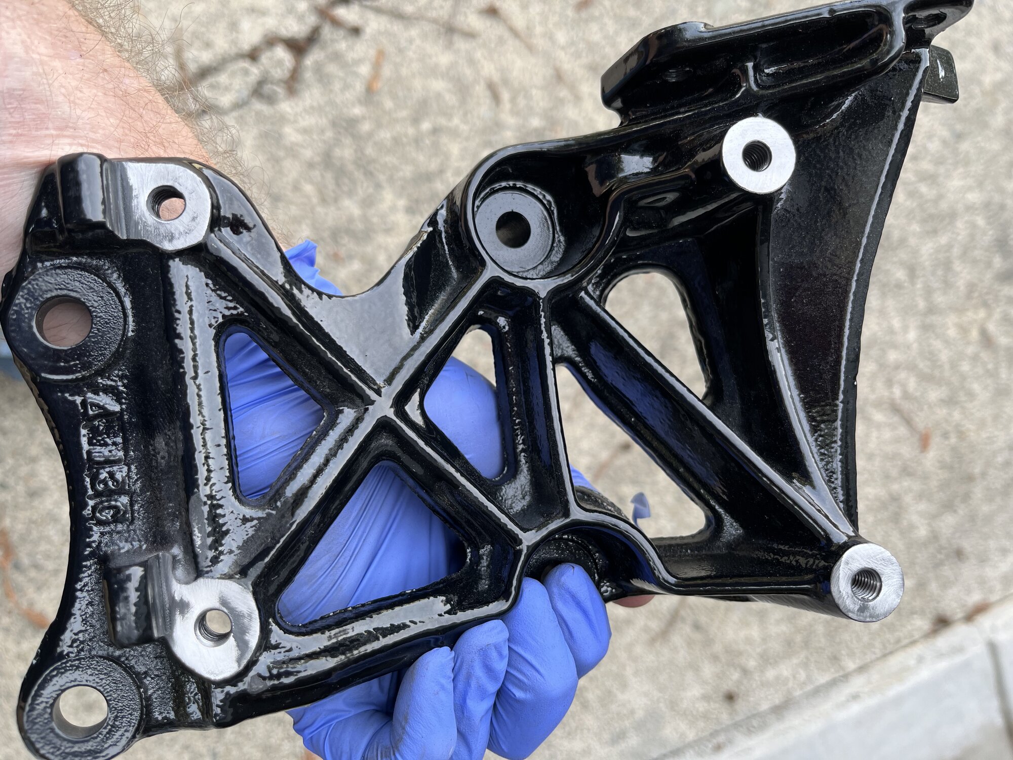

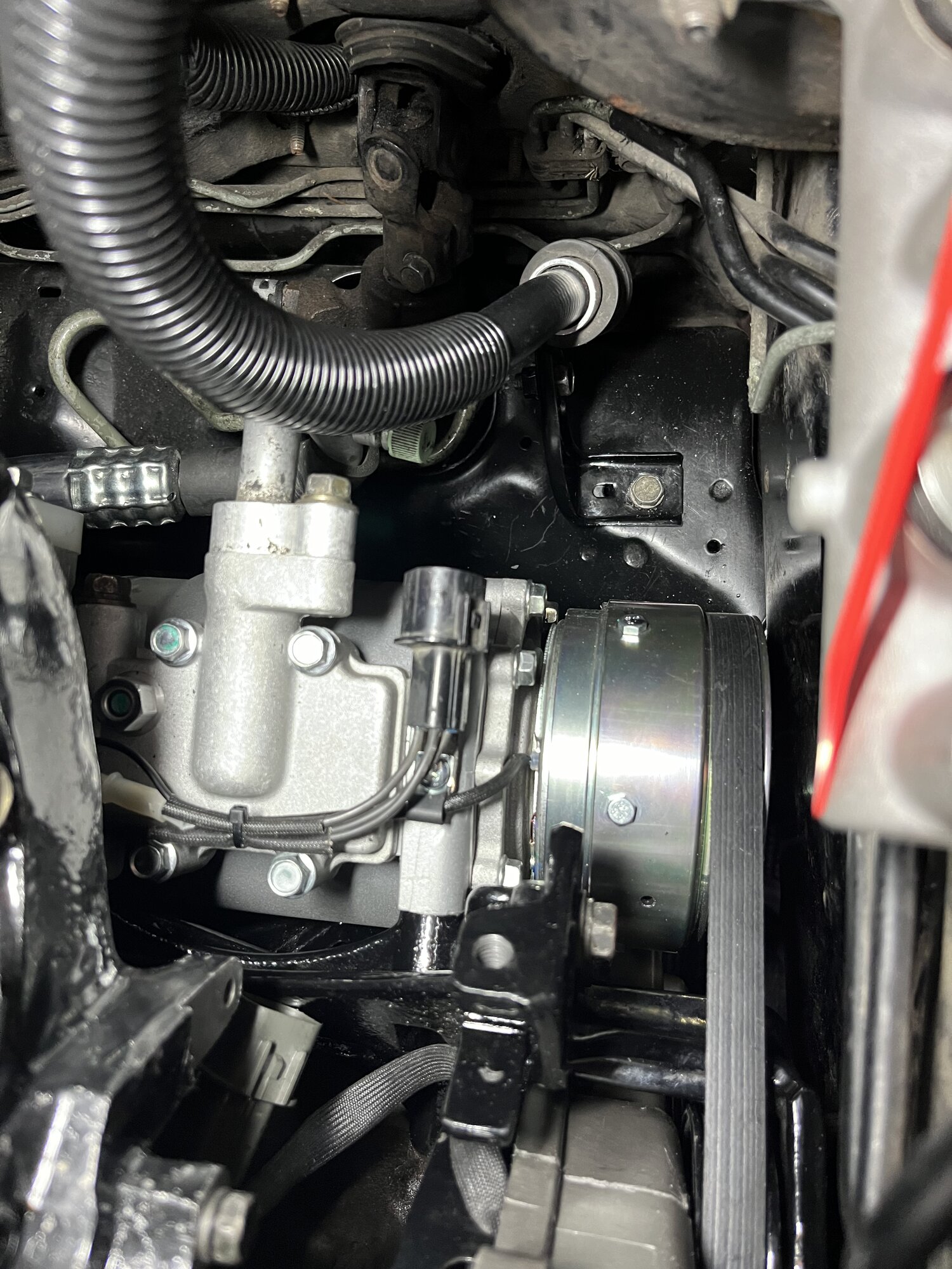

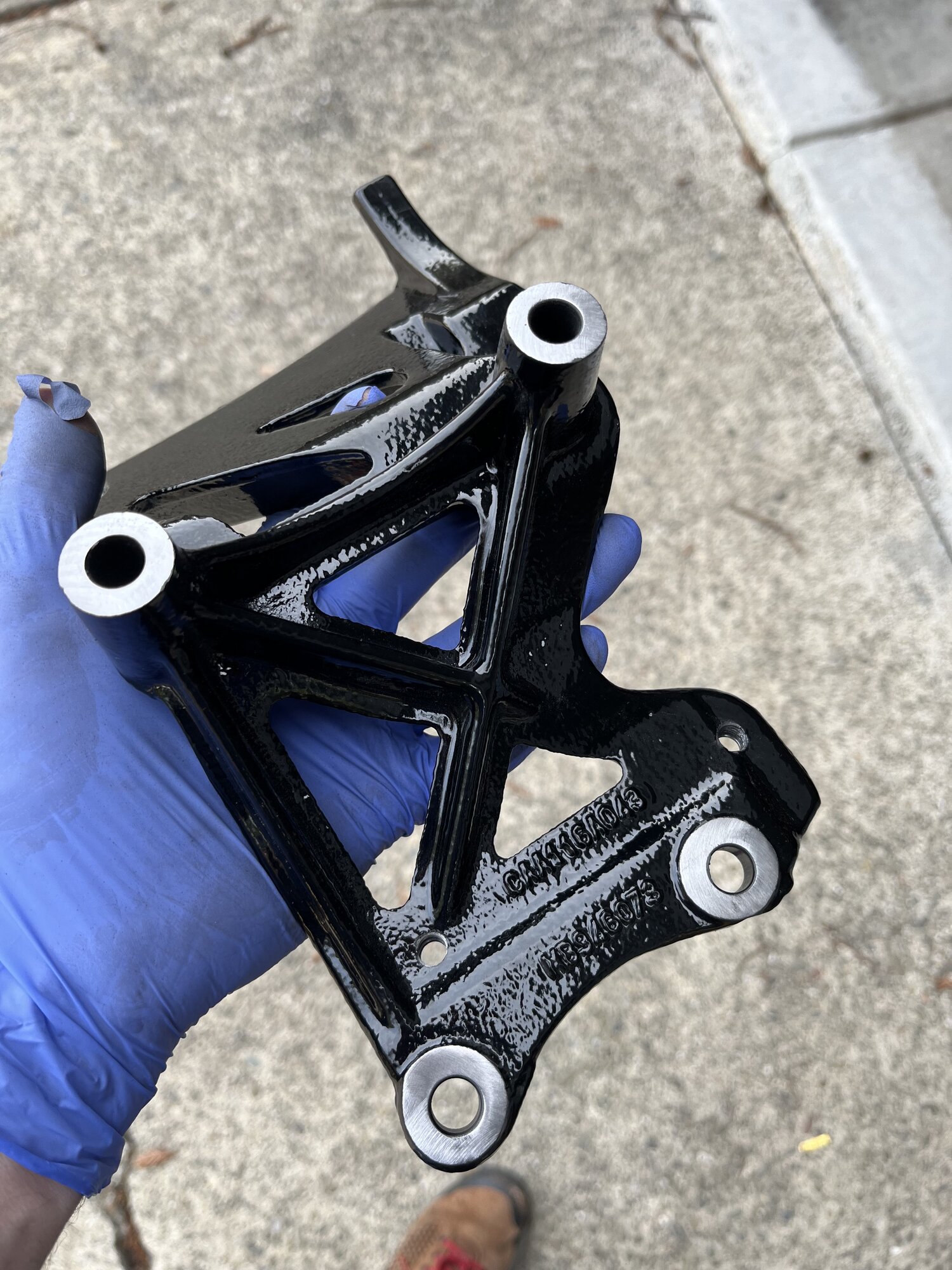

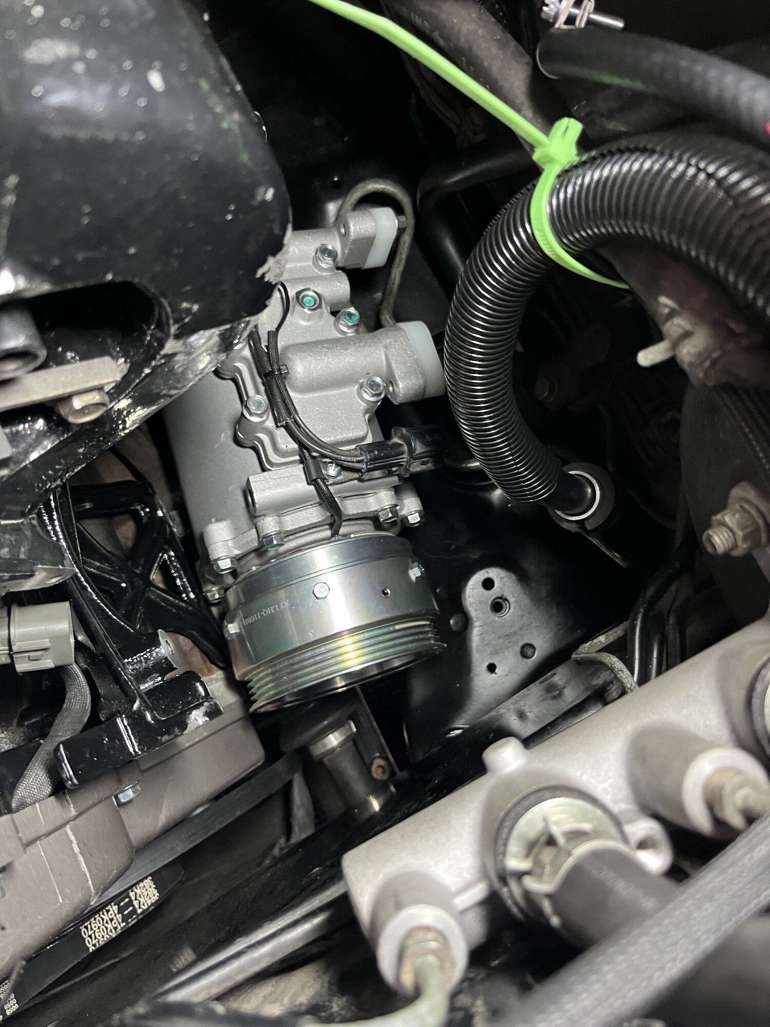

I clean off the PC on the faces that get squished by bolt torque. I learned that PC gets soft when it gets hot and this can make things loose. Also, chased the threads.

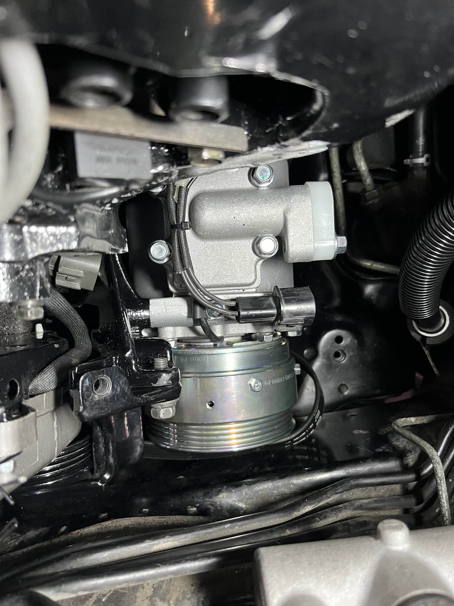

Now for the install,
Bracket first, then carefully work the compressor into the gap, zip ties to hold that pesky PS pump hose back.
4 bolts in
Tensioner, belt tight, 1st hose on, PS bracket back on.

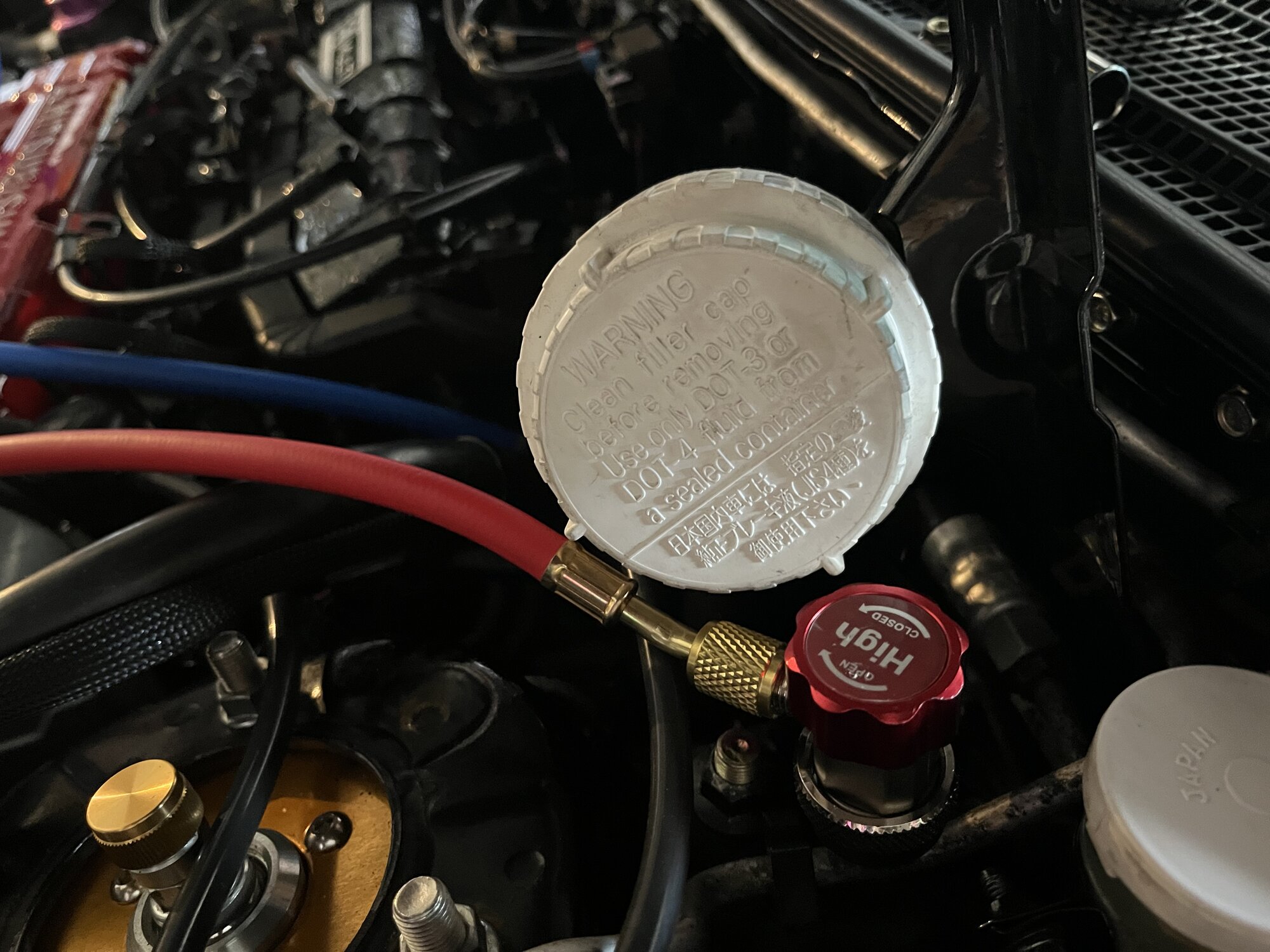

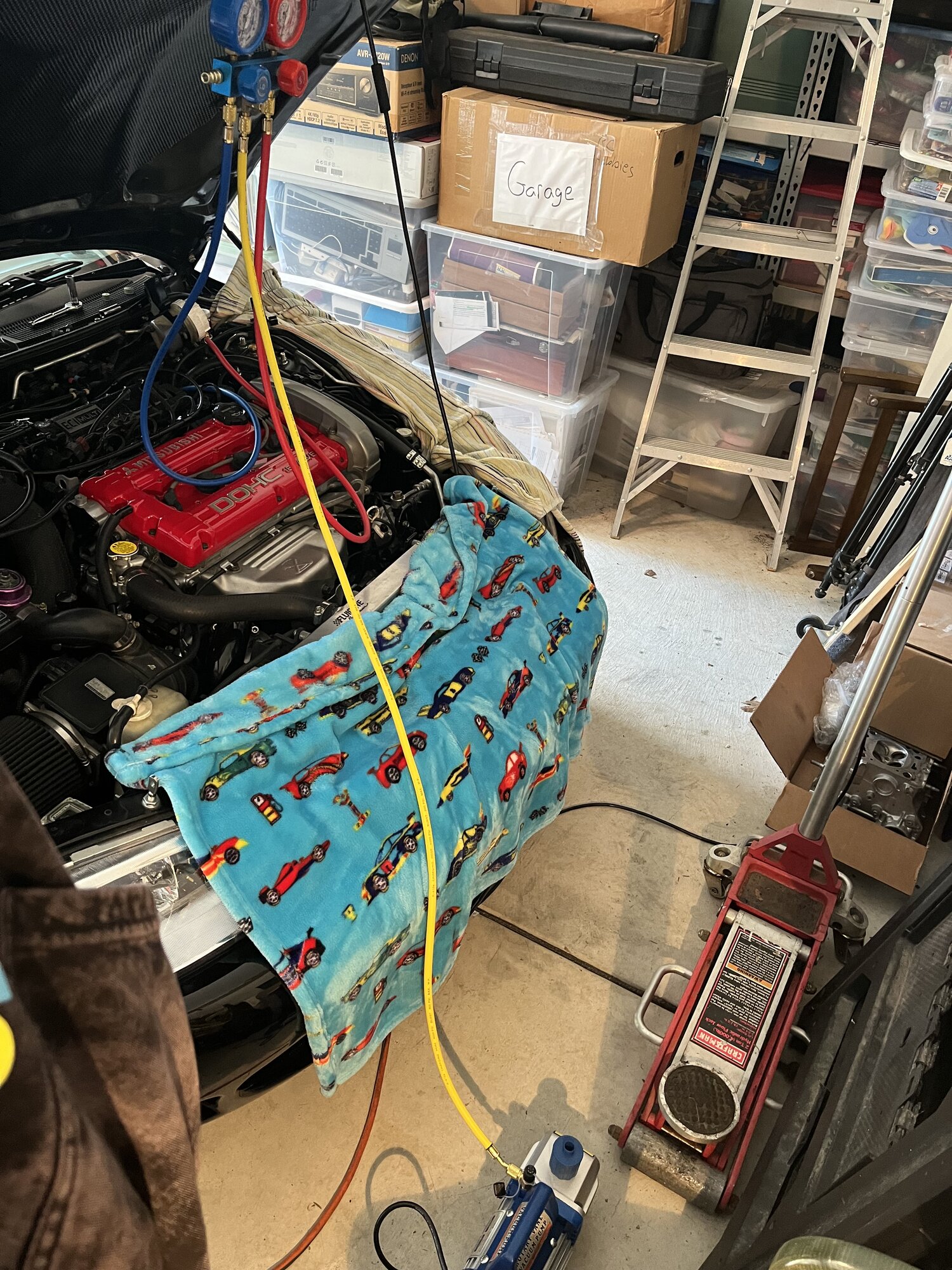

Well, the economics of AC repair by service provider is pretty bad. I decided it was worth it to buy a double gauge recharge kit with vacuume pump and 6 cans of refrigerant for ~$200
I figured its worth failing for less than the shop fee, and I will eventually figure it out.

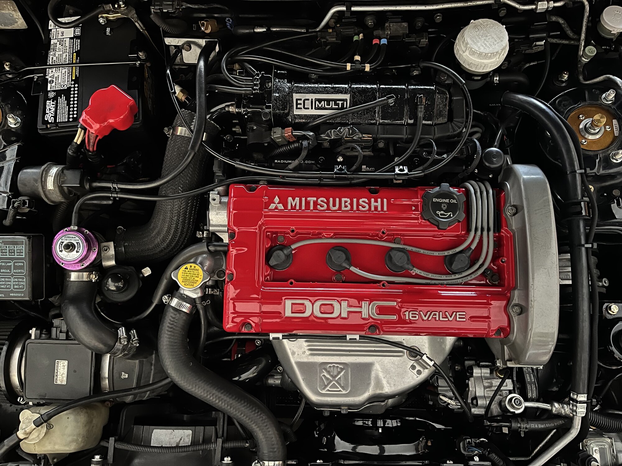

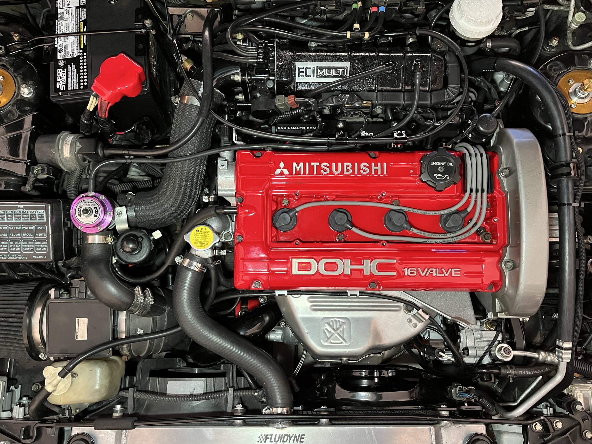

I'm sure you know how to vacuum/test an A/C system, so I won't patronize you with info you already know. But it always astounds me how sneaky/OEM this car's engine bay looks. Especially considering what it is and how much it will rip on full kill. Love it.

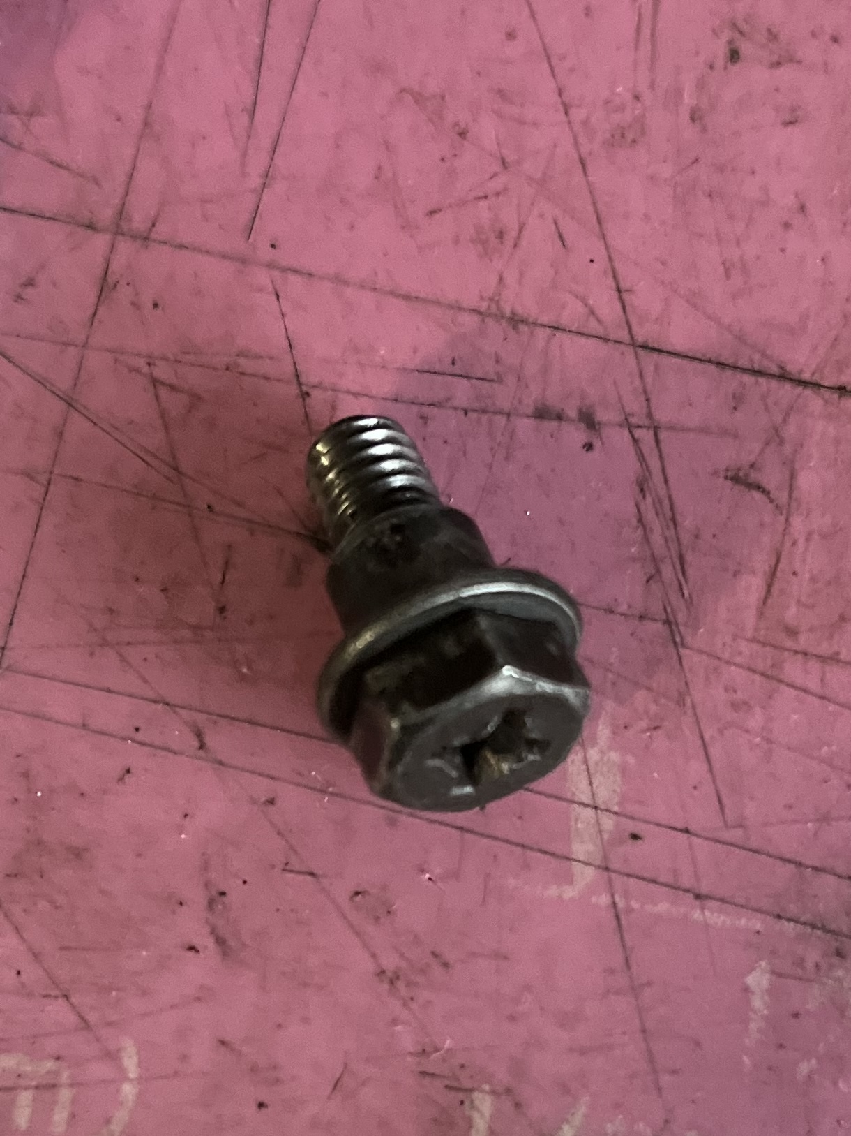

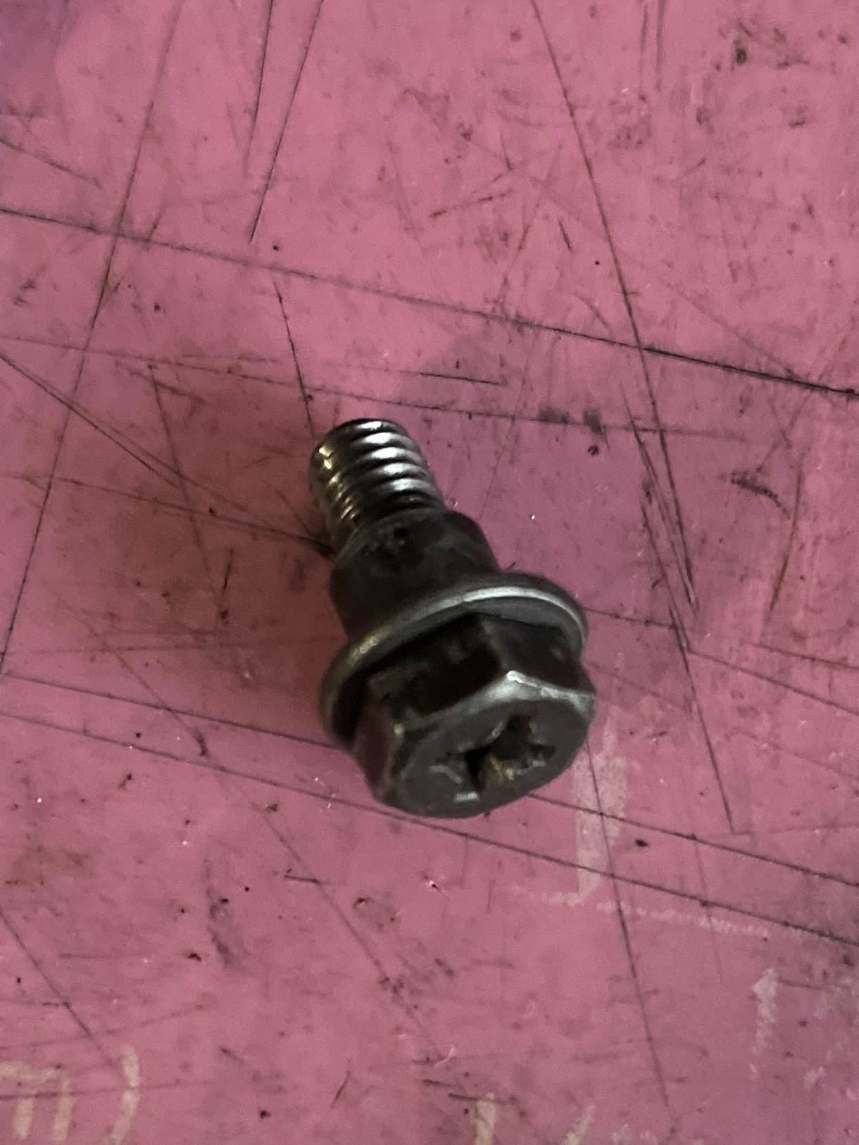

I’m missing one of these plug cover bolts - Anyone got one?
I do. PM me your address and I'll send it out.

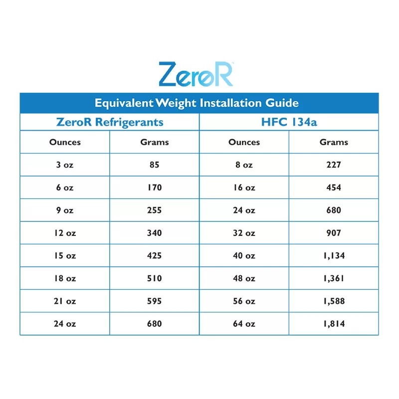

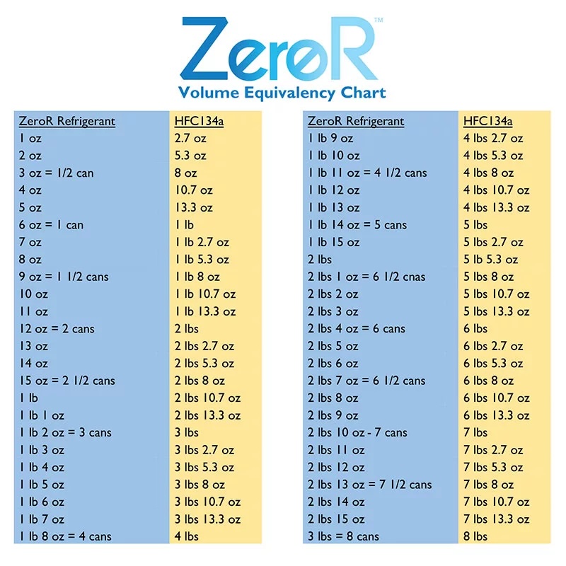

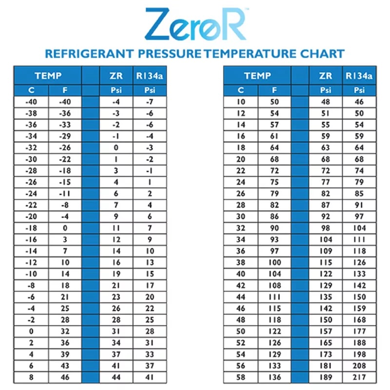

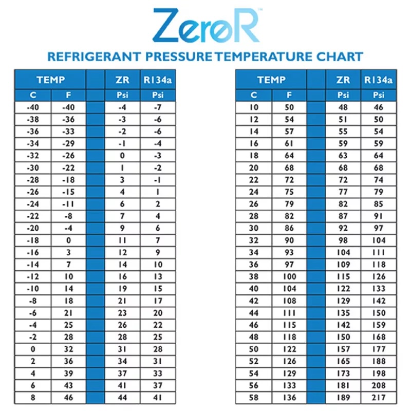

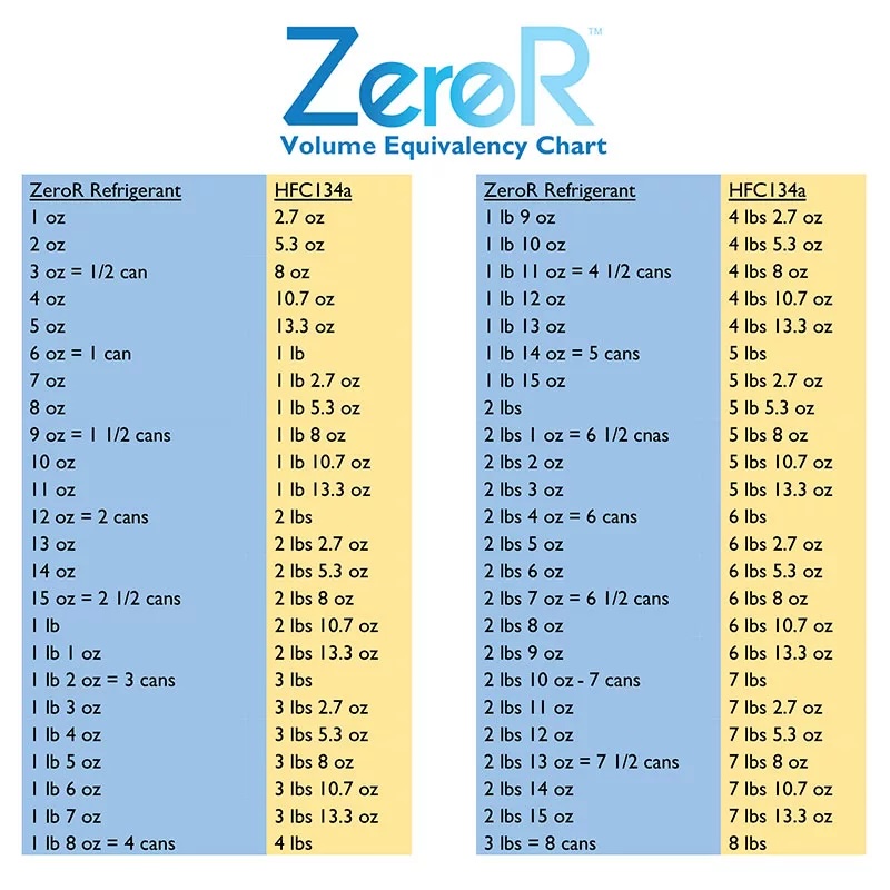

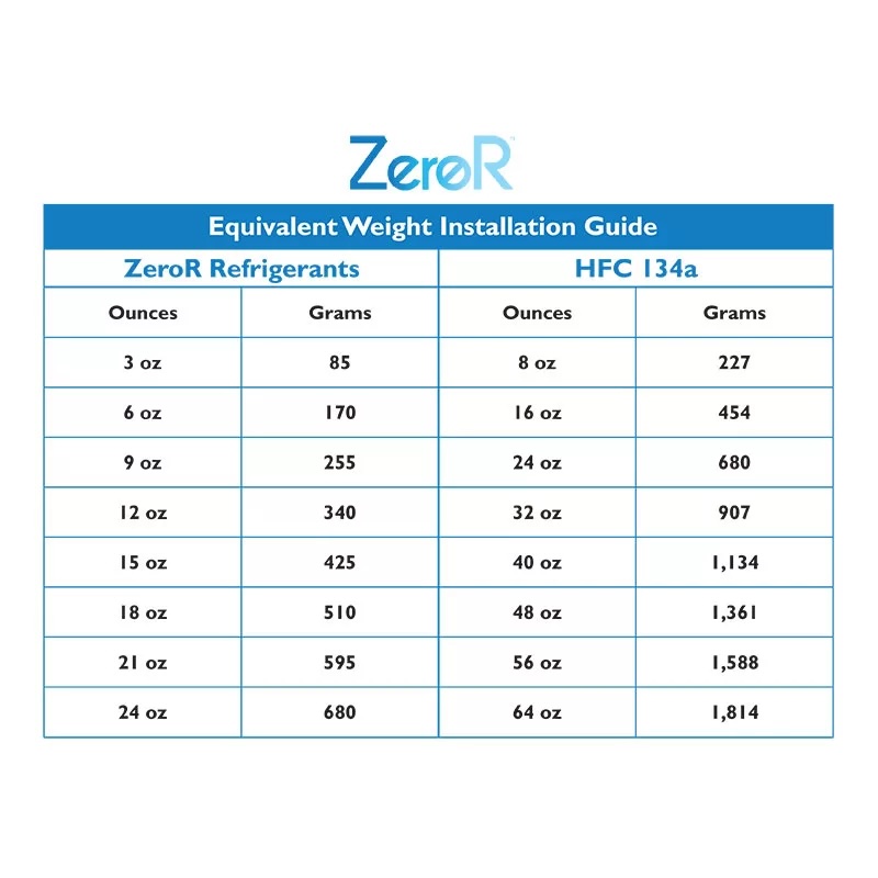

I gave myself extra difficulty since I am using a lighter weight 134a substitute. So I get to have fun with conversion charts to figure out how to get the equivilant of 26oz of 134a, using the ZeroR product.
Looks like I need 9oz - 1 and 1/2 cans. I'm going to need to find a scale for this.

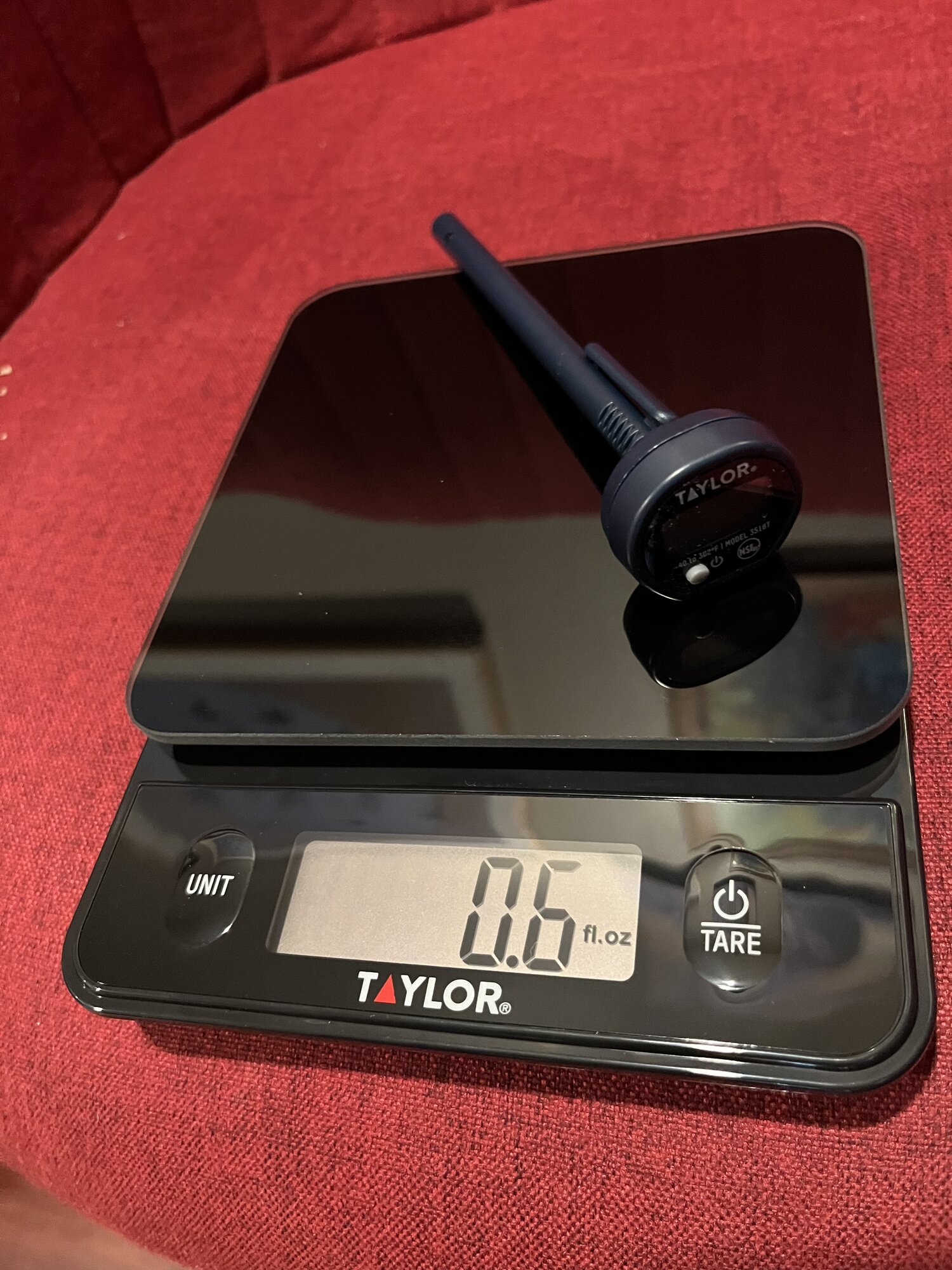

Grab a Walmart kitchen scale. Weigh the can and just subtract everything above what the can advertises the weight of the product is. If you have an empty can of the stuff place it on the scale and hit “tare”. It’ll automatically zero the scale and only show the weight of the product inside. :)
Target! - $20 for a scale $10 for a thermometer

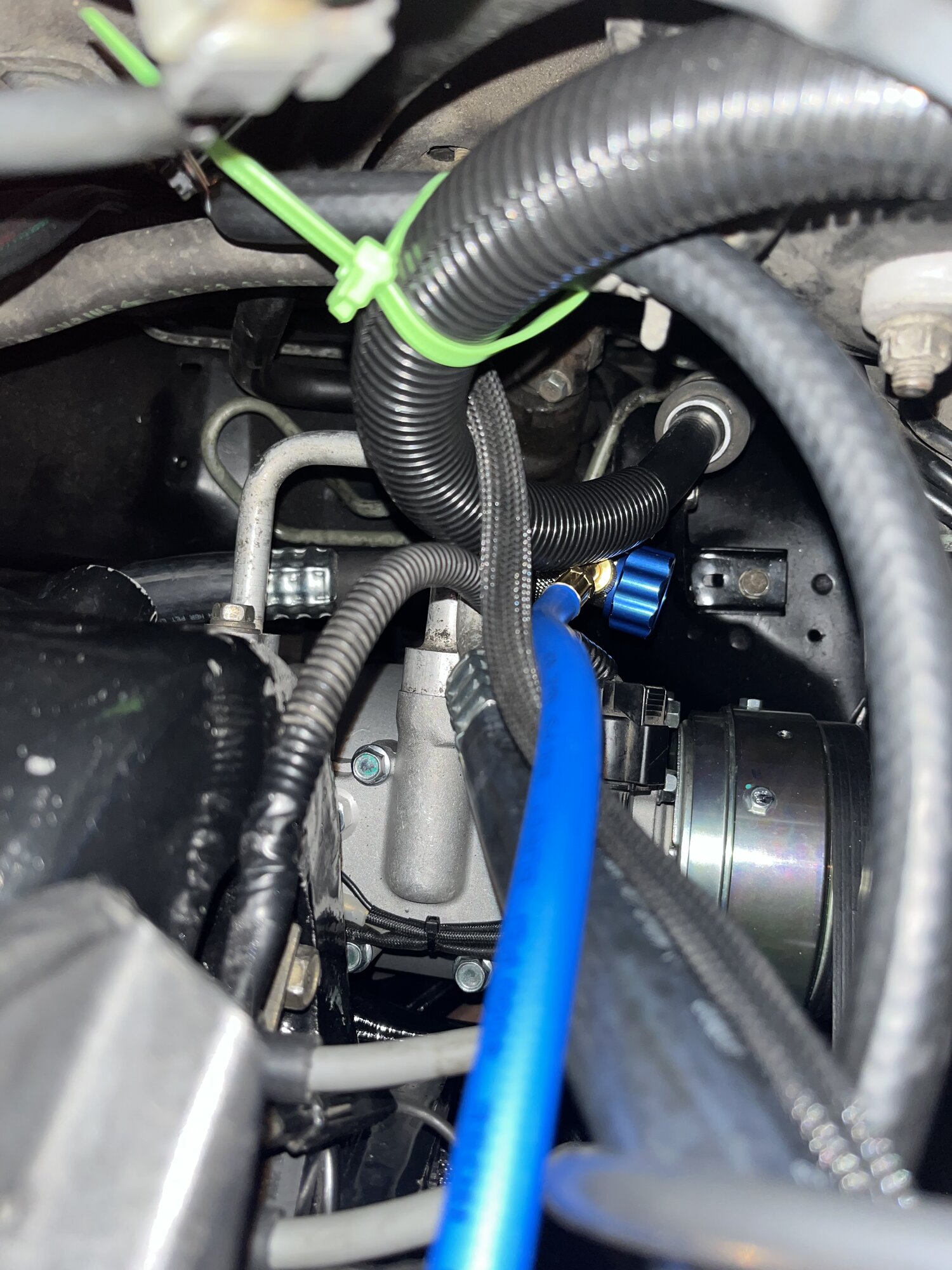

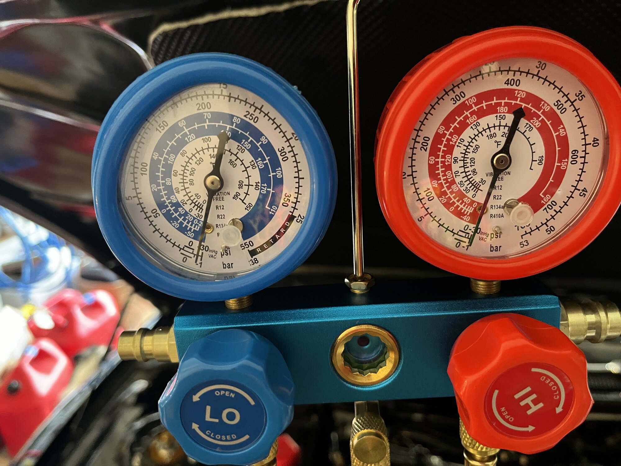

To be honest - it was my error when selecting it. ZeroR would have worked great, but the valve that punctures the can that came with the kit leaks. I could not fix it.
The kit also came with another valve that is for cans that self seal, so I picked up 2 - 12 OZ cans of real 134a from AutoZone.
I didn't have to weigh or check temperatures, cause two 12 OZ cans filled it to 24 OZ. good enough for today. I'll order another piercing valve and keep the ZeroR cans for another time.
