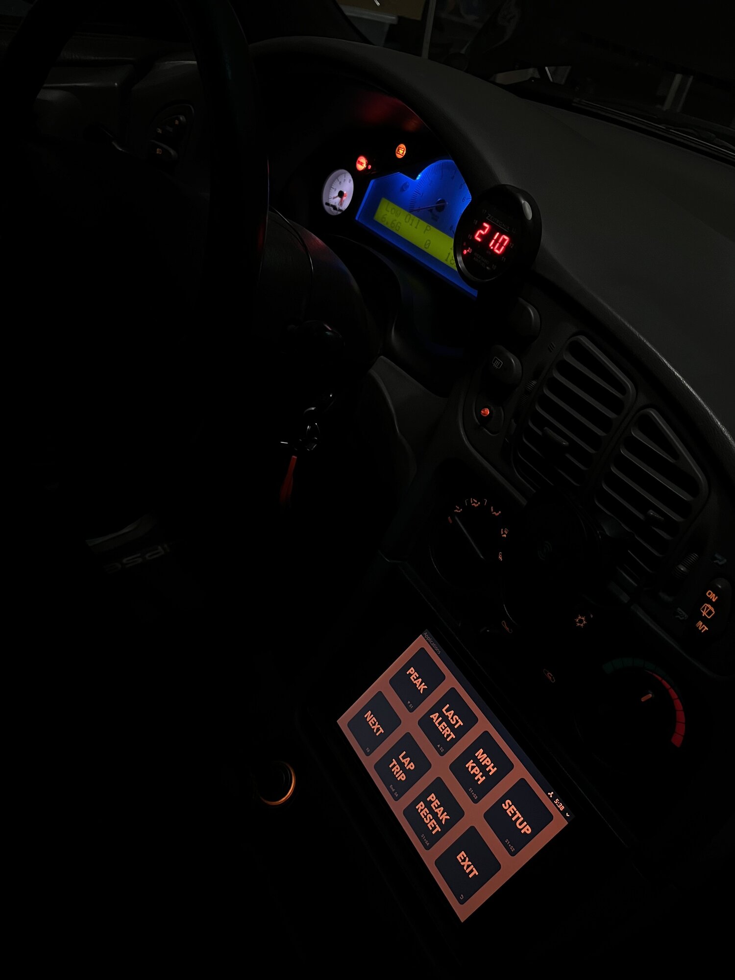

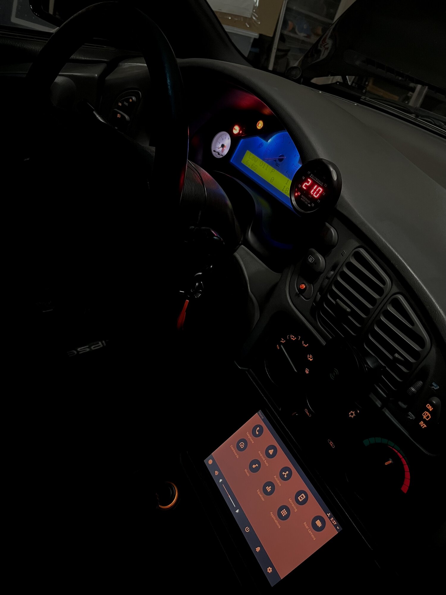

Anyone else tried to make their LCD look like the incandescent dash lit controls? Its hard.
The LCD at night can be overbright. The camera exposure exaggerates the issue. The darker shot is closer to actual perception. The backlight is not dynamically configurable, so it stays at a brighter level for daylight viewing, and I was able to force a darker-orange display color pallet when the computer is night scheme after sunset.

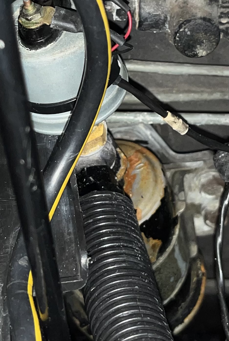

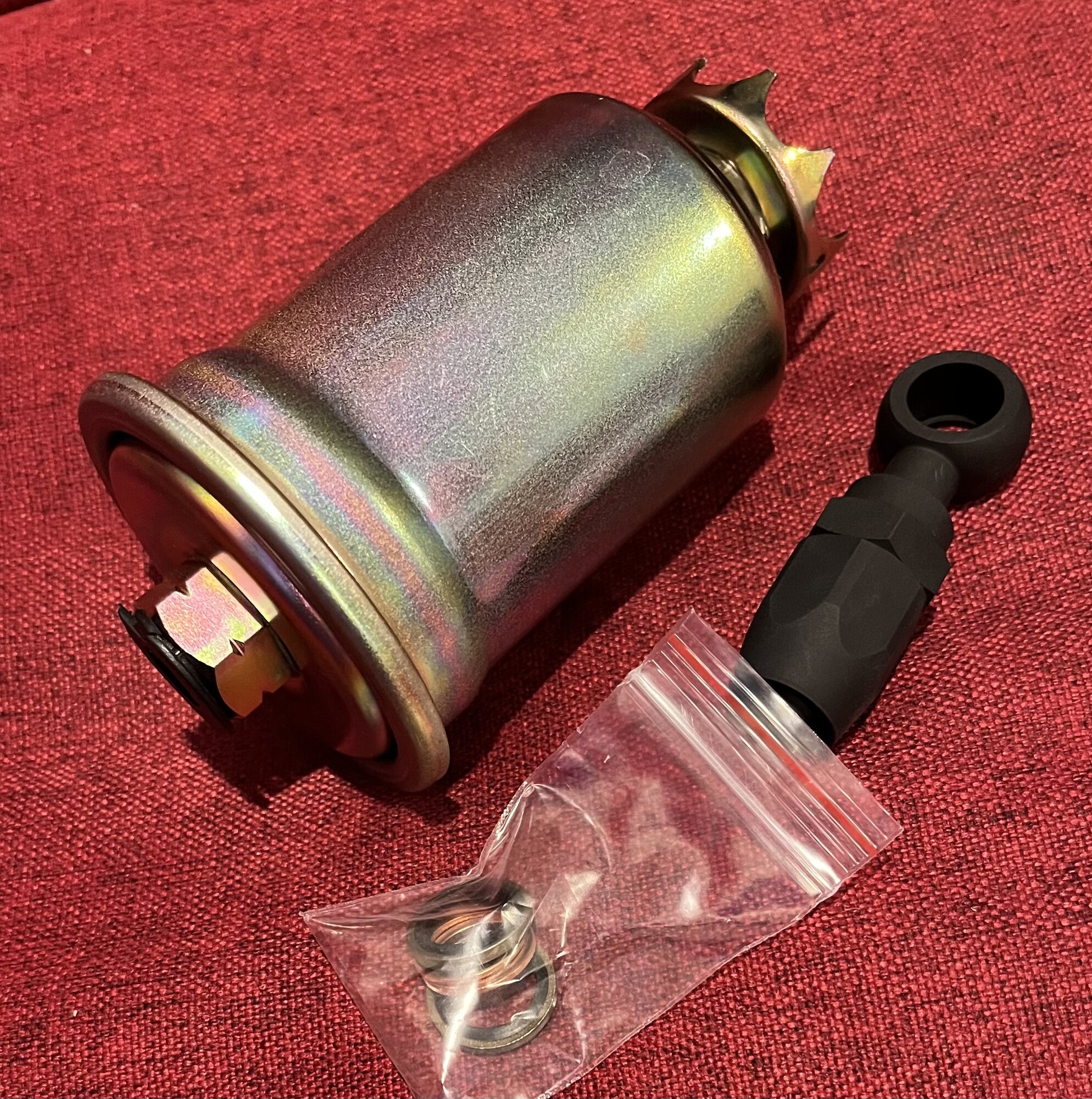

New hose end fits the factory style fuel filter. Boy did I learn a lesson- Battery acid is no joke. If you see leaking arround your battery - you need to neutralize that shit fast. lots of water and windex.

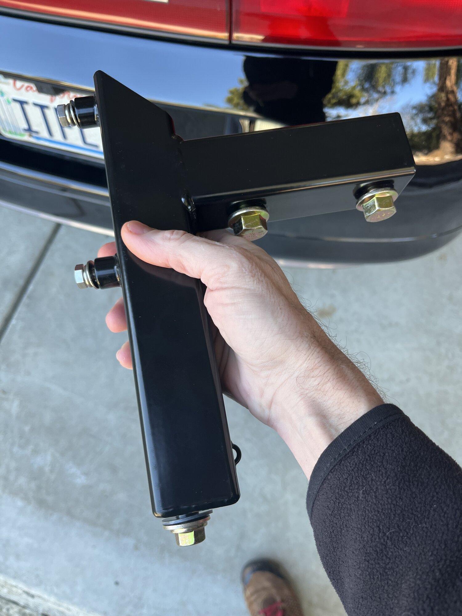

New thing arrived from @turbosax2 - A rear tow loop mount point that hides under the rear bumper cover, replacing one of the bumper mounts. This is basically required by some track day clubs. If you have ever had to pull a car out of a ditch off track, you will know the pain of trying to do it, and be glad you had a spot to tie in at the ready.

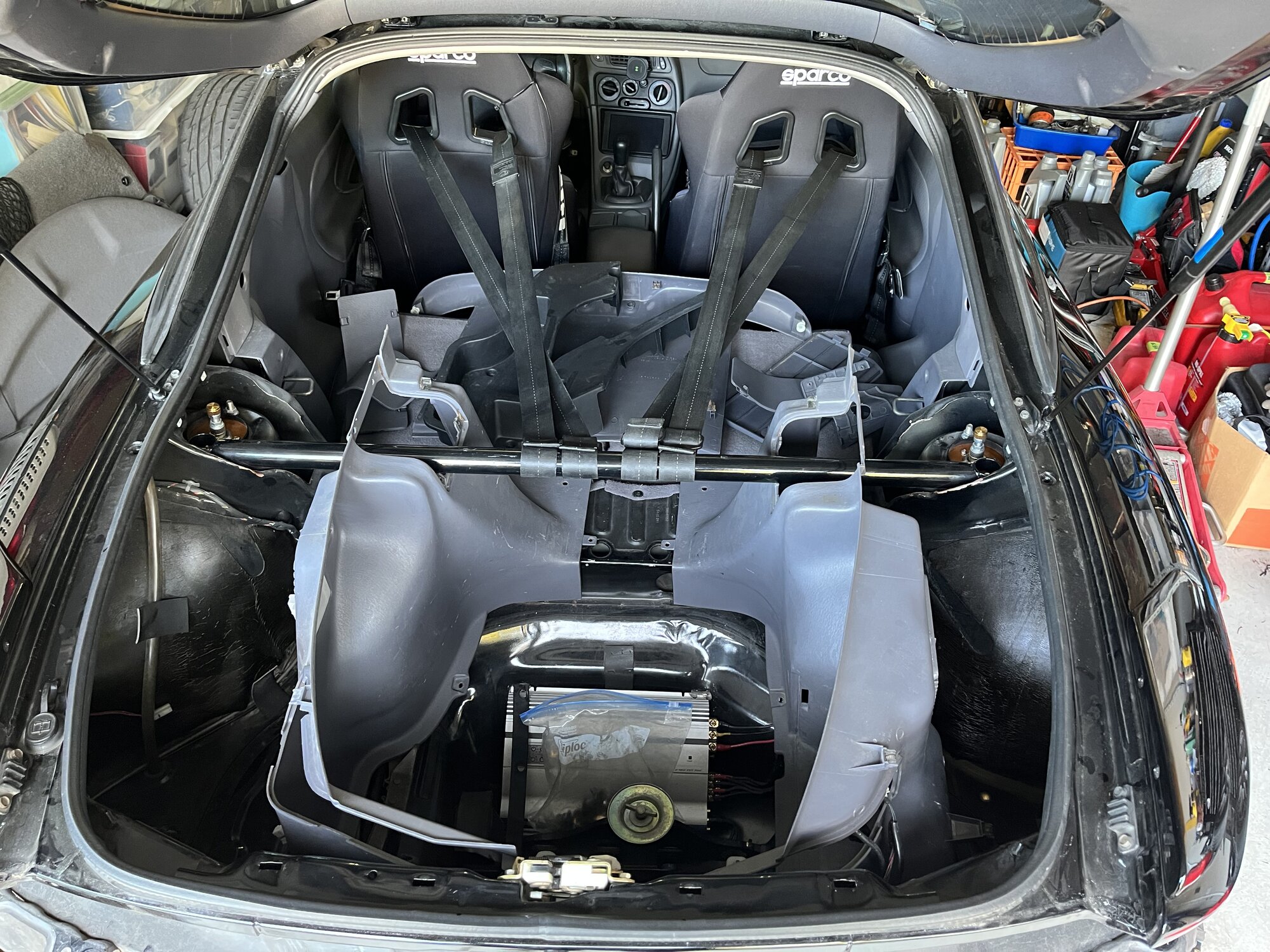

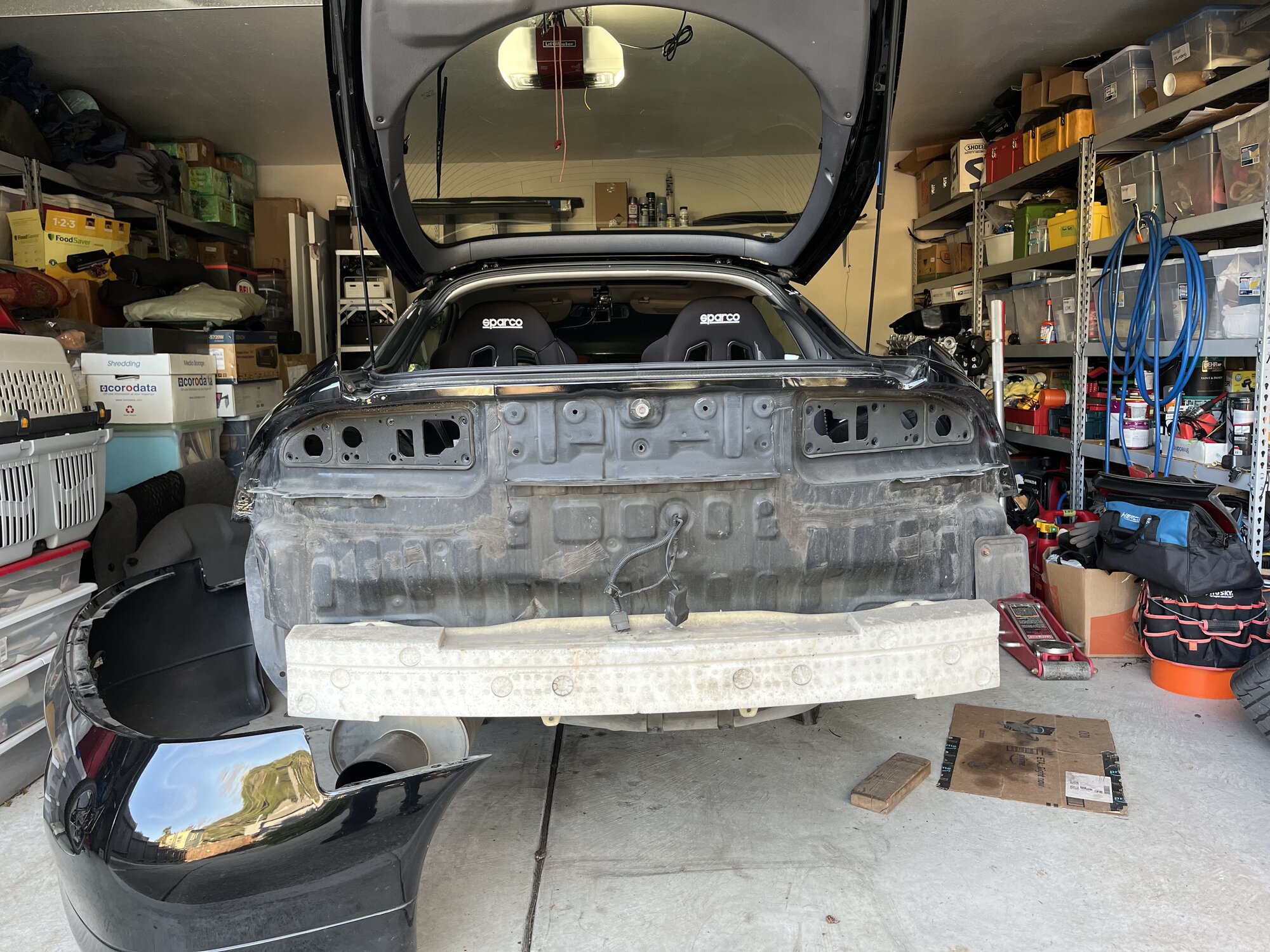

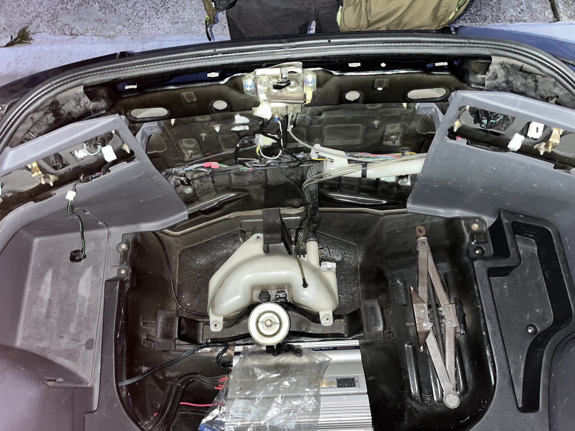

And to get the back bumper off - you basically have to disassemble the whole rear interior to do it.
I saved this task to group with another that requires removing the bumper, so I’m gonna take care of two things.

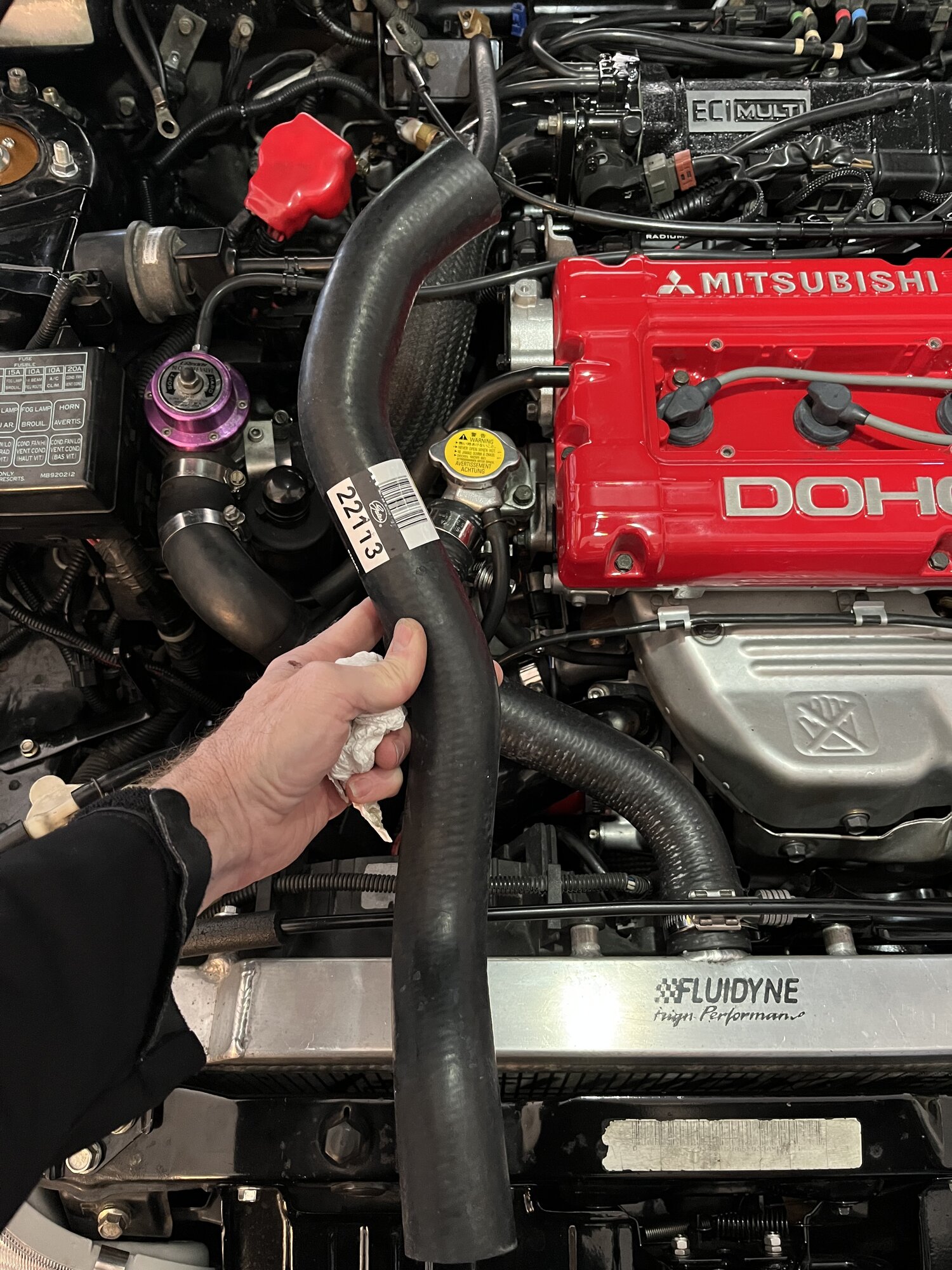

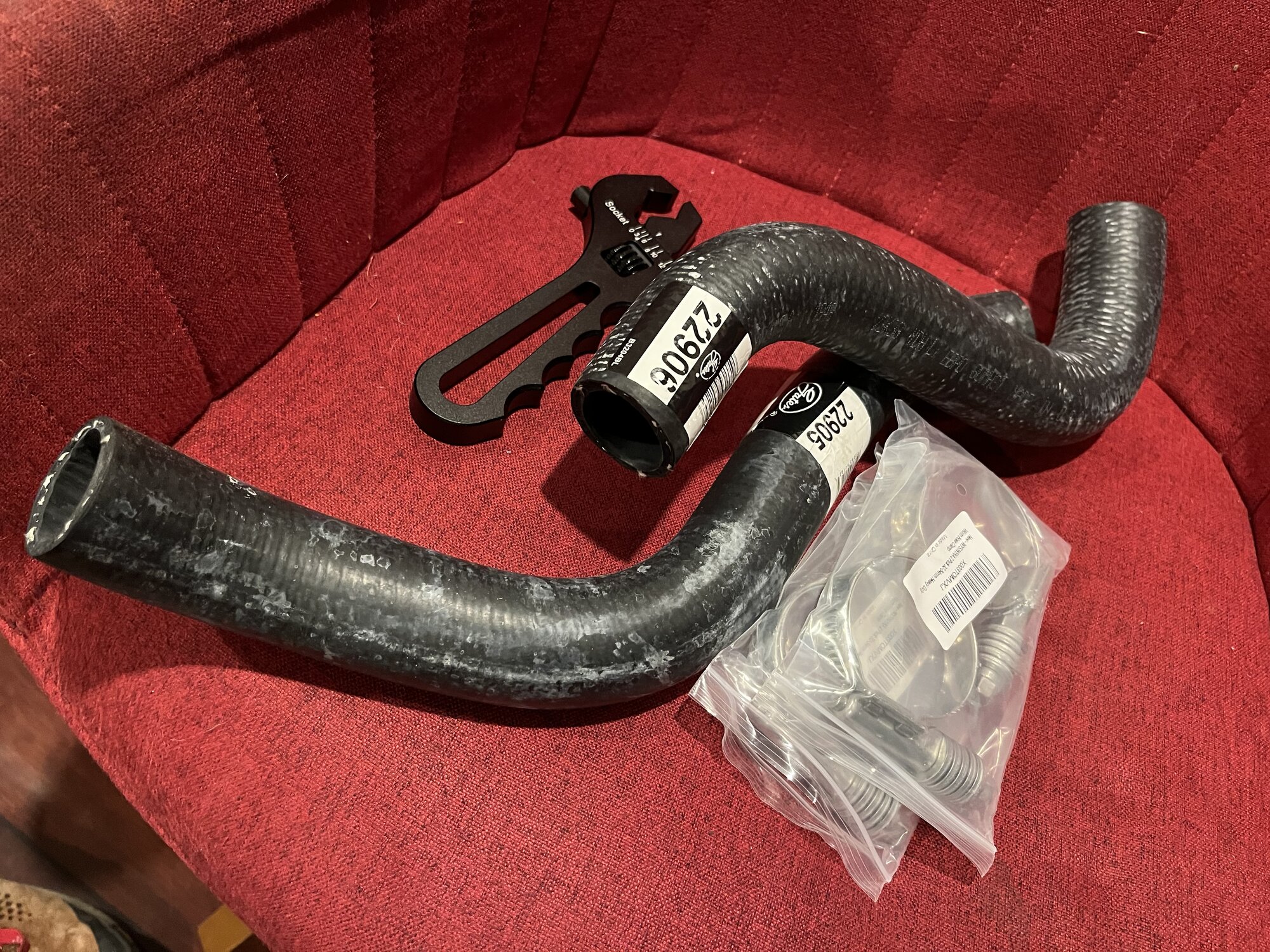

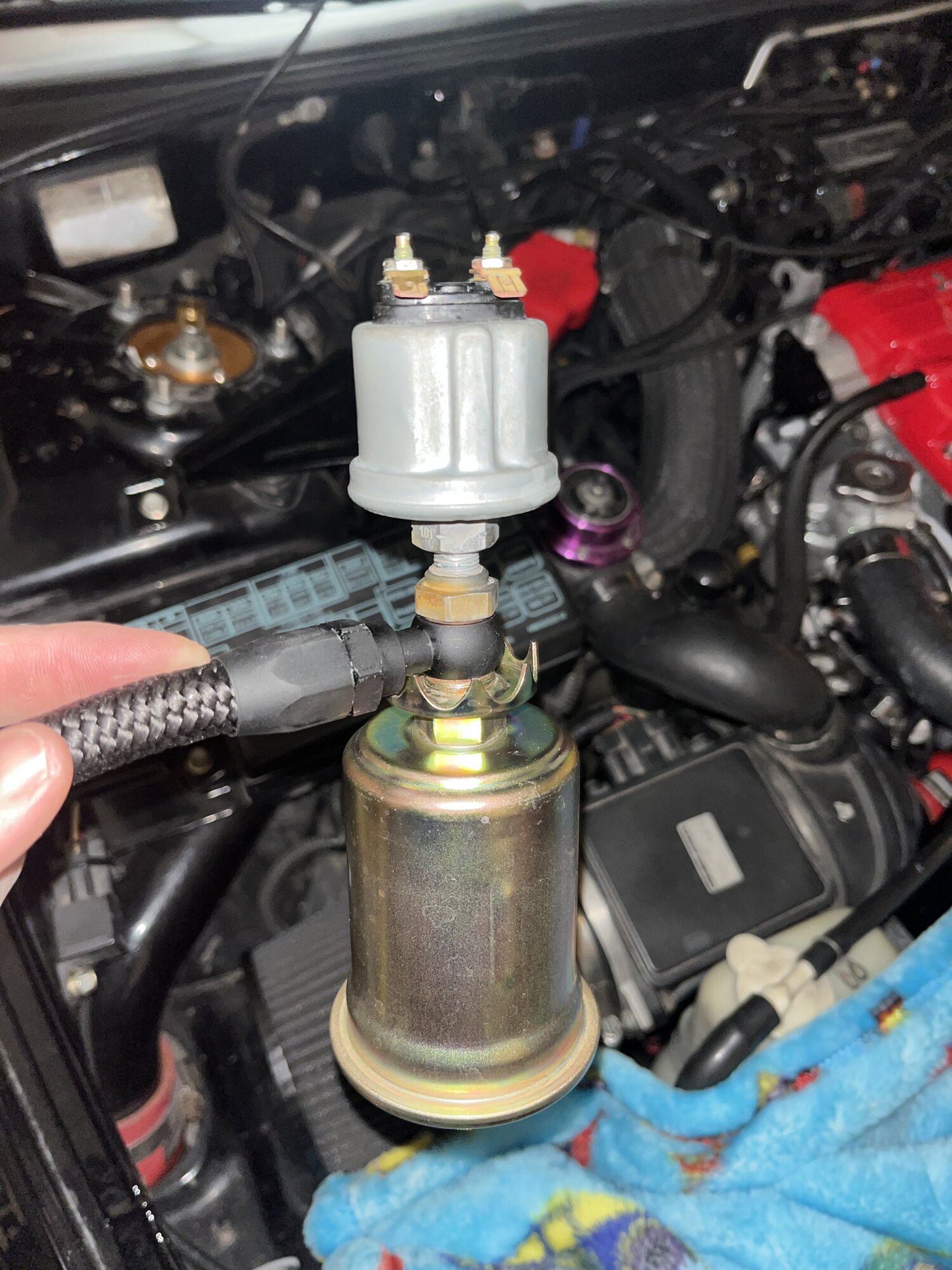

Its not a difficult change, but one I’ll have to do as time permits. The ID is different, takes PTFE hose ends, and I’m not in the mood to re-tool for it.
The connection that will give me pause, is the return hose from the regulator to the OE hardline. Bigger ID would be bad for that spot.
Is PTFE lined fuel hose required for E85?
Normal AN lines are E safe but lined is better because it also contains the smells and vapors. Lined lines are 100% if ran inside the cabin for safety.

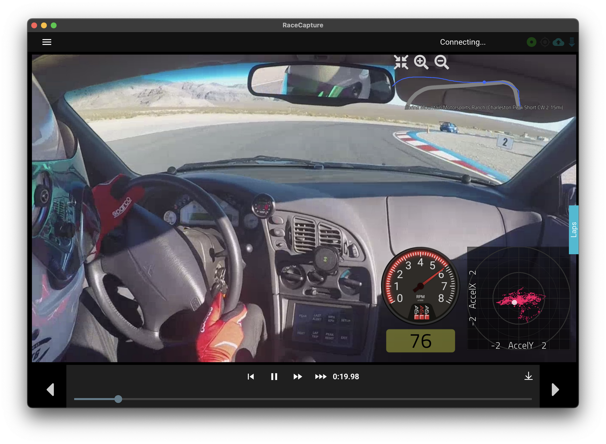

Too good not to share... This is the entire last session before my off track shenanigans. John towed me up to speed leading the way in the EVO - and he eventually drove away from me as I tried to remember the ideal line. I was really learning a lot about the track, the car, and doing stupid things with my hands just to see how the car would respond.
And for anyone interested in the raw data that goes with the raw footage - Enjoy

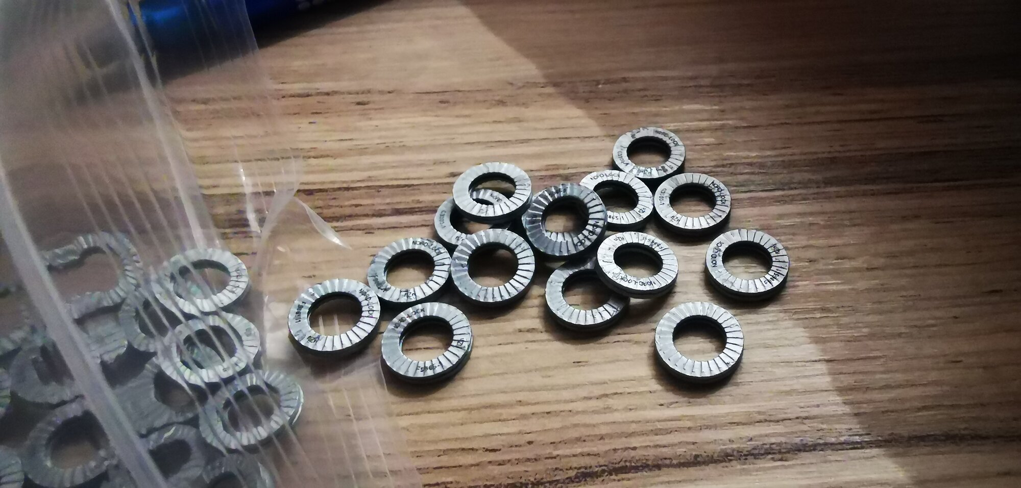

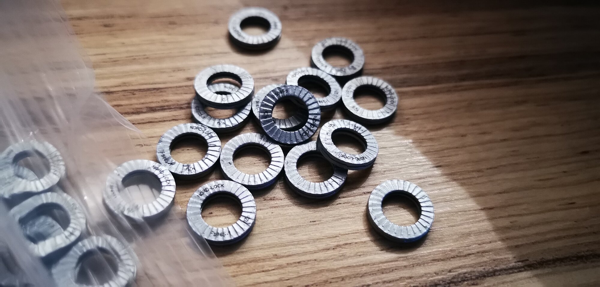

Also forgot to post this up! But for your hardware getting loose. Use these nord washers, they wont come loose again and resist vibrations. I use them in many places now. Suspension, exhaust, brakes. They do great

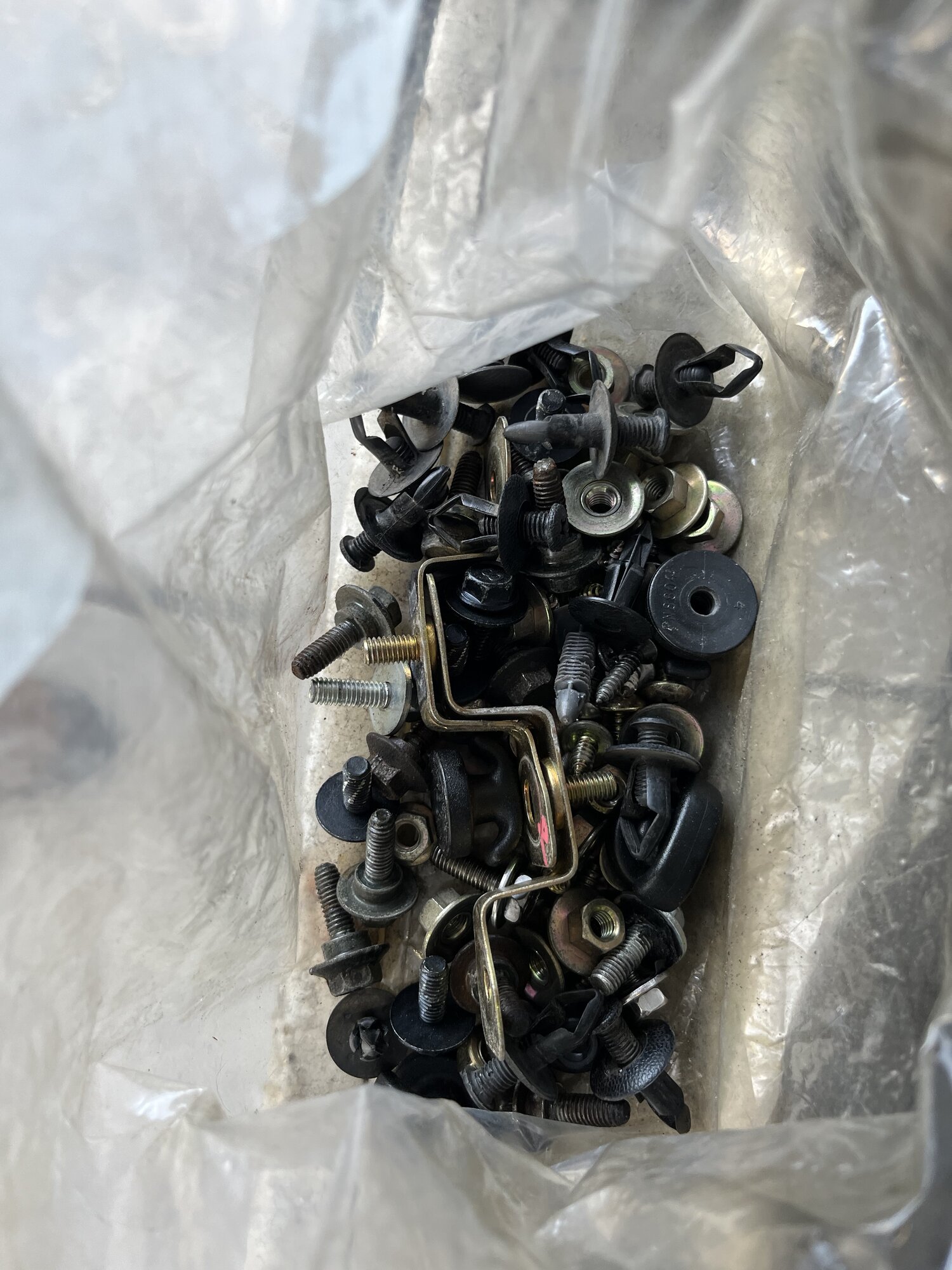

There is no easy way to remove the rear bumper cover.
Jack up the rear, remove two wheels, remove the back fender liner to get to the corner bolts.
All the lower rear interior has to come off:
This lets you remove the tail lights and center garnish, and THEN you can get to the cover bolts top and bottom,
Undo the license plate wiring, and in my case unmount a rearview camera so that, you can carefully lift back the cover. Don’t forget the cover clips that tie into the bumper.
