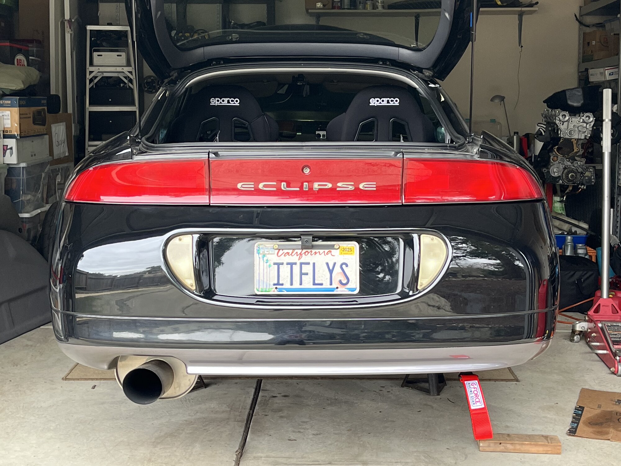

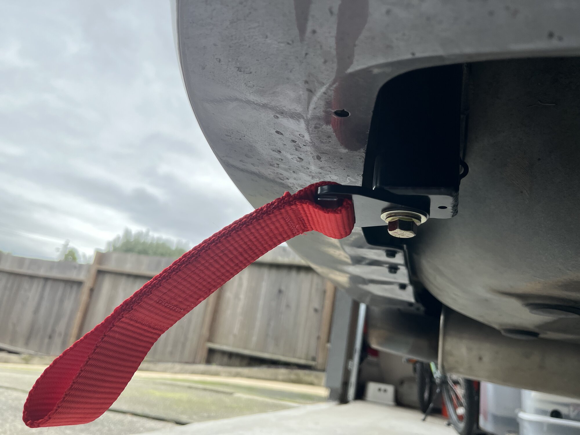

Strong tow loop:
I’ll tuck this away most of the time.
2 things.

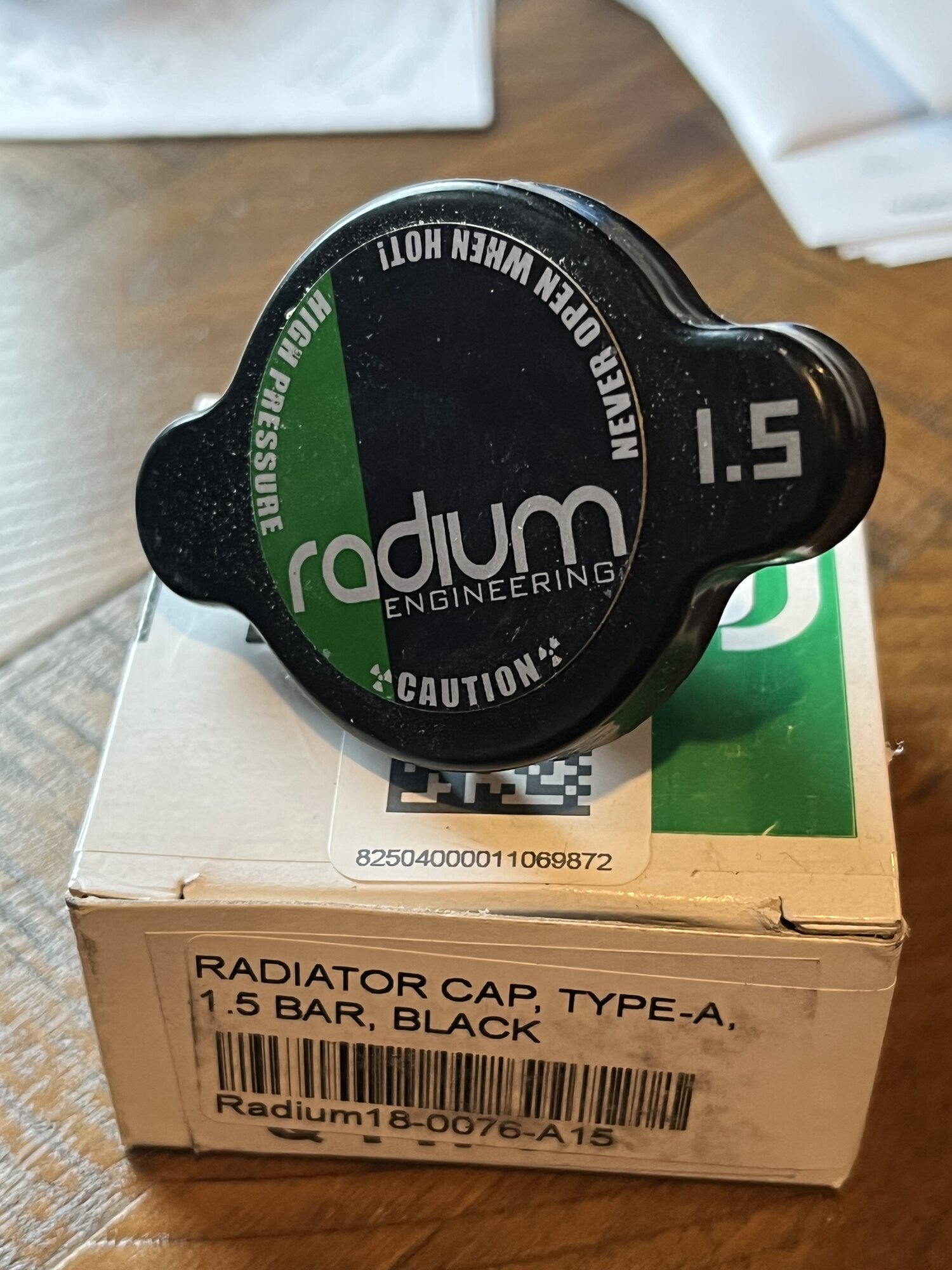

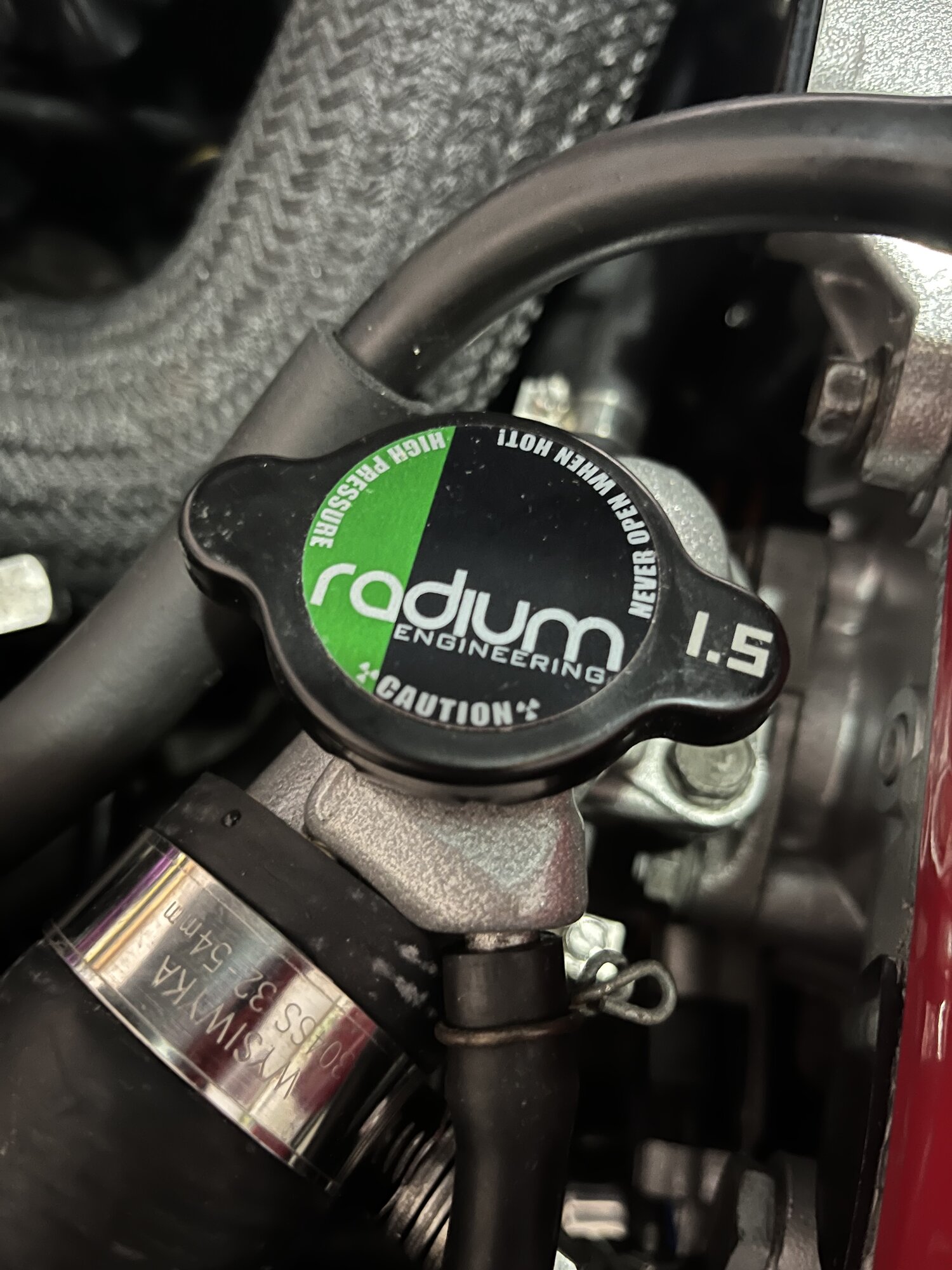

1, be careful with that rad cap and stock type hoses! They do not support the pressures the higher rated caps produce! So they can split oem based hoses very fast! Silicone uogrades are genetally better for you when you increase the pressure.

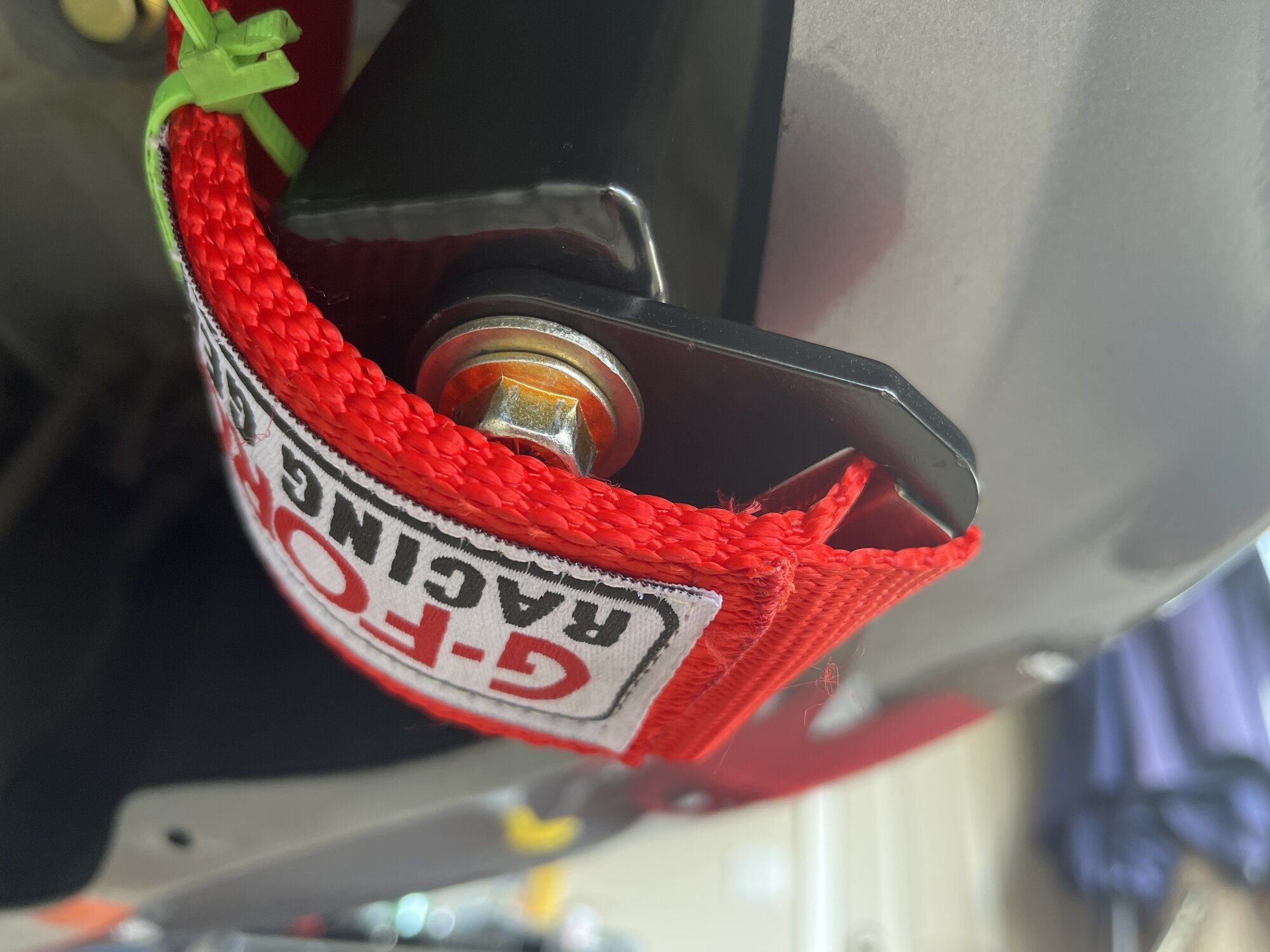

2. On the tow strap you want it free moving. If they need to use it to pull out sideways it can loosen the bolt and bend the buckle and tear it! So add a sleeve to allow a free moving buckle and this is strong in any direction then. Or consider a cable thats rated to a higher capacity but still ideally free moving to prevent bolt coming loose on you. Likely wont need it but never know and always make sure its accounted for in all situations before hand.
Yeah I noticed that some of these straps have a 14mm or 15mm hole where you put the mounting bolt through. Maybe they are figuring a 12mm or half-inch bolt with a sleeve around it?
What is the hole diameter in that G-Force strap Justin? It looks about right but I didn't see a diameter number anywhere on the web pages. I need something like that too.
Alot of the UK based events now ban these versions as they dont offer as much support and their logic is it needs to hold the weight of the whole car LOL in the UK we need 4 now vs 2 previously. I know we stem from FIA which is OTT sometimes.
Most i have seen or even had previously were 12mm holes. Oem tow eyelets are m14-18 depending on manufactuer so about middle ground is strong for the holt then the rest is uoto the buckle but if free moving loads ideal all the time vs pulling the strap sideways if needed
The tow hook mounting bracket is designed so that the tow hook sits over a sleeve so it can rotate 360* without loosening up the bolt.
Thats great then. I wanted to mention it just incase. if its added into it then no worries on it. better to be safe than not of said anything.

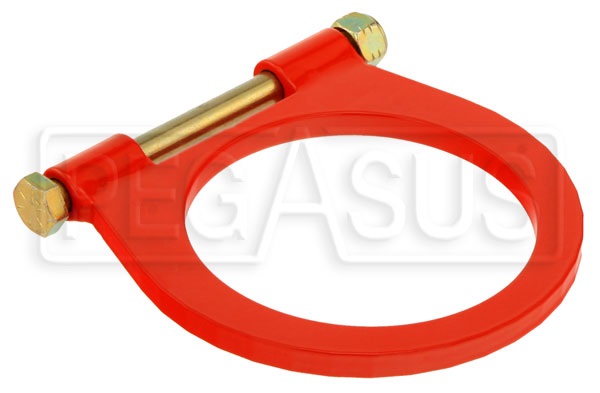

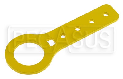

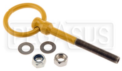

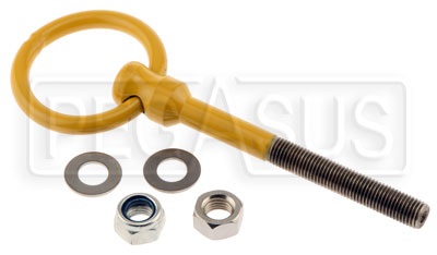

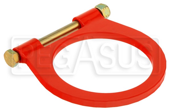

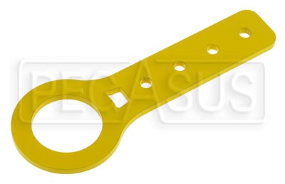

Since our terminology is getting a little messy here, I'm going to show some pics of what I mean by a tow hook:
tow hook, Pegasus, swinging loop type.jpg tow hook, Pegasus, rigid type.jpg tow hook loop only, Pegasus, swinging loop type.jpg
Tow Hooks & Tow Straps
Are you saying they ban tow straps period?
If they ban tow straps, then what do they think about tow hooks?
View attachment 755678 View attachment 755679 View attachment 755681

I have pulled my car many times with one or both my wires and it takes it well. Its fed into 1 bolt but through a fixture thats actually supported by 2 bolts so spreads the pulling load more evenly..
I go through my bumper as its direct access to the rails but not everyone wants to do that and Brian and his brother did one that comes through the foglight port which is neat and compact. So thats an option to look at if you wanted something more bolt on and less cutting

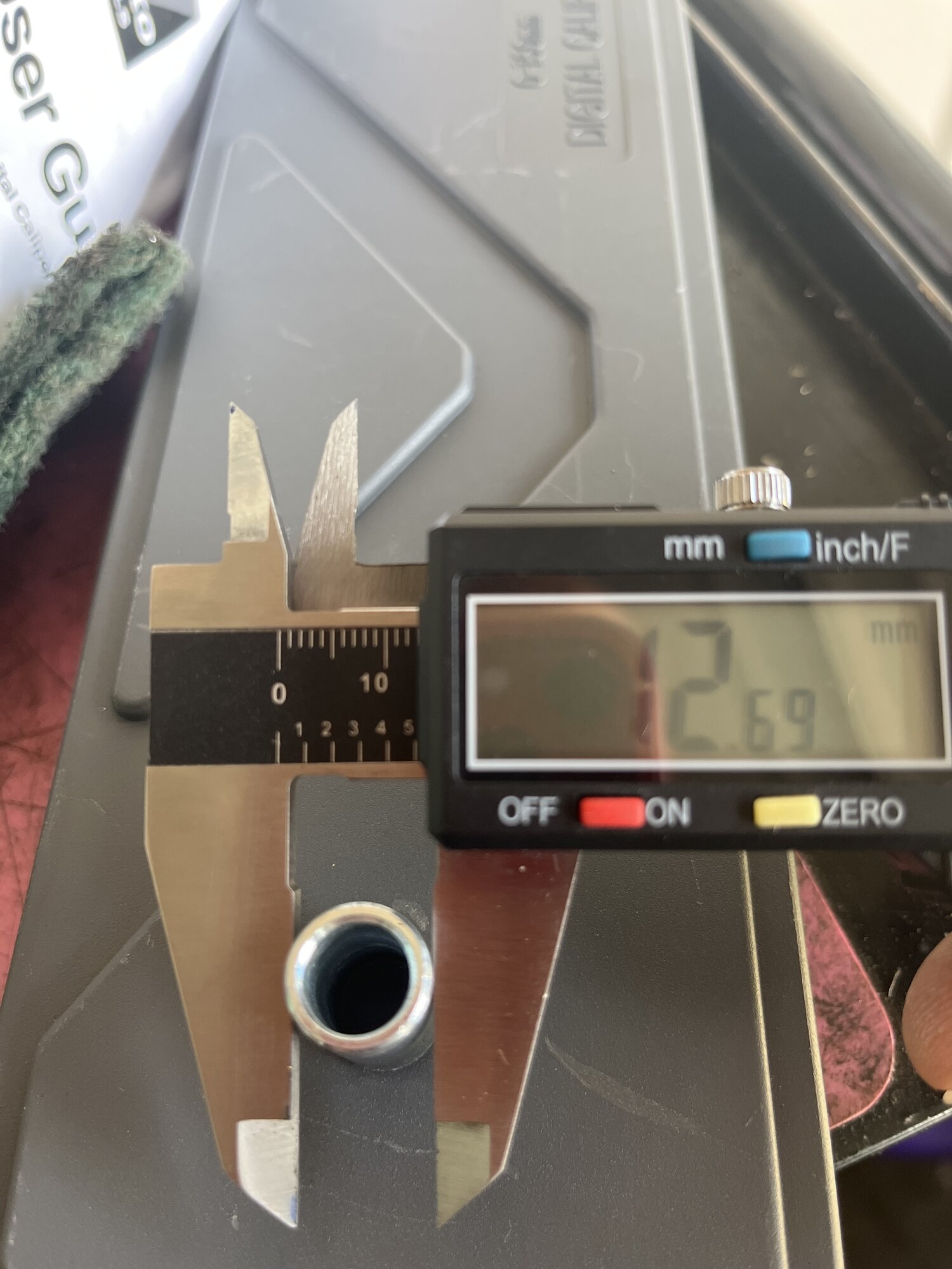

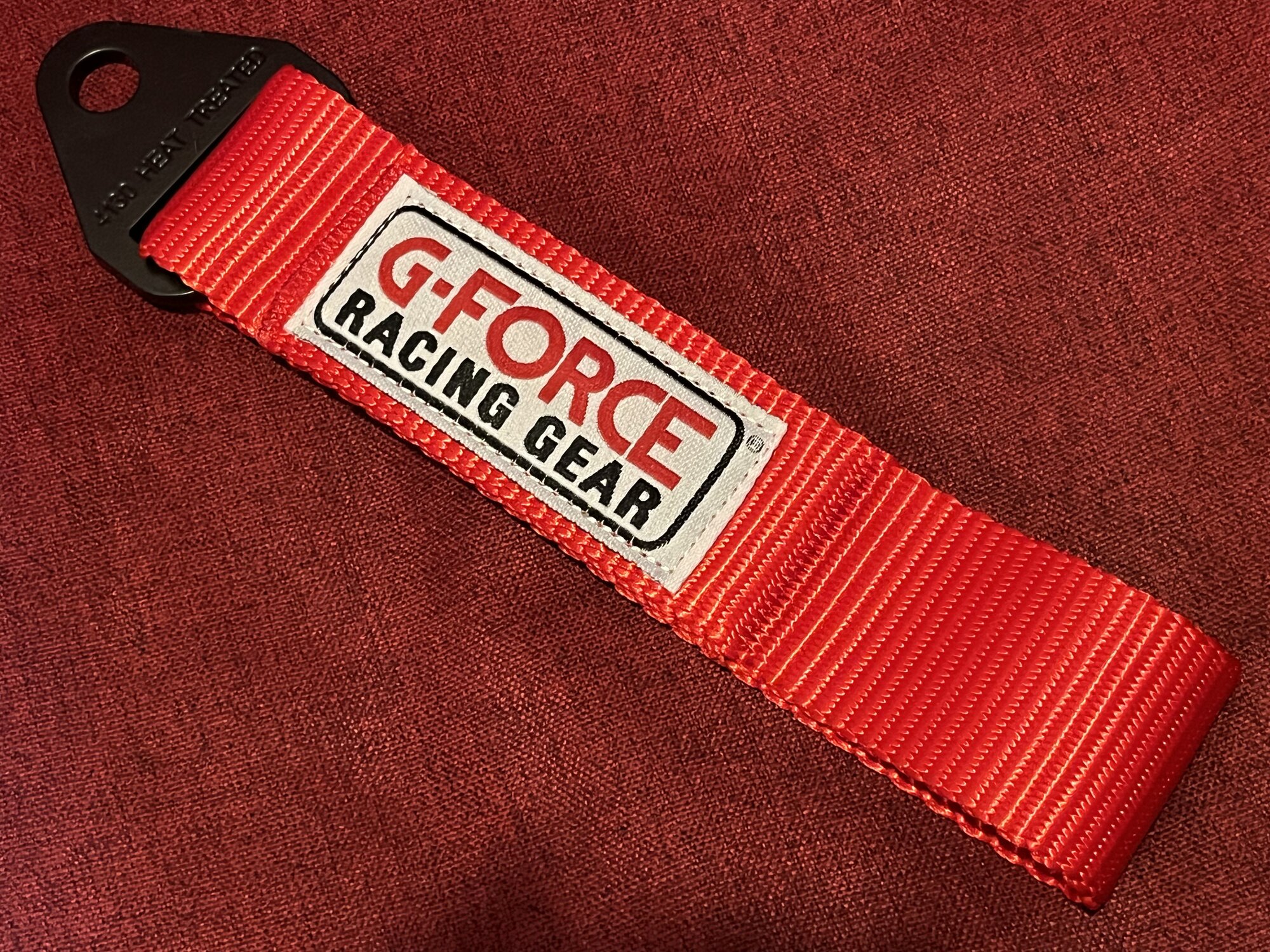

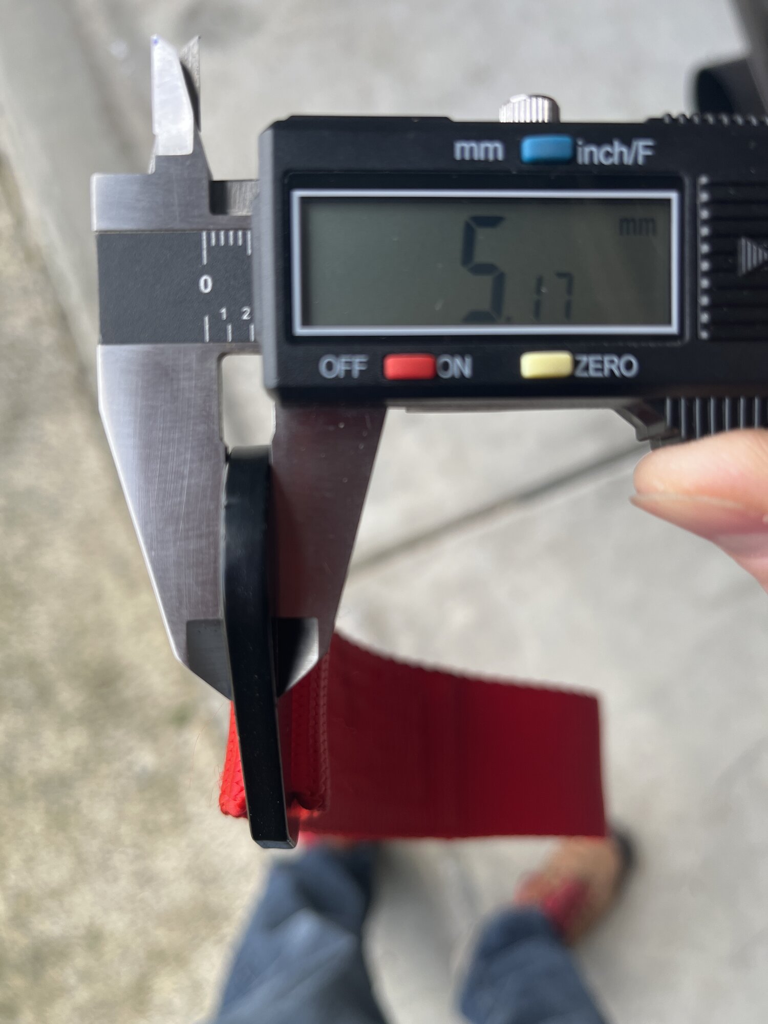

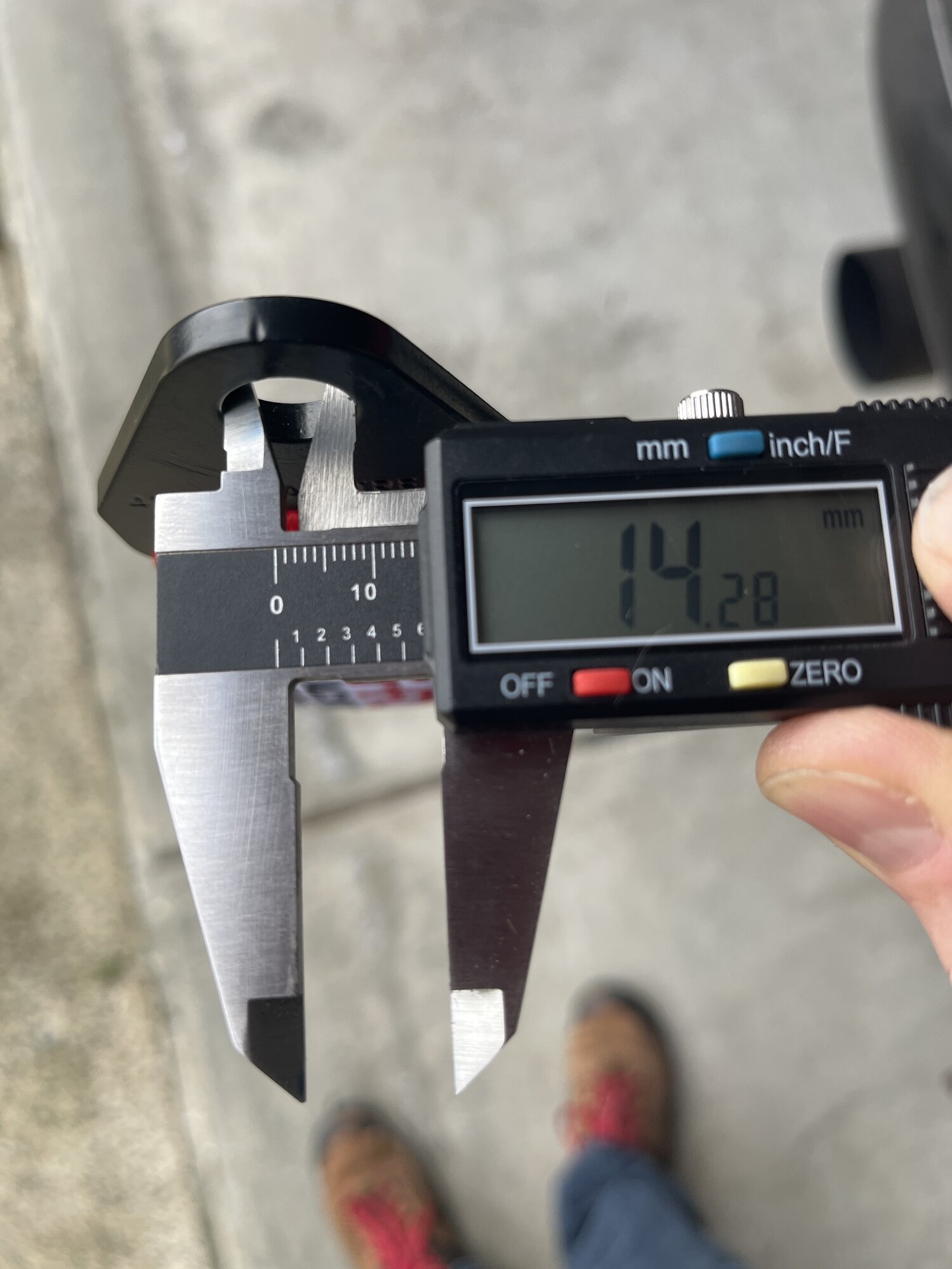

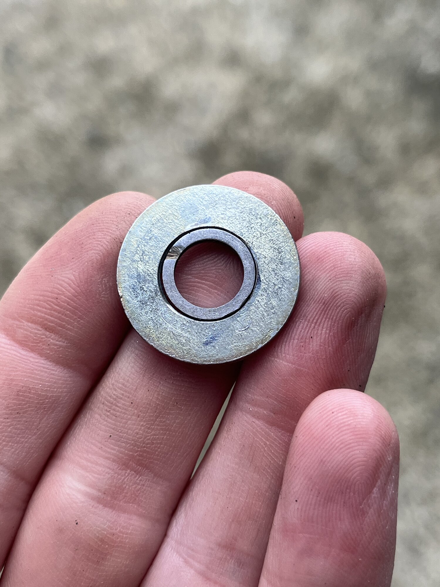

The G-Force buckel dimensions here:
Hole- 14.28mm
Thickness- 5.17mm

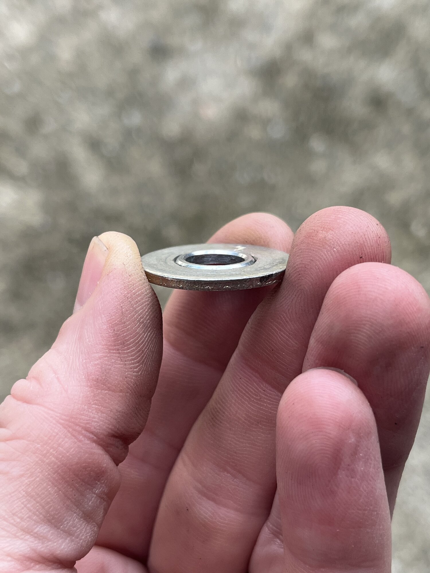

I needed to add a tiny bit more on to the threaded standoff - so I located a 3/8” ID seamless steel sleeve:
Chopped a bit more than a washer thickness, and sanded it down, then opened up the washer to fit over it.
It’s basically a home grown shoulder washer.
This lets me torque the bolt down tight and the buckle will pivot.
Hole- 14.28mm
Good thanks. That's what I've seen on most of the straps that give a diameter number.
so I located a 3/8” ID seamless steel sleeve - Chopped a bit more than a washer thickness, and sanded it down, then opened up the washer to fit over it.
Nice rigging! That's the kind of stuff I like to do.
I guess then that the bolt there is a 3/8" or 10mm bolt?

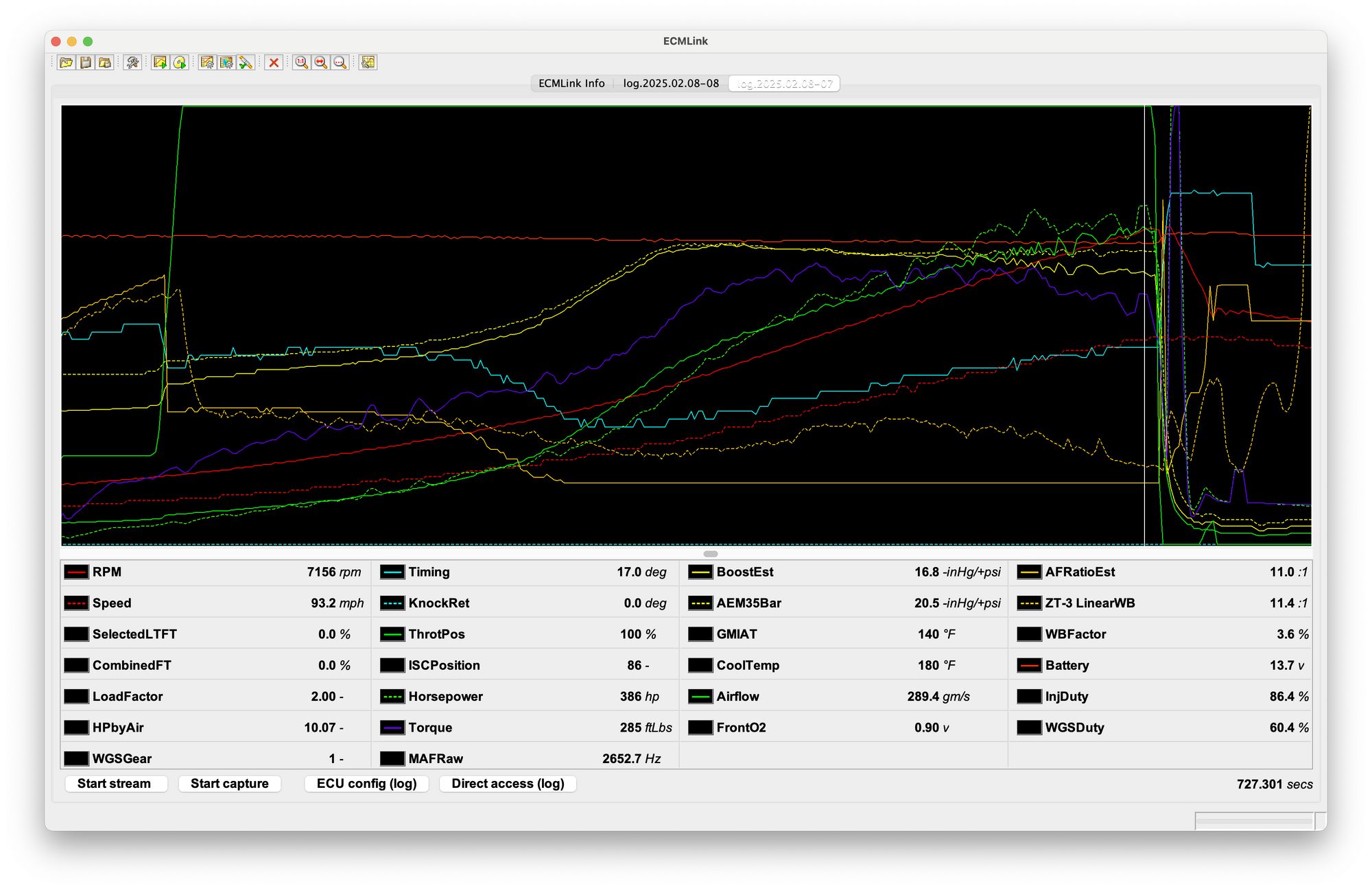

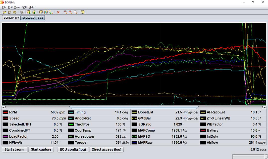

First pull on 100% E85. No knock so I just stayed in it till the shift light came on.
And with no other changes, it is reaching full timing, no knock, and 386HP at the wheel is more than I have recorded - ever.

Also note - low boost setting was in use when I hit 386hp.
I think 400 is closer than ever
