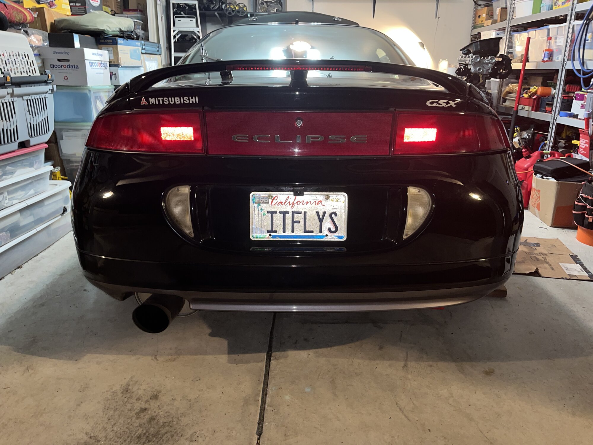

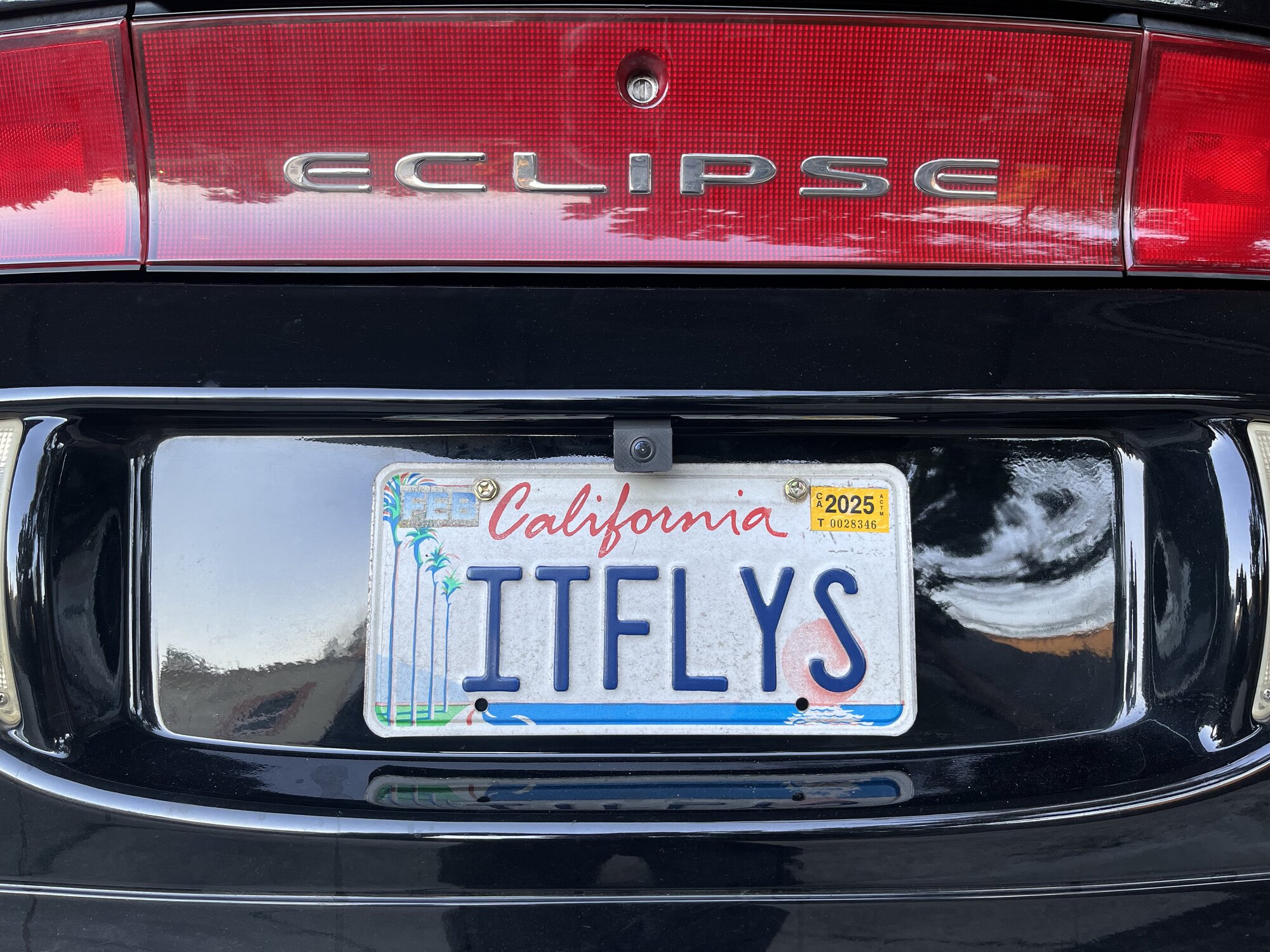

So I can turn on the car and check the new backup camera mount - now inside the bumper.

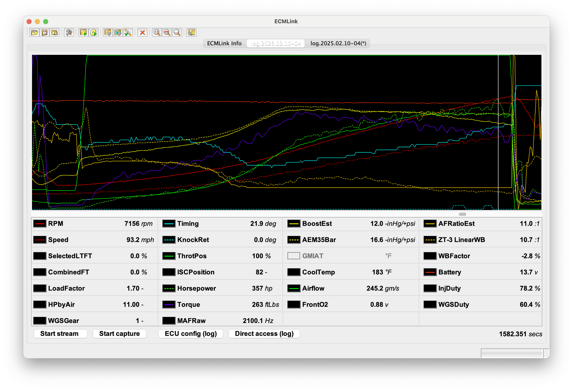

You can run more timing than that.
Baby steps - I'm going to leave the targets and tables the same for now. I'm messing around in MAF mode for SMOG testing. It was cold this AM, and it fired over second attempt cranking. That's not bad. With a little global fuel tweaking for WOT, it should be good enough to test.
I'll make max power after going back to SD mode. Idle was smoother on SD than MAF with E85. I'll see how it feels after its all dialed in.
For the flow benefit of a K&N filter, you lose some performance pulling heated air from the engine bay. The stock airbox is a cold air intake from the fender - a design I would like to improve on.

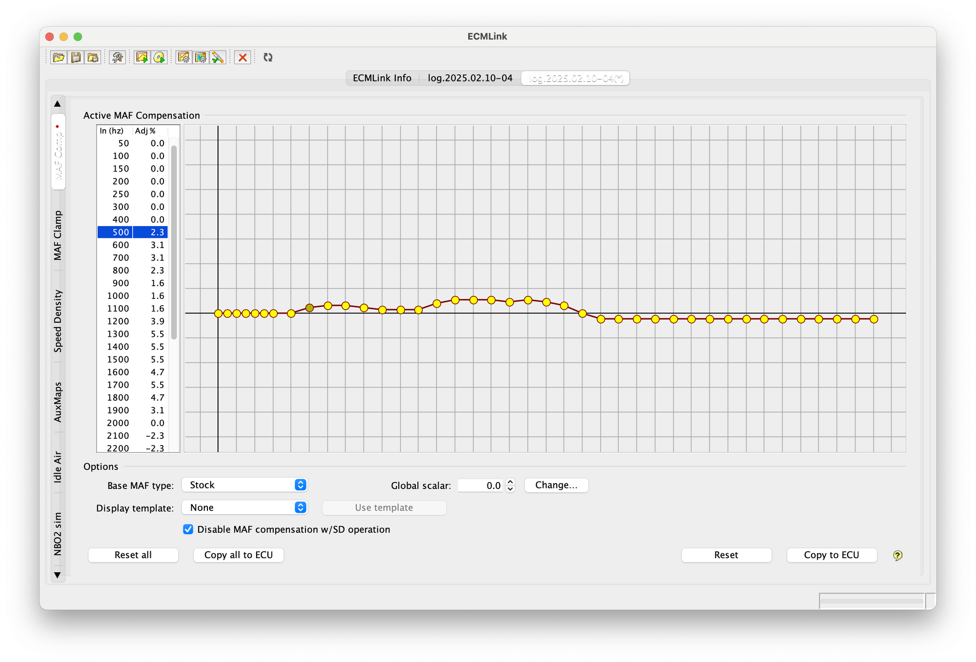

I can see wanting it a little leaner above 2000 Hz. Hence the -2.3 there.
I don't know that you really need it any richer from 500 to 1900 Hz though. Is it just to meet your WB target?
Right - MAF calibration is to align results with the current targets. Targeting a leaner AFR is a Direct Access table adjustment - which is desirable for E85. I'll do that after switching back to SD.
Ok, that's a lot of timing LOL. I'll target 21-22 peak. Most I've ever seen someone do is 23, I don't think I've ever seen 24.
It may seem counterintuitive, but if you ran a little more boost it would kick you down a row on the timing table into less timing.
Alternatively, you should just adjust the timing table. You're riding the line of 21/24 on the table and ending up at 22.9 which is probably pretty fun to drive but a hair too aggressive for me personally.

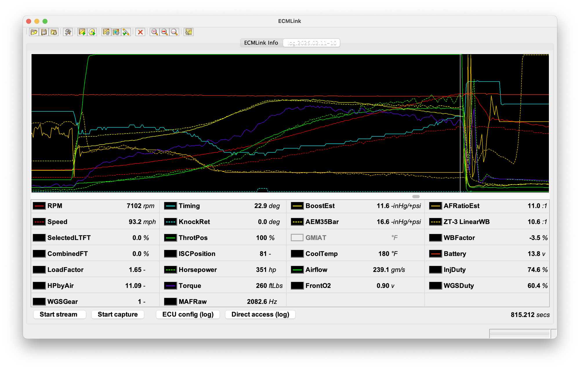

It looks like the MAFComp didn't do anything. MAF and MAFComp numbers are the same at 1332 Hz (809.370 sec) and again at 2062 Hz (815.159 sec). You still have a check in the "Disable MAF comp w/SD operation". I guess this tells us that the Disable checkbox works whether you are using SD or not? And that would be why your MAFComp didn't do anything. Is that how it looks to you?
Very nice that there's no knock in these pulls.
I will look into the numbers - but the two adjustments I made were to MAF Comp, and global fuel. I think the fuel mix is shifting a bit, as I added another 7 gal of E85 from the pump direct to tank. The ratio of old E25 to E85 is improving.
I see a direct correlation to the MAFComp changes in the next runs wideband results. I did several. The Wideband to AFRest alignment improved with each tweak. This last one is pretty good, and it goes rich in the last 1000 rpm between 6-7k. There isn't much increase in MAFraw hz above 6k. There isn't any tweak I can make that will get it completely aligned - but that's OK. I really didn't need to.

You're not going to knock e85 unless something is ridiculously wrong. I've done long WOT pulls on the highway with my A/W pump accidently off resulting in IATs to almost 200* and didn't even know it until I got home and went through the log. No power loss, nothing.
The second log looks awesome. You should be looking at MAFRaw for this. 2000hz is peak VE, so you can look at your adjustment on mafcomp at this value (pulling 1.6%, 2.3%, 3.1% during and after this Hz). So you're globally those percentages rich AND output is still about .3-.4 rich. You have two things here telling you to lower the global fuel.
I'll also add, don't make the classical mistake of jumping right to airflow adjustments (mafcomp) for correcting a fuel change (global% and/or basefuel). I know it's ezpz to adjust the mafcomp sliders/sd table but that is the wrong route which everyone takes.
Did the personality of your airflow change by going to e85? No.
Did the personality of your fuel system change by going to e85? Yes.
Do not bleed them together. Do not use airflow changes to correct fuel changes. I'd go max effort to leave mafcomp as you had it and make everything happy by changing only global fuel % paired with a finer adjustment of base fuel pressure via afpr (infinite degree adjustment here by physically turning it a hair of a hair at a time).

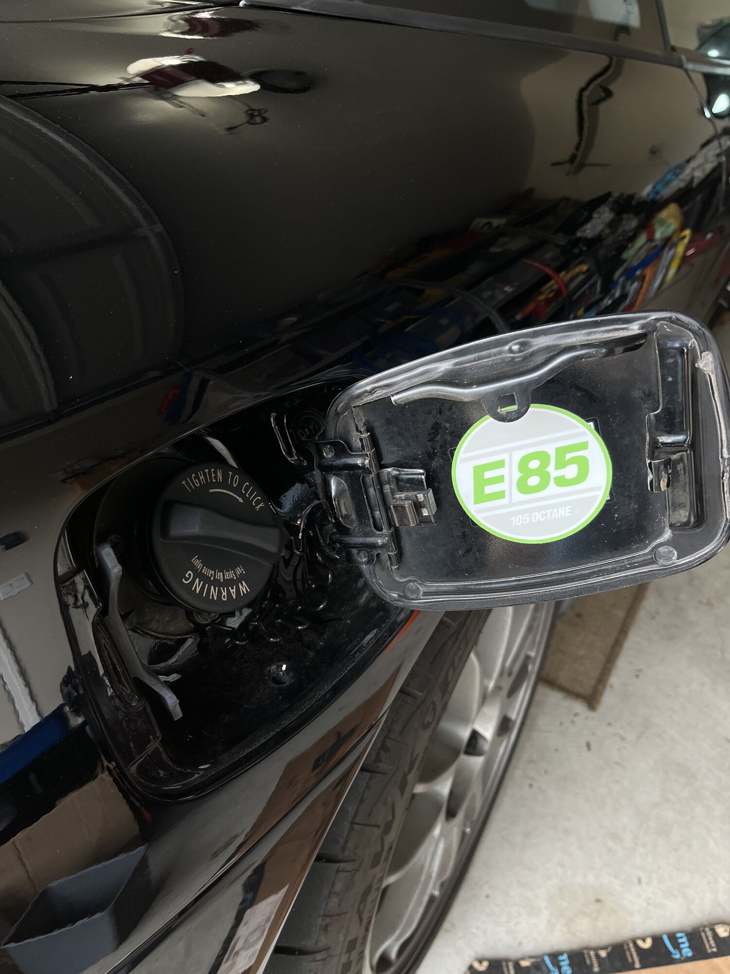

E85 sticker - ordered

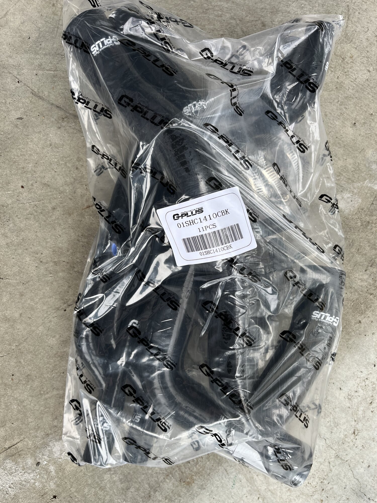

Silicone Coolant hoses - ordered

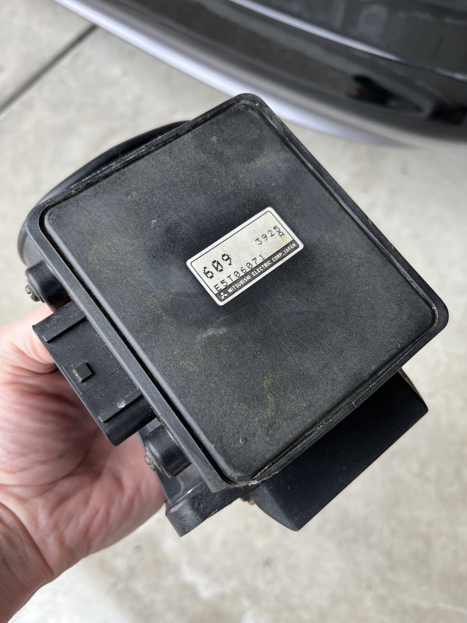

MAF for modification - ordered

E85 sticker - installed

Silicone Coolant hoses - arrived

MAF for modification - arrived
