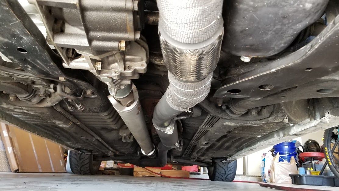

I think having the propeller shaft perfectly balanced would be important too, and I'm not so sure mine is.

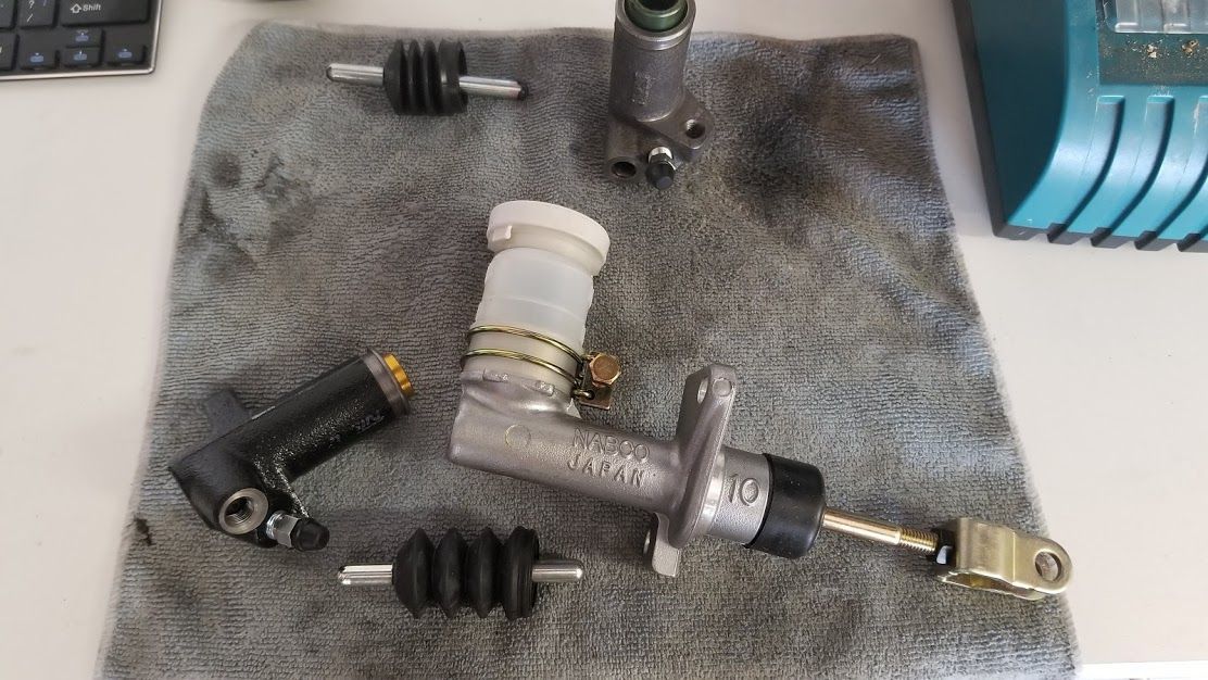

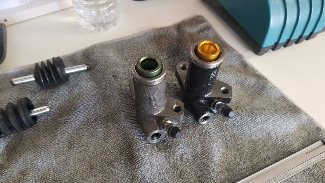

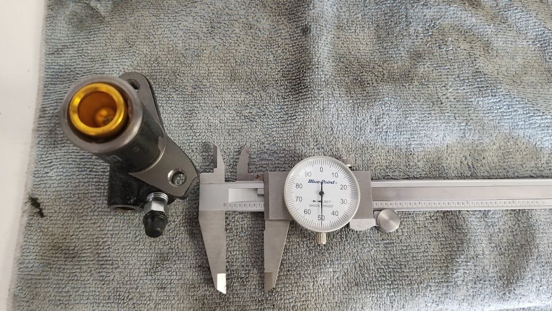

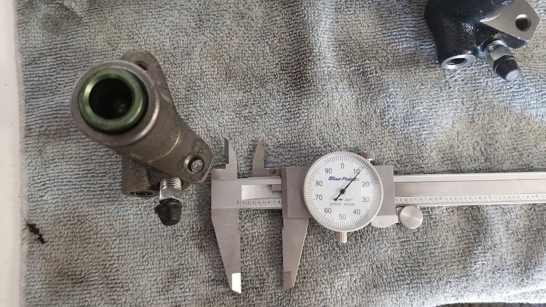

I actually did a bit of wrenching on the car for the first time in quite a while. The clutch on the car has never been very cooperative. In hopes of getting the QM to be a bit more tame on the street, I changed up some of the hydraulics on the system.
I went from a "green" slave (which has a 13/16" slave piston) to a "red/gold" slave (which has a 3/4" slave piston). The idea being, I get a bit more travel at the slave, which makes the clutch release a bit more effectively. I went ahead and installed a new clutch master cylinder as well, just to make sure there were no hidden issues there.

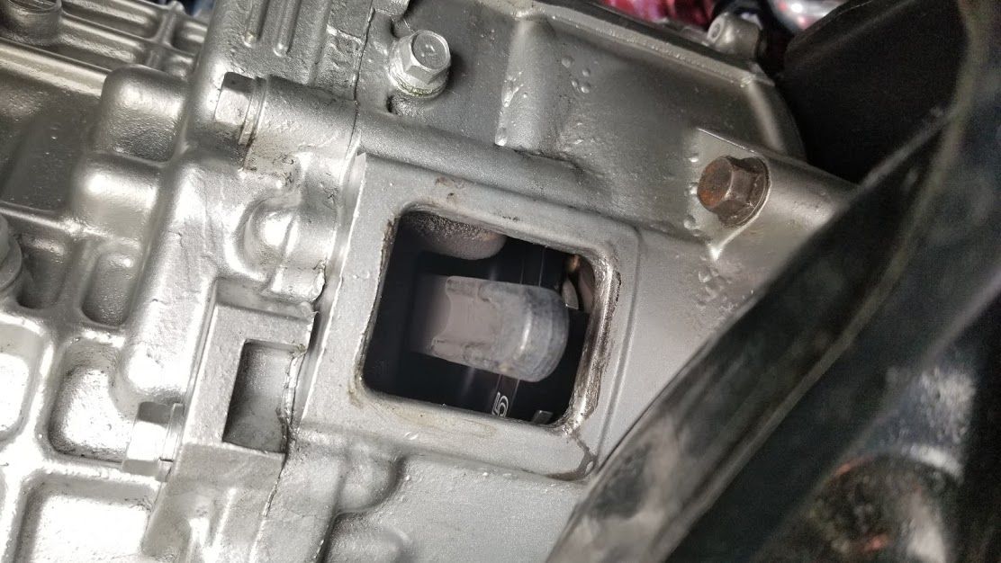

I checked the clutch fork position in the trans window by removing the boot. I just wanted to verify nothing crazy had changed since installation. It looked good as well, so I installed the new hydraulic components, and bled the system.
faqAnPuDzMozMeb9CqWazSUIffs9zX0EIc3vouLPZ-TyiVpTYV_oV6IAJ4-nFKrRltbK5HP6prRcKKspWw=w1112-h626-no.jpg
Once I had the car out on the street, I could immediately feel a difference. Nothing drastic, but the twin disc was a bit more tame...And if you've ever owned a twin, than you know anything helps.

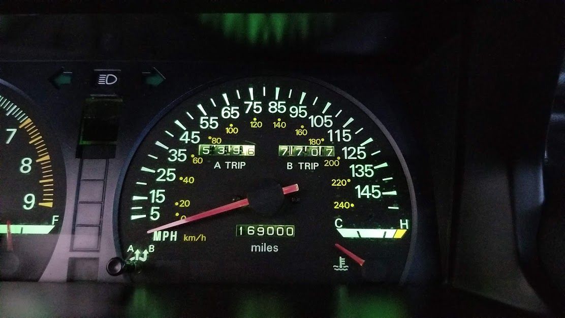

Rolled 169,000 miles on the chassis over Xmas, which is picture worthy :sneaky:

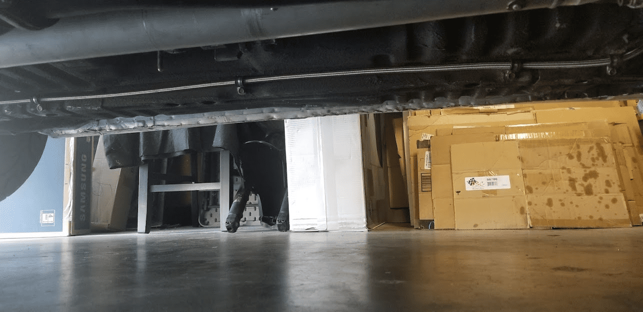

Still nice and tidy underneath:

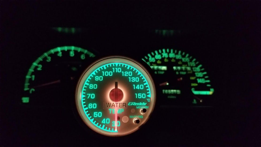

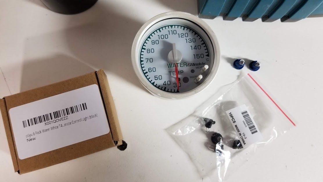

Had a light burn out in my Greddy temp gauge, so ordered some tiny ass bulbs and replaced them:

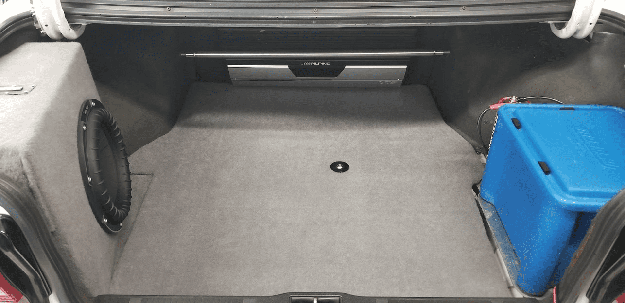

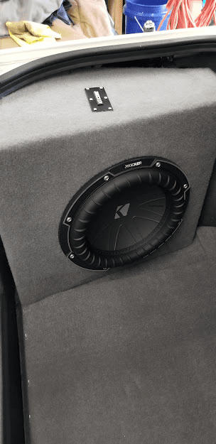

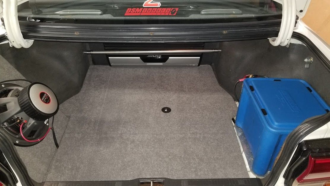

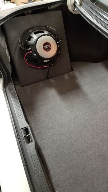

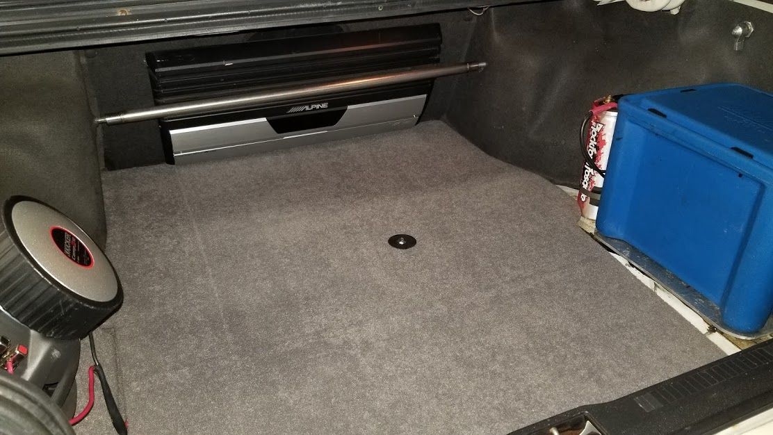

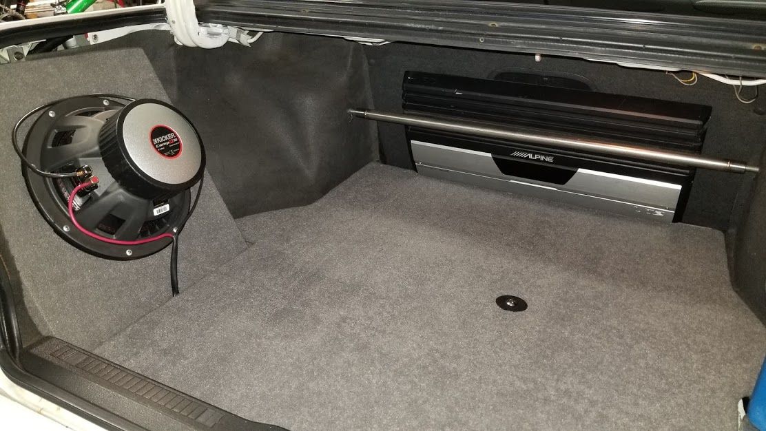

Lastly, I finally got around to refinishing the trunk area. I rebuilt the custom subwoffer box, and put in a custom floor panel. It turned out nice and tidy, just as I hoped it would.
8l_1dygM6HwBvI6_7Hb1HEEqGuTSyEhhJ2RdA3pex1CY8Rl4NSUdYfSvcvruxew8lmirIkPcxFOPgTDwizw=w352-h625-no.jpg
XuLZFx1u3De4ge3UCsAGsKqL9T06NfV9KDp2LGC1bFK6q1VztGep9x74D6PApKD0Sjhc-D72D5Ubg3KLAg=w1112-h626-no.jpg
YVW50dJ6AXZu57cvWUpVJI7RfeHHROeJ65qDDR4OPH0wCjDSnFIztDqg14dwRDDy-KRAWj-pR9sbRd9gtA=w1112-h626-no.jpg
uoaBpnaPdyA_qzErxPSjMXsTOmVUuV4_nN7ZF-fGDta60zxlVPgpJBuyG6XQN3TxPx6vc4Bwg6ZZZNEApo=w1112-h626-no.jpg

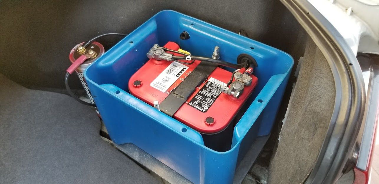

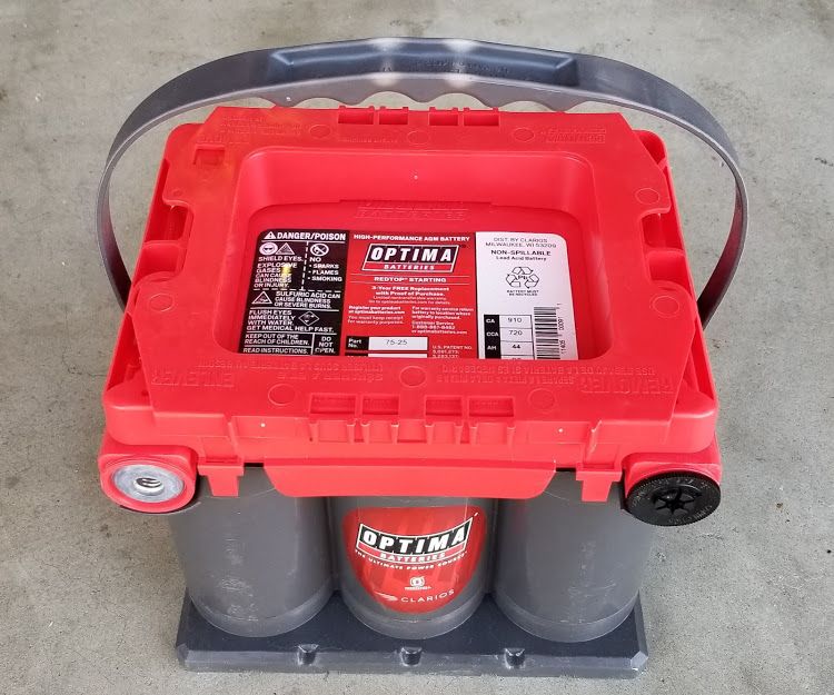

My battery shit out. The car usually sits for long periods of time, and I never remember to put it on the tender. I think age and the lack of use took their toll finally, so I just picked up a new Optima red top. I remember back in the day when you could pick one of these things up on sale for $119 bucks, these shits are expensive now!

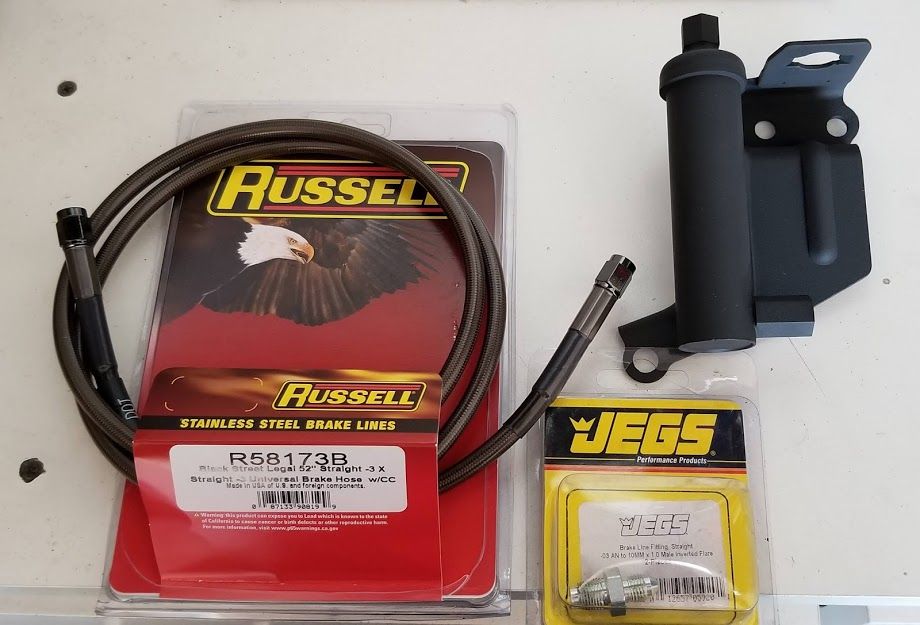

In a last-ditch effort to make my QM twin more tame and streetable, I decided to add the 2G clutch accumulator everyone always suggests. All said and done, it made a tiny improvement, but overall the clutch still sucks ass to drive on the street. I think I can chalk it up and say there's nothing I can do to make this thing anymore enjoyable to drive when I'm not balls out banging through the gears...She's just never gonna be a lady in the streets.

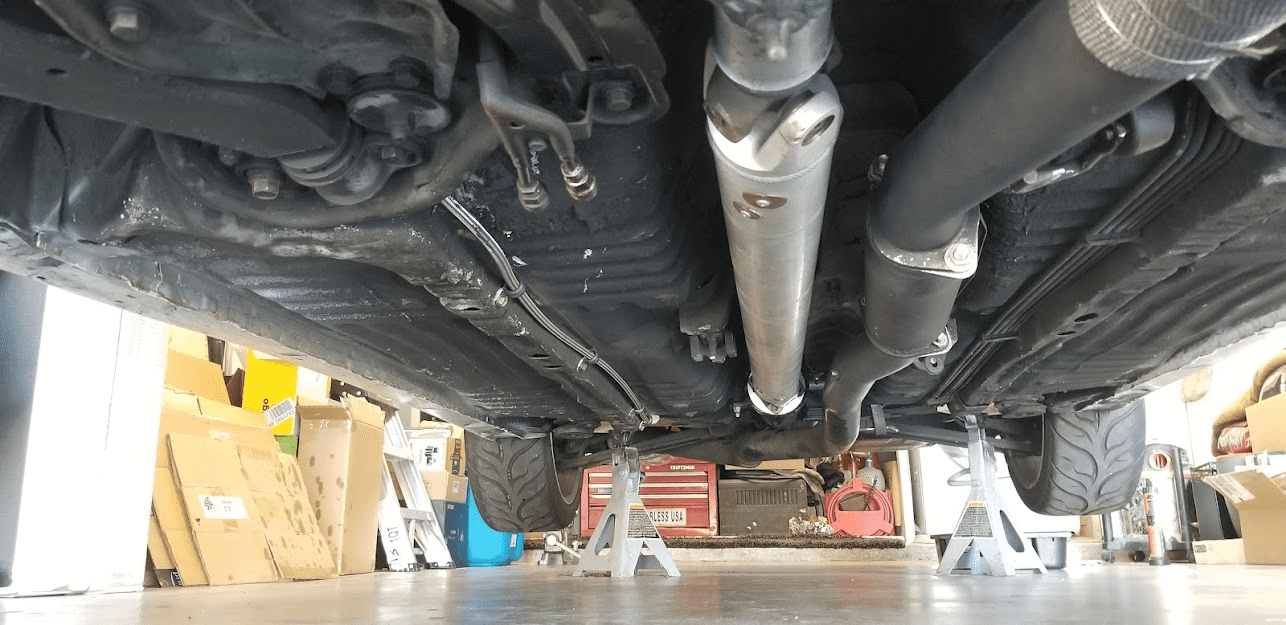

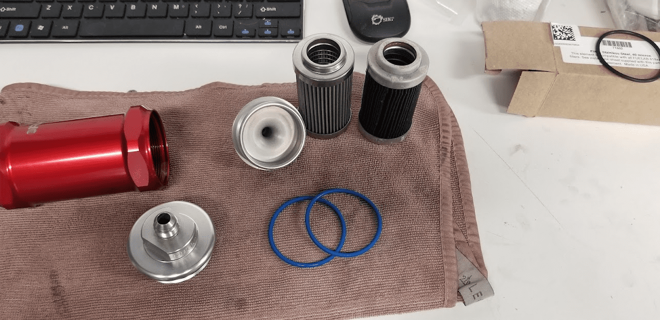

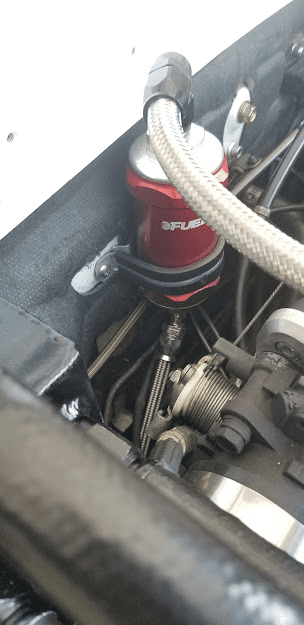

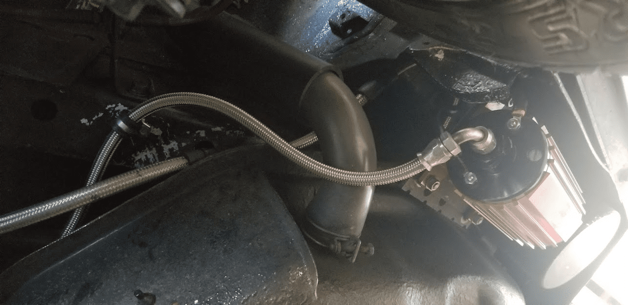

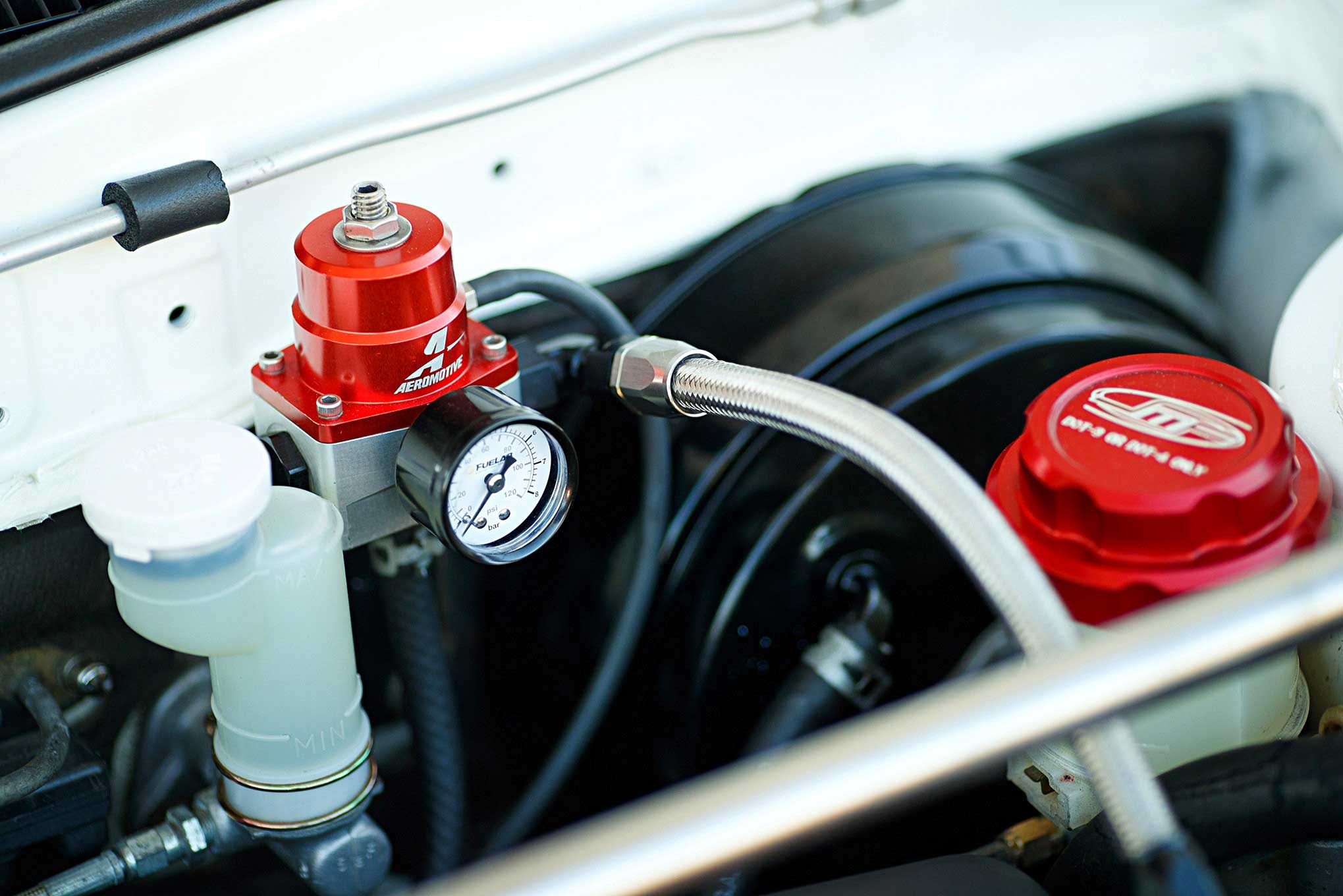

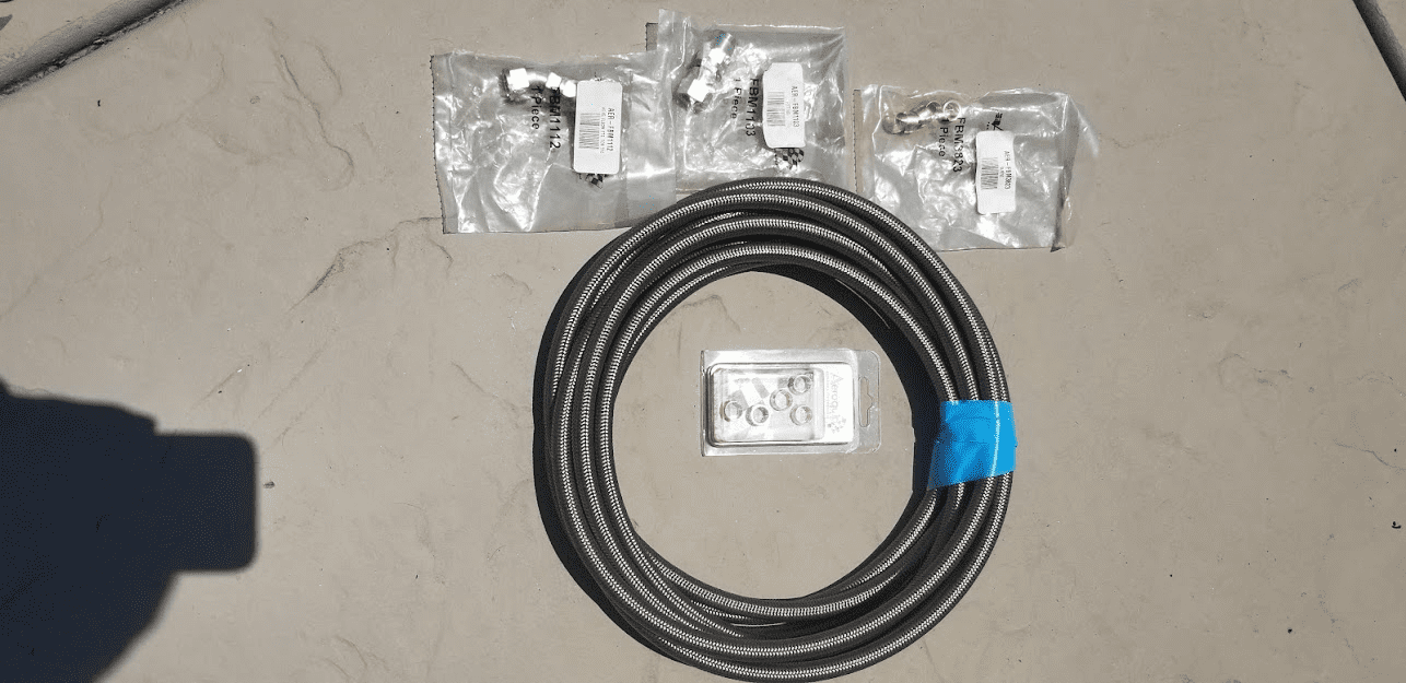

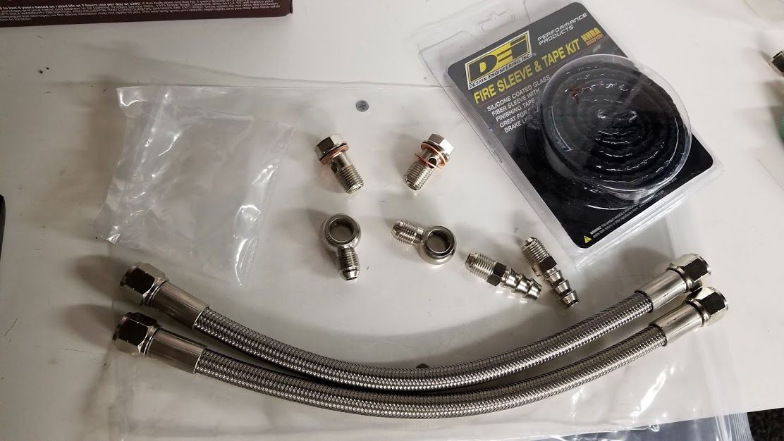

I replaced the stock fuel feed line with a -6 AN. New fittings and all that jazz

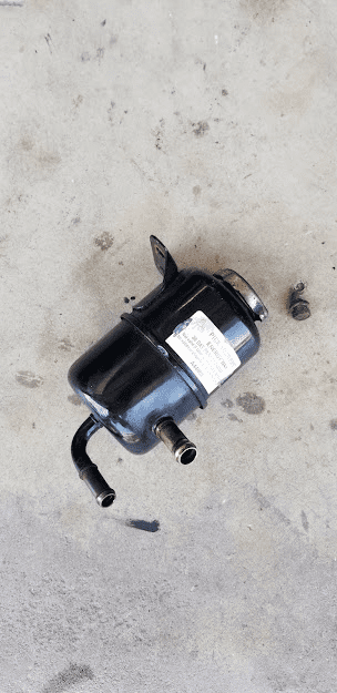

Ripped out the rest of the remaining unused 4WS lines. Also ditched the GVR4 power steering reservoir for a clean 2G unit.

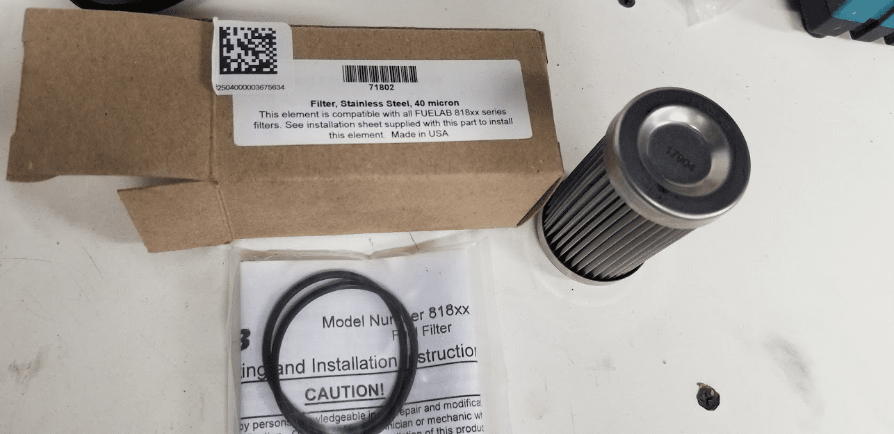

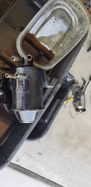

Replaced the old fuel lab fuel filter.

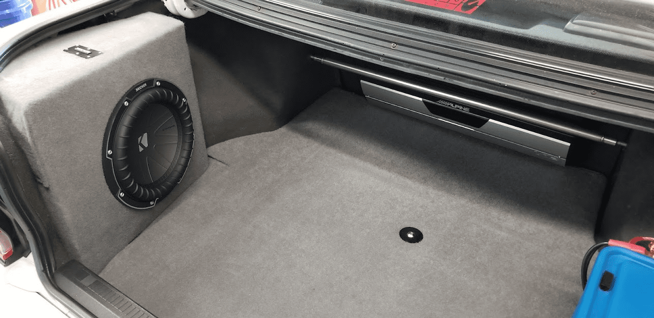

Built a new speaker box and upgraded the sub to a Kicker Q-Class 10. Also tidied up the rear trunk area.

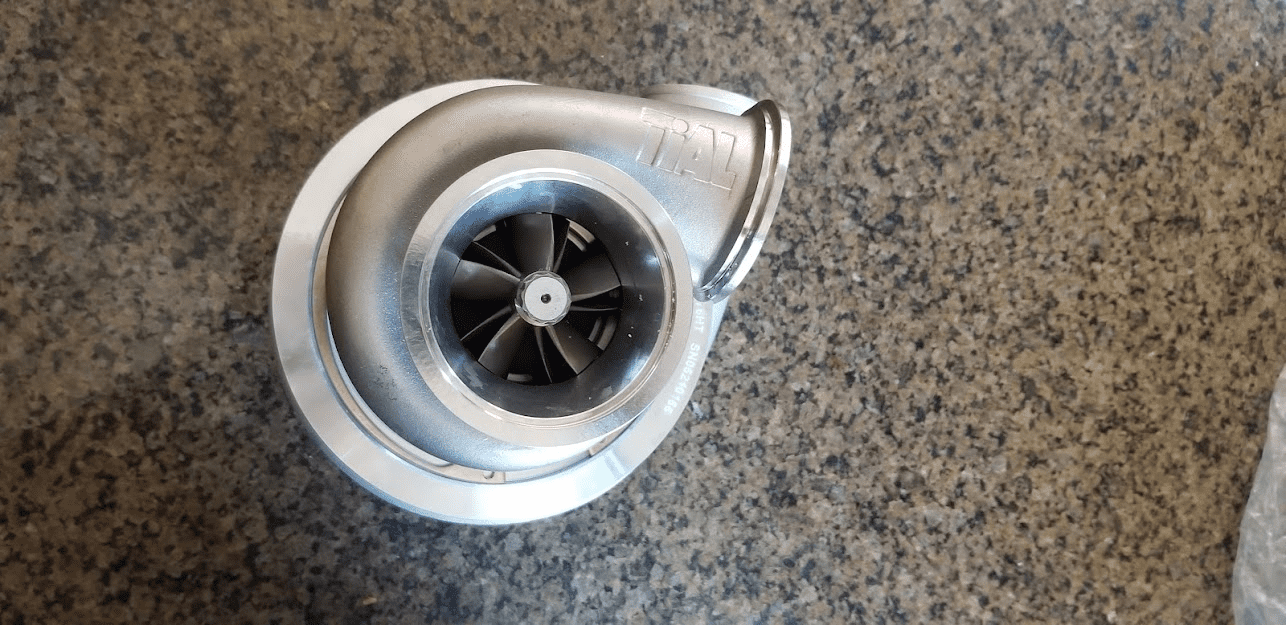

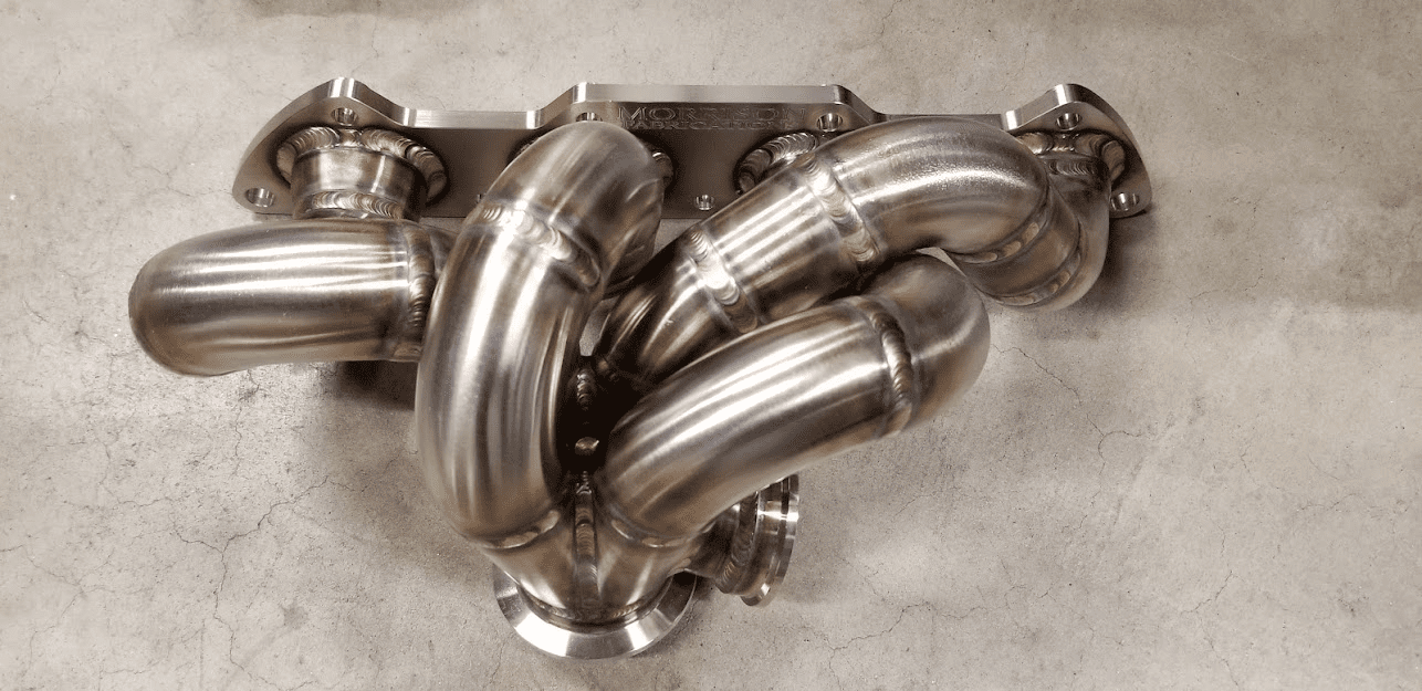

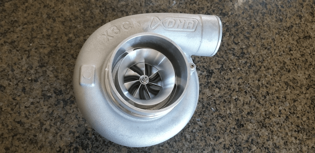

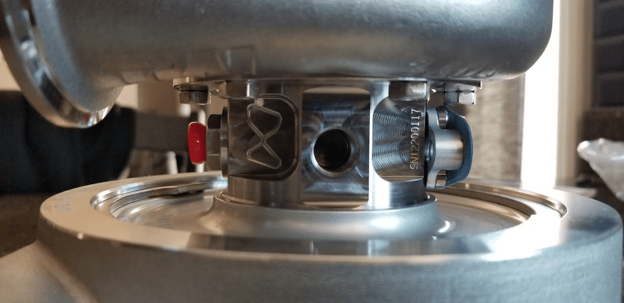

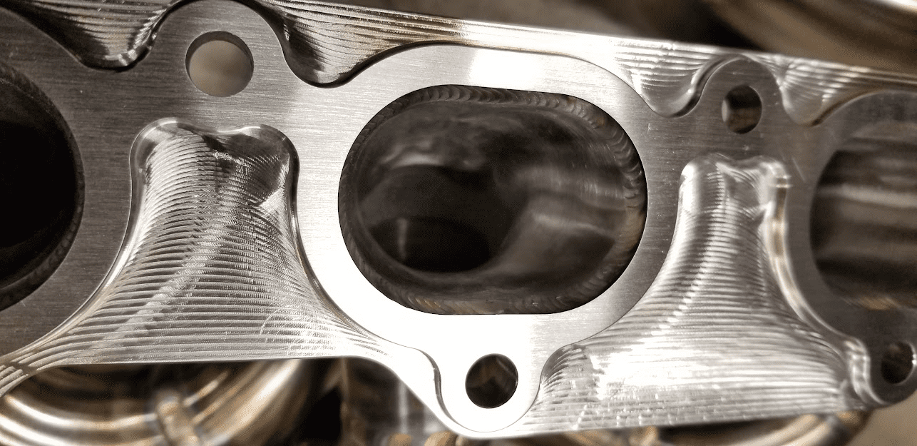

Oh, I bought a Xona Rotor XR61-57S and a @MorrisonFab hot parts setup.
