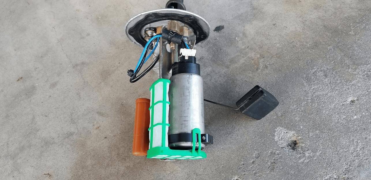

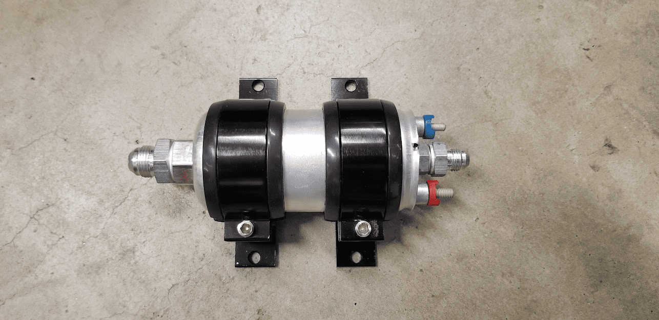

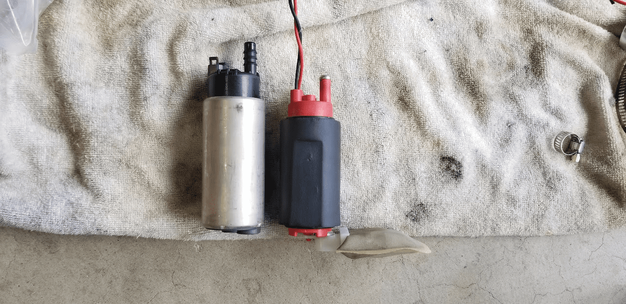

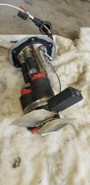

After much dicking around, I found increasing the fuel pressure at the regulator made the car run better. My initial thought was my A1000, which are notorious for wearing out prematurely on E85 exclusive cars, was failing. Since I've been wanting to take my fuel system from way overkill to something more reasonable, I figured now was the time to make some changes. I decided to ditch my A1000 and dual 340 in-tank setup for a single Bosch 044 and Bosch Motorsport BR540 in tank fuel pump. Now, what I didn't realize is that finding a NOT f***ING KNOCKOFF 044 pump these days would be nearly impossible. So much so in fact, that I had to order my parts from EFI Hardware in MoFuckiN AUSTRALIA.
WAT?

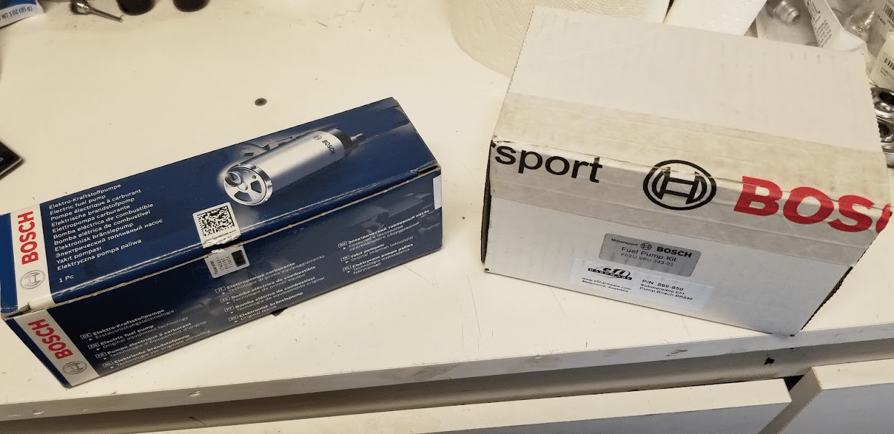

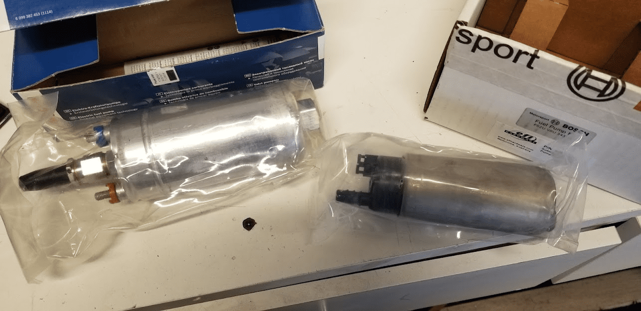

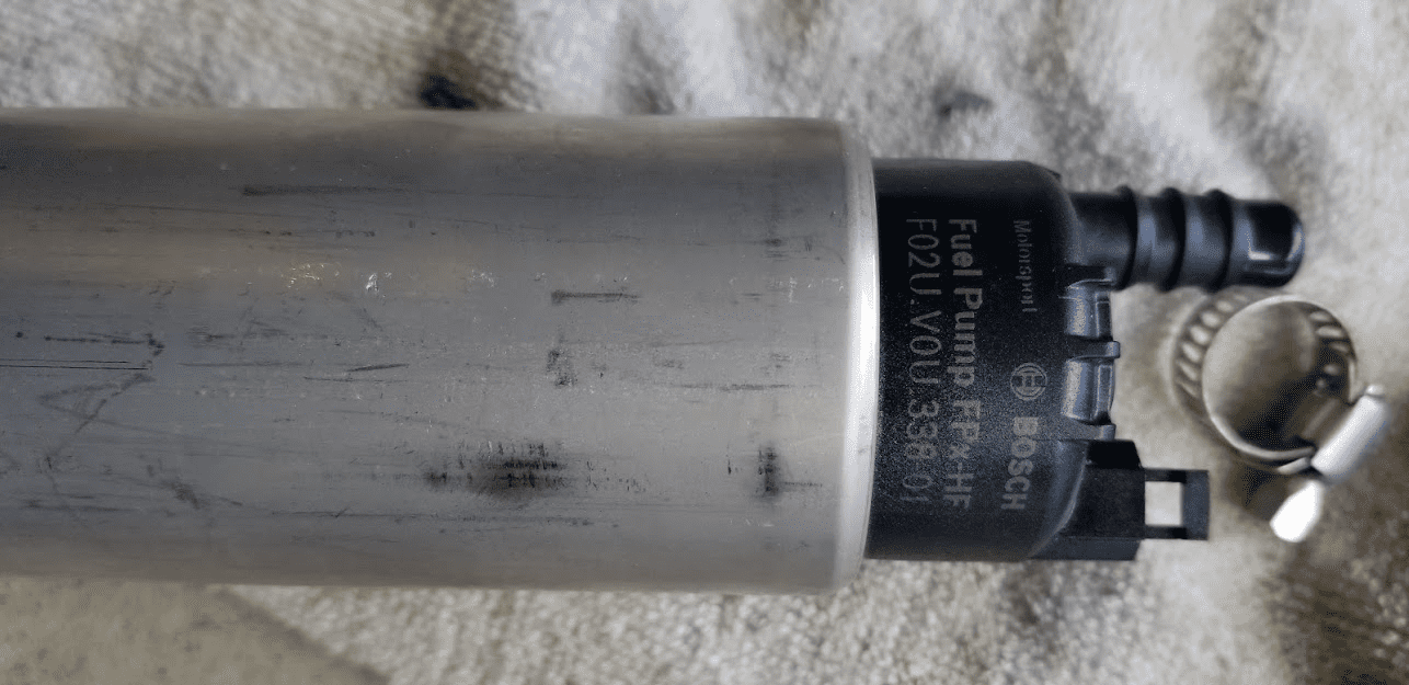

Anyways, after some waiting for parts to get shipped around the entire world, I got the new pumps and did a quick clean install, ditching the Aeromotive stuff for all new German engineered Bosch greatness.
Annnnddd...Naturally, all my new parts didn't fix anything and I was left back at square 1 troubleshooting again LOL

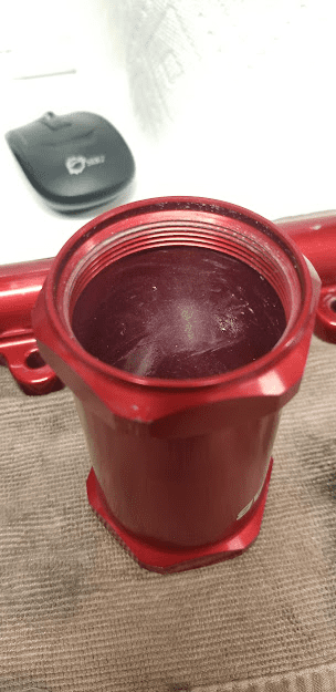

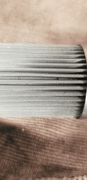

I pulled the lines, fuel rail, injectors, and fuel filter, and confirmed some of my suspicions:

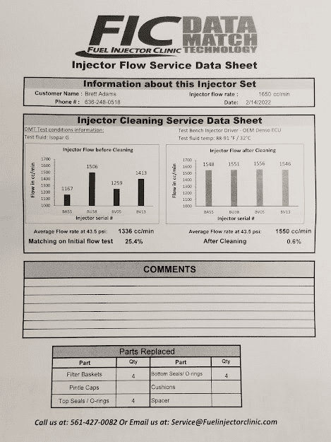

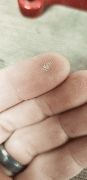

The filter was full of this moon dust shit. When wet, it was solid. As soon as it dried, it crumbled into nothing. At this point, I was convinced my injectors had ingested a metric shitload of moon dust, and needed a good cleaning. So, I sent them off the FIC, who confirmed that suspicion:
Once FIC sent me the flow sheet confirming the injectors were likely at fault, I started putting the pieces together:
1) The car sat while I was on deployment with E85 in the tank for nearly 8 months (f***up #1)
2) When I got back from deployment, I upgraded the fuel feed line with a 6an tank to rail, and swapped from a 10 micron paper element to a 40 micron stainless (f***up #2 and #3...you're not supposed to use paper elements with E85 and 40 microns doesn't filter out all the particulates).
3) The combination of stagnant fuel coupled with the 40 micron filter element let debris in the system pass into the injectors, clogging them up.
Somehow I couldn't put all these things together until this point in time.

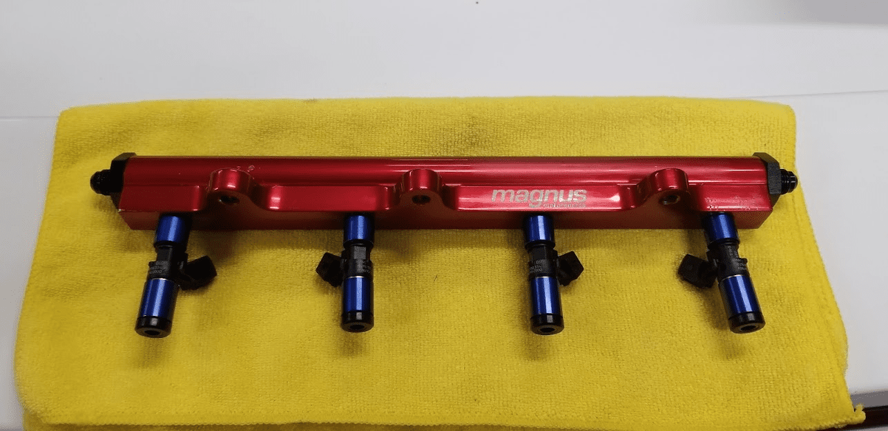

So, got the injectors back from FIC and installed them in the car, crossing my fingers and hoping my issue would be fixed.

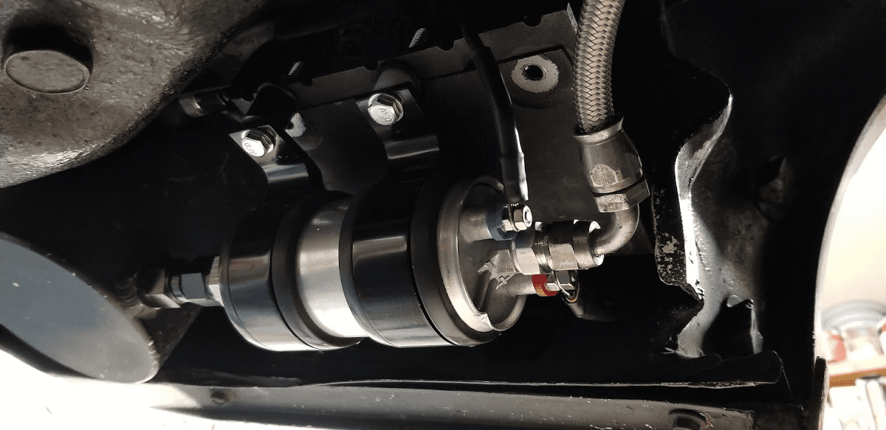

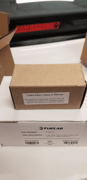

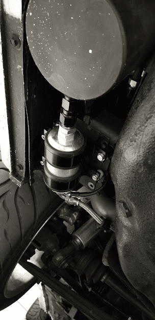

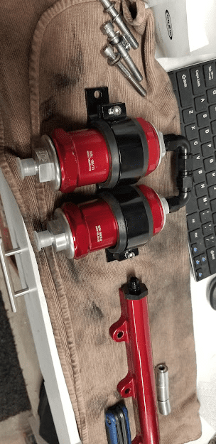

Additionally, I wised up and decided to run a dual filter setup to try and minimize any future occurrences of this happening. Probably overkill, but whatever. The 818 filters are cheap insurance. I decided to fabricate a Fuel Lab 818 dual fuel filter setup with a 40μ stainless element feeding into a 6μ fiberglass element (all E85 compatible this time...). The dual pass filters just before the rail should take care of any crap heading toward the injectors.
Put everything together, and used ECMlink to activate the pumps and check for leaks. With everything dry, I cranked the car up and went for a drive. SMOOTH AS BUTTER. In fact, this thing hasn't ran this good since I had it out at Streets of Willow.
With the car finally fixed, I kinda fell in love with it again. I wonder if I'm ever going to be able to let it go, or if this thing is legitimately a forever car...
Lastly, I don't get everything right. I share with you all in hopes you don't f*** up the same stuff I do. Live and learn. But please, do learn 🤣
:dsm:Thanks for following along :dsm:
Glad you figured it out. I wouldn't worry about using the paper filters. I've been running a stock type dsm filter on my car since like 08 and ever had issues with them. Drill the bottom so the inlet matches the stock hard line id, and they good enough for 800ish hp.
Agreed. I know it's not "recommended" but my 10 micron paper element held up just fine. In fact, I definitively proved it works better than the 40 micron stainless filter I changed it out for.
The 6 micron glass element should certainly do the trick, and it's E85 compatible.
All said and done, it's now very clear to me the filter selection at the rail is critically important.

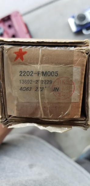

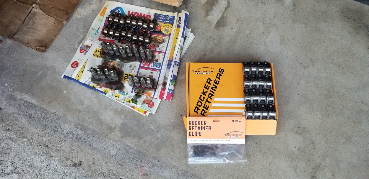

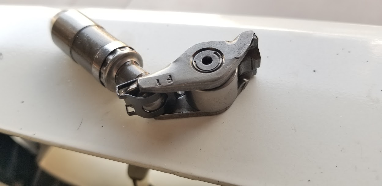

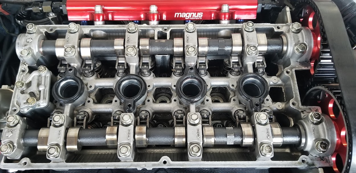

Just getting around to posting an old update. Swapped in a 272 intake cam a while back, so I'm 272 in/ex at this point. Used the olé zip tie trick because I'm old and lazy. While I was in there, added some Evo rockers and rocker retainer clips.
I was kind of surprised at how much more air the top end was flowing just from changing the one cam. I had to make a few small adjustments to the fuel tune, but overall nothing major.

Interesting, I have never seen the rocker retainer clips used before! I wonder how they do on extremely high rpm applications (i.e. Wohler at 11k rpm LOL).
Well I spoke with Wohler, he actually tried them, broke all 16 in one race day, had to fish chunks out of everywhere. They do not work on very high rpm applications.
That's rough. Well, not the first $100 bucks I've pissed away on the car I guess ROFL
I'm sure it will be fine for mere mortals that are just going to standard rpm limits, just don't get frisky and think they are going to handle 9.5k+.
