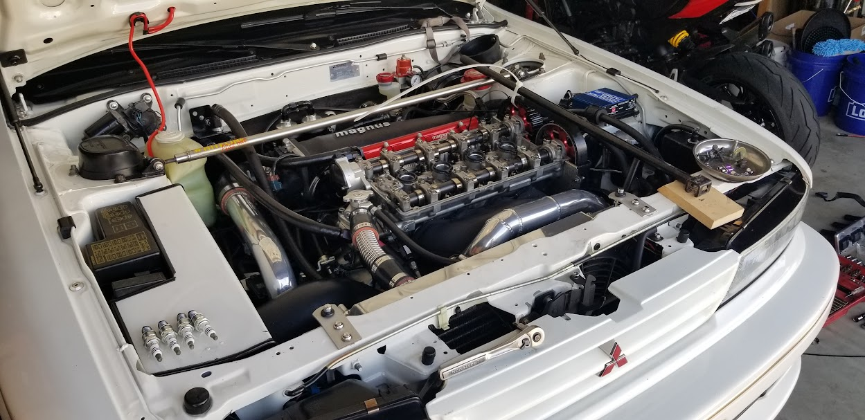

Mitsubishi Galant VR4 number 1837 out of 2000 imported in 1991

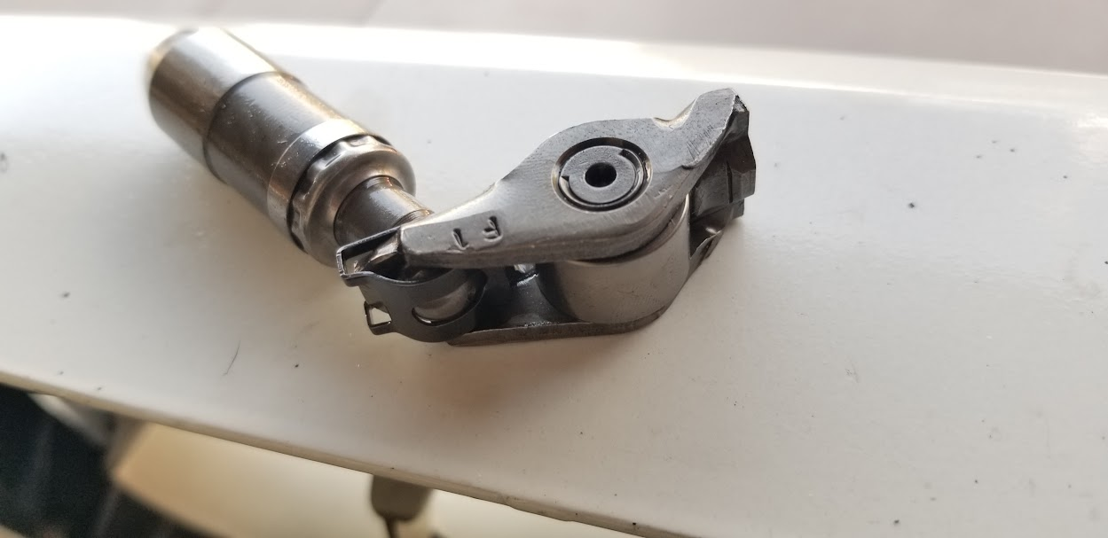

Is there even a need for these? I thought the factory rockers stay put till at least 9000 rpm.
I know SR20's like to spit out rockers but is this just a solution looking for a problem?

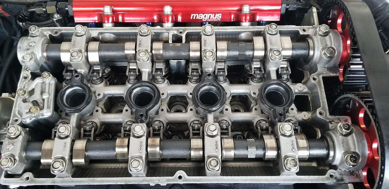

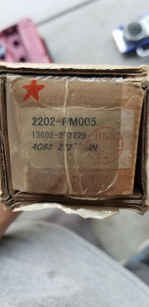

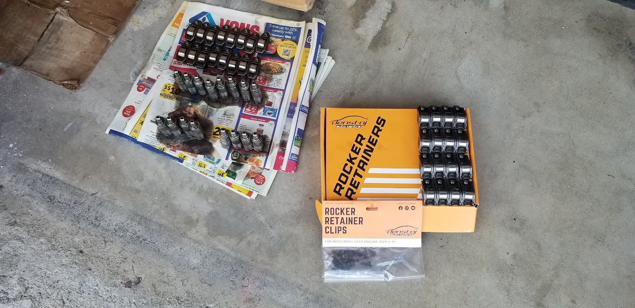

Just getting around to posting an old update. Swapped in a 272 intake cam a while back, so I'm 272 in/ex at this point. Used the olé zip tie trick because I'm old and lazy. While I was in there, added some Evo rockers and rocker retainer clips.
I was kind of surprised at how much more air the top end was flowing just from changing the one cam. I had to make a few small adjustments to the fuel tune, but overall nothing major.

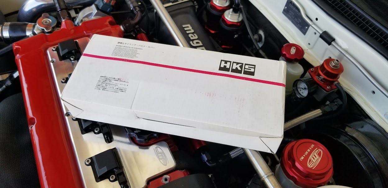

Looked around for a while, and found one of these. Hard to find the legit part nowadays, since the knockoffs are pretty much all that's out there now.

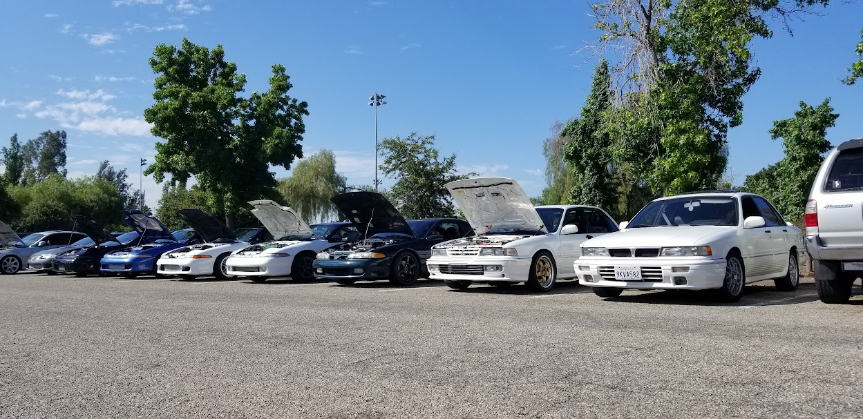

Lastly, a CnC meet a while back I never posted
do you have issues with rockers flying off or just a worry on it?
The were cheap, so figured the added insurance wouldn't hurt.
I'll just consider myself "lucky".....:oops:
