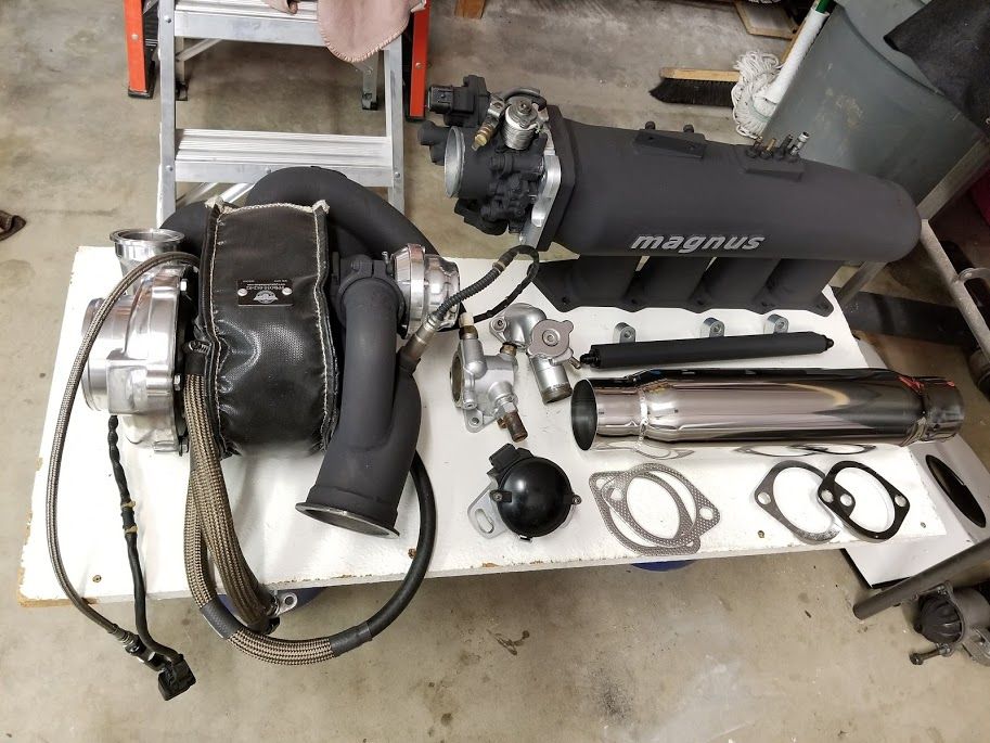

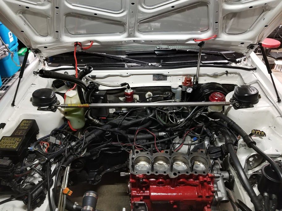

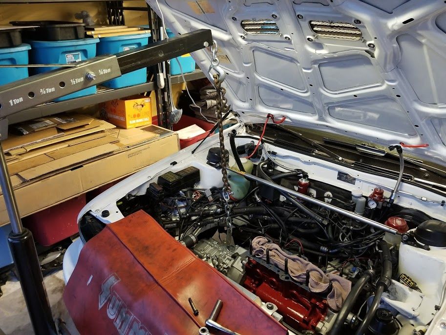

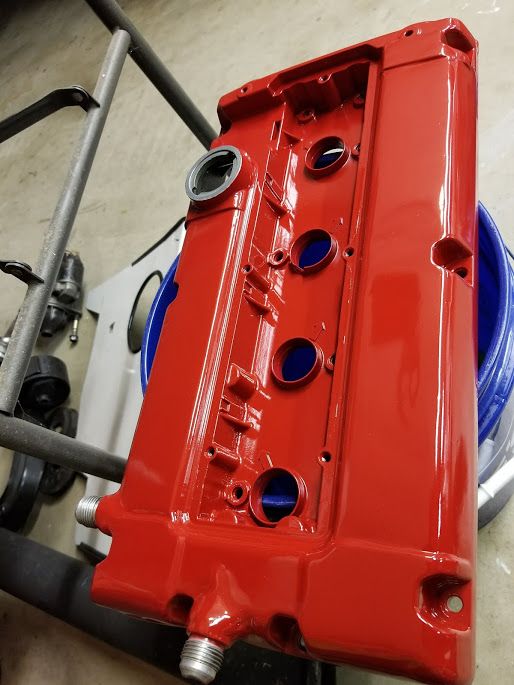

Once everything was pulled apart, I went ahead and did some cleaning where needed. I also repainted the hot parts, per the usual. If I had to guess, damn near 60% of my time is spent cleaning rather than building...But it's always worth it in the end.
0P_UUUbmVYd3Wd_8J1C8GaATwYuyDT2tjAnPxssosa2LFvCThsERp6y3Fb0vrgAubZ8EM179mzZ6a_OLHvA=w514-h685-no.jpg
I_Yt7RlbzMZfzCaY05pgBMjQ78NOpIybziIi8JKXH8D2xoTmz-oQUVax3UedFyhA0U8qOR-0gF84bs46-_w=w914-h685-no.jpg
n6f1fx3Tuzhu9-_K50WwHoC0aGnvo9NohE1a2vcrugsxmAHusf0fOO6smwT2AM8LCtoAzShGuEEoVyeX0Cg=w914-h685-no.jpg
o6XYGMJ0Dz4NGVzP8n6fnVLvSlWq4IsseFPymkSQf0IEB33_-Agzr5WqZx5Nz-JsSnwLuhdRiVUzhwHGdhg=w514-h685-no.jpg
uIyVIVZ5jUryqCxR44POXetvfPkFIbIHC13wkyWLAbVo9ofaVzmSlZbr2x73OMViy_g9ldX7CICgx9FUiow=w514-h685-no.jpg

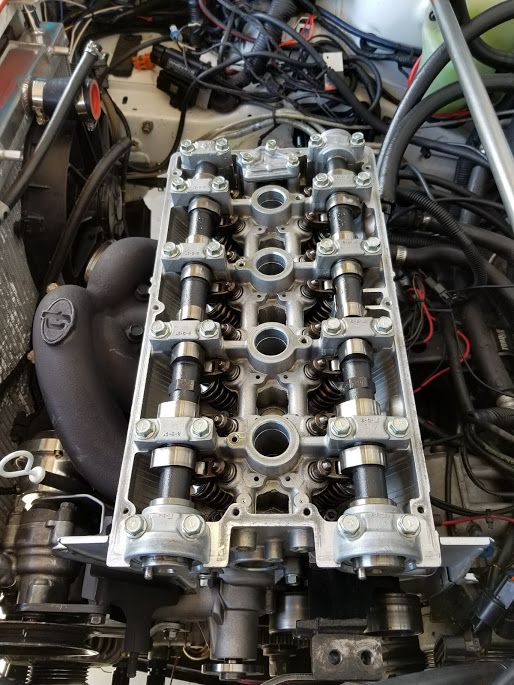

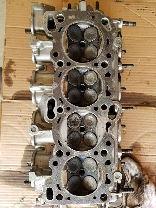

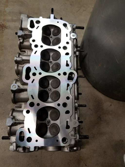

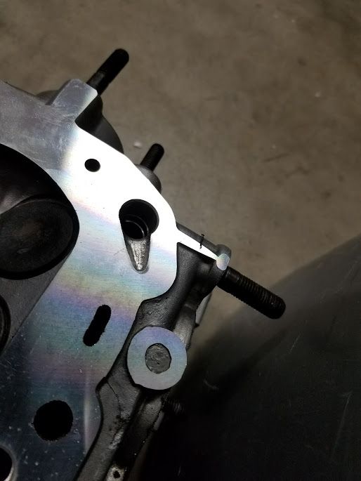

Here's a little before and after of the head. It took the machine shop 2 times to get it right, but it turned out pretty decent in the end. I went ahead and ported the oil passage since I lost some meat from the deck surface.
RF9WMhgzDZDrY6MXaGxNNaQX6j-HXncHzZqd--iPFUcAs3eI4Ab_3cTNiUnxzb7ZGKXss1d34LWEK3RdoEA=w514-h685-no.jpg
mi7PrHZAz-lGUk4klYZqAX2WzVL0_nHhz4Ow8iY1qd6_M2eO_ldgtJPgtPOwbLKfxkUVbrRJYRAPjYtMkxQ=w514-h685-no.jpg
UypADsaEu2PF5AURpW1zMXxdE5GFVs185jLHjyrcTbljC-Fw9Q1M4UKWM5JSKwhp3FVKhvsQevW8Vdc3VJA=w514-h685-no.jpg

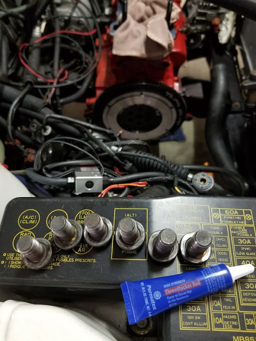

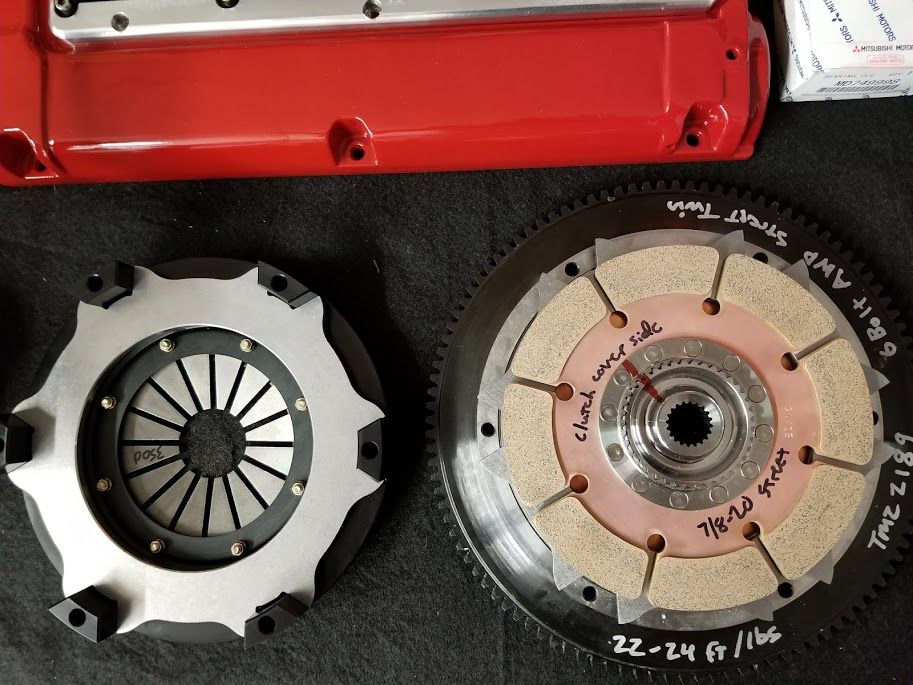

Since the car was down and apart, it was finally time to put in some of the new parts I've had on the shelf. The big one was a new Quarter Master Gear-Drive 6-leg clutch and flywheel custom spec'd for the car by Tim at TMZ @twicks69. It was a pretty pricey addition, but it's also a pretty nice piece of hardware. A new Mitsubishi TOB and Competition Clutch release fork & pivot ball went in as well.

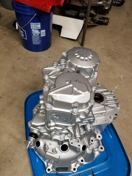

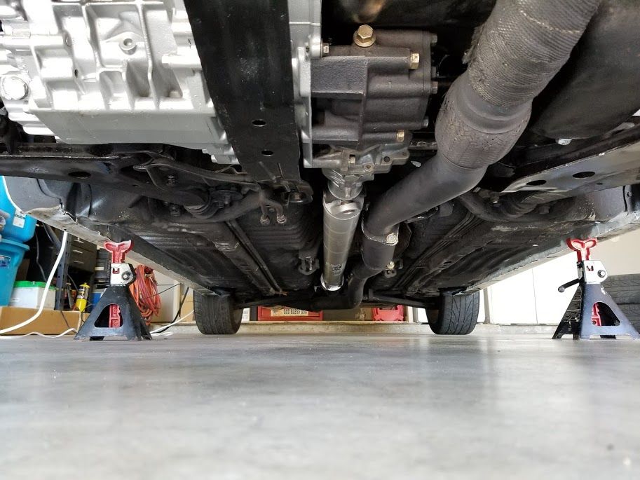

Trans installed single-handedly...Because engine hoist > any amount of hands.
JRnYEmTeyesY3nxkPZ3kttVTy6tHszJZxh3-Jl7OHB6NnUJap2S3-wPvcVnfrC2PUoOpzT385sJpGyZ7Kcw=w914-h685-no.jpg

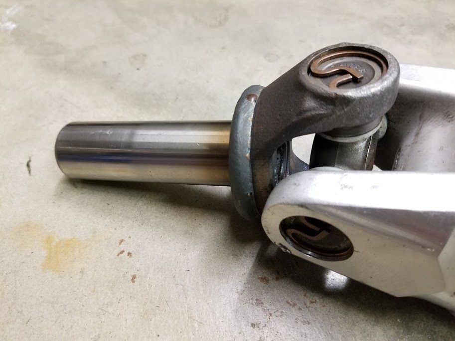

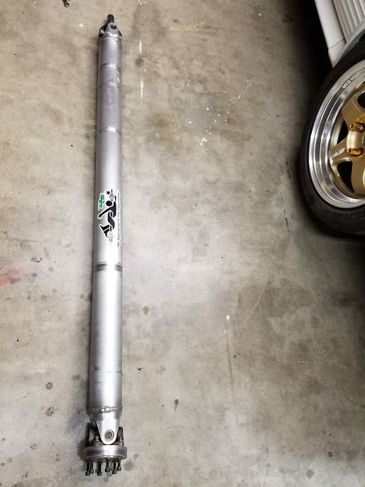

After much wasted time and ass pain, DSS finally shipped me a new slip yoke. With the addition of all new Torque Solutions motor mounts, I'm hoping the slip yoke will hold out longer than the last one did. Time will tell. I also added a Vibrant resonator in place of my old cat to make some extra room for the DSS driveshaft.

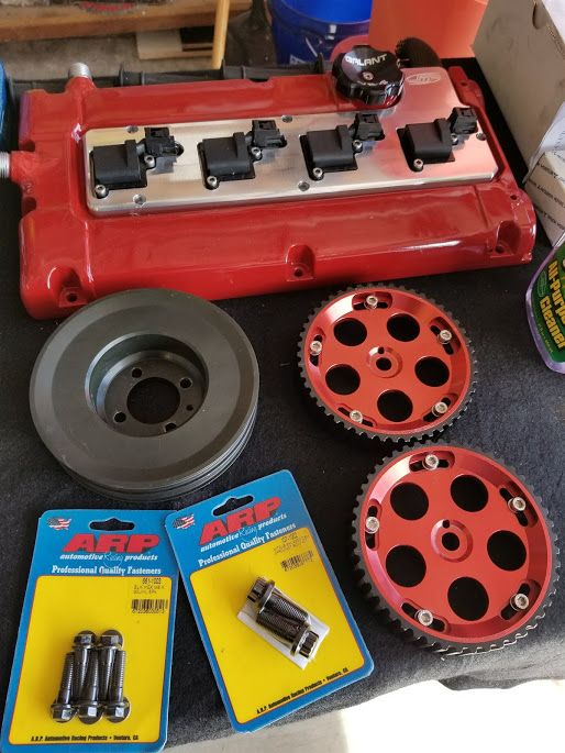

A Fluidampr and some new ARP hardware sum up the new additions.

At this point, I've got about 200 miles on the new setup, and so far so good. Now, just need to get back on the dyno, down the 1/4 mile, or on the road course...Or all of the above :sneaky:
That's odd. I've never seen a felpro torch a head like that. I've had some leakers before too LOL. Seem's like maybe it was lean in that hole. I'd suggest having your injectors flowed, and fattening it up a touch.
Pics not working?
Sorry, guys. Should be fixed now. Google used to make hosting images easy :|
Yeah, I think my issue was tune related, coupled with operator error. I wasn't looking at the dash for knock, or logging, but I'm guessing the CEL was telling me to get out of the throttle and I didn't see it until it was too late. I've since pulled some timing out of the map for now. Finding a back country road here in San Diego to do 3rd gear tuning pulls isn't as easy as it once was while I was on the East Coast.

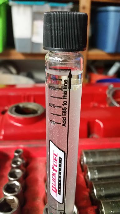

I thought maybe this Cali corn juice may have been weak, but that's definitely not the case.

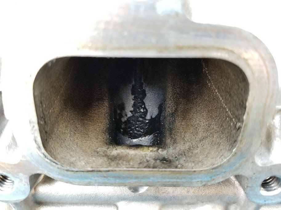

I didn't get the injectors cleaned, but did remove some goo from the head, and a small bit from the injector tips. I'll probably send them off to get cleaned and flow tested before summer.

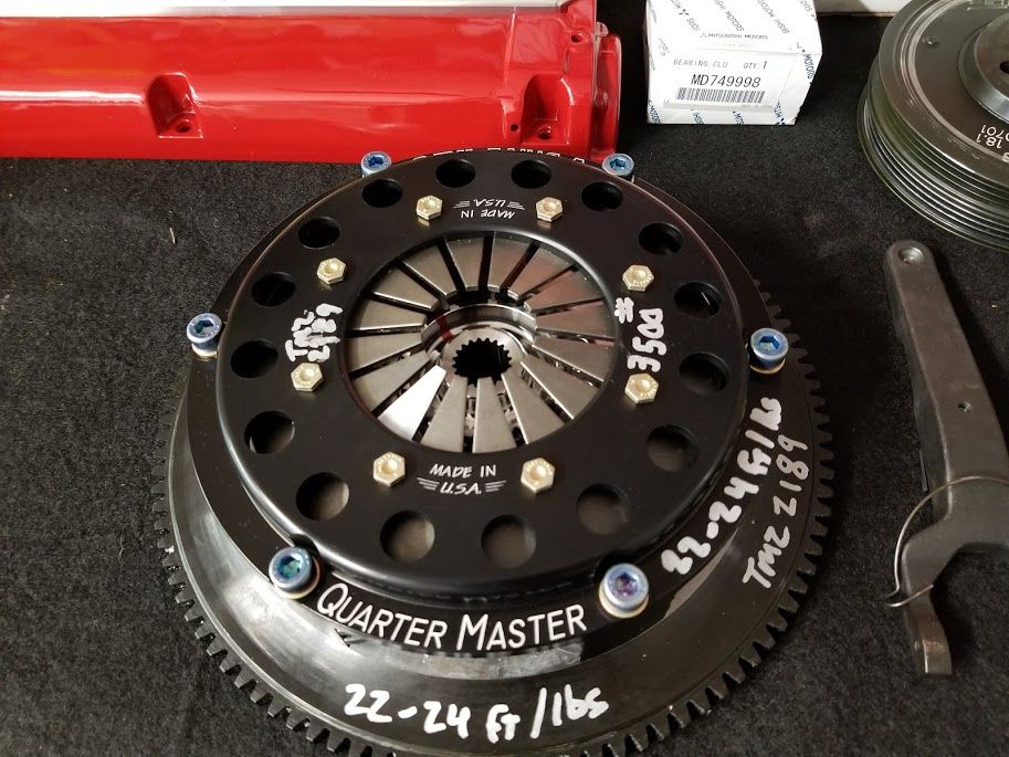

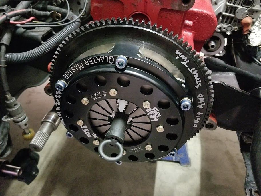

Your QM clutch looks great. How does the pedal effort compare with your previous clutch? How would you say it compares in other ways? Your previous was an ACT 2600 I believe?

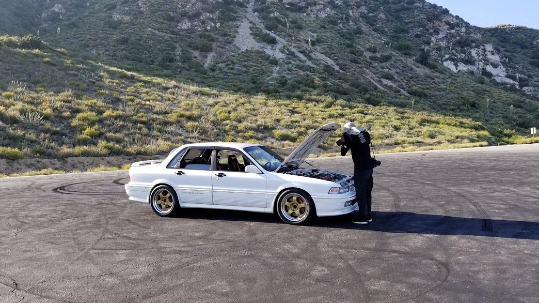

I decided to take the Galant out to Race Legal in San Diego to test out the new clutch. Finding a place to do test launches in SoCal isn't easy or convenient like it was while I was in Maryland. I wasn't expecting to set any record times, since the 1/8 mile "track" is just a section of parking lot they section off to make runs on. As expected, zero traction out of the hole, but it was definitely fun making passes and hanging out.
I dragged my buddy David along with me, and also got to meet a guy from the Galant board and check out his GGSX. There were some local DSM guys there we got to chat with as well, so all in all, it was a good time.
Pics of the Mitsu stuff, Richard's GGSX, and some video of my first pass of the night:

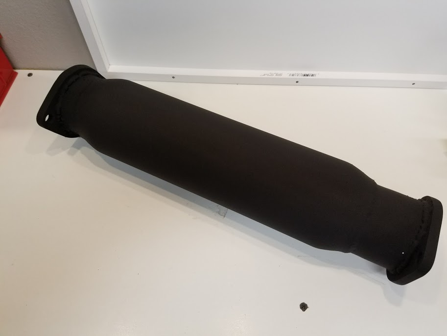

I've been looking through your photos to see if your O2 housing is wrapped, or has a blanket. Looks like no. Is heat-wrapping the O2 kind of not a good idea? I've been thinking about it just to reduce heat to the alternator (in stock position) but kind of chickening out on it. I'm just now finishing up a nice heat shield that will go between the alternator and the hot stuff, to block infrared to the alternator. My exhaust manifold is wrapped. My turbine housing is not wrapped.
What do you think?
@GST with PSI
What do you think?
I have blankets on the exhaust manifold and turbine housing. My downpipe is wrapped, but not the O2 housing.
Anything you can do to keep heat from getting to the alternator is a good thing.

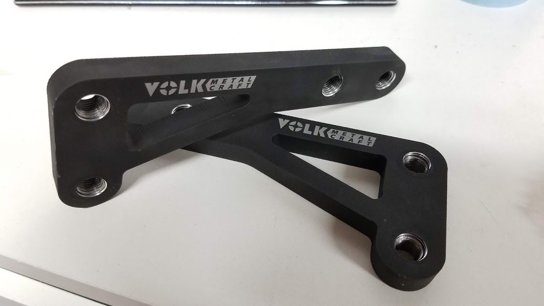

Luckily, @99gst_racer agreed to make some new brackets, which will help me and the community out! So, just waiting on those to get finished up so I can get the car back together.
