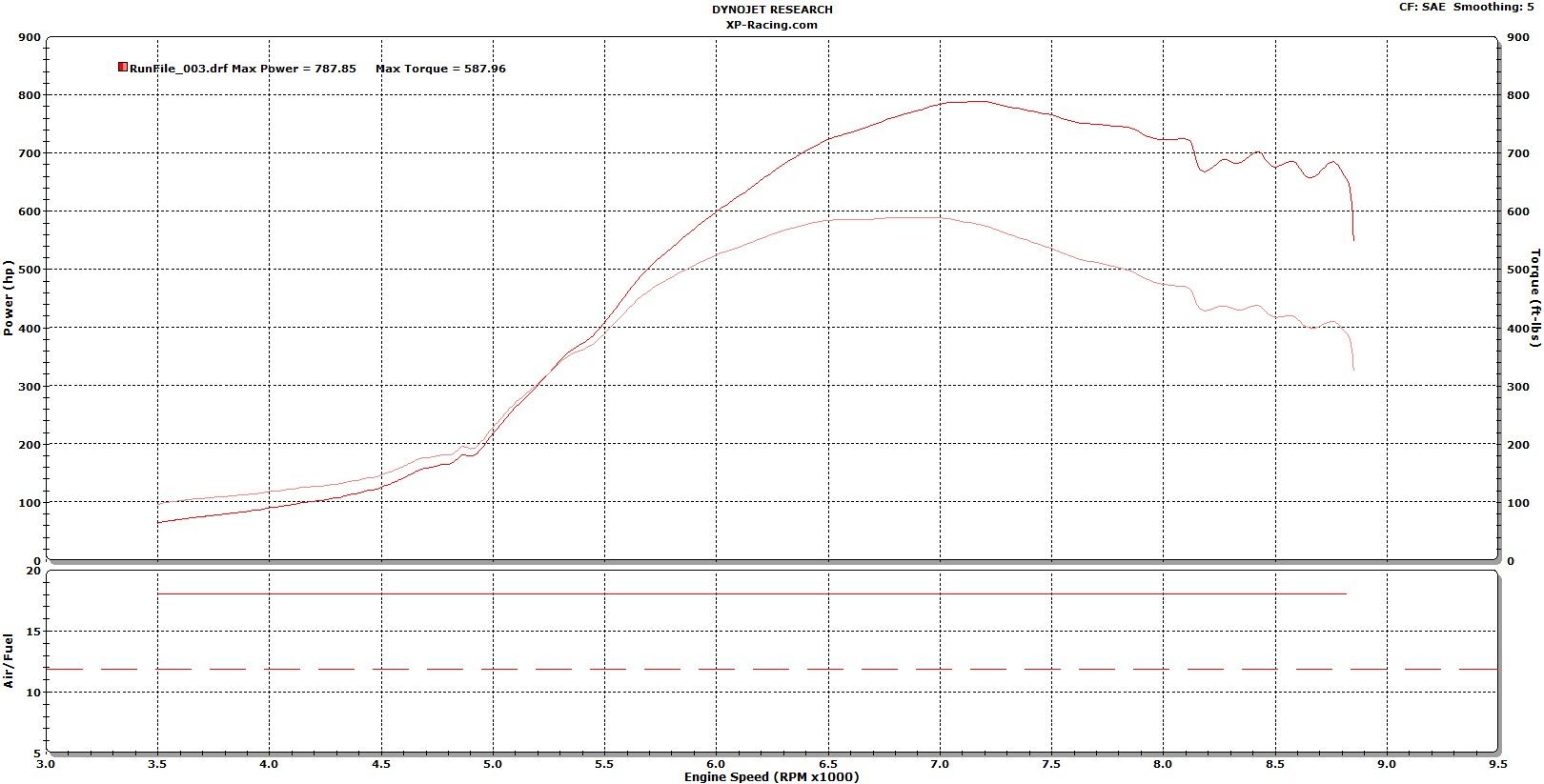

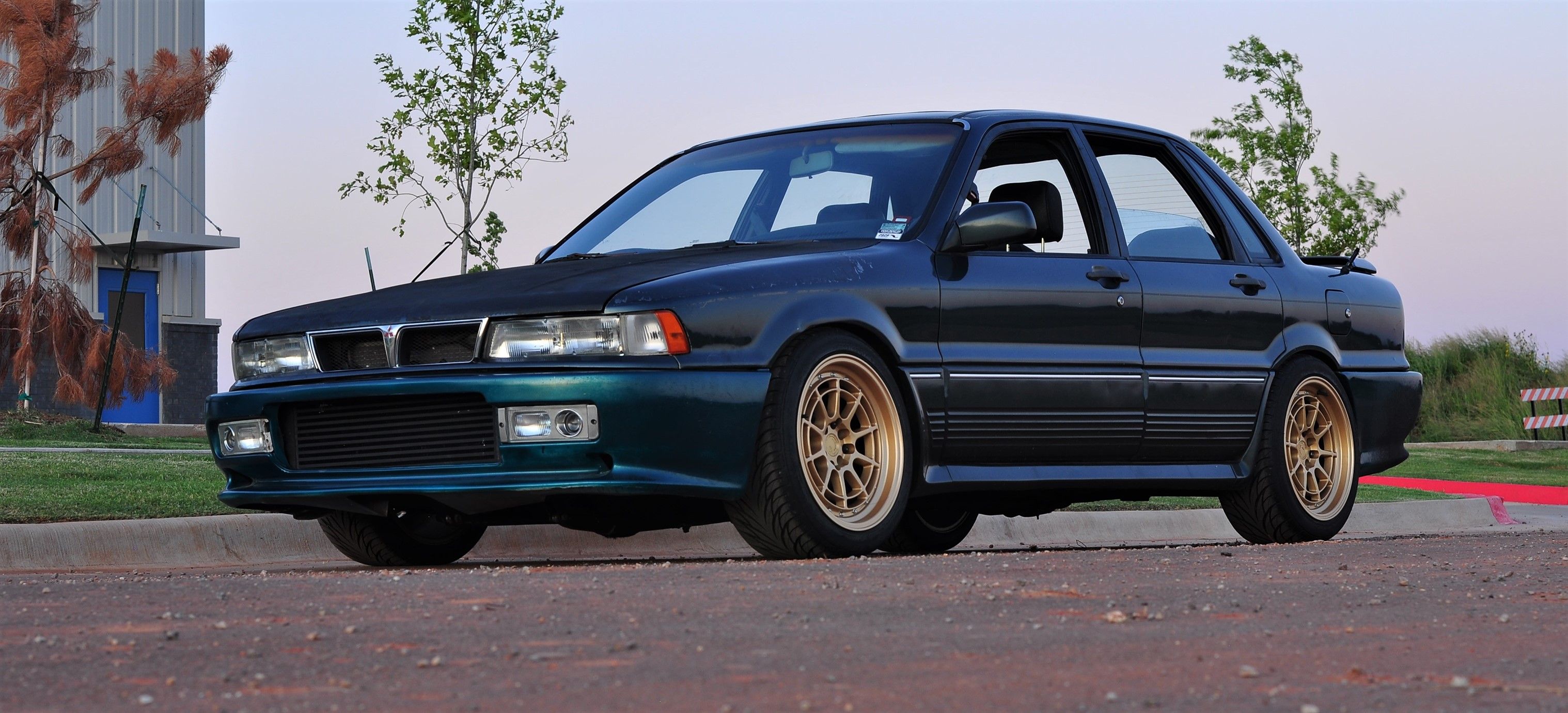

After torching the head over a year ago, I had the head rebuilt by Darren (Darren Thomas Racing.) It was time since there was evidence of valve float last time I had it on the dyno (790whp) so he installed new Kiggly springs and did a nice freshen up. I installed a new Mitsubishi MLS gasket as my old one got torched after I did something dumb. Over the winter, I changed the turbo setup up (bigger turbo now which will remain undisclosed) got some of that Morrison FAB Swag, and I just recently upgraded my entire fuel system. After cleaning my 2150ccs almost 4 times in less than 1000 miles, I had enough of it. Car now has all PTFE -10AN lines (feed and return - was expensive AF - damn Fragola fittings) a Magnus fuel rail, and a Magnafuel 750 with the Magnafuel filters. Fuel for days. Got rid of the twin intank setup I had because it was becoming unreliable and I didn't want to risk torching something from running lean due to a single pump failure. Currently, doing testing.
Wow. I drove this car this weekend for the first time since the summer of 2021. It felt nice. Took it to the car bath to hose off some bird poop. It has some vibration which could be from tire flat spots? I will be swapping those wheels/tires out in a week or two. But...feels good not to be a garage/driveway ornament. I intend to drive it some so she has some regular pump gas in it. It's probably been 7 years since I ran 91 in it.
New wheels and tires and she runs good. Still on pump so I am not doing any boost pulls until I have burned the tank. Other than a small oil return hose leak, it runs relatively well. I may have put around a 100 miles or so and hope to put more. I would definitely daily it more if it didn't have an open exhaust. :D
