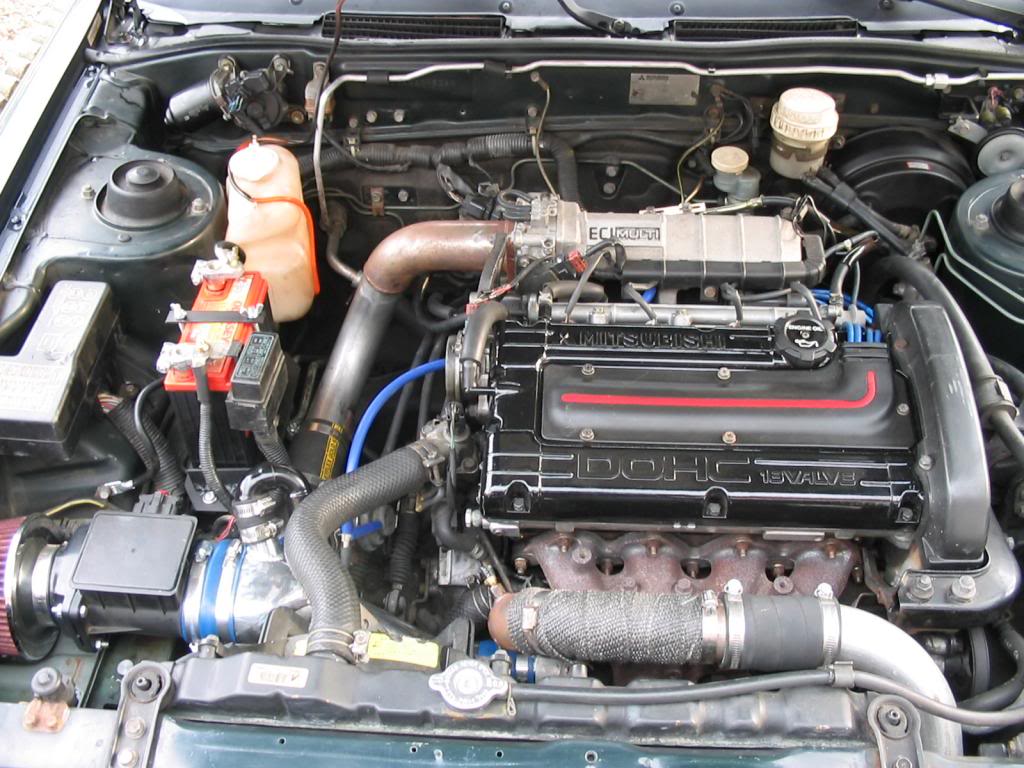

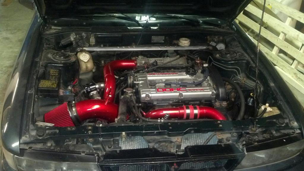

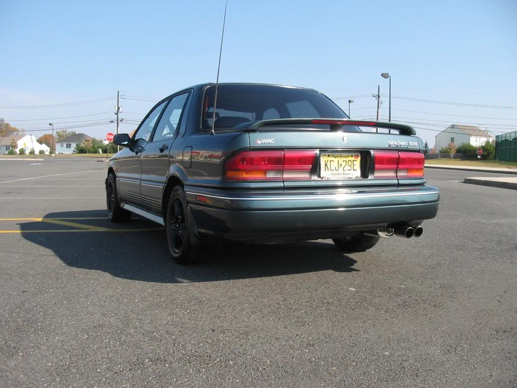

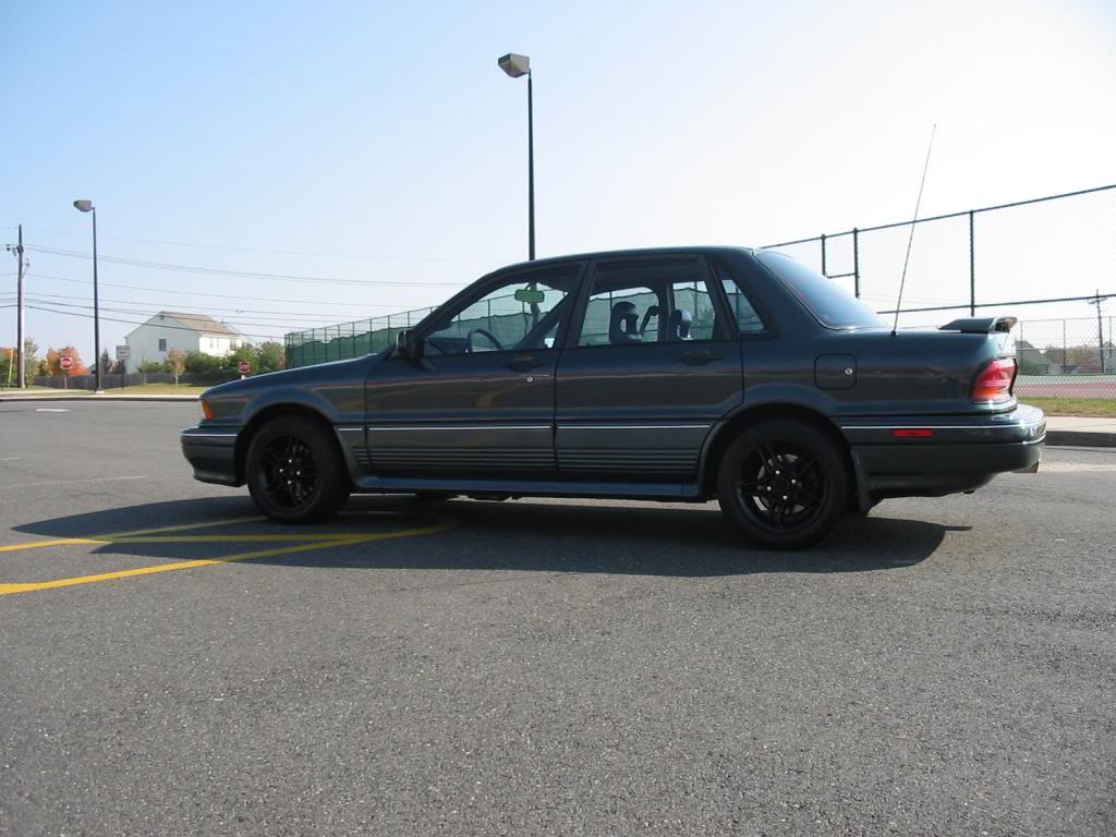

Car:
'91 Belize Green Galant Vr4 |AWS|AWD|
As it was bought:
~Turbo back 2.5in exhaust w/ Magnaflow twin tip muffler
~2.5in pipping with some FMIC (Knowing the PO's its probably Ebay)
~Big 16g turbo from evo 8
~560cc injectors from evo 8
~Walbro Fuel pump
~Act 2600? clutch
~KYB Gr2's
~Ebay FPR with Jegs Fuel pressure gauge
~Some Random BOV.
~AEM Filter that adds mad HP yo!. (being replaced since its GLUED onto the EBAY MAF and its so dirty idk how its getting air.
~S13 SE 240sx wheels hahaha.
Ive had this car to work on for almost a week in my free time for a friend and basically heres what i got the first day:
~Idle screw set to idle car at 2700
~Found 3 blown fuses with a small metal wire wrapped around boths sides of the fuse so it wouldn't blow.
~Passenger wiper looks like it would fit on a ATV if ATVs had wipers
~Glued on air filter to the MAF and its SO DIRTY. but someone decided to keep it bc its a AEM (MAD HP YO!)
~Both front axle bearings are bad
~PCV valve missing and stripped out on valve cover.
~Wiring... LOL on 7 plugs someone must of broke the soder and put the plug on but the wires were just JAMMED in there.
~slight Overheating due to Bad fan relay and fan not on at all.
~Syncos in 1st, 2nd, and reverse are half way to shot. (have a spare Trans in my garage )
~Radiator seems to be pushed down 2 inches with no top support bars...
~4 vacuum lines on the Intake manifold that weren't capped or being used.
And so on...

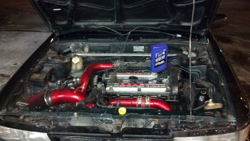

Current Mod List
~Big 16g turbo
~Evo 560cc injectors
~Walbro Fuel pump
~Act 2600 clutch
~KYB Gr2's
~Custom FMIC piping and Red Candy flake powdercoat.
~Intake cone
~new alternator (pain in the ass because the wiring is...horrible ..)
~Samco Diverter value installed
~DSM Link V3
~Innovate Wideband o2 and Sensor plugs for the dsm link to run NO maf and map sensor/speed density (was like that when i got it)
~New wipers finally! LOL
~Wheel Bearings
~Brake/coolant system bled and cleaned
~Royal Purple oil (Got a deal on royal purple bc my g35 takes 5.5 quarts LOL)
~New valve cover and Timing belt cover
~OEM thermostat
~Hallaman Pro MBC
~2 New fan relays
~ Custom Intercooler pipping. Chrome base/candy red powder coat and tons of metallic paint.
~LC1 wb02 gm map/gm iat/No maf
~Complete 4WS System removed. Leaking more then a whore with gonorrhea.

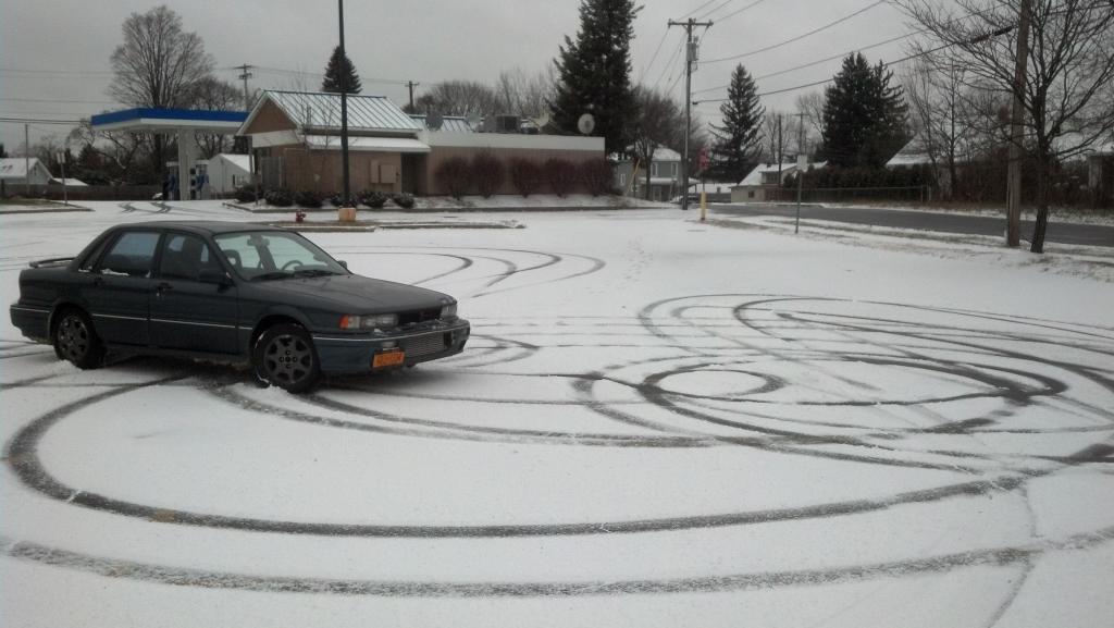

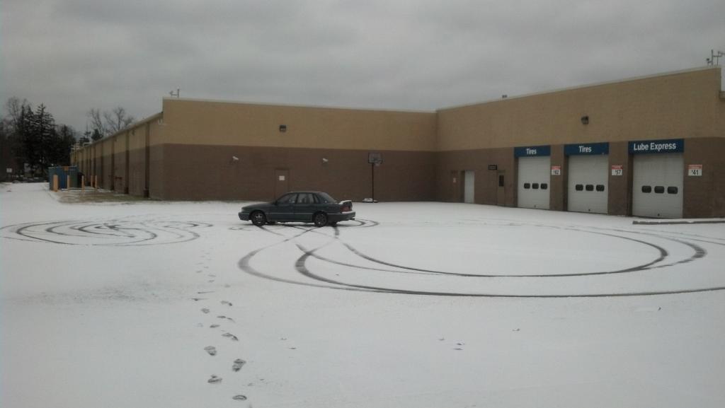

Small parking lot fun, just a dusting of snow.

Saw a 1969 Chev Malibu with a 427, L-88 motor under the hood doing some serious cookies in the mall parking lot like that on a fresh, snow covered day.
Motor was all wrapped up real good and vehicle skidding everywhere but where it shouldn't be. Just about found a few light posts.
Suddenly, the back end found some dry stuff and horrible happened:
Back tires (positrac rear end), when hitting the dry stuff, suddenly grabbed causing a connecting rod on the down stroke, go through the crank and out through the oil pan along with twisting up the drive shaft like a rubber band. Oil went everywhere along with some serious smoke. People saw some smoke, called the fire department and police. Owner paid dearly for his antics on a privately owned parking lot in more ways that one can think about.
Best not show picts of poor driving habits and in privately owned parking lots where doing cookies is against the law- it's not what this forum needs to be known for since we don't support any of that . We want to see vehicles in a more presentable and respectable position. Links do not work either...a good thing for your sake.
Nice vehicle though and motor layout - just don't find any lamp posts.

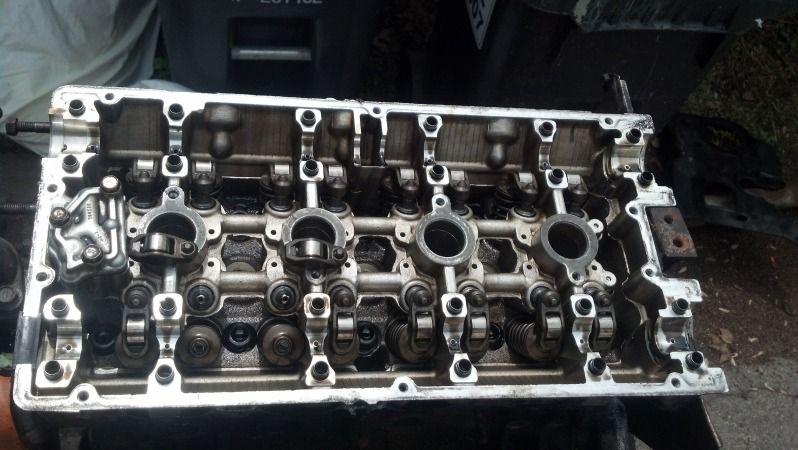

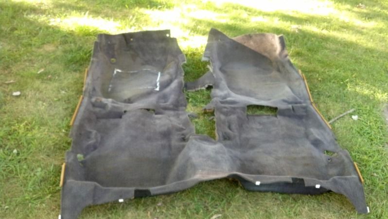

Got my Arp headstuds in the mail. Drove 2 hours to get a complete Talon awd rear subframe with everything from 4bolt rear/axles... control arms to fix my 4ws delete properly. etc. Has 5 lug but not sure if im going to use it. When the subframe down to parts for sandblasting ill take pics.
Also ordered a built head that used to be a members on here. Things are moving better then what i had expected. Soon as more parts arrive i assure you this thread will actually be interesting LOL.
Thanks! bought it as winter beater to just fix up and get another 240 as a project car but we've all seen were this is headed LOL. Car is a blast to drive even if i only get 10mpg LOL.
yea i cant wait to i can get mine back on the road. they are really funn cars to drive. i going to make mine a sleeper, just hope that it gets a little bit better them 10mpg.
Only thing besides doing this: (she loves to drink)
I got mail!
~HKS 272/272
~Complete AWD rear subframe w/4bolt and 5lug. Might stay 4 lug for now.
~Built head (Port and polish,Evo springs and retainers,3G lifters, hot tank, bronze guides etc)
~Evo 9 Steering wheel (HATE the factory 1g)
~Evo 9 Gauge cluster
~All 4, New mounts with Poly Bushings (mine are SHOT)
~Complete dash and engine harness. (Engine wire tuck and replace the crap/hacked wire job it has now.)

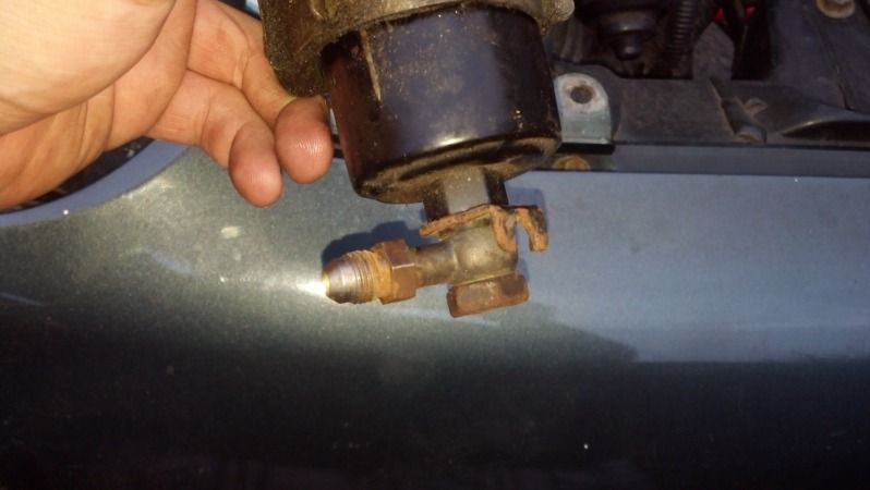

~OEM Thermostat housing. looks like someone took a hammer to mine on the seal for the thermostat.
And alot more.
Still after some hard to find parts like interior pieces and oem mudflaps in addition to allllllll the other things like Complete fuel and brake lines, A1000 pump bottom end rebuild etc.

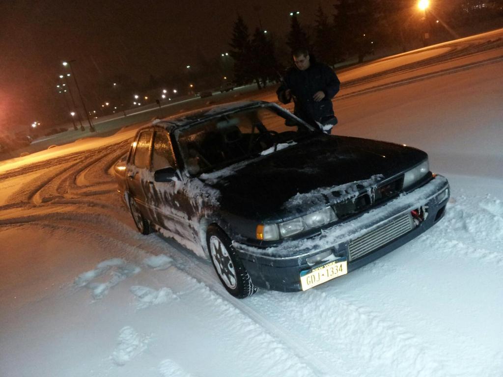

Heres some pics of the recent storm and a closing vid of what happens when i get bored. I love doing this in any parking lot. This was my second time doing it in the same spot so it got dry and the parking lot wasn't exactly smooth. (Ignore my friend... Not sure what was so funny LOL)
[ame=http://www.youtube.com/watch?v=riDk8oLtZRM]Galant VR4 Winter Fun - YouTube[/ame]

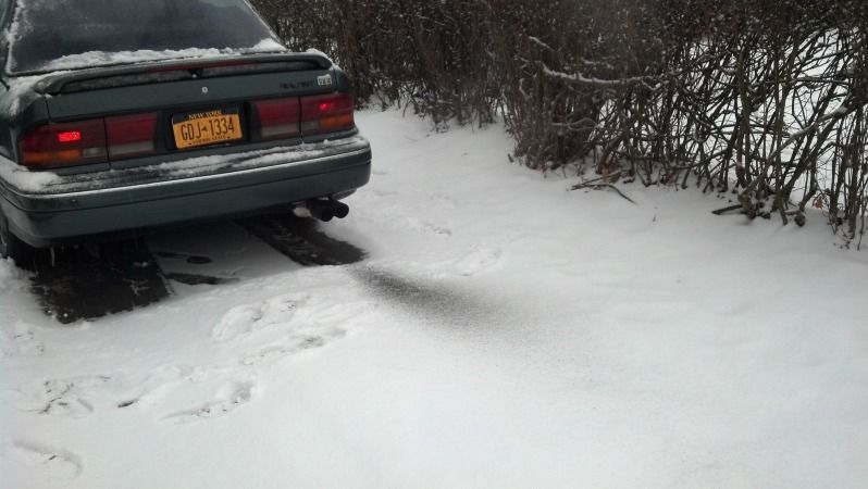

To give you an idea HOW rich it runs. Taken 2 months ago.
The next day

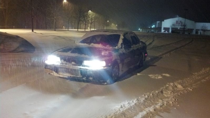

Snow was coming down at 1.5 inches an hour for 10 hours straight. Needless to say i wasnt haveing fun past 2 inches bc of my all seasons i forgot to swap out to the snows LOL
Stock headlights look bright, but they SUCK.

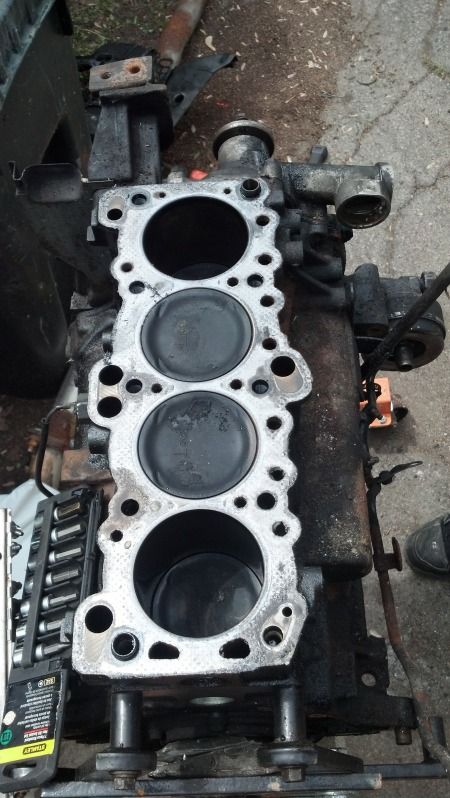

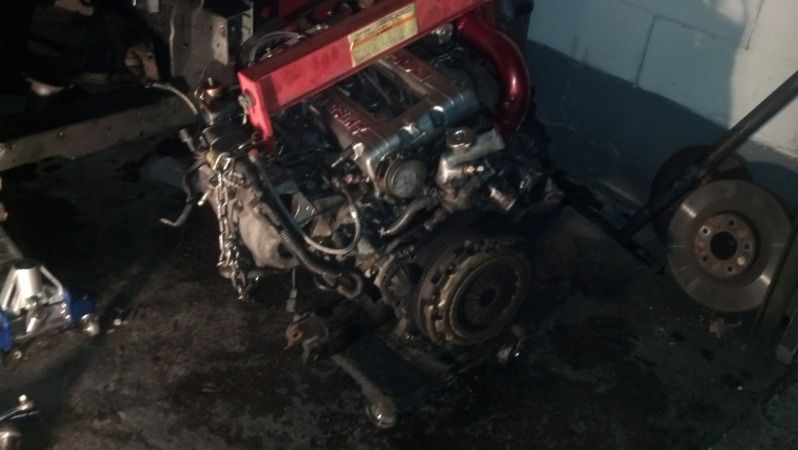

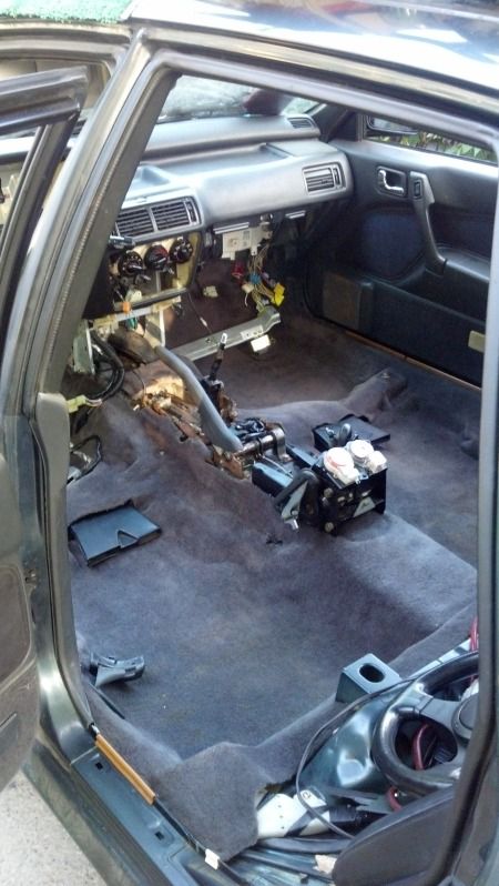

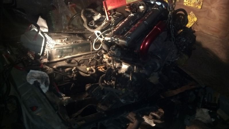

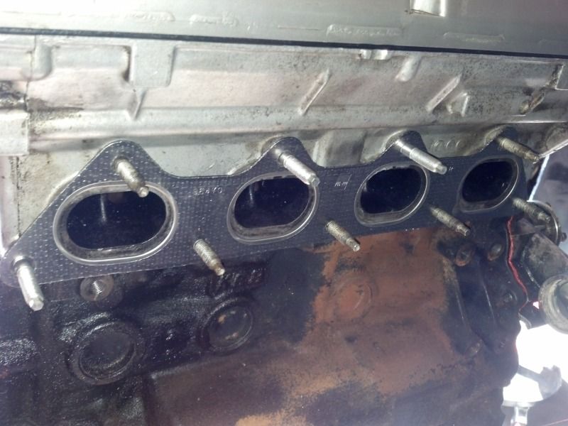

Well as of 1130pm 5.6.13 the motor/trans is finally pulled.
As i pulled it i realized how clean and new the freeze plugs were. Upon finshing up i went inside and went to town searching the internet and BINGO!!

The car runs and drives well, the new turbo really spools up beautifully and pulls hard. It's a great tight driver, front end aligned last month, no rattles and NJ inspection si good until 10/2006. After what I payed and put into it, i know i'm taking a nice loss selling but know that it would be going to the right person here.
With that being said it makes sense why the freeze plugs look almost brand new and the block is really clean except the spot where i had the power steering hose come off and make a mess last year.

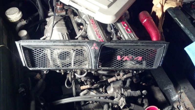

Grill before i repainted it (Paint is drying now so no pics yet)

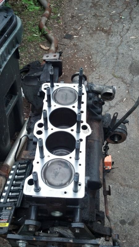

Motor out and trans/diff off.
Plans for this week are
~Strip block down to just the complete block.
~Clean / Port and Shave Stock intake manifold
~Rebuild the big16G
~Clean rust off random parts/bolts. Most of the small stuff in my new tumbler.

Catch everyone upto speed since May.
Current Mod list, All of which have been done since may
Engine: Rebuilt bottom end to stock spec.
ARP Headbolts
OEM Alternator
OEM Waterpump
OEM Oil pump
OEM Headgasket and Gasket kit
OEM Timing belt
OEM Water neck (Car Came with 1g water neck)
Complete BSE
Jays Racing Alternator relocation kit
Energy Suspension poly mounts
Head: Rebuilt Head - Hot tanked, etc
HKS 272/272
Port/polish
3G lifters
Bronze guides
Stock Cam gears
PTE 880's
Turbo:
Rebuilt my Big 16g
Interior:
Factory engine and interior harness torn apart, inspected and deleted and lengthened alot of stuff.
Found a factory CD player and radio
Interior stipped and cleaned
Trans: Stock trans rebuilt
Act 2600
AEM Streetlite flywheel
OEM throw out bearing.
Misc:
All new rotors and pads
New hand bent brake lines on every wheel
New fuel lines
ABS delete
4WS delete
4 Bolt rear with axles (still 4 lug)

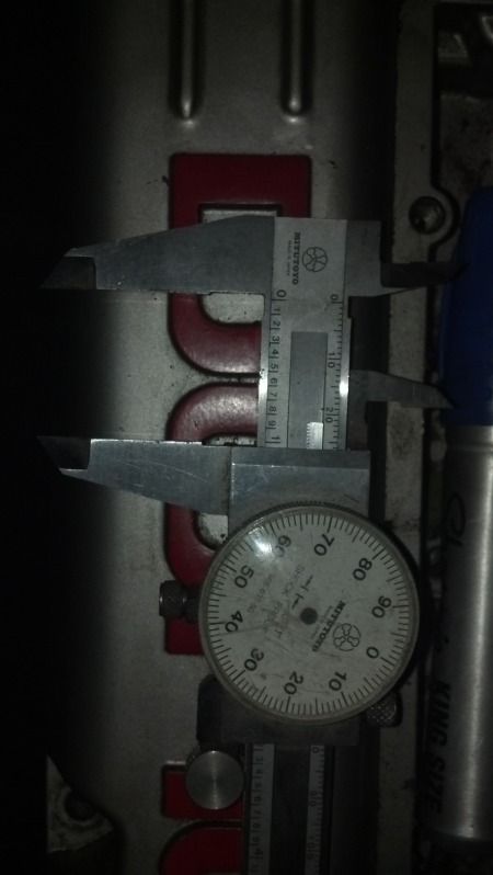

Found that my engine got rebuilt at 100k (now 185k) by a previous owner and found that the head was rebuilt with the 3G lifters and bronze guides as well!
Valve slap...rut Roh raggy
ARP studs!

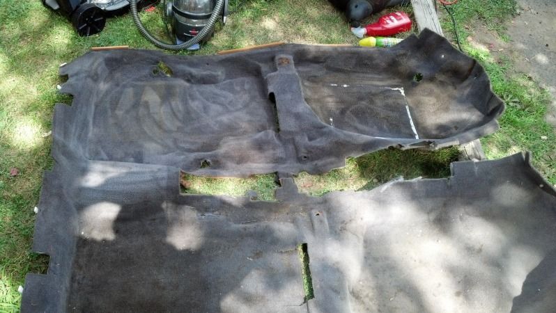

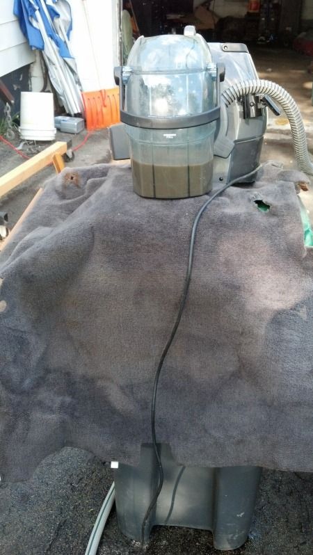

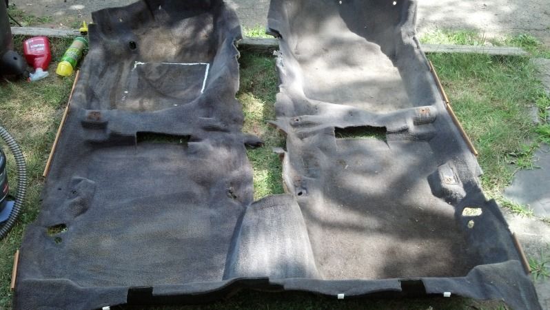

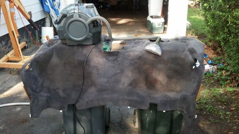

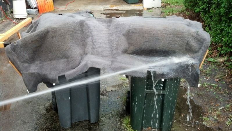

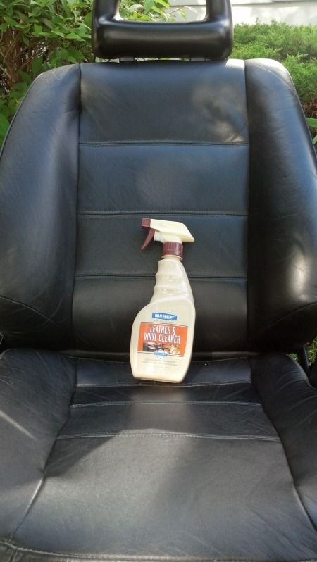

30minute soak in boiling water and oxyclean. Cleaned with a rug shampooer then draped over my garbage cans and sprayed on jet setting with my hose til I seen no dirty water coming off. Took 2 hours total.

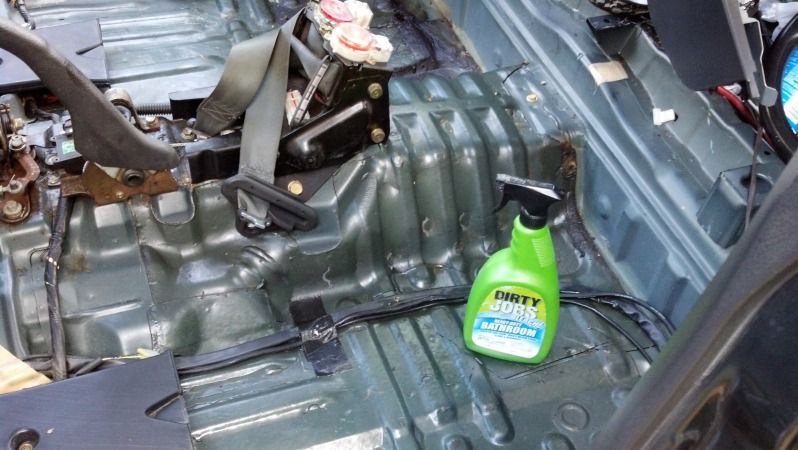

I had my 4 bolt rear subframe in my back seat and the diff leaked, and this cleaned up all the rest of the best oil great.
Can't say enough about this stuff
Who knew extra exhaust studs from 20 years ago in my grandfathers basement fits the 4g63 just as good as stock!!
