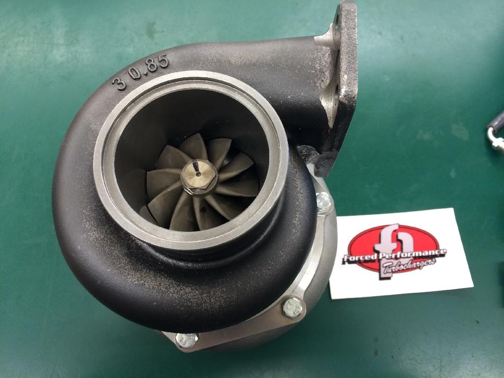

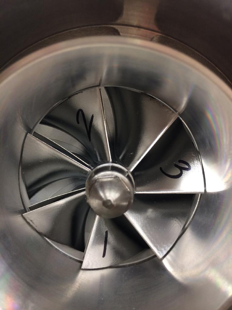

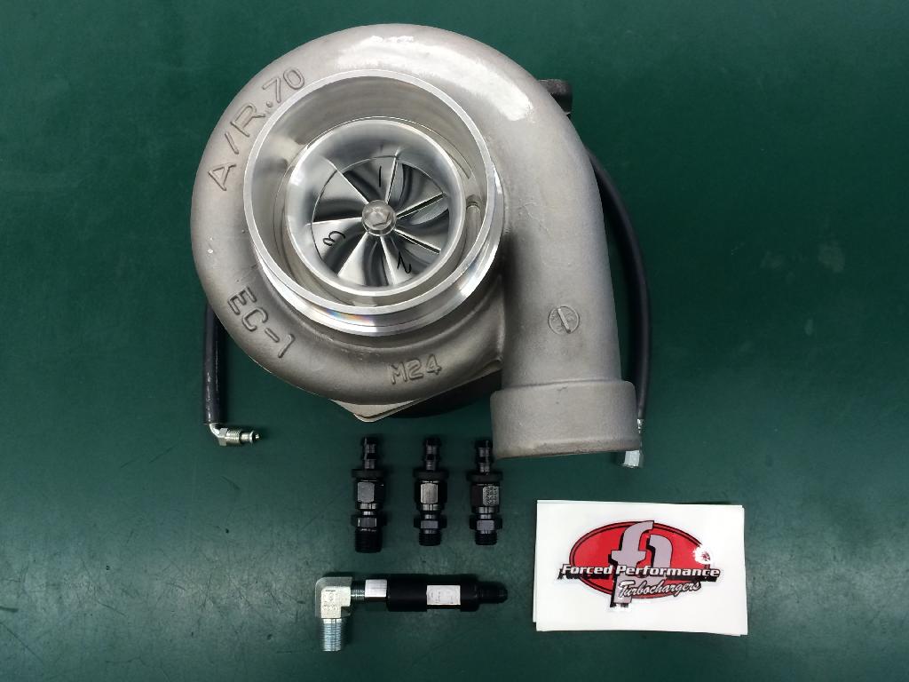

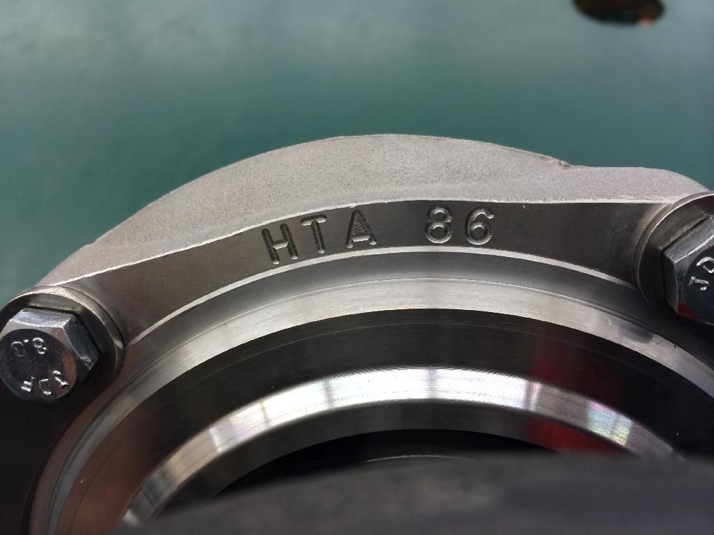

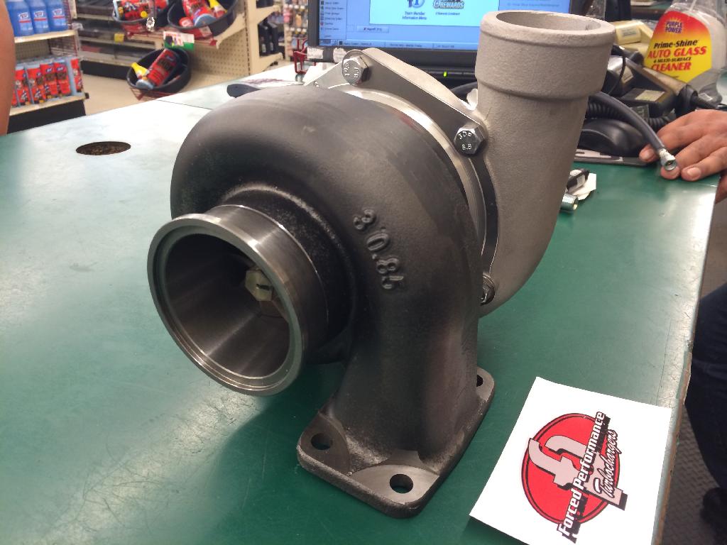

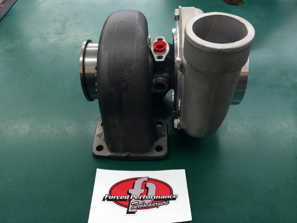

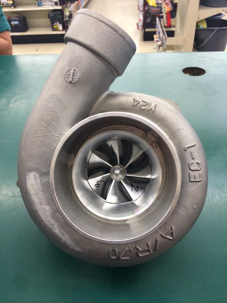

Got my new Turbo for the VR4!!! BIG thanks to Dave Nugent for selling me his BNIB Forced Performance HTA3586R!! 75 pounds per minute here I come! Now just gotta put this baby on the VR4 then have Chris Delgado at D3 Performance Engineering work his magic on the Dyno and get her tuned on E85. =)

Nice! Do you have all of the supporting mods for it? It might be way too laggy but it's got plenty of room to grow once you get serious with the build
Have you not seen my build in the previous 11 pages? It's serious alright, and has all the supporting mods. Just waiting on the instal of this bad boy now then a 500 Dyno tune session.
What...on 1050's and a single walbro?
Chris is a great tuner so I'm sure he can squeeze some power out of it but I would upgrade the fuel system.
Yes I do intend to upgrade the fuel system but the point I was trying to make was this it is serious. Later I plan to get bigger lines, dual E85 450's, and 2150's as far as fuel goes.

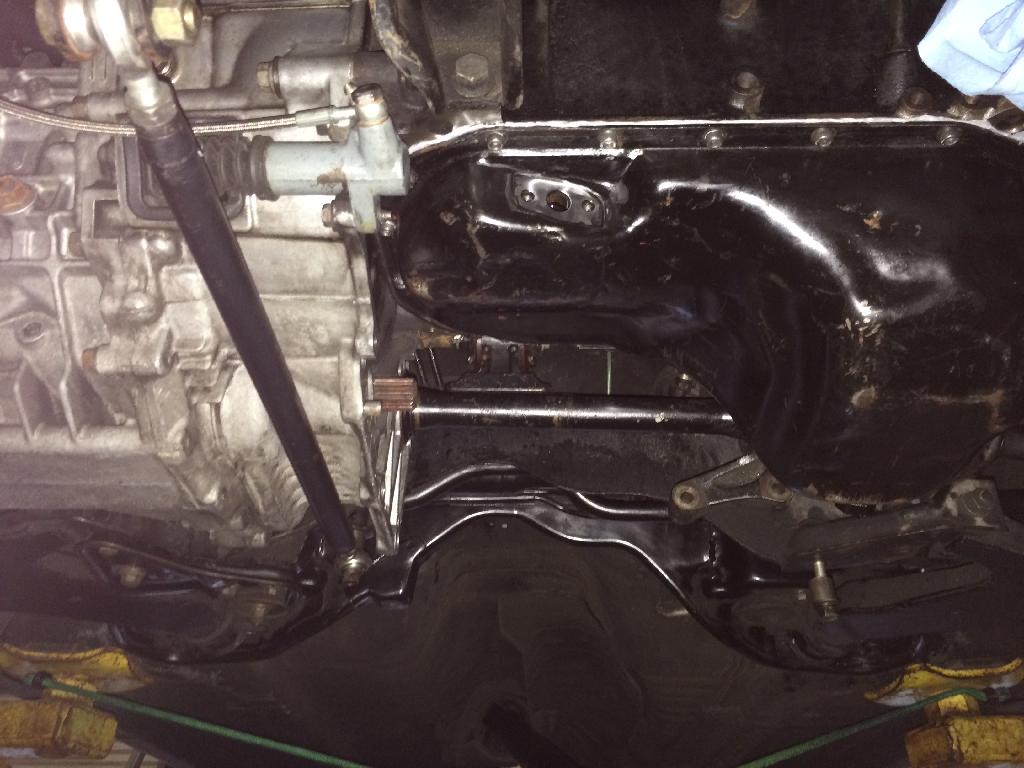

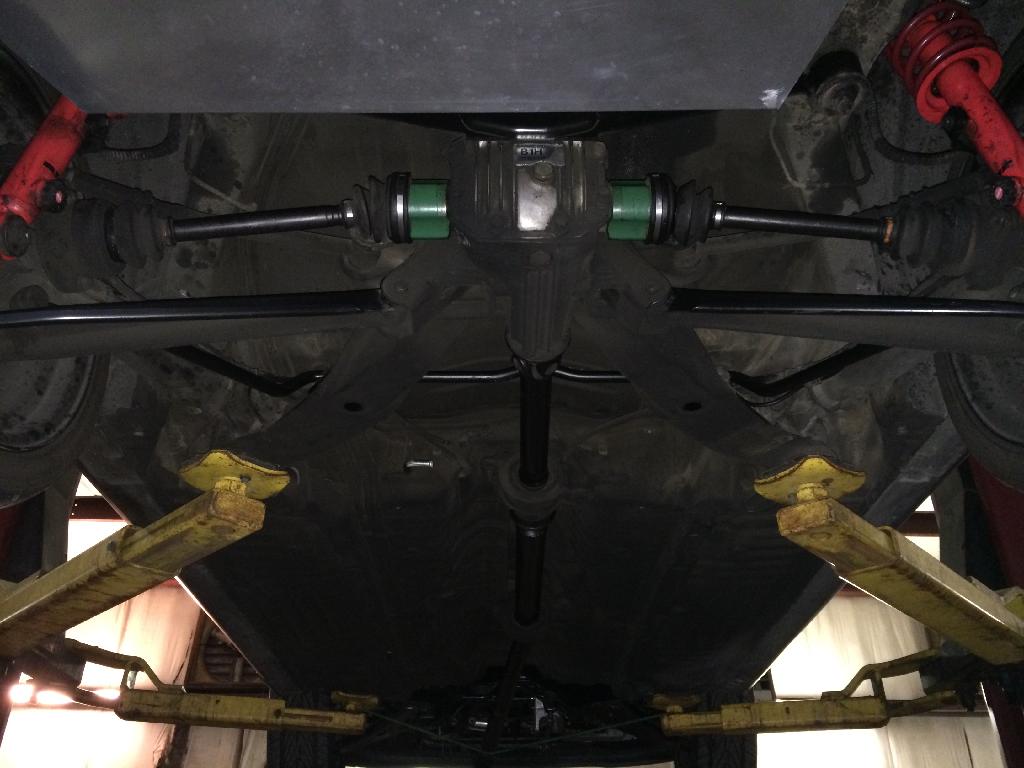

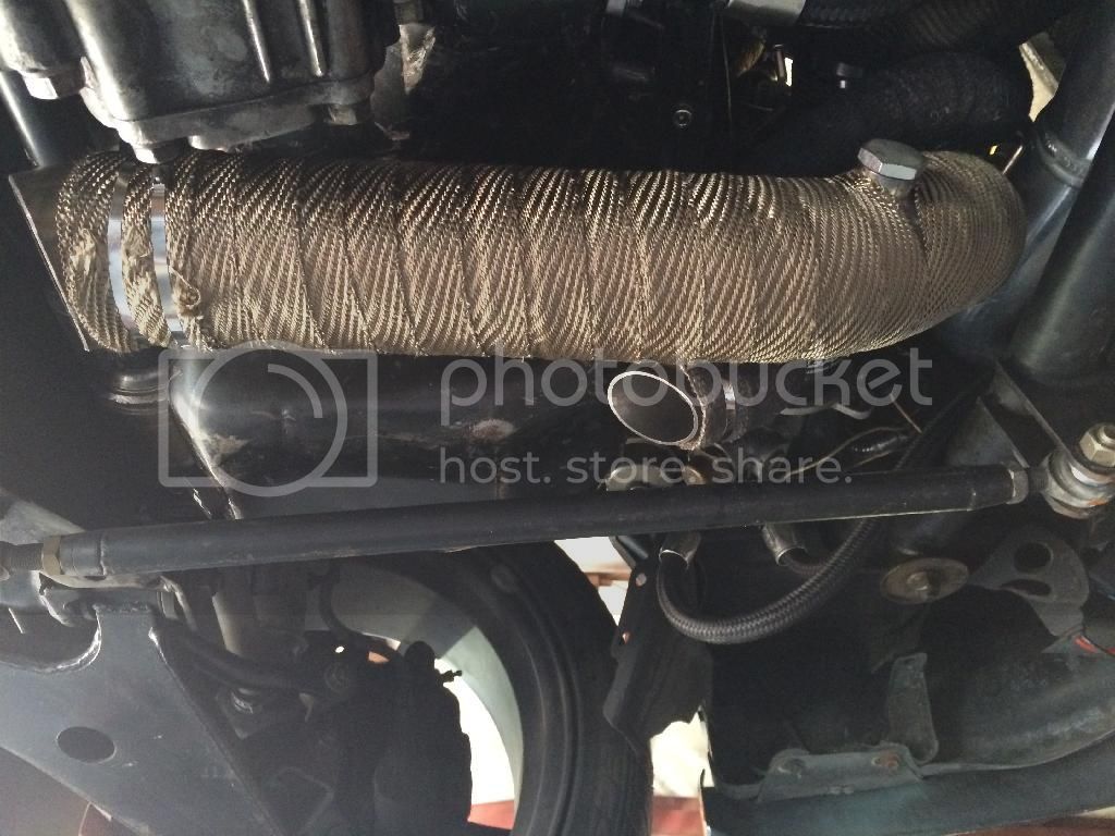

While the car is down for mods, I got bored and cleaned up a few things today under the car =)
Thanks man!

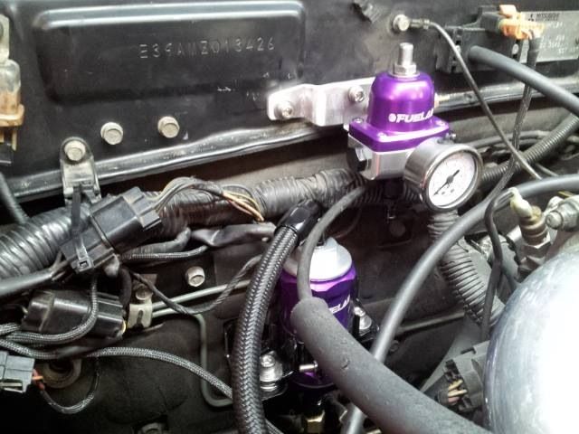

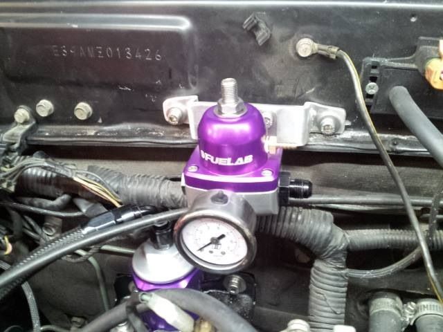

Got my Fuel system installed!

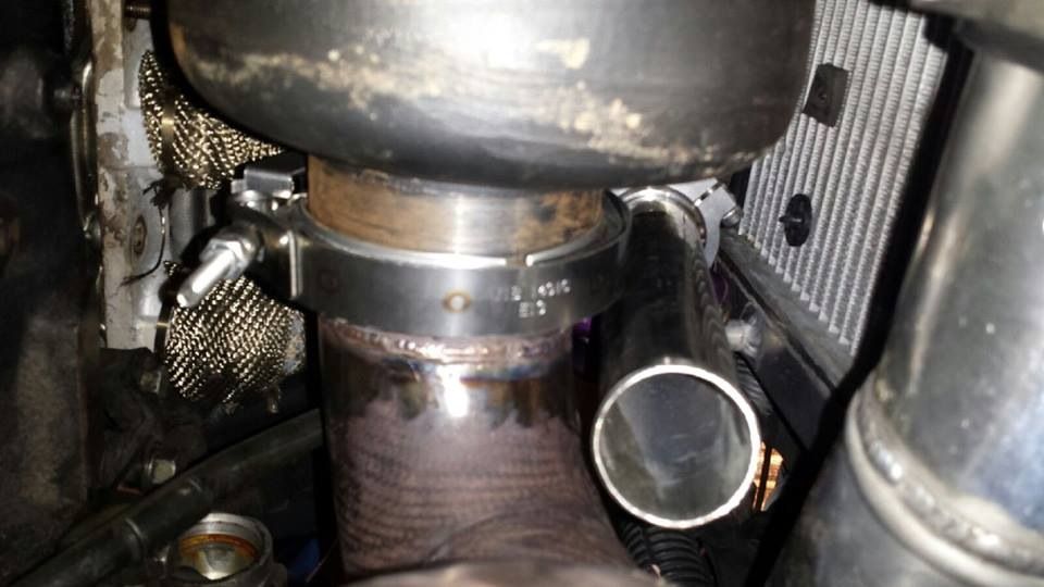

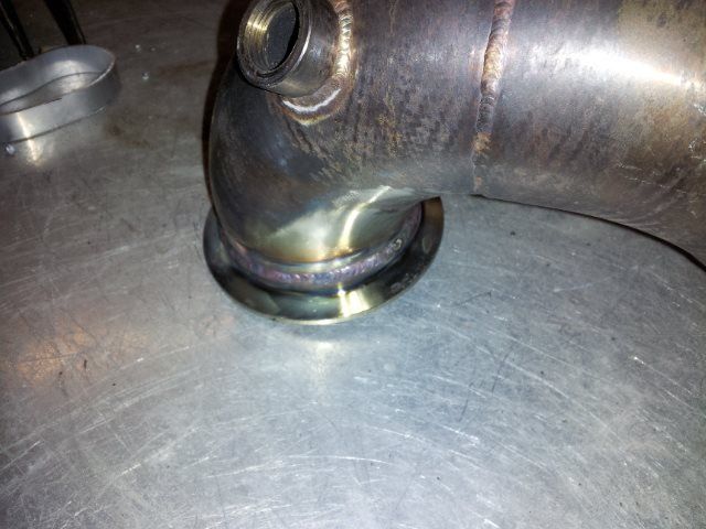

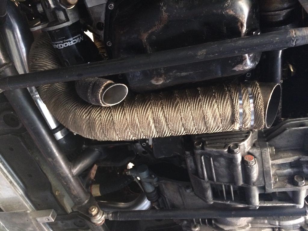

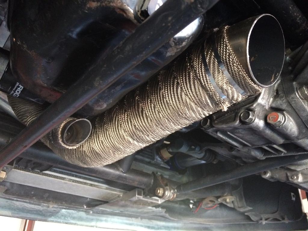

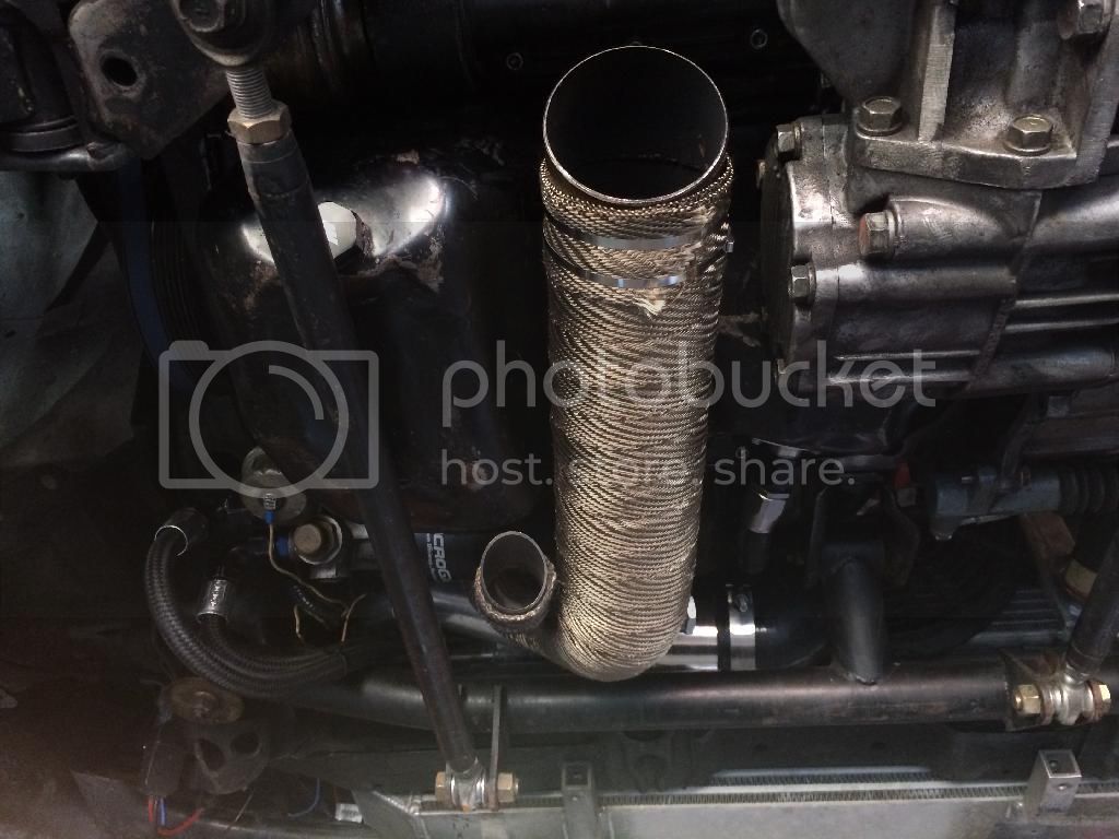

Then got the down pipe switched to Vband for the new turbo

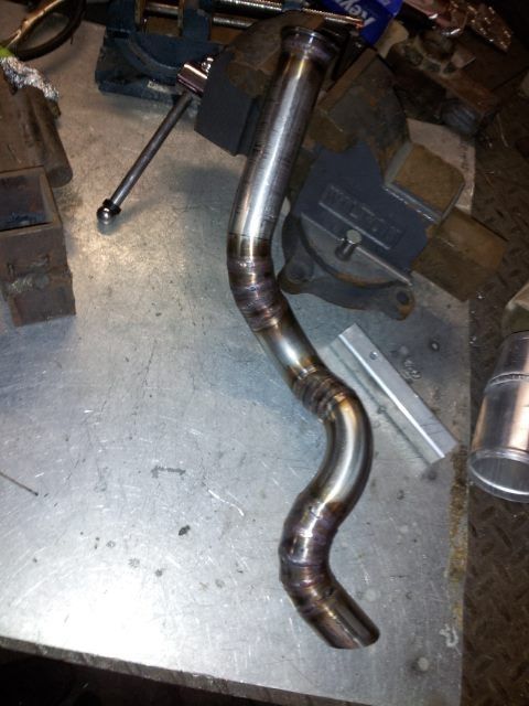

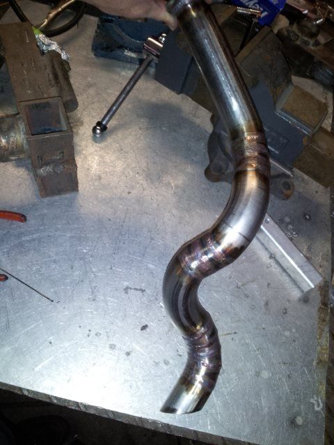

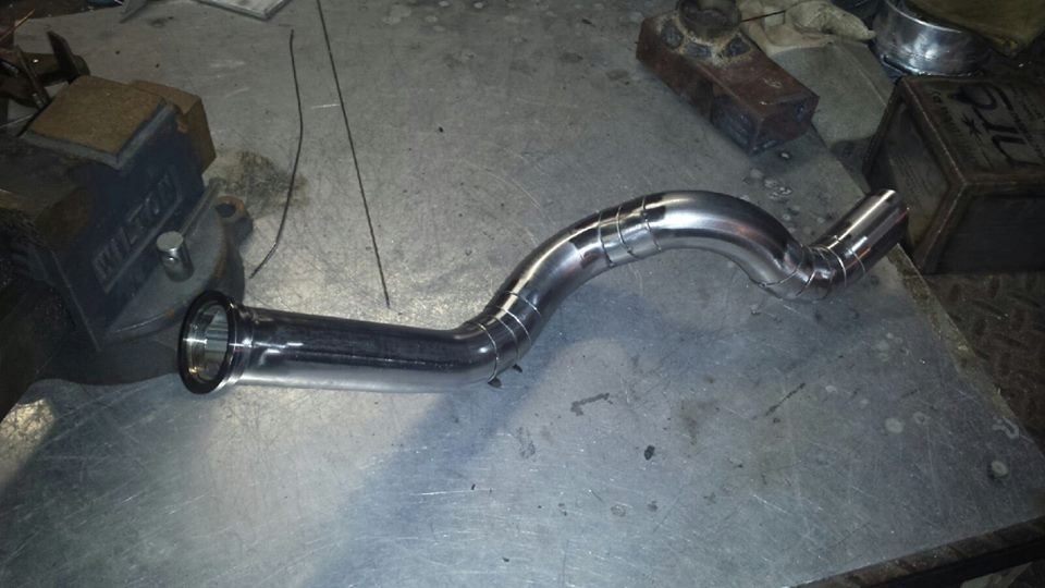

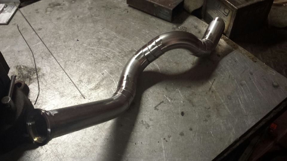

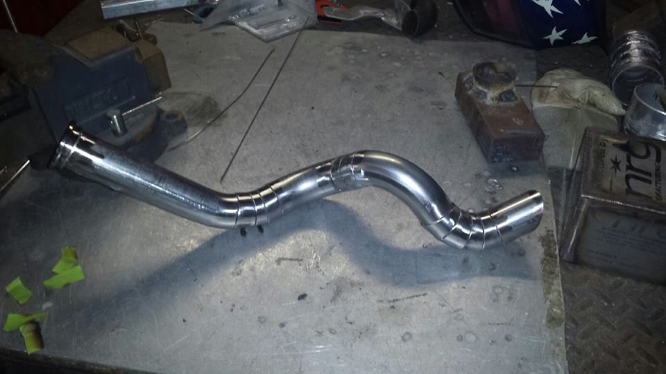

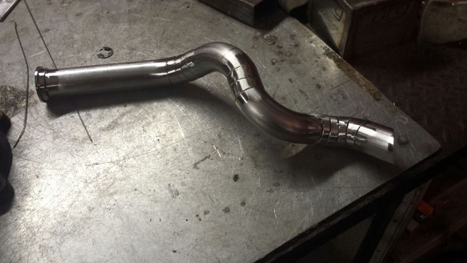

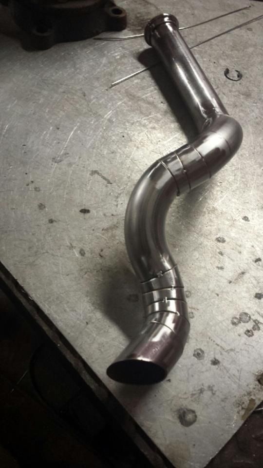

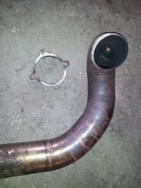

Then got my wastegate dump tube all fabbed up

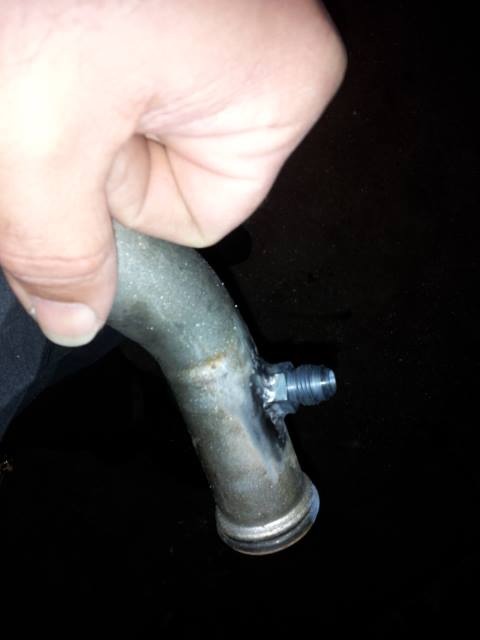

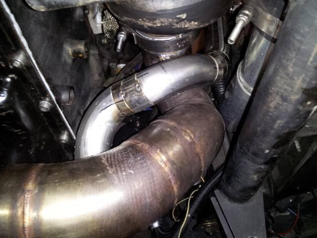

Then modified the water pipe for -6an for the turbo
She's getting there!! =)
WG dump tube is all welded up and ready to go in.

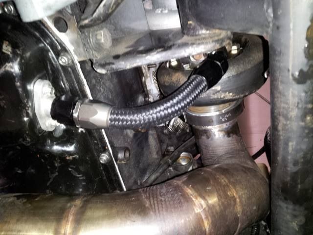

Also fixed the leaking oil drain and fixed the slight kink the line had from before.

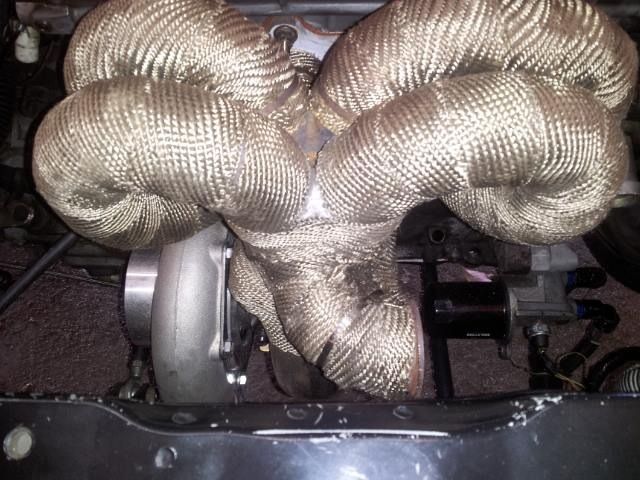

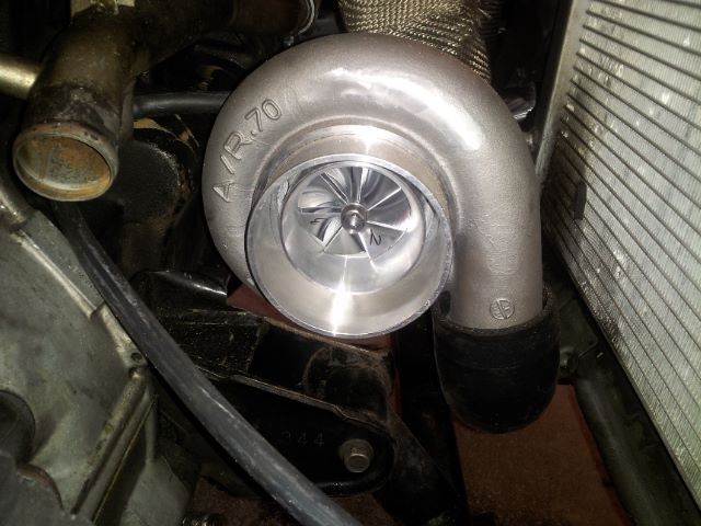

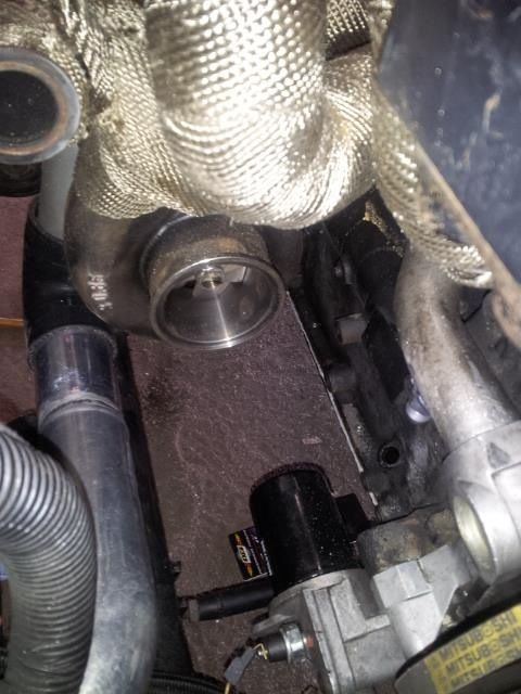

And it's on! Samara is Officially HTA3586R powered now! Soo freakin beautiful, billet wheel sexiness =D
Using a 2g oil filter now for clearance, and all Vband now =)

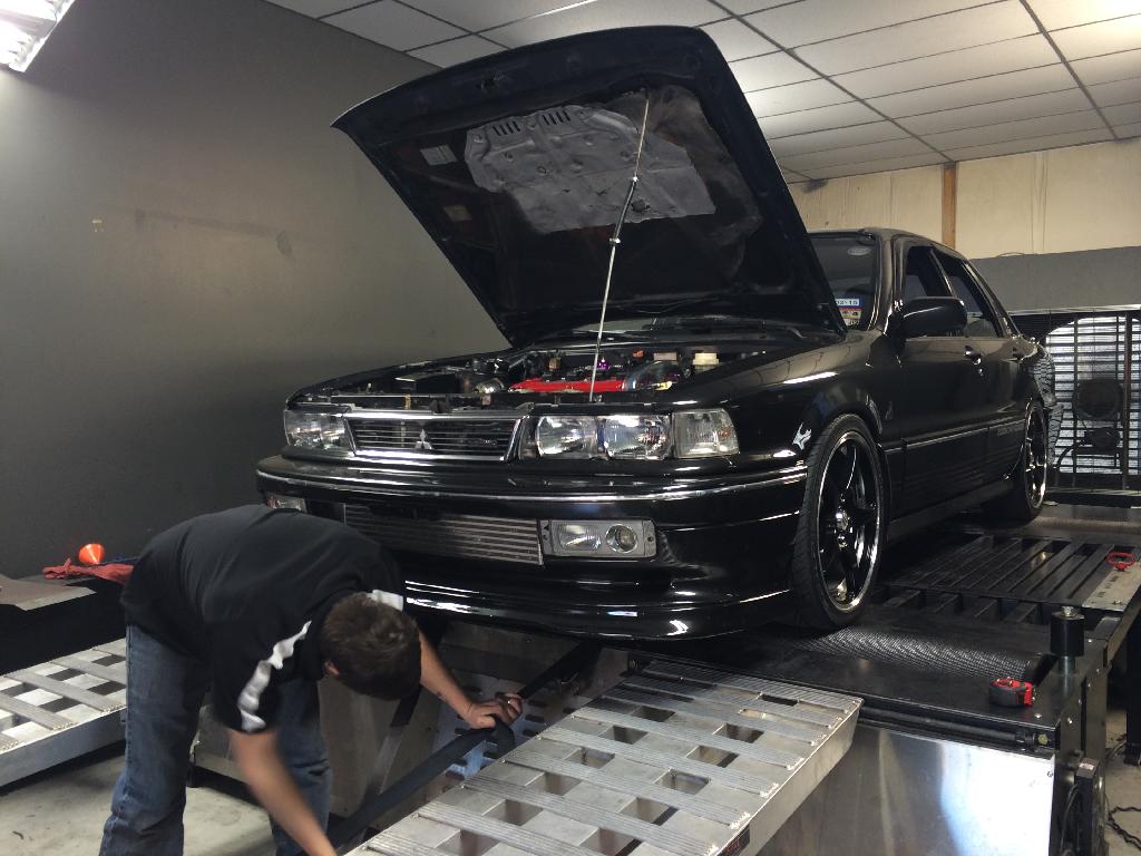

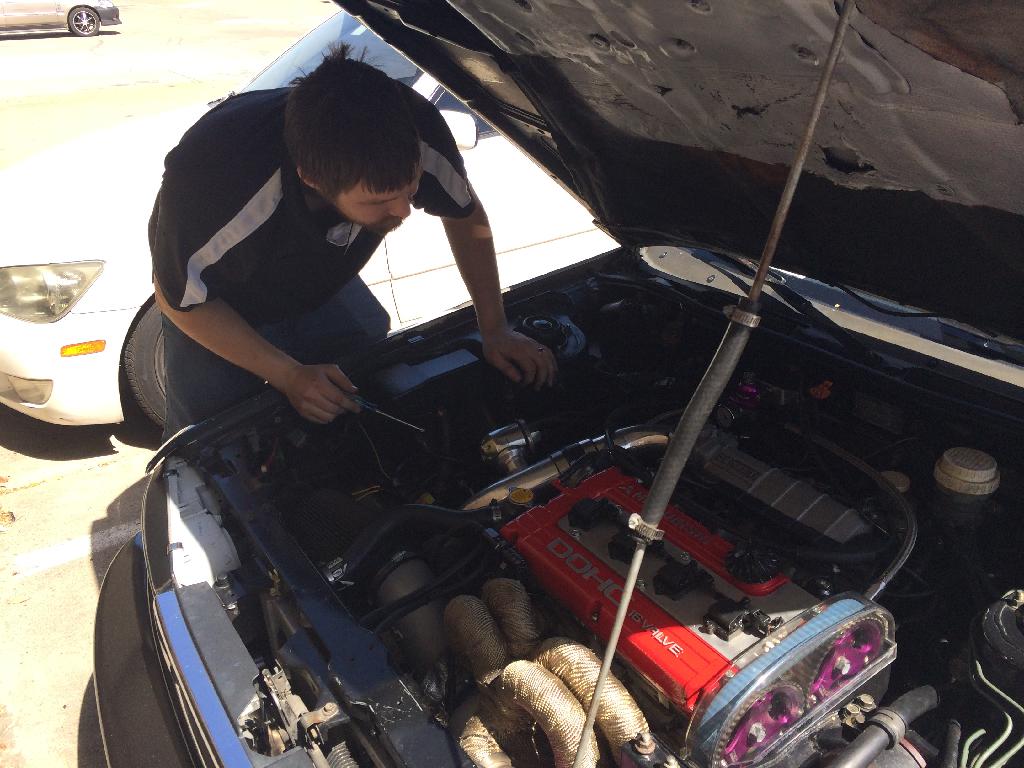

And Chris Delgado meets Samara!! =D

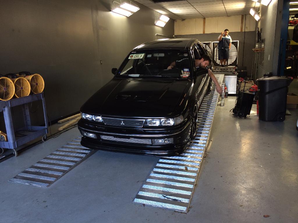

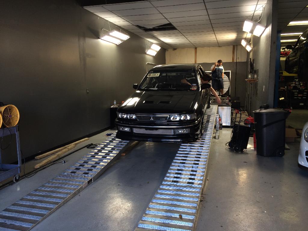

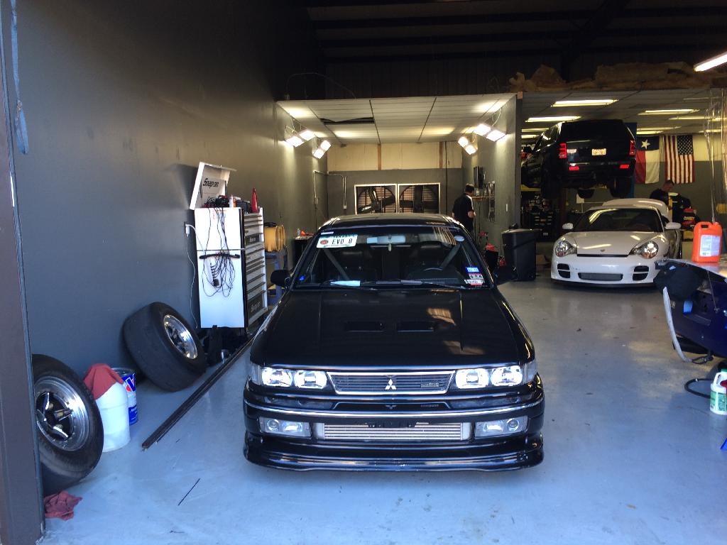

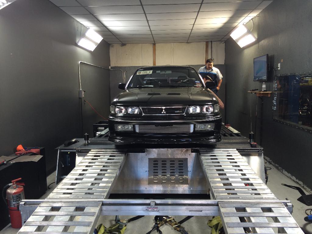

Still up here at the shop and Chris had time in between cars to do a quick tune to get her on E85, before we Dyno tune it later on today. I've been wanting to take this pic for the longest time!!
Dyno results coming soon, got two cars ahead of me and it takes a few hours a car. Soo excited I can't even eat! Lol

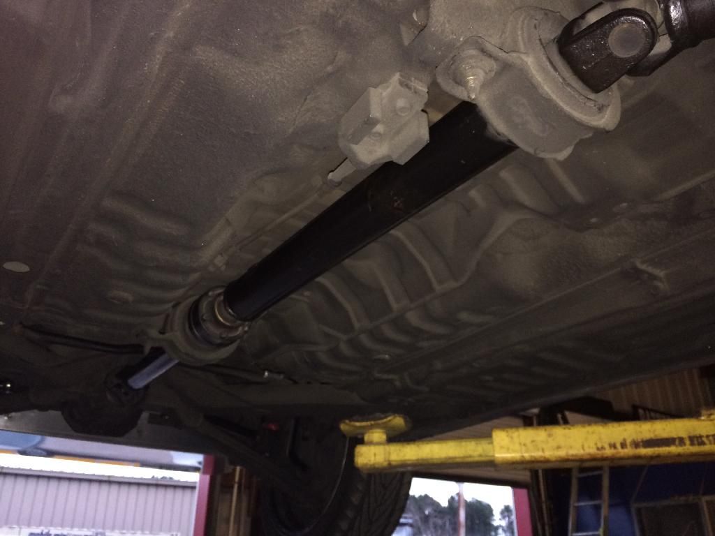

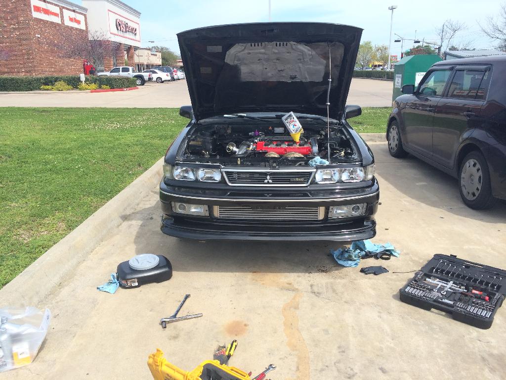

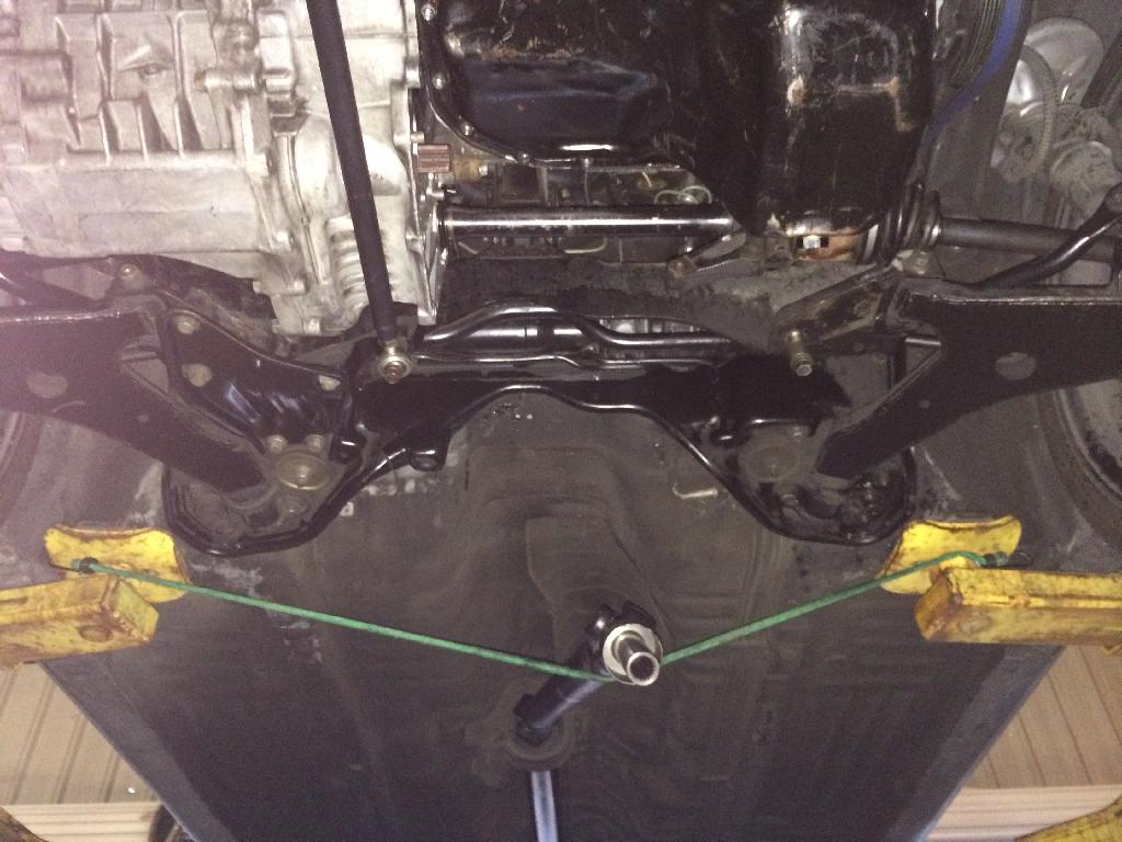

Oil changes look like a PITA.
:dsm:
Well according to mike it actually is easier to do now because before you had to remove the down pipe just to get the oil filter off and they re did it so nothing has to come off now. =)

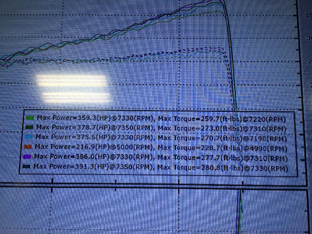

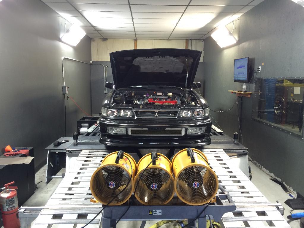

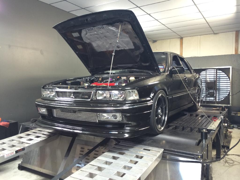

Ok guys here's the video, she made 391 awhp and 280 torque at 16 psi and 81% IDC, it could make a lot more but we ran out of pump and the 1050's too. BIG thanks to Mike At Fist Racing for making this all possible and Chris Delgado at D3 Performance Engineering for his mad skills.

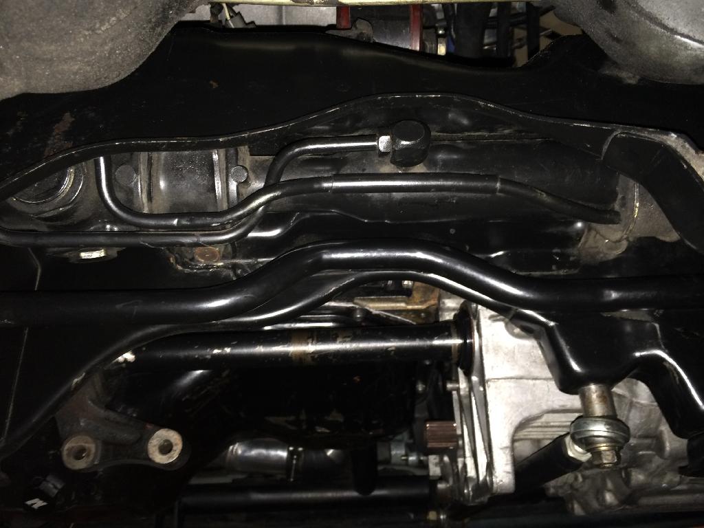

I just removed one end of that bar in the way then it allows access to the drain plug Corey.

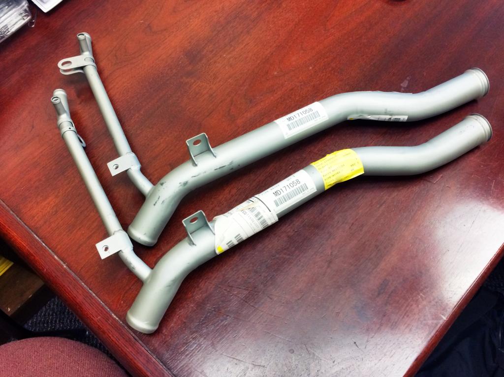

Long time since an update, car has been running great but started leaking at the water pipe due to it being old and corroded so I Got some brand new oem ones. I would like to replace it before our trip to the shootout and have Mike at FIST weld on the an fittings on it again. Went ahead and got a second one for the 91 GSX as well, these are kinda hard to come by.
