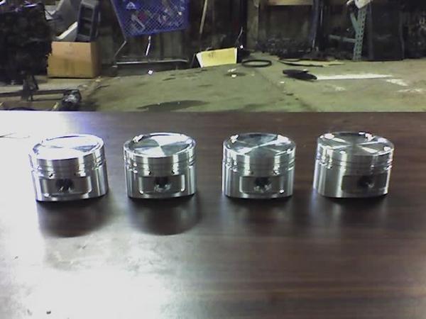

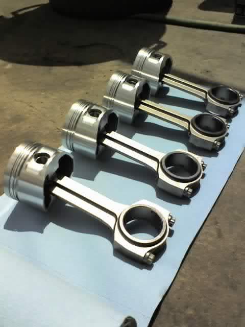

Pauter Rods, Ross Racing Pistons, ARP everything polished crank, Clevite 77 bearings

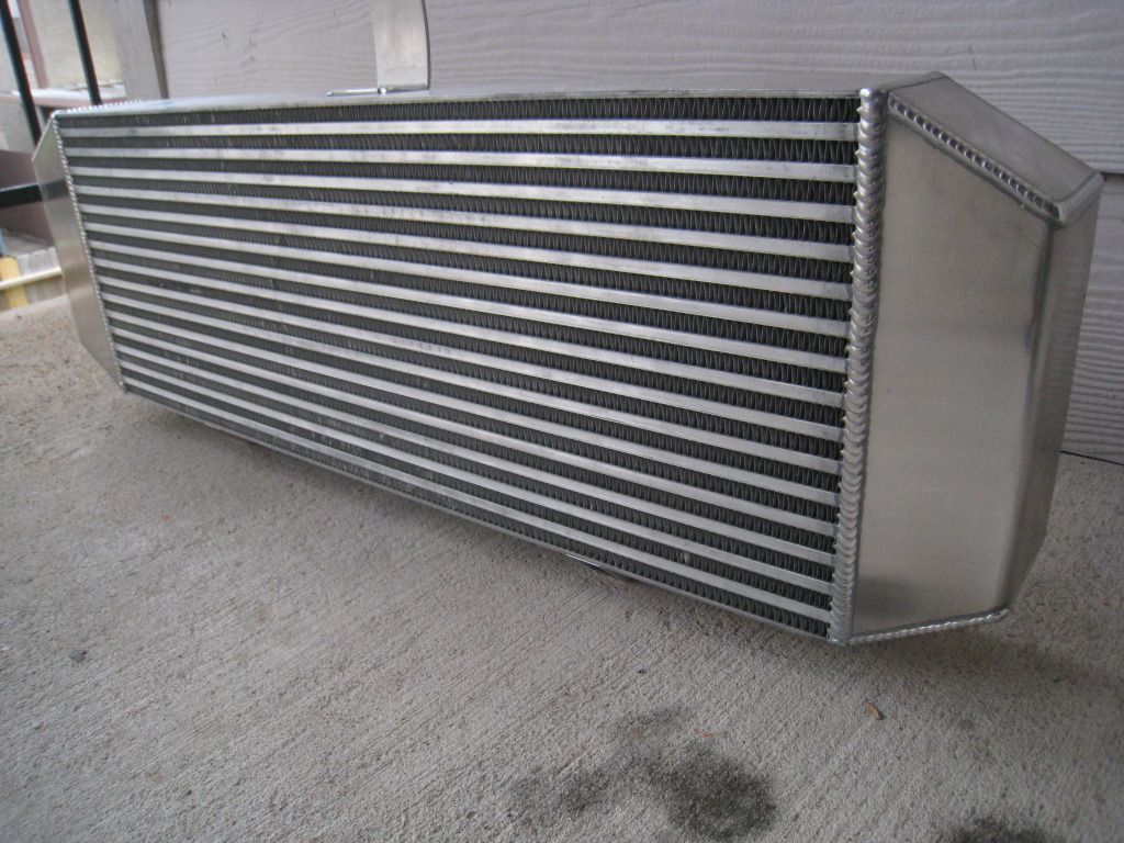

Spearco 2-216 Front mount

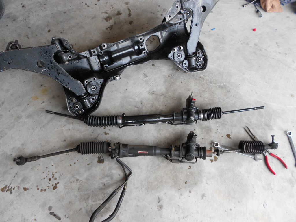

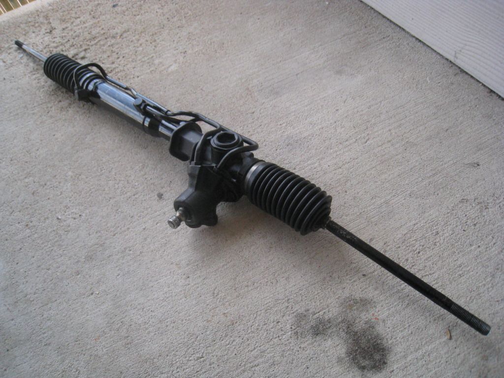

New power steering rack

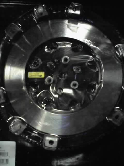

ACT Streetlite flywheel and ARP flywheel bolts

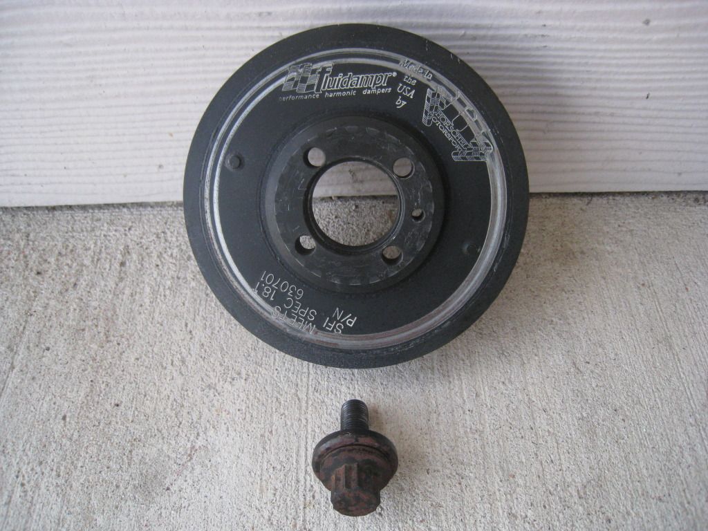

Fluidampr with ARP crank Bolt

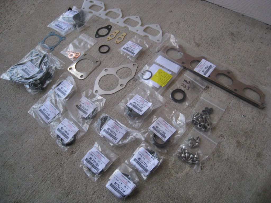

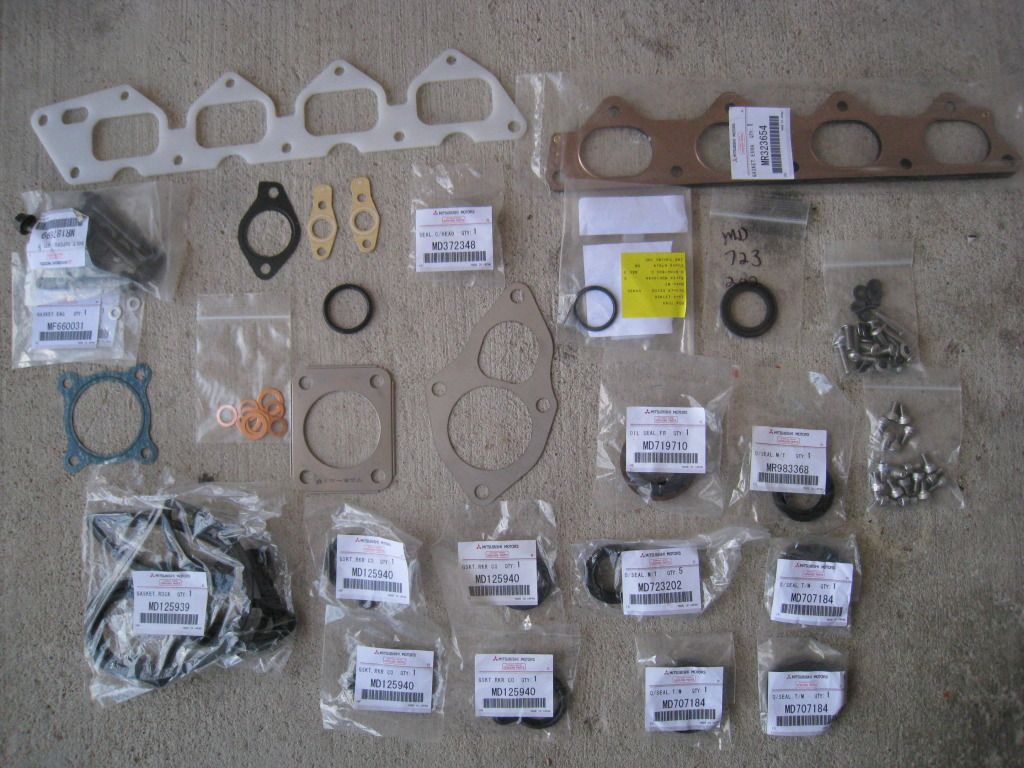

All new gaskets, bolts, washers, Orings etc etc

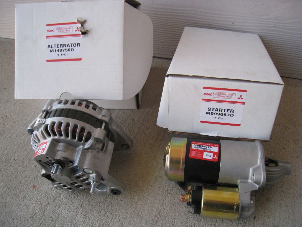

new OEM Mitsu Alternator and Starter

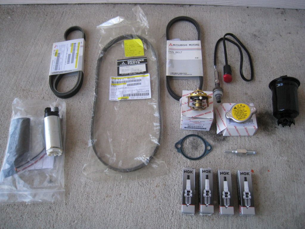

new OEM Mitsu belts, Walboro 255 fuel pump, OEM 0/2 sensor, thermostat, fuel filter, and spark plugs.

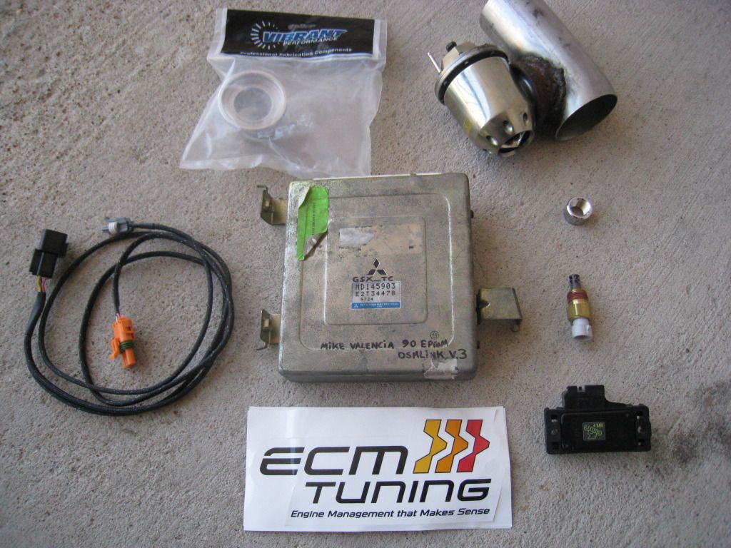

DSMlink version 3, speed density parts, and HKS BOV

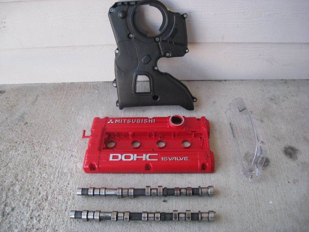

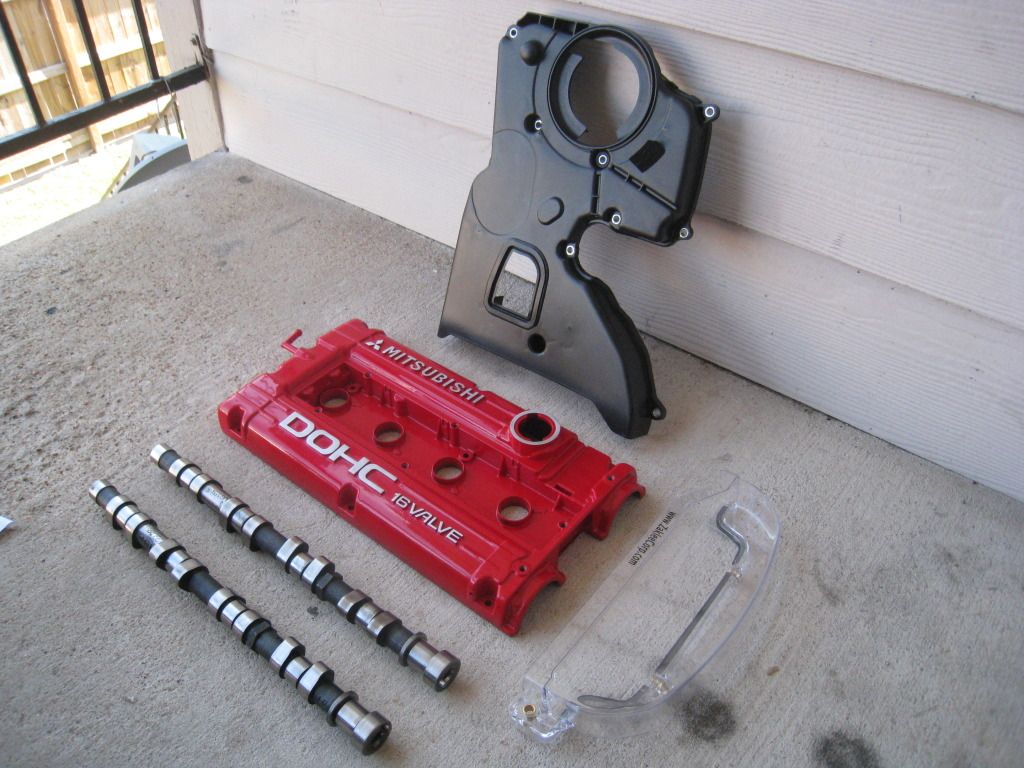

new OEM lower cover, zaklee upper clear cover, and FP2 cams with my powdercoated Valve cover

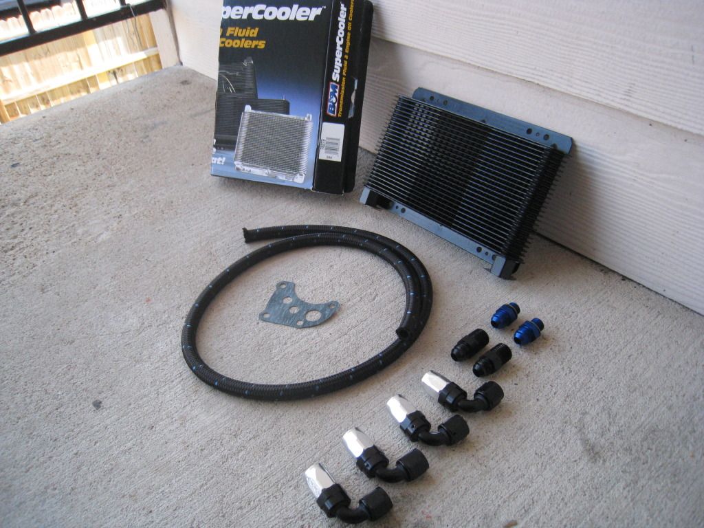

Two questions for you though: What's the part number for the K&N filter? I'm fairly certain the part number that comes up at my work is for the 420a :(. And what's the part number for the B&M oil cooler?
Looking good mike. What are your goals for the car?
Looks like a good start!
That knn air filter is for 1g/vr4 and the 420a is a rectangle shape

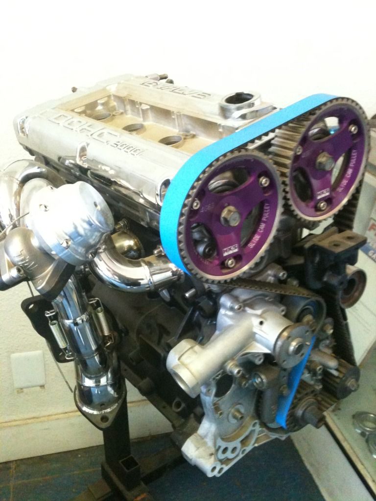

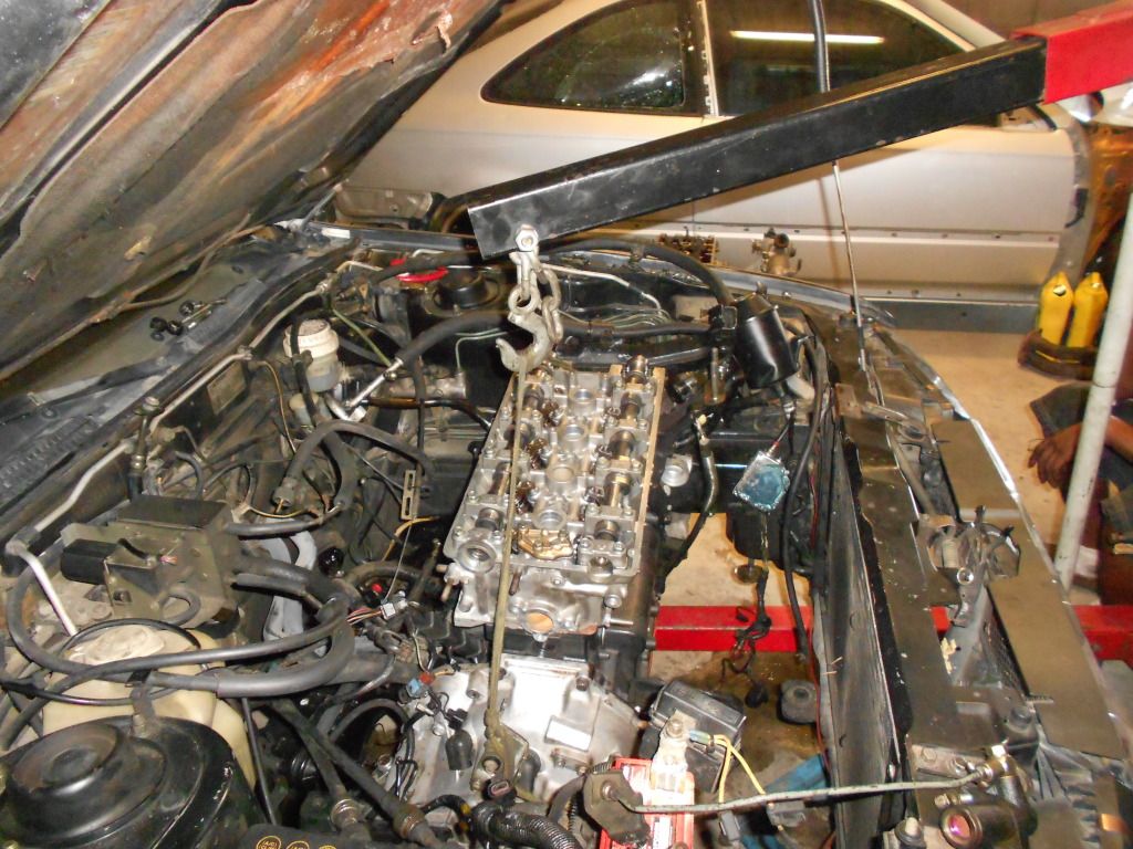

What are the springs on the 02 housing for?
Lol what springs? I don't have an o/2 housing pictured.

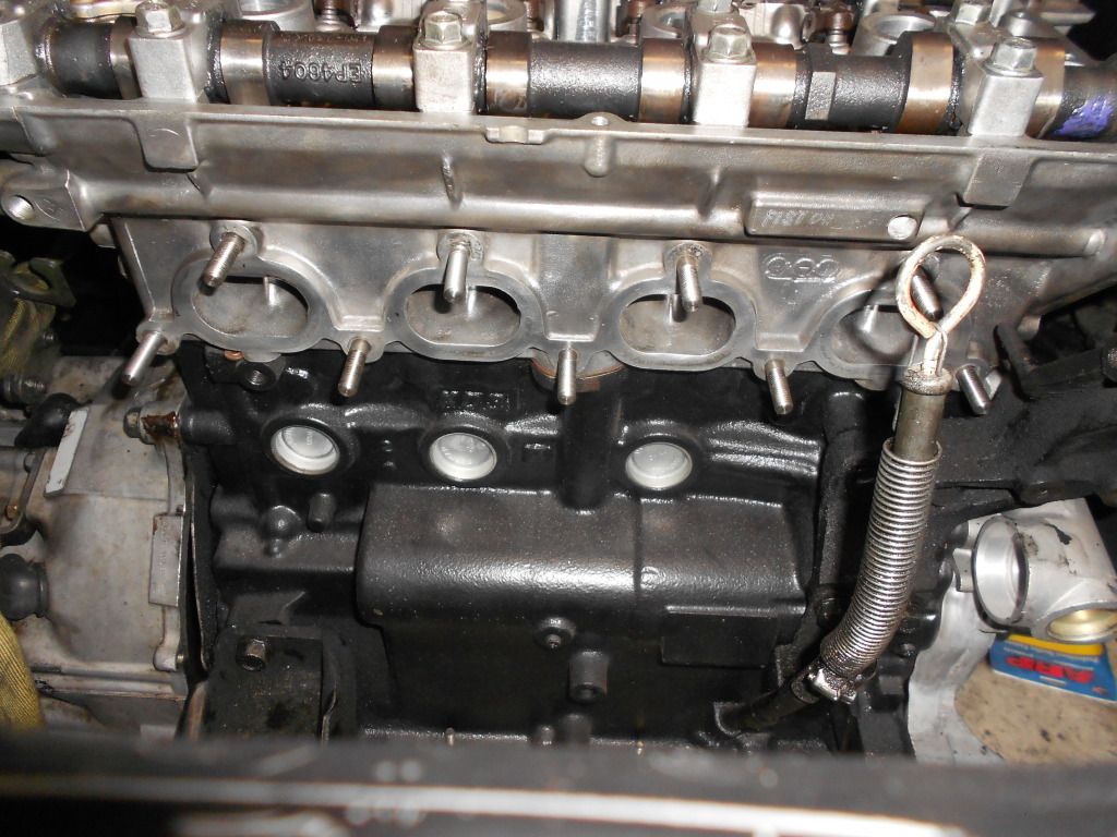

Oww! Your new cams are laying on the concrete!
Lol I placed them there gently

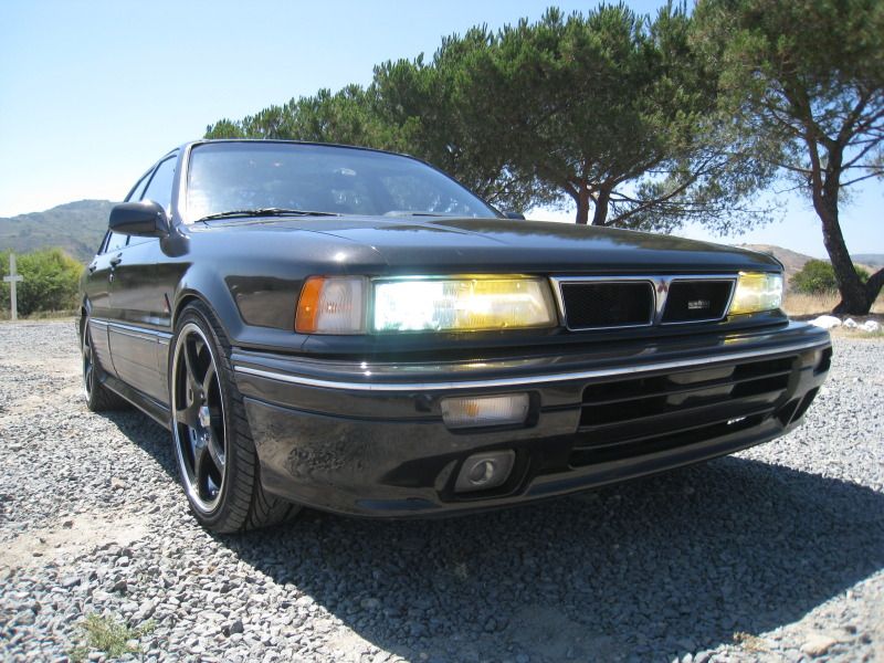

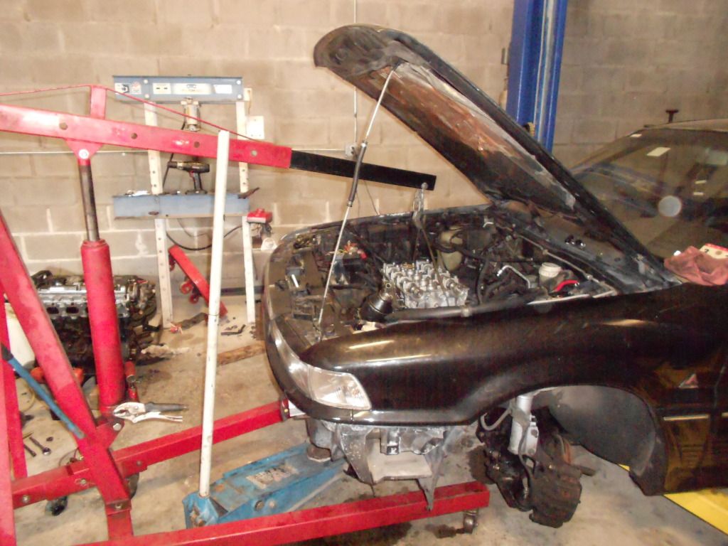

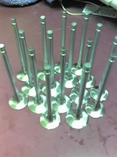

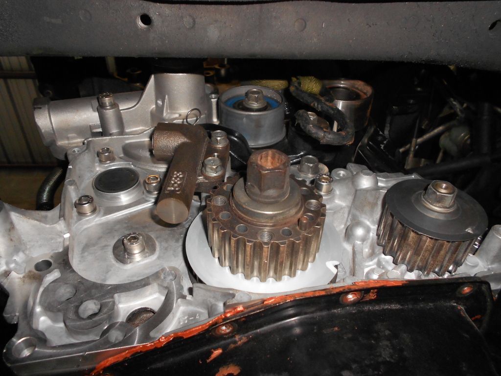

2nd picture.
Springs on what appears to be a external wastegate connecting to a exhaust piping that has a 2 bolt flange on the bottom (I thought the flange connected to the down pipe which lead me to believe it was an O2 housing of sorts).
Ahh ok yeah man that pic was taken when my motor was in the showroom of the shop that built it for me. They had that setup on there for display purposes.

Sorry, I meant oil filter. Should have been more clear.
Still curious about the B&M cooler as well.
the oil filter is part number HP-1005 from K&N
and heres the link for the 1g DSM oil cooler kit

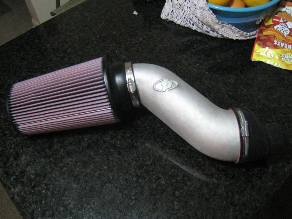

got another piece to add to the build.

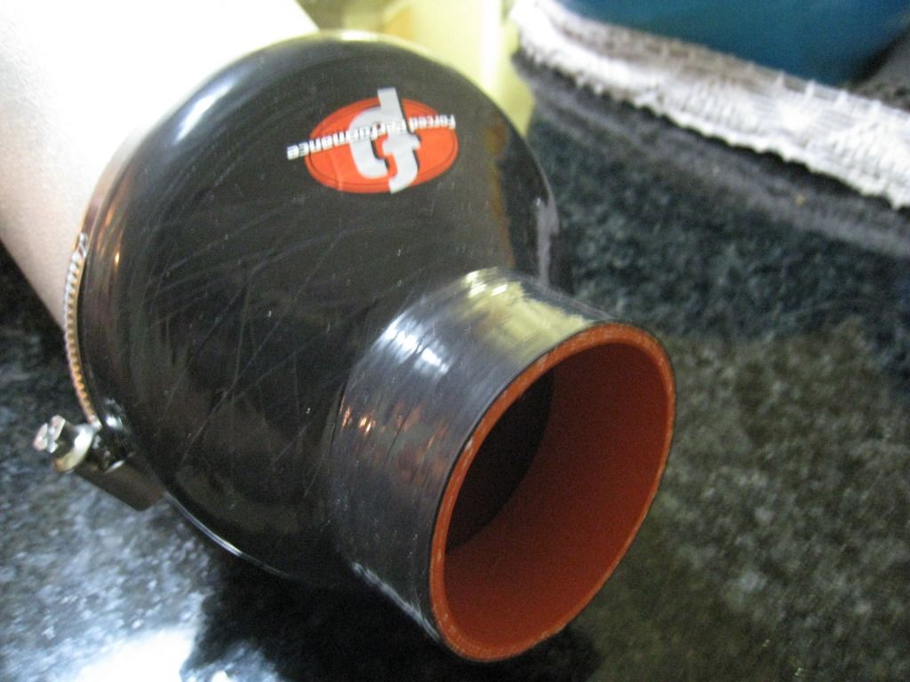

FP 4inch intake non recirculated, with massive K&N filter and a miracle reducer coupler that allows that huge intake to fit onto my evo III big 16g =)

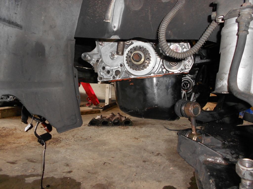

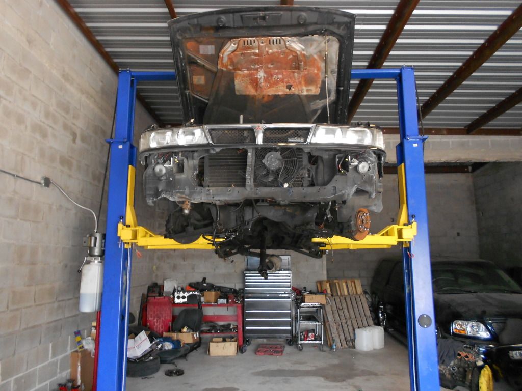

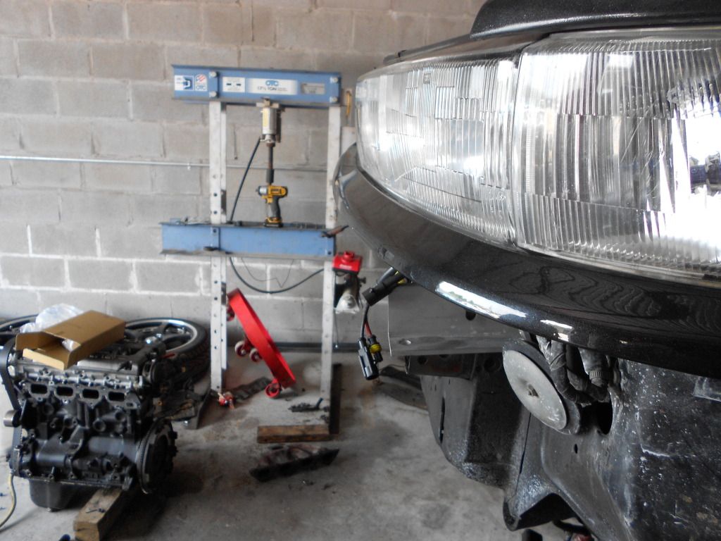

On the lift
this motor got me from Cali to Ohio, then cali to AZ then Cali to TX =)
Before

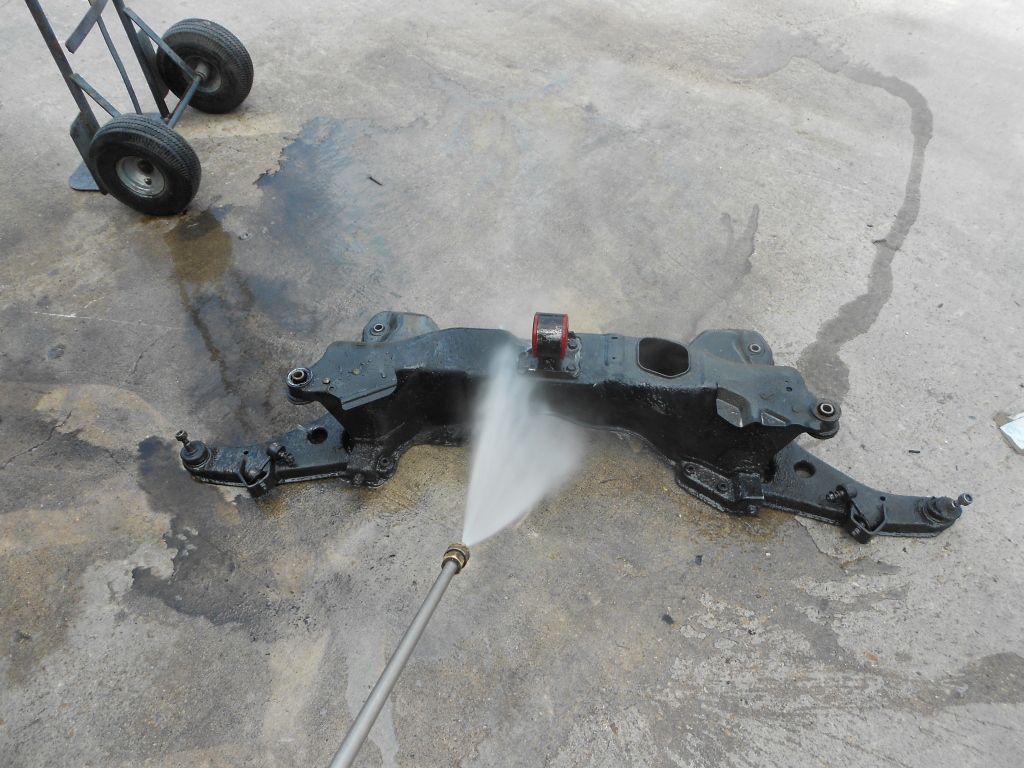

pressure washing
After

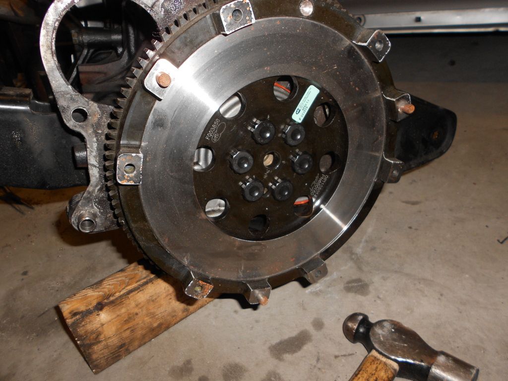

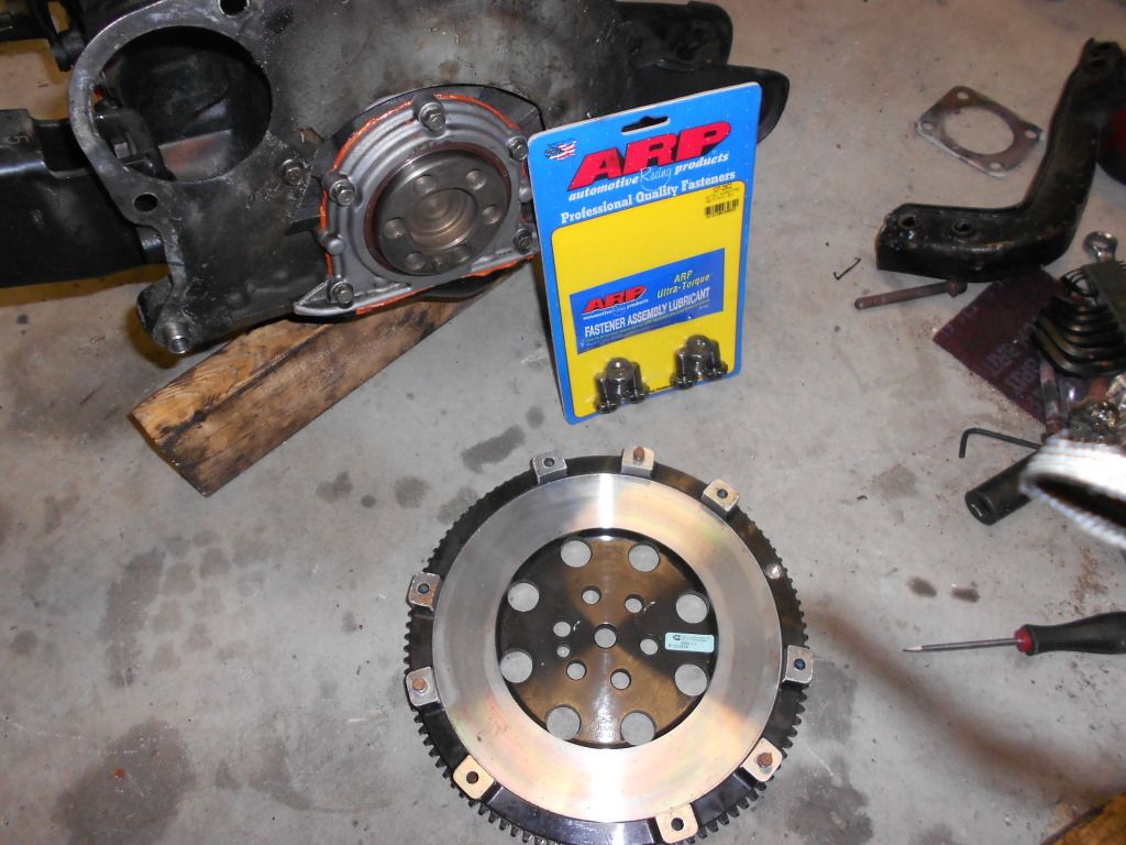

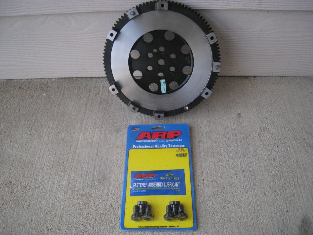

about to put on the ACT streetlite, with ARP bolts

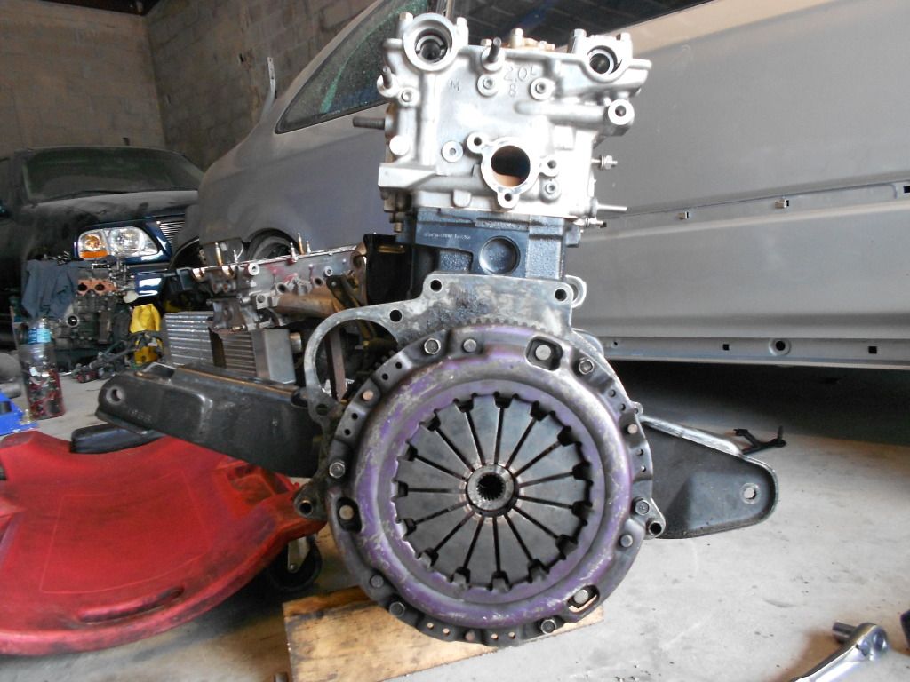

old clutch back on, now to put it back in next.

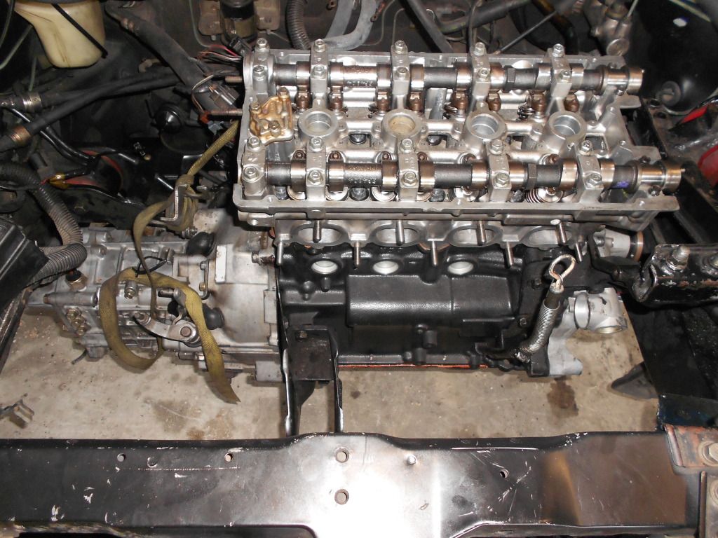

Ok the new Motor is finally in =)
So clean and fresh

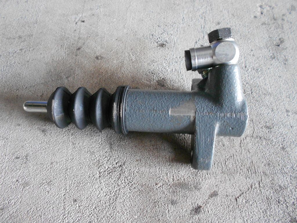

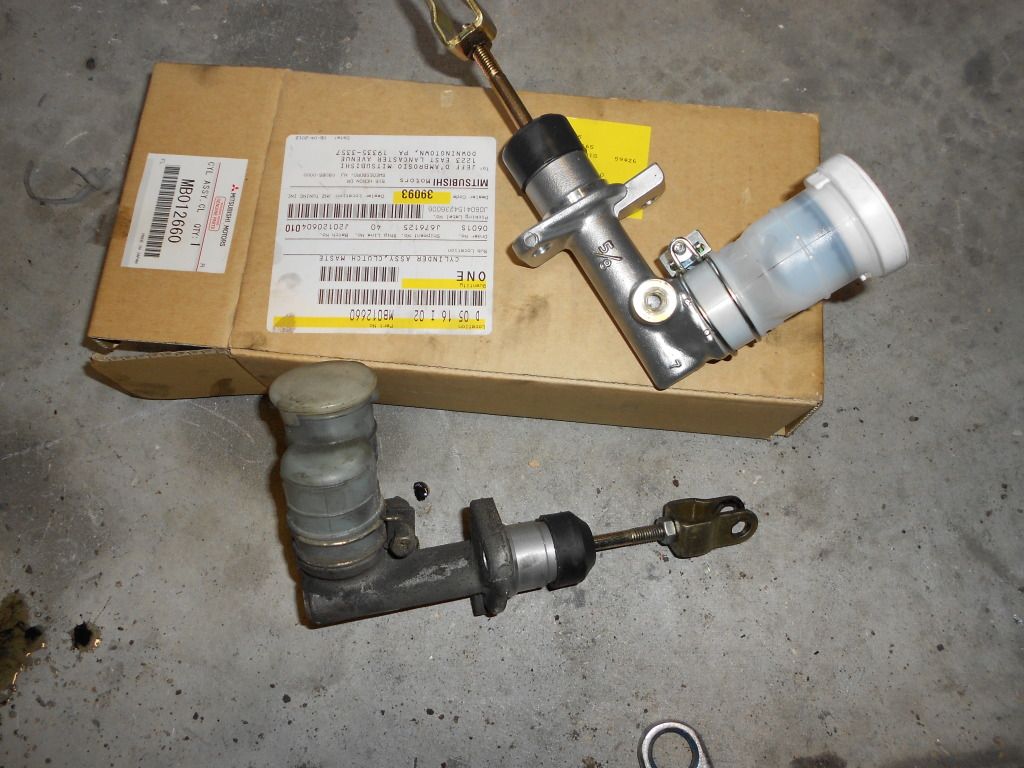

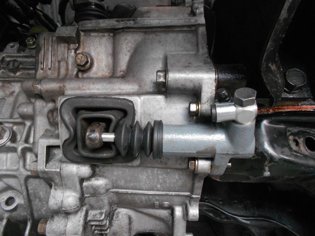

New OEM Mitsu Slave going on

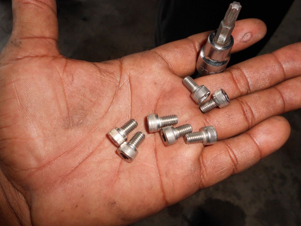

stainless bolts for the oil pan

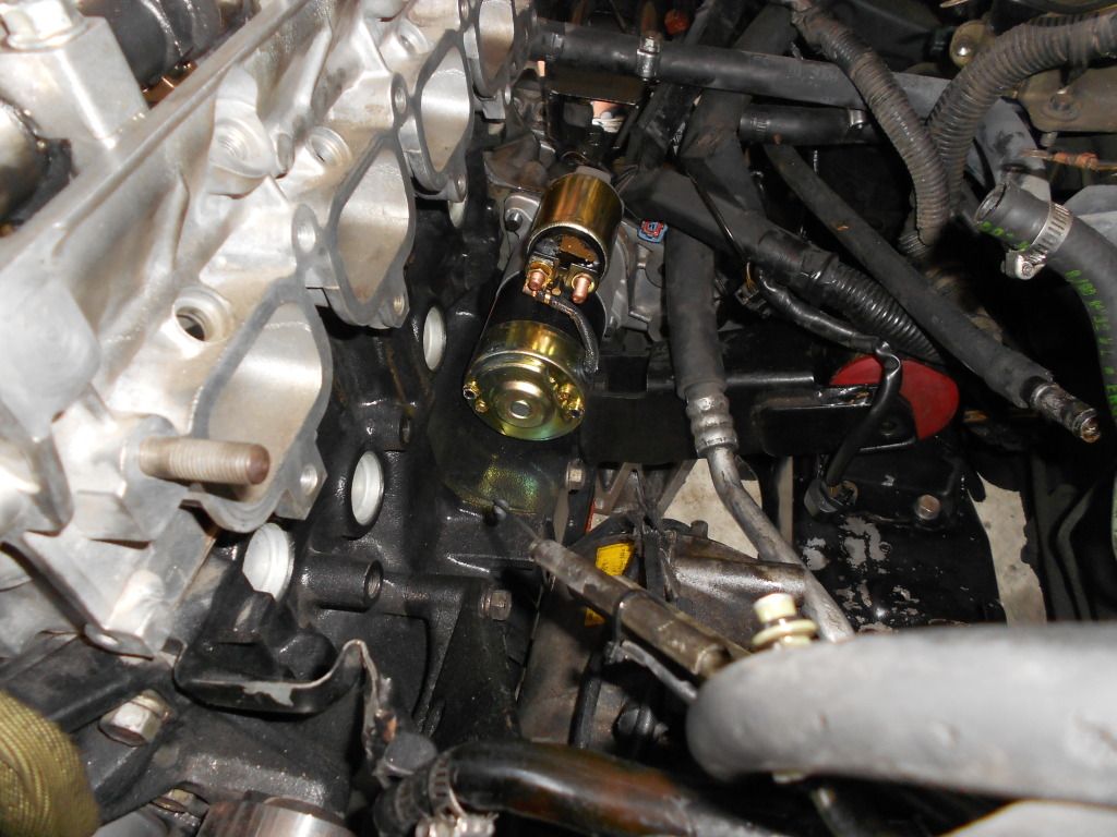

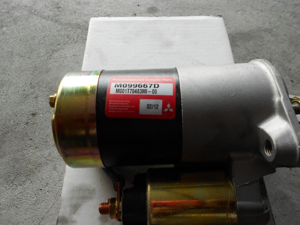

New OEM Mitsu Starter going on
the old motor lurking in the distance

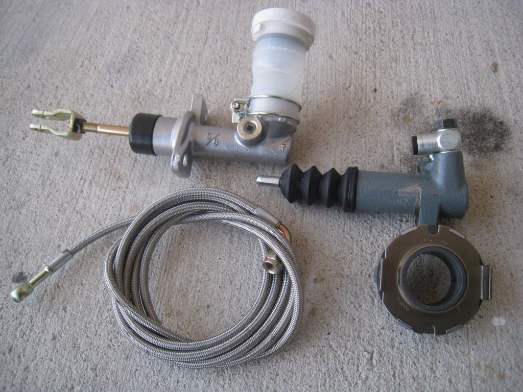

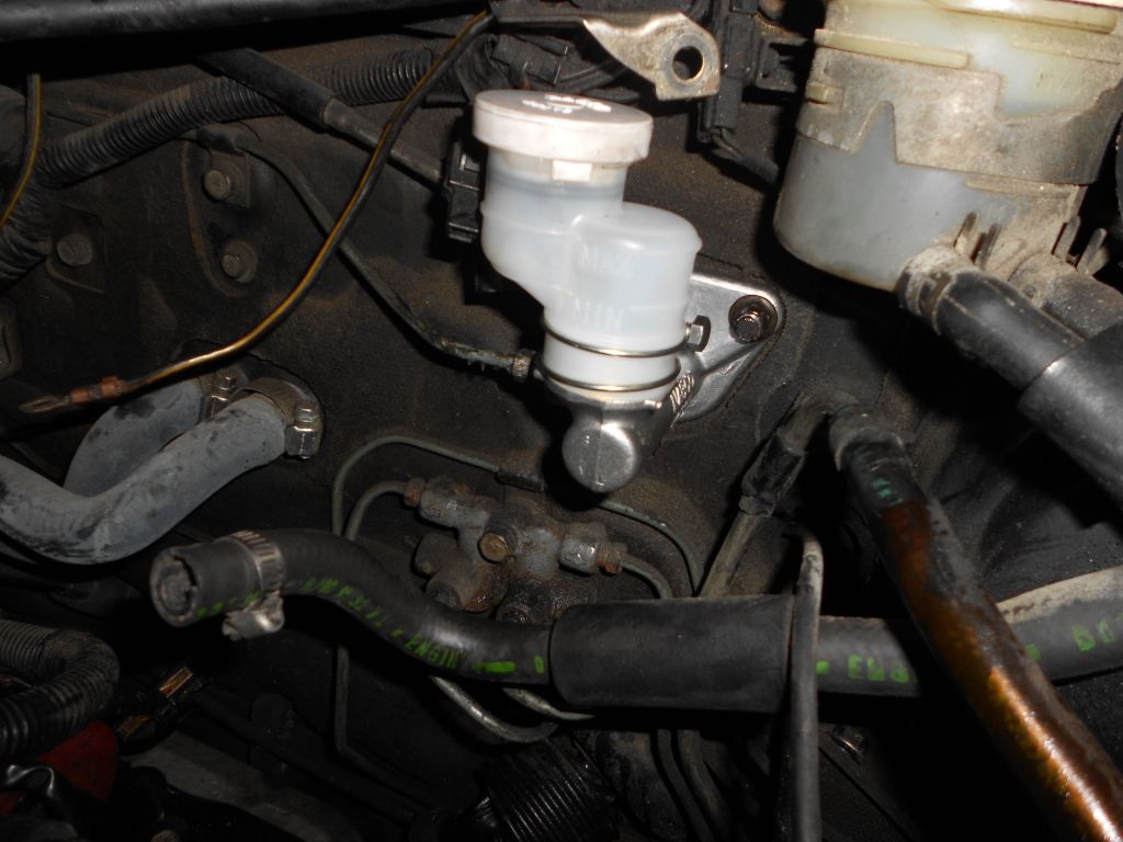

New OEM Mitsu Clutch master going on next
