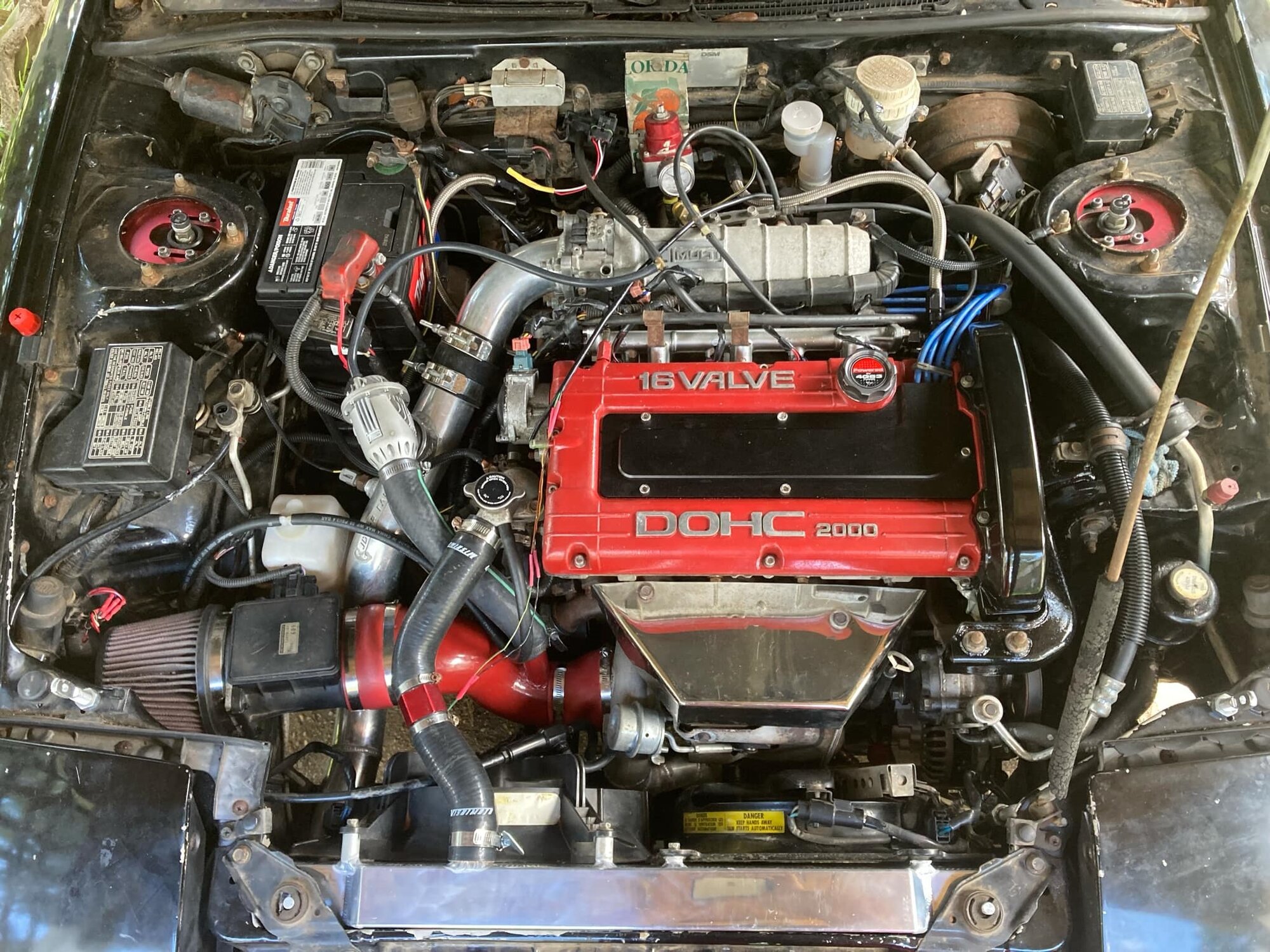

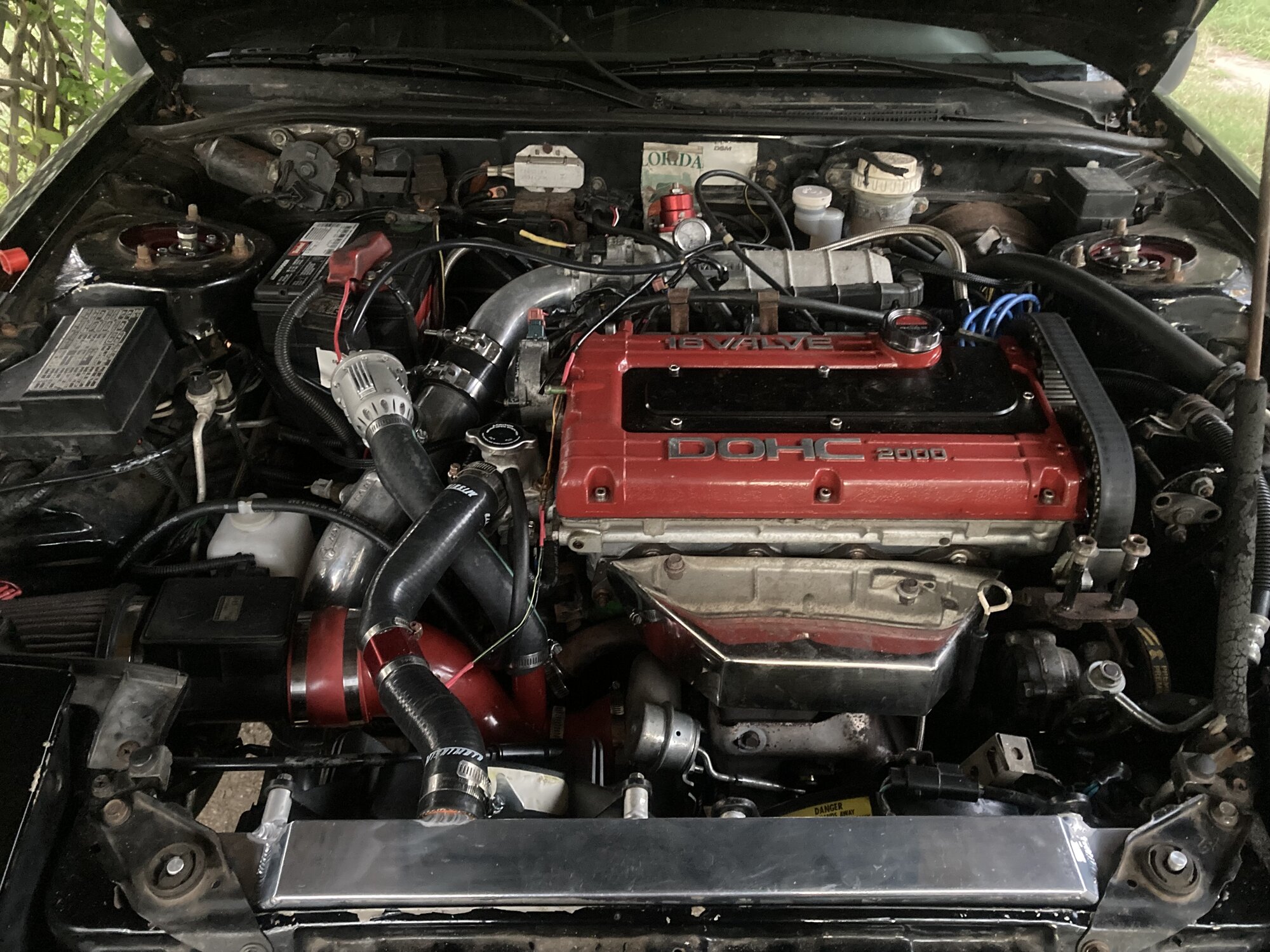

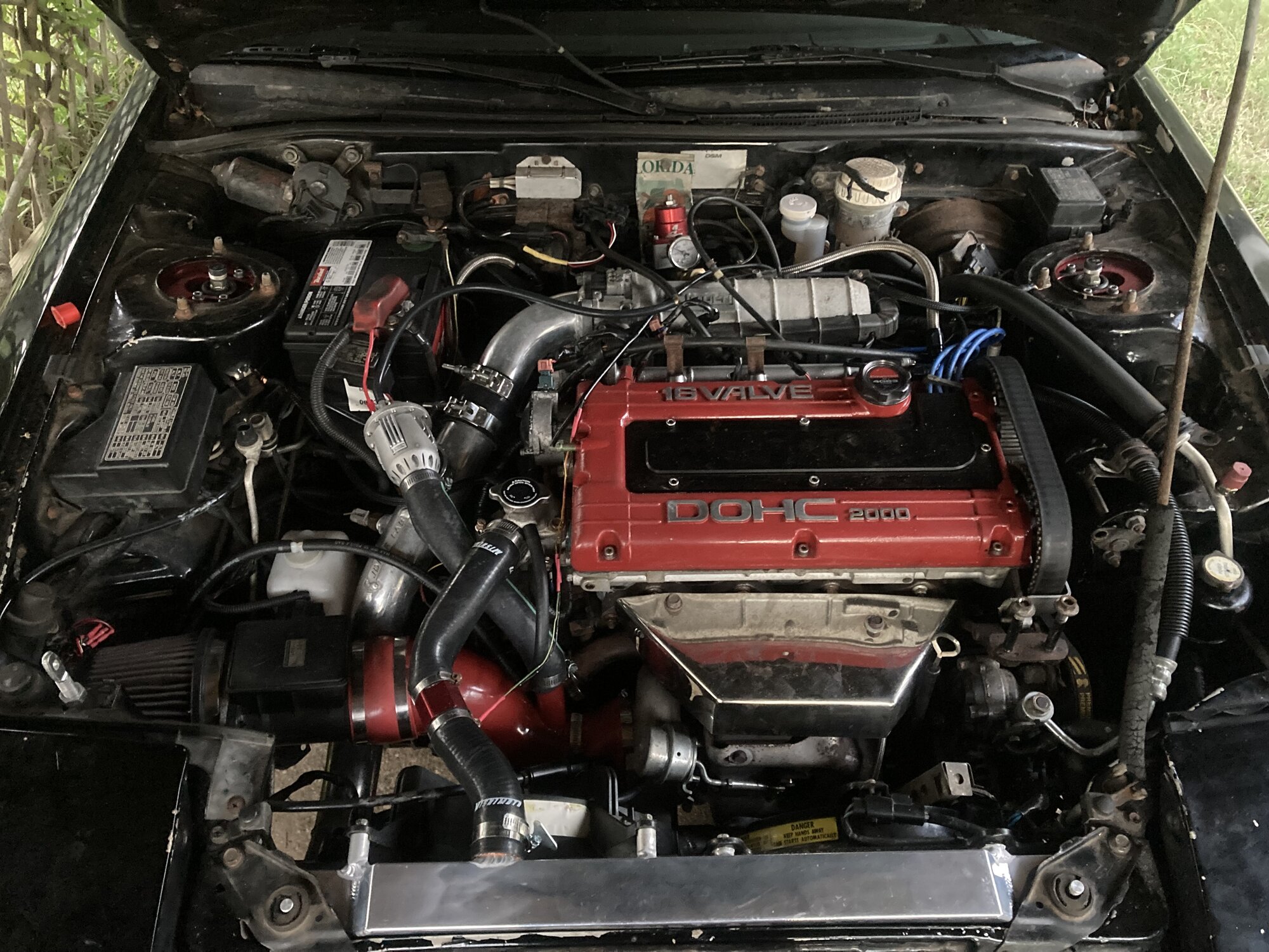

First order of business since I woke up at a decent time and it was very low 70's out was to pull the timing cover to get the bolt out. Plus I've wanted to do this for awhile to check things in there. So I went to do it, and discovered the previous owner replaced all the timing cover hardware with allen head bolts, that rusted somewhere in the past 10+ years it sat. I genuinely mean what I'm about to say next: if you're the type of guy who puts allen headed bolts that aren't titanium or some kind of guaranteed rust-free metal/coating, especially in hard to reach spots, please accept my heartfelt F**K YOU!!! :p
But, that wasn't a big deal as my giant dewalt "mechanic set" has allen key sockets, so I removed them all. This however added another step the list, and that was a trip to Ace Hardware to replace all the allen key bolts with stainless hex head bolts. That comes later though.
Before I could remove it entirely, I had to remove the crank pulley, water pump/PS pulley combo, and the belts. That went surprisingly easy, except the crank pulley was held in by...you guessed it..allen headed bolts. Seriously W-T-F is it with the fascination with these allen head bolts? Add more bolts to the hardware store list. Sigh.
But yeah, those came off easily enough. Popped the cover off, and was pleased to see all of it looks great still. Everything's tight and OEM, BSE was done properly and speaking of which since I finally had the timing cover off, I pulled the Oil Pressure Relief Valve Spring and replaced it with the shorter/softer Mirage spring. That was so satisfying to do as I've been wanting to do this for WEEKS but was too chicken to actually pull the timing cover. Win-Win.
So yeah, when I pulled the timing cover off I noticed the upper engine mount/cam gear engine mount was rusty and flakey. Can't have that. So I wire wheeled it up, primed it, and painted it. Also painted my spare cam gear cover/OEM Upper Timing Cover with the same paint at the same time, and it turned out great. Pictures tomorrow when the paint cures/dries.
But, with all that I hit a good stopping point and was starving. So locked the Talon up, and went to the hardware store, but first got some pizza. Mmmmmh.
Anyway, head home, start on the car again. Right on time is Amazon Prime and FedEx with my goodies. LED 1157 bulbs to replace the OEM brake lights and honestly, they're fantastic. I tested them out on the front blinkers too, and there's no rapid blink. Just a normal blinking pace. Since I wanted the priority to be brighter taillights, I put all four in the brake lights. Gonna order the front blinkers and rear blinkers next paycheck because I'm so satisfied. Here's a pic showing the difference in broad(very broad, it was bright AF out) daylight between the LED taillights and the OEM brake light bulbs. Pretty sure you can tell which is which. Keep in mind, the bulbs I put in there were amber. I read some reviews that the white ones were too bright and created a hot-spot of light. In hindsight, with retardedly tinted tails, the clear/white would've been fine. But yeah.

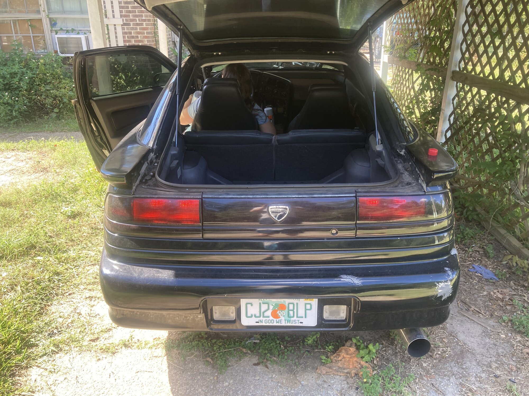

Definitely a big difference. Again, this is with near black taillights and the surface of the sun while welding levels of daylight out.
After that, was the job I was dreading. I'm once bitten, twice shy so I was terrified of destroying this SECOND radiator but I took my time and was methodical. If you use the OEM A/C fan with any of the aluminum radiators(Mishimoto, no-name, etc) you will have to cut the three posts down by about half an inch, or it will push the fan like, millimeters away from the turbo and leave a giant 1/2-2/3" air gap between the fan and the radiator. Not ideal.
Anyway, I cut the posts, mounted the fans, and honestly like magic(I'm crediting my wife here, her presence makes stuff go so much better) it dropped in with a little effort, and bolted in like it wanted to be there. Now comes the test...I filled it with water, checked underneath...son of a bi*** there's a leak. F**K. Not again.
Well, lemme see where it's leaking from so I can see where I destroyed it again. Get down underneath and...uh...the radiators not leaking? The water is dripping/flowing down the damn clutch line? WTF How...the radiator itself everywhere I can look is dry as a bone. How is water coming from the clutch line? Trace it back and found the answer. I left the cap from the overflow bottle off the bottle, and the tube was resting on the clutch line near the top. LOL ROFL well, that's hilarious. Popped the cap on the bottle, wiped the line...bam. Dry as a bone.
Got her burped with the help of my awesome funnel and adapter set, enjoyed some revs, and shut her down for the night. At idle with both fans it cools down rapidly, way faster than the other radiator which was probably blocked with rust and grime from 10+ years. Very...very pleased. Snapped these two pictures, couldn't decide which one I liked better, shut the hood and went in for the night just as the mosquito army showed up to molest me.
F*cking stoked with how today went. OFH is still dry as a bone which is nice, now the cooling system has been flushed and a new radiator is in there(that's also slightly thicker than the mishimoto unit), and tomorrow I can't wait to see how it looks with the painted upper timing cover and reconditioned driver's side engine mount.

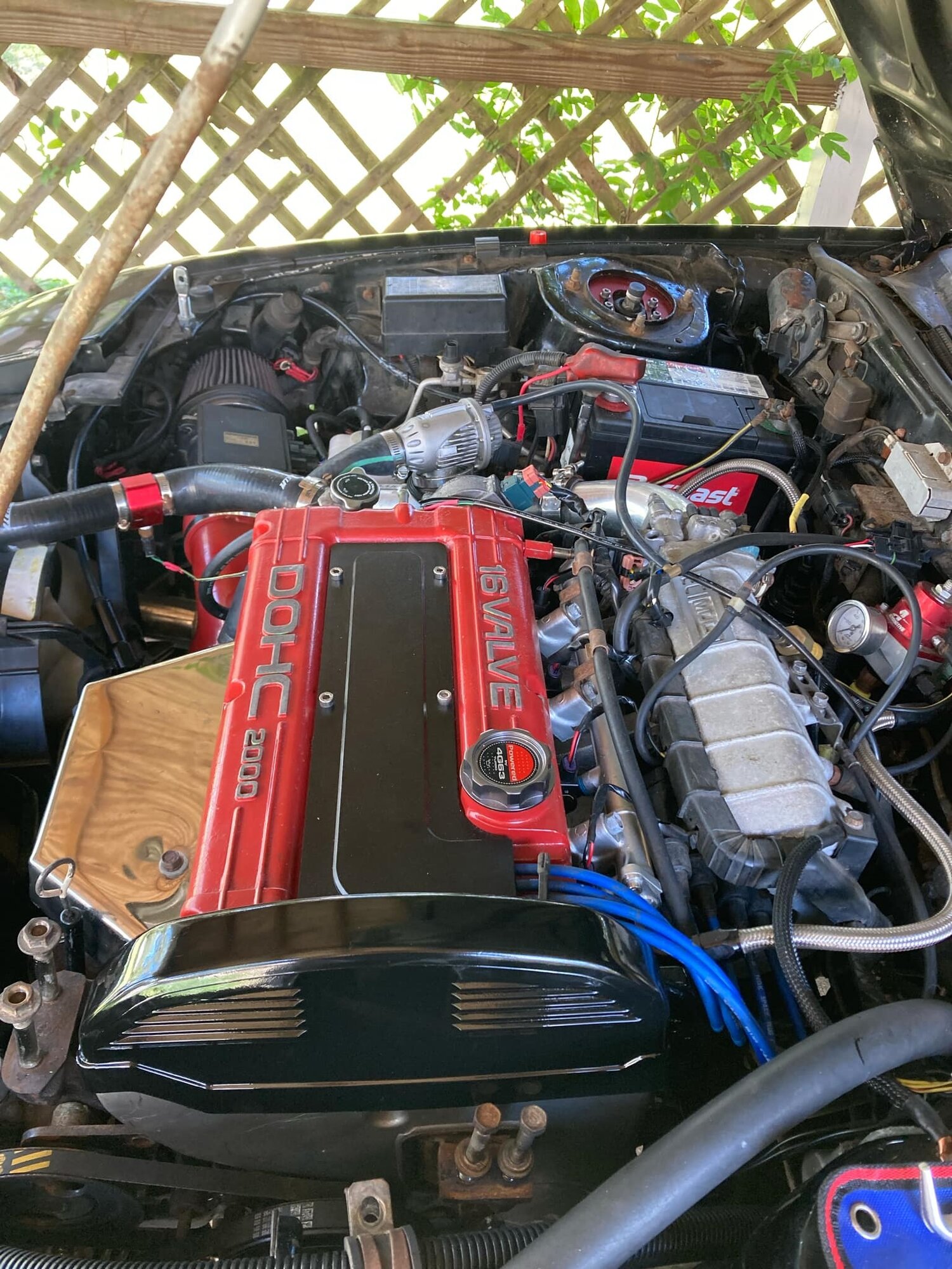

Alright, the paint on the upper timing cover and the engine mount is relatively cured(still needs a few days I think, or maybe just a nice day in some hot engine bay temps), so I popped these bad boys in. Very happy with how they both turned out. I really think black on the cam gear cover was the right choice, as red would've been waaaay too much.
So happy with that. I have way more pictures but they're kind of repetitive.

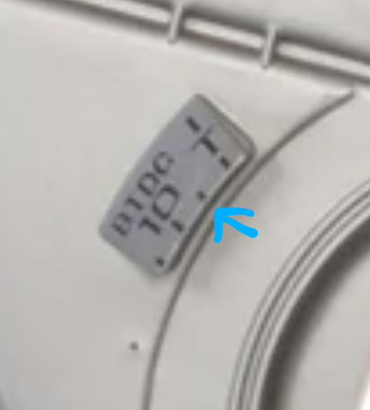

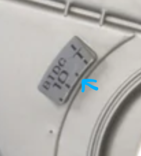

Also to update the thread, I finally set timing with a timing light. I've verified mechanical timing is correct already when I removed the front cover to retrieve my lost bolt, so this was the next step. Timing with the connector ground was at 10* or a little beyond. I set it to what I assume was 5*. Dumb question: 5* on a 6 bolt is lining the mark with the T on the cover, right? It really hates life idling at 5* timing, but it didn't die at least.
I really thoroughly enjoy how it idles with the deadtimes and deadtime settings Stapl3 gave. It revs fast and responds really well.
Anyway, here's the log. Thanks for looking!
Mr. @Stapl3 , warmed up idle log as requested sir!
Do you need it to be longer? (That's what he said?)
5* on the timing cover is the mark between the T and 10*
Shit! Lol. No wonder it idled like ass.
Thanks buddaaay. Gonna go fix my mistake.
Also when you lock the timing at 5* it usually almost dies. Car idle with dynamic ignition timing. Usually PROBABLY something like around 15* but jumps around.
It's also a good idea to give it a few revs while it's locked IF you can while watching the light and timing mark to make sure it's not drifting while revving
