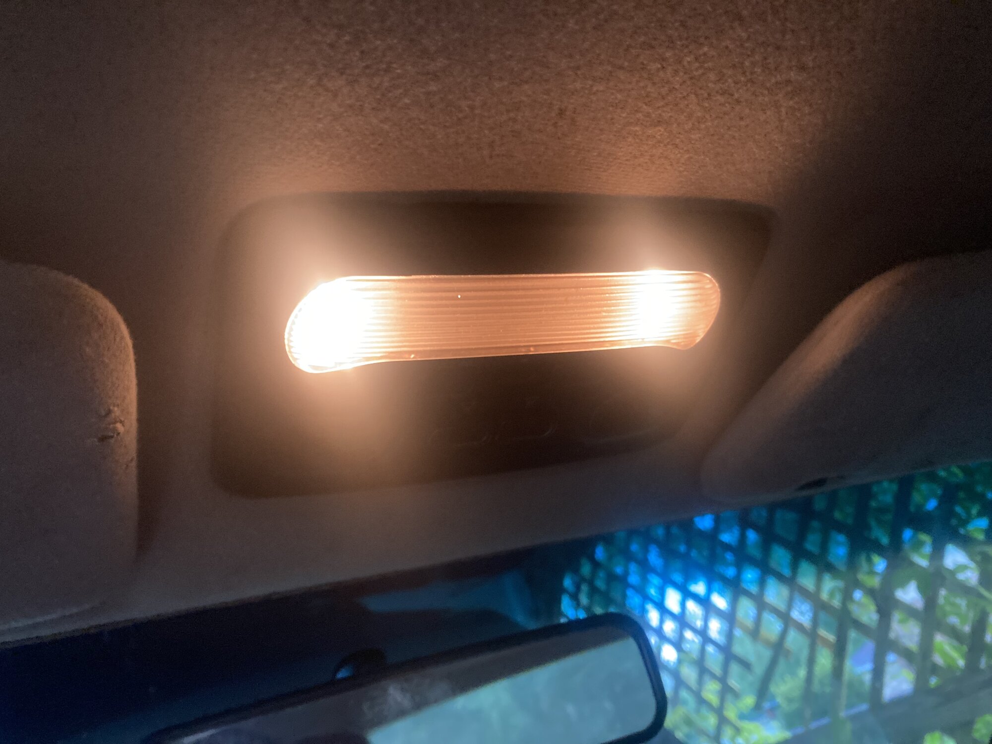

This has never worked since I got the car, but all it needed to fix it was I removed a bulb that didn’t look fully seated, cleaned it a bit, and reinserted it firmly kind of turning it a bit to further make sure it contacted the tabs, and viola! It works!
The reading lights still don’t work and the bulbs are fine, so I should dig into why, but honestly…just the dome lights are fine with me.

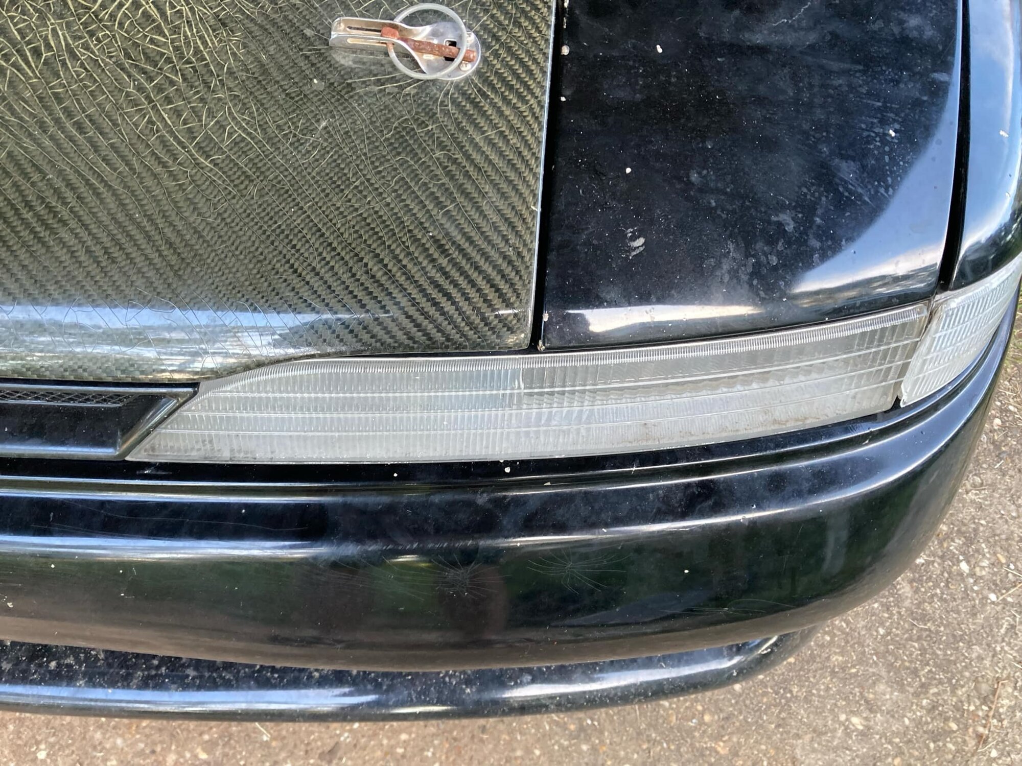

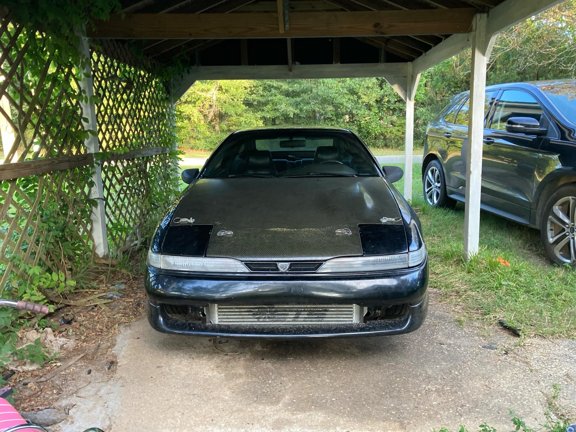

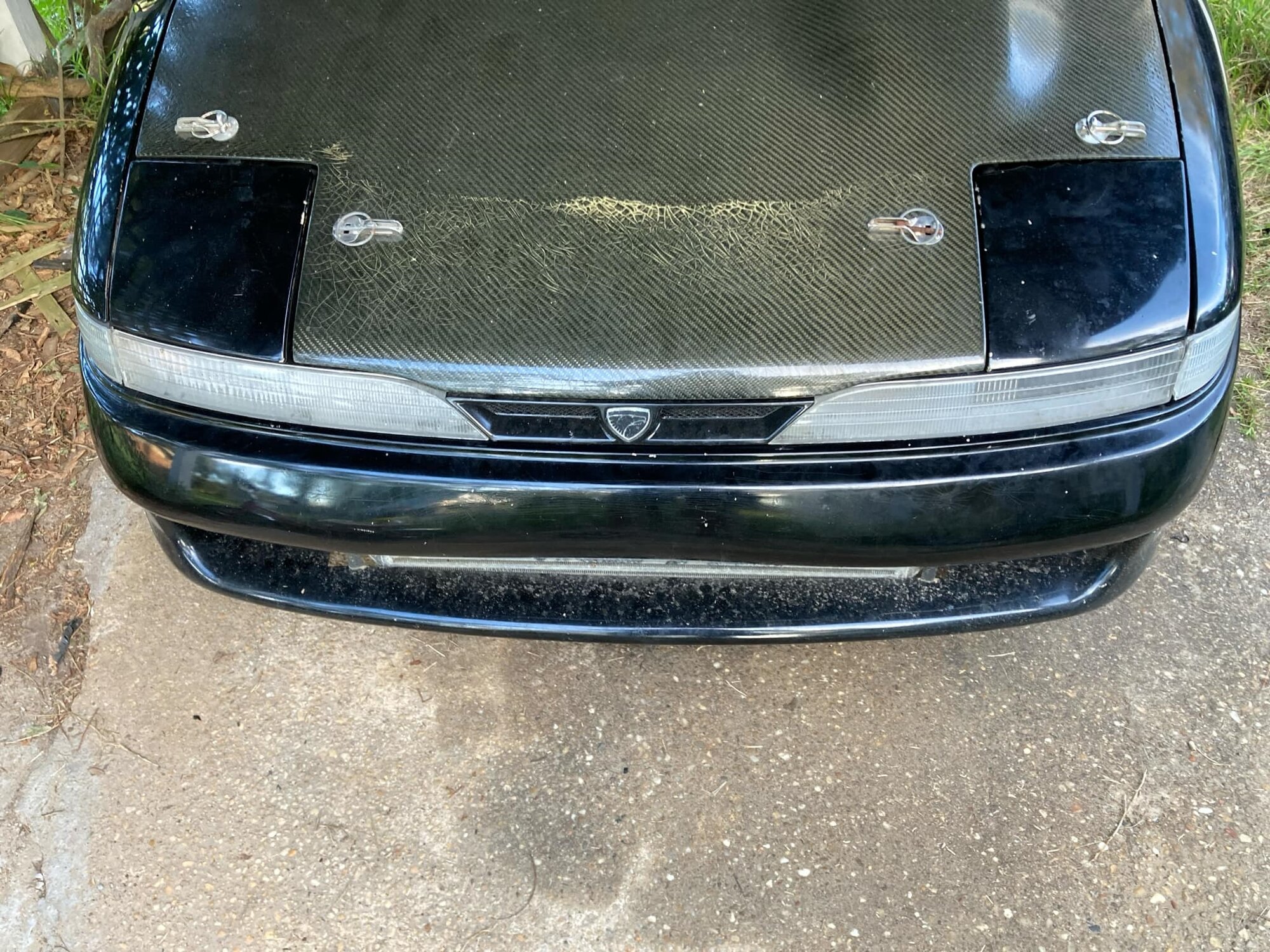

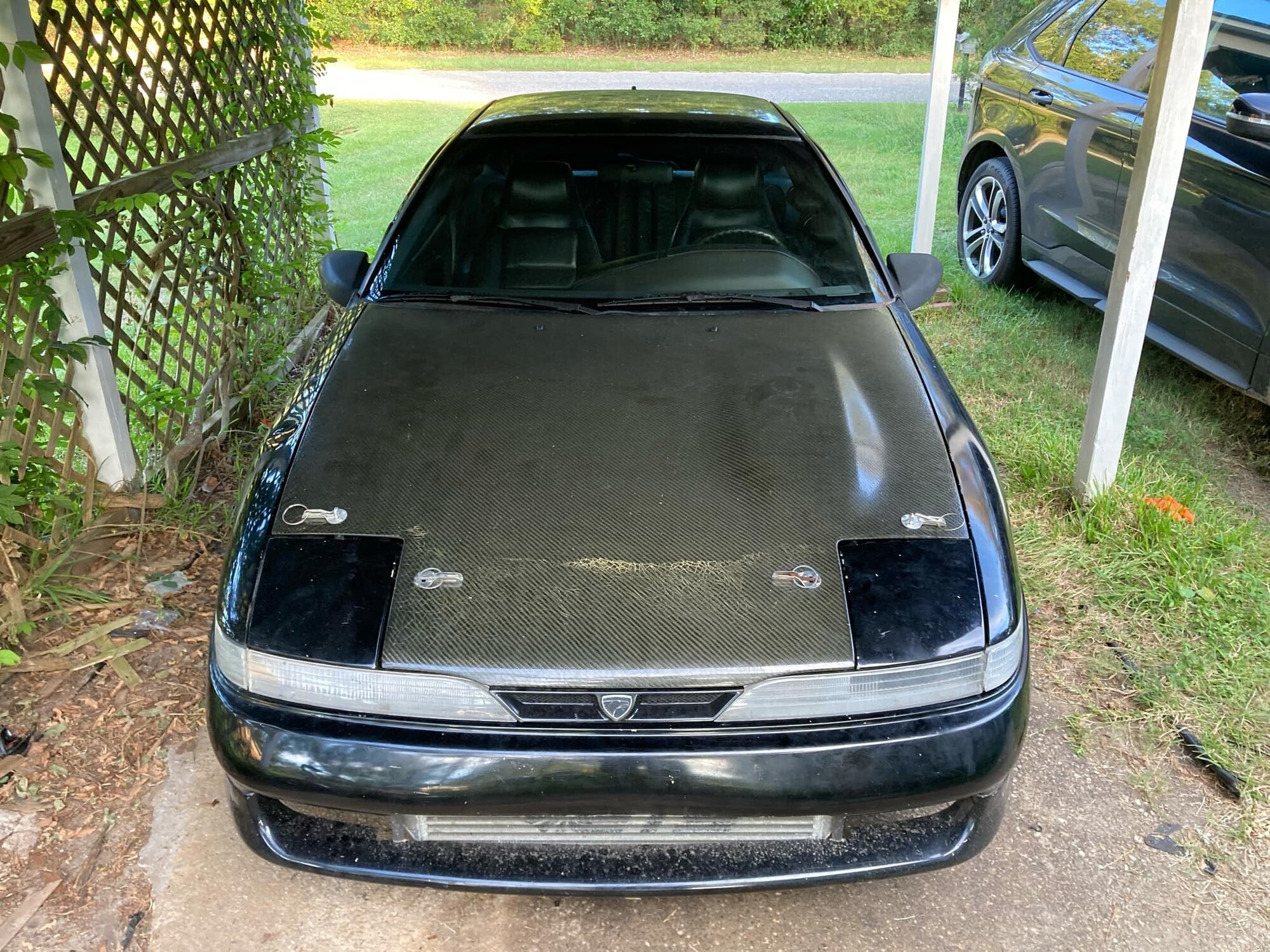

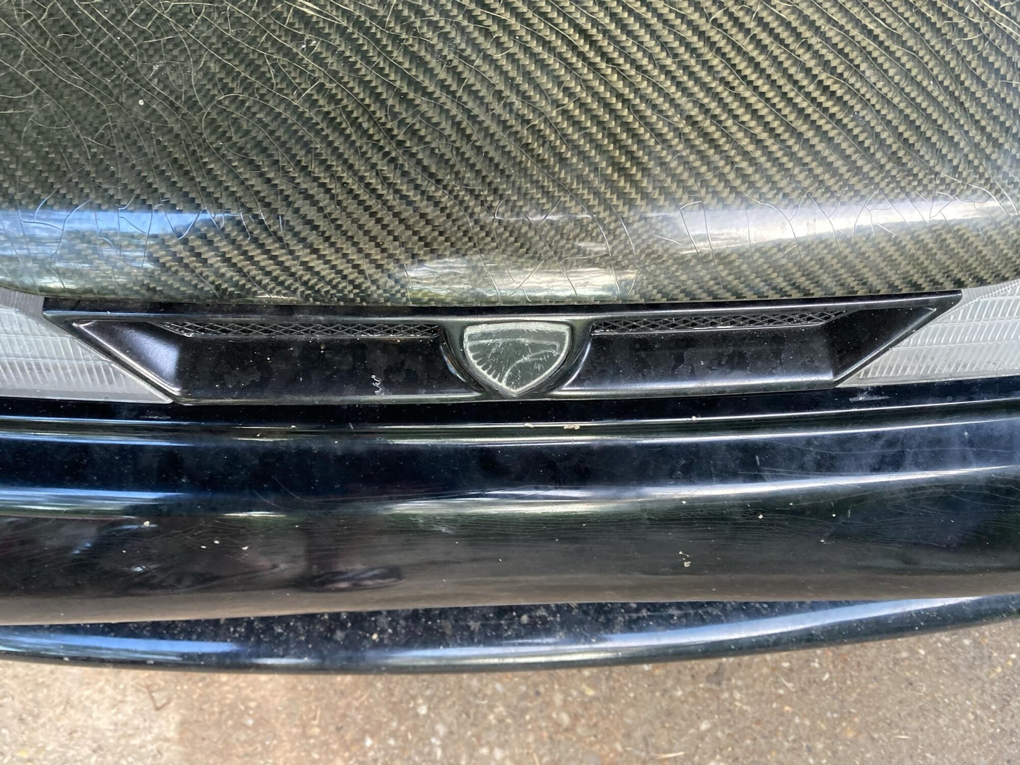

Well, shit. I was adjusting the front end(the front bumper sat just a little beyond the turn signal housings so there was a gap that bothered me. While I was messing around and got it perfect, I dropped a bolt down the front timing cover. 🙃
God damn it. Lol. Guess I'm pulling the front timing cover off. Since I'm doing that, I'm gonna change out the oil pressure relief spring to the weaker mirage spring I've had for forever.
I'll say it again, life is so much harder when you're stupid.
But, I daresay it looks way better. I'll dig out some before pictures later(maybe), but don't mind how FILTHY the car is. The car also has definitely been in a low speed front-end collision before though because everything is off, and the core support is bent ever so slightly inwards. I may honestly try to take a hammer and "fix" some of it, but I may not mess with it. I'd hate to break something or ruin something. I'm not a body guy.
