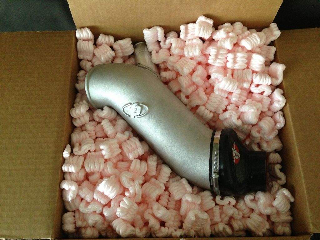

Got some stuff in.
Im going to order an FP 4 inch coupler for the maf side so it matches.

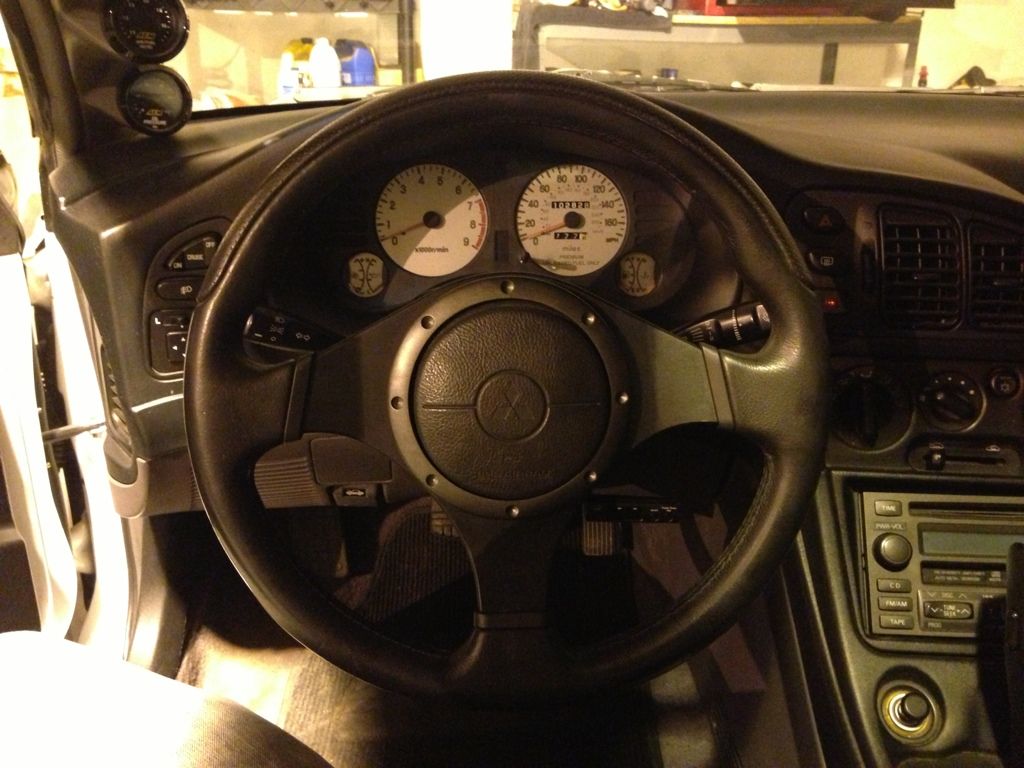

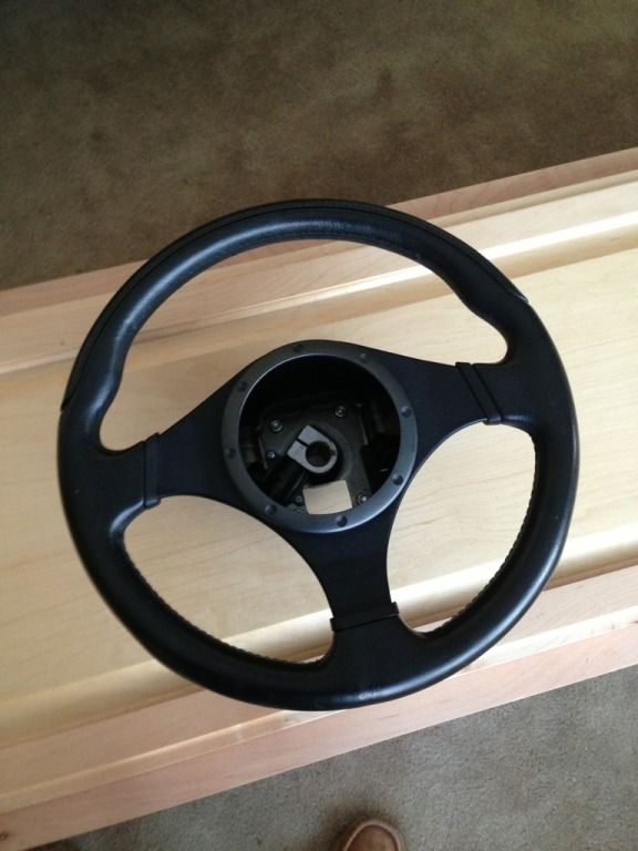

My wheel came in. Thing is in perfect shape.
Got it installed.
looking awesome! good work. what did you have to do to make the evo 9 wheel work?

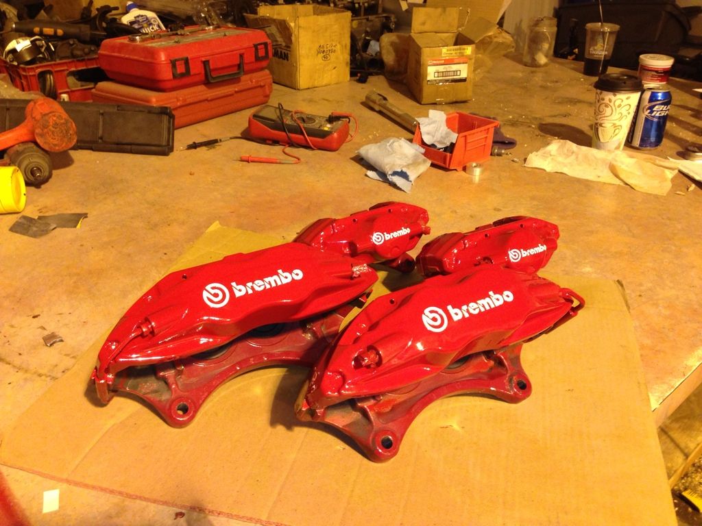

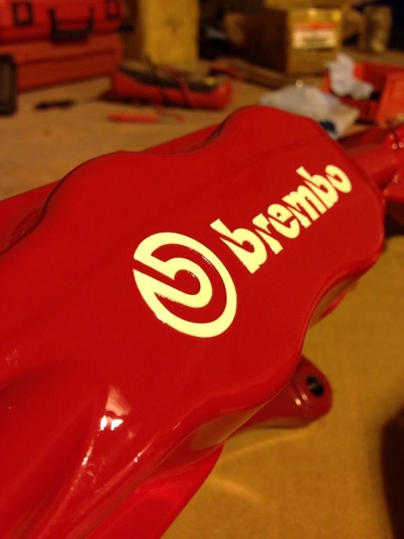

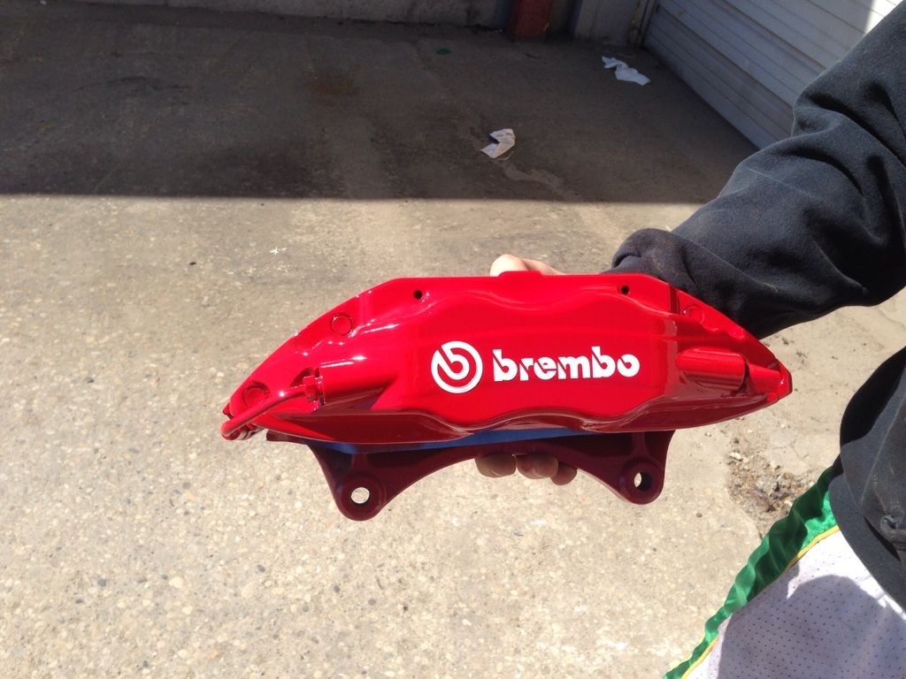

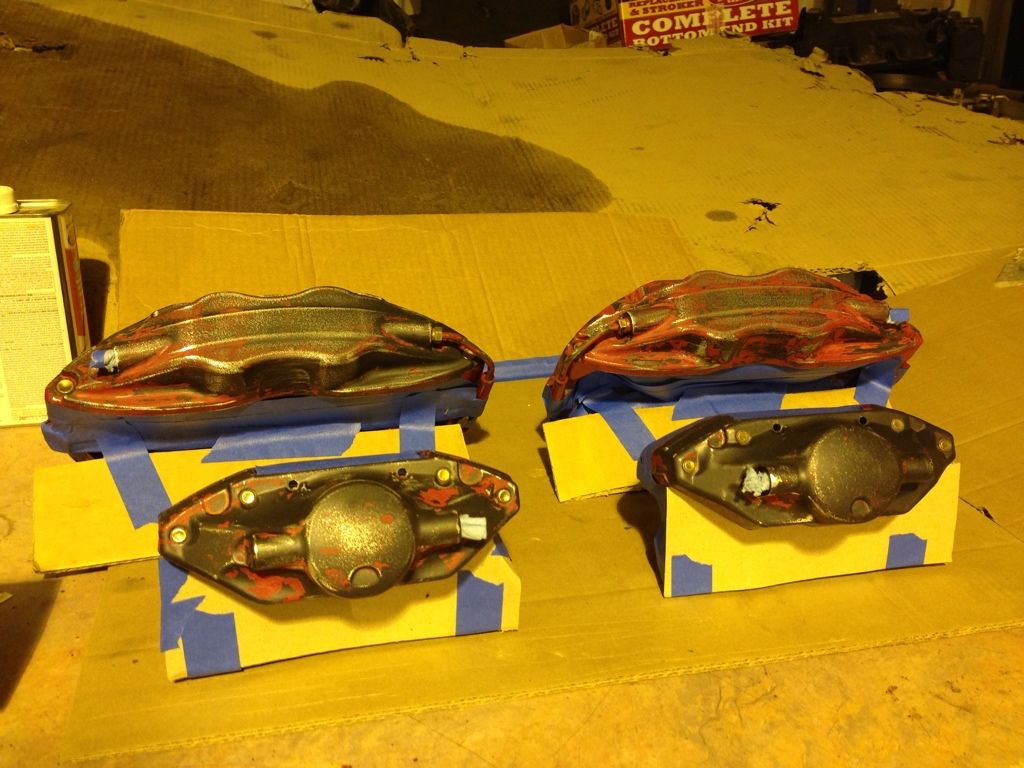

Next thing I did was strip all the paint off the old Brembos.
I only masked off the back and painted the front. I did a decent job but the letters are a little weird but no one will notice besides me.
This color is bright as hell outside, can't wait to get them all on and see it outside.

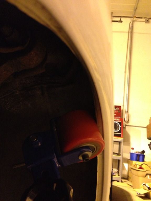

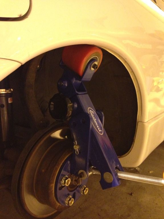

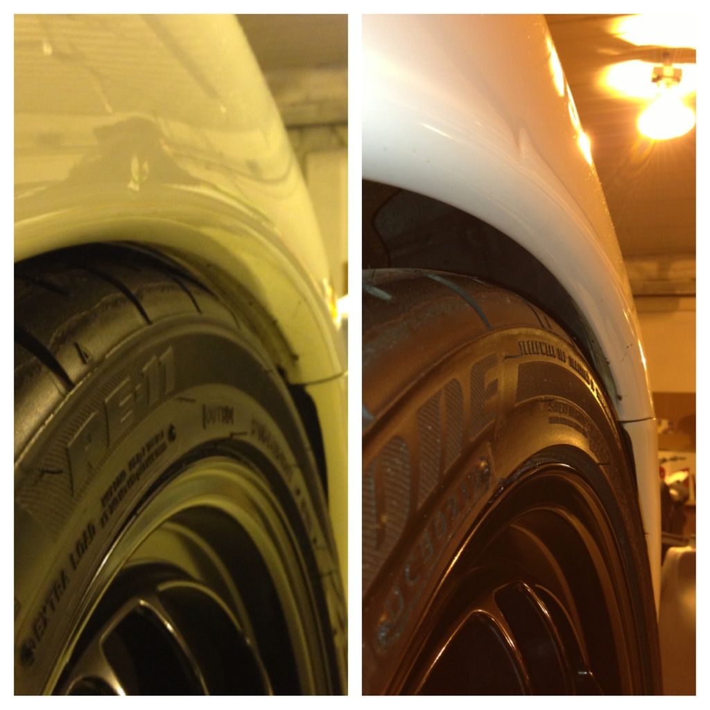

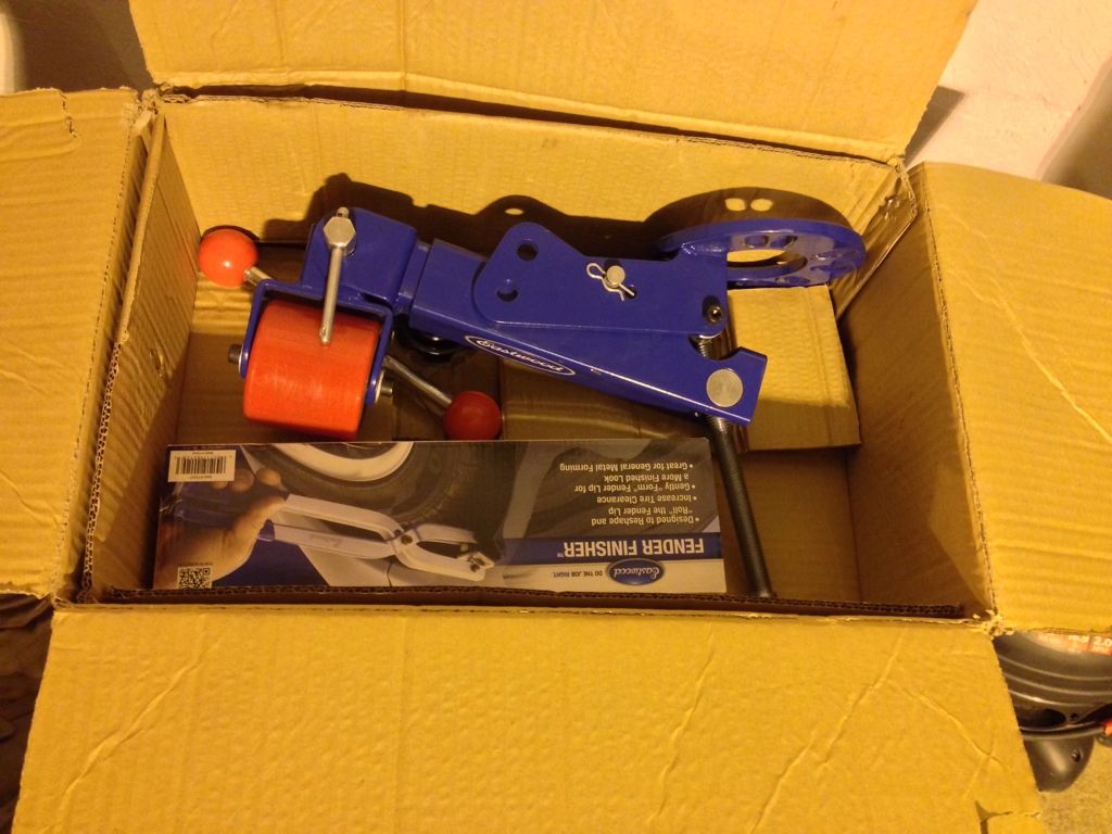

The next thing I did was try to find a fender roller. I finally got a hold of someone who said his cousin had one he would rent for $50 so I called him up. By the time I got the roller, which was brand new used once, I had two buddies asking me to rent it.
So I asked the guy if he would just sell me the whole roller and fender finisher for $165 and he took it. So I have a fender roller now!

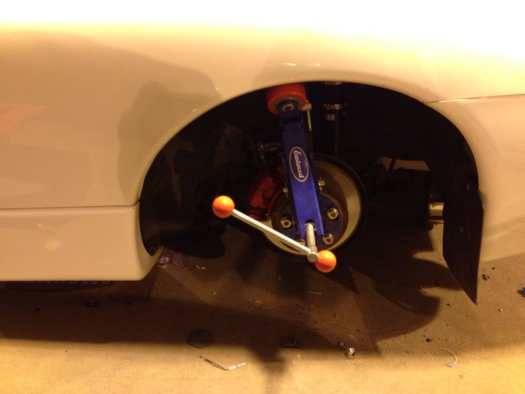

I only needed to roll a little bit in the back so I did that. Thing works awesome.

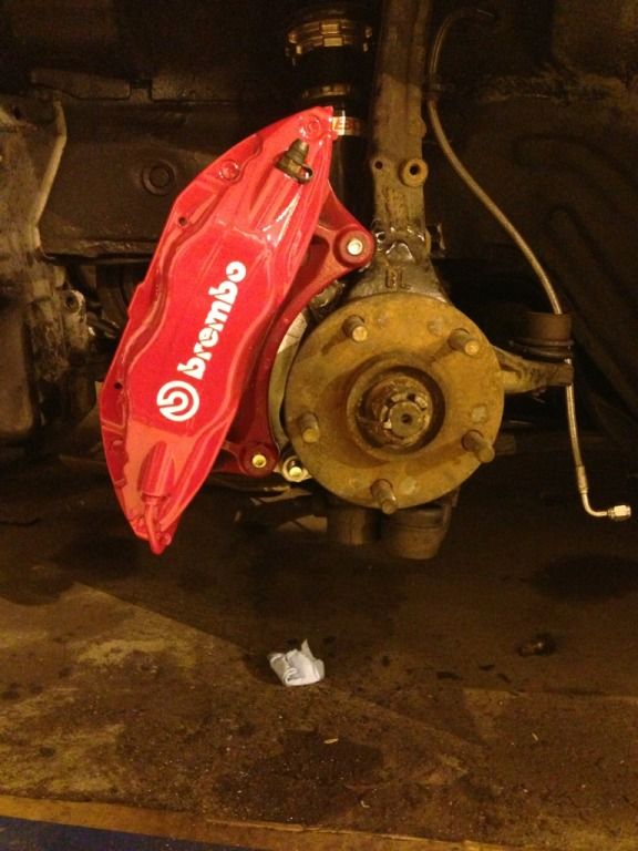

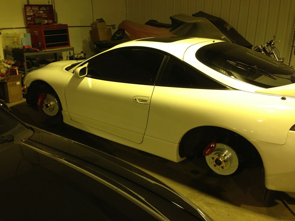

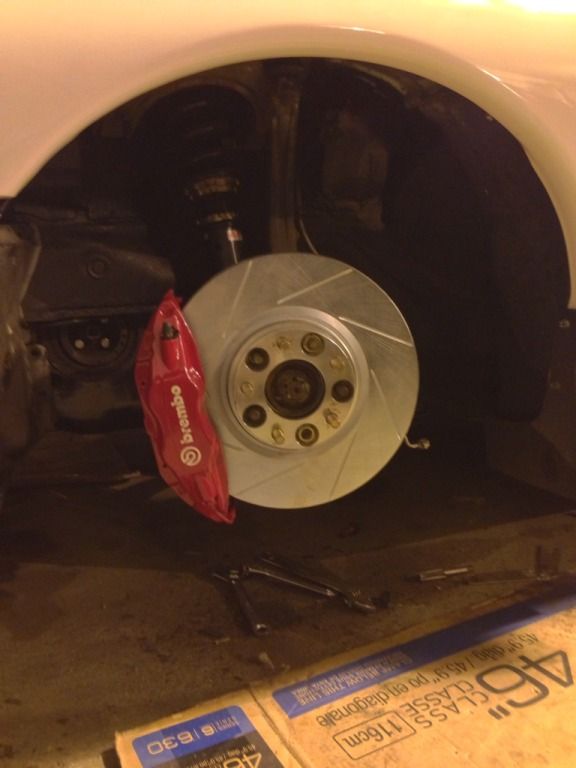

Now I started on the Brembo install. I grinded the hubs/ tapped the ear, and had the caliper bolted up, but am now wishing I clocked them up.... So I might have to switch them around......

Tomorrow Im going to finish up the brakes and start on fuel pump rewire and evo 8 pump install.

Quick question, and it might be a silly one. What kind of rotors did you buy? GSX ones or are they Evo 8 Rotors?
How did you end up rolling the rear fenders with the upper control arm in the way?
They werent in the way! Roller fit fine in there.
Evo 8 rotors, they are a lot bigger.

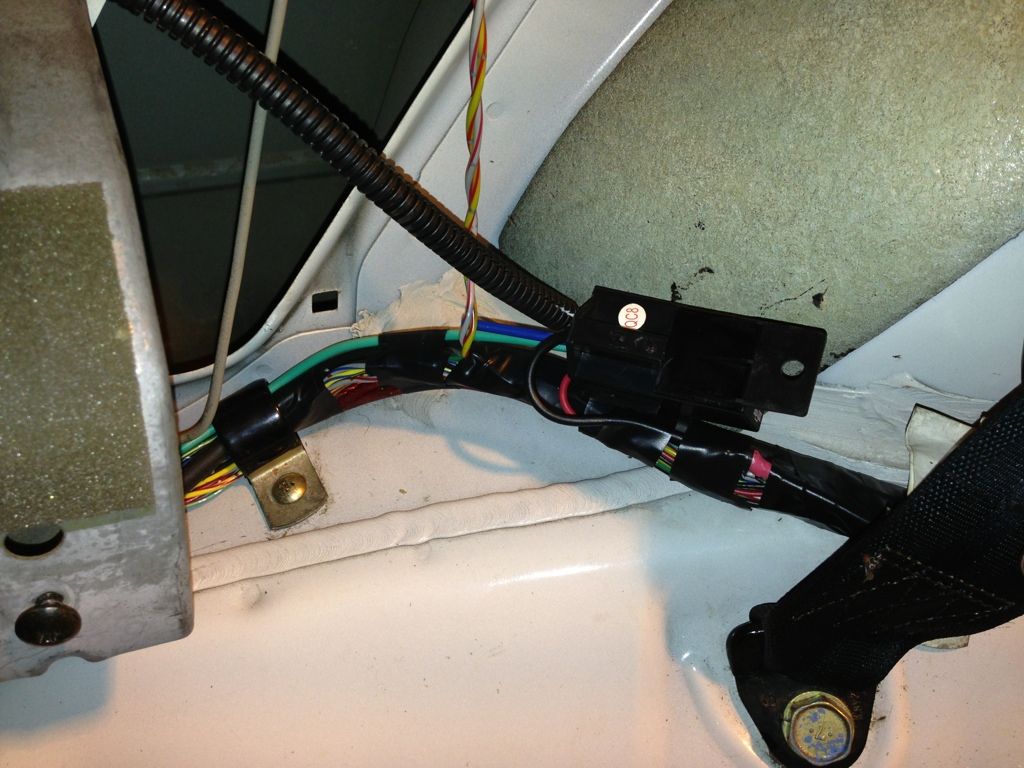

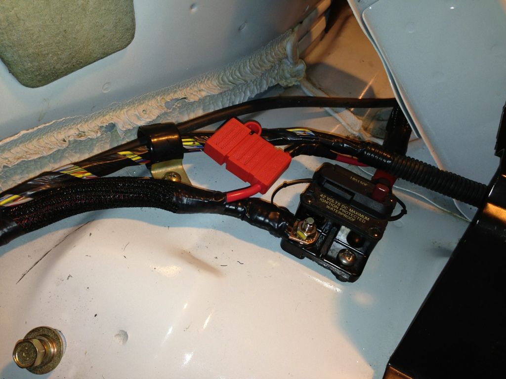

I dont think I have ever shown my wiring set up before but here it is.
I have a 4 gauge cable from battery to a 150 amp circuit breaker, then to a distribution block in the glove box. I then have an 8 gauge cable from battery to the 30 amp fuse for fuel pump. I tied everything into the factory witing harness and brackets.
Here you can see the relay and ground cable from the fuel pump.

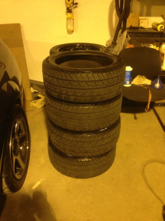

Also picked up some new rubber.
Bridgestone Potenza go19 Grids

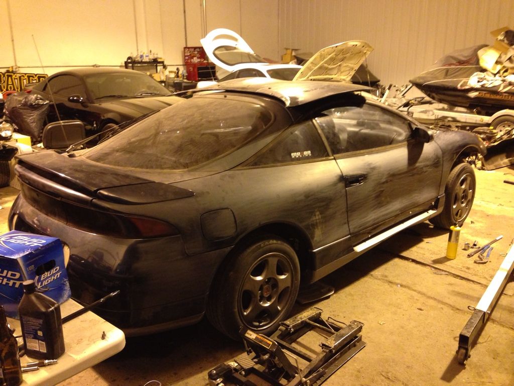

And here is my new clearance in the back from rolling the fenders. A before and after, no height change, all fender work.

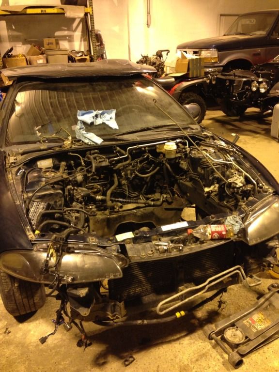

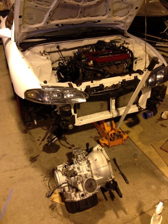

I have always tried finding a 5 speed swap that worked out for me and I finally found one. A guy about an hour away put up a 95 gsx with a blown motor up for 1k. I was going to go for it. Luckily someone offered to come pick up my auto trans and t-case for 700 on saturday so I was golden.
I picked the 5 speed donor up and got it back at about 9 pm Friday night and got started pulling my trans because the guy was picking it up at 5 the following day.
I literally had that trans out of there within 3 hours, a new record I think for awd auto trans LOL.

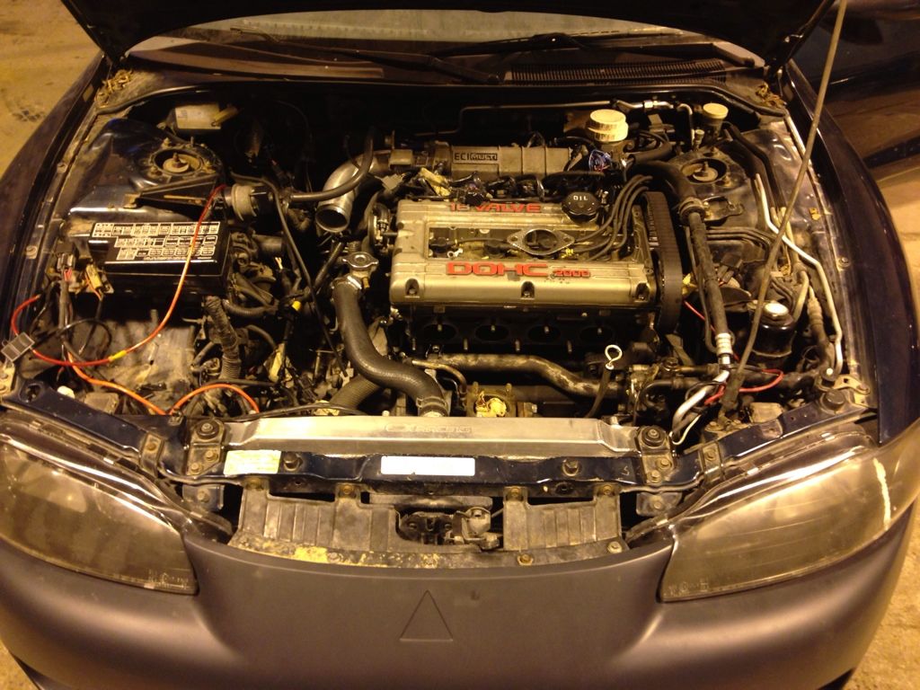

I then pulled the engine/trans from the donor.
So on saturday I pulled the pedals from both cars, the front axles, shifter cables, auto shifter and 5 speed shifters, and TCU from my car.

All you have to do is remove the evo hub, and weld on a hub from a 1g dsm, pretty straight forward.
Heres a write-up if you are interested!
http://www.dsmtuners.com/forums/articles-parts-fabrication/273299-evo-steering-wheel-dsm.html

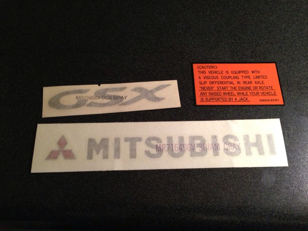

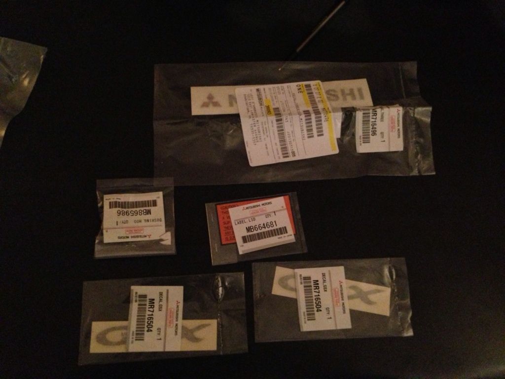

My package from Jnz came!
Have my two gsx decals, my mitsubishi decal, lsd decal, fuel pump rewire, and this little hood prop clip.
