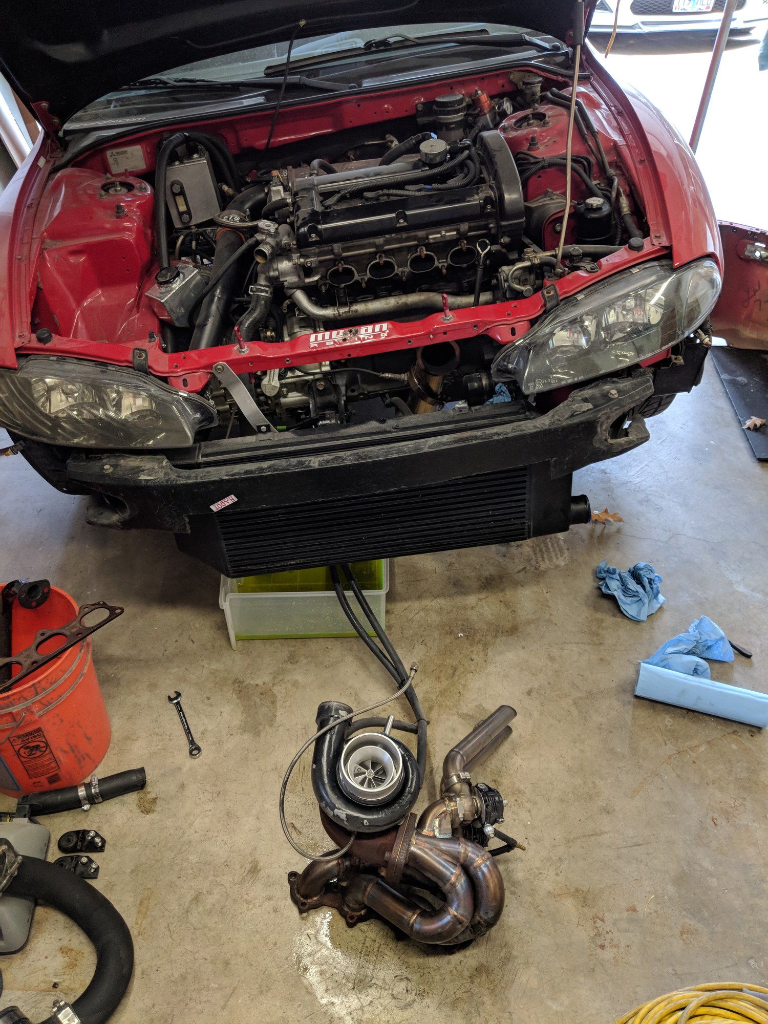

Got a start on the new setup last night. Going to have to do some thinking on the hood latch pins and how best to fit the rad under the upper support but I think it will be doable. Stay tuned!

Yeah it's the 3" FP O2 housing. I'm probably over thinking it on the internals, just stressing over something I have no control over I suppose. It'll be what it is, I'll adjust as needed.
That's interesting about the O2 housing. I called FP just, well, back in November, to ask if they still had any of those, because I don't see them listed on their web site any more. They said at the time that they still have a few of them, and even fewer of the FP30 turbine housings.
Anyway, it's something I kind of follow because there are times when I wish I didn't have an open dump from the wastegate. Just from the standpoint of .... police attraction LOL.
I was surprised they had one when I called as well. The FP30 housing I bought used. I'll be interested to see how the single scroll housing performs compared to the 1.1 I had.

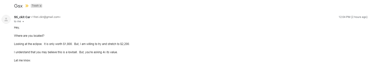

Gotta love some peoples kids man! I don't NEED to sell. I'm happy to entertain any offer but don't come swinging at 1/3 the price, I'm just gunna poke fun at ya!
Wow, I'd have either not even responded or flat out told him to choke on that offer. That's insulting as hell.
