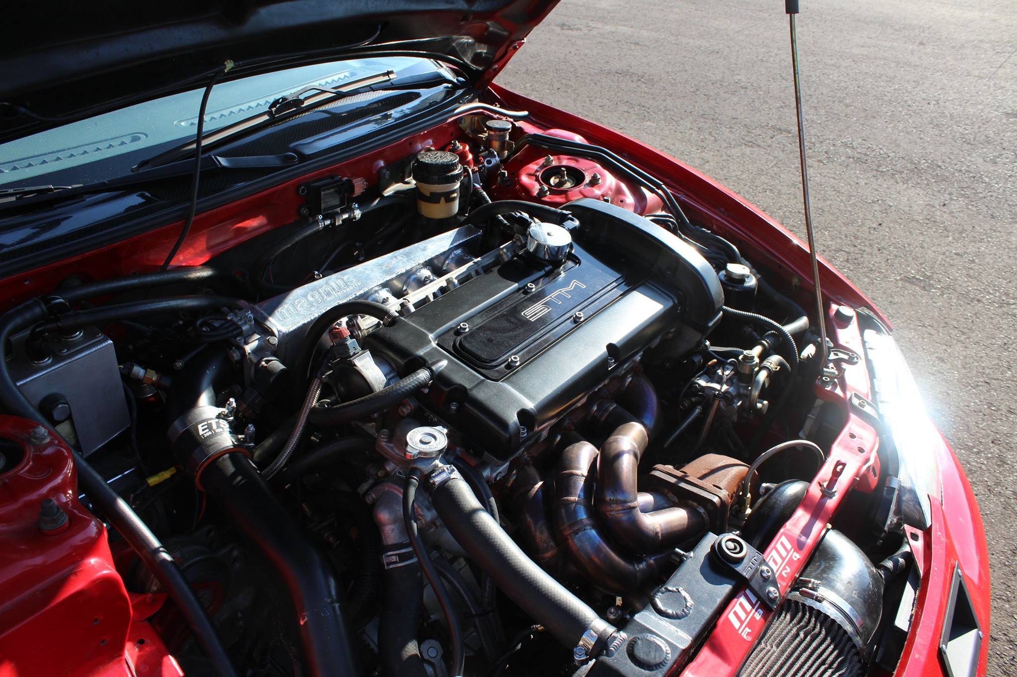

97 GSX: 2.3 Stroker with a T4 FF TS HTA3076

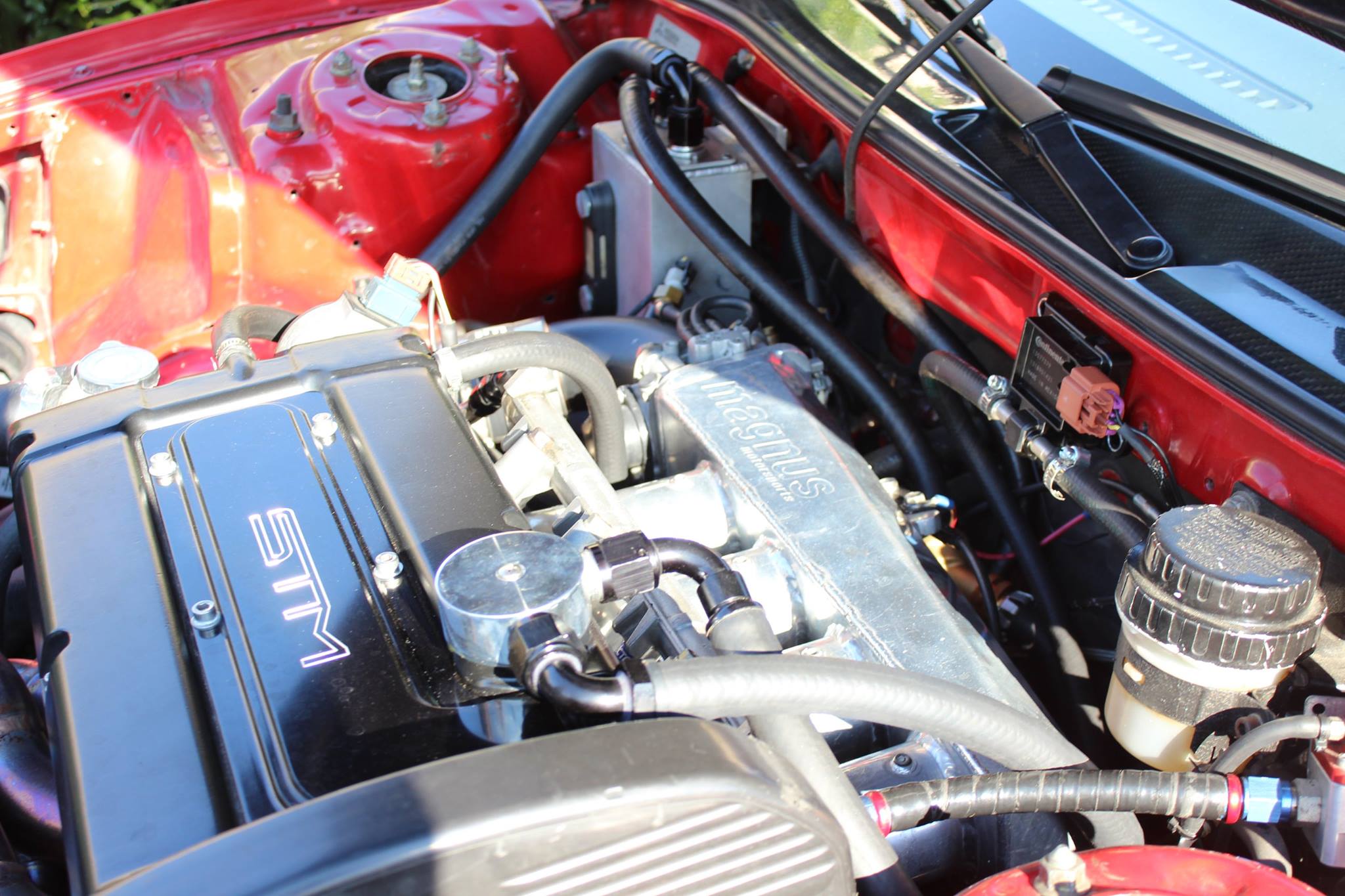

Did a little powder coating to update the look a bit. Got a couple goodies coming for some extra control / protection. Should be setup with my Hal vented oil cap, ebc, and hopefully flex fuel in the next couple weeks.

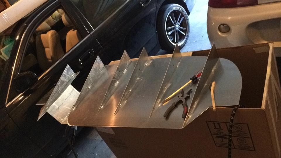

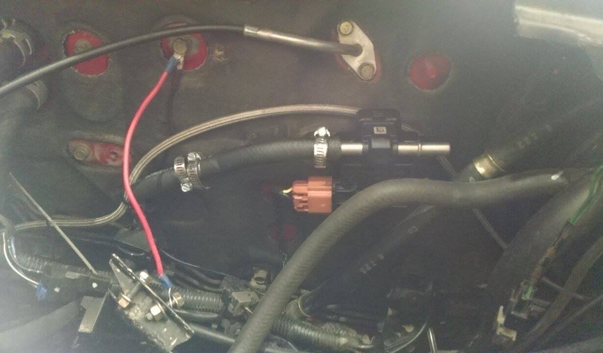

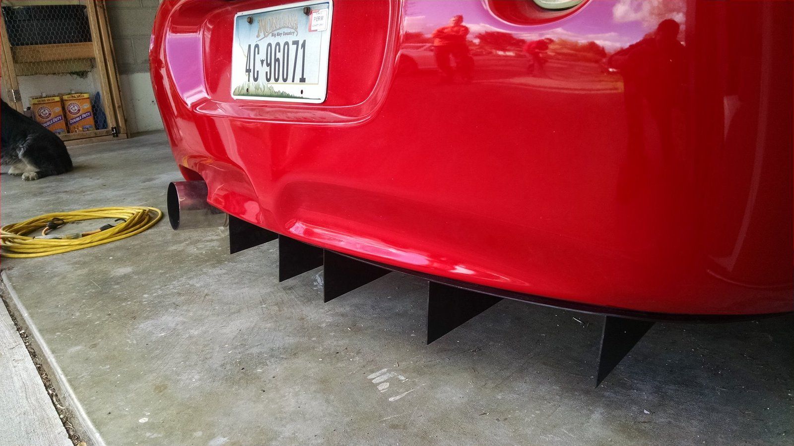

Been a while, haven't had time to play with the car much since my career change. I purchased a 2007 5.9 Cummins and have been putting all my time into it. Small things have happened on the car, it is now flex tuned and I have completed my Hal vented oil cap setup. We are beginning to produce rear diffusers for the 2g now, see here for some pics: http://www.dsmtuners.com/threads/2g-rear-diffuser.484035/#post-153457104

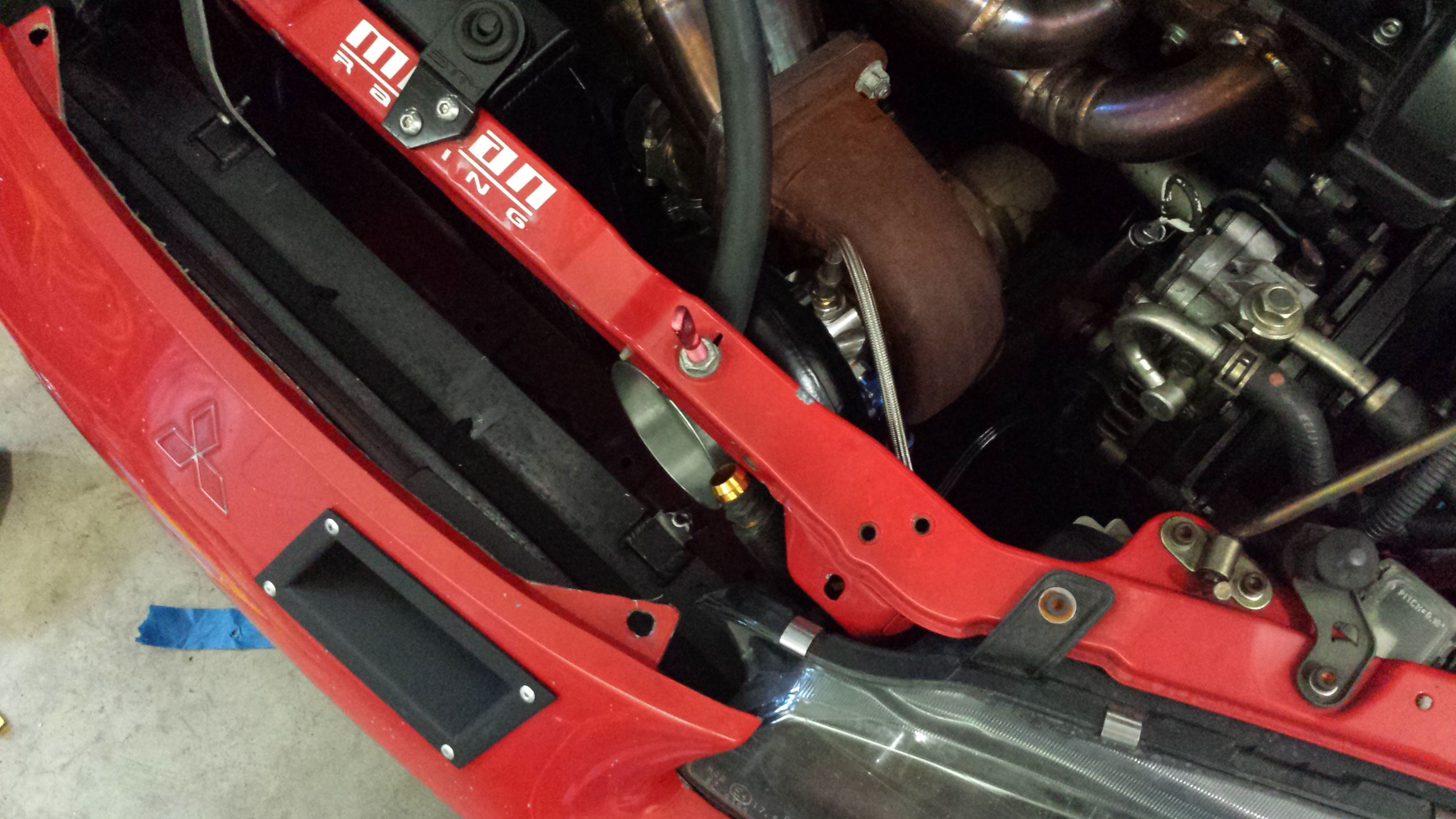

I also picked up a new freshly repainted bumper with some small curb rash that I will be working on transferring over to the car when I get some spare time. I suspect with the summer coming to a close that I will have her apart soon for some much needed love in the suspension department. Thanks for looking!

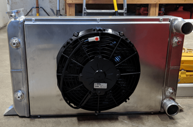

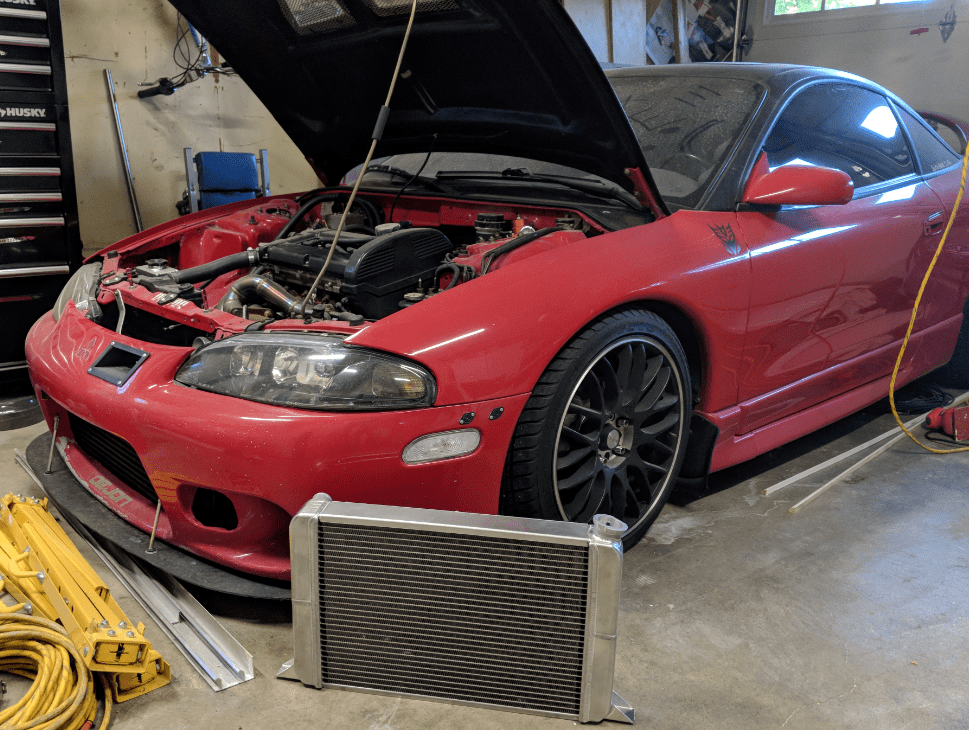

Time to bring her back to life, she has been down for a few months with a failing alternator and problems with the half rad not keeping up in hot conditions. Ive sat her just because I haven't wanted to deal with it but its time to fix it so here we go:

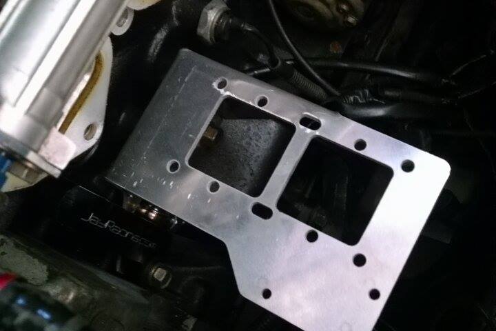

Currently installing a new saturn alt with the jays racing relocation kit and a coil pack relocation bracket from JMF. New 51r battery tray being built, until then Ill run the stock one modified to hold the new battery. Also doing some ducting work on the radiator/IC setup to try and correct the heating issue. Im also going to go to a straight water/water wetter setup since she is kept in the garage and doesn't see freezing temps. I relocated some lines, deleted some more wiring, and found a partial kink in my return line running from my ethanol sensor to the stock return line so I cleaned that all up. We will see how she does once she is all back together.

Well finally got her fired up after a huge push last night to get it all sorted out. Alt relocation is done and saturn alt shows a drop at the battery of .5 volts with heater on full blast and all the lights I could possibly have on, on. Not sure if this is good or bad but considering that it is still sitting at 14V with all that on I think it is pretty decent.

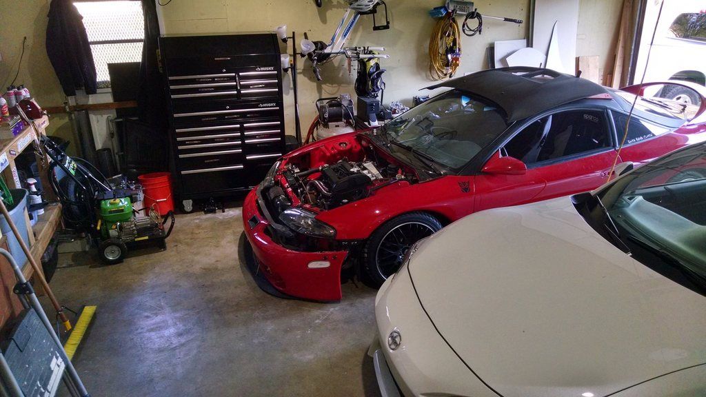

Well cleaned up the man cave with a new tool box which greatly improved my work space! During the process I pulled the car out of the garage and she spun the P/S belt. I ignored the directions on the jays racing alt relocation and didn't bend the P/S bracket hoping I wouldn't have to, guess thats outta the question! Once I clean that little detail up she will be road worthy again! Anyway, here is the current state of affairs:

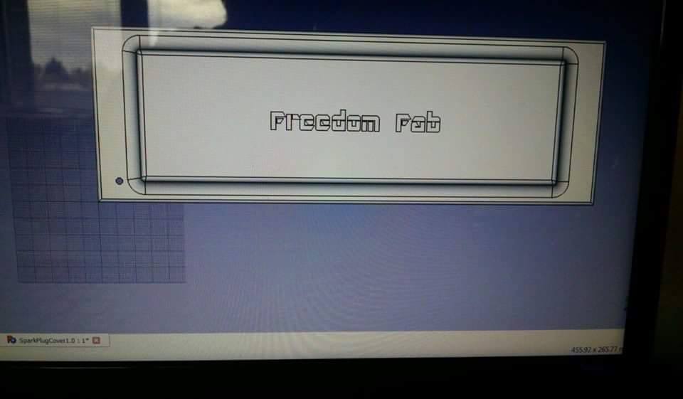

Next we will be tackling the lighting and the lack of plug ins in my work space. I have a new tabletop CNC on the way and I need to get ready for it. Also have this to install:

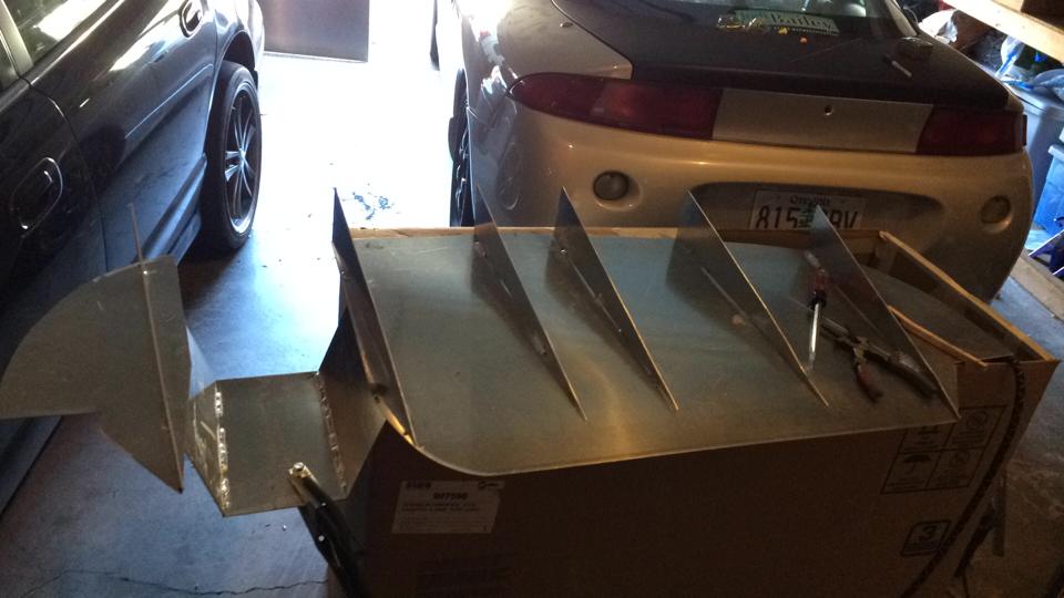

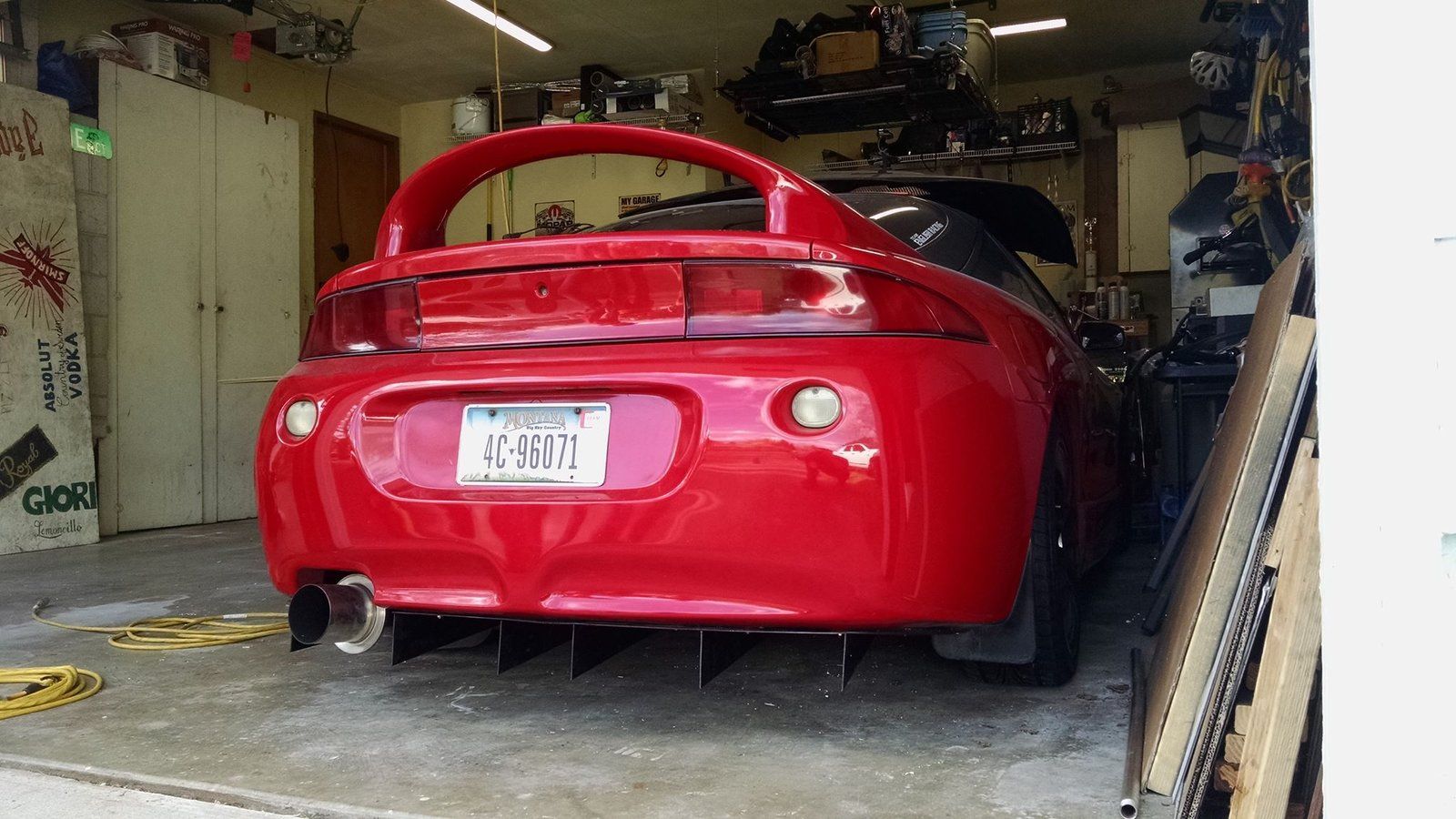

Some of the latest fun shown in the enclosed pictures. Got the diffuser on and painted and I have started designing parts for the table top CNC I ordered which is due for arrival the end of this month if the schedule holds! Enjoy!
