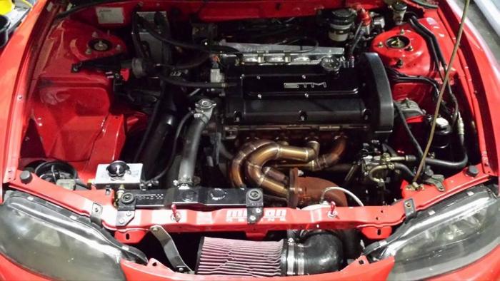

Currently away on a work trip but a quick update: Car started running rich by a whole point (from 11.5 to 10.5) at wot and I've even seen it rich at idle. A little baffled, from my initial boost leak test I've found a leak somewhere at the head to intake mani connection, not sure if this could cause these types off issues on sd. Thoughts? I already tested the e85 content and it's nuts on.
As for power, once I figure out the above issue, I'm going to a ebc to try and hold boost better up top and I'm gonna open up the tial wastegates and put some stiffer springs in. Not sure on what's currently installed but I think a lower boost spring set could be causing my lower than expected power numbers? Thoughts?
I'll keep you updated, keep your ideas rolling, I need some sd tuning theory know how in here for sure!
No I've got the iat and map sensor both. Keep in mind the car was ran for roughly 1000 miles prior to this afr issue too.
Intake manifold is off, waiting on STM to get my new heat barrier gasket out the door. Found two of the manifold to head bolts were loose and there was e85 'black goo' seeping out under the gasket, I think it is safe to say there was a leak there. Ill post back when she is back together and we have a new BLT done.

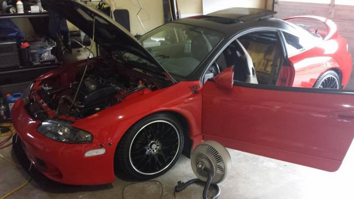

Took the car and did some hardcore cleaning on her. This is what a quick wash, claybar, and wax can do. I forgot that she could still look half decent. Ill try and get some more pics of her at the Red Door Meet (count was +300 cars that night). She was parked on a little slant which gave me less than a finger width between the pavement and the bottom of the new lip, sexy pic IMO! Anyway, found out that she has a decent fuel leak from the O-ring that the fuel sender is sealed with, new one should be here tomorrow. :thumb:

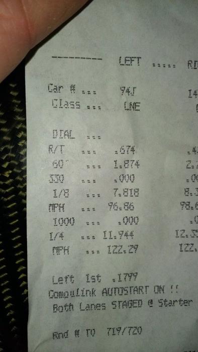

Here is the timeslip, got more work to do but I am pretty satisfied! Get a few more kinks worked out and go back for more! LOL
