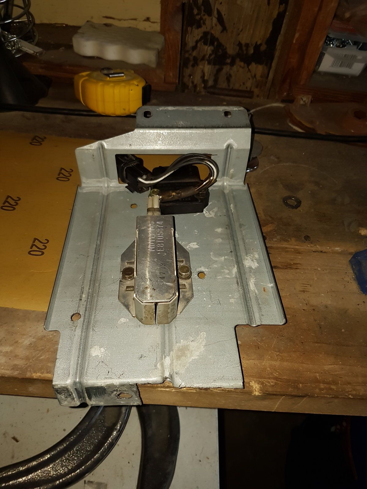

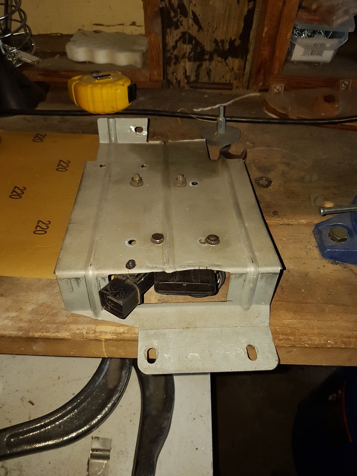

Here is what i did today. Put in haness that goes on car. Came out nice. My noise condenser, power transistor and the other sensor in pic i know just cant think at moment. These are all on the tcu bracket for a auto. Had to modify a bit but its a race car. More work coming soon

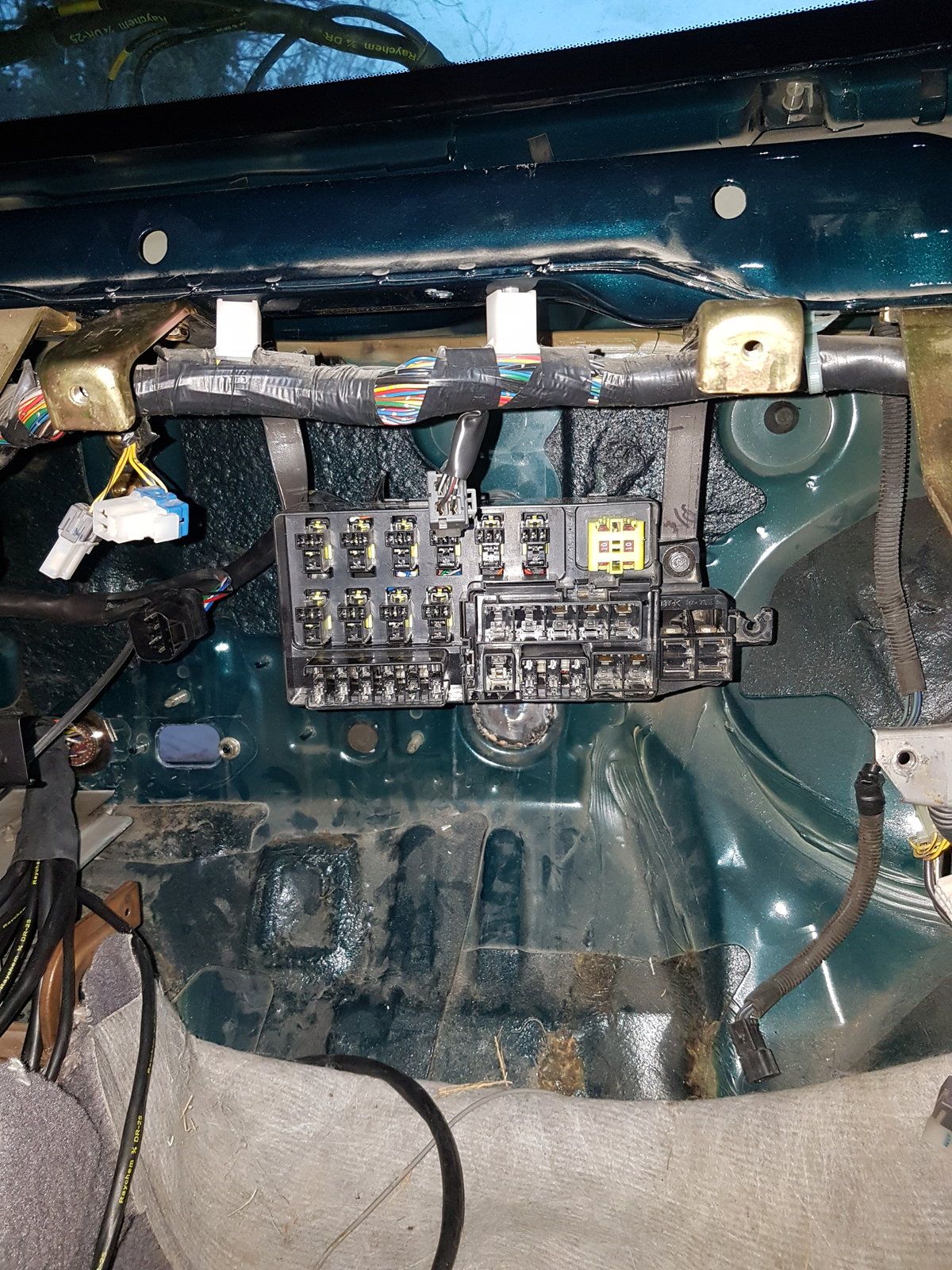

Ok got some parts coming for rack to finish up. Then need to paint trunk area were battery box is going. Also need some input on a this. I got some amplifier wires that i can use for battery relocation but not sure if i should use them or get new wires. Input and any opinions would be great. Thanks
Ok decided to replace all wires i need for fuse box relocation. 0 gauge wire so been looking havent found anything. Let me know what you guys have went with. Links to wires help thanks.

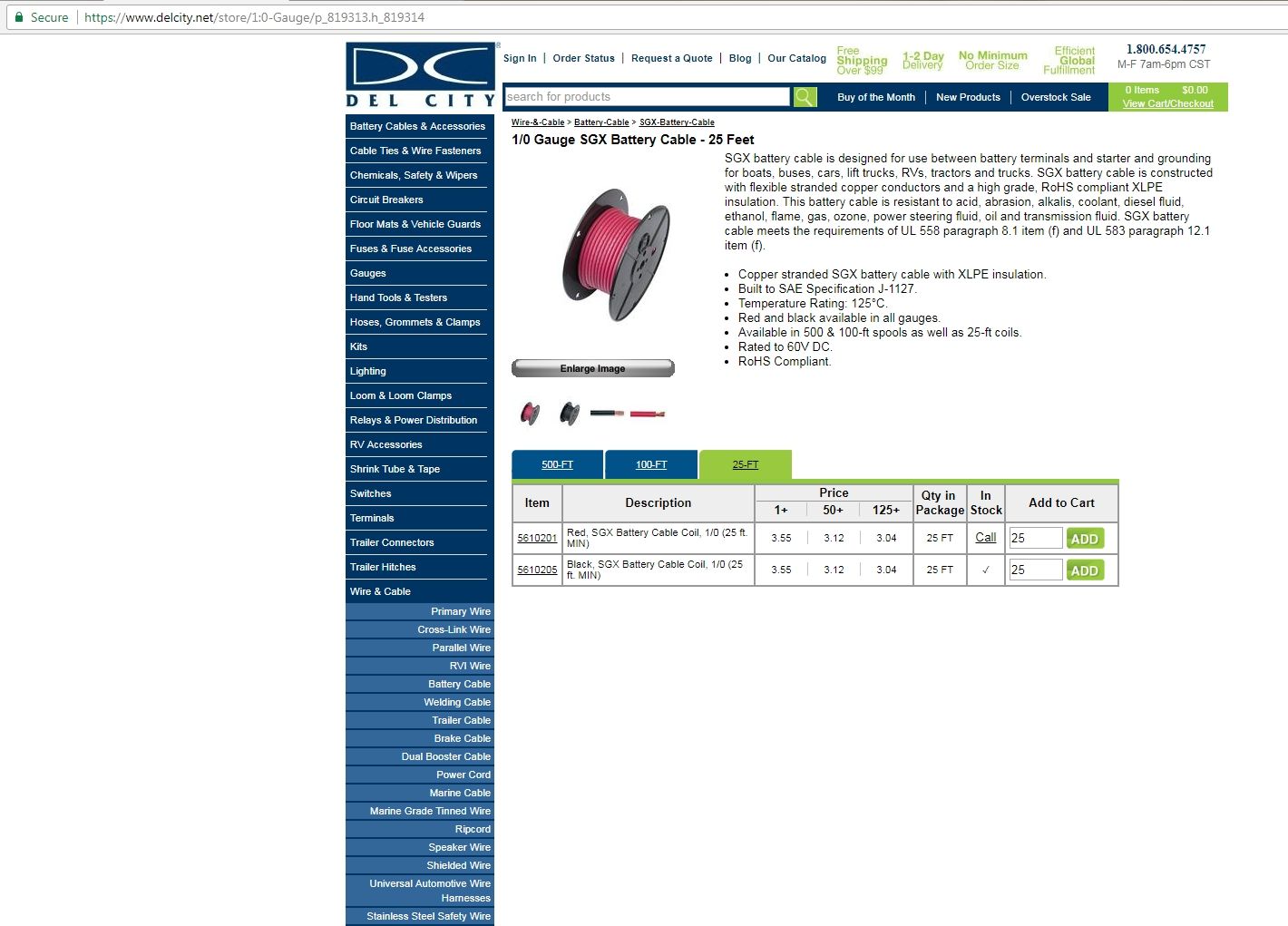

If it turns out you need to order, and you are going to get 25 feet or more, you can get actual automotive battery cable from Del City in 25 foot coils. I've noticed that automotive battery cable and engine compartment wire always meets SAE J-1127. This stuff meets that and is rated to 125 deg C for temperature. It's $3.55 per foot and they charge $10 for shipping. Not cheap but for sure it's the good stuff.
I don't think you would need 25 feet for a single run though. Totally depends on how you route it of course. I haven't measured it, but 25 feet might be enough for 2 runs. I'm sort of wild-guessing 10 to 12 feet for a single run, would be good to measure before buying!
