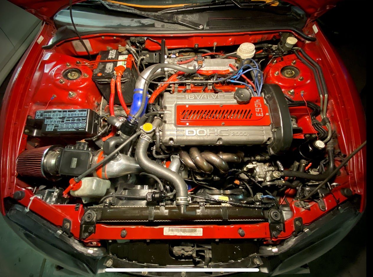

Big Issues:
  • The car has a pretty bad oil leak on the oil sending unit... I believe.
  • The battery needs replaced, it sat over the cold winter with it connected. I knew this had to be done beforehand, just an oversight.
  • The car idles rough, this is due to having a 98 DSM ECU connected with no tune.

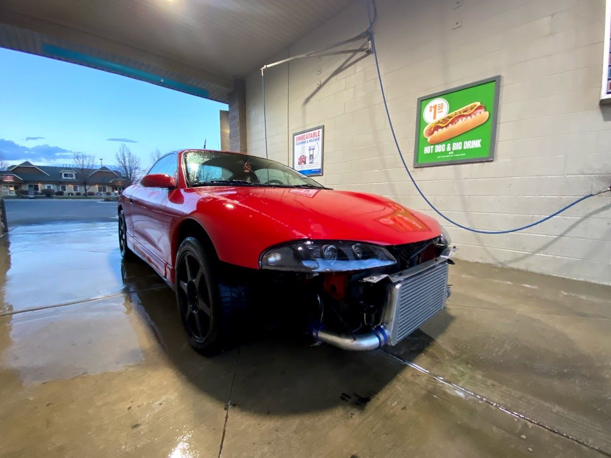

  • The vehicle overheats after a while and especially when cruising.
  • There is an exhaust leak post-cat because an exhaust clamp is what connects the cat to the catback.
  • The turbo MBC doesn't work... or the vacuum pipe has a leak.

My Plan:
  1. All new OEM gaskets kit on the timing side of the vehicle. I don't want it to leak anymore and hopefully this resolves the issue.
  2. Replace the battery.
  3. Place in my stock ECU for now.
  4. Fab up some ducting to force more air to the radiator since I have a punishment FMIC throwing the air all over the place. This should help.
  5. Reduce engine bay heat by wrapping my turbo exhaust manifold as well as a turbo blanket.
  6. Weld flanges on the downpipe, cat, and a new 3" catback exhaust for a proper exhaust.
  7. Replace the piping to the MBC and replace the MBC with a nice unit.
  8. Get the front bumper fitting correctly. My two ideas are somehow get the stripped bolt back out of the thread or cut off the bracket and weld a new custom one on. Fab up some bolt-on brackets to hold up the front bumper correctly to prevent sagging.
  9. Get plugs either made by my friend with his 3D printer or find some online.
  10. Bring my car to my buddy's detail shop and have him remove all the oil junk from under the car. Have his team clean up the interior too.
  11. New pins for the driver-side side skirt.
  12. New fluids.
  13. New door for driver side.
  14. Replace hatchback struts.
  15. Get my spoiler wrapped and put on and re-wrap all sections of the vehicle that look bad.
This is my plan to get it back in commission. I will update more when I've made some good progress. Thanks for reading and please reach out if you have any tips for the steps I am taking.
