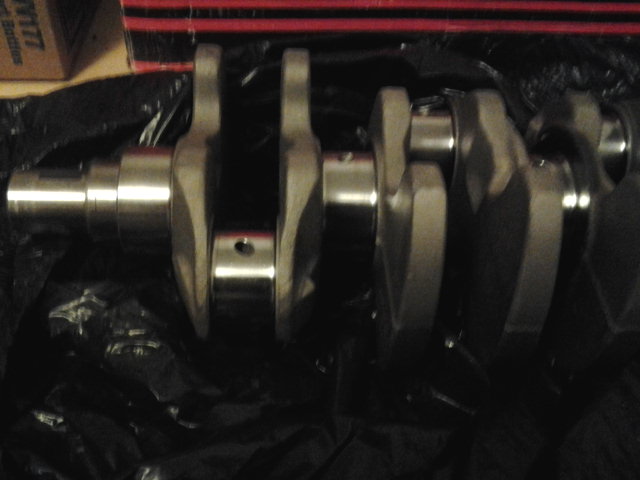

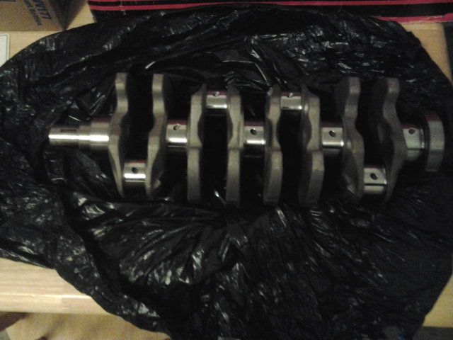

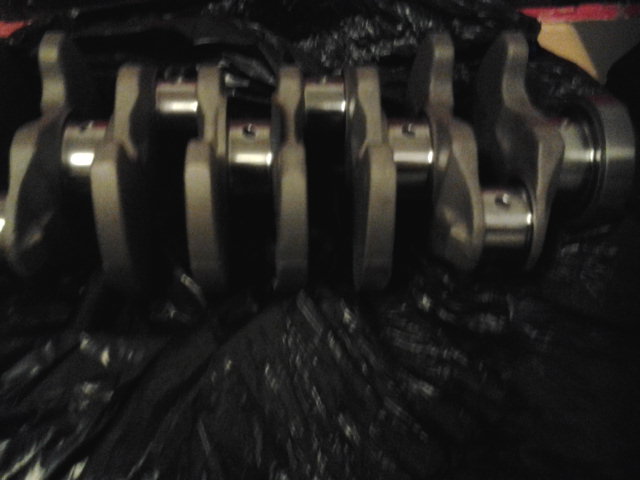

This is the crank i got. It is a 2.3 stroker 100mm Manley crank.

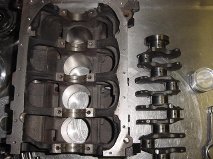

Update. These are the newest pictures of my 2.3 stroker.:thumb:. Jacks Transmission is the one that did all the machine work and put it together. Thanks Jacks.:hellyeah:. They took the pictures of the engine going together for me thanks Jack.:thumb:.
100mm OEM crank
Manley H beam rods/with ARP-2000
Wiseco Forged 2.3 Pistons
BSE kit
Oil pump with straight cut gears
ARP main studs

It would be cool if you could post a full resolution (big) version of that one picture you have above, because it would show where the wrist pin goes relative to the oil ring groove and skirt and so-forth. I'll post a copy of the one I mean below.
The crank is a Manley? or is it from like a 4g64 or something?
Cool - Thanks!
That rod chart on the Manley page is a good one. They give "big end width" which is something I've been wondering about. Here you can see that the 6 bolt and 7 bolt have different big end width.
The piston compression height I see is 1.130 inches. There are some good closeup pictures of Wiseco pistons with that compression height on the English Racing web site, so I think yours will look the same as far as how the pin bore goes into the oil ring groove and so-forth. That is the CH they use with 153mm rods and 94mm stroke in 4g63 builds that come out to about 2.16 liters, which is a way I might go. They think the 1.130 CH is OK, and I think that's about as far up as I would want the pin to go. Some of the 100mm stroke builds use a CH less than that, with longer rods.
