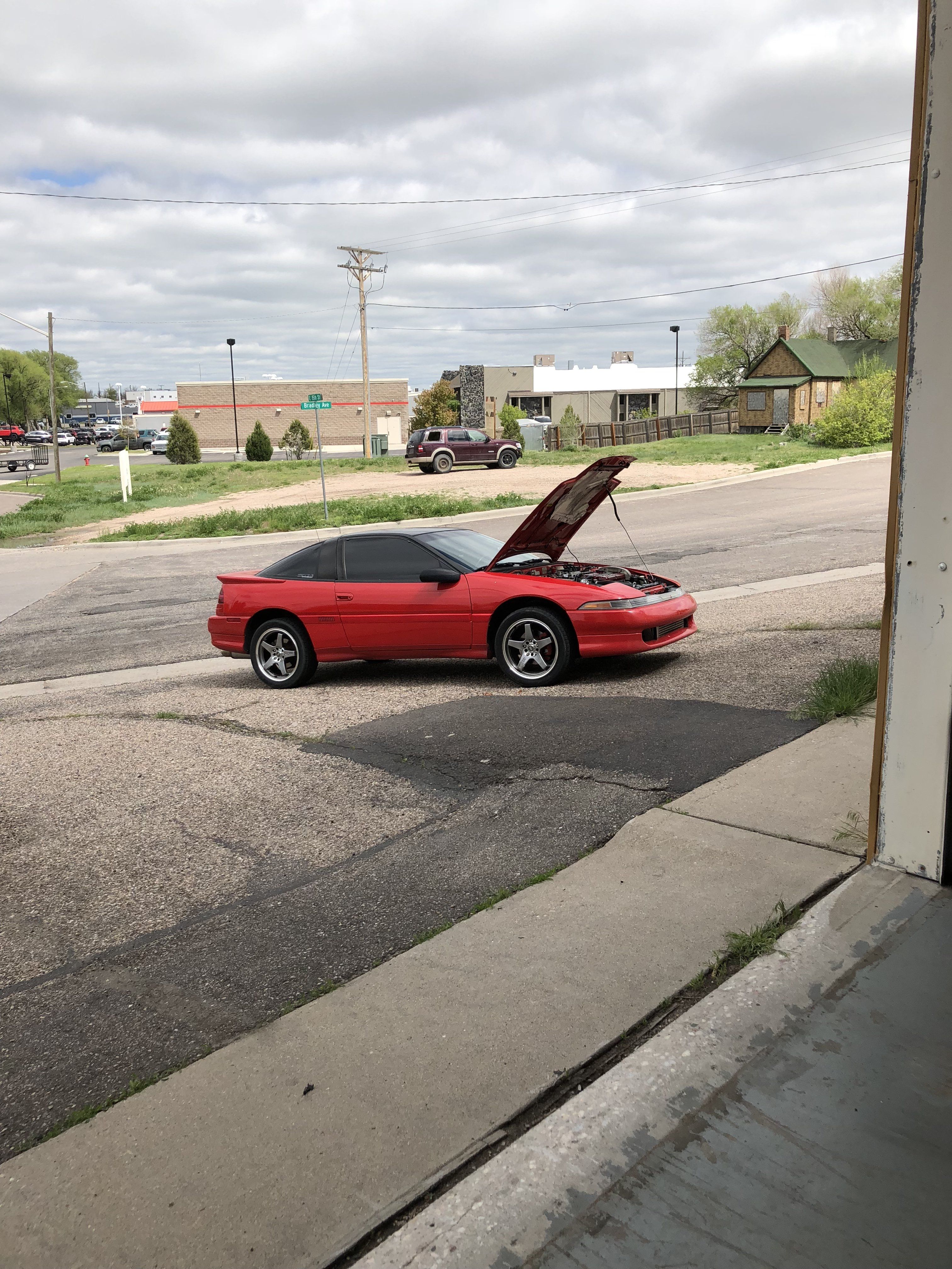

What’s up guys! So I’m not sure where to start, the car RIPS!! I’ve now officially got 75 miles on this new engine/clutch, and yes I’ve been cheating on the break-in LOL. I can’t get over how hard the car pulls on wastegate, which is 27 psi by the way. It’s funny I installed the 3 springs which according to TIAL would produce around 21 psi. Anyways I’ve been slowly inching up my part throttle pulls, dialing in Gobal/Deadtime and smoothing out the VE table. I also still need to calibrate my lc-2 wideband as it reads about .5 richer than what the laptop shows, but again she’s leak free, and PULLS:D. Today I took my coworkers and boss out for a rip and they loved it! Such a good feeling, I feel like I’m finally riding that wave after SO many set backs..well tomorrow I’m going to upload a log for you guys to check out but here’s a few pics.
