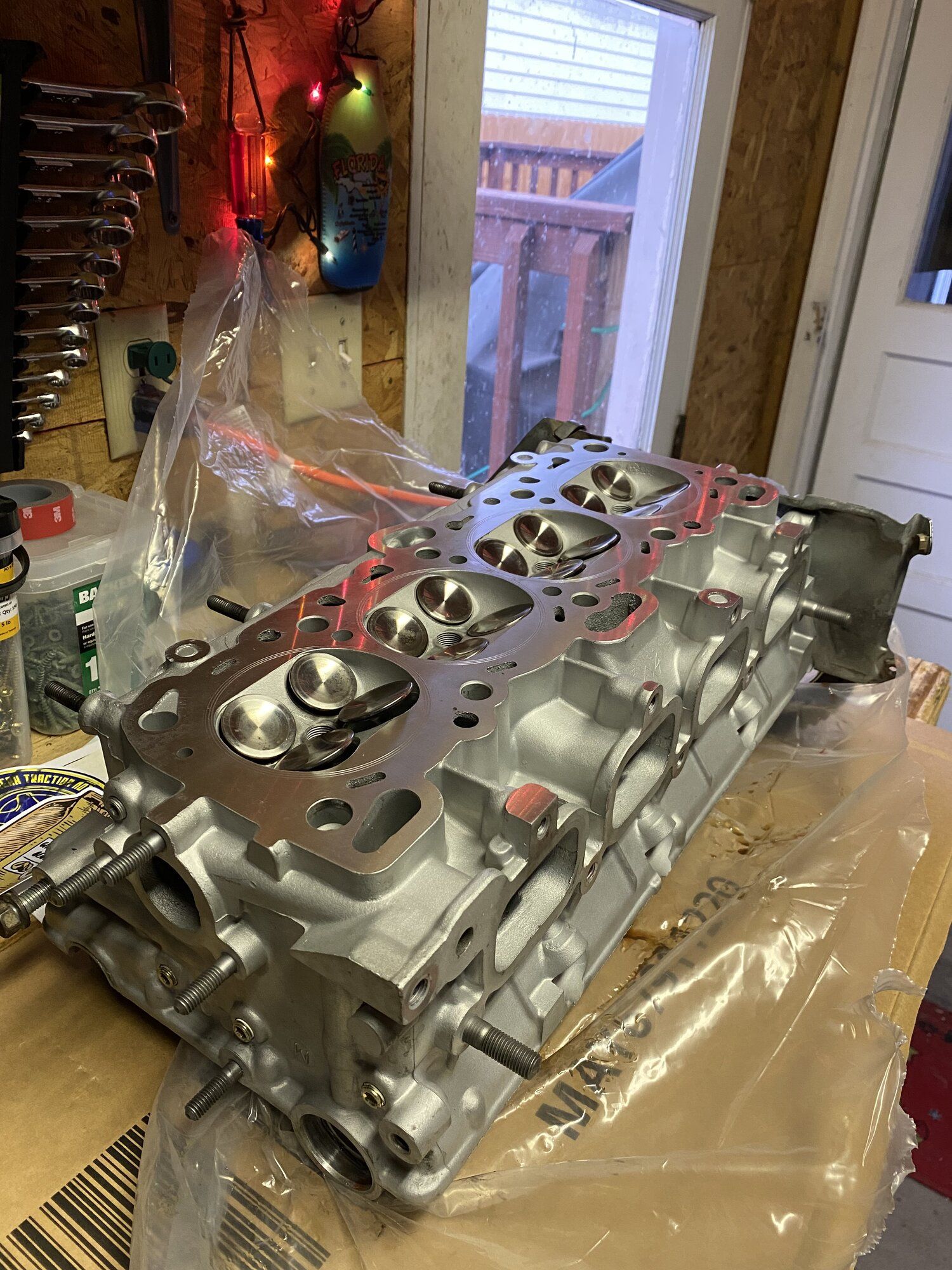

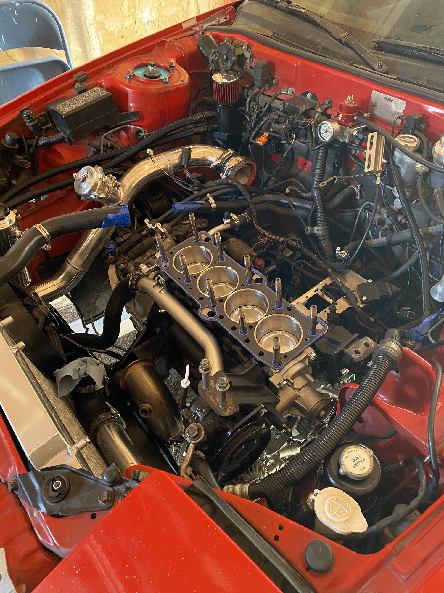

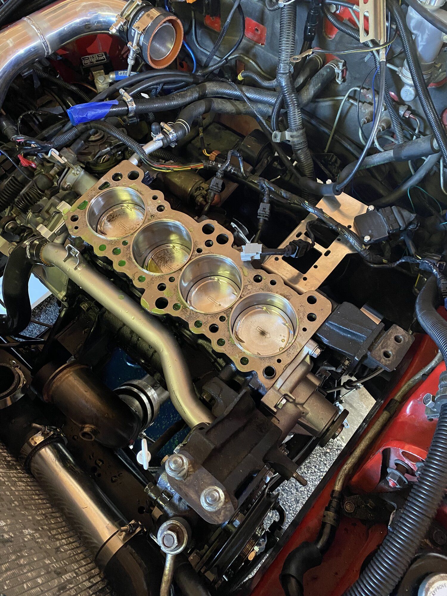

Okay so I’ll try to bring things up to speed, back in October on Halloween actually, I went for her first start and although she started she was running pretty rough and wouldn’t stay idling no matter what, pulled the plugs and the #1 plug looked new still:hmm:. So sure enough a compression test showed 0 compression in that cylinder:banghead:. So the next week I pulled the head and took it back to the machine shop for an inspection.

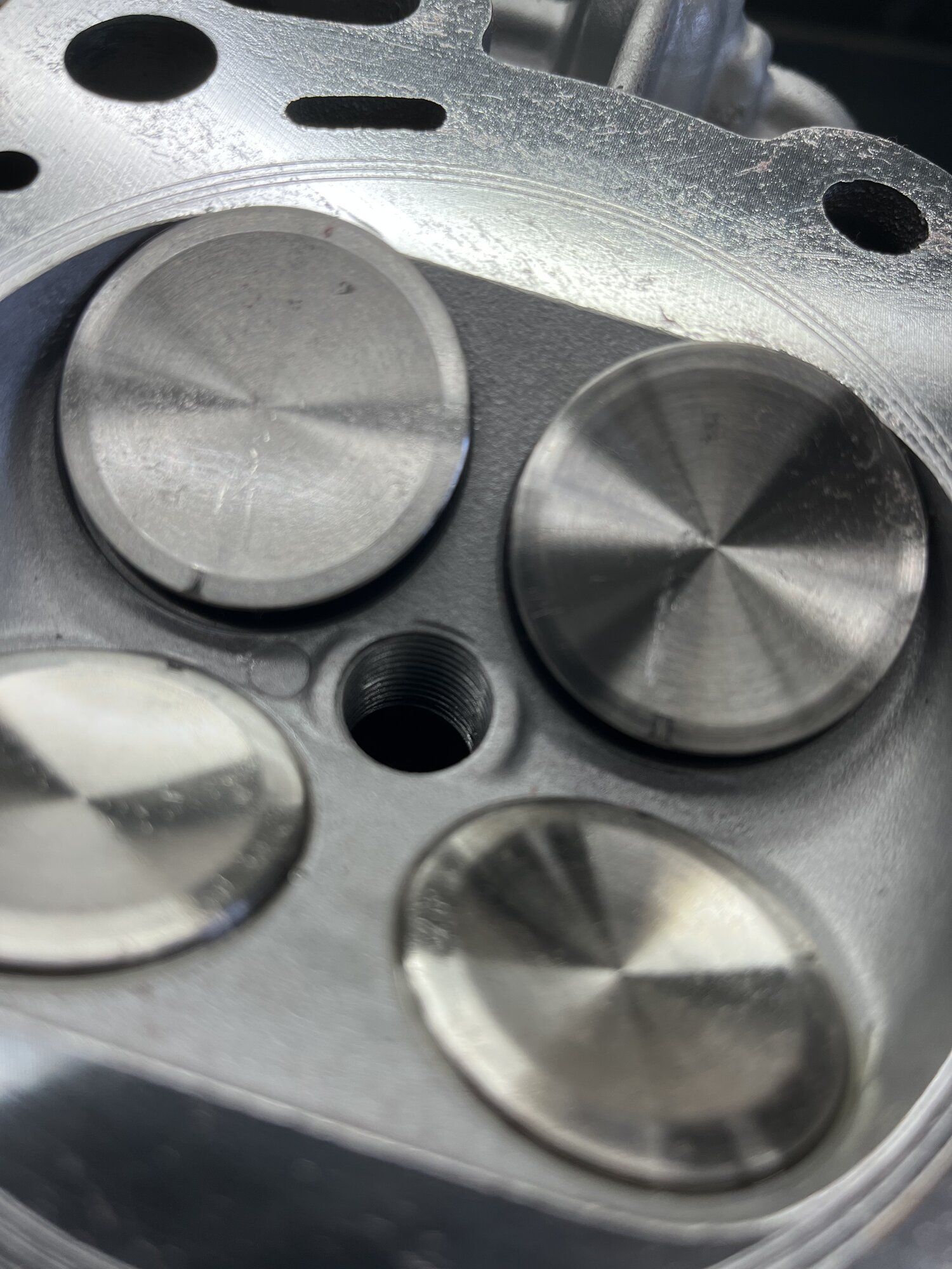

Shortly after they called and let me know I had 2 bent valves
I think what happened was back in April when assembling the long block I had the block timed up with pistons #1 and 4 at tdc, and those 2 valves made contact when I torqued the head down, stupid mistake I know LOL. So fast forward a month later and I get my head back all fixed up.
I went ahead and purchased another head gasket to be safe, as I got a good bit of coolant on the other one when I pulled the head off, the l19’s were stored safely in oil and re used of course.

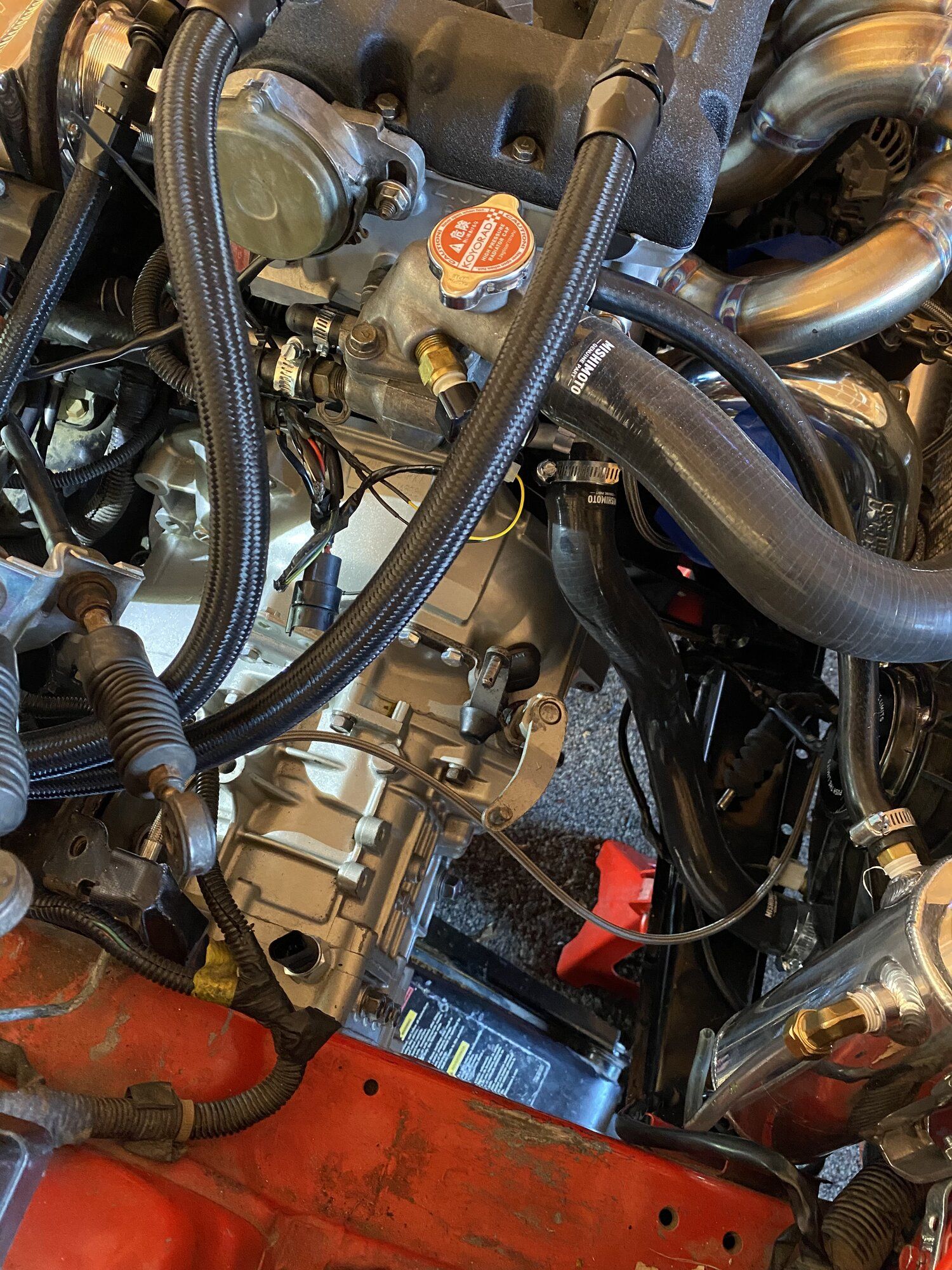

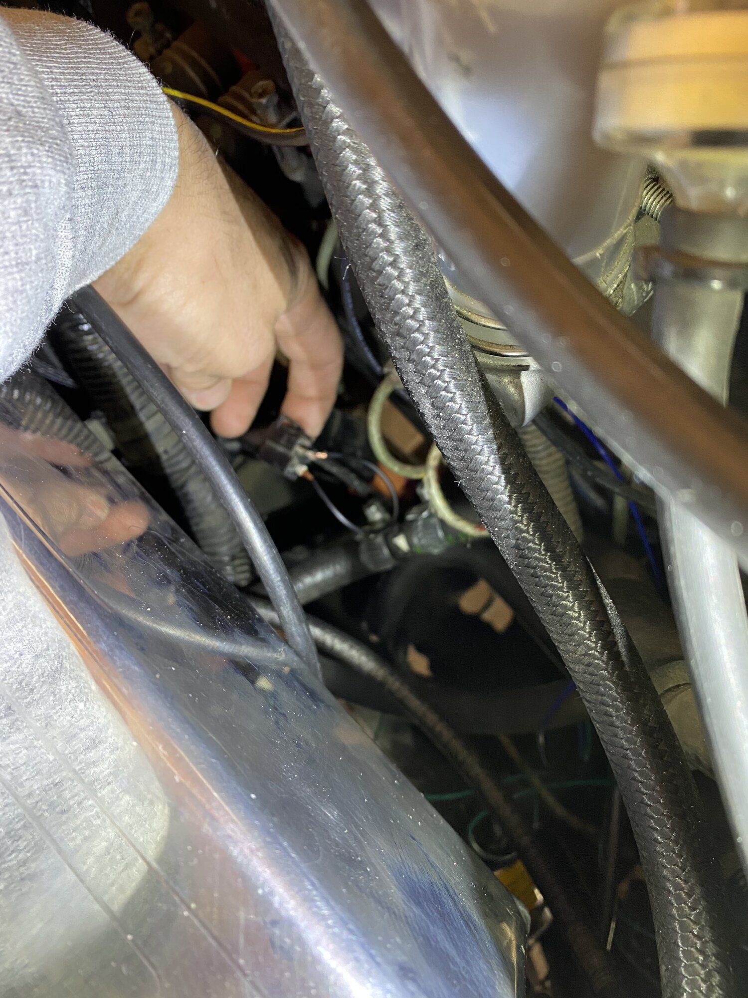

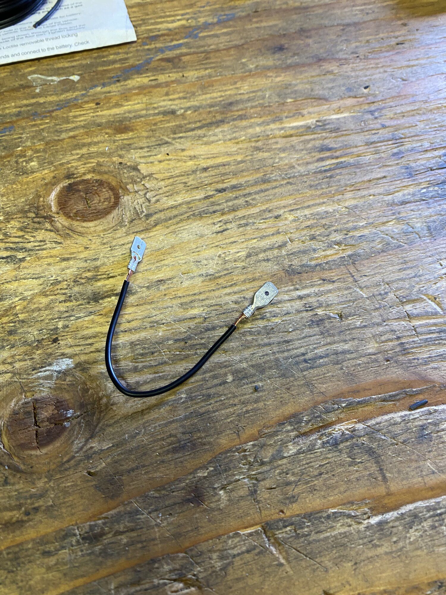

So now she’s back together, and this past Sunday went much better than last time, compression was 155-160 across all cylinders, fired right up and at least idled on her own however, my wideband quit working 20 minutes or so in to idling. My fuel gauge doesn’t work, which I’m sure is a grounding issue with full blown hanger, and the RPM tachometer wasn’t working, and shes leaking oil pretty good on the rear main seal side, so I’m gonna be pulling the trans next week to address that BUTT, no coolant leaks, no fuel leaks, the valve covers not leaking LOL. I DID fix the RPM issue on Monday thx to a great write on this fabulous forum. With my car being a bastard 1990, it apparently had a “noise filter” on the bracket I threw away under the stock intake manifold which is responsible for the tach working. The fix is pretty clever, I basically just made a jumper wire to plug into the noise filter harness and it worked:thumb:
Fixed. So today I’m gonna re locate the lc2 to a downstream location and re calibrate it again and see if it works, if not I guess I guess I’ll replace the sensor. I’m also contemplating a 91-94 FIAV/ISC install on this s90, as the car surges unless I leave a 1-3% throttle adjustment with the stop screw, which idles at like 16-1700 rpm’s pulling a whopping -10in vacuum LOL, so anyways that’s where I’m at, trying to tackle issues 1 at a time, stay tuned:dsm:
Can you or anyone explain the valves being bent while torturing the head? Were the valves not in the correct firing order ?
He probably had cams installed and 2 pistons were at the top of their stroke so when he torqued it torqued it down, it bent the valves. It’s good practice to leave the all the piston down half way in the bore so you don’t have this issue.
That’s exactly what I did the Second go around Tony:thumb:

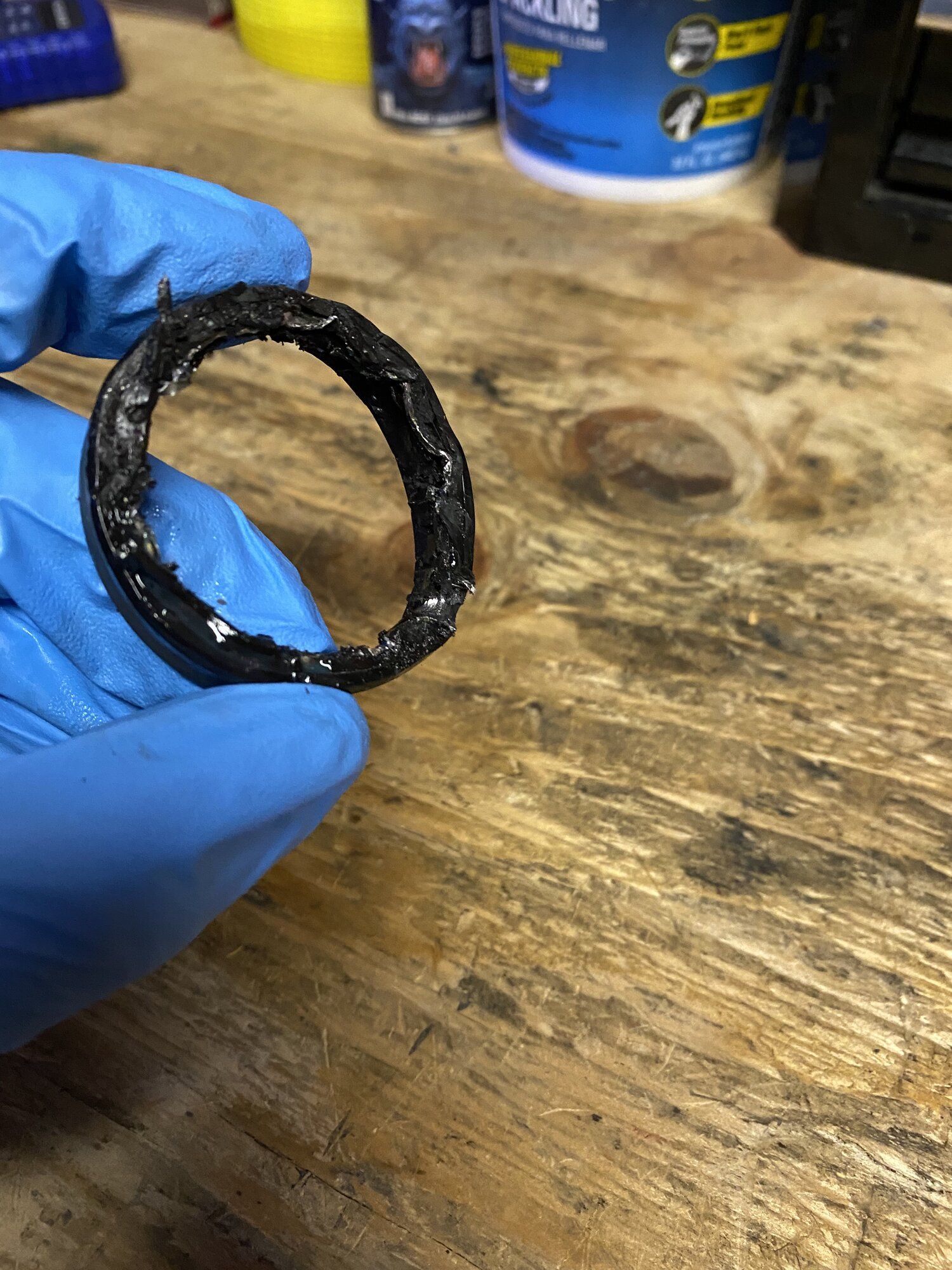

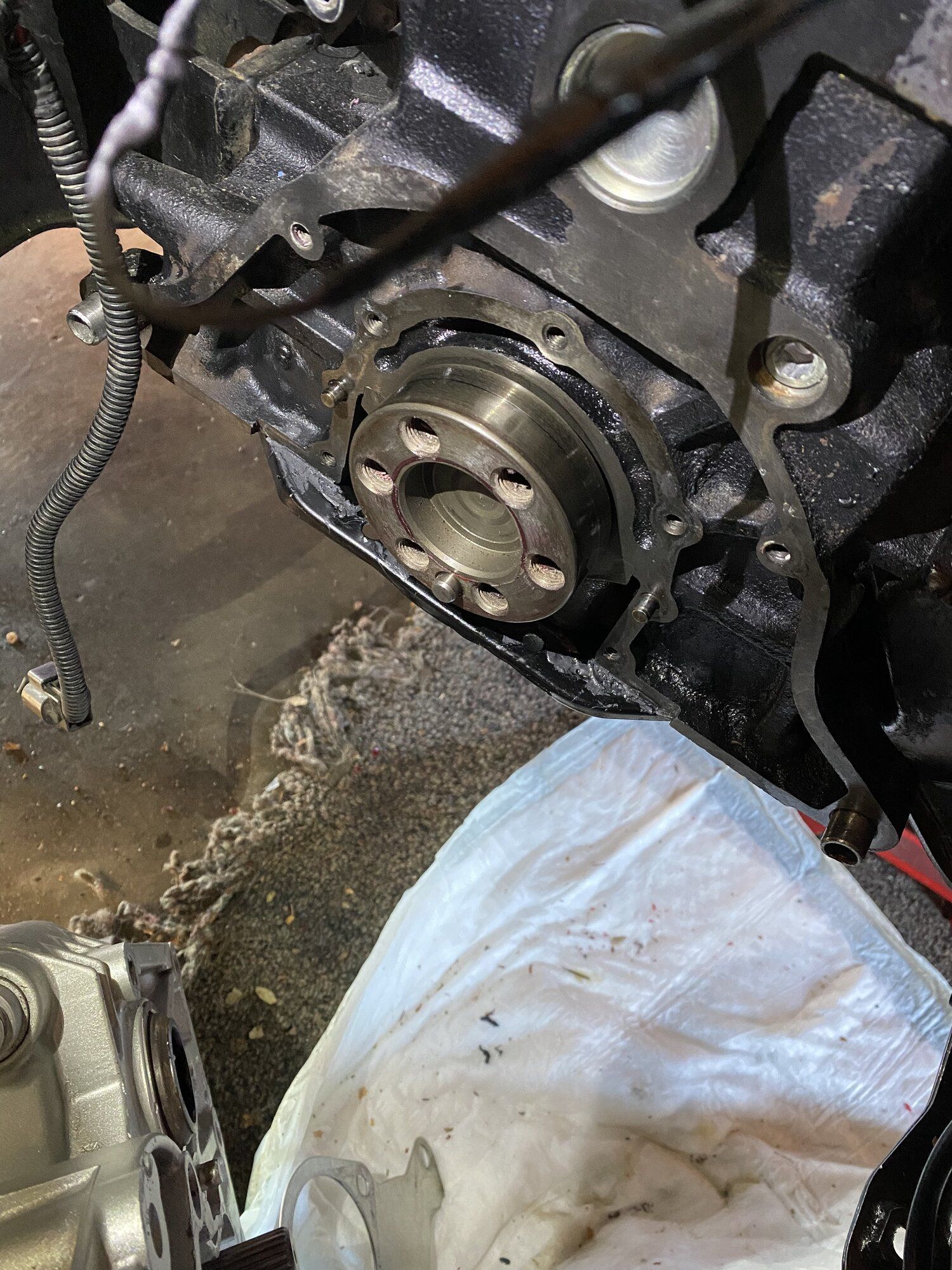

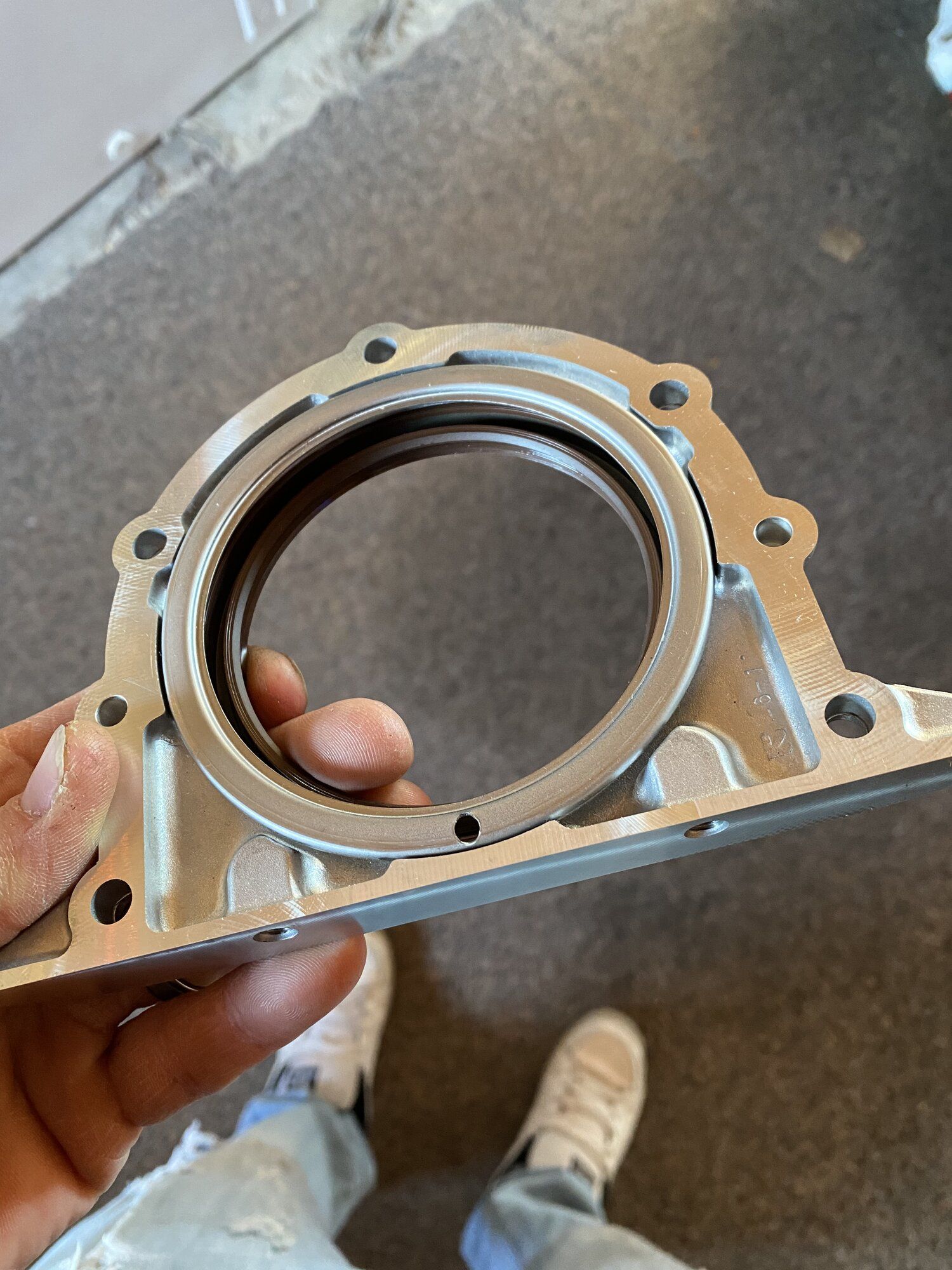

Hey guys! Today was a GOOD day. I finally tackled the trans and got it back on by myself with a floor jack and some patience LOL, I had soo much anxiety on that for some reason, it was my first time stabbing the trans back on with the engine in the car. Anyways so last weekend I got the “fixes” done on my 2 oil leaks that you could see in the last video. I added some Teflon tape to the inline filter and wrenched it a little tighter which will hopefully fix that, and I replaced my rear main housing because the 2 fastener holes were ruined when I cross threaded them the first time LOL
What started this failure was when I had to “modify” the pan with a hammer for it to clear the MainStuds on the Kiggly girdle, these 2 holes were just barely off, the motor/trans were already mated together and in the car, so I tried my best and hoped it wouldn’t leak but here we are LOL
Now to fix this at this point I took a drill bit and bored out the 2 holes a little, dry fitted the new housing to make sure the fasteners would thread in before rtv’ing the pan. I also ran masking tape across the face of the block to prevent any metal from getting into the pan. Everything went good and I got the new housing on nice and tight with a bitchin new seal of rtv:rocks:

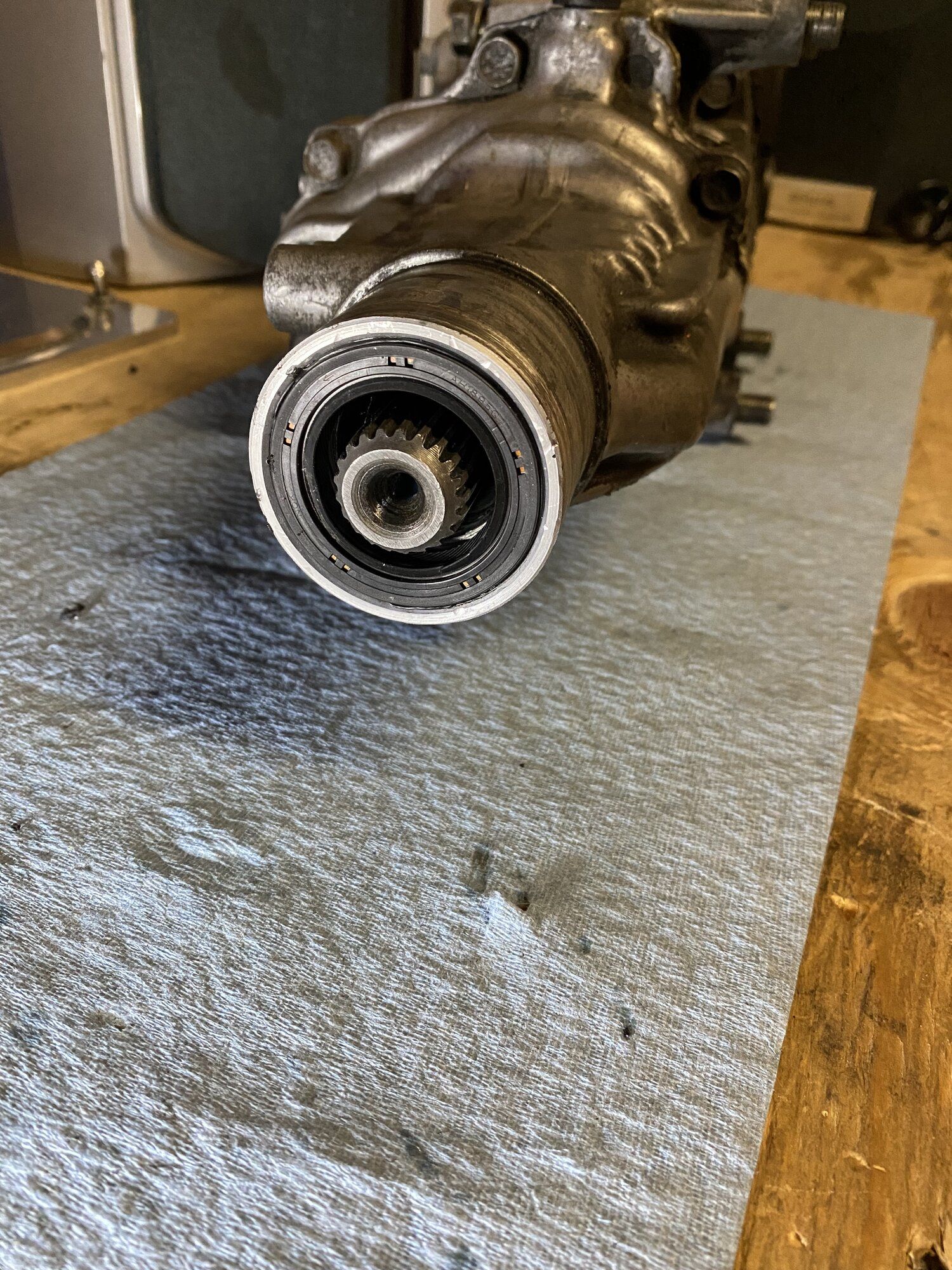

So here’s the trans goin back on! This was one of those moments where I over came self doubt and worry LOL, I know you guys know what I’m talking about, such a good feeling:D And, I also cleared another hurdle today with the stupid transfer case.

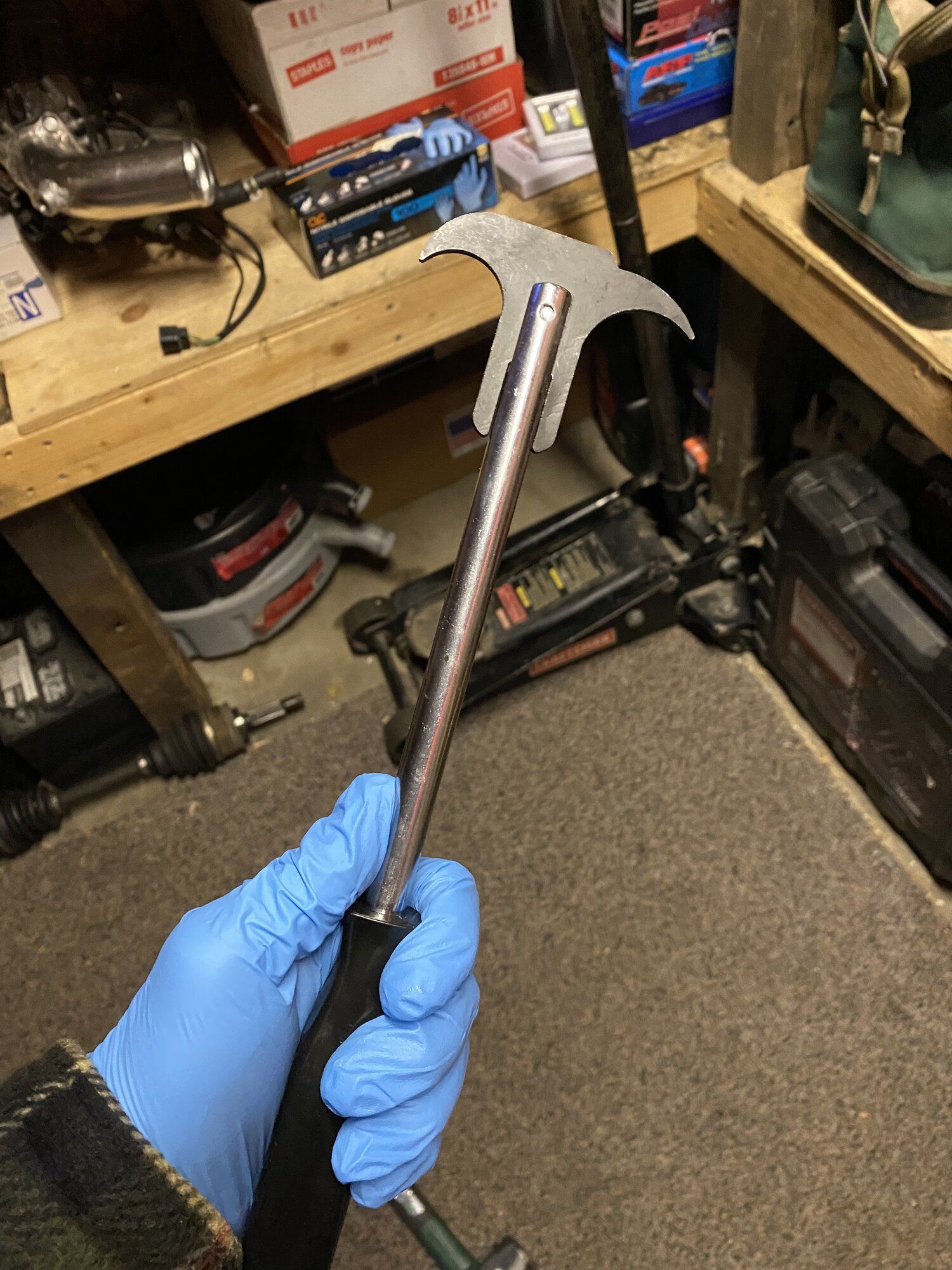

This is the output shaft seal which was leaking lightweight shockproof on the ground while idling, what you see here is the damage I did with a flat head screwdriver and some pliers LOL, after googling other options I found a tool online my local Harbor Freight had for like 8 bucks that worked like a charm.
So once I got this thing inserted with a good bite on the seal, I put the transfer case on the floor, stood on top of it and then wacked the tool with my 4lb pounder and she came right out. That’s when I cracked a beer and turned up the radio:thumb:
