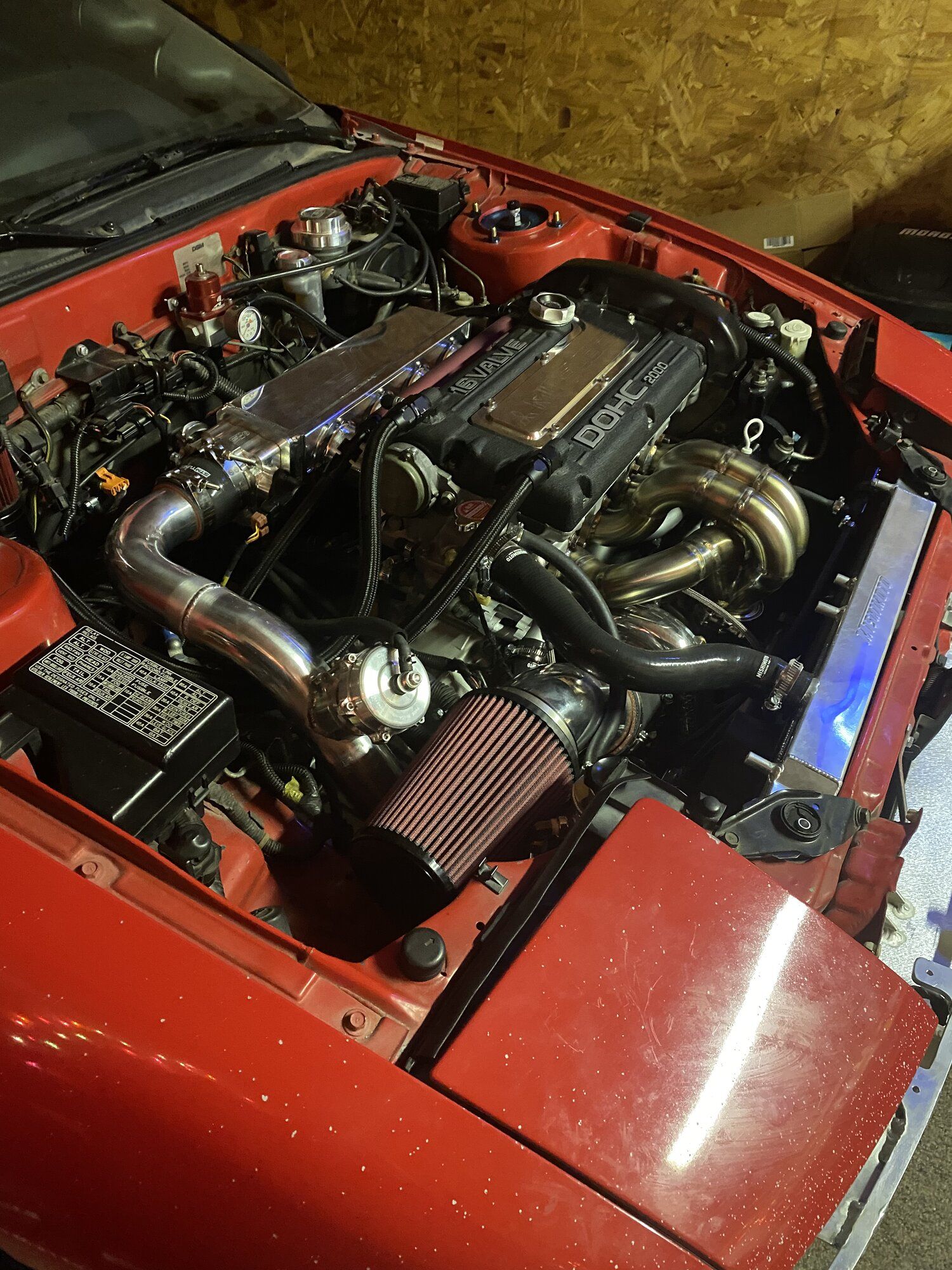

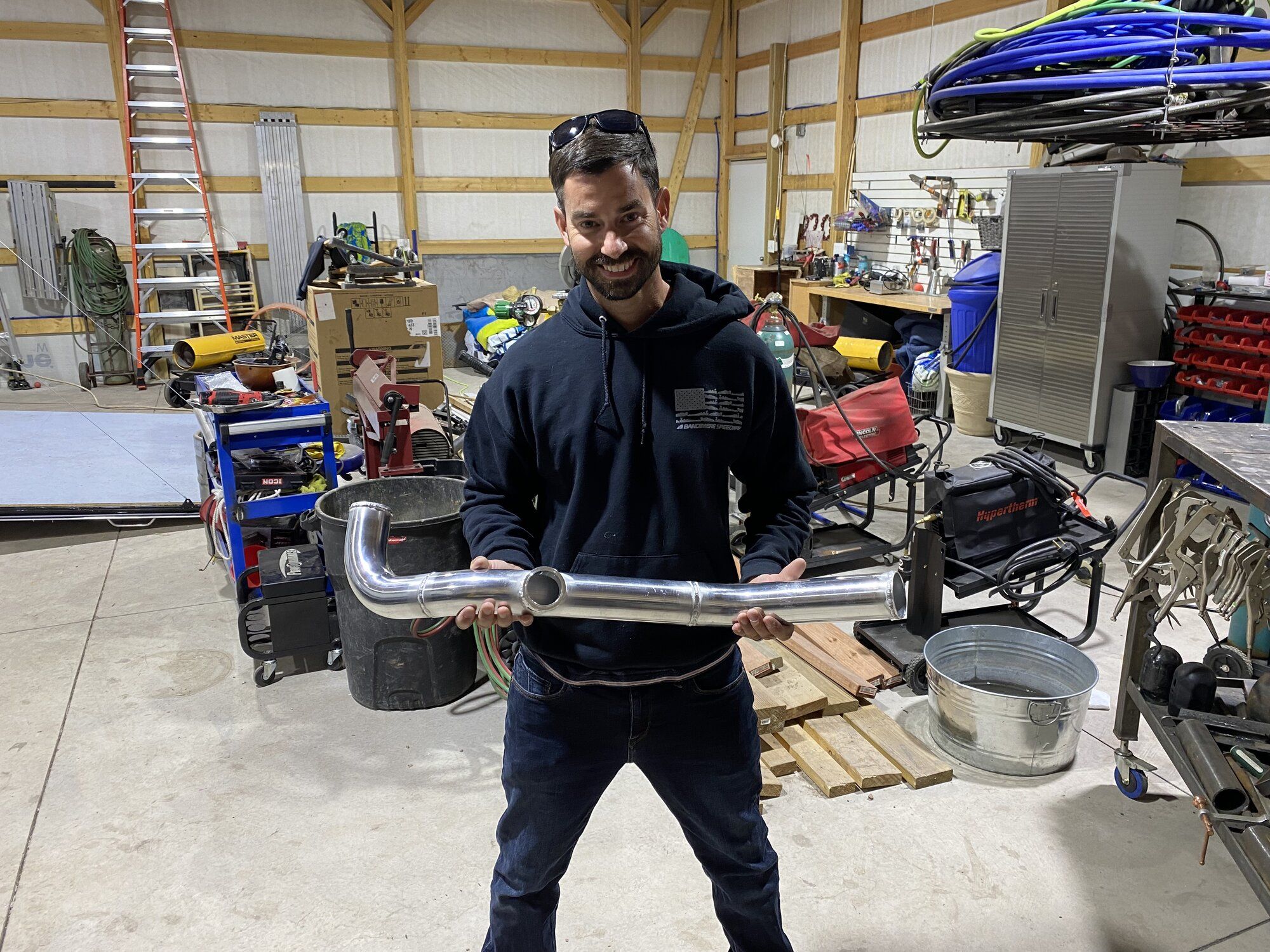

Got’er done! I’m happier than a kid at Christmas LOL, my Boss finished up the welding on the upper intercooler pipe which was the LAST piece of the puzzle.

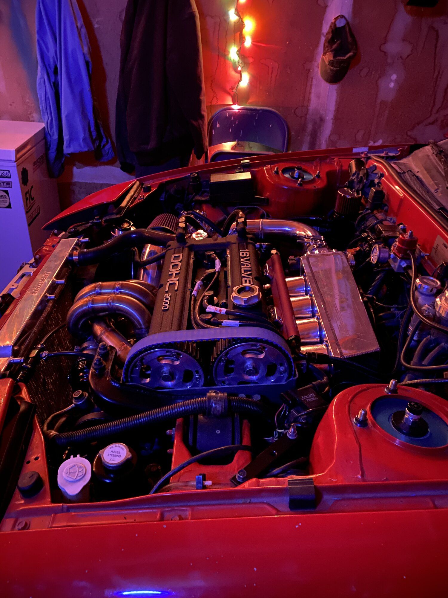

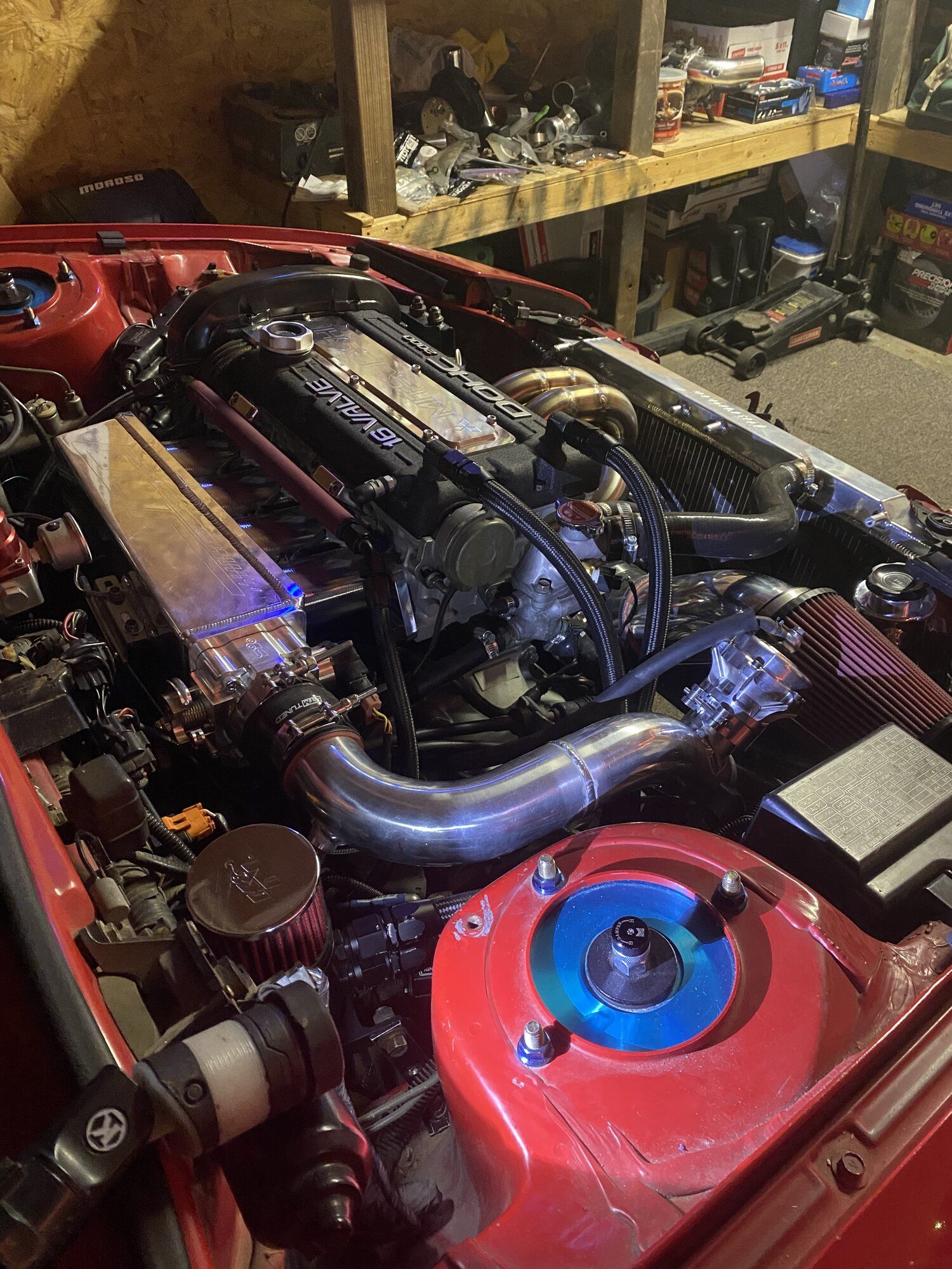

Install wasn’t too bad, had to notch out a little more by the radiator with the ole grinder which I didn’t take pictures of, but you guys know about that LOL, anyways I think it came out nice, it’s so surreal, that this 2 year project is ready to START!
So I hope you guys have enjoyed the build, I know there’s soo many more detailed and much gnarlier builds, but I appreciate the comments and feedback, I’ll post a video of it running tomorrow :rocks: :rocks: :rocks:

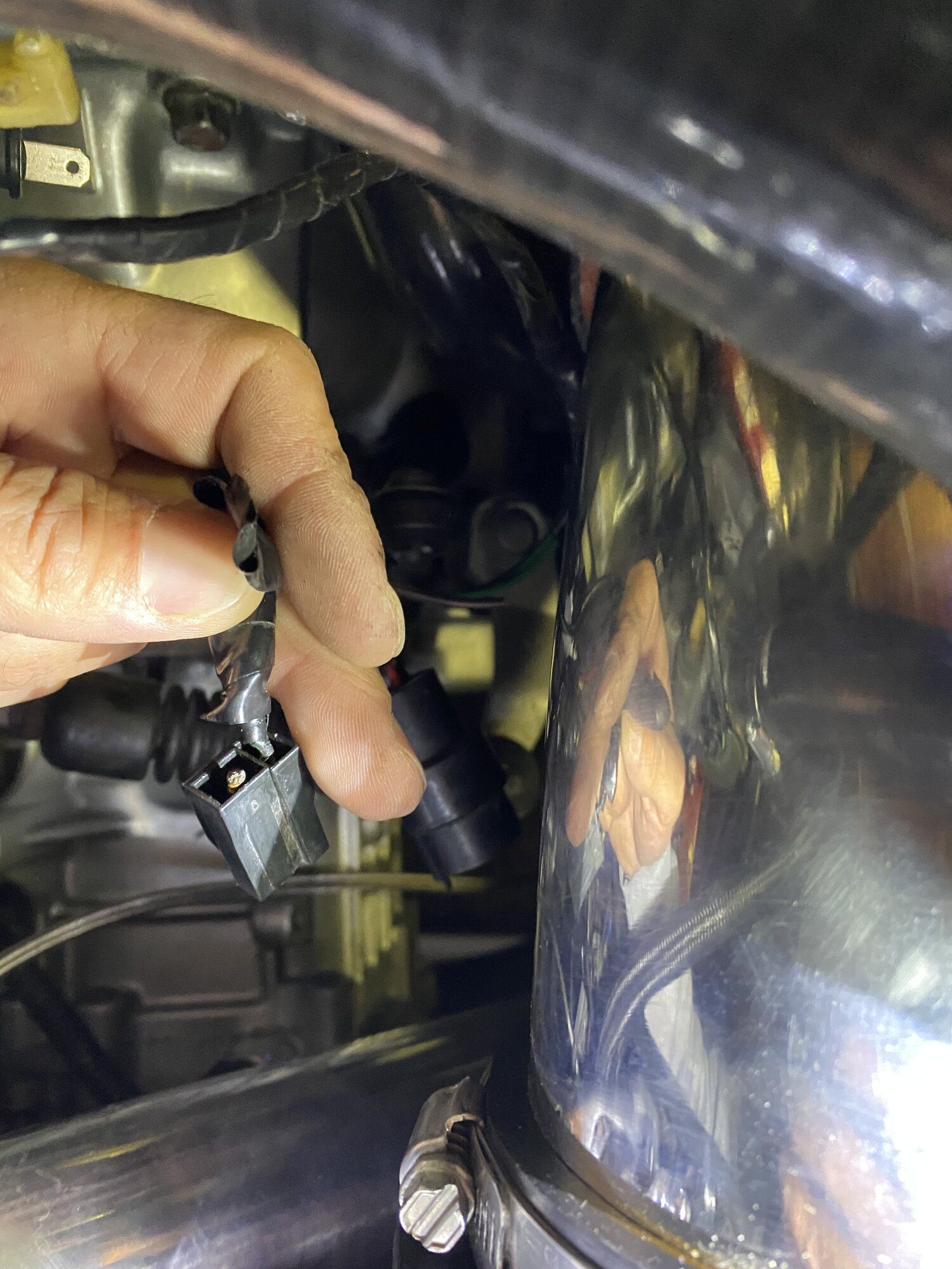

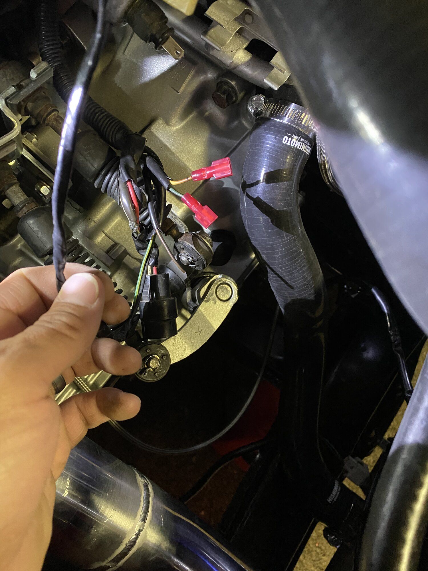

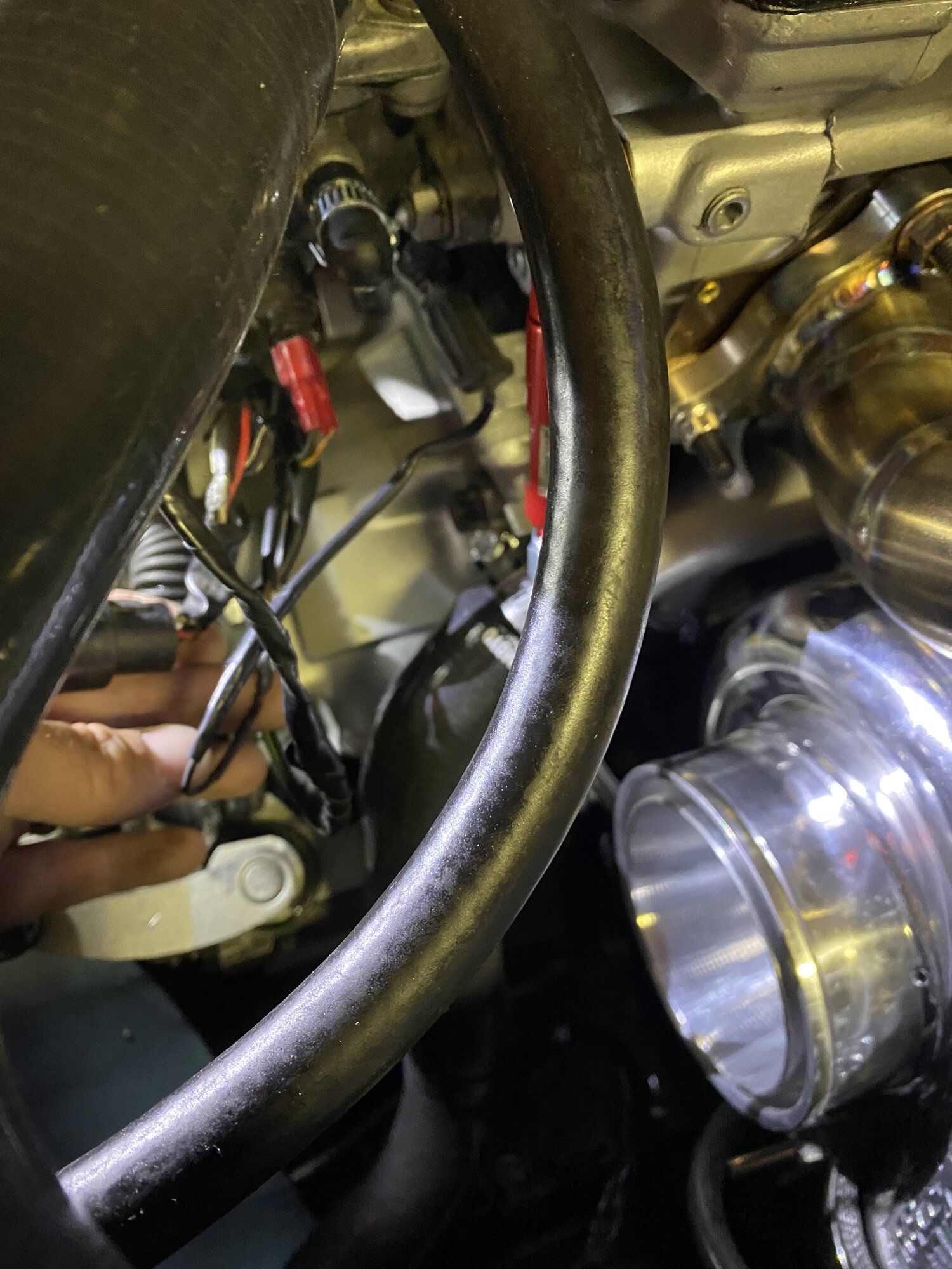

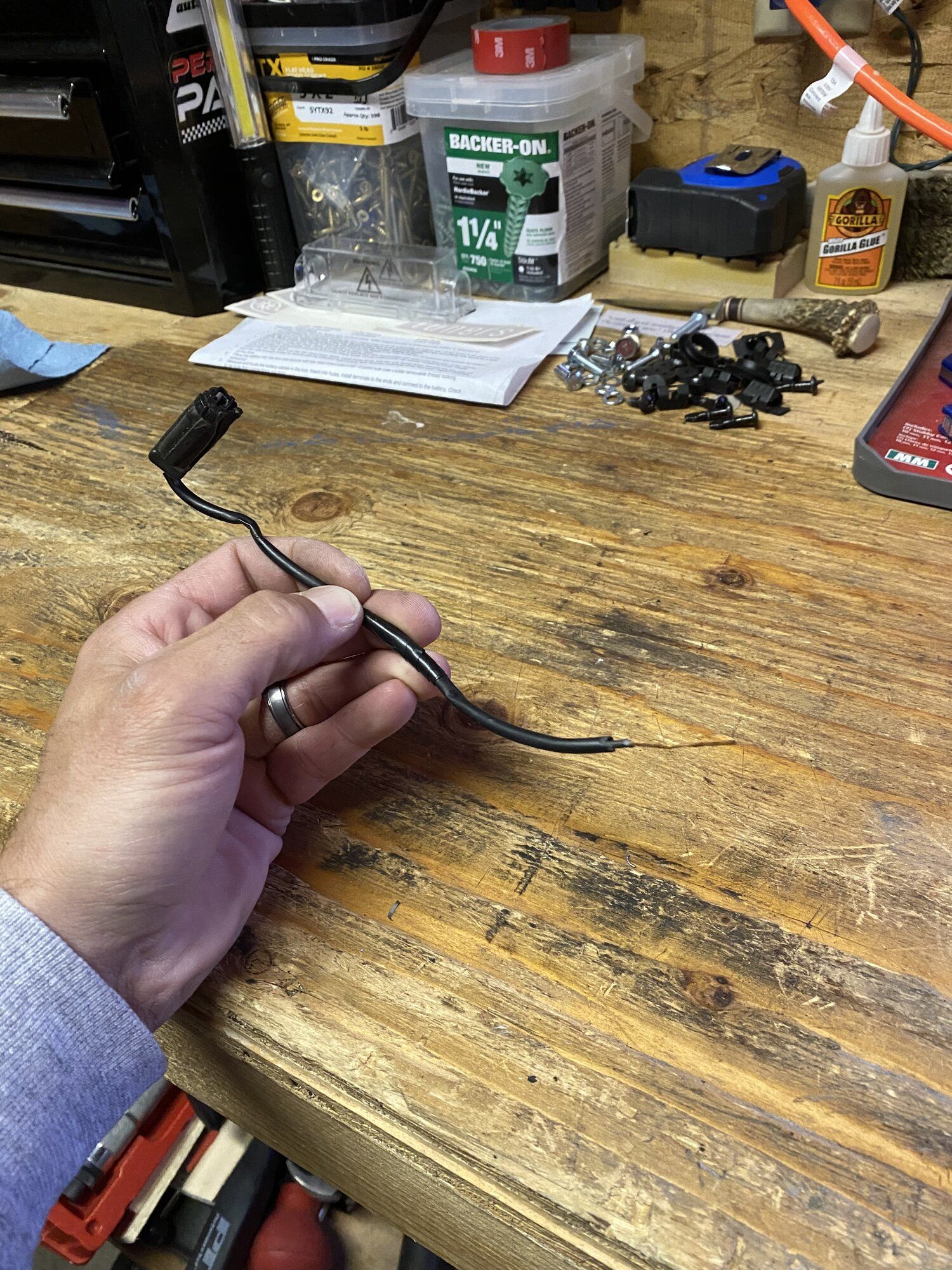

Found my hard start culprit. Severed coolant temp sensor wire, along with a disconnected coolant temp gauge sensor connector LOL. I know I know I don’t deserve this car LOL, these are the overlooked casualties of a 2 year project okay? I’ve since ordered 2 new connector pig tails from OHM-RACING, but in the mean time I’m gonna get a couple female spade connectors for the temp sensor and solder this up for the gauge sensor.
I can’t wait for the pig tails so I’m gonna J-rig these connectors to please the ecu so I can hear this thing idle, top off coolant, and set base timing :rocks:
Hey guys…
Haha F@%k yeah! So far the car hasn’t idled yet cuz it wouldn’t stay running, first start last Sunday it didn’t want to start, I figured well it’s in the low 30’s outside on e85. I then checked codes in ecmlink and it showed coolant temp sensor circuit malfunction, so I checked my coolant temp sensor and sure enough 1 of the 2 wires was severed, so as stated above I ordered a new pigtail. But In the meantime I decided to just get some spade connectors in hopes of getting it to idle.

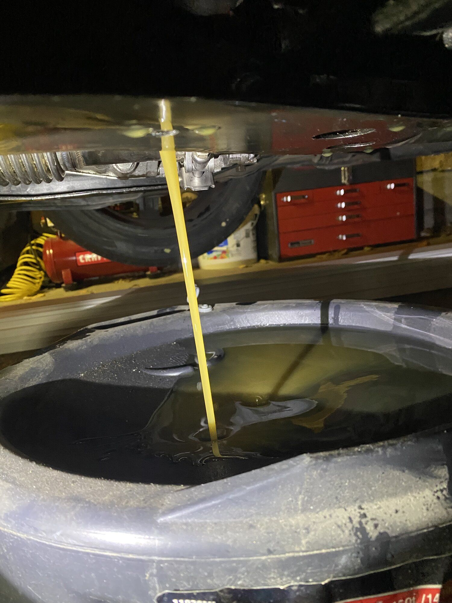

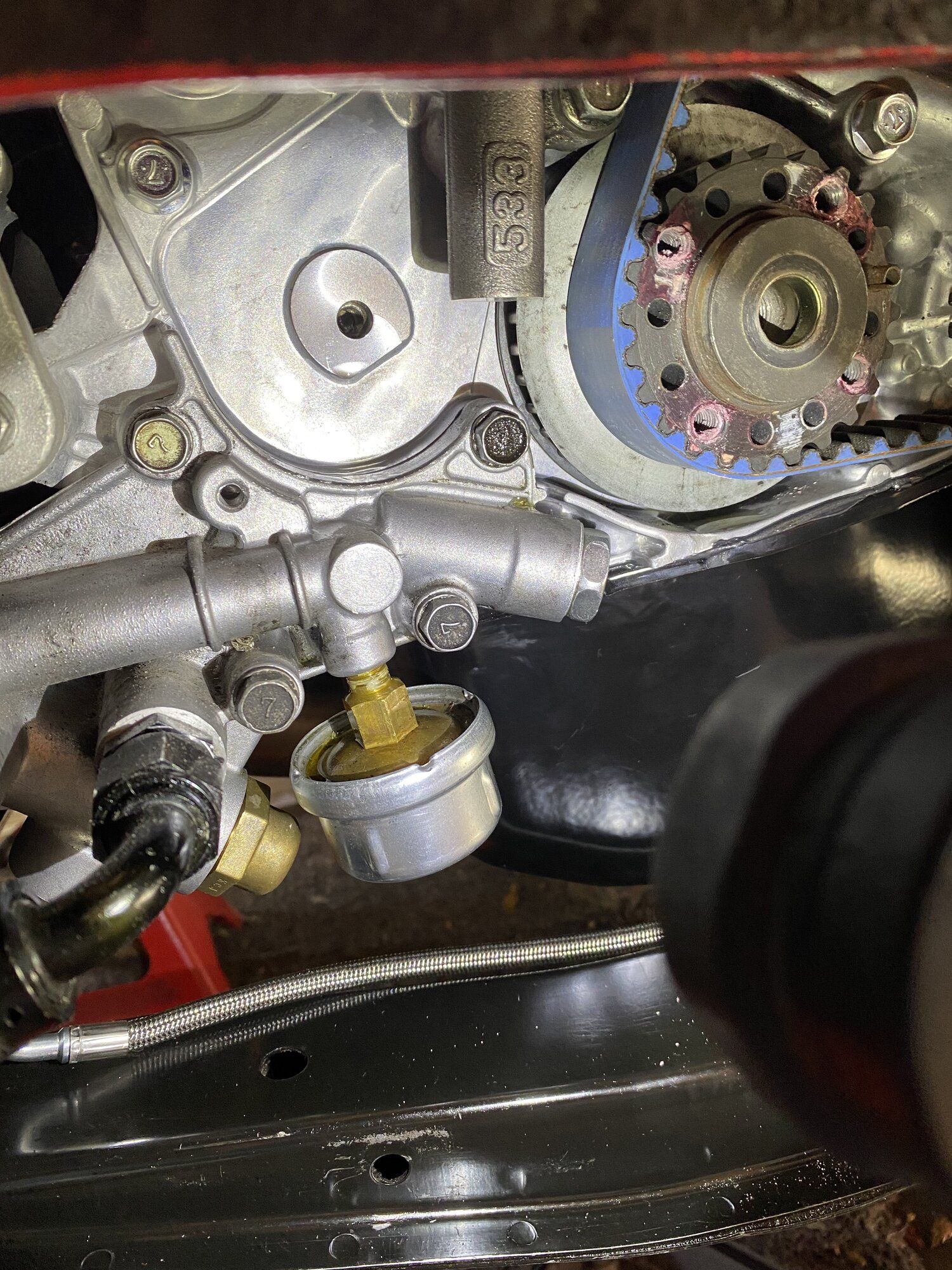

Worked. So this past Wednesday after work I give it another go with high hopes, she fired right up, but still wouldn’t idle on its own, the third time or so I held it steady at 1800 rpms, got coolant temp just over 100 degrees, let off and it died. I decided to take a peak under the car and see oil everywhereOMG. I’m like WTF! I then notice it clearly has coolant or something mixed in so I’m like great! Started drinking and called it a night. The last couple of nights I’ve been brainstorming over the oil leak and the mix, after looking thru old build photos I discovered the leak.

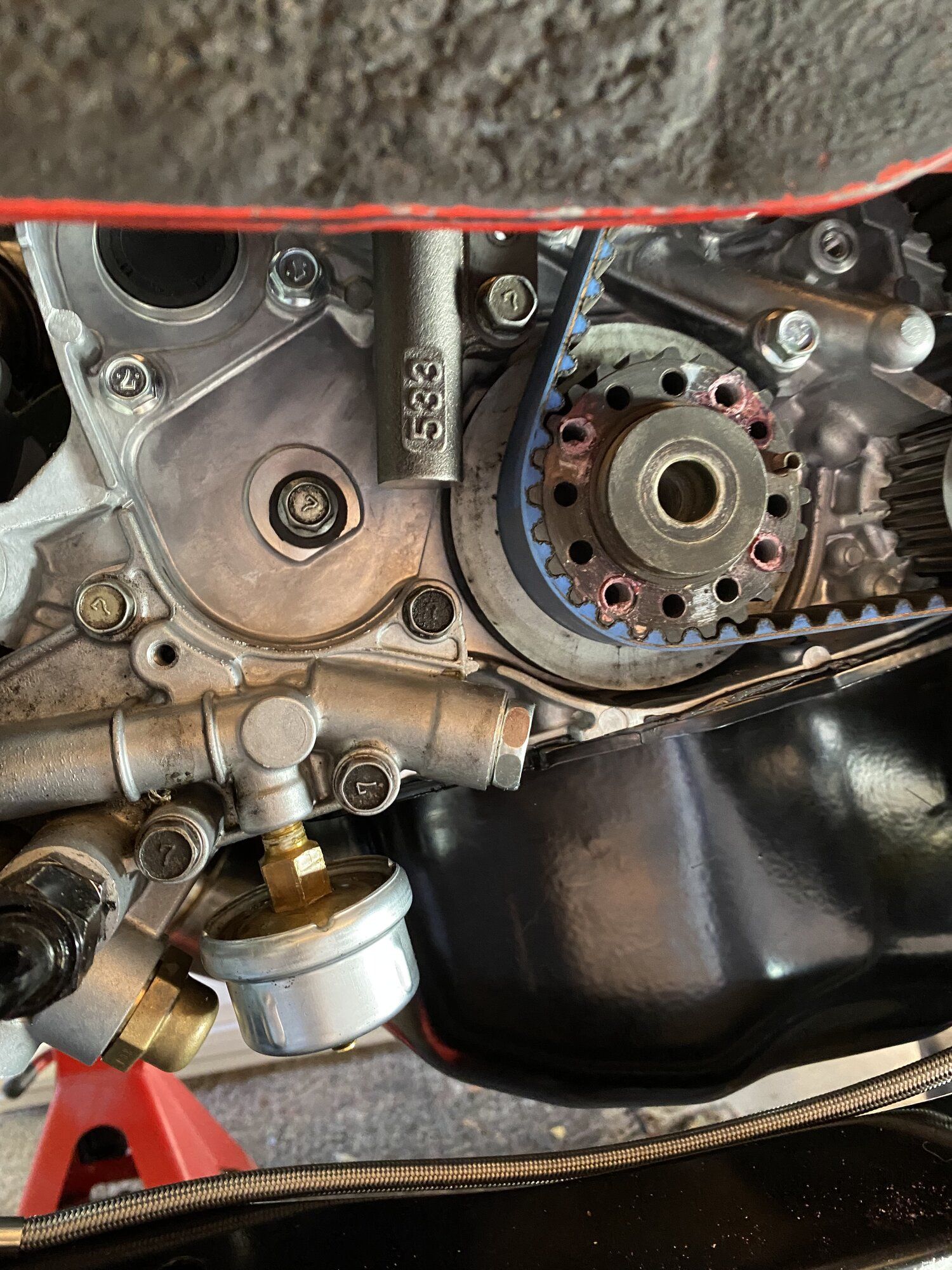

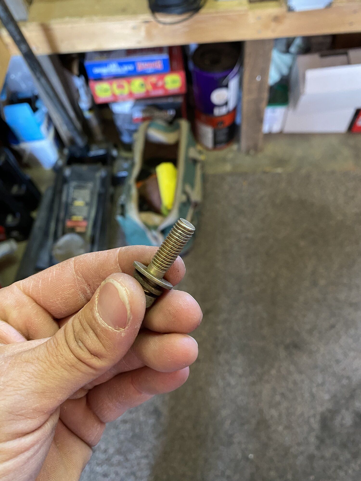

When I did the balance shaft delete I never plugged this hole where the balancer tensioner pulley went, I figured this has to be it LOL
So today I dug in and plugged that dad gum leak LOL.
Cleaned everything up while I was in there, thankfully there was NO oil on the timing belt, after reading a bunch of old threads and Google posts, and getting my hand covered in this happy oil it smells like ONE thing, E85 LOL. I’m pretty certain when we were priming the engine last Sunday and just dumping fuel without spark on a fresh build with looser clearances some of that fuel could’ve made its way to the crankcase and mixed with the oil. If it weren’t for that terrible oil leak I would’ve ran this contaminated oil even longer in the engine which wouldn’t have been good. So I guess the moral of tonight’s story is sometimes these bad episodes in the never ending series of dsm’s can have a positive silver lining LOL. Tomorrow my brother n law and I will do a coolant pressure test to verify it’s not a HG, which I’m certain it’s not, but I don’t mind the assurance, then we’ll start her up again with a much leaner global on the 2150’s to see if I can get this old picky high maintenance B%tch to idle LOL, wish me luck!

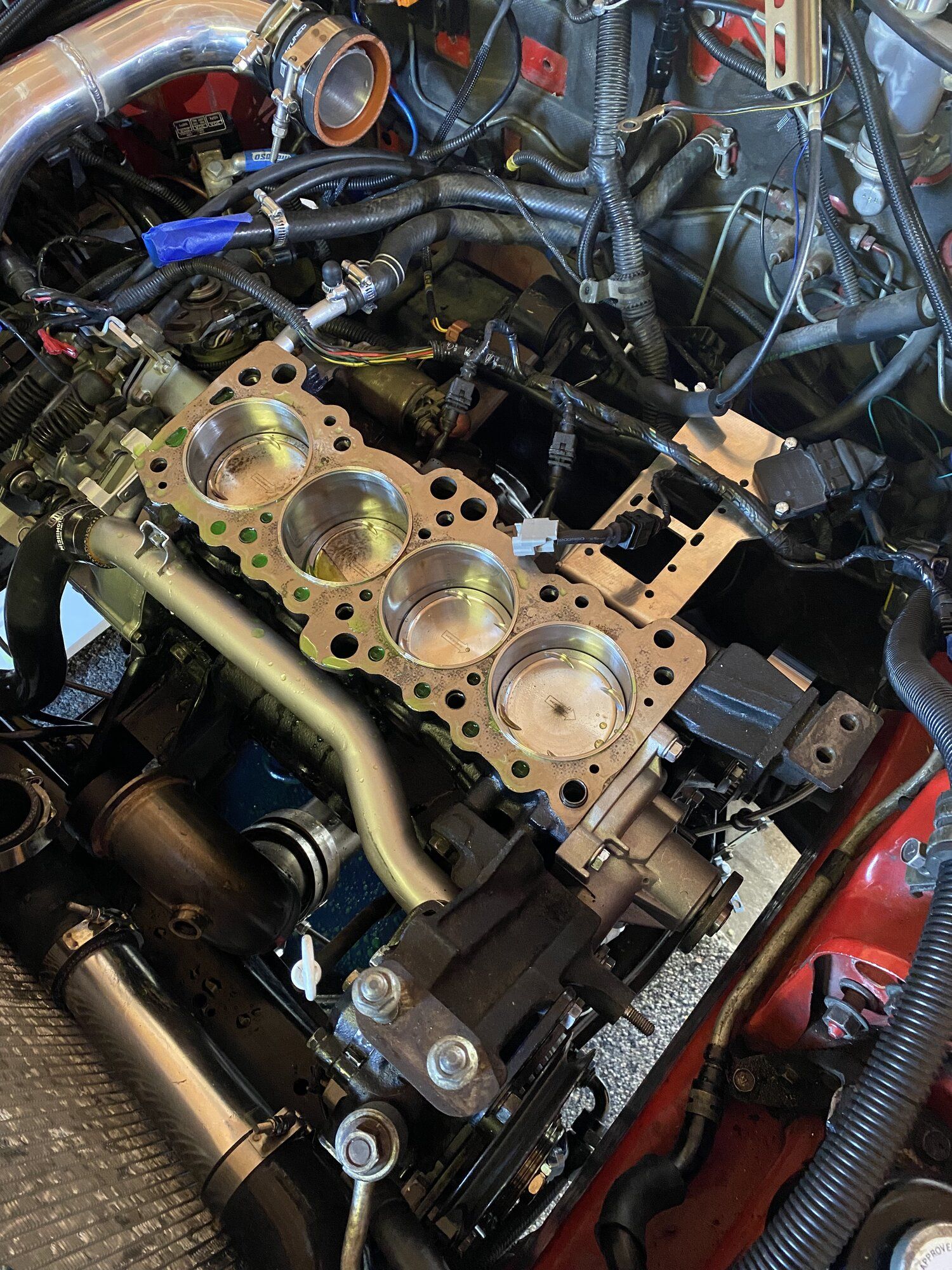

Well boys looks like project bust continues LOL. After a couple diagnostic tests, a coolant pressure test, which the car passed with flying colors like I new it would, we go to compression test it and right off the bat find out cylinder #1 has ZERO compression. :rocks::rocks:. The rest went 150,160,150. I live at 6000ft above sea level so I don’t think those numbers are too bad, we then removed the valve cover and put some air in cylinder#1 and could hear it leaking past one of the intake valves, also we noticed one of the rollers had some play on top of the lifter or hla, where as all other 15 were solid, so it could be a valve guide or seat issue I don’t know, but needless to say the head will be going back to Santa’s workshop LOL
Thanks Tony! I will for sure man, I’m honestly not too upset, everything under the hood of my car is still technically fine, minus the 1 valve that won’t close LOL, there’s worse issues for sure, I’m gonna get this head off and hopefully back on before Christmas :thumb:
