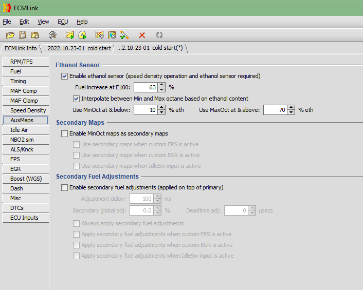

as I’m adding this stuff I’ll be adjusting the global a few times, but there’s a rock solid calculation formula on ecmtuning that nails it
Are you going to do it that way instead of using the "AuxMaps" page in DSMlink?

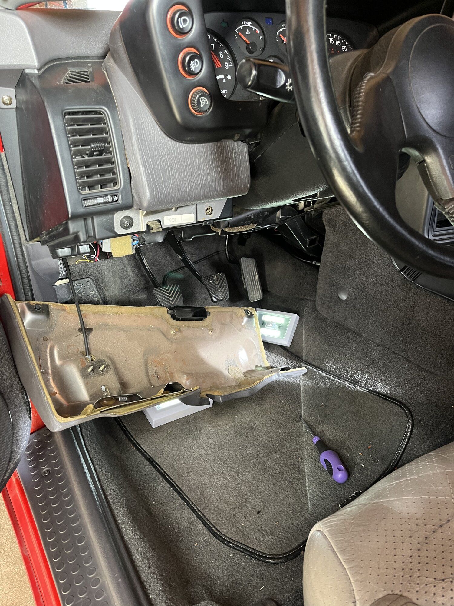

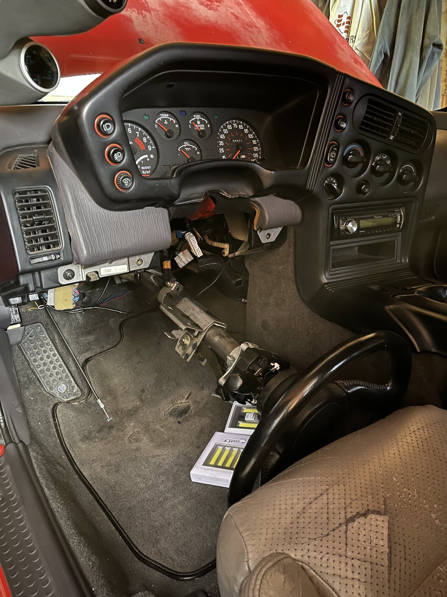

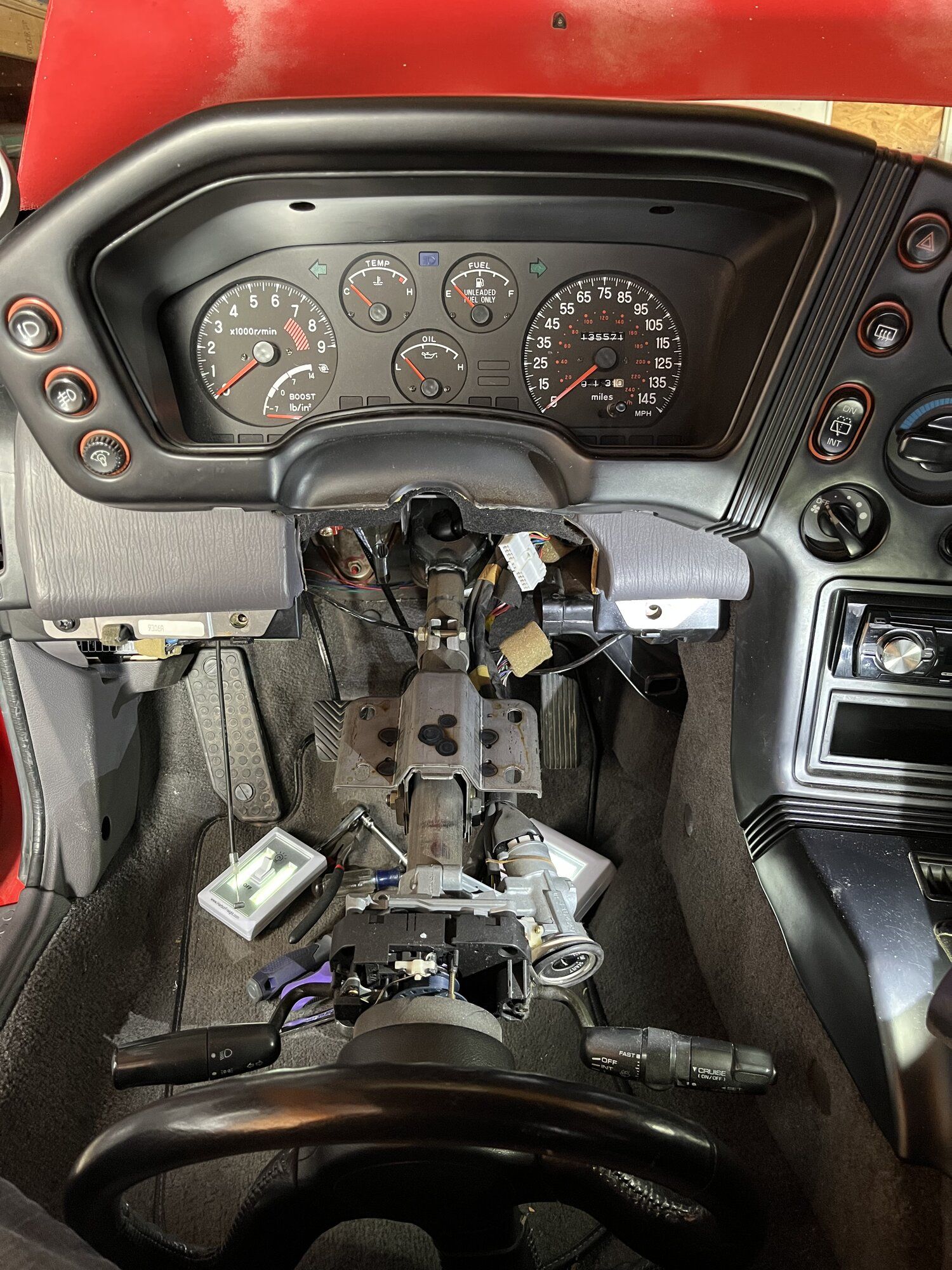

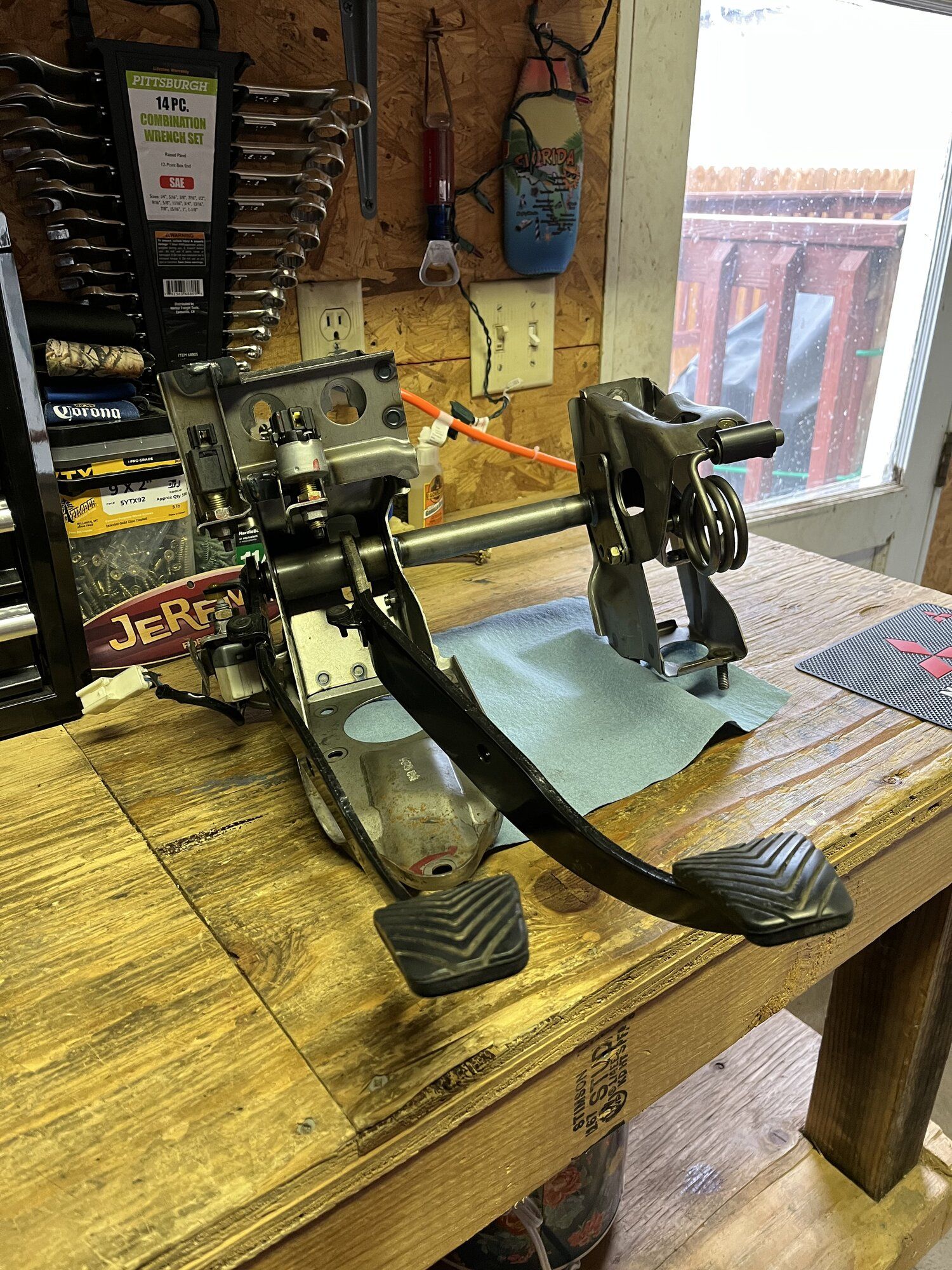

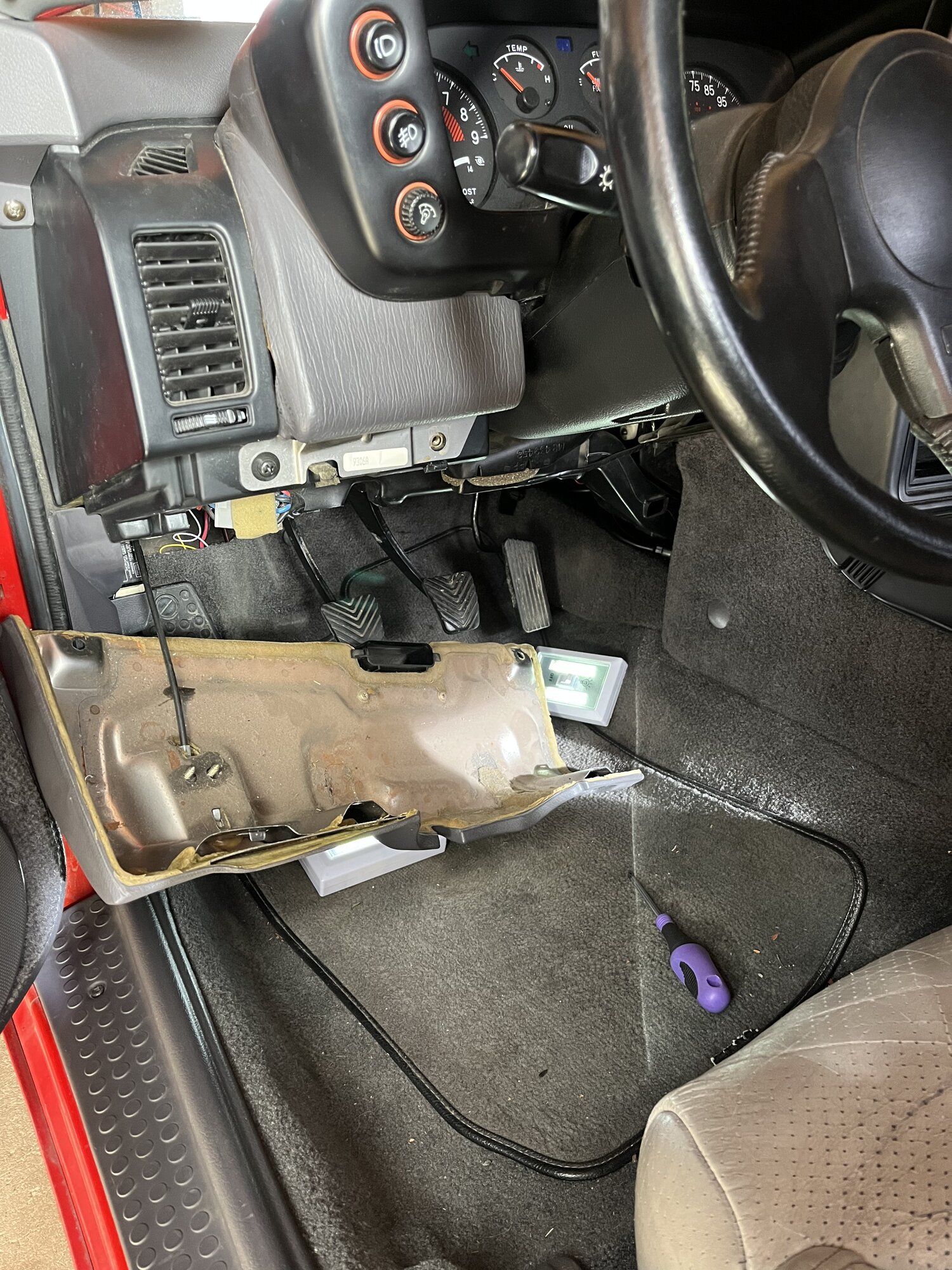

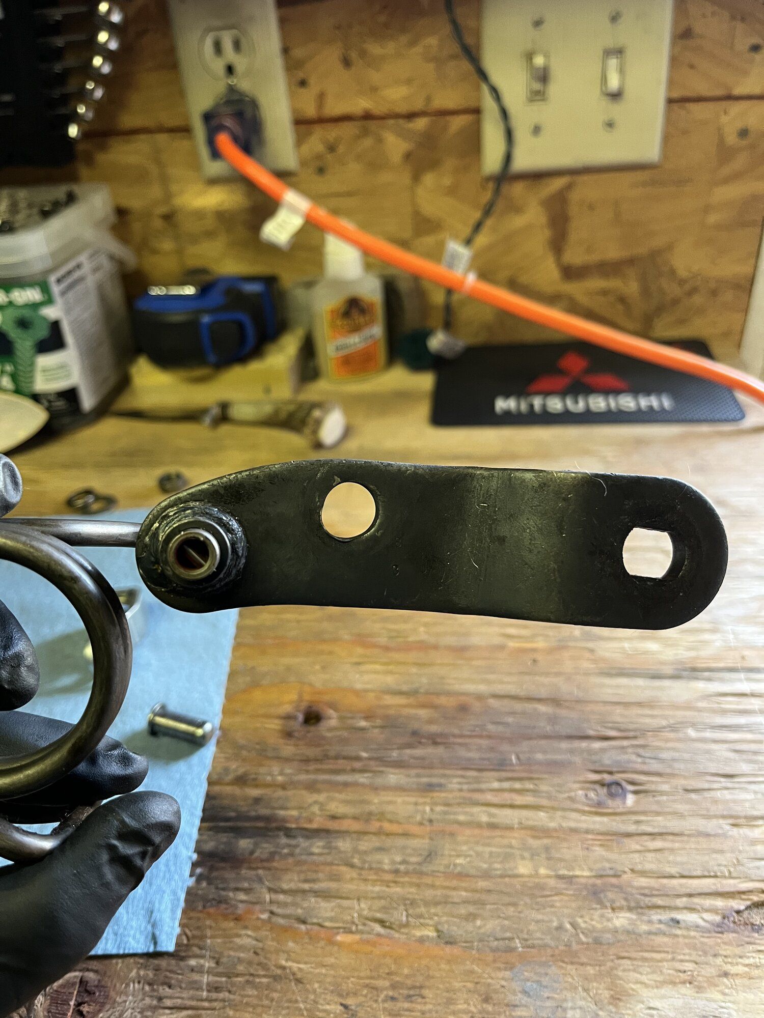

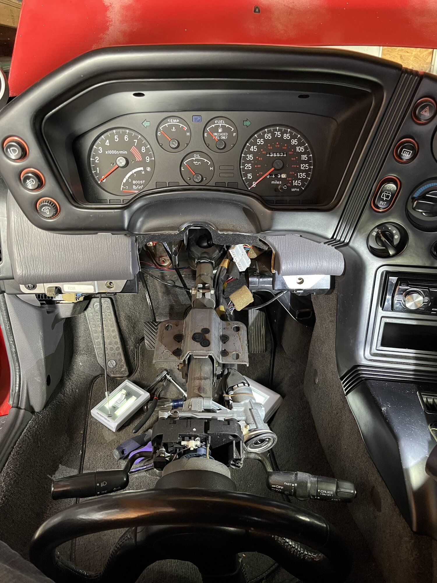

, I’m curious was ANY other car in HISTORY engineered with a pedal assembly this retarded? I’m guilty of ignoring this problem for 600 miles on a $3,000 transmission, so if I’ve incurred damage from my dragging clutch it is what it is I guess. Anyways today I just wanted to get a good start, got the steering column down, and tomorrow I’ll start un bolting the pedal assembly, I plan to replace the infamous plastic bushing with the bronze bushing and weld this thing so I hopefully never have to pull it again, I’m excited to hopefully one day be the proud owner of a 1g that DOES’NT have a dragging clutch
I just pulled that last weekend from my car finally, and it was literally the last piece to come out from the interior aside from stuff like the headliner. I was thinking damn, this thing is a bi$&h with everything out of the way! I even let the clutch spring back and sandwich my finger trying to remove it. Ouch! I totally get why people who try and do it with the interior intact express their displeasure!Hey guys, hope all is well and Happy Holidays! This isn’t a “Cool” update, just what I’m currently up to with the car. I’ve got these last 2 weeks of the year off so I figured I’d finally get to something I’ve been putting off for years now..View attachment 682995Fixing this stupid pedal assembly

Looking forward to seeing the upgrade as I need a reminder of how to do it. Wish I had two weeks off, have fun!
Perfect! Looking for how to do that too, still debating and timid but I mean, how do I touch literally every other piece and not that?Thanks man! I’m re doing my headliner tooView attachment 682998

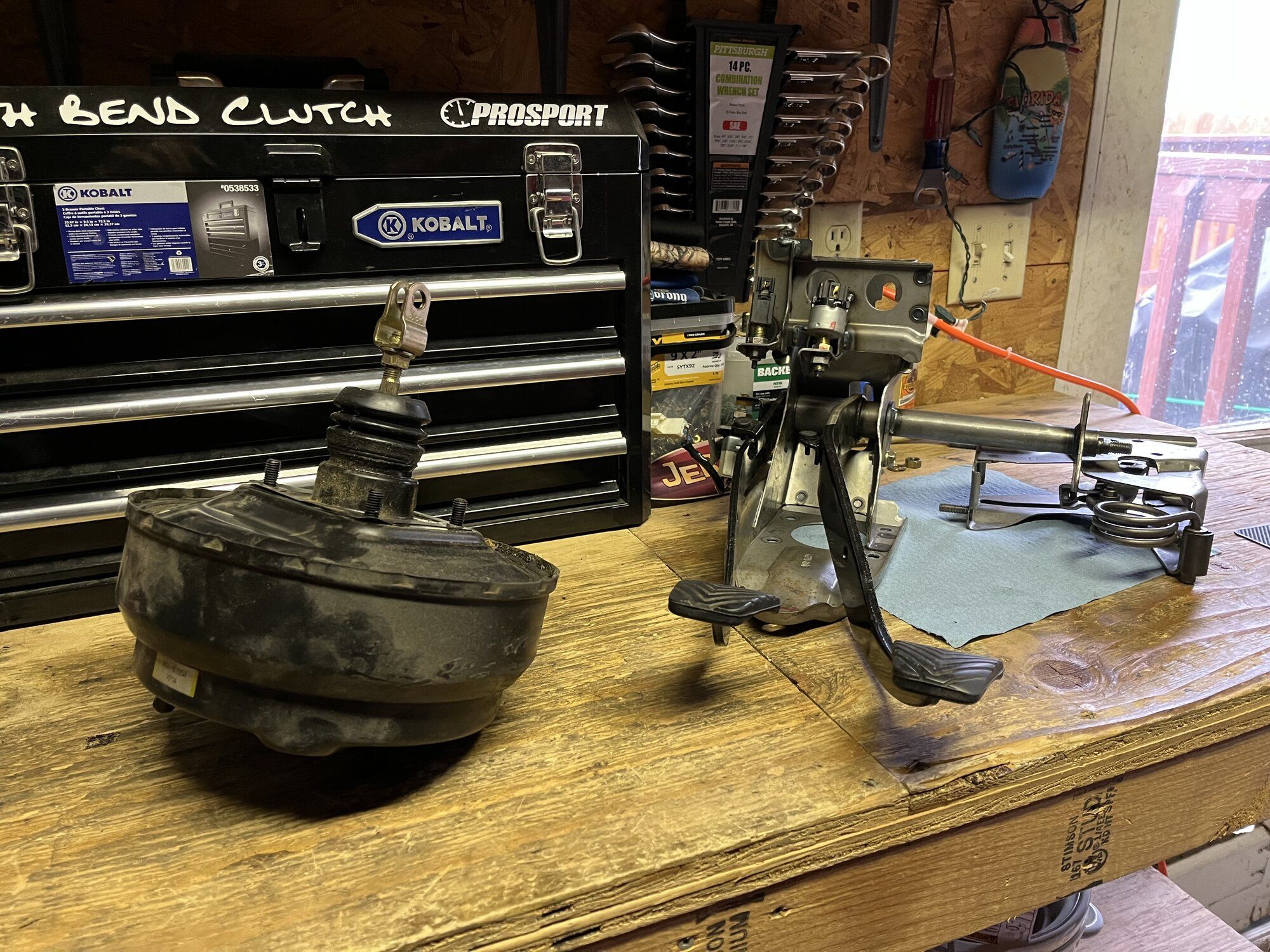

Getting to those pedals really sucks. I was thinking of replacing the entire assembly with a Wilwood pedal setup. The Tilton kit is cooler looking but way more pricey. Would have been bad ass.Hey guys, hope all is well and Happy Holidays! This isn’t a “Cool” update, just what I’m currently up to with the car. I’ve got these last 2 weeks of the year off so I figured I’d finally get to something I’ve been putting off for years now..View attachment 682995Fixing this stupid pedal assembly

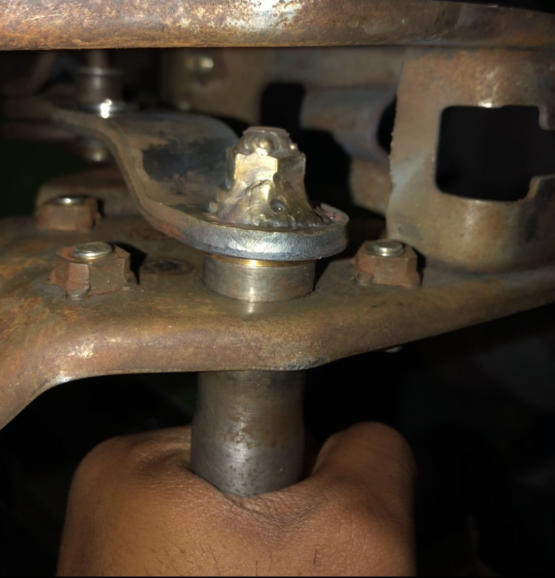

, not really tho, I’ve taken my time, finally got this sucker out, time for a rebuild and some welding so it NEVER has to come out again.
. Now as far as the the welding goes, I’m going off YouTube videos and old threads on here that show the most common spot to weld is the nut on the end of the shaft that the z bar attaches too. I’ll say that I have very little movement and wear at that end but I’m still gonna weld it anyway. The WORST spot on my assembly is the clevis pin hole that attaches to the clutch master rod.
. I’ve got a new 1/2” pin on the way to address that, anyways I’m hoping for the best, I’d love to be able to shift at 8 grand without worry some day, In the meantime I also just got my aem 5 map sensor I’ll be installing this weekend along with switching over to a 3 port boost solenoid, and hopefully getting the new headliner on soon so I can hit the dyno.as far as the the welding goes, I’m going off YouTube videos and old threads on here that show the most common spot to weld is the nut on the end of the shaft that the z bar attaches too.
