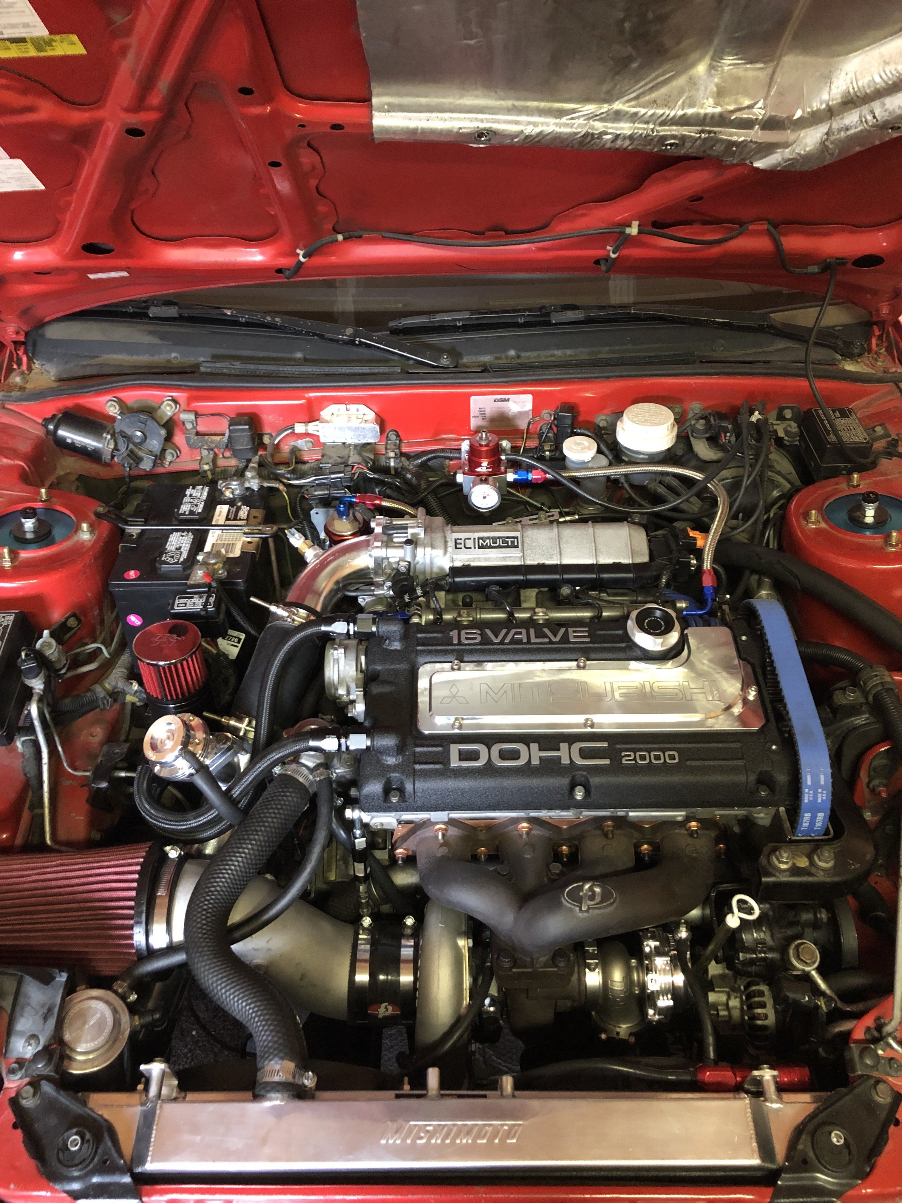

Hey guys, so in the last few weeks I’ve been checking off my list one by one. I got the headliner replaced, re torqued the head and replaced the valve cover gasket, installed the aem 5 bar and today got my 3 port boost solenoid wired, mounted and plumbed:rocks:.
Only thing left before backing her back out of the garage as you could see from my previous post is re install that darn pedal assembly which I’m not looking forward too LOL. I am proud of my self for finally addressing that issue. So I ended up NOT welding the traditional nut that most people do, as I really had no play there, the original plastic bushing was in great shape, and some say welding that spot weakens the shaft and doesn’t really fix pedal slop anyways, ALL my slop was at the clevis pin.
