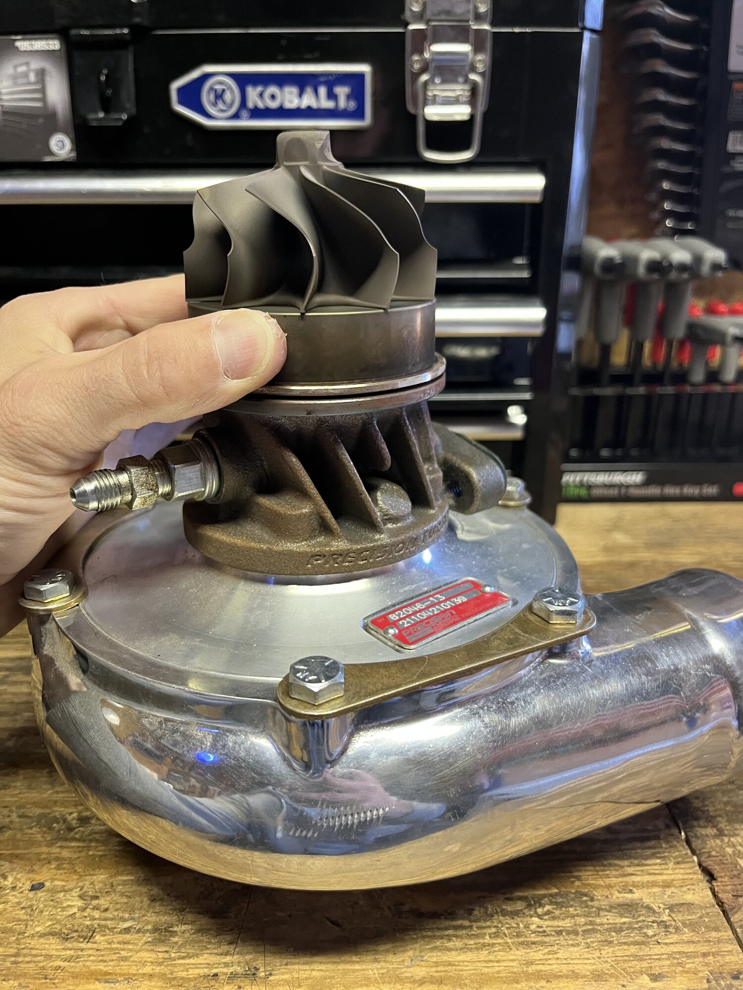

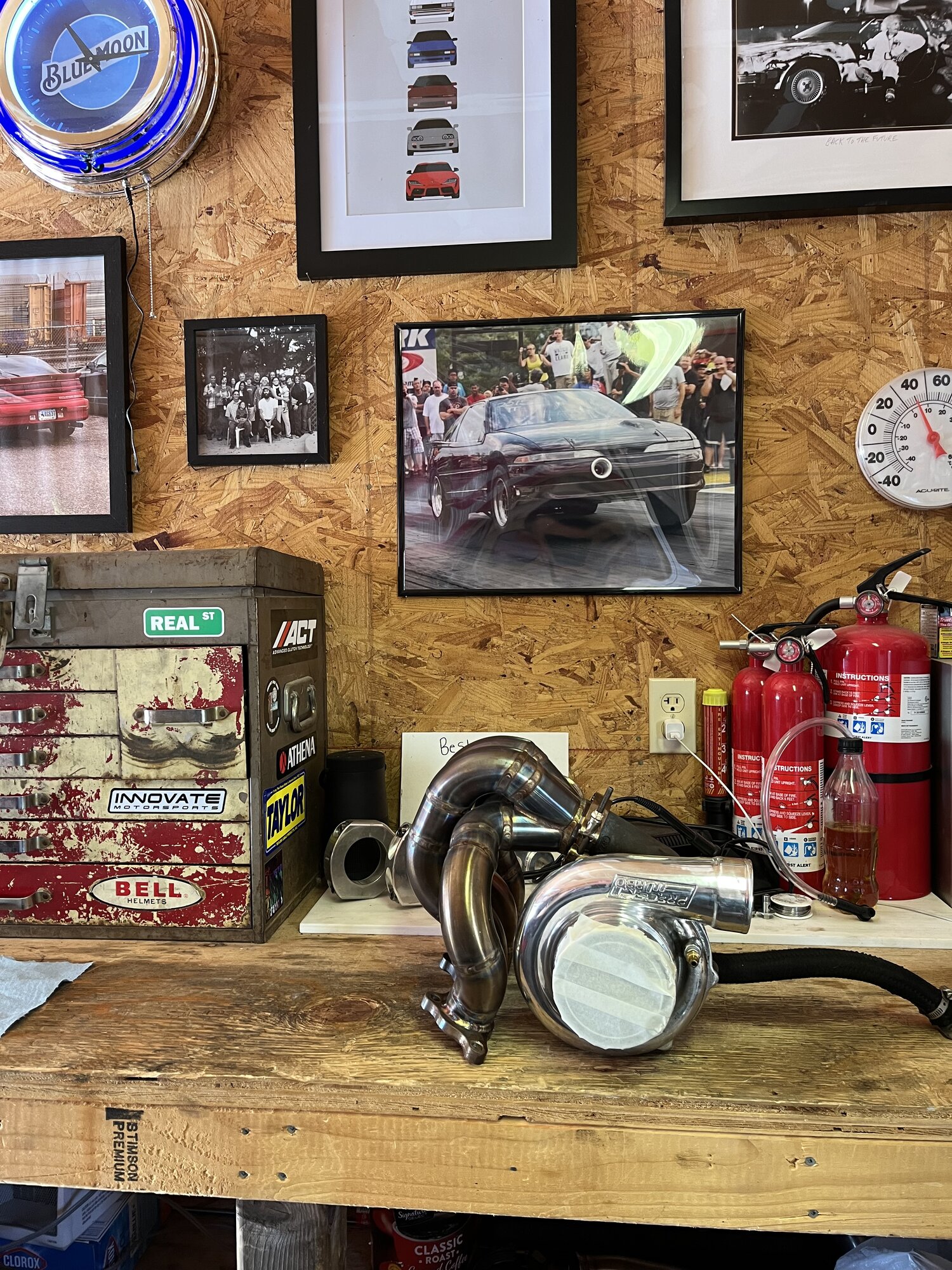

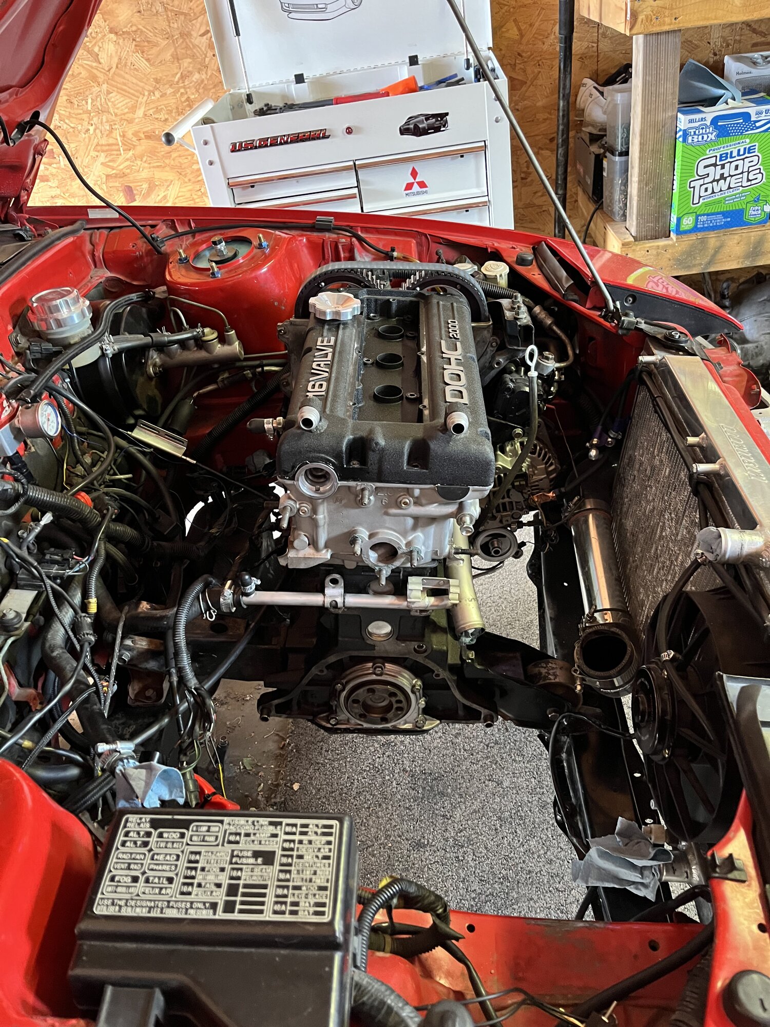

Made some progress today, got the manifold and turbo/hot parts out.

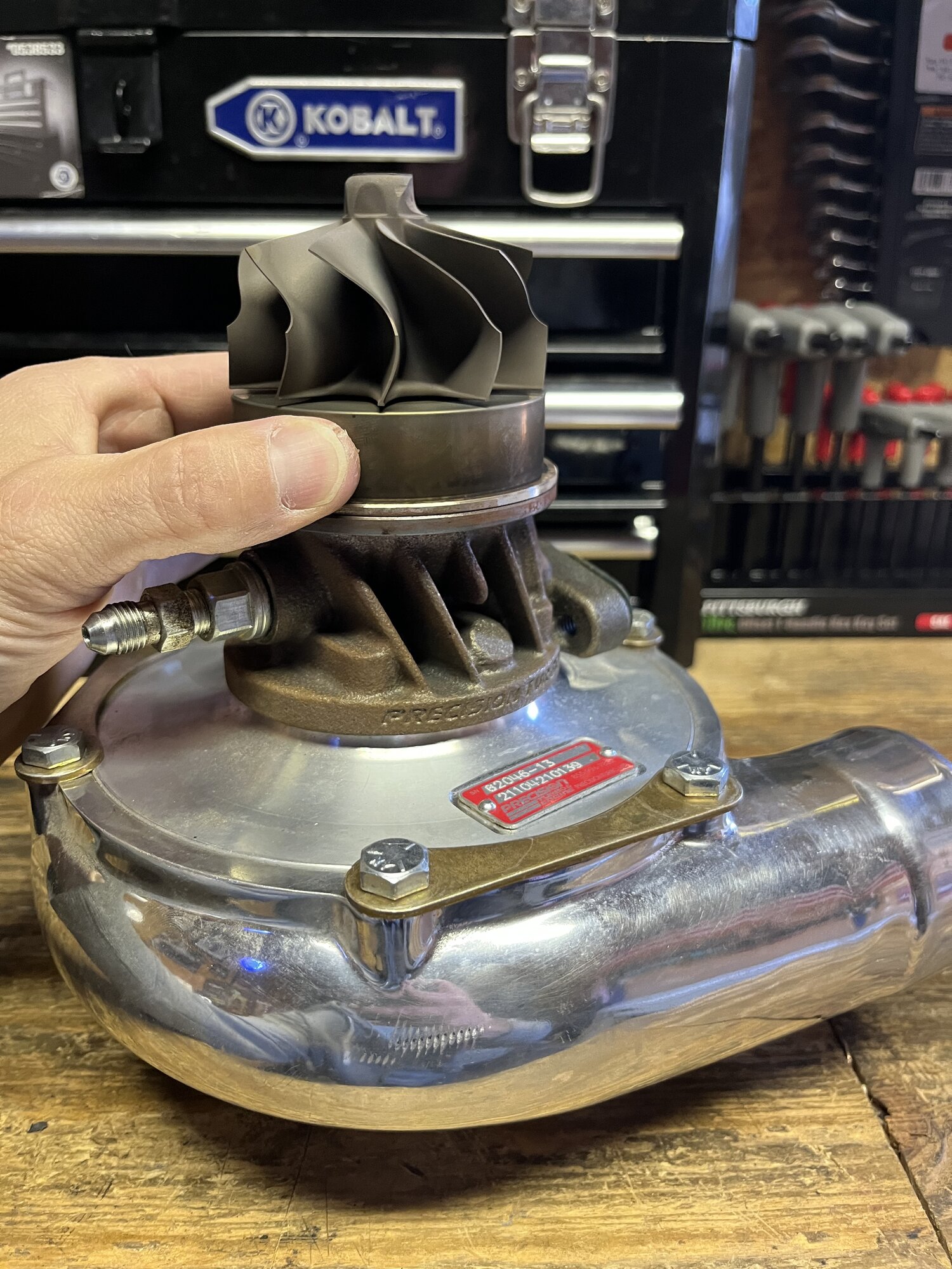

I also went ahead and removed the turbine housing, as I’d like to get all my hot parts ceramics coated this year, this is my first time ever removing the hot side, and there’s some play/wiggle on this part I’m unsure about.

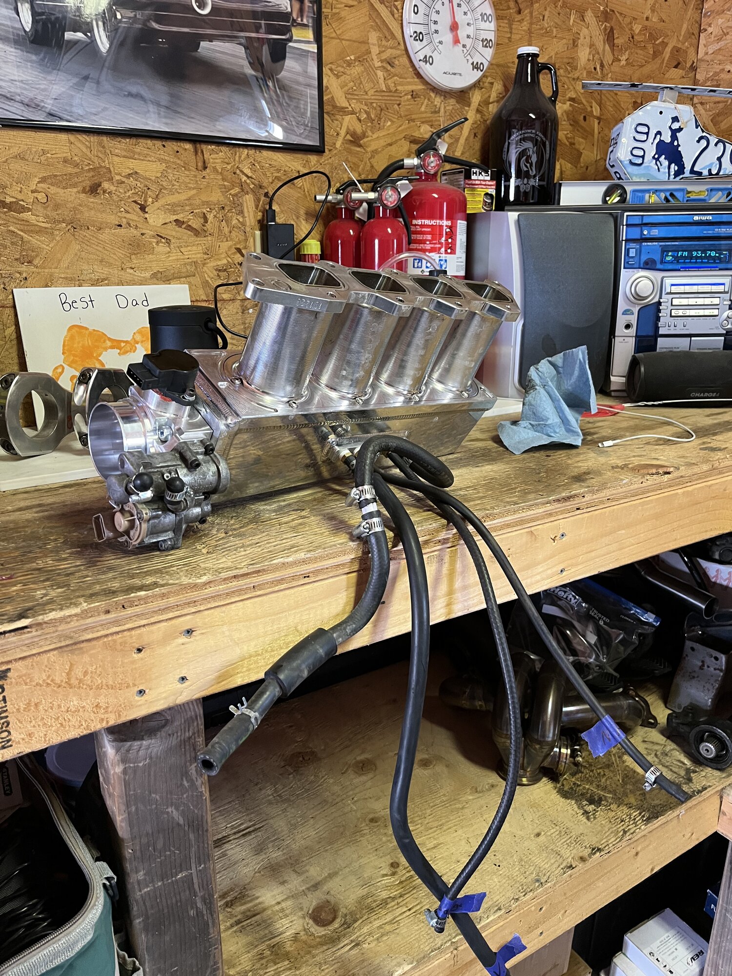

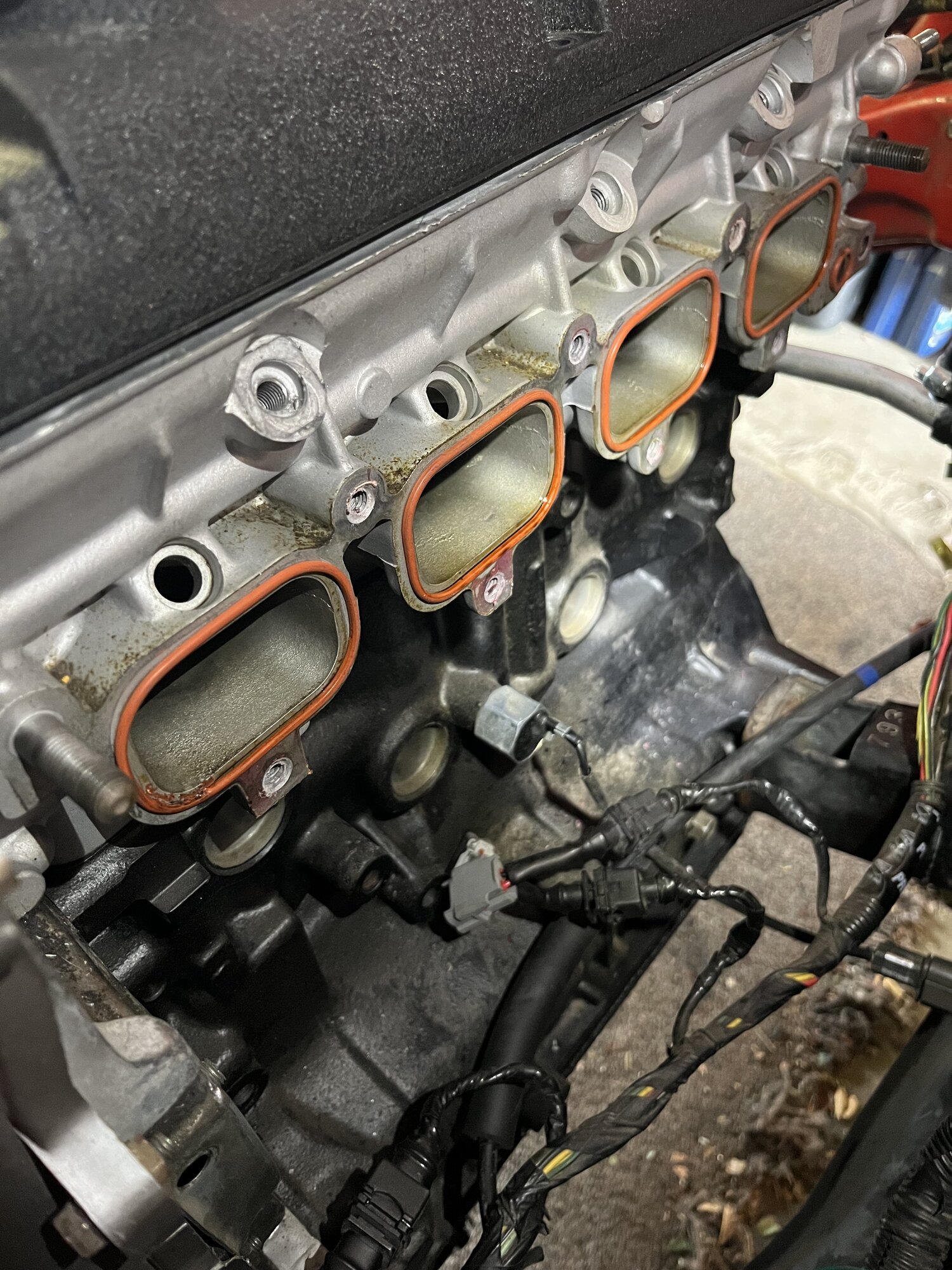

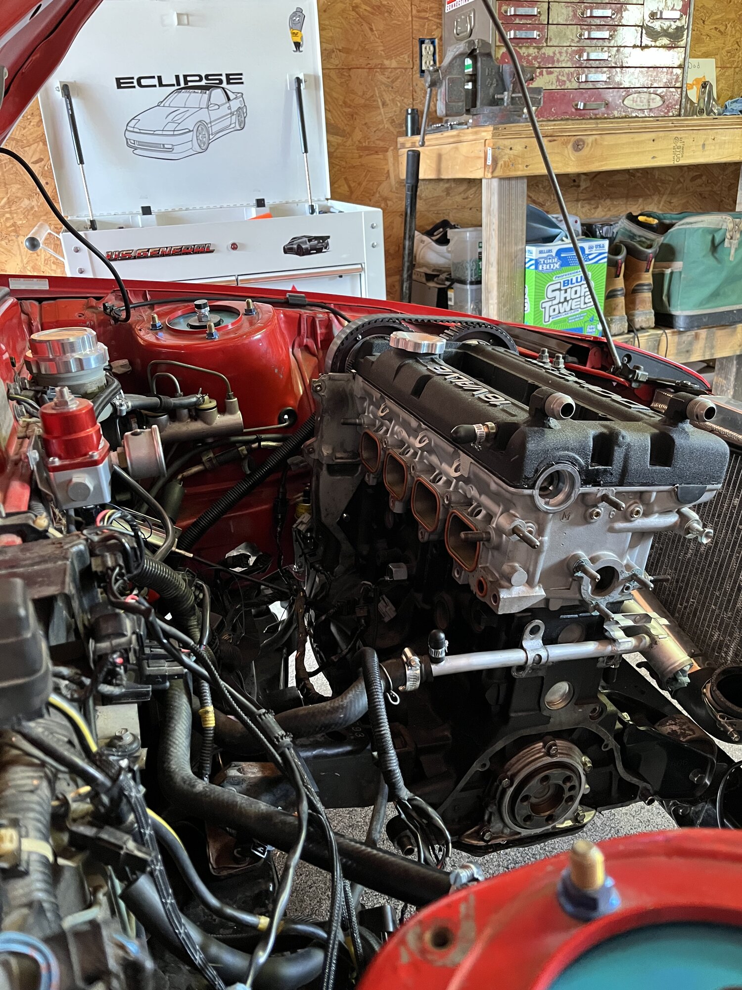

Made some more progress today, pulled the thermostat housing and intake/throttle body.

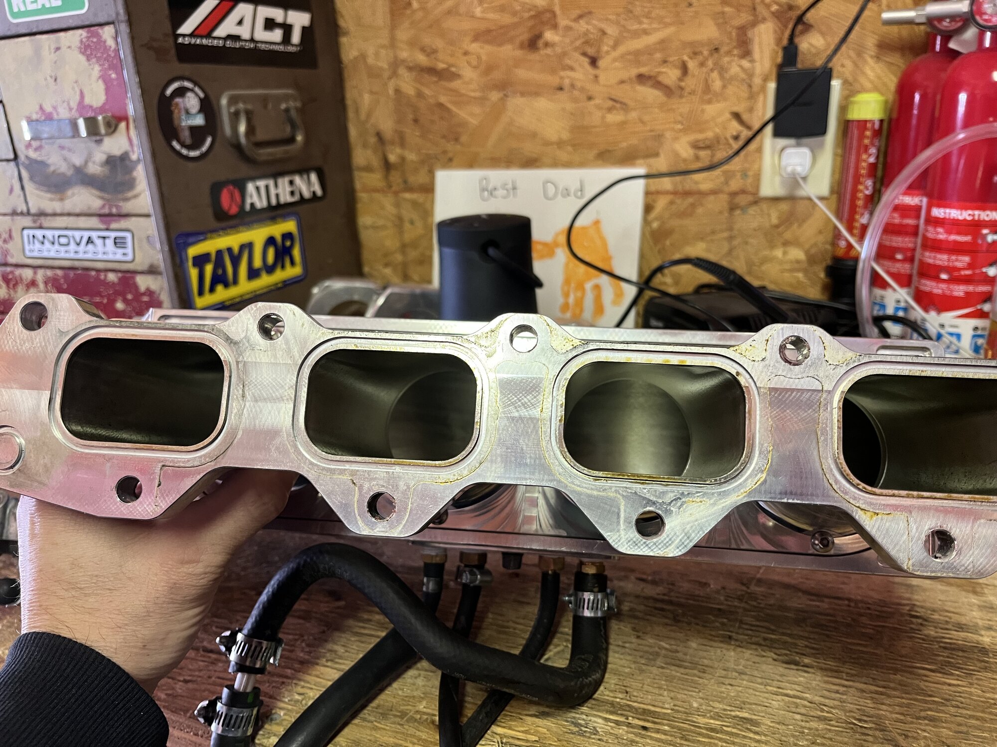

Looks like the o ring on the #1 intake port got pinched, obviously I’ll replace them all upon re installing, and I can’t get over how nice and clean the inside of the intake is, unlike my black and sooty stocker LOL, I know deleting the pcv valve is to thank for that.
Next up I’ll pull the power steering pump and alternator and then yank the head off. Nothings going to the machine shop anytime soon, work is slow right now which is why I have all this time to pull everything apart LOL, I wonder if it’s possible to re use my piston rings? Assuming the engine still had good compression, might be a dumb question but it’d be cool if I didn’t have to re seat anything. I’m specifically tearing this down as precautionary/preventative maintenance. It’s the bearings I’m worried about, but again it’s a good time to make a few changes/upgrades, maybe discuss a looser clearance on bearings with the machine shop with the even higher oil pressure I’ll have after plugging the oil squirters, who knows :)

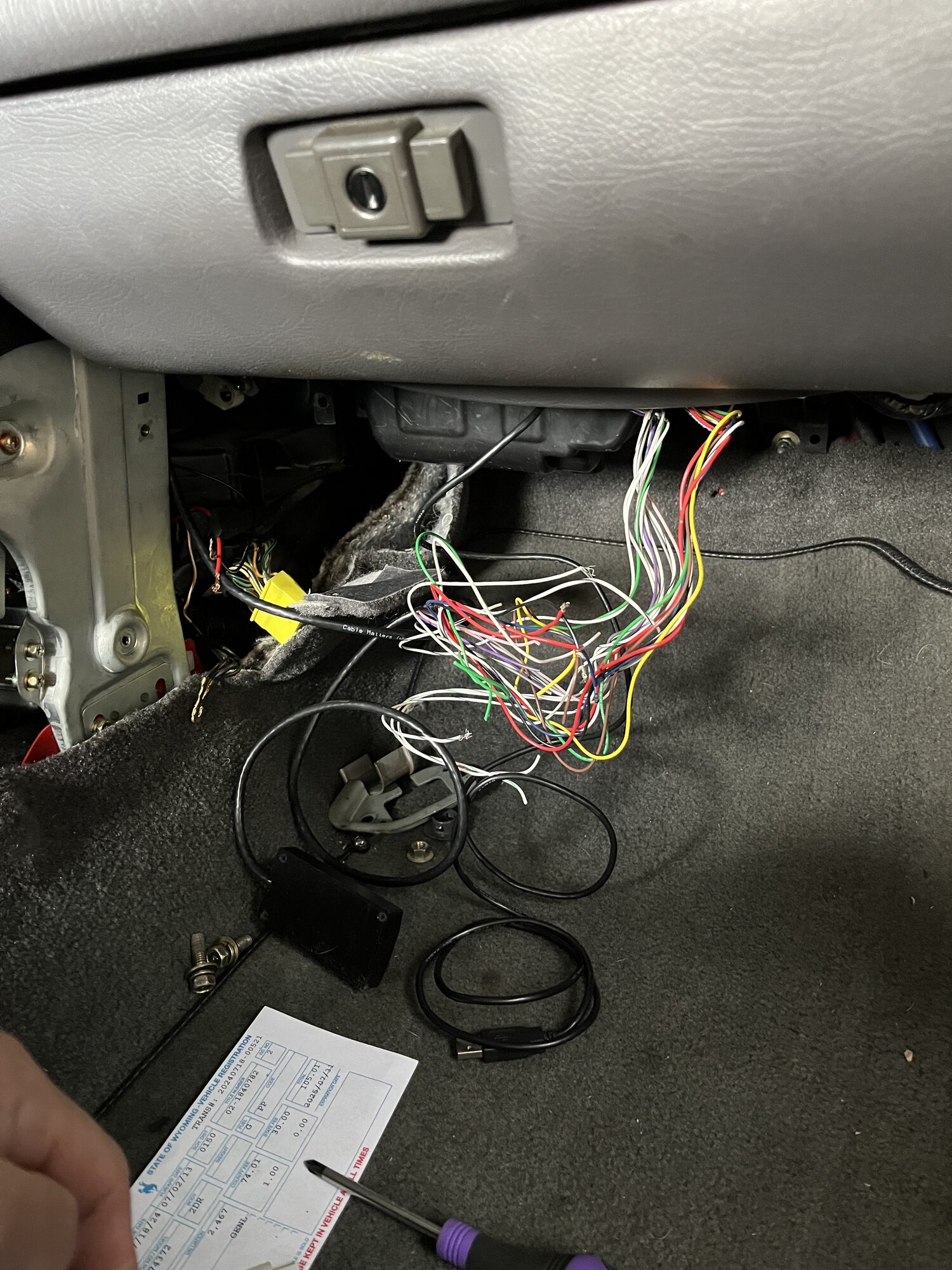

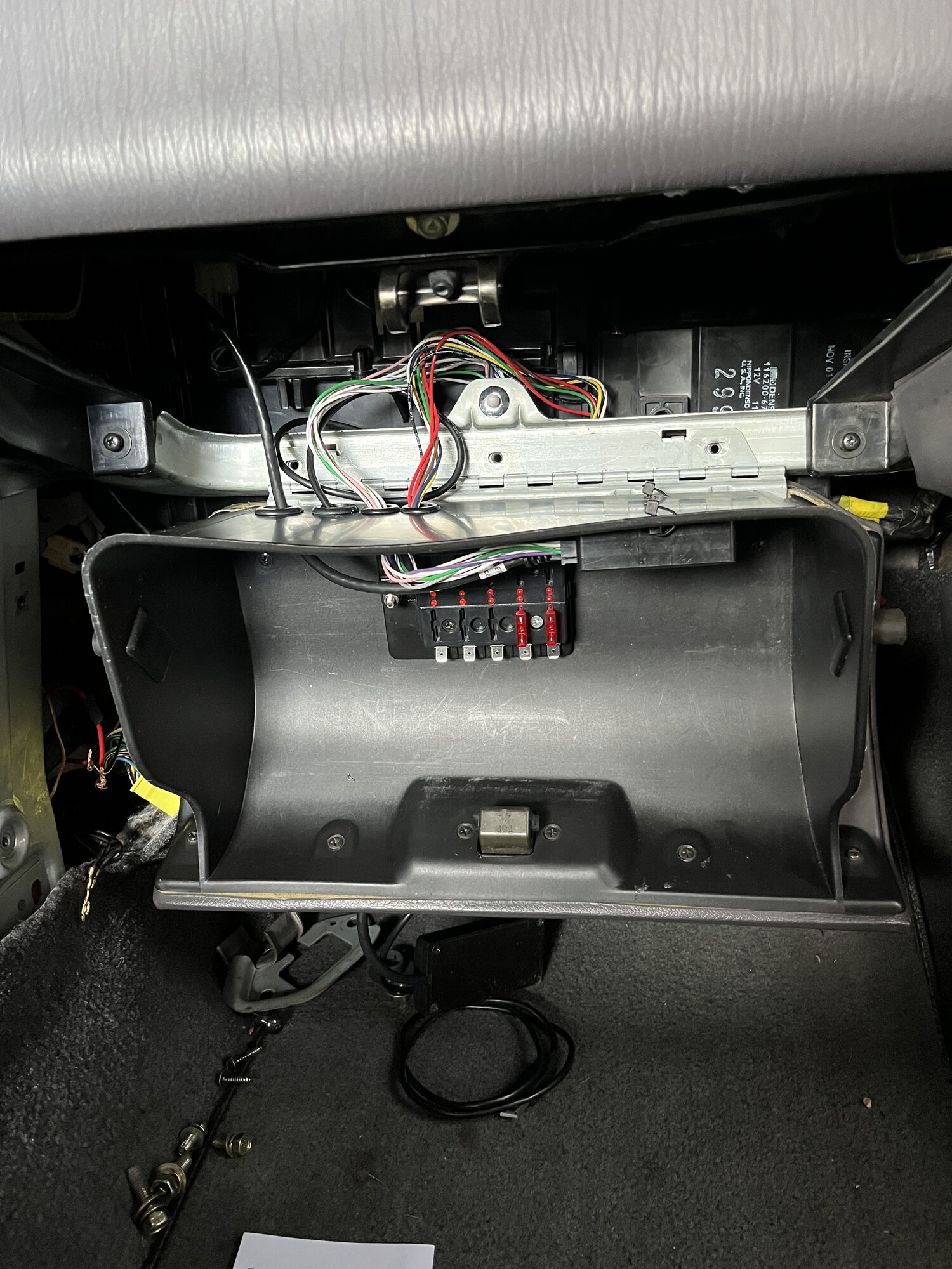

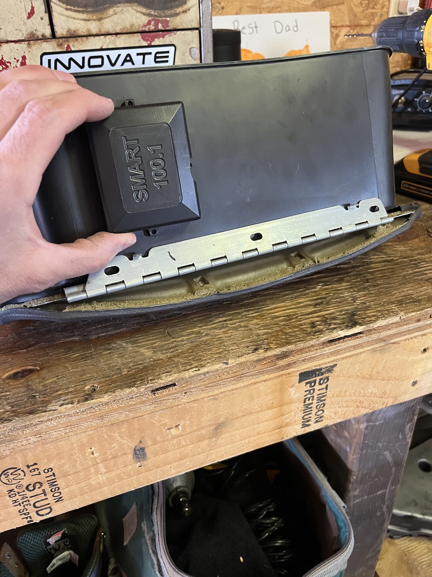

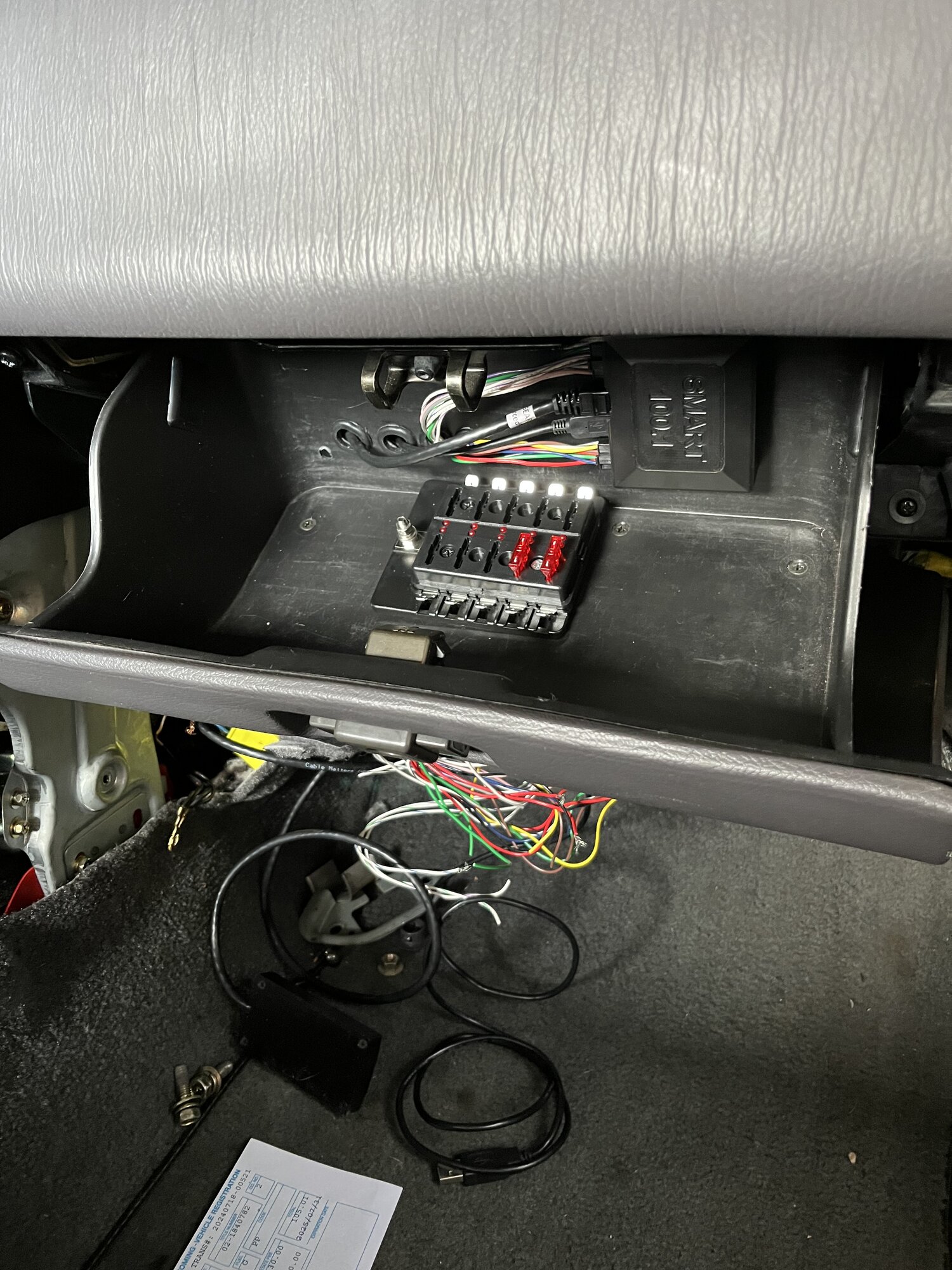

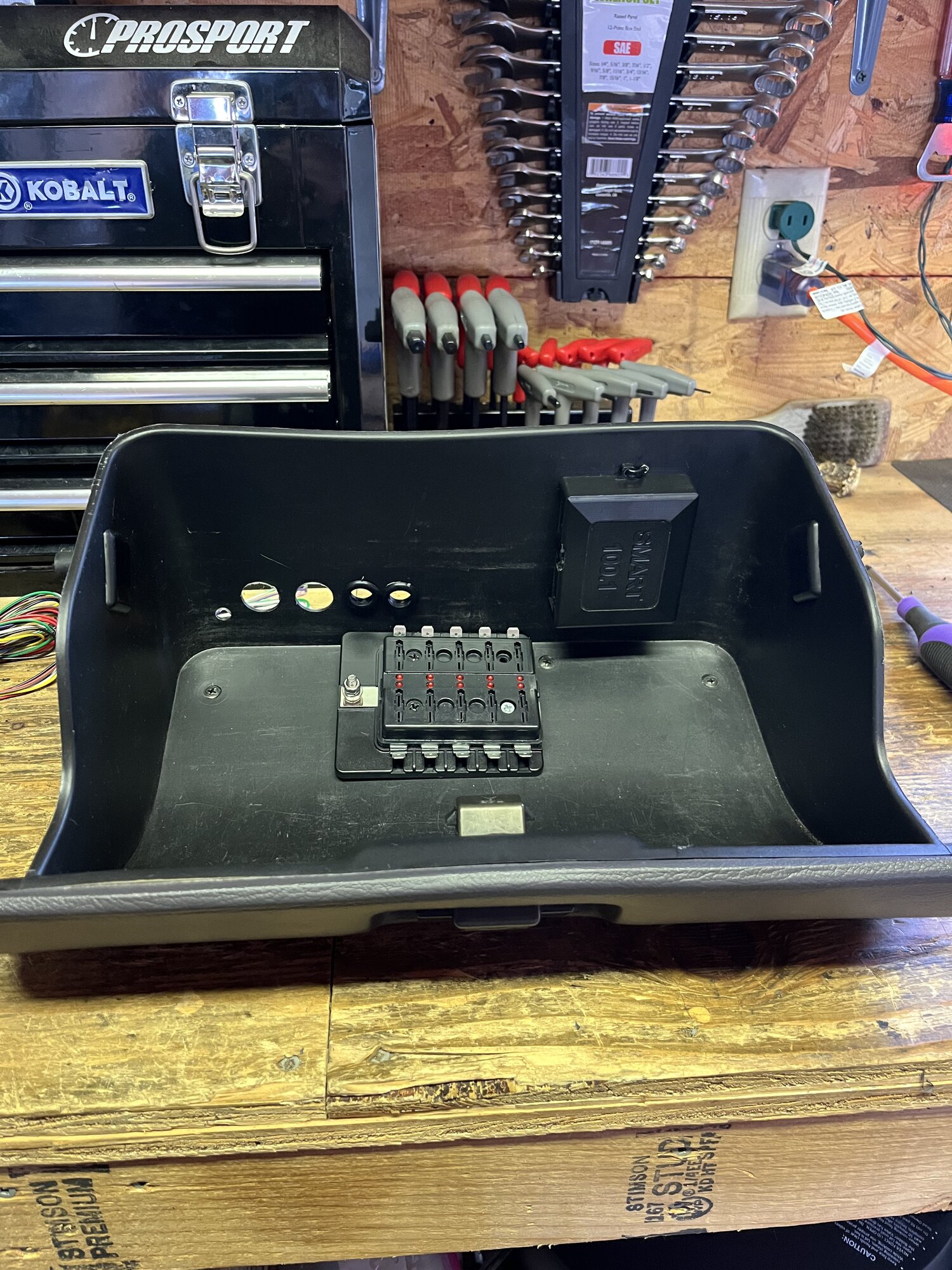

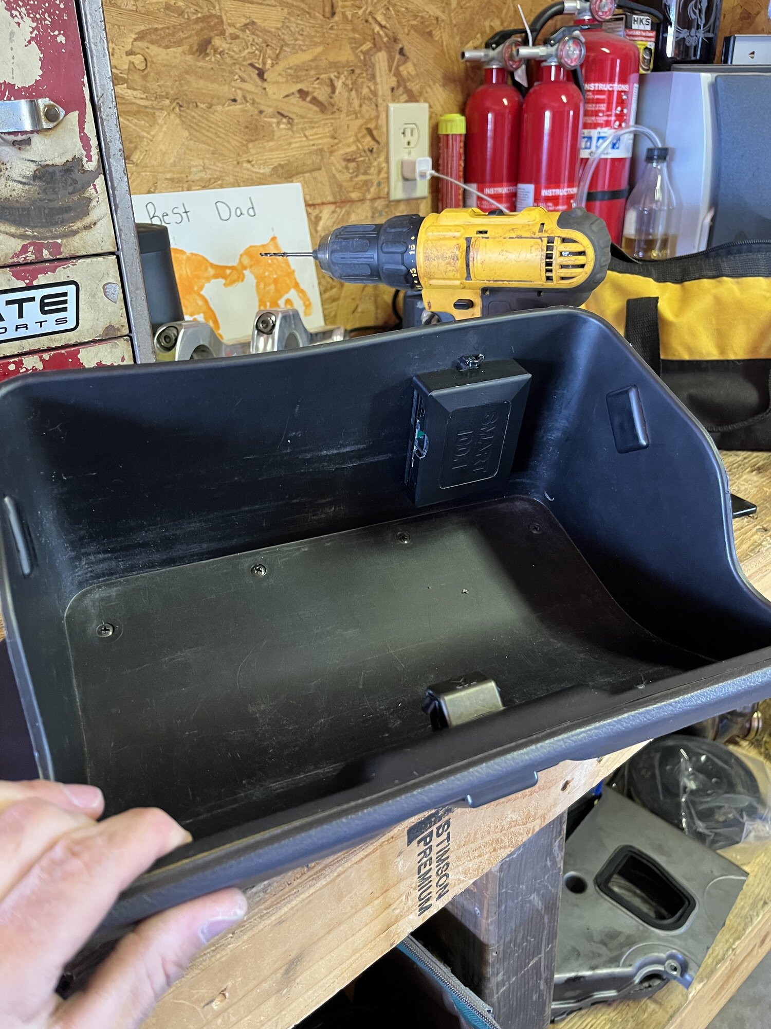

Hey guys, haven’t done much in the last couple weeks, today I finally got the forced four shift box mounted in its new home. I 100% copied this idea from @SasaniFab. Back in 2018 or so he auto swapped his 92 and that thread was very helpful.
First I used the box as a template to drill the holes for the zip ties to hold it in place.
Boom.

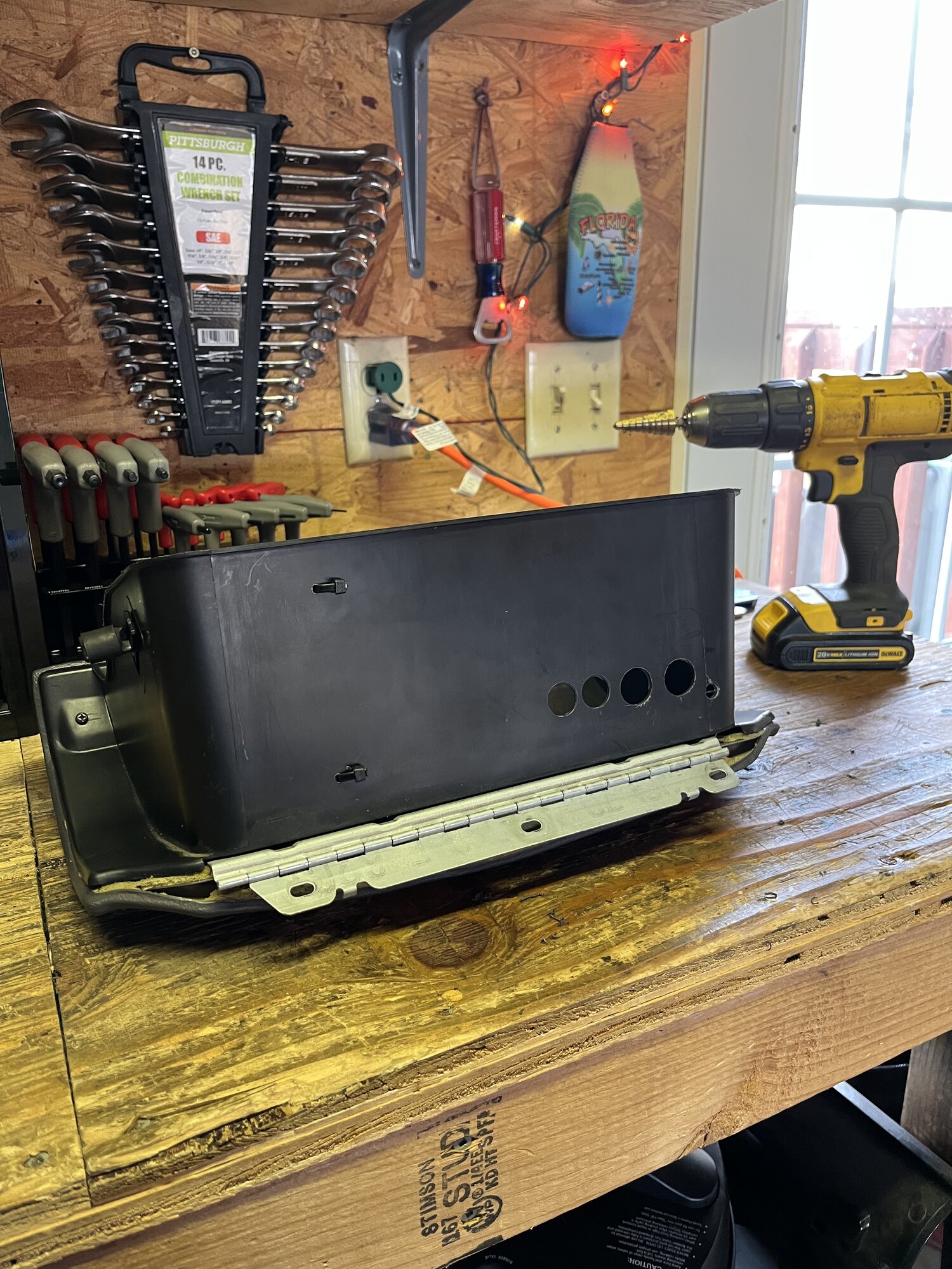

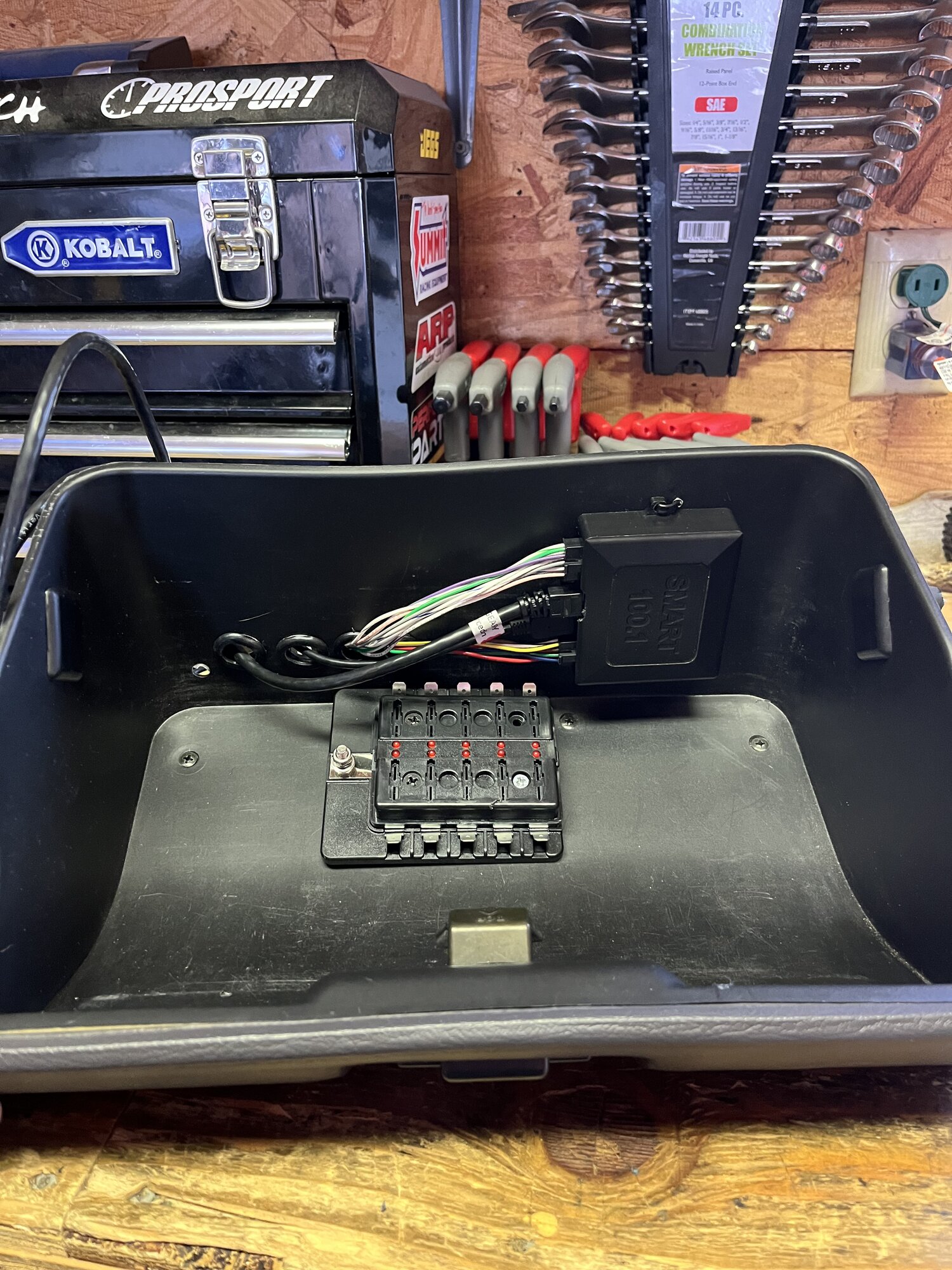

Next I drilled for the input/output harness and the usb/shift selector. The little hole to the right is for the 8 gauge power feed I’ll run to the fuse block.
I think this is a pretty clever location LOL.
Im happy with the way it turned out, next up I’ll be tackling the main engine harness taps I need for tps/tach/gas etc. I also picked an oem plug from Extremepsi I’ll use for the shift solenoids, hope all is well guys, :rocks:
