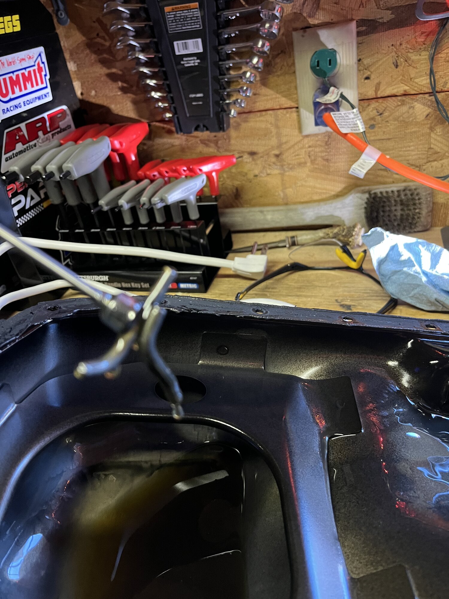

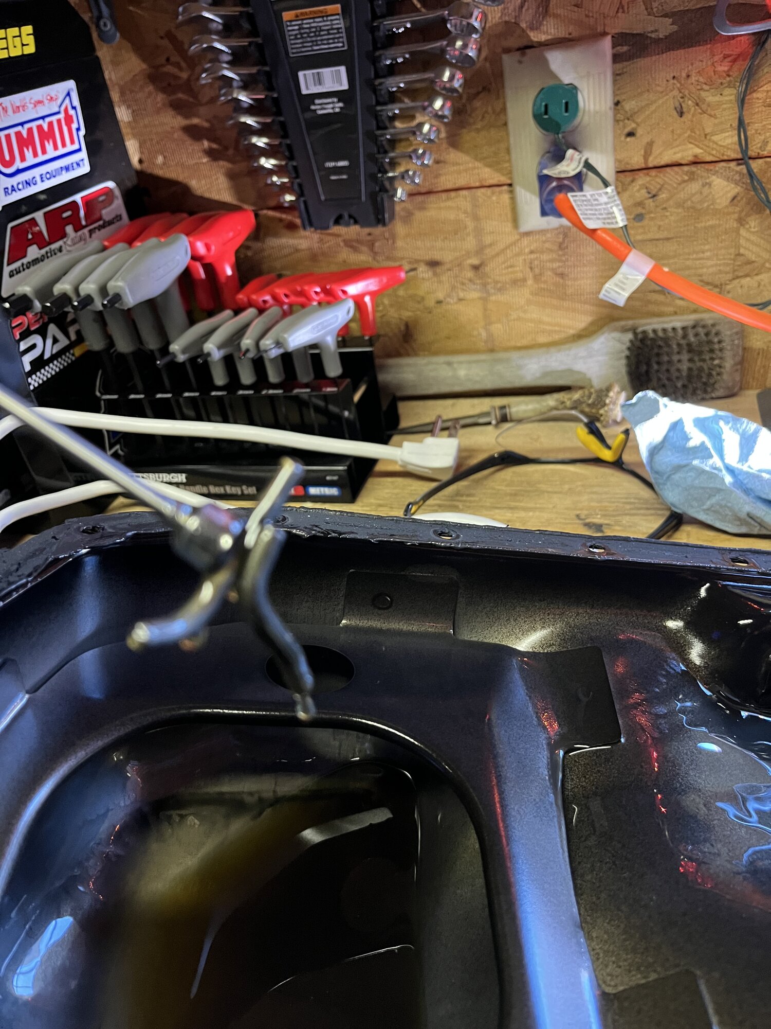

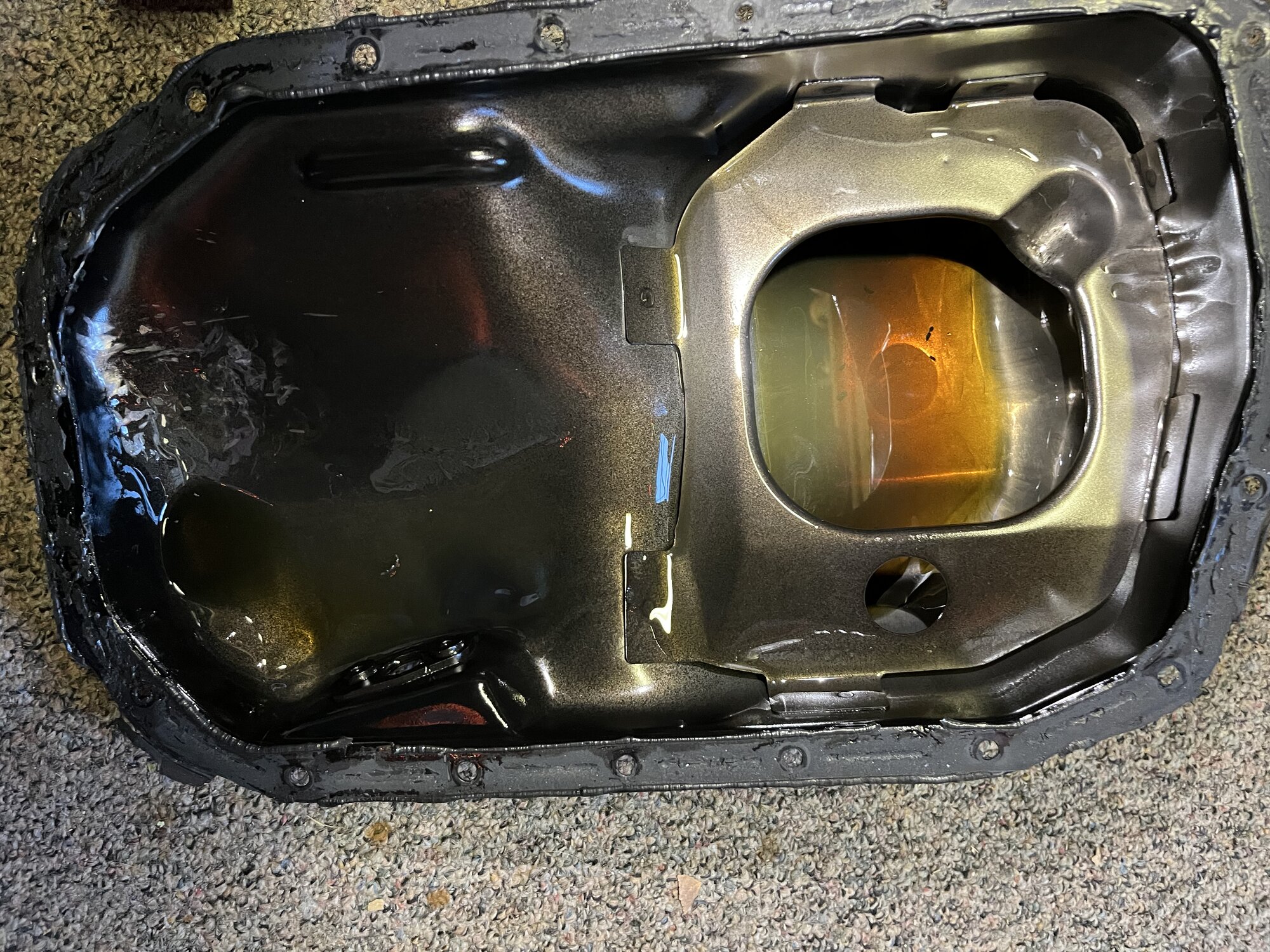

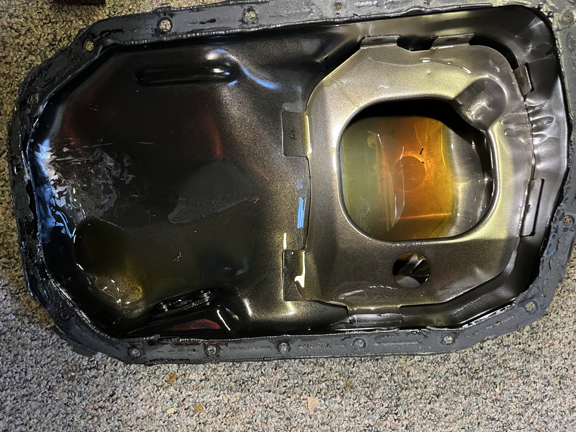

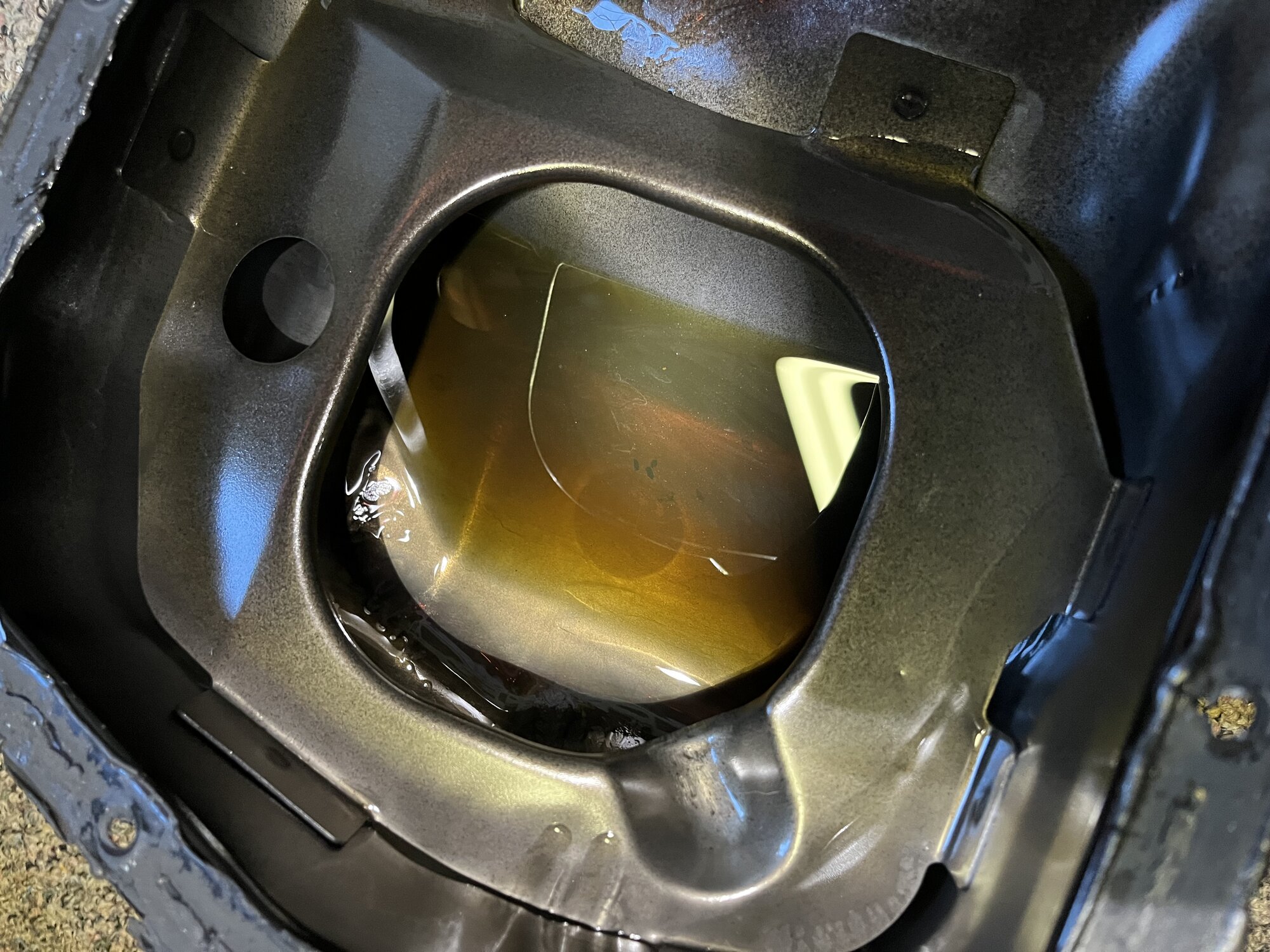

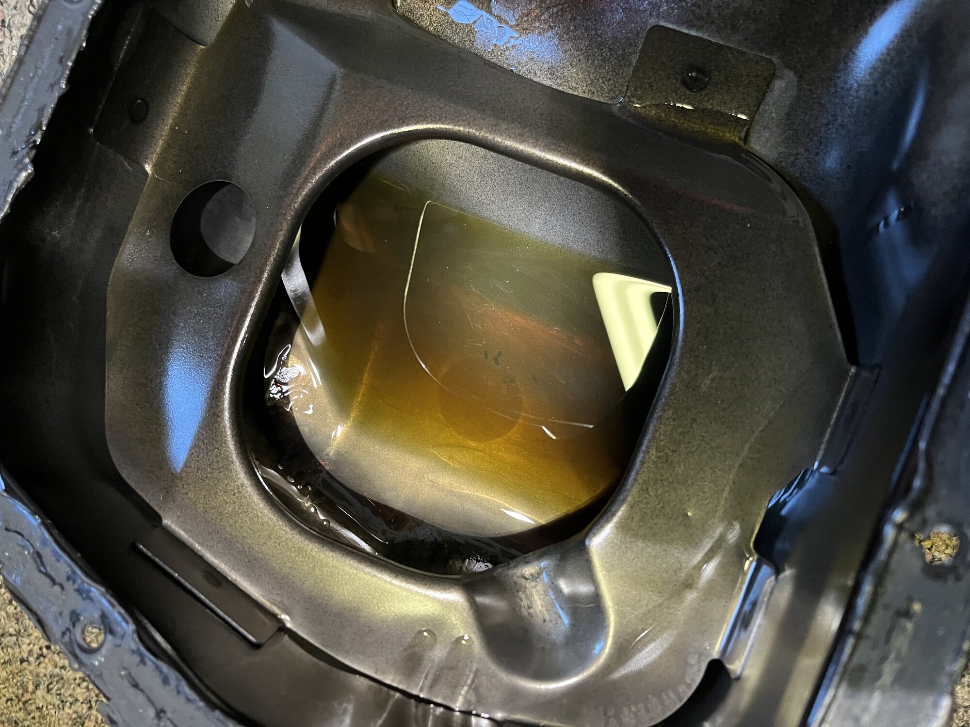

Welp, finally pulled the oil pan today, and sure enough the other 2 oil squirters were in there LOL, but unfortunately I also saw what looks like bearing material, not a lot, but enough to make me want to pull the engine and tear it down for a refresh. I can make a few small upgrades, like bigger wrist pins, and those head stud inserts from tmz, along with all the oil pressure mods, as once I completely block off the squirters the oil pressure will be even higher LOL.
Zoom in to the middle of the pan and you can see the bearing material.
This engine didn’t fail, I posted the video of it idling right after I installed the new valve cover and isc. Oil pressure was normal and it sounded fine, I thought about just doing a flush the next time I start it, but wherever that material came from is only going to continue to wear, at this point I should still be able to re use my crank, rods and pistons, she’ll just get re honed, re ringed, upgraded pins and a new owner..

Welp, finally pulled the oil pan today, and sure enough the other 2 oil squirters were in there LOL, but unfortunately I also saw what looks like bearing material, not a lot, but enough to make me want to pull the engine and tear it down for a refresh. I can make a few small upgrades, like bigger wrist pins, and those head stud inserts from tmz, along with all the oil pressure mods, as once I completely block off the squirters the oil pressure will be even higher LOL.View attachment 754142Zoom in to the middle of the pan and you can see the bearing material.View attachment 754143View attachment 754144This engine didn’t fail, I posted the video of it idling right after I installed the new valve cover and isc. Oil pressure was normal and it sounded fine, I thought about just doing a flush the next time I start it, but wherever that material came from is only going to continue to wear, at this point I should still be able to re use my crank, rods and pistons, she’ll just get re honed, re ringed, upgraded pins and a new owner..
What happened at the trans end of that oil pan? It looks like something beat the hell out of it LOL
That was my pry bar LOL

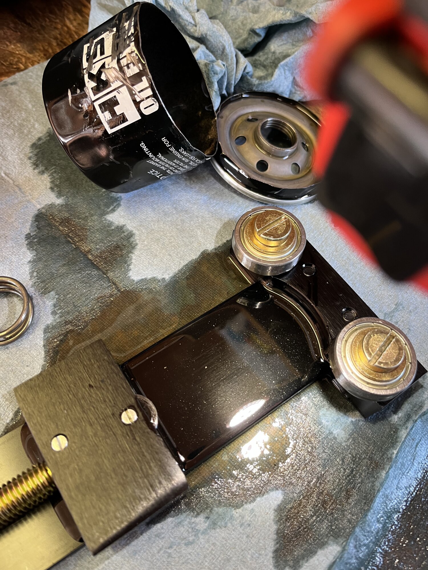

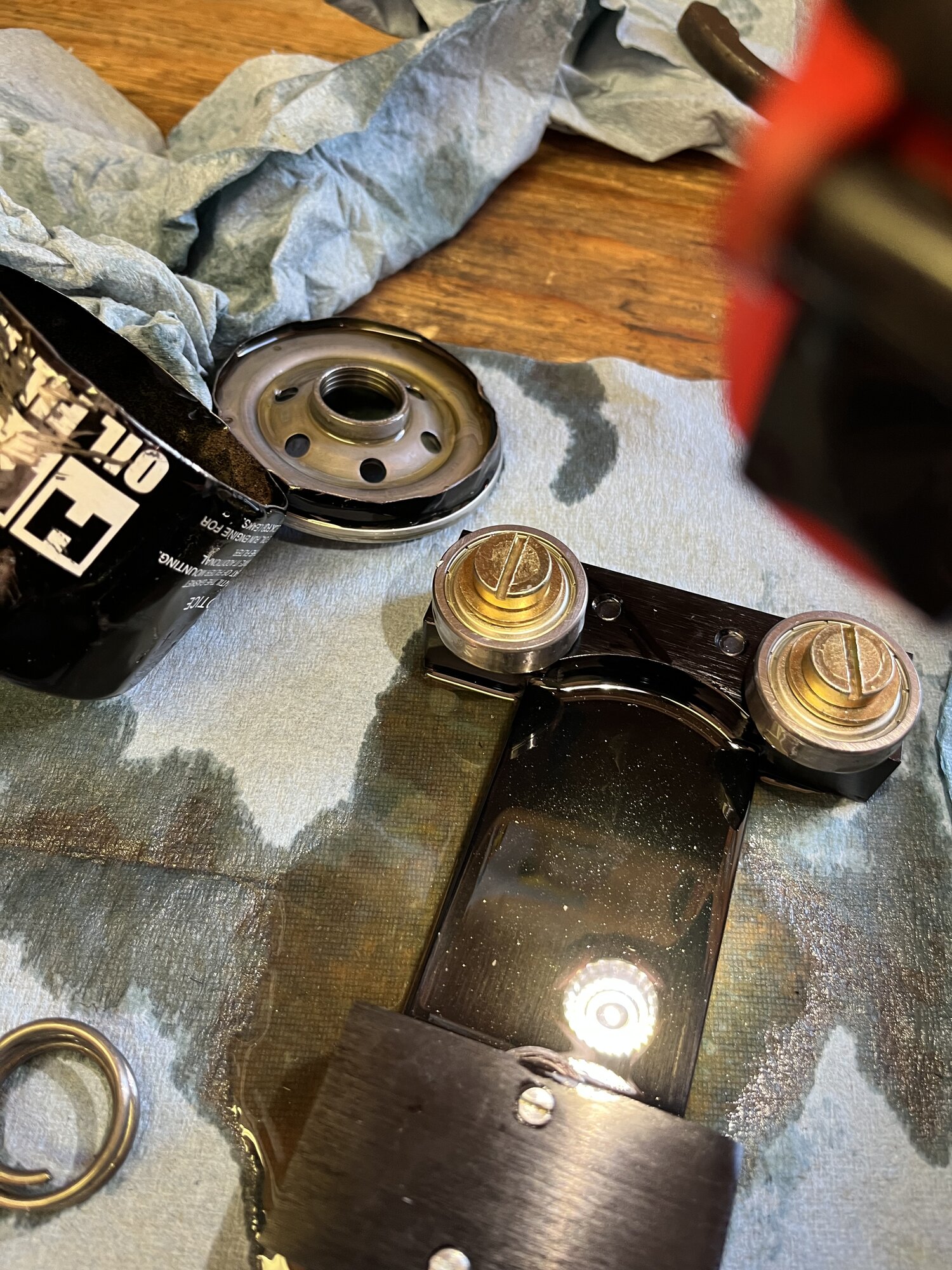

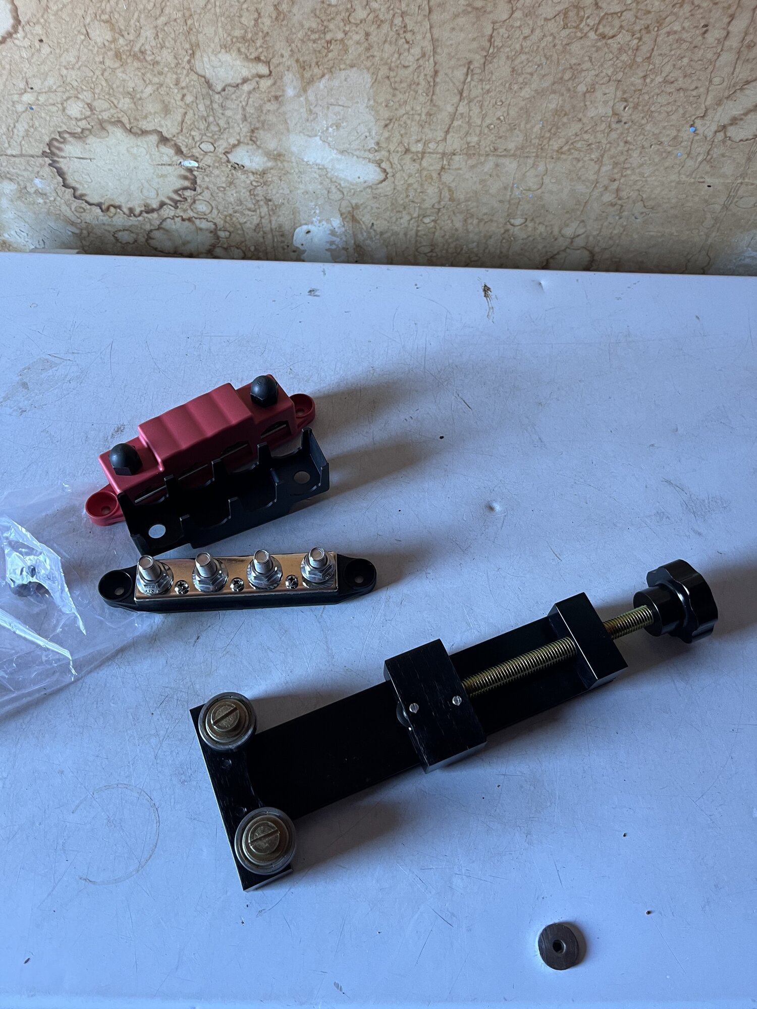

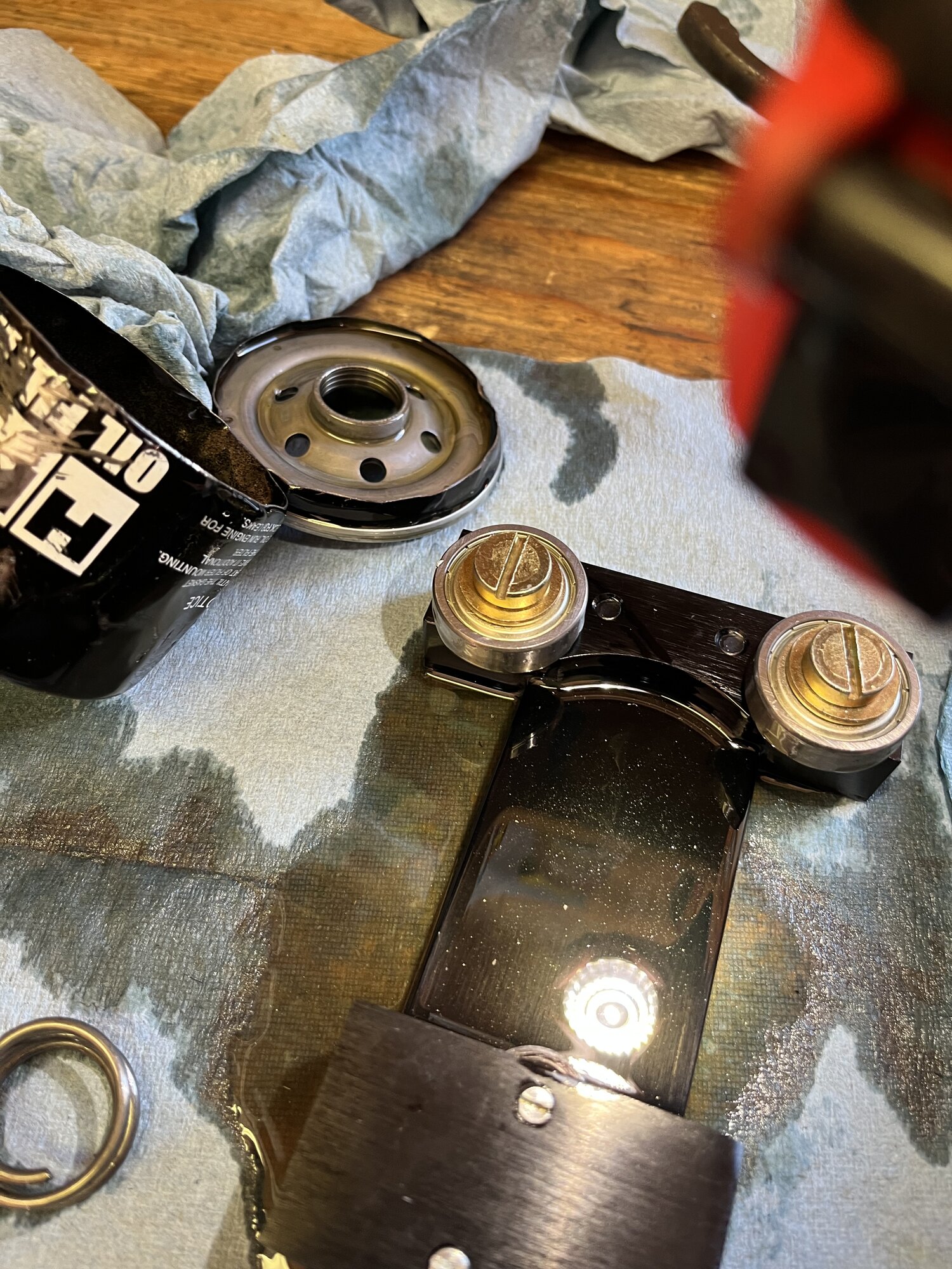

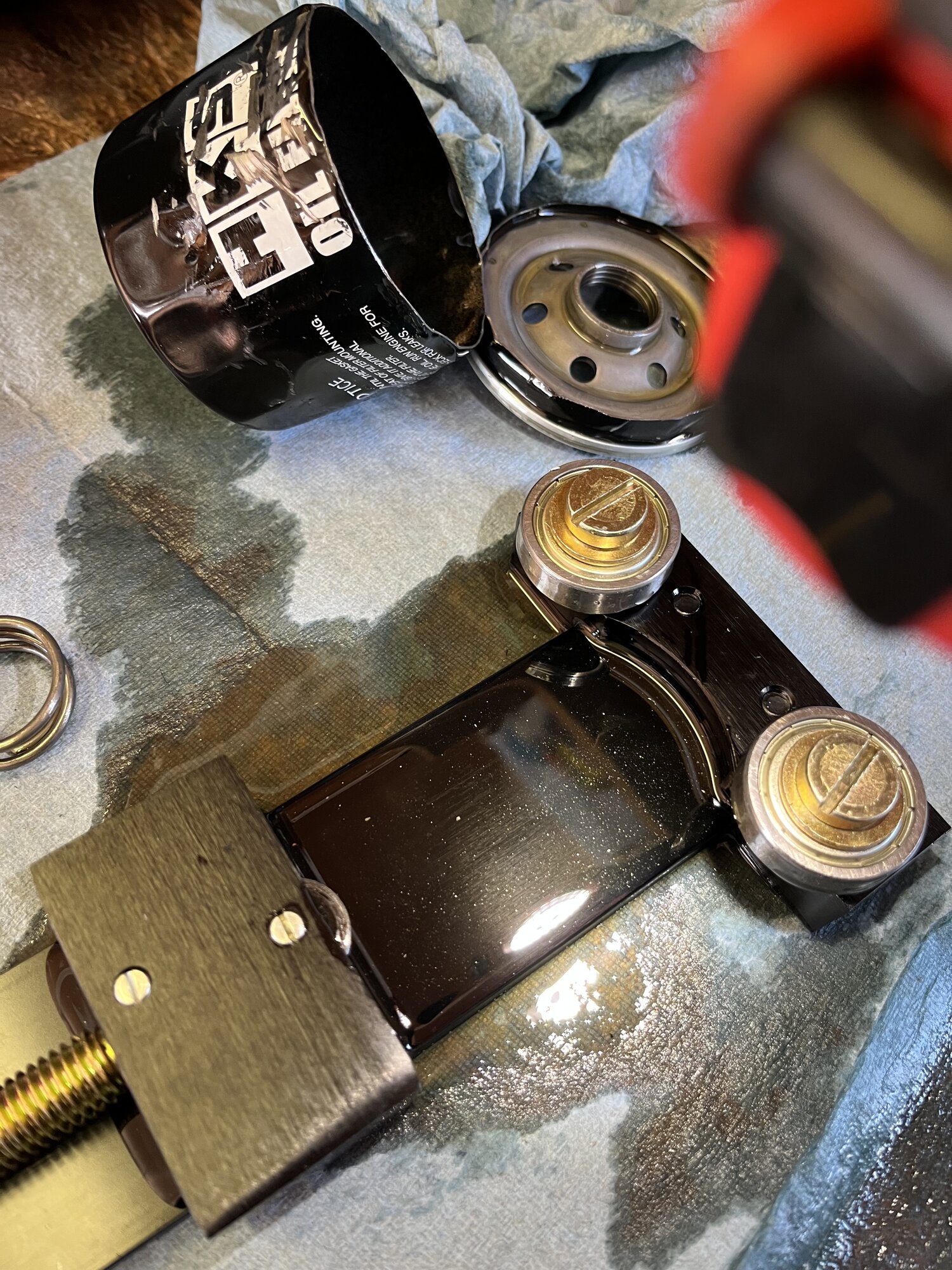

Well gents, today confirmed what I feared. Truth be told I wasn’t 100% certain I was going to pull the motor until I cut open the oil filter. Its funny all these years with a dsm and I just now got a cutter off Amazon along with a distribution block.
Using the cutter wasn’t to bad, similar to a copper cutting tool, anyways here’s what the oil looked like:cry:
Oddly enough I couldn’t really make out any bearing looking material in the filter paper, just some specs of black/metal that look like they came from the filter itself. I’m thankful I got a few years out of this motor, 1300 miles or so, I’m still assuming the broken oil squirters had a part to play. I’m honestly looking forward to tearing down the block and taking a look at the bearings, this also brings the opportunity to upgrade my wrist pins and lifters. I hope to be able to re use the crank/rods/pistons. Work is slow for me this time of year so I have plenty of time to wrench on the car, I might be able to pull the motor this weekend who knows..

That's unfortunate but honestly a good catch. Better to tear it down now while there's little to no damage and still be able to reuse parts.
What do you think that stuff is? Leftovers from a valve cover blast, coating from the inside of the oil pan, hmmm. Dam good catch man!

I think you are overthinking what you found in the oil filter and pan. I have seen and ran far worse. I would have a better gauge seeing it in person but, those pictures look just fine to me. You do realize some debris isn’t abnormal, right? I really don’t think I ever have perfect oil inspections.
I think you will be pleasantly surprised when you start pulling rod caps.

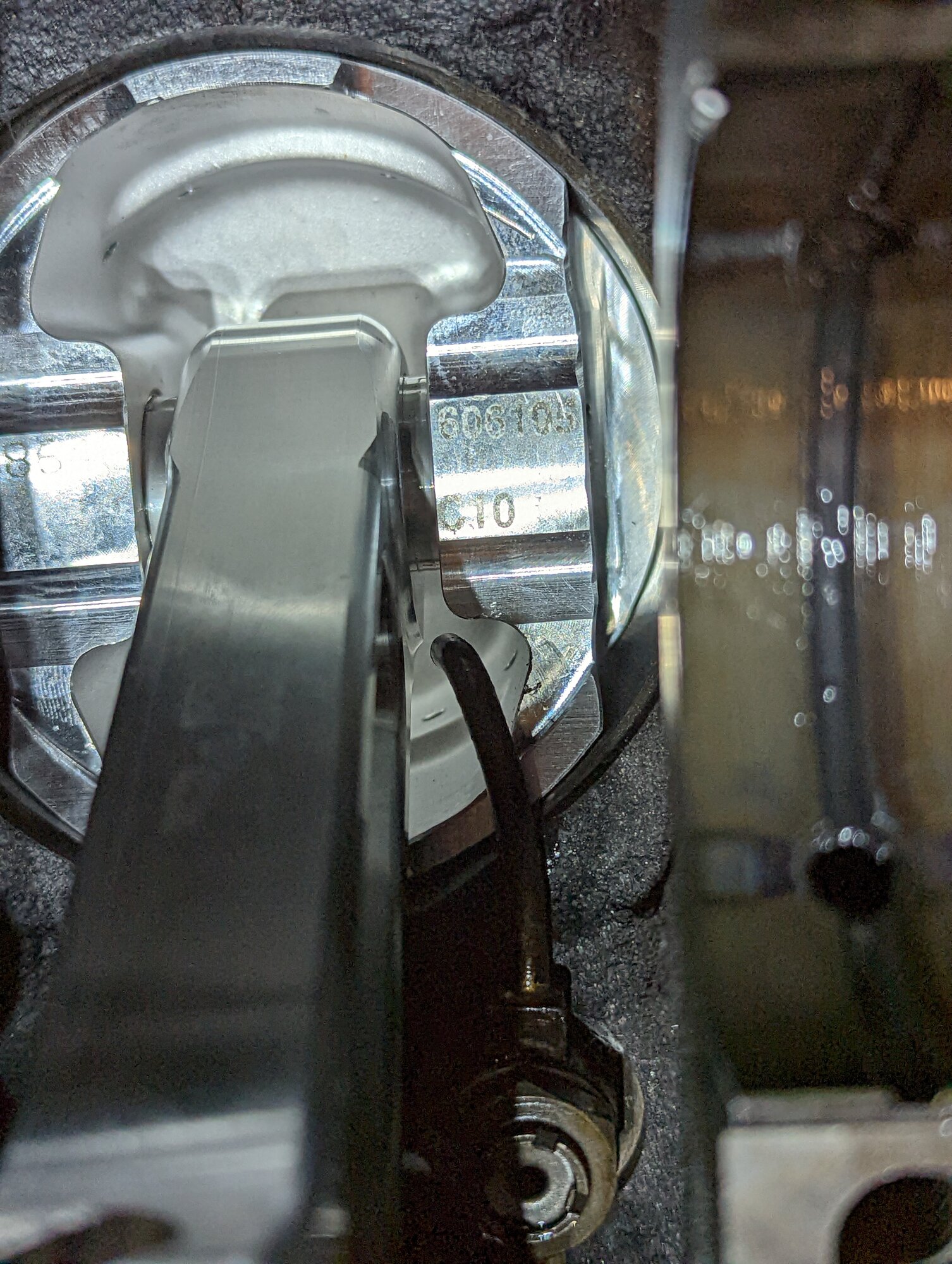

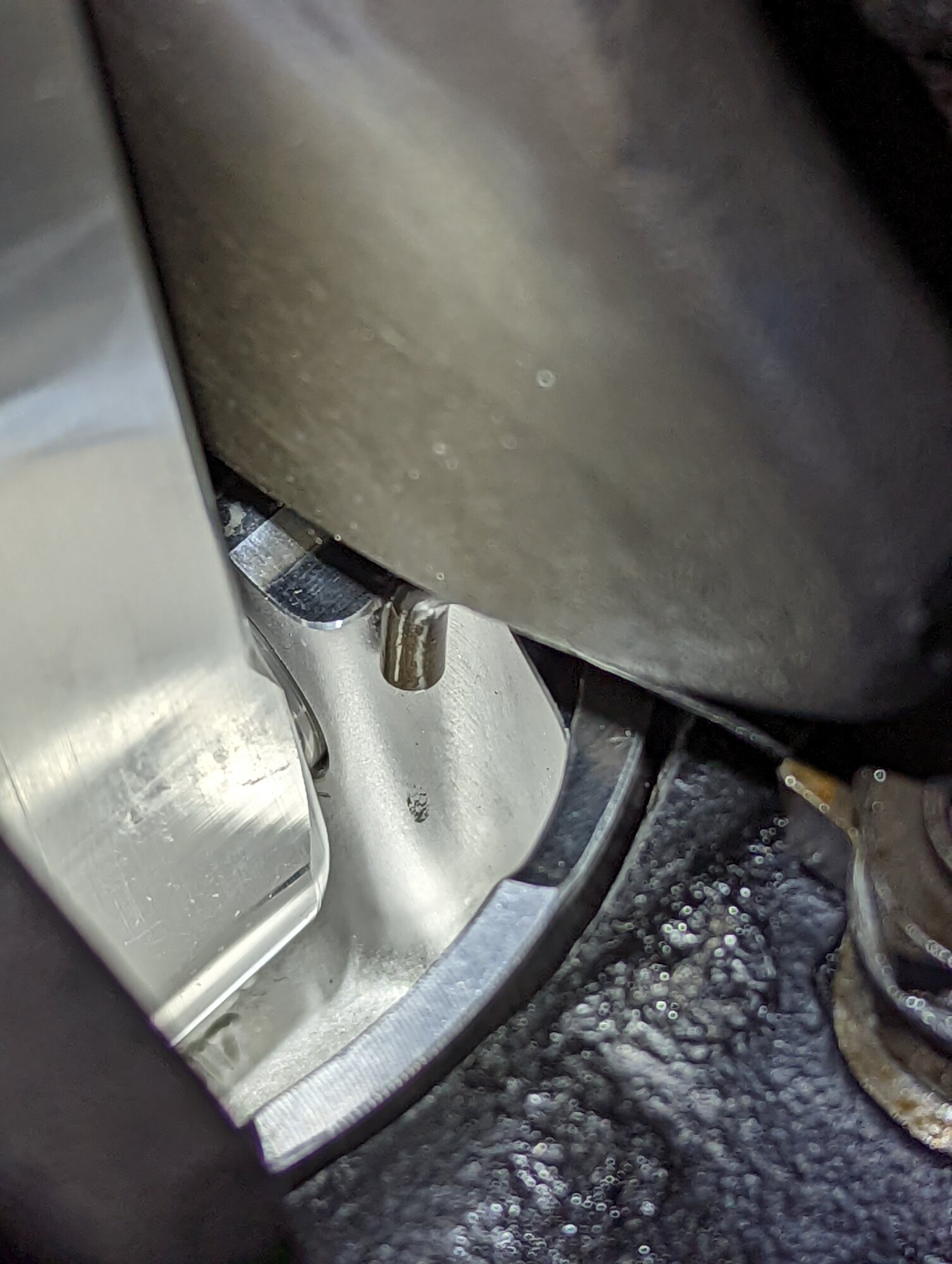

Did the pistons hit the squirters and break them or did they fall out? Either way they need blocked off.

I can’t say for sure how or why the squirters broke just yet, I would’ve thought if it was a clearance issue with the piston they would’ve broken long ago but who knows, and I agree I may not need the dowels either, I’ll also check the head to see if it looks like the washers were pressing in to it at 110ft lbs. Oil pressure would always settle around 28 psi or so once warmed up, 23-24 psi after ripping on it, this is on 10w-40 conventional. The current wrist pins are the .210 “extreme duty” in the manley’s, they sell a 21mm “turbo tuff” .250 I was going to upgrade to, might be over kill, but anyways I will definitely be doing a proper block off of the squirters:)

Curious as to why you say they need blocked off?
I’m assuming he’s implying that because they’re all broken in my engine LOL, I know it’s somewhat of a debate if you need oil squirters with forged pistons anyways, I’m certainly not worried about them with weekend spirited driving.

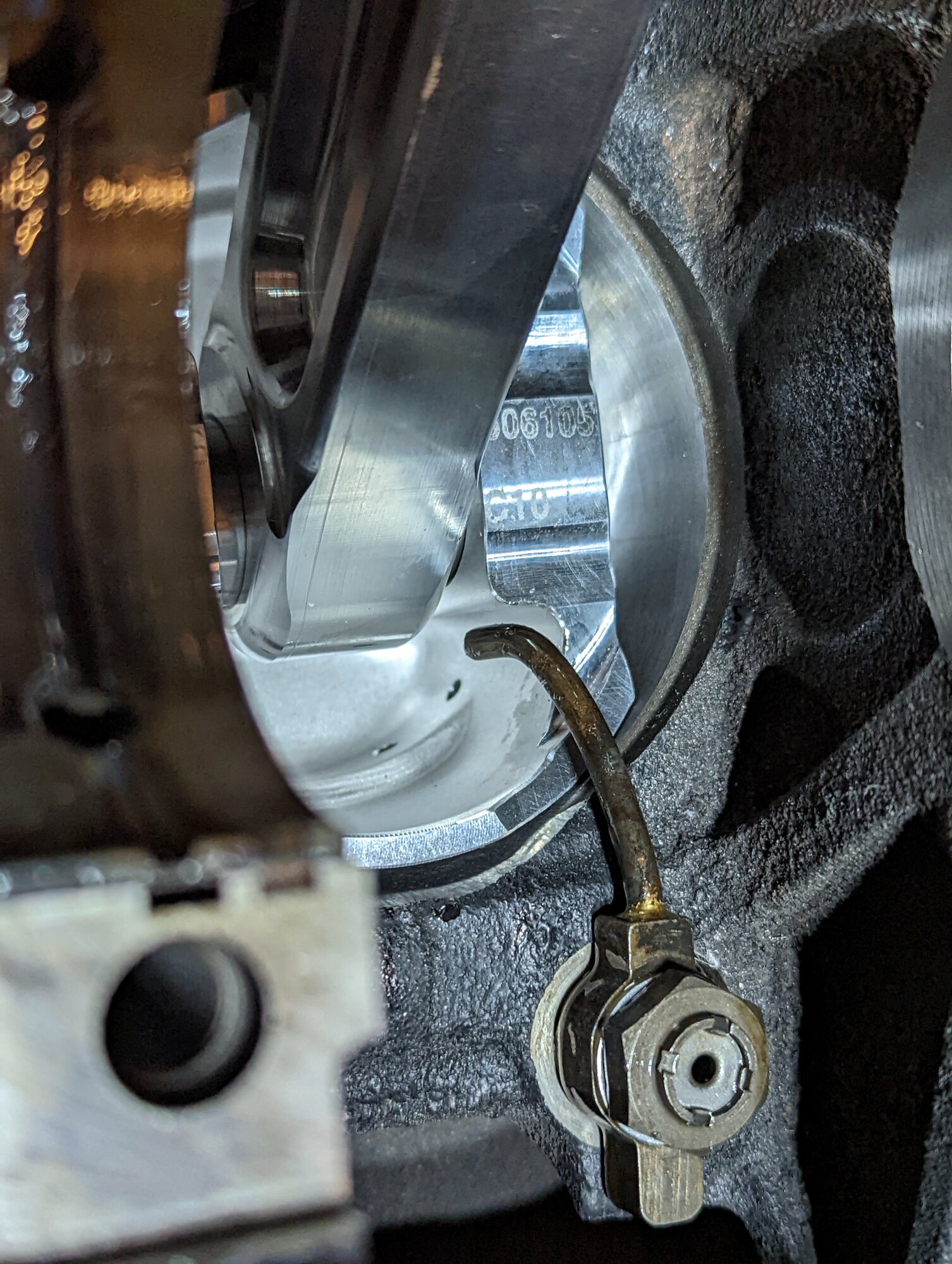

I've still got mine in and they're all intact, thankfully. It was difficult to get them sorted around the aluminum rods and pistons..
