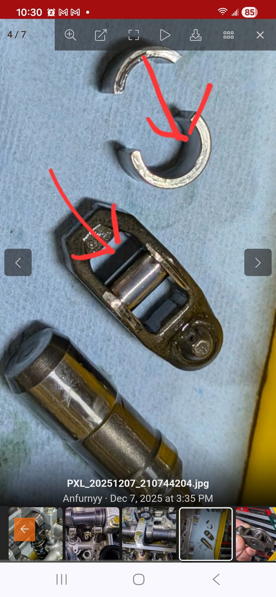

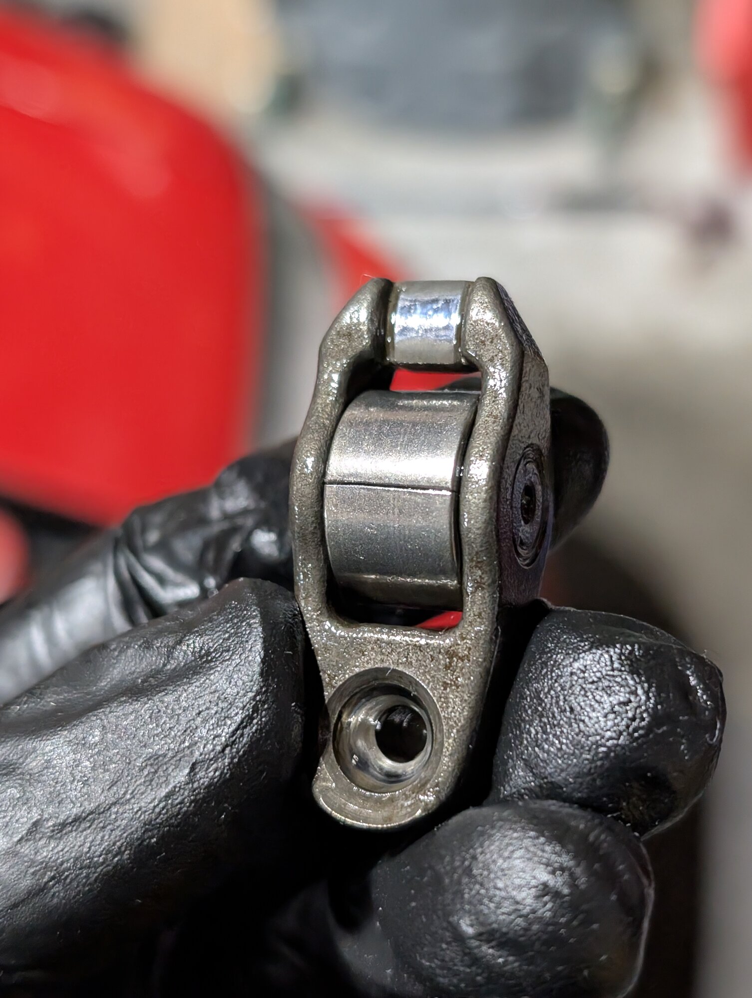

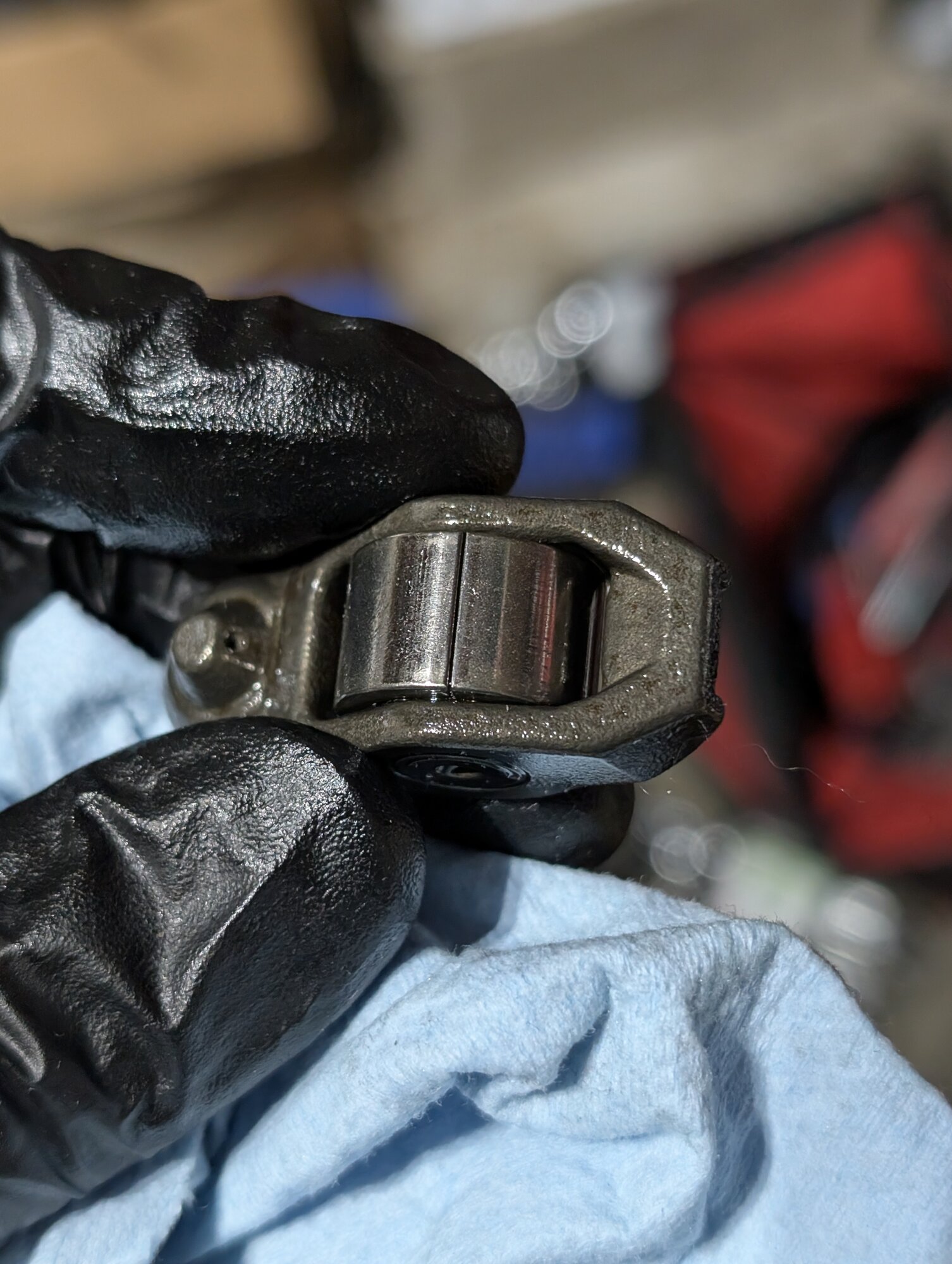

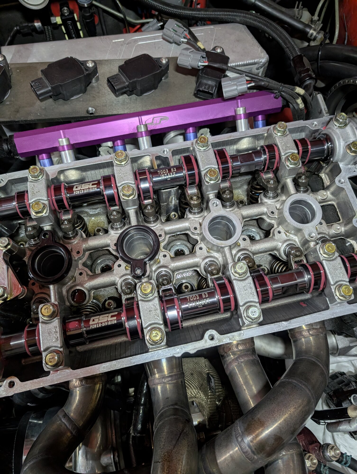

They aren't balls, they are rollers. Its funny there isn't a single one left up in the head. Count how many are in the pan and then how many are in a rocker. Account for them all. Best of luck! :thumb:
Are they really rollers? They look like 2 ball bearings but I did originally thing they were little needle bearings.
They are needle bearings. When I jumped time, it wrecked a few and they are all needles. They are as wide as the rocker center.

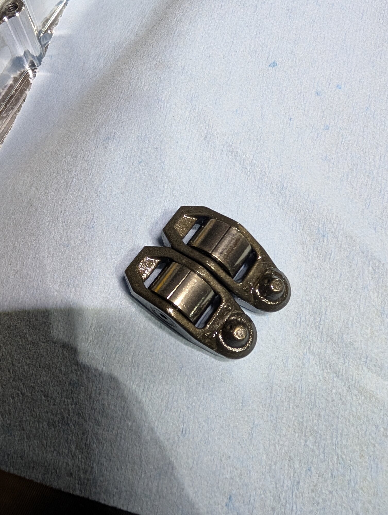

I am SO happy I decided to check all the rockers..
I found 2 more the outer bearing race were cracked on, about ready to go too. Swapped those out with spares.
I found a decent price on some evo rockers and snagged those up. Will be here next week and will probably swap to those.

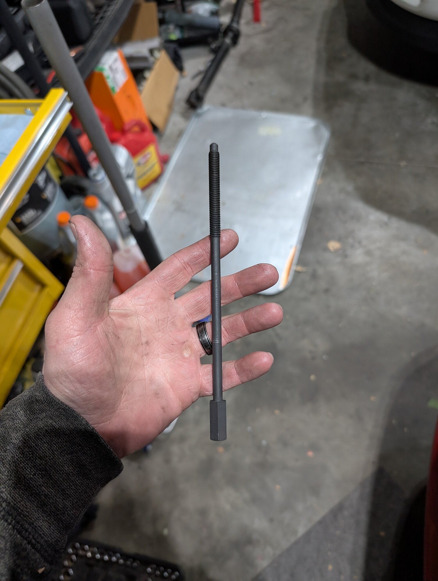

Pulled the timing cover. I'm gonna tell you hwhat.. this need tensioner tool/rod/bolt is SUCH a time saver when just pulling the belt. Now I don't have to dick around with the tensioner pulley.. I just screw it in to let the tension off the belt, pull the belt and then let the rod back out with the belt on and it goes back to the tension it was on.

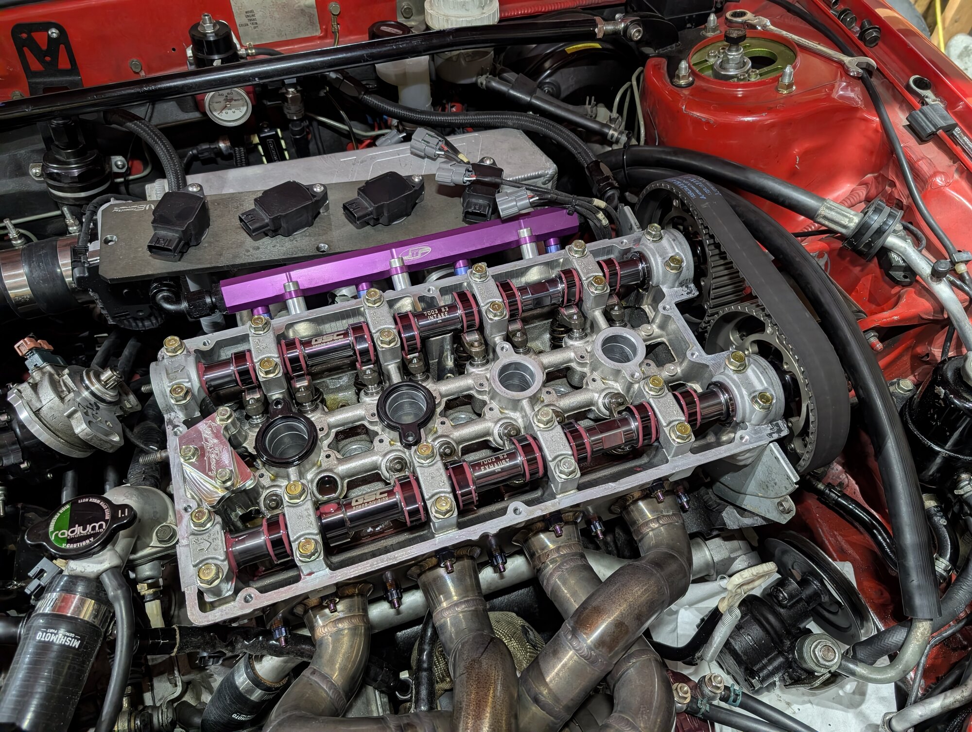

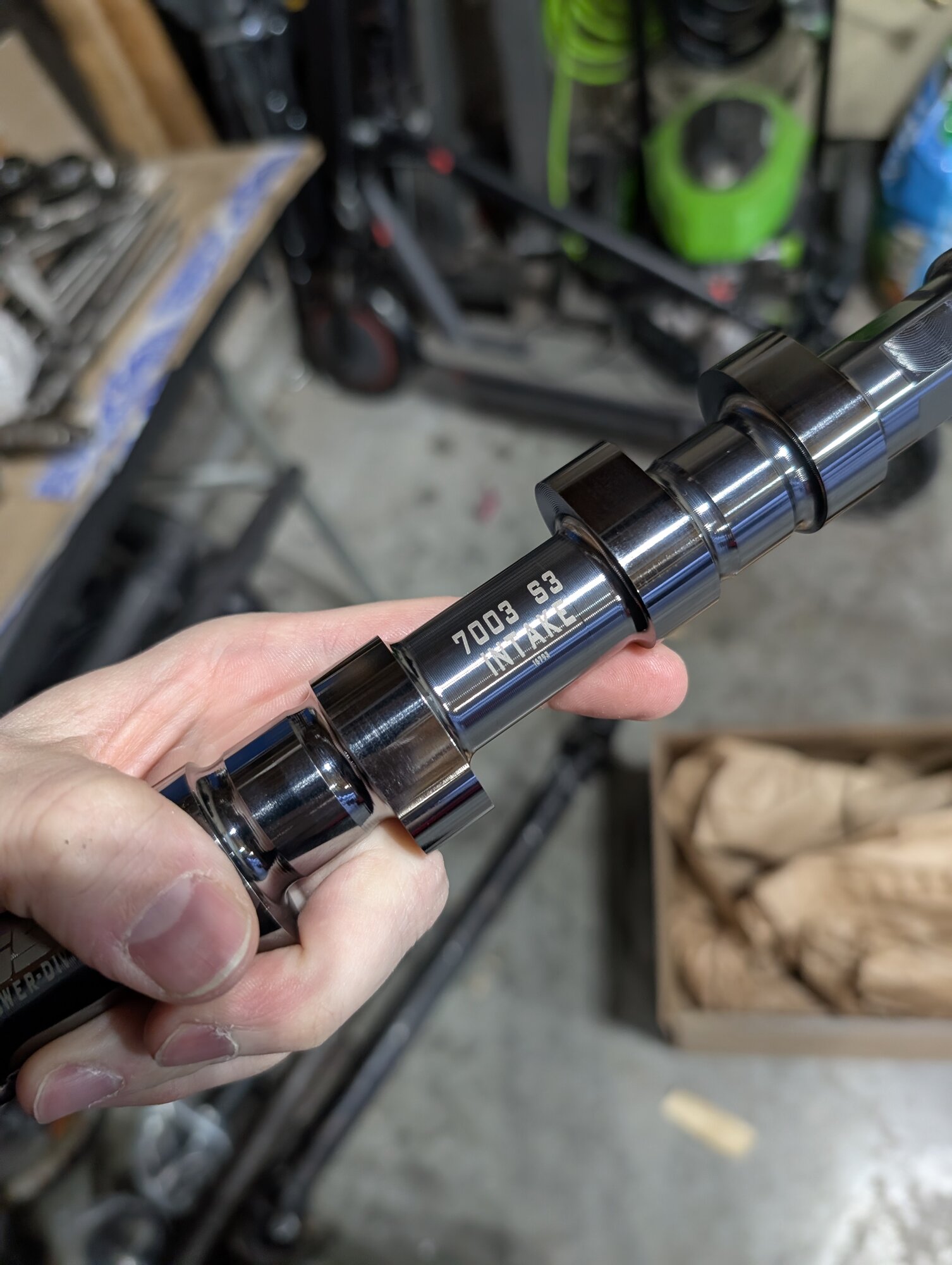

Anyways, new S3 cams in, timing belt back on. That's as far as I made it. Couldn't feel my toes after being in the garage for a couple hours. Single digits outside and after my garage heater was on for a couple hours it got up to about 45°?

The craziest part is I didn't even know man. It's crazy. Makes me feel like I took maintenance stuff for granted at this level. I'm definitely planning being a little more involved with maintenance.
You're a TROOPER!!! I'm glad you spotted others too. Any sign of the missing roller bearings? They're not "really" gonna kill anything except blocking sump area so get them out if you can. I'd hate for a crank throw to catch one and exit it out the pan somewhere.
I looked in literally every crevice I could find in the head and found nothing. Can only assume that the oil in the head dampened the "explosion" and they all got dragged down into the pan by the oil.. that's the hope anyways.

I thought my S2s were gonna chop but they really didn't honestly. Sounded fairly normal. Maybe slightly more than stock?
My hopes also :thumb: :pray:
You can tune the chop out or make it more pronounced. My Kelford 272s I could get to sound pretty "normal" but the 280R's are always talking.
I could do with less chop on these BC cams. There was a set of OG HKS 272s for sale on FB for $350 for exactly 20 minutes before they got bought. Damn it! Lol.

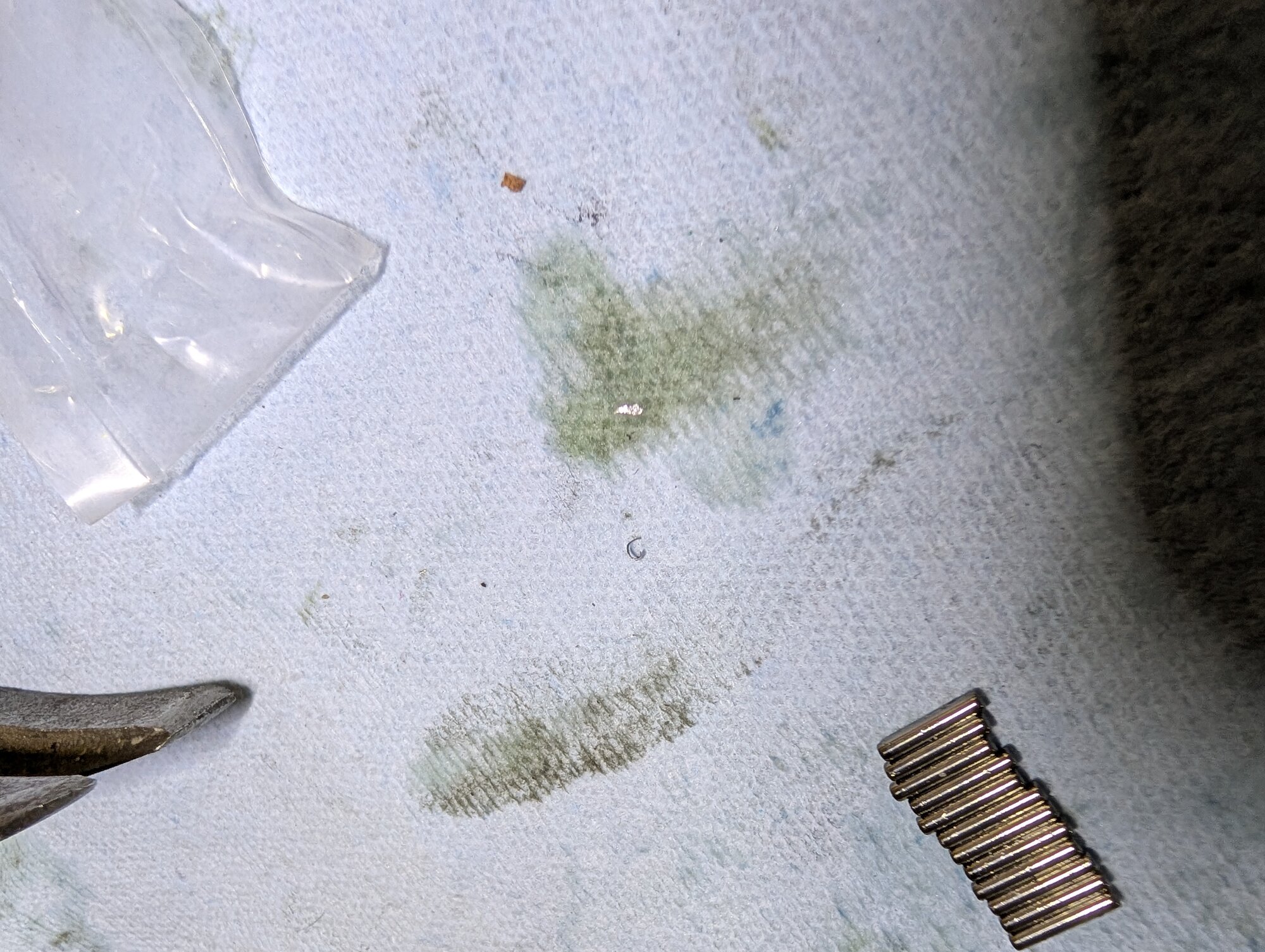

So we have good news and we have bad news.

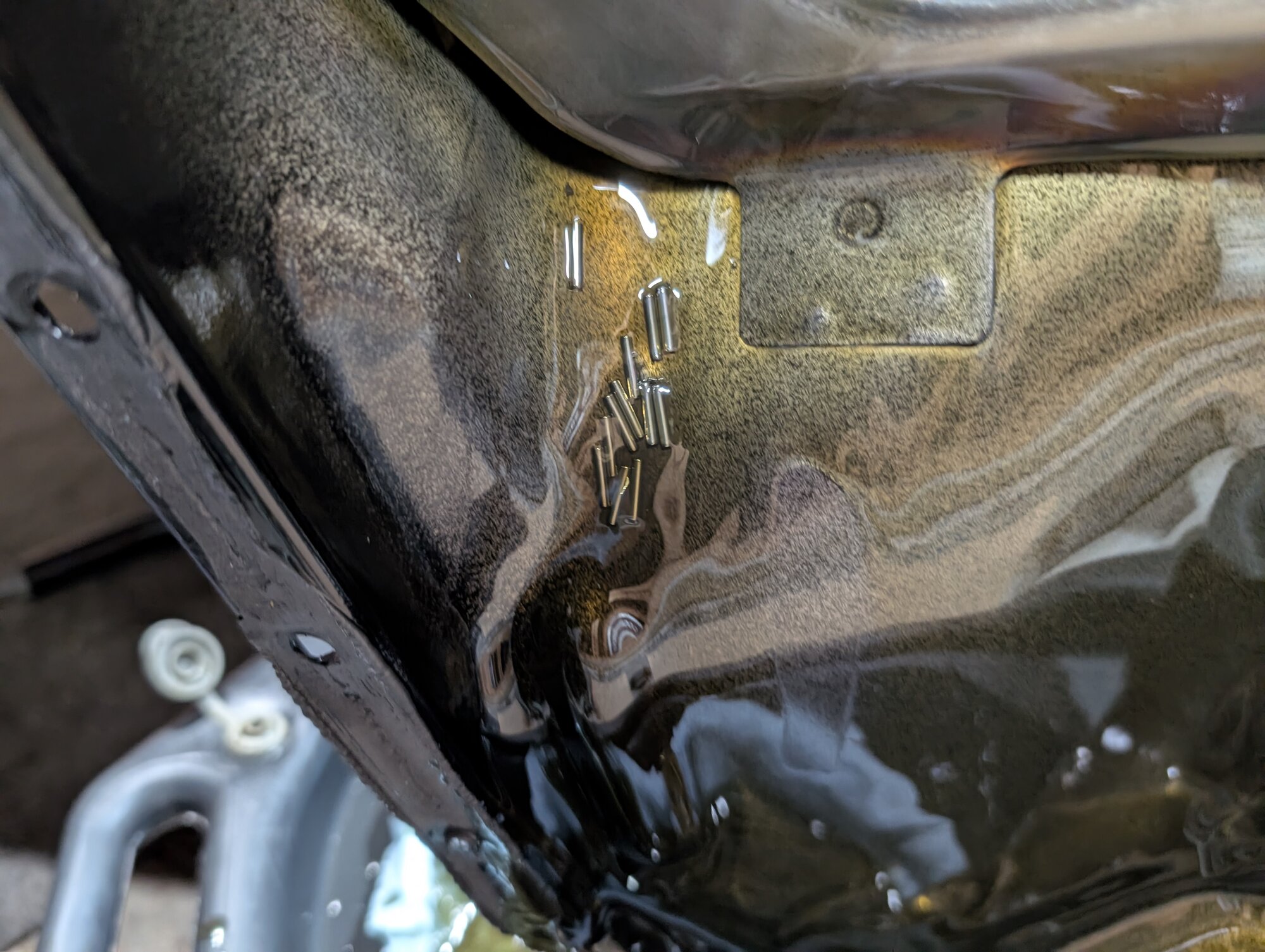

Dropped the pan last night.
The good news: I found the needle bearings!
The bad news: I'm short 4... They are nowhere to be found.

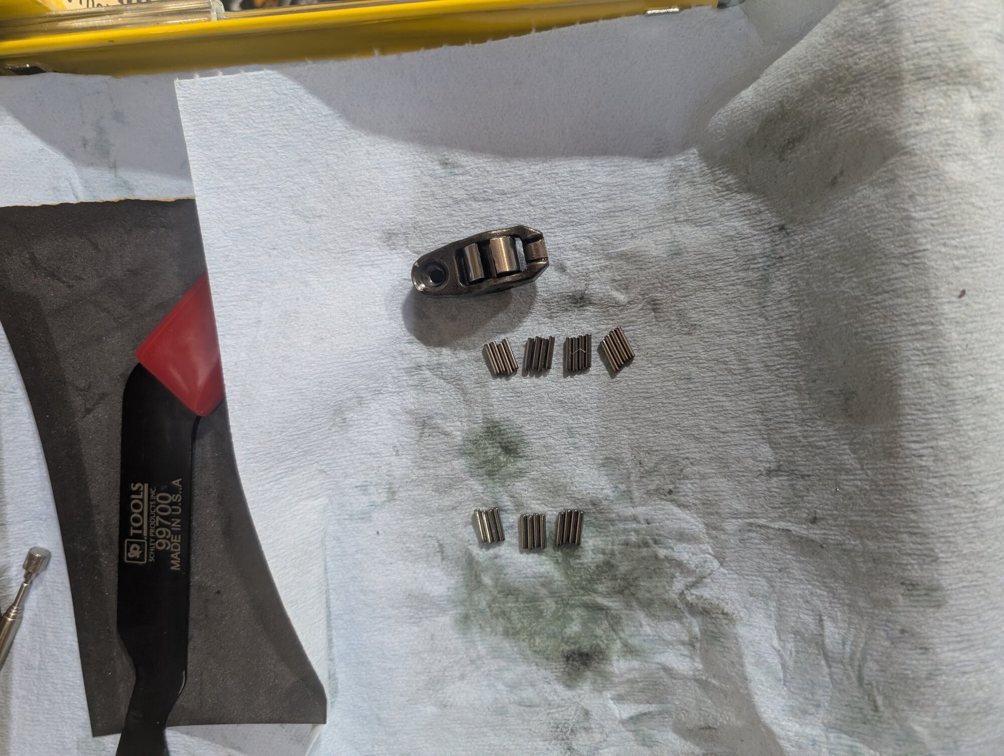

You can see here ↑, I broke open one of the cracked bearings on one and there are 16 needle bearings (top), I only have 12 (bottom).

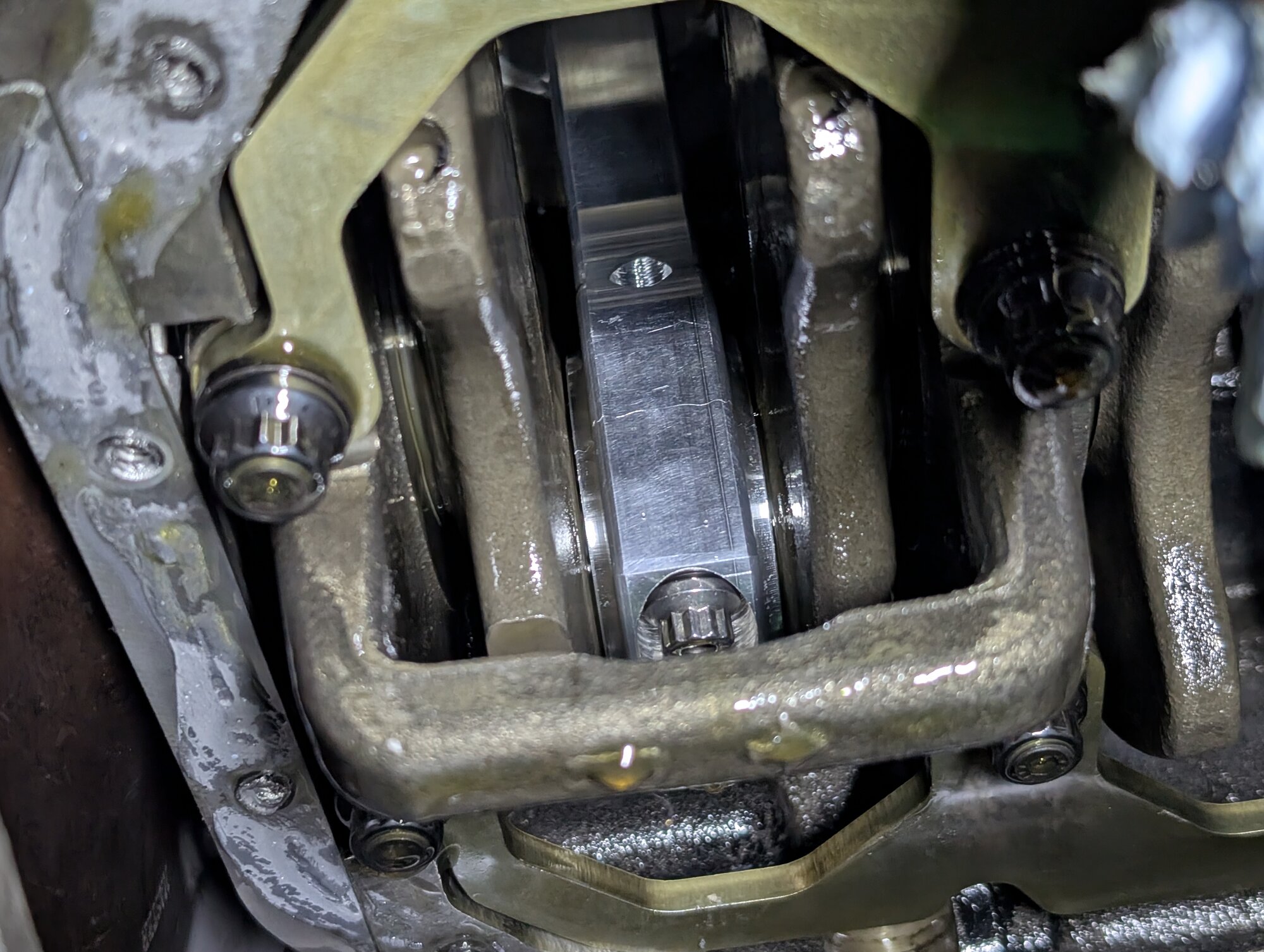

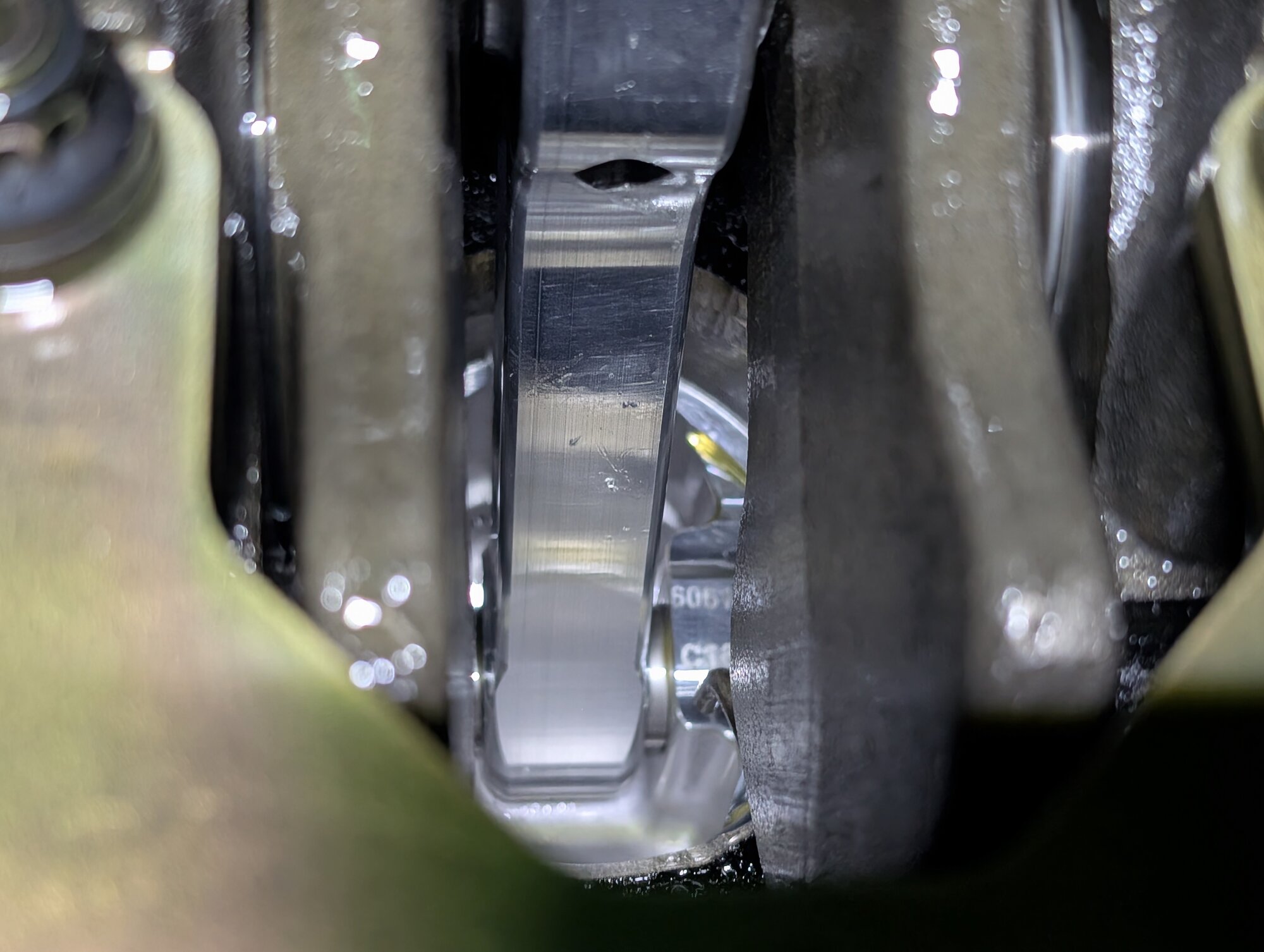

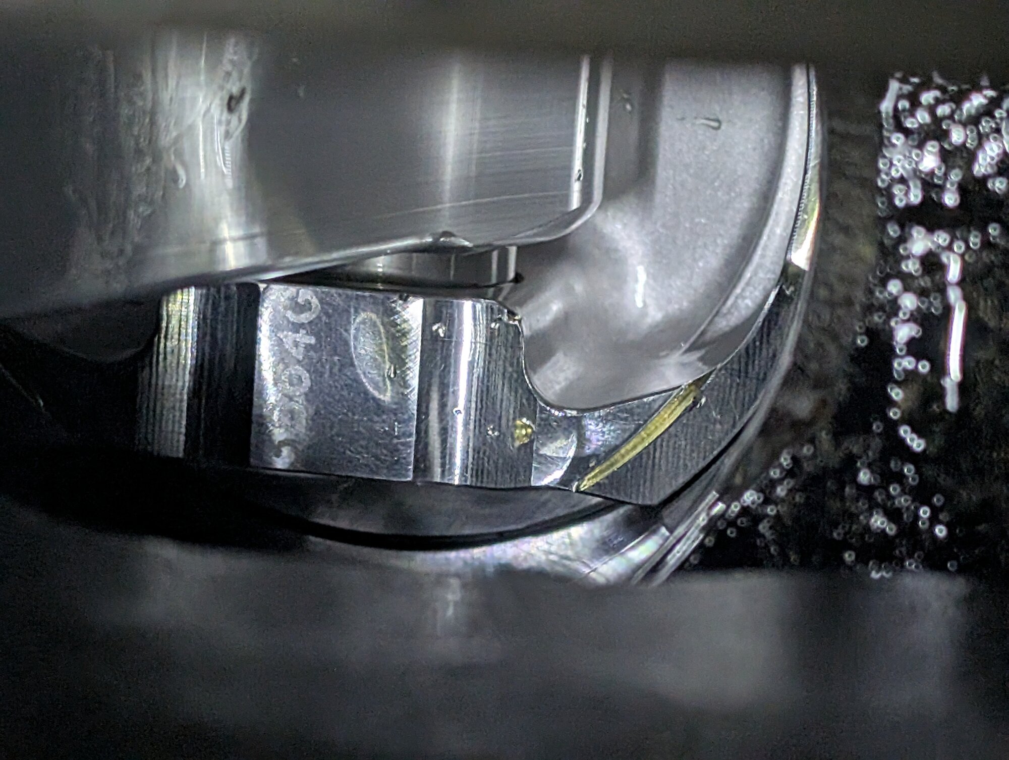

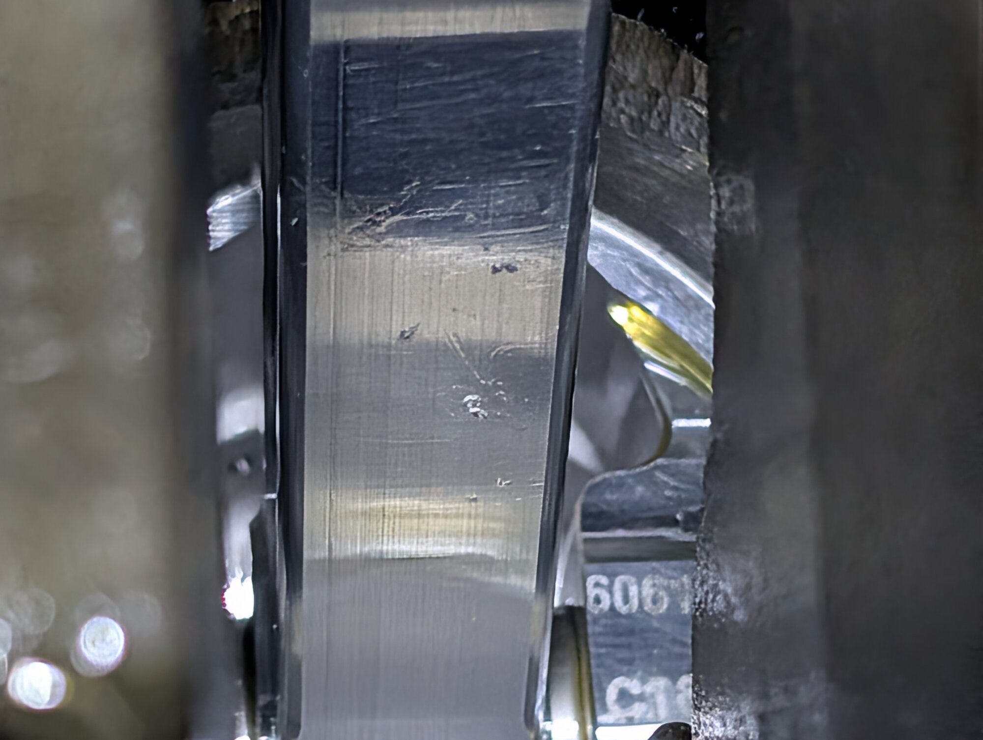

I inspected everything in the bottom end and found some suspected evidence on where they might have went: obliterated. There some dimples on rod and bottom of piston #3. Nothing significant or even enough to make me, personally concerned.
PXL_20251216_021015217.jpgPXL_20251216_021225954.jpgPXL_20251216_021229774.jpgPXL_20251216_021437260.jpg
I found nothing else in the pan, no debris.. nothing. Went magnet fishing, nothing. Poured a whole quart of 5w-30 in there and sloshed it around hopefully to grab a stuck one and nothing. Came out clean.
I DID find one small flake of what looks like aluminum stuck to the picking screen.
So the missing needle bearings are either:
A) Still in the head.. somewhere.
B) Obliterated
C) Maybe they somehow drained out with the oil when I drained it and I missed it? I didn't watch it the whole time.
So now, lifter lubed up and bled. Rockers all accounted for, new lumpy boi cams in, timing belt on. Today hopefully I get the pan back on without much fuss and we hear this ol girl purr. I'm also really curious if this properly functioning rocker is going to make a performance difference or not.
If the cylinder head is still on the block, then maybe the missing needle bearings are stuck between the head and the block. If you have a long small head magnet, put it tinto the all oil drain holes in the head. That's where I found a couple of it when this happened to me.
I'll definitely check there. I visually looked but didn't see anything.
Those needles will hide in crevices in the head for sure. Use a good magnet, as suggested, and see if it will find another 1 or more. I had 3 that were broken and they were in little places and grooves. You could put a super magnet on the bottom of the pan to try and capture any if they get in the oil flow. They won't get through the pickup screen. You may find one in an oil change. I know you must be worried but I don't think they are going to hurt anything, but in the back of your mind, you are always wondering and bothered by it.
