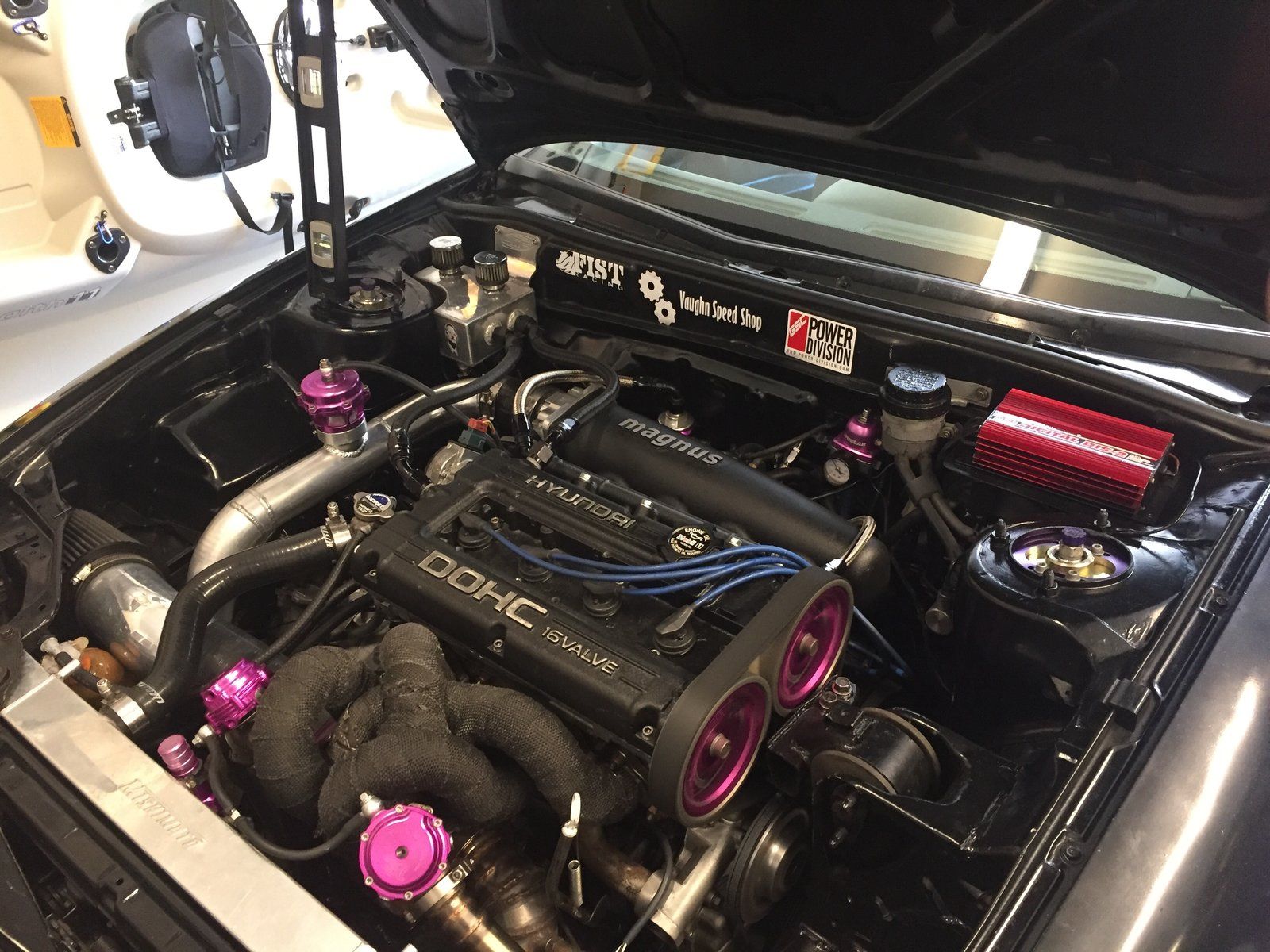

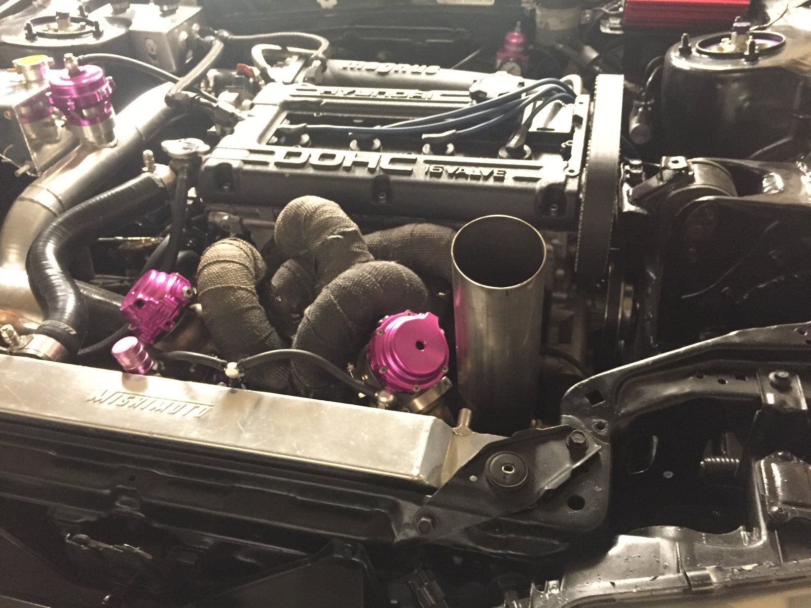

Tried my hand at wrapping the manifold with fiberglass. Didn't do a very good job and it took forever but hopefully it'll keep the temps down . There was a few areas that the pipes were so close together that the wrap couldn't make it in between which made it tricky .
Still think it looks better than no wrap

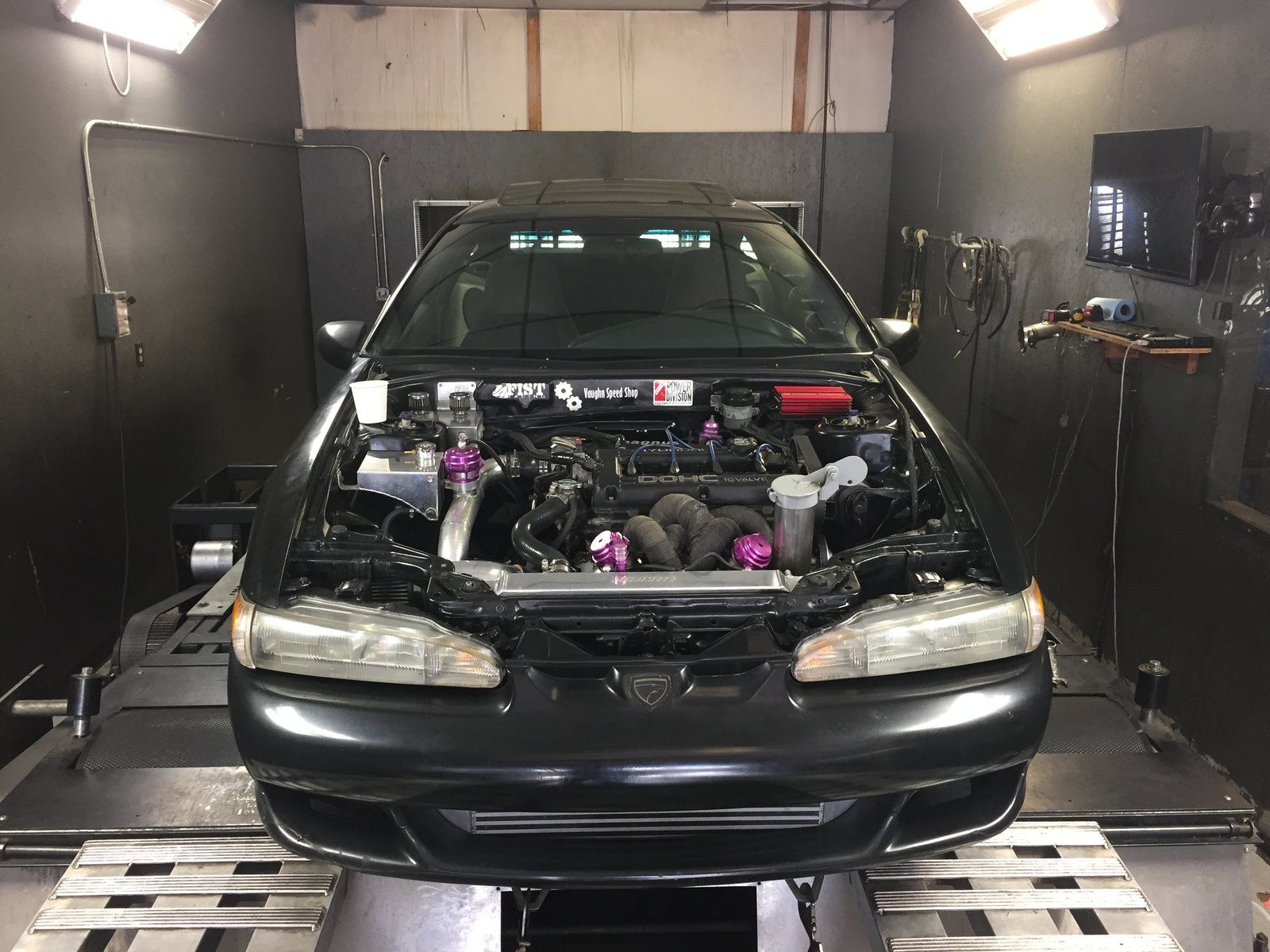

So yesterday I noticed the cooling system pressure was a bit high and went ahead and changed the headgasket before the dyno.
Dyno day is here!!
Went to the dyno, took it slow with the tune and had 0 issues until about 32psi when it pushed all the coolant out of the overflow.
So we let it cool off completely and retorqued the studs. Surprisingly it actually helped a lot. It pushed coolant still but much slower. We could make about 5 full 3rd gear pulls before the overflow was full.
They explained to me that it would not make as much power as last time because they had just recalibrated for the dyno. So ended up making 572whp on 42psi. Haven't ran it on the street yet but I'm going to guess that a good bit more power than last time with the bigger housing and 5psi more boost. I felt like we were pushing our luck so I had him stop there. Going to retorque again tomorrow and see how it goes on the street. Really hoping to get a 9 sec pass out of it.

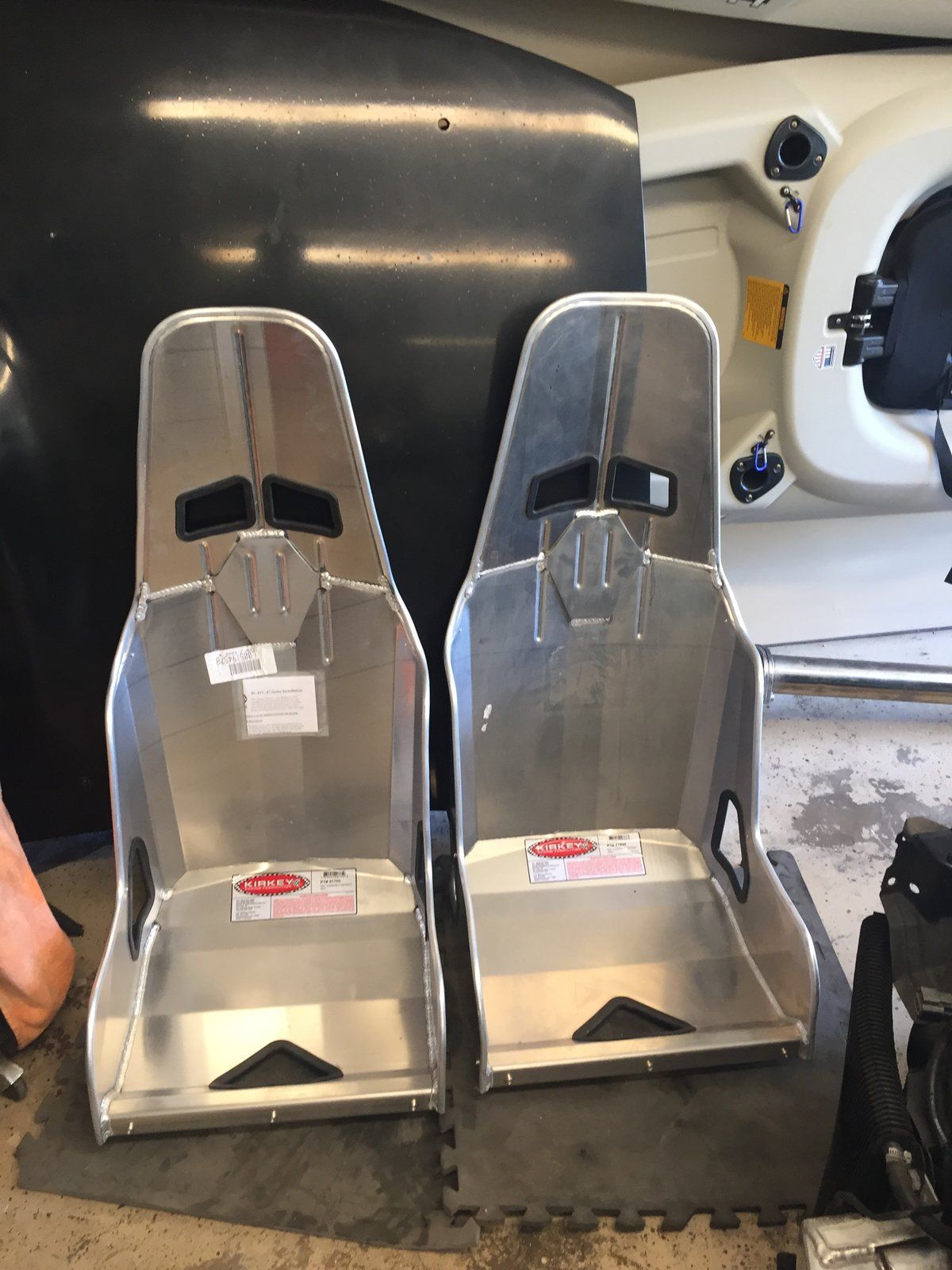

3. Picked up some kirkey seats off Craigslist brand new for 200.00. Going to get those installed and drop all the seat weight and auto belt weight.
