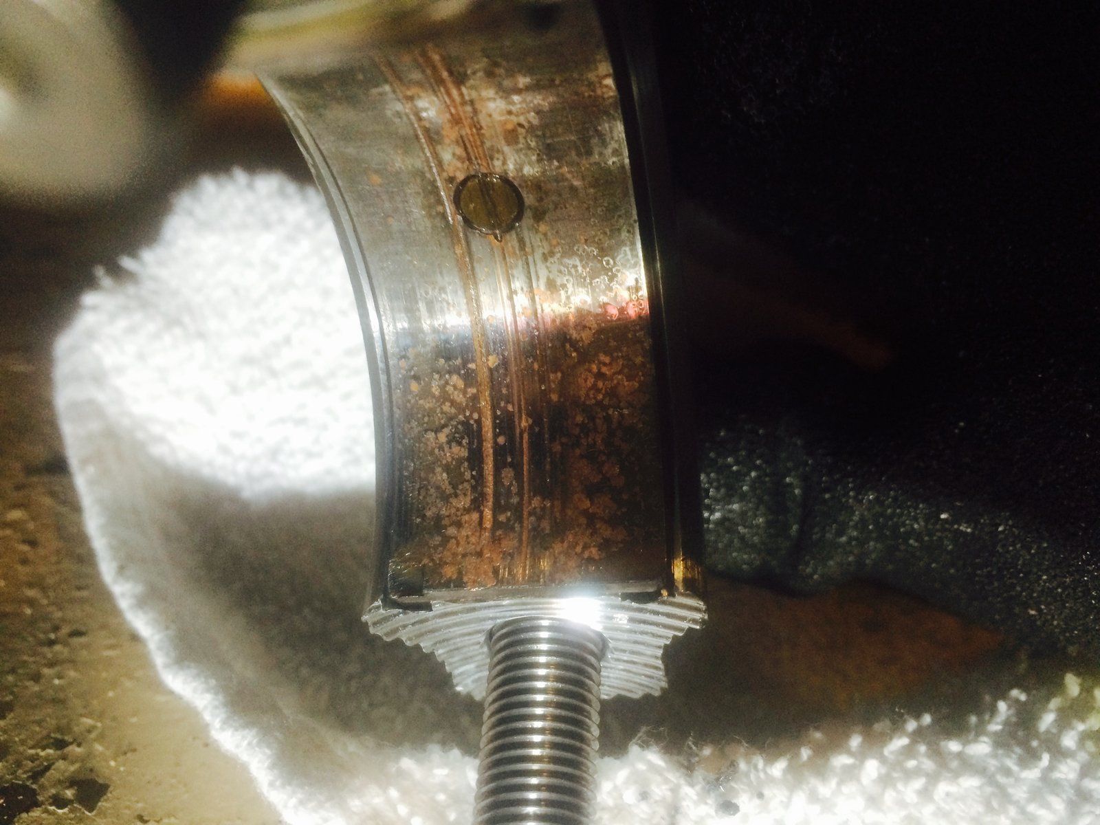

Here's the only pic I took of the engine before I sent it off. Dinged up rod bearing.
It will get there just be patient. What was the issue with the rod bearings? I thought you had a coolant issue?
Got a whole new block to fix the coolant issue . Then was loading the car onto the trailer to go tune it and it started knocking !! Crazy .
