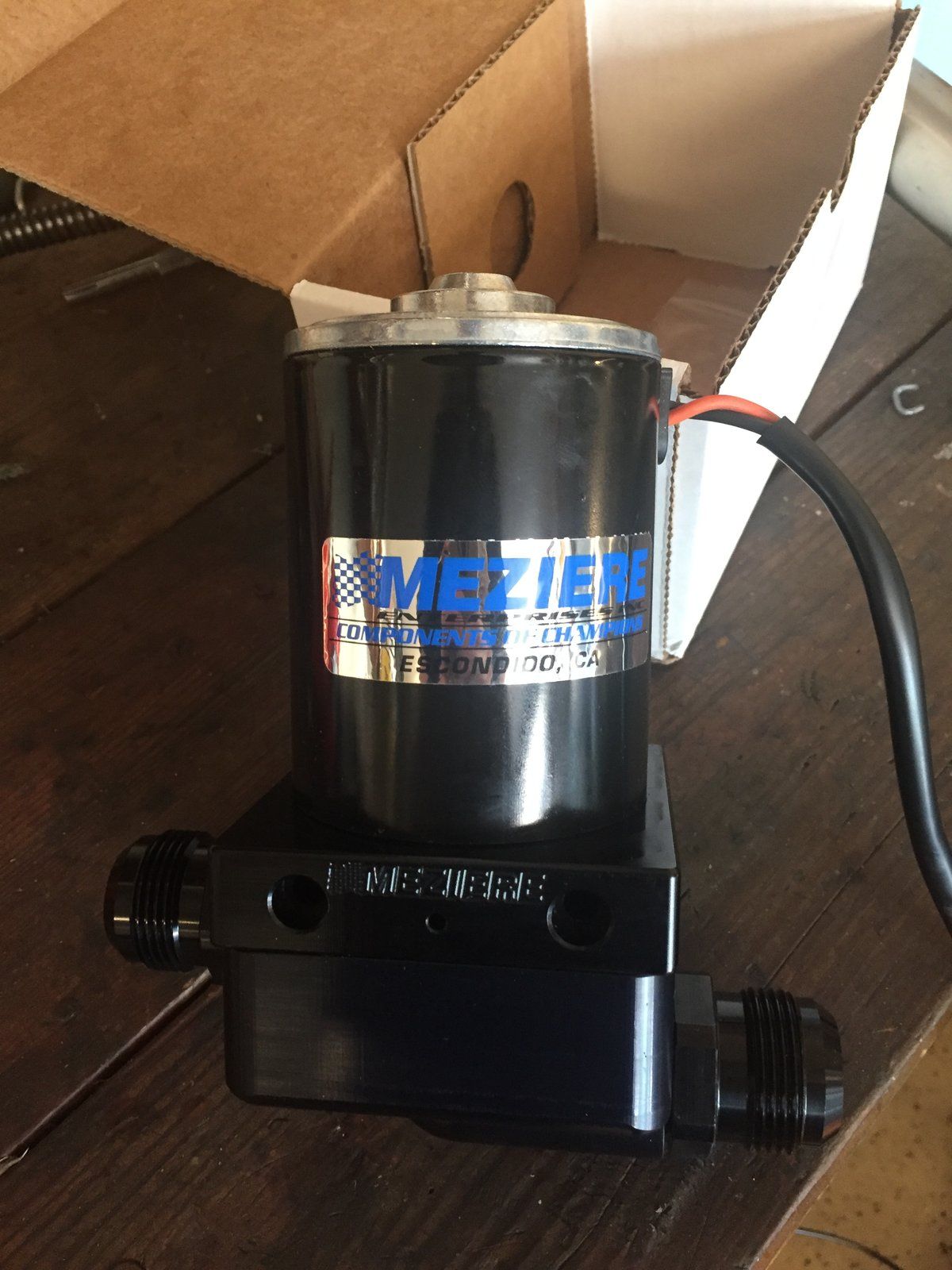

Can't wait for some parts to show up. Got the water pump and fittings in today.

I lost around 40 lbs doing my seatbelt delete, amazing how much that crap weighs! What's that meziere pump rated at?

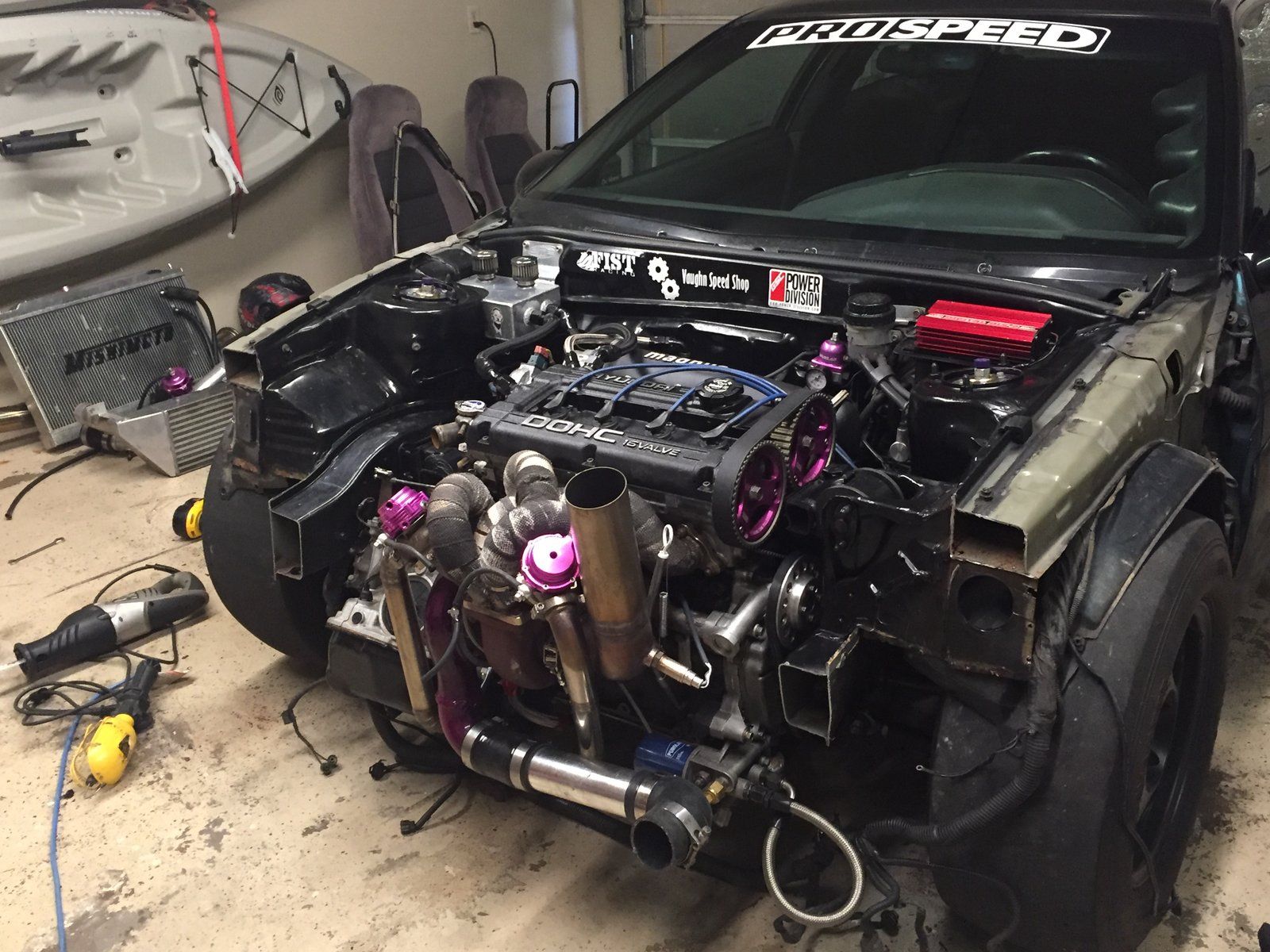

Roughly cut the front end off. Just have to get the engine out of the way to make the final cuts.
Even with the chromoly Crossmemeber with the solid mount, and no crash beam it weighed 51 lbs bare. !! So there's a good amount of weight to be saved here and it is way easier to work on.

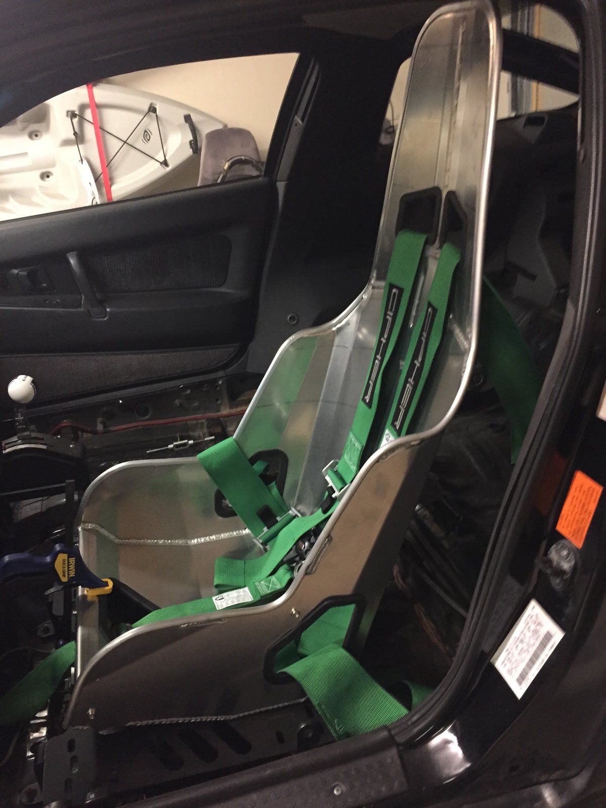

First mockup on the kirkey, this is actually the passenger seat bracket, still waiting on the shipping for the drivers. Harnesses are great! Very happy with them.

20GPM. I was really surprised when I removed al the auto belts. Just that lab belt alone weighed a ton.

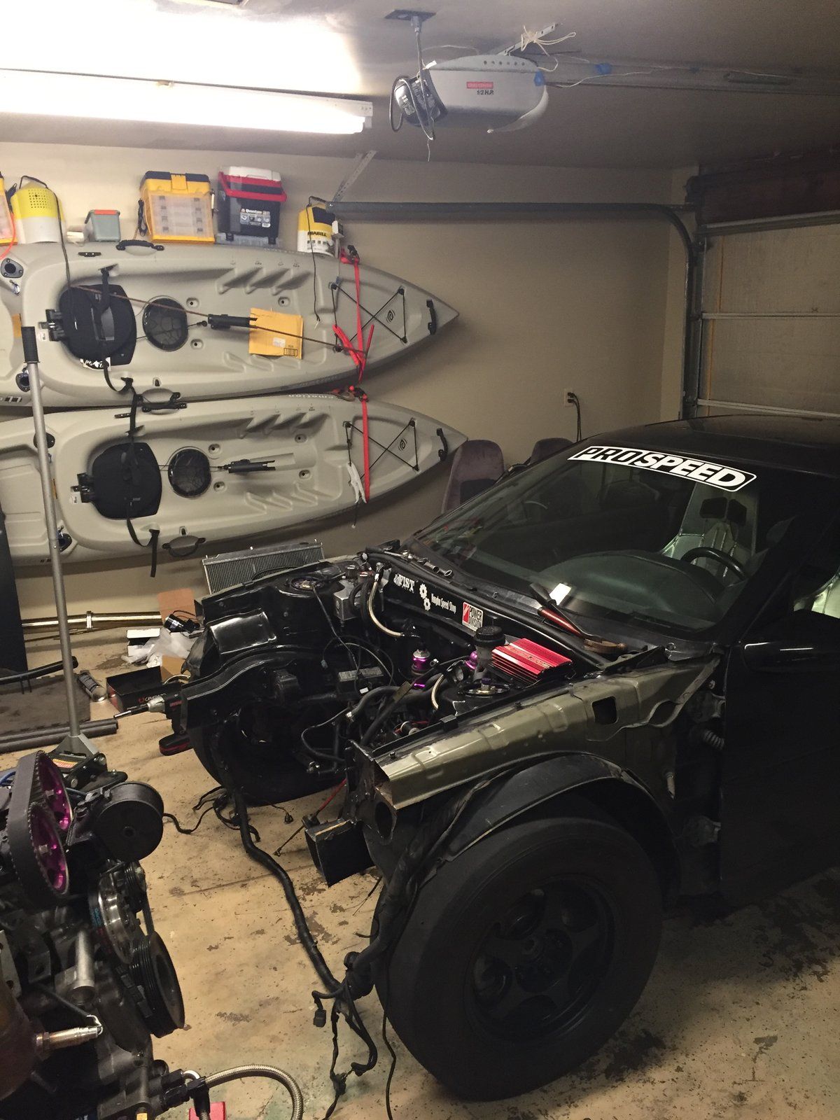

Pulled the engine and trans today and I'll get it all disassembled and to the New machine shop tomorrow. Then we can start the front end and seat mounting.
