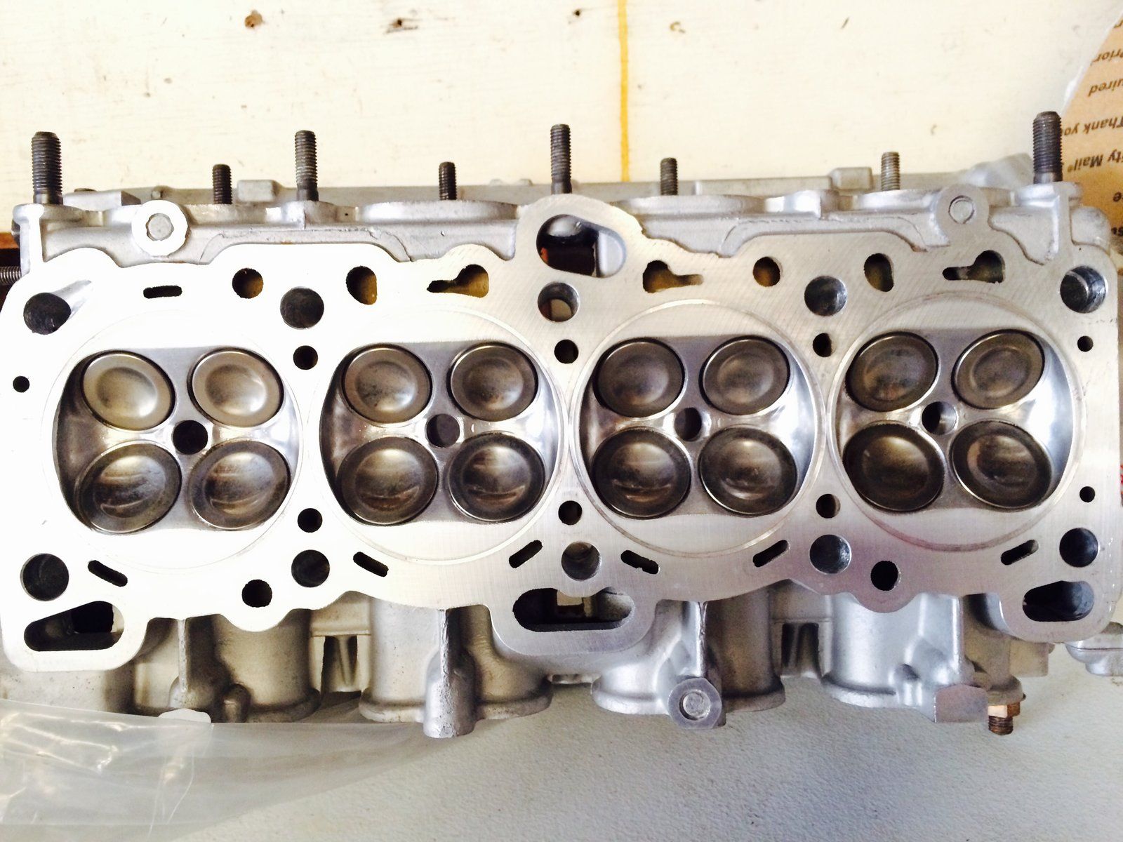

The 3000gt guys mill out the area under the fire ring, weld it solid and deck the head. There is still plenty of water running through the heads, but the head deck is much less likely to flex.
A local shop here in DFW that cut their teeth on the 4G platform back in the day will do that with 4G heads.

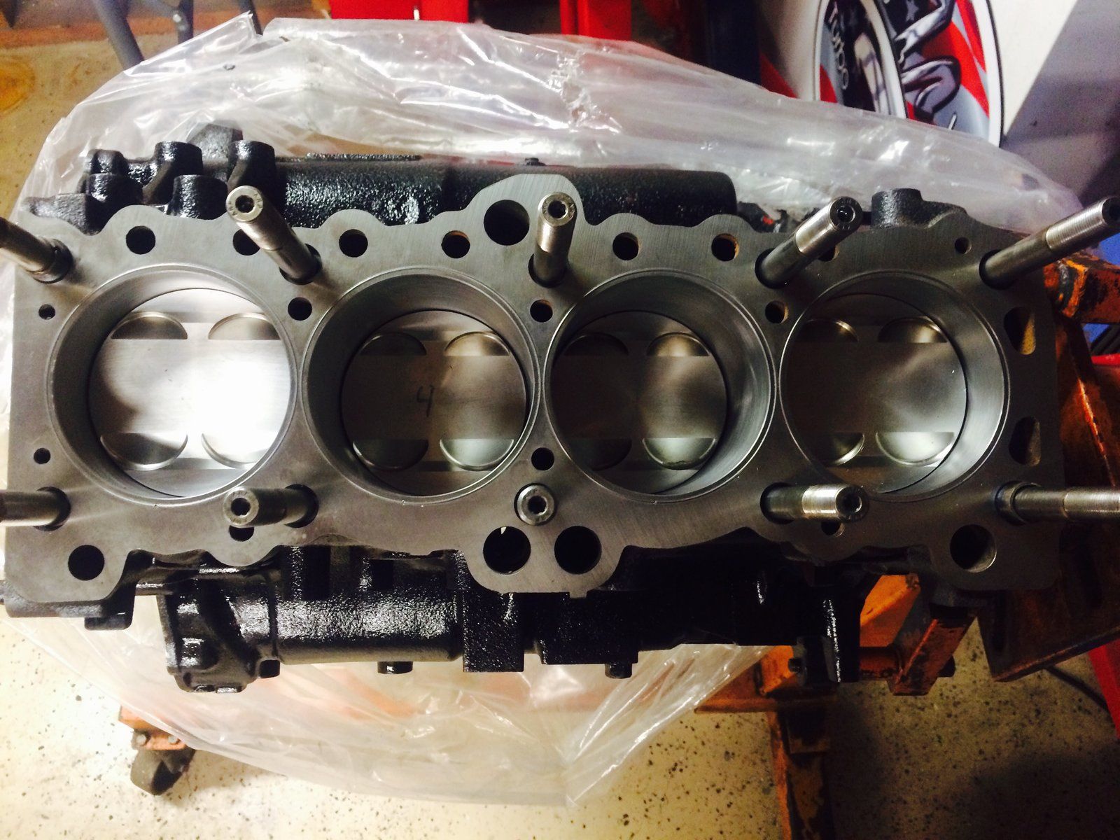

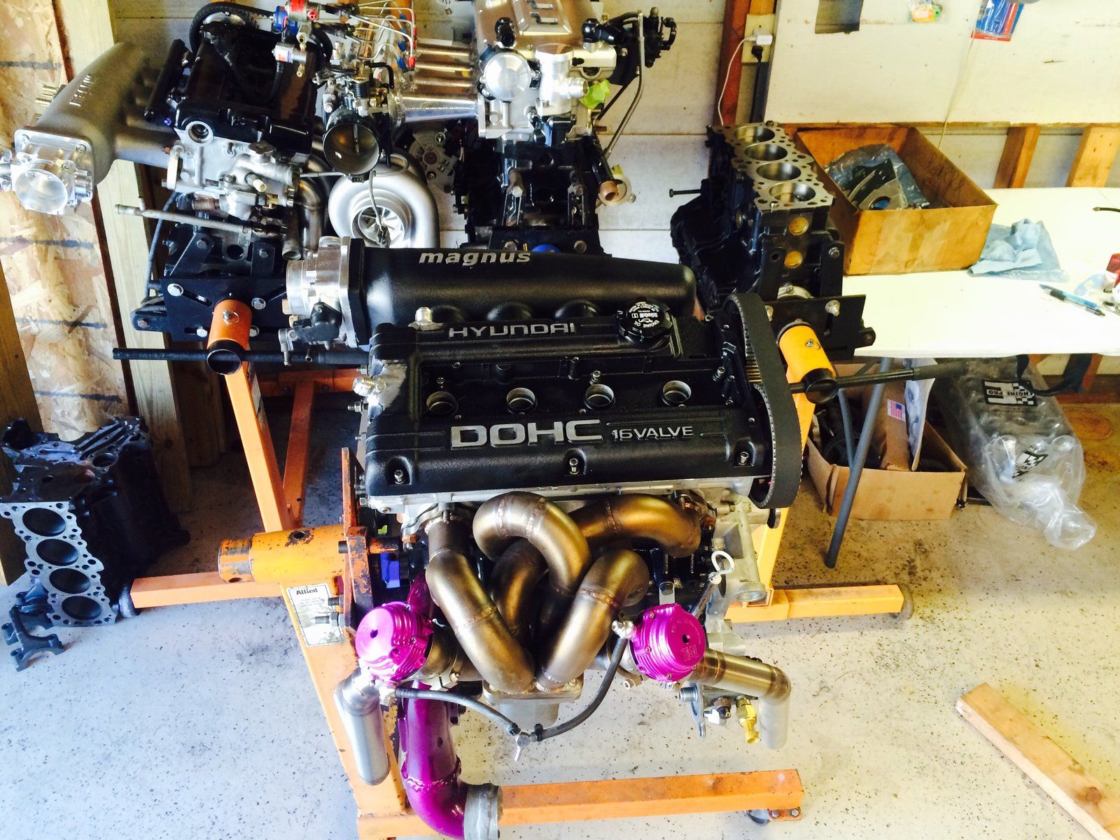

Back again. New block, inserts turned out great this time. Going to try to get it in the car and ready for tx2k. We will see if it makes it.

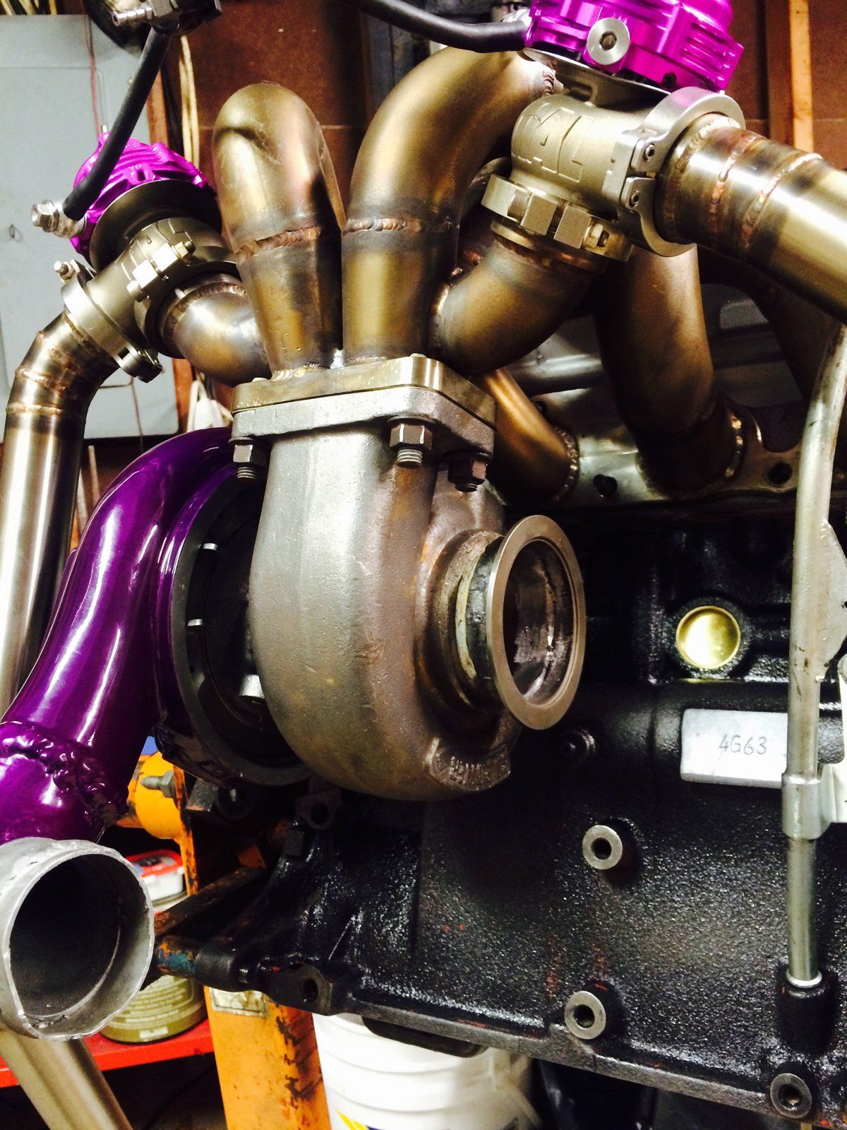

Only change is going from a 12cm^2 housing to a 16cm^2 housing. We will see what that does to it.

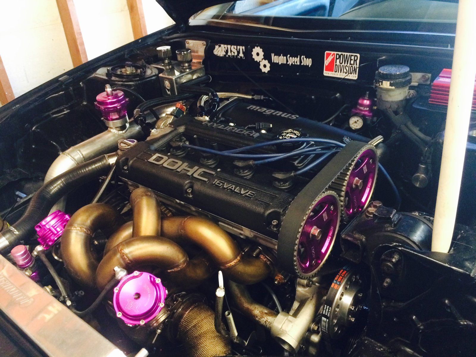

Engine is in, waiting on a few fittings from extremepsi and it will be ready to start.
This engine is the hardest by far to install that I've ever dealt with. Solid mounts in all but one doesn't leave you much wiggle room.

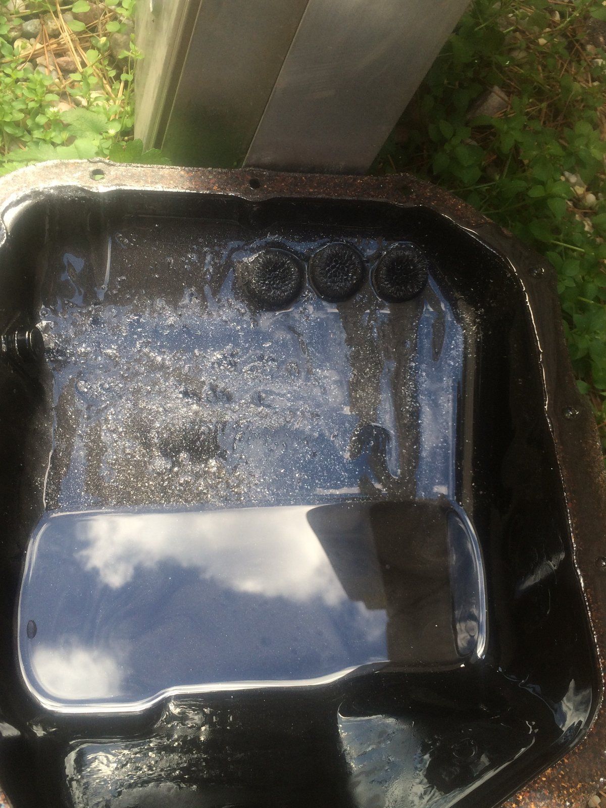

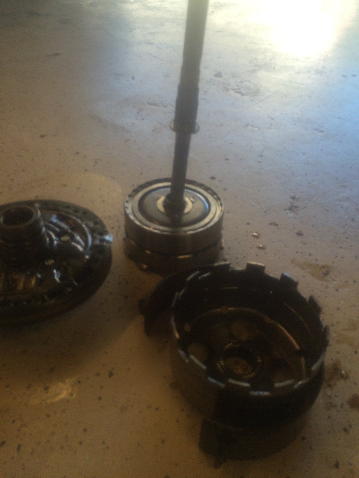

Trans stopped working after 5 miles. Looks like a planetary bearing came apart. Luckily I've been hoarding these things and had a spare. Put it in today and so far so good.
That sucks stick with it I never give up it breaks in fix it more than I wanted too seeing the ultimate goal in sight.
I believe so. There was little pieces of bearing in the pan. Have to tear it apart and see what's up. But for now, as always, it's a mad scramble to get her ready for tx2k. Haven't missed one yet and don't intend to.
the needle bearing?

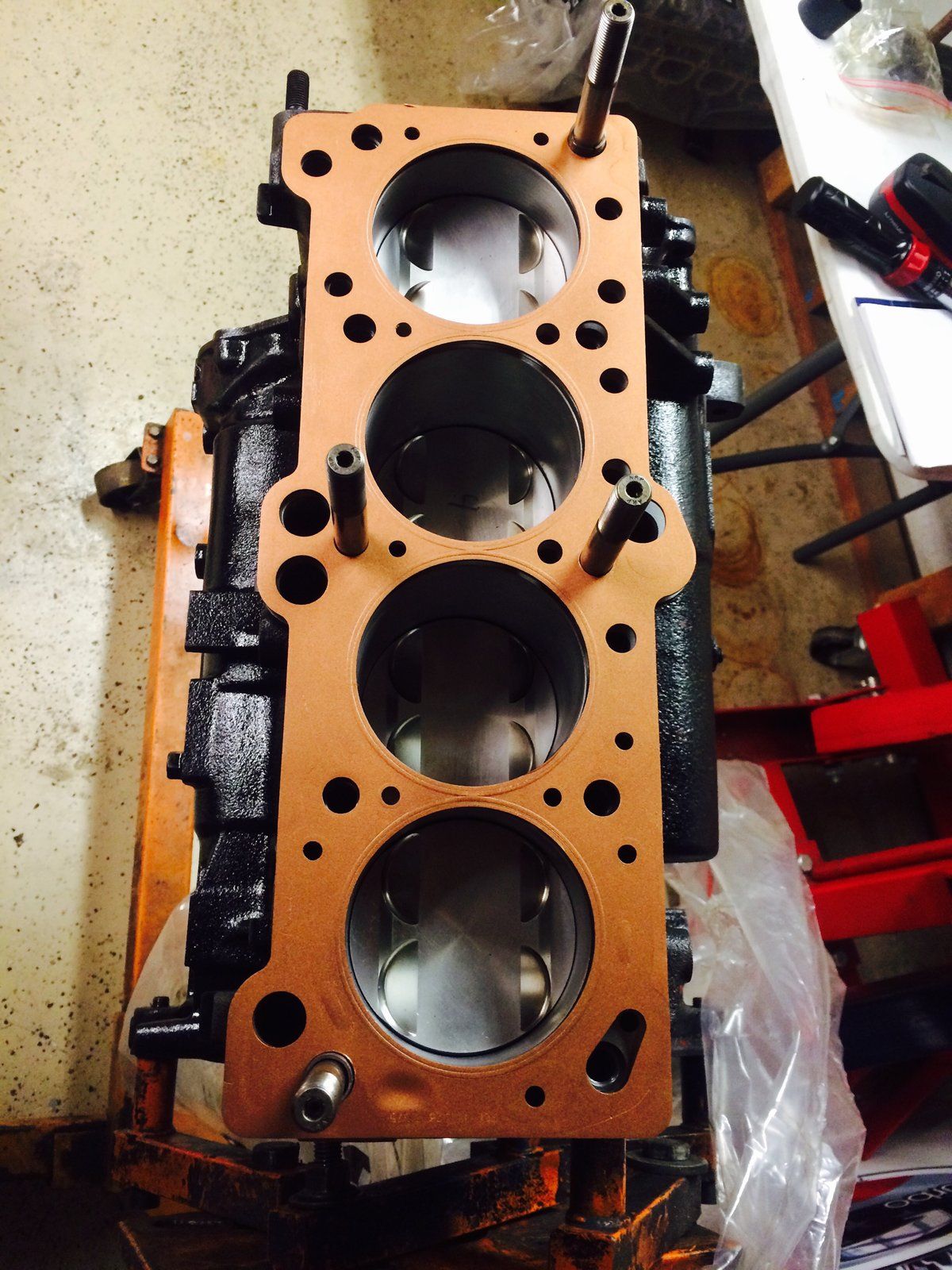

New trans is no good. Well at least the pump isn't flowing. Going to pull it again tomorrow. Completely disassembled my race valvebody and cleaned it to throw in this as well as a pump, and I'm replacing the forward clutches with some I have here just in case the low pressure affected them.
Side note I also did a leak down test and the headgasket is pushing coolant..... I reused this copper gasket per SCEs instructions, so I'm looking at either a new copper or something else that will work with the oring setup.
$35 felpro and done
Not quite. Not with the O rings .
I finally got the trans all seated, getting all the clutches lined up proved to be a real pain. Took apart 3 trans' and used the best parts from each to make one.

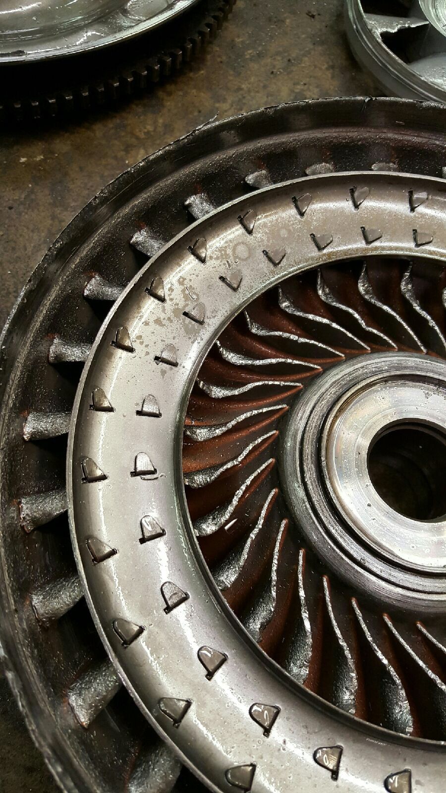

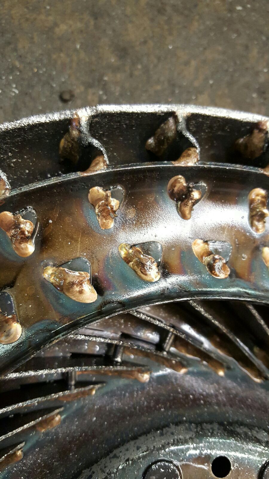

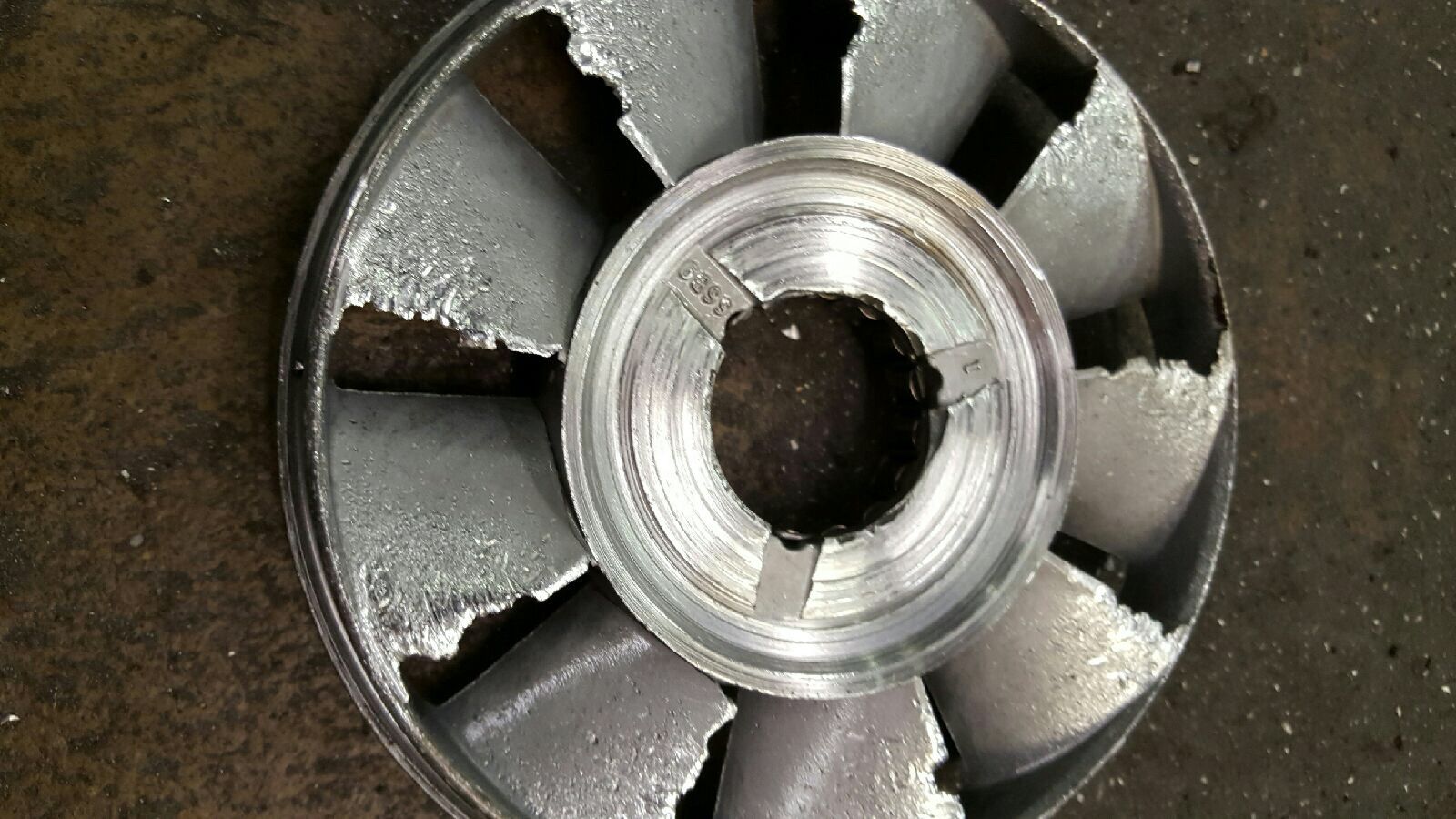

Bad news is my Bradco converter needed to go back, there was a bearing I could move around with my fingers inside of it. Sent him the pictures and he said to send it to him. Very helpful guy, he should have it Monday. So for now, I'm going to throw a stock converter in and get it all hopefully sorted out. Best hope now for making tx2k is to have all the other issues completed, then get this Bradco back and in before the event. It's a stretch but maybe it will work out.
Added some pictures from Bradco .
Ok, update. So Bradco has my converter, turns out the stator broke so internally it was pretty much done. He is making me a new one and getting it back to me ASAP. Very helpful guy, really happy that he is so helpful. I guess I had one of his early converters that still used the aluminum stator. Has ones now are steel and way stronger.
Headgasket wise, I have another copper coming tomorrow, if I can't get that to work, I will get a new head and go no receiver grooves. Hoping I don't have to do all that though .

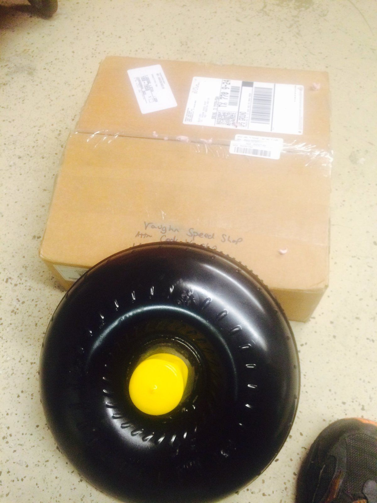

Bradco came through on the converter and got me one in a week. Awesome!

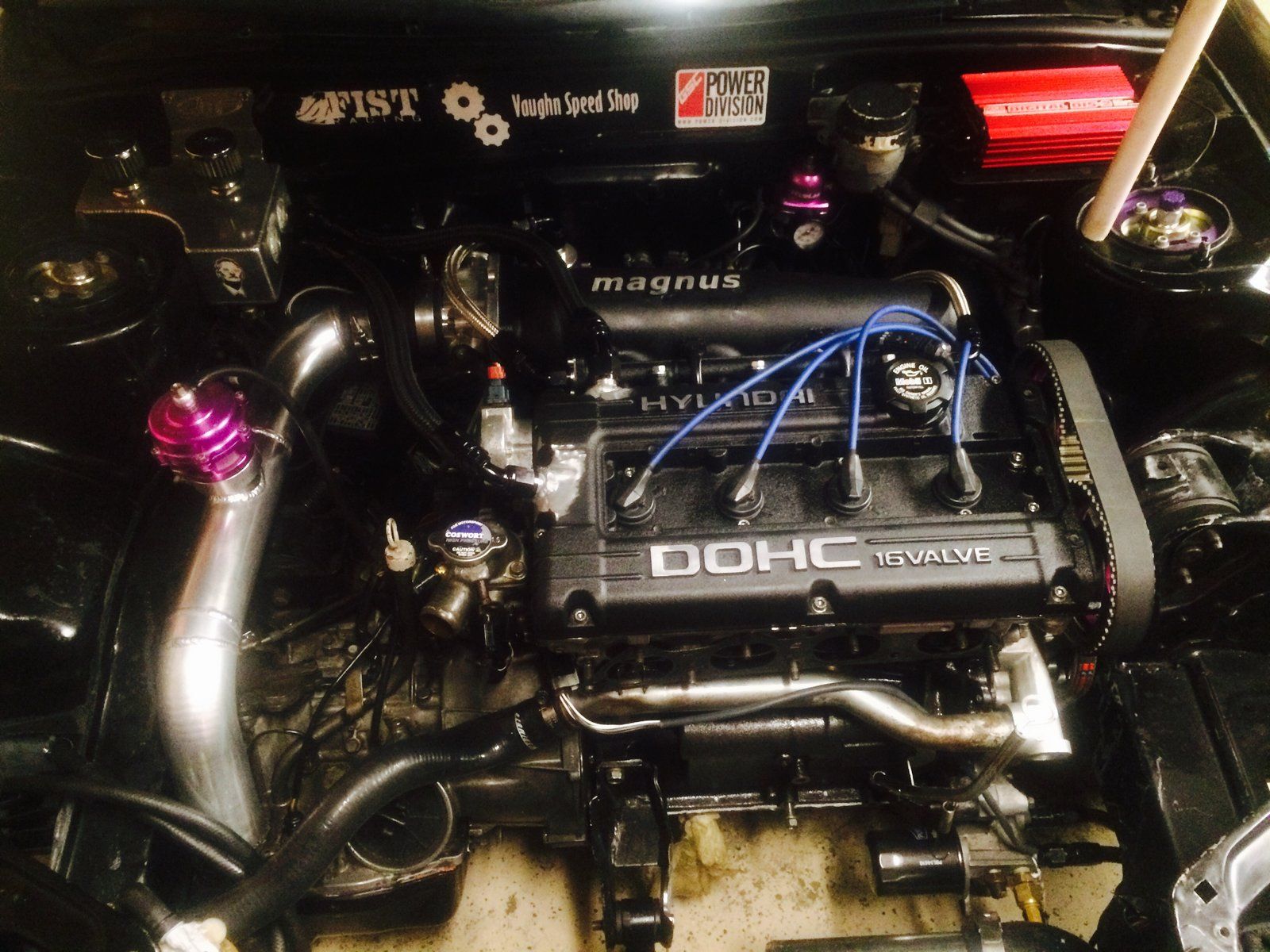

FIST racing is helping out doing my downpipe modification. Had to modify it to a new vband flange and also this turbine housing shifted it a bit. So good news from them today as they are done with it. Gonna get all the turbo setup from them tomorrow and hopefully get to test her out tomorrow. Lot of question marks, trans and headgasket being the big hurdles. Hoping for the best . Less than a week before the event and scrambling as always . Still need to get on the dyno too. Crap.

Drove it about 10 miles today, no issues at all. On the call list for dyno so I'll wrap up a few small things tomorrow, load it on the trailer and wait for the call. Good news though I backed out the boost controller all the way and did a few pulls and the boost goes right to 20psi and holds , which it should with these gate springs. For whatever reason on the old housing, which is all I changed, it would pull 34psi on wastegate. Not sure the reason, maybe someone with some better turbo knowledge can chime in.
