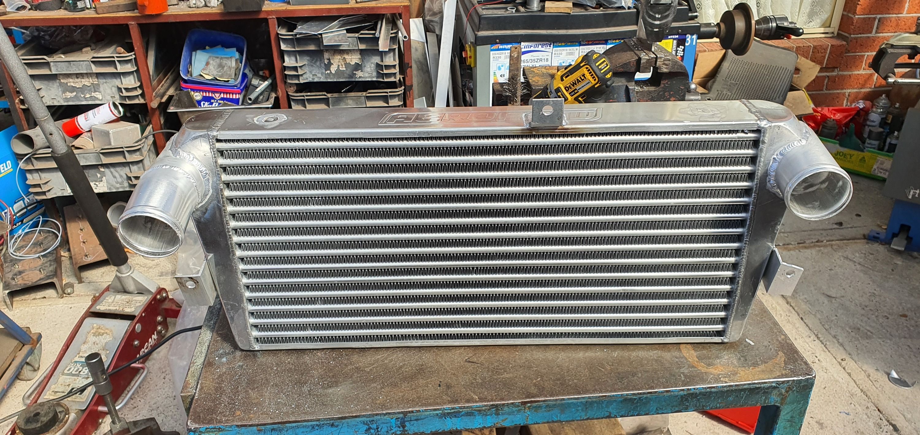

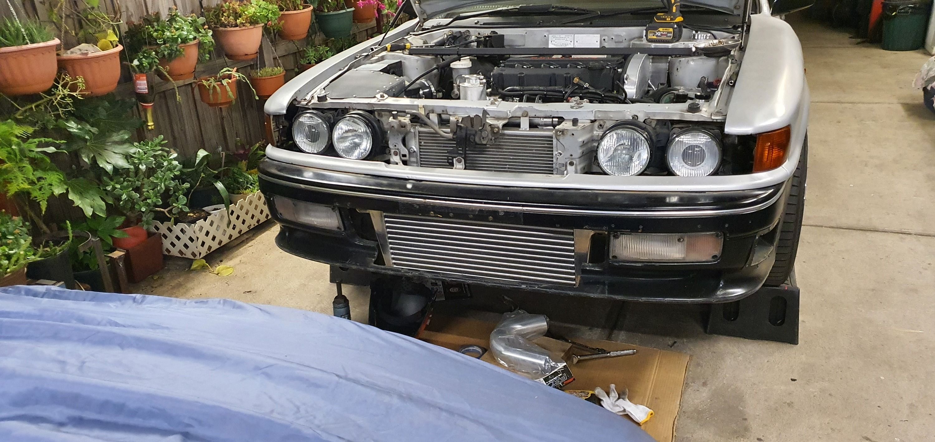

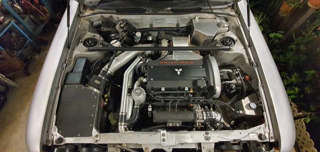

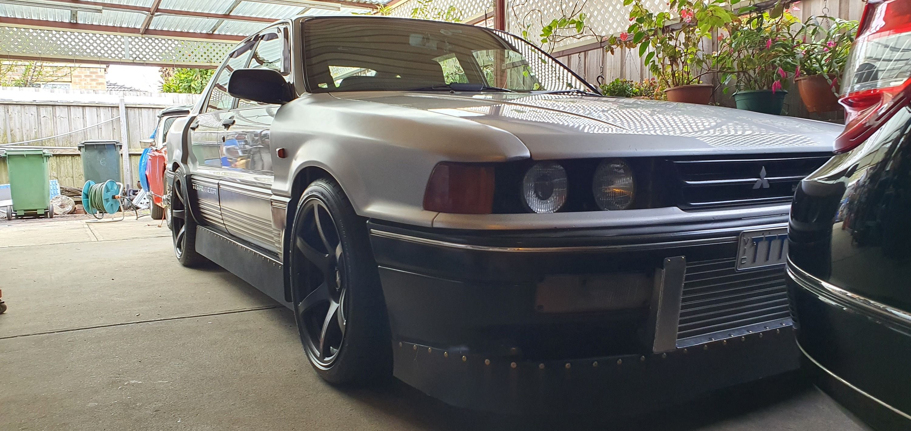

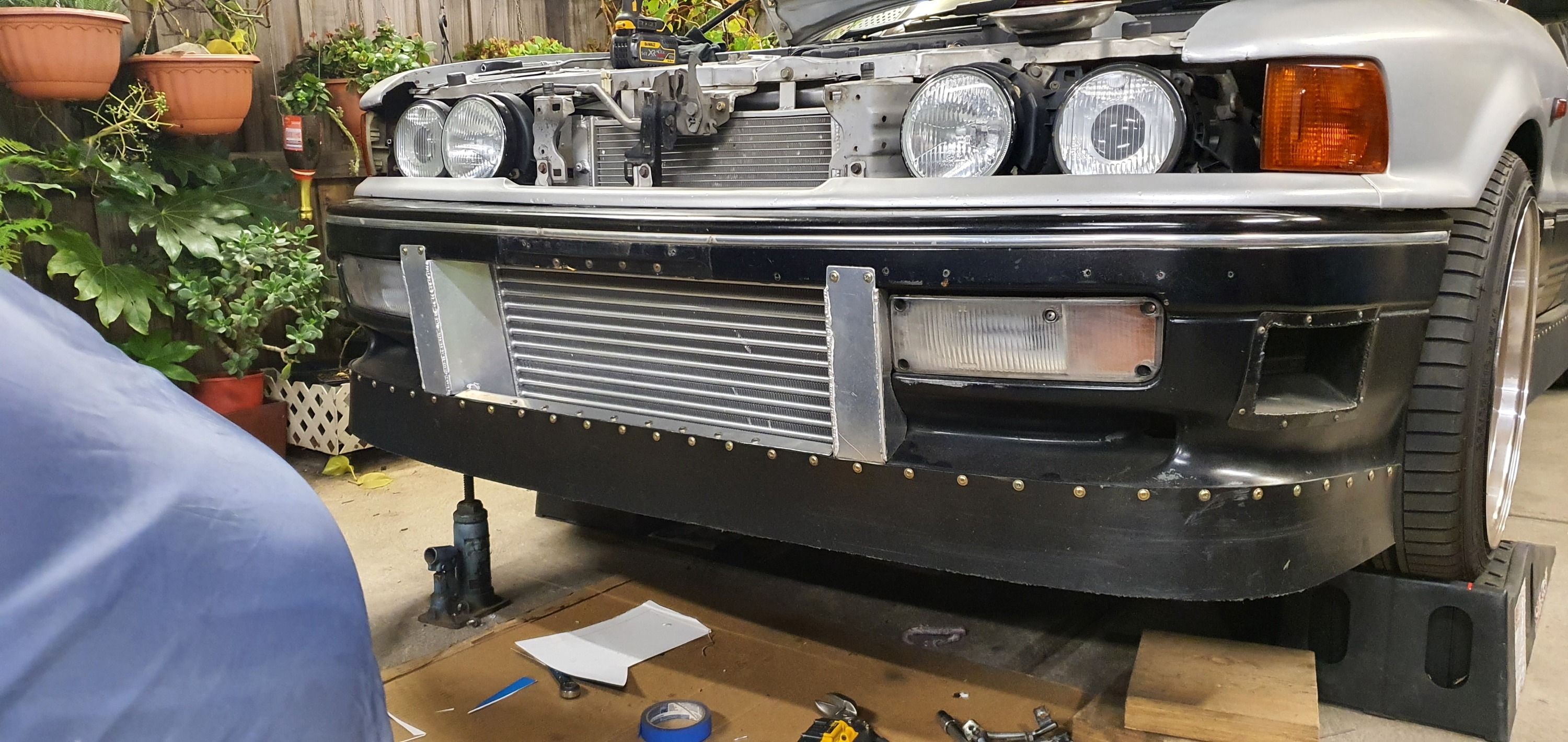

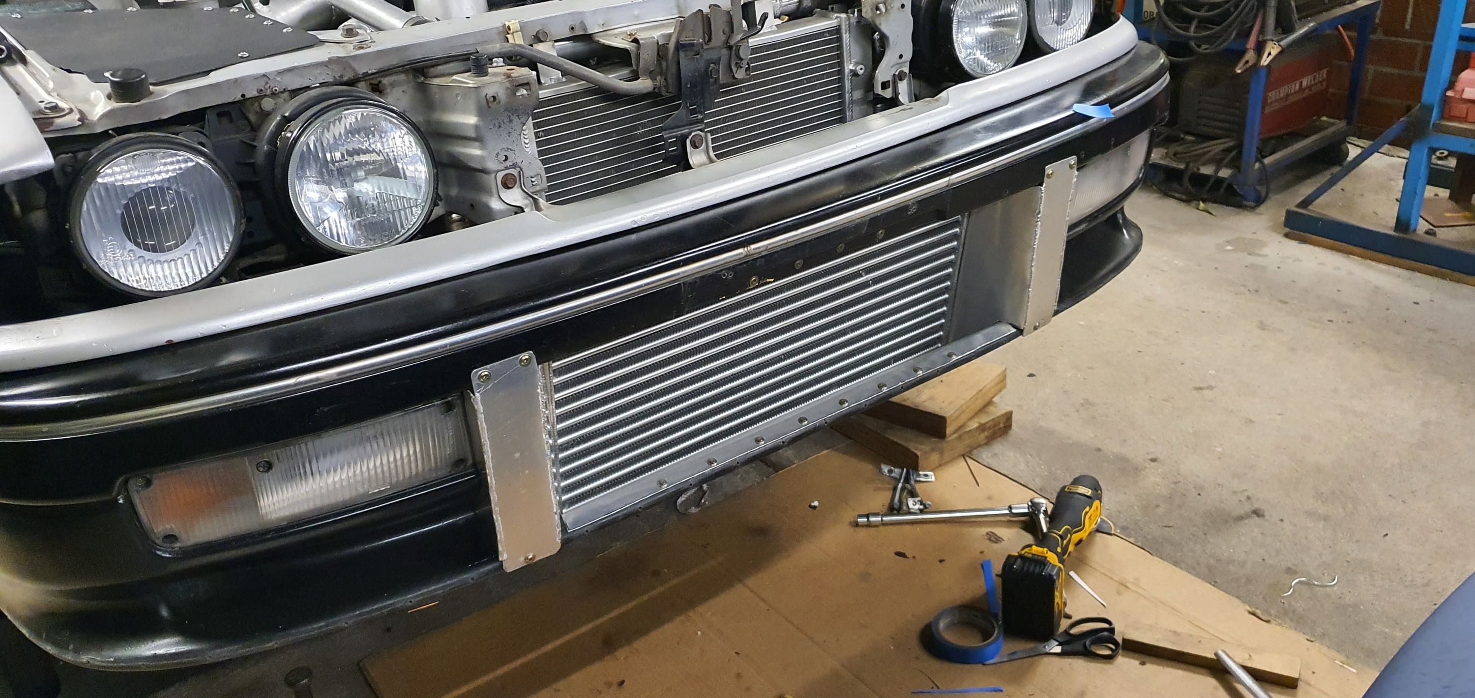

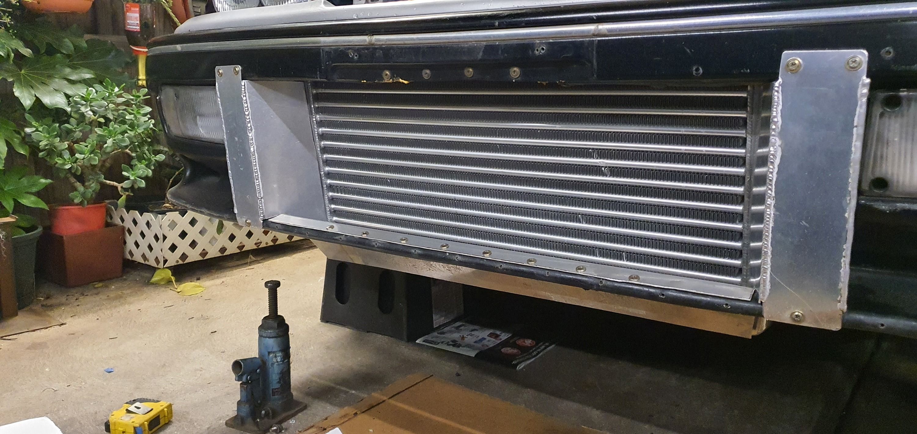

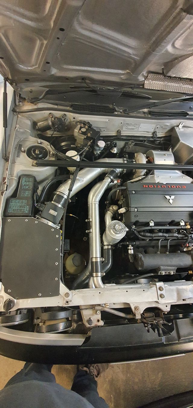

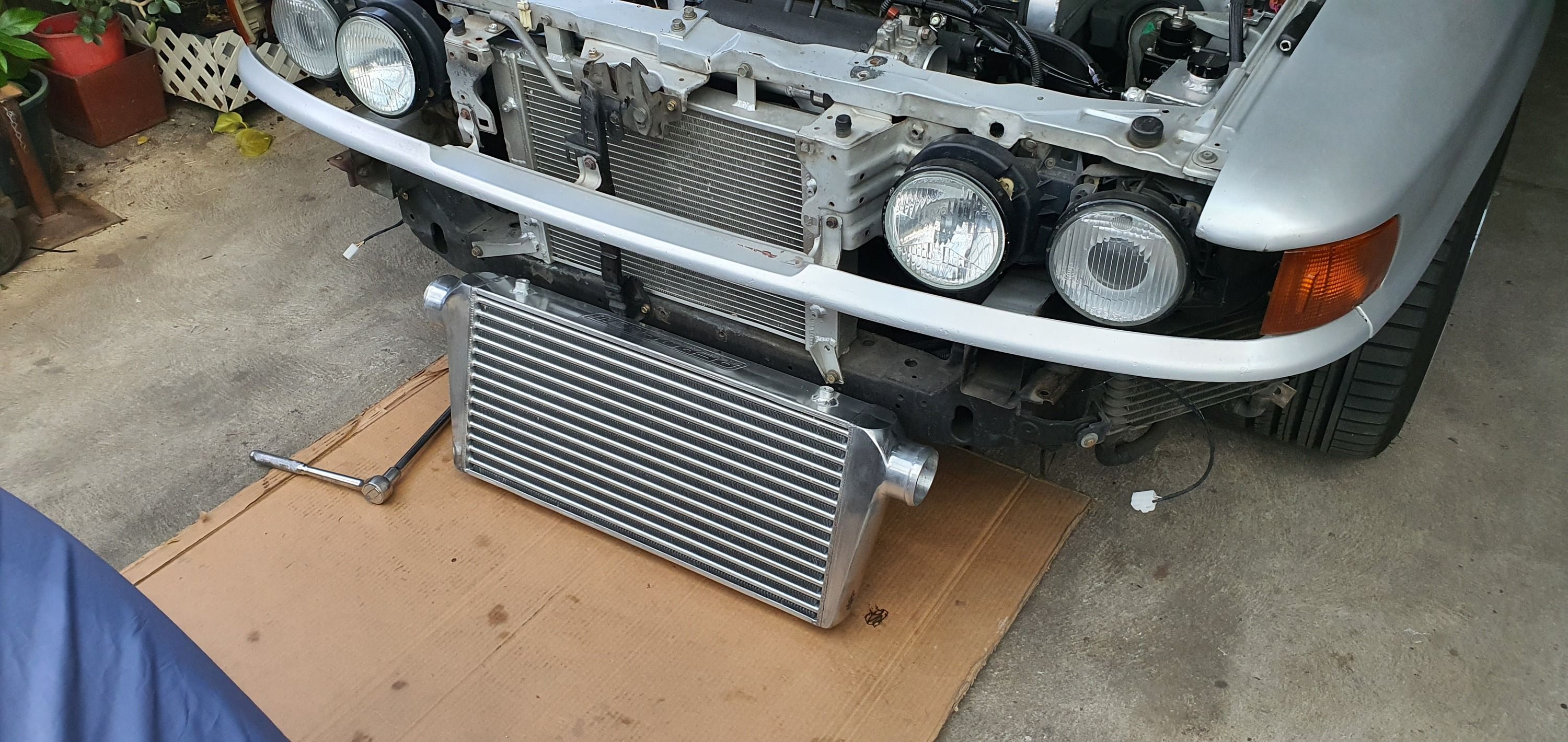

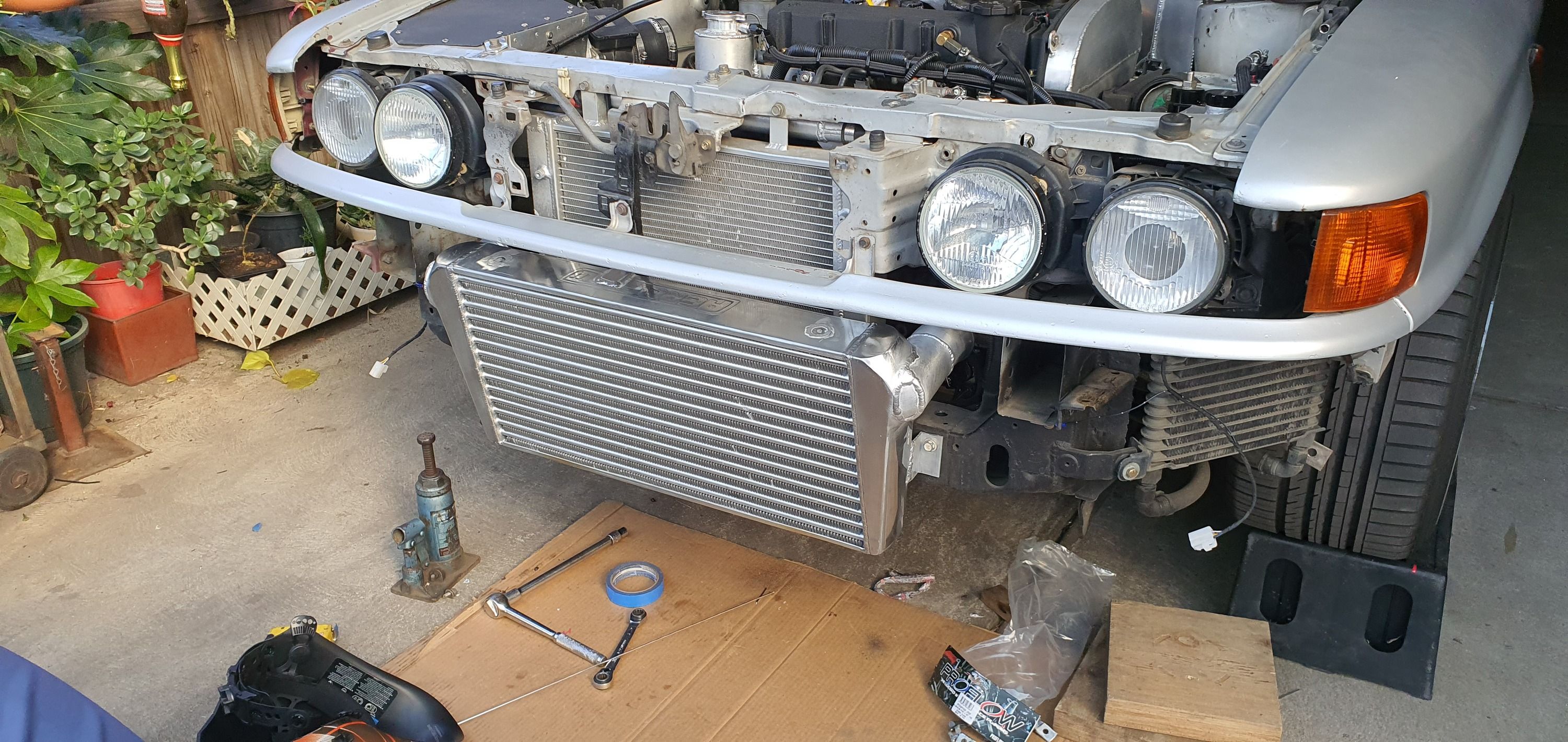

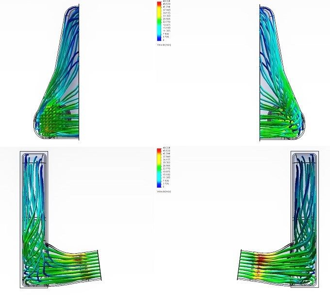

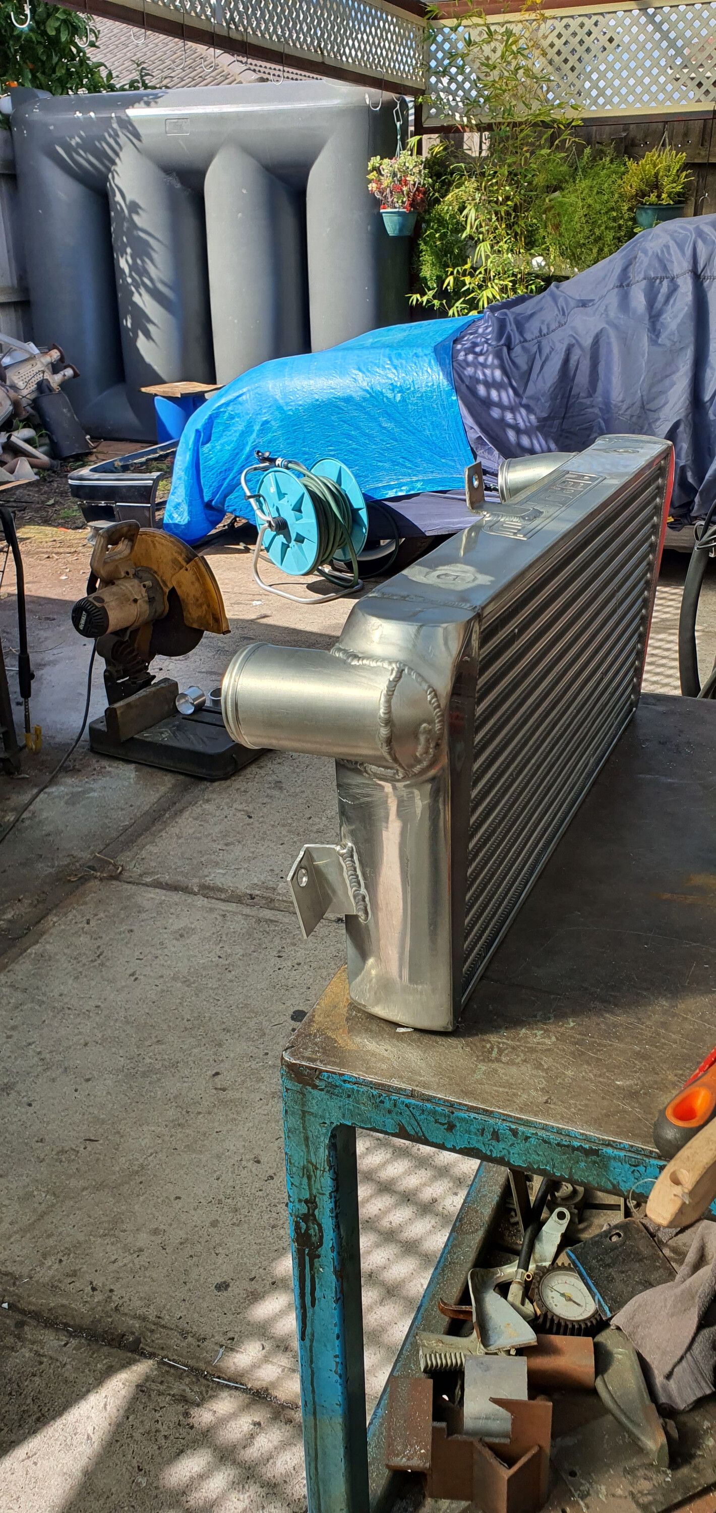

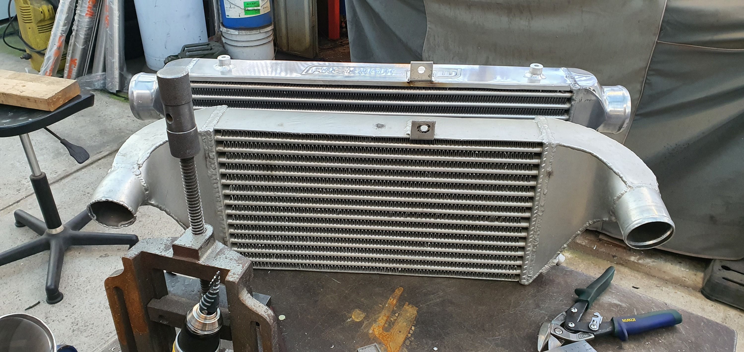

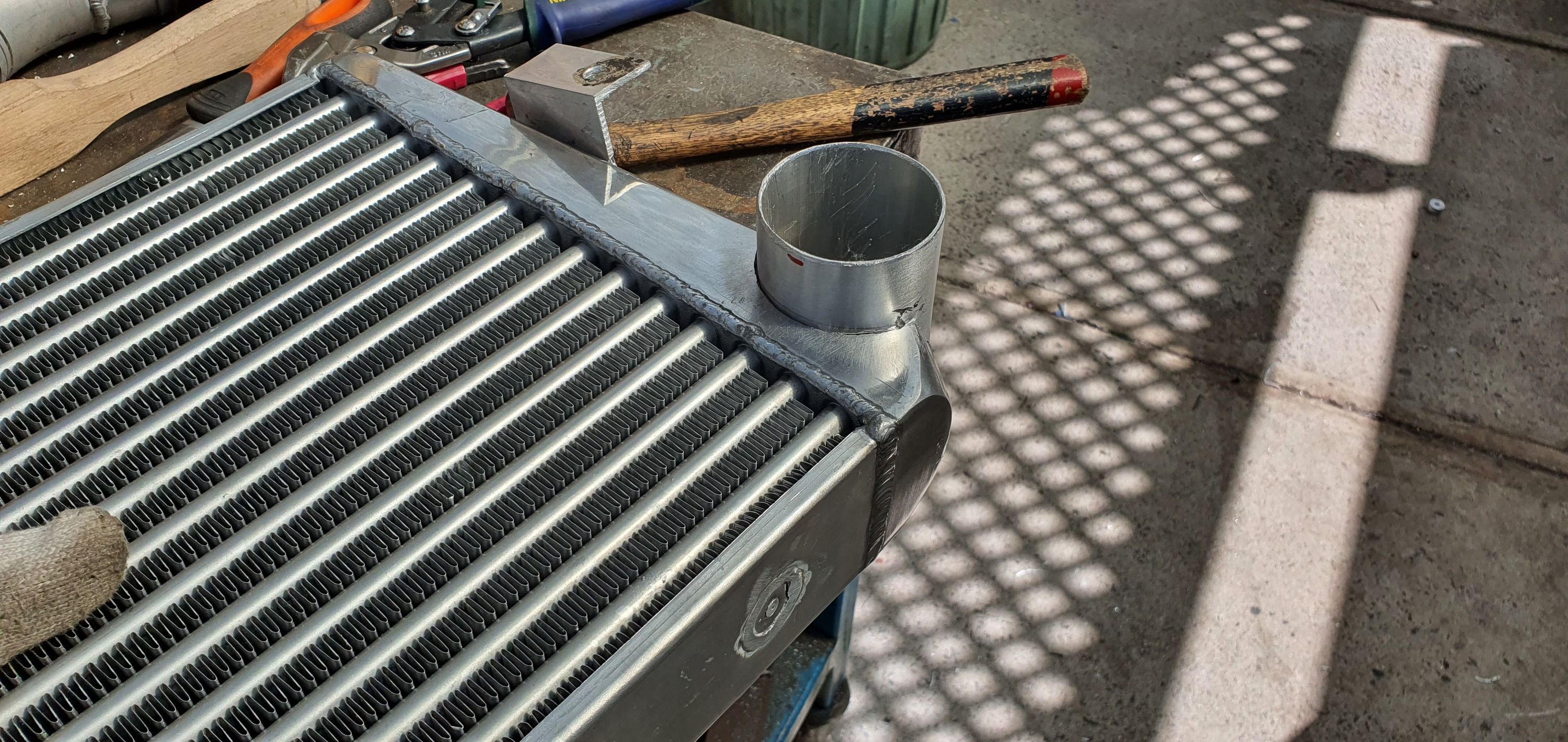

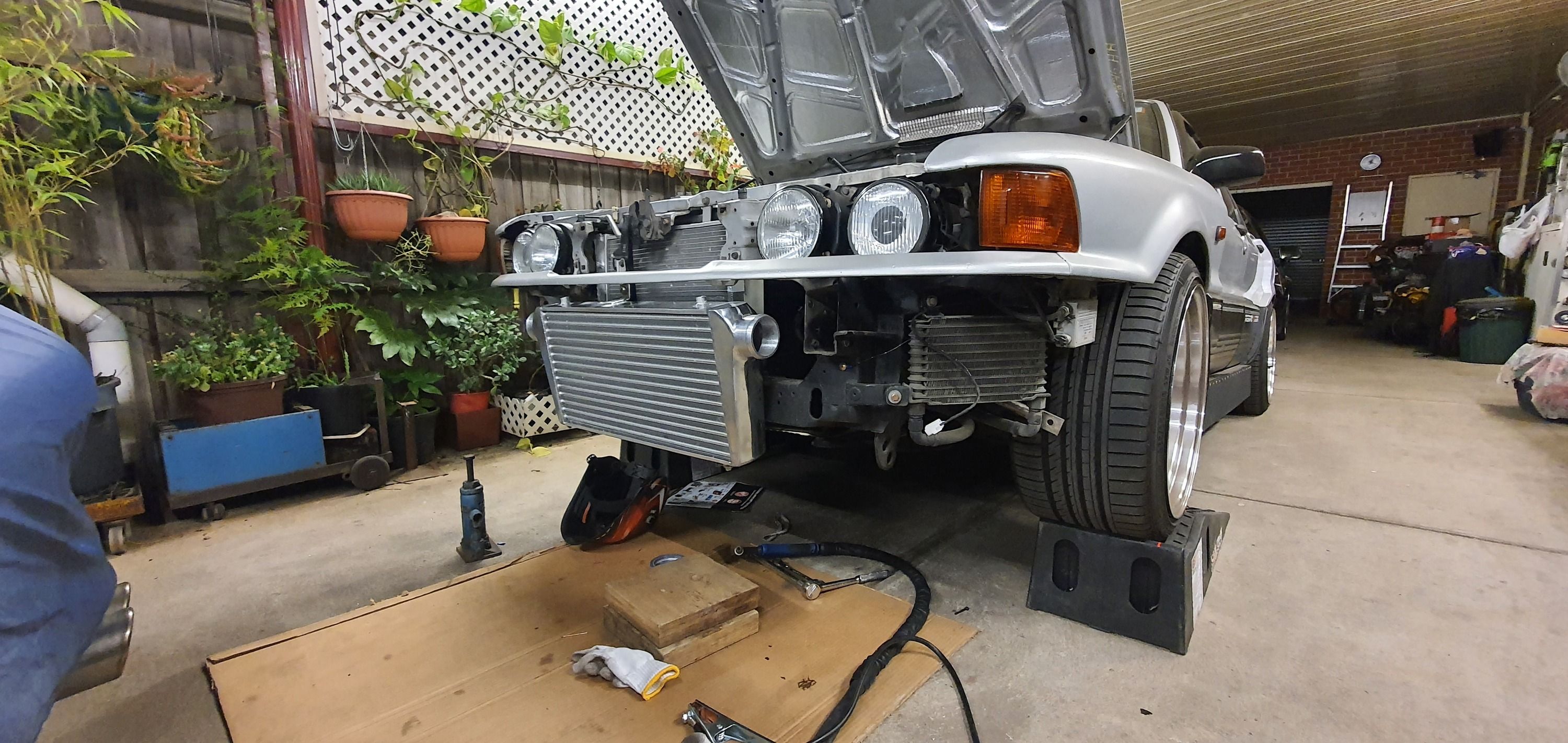

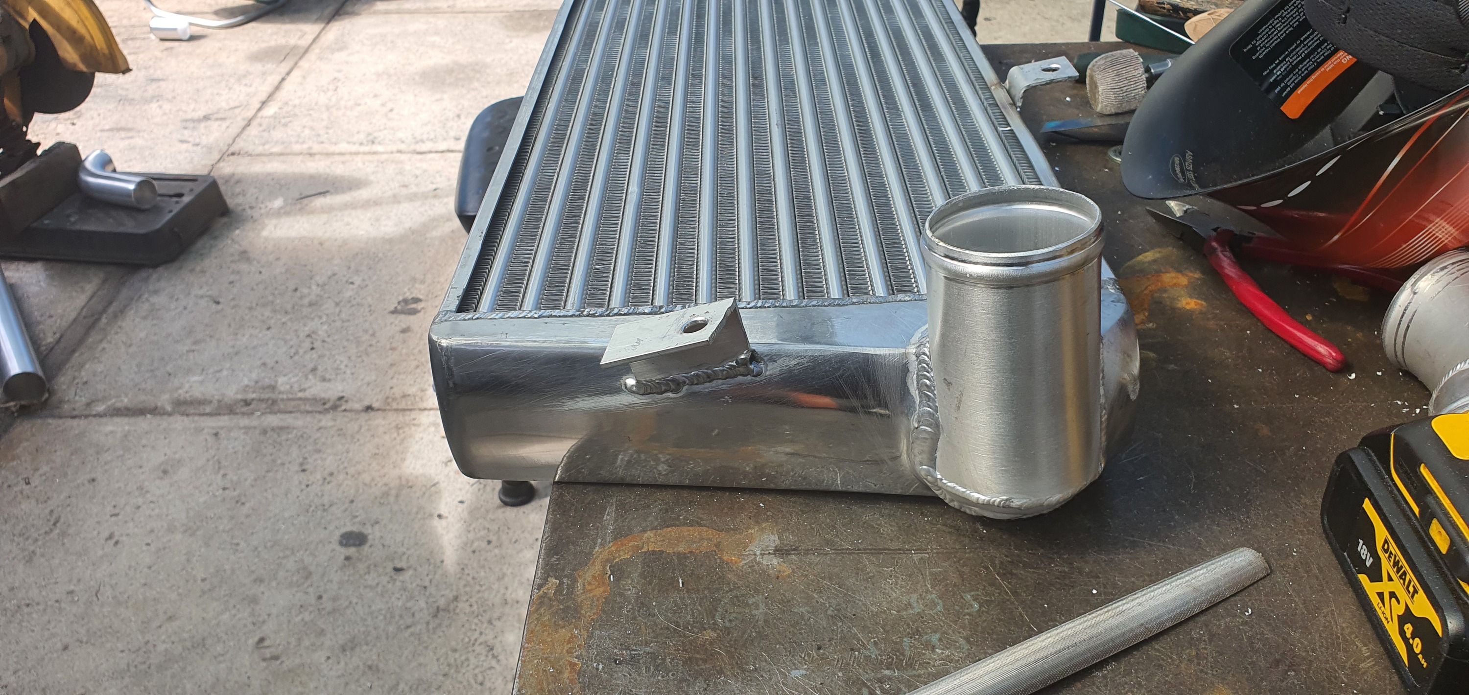

@JayRome I very much liked your old intercooler with the custom, swept end tanks. I'm interested in knowing a few details of the upgrade: was there a volume issue, core issue etc? Just curious as the sharp transitions seem less efficient to me, but I'm no intercooler expert.
Um basically.. i got.. bored? Ahahha... my other intercooler was just a freeby from a friend, and was fairly aged (paint made it look good) so it was time for an upgrade (thank you ebay sales).
Design is due to space constraints, but its not as bad as you might think. I spent a few hours with a die grinder to flow out the internals accordingly. It flows better than most that are welded at a 90 as the edges are actually curved inside towards the outlet/inlet. Id say both coolers have the same volume, as the old cooler had empy space doing nothing thanks to my tank design. Now the extra volume is extra cooling fins, so no big loss.
Its not the greatest, but it will do fine for how i use the car...
Designs not far off this, if i had the time, id cut it open and add air diverters inside to help more if i was chasing every HP.
Check out Rob Dahm's vid on his intercooler flow:

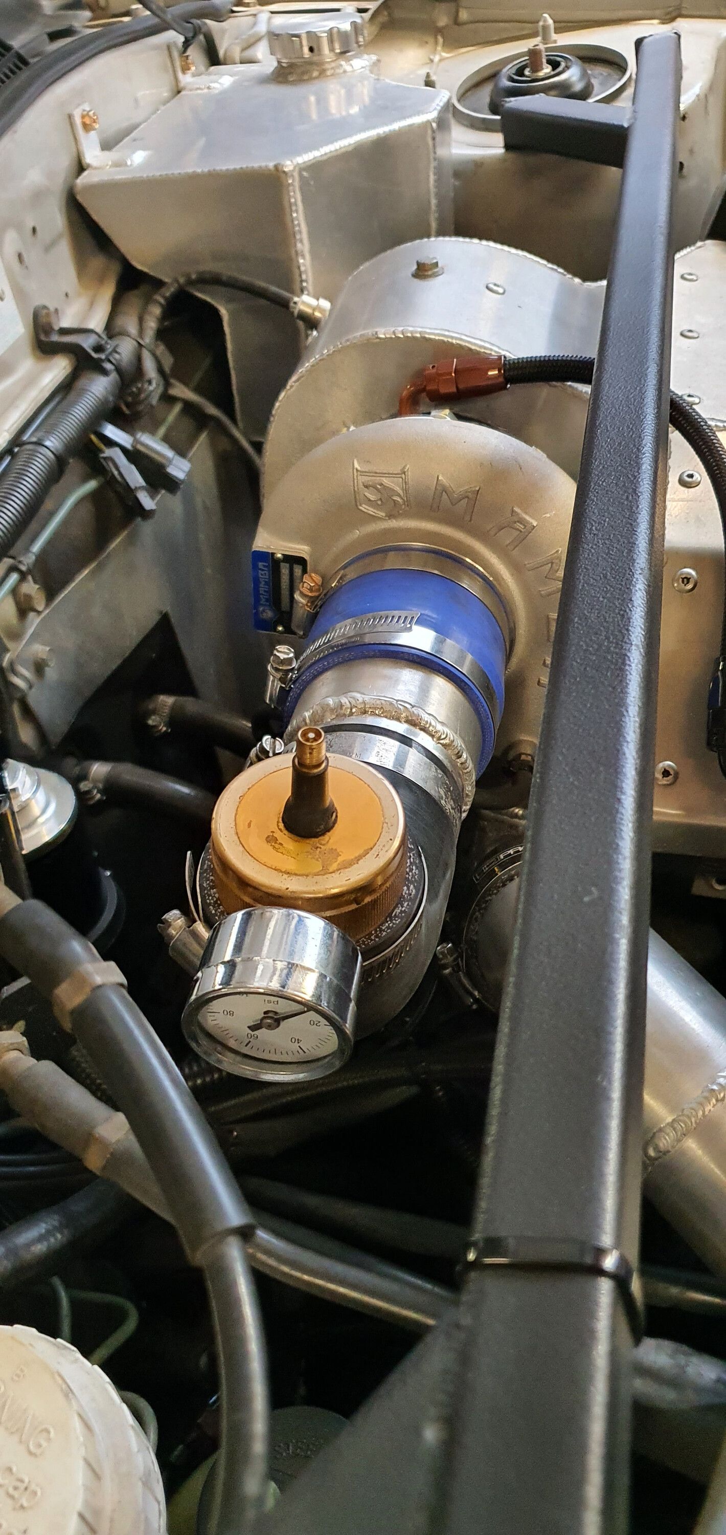

Superchargers are getting harder to find around here, going towards a compoud setup.
Also the BorgWarner S200's are really cheap these days, so a few ideas being tossed up.

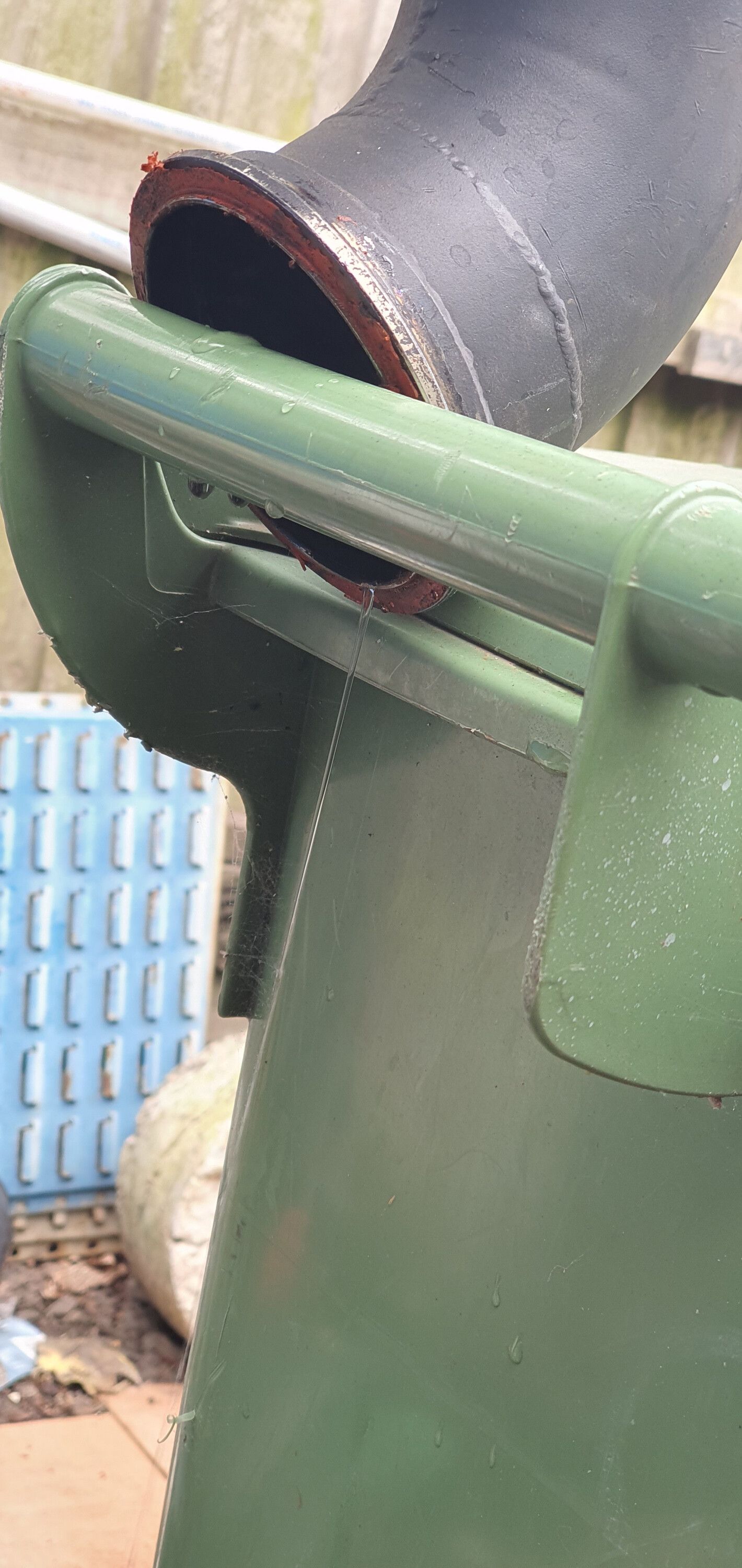

Pressure testing... found a leak, should have rebuilt it when i bought it many years ago

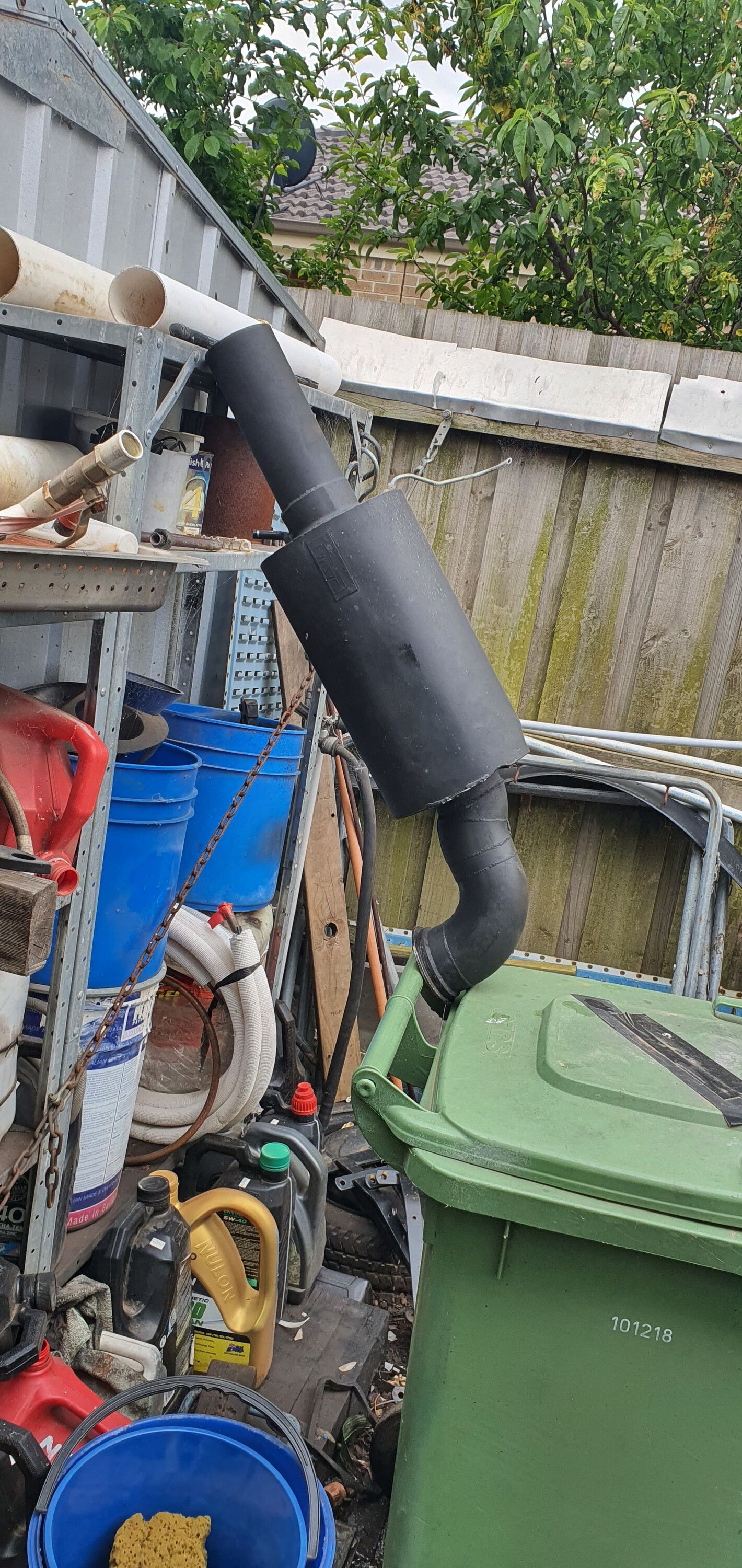

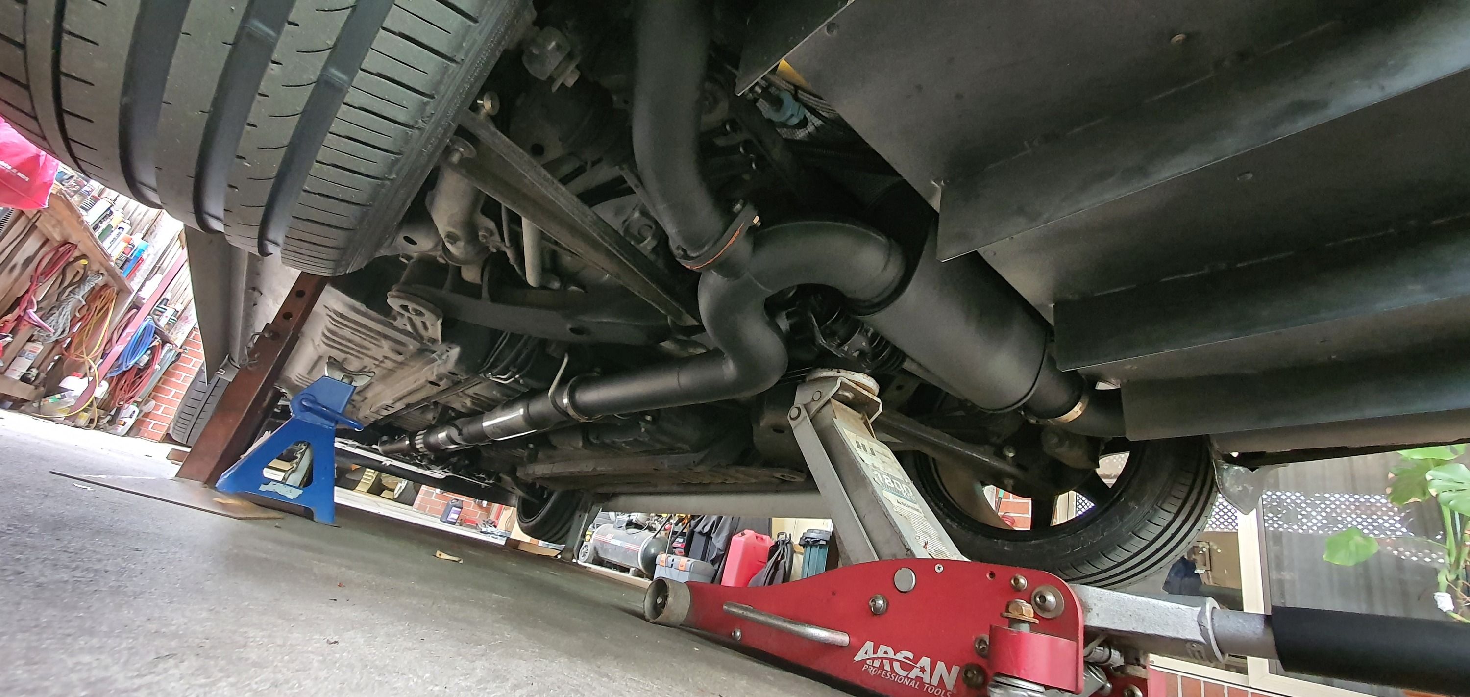

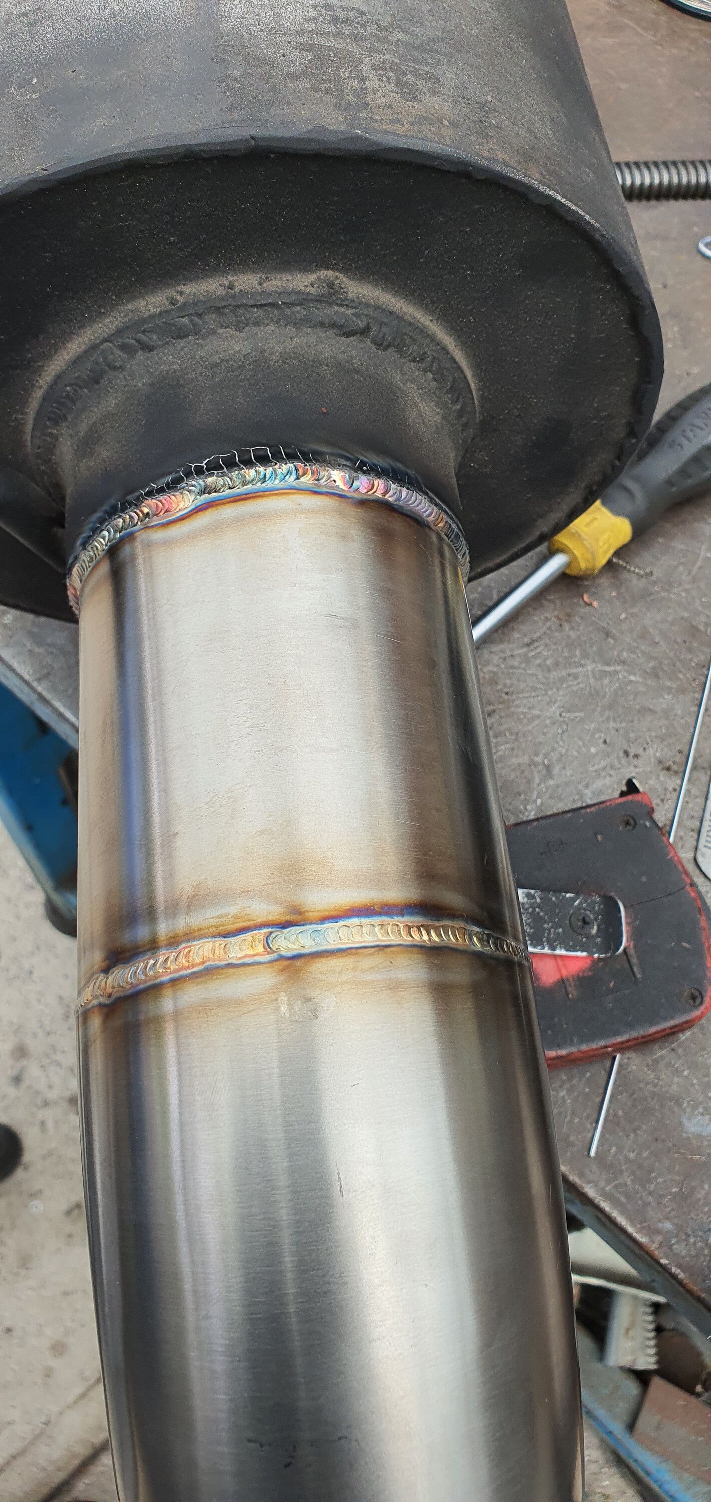

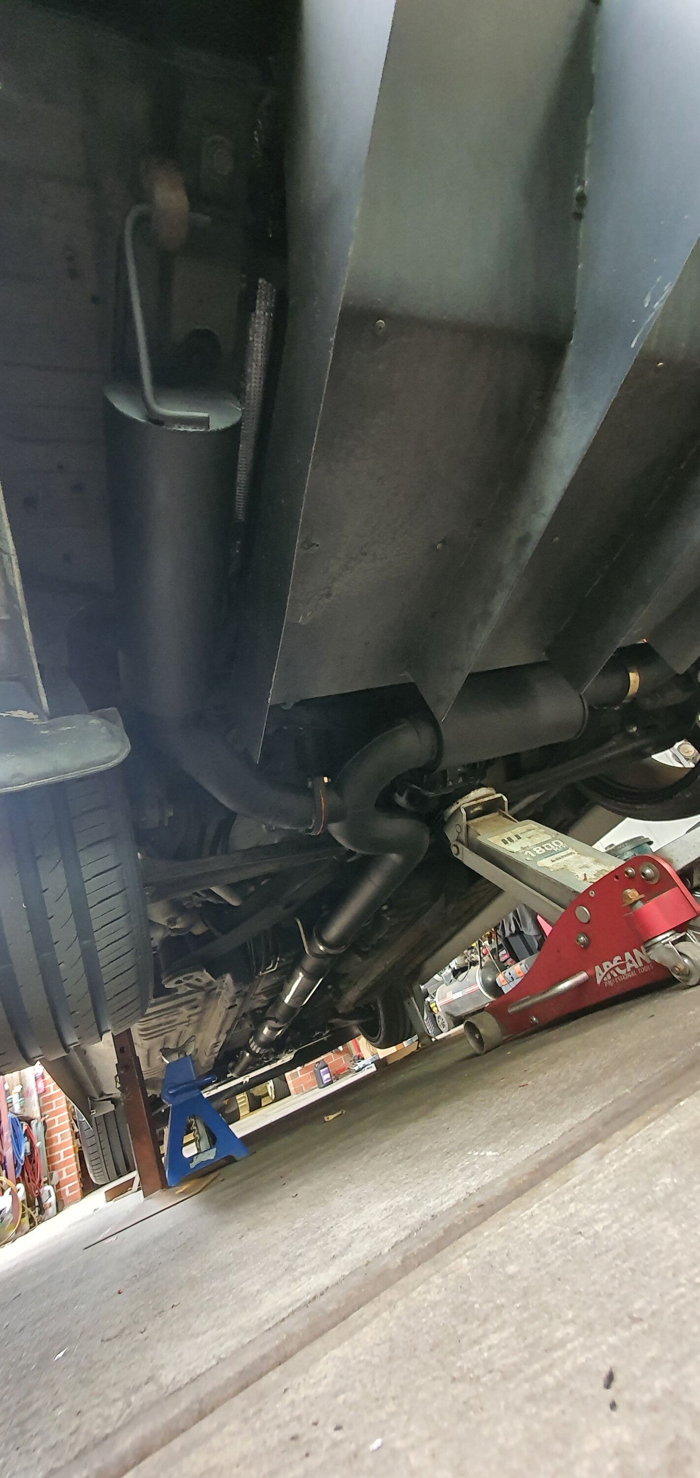

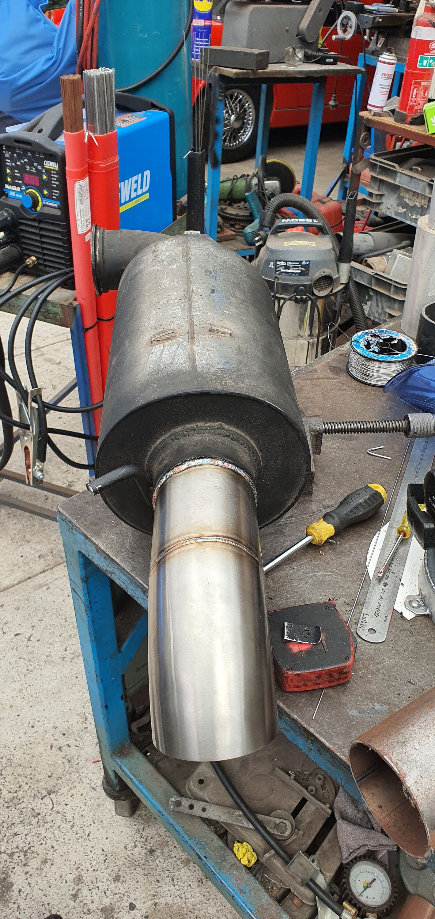

Need to remember to empty my muffler water more offten (yeah e85 can suck when you dont drive the car enough)

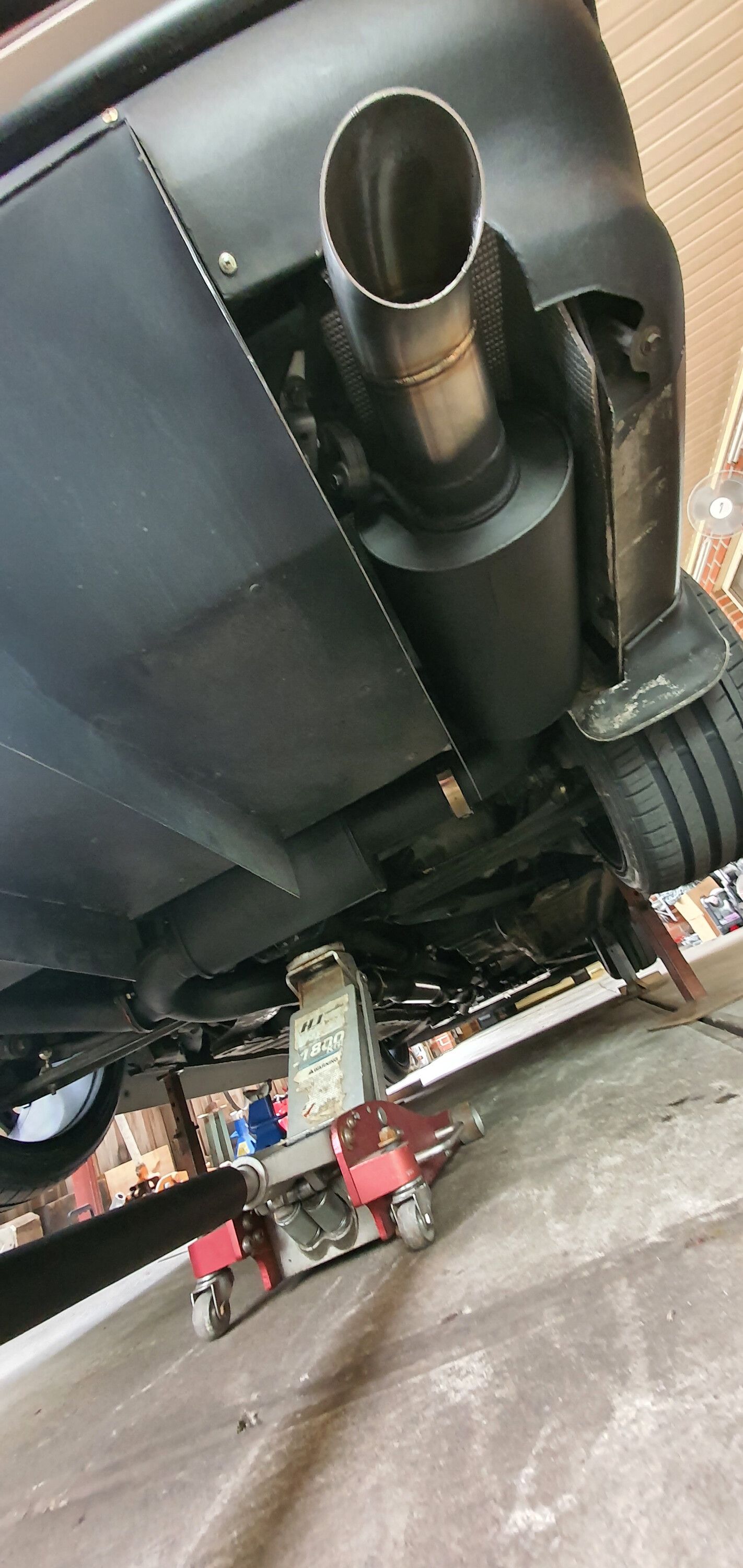

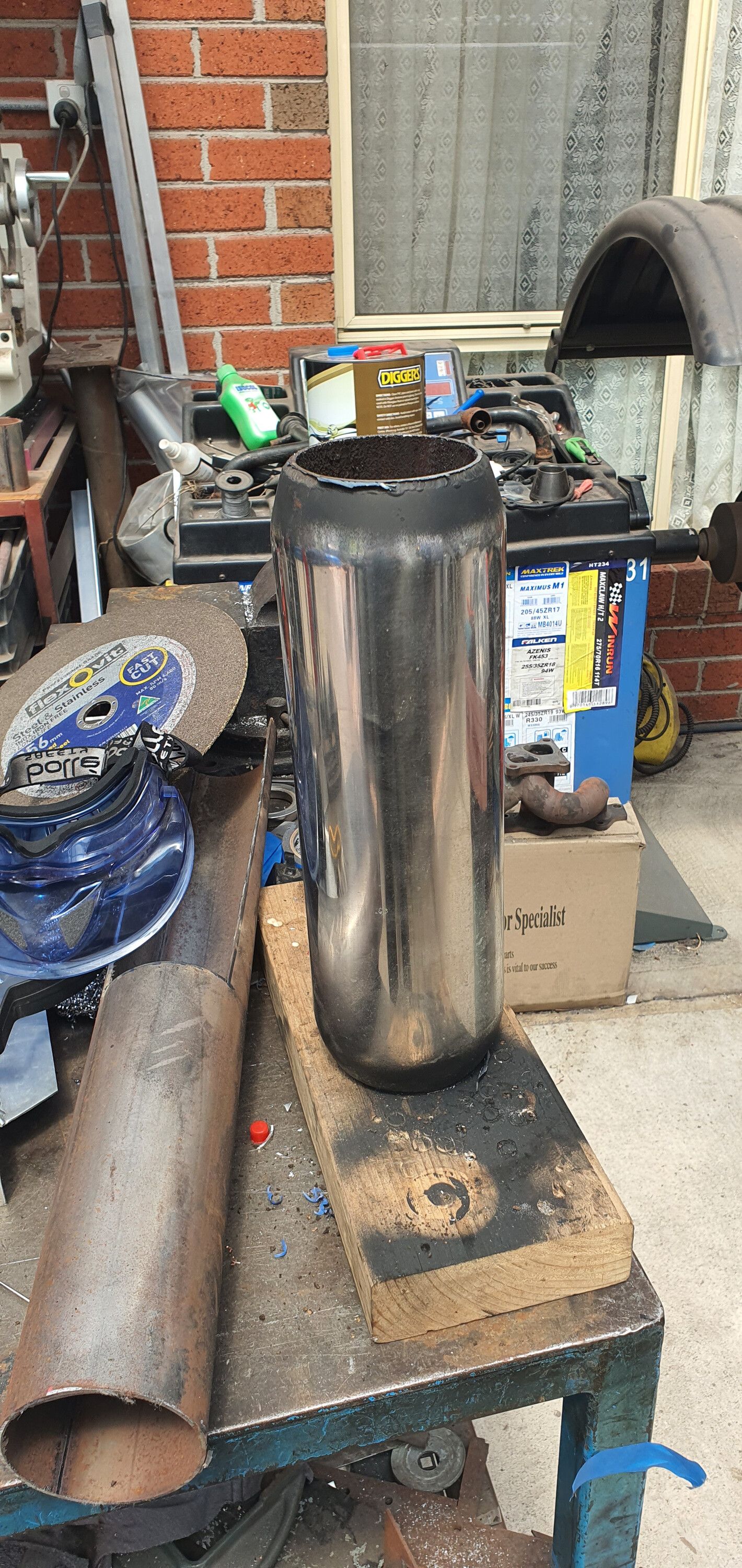

Cut off a hotdog to see how it would sound.... still not loud.. Got bored and added a dumpy tip from left over bends from other jobs..

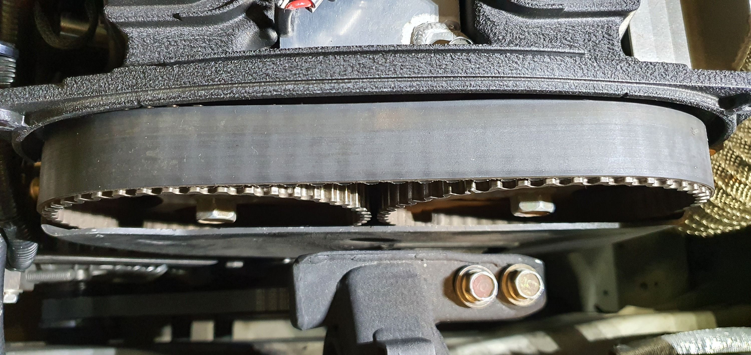

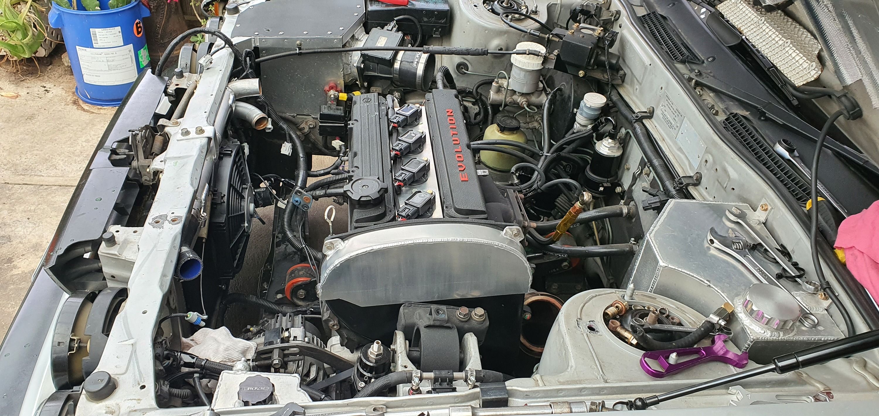

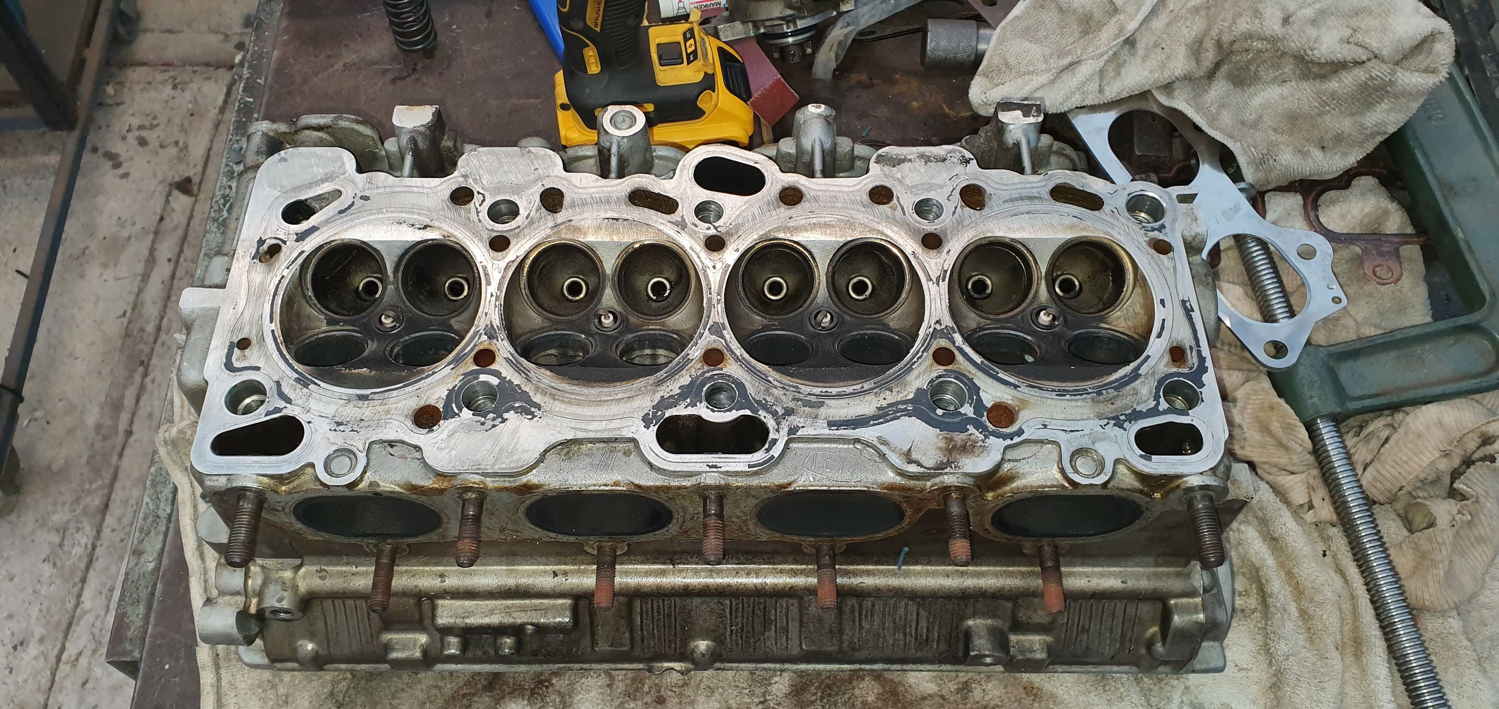

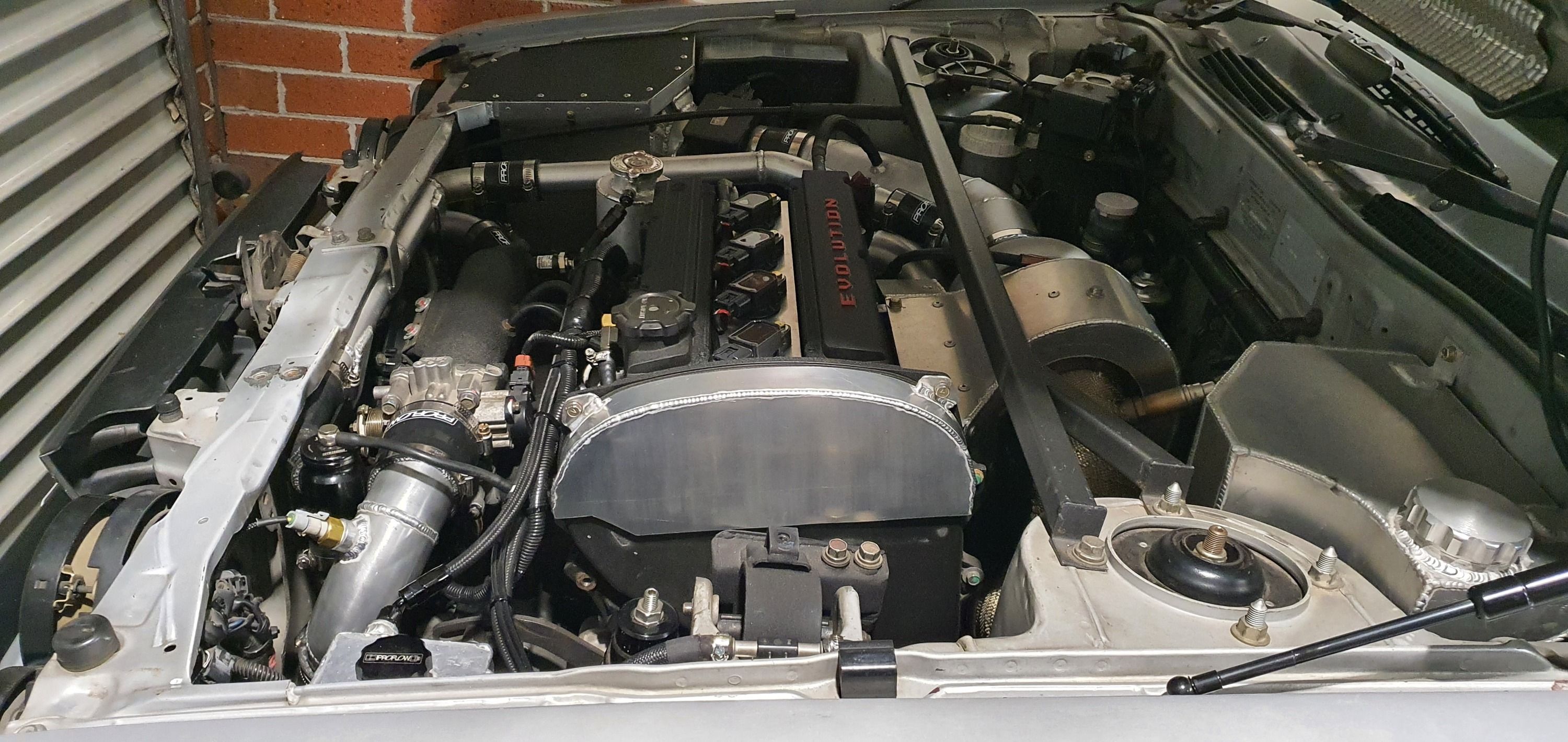

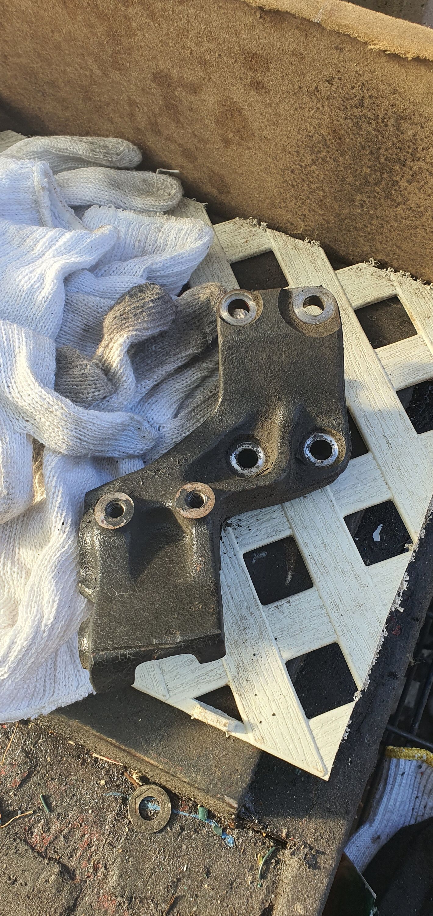

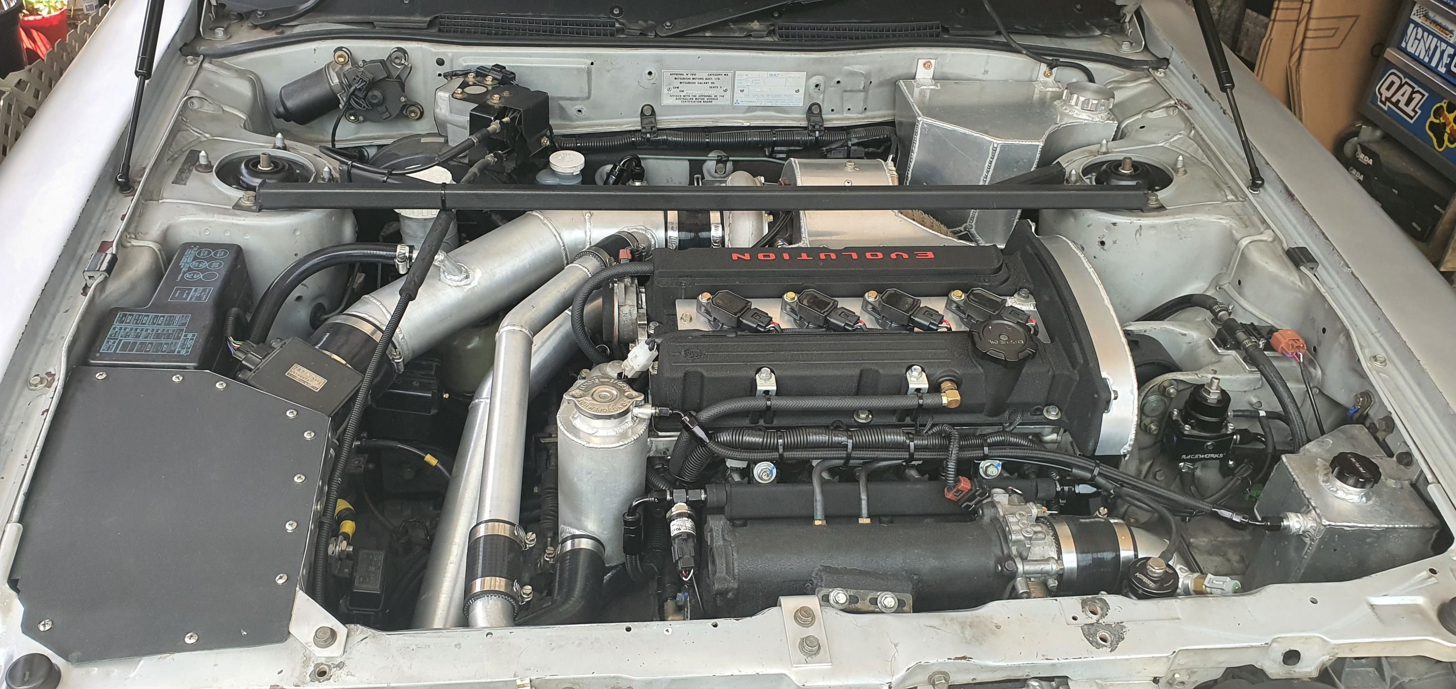

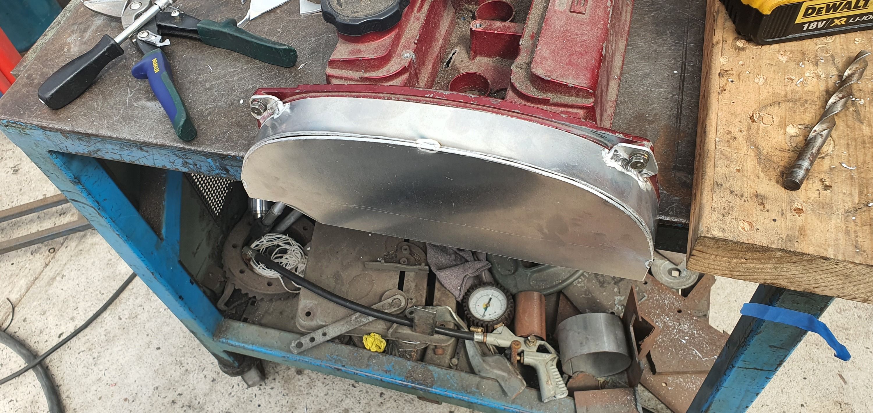

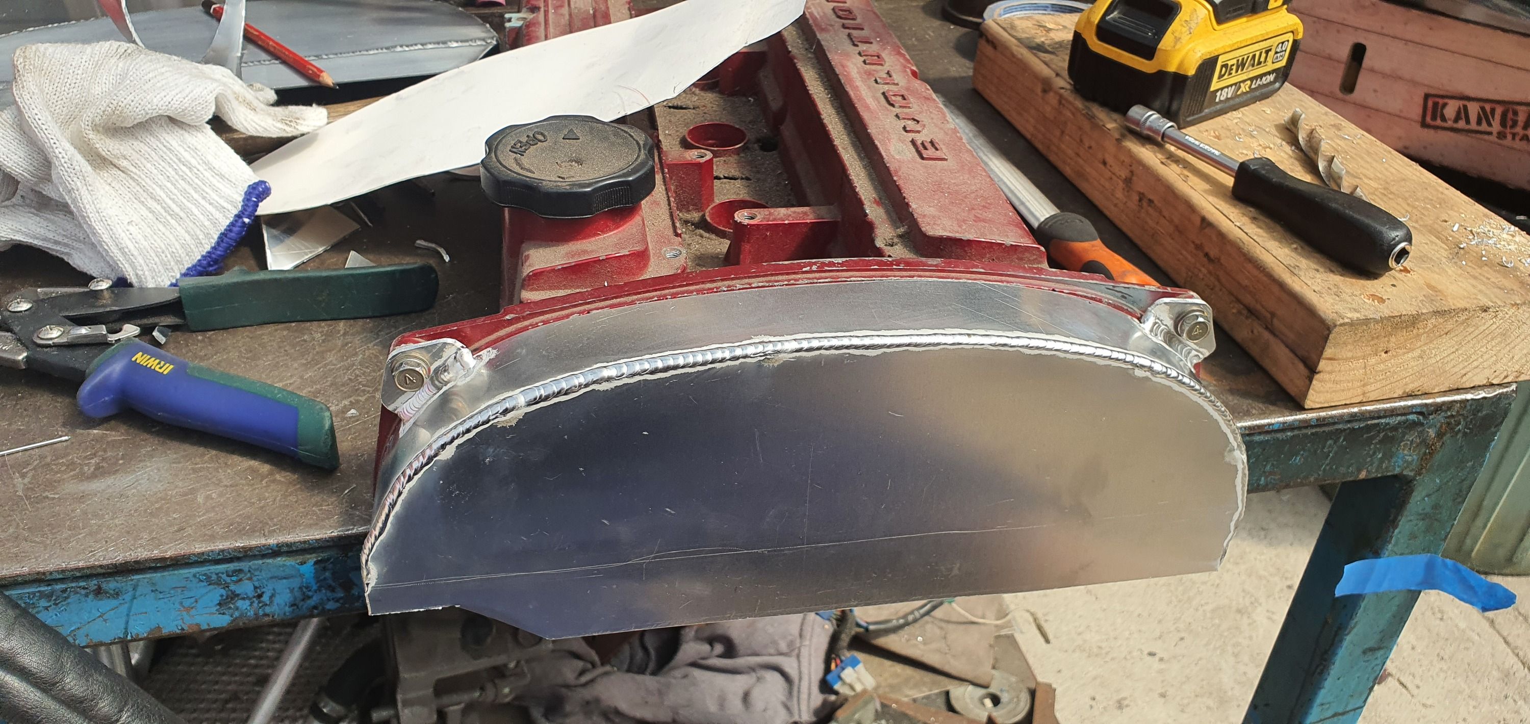

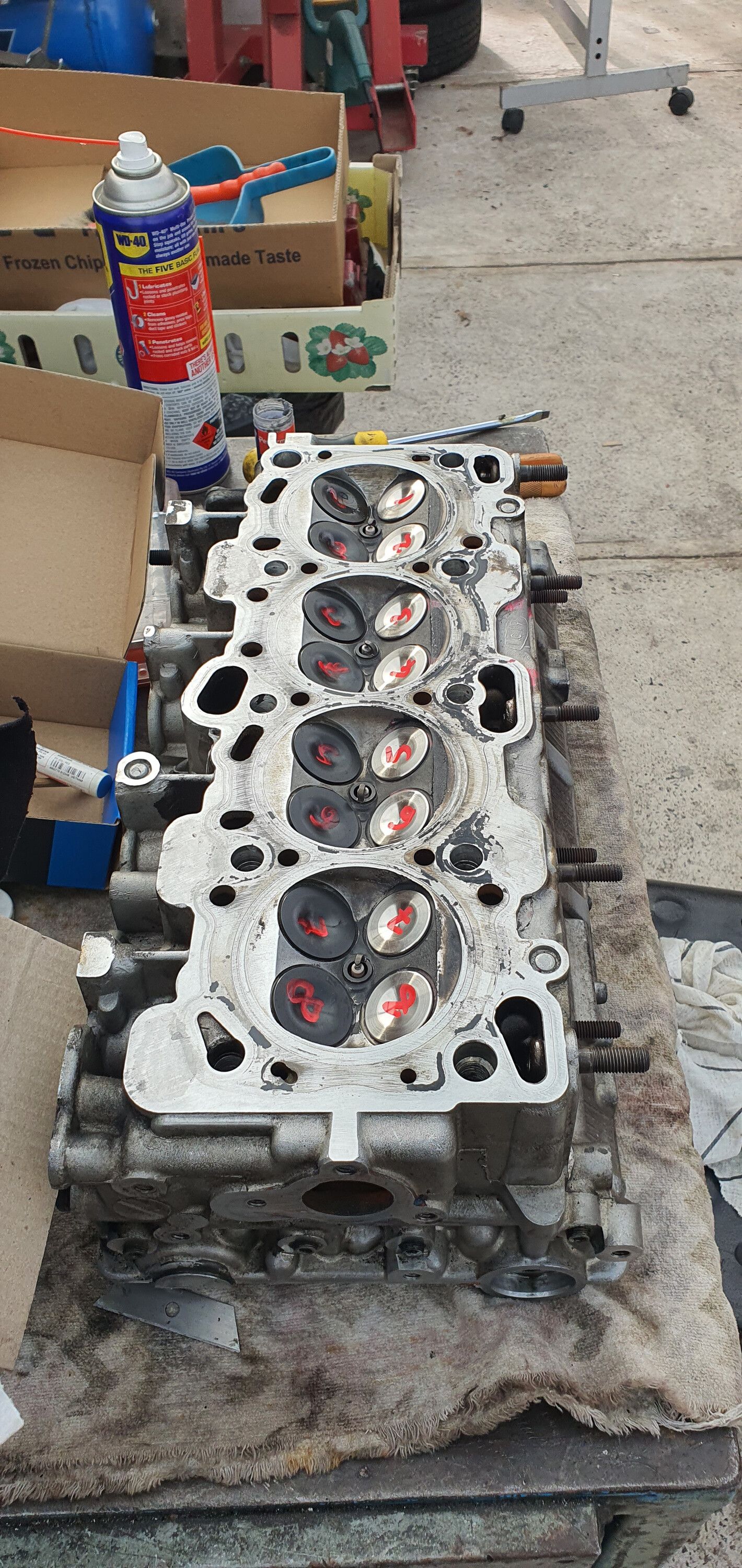

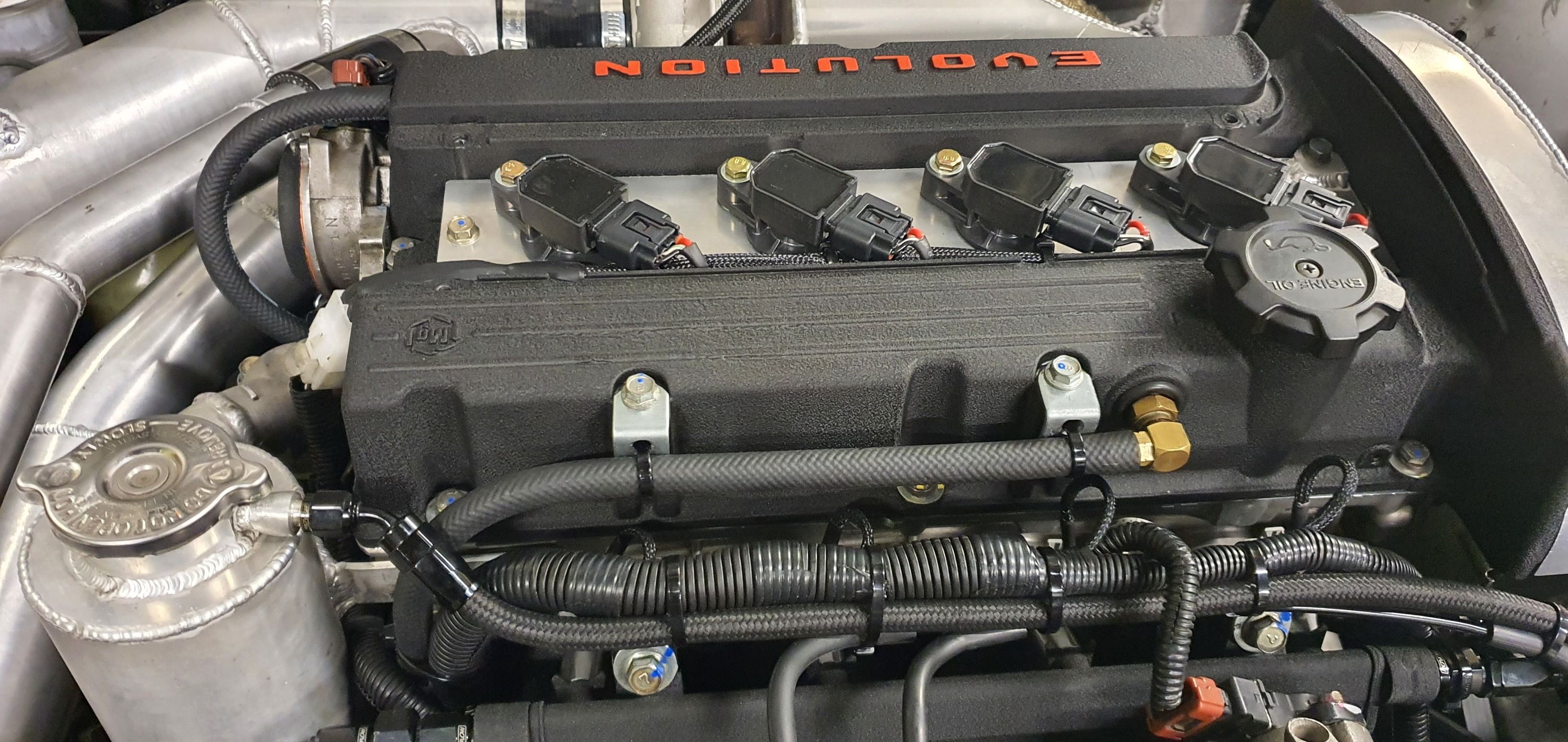

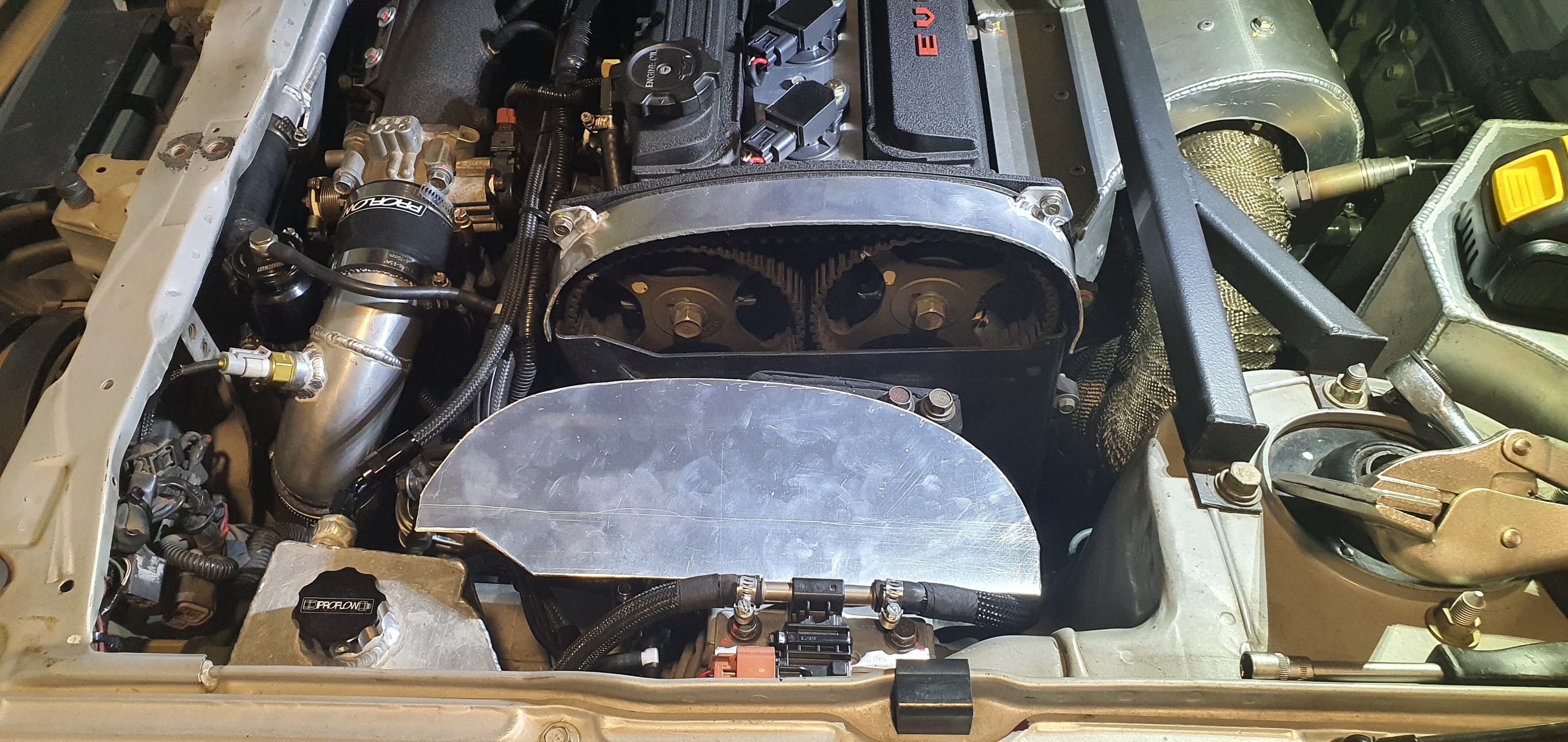

Alloy cover to tie in the 6bolt lower cover. Later model head does not have mounting points below the cam gears for timing cover. So at times the timing cover can flex and touch the cam gears.

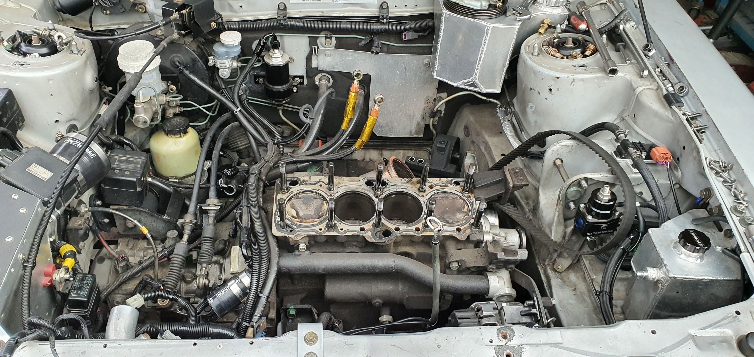

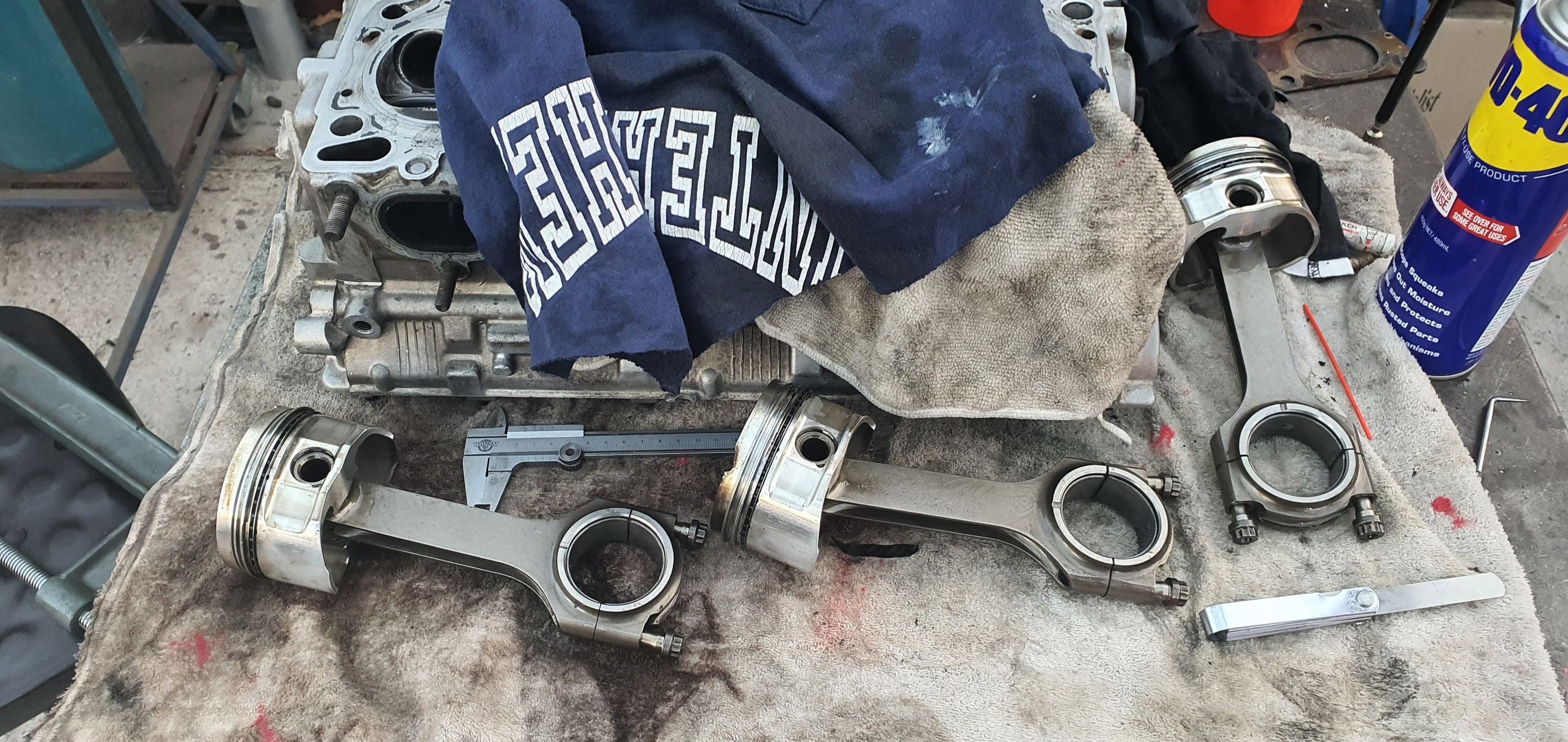

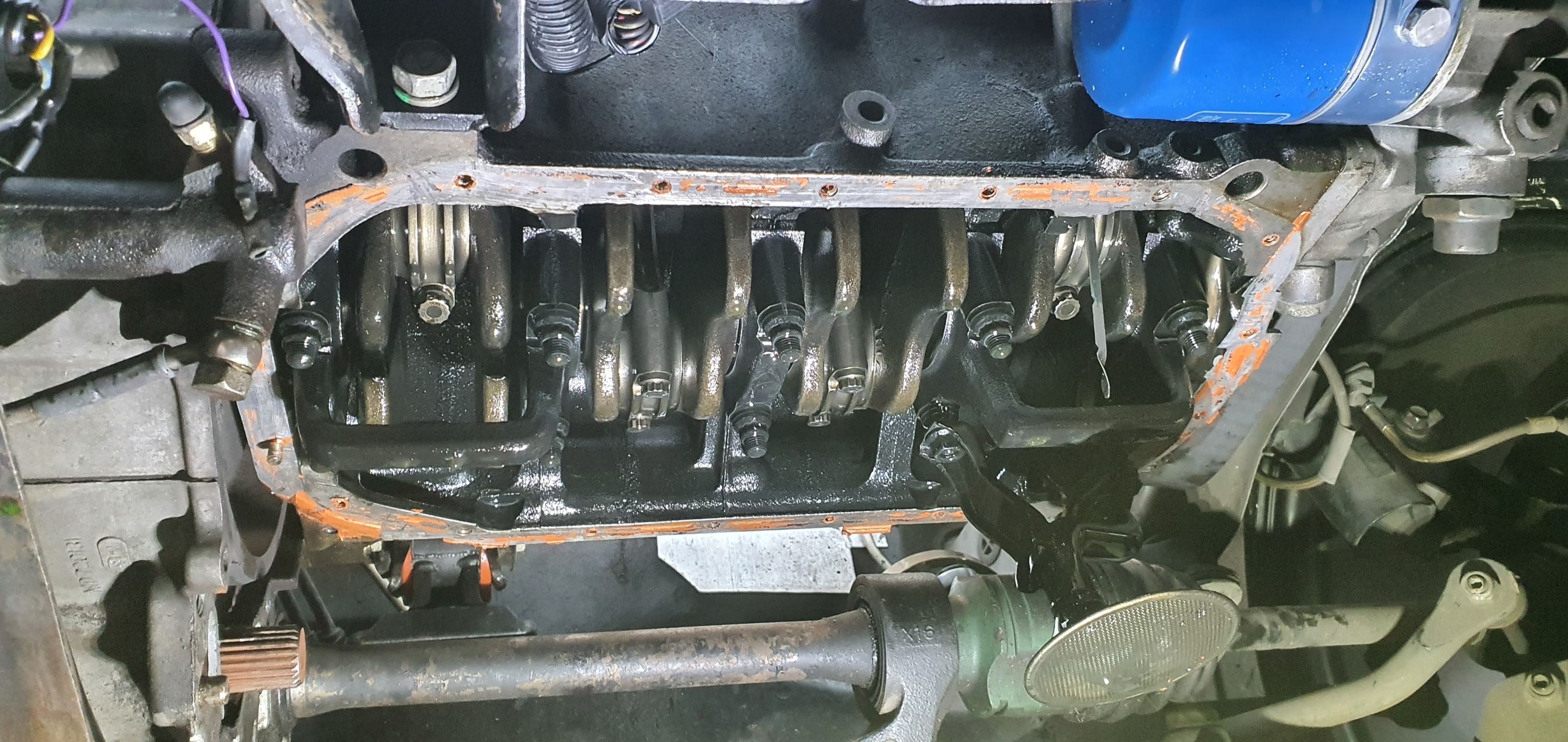

It has been 10 years or so since i installed the reverse head for shits and giggles, was a budget build so reusing valves and springs etc was the go. Probably time I rebuild the head properly.
Super Tech valves
BC springs
Switched from HKS 272 to GSC S1
Checked over the pistons and rings

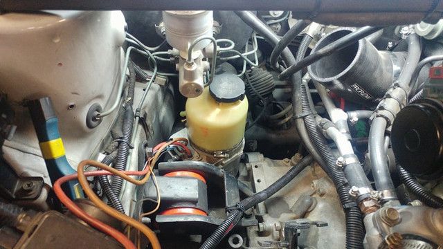

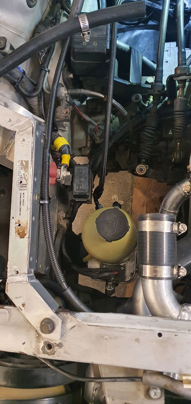

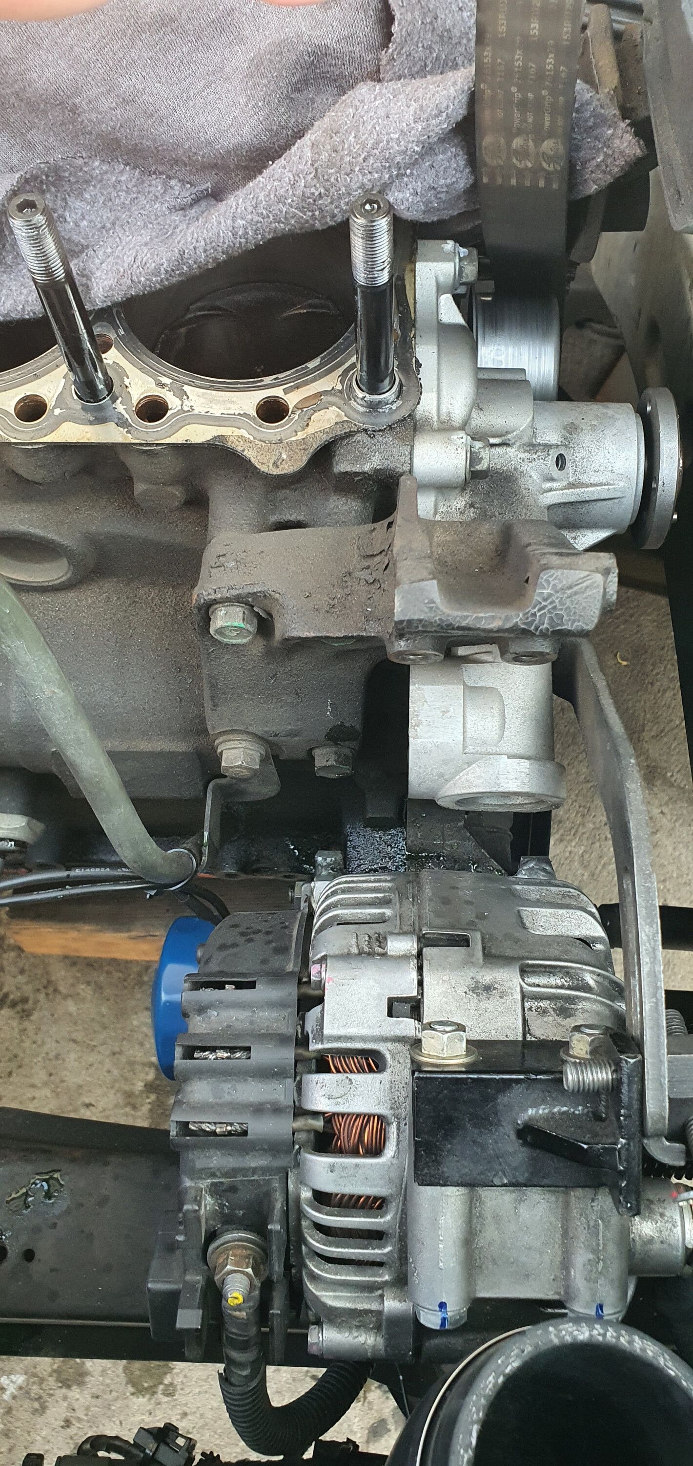

Finally got rid of this useless bracket thats been stuck their for a while (power steering pump bracket, replaced with elec-hydraulic pump)

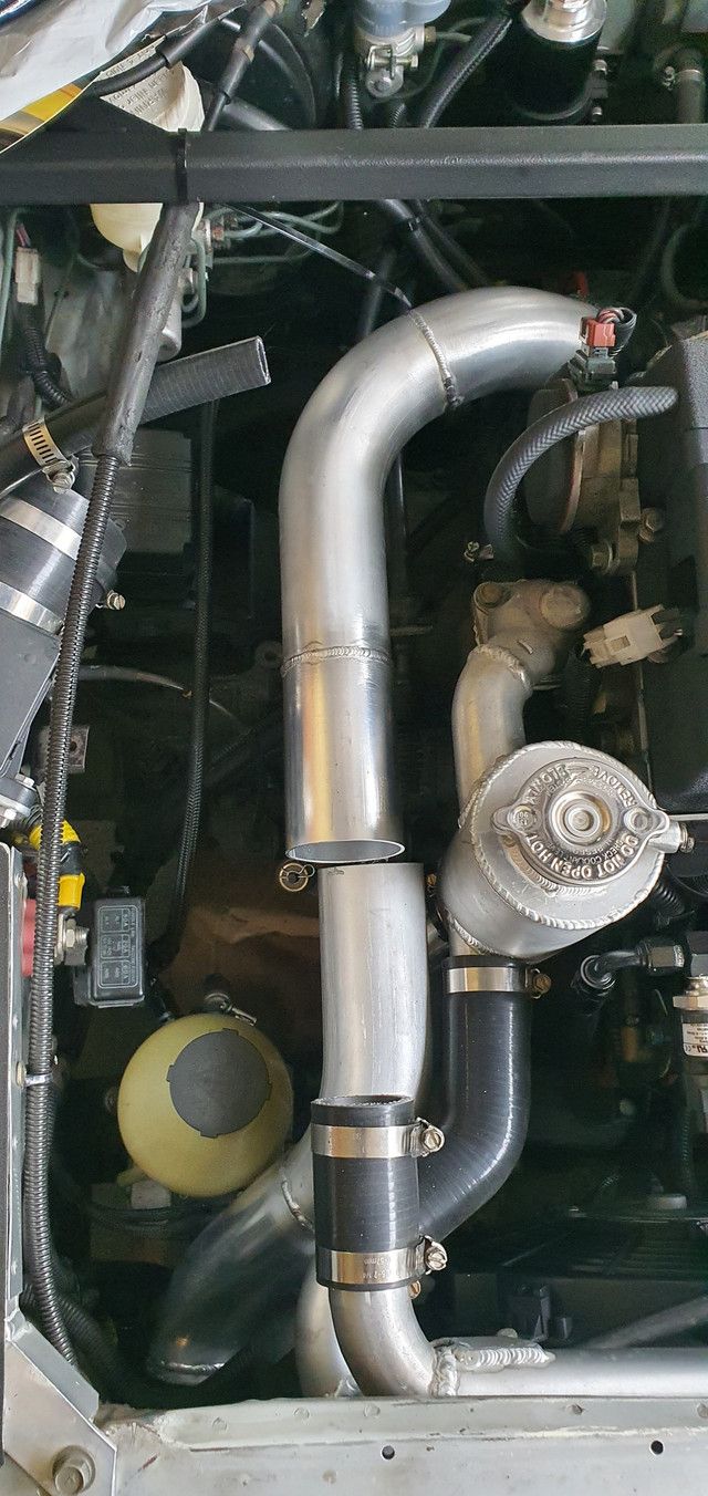

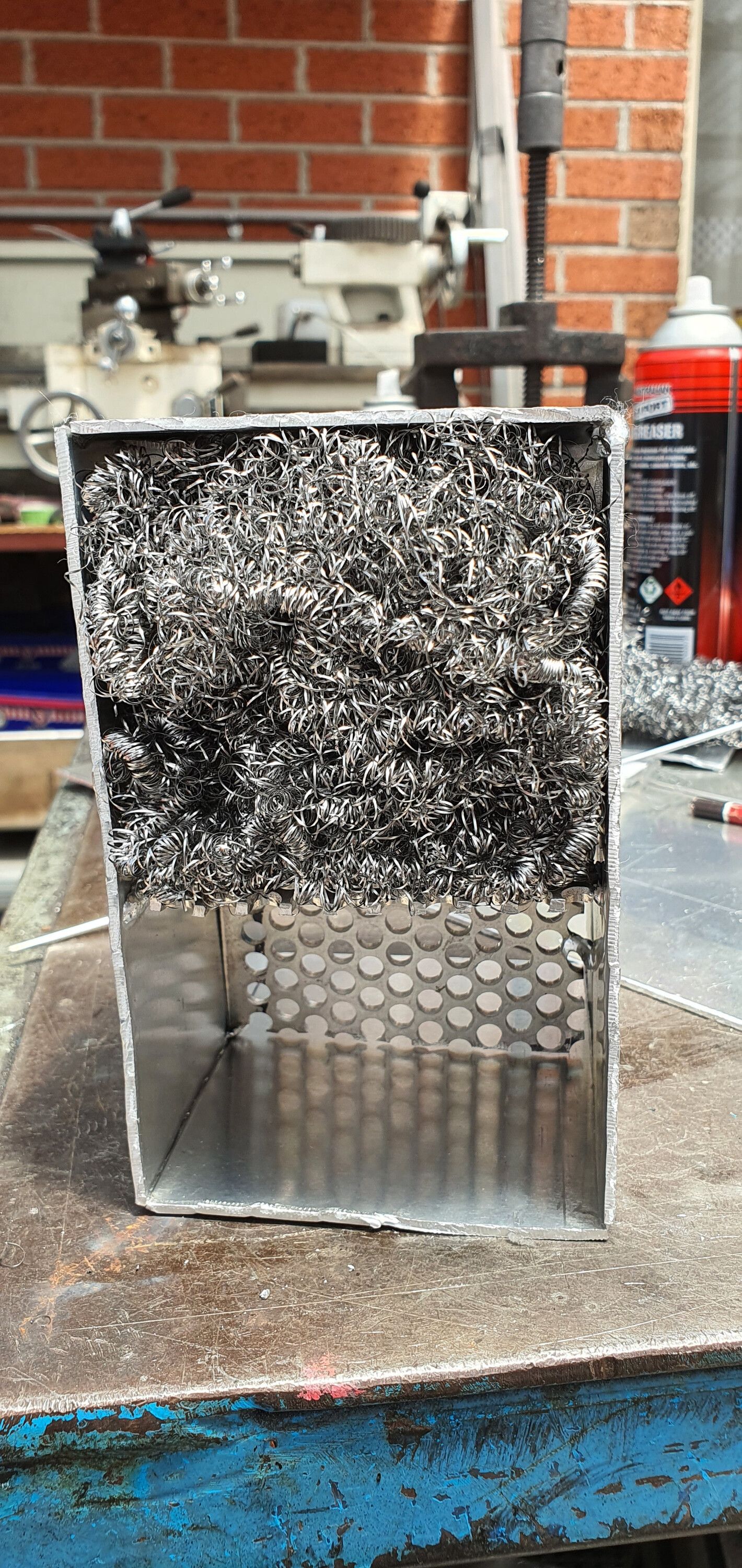

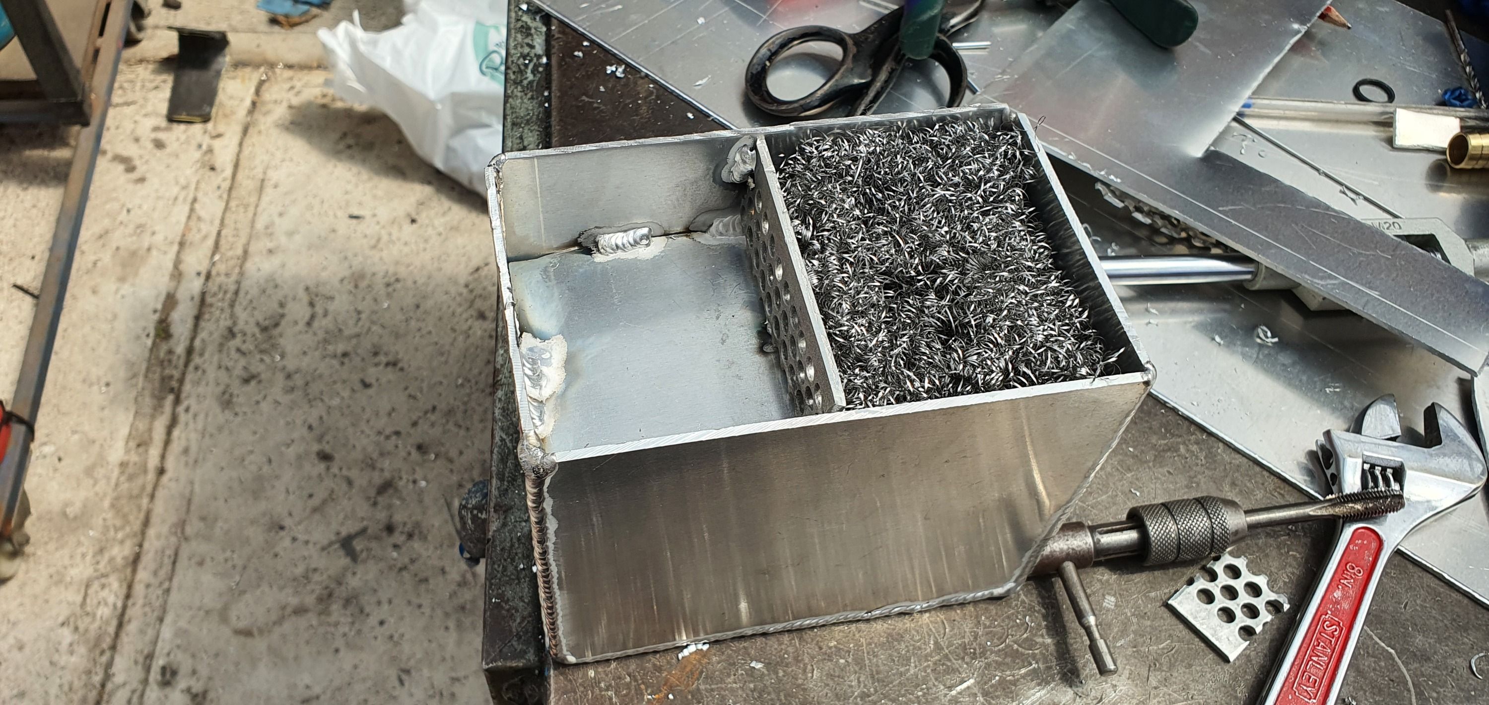

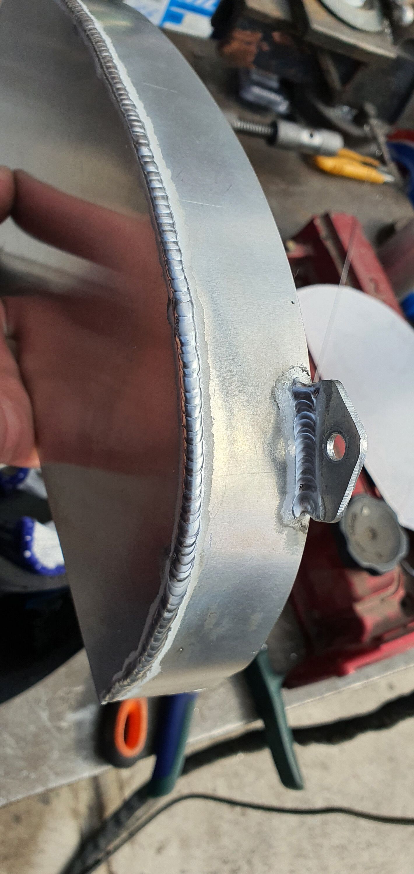

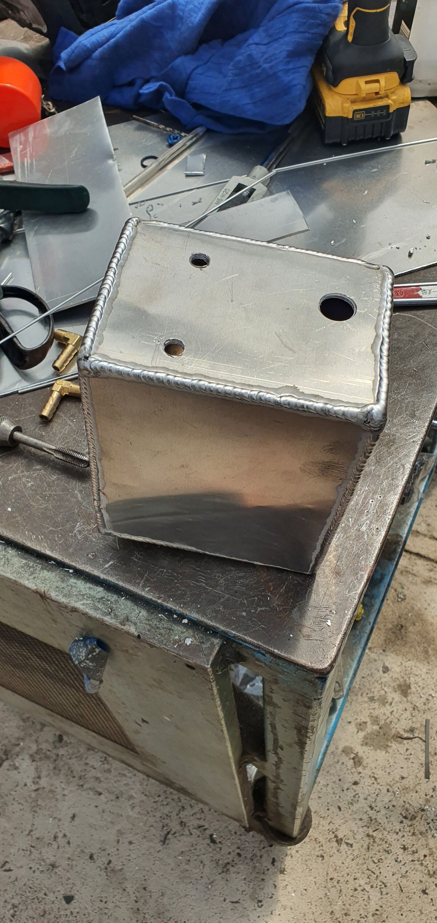

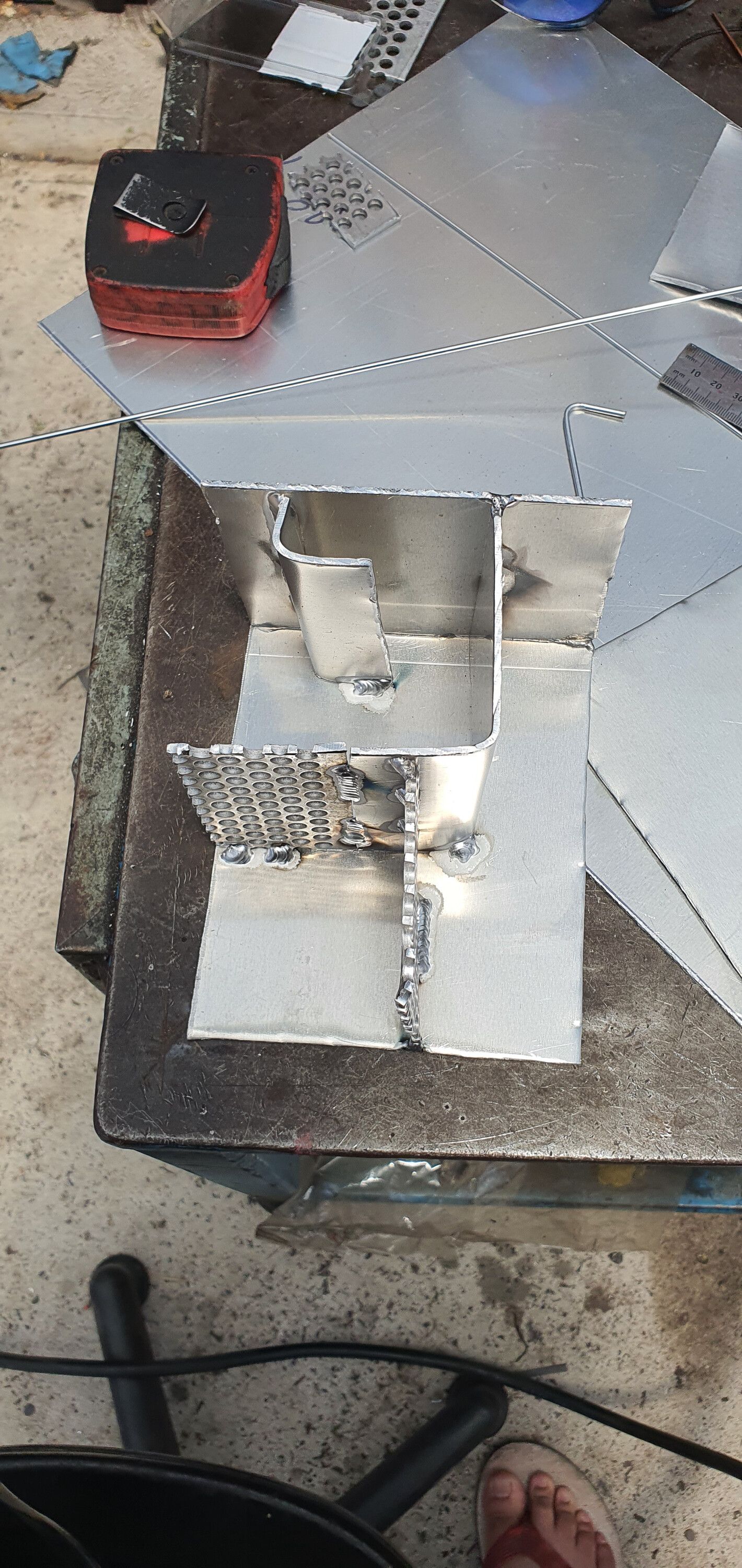

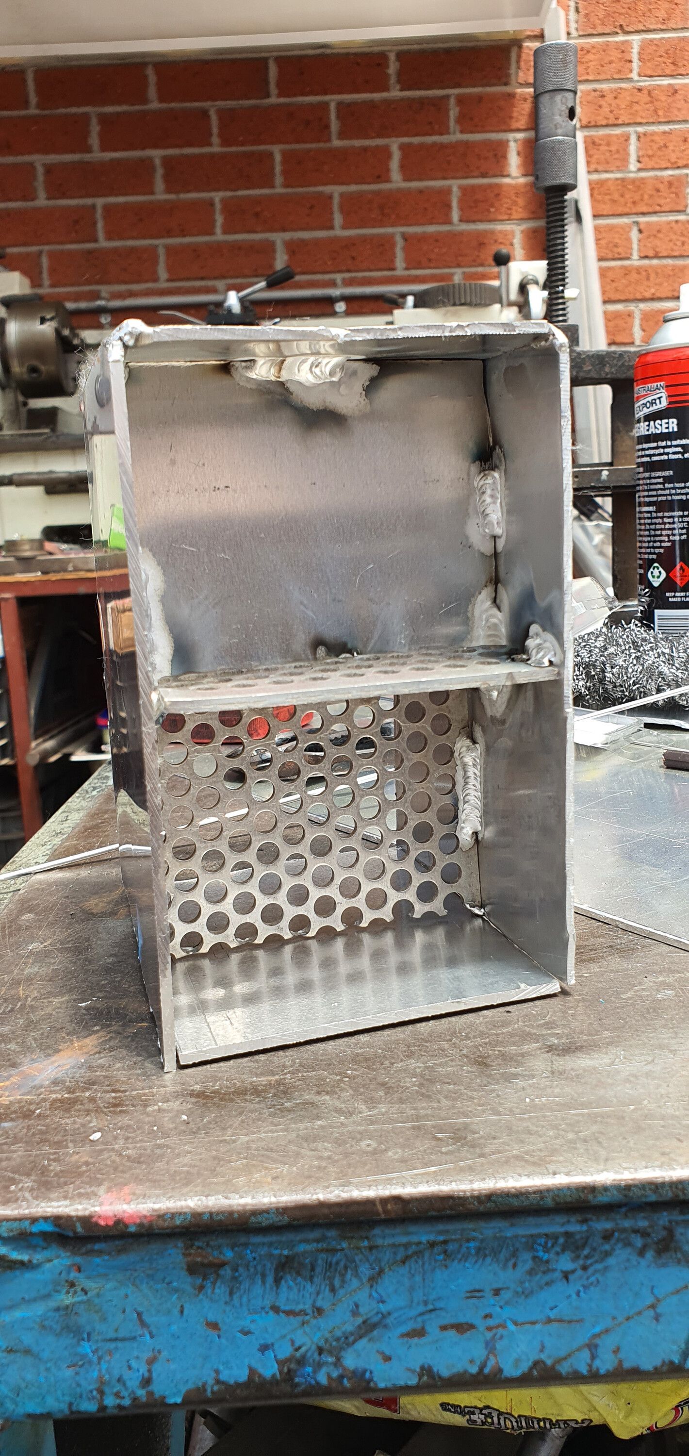

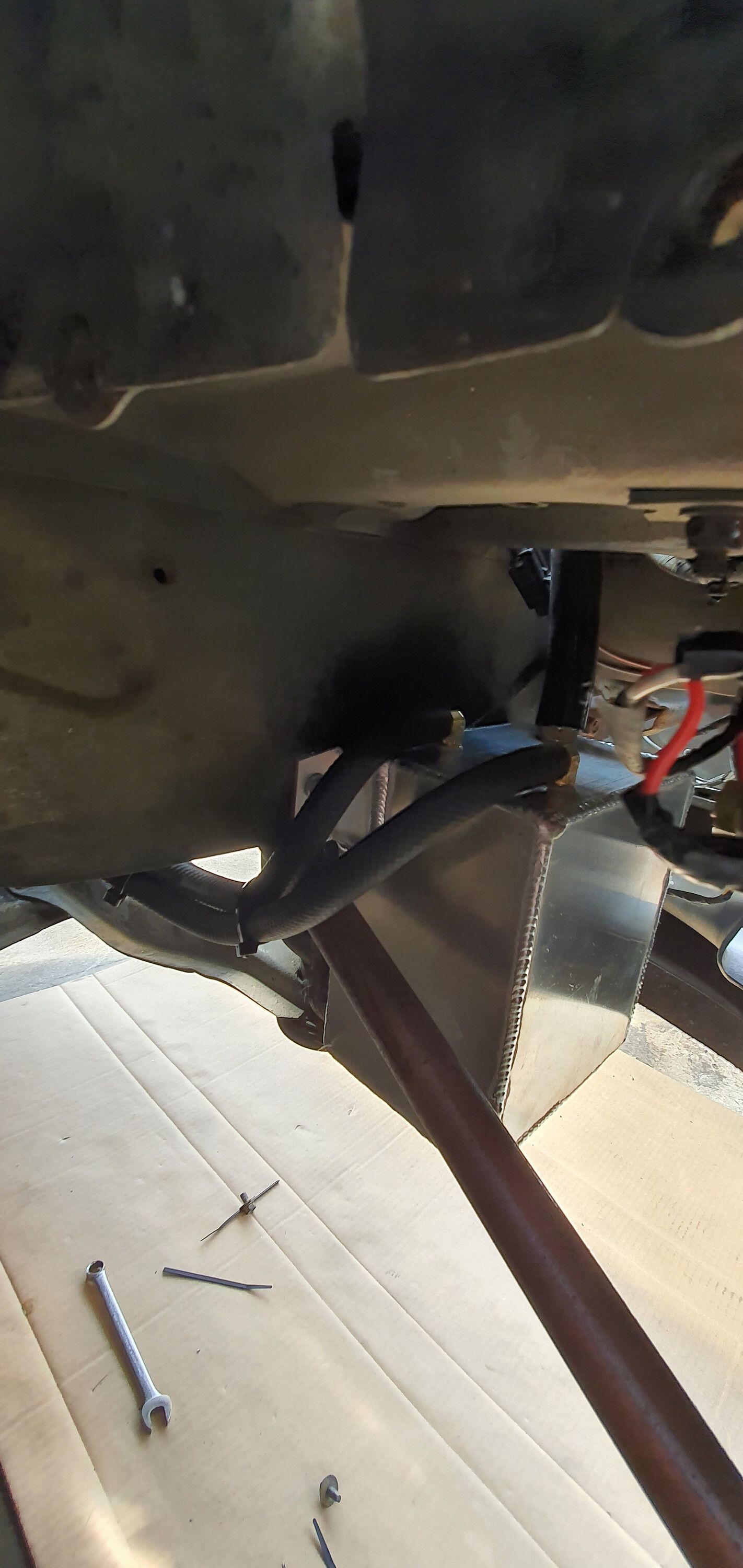

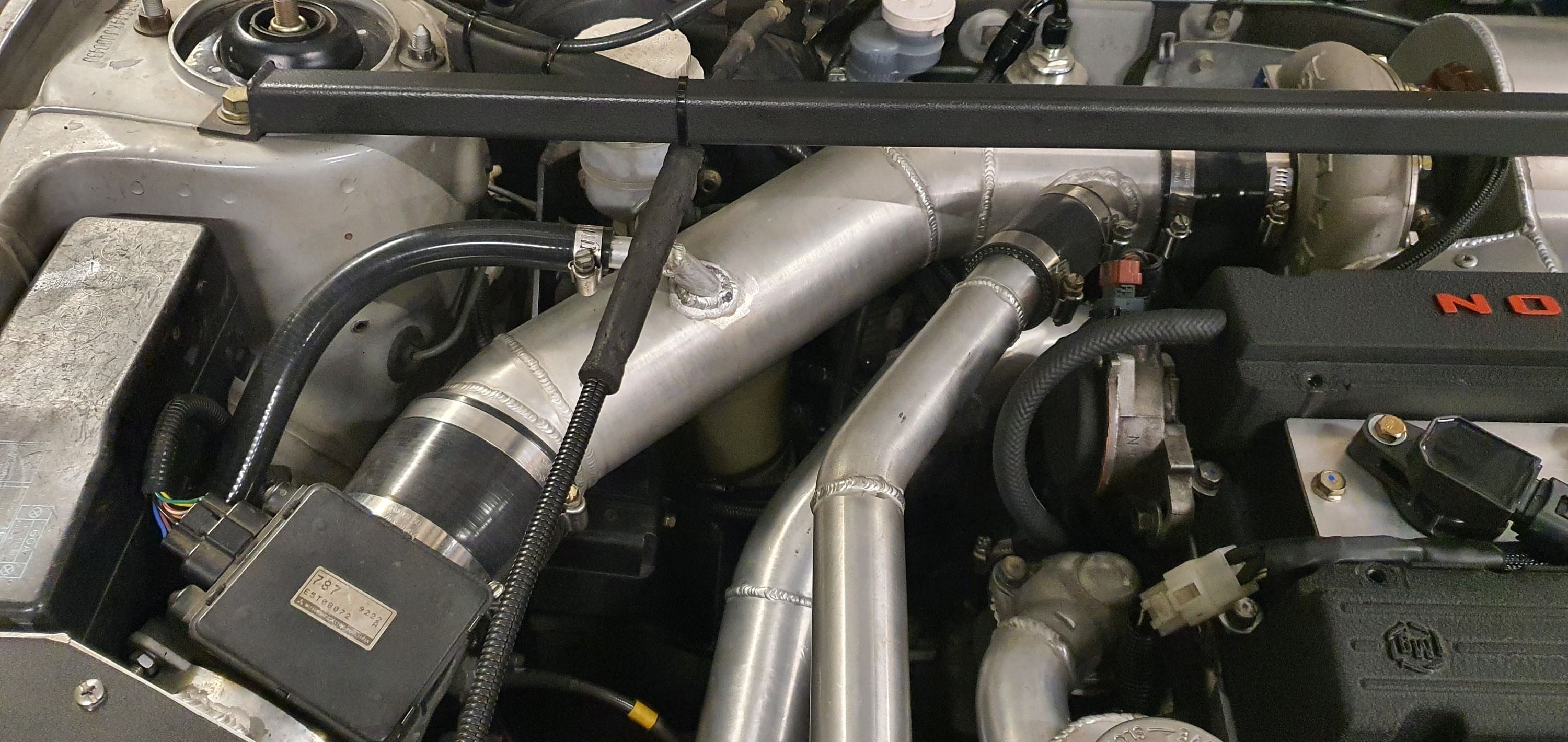

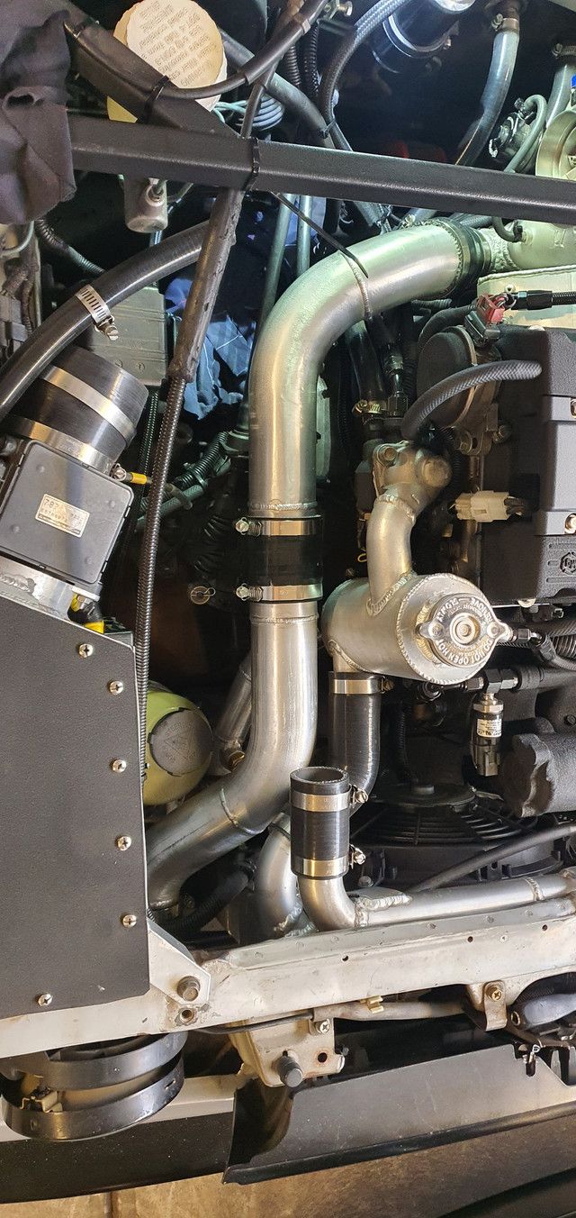

Scrap alloy catch can, plumbed back into intake pipe, 2 stage filtering/seprating
That probably makes a huge difference. That location looks good and works well for what you were trying to do. Nicely done.
Back when I was planning out the location of everything it all revolved around handling and balance - so anything with any weight to it had to be placed rearward of the front wheels, preferably in the hatch area if possible to help with weight distribution, and as low to the ground as possible for center of gravity. Sound and comfort be damned LOL Of course, that wasn't always possible, but it was always the first thought on everything. It's nice to not have that rule all the plans, in this situation for example.

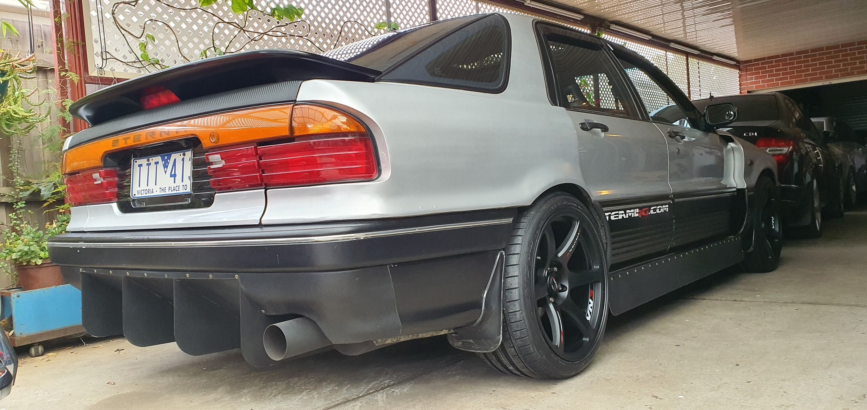

Yeah..... I started that then gave up on making it track worthy. Way to much designing and memories to possibly wreck it. Turned it back into a cruiser and put the sound deadening back in. Now its just for pure shits and giggles for designs i want to try out, pure fun now.

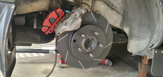

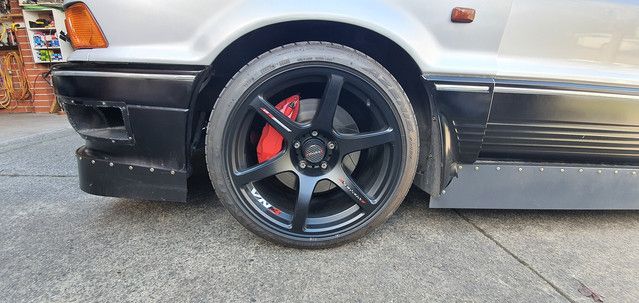

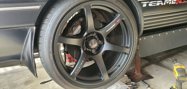

Brake upgrades
Master cylinder:
GTO/3000GT Twin turbo 1-1/16" master
Front:
Evo 8 Brembo's on the front (fairly normal upgrade)

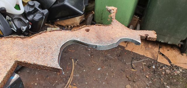

Custom brackets
Winmax W3's
Unknown 320mm slotted rotors

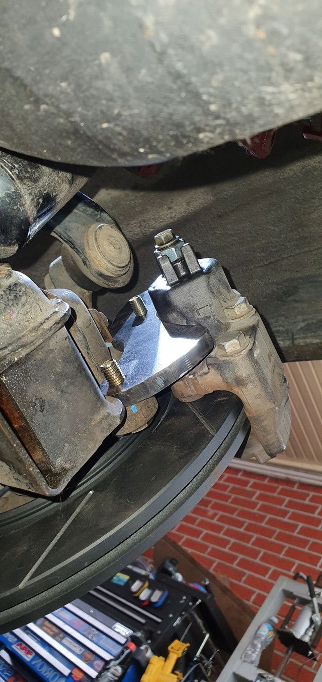

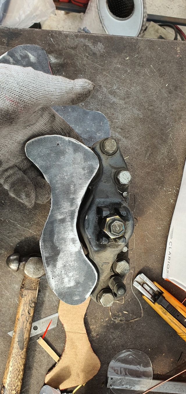

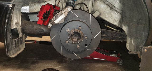

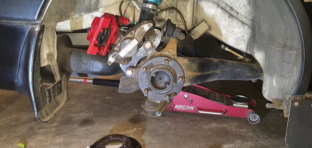

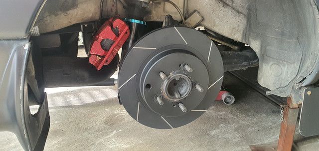

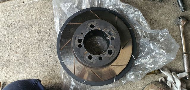

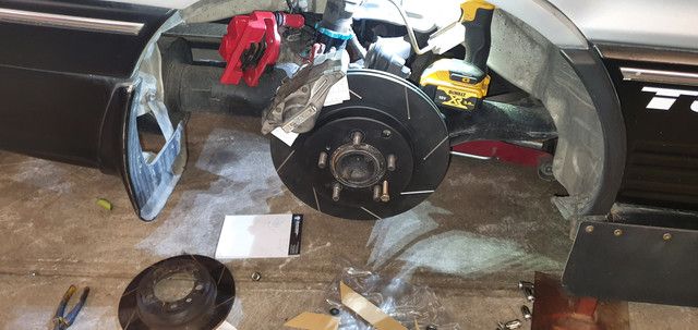

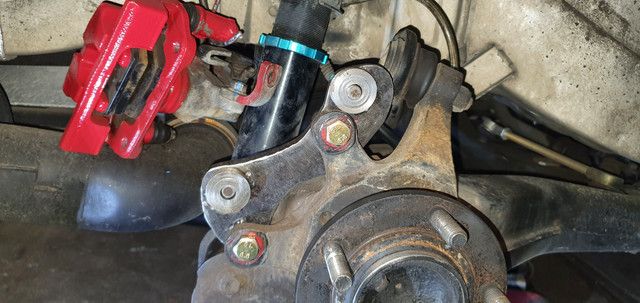

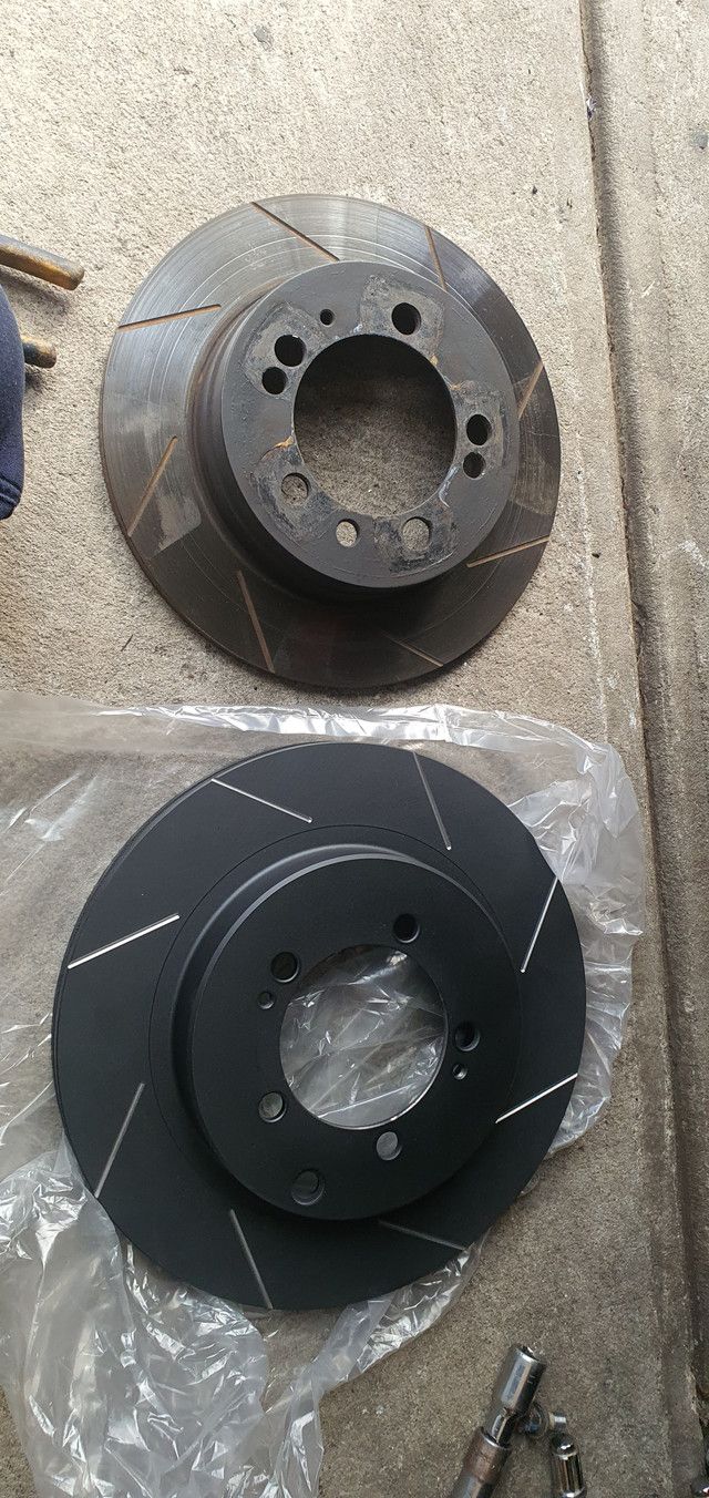

Rear: (there is a kit for a brembo rear upgrade, but that requires welding and spacing the hub out.
Developing a bolt on rear brake upgrade with available parts (junkyard parts)
No longer stuck with single piston with in built hand brake (E brake)
Subaru twin piston Sumitomo caliper

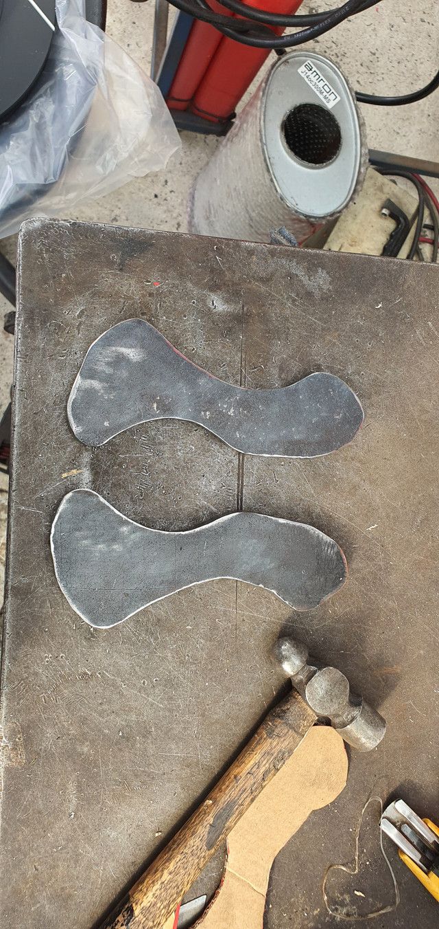

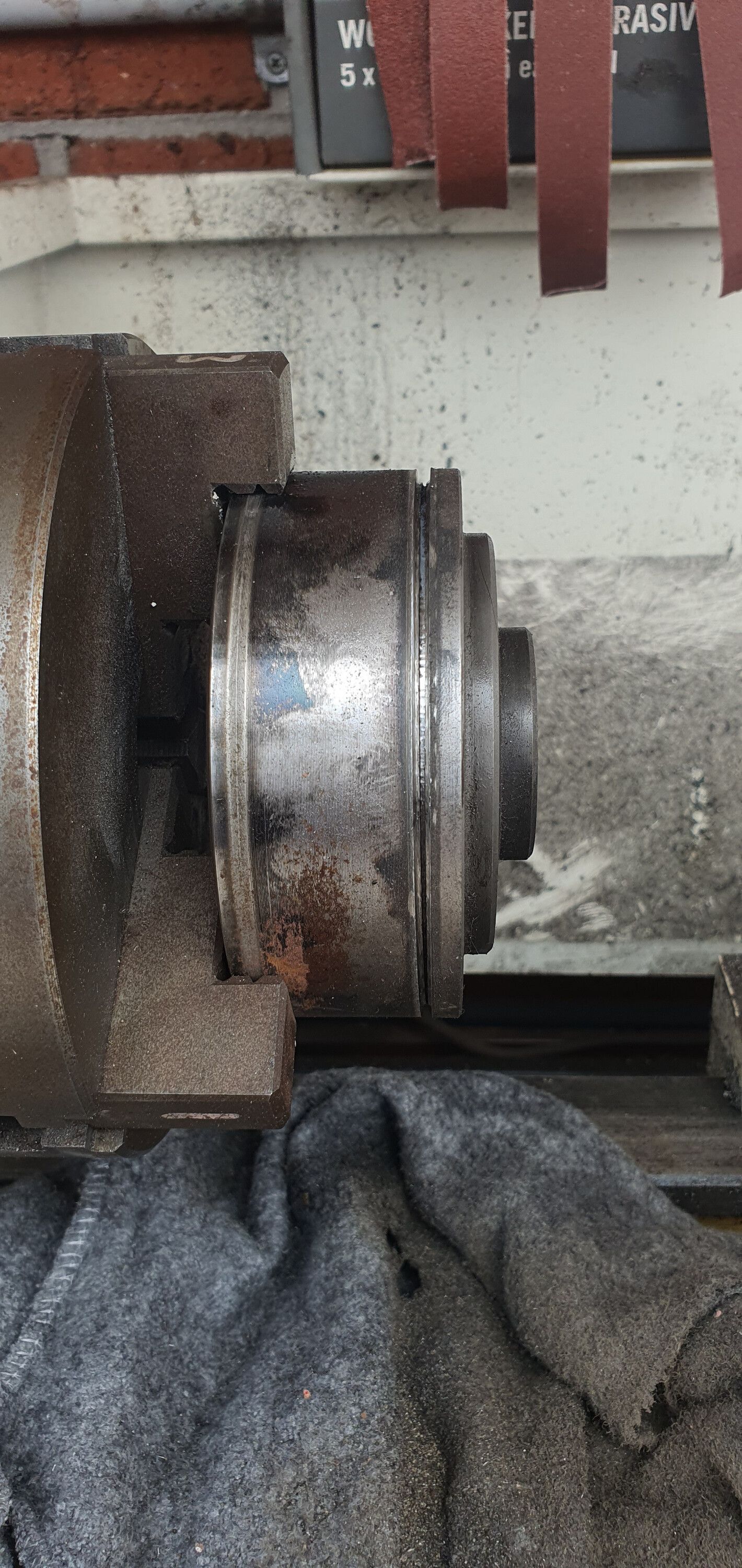

296mm vented disc custom slotted (Bolt on disc, off the shelf item)
Custom brackets

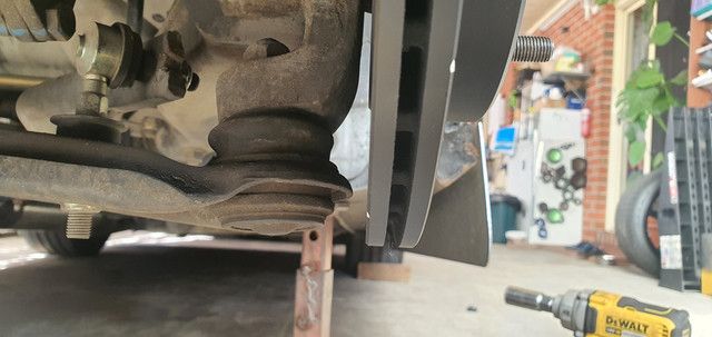

Disc fitment
Mock up/caliper placement
Fabrication
Fitment check
Hand brake (E brake) design on the way.....
