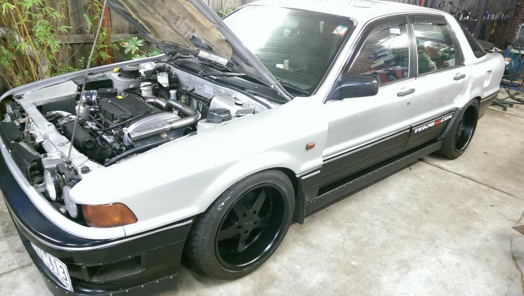

How she last looked before I took her off the road for more mods:

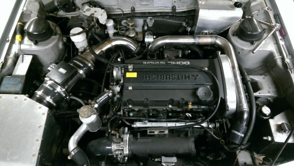

Current set up, EVO7 Head and turbo VR4 block

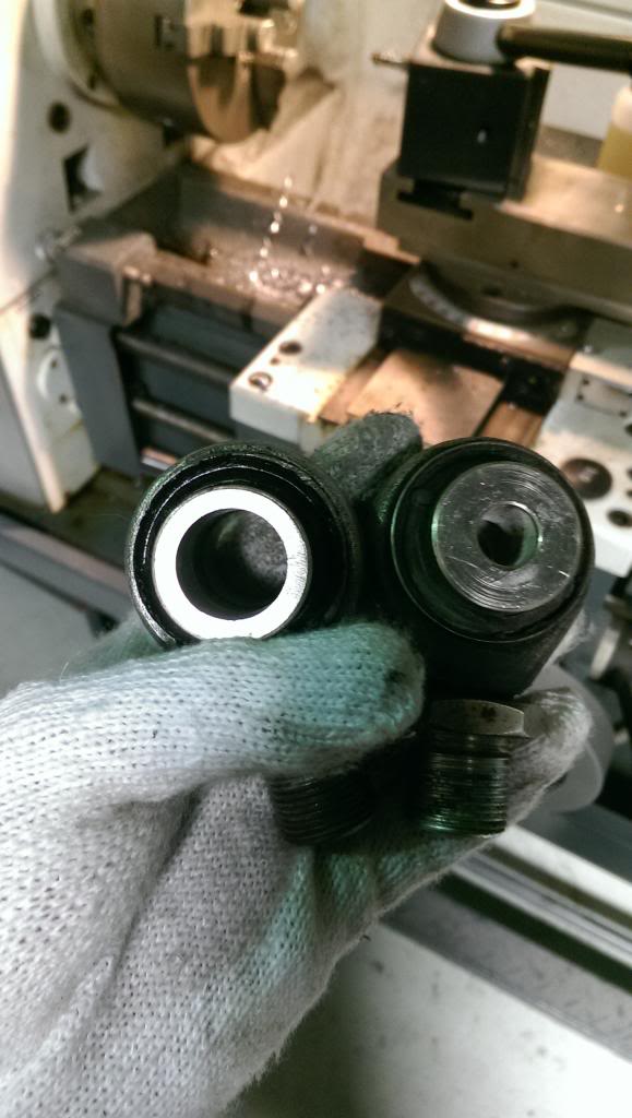

EVO1-3 Rear LSD should fit, have a look in the Malaysian markets from the Proton Wira AWD's (Hatch and sedan of an evo 1-3) plenty around over there. (if it doesnt fit, i'd probably just make it fit ahaha)
Front LSD i'm not to sure, the one I have was a fluke buy and only some lathe work was needed..

Its been a while since update:
new engine is done, usual forged parts..
Solid front and rear engine mounts
Excedy 5 puk clutch (i'm sure i'll snap this) Free with last VR4 wreck..

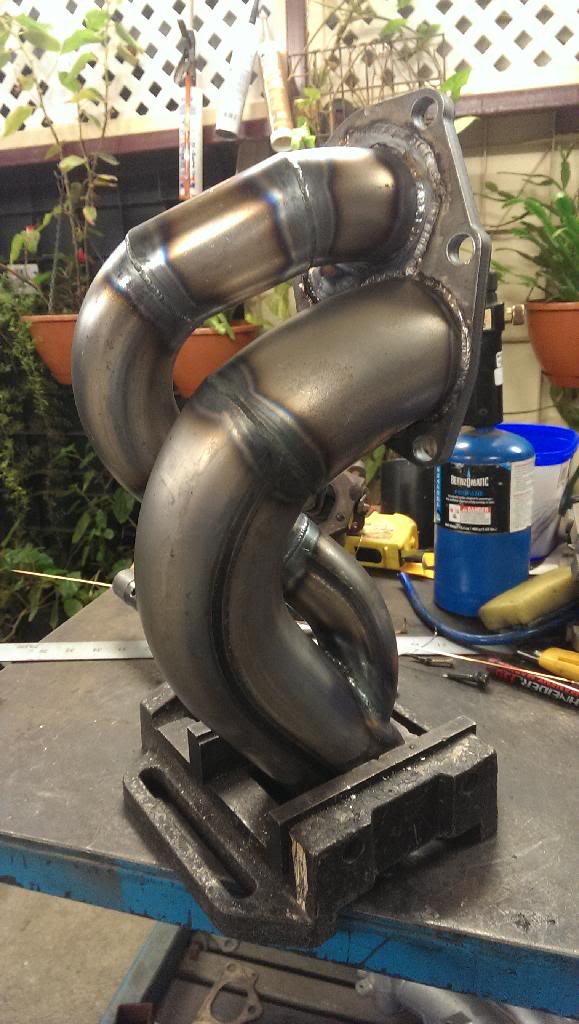

Exhaust manifold shortest route possible, Using stock frame Evo4-9 turbo (looking to use MR or RS turbo)
Ready for custom tunnel..
Hybrid TD05/6 with billet 20G front wheel, single flapper 10.5 twin entry rear housing..

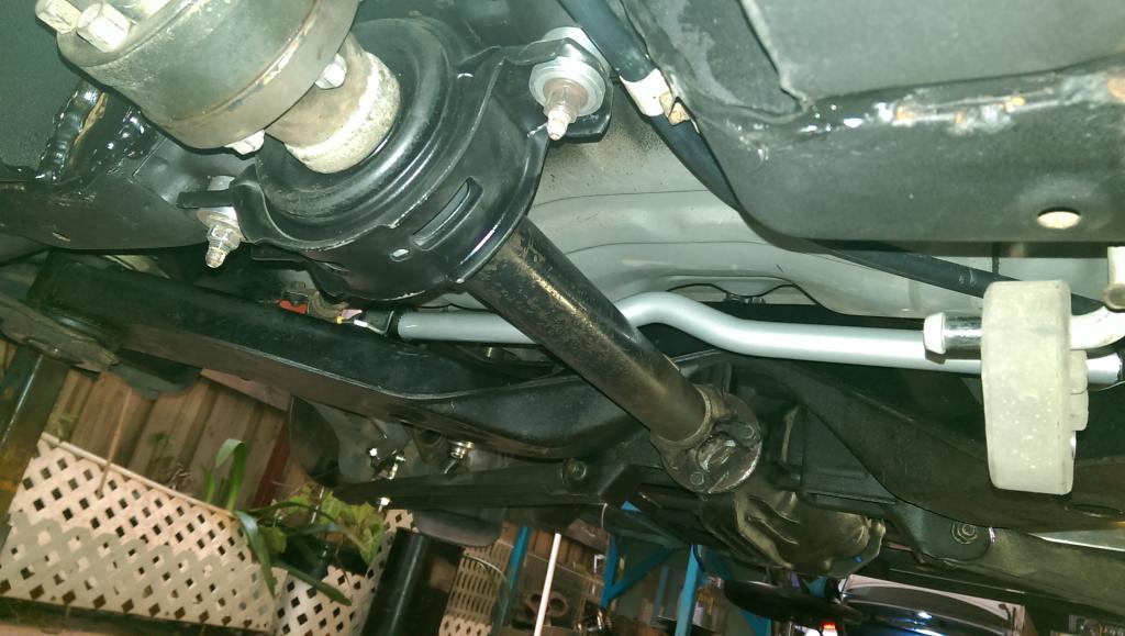

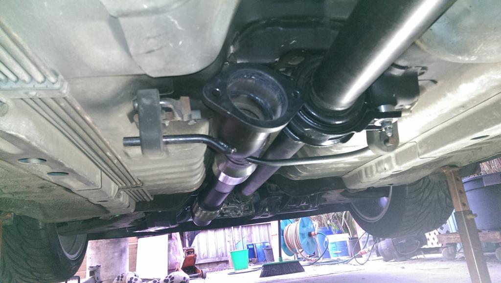

Prop shaft

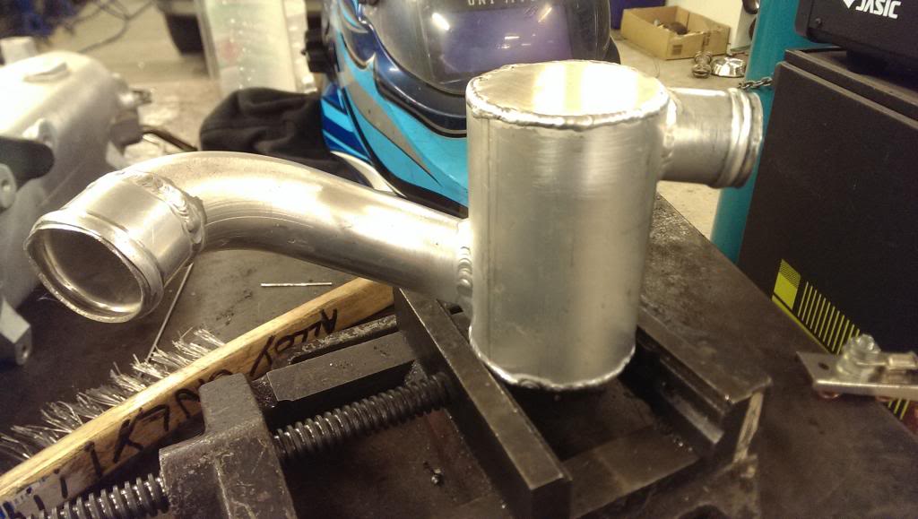

Coolant swirl pot and filler neck:

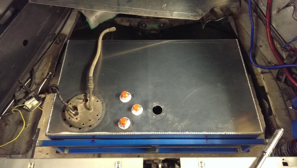

Race fuel tank :)

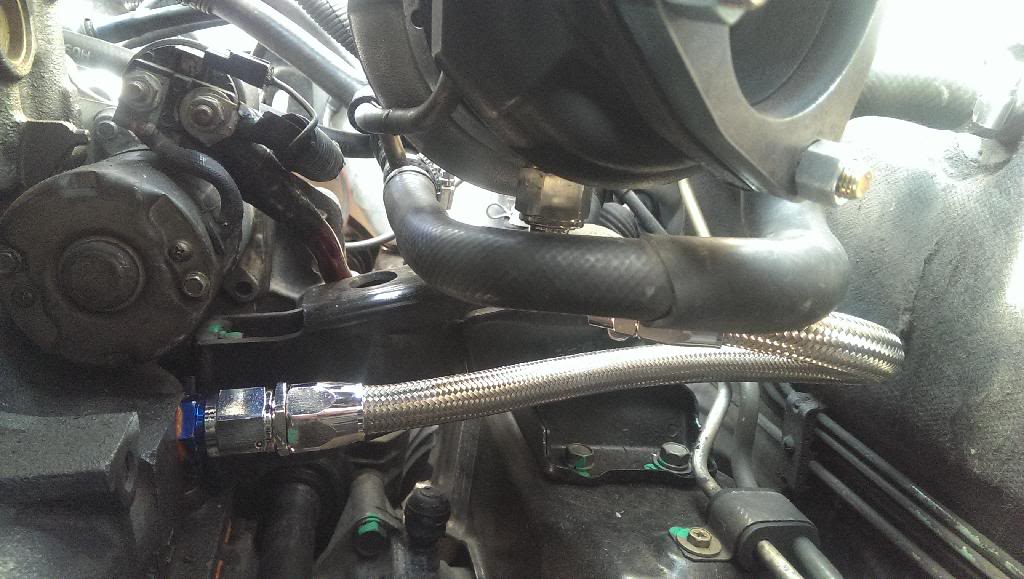

Turbo oil return line
full 3" split dump

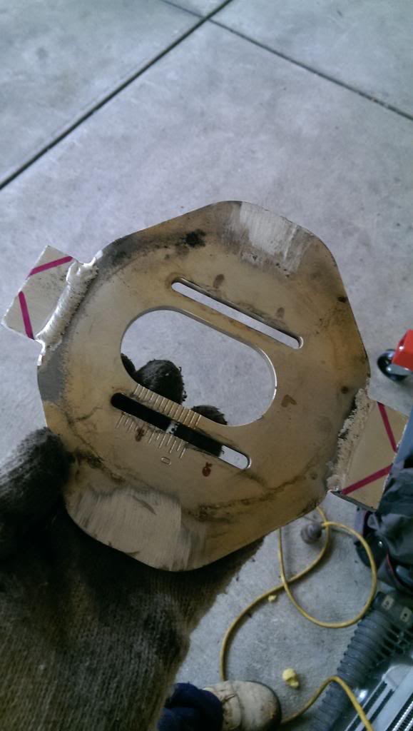

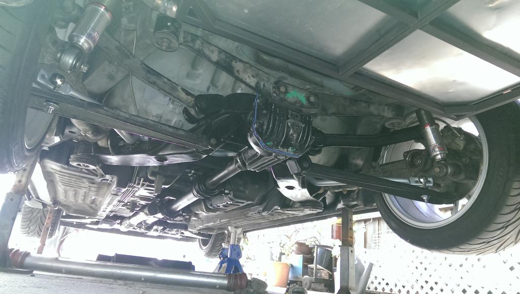

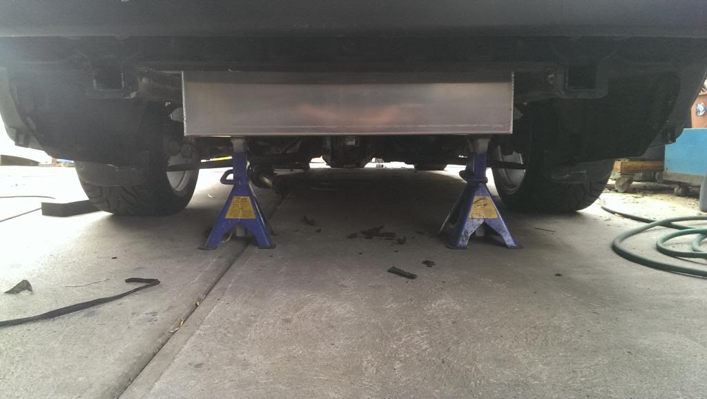

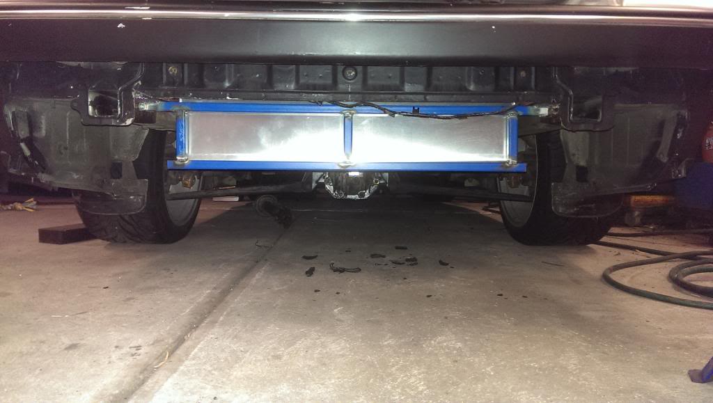

finished welding the rear end for K frame..
a friend hooked me up with a spark plug cover, should confuse more people now....

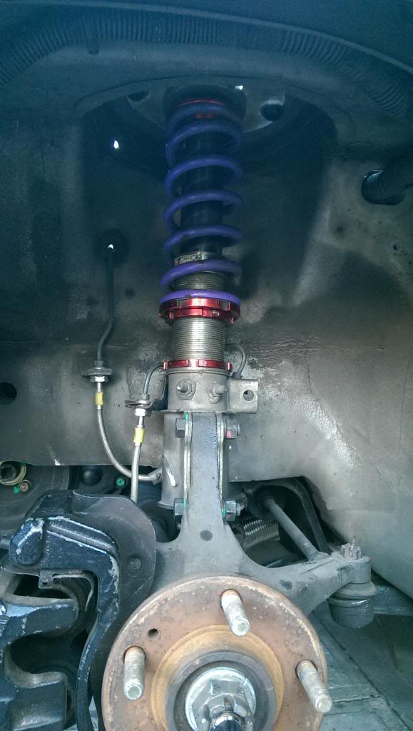

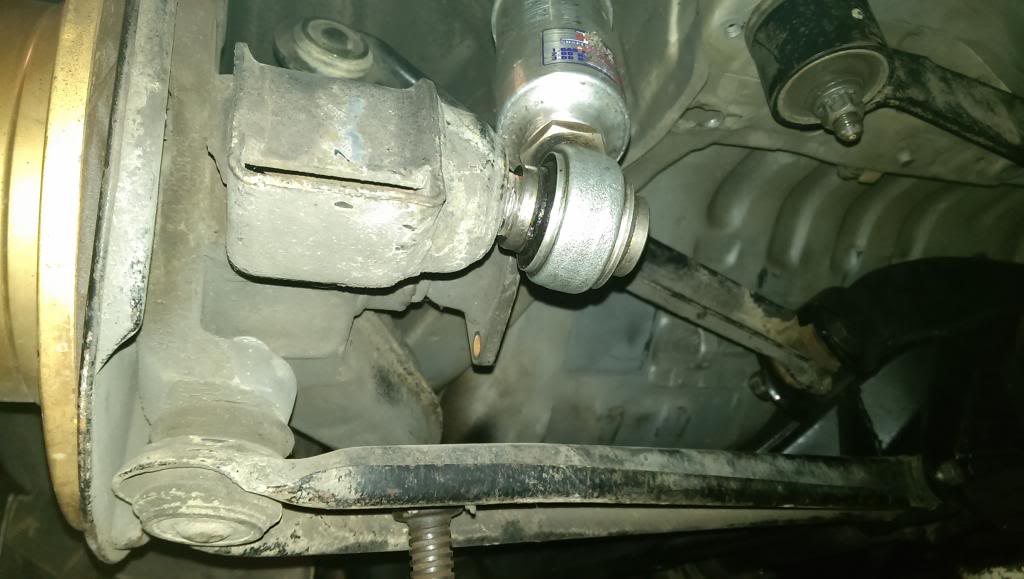

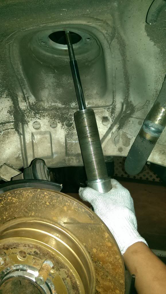

Making coilovers fit ... (no idea what car they came off)
Front:

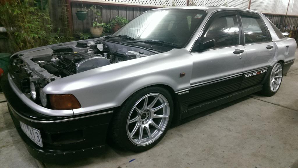

this low only for photos...
fun parts

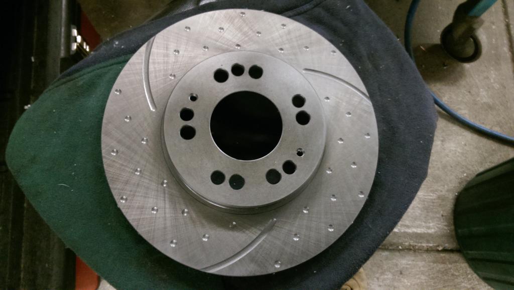

RDA Slotted and dimpled

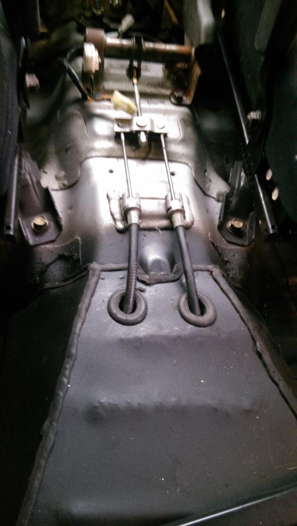

Handbrake finally set up

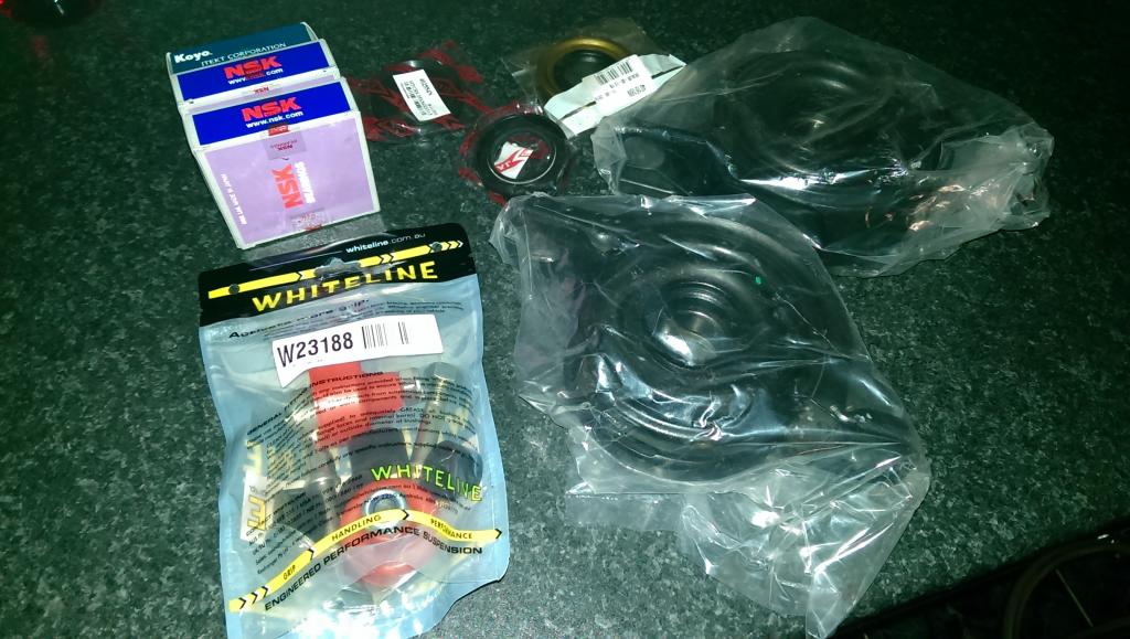

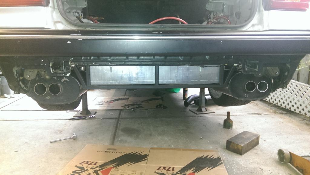

Rear end finally finished, LSD and 26mm sway bar installed, new carrier bearings with alloy bushings

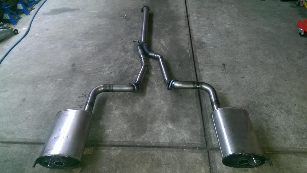

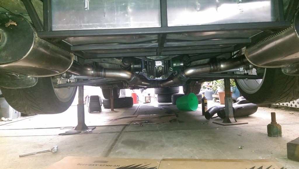

3" full tucked front pipe

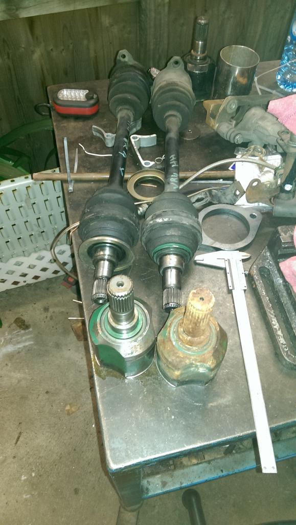

Need to make rear drive shafts, a few parts have to be machined to sit properly

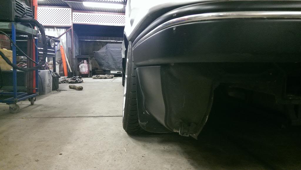

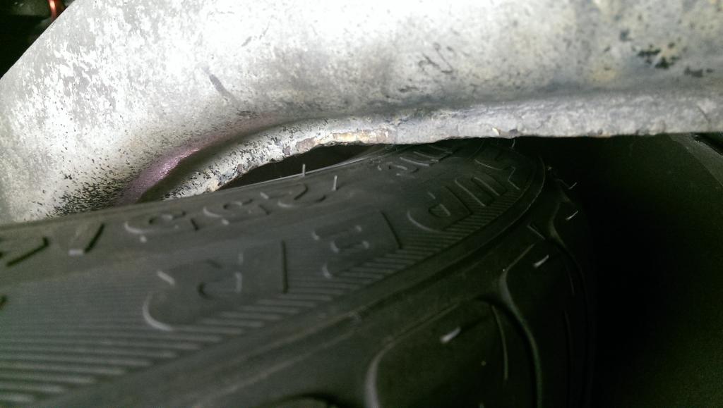

Rear wheel clearance with 17X9.75 +25

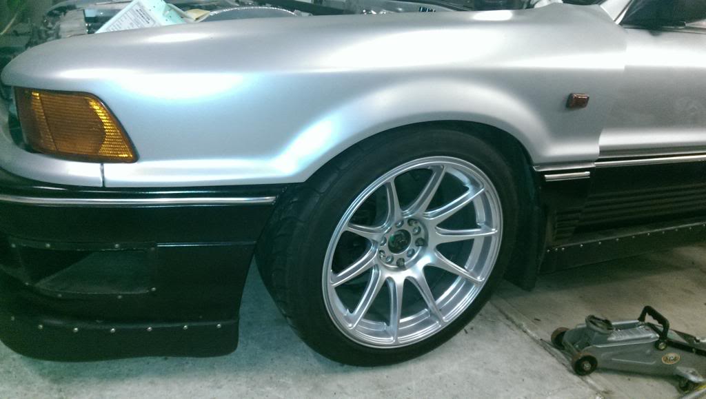

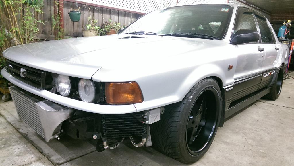

New wheels arrived: XXR 968 17X10 +20, fronts are filled, rears can go 17X12 before they poke out.

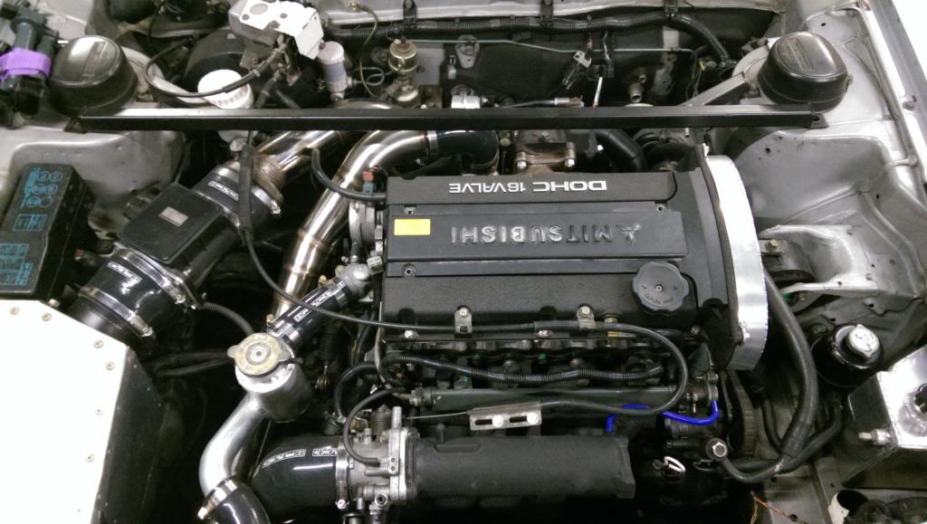

Redesigning the cooler piping route. Cold side is less then 30cm long. Hot side pipe will also hold the heat shield over turbo and manifold.
