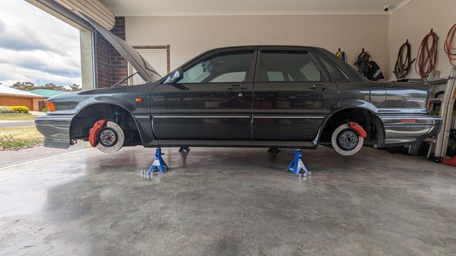

Rear brake upgrade V2

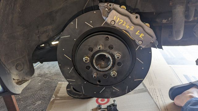

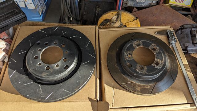

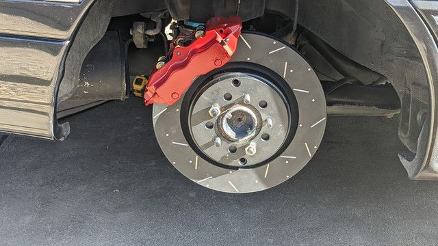

Custom machined 350mm discs

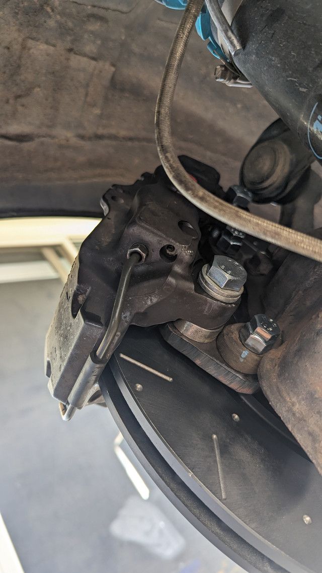

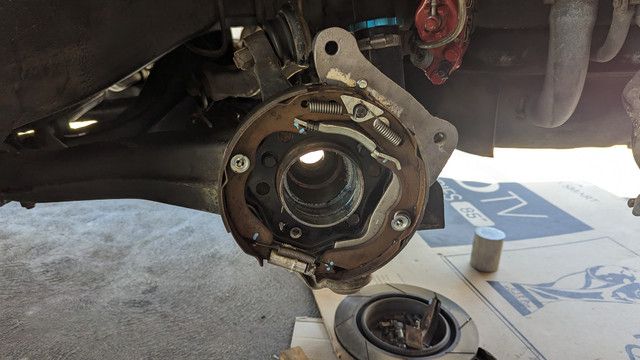

Custom 190mm hand brake assembly

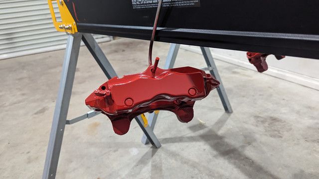

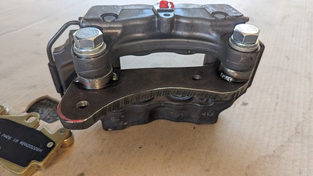

VAG group rear 4 piston calipers (matches the front 6 piston calipers)

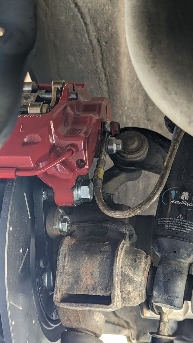

Stock brake lines fit fine

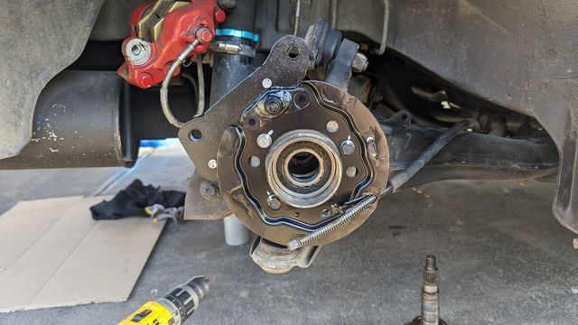

E brake cable re used from last set up, from an evo8

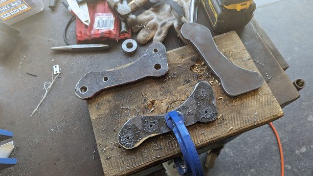

Custom braket to suit

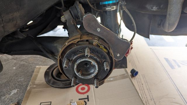

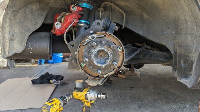

Old set up: Mitsu GTO/3000GT 296mm rear dics vs new 350mm disc

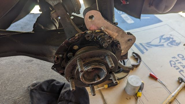

Caliper bracket:
E brake:

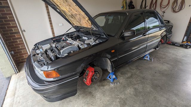

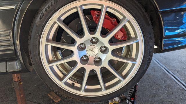

install:
😳 you're gonna break some necks when you slam that pedal... once you get the bias worked out.
Have done about 100km's around my area to bed in the brakes, and they are scarily strong.
Need to do the final brake bleed and re torque bolts and nuts.
