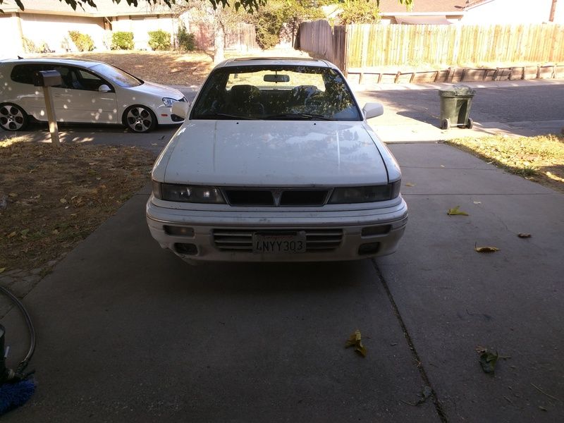

The goal of this car is a mild street build that retains mostly stock looks, since I am from California, I would like to make smog checks as headache free as possible, and making sure I pass the visual is a big part of that. It means no emissions delete, all vacuum lines in place, stock intake etc...

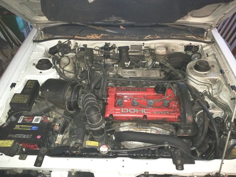

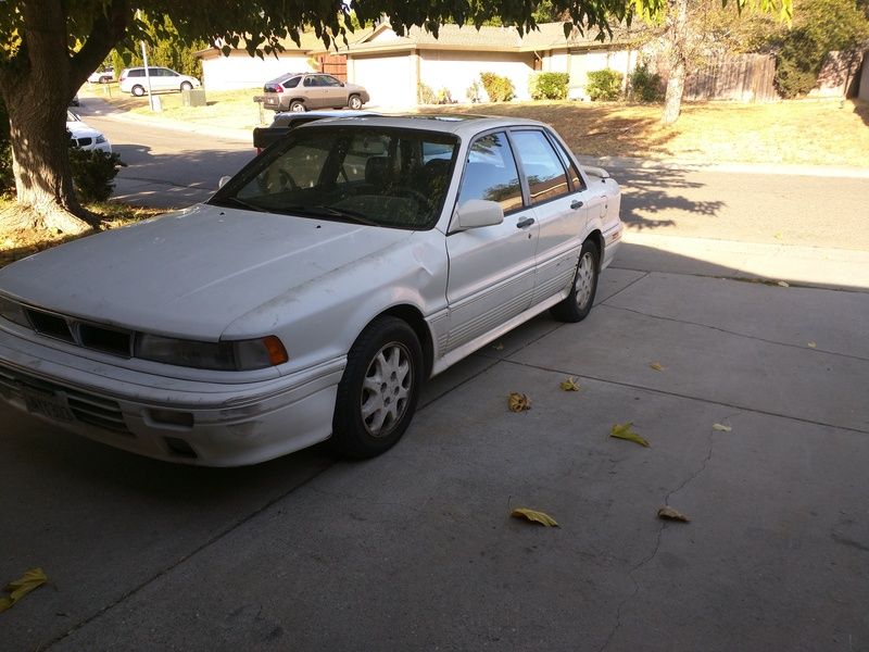

Here are the pics I took of it before it would go under the knife, the body is very rough with dings on basically every panel.

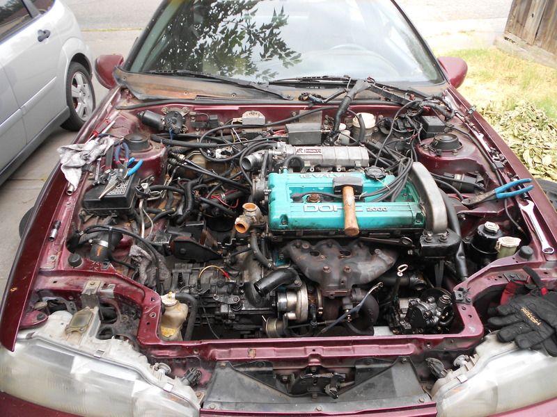

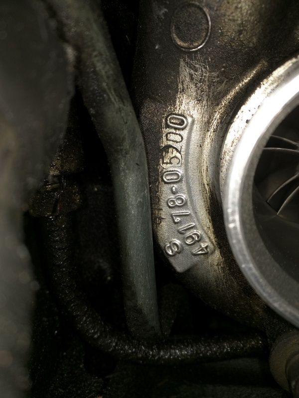

The engine in the car at the time, looked stock, and we had been told by the PO that it was a "JDM" motor that had been swapped in (little did I know this was NOT the case, I would later find the real origins of this engine). This thing was leaking oil from every possible place it seemed and the entire engine bay was covered in grime.
The infamous timing belt groove from the wrong oil pan bolts:
A pleasant surprise when I found a small 16g!

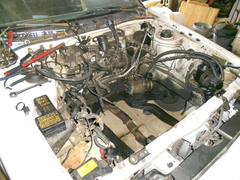

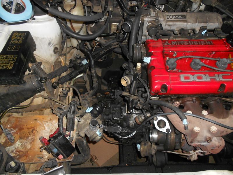

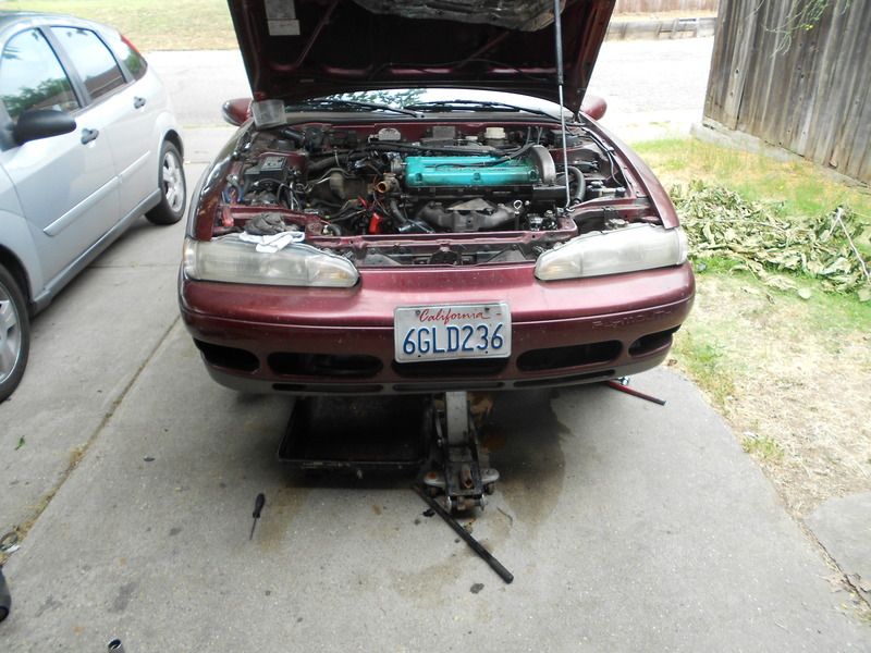

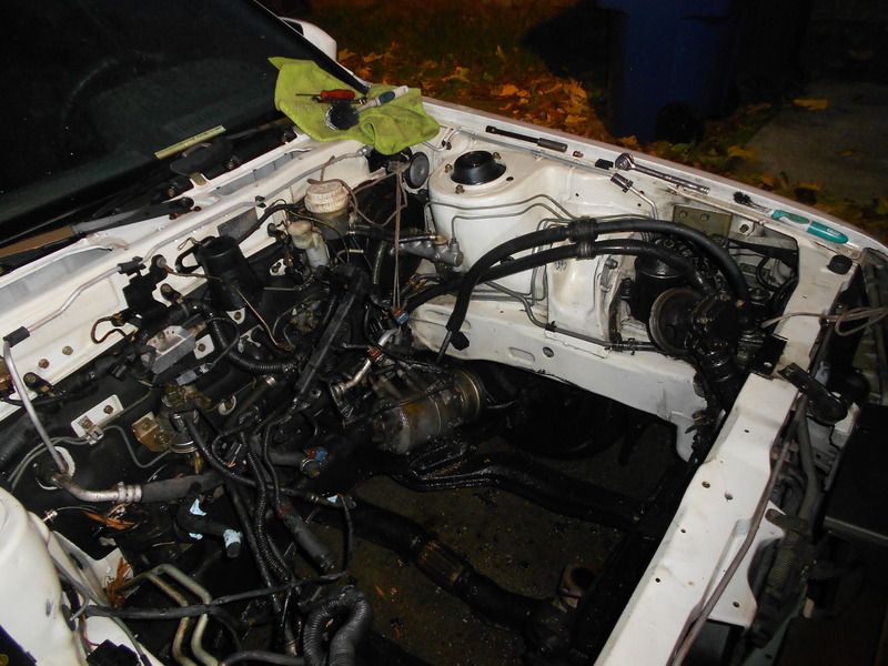

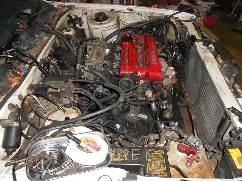

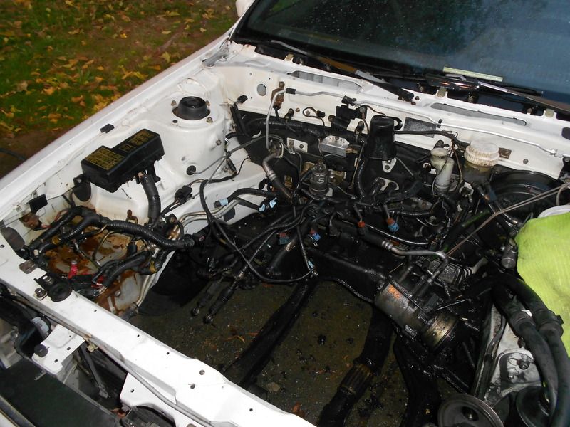

Tearing it apart, this engine bay was the worst!
The old engine removed
Did I mention there was oil EVERYWHERE!!!
A lot of cleaning ahead of me:
Some progress in cleaning, trying to shine up this turd:

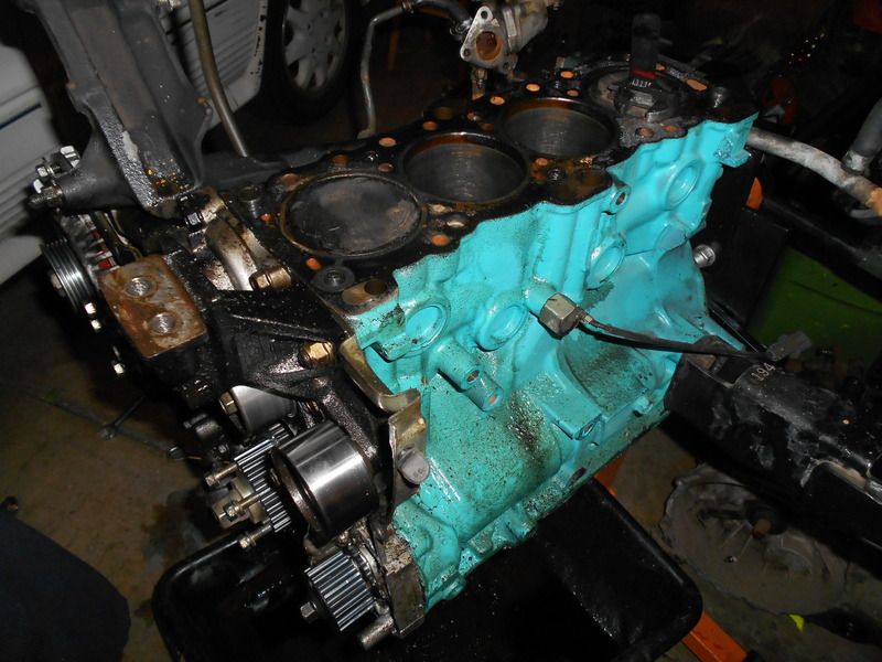

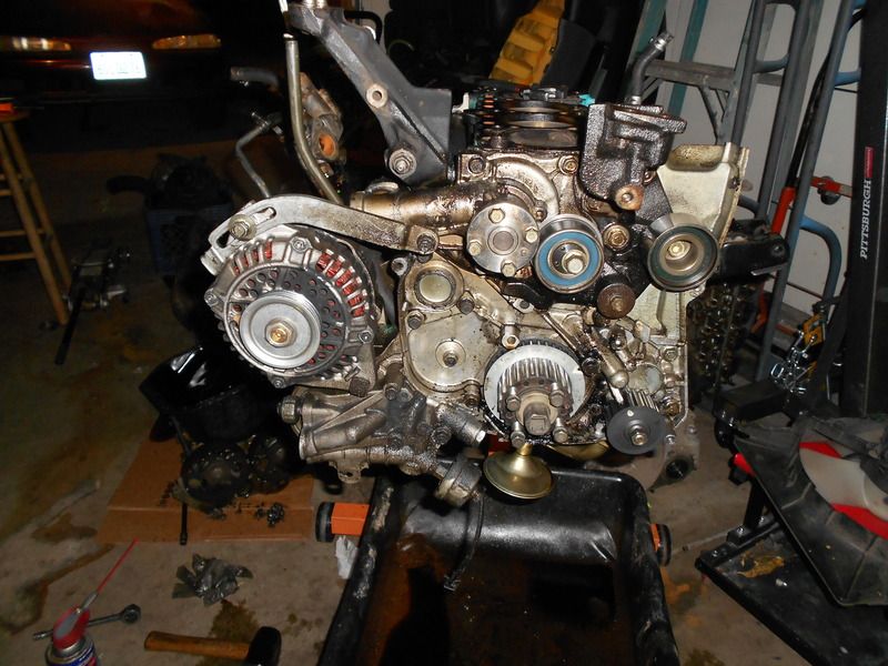

So I got the engine out and wanted to see what caused the zero compression so I began taking apart the engine.

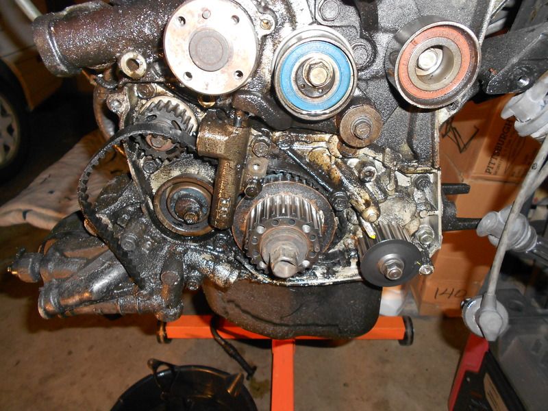

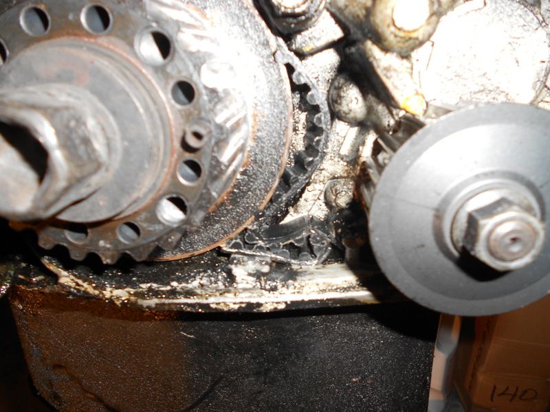

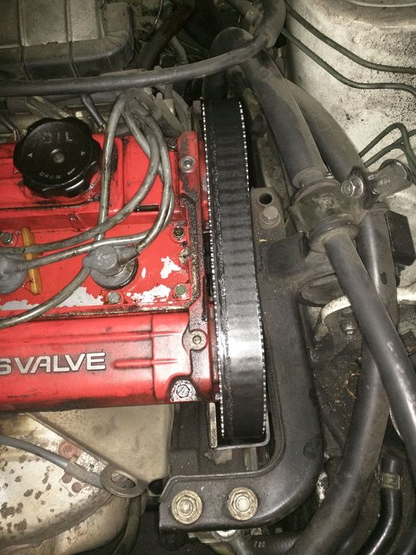

First, once I got the front cover off, I noticed something weird with the balance shaft belt...
closer...
Balance shaft belt snapped and got caught up, it didnt take out the timing belt thankfully, I have no clue how long it was running like this.

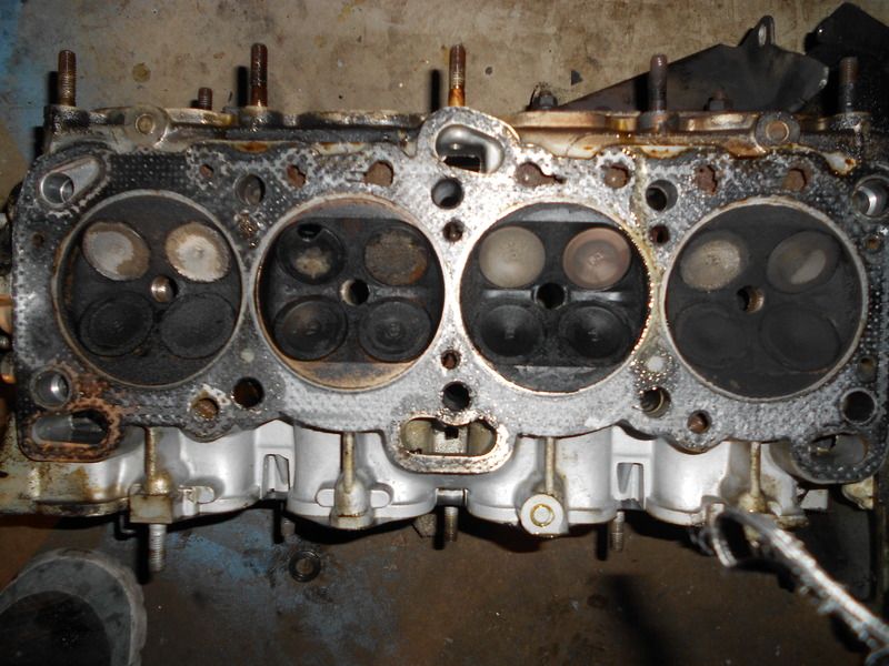

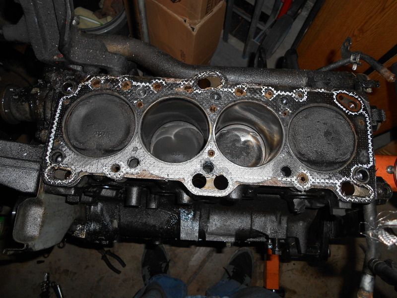

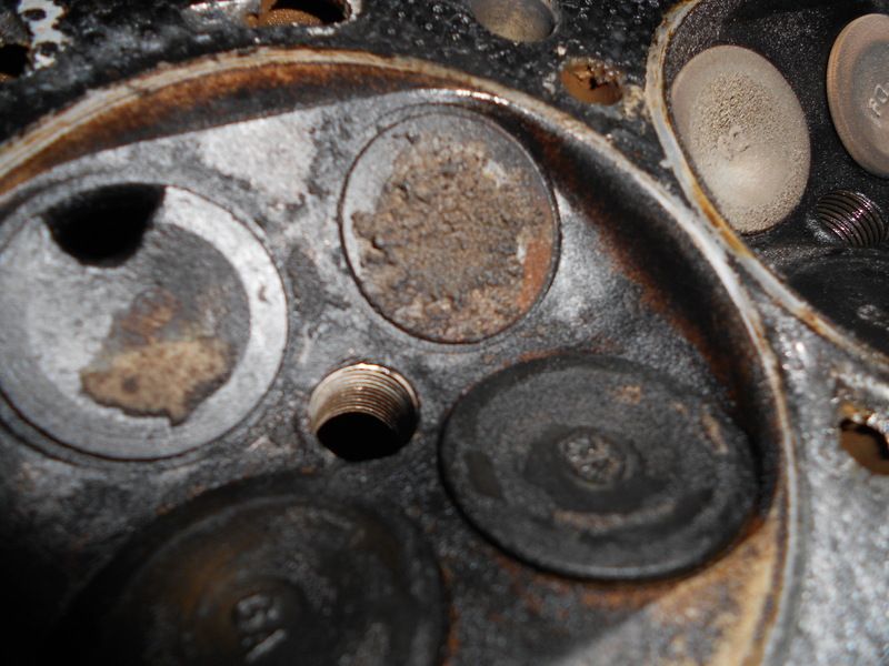

Next I got the head off and found exactly what was wrong:
Well there's my problem! A huge chunk missing from one of the valves! I figured the turbo would be damaged from the piece making its way out, but there is no evidence of the piece damaging anything so I got lucky. The rest of the block looked ok, and I thought about just fixing the head and getting all new gaskets and calling it good but I soon found some interesting evidence.
Not pictured, but I determined that the engine had been rebuilt at some point which was cool, but then I realized whoever rebuilt it, used a Hyundai N/A block with no oil squirters. It seems that they at least used turbo pistons but at this point I felt better sourcing a turbo short block if possible.

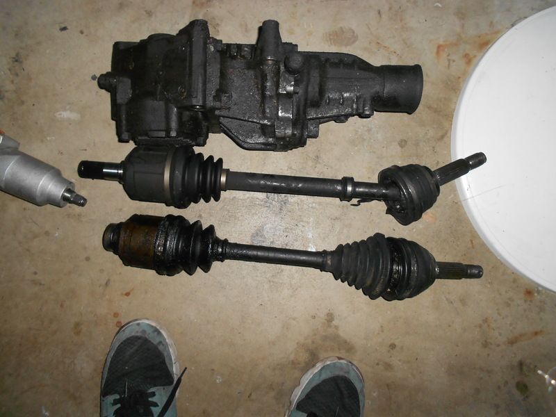

My friend sends me a craigslist link for an AWD Laser that had the transfer case lock up and the car was stranded in a neighborhood, the owner had no means of working on it and basically needed to sell it for anything, or it was getting towed and would get nothing. After buying it and getting it towed to my friends shop, we threw in my transfer case and the car was off and driving. The Laser had some upgrades that would save me a little money on top of having a good running engine. We got the car to my place and I proceed to pull the engine.

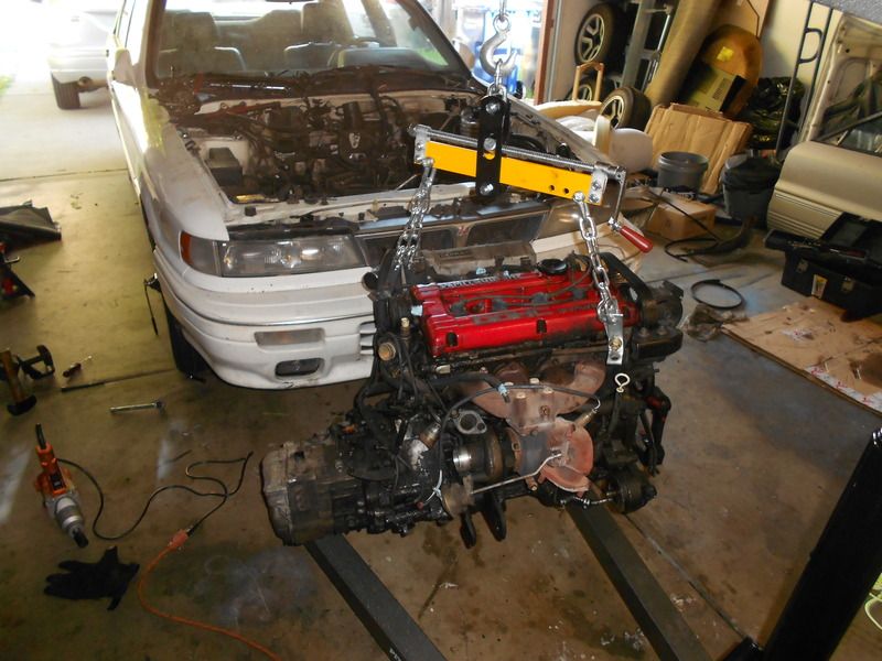

The engine had good compression and ran well when it was in the car, but while it was out I put all the stuff I had gotten for the other block. I installed ARP head studs, OEM head gasket, balance shaft delete, Evo 9 timing belt, all new OEM gaskets. I got the engine all cleaned up, but did not feel like stripping this ugly blue from the block.

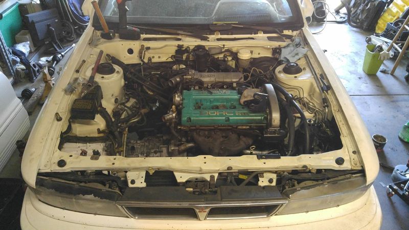

After getting the engine back together I got it into the galant:
Progress is slow when you have a child, so I can only get a little bit done at a time!

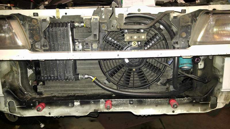

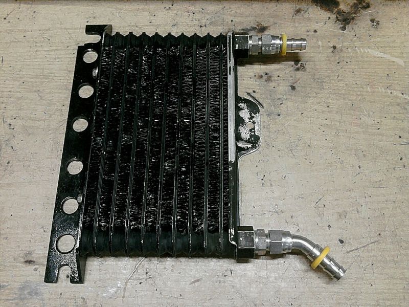

So I planned on installing an external oil cooler from a 90 DSM, while testing locations with the bumper off, I noticed something weird with the factory intercooler. I took off the pipes and was greeted to this:
The really bad side had the piping barely holding on, and I am sure there was a boost leak. I have no clue how there could have been damage like this, as there is no evidence of any sort of impact anywhere else. After weighing my options, my friend insisted on just going with an upgraded front mount, this would slow progress down quite a bit.
While we sorted out what to do with the intercooler, my friend had a crazy idea of how to mount the oil cooler:
We made a bracket that mounted to the AC condenser, and would have air flow from the radiator fan.

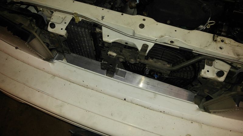

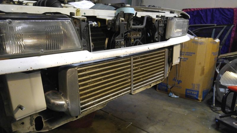

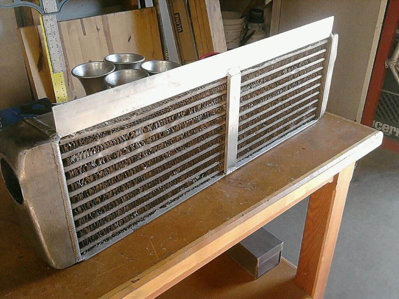

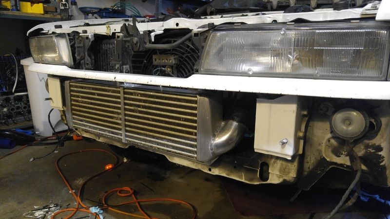

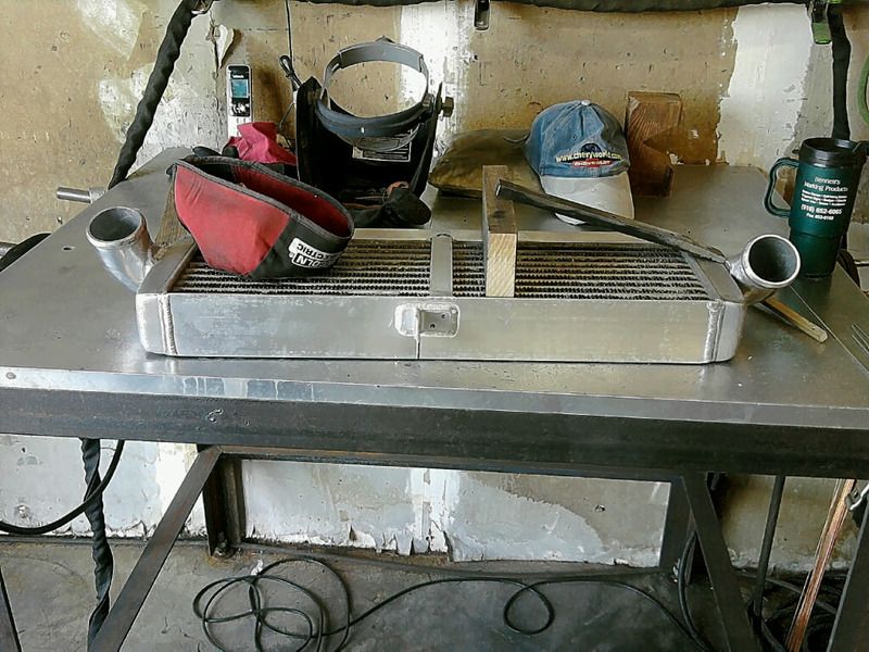

Ok on to the front mount! My friend pulled a kit off of a Talon that he was working on that had a Greddy core and a bunch of lovely blue piping. After some mock up we determined that we would be able to make it work, it ended up being a ton more work than we anticipated.
This is what we started with, here we are checking to see if it will even fit:
We wanted to make it short route, so I clearanced this area as much as I could, it ended up being plenty of room:

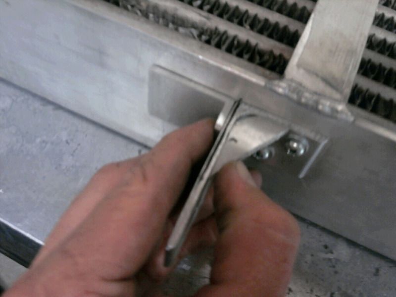

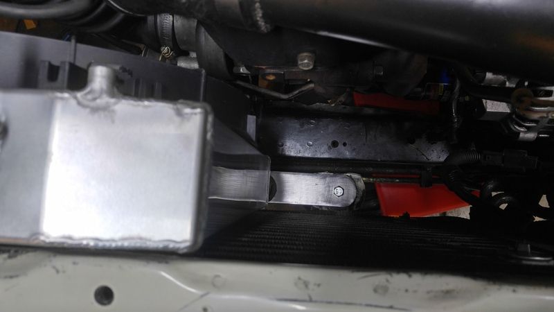

Mounting was actually pretty easy, seeing as the Galant has a bunch of threaded holes for us to use. We decided on using angle aluminum welded to the bottom for mounting and use suspension bushings as isolators:
To gain maximum clearance we removed the hood latch support, and integrated it into the actual intercooler, providing the support, and an upper mounting point for the intercooler. We mocked it up, then had it welded on.

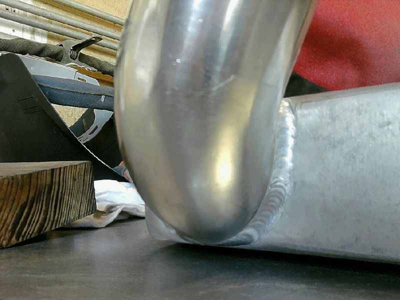

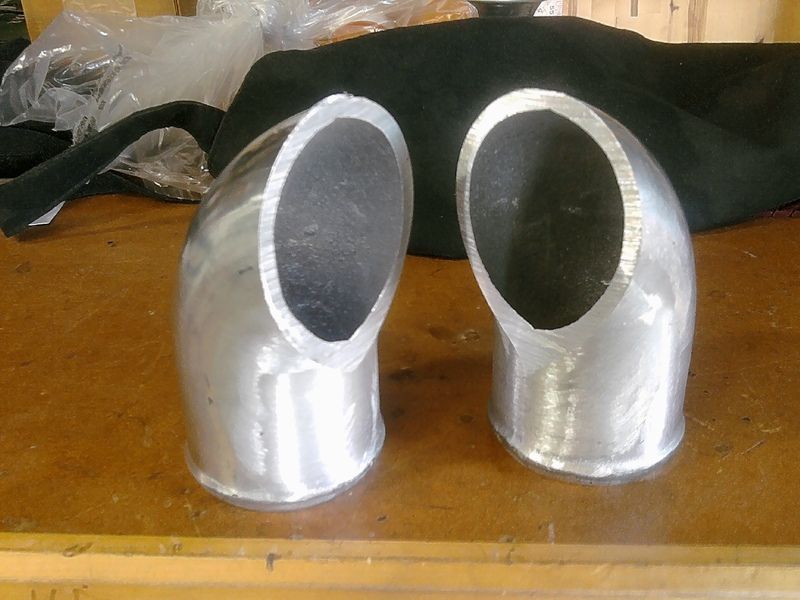

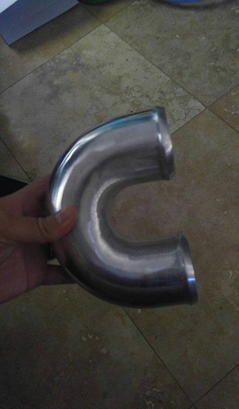

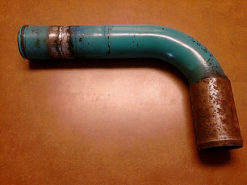

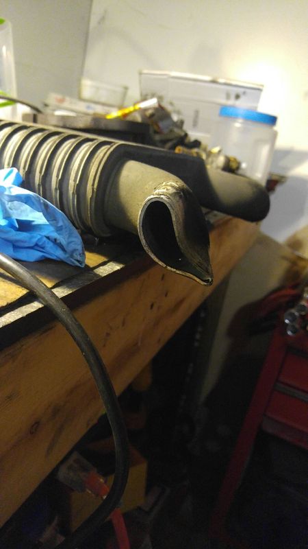

We needed the inlet and outlet to be completely different from what the intercooler had, so I bought this:
We needed tight bends, so we cut this U in half to make the inlet and outlet. After mocking it up many times we finally committed to welding it:

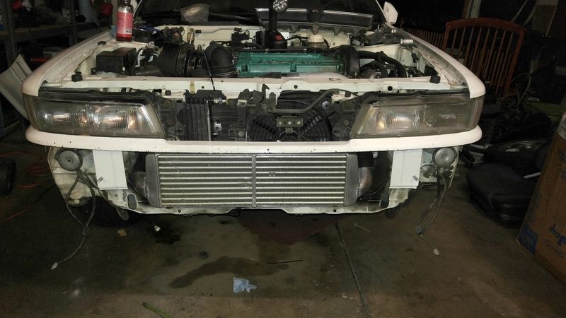

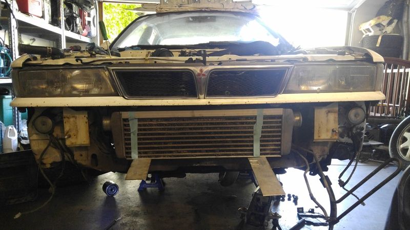

We got the intercooler mounted:
The best part about how me mounted it? No trimming was required to fit the bumper! we didnt really plan on this, but when we decided to do a test fit we were amazed that it clears with no trimming.

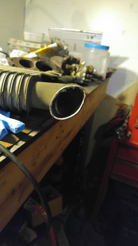

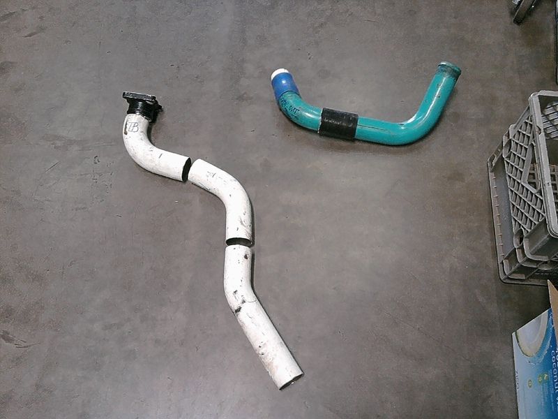

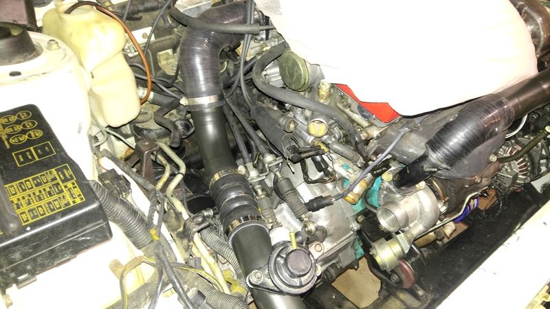

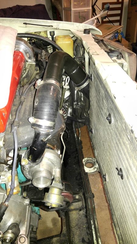

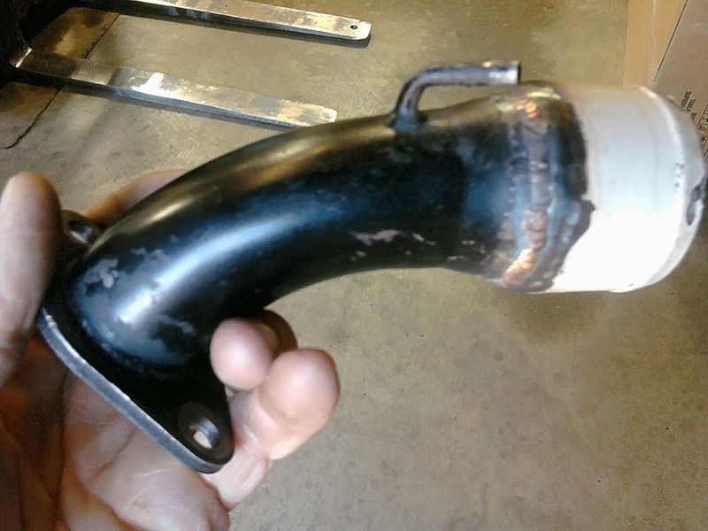

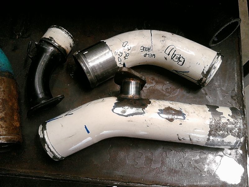

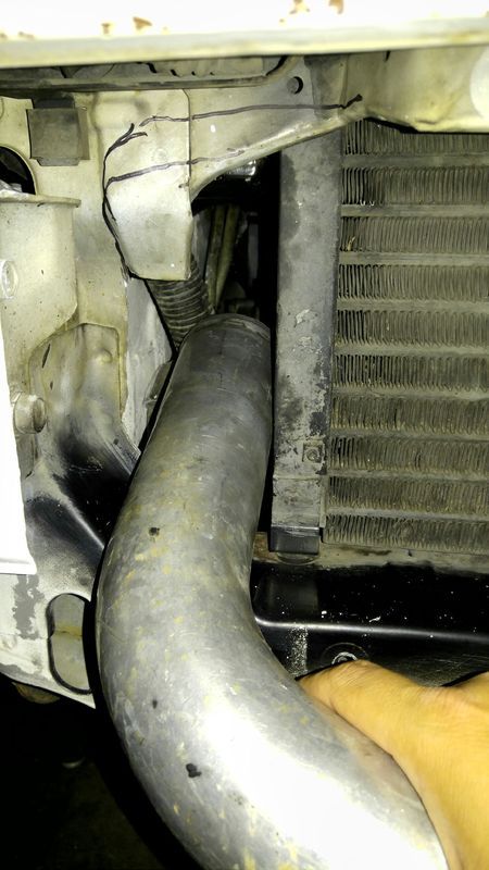

Now that we had the intercooler sorted out, we had to figure out the piping situation. We had the stuff that was used on the DSM we got the intercooler from, my friend got a couple pieces from someone else, and brought over his crate full of couplers. We mocked up a bunch of times and pieced together what would work with the parts on hand. One of the issues was that the piping was different diameters. The green stuff was like 60mm, same with the white pieces, while we were using 2.5 inch on the intercooler.

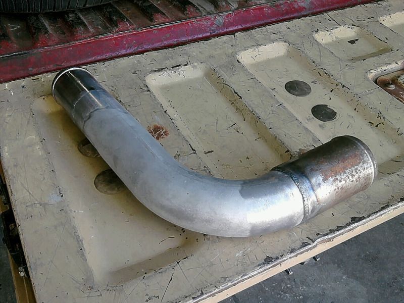

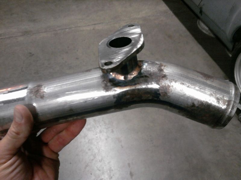

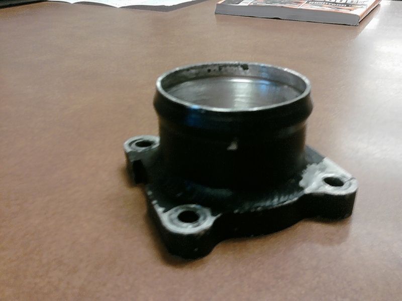

Welded on a wider piece to the turbo outlet:
basically what we started with:

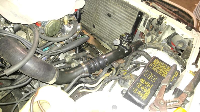

Some work on the hot site pipe:

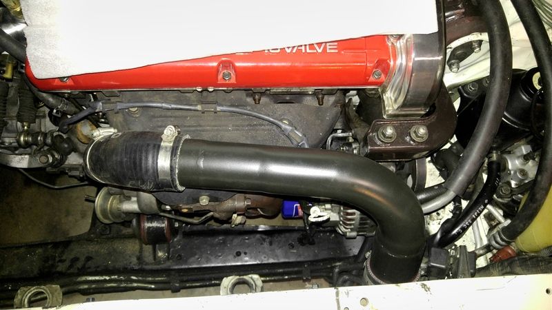

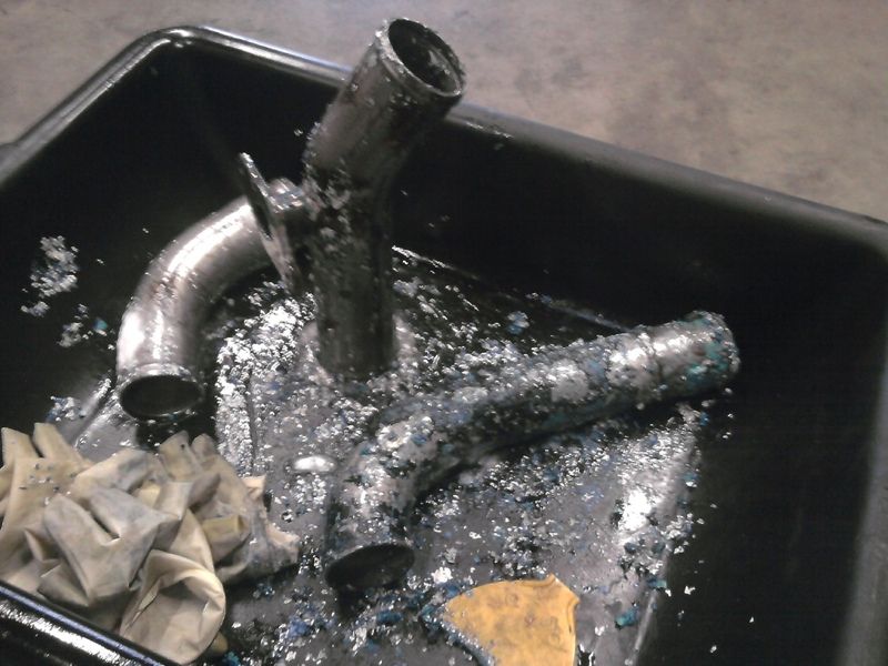

Once we were confident with the placement of the placement of the piping, we needed to strip it from all its ugly paint. The blue stuff had at least 4 layers and the white had like 3:
I painted the piping matte black, to keep it as stealth as possible, and only used black couplers. Once it was all said and done, it looks pretty nice, and would be hard to tell its not factory at a glance.
A quick mock up with the stock intake:

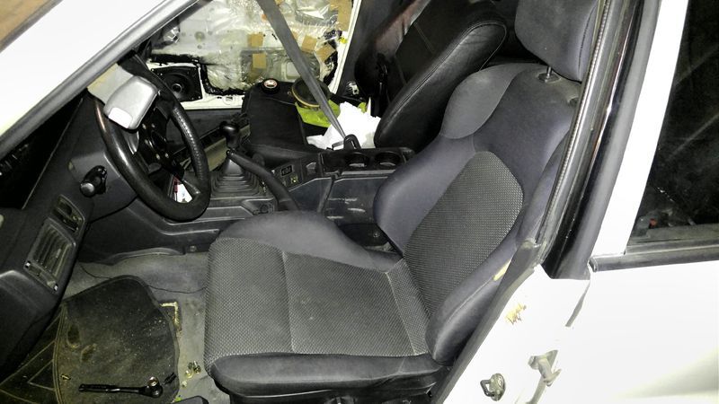

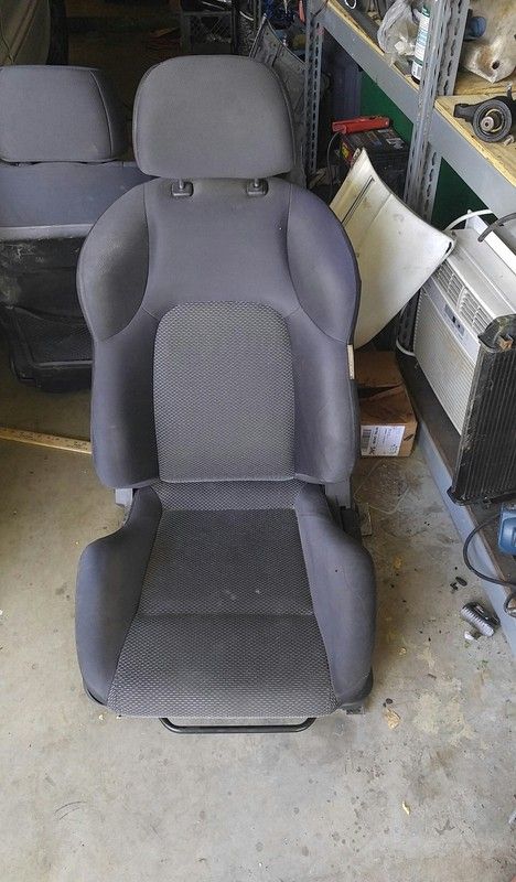

A couple months ago it was 50% off day at Pick and Pull and they happened to have a white Galant I was hoping to steal some body panels off of. Unfortunately the main thing I wanted (Drivers fender) was damaged almost in the same way mine is so I struck out there.
While browsing the random cars in the lot I came across some early 2000's Hyundai Tiberon and noticed the seats looked very nice and were in great shape. Being it was the 50% off day, they were having a special that all seats were $15 each, so I said screw it and grabbed them.
They look like they will work nicely with some brackets, much easier on the wallet than the Evo seat conversion.
Welcome to the forums. I like the recent influx of new Galant VR-4 owners I've seen here lately.
You should start off by building a profile for your car: http://www.dsmtuners.com/threads/welcome-to-dsmtuners-now-go-create-a-dsm-profile.499707/
I'd recommend registering for an account on http://www.galantvr4.org/ if you haven't already. It's a good source of information for Galant VR-4 owners. It's also a great resource for parts.
Those seats look right at home in the Galant. Not bad for $30 bucks!

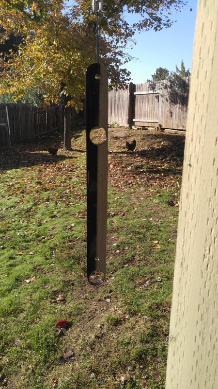

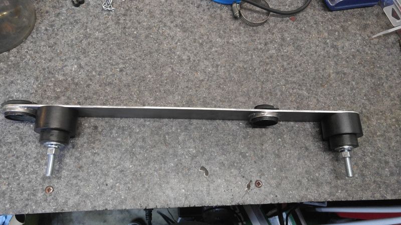

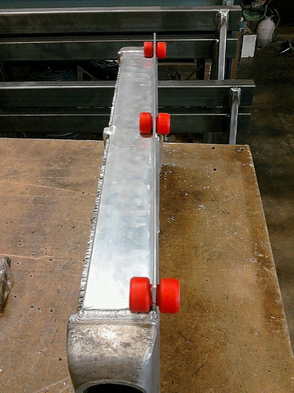

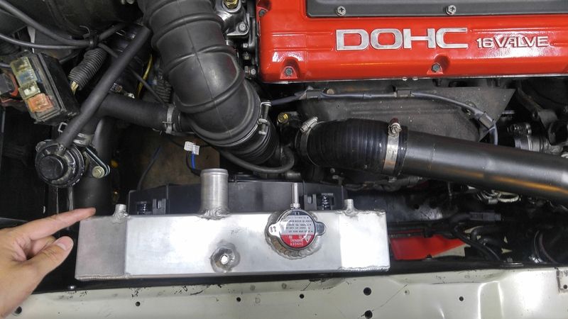

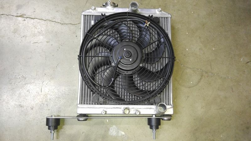

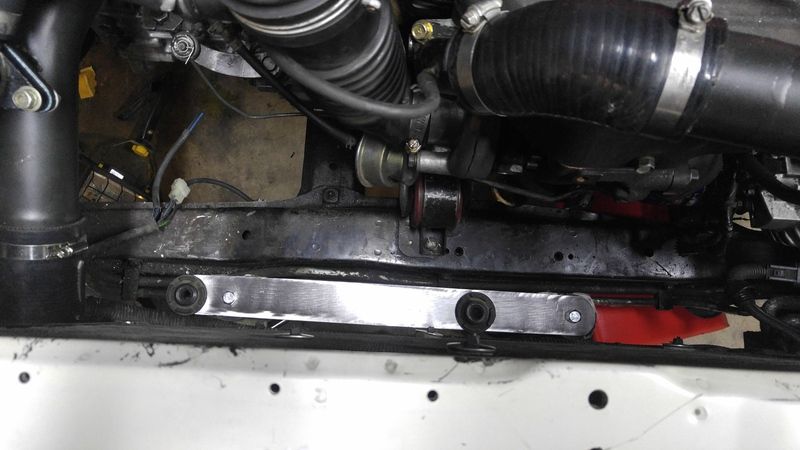

Finally had some time to work on the Galant, this time I was sorting out the radiator. Because of the intercooler piping route, I have gone with a triple core Honda half size radiator. I did a bit of searching and quite a few people have successfully ran this radiator so I am giving it a shot.

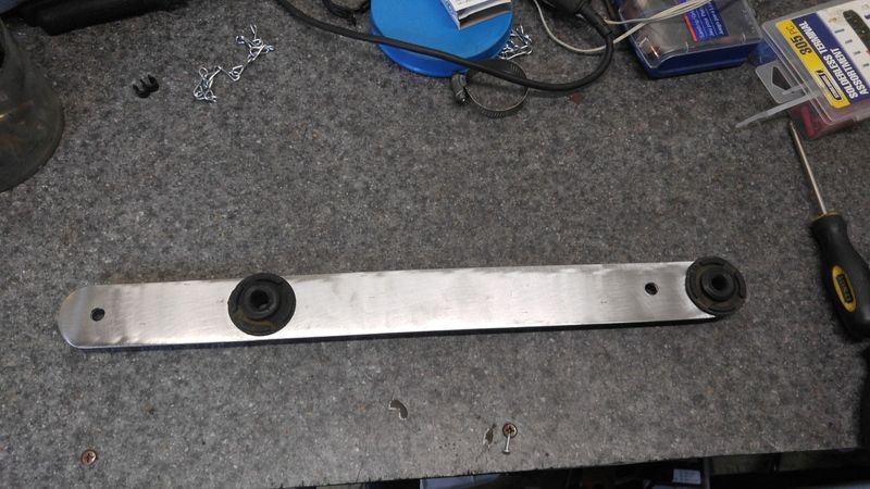

I needed to get it to sit at the correct location, and to do this my friend and I made a bracket that would shift the radiator over while utilizing the stock mount points.

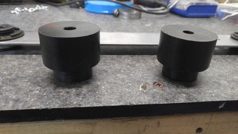

My friend made these risers out of UHMW plastic:
We took some bar stock and made this:
Placed into the car:
To give you a better shot of how it all works:
After test fitting it I gave it a few coats of black paint to ward off rust:

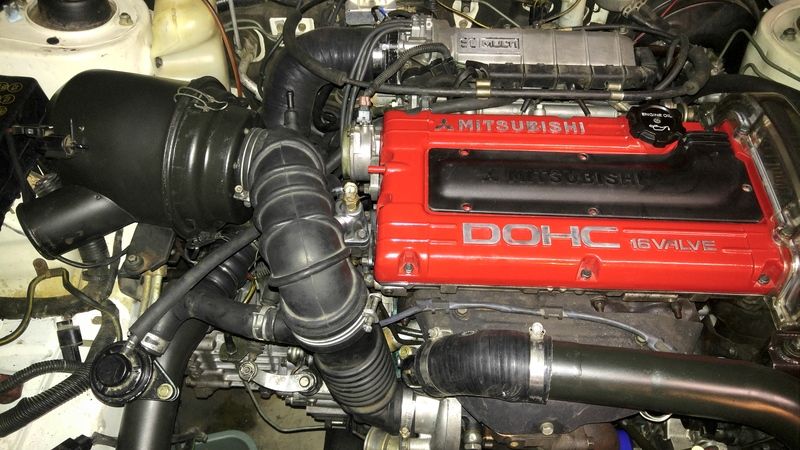

After getting it all in place I was able to fill it and test it out, the car officially runs, and I am squashing bugs as I find them. First there was a rattle coming from the water pump, turns out I forgot to tighten the pulley bolts. Then the power steering was leaking, replaced the O-Rings. Then there were at least 3 coolant leaks, I have to wait for it all to cool down before I tackle some of those. Then to top it off, the radiator fan did not turn on, not sure what went wrong there, my wiring or the sensor maybe...
In any case, this is a nice sight to see:
It idles pretty steady, but stumbles when you rev it and let it drop. I have to check the timing once I get the cooling sorted out.
