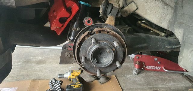

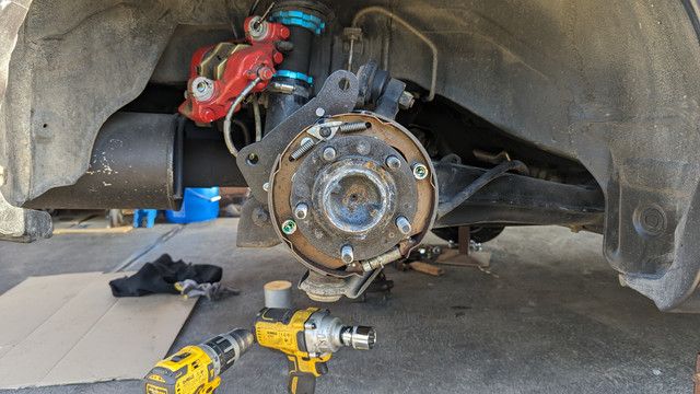

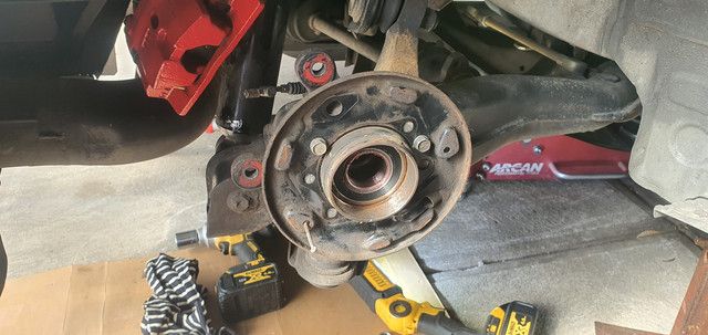

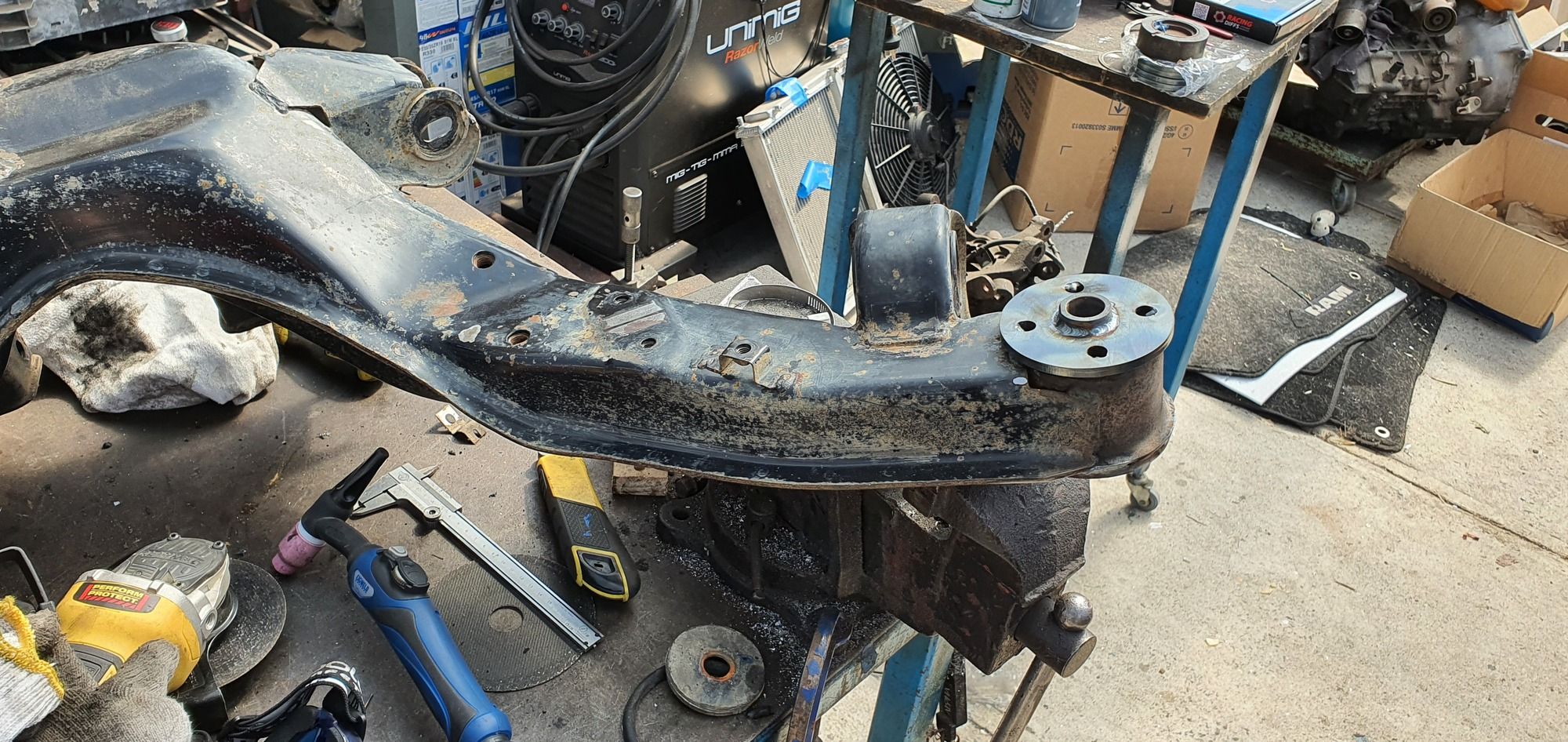

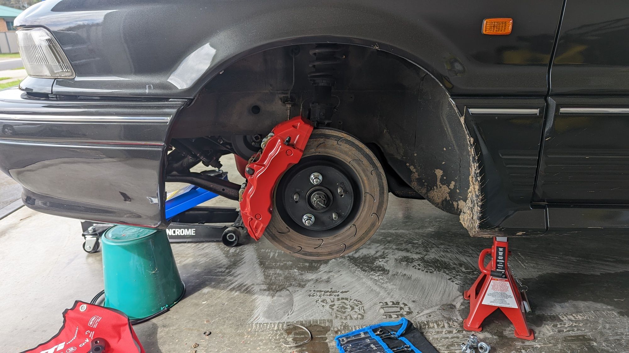

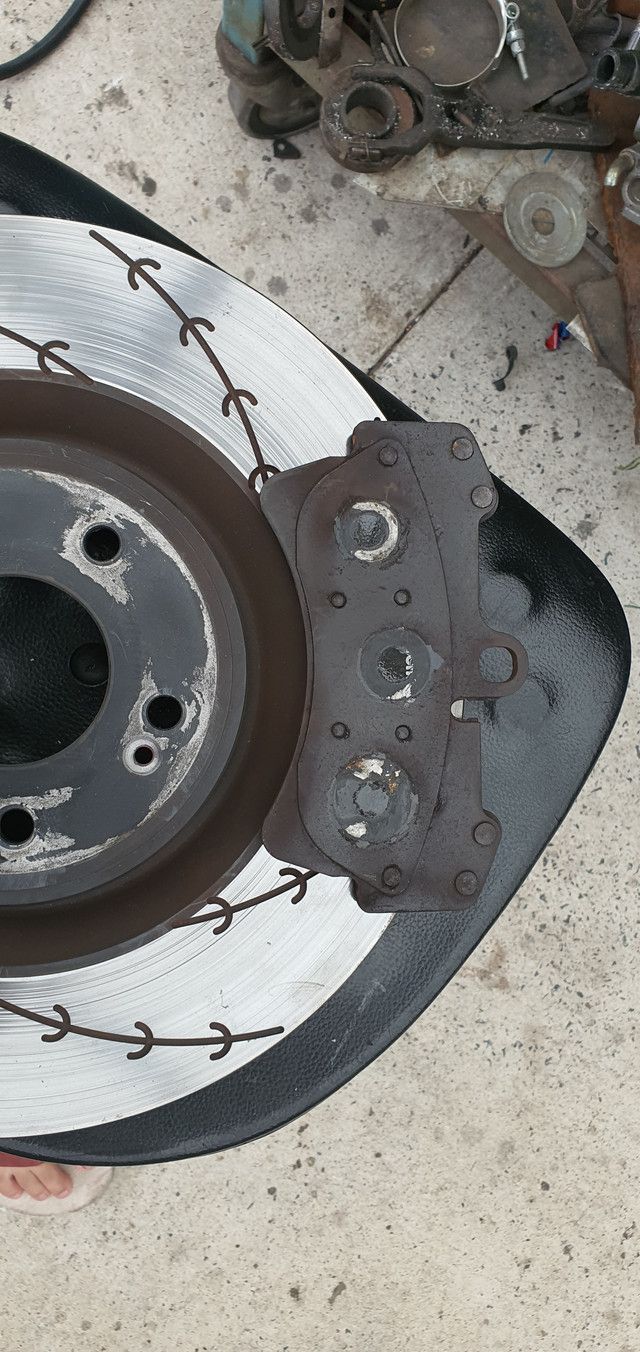

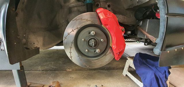

Handbrake set up..

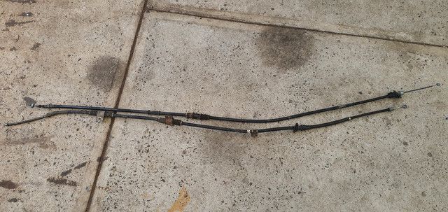

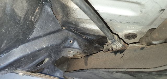

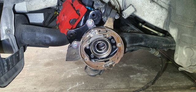

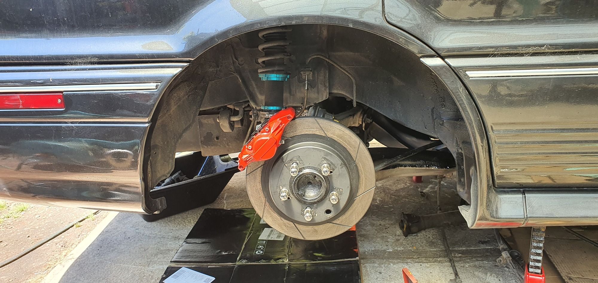

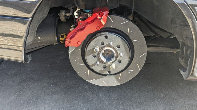

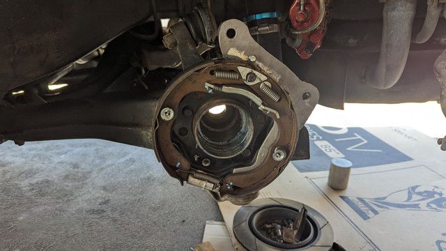

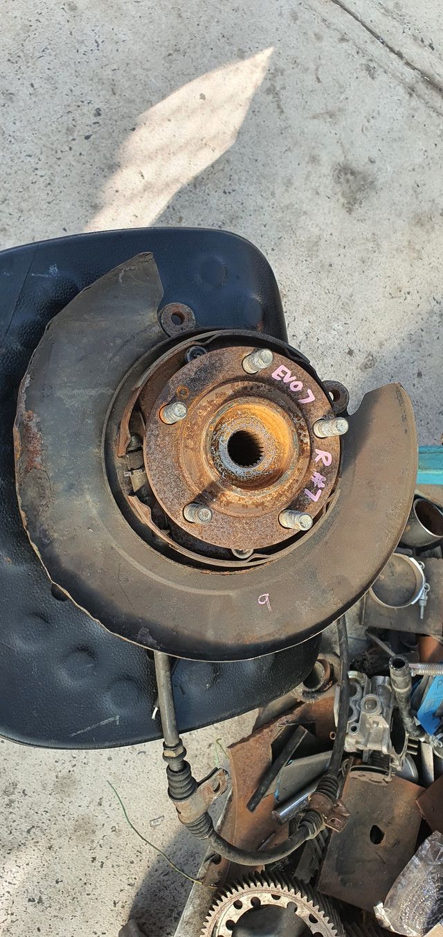

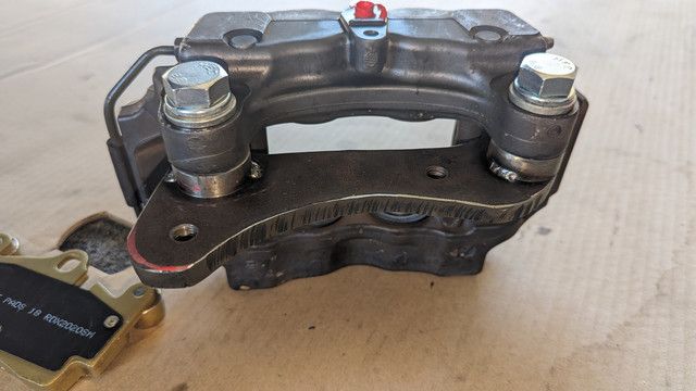

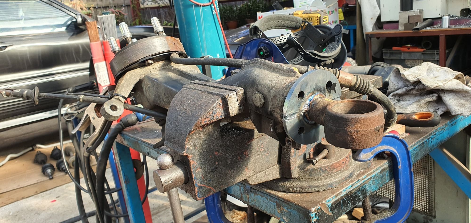

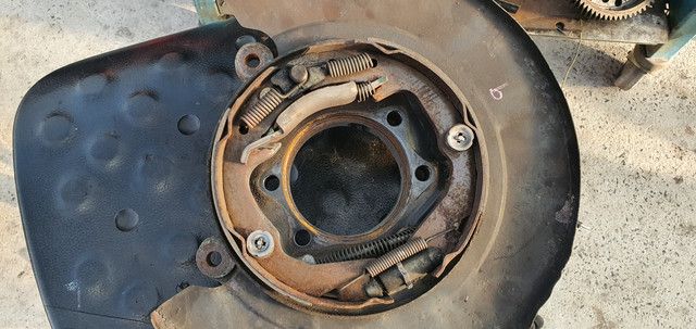

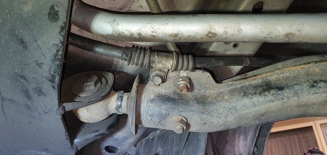

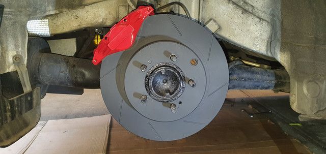

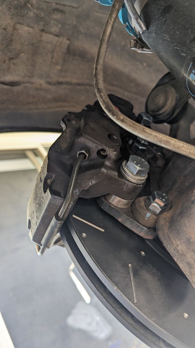

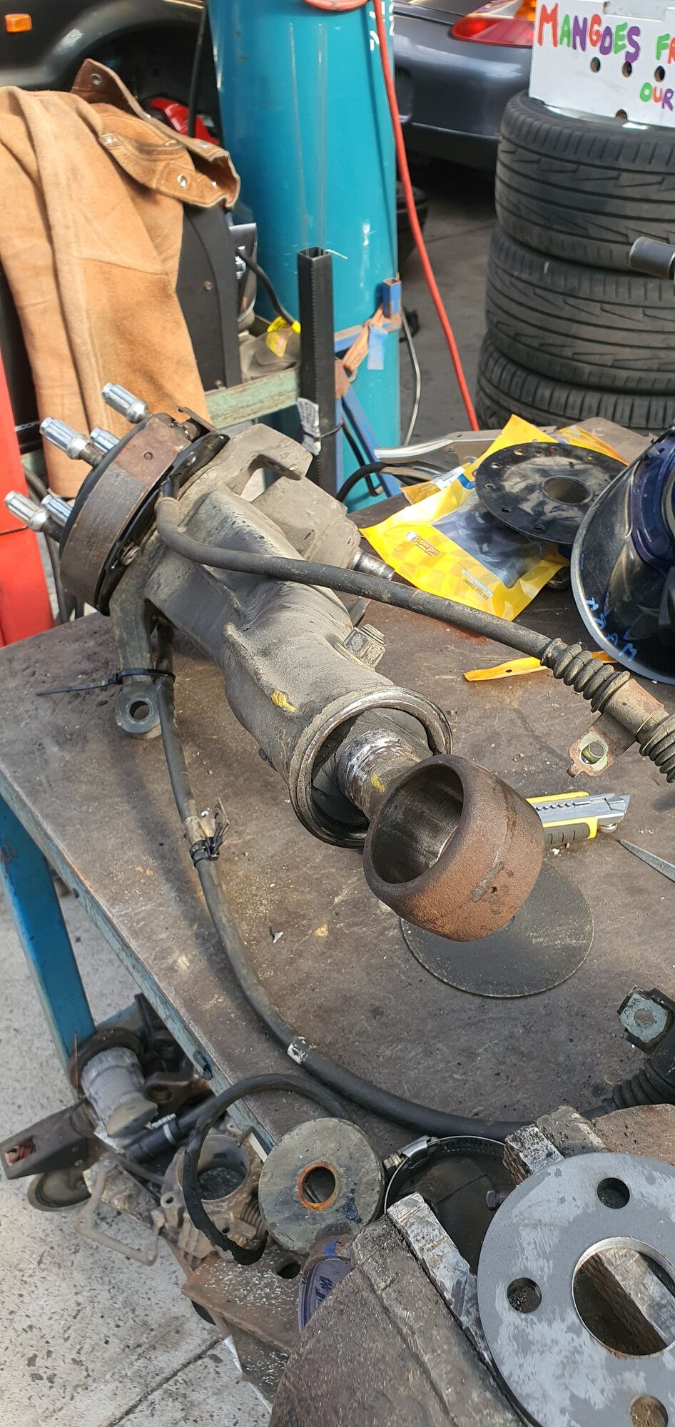

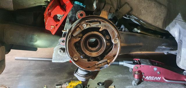

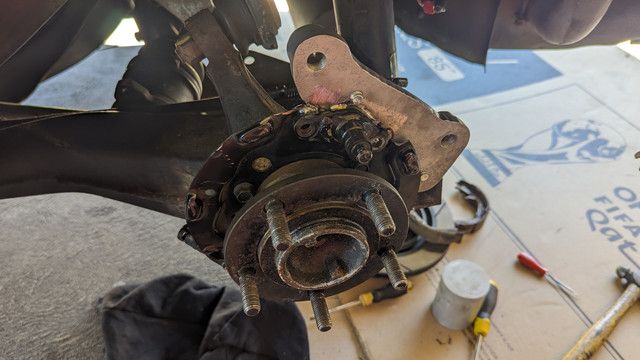

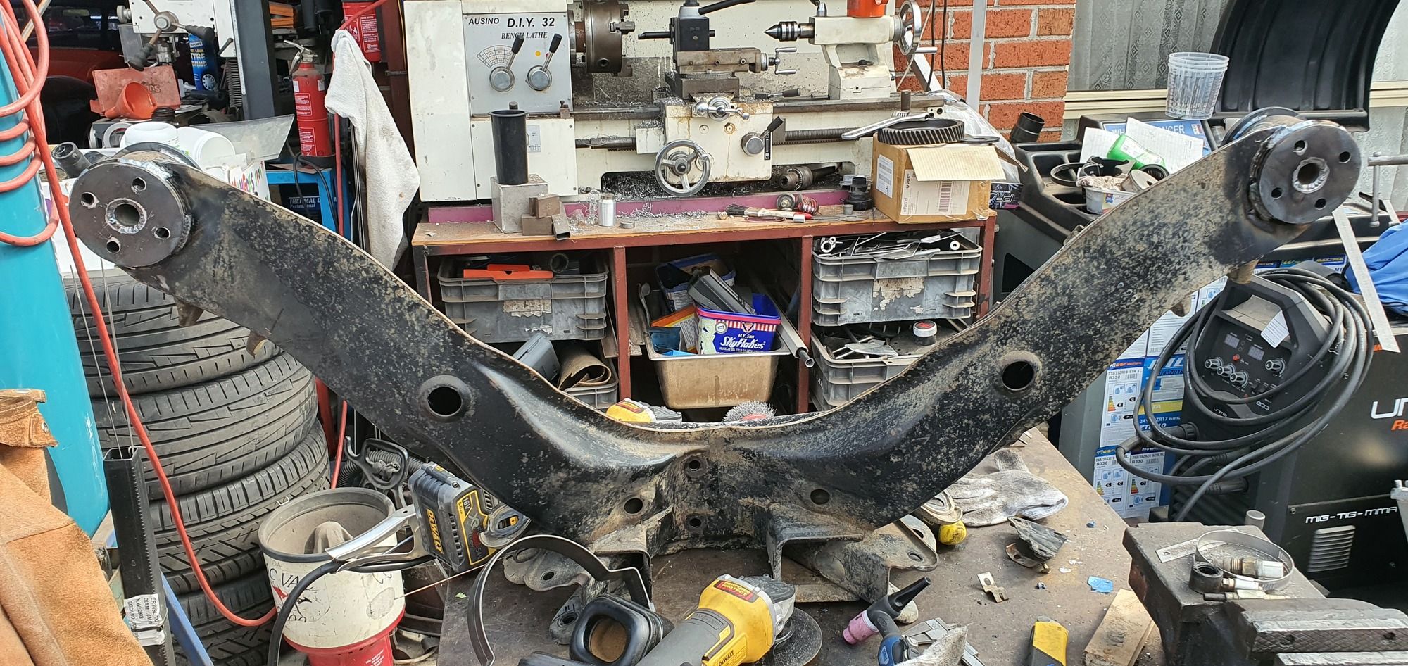

CT9a hand brake assembly modified to bolt onto stock galant rear trailing arm.

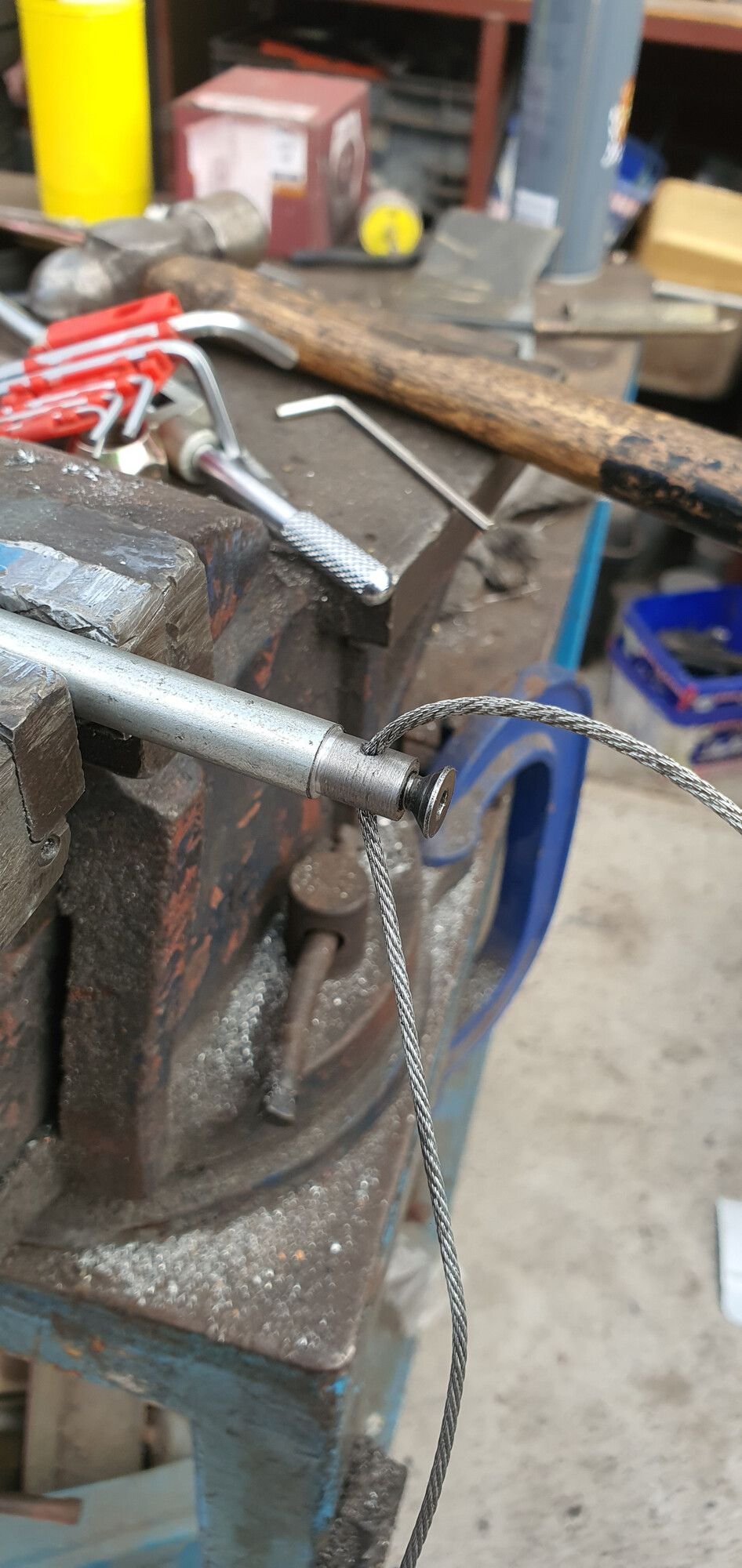

Need to figure out hand brake cables.
(will update more photos later on)
Stock ct9a complete rear hub
Mock up

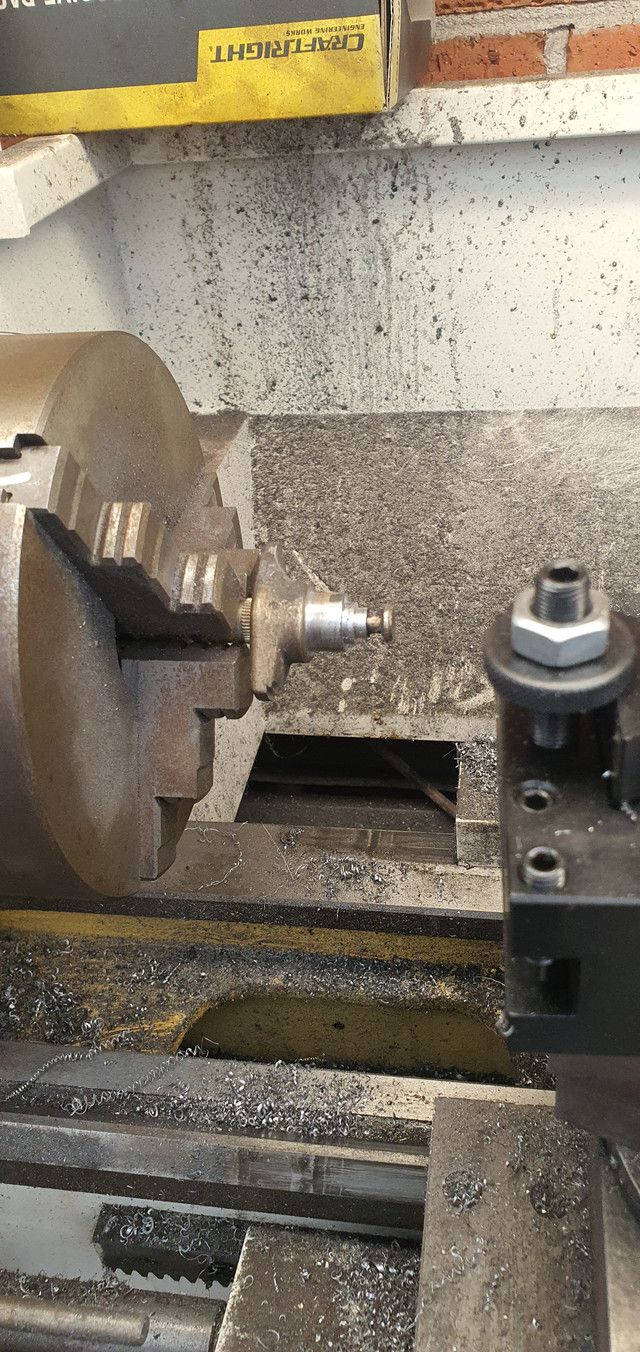

Machining

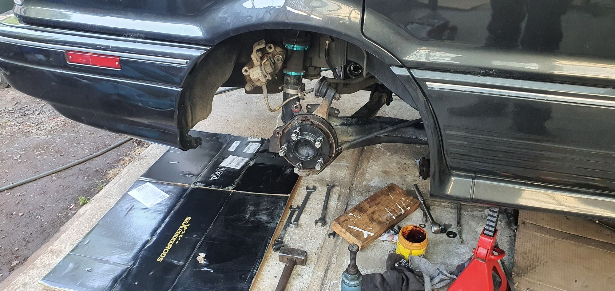

Test fitting
Mock up
Machining
Test fitting
